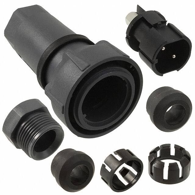

7000 Series Buccaneer The all plastic and metal construction of the 7000 Series Buccaneer - circular connectors that combine the ease of use of a quick coupling mechanism with proven environmental sealing for signal and mains power. Designed and independently tested to IP66, IP68 & IP69K standards, they are ideal for applications where ingress of dust and water must be avoided and where ease of connection, space and appearance are important considerations. Less than 1/4 Turn locking mechanism Secure, quick connector mating and release Positive feedback on locking mechanism Confidence that connector is correctly mated and sealed IP66, IP68 and IP69K when mated Suitable for a wide range of dust and water borne environments All plastic body version; UL94-V0 rated, UV stable, halogen free Light-weight, self-extinguishing material suitable for long-term outdoor use Flex, Inline & panel mount body styles,with sealing caps Complete family of products maintain sealing integrity in all styles Polarisation and visual alignment features Aids the correct mating of connectors 2 to 32 Contacts – up to 25A, 600V rated Suitable for mains power to signal applications ‘Scoop proof’ contacts Prevents damage through mis-mating – ideal for ‘blind mating’ applications cULs, UL, approvals Internationally recognised certification (pending) Screw, Crimp and Solder terminations available EN60068-2-52 Test Kb Salt Mist (Cyclic) Marine Severity Level 1 Circular Power Connectors 55 BUCCANEER FOR POWER 7000 Series Buccaneer Thermo Plastic Flex Cable Connector Mates with Inline or Panel Mounting versions PXP7011 & PXP7012 Quick turn locking ring Plug or socket versions Leading earth on 3 Contact connectors 2, 3, 6, 10 & 32 Contact Screw solder and crimp termination PXP7010 Contacts 2 3 6 10 32 Termination Screw Screw Screw Crimp / Solder Crimp / Solder Plug Contacts PXP7010/02P/ST PXP7010/03P/ST PXP7010/06P/ST PXP7010/10P/CR PXP7010/32P/CR Socket Contacts PXP7010/02S/ST PXP7010/03S/ST PXP7010/06S/ST PXP7010/10S/CR PXP7010/32S/CR Contacts Supplied Fitted Supplied Fitted Supplied Fitted Contact Required Contact Required Inline Cable Connector Mates with Flex Cable connector PXP7010 For Inline cable connection Plug or socket versions Leading earth on 3 Contact connectors 2, 3, 6, 10 and 32 Contact Screw solder and crimp termination PXP7011 Contacts 2 3 6 10 32 Termination Screw Screw Screw Crimp / Solder Crimp / Solder Plug Contacts PXP7011/02P/ST PXP7011/03P/ST PXP7011/06P/ST PXP7011/10P/CR PXP7011/32P/CR Front Panel Mounting Connector Socket Contacts PXP7011/02S/ST PXP7011/03S/ST PXP7011/06S/ST PXP7011/10S/CR PXP7011/32S/CR Contacts Supplied Fitted Supplied Fitted Supplied Fitted Contact Required Contact Required Mates with Flex Cable connectors PXP7010 Single hole fixing Plug or socket versions Leading earth on 3 Contact connectors 2, 3, 6, 10 and 32 Contact Screw solder and crimp termination PXP7012 Contacts 2 3 6 10 32 Termination Screw Screw Screw Crimp / Solder Crimp / Solder 56 Circular Power Connectors Plug Contacts PXP7012/02P/ST PXP7012/03P/ST PXP7012/06P/ST PXP7012/10P/CR PXP7012/32P/CR Socket Contacts PXP7012/02S/ST PXP7012/03S/ST PXP7012/06S/ST PXP7012/10S/CR PXP7012/32S/CR Contacts Supplied Fitted Supplied Fitted Supplied Fitted Contact Required Contact Required BUCCANEER FOR POWER 7000 Series Buccaneer Metal Version Flex Cable Connector PXM7010 Contacts 2 3 6 10 32 Termination Screw Screw Screw Crimp / Solder Crimp / Solder Mates with Inline or Panel Mounting versions PXM7011 & PXM7012 Quick turn locking ring Plug or socket versions Leading earth on 3 Contact connectors 2, 3, 6, 10 & 32 Contact Screw solder and crimp termination Cable braid termination accessory option, add /SNsuffix Plug Contacts PXM7010/02P/ST PXM7010/03P/ST PXM7010/06P/ST PXM7010/10P/CR PXM7010/32P/CR Socket Contacts PXM7010/02S/ST PXM7010/03S/ST PXM7010/06S/ST PXM7010/10S/CR PXM7010/32S/CR Contacts Supplied Fitted Supplied Fitted Supplied Fitted Contact Required Contact Required Inline Cable Connector Mates with Flex Cable connector PXM7010 For Inline cable connection Plug or socket versions Leading earth on 3 Contact connectors 2, 3, 6, 10 and 32 Contact Screw solder and crimp termination Cable braid termination accessory option, add /SNsuffix PXM7011 Contacts 2 3 6 10 32 Termination Screw Screw Screw Crimp / Solder Crimp / Solder Plug Contacts PXM7011/02P/ST PXM7011/03P/ST PXM7011/06P/ST PXM7011/10P/CR PXM7011/32P/CR Socket Contacts PXM7011/02S/ST PXM7011/03S/ST PXM7011/06S/ST PXM7011/10S/CR PXM7011/32S/CR Contacts Supplied Fitted Supplied Fitted Supplied Fitted Contact Required Contact Required Front Panel Mounting Connector Mates with Flex Cable connectors PXM7010 Single hole fixing Plug or socket versions Leading earth on 3 Contact connectors 2, 3, 6, 10 and 32 Contact Screw solder and crimp termination PXM7012 Contacts 2 3 6 10 32 Termination Screw Screw Screw Crimp / Solder Crimp / Solder Plug Contacts PXM7012/02P/ST PXM7012/03P/ST PXM7012/06P/ST PXM7012/10P/CR PXM7012/32P/CR Socket Contacts PXM7012/02S/ST PXM7012/03S/ST PXM7012/06S/ST PXM7012/10S/CR PXM7012/32S/CR Contacts Supplied Fitted Supplied Fitted Supplied Fitted Contact Required Contact Required Circular Power Connectors 57 BUCCANEER FOR POWER 7000 Series Buccaneer Accessories Crimp / Solder Contacts Gold Plated Current ratings: 10 Contact: 10A 32 Contact: 2A 10 & 32 Contacts Crimp Tooling Contacts (for 10 Contact) (Supplied in packs of 10) Plugs Sockets Contacts (for 32 Contact) (Supplied in packs of 10) Plugs Sockets Crimp Solder SA3544/P SA3544/S SA3623/P SA3623/S Crimp Solder SA3542/P SA3542/S SA3622/P SA3622/S Crimp Tooling Crimp Tools for 10 and 32 Contact crimp contacts Crimp Tool (10 & 32 Contact) PNo. 14025 Positioner (10 Contacts) PNo. 15021/SP Positioner (32 Contacts) PNo. 15019/SP PNo 14025 Extraction Tools Extraction Tools Extraction tool for 10 and 32 Contact contacts PNo 14944/SP Extraction tool (10 Contacts) Extraction tool (32 Contacts) PNo. 14945/SP PNo. 14944/SP PNo 14945/SP Contact Carrier Removal Tool Contact Carrier Removal Tool Contact carrier removal tool (all Contacts) For removal of all contact carriers PNo 15065/SP Cable Braid Termination Option For cable braid termination Supplied with ty-rap PXM7090 58 Circular Power Connectors PNo. 15065/SP BUCCANEER FOR POWER 7000 Series Buccaneer Accessories Sealing Caps Maintains IP rating of unmated connectors PXP7081: Fits PXP7010 (Flex Connector) PXP7082: Fits PXP7011 (Inline Connector) and PXP7012: (Panel Connector) PXP7082 PXP7081 Sealing Caps PXM7082 PXM7081 PXM7083 Cable Gland Packs PXP7088/ * Maintains IP rating of unmated connectors PXM7081: Fits PXM7010 (Flex Connector) PXM7082: Fits PXM7011 (Inline Connector) and PXP7012: (Panel Connector) PXM7083: Fits PXM7012 (Panel Mounting Connector) Packs of cable glands, cages and gland nuts to suit cables ranges from 5.0 to 15.0mm diameter PXP7088/0507: for cable ranges between 5.0 and 7.0mm PXP7088/0713: for cable ranges between 7.0 and 13.0mm PXP7088/1315: for cable ranges between 13.0 and 15.0mm Circular Power Connectors 59 BUCCANEER FOR POWER 7000 Series Buccaneer Part No System PXX 701X XX X Series Designation Series / Body Style No. of Contacts Contacts Type PXM= Metal Series PXP= Plastic Series 7010 = Flex 7011 = Inline 7012 = Front Panel 02 03 06 10 32 P = Plug S = Socket XX XXXX Terminations Cable Entry Size Cable Brand Termination Accessory ST = Screw Terminal (2, 3, & 6 Contacts only) CR = Contacts Required (10 & 32 Contacts only) (for Flex and Inline connectors only) 0507 = 5-7mm (grey) (for Flex and Inline connectors only) 0709 = 7-9mm (white) 0911 = 9-11mm (black) 1113 = 11 to 13 mm (yellow) 1315 = 13 to 15 mm (light grey) Examples PXM7010/10/P/CR/0911/SN= Flex cable connector, 10 Contacts, Plug contacts with 9 to 11mm cable glands and braid termination accessory PXM7012/03/S/ST= Front panel mounting connector, 3 Contacts, socket with screw termination 60 Circular Power Connectors XX SN - If requires Blank - If not required BUCCANEER FOR POWER 7000 Series Buccaneer Specifications Electrical: No Contacts: Current Rating: UL cUL (pending) Voltage Rating (AC/DC): UL, cUL (pending) Contact Resistance: Insulation Resistance: AC Breakdown voltage: 2 Contacts 3 Contacts 6 to 32 Contacts Operating Temp. Range: Approvals: C US UL cULus Mechanical: 2 3 25A 25A 25A 25A 6 10 10A 10A 8A 6A 32 3A 2A 600V 600V 600V 600V 600V 10⁶MΩ @500V DC >10kV >8kV >5kV –40°C to +120°C UL1977 C22.2 No.182.3-M2016 (R2009) Locking mechanism Quarter turn, rapid locking Sealing: IP66 to EN60529:1992+A2:2013 IP68 to EN60529:1992+A2:2013 (10m depth for 2 weeks) IP69k to DIN 40050-9 Salt Mist (plastic): EN60068-2-52 Test Kb Salt Mist (Cyclic) Marine Severity Level 1 Salt Mist (metal): EN60068-2-11 Test Ka Salt Mist Contact Accommodation: 2 & 3 Contacts screw terminals 6 Contacts screw 10 Contacts crimp / solder 32 Contacts crimp / solder 6.0mm² max 1.00mm² max 18 to 20AWG 22 to 26AWG Cable Acceptance: 5-15mm dia. Cable retention force (to BS EN61984): 5 - 9mm dia cable 9 - 15mm dia cable 80N 100N Terminations 2 Contacts: 3 Contacts: 6 Contacts: 10 Contacts: 32 Contacts: Screw Terminals Screw Terminals Screw Terminals Crimp / Solder Contacts Crimp / Solder Contacts Tightening Torques: Gland Nut: Panel Nut: 1.13Nm (10lb.in) 1.7Nm (15lbf.in.) Panel Nut Thread M30 x 2-6g Dimensions: Diameter: (over coupling ring) Diameter: (panel hole cut-out) 42mm 30mm Materials: Plastic Metal Body: PC/ PBT Cast zinc alloy, nickel plated Colour: Grey Matt silver Contacts: Brass, Nickel Plate (Screw and Crimp) Brass, (3A – Gold plated) Brass, Nickel Plate (Screw and Crimp) Brass, (3A – Gold plated) O Rings & Gaskets: Silicone Silicone Flammability Rating: UL94 V-0 - Halogen free Yes - UV Resistance: ISO 4892 part 3 cycle 1 (QUV) - RoHS Compliant Compliant Circular Power Connectors 61 BUCCANEER FOR POWER 7000 Series Buccaneer Current Carrying Capacity 3 Pole, Plastic Body, Screw Terminal, 4.0mm2 wire 2 Pole, Plastic Body, Screw Terminal, 6.0mm wire 2 current applied through all pins simultaneously current applied through all pins simultaneously 40 40 30 30 Current (A) Current (A) The maximum current varies with different contact layouts, and because of these factors it is necessary to produce de-rating curves for each contact variant. This de-rating curve is specified in the standard IEC 60512 part 3. De-rating curves are plotted for each contact carrier combination with the current being carried simultaneously by all contacts. These graphs show the heat rise generated as the current is increased. 7000 Series Current vs. Temperature Characteristics 7000 Series Current vs. Temperature Characteristics The thermal properties of the materials used in the construction of a connector limit the current carrying capacity. There are a number of factors that determine the amount of current that can be handled: contact spacing, size of cable, ambient temperature and the heat that is generated by the current passing through the connector. 20 Operating Area 10 The red line indicates the direct correlation between current applied and the measured temperature rise within the connector. The dotted blue line shows rated current and the green line is derived by applying a factor of 0.8 to the original plot data to give a de-rating curve. The dashed blue line shows the rated current. 20 Operating Area 10 10 20 30 40 50 60 70 80 90 100 110 120 130 140 10 30 40 50 The shaded area under the 0.8 curve shows the permitted operating area, and allows safe current vs ambient temperature characteristics to be determined. 70 80 90 100 110 120 130 140 7000 Series Current vs. Temperature Characteristics 7000 Series Current vs. Temperature Characteristics 6 Pole, Plastic Body, Screw Terminal, 1.0mm wire 10 Pole, Plastic Body, Crimp Terminal, 18 AWG wire current applied through all pins simultaneously current applied through all pins simultaneously 16 16 14 14 12 12 10 10 Current (A) Current (A) 60 Ambient Temperature °C 2 = tested operating limits = de-rated operating limits = rated current 20 Ambient Temperature °C 8 6 8 6 Operating Area Operating Area 4 4 2 2 10 20 30 40 50 60 70 80 90 100 110 120 130 140 10 20 30 40 50 Ambient Temperature °C 60 70 80 90 100 110 120 130 140 Ambient Temperature °C 7000 Series Current vs. Temperature Characteristics 32 Pole, Plastic Body, Crimp Terminal, 22 AWG wire current applied through all pins simultaneously 5 Current (A) 4 3 2 Operating Area 1 10 20 30 40 50 60 70 80 90 100 110 120 130 140 Ambient Temperature °C 62 Circular Power Connectors

物料型号: - 7000系列Buccaneer连接器有不同的变体,如PXP7010、PXP7011、PXP7012、PXM7010等,适用于不同的安装方式和应用。
器件简介: - Buccaneer连接器采用全塑料和金属构造,具有快速耦合机制和经过验证的环境密封性,适用于信号和电源的连接。
引脚分配: - 提供2至32个接触点,适用于从信号到主电源的各种应用,具有“防勺形”接触点,防止错误配对。
参数特性: - 设计并独立测试符合IP66、IP68和IP69K标准,适用于需要避免灰尘和水侵入的环境。 - 提供多种安装方式,如柔性、直列和面板安装样式。 - 有UL94-V0评级的塑料体版本,适合长期使用。
功能详解: - 少于1/4圈锁定机制,确保连接器正确配对和密封。 - 提供极性和视觉对齐特性,帮助正确配对连接器。
应用信息: - 适用于广泛的灰尘和水环境,材料轻质、自熄,适合户外长期使用。
封装信息: - 提供螺丝、压接和焊接等多种终止方式。 - 有国际认可的认证(cULs, UL)。
