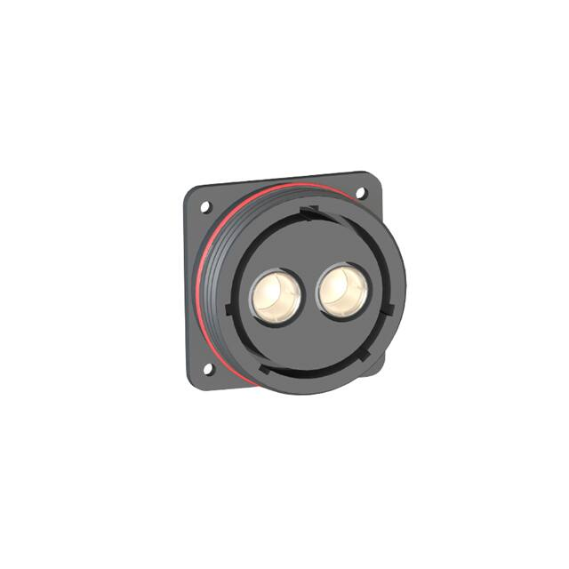

9000 Series High Power Buccaneer A range of high amperage flex body, flex body inline and flange mount connectors rated to IP68. These Delrin housing multi pin circular connectors are ideal for applications where dust and water ingress must be avoided and ease of connection to high ratings must be achieved. Bayonet 1/4 Turn locking Mechanism Secure, quick connector mating and release Screw Turn Locking Secure, robust connection and easy to disconnect Positive feedback on locking mechanism Confidence that connector is correctly mated and sealed IP68 when mated (for parts with backshell) Suitable for a wide range of dust and water borne environments Flex Body, Flex Body Inline and Flange Mount Available Complete family of products maintain sealing integrity in all styles Visual alignment features Aids the correct mating of connectors 2 to 11 Contacts - up to 225A, 1250V AC RMS Suitable for mains power to signal applications Crimp termination available 300+ AMP contacts upon request Circular Power Connectors 63 BUCCANEER FOR POWER 9000 Series High Power Buccaneer Screw Locking Male & Female Flex Body, Inline Body & Flange Mount available Plug and Socket available IP68 Rated Up to 1250V AC RMS PXP9050 Part Number Contacts Contact Type Contact Size Body Type Backshell PXP9050/02/P/1 PXP9051/02/S/1 PXP9052/02/S PXP9050/04/P/1 PXP9051/04/S/1 PXP9052/04/S PXP9050/06/P/1 PXP9051/06/S/1 PXP9052/06/S PXP9050/08/P/1 PXP9051/08/S/1 PXP9052/08/S PXP9050/11/P/1 PXP9051/11/S/1 PXP9052/11/S 2 2 2 4 4 4 6 6 6 8 8 8 11 11 11 Plug Socket Socket Plug Socket Socket Plug Socket Socket Plug Socket Socket Plug Socket Socket 4/0 4/0 4/0 1/0 1/0 1/0 1/0 1/0 1/0 4x 4 & 16AWG 4x 4x 4 & 16AWG 4x 4x 4 & 16AWG 4x 10x 4 & 16AWG 1x 10x 4 & 16AWG 1x 10x 4 & 16AWG 1x Flex Inline Flange Mount Flex Inline Flange Mount Flex Inline Flange Mount Flex Inline Flange Mount Flex Inline Flange Mount Yes Yes Yes Yes Yes Yes Yes Yes Yes Yes - Bayonet Quarter Turning Lock Male & Female Flex Body, Inline Body & Flange Mount available Plug and Socket available IP68 Rated Up to 1250V AC RMS Robust, with Quick Disconnect System PXP9010 Part Number Contacts Contact Type Contact Size Body Type Backshell PXP9010/02/P/1 PXP9011/02/S/1 PXP9012/02/S PXP9010/04/P/1 PXP9011/04/S/1 PXP9012/04/S PXP9010/06/P/1 PXP9011/06/S/1 PXP9012/06/S PXP9010/08/P/1 PXP9011/08/S/1 PXP9012/08/S PXP9010/11/P/1 PXP9011/11/S/1 PXP9012/11/S 2 2 2 4 4 4 6 6 6 8 8 8 11 11 11 Plug Socket Socket Plug Socket Socket Plug Socket Socket Plug Socket Socket Plug Socket Socket 4/0 4/0 4/0 1/0 1/0 1/0 1/0 1/0 1/0 4x 4 & 16AWG 4x 4x 4 & 16AWG 4x 4x 4 & 16AWG 4x 10x 4 & 16AWG 1x 10x 4 & 16AWG 1x 10x 4 & 16AWG 1x Flex Inline Flange Mount Flex Inline Flange Mount Flex Inline Flange Mount Flex Inline Flange Mount Flex Inline Flange Mount Yes Yes Yes Yes Yes Yes Yes Yes Yes Yes - 64 Circular Power Connectors BUCCANEER FOR POWER 9000 Series High Power Buccaneer Adapter Adapter *crimping tool required - contact us for more details. PXP9080 Part Number Description PXP9080 1/0 Plug and Socket Adapter to accommodate 6-8AWG conductors Tooling Tooling: Pneumatic Tool Press Tooling Locator Tool Die Set PXP9081 PXP9082 PXP9083 Part Number Description PXP9081 PXP9082 PXP9083 Pneumatic Tool Press Tooling Locator Tool Die Set Circular Power Connectors 65 BUCCANEER FOR POWER 9000 Series High Power Buccaneer Specifications & Part No System Electrical: Mechanical: No Contacts: 2, 4, 6, 8, 11 Locking Mechanism: Current Rating: 2 Contact 4 Contact 6 Contact 8 Contact 11 Contact Bayonet Quarter Turn Rapid Locking Screw Lock 225A 150A 150A 13A, 80A 80A, 13A Sealing: IP68 Voltage Rating (AC): 1250V AC RMS +700V AC RMS Contact Accommodation: 2 Contact 4 Contact 6 Contact 8 Contact 11 Contact 4/0 (107.2 mm²) 1/0 (53.5 mm²) 1/0 (107.2 mm²) 4x 4 (107.2 mm²) & 16 AWG (1.5 mm²) 4x 10x 4 (107.2 mm²) & 16 AWG (1.5 mm²) 1x Operating Temp. Range: -55°C to +125°C Approvals: Standard Available Cable Acceptance: Back Shell Inner Diameter 48.26 mm Terminations: Crimp Terminals Dimensions: Diameter: (over coupling ring) 72.77mm (bayonet), 80.67mm (screw lock) Materials: Plastic: Body: Delrin Colour: Black Contacts: Copper Alloy Silver Plating Flammability Rating: UL94 V-0 RoHS Compliant PXP90XX X XX Series Designation Series / Body Style Contact of Contacts Contact Type Backshell PXP901X = Bayonet Quarter Turn 0 = Flex 02 P = Plug N/A = No Backshell 1 = Inline 04 S = Socket 2 = Flange Mount 06 1 = 4” Screw on Backshell PXP905X = Screw Locking 08 11 Examples PXP9050/02/P/1 = Screw Locking Flex Body Connector, 4 inch Backshell, 2 Contacts, Plug PXP9012/02/S = Bayonet Locking Flange Mount Connector, No Backshell, 2 Contacts, Socket 66 Circular Power Connectors X X
