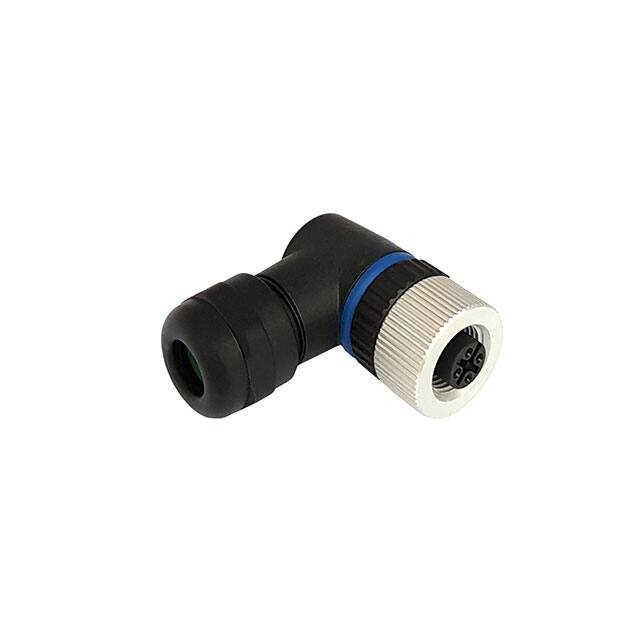

Introduction M12 Series With a high degree of mechanical and electrical stability, Bulgin’s M12 connectors provide a cost effective and flexible connectivity solution for onsite installations, helping to decrease downtime in process control, manufacturing automation and industrial instrumentation applications. Key features: Reliable industry standard (EN 61076-2-101) screw locking mechanism IP67 degree of protection A, B, D, L, S & T Coded versions Field installable, cable and panel mount options Plastic and metal options variants Straight and right angled forms Overmolded PVC, PUR, PNP or NPN cable connectors Contact variants from 3 – 17 Full Contact Diagrams Page 164 Circular Automation Connectors 149 BUCCANEER M12 Series M12 connectors are established as one of the most reliable and efficient connection standards for Industrial Machinery and Factory Automation applications. With a small footprint, extremely low failure rate and high performance capabilities, this range is ideal not only for sensor connections but also for a variety of fieldbus systems. These M12 Series circular connectors are rugged, easy to use and extremely reliable solutions for sensor/actuator connectivity in industrial automation and control applications. With an IP67 rating, they are also extremely effective in harsh environments outside of industrial automation applications where compact and dependable connections with environmental protection are required. Bulgin’s field attachable M12 connectors feature a robust aluminium coupling nut, making them a lightweight and durable alternative to the more common nickel-plated M12 nut variants and an ideal plug and play solution for upgrading sensor systems with M12 connectivity. Bulgin’s M12 Series connectors are available in a variety of industry standard keying/coding options to further minimize wiring errors and serve a large variety of customer needs. M12 Series coding options: (Full Contact Diagrams Page 164) A-Coding B-Coding D-Coding L-Coding S-Coding T-Coding 150 Circular Automation Connectors Buccaneer M12 Series M12 Rear Panel Mounting Male 3, 4, 5, 8 & 12 Contacts PCB termination Mates with Flex Body connectors PXMBNI12RPM Part Number Contacts Code Termination Mounting Nut PXMBNI12RPM03APCPG9 PXMBNI12RPM04APCPG9 PXMBNI12RPM05APCPG9 PXMBNI12RPM08APCPG9 PXMBNI12RPM12APCPG9 PXMBNI12RPM05BPCPG9 PXMBNI12RPM04DPCPG9 PXMBNI12RPM03APCM16 PXMBNI12RPM04APCM16 PXMBNI12RPM05APCM16 PXMBNI12RPM08APCM16 PXMBNI12RPM12APCM16 PXMBNI12RPM05BPCM16 PXMBNI12RPM04DPCM16 PXMBNI12RPM03APCM12 PXMBNI12RPM04APCM12 PXMBNI12RPM05APCM12 PXMBNI12RPM08APCM12 PXMBNI12RPM12APCM12 PXMBNI12RPM05BPCM12 PXMBNI12RPM04DPCM12 03 04 05 08 12 05 04 03 04 05 08 12 05 04 03 04 05 08 12 05 04 A A A A A B D A A A A A B D A A A A A B D PCB Terminal PCB Terminal PCB Terminal PCB Terminal PCB Terminal PCB Terminal PCB Terminal PCB Terminal PCB Terminal PCB Terminal PCB Terminal PCB Terminal PCB Terminal PCB Terminal PCB Terminal PCB Terminal PCB Terminal PCB Terminal PCB Terminal PCB Terminal PCB Terminal PG9 Mounting / Gland Nut Thread PG9 Mounting / Gland Nut Thread PG9 Mounting / Gland Nut Thread PG9 Mounting / Gland Nut Thread PG9 Mounting / Gland Nut Thread PG9 Mounting / Gland Nut Thread PG9 Mounting / Gland Nut Thread M16 Mounting / Gland Nut Thread M16 Mounting / Gland Nut Thread M16 Mounting / Gland Nut Thread M16 Mounting / Gland Nut Thread M16 Mounting / Gland Nut Thread M16 Mounting / Gland Nut Thread M16 Mounting / Gland Nut Thread M12 Mounting / Gland Nut Thread M12 Mounting / Gland Nut Thread M12 Mounting / Gland Nut Thread M12 Mounting / Gland Nut Thread M12 Mounting / Gland Nut Thread M12 Mounting / Gland Nut Thread M12 Mounting / Gland Nut Thread M12 Rear Panel Mounting Female 3, 4, 5, 8 & 12 Contacts PCB termination Mates with Inline Body connectors PXMBNI12RPF Part Number Contacts Code Termination Mounting Nut PXMBNI12RPF03APCPG9 PXMBNI12RPF04APCPG9 PXMBNI12RPF05APCPG9 PXMBNI12RPF08APCPG9 PXMBNI12RPF12APCPG9 PXMBNI12RPF05BPCPG9 PXMBNI12RPF04DPCPG9 PXMBNI12RPF03APCM16 PXMBNI12RPF04APCM16 PXMBNI12RPF05APCM16 PXMBNI12RPF08APCM16 PXMBNI12RPF12APCM16 PXMBNI12RPF05BPCM16 PXMBNI12RPF04DPCM16 03 04 05 08 12 05 04 03 04 05 08 12 05 04 A A A A A B D A A A A A B D PCB Terminal PCB Terminal PCB Terminal PCB Terminal PCB Terminal PCB Terminal PCB Terminal PCB Terminal PCB Terminal PCB Terminal PCB Terminal PCB Terminal PCB Terminal PCB Terminal PG9 Mounting / Gland Nut Thread PG9 Mounting / Gland Nut Thread PG9 Mounting / Gland Nut Thread PG9 Mounting / Gland Nut Thread PG9 Mounting / Gland Nut Thread PG9 Mounting / Gland Nut Thread PG9 Mounting / Gland Nut Thread M16 Mounting / Gland Nut Thread M16 Mounting / Gland Nut Thread M16 Mounting / Gland Nut Thread M16 Mounting / Gland Nut Thread M16 Mounting / Gland Nut Thread M16 Mounting / Gland Nut Thread M16 Mounting / Gland Nut Thread Circular Automation Connectors 151 Buccaneer M12 Series M12 Inline Body Male 3, 4, 5 & 8 Contacts Screw termination Plastic Inline Body Mates with Flex body and panel mount connectors PXPPAM12FIM Part Number Contacts Code Termination PXPPAM12FIM03ASTPG9 PXPPAM12FIM04ASTPG9 PXPPAM12FIM05ASTPG9 PXPPAM12FIM08ASTPG9 03 04 05 08 A A A A Screw Terminal Screw Terminal Screw Terminal Screw Terminal M12 Flex Body Female 3, 4, 5 & 8 Contacts Screw termination Plastic Flex Body Mates with Inline Body and panel mount connectors PXPPAM12FBF Part Number Contacts Code Termination PXPPAM12FBF03ASTPG9 PXPPAM12FBF04ASTPG9 PXPPAM12FBF05ASTPG9 PXPPAM12FBF08ASTPG9 03 04 05 08 A A A A Screw Terminal Screw Terminal Screw Terminal Screw Terminal M12 Right Angled Male 3, 4, 5 & 8 Contacts Screw termination Plastic Inline Body Mates with Flex Body and panel mount connectors PXPPAM12RAM Part Number Contacts Code Termination PXPPAM12RAM03ASTPG9 PXPPAM12RAM04ASTPG9 PXPPAM12RAM05ASTPG9 PXPPAM12RAM08ASTPG9 03 04 05 08 A A A A Screw Terminal Screw Terminal Screw Terminal Screw Terminal M12 Right Angled Female 3, 4, 5 & 8 Contacts Screw termination Plastic Flex Body Mates with Inline Body and panel mount connectors PXPPAM12RAF Part Number Contacts Code Termination PXPPAM12RAF03ASTPG9 PXPPAM12RAF04ASTPG9 PXPPAM12RAF05ASTPG9 PXPPAM12RAF08ASTPG9 03 04 05 08 A A A A Screw Terminal Screw Terminal Screw Terminal Screw Terminal 152 Circular Automation Connectors Buccaneer M12 Series Nickel Plating M12 Inline Body Male 3, 4, 5, 8 & 12 Contacts Solder termination Metal Inline Body Mates with Flex body and panel mount connectors PXMBNI12FIM Part Number Contacts Code Termination Mounting Nut PXMBNI12FIM03ASCPG7 PXMBNI12FIM04ASCPG7 PXMBNI12FIM05ASCPG7 PXMBNI12FIM08ASCPG7 PXMBNI12FIM12ASCPG7 PXMBNI12FIM05BSCPG7 PXMBNI12FIM04DSCPG7 PXMBNI12FIM03ASCPG9 PXMBNI12FIM04ASCPG9 PXMBNI12FIM05ASCPG9 PXMBNI12FIM08ASCPG9 PXMBNI12FIM12ASCPG9 PXMBNI12FIM05BSCPG9 PXMBNI12FIM04DSCPG9 03 04 05 08 12 05 04 03 04 05 08 12 05 04 A A A A A B D A A A A A B D Solder Terminal Solder Terminal Solder Terminal Solder Terminal Solder Terminal Solder Terminal Solder Terminal Solder Terminal Solder Terminal Solder Terminal Solder Terminal Solder Terminal Solder Terminal Solder Terminal PG7 Mounting / Gland Nut Thread PG7 Mounting / Gland Nut Thread PG7 Mounting / Gland Nut Thread PG7 Mounting / Gland Nut Thread PG7 Mounting / Gland Nut Thread PG7 Mounting / Gland Nut Thread PG7 Mounting / Gland Nut Thread PG9 Mounting / Gland Nut Thread PG9 Mounting / Gland Nut Thread PG9 Mounting / Gland Nut Thread PG9 Mounting / Gland Nut Thread PG9 Mounting / Gland Nut Thread PG9 Mounting / Gland Nut Thread PG9 Mounting / Gland Nut Thread Nickel Plating M12 Flex Body Female 3, 4, 5, 8 & 12 Contacts Solder termination Metal Flex Body Mates with Inline Body and panel mount connectors PXMBNI12FBF Part Number Contacts Code Termination Mounting Nut PXMBNI12FBF03ASCPG7 PXMBNI12FBF04ASCPG7 PXMBNI12FBF05ASCPG7 PXMBNI12FBF08ASCPG7 PXMBNI12FBF12ASCPG7 PXMBNI12FBF05BSCPG7 PXMBNI12FBF04DSCPG7 PXMBNI12FBF04TSCPG7 PXMBNI12FBF03ASCPG9 PXMBNI12FBF04ASCPG9 PXMBNI12FBF05ASCPG9 PXMBNI12FBF08ASCPG9 PXMBNI12FBF12ASCPG9 PXMBNI12FBF05BSCPG9 PXMBNI12FBF04DSCPG9 PXMBNI12FBF04TSCPG9 03 04 05 08 12 05 04 04 03 04 05 08 12 05 04 04 A A A A A B D T A A A A A B D T Solder Terminal Solder Terminal Solder Terminal Solder Terminal Solder Terminal Solder Terminal Solder Terminal Solder Terminal Solder Terminal Solder Terminal Solder Terminal Solder Terminal Solder Terminal Solder Terminal Solder Terminal Solder Terminal PG7 Mounting / Gland Nut Thread PG7 Mounting / Gland Nut Thread PG7 Mounting / Gland Nut Thread PG7 Mounting / Gland Nut Thread PG7 Mounting / Gland Nut Thread PG7 Mounting / Gland Nut Thread PG7 Mounting / Gland Nut Thread PG7 Mounting / Gland Nut Thread PG9 Mounting / Gland Nut Thread PG9 Mounting / Gland Nut Thread PG9 Mounting / Gland Nut Thread PG9 Mounting / Gland Nut Thread PG9 Mounting / Gland Nut Thread PG9 Mounting / Gland Nut Thread PG9 Mounting / Gland Nut Thread PG7 Mounting / Gland Nut Thread Circular Automation Connectors 153 Buccaneer M12 Series M12 Right Angled Female 3, 4, 5, 8 & 12 Contacts 1, 2, 3, 5, 10 & 15m cable options Overmold Flex Body Mates with Inline Body & panel mount connectors PXPTPU12RAF PXPPVC12RAF Part Number Contacts Code Termination Lead Length PXPPVC12RAF03ACL010PVC PXPTPU12RAF03ACL010PUR PXPPVC12RAF03ACL020PVC PXPTPU12RAF03ACL020PUR PXPPVC12RAF03ACL030PVC PXPTPU12RAF03ACL030PUR PXPPVC12RAF03ACL050PVC PXPTPU12RAF03ACL050PUR PXPPVC12RAF03ACL100PVC PXPTPU12RAF03ACL100PUR PXPPVC12RAF03ACL150PVC PXPTPU12RAF03ACL150PUR PXPPVC12RAF04ACL010PVC PXPTPU12RAF04ACL010PUR PXPPVC12RAF04ACL020PVC PXPTPU12RAF04ACL020PUR PXPPVC12RAF04ACL030PVC PXPTPU12RAF04ACL030PUR PXPPVC12RAF04ACL050PVC PXPTPU12RAF04ACL050PUR PXPPVC12RAF04ACL100PVC PXPTPU12RAF04ACL100PUR PXPPVC12RAF04ACL150PVC PXPTPU12RAF04ACL150PUR PXPPVC12RAF05ACL010PVC PXPTPU12RAF05ACL010PUR PXPPVC12RAF05ACL020PVC PXPTPU12RAF05ACL020PUR PXPPVC12RAF05ACL030PVC PXPTPU12RAF05ACL030PUR PXPPVC12RAF05ACL050PVC PXPTPU12RAF05ACL050PUR PXPPVC12RAF05ACL100PVC PXPTPU12RAF05ACL100PUR PXPPVC12RAF05ACL150PVC PXPTPU12RAF05ACL150PUR PXPPVC12RAF08ACL010PVC PXPTPU12RAF08ACL010PUR PXPPVC12RAF08ACL020PVC PXPTPU12RAF08ACL020PUR PXPPVC12RAF08ACL030PVC PXPTPU12RAF08ACL030PUR PXPPVC12RAF08ACL050PVC PXPTPU12RAF08ACL050PUR PXPPVC12RAF08ACL100PVC PXPTPU12RAF08ACL100PUR PXPPVC12RAF08ACL150PVC PXPTPU12RAF08ACL150PUR PXPPVC12RAF12ACL010PVC PXPTPU12RAF12ACL010PUR PXPPVC12RAF12ACL020PVC PXPTPU12RAF12ACL020PUR PXPPVC12RAF12ACL030PVC PXPTPU12RAF12ACL030PUR PXPPVC12RAF12ACL050PVC PXPTPU12RAF12ACL050PUR PXPPVC12RAF12ACL100PVC PXPTPU12RAF12ACL100PUR PXPPVC12RAF12ACL150PVC PXPTPU12RAF12ACL150PUR 03 03 03 03 03 03 03 03 03 03 03 03 04 04 04 04 04 04 04 04 04 04 04 04 05 05 05 05 05 05 05 05 05 05 05 05 08 08 08 08 08 08 08 08 08 08 08 08 12 12 12 12 12 12 12 12 12 12 12 12 A A A A A A A A A A A A A A A A A A A A A A A A A A A A A A A A A A A A A A A A A A A A A A A A A A A A A A A A A A A A Overmold Cable Overmold Cable Overmold Cable Overmold Cable Overmold Cable Overmold Cable Overmold Cable Overmold Cable Overmold Cable Overmold Cable Overmold Cable Overmold Cable Overmold Cable Overmold Cable Overmold Cable Overmold Cable Overmold Cable Overmold Cable Overmold Cable Overmold Cable Overmold Cable Overmold Cable Overmold Cable Overmold Cable Overmold Cable Overmold Cable Overmold Cable Overmold Cable Overmold Cable Overmold Cable Overmold Cable Overmold Cable Overmold Cable Overmold Cable Overmold Cable Overmold Cable Overmold Cable Overmold Cable Overmold Cable Overmold Cable Overmold Cable Overmold Cable Overmold Cable Overmold Cable Overmold Cable Overmold Cable Overmold Cable Overmold Cable Overmold Cable Overmold Cable Overmold Cable Overmold Cable Overmold Cable Overmold Cable Overmold Cable Overmold Cable Overmold Cable Overmold Cable Overmold Cable Overmold Cable 1m 1m 2m 2m 3m 3m 5m 5m 10m 10m 15m 15m 1m 1m 2m 2m 3m 3m 5m 5m 10m 10m 15m 15m 1m 1m 2m 2m 3m 3m 5m 5m 10m 10m 15m 15m 1m 1m 2m 2m 3m 3m 5m 5m 10m 10m 15m 15m 1m 1m 2m 2m 3m 3m 5m 5m 10m 10m 15m 15m 154 Circular Automation Connectors Cable Material PVC PUR PVC PUR PVC PUR PVC PUR PVC PUR PVC PUR PVC PUR PVC PUR PVC PUR PVC PUR PVC PUR PVC PUR PVC PUR PVC PUR PVC PUR PVC PUR PVC PUR PVC PUR PVC PUR PVC PUR PVC PUR PVC PUR PVC PUR PVC PUR PVC PUR PVC PUR PVC PUR PVC PUR PVC PUR PVC PUR Buccaneer M12 Series PXPPVC12RAF05BCL010PVC PXPTPU12RAF05BCL010PUR PXPPVC12RAF05BCL020PVC PXPTPU12RAF05BCL020PUR PXPPVC12RAF05BCL030PVC PXPTPU12RAF05BCL030PUR PXPPVC12RAF05BCL050PVC PXPTPU12RAF05BCL050PUR PXPPVC12RAF05BCL100PVC PXPTPU12RAF05BCL100PUR PXPPVC12RAF05BCL150PVC PXPTPU12RAF05BCL150PUR PXPPVC12RAF04DCL010PVC PXPTPU12RAF04DCL010PUR PXPPVC12RAF04DCL020PVC PXPTPU12RAF04DCL020PUR PXPPVC12RAF04DCL030PVC PXPTPU12RAF04DCL030PUR PXPPVC12RAF04DCL050PVC PXPTPU12RAF04DCL050PUR PXPPVC12RAF04DCL100PVC PXPTPU12RAF04DCL100PUR PXPPVC12RAF04DCL150PVC PXPTPU12RAF04DCL150PUR PXPPNP12RAF04ACL010PVC PXPPNP12RAF04ACL030PVC PXPPNP12RAF04ACL050PVC PXPPNP12RAF04ACL100PVC 05 05 05 05 05 05 05 05 05 05 05 05 04 04 04 04 04 04 04 04 04 04 04 04 04 04 04 04 M12 Flex Body Female B B B B B B B B B B B B D D D D D D D D D D D D A A A A Overmold Cable Overmold Cable Overmold Cable Overmold Cable Overmold Cable Overmold Cable Overmold Cable Overmold Cable Overmold Cable Overmold Cable Overmold Cable Overmold Cable Overmold Cable Overmold Cable Overmold Cable Overmold Cable Overmold Cable Overmold Cable Overmold Cable Overmold Cable Overmold Cable Overmold Cable Overmold Cable Overmold Cable Overmold Cable Overmold Cable Overmold Cable Overmold Cable 1m 1m 2m 2m 3m 3m 5m 5m 10m 10m 15m 15m 1m 1m 2m 2m 3m 3m 5m 5m 10m 10m 15m 15m 1m 3m 5m 10m PVC PUR PVC PUR PVC PUR PVC PUR PVC PUR PVC PUR PVC PUR PVC PUR PVC PUR PVC PUR PVC PUR PVC PUR PVC PVC PVC PVC 3, 4, 5, 8 & 12 Contacts 1, 2, 3, 5, 10 & 15m cable options Overmold Flex Body Mates with Inline Body & panel mount connectors PXPTPU12FBF PXPPVC12FBF Part Number Contacts Code Termination Lead Length PXPPVC12FBF03ACL010PVC PXPTPU12FBF03ACL010PUR PXPPVC12FBF03ACL020PVC PXPTPU12FBF03ACL020PUR PXPPVC12FBF03ACL030PVC PXPTPU12FBF03ACL030PUR PXPPVC12FBF03ACL050PVC PXPTPU12FBF03ACL050PUR PXPPVC12FBF03ACL100PVC PXPTPU12FBF03ACL100PUR PXPPVC12FBF03ACL150PVC PXPTPU12FBF03ACL150PUR PXPPVC12FBF04ACL010PVC PXPTPU12FBF04ACL010PUR PXPPVC12FBF04ACL020PVC PXPTPU12FBF04ACL020PUR PXPPVC12FBF04ACL030PVC PXPTPU12FBF04ACL030PUR PXPPVC12FBF04ACL050PVC PXPTPU12FBF04ACL050PUR PXPPVC12FBF04ACL100PVC PXPTPU12FBF04ACL100PUR PXPPVC12FBF04ACL150PVC PXPTPU12FBF04ACL150PUR PXPPVC12FBF05ACL010PVC PXPTPU12FBF05ACL010PUR PXPPVC12FBF05ACL020PVC PXPTPU12FBF05ACL020PUR PXPPVC12FBF05ACL030PVC PXPTPU12FBF05ACL030PUR PXPPVC12FBF05ACL050PVC PXPTPU12FBF05ACL050PUR PXPPVC12FBF05ACL100PVC 03 03 03 03 03 03 03 03 03 03 03 03 04 04 04 04 04 04 04 04 04 04 04 04 05 05 05 05 05 05 05 05 05 A A A A A A A A A A A A A A A A A A A A A A A A A A A A A A A A A Overmold Cable Overmold Cable Overmold Cable Overmold Cable Overmold Cable Overmold Cable Overmold Cable Overmold Cable Overmold Cable Overmold Cable Overmold Cable Overmold Cable Overmold Cable Overmold Cable Overmold Cable Overmold Cable Overmold Cable Overmold Cable Overmold Cable Overmold Cable Overmold Cable Overmold Cable Overmold Cable Overmold Cable Overmold Cable Overmold Cable Overmold Cable Overmold Cable Overmold Cable Overmold Cable Overmold Cable Overmold Cable Overmold Cable 1m 1m 2m 2m 3m 3m 5m 5m 10m 10m 15m 15m 1m 1m 2m 2m 3m 3m 5m 5m 10m 10m 15m 15m 1m 1m 2m 2m 3m 3m 5m 5m 10m Cable Material PVC PUR PVC PUR PVC PUR PVC PUR PVC PUR PVC PUR PVC PUR PVC PUR PVC PUR PVC PUR PVC PUR PVC PUR PVC PUR PVC PUR PVC PUR PVC PUR PVC Circular Automation Connectors 155 Buccaneer M12 Series PXPTPU12FBF05ACL100PUR PXPPVC12FBF05ACL150PVC PXPTPU12FBF05ACL150PUR PXPPVC12FBF08ACL010PVC PXPTPU12FBF08ACL010PUR PXPPVC12FBF08ACL020PVC PXPTPU12FBF08ACL020PUR PXPPVC12FBF08ACL030PVC PXPTPU12FBF08ACL030PUR PXPPVC12FBF08ACL050PVC PXPTPU12FBF08ACL050PUR PXPPVC12FBF08ACL100PVC PXPTPU12FBF08ACL100PUR PXPPVC12FBF08ACL150PVC PXPTPU12FBF08ACL150PUR PXPPVC12FBF12ACL010PVC PXPTPU12FBF12ACL010PUR PXPPVC12FBF12ACL020PVC PXPTPU12FBF12ACL020PUR PXPPVC12FBF12ACL030PVC PXPTPU12FBF12ACL030PUR PXPPVC12FBF12ACL050PVC PXPTPU12FBF12ACL050PUR PXPPVC12FBF12ACL100PVC PXPTPU12FBF12ACL100PUR PXPPVC12FBF12ACL150PVC PXPTPU12FBF12ACL150PUR PXPPVC12FBF05BCL010PVC PXPTPU12FBF05BCL010PUR PXPPVC12FBF05BCL020PVC PXPTPU12FBF05BCL020PUR PXPPVC12FBF05BCL030PVC PXPTPU12FBF05BCL030PUR PXPPVC12FBF05BCL050PVC PXPTPU12FBF05BCL050PUR PXPPVC12FBF05BCL100PVC PXPTPU12FBF05BCL100PUR PXPPVC12FBF05BCL150PVC PXPTPU12FBF05BCL150PUR PXPPVC12FBF04DCL010PVC PXPTPU12FBF04DCL010PUR PXPPVC12FBF04DCL020PVC PXPTPU12FBF04DCL020PUR PXPPVC12FBF04DCL030PVC PXPTPU12FBF04DCL030PUR PXPPVC12FBF04DCL050PVC PXPTPU12FBF04DCL050PUR PXPPVC12FBF04DCL100PVC PXPTPU12FBF04DCL100PUR PXPPVC12FBF04DCL150PVC PXPTPU12FBF04DCL150PUR PXPTPU12FBF04TCL010PUR PXPTPU12FBF04SCL010PUR PXPTPU12FBF05LCL010PUR PXPPNP12FBF04ACL010PVC PXPPNP12FBF04ACL030PVC PXPPNP12FBF04ACL050PVC PXPPNP12FBF04ACL100PVC 05 05 05 08 08 08 08 08 08 08 08 08 08 08 08 12 12 12 12 12 12 12 12 12 12 12 12 05 05 05 05 05 05 05 05 05 05 05 05 04 04 04 04 04 04 04 04 04 04 04 04 05 04 04 04 04 04 04 M12 Right Angled Male A A A A A A A A A A A A A A A A A A A A A A A A A A A B B B B B B B B B B B B D D D D D D D D D D D D L S T A A A A Overmold Cable Overmold Cable Overmold Cable Overmold Cable Overmold Cable Overmold Cable Overmold Cable Overmold Cable Overmold Cable Overmold Cable Overmold Cable Overmold Cable Overmold Cable Overmold Cable Overmold Cable Overmold Cable Overmold Cable Overmold Cable Overmold Cable Overmold Cable Overmold Cable Overmold Cable Overmold Cable Overmold Cable Overmold Cable Overmold Cable Overmold Cable Overmold Cable Overmold Cable Overmold Cable Overmold Cable Overmold Cable Overmold Cable Overmold Cable Overmold Cable Overmold Cable Overmold Cable Overmold Cable Overmold Cable Overmold Cable Overmold Cable Overmold Cable Overmold Cable Overmold Cable Overmold Cable Overmold Cable Overmold Cable Overmold Cable Overmold Cable Overmold Cable Overmold Cable Overmold Cable Overmold Cable Overmold Cable Overmold Cable Overmold Cable Overmold Cable Overmold Cable 10m 15m 15m 1m 1m 2m 2m 3m 3m 5m 5m 10m 10m 15m 15m 1m 1m 2m 2m 3m 3m 5m 5m 10m 10m 15m 15m 1m 1m 2m 2m 3m 3m 5m 5m 10m 10m 15m 15m 1m 1m 2m 2m 3m 3m 5m 5m 10m 10m 15m 15m 1m 1m 1m 1m 3m 5m 10m PUR PVC PUR PVC PUR PVC PUR PVC PUR PVC PUR PVC PUR PVC PUR PVC PUR PVC PUR PVC PUR PVC PUR PVC PUR PVC PUR PVC PUR PVC PUR PVC PUR PVC PUR PVC PUR PVC PUR PVC PUR PVC PUR PVC PUR PVC PUR PVC PUR PVC PUR PUR PUR PUR PVC PVC PVC PVC 3, 4, 5, 8 & 12 Contacts 1, 2, 3, 5, 10 & 15m cable options Overmold Inline Body Mates with Flex Body & panel mount connectors PXPTPU12RAM PXPPVC12RAM Part Number Contacts Code Termination Lead Length PXPPVC12RAM03ACL010PVC PXPTPU12RAM03ACL010PUR PXPPVC12RAM03ACL020PVC PXPTPU12RAM03ACL020PUR PXPPVC12RAM03ACL030PVC PXPTPU12RAM03ACL030PUR PXPPVC12RAM03ACL050PVC 03 03 03 03 03 03 03 A A A A A A A Overmold Cable Overmold Cable Overmold Cable Overmold Cable Overmold Cable Overmold Cable Overmold Cable 1m 1m 2m 2m 3m 3m 5m 156 Circular Automation Connectors Cable Material PVC PUR PVC PUR PVC PUR PVC Buccaneer M12 Series PXPTPU12RAM03ACL050PUR PXPPVC12RAM03ACL100PVC PXPTPU12RAM03ACL100PUR PXPPVC12RAM03ACL150PVC PXPTPU12RAM03ACL150PUR PXPPVC12RAM04ACL010PVC PXPTPU12RAM04ACL010PUR PXPPVC12RAM04ACL020PVC PXPTPU12RAM04ACL020PUR PXPPVC12RAM04ACL030PVC PXPTPU12RAM04ACL030PUR PXPPVC12RAM04ACL050PVC PXPTPU12RAM04ACL050PUR PXPPVC12RAM04ACL100PVC PXPTPU12RAM04ACL100PUR PXPPVC12RAM04ACL150PVC PXPTPU12RAM04ACL150PUR PXPPVC12RAM05ACL010PVC PXPTPU12RAM05ACL010PUR PXPPVC12RAM05ACL020PVC PXPTPU12RAM05ACL020PUR PXPPVC12RAM05ACL030PVC PXPTPU12RAM05ACL030PUR PXPPVC12RAM05ACL050PVC PXPTPU12RAM05ACL050PUR PXPPVC12RAM05ACL100PVC PXPTPU12RAM05ACL100PUR PXPPVC12RAM05ACL150PVC PXPTPU12RAM05ACL150PUR PXPPVC12RAM08ACL010PVC PXPTPU12RAM08ACL010PUR PXPPVC12RAM08ACL020PVC PXPTPU12RAM08ACL020PUR PXPPVC12RAM08ACL030PVC PXPTPU12RAM08ACL030PUR PXPPVC12RAM08ACL050PVC PXPTPU12RAM08ACL050PUR PXPPVC12RAM08ACL100PVC PXPTPU12RAM08ACL100PUR PXPPVC12RAM08ACL150PVC PXPTPU12RAM08ACL150PUR PXPPVC12RAM12ACL010PVC PXPTPU12RAM12ACL010PUR PXPPVC12RAM12ACL020PVC PXPTPU12RAM12ACL020PUR PXPPVC12RAM12ACL030PVC PXPTPU12RAM12ACL030PUR PXPPVC12RAM12ACL050PVC PXPTPU12RAM12ACL050PUR PXPPVC12RAM12ACL100PVC PXPTPU12RAM12ACL100PUR PXPPVC12RAM12ACL150PVC PXPTPU12RAM12ACL150PUR PXPPVC12RAM05BCL010PVC PXPTPU12RAM05BCL010PUR PXPPVC12RAM05BCL020PVC PXPTPU12RAM05BCL020PUR PXPPVC12RAM05BCL030PVC PXPTPU12RAM05BCL030PUR PXPPVC12RAM05BCL050PVC PXPTPU12RAM05BCL050PUR PXPPVC12RAM05BCL100PVC PXPTPU12RAM05BCL100PUR PXPPVC12RAM05BCL150PVC PXPTPU12RAM05BCL150PUR PXPPVC12RAM04DCL010PVC PXPTPU12RAM04DCL010PUR PXPPVC12RAM04DCL020PVC PXPTPU12RAM04DCL020PUR PXPPVC12RAM04DCL030PVC PXPTPU12RAM04DCL030PUR PXPPVC12RAM04DCL050PVC PXPTPU12RAM04DCL050PUR PXPPVC12RAM04DCL100PVC PXPTPU12RAM04DCL100PUR PXPPVC12RAM04DCL150PVC PXPTPU12RAM04DCL150PUR 03 03 03 03 03 04 04 04 04 04 04 04 04 04 04 04 04 05 05 05 05 05 05 05 05 05 05 05 05 08 08 08 08 08 08 08 08 08 08 08 08 12 12 12 12 12 12 12 12 12 12 12 12 05 05 05 05 05 05 05 05 05 05 05 05 04 04 04 04 04 04 04 04 04 04 04 04 A A A A A A A A A A A A A A A A A A A A A A A A A A A A A A A A A A A A A A A A A A A A A A A A A A A A A B B B B B B B B B B B B D D D D D D D D D D D D Overmold Cable Overmold Cable Overmold Cable Overmold Cable Overmold Cable Overmold Cable Overmold Cable Overmold Cable Overmold Cable Overmold Cable Overmold Cable Overmold Cable Overmold Cable Overmold Cable Overmold Cable Overmold Cable Overmold Cable Overmold Cable Overmold Cable Overmold Cable Overmold Cable Overmold Cable Overmold Cable Overmold Cable Overmold Cable Overmold Cable Overmold Cable Overmold Cable Overmold Cable Overmold Cable Overmold Cable Overmold Cable Overmold Cable Overmold Cable Overmold Cable Overmold Cable Overmold Cable Overmold Cable Overmold Cable Overmold Cable Overmold Cable Overmold Cable Overmold Cable Overmold Cable Overmold Cable Overmold Cable Overmold Cable Overmold Cable Overmold Cable Overmold Cable Overmold Cable Overmold Cable Overmold Cable Overmold Cable Overmold Cable Overmold Cable Overmold Cable Overmold Cable Overmold Cable Overmold Cable Overmold Cable Overmold Cable Overmold Cable Overmold Cable Overmold Cable Overmold Cable Overmold Cable Overmold Cable Overmold Cable Overmold Cable Overmold Cable Overmold Cable Overmold Cable Overmold Cable Overmold Cable Overmold Cable Overmold Cable 5m 10m 10m 15m 15m 1m 1m 2m 2m 3m 3m 5m 5m 10m 10m 15m 15m 1m 1m 2m 2m 3m 3m 5m 5m 10m 10m 15m 15m 1m 1m 2m 2m 3m 3m 5m 5m 10m 10m 15m 15m 1m 1m 2m 2m 3m 3m 5m 5m 10m 10m 15m 15m 1m 1m 2m 2m 3m 3m 5m 5m 10m 10m 15m 15m 1m 1m 2m 2m 3m 3m 5m 5m 10m 10m 15m 15m PUR PVC PUR PVC PUR PVC PUR PVC PUR PVC PUR PVC PUR PVC PUR PVC PUR PVC PUR PVC PUR PVC PUR PVC PUR PVC PUR PVC PUR PVC PUR PVC PUR PVC PUR PVC PUR PVC PUR PVC PUR PVC PUR PVC PUR PVC PUR PVC PUR PVC PUR PVC PUR PVC PUR PVC PUR PVC PUR PVC PUR PVC PUR PVC PUR PVC PUR PVC PUR PVC PUR PVC PUR PVC PUR PVC PUR Circular Automation Connectors 157 Buccaneer M12 Series M12 Inline Body Male 3, 4, 5, 8 & 12 Contacts 1, 2, 3, 5, 10 & 15m cable options Overmold Inline Body Mates with Flex Body & panel mount connectors PXPTPU12FIM PXPPVC12FIM Part Number Contacts Code Termination Lead Length PXPPVC12FIM03ACL010PVC PXPTPU12FIM03ACL010PUR PXPPVC12FIM03ACL020PVC PXPTPU12FIM03ACL020PUR PXPPVC12FIM03ACL030PVC PXPTPU12FIM03ACL030PUR PXPPVC12FIM03ACL050PVC PXPTPU12FIM03ACL050PUR PXPPVC12FIM03ACL100PVC PXPTPU12FIM03ACL100PUR PXPPVC12FIM03ACL150PVC PXPTPU12FIM03ACL150PUR PXPPVC12FIM04ACL010PVC PXPTPU12FIM04ACL010PUR PXPPVC12FIM04ACL020PVC PXPTPU12FIM04ACL020PUR PXPPVC12FIM04ACL030PVC PXPTPU12FIM04ACL030PUR PXPPVC12FIM04ACL050PVC PXPTPU12FIM04ACL050PUR PXPPVC12FIM04ACL100PVC PXPTPU12FIM04ACL100PUR PXPPVC12FIM04ACL150PVC PXPTPU12FIM04ACL150PUR PXPPVC12FIM05ACL010PVC PXPTPU12FIM05ACL010PUR PXPPVC12FIM05ACL020PVC PXPTPU12FIM05ACL020PUR PXPPVC12FIM05ACL030PVC PXPTPU12FIM05ACL030PUR PXPPVC12FIM05ACL050PVC PXPTPU12FIM05ACL050PUR PXPPVC12FIM05ACL100PVC PXPTPU12FIM05ACL100PUR PXPPVC12FIM05ACL150PVC PXPTPU12FIM05ACL150PUR PXPPVC12FIM08ACL010PVC PXPTPU12FIM08ACL010PUR PXPPVC12FIM08ACL020PVC PXPTPU12FIM08ACL020PUR PXPPVC12FIM08ACL030PVC PXPTPU12FIM08ACL030PUR PXPPVC12FIM08ACL050PVC PXPTPU12FIM08ACL050PUR PXPPVC12FIM08ACL100PVC PXPTPU12FIM08ACL100PUR PXPPVC12FIM08ACL150PVC PXPTPU12FIM08ACL150PUR PXPPVC12FIM12ACL010PVC PXPTPU12FIM12ACL010PUR PXPPVC12FIM12ACL020PVC PXPTPU12FIM12ACL020PUR PXPPVC12FIM12ACL030PVC PXPTPU12FIM12ACL030PUR PXPPVC12FIM12ACL050PVC PXPTPU12FIM12ACL050PUR PXPPVC12FIM12ACL100PVC PXPTPU12FIM12ACL100PUR PXPPVC12FIM12ACL150PVC PXPTPU12FIM12ACL150PUR 03 03 03 03 03 03 03 03 03 03 03 03 04 04 04 04 04 04 04 04 04 04 04 04 05 05 05 05 05 05 05 05 05 05 05 05 08 08 08 08 08 08 08 08 08 08 08 08 12 12 12 12 12 12 12 12 12 12 12 12 A A A A A A A A A A A A A A A A A A A A A A A A A A A A A A A A A A A A A A A A A A A A A A A A A A A A A A A A A A A A Overmold Cable Overmold Cable Overmold Cable Overmold Cable Overmold Cable Overmold Cable Overmold Cable Overmold Cable Overmold Cable Overmold Cable Overmold Cable Overmold Cable Overmold Cable Overmold Cable Overmold Cable Overmold Cable Overmold Cable Overmold Cable Overmold Cable Overmold Cable Overmold Cable Overmold Cable Overmold Cable Overmold Cable Overmold Cable Overmold Cable Overmold Cable Overmold Cable Overmold Cable Overmold Cable Overmold Cable Overmold Cable Overmold Cable Overmold Cable Overmold Cable Overmold Cable Overmold Cable Overmold Cable Overmold Cable Overmold Cable Overmold Cable Overmold Cable Overmold Cable Overmold Cable Overmold Cable Overmold Cable Overmold Cable Overmold Cable Overmold Cable Overmold Cable Overmold Cable Overmold Cable Overmold Cable Overmold Cable Overmold Cable Overmold Cable Overmold Cable Overmold Cable Overmold Cable Overmold Cable 1m 1m 2m 2m 3m 3m 5m 5m 10m 10m 15m 15m 1m 1m 2m 2m 3m 3m 5m 5m 10m 10m 15m 15m 1m 1m 2m 2m 3m 3m 5m 5m 10m 10m 15m 15m 1m 1m 2m 2m 3m 3m 5m 5m 10m 10m 15m 15m 1m 1m 2m 2m 3m 3m 5m 5m 10m 10m 15m 15m 158 Circular Automation Connectors Cable Material PVC PUR PVC PUR PVC PUR PVC PUR PVC PUR PVC PUR PVC PUR PVC PUR PVC PUR PVC PUR PVC PUR PVC PUR PVC PUR PVC PUR PVC PUR PVC PUR PVC PUR PVC PUR PVC PUR PVC PUR PVC PUR PVC PUR PVC PUR PVC PUR PVC PUR PVC PUR PVC PUR PVC PUR PVC PUR PVC PUR Buccaneer M12 Series PXPPVC12FIM05BCL010PVC PXPTPU12FIM05BCL010PUR PXPPVC12FIM05BCL020PVC PXPTPU12FIM05BCL020PUR PXPPVC12FIM05BCL030PVC PXPTPU12FIM05BCL030PUR PXPPVC12FIM05BCL050PVC PXPTPU12FIM05BCL050PUR PXPPVC12FIM05BCL100PVC PXPTPU12FIM05BCL100PUR PXPPVC12FIM05BCL150PVC PXPTPU12FIM05BCL150PUR PXPPVC12FIM04DCL010PVC PXPTPU12FIM04DCL010PUR PXPPVC12FIM04DCL020PVC PXPTPU12FIM04DCL020PUR PXPPVC12FIM04DCL030PVC PXPTPU12FIM04DCL030PUR PXPPVC12FIM04DCL050PVC PXPTPU12FIM04DCL050PUR PXPPVC12FIM04DCL100PVC PXPTPU12FIM04DCL100PUR PXPPVC12FIM04DCL150PVC PXPTPU12FIM04DCL150PUR PXPTPU12FIM05LCL010PUR PXPTPU12FIM04SCL010PUR PXPTPU12FIM04TCL010PUR 05 05 05 05 05 05 05 05 05 05 05 05 04 04 04 04 04 04 04 04 04 04 04 04 05 04 04 M12 Flex Body To Inline B B B B B B B B B B B B D D D D D D D D D D D D L S T Overmold Cable Overmold Cable Overmold Cable Overmold Cable Overmold Cable Overmold Cable Overmold Cable Overmold Cable Overmold Cable Overmold Cable Overmold Cable Overmold Cable Overmold Cable Overmold Cable Overmold Cable Overmold Cable Overmold Cable Overmold Cable Overmold Cable Overmold Cable Overmold Cable Overmold Cable Overmold Cable Overmold Cable Overmold Cable Overmold Cable Overmold Cable 1m 1m 2m 2m 3m 3m 5m 5m 10m 10m 15m 15m 1m 1m 2m 2m 3m 3m 5m 5m 10m 10m 15m 15m 1m 1m 1m PVC PUR PVC PUR PVC PUR PVC PUR PVC PUR PVC PUR PVC PUR PVC PUR PVC PUR PVC PUR PVC PUR PVC PUR PUR PUR PUR 4 Contacts 0.3, 0.6, 1 & 2m cable options Overmold Inline Body to Inline Mates with Flex Body & panel mount connectors PXPPNP12FBF Part Number Contacts Code Termination Lead Length PXPPNP12FBF04AFI003PUR PXPPNP12FBF04AFI006PUR PXPPNP12FBF04AFI010PUR PXPPNP12FBF04AFI020PUR 04 04 04 04 A A A A Inline Inline Inline Inline 0.3m 0.6m 1m 2m M12 Right Angle To Inline Cable Material PUR PUR PUR PUR 4 Contacts 0.3, 0.6, 1 & 2m cable options Overmold Inline Body to Inline Mates with Flex Body & panel mount connectors PXPPNP12RAF Part Number Contacts Code Termination Lead Length PXPNPN12RAF04AFI003PUR PXPNPN12RAF04AFI006PUR PXPNPN12RAF04AFI010PUR PXPNPN12RAF04AFI020PUR 04 04 04 04 A A A A Inline Inline Inline Inline 0.3m 0.6m 1m 2m Cable Material PUR PUR PUR PUR Circular Automation Connectors 159 Buccaneer M12 Series M12 Front & Rear Panel Mount Flying Leads PXMBNI12RPM PXMBNI12RPF PXMBNI12FPF PXMBNI12FPM 4, 5 & 17 Contacts 0.1 & 0.2m cable options Overmold Inline Body Mates with Flex Body Part Number Front or Rear Contacts Code Termination Lead Length PXMBNI12FPM17AFLM12001 PXMBNI12FPF17AFLPG9001 PXMBNI12FPM17AFLPG9001 PXMBNI12FPF17AFLM16001 PXMBNI12FPM17AFLM16001 PXMBNI12RPM17AFLM12001 PXMBNI12RPF17AFLPG9001 PXMBNI12RPM17AFLPG9001 PXMBNI12RPF17AFLM16001 PXMBNI12RPM17AFLM16001 PXMBNI12RPM05LFLM16001 PXMBNI12RPF05LFLM16001 PXMBNI12RPM04SFLM16002 PXMBNI12RPF04SFLM16002 PXMBNI12RPM04TFLM16001 PXMBNI12RPF04TFLM16001 Front Front Front Front Front Rear Rear Rear Rear Rear Rear Rear Rear Rear Rear Rear 17 17 17 17 17 17 17 17 17 17 5 5 4 4 4 4 A A A A A A A A A A L L S S T T Flying Lead Flying Lead Flying Lead Flying Lead Flying Lead Flying Lead Flying Lead Flying Lead Flying Lead Flying Lead Flying Lead Flying Lead Flying Lead Flying Lead Flying Lead Flying Lead 0.1m 0.1m 0.1m 0.1m 0.1m 0.1m 0.1m 0.1m 0.1m 0.1m 0.1m 0.1m 0.2m 0.2m 0.1m 0.1m M12 T-Splitters Mounting Nut M12 PG9 PG9 M16 M16 M12 PG9 PG9 M16 M16 M16 M16 M16 M16 M16 M16 4, 5, 8 & 12 Contacts Mates with Flex Body & panel mount connectors PXPPVC12TS Part Number Contacts Code Termination PXPPVC12TSMM04AFIIFI PXPPVC12TSMM05AFIIFI PXPPVC12TSMM08AFIIFI PXPPVC12TSMM12AFIIFI PXPPVC12TSFM04AFBIFB PXPPVC12TSFM05AFBIFB PXPPVC12TSFM08AFBIFB PXPPVC12TSFM12AFBIFB PXPPVC12TSFF04AFBBFB PXPPVC12TSFF05AFBBFB PXPPVC12TSFF08AFBBFB PXPPVC12TSFF12AFBBFB 4 5 8 12 4 5 8 12 4 5 8 12 A A A A A A A A A A A A Male-Male-Male Male-Male-Male Male-Male-Male Male-Male-Male Female-Male-Male Female-Male-Male Female-Male-Male Female-Male-Male Female-Female-Female Female-Female-Female Female-Female-Female Female-Female-Female M12 Fixed Flange 17 Contacts 0.1m cable options Mates with Flex Body PXMBNI12FL Part Number Contacts Code Termination Lead Length Mounting PXMBNI12FLF17AFLFFL001 PXMBNI12FLM17AFLFFL001 17 17 A A Flying Lead Flying Lead 0.1m 0.1m Fixed Flange Fixed Flange 160 Circular Automation Connectors Buccaneer M12 Series M12 Right Angle Rear Panel Mount 4, 5, 8 & 12 Contacts Mates with Flex Body PCB Termination PXMBNI12RA Part Number Contacts Code Type Termination Mounting Nut PXMBNI12RAF04APCM12 PXMBNI12RAF05APCM12 PXMBNI12RAF08APCM12 PXMBNI12RAF12APCM12 PXMBNI12RAM04APCM12 PXMBNI12RAM05APCM12 PXMBNI12RAM08APCM12 PXMBNI12RAM12APCM12 4 5 8 12 4 5 8 12 A A A A A A A A Female Female Female Female Male Male Male Male PCB Terminal PCB Terminal PCB Terminal PCB Terminal PCB Terminal PCB Terminal PCB Terminal PCB Terminal M12 M12 M12 M12 M12 M12 M12 M12 PCB Contact Layouts: 4 Contact PCB Layout 5 Contact PCB Layout 8 Contact PCB Layout 12 Contact PCB Layout M12 SMT Connectors 4, 5, 8 & 12 Contacts Male and Female options PCB Termination PXPLCP12SM Part Number Male-Male or Male-Female Contacts Code Termination PXPLCP12SMM04APC PXPLCP12SMM05APC PXPLCP12SMM08APC PXPLCP12SMM12APC PXPLCP12SMF05APC PXPLCP12SMF08APC Male-Male Male-Male Male-Male Male-Male Male-Female Male-Female 4 5 8 12 5 8 A A A A A A PCB Terminal PCB Terminal PCB Terminal PCB Terminal PCB Terminal PCB Terminal Circular Automation Connectors 161 Buccaneer M12 Series PA66 M12 Sealing Cap Sealing caps to maintain IP67 rating Male & Female versions PXPPAM12 Part Number Series Type Material PXPPAM12CAM PXPPAM12CAF M12 M12 Male Female PA66 PA66 Brass - Nickel Plating M12 Sealing Cap Sealing caps to maintain IP67 rating Male & Female versions PXMBNI12 Part Number Series Type Material PXMBNI12CAM PXMBNI12CAF M12 M12 Male Female Brass - Nickel Plating Brass - Nickel Plating 162 Circular Automation Connectors Buccaneer M12 Series Specifications Electrical Mechanical: No. Contacts: 3 4 Current Rating: 4A Voltage Rating (ac/dc) : 4A 250V 250V 5 6 8 12 17 Screw coupling IP67 4A 1.5A 2A 1.5A 1.5A 60V 30V 30V 30V 30V Contact Accomodation: Contact Resistance: 100MΩ AC Breakdown Voltage: 3 Contacts 1.5KV 4 Contacts 1.5KV 5 Contacts 1.5KV 6 Contacts 1.5KV 8 Contacts 0.8KV 12 Contacts 0.8KV 17 Contacts 0.8KV Operating Temp Range: Locking Mechanism: Rating: 3, 4, 5, 6, 8, 12 & 17 Contacts 28AWG-22AWG Cable Acceptance: 4.6 - 8.0mm Dia Contacts: Terminations: 3, 4, 5, 6, 8 12, 17 PCB / Screw / Solder / Cable PCB / Solder / Cable Mechanical Operation: 500 & 100 mating cycle options available Largest diameter over coupling ring: 20.0mm -25°C to 80°C Panel Mounting Connectors: Cable Connectors: Flex & Inline Connectors: Body Material: Nickel Plated Brass TPU / PVC / LCP Nickel Plated Brass / PA66 Coupling Nut Material: Nickel Plated Brass Nickel Plated Brass Nickel Plated Brass Colour: Grey Black Black or Grey Plug Contacts Material: Brass, Gold plating Brass, Gold plating Brass, Gold plating Socket Contacts Material: Phosphor Bronze, Gold plating Phosphor Bronze, Gold plating Phosphor Bronze, Gold plating O Rings & Gaskets Materials: Viton Viton Viton RoHS: Compliant Compliant Compliant XXX XXX XX Series Material PXM BNI = Brass Nickel PAM = Polyamide TPU = Overmold for PUR PVC = Overmold for PVC PNP = + Signal LED NPN = - Signal LED LCP = Liquid Crystal Polymer PXP XX X or XX XX X Series Size Body Style Orientation Contacts Code Termination 12 FB = Flex Body FI = Inline Body RP = Rear Panel Mounting RA = Right Angle SC = Sealing Cap FP = Front Panel Mounting TS = T-Splitter FL = Flange SM = Surface Mount M = Male F = Female 03 04 05 06 08 12 17 A B D L S T P ST = Screw Terminal PC = PCB CL = Cable SC = Solder FI = Inline FL = Flying Lead XXX XXX XXX Mounting / Gland Nut Thread Lead Length Cable Material PG9 001 = 100mm 002 = 200mm 003 = 300mm 010 = 1m 030 = 3m 050 = 5m 100 = 10m 150 = 15m PUR PG7 M12 M16 FFL = Fixed Flange T-Splitters = MM FM FF XX T-Splitter = FIIFI FBIFB FBBFB PVC Circular Automation Connectors 163 Buccaneer M12 Series Specifications Contact Diagrams: XXXXXXXXXXM03XXXXXXXXXXXX XXXXXXXXXXF03XXXXXXXXXXXX Male Female Ø5 P1 3 3 pole P2 1 1 3 4 ‘A’ Code Front View 4 WIRE COLOUR P2 1 BROWN 1 3 BLUE 3 4 BLACK 4 P1 PAIR Ø 1.0 ±0.03 Male 2 Male 3 4 pole Female Female 2 Ø5 1 3 Code 3‘A’pole Front View Ø5 Ø5 1 1 4 3 1 Code XXXXXXXXXXM04XXXXXXXXXXXX 3‘A’pole Ø 1.0 ±0.03 Front View XXXXXXXXXXF04XXXXXXXXXXXX ‘A’ Code 3 1 4 1 o .5 61 45 o Ø 1.0 ±0.03 ±33 ’ Ø 1.0 ±0.03 Ø5 Male Ø5 2 P1 Ø5 Male 2 ’ 0 ±3 3 4 pole 4 ‘A’pole Code 4 3 pole Front View 2 1 4 1 11 3 3 3 ‘D’ Code ‘A’ Front View ‘A’ Code Code Front View Front View 3 pole 4 4 4 3 ‘A’ Code Front View ±3 o ±3 ’ 22 2 pole 54 pole 4 pole ‘A’Code Code ‘A’ Front View 4 pole Front View Code 4‘D’pole Front View 11 1 3 3 44 4 1 1 o .5 61 ’ ± ’ 30 o ± .5 61 Ø 5 2 2 3 5 pole 4 pole ‘A’ Code pole 55 pole Front View ‘D’ Code Front View 4Code pole ‘B’ Code ‘A’ 252 3 2 545 33 3 33 P1 11 1 52 2 33 3 1 1 44 4 3 3 5 pole Ø5 5 pole 8 pole ‘B’ Code Front View 5 pole ‘A’ Code pole Front View 812pole ‘B’ Code Front View ‘A’Code Code ‘A’ FrontView View Front 2 25 4 5 3 3 3 ‘A’pole Code 5 Front View 5 pole 8 pole ‘B’ Code 5‘A’pole Code Front View Front View ‘A’ Code Front View ‘B’ Code Front View 5 2 4 3 8 54 4 5 7 6 4 11 11 252 3 2 545 33 3 4 3 3 5 11 54 12 4 65 7 1 1 1 1 1 1 1 1 Ø 1.0 ±0.03 Ø 9 8 2.2 o o .125 3749 8x6x 3 44 5 4 4 6 12 pole ‘A’ Code Front View 8 pole ‘A’ Code Front View ‘A’ pole Code 12 Front View ‘A’ Code Front View 5 Ø 311 53 11 5 7 6 2.2 8 2 6 12 9 5 12 pole ‘A’ Code Front View 4 6 5 Ø Ø 10 2 11 3 2.2 2.2 12 11 7 6 7 10 8 12 8 7 Ø WIRE COLOUR P2 1 PAIR YELLOW 1 2 WHITE 2 3 ORANGE 3 4 BLUE 4 P2 BROWN 1 3 2 WHITE 2 33 3 3 BLUE 3 4 BLACK 4 5 GREY 5 WIRE COLOUR P2 1 BROWN 1 2 WHITE 2 3 BLUE 3 4 BLACK 4 5 GREY 5 5 6 4 3 5 2 2 28 3 4 3 9 P1 6 8 P2 4 5 124 7 3 4 3 4 5 3 11 4 7 1 1 10 5 1 86 5 6 7 2x120 o 2 1 9 1 Ø 0.8 ±0.03 1 10 7 2 10 7 8 8 2 6 128 12 9 3 2x12 3 0o 2 1 Ø 0.1 Ø 0.8 ±0.03 Ø 29 2.2 .5 o o Ø 0.1 8x37.125 Ø 5.829.5 o 4 8 54 4 2 6 8 8x37.125 2 2 25 4 5 1 1 8 o 7 3 ‘A’ Code Front View 12 pole 1 1 9 10 7 1 8 P1 PAIR 5 Plugs B-CODED Ø 1.0 ±0.03 Ø 0.8 ±0.03 6 8 12 4 WIRE COLOUR 2x120 o P1 Ø1 5.8 BLACK 1 P2 2 5 2 Ø 1.0 ±0.03 0.8 ±0.03 ØØ 3230.1 9o.5 o 10 7 2 3 4 5 Plugs A-CODED 4 2 Ø 5.5 o o .125 Ø 3 3749 8x6x 2 5.8239.o5 o 3Ø 5.5 2 8 pole BLUE P1 1 7 6 2 3 3 44 2 1 2 1 28 4 5 10 7 1 1 1 86 WHITE 3 4 1 Ø 1.0 ±0.03 45 o Ø 1.0 ±0.03 ±Ø30.8 ±0.03 0’ Ø 1.0 ±0.03 o 49 6x o 45 o 3±33o Ø 5 8x37.125 0’ 2 Ø 5.5 9.5 o o 6x492 33 o Ø5 2 Ø Ø 5.5 5 3 3 5 1 .8 2 4 1 2 2 Ø 1.0 1.0 ±0.03 ±0.03 45 o Ø ± 3Ø 1.0 ±0.03 Ø 05 ’ 45 o ±3 ’ 3Ø 3 0o5P1 Ø 5.5 2 3 P2 BROWN 2 1 4 o P2 4 4 1 6x492 PAIR 4 Plugs D-CODED XXXXXXXXXXM05XXXXXXXXXXXX FrontView View Front Ø 1.0 ±0.03 ‘D’ Code Ø 1.0 ±0.03 XXXXXXXXXXF05XXXXXXXXXXXX Front View Ø5 3 22 2 1 44 4 WIRE COLOUR 1 4 1 4 3 3 4 44 1 Ø 1.0 ±0.03 Ø 1.0 ±0.03 45 o Ø 1.0 ±0.03 ±331.0 ’ ±0.03 45 o Ø ± 0’ 45 o Ø35 Ø 5 ±33 ’ Ø5 Ø 51 30 2 1 11 Ø5 52 2 4 4 ‘A’ Code Front View ‘D’ Code Front View Female 2 1 Ø5 Ø5 33 3 P1 P2 2 Ø 1.0 ±0.03 Ø 1.0 ±0.03 45 o Ø 1.0 ±0.03 ±33 ’ 45 o ØØ51.0 ±0.03 Ø5 Ø 5 ±33 ’ 0 .5 61 0 o .5 61 4 Plugs A-CODED 4 Female 1 4 ’ 3 4 4 Front View 3 4 11 3 3 5 11 5 7 44 44 6 5 5 6 7 2x120 o 2x3120 o 2 5.8 1 1 10 2 9 1 9 1 12 10 9 9 Ø 0.1 Ø 0.1 164 Circular Automation Connectors 8 12 8 4 11 3 11 7 6 5 6 7 5 4 PAIR Ø 1.0 ±0.03 Ø 1.0 ±0.03 o .5 61 45 o Ø 5 ±33 ’ ’ 0 ±3 2 3 5 pole Buccaneer 1 2 4 1 Specifications 3 1 3 Ø 1.0 ±0.03 4 ‘D’ Code Front View 5 2 3 4 pole 1 4 M12 Series ‘A’ Code Front View 2 Ø5 5 4 45 o Ø 1.0 ±0.03 ±3 0’ Ø5 Ø5 Contact Diagrams: 22 33 pole 55 pole 22 55 11 11 55 ‘B’Code Code XXXXXXXXXXM08XXXXXXXXXXXX ‘A’ FrontView View Front XXXXXXXXXXF08XXXXXXXXXXXX 4 4 3 3 4 4 P1 Ø 1.0 1.0 ±0.03 ±0.03 Ø 45 o o 6x49 Ø 5.5 Ø5 2 4 3 ‘A’ Code Front View ‘B’ Code Front View P1 2 3 8 pole 5 pole ±3 3o 3 0’ 1 5 7 6 1 1 7 8 4 5 5 6 3 Ø 0.8 ±0.03 Ø 1.0 ±0.03 o o 6x49 4 5 12 pole 8 pole 3 2 2 10 11 4 .5 o 2 5 8 7 6 7 2.2 9 9 8x37.125 3 2 4 12 6 7 Ø 2.2 10 11 5 7 8 4 6 7 .5 o 5.8 1 9 8 5 2 3 GREEN 3 4 YELLOW 4 GREY 5 6 PINK 7 BLUE 7 8 RED 8 6 5 6 2x120 o P1 2 1 11 12 9 P2 3 4 10 8 Ø 0.1 1 BROWN P1 29 Ø WHITE 2 4 3 8 12 ØØ0.1 0.8 ±0.03 o 12 pole 11 1 1 ‘A’ Code XXXXXXXXXXM12XXXXXXXXXXXX ‘A’ Code Front View Front View XXXXXXXXXXF12XXXXXXXXXXXX Ø 6 1 3 2 10 1 1 8 12 P2 2x120 o Ø 33 o 5.8 Ø 5.5 3 29 WIRE COLOUR 5 4 4 8x37.125 ‘A’ Code Front View P2 3 2 1 8 5 2 PAIR 5 6 7 WIRE COLOUR P2 1 BROWN 1 2 BLUE 2 3 WHITE 3 4 GREEN 4 5 PAIR PINK 5 6 YELLOW 7 BLACK 7 8 GREY 8 9 RED 9 10 VIOLET 10 11 GREY / PINK 11 12 RED / BLUE 12 6 Circular Automation Connectors 165 Buccaneer M12 Series Specifications Contact Diagrams: XXXXXXXXXXM05XXXXXXXXXXXX XXXXXXXXXXF05XXXXXXXXXXXX P1 5 Plugs L-CODED P1 P2 XXXXXXXXXXM04XXXXXXXXXXXX XXXXXXXXXXF04XXXXXXXXXXXX P1 166 Circular Automation Connectors PAIR P2 BROWN 1 2 WHITE 2 3 BLUE 3 4 BLACK 4 GND GREY GND COLOUR P2 1 BROWN 1 2 WHITE 2 3 BLUE 3 GND BLACK GND COLOUR P2 1 BROWN 1 2 WHITE 2 3 BLUE 3 4 BLACK 4 4 Plugs S-CODED P1 P2 XXXXXXXXXXM04XXXXXXXXXXXX XXXXXXXXXXF04XXXXXXXXXXXX P1 COLOUR 1 PAIR 4 Plugs T-CODED P2 P1 PAIR Introduction M12 X Coding Series With a high degree of mechanical and electrical stability, Bulgin’s M12 X Coding connectors provide a cost effective and flexible connectivity solution for onsite installations, helping to decrease downtime in process control, manufacturing automation and industrial instrumentation applications. Key features: Reliable industry standard (EN 61076-2-109) screw locking mechanism Field installable, cable and panel mount options Maximum Data Signaling Rate to 10Gbit/s -25 °C `to 85 °C Temperature Range Plastic and metal options variants Cat6a cables Ethernet, Profinet Application 800V Rated Impulse Voltage IP67 degree of protection 0.5A Rated Current M12 X Coding M12 Series coding options: (Full Contact Diagrams Page 174) X-Coding Circular Automation Connectors 167 Buccaneer M12 X Coding Series M12 X Code Rear Panel Mounting Male 8 Contacts PCB termination Mates with flex body connectors PXMBNI12RPM08XPCM16 Part Number Contacts Code Termination Mounting Nut PXMBNI12RPM08XPCM16 08 X PCB Terminal M16 Mounting / Gland Nut Thread M12 X Code Rear Panel Mounting Female 8 Contacts PCB termination Mates with Inline body connectors PXMBNI12RPF08XPCM16 Part Number Contacts Code Termination Mounting Nut PXMBNI12RPF08XPCM16 08 X PCB Terminal M16 Mounting / Gland Nut Thread M12 X Code Rear Panel Mounting Female RJ45 8 Contacts Solder termination Metal flex body Mates with Inline body connectors PXMBNI12RAF08XRJM16 Part Number Contacts Code Termination Mounting Nut PXMBNI12RAF08XRJM16 08 X RJ45 M16 Mounting / Gland Nut Thread M12 X Code Rear Panel Mounting Female RJ45 8 Contacts Solder termination Metal flex body Mates with Inline body connectors PXMBNI12RPM08XRJM16 Part Number Contacts Code Termination Mounting Nut PXMBNI12RPM08XRJM16 08 X RJ45 M16 Mounting / Gland Nut Threa 168 Circular Automation Connectors Buccaneer M12 X Coding Series Nickel Plated M12 X Code Inline Body Male 8 Contacts Solder termination Metal Inline body Mates with flex body and panel mount connectors PXMBNI12FIM08XSCPG9 Part Number Contacts Code Termination Mounting Nut PXMBNI12FIM08XSCPG9 08 X Solder Terminal PG9 Mounting / Gland Nut Thread Nickel Plating M12 X Code Flex Body Female 8 Contacts Solder termination Metal Flex Body Mates with Inline Body and panel mount connectors PXMBNI12FBF08XSCPG9 Part Number Contacts Code Termination Mounting Nut PXMBNI12FBF08XSCPG9 08 X Solder Terminal PG9 Mounting / Gland Nut Threa Inline to Inline Overmould Cable 8 Contacts 1, 2, 3, 5 & 10m cable options TPU flex body overmold PU jacket cable PXPTPU12FIM08XFI010PU Part Number Contacts Code Termination Lead Length PXPTPU12FIM08XFI010PU PXPTPU12FIM08XFI020PU PXPTPU12FIM08XFI030PU PXPTPU12FIM08XFI050PU PXPTPU12FIM08XFI100PU 08 08 08 08 08 X X X X X Overmold Cable Overmold Cable Overmold Cable Overmold Cable Overmold Cable 1m 2m 3m 5m 10m Flex Body to Flex Body Overmould Cable Cable Material PU PU PU PU PU 8 Contacts 1, 2, 3, 5 & 10m cable options TPU flex body overmold PU jacket cable PXPTPU12FBF08XFB010PU Part Number Contacts Code Termination Lead Length PXPTPU12FBF08XFB010PU PXPTPU12FBF08XFB020PU PXPTPU12FBF08XFB030PU PXPTPU12FBF08XFB050PU PXPTPU12FBF08XFB100PU 08 08 08 08 08 X X X X X Overmold Cable Overmold Cable Overmold Cable Overmold Cable Overmold Cable 1m 2m 3m 5m 10m Cable Material PU PU PU PU PU Circular Automation Connectors 169 Buccaneer M12 X Coding Series Inline to Flex Body Overmould Cable 8 Contacts 1, 2, 3, 5 & 10m cable options TPU flex body overmold PU jacket cable PXPTPU12FIM08XFB010PU Part Number Contacts Code Termination Lead Length PXPTPU12FIM08XFB010PU PXPTPU12FIM08XFB020PU PXPTPU12FIM08XFB030PU PXPTPU12FIM08XFB050PU PXPTPU12FIM08XFB100PU 08 08 08 08 08 X X X X X Overmold Cable Overmold Cable Overmold Cable Overmold Cable Overmold Cable 1m 2m 3m 5m 10m Inline to RJ45 Overmould Cable Cable Material PU PU PU PU PU 8 Contacts 1, 2, 3, 5 & 10m cable options TPU flex body overmold PU jacket cable PXPTPU12FIM08XRJ010PU Part Number Contacts Code Termination Lead Length PXPTPU12FIM08XRJ010PU PXPTPU12FIM08XRJ020PU PXPTPU12FIM08XRJ030PU PXPTPU12FIM08XRJ050PU PXPTPU12FIM08XRJ100PU 08 08 08 08 08 X X X X X Overmold Cable Overmold Cable Overmold Cable Overmold Cable Overmold Cable 1m 2m 3m 5m 10m Flex body to RJ45 Overmould Cable Cable Material PU PU PU PU PU 8 Contacts 1, 2, 3, 5 & 10m cable options TPU flex body overmold PU jacket cable PXPTPU12FBF08XRJ010PU Part Number Contacts Code Termination Lead Length PXPTPU12FBF08XRJ010PU PXPTPU12FBF08XRJ020PU PXPTPU12FBF08XRJ030PU PXPTPU12FBF08XRJ050PU PXPTPU12FBF08XRJ100PU 08 08 08 08 08 X X X X X Overmold Cable Overmold Cable Overmold Cable Overmold Cable Overmold Cable 1m 2m 3m 5m 10m 170 Circular Automation Connectors Cable Material PU PU PU PU PU Buccaneer M12 X Coding Series Inline Overmould Cable 8 Contacts 1, 2, 3, 5 & 10m cable options TPU flex body overmold PU jacket cable PXPTPU12FIM08XCL010PU Part Number Contacts Code Termination Lead Length PXPTPU12FIM08XCL010PU PXPTPU12FIM08XCL020PU PXPTPU12FIM08XCL030PU PXPTPU12FIM08XCL050PU PXPTPU12FIM08XCL100PU 08 08 08 08 08 X X X X X Overmold Cable Overmold Cable Overmold Cable Overmold Cable Overmold Cable 1m 2m 3m 5m 10m Inline Overmould Cable Cable Material PU PU PU PU PU 8 Contacts 1, 2, 3, 5 & 10m cable options TPU flex body overmold PU jacket cable PXPTPU12FBF08XCL010PU Part Number Contacts Code Termination Lead Length PXPTPU12FBF08XCL010PU PXPTPU12FBF08XCL020PU PXPTPU12FBF08XCL030PU PXPTPU12FBF08XCL050PU PXPTPU12FBF08XCL100PU 08 08 08 08 08 X X X X X Overmold Cable Overmold Cable Overmold Cable Overmold Cable Overmold Cable 1m 2m 3m 5m 10m M12 SMT Connectors Cable Material PU PU PU PU PU 4, 5, 8 & 12 Contacts Male and Female options PCB Termination PXPLCP12SM Part Number Contacts Code Termination PXPLCP12SMF08XPC 8 X PCB Terminal Circular Automation Connectors 171 Buccaneer M12 X Coding Series PA66 M12 Sealing Cap Sealing caps to maintain IP67 rating Male & Female versions PXPPAM12 Part Number Series Type Material PXPPAM12CAM PXPPAM12CAF M12 M12 Male Female PA66 PA66 Brass - Nickel Plating M12 Sealing Cap Sealing caps to maintain IP67 rating Male & Female versions PXMBNI12 Part Number Series Type Material PXMBNI12CAM PXMBNI12CAF M12 M12 Male Female Brass - Nickel Plating Brass - Nickel Plating 172 Circular Automation Connectors Buccaneer M12 X Coding Series Specifications Electrical Mechanical: No. Contacts: 8 Locking Mechanism: Screw coupling Current Rating: 0.5A Sealing: IP67 Voltage Rating (ac/dc) : 48V Contact Accomodation: Contact Resistance: 100MΩ Operating Temp Range: -25°C to 85°C 8 Contacts 26AWG x 4P + AEB Cable: 6.2mm Dia Contacts: Terminations: 8 Contacts PCB / Solder / Cable Mechanical Operation: 500 mating cycles Largest diameter over coupling ring: 20.0mm Panel Mount: Cable Connectors: Flex & Inline Connectors: Body Material: Nickel Plated Brass TPU / LCP Nickel Plated Brass Coupling Nut Material: Nickel Plated Brass Nickel Plated Brass Nickel Plated Brass Colour: Grey Black Grey Plug Contacts Material: Brass, Gold plating Brass, Gold plating Brass, Gold plating Socket Contacts Material: Phosphor Bronze, Gold plating Phosphor Bronze, Gold plating Phosphor Bronze, Gold plating O Rings & Gaskets Materials: Viton Viton Viton RoHS: Compliant Compliant Compliant MX XXX XX XX X XX X XX Series Material Series Size Body Style Orientation Contacts Code Termination PXM BNI = Brass Nickel TPU = overmold for PUR LCP = Liquid Crystal Polymer 12 FB = Flex Body M = Male 08 X PC = PCB FI = Inline Body F = Female PXP CL = Cable RP = Rear Panel Mounting SC = Solder RA = Right Angle RJ = RJ45 FB = FLEX BODY FI = Inline BODY XXX XXX XXX Mounting / Gland Nut Thread Lead Length Cable Material PG9 010 = 1m M16 020 = 2m PUR 030 = 3m 050 = 5m 100 = 10m Circular Automation Connectors 173 Buccaneer M12 X Coding Series Specifications Contact Diagrams: PXMBNI12RPM08XPCM16 PXMBNI12FIM08XSCPG9 8 pins X Code Front View 3 4 5 6 2 PXMBNI12RPF08XPCM16 PXMBNI12FBF08XSCPG9 P1 8 8 pins 1 7 X Code Front View 8 6 7 5 PXMBNI12RAF08XRJM16 PXMBNI12RPM08XRJM16 8 pins X Code Front View 8 7 6 5 P2 2 3 4 P1 P1 1 1 P2 2 3 8 4 1 WIRE COLOUR P2 1 2 PAIR WHITE / ORANGE 1 2 3 4 WHITE / GREEN 3 4 5 6 WHITE / BLUE 5 6 7 8 WHITE / BROWN 7 8 WIRE COLOUR P2 1 2 WHITE / ORANGE 1 2 3 4 WHITE / GREEN 3 4 5 6 WHITE / BLUE 5 6 7 8 WHITE / BROWN 7 8 SHELL BRAID SHELL PXPTPU12FIM08XFI010PU 8 pins X Code Front View 3 4 5 6 2 P1 3 8 pins 1 X Code Front View 8 2 4 8 5 7 P2 1 6 7 P1 PXPTPU12FBF08XFB010PU 8 pins X Code Front View 8 7 6 5 1 P1 8 8 pins 2 7 X Code Front View 3 1 2 6 4 P2 3 5 4 PXPTPU12FIM08XFB010PU 8 pins X Code Front View 3 4 5 6 2 P1 8 8 pins 1 7 X Code Front View 8 1 2 6 3 5 7 P2 PAIR 4 PXPTPU12FIM08XRJ010PU 8 pins X Code Front View 3 4 5 6 2 8 P1 1 P2 RJ45 1 8 7 PXPTPU12FBF08XRJ010PU 8 pins X Code Front View 8 7 6 5 P1 1 2 8 1 RJ45 P2 P1 WIRE COLOUR P2 1 2 PAIR WHITE / ORANGE 1 2 3 4 WHITE / GREEN 3 4 5 6 WHITE / BLUE 5 6 7 8 WHITE / BROWN 7 8 SHELL BRAID SHELL WIRE COLOUR P2 3 4 8 pins X Code Front View 3 4 5 6 2 P1 1 P2 TINNED WIRES 8 7 PXPTPU12FBF08XCL010PU 8 pins X Code Front View 8 7 6 5 1 P1 2 3 4 174 Circular Automation Connectors P2 TINNED WIRES P1 PAIR 1 2 WHITE / ORANGE 3 4 WHITE / GREEN 5 6 WHITE / BLUE 7 8 WHITE / BROWN SHELL BRAID OPEN PXPTPU12FIM08XCL010PU

物料型号: - M12系列连接器有多种型号,包括PXMBNI12RPM、PXMBNI12RPF、PXPPAM12FIM、PXPPAM12FBF、PXPPAM12RAM等,分别对应不同的安装方式、接触件数量和编码选项。
器件简介: - M12系列连接器以其高机械和电气稳定性而著称,为现场安装提供了一种成本效益高、灵活性强的连接解决方案,有助于减少过程控制、制造自动化和工业仪表应用中的停机时间。
引脚分配: - 引脚分配多样,从3到17个接触件不等,具体分配见各型号的详细规格说明。
参数特性: - 具有高防护等级IP67,适用于恶劣环境。 - 提供多种编码选项,如A、B、D、L、S、T编码,以最小化接线错误。 - 提供现场可安装的电缆和面板安装选项。 - 有塑料和金属变体可选。 - 提供直插和直角两种形式。
功能详解: - M12系列连接器适用于工业机械和工厂自动化应用,具有小尺寸、极低的故障率和高性能能力。 - 提供了一种坚固、易于使用且极其可靠的传感器/执行器连接解决方案。 - 具有IP67等级,非常适用于需要紧凑且可靠的连接和环境保护的恶劣环境。
应用信息: - 适用于传感器连接以及各种现场总线系统。 - 也适用于需要紧凑且可靠的连接和环境保护的工业自动化应用之外的恶劣环境。
封装信息: - 提供多种行业标准编码/键槽选项,以进一步最小化接线错误,并满足客户的多样化需求。
电气特性包括: - 接触件数量:3至17个不等。 - 电流额定值:最高4A(具体取决于接触件数量)。 - 电压额定值:交流/直流,最高250V(具体取决于接触件数量)。 - 接触电阻:小于10毫欧姆。 - 绝缘电阻:大于100兆欧姆。 - AC击穿电压:最高1.5千伏(具体取决于接触件数量)。
机械特性包括: - 锁紧机制:螺丝耦合。 - 操作温度范围:-25°C至85°C。 - 最大直径过耦合环:20.0mm。 - 机械操作:500次配对周期选项。
材料和颜色: - 面板安装连接器:镀镍黄铜材质,颜色为灰色。 - 电缆连接器:TPU/PVC/LCP材质,颜色为黑色。 - 插头和插座接触件材质:黄铜,镀金。 - O型圈和垫圈材料:Viton。 - 符合RoHS标准。
