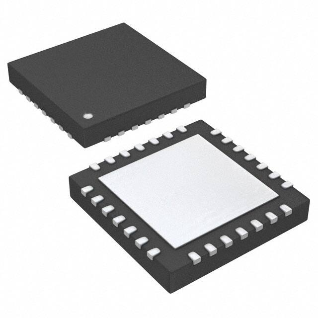

    高精度16位600kHz假差分输入模数转换器,带有单端输入,内置采样保持电路,高速CMOS串行,支持2's补码或直二进制输出格式。
ADS8370IBRHPT 数据手册
          ADS8370 SLAS450 – JUNE 2005 16-BIT, 600-kHz, PSEUDO-DIFFERENTIAL INPUT, MICROPOWER SAMPLING ANALOG-TO-DIGITAL CONVERTER WITH SERIAL INTERFACE AND REFERENCE • FEATURES • • • • • • • • • • • • • • • 600-kHz Sample Rate ±0.5 LSB Typ, ±1.25 LSB Max INL ±0.4 LSB Typ, ±0.75 LSB Max DNL 16-Bit NMC SINAD 89.5 dB, SFDR 119 dB at fi = 1 kHz High-Speed Serial Interface up to 40 MHz Onboard Reference Buffer Onboard 4.096-V Reference Pseudo-Differential Input, 0 V to 4.2 V Onboard Conversion Clock Selectable Output Format, 2's Complement or Straight Binary Zero Latency Wide Digital Supply Low Power: – 110 mW at 600 kHz – 15 mW During Nap Mode – 10 µW During Power Down 28-Pin 6 x 6 QFN Package Pin compatible With 18-Bit ADS8380 APPLICATIONS • • • • • Medical Instruments Optical Networking Transducer Interface High Accuracy Data Acquisition Systems Magnetometers DESCRIPTION The ADS8370 is a high performance 16-bit, 600-kHz A/D converter with single-ended (pseudo-differential) input. The device includes an 16-bit capacitor-based SAR A/D converter with inherent sample and hold. The ADS8370 offers a high-speed CMOS serial interface with clock speeds up to 40 MHz. The ADS8370 is available in a 28 lead 6 × 6 QFN package and is characterized over the industrial –40°C to 85°C temperature range. High Speed SAR Converter Family Type/Speed 18-Bit Pseudo-Diff 500 kHz ~ 600 kHz ADS8383 750 kHZ 1 MHz 1.25 MHz 2 MHz 3 MHz 4 MHz ADS8381 ADS8380 (S) 18-Bit Pseudo-Bipolar, Fully Diff ADS8382 (S) 16-Bit Pseudo-Diff ADS8370 (S) 16-Bit Pseudo-Bipolar, Fully Diff ADS8372 (S) ADS8371 14-Bit Pseudo-Diff ADS8401/05 ADS8411 ADS8402/06 ADS8412 ADS7890 (S) 12-Bit Pseudo-Diff ADS7891 ADS7886 SAR +IN −IN + _ CDAC ADS7881 Output Latches and 3-State Drivers FS SCLK SB/2C SDO Comparator REFIN REFOUT 4.096-V Internal Reference Clock Conversion and Control Logic CS CONVST BUSY PD Please be aware that an important notice concerning availability, standard warranty, and use in critical applications of Texas Instruments semiconductor products and disclaimers thereto appears at the end of this data sheet. PRODUCTION DATA information is current as of publication date. Products conform to specifications per the terms of the Texas Instruments standard warranty. Production processing does not necessarily include testing of all parameters. Copyright © 2005, Texas Instruments Incorporated ADS8370 www.ti.com SLAS450 – JUNE 2005 These devices have limited built-in ESD protection. The leads should be shorted together or the device placed in conductive foam during storage or handling to prevent electrostatic damage to the MOS gates. ORDERING INFORMATION (1) MODEL MAXIMUM INTEGRAL LINEARITY (LSB) ADS8370I ADS8370IB (1) MAXIMUM DIFFERENTIAL LINEARITY (LSB) ±2 NO MISSING CODES RESOLUTION (BIT) PACKAGE TYPE 16 28 Pin 6×6 QFN –1/1.5 ±1.25 ±0.75 PACKAGE DESIGNATOR 28 Pin 6×6 QFN 16 RHP RHP TEMPERATURE RANGE ORDERING INFORMATION TRANSPORT MEDIA QUANTITY ADS8370IRHPT Small Tape and reel 250 ADS8370IRHPR Tape and reel 2500 ADS8370IBRHPT Small Tape and reel 250 ADS8370IBRHPR Tape and reel 2500 –40°C to 85°C –40°C to 85°C For the most current package and ordering information, see the Package Option Addendum at the end of this document, or see the TI website at www.ti.com. ABSOLUTE MAXIMUM RATINGS over operating free-air temperature range unless otherwise noted (1) UNIT Voltage +IN to AGND –0.3 V to +VA + 0.3 V –IN to AGND –0.3 V to +VA + 0.3 V +VA to AGND –0.3 V to 6 V +VBD to BDGND –0.3 V to 6 V Digital input voltage to BDGND –0.3 V to +VBD + 0.3 V Digital input voltage to +VA +0.3 V Operating free-air temperature range, TA –40°C to 85°C Storage temperature range, Tstg –65°C to 150°C Junction temperature (TJ max) QFN package Lead temperature, soldering (1) 2 150°C Power dissipation (TJmax – TA)/θJA θJA thermal impedance 86°C/W Vapor phase (60 sec) 215°C Infrared (15 sec) 220°C Stresses beyond those listed under "absolute maximum ratings" may cause permanent damage to the device. These are stress ratings only, and functional operation of the device at these or any other conditions beyond those indicated under "recommended operating conditions" is not implied. Exposure to absolute-maximum-rated conditions for extended periods may affect device reliability. Submit Documentation Feedback ADS8370 www.ti.com SLAS450 – JUNE 2005 SPECIFICATIONS At –40°C to 85°C, +VA = +5 V, +VBD = +5 V or +VBD = +2.7 V, using internal or external reference, fSAMPLE = 600 kHz, unless otherwise noted. (All performance parameters are valid only after device has properly resumed from power down, see Table 2.) PARAMETER TEST CONDITIONS ADS8370IB MIN TYP ADS8370I MAX MIN TYP MAX 0 Vref 0 Vref +IN –0.2 Vref + 0.2 –0.2 Vref + 0.2 –IN –0.2 0.2 –0.2 0.2 UNIT ANALOG INPUT Full-scale input voltage (1) Absolute input voltage +IN – (–IN) Sampling capacitance (measured from ±IN to AGND) Input leakage current V V 40 40 pF 1 1 nA 16 Bits SYSTEM PERFORMANCE Resolution 16 No missing codes Integral linearity (2) (3) (4) INL DNL Differential linearity (3) EO Offset error 16 Quiet zones observed –1.25 Quiet zones not observed Quiet zones observed –0.75 PSRR ±0.4 ±0.4 –0.075 Gain temperature drift (3) (5) CMRR –2 2 LSB (16 bit) 0.75 –1 1.5 LSB (16 bit) 0.75 –1.5 ±0.4 Gain error (3) (5) Bits 1.25 ±0.75 Offset temperature drift (3) EG ±0.5 ±0.8 –0.75 Quiet zones not observed (3) 16 1.5 ±0.4 0.075 –0.15 mV ppm/°C 0.15 %FS ±1.25 ±1.25 ppm/°C At DC 80 80 Common-mode rejection ratio [+IN – (–IN)] = Vref/2 with 50 mVp-p common mode signal at 1 MHz 55 55 Noise At 0 V analog input 40 40 µV RMS DC Power supply rejection ratio At full scale analog input 55 55 dB dB SAMPLING DYNAMICS Conversion time 1.0 Acquisition time 0.50 1.16 Throughput rate 1.16 µs 600 kHz µs 600 Aperture delay 10 10 ns Aperture jitter 12 12 ps RMS 400 400 ns 400 400 ns Step response Overvoltage recovery (1) (2) (3) (4) (5) (6) 1.0 0.50 (6) Ideal input span; does not include gain or offset error. LSB means least significant bit. Measured using analog input circuit in Figure 51 and digital stimulus in Figure 56 and Figure 57 and reference voltage of 4.096 V. This is endpoint INL, not best fit. Measured using external reference source so does not include internal reference voltage error or drift. Defined as sampling time necessary to settle an initial error of Vref on the sampling capacitor to a final error of 1 LSB at 16-bit level. Measured using the input circuit in Figure 51. Submit Documentation Feedback 3 ADS8370 www.ti.com SLAS450 – JUNE 2005 SPECIFICATIONS (continued) At –40°C to 85°C, +VA = +5 V, +VBD = +5 V or +VBD = +2.7 V, using internal or external reference, fSAMPLE = 600 kHz, unless otherwise noted. (All performance parameters are valid only after device has properly resumed from power down, see Table 2.) PARAMETER TEST CONDITIONS ADS8370IB MIN ADS8370I TYP MAX MIN TYP MAX UNIT DYNAMIC CHARACTERISTICS Total harmonic distortion (7) (8) THD Signal-to-noise ratio (7) SNR SINAD SFDR Signal-to-noise + distortion (7) (8) Spurious free dynamic range (7) VIN = 4 Vp-p at 1 kHz –112 –111 VIN = 4 Vp-p at 10 kHz –111 –111 VIN = 4 Vp-p at 100 kHz –92 –92 VIN = 4 Vp-p at 1 kHz 89.5 89.5 VIN = 4 Vp-p at 10 kHz 89.5 89 VIN = 4 Vp-p at 100 kHz 89.5 88.5 VIN = 4 Vp-p at 1 kHz 89.5 89.5 VIN = 4 Vp-p at 10 kHz 89.5 89 VIN = 4 Vp-p at 100 kHz 87.5 87 VIN = 4 Vp-p at 1 kHz 119 119 VIN = 4 Vp-p at 10 kHz 117 117 VIN = 4 Vp-p at 100 kHz 92 92 75 75 –3dB Small signal bandwidth dB dB dB dB MHz REFERENCE INPUT Vref Reference voltage input range 2.5 Resistance (9) 4.096 4.2 2.5 10 4.096 4.2 10 V MΩ INTERNAL REFERENCE OUTPUT Vref Reference voltage range IOUT = 0 A, TA = 30°C Source current Static load 4.088 4.096 4.104 4.088 4.096 Line regulation +VA = 4.75 V to 5.25 V 2.5 2.5 mV Drift IOUT = 0 A 25 25 ppm/°C 10 4.104 V 10 µA DIGITAL INPUT/OUTPUT Logic family CMOS VIH High level input voltage +VBD – 1 +VBD + 0.3 +VBD – 1 +VBD + 0.3 V VIL Low level input voltage –0.3 0.8 –0.3 0.8 V VOH High level output voltage IOH = 2 TTL loads VOL Low level output voltage IOL = 2 TTL loads +VBD –0.6 +VBD –0.6 V 0.4 0.4 V Data format: MSB first, 2's complement or straight binary (selectable via the SB/2C pin) POWER SUPPLY REQUIREMENTS Power supply voltage +VA +VBD Supply current, 600-kHz sample rate (10) ICC 4.75 5 5.25 4.75 5 5.25 V 2.7 3.3 5.25 2.7 3.3 5.25 V 22 25 22 25 +VA = 5 V mA POWER DOWN ICC(PD) Supply current, power down 2 µA 2 NAP MODE ICC(NAP) Supply current, nap mode 3 Power-up time from nap 3 300 mA 300 ns 85 °C TEMPERATURE RANGE Specified performance (7) (8) (9) (10) 4 –40 85 –40 Measured using analog input circuit in Figure 51 and digital stimulus in Figure 56 and Figure 57 and reference voltage of 4.096 V. Calculated on the first nine harmonics of the input frequency. Can vary +/-30%. This includes only +VA current. With +VBD = 5 V, +VBD current is typically 1 mA with a 10-pF load capacitance on the digital output pins. Submit Documentation Feedback ADS8370 www.ti.com SLAS450 – JUNE 2005 TIMING REQUIREMENTS (1) (2) (3) (4) (5) (6) ADS8370I/ADS8370IB PARAMETER MIN 1000 TYP MAX 1160 UNIT REF FIGURE tconv Conversion time ns 41 – 44 tacq1 Acquisition time in normal mode 0.5 µs 41,42,44 tacq2 Acquisition time in nap mode (tacq2 = tacq1 + td18) 0.8 µs 43 CONVERSION AND SAMPLING tquiet1 Quite sampling time (last toggle of interface signals to convert start command) (6) 30 ns 40 – 43, 45 – 47 tquiet2 Quite sampling time (convert start command to first toggle of interface signals) (6) 10 ns 40 – 43, 45 – 47 600 ns 40 – 43, 45,47 tquiet3 Quite conversion time (last toggle of interface signals to fall of BUSY) (6) tsu1 Setup time, CONVST before BUSY fall 15 ns 41 tsu2 Setup time, CS before BUSY fall (only for conversion/sampling control) 20 ns 40,41 tsu4 Setup time, CONVST before CS rise (so CONVST can be recognized) 5 ns 41,43,44 th1 Hold time, CS after BUSY fall (only for conversion/sampling control) 0 ns 41 th3 Hold time, CONVST after CS rise 7 ns 43 th4 Hold time, CONVST after CS fall (to ensure width of CONVST_QUAL) (4) 20 ns 42 tw1 CONVST pulse duration 20 ns 43 tw2 CS pulse duration 10 ns 41,42 tw5 Pulse duration, time between conversion start command and conversion abort command to successfully abort the ongoing conversion ns 44 ns 45 – 47 1000 DATA READ OPERATION tcyc SCLK period 25 SCLK duty cycle 40% 60% tsu5 Setup time, CS fall before first SCLK fall 10 ns 45 tsu6 Setup time, CS fall before FS rise 7 ns 46,47 tsu7 Setup time, FS fall before first SCLK fall 7 ns 46,47 th5 Hold time, CS fall after SCLK fall 3 ns 45 th6 Hold time, FS fall after SCLK fall 7 ns 46,47 tsu2 Setup time, CS fall before BUSY fall (only for read control) 20 ns 40,45 tsu3 Setup time, FS fall before BUSY fall (only for read control) 20 ns 40,47 th2 Hold time, CS fall after BUSY fall (only for read control) 15 ns 40,45 th8 Hold time, FS fall after BUSY fall (only for read control) 15 ns 40,47 tw2 CS pulse duration 10 ns 45 tw3 FS pulse duration 10 ns 46,47 PD pulse duration for reset and power down 60 ns 53,54 All unspecified pulse durations 10 ns MISCELLANEOUS tw4 (1) (2) (3) (4) (5) (6) All input signals are specified with tr = tf = 5 ns (10% to 90% of VDD) and timed from a voltage level of (VIL + VIH)/2. All specifications typical at –40°C to 85°C, +VA = +4.75 V to +5.25 V, +VBD = +2.7 V to +5.25 V. All digital output signals loaded with 10-pF capacitors. CONVST_QUAL is CONVST latched by a low value on CS (see Figure 39). Reference figure indicated is only a representative of where the timing is applicable and is not exhaustive. Quiet time zones are for meeting performance and not functionality. Submit Documentation Feedback 5 ADS8370 www.ti.com SLAS450 – JUNE 2005 TIMING CHARACTERISTICS (1) (2) (3) (4) ADS8370I/ADS8370IB PARAMETER MIN TYP UNIT REF FIGURE 10 ns 41,43 MAX CONVERSION AND SAMPLING td1 Delay time, conversion start command to conversion start (aperture delay) td2 Delay time, conversion end to BUSY fall td4 Delay time, conversion start command to BUSY rise td3 Delay time, CONVST rise to sample start td5 td6 5 ns 41 – 43 20 ns 41 5 ns 43 Delay time, CS fall to sample start 10 ns 43 Delay time, conversion abort command to BUSY fall 10 ns 44 DATA READ OPERATION td12 Delay time, CS fall to MSB valid 3 15 ns 45 td15 Delay time, FS rise to MSB valid 6 18 ns 46,47 18 ns 47 10 ns 45– 47 6 ns 45 55 ns 53,54 300 ns 55 td7 Delay time, BUSY fall to MSB valid (if FS is high when BUSY falls) td13 Delay time, SCLK rise to bit valid 2 td14 Delay time, CS rise to SDO 3-state MISCELLANEOUS td10 Delay time, PD rise to SDO 3-state Nap mode td18 Delay time, total device resume time Full power down (external reference used with or without 1-µF||0.1-µF capacitor on REFOUT) td11 + 2x conversions Full power down (internal reference used with or without 1-µF||0.1-µF capacitor on REFOUT) 25 (4) ms 53 1 td11 Delay time, untrimmed circuit full power-down resume time td16 Delay time, device power-down time td17 Delay time, trimmed internal reference settling (either by turning on supply or resuming from full power-down mode), with 1-µF||0.1-µF capacitor on REFOUT (1) (2) (3) (4) 6 Nap Full power down (internal/external reference used) ms 53,54 200 ns 55 10 µs 53,54 ms 53 4 All input signals are specified with tr = tf = 5 ns (10% to 90% of VDD) and timed from a voltage level of (VIL + VIH)/2. All specifications typical at –40°C to 85°C, +VA = +4.75 V to +5.25 V, +VBD = +2.7 V to +5.25 V. All digital output signals loaded with 10-pF capacitors. Including td11, two conversions (time to cycle CONVST twice), and td17. Submit Documentation Feedback 54 ADS8370 www.ti.com SLAS450 – JUNE 2005 PIN ASSIGNMENTS 28 27 26 25 24 23 22 PD FS CS CONVST SCLK SDO BUSY TOP VIEW 1 SB/2C BDGND 21 2 AGND +VBD 20 3 +VA AGND 19 4 AGND AGND 18 5 AGND +VA 17 6 +VA +VA 16 7 REFM AGND 15 Note: +VA −IN 12 14 +IN 11 NC NC 10 13 REFOUT 9 8 REFIN ADS8370 The package thermal pad must be soldered to the printed circuit board for thermal and mechanical performance. TERMINAL FUNCTIONS PIN NAME AGND NO. I/O DESCRIPTION 2, 4, 5, 15, 18, 19 – Analog ground pins. AGND must be shorted to analog ground plane below the device. BDGND 21 – Digital ground for all digital inputs and outputs. BDGND must be shorted to the analog ground plane below the device. BUSY 22 O Status output. This pin is high when conversion is in progress. CONVST 25 I Convert start. This signal is qualified with CS internally. CS 26 I Chip select FS 27 I Frame sync. This signal is qualified with CS internally. +IN 11 I Noninverting analog input channel –IN 12 I Inverting analog input channel NC 10, 13 – No connection PD 28 I Power down. Device resets and powers down when this signal is high. REFIN 8 I Reference (positive) input. REFIN must be decoupled with REFM pin using 0.1-µF bypass capacitor and 1-µF storage capacitor. REFM 7 I Reference ground. To be connected to analog ground plane. REFOUT 9 O Internal reference output. Shorted to REFIN pin only when internal reference is used. SB/2C 1 I Straight binary or 2's complement output data format. When low the device output is straight binary format; when high the device output is 2's complement format. See Table 1. SCLK 24 I Serial clock. Data is shifted onto SDO with the rising edge of this clock. This signal is qualified with CS internally. SDO 23 O Serial data out. All bits except MSB are shifted out at the rising edge of SCLK. +VA 3, 6, 14, 16, 17 – Analog power supplies 20 – Digital power supply for all digital inputs and outputs. +VBD Submit Documentation Feedback 7 ADS8370 www.ti.com SLAS450 – JUNE 2005 TYPICAL CHARACTERISTICS SIGNAL-TO-NOISE AND DISTORTION vs REFERENCE VOLTAGE SIGNAL-TO-NOISE RATIO vs REFERENCE VOLTAGE SINAD − Signal-to-Noise and Distortion − dB SNR − Signal-to-Noise Ratio − dB 91 +VA = 5 V, +VBD = 5 V, fi = 1 kHz, TA = 25°C 90 89 88 87 86 85 2.5 3 3.5 4 91 +VA = 5 V, +VBD = 5 V, fi = 1 kHz, TA = 25°C 90 89 88 87 86 85 2.5 4 Figure 2. SPURIOUS FREE DYNAMIC RANGE vs REFERENCE VOLTAGE TOTAL HARMONIC DISTORTION vs REFERENCE VOLTAGE 120 −106 +VA = 5 V, +VBD = 5 V, fi = 1 kHz, TA = 25°C 119 118 117 116 115 114 113 112 111 2.5 3 3.5 −107 −108 −109 −110 +VA = 5 V, +VBD = 5 V, fi = 1 kHz, TA = 25°C −111 −112 4 2.5 3 3.5 4 Vref − Reference Voltage − V Figure 3. Figure 4. EFFECTIVE NUMBER OF BITS vs REFERENCE VOLTAGE EFFECTIVE NUMBER OF BITS vs FREE-AIR TEMPERATURE 14.7 ENOB − Effective Number of Bits − Bits 14.6 ENOB − Effective Number of Bits − Bits 3.5 Figure 1. Vref − Reference Voltage − V +VA = 5 V, +VBD = 5 V, fi = 1 kHz, TA = 25°C 14.5 14.4 14.3 14.2 14.1 14 14.6 14.5 14.4 14.3 +VA = 5 V, +VBD = 5 V, REFIN = 4.096 V, fi = 1 kHz, 14.2 13.9 2.5 3 3.5 Vref − Reference Voltage − V 4 −40 −25 −10 5 20 35 50 65 TA − Free-Air-Temperature − 5C Figure 5. 8 3 Vref − Reference Voltage − V THD − Total Harmonic Distortion − dB SFDR − Spurious Free Dynamic Range − dB Vref − Reference Voltage − V Figure 6. Submit Documentation Feedback 80 ADS8370 www.ti.com SLAS450 – JUNE 2005 TYPICAL CHARACTERISTICS (continued) SIGNAL-TO-NOISE AND DISTORTION vs FREE-AIR TEMPERATURE SIGNAL-TO-NOISE RATIO vs FREE-AIR TEMPERATURE SINAD − Signal-to-Noise and Distortion − dB SNR − Signal-to-Noise Ratio − dB 90 89.5 89 88.5 88 +VA = 5 V, +VBD = 5 V, REFIN = 4.096 V, fi = 1 kHz, 87.5 87 80 89.5 89 88.5 88 +VA = 5 V, +VBD = 5 V, REFIN = 4.096 V, fi = 1 kHz, 87.5 87 −40 −25 −10 20 35 50 65 80 Figure 7. Figure 8. SPURIOUS FREE DYNAMIC RANGE vs FREE-AIR TEMPERATURE TOTAL HARMONIC DISTORTION vs FREE-AIR TEMPERATURE −100 120 119 118 117 116 115 114 +VA = 5 V, +VBD = 5 V, REFIN = 4.096 V, fi = 1 kHz, 113 112 5 20 35 50 65 −102 −104 −106 −108 −110 80 20 35 50 Figure 9. Figure 10. EFFECTIVE NUMBER OF BITS vs INPUT FREQUENCY SIGNAL-TO-NOISE AND DISTORTION vs INPUT FREQUENCY SINAD − Signal-to-Noise and Distortion − dB 14.6 14.55 14.5 +VA = 5 V, +VBD = 5 V, REFIN = 4.096 V, TA = 25°C 14.4 1 5 10 65 80 TA − Free-Air-Temperature − 5C TA − Free-Air-Temperature − 5C 14.45 +VA = 5 V, +VBD = 5 V, REFIN = 4.096 V, fi = 1 kHz, −112 −40 −25 −10 111 −40 −25 −10 ENOB − Effective Number of Bits − Bits 5 TA − Free-Air-Temperature − 5C THD − Total Harmonic Distortion − dB SFDR − Spurious Free Dynamic Range − dB −40 −25 −10 5 20 35 50 65 TA − Free-Air-Temperature − 5C 90 100 fi − Input Frequency − kHz Figure 11. 89.6 89.4 89.2 89 88.8 +VA = 5 V, +VBD = 5 V, REFIN = 4.096 V, TA = 25°C 88.6 88.4 1 10 fi − Input Frequency − kHz 100 Figure 12. Submit Documentation Feedback 9 ADS8370 www.ti.com SLAS450 – JUNE 2005 TYPICAL CHARACTERISTICS (continued) SIGNAL-TO-NOISE RATIO vs INPUT FREQUENCY SPURIOUS FREE DYNAMIC RANGE vs INPUT FREQUENCY SFDR − Spurious Free Dynamic Range − dB SNR − Signal-to-Noise Ratio − dB 89.6 89.4 89.2 89 88.8 +VA = 5 V, +VBD = 5 V, REFIN = 4.096 V, TA = 25°C 88.6 88.4 1 10 fi − Input Frequency − kHz 140 120 100 80 60 40 +VA = 5 V, +VBD = 5 V, REFIN = 4.096 V, TA = 25°C 20 0 100 10 1 100 fi − Input Frequency − kHz Figure 13. Figure 14. TOTAL HARMONIC DISTORTION vs INPUT FREQUENCY THD − Total Harmonic Distortion − dB 0 +VA = 5 V, +VBD = 5 V, REFIN = 4.096 V, TA = 25°C −20 −40 −60 −80 −100 −120 1 10 100 fi − Input Frequency − kHz Figure 15. HISTOGRAM 65536 CONVERSIONS WITH A DC INPUT AT ZERO SCALE (0 V) 40000 35000 30000 HISTOGRAM 100000 CONVERSIONS WITH A DC INPUT CLOSE TO FULL SCALE (4 V) 60000 +VA = 5 V, +VBD = 5 V, REFIN = 4.096 V, TA = 25°C +VA = 5 V, +VBD = 5 V, REFIN = 4.096 V, TA = 25°C 50000 40000 Hits Hits 25000 20000 15000 30000 20000 10000 10000 65430 Code Out (Straight Binary Code in Decimal) Figure 16. 10 Figure 17. Submit Documentation Feedback 65431 65428 65429 65426 65427 65424 65425 65422 0 65423 49 50 51 52 53 54 55 56 57 58 59 60 Code Out (Straight Binary Code in Decimal) 65420 0 65421 5000 ADS8370 www.ti.com SLAS450 – JUNE 2005 TYPICAL CHARACTERISTICS (continued) GAIN ERROR vs REFERENCE VOLTAGE GAIN ERROR vs ANALOG SUPPLY VOLTAGE 1 4 EG − Gain Error − mV 0.6 EG − Gain Error − mV 6 +VA = 5 V, +VBD = 5 V, TA = 25°C 0.8 0.4 0.2 0 −0.2 −0.4 2 0 −2 −0.6 +VBD = 5 V, REFIN = 4.096 V, TA = 25°C −4 −0.8 −6 4.75 −1 2.5 3 3.5 Vref − Reference Voltage − V 4 Figure 18. Figure 19. GAIN ERROR vs FREE-AIR TEMPERATURE OFFSET ERROR vs REFERENCE VOLTAGE 2 1 +VA = 5 V, +VBD = 5 V, REFIN = 4.096 V +VA = 5 V, +VBD = 5 V, TA = 25°C EO − Offset Error − mV 0.75 1 EG − Gain Error − mV 5.25 5 +VA − Analog Supply Voltage − V 0 0.5 0.25 0 −0.25 −1 −0.5 −0.75 −2 −1 −40 −25 −10 5 20 35 50 65 2.5 80 Figure 21. OFFSET ERROR vs FREE-AIR TEMPERATURE OFFSET ERROR vs SUPPLY VOLTAGE 4 0.2 +VA = 5 V, +VBD = 5 V, REFIN = 4.096 V 0.1 EO − Offset Error − mV EO − Offset Error − mV 3.5 Figure 20. 1 0.75 3 Vref − Reference Voltage − V TA − Free-Air-Temperature − 5C 0.5 0.25 0 −0.25 −0.5 −0.75 +VBD = 5 V, REFIN = 4.096 V, TA = 25°C 0 −0.1 −0.2 −0.3 −0.4 −0.5 −1 −40 −25 −10 −0.6 5 20 35 50 65 80 TA − Free-Air-Temperature − 5C Figure 22. 4.75 5 +VA − Analog Supply Voltage − V 5.25 Figure 23. Submit Documentation Feedback 11 ADS8370 www.ti.com SLAS450 – JUNE 2005 TYPICAL CHARACTERISTICS (continued) POWER DISSIPATION vs SUPPLY VOLTAGE POWER DISSIPATION vs SAMPLE RATE 140 116 PD − Power Dissipation − mW 114 112 PD − Power Dissipation − mW +VBD = 5 V, fs = 600 KSPS TA = 25°C 110 108 106 104 102 Normal Mode Current 100 80 60 NAP Mode Current 40 +VA = 5 .25 V, +VBD = 5.25 V, TA = 25°C 20 0 100 4.75 5 +VA − Analog Supply Voltage − V 0 5.25 300 400 500 600 Figure 25. POWER DISSIPATION vs FREE-AIR TEMPERATURE DIFFERENTIAL NONLINEARITY vs REFERENCE VOLTAGE 1 DNL − Diffreential Nonlinearity − LSB +VA = 5 V, +VBD = 5 V, fs = 600 KSPS 115 110 105 −40 −25 −10 5 20 35 50 65 0.8 0.6 MAX 0.4 0.2 0 −0.2 MIN −0.4 +VA = 5 V, +VBD = 5 V, TA = 25°C −0.6 −0.8 −1 2.5 80 TA − Free-Air Temperature − °C 3 3.5 Vref − Reference Voltage − V 4 Figure 26. Figure 27. INTEGRAL NONLINEARITY vs REFERENCE VOLTAGE DIFFERENTIAL NONLINEARITY vs FREE-AIR TEMPERATURE 1 DNL − Diffreential Nonlinearity − LSB 1 INL − Integral Nonlinearity − LSB 200 Figure 24. 100 0.8 MAX 0.6 0.4 +VA = 5 V, +VBD = 5 V, TA = 25°C 0.2 0 −0.2 −0.4 MIN −0.6 −0.8 −1 2.5 3 3.5 4 0.8 0.6 MAX 0.4 0.2 0 −0.2 MIN −0.4 −0.6 −0.8 +VA = 5 V, +VBD = 5 V, REFIN = 4.096 V −1 −40 −25 −10 5 20 35 50 65 TA − Free-Air-Temperature − 5C Vref − Reference Voltage − V Figure 28. 12 100 fs − Sample Rate − KSPS 120 PD − Power Dissipation − mW 120 Figure 29. Submit Documentation Feedback 80 ADS8370 www.ti.com SLAS450 – JUNE 2005 TYPICAL CHARACTERISTICS (continued) INTEGRAL NONLINEARITY vs FREE-AIR TEMPERATURE INTERNAL VOLTAGE REFERENCE vs FREE-AIR TEMPERATURE 4.126 MAX Internal Reference Output Voltage − V INL − Integral Nonlinearity − LSB 1 0.8 0.6 0.4 0.2 +VA = 5 V, +VBD = 5 V, REFIN = 4.096 V 0 −0.2 MIN −0.4 −0.6 −0.8 −1 −40 −25 −10 +VA = 5 V, +VBD = 5 V, 4.116 4.106 4.096 4.086 4.076 4.066 5 20 35 50 65 80 −40 −25 −10 5 35 50 Figure 30. Figure 31. INTERNAL VOLTAGE REFERENCE vs SUPPLY VOLTAGE DELAY TIME vs LOAD CAPACITANCE 4.126 65 80 9.5 SCLK to SDO Delay Time (td13 ) − ns +VBD = 5 V, TA = 25°C 4.116 4.106 4.096 4.086 4.076 4.066 4.75 5 +VA = 5 V, TA = 85°C 9 8.5 8 +VBD = 2.7 V 7.5 7 +VBD = 5 V 6.5 6 5.5 5 4.5 5.25 5 +VA − Analog Supply Voltage − V 10 15 20 CL − Load Capacitance − pF Figure 32. Figure 33. DIFFERENTIAL NONLINEARITY 1 0.8 0.6 DNL − LSBs Internal Reference Output Voltage − V 20 TA − Free-Air Temperature − °C TA − Free-Air-Temperature − 5C 0.4 0.2 0 −0.2 +VA = 5 V, +VBD = 5 V, REFIN = 4.096 V, fS = 600 KSPS, TA = 25°C −0.4 −0.6 −0.8 −1 0 16384 32768 49152 65536 Code (Straight Binary Code in Decimal) Figure 34. Submit Documentation Feedback 13 ADS8370 www.ti.com SLAS450 – JUNE 2005 TYPICAL CHARACTERISTICS (continued) INTEGRAL NONLINEARITY 1 0.8 INL − LSB 0.6 0.4 0.2 0 −0.2 −0.4 −0.6 −0.8 +VA = 5 V, +VBD = 5 V, REFIN = 4.096 V, fS = 600 KSPS, TA = 25°C −1 0 16384 32768 Code (Straight Binary Code in Decimal) 49152 65536 Figure 35. FFT (100 kHz Input) 0 +VA = 5 V, +VBD = 5 V, REFIN = 4.096 V, fS = 600 KSPS, TA = 25°C −20 Amplitude − dB −40 −60 −80 −100 −120 −140 −160 −180 −200 0 50000 100000 150000 200000 250000 300000 f − Frequency − Hz Figure 36. FFT (10 kHz Input) 20 +VA = 5 V, +VBD = 5 V, REFIN = 4.096 V, fS = 600 KSPS, TA = 25°C 0 −20 Amplitude − dB −40 −60 −80 −100 −120 −140 −160 −180 −200 0 50000 100000 150000 200000 f − Frequency − Hz Figure 37. 14 Submit Documentation Feedback 250000 300000 ADS8370 www.ti.com SLAS450 – JUNE 2005 Power On BUSY=0 +VA and +VBD Reach Operation Range and PD = 0 Sample BUSY=0 CS = 0 and CONVST = 1 Falling Edge of CONVST_QUAL SOC BUSY=0 −> 1 CS = 0 and CONVST = 1 Back to Back Cycle CS = 0 and CONVST = 1 Falling Edge of CONVST_QUAL and BUSY = 1 CONVERSION Abort EOC BUSY= 1−>0 CONVST_QUAL = 0 A. CONVST_QUAL = 1 and CS = 1 NAP Wait BUSY=0 BUSY=0 EOC = End of conversion, SOC = Start of conversion, CONVST_QUAL is CONVST latched by CS = 0, see Figure 39. Figure 38. Device States and Ideal Transitions CONVST Q D CONVST_QUAL LATCH CS LATCH Figure 39. Relationship Between CONVST_QUAL, CS, and CONVST TIMING DIAGRAMS In the following descriptions, the signal CONVST_QUAL represents CONVST latched by a low value on CS (see Figure 39). To avoid performance degradation, there are three quiet zones to be observed (tquiet1 and tquiet2 are zones before and after the falling edge of CONVST_QUAL while tquiet3 is a time zone before the falling edge of BUSY) where there should be no I/O activities. Interface control signals, including the serial clock should remain steady. Typical degradation in performance if these quiet zones are not observed is depicted in the specifications section. To avoid data loss a read operation should not start around the BUSY falling edge. This is constrained by tsu2, tsu3, th2, and th8. Submit Documentation Feedback 15 ADS8370 www.ti.com SLAS450 – JUNE 2005 CONVST_QUAL tquiet1 tquiet2 BUSY tquiet3 CS Quiet Zones FS tsu3 CS th8 tsu2 BUSY th2 No Read Zone (FS Initiated) BUSY No Read Zone (CS Initiated) Figure 40. Quiet Zones and No-Read Zones CONVERSION AND SAMPLING 1. Convert start command: The device enters the conversion phase from the sampling phase when a falling edge is detected on CONVST_QUAL. This is shown in Figure 41, Figure 42, and Figure 43. 2. Sample (acquisition) start command: The device starts sampling from the wait state or at the end of a conversion if CONVST_QUAL is detected as high and CS as low. This is shown in Figure 41, Figure 42, and Figure 43. Maintaining this condition when the device has just finished a conversion (as shown in Figure 41) takes the device immediately into the sampling phase after the conversion phase (back-to-back conversion) and hence achieves maximum throughput. Otherwise, the device enters the wait state. tsu2 tw2 th1 CS tsu4 CONVST tsu1 td1 CONVST_QUAL (Device Internal) tquiet2 tquiet2 tquiet1 tquiet1 SAMPLE CONVERT DEVICE STATE SAMPLE tacq1 tCONV td2 td4 BUSY tquiet3 Figure 41. Back-To-Back Conversion and Sample 16 Submit Documentation Feedback ADS8370 www.ti.com SLAS450 – JUNE 2005 3. Wait/Nap entry stimulus: The device enters the wait phase at the end of the conversion if the sample start command is not given. This is shown in Figure 42. tw2 tsu4 CS th4 CONVST CONVST_QUAL (Device Internal) tquiet2 tquiet2 tquiet1 tquiet1 DEVICE STATE SAMPLE CONVERT SAMPLE WAIT tCONV tacq1 td2 BUSY tquiet3 Figure 42. Convert and Sample with Wait If lower power dissipation is desired and throughput can be compromised, a nap state can be inserted in between cycles (as shown in Figure 43). The device enters a low power (3 mA) state called nap if the end of the conversion happens when CONVST_QUAL is low. The cost for using this special wait state is a longer sampling time (tacq2) plus the nap time. th3 CS td5 tw1 CONVST td1 CONVST_QUAL td3 tquiet2 tquiet2 (Device Internal) tquiet1 tquiet1 DEVICE STATE NAP SAMPLE CONVERT NAP tCONV SAMPLE CONVERT NAP SAMPLE tacq2 td2 BUSY tquiet3 tquiet3 td4 Figure 43. Convert and Sample with Nap Submit Documentation Feedback 17 ADS8370 www.ti.com SLAS450 – JUNE 2005 4. Conversion abort command An ongoing conversion can be aborted by using the conversion abort command. This is done by forcing another start of conversion (a valid CONVST_QUAL falling edge) onto an ongoing conversion as shown in Figure 44. The device enters the wait state after an aborted conversion. If the previous conversion was successfully aborted, the device output reads 0xFF00 on SDO. tw5 CS tw5 tsu4 CONVST CONVST_QUAL (Device Internal) DEVICE STATE SAMPLE CONVERT WAIT SAMPLE CONVERT tacq1 tCONV WAIT Incomplete Conversion Incomplete Conversion tCONV BUSY td6 td6 Figure 44. Conversion Abort DATA READ OPERATION Data read control is independent of conversion control. Data can be read either during conversion or during sampling. Data that is read during a conversion involves latency of one sample. The start of a new data frame around the fall of BUSY is constrained by tsu2, tsu3, th2, and th8. 1. SPI Interface: A data read operation in SPI interface mode is shown in Figure 45. FS must be tied high for operating in this mode. The MSB of the output data is available at the falling edge of CS. MSB – 1 is shifted out at the first rising edge after the first falling edge of SCLK after CS falling edge. Subsequent bits are shifted at the subsequent rising edges of SCLK. If another data frame is attempted (by pulling CS high and subsequently low) during an active data frame, then the ongoing frame is aborted and a new frame is started. 18 Submit Documentation Feedback ADS8370 www.ti.com SLAS450 – JUNE 2005 2 1 SCLK 3 4 16 tsu5 th5 17 18 19 tcyc td14 CS tw2 tquiet2 CONVST tquiet1 td13 SDO MSB D15 BUSY LSB D14 D13 D12 D1 D0 D0 D15 Repeated If There is 19th SCLK td12 tquiet3 D0 Don’t Care (D0 Repeated) Conversion N Conversion N+1 th2 tsu2 CS Fall Before This Point Reads Data From Conversion N−1 CS Fall After This Point Reads Data From Conversion N No CS Fall Zone Figure 45. Read Frame Controlled via CS (FS = 1) If another data frame is attempted (by pulling CS high and then low) during an active data frame, then the ongoing frame is aborted and a new frame is started. 2. Serial interface using FS: A data read operation in this mode is shown in Figure 46 and Figure 47. The MSB of the output data is available at the rising edge of FS. MSB – 1 is shifted out at the first rising edge after the first falling edge of SCLK after the FS falling edge. Subsequent bits are shifted at the subsequent rising edges of SCLK. 1 SCLK 4 16 17 18 19 tcyc th6 tsu7 CS tsu6 3 2 tw3 FS CONVST tquiet1 td13 td15 MSB of Conversion N SDO D15 D14 D13 D12 D1 D0 D0 LSB D0 tquiet2 D15 Repeated If There is 19th SCLK BUSY Don’t Care (D0 Repeated) Conversion N+1 Conversion N Figure 46. Read Frame Controlled via FS (FS is Low When BUSY Falls) If FS is high when BUSY falls, the SDO is updated again with the new MSB when BUSY falls. This is shown in Figure 47. Submit Documentation Feedback 19 ADS8370 www.ti.com SLAS450 – JUNE 2005 1 SCLK 2 4 16 17 18 19 tcyc th6 tsu7 CS tsu6 3 tw3 FS CONVST MSB of Conversion N−1 MSB of Conversion N td15 tquiet1 td13 SDO D15 D14 D13 D12 D1 D0 D0 LSB D0 D15 Repeated If There is 19th SCLK td7 Don’t Care (D0 Repeated) tquiet3 BUSY Conversion N Conversion N+1 th8 tsu3 FS Fall Before This Point Reads Data From Conversion N−1 tquiet2 No FS Fall Zone FS Fall After This Point Reads Data From Conversion N Figure 47. Read Frame Controlled via FS (FS is High When BUSY Falls) If another data frame is attempted by pulling up FS during an active data frame, then the ongoing frame is aborted and a new frame is started. PRINCIPLES OF OPERATION The ADS8370 is a high-speed successive approximation register (SAR) analog-to-digital converter (ADC). The architecture is based on charge redistribution, which inherently includes a sample/hold function. The device includes a built-in conversion clock, internal reference, and 40-MHz SPI compatible serial interface. The maximum conversion time is 1.16 µs which is capable of sustaining a 600-kHz throughput. The analog input is provided to the two input pins: +IN and –IN. When a conversion is initiated, the differential input on these pins is sampled on the internal capacitor array. While a conversion is in progress, both inputs are disconnected from any internal function. REFERENCE The ADS8370 has a built-in 4.096-V (nominal value) reference but can operate with an external reference also. When the internal reference is used, pin 9 (REFOUT) should be shorted to pin 8 (REFIN) and a 0.1-µF decoupling capacitor and a 1-µF storage capacitor must be connected between pin 8 (REFIN) and pin 7 (REFM) (see Figure 48). The internal reference of the converter is buffered. 20 Submit Documentation Feedback ADS8370 www.ti.com SLAS450 – JUNE 2005 PRINCIPLES OF OPERATION (continued) ADS8370 REFOUT REFIN 1 mF 0.1 mF REFM AGND Figure 48. ADS8370 Using Internal Reference The REFIN pin is also internally buffered. This eliminates the need to put a high bandwidth buffer on the board to drive the ADC reference and saves system area and power. When an external reference is used, the reference must be of low noise, which may be achieved by the addition of bypass capacitors from the REFIN pin to the REFM pin. See Figure 49 for operation of the ADS8370 with an external reference. REFM must be connected to the analog ground plane. ADS8370 REFOUT 50 W REF3240 REFIN 0.1 mF 22 mF 1 mF REFM AGND AGND Figure 49. ADS8370 Using External Reference +VA ADS8370 +IN 53 W −IN 53 W 40 pF AGND + _ 40 pF AGND Figure 50. Simplified Analog Input ANALOG INPUT When the converter enters hold mode, the voltage difference between the +IN and –IN inputs is captured on the internal capacitor array. The +IN input has a range of –0.2 V to (+VREF + 0.2 V), whereas the –IN input has a range of –0.2 V to +0.2 V. The input span [+IN – (–IN)] is limited from 0 V to VREF. The input current on the analog inputs depends upon throughput and the frequency content of the analog input Submit Documentation Feedback 21 ADS8370 www.ti.com SLAS450 – JUNE 2005 PRINCIPLES OF OPERATION (continued) signals. Essentially, the current into the ADS8370 charges the internal capacitor array during the sampling (acquisition) time. After this capacitance has been fully charged, there is no further input current. The source of the analog input voltage must be able to charge the device sampling capacitance (40 pF each from +IN/–IN to AGND) to an 16-bit settling level within the sampling (acquisition) time of the device. When the converter goes into hold mode, the input resistance is greater than 1 GΩ. Care must be taken regarding the absolute analog input voltage. To maintain the linearity of the converter, the +IN, –IN inputs and the span [+IN – (–IN)] should be within the limits specified. Outside of these ranges, the converter's linearity may not meet specifications. Care should be taken to ensure that the output impedance of the sources driving +IN and –IN inputs are matched. If this is not observed, the two inputs can have different settling times. This can result in offset error, gain error, and linearity error which vary with temperature and input voltage. A typical input circuit using TI's THS4031 is shown in Figure 52. In the figure, input from a bipolar source is converted to a unipolar signal for the ADS8370. In the case where the source signal is in range for the ADS8370, the circuit in Figure 51 may be used. Most of the specified performance figure were measured using the circuit in Figure 51. Input Signal (0 V to 4 V) ADS8370 THS4031 20 W +IN 1.5 nF −IN 50 W 20 W Figure 51. Unipolar Input Drive Configuration ADS8370 1 V DC 600 W THS4031 20 W +IN 1.5 nF Input Signal (−2V to 2 V) −IN 600 W 20 W Figure 52. Bipolar Input Drive Configuration DIGITAL INTERFACE TIMING AND CONTROL Conversion and sampling are controlled by the CONVST and CS pins. See the timing diagrams for detailed information on timing signals and their requirements. The ADS8370 uses an internally generated clock to control the conversion rate and in turn the throughput of the converter. SCLK is used for reading converted data only. A clean and low jitter conversion start command is important for the performance of the converter. There is a minimal quiet zone requirement around the conversion start command as mentioned in the timing requirements table. 22 Submit Documentation Feedback ADS8370 www.ti.com SLAS450 – JUNE 2005 DIGITAL INTERFACE (continued) READING DATA The ADS8370 offers a high speed serial interface that is compatible with the SPI protocol. The device outputs data in either 2's complement format or straight binary format depending on the state of the SB/2C pin. Refer to Table 1 for the ideal output codes. Table 1. Input Voltages and Ideal Output Codes DESCRIPTION ANALOG VALUE +IN – (–IN) Full-scale range (+VREF) Least significant bit (LSB) (+VREF)/216 Full scale Mid scale DIGITAL OUTPUT (HEXADECIMAL) SB/2C Pin = 0 SB/2C Pin = 1 VREF – 1 LSB FFFF 7FFF (+VREF)/2 8000 0000 Mid scale – 1 LSB (+VREF)/2 – 1 LSB 7FFF FFFF 0 0 0000 8000 To avoid performance degradation due to the toggling of device buffers, read operation must not be performed in the specified quiet zones (tquiet1, tquiet2, and tquiet3). Internal to the device, the previously converted data is updated with the new data near the fall of BUSY. Hence, the fall of CS and the fall of FS around the fall of BUSY is constrained. This is specified by tsu2, tsu3, th2, and th8 in the timing requirements table. POWER SAVING The converter provides two power saving modes, full power down and nap. Refer to Table 2 for information on activation/deactivation and resumption time for both modes. Table 2. Power Save TYPE OF POWER DOWN SDO POWER CONSUMPTION ACTIVATED BY ACTIVATION TIME (td16) RESUME POWER BY Normal operation Not 3 stated 22 mA NA NA NA Full power down (Int Ref, 1-µF capacitor on REFOUT pin) 3 Stated (td10 timing) 2 µA PD = 1 10 µs PD = 0 Full power down 3 Stated (td10 (Ext Ref, 1-µF capacitor on REFOUT pin) timing) 2 µA PD = 1 10 µs PD = 0 Nap power down 3 mA At EOC and CONVST_QUAL = 0 200 ns Sample Start command Not 3 stated FULL POWER-DOWN MODE Full power-down mode is activated by turning off the supply or by asserting PD to 1. See Figure 53 and Figure 54. The device can be resumed from full power down by either turning on the power supply or by de-asserting the PD pin. The first two conversions produce inaccurate results because during this period the device loads its trim values to ensure the specified accuracy. If an internal reference is used (with a 1-µF capacitor installed between the REFOUT and REFM pins), the total resume time (td18) is 25 ms. After the first two conversions, td17 (4 ms) is required for the trimmed internal reference voltage to settle to the specified accuracy. Only then the converted results match the specified accuracy. Submit Documentation Feedback 23 ADS8370 www.ti.com SLAS450 – JUNE 2005 PD ÎÎÎÎÎ ÎÎÎÎÎ ÎÎÎÎÎ ÎÎÎÎÎ ÎÎÎÎÎ ÎÎÎÎÎ ÎÎÎÎÎ ÎÎÎÎÎ ÎÎÎÎÎ tw4 td10 Valid Data Invalid Data SDO td11 1 td18 2 3 BUSY REFOUT ICC td17 td16 Full ICC ICC PD Full ICC Figure 53. Device Full Power Down/Resume (Internal Refernce Used) PD tw4 td10 SDO ÎÎÎÎÎ ÎÎÎ ÎÎÎ ÎÎÎÎÎ ÎÎÎ ÎÎÎ ÎÎÎÎÎ ÎÎÎ ÎÎÎÎÎ ÎÎÎÎÎÎ ÎÎÎ Invalid Data td11 td18 1 2 Valid Data 3 BUSY tacq1 td16 ICC Full ICC ICC PD Full ICC Figure 54. Device Full Power Down/Resume (External Reference Used) NAP MODE Nap mode is automatically inserted at the end of a conversion if CONVST_QUAL is held low at EOC. The device can be operated in nap mode at the end of every conversion for saving power at lower throughputs. Another way to use this mode is to convert multiple times and then enter nap mode. The minimum sampling time after a nap state is tacq1 + td18 = tacq2. 24 Submit Documentation Feedback ADS8370 www.ti.com SLAS450 – JUNE 2005 PD = 0 CONVST CS CONVST_QUAL DEVICE STATE SAMPLE CONVERT NAP SAMPLE Hi−Z SDO LSB+1 LSB MSB MSB−1 tCONV BUSY REFIN (or REFOUT) td18 td16 ICC Full ICC ICC NAP Full ICC Figure 55. Device Nap Power Down/Resume LAYOUT For optimum performance, care should be taken with the physical layout of the ADS8370 circuitry. Since the ADS8370 offers single-supply operation, it is often used in close proximity with digital logic, microcontrollers, microprocessors, and digital signal processors. The more the digital logic in the design and the higher the switching speed, the greater the need for better layout and isolation of the critical analog signals from these switching digital signals. The basic SAR architecture is sensitive to glitches or sudden changes on the power supply, reference, ground connections and digital inputs that occur just prior to the end of sampling and just prior to the latching of the analog comparator. Such glitches might originate from switching power supplies, nearby digital logic, or high power devices. Noise during the end of sampling and the latter half of the conversion must be kept to a minimum (the former half of the conversion is not very sensitive since the device uses a proprietary error correction algorithm to correct for the transient errors made here). The degree of error in the digital output depends on the reference voltage, layout, and the exact timing and degree of the external event. On average, the ADS8370 draws very little current from an external reference as the reference voltage is internally buffered. If the reference voltage is external, it must be ensured that the reference source can drive the bypass capacitor without oscillation. A 0.1-µF bypass capacitor is recommended from pin 8 directly to pin 7 (REFM). The AGND and BDGND pins should be connected to a clean ground point. In all cases, this should be the analog ground. Avoid connections that are too close to the grounding point of a microcontroller or digital signal processor. If required, run a ground trace directly from the converter to the power supply entry point. The ideal layout consists of an analog ground plane dedicated to the converter and associated analog circuitry. As with the AGND connections, +VA should be connected to a +5-V power-supply plane or trace that is separate from the connection for digital logic until they are connected at the power entry point. Power to the ADS8370 should be clean and well bypassed. A 0.1-µF ceramic bypass capacitor should be placed as close to the device as possible. See Table 3 for the placement of these capacitors. In addition, a 1-µF capacitor is recommended. In some situations, additional bypassing may be required, such as a 100-µF electrolytic capacitor or even a Pi filter made up of inductors and capacitors—all designed to essentially low-pass filter the +5-V supply, removing the high frequency noise. Submit Documentation Feedback 25 ADS8370 www.ti.com SLAS450 – JUNE 2005 Table 3. Power Supply Decoupling Capacitor Placement SUPPLY PINS Pair of pins requiring a shortest path to decoupling capacitors CONVERTER ANALOG SIDE CONVERTER DIGITAL SIDE (2,3); (5,6); (15,16); (17,18) (20,21) Pins requiring no decoupling 4, 14, 19 When using the internal reference, ensure a shortest path from REFOUT (pin 9) to REFIN (pin 8) with the bypass capacitor directly between pins 8 and 7. APPLICATION INFORMATION EXAMPLE DIGITAL STIMULUS The use of the ADS8370 is very straightforward. The following timing diagram shows one example of how to achieve a 600-KSPS throughput using a SPI compatible serial interface. BUSY DEVICE STATE CONVERT SAMPLE CONVERT 485 ns CONVST Frequency = 600 kHz 15 ns 15 ns 80 ns 50 ns CS 25 ns 2 15 16 3 SCLK 12.5 ns SDO MSB D15 LSB D14 D13 D2 D1 D0 Figure 56. Example Stimulus in SPI Mode (FS =1), Back-To-Back Conversion that Achieves 600 KSPS 26 Submit Documentation Feedback ADS8370 www.ti.com SLAS450 – JUNE 2005 APPLICATION INFORMATION (continued) It is also possible to use the frame sync signal, FS. The following timing diagram shows how to achieve a 600-KSPS throughput using a modified serial interface with FS active. BUSY DEVICE STATE CONVERT SAMPLE CONVERT 485 ns Frequency = 600 kHz CONVST 50 ns CS = 0 15 ns 15 ns 80 ns FS 25 ns 1 2 3 15 16 SCLK 12.5 ns SDO LSBn−1 D0 MSBn D15 LSBn D14 D13 D2 D1 D0 Figure 57. Example Stimulus in Serial Interface With FS Active, Back-To-Back Conversion that Achieves 600 KSPS Submit Documentation Feedback 27 PACKAGE OPTION ADDENDUM www.ti.com 7-Oct-2021 PACKAGING INFORMATION Orderable Device Status (1) Package Type Package Pins Package Drawing Qty Eco Plan (2) Lead finish/ Ball material MSL Peak Temp Op Temp (°C) Device Marking (3) (4/5) (6) ADS8370IBRHPT ACTIVE VQFN RHP 28 250 RoHS & Green Call TI Level-2-260C-1 YEAR -40 to 85 ADS8370I B ADS8370IRHPT ACTIVE VQFN RHP 28 250 RoHS & Green Call TI Level-2-260C-1 YEAR -40 to 85 ADS8370I (1) The marketing status values are defined as follows: ACTIVE: Product device recommended for new designs. LIFEBUY: TI has announced that the device will be discontinued, and a lifetime-buy period is in effect. NRND: Not recommended for new designs. Device is in production to support existing customers, but TI does not recommend using this part in a new design. PREVIEW: Device has been announced but is not in production. Samples may or may not be available. OBSOLETE: TI has discontinued the production of the device. (2) RoHS: TI defines "RoHS" to mean semiconductor products that are compliant with the current EU RoHS requirements for all 10 RoHS substances, including the requirement that RoHS substance do not exceed 0.1% by weight in homogeneous materials. Where designed to be soldered at high temperatures, "RoHS" products are suitable for use in specified lead-free processes. TI may reference these types of products as "Pb-Free". RoHS Exempt: TI defines "RoHS Exempt" to mean products that contain lead but are compliant with EU RoHS pursuant to a specific EU RoHS exemption. Green: TI defines "Green" to mean the content of Chlorine (Cl) and Bromine (Br) based flame retardants meet JS709B low halogen requirements of
