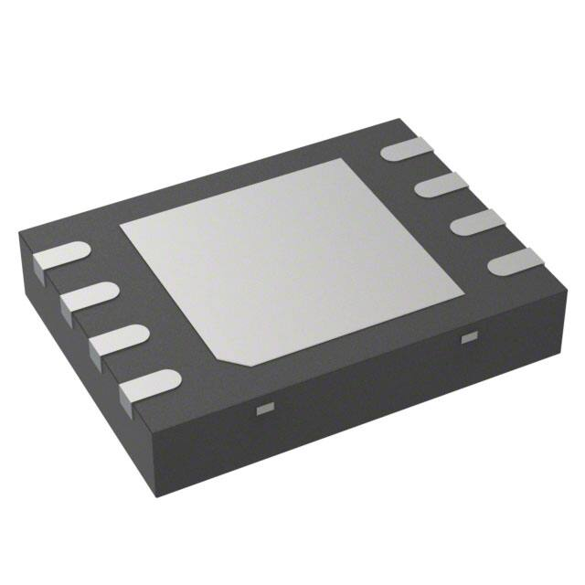

BQ771818DPJT
BQ771818DPJT
    BURR-BROWN(德州仪器)
    WSON-8_4X3MM-EP
    BQ7718 具有内部延迟计时器的 2-5 节电池过压保护器系列
BQ771818DPJT 数据手册
BQ7718 SLUSAX1L – DECEMBER 2012 – REVISED JUNE 2021 BQ7718 Overvoltage Protection for 2-Series to 5-Series Cell Li-Ion Batteries with Internal Delay Timer 1 Features 3 Description • • • • The BQ7718xy family of products provides an overvoltage monitor and protector for Li-Ion battery pack systems. Each cell is monitored independently for an overvoltage condition. For quicker productionline testing, the BQ7718xy device provides a Customer Test Mode (CTM) with greatly reduced delay time. • • • • 2-, 3-, 4-, and 5-series cell overvoltage protection Internal delay timer Fixed OVP threshold High-accuracy overvoltage protection: ± 10 mV Low power consumption ICC ≈ 1 µA (VCELL(ALL) < VPROTECT) Low leakage current per cell input < 100 nA Functional Safety-Capable – Documentation available to aid functional safety system design Package footprint options: – Small 8-pin QFN (3.00 mm × 4.00 mm) – Leaded 8-pin MSOP (3.00 mm × 5.00 mm, including leads) In the BQ7718xy device, an internal delay timer is initiated upon detection of an overvoltage condition on any cell. Upon expiration of the delay timer, the output is triggered into its active state (either high or low depending on the configuration). Device Information Table PART NUMBER 2 Applications Protection for li-ion battery packs used in: – Handheld garden tools – Handheld power tools – Cordless vacuum cleaners – UPS battery backup – Light electric vehicles (eBike, eScooter, pedal assist bicycles) BODY SIZE (NOM) DPJ (8) 3.00 mm × 4.00 mm BQ771800(2) DGK (8) 3.00 mm x 3.00 mm (3.00 mm x 5.00 mm, including leads) (1) (2) For available catalog packages, see the orderable addendum at the end of the data sheet and Section 5. Contact TI for more information. PACK+ RVD C VD VDD RIN V5 CIN RIN V4 CIN RIN V3 CIN RIN V2 Sensing Circuit • PACKAGE BQ771800(1) REG INT_EN VOV Delay Timer OUT CIN RIN V1 OSC CIN VSS PACK– Copyright © 2016, Texas Instruments Incorporated Simplified Schematic An IMPORTANT NOTICE at the end of this data sheet addresses availability, warranty, changes, use in safety-critical applications, intellectual property matters and other important disclaimers. UNLESS OTHERWISE NOTED, this document contains PRODUCTION DATA. BQ7718 www.ti.com SLUSAX1L – DECEMBER 2012 – REVISED JUNE 2021 Table of Contents 1 Features............................................................................1 2 Applications..................................................................... 1 3 Description.......................................................................1 4 Revision History.............................................................. 2 5 Device Comparison Table...............................................3 6 Pin Configuration and Functions...................................4 7 Specifications.................................................................. 5 7.1 Absolute Maximum Ratings........................................ 5 7.2 ESD Ratings............................................................... 5 7.3 Recommended Operating Conditions.........................5 7.4 Thermal Information....................................................5 7.5 DC Characteristics...................................................... 6 7.6 Timing Requirements.................................................. 7 7.7 Typical Characteristics................................................ 8 8 Detailed Description........................................................9 8.1 Overview..................................................................... 9 8.2 Functional Block Diagram........................................... 9 8.3 Feature Description.....................................................9 8.4 Device Functional Modes..........................................10 9 Application and Implementation.................................. 12 9.1 Application Information............................................. 12 9.2 Systems Examples................................................... 15 10 Power Supply Recommendations..............................15 11 Layout........................................................................... 16 11.1 Layout Guidelines................................................... 16 11.2 Layout Example...................................................... 16 12 Device and Documentation Support..........................17 12.1 Documentation Support.......................................... 17 12.2 Third-Party Products Disclaimer............................. 17 12.3 Receiving Notification of Documentation Updates..17 12.4 Support Resources................................................. 17 12.5 Trademarks............................................................. 17 12.6 Electrostatic Discharge Caution..............................17 12.7 Glossary..................................................................17 13 Mechanical, Packaging, and Orderable Information.................................................................... 17 4 Revision History NOTE: Page numbers for previous revisions may differ from page numbers in the current version. Changes from Revision K (April 2021) to Revision L (June 2021) Page • Changed the BQ771825 device to Production Data...........................................................................................3 Changes from Revision J (September 2020) to Revision K (June 2021) Page • Added the BQ771825 device to the Device Comparison Table .........................................................................3 Changes from Revision I (July 2020) to Revision J (September 2020) Page • Added the BQ771824 device to the Device Comparison Table .........................................................................3 • Added BQ771824 to the DC Characteristics ..................................................................................................... 6 • Added BQ771824 delay settings........................................................................................................................ 7 Changes from Revision H (February 2020) to Revision I (July 2020) Page • Added the Functional Safety-Capable feature....................................................................................................1 • Added the BQ771823 device to the Device Comparison Table .........................................................................3 • Added BQ771823 to the DC Characteristics ..................................................................................................... 6 • Added BQ771823 delay settings to Section 7.6 ................................................................................................ 7 2 Submit Document Feedback Copyright © 2021 Texas Instruments Incorporated Product Folder Links: BQ7718 BQ7718 www.ti.com SLUSAX1L – DECEMBER 2012 – REVISED JUNE 2021 5 Device Comparison Table TA Part Number Package Package Designator BQ771800 Output Delay Output Drive Tape and Reel (Large) Tape and Reel (Small) 4.300 0.300 4s CMOS Active High BQ771800DPJR BQ771800DPJT BQ771801DPJR BQ771801DPJT BQ771802DPJR BQ771802DPJT BQ771801 4.275 0.050 3s BQ771802 4.225 0.300 1s NCH Active Low, Open Drain BQ771803DPJR BQ771803DPJT BQ771803 4.275 0.050 1s NCH Active Low, Open Drain BQ771803DGKR(2) BQ771803DGKT(2) BQ771806 4.350 0.300 3s CMOS Active High BQ771806DPJR BQ771806DPJT BQ771807 4.450 0.300 3s CMOS Active High BQ771807DPJR BQ771807DPJT BQ771808DPJR BQ771808DPJT BQ771809 (1) (2) OV Hysteresis (V) NCH Active Low, Open Drain BQ771808 –40°C to 110°C OVP (V) BQ771811 8-Pin QFN or 8-Pin MSOP DPJ/DGK 4.200 0.050 1s NCH Active Low, Open Drain 4.200 0.050 1s CMOS Active High BQ771809DPJR BQ771809DPJT 4.225 0.050 1s CMOS Active High BQ771811DPJR BQ771811DPJT BQ771815DPJR BQ771815DPJT BQ771817DPJR BQ771817DPJT BQ771815 4.225 0.050 1s NCH Active Low, Open Drain BQ771817 4.275 0.050 1s CMOS Active High BQ771818DPJR BQ771818DPJT BQ771818DGKR BQ771818DGKT — BQ771818 4.300 0.300 1s CMOS Active High BQ771823 4.275 0.300 3s NCH Active Low, Open Drain BQ771823DPJR BQ771824 3.850 0.300 4s CMOS Active High BQ771824DPJR — NCH Active Low, Open Drain BQ771825DPJR BQ771825DPJT BQ771825DGKR(2) BQ771825DGKT(2) BQ7718xyDPJR BQ7718xyDPJT BQ771825 3.950 0.050 3s BQ7718xy(1) 3.850 – 4.650 Latch, 0.05, 0.25, 0.3 1, 4, 3, 5.5 s NCH, Active Low, Open Drain, CMOS Active High Future option. Contact TI for more information. Contact TI for more information. Submit Document Feedback Copyright © 2021 Texas Instruments Incorporated Product Folder Links: BQ7718 3 BQ7718 www.ti.com SLUSAX1L – DECEMBER 2012 – REVISED JUNE 2021 6 Pin Configuration and Functions VDD 1 8 OUT V5 2 7 VSS V4 3 6 V1 V3 4 5 V2 Figure 6-1. DPJ Package 8-Pin (WSON) Top View VDD 1 8 OUT V5 2 7 VSS V4 3 6 V1 V3 4 5 V2 Not to scale Figure 6-2. DGK Package 8-Pin (PDSO) Top View Table 6-1. Pin Functions NO. NAME TYPE I/O DESCRIPTION 1 VDD P Power supply 2 V5 I Sense input for positive voltage of the fifth cell from the bottom of the stack 3 V4 I Sense input for positive voltage of the fourth cell from the bottom of the stack 4 V3 I Sense input for positive voltage of the third cell from the bottom of the stack 5 V2 I Sense input for positive voltage of the second cell from the bottom of the stack 6 V1 I Sense input for positive voltage of the lowest cell in the stack 7 VSS P Electrically connected to IC ground and negative terminal of the lowest cell in the stack 8 OUT O Output drive for overvoltage fault signal O = Output, I = Input, P = Power connection 4 Submit Document Feedback Copyright © 2021 Texas Instruments Incorporated Product Folder Links: BQ7718 BQ7718 www.ti.com SLUSAX1L – DECEMBER 2012 – REVISED JUNE 2021 7 Specifications 7.1 Absolute Maximum Ratings Over-operating free-air temperature range (unless otherwise noted)(1) MIN MAX UNIT Supply voltage range VDD – VSS –0.3 30 V Input voltage range V5 – VSS or V4 – VSS or V3 – VSS or V2 – VSS or V1 – VSS –0.3 30 V Output voltage range OUT – VSS –0.3 30 V Continuous total power dissipation, PTOT See Section 7.4. Functional temperature –40 110 °C Storage temperature range, TSTG –65 150 °C (1) Stresses beyond those listed under “absolute maximum ratings” may cause permanent damage to the device. These are stress ratings only and functional operation of the device at these or any other conditions beyond those indicated under “recommended operating conditions” is not implied. Exposure to absolute-maximum–rated conditions for extended periods may affect device reliability. 7.2 ESD Ratings VALUE V(ESD) Rating (1) (2) Electrostatic discharge Human body model (HBM) ESD stress voltage(1) ±2000 Charged device model (CDM) ESD stress voltage(2) ±500 UNIT V JEDEC document JEP155 states that 500-V HBM allows safe manufacturing with a standard ESD control process. JEDEC document JEP157 states that 250-V CDM allows safe manufacturing with a standard ESD control process. 7.3 Recommended Operating Conditions Over-operating free-air temperature range (unless otherwise noted) MIN Supply voltage, VDD (1) Input voltage range V5–V4 or V4–V3 or V3–V2 or V2–V1 or V1–VSS Operating ambient temperature range, TA (1) MAX UNIT 3 25 V 0 5 V –40 110 °C See Section 9.2. 7.4 Thermal Information BQ7718xy THERMAL METRIC(1) DPJ (WSON) UNIT 8 PINS RθJA Junction-to-ambient thermal resistance 56.6 °C/W RθJCtop Junction-to-case(top) thermal resistance 56.4 °C/W RθJB Junction-to-board thermal resistance 30.6 °C/W ψJT Junction-to-top characterization parameter 1.0 °C/W ψJB Junction-to-board characterization parameter 37.8 °C/W RθJCbot Junction-to-case(bottom) thermal resistance 11.3 °C/W (1) For more information about traditional and new thermal metrics, see the Semiconductor and IC Package Thermal Metrics application report. Submit Document Feedback Copyright © 2021 Texas Instruments Incorporated Product Folder Links: BQ7718 5 BQ7718 www.ti.com SLUSAX1L – DECEMBER 2012 – REVISED JUNE 2021 7.5 DC Characteristics Typical values stated where TA = 25°C and VDD = 18 V, MIN/MAX values stated where TA = –40°C to 110°C and VDD = 3 V to 25 V (unless otherwise noted). SYMBOL PARAMETER CONDITION MIN TYP MAX UNIT Voltage Protection Threshold VCx V(PROTECT) Overvoltage Detection VOV VHYS OV Detection Hysteresis VOA OV Detection Accuracy VOADRIFT OV Detection Accuracy Across Temperature BQ771800 4.300 V BQ771801 4.275 V BQ771803 4.275 V BQ771802 4.225 V BQ771806 4.350 V BQ771807 4.450 V BQ771808 4.200 V BQ771809 4.200 V BQ771811 4.225 V BQ771815 4.225 V BQ771817 4.275 V BQ771818 4.300 V BQ771823 4.275 V BQ771824 3.850 V BQ771800 250 300 400 mV BQ771801 0 50 100 mV BQ771802 250 300 400 mV BQ771803 0 50 100 mV BQ771806 250 300 400 mV BQ771807 250 300 400 mV BQ771808 0 50 100 mV BQ771809 0 50 100 mV BQ771811 0 50 100 mV BQ771815 0 50 100 mV BQ771817 0 50 100 mV BQ771818 250 300 400 mV BQ771823 250 300 400 mV BQ771824 250 300 400 mV TA = 25°C –10 10 mV TA = –40°C –40 44 mV TA = 0°C –20 20 mV TA = 60°C –24 24 mV TA = 110°C –54 54 mV 2 µA 0.1 µA Supply and Leakage Current 6 ICC Supply Current (V5–V4) = (V4–V3) = (V3–V2) = (V2–V1) = (V1–VSS) = 4 V (See Figure 8-2.) IIN Input Current at Vx Pins (V5–V4) = (V4–V3) = (V3–V2) = (V2–V1) = (V1–VSS) = 4 V (See Figure 8-2.) Submit Document Feedback 1 –0.1 Copyright © 2021 Texas Instruments Incorporated Product Folder Links: BQ7718 BQ7718 www.ti.com SLUSAX1L – DECEMBER 2012 – REVISED JUNE 2021 Typical values stated where TA = 25°C and VDD = 18 V, MIN/MAX values stated where TA = –40°C to 110°C and VDD = 3 V to 25 V (unless otherwise noted). SYMBOL PARAMETER CONDITION MIN TYP MAX UNIT Output Drive OUT, CMOS Active HIGH Versions Only (V5–V4), (V4–V3), (V3–V2), (V2–V1), or (V1–VSS) > VOV, VDD = 18 V, IOH = 100 µA VOUT1 Output Drive Voltage, Active High 6 V If three of four cells are short circuited and only one cell remains powered and > VOV, VDD = Vx (cell voltage), IOH = 100 µA VDD – 0.3 (V5–V4), (V4–V3), (V3–V2), (V2–V1), and (V1–VSS) < VOV, VDD = 18 V, IOL = 100 µA measured into pin 250 IOUTH1 OUT Source Current (during OV) (V5–V4), (V4–V3), (V3–V2), (V2–V1), or (V1–VSS) > VOV, VDD = 18 V. OUT = 0 V. Measured out of OUT pin IOUTL1 OUT Sink Current (no OV) (V5–V4), (V4–V3), (V3–V2), (V2–V1), and (V1–VSS) < VOV, VDD = 18 V, OUT = VDD. Measured into OUT pin 0.5 V 400 mV 4.5 mA 14 mA 400 mV 14 mA 100 nA Output Drive OUT, NCH Open Drain Active LOW Versions Only VOUT2 Output Drive Voltage, Active Low (V5–V4), (V4–V3), (V3–V2), (V2–V1), or (V1–VSS) > VOV, VDD = 18 V, IOL = 100 µA measured into OUT pin IOUTH2 OUT Sink Current (during OV) (V5–V4), (V4–V3), (V3–V2), (V2–V1), or (V1–VSS) > VOV, VDD = 18 V. OUT = VDD. Measured into OUT pin IOUTL2 OUT Source Current (no OV) (V5–V4), (V4–V3), (V3–V2), (V2–V1), and (V1–VSS) < VOV, VDD = 18 V. OUT = VDD. Measured out of OUT pin 250 0.5 7.6 Timing Requirements MIN NOM MAX UNIT BQ771800, BQ771824 3.2 4 4.8 s BQ771801, BQ771807, BQ771823 2.4 3 3.6 s BQ771802, BQ771803, BQ771811, BQ771815, BQ771818 0.8 1 1.2 s Preview option only. Contact TI. 4.4 5.5 6.6 s Delay Timer tDELAY XCTMDELAY OV Delay Time Fault Detection Delay Time during Customer Test Mode See Section 8.4.3. 15 ms Submit Document Feedback Copyright © 2021 Texas Instruments Incorporated Product Folder Links: BQ7718 7 BQ7718 www.ti.com SLUSAX1L – DECEMBER 2012 – REVISED JUNE 2021 7.7 Typical Characteristics 4.40 4.39 4.38 0.316 Mean Min Max 0.315 4.36 VHYS (V) VOUT (V) 4.37 4.35 4.34 4.33 0.314 0.313 4.32 4.31 4.30 −50 −25 0 25 50 Temperature (°C) 75 100 125 0.312 −50 −25 0 G001 Figure 7-1. Overvoltage Threshold (OVT) vs. Temperature 25 50 Temperature (°C) 75 100 125 G002 Figure 7-2. Hysteresis VHYS vs. Temperature 1.8 1.6 1.5 1.6 1.4 1.4 1.2 ICELL (µA) IDD (µA) 1.3 1.1 1.0 1.2 1.0 0.9 0.8 0.8 0.7 0.6 −50 −25 0 25 50 Temperature (°C) 75 100 125 0.6 −50 Figure 7-3. IDD Current Consumption vs. Temperature at VDD = 16 V 8 −3.70 7 −3.72 −3.76 VOUT (V) IOUT (mA) 25 50 Temperature (°C) 75 100 125 G004 6 −3.74 −3.78 −3.80 −3.82 5 4 3 2 −3.84 1 −3.86 −25 0 25 50 Temperature (°C) 75 100 125 0 0 G005 Figure 7-5. Output Current IOUT vs. Temperature 8 0 Figure 7-4. ICELL vs. Temperature at VCELL= 9.2 V −3.68 −3.88 −50 −25 G003 Submit Document Feedback 5 10 15 VDD (V) 20 25 30 G006 Figure 7-6. VOUT vs. VDD Copyright © 2021 Texas Instruments Incorporated Product Folder Links: BQ7718 BQ7718 www.ti.com SLUSAX1L – DECEMBER 2012 – REVISED JUNE 2021 8 Detailed Description 8.1 Overview In the BQ7718xy family of devices, each cell is monitored independently and an external delay timer is initiated if an overvoltage condition is detected on any cell. For quicker production-line testing, the device provides a Customer Test Mode with greatly reduced delay time. 8.2 Functional Block Diagram PACK+ RVD C VD VDD RIN V5 CIN RIN CIN RIN V3 CIN RIN V2 Sensing Circuit V4 REG INT_EN VOV Delay Timer OUT CIN RIN V1 OSC CIN VSS PACK– Copyright © 2016, Texas Instruments Incorporated 8.3 Feature Description In the BQ7718xy device, each cell is monitored independently. Overvoltage is detected by comparing the actual cell voltage to a protection voltage reference, VOV. If any cell voltage exceeds the programmed OV value, a timer circuit is activated. When the timer expires, the OUT pin goes from inactive to active state. For NCH Open Drain Active Low configurations, the OUT pin pulls down to VSS when active (OV present) and is high impedance when inactive (no OV). Submit Document Feedback Copyright © 2021 Texas Instruments Incorporated Product Folder Links: BQ7718 9 BQ7718 www.ti.com Cell Voltage (V) (V5–V4, V4–V3, V 3–V2, V2–V1, V1–VSS) SLUSAX1L – DECEMBER 2012 – REVISED JUNE 2021 VOV VOV –VHYS tDELAY OUT (V) Figure 8-1. Timing for Overvoltage Sensing 8.3.1 Sense Positive Input for Vx This is an input to sense each single battery cell voltage. A series resistor and a capacitor across the cell for each input is required for noise filtering and stable voltage monitoring. 8.3.2 Output Drive, OUT This pin serves as the fault signal output, and may be ordered in either active HIGH or LOW options. 8.3.3 Supply Input, VDD This pin is the unregulated input power source for the IC. A series resistor is connected to limit the current, and a capacitor is connected to ground for noise filtering. 8.4 Device Functional Modes 8.4.1 NORMAL Mode When all of the cell voltages are below the overvoltage threshold, VOV, the device operates in NORMAL mode. The device monitors the differential cell voltages connected across (V1 – VSS), (V2 – V1), (V3 – V2), (V4 – V3), and (VC4 – VC5). The OUT pin is inactive and if configured: The OUT pin is inactive and if configured: • Active high is low. • Active low is being externally pulled up and is an open drain. 8.4.2 OVERVOLTAGE Mode OVERVOLTAGE mode is detected if any of the cell voltages exceeds the overvoltage threshold, VOV for configured OV delay time. The OUT pin is activated after a delay time set by the capacitance in the CD pin. The OUT pin will either pull high internally, if configured as active high, or will be pulled low internally, if configured as active low. When all of the cell voltages fall below the (VOV – VHYS), the device returns to NORMAL mode. 8.4.3 Customer Test Mode Customer Test Mode (CTM) helps to reduce test time for checking the overvoltage delay timer parameter once the circuit is implemented in the battery pack. To enter CTM, VDD should be set to at least 10 V higher than V5 (see Figure 8-2). The delay timer is greater than 10 ms, but considerably shorter than the timer delay in normal operation. To exit Customer Test Mode, remove the VDD to a V5 voltage differential of 10 V so that the decrease in this value automatically causes an exit. 10 Submit Document Feedback Copyright © 2021 Texas Instruments Incorporated Product Folder Links: BQ7718 BQ7718 www.ti.com SLUSAX1L – DECEMBER 2012 – REVISED JUNE 2021 CAUTION Avoid exceeding any Absolute Maximum Voltages on any pins when placing the part into Customer Test Mode. Also avoid exceeding Absolute Maximum Voltages for the individual cell voltages (V5– V4), (V4–V3), (V4–V3), (V3–V2), (V2–V1), and (V1–VSS). Stressing the pins beyond the rated limits may cause permanent damage to the device. Figure 8-2 shows the timing for the Customer Test Mode. Cell Voltage (V) (V5–V4, V4–V3, V3–V2, V2–V1, V1–VSS) 10 V VOV VOV – VHYS > 10 ms OUT (V) Figure 8-2. Timing for Customer Test Mode Submit Document Feedback Copyright © 2021 Texas Instruments Incorporated Product Folder Links: BQ7718 11 BQ7718 www.ti.com SLUSAX1L – DECEMBER 2012 – REVISED JUNE 2021 9 Application and Implementation Note Information in the following applications sections is not part of the TI component specification, and TI does not warrant its accuracy or completeness. TI’s customers are responsible for determining suitability of components for their purposes. Customers should validate and test their design implementation to confirm system functionality. 9.1 Application Information In the case of an Open Drain Active Low configuration, an external pull-up resistor is required on the OUT pin. Changes to the ranges stated in Table 9-1 will impact the accuracy of the cell measurements. C VD VDD OUT V5 VSS V4 V1 V3 V2 RVD Cell5 R IN Cell4 R IN Cell3 R IN CIN CIN CIN Cell2 R IN CIN Cell1 R IN CIN Copyright © 2016, Texas Instruments Incorporated Figure 9-1. Application Configuration 9.1.1 Design Requirements Changes to the ranges stated in Table 9-1 will impact the accuracy of the cell measurements. Figure 9-1 shows each external component. Table 9-1. Parameters PARAMETER EXTERNAL COMPONENT MIN NOM MAX UNIT RIN 900 1000 1100 Ω Voltage monitor filter capacitance CIN 0.01 0.1 µF Supply voltage filter resistance RVD 100 1K Ω Supply voltage filter capacitance CVD Voltage monitor filter resistance 0.1 CD external delay capacitance 0.1 OUT Open drain version pull-up resistance to PACK+ 100 12 Submit Document Feedback µF 1 µF kΩ Copyright © 2021 Texas Instruments Incorporated Product Folder Links: BQ7718 BQ7718 www.ti.com SLUSAX1L – DECEMBER 2012 – REVISED JUNE 2021 Note The device is calibrated using an RIN value = 1 kΩ. Using a value other than this recommended value changes the accuracy of the cell voltage measurements and VOV trigger level. 9.1.2 Detailed Design Procedure Figure 9-2 shows the measurement for current consumption for the product for both VDD and Vx. VDD OUT V5 VSS I IN V4 V1 I IN V3 V2 ICC I IN Cell5 Cell 4 Cell 3 I IN Cell 2 IIN Cell 1 Copyright © 2016, Texas Instruments Incorporated Figure 9-2. Configuration for IC Current Consumption Test Submit Document Feedback Copyright © 2021 Texas Instruments Incorporated Product Folder Links: BQ7718 13 BQ7718 www.ti.com SLUSAX1L – DECEMBER 2012 – REVISED JUNE 2021 9.1.2.1 Application Curves 4.40 4.39 4.38 0.316 Mean Min Max 0.315 4.36 VHYS (V) VOUT (V) 4.37 4.35 4.34 4.33 0.314 0.313 4.32 4.31 4.30 −50 −25 0 25 50 Temperature (°C) 75 100 125 0.312 −50 −25 0 G001 Figure 9-3. Overvoltage Threshold (OVT) vs. Temperature 25 50 Temperature (°C) 75 100 125 G002 Figure 9-4. Hysteresis VHYS vs. Temperature 1.6 1.8 1.5 1.6 1.4 1.4 1.2 ICELL (µA) IDD (µA) 1.3 1.1 1.0 1.2 1.0 0.9 0.8 0.8 0.7 0.6 −50 −25 0 25 50 Temperature (°C) 75 100 125 0.6 −50 Figure 9-5. IDD Current Consumption vs. Temperature at VDD = 16 V 8 −3.70 7 −3.72 −3.76 VOUT (V) IOUT (mA) 25 50 Temperature (°C) 75 100 125 G004 6 −3.74 −3.78 −3.80 −3.82 5 4 3 2 −3.84 1 −3.86 −25 0 25 50 Temperature (°C) 75 100 125 0 0 G005 Figure 9-7. Output Current IOUT vs. Temperature 14 0 Figure 9-6. ICELL vs. Temperature at VCELL= 9.2 V −3.68 −3.88 −50 −25 G003 Submit Document Feedback 5 10 15 VDD (V) 20 25 30 G006 Figure 9-8. VOUT vs. VDD Copyright © 2021 Texas Instruments Incorporated Product Folder Links: BQ7718 BQ7718 www.ti.com SLUSAX1L – DECEMBER 2012 – REVISED JUNE 2021 9.2 Systems Examples In these application examples, an external pull-up resistor is required on the OUT pin to configure for an Open Drain Active Low operation. C VD R VD Cell 4 Cell 3 Cell 2 Cell 1 RIN RIN C VD VDD OUT VSS V5 VSS V4 V1 V4 V1 V3 V2 V3 V2 VDD OUT V5 RVD CIN RIN CIN Cell3 RIN CIN Cell2 RIN CIN Cell1 CIN RIN RIN CIN CIN Copyright © 2016, Texas Instruments Incorporated Copyright © 2016, Texas Instruments Incorporated Figure 9-10. 3-Series Cell Configuration with Fixed Delay Figure 9-9. 4-Series Cell Configuration C VD RVD Cell2 Cell1 RIN CIN RIN CIN VDD OUT V5 VSS V4 V1 V5 V2 Copyright © 2016, Texas Instruments Incorporated Figure 9-11. 2-Series Cell Configuration with Internal Fixed Delay 10 Power Supply Recommendations The maximum power of this device is 25 V on VDD. Submit Document Feedback Copyright © 2021 Texas Instruments Incorporated Product Folder Links: BQ7718 15 BQ7718 www.ti.com SLUSAX1L – DECEMBER 2012 – REVISED JUNE 2021 11 Layout 11.1 Layout Guidelines • • Ensure the RC filters for the V1 and VDD pins are placed as close as possible to the target terminal. The VSS pin should be routed to the CELL– terminal. 11.2 Layout Example Place the RC filters close to the device terminals Power Trace Line Pack + VDD OUT VC5 VSS VCELL5 OUT Pack VC4 VC1 PWPD VCELL4 VC3 VC2 VCELL3 VCELL2 VCELL1 Figure 11-1. Example Layout 16 Submit Document Feedback Copyright © 2021 Texas Instruments Incorporated Product Folder Links: BQ7718 BQ7718 www.ti.com SLUSAX1L – DECEMBER 2012 – REVISED JUNE 2021 12 Device and Documentation Support 12.1 Documentation Support For additional information, see the BQ7718 technical documentation, including the documentation available to aid functional safety system design. 12.2 Third-Party Products Disclaimer TI'S PUBLICATION OF INFORMATION REGARDING THIRD-PARTY PRODUCTS OR SERVICES DOES NOT CONSTITUTE AN ENDORSEMENT REGARDING THE SUITABILITY OF SUCH PRODUCTS OR SERVICES OR A WARRANTY, REPRESENTATION OR ENDORSEMENT OF SUCH PRODUCTS OR SERVICES, EITHER ALONE OR IN COMBINATION WITH ANY TI PRODUCT OR SERVICE. 12.3 Receiving Notification of Documentation Updates To receive notification of documentation updates, navigate to the device product folder on ti.com. Click on Subscribe to updates to register and receive a weekly digest of any product information that has changed. For change details, review the revision history included in any revised document. 12.4 Support Resources TI E2E™ support forums are an engineer's go-to source for fast, verified answers and design help — straight from the experts. Search existing answers or ask your own question to get the quick design help you need. Linked content is provided "AS IS" by the respective contributors. They do not constitute TI specifications and do not necessarily reflect TI's views; see TI's Terms of Use. 12.5 Trademarks TI E2E™ is a trademark of Texas Instruments. All trademarks are the property of their respective owners. 12.6 Electrostatic Discharge Caution This integrated circuit can be damaged by ESD. Texas Instruments recommends that all integrated circuits be handled with appropriate precautions. Failure to observe proper handling and installation procedures can cause damage. ESD damage can range from subtle performance degradation to complete device failure. Precision integrated circuits may be more susceptible to damage because very small parametric changes could cause the device not to meet its published specifications. 12.7 Glossary TI Glossary This glossary lists and explains terms, acronyms, and definitions. 13 Mechanical, Packaging, and Orderable Information The following pages include mechanical, packaging, and orderable information. This information is the most current data available for the designated devices. This data is subject to change without notice and revision of this document. For browser-based versions of this data sheet, refer to the left-hand navigation. Submit Document Feedback Copyright © 2021 Texas Instruments Incorporated Product Folder Links: BQ7718 17 PACKAGE OPTION ADDENDUM www.ti.com 23-Aug-2021 PACKAGING INFORMATION Orderable Device Status (1) Package Type Package Pins Package Drawing Qty Eco Plan (2) Lead finish/ Ball material MSL Peak Temp Op Temp (°C) Device Marking (3) (4/5) (6) BQ771800DPJR ACTIVE WSON DPJ 8 3000 RoHS & Green NIPDAU Level-2-260C-1 YEAR -40 to 85 771800 BQ771800DPJT ACTIVE WSON DPJ 8 250 RoHS & Green NIPDAU Level-2-260C-1 YEAR -40 to 85 771800 BQ771801DPJR ACTIVE WSON DPJ 8 3000 RoHS & Green NIPDAU Level-2-260C-1 YEAR -40 to 85 771801 BQ771801DPJT ACTIVE WSON DPJ 8 250 RoHS & Green NIPDAU Level-2-260C-1 YEAR -40 to 85 771801 BQ771802DPJR ACTIVE WSON DPJ 8 3000 RoHS & Green NIPDAU Level-2-260C-1 YEAR -40 to 85 771802 BQ771802DPJT ACTIVE WSON DPJ 8 250 RoHS & Green NIPDAU Level-2-260C-1 YEAR -40 to 85 771802 BQ771803DPJR ACTIVE WSON DPJ 8 3000 RoHS & Green NIPDAU Level-2-260C-1 YEAR -40 to 85 771803 BQ771803DPJT ACTIVE WSON DPJ 8 250 RoHS & Green NIPDAU Level-2-260C-1 YEAR -40 to 85 771803 BQ771806DPJR ACTIVE WSON DPJ 8 3000 RoHS & Green NIPDAU Level-2-260C-1 YEAR -40 to 85 771806 BQ771806DPJT ACTIVE WSON DPJ 8 250 RoHS & Green NIPDAU Level-2-260C-1 YEAR -40 to 85 771806 BQ771807DPJR ACTIVE WSON DPJ 8 3000 RoHS & Green NIPDAU Level-2-260C-1 YEAR -40 to 85 771807 BQ771807DPJT ACTIVE WSON DPJ 8 250 RoHS & Green NIPDAU Level-2-260C-1 YEAR -40 to 85 771807 BQ771808DPJR ACTIVE WSON DPJ 8 3000 RoHS & Green NIPDAU Level-2-260C-1 YEAR -40 to 85 771808 BQ771808DPJT ACTIVE WSON DPJ 8 250 RoHS & Green NIPDAU Level-2-260C-1 YEAR -40 to 85 771808 BQ771809DPJR ACTIVE WSON DPJ 8 3000 RoHS & Green NIPDAU Level-2-260C-1 YEAR -40 to 85 771809 BQ771809DPJT ACTIVE WSON DPJ 8 250 RoHS & Green NIPDAU Level-2-260C-1 YEAR -40 to 85 771809 BQ771811DPJR ACTIVE WSON DPJ 8 3000 RoHS & Green NIPDAU Level-2-260C-1 YEAR -40 to 85 771811 BQ771811DPJT ACTIVE WSON DPJ 8 250 RoHS & Green NIPDAU Level-2-260C-1 YEAR -40 to 85 771811 BQ771815DPJR ACTIVE WSON DPJ 8 3000 RoHS & Green NIPDAU Level-2-260C-1 YEAR -40 to 85 771815 BQ771815DPJT ACTIVE WSON DPJ 8 250 RoHS & Green NIPDAU Level-2-260C-1 YEAR -40 to 85 771815 Addendum-Page 1 Samples PACKAGE OPTION ADDENDUM www.ti.com Orderable Device 23-Aug-2021 Status (1) Package Type Package Pins Package Drawing Qty Eco Plan (2) Lead finish/ Ball material MSL Peak Temp Op Temp (°C) Device Marking (3) (4/5) (6) BQ771817DPJR ACTIVE WSON DPJ 8 3000 RoHS & Green NIPDAU Level-2-260C-1 YEAR -40 to 85 771817 BQ771817DPJT ACTIVE WSON DPJ 8 250 RoHS & Green NIPDAU Level-2-260C-1 YEAR -40 to 85 771817 BQ771818DPJR ACTIVE WSON DPJ 8 3000 RoHS & Green NIPDAU Level-2-260C-1 YEAR -40 to 85 771818 BQ771818DPJT ACTIVE WSON DPJ 8 250 RoHS & Green NIPDAU Level-2-260C-1 YEAR -40 to 85 771818 BQ771823DPJR ACTIVE WSON DPJ 8 3000 RoHS & Green NIPDAU Level-2-260C-1 YEAR -40 to 110 771823 BQ771824DPJR ACTIVE WSON DPJ 8 3000 RoHS & Green NIPDAU Level-1-260C-UNLIM -40 to 110 771824 BQ771825DPJR ACTIVE WSON DPJ 8 3000 RoHS & Green NIPDAU Level-2-260C-1 YEAR -40 to 85 771825 (1) The marketing status values are defined as follows: ACTIVE: Product device recommended for new designs. LIFEBUY: TI has announced that the device will be discontinued, and a lifetime-buy period is in effect. NRND: Not recommended for new designs. Device is in production to support existing customers, but TI does not recommend using this part in a new design. PREVIEW: Device has been announced but is not in production. Samples may or may not be available. OBSOLETE: TI has discontinued the production of the device. (2) RoHS: TI defines "RoHS" to mean semiconductor products that are compliant with the current EU RoHS requirements for all 10 RoHS substances, including the requirement that RoHS substance do not exceed 0.1% by weight in homogeneous materials. Where designed to be soldered at high temperatures, "RoHS" products are suitable for use in specified lead-free processes. TI may reference these types of products as "Pb-Free". RoHS Exempt: TI defines "RoHS Exempt" to mean products that contain lead but are compliant with EU RoHS pursuant to a specific EU RoHS exemption. Green: TI defines "Green" to mean the content of Chlorine (Cl) and Bromine (Br) based flame retardants meet JS709B low halogen requirements of
