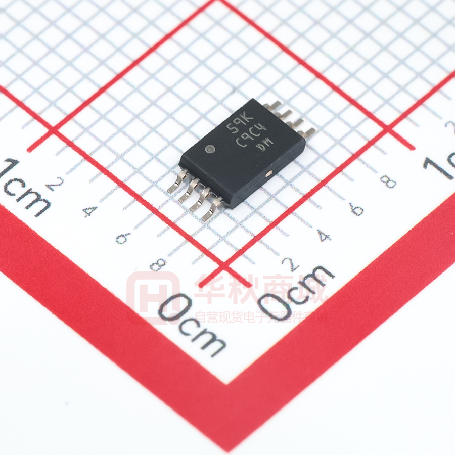

CDCLVC1104PWR
CDCLVC1104PWR
    BURR-BROWN(德州仪器)
    TSSOP8
    CDCLVC1104 低抖动 1:4 LVCMOS 扇出时钟缓冲器
CDCLVC1104PWR 数据手册
Order Now Product Folder Technical Documents Support & Community Tools & Software CDCLVC1102, CDCLVC1103, CDCLVC1104 CDCLVC1106, CDCLVC1108, CDCLVC1110, CDCLVC1112 SCAS895B – MAY 2010 – REVISED FEBRUARY 2017 CDCLVC11xx 3.3-V and 2.5-V LVCMOS High-Performance Clock Buffer Family 1 Features 3 Description • The CDCLVC11xx is a modular, high-performance, low-skew, general-purpose clock buffer family from Texas Instruments. 1 • • • • • • High-Performance 1:2, 1:3, 1:4, 1:6, 1:8, 1:10, 1:12 LVCMOS Clock Buffer Family Very Low Pin-to-Pin Skew < 50 ps Very Low Additive Jitter < 100 fs Supply Voltage: 3.3 V or 2.5 V fmax = 250 MHz for 3.3 V fmax = 180 MHz for 2.5 V Operating Temperature Range: –40°C to 85°C Available in 8-, 14-, 16-, 20-, 24-Pin TSSOP Package (All Pin-Compatible) 2 Applications General-Purpose Communication, Industrial, and Consumer Applications The entire family is designed with a modular approach in mind. It is intended to round up TI's series of LVCMOS clock generators. Seven different fan-out variations, 1:2 to 1:12, are available. All of the devices are pin-compatible to each other for easy handling. All family members share the same high performing characteristics such as low additive jitter, low skew, and wide operating temperature range. The CDCLVC11xx supports an asynchronous output enable control (1G) which switches the outputs into a low state when 1G is low. The CDCLVC11xx family operates in a 2.5-V and 3.3-V environment and are characterized for operation from –40°C to 85°C. Device Information(1) PART NUMBER PACKAGE BODY SIZE (NOM) CDCLVC1102 CDCLVC1103 TSSOP (8) 3.00 mm × 4.40 mm CDCLVC1104 CDCLVC1106 TSSOP (14) CDCLVC1108 TSSOP (16) CDCLVC1110 TSSOP (20) 6.50 mm × 4.40 mm CDCLVC1112 TSSOP (24) 7.80 mm × 4.40 mm 5.00 mm × 4.40 mm (1) For all available packages, see the orderable addendum at the end of the data sheet. Functional Block Diagram CLKIN LV CMOS LV CMOS Y0 LV CMOS Y1 LV CMOS Y2 LV CMOS Y3 • • • LV CMOS CLKIN 1 1G 2 Y0 3 GND 4 VDD 5 Y4 6 GND 7 Y6 8 VDD 9 Y9 10 GND 11 Y11 12 CDCLVC CDCLVC CDCLVC 1102 1103 1104 CDCLVC 1106 CDCLVC 1108 CDCLVC 1110 CDCLVC 1112 24 23 22 21 20 19 18 17 16 15 14 13 Y1 Y3 VDD Y2 GND Y5 VDD Y7 Y8 GND Y 10 VDD Yn 1G 1 An IMPORTANT NOTICE at the end of this data sheet addresses availability, warranty, changes, use in safety-critical applications, intellectual property matters and other important disclaimers. PRODUCTION DATA. CDCLVC1102, CDCLVC1103, CDCLVC1104 CDCLVC1106, CDCLVC1108, CDCLVC1110, CDCLVC1112 SCAS895B – MAY 2010 – REVISED FEBRUARY 2017 www.ti.com Table of Contents 1 2 3 4 5 6 7 8 Features .................................................................. Applications ........................................................... Description ............................................................. Revision History..................................................... Pin Configuration and Functions ......................... Specifications......................................................... 1 1 1 2 3 5 6.1 6.2 6.3 6.4 6.5 6.6 6.7 5 5 5 6 6 7 7 Absolute Maximum Ratings ...................................... ESD Ratings.............................................................. Recommended Operating Conditions....................... Thermal Information .................................................. Electrical Characteristics........................................... Switching Characteristics .......................................... Typical Characteristics .............................................. Parameter Measurement Information .................. 8 Detailed Description ............................................ 10 8.1 Overview ................................................................. 10 8.2 Functional Block Diagram ....................................... 10 8.3 Feature Description................................................. 10 8.4 Device Functional Modes........................................ 10 9 Application and Implementation ........................ 11 9.1 Application Information............................................ 11 9.2 Typical Application ................................................. 11 10 Power Supply Recommendations ..................... 12 10.1 Power Considerations ........................................... 13 11 Layout................................................................... 14 11.1 Layout Guidelines ................................................. 14 11.2 Layout Example .................................................... 14 12 Device and Documentation Support ................. 15 12.1 12.2 12.3 12.4 12.5 12.6 Related Links ........................................................ Receiving Notification of Documentation Updates Community Resources.......................................... Trademarks ........................................................... Electrostatic Discharge Caution ............................ Glossary ................................................................ 15 15 15 15 15 15 13 Mechanical, Packaging, and Orderable Information ........................................................... 15 4 Revision History Changes from Revision A (October 2014) to Revision B Page • Changed Packaging name from TTSOP to TSSOP in Device Information Table ................................................................. 1 • Changed CDCLVC1110 Y8 pin number from: 10 to: 12 ........................................................................................................ 3 • Changed CDCLVC1110 Y9 pin number from: — to: 10......................................................................................................... 3 • Moved Tstg from ESD Ratings to Absolute Maximum Ratings .............................................................................................. 5 • Added Receiving Notification of Documentation Updates and Community Resources sections ......................................... 15 Changes from Original (May 2010) to Revision A • 2 Page Added ESD Ratings table, Feature Description section, Device Functional Modes, Application and Implementation section, Power Supply Recommendations section, Layout section, Device and Documentation Support section, and Mechanical, Packaging, and Orderable Information section .................................................................................................. 1 Submit Documentation Feedback Copyright © 2010–2017, Texas Instruments Incorporated Product Folder Links: CDCLVC1102 CDCLVC1103 CDCLVC1104 CDCLVC1106 CDCLVC1108 CDCLVC1110 CDCLVC1112 CDCLVC1102, CDCLVC1103, CDCLVC1104 CDCLVC1106, CDCLVC1108, CDCLVC1110, CDCLVC1112 www.ti.com SCAS895B – MAY 2010 – REVISED FEBRUARY 2017 5 Pin Configuration and Functions PW Package 8-, 14-, 16-, 20, 24-Pin TSSOP Top View CLKIN 1G Y0 GND 1 2 3 4 CLKIN 1G Y0 GND 1 2 3 4 CDCLVC1103 CLKIN 1G Y0 GND 1 2 3 4 CDCLVC1104 CDCLVC1102 8 7 6 5 Y1 NC VDD NC 8 7 6 5 Y1 NC VDD Y2 8 7 6 5 Y1 Y3 VDD Y2 CLKIN 1G Y0 GND VDD Y4 GND 1 2 3 4 5 6 7 CLKIN 1G Y0 GND VDD Y4 GND Y6 1 2 3 4 5 6 7 8 CDCLVC1106 CDCLVC1108 14 13 12 11 10 9 8 Y1 Y3 VDD Y2 GND Y5 VDD 16 15 14 13 12 11 10 9 Y1 Y3 VDD Y2 GND Y5 VDD Y7 CLKIN 1 1G 2 Y0 3 GND 4 VDD 5 Y4 6 GND 7 Y6 8 VDD 9 Y 9 10 CDCLVC 1110 20 19 18 17 16 15 14 13 12 11 Y1 Y3 VDD Y2 GND Y5 VDD Y7 Y8 GND CLKIN 1 1G 2 Y0 3 GND 4 VDD 5 Y4 6 GND 7 Y6 8 VDD 9 Y 9 10 GND 11 Y 11 12 CDCLVC 1112 24 23 22 21 20 19 18 17 16 15 14 13 Y1 Y3 VDD Y2 GND Y5 VDD Y7 Y8 GND Y 10 VDD Pin Functions PIN NAME CDCLVC 1102 CDCLVC 1103 CDCLVC 1104 CDCLVC 1106 CDCLVC 1108 CDCLVC 1110 CDCLVC 1112 TYPE DESCRIPTION 1 1 1 1 1 Input Input Pin 2 2 2 2 2 Input Output Enable LVCMOS CLOCK INPUT CLKIN 1 1 CLOCK OUTPUT ENABLE 1G 2 2 LVCMOS CLOCK OUTPUT Y0 3 3 3 3 3 3 3 Y1 8 8 8 14 16 20 24 Y2 — 5 5 11 13 17 21 Y3 — — 7 13 15 19 23 Y4 — — — 6 6 6 6 Y5 — — — 9 11 15 19 Y6 — — — — 8 8 8 Y7 — — — — 9 13 17 Y8 — — — — — 12 16 Y9 — — — — — 10 10 Y10 — — — — — — 14 Y11 — — — — — — 12 5 5 9 13 8 10 14 18 12 14 18 22 Output LVCMOS output. Unused outputs can be left floating. Power 2.5-V or device supply SUPPLY VOLTAGE VDD 6 6 6 5 5 9 GROUND Copyright © 2010–2017, Texas Instruments Incorporated Submit Documentation Feedback Product Folder Links: CDCLVC1102 CDCLVC1103 CDCLVC1104 CDCLVC1106 CDCLVC1108 CDCLVC1110 CDCLVC1112 3 CDCLVC1102, CDCLVC1103, CDCLVC1104 CDCLVC1106, CDCLVC1108, CDCLVC1110, CDCLVC1112 SCAS895B – MAY 2010 – REVISED FEBRUARY 2017 www.ti.com Pin Functions (continued) PIN NAME GND 4 CDCLVC 1102 4 CDCLVC 1103 4 CDCLVC 1104 CDCLVC 1106 CDCLVC 1108 4 4 7 11 7 7 11 15 10 12 16 20 4 Submit Documentation Feedback CDCLVC 1110 4 CDCLVC 1112 TYPE DESCRIPTION GND Device ground 4 7 Copyright © 2010–2017, Texas Instruments Incorporated Product Folder Links: CDCLVC1102 CDCLVC1103 CDCLVC1104 CDCLVC1106 CDCLVC1108 CDCLVC1110 CDCLVC1112 CDCLVC1102, CDCLVC1103, CDCLVC1104 CDCLVC1106, CDCLVC1108, CDCLVC1110, CDCLVC1112 www.ti.com SCAS895B – MAY 2010 – REVISED FEBRUARY 2017 6 Specifications 6.1 Absolute Maximum Ratings over operating free-air temperature range (unless otherwise noted) VDD (1) MIN MAX UNIT Supply voltage –0.5 4.6 V (2) V VIN Input voltage –0.5 VDD + 0.5 VO Output voltage (2) –0.5 VDD + 0.5 V IIN Input current –20 20 mA IO Continuous output current –50 TJ Maximum junction temperature Tstg Storage temperature (1) (2) –65 50 mA 125 °C 150 °C Stresses beyond those listed under Absolute Maximum Ratings may cause permanent damage to the device. These are stress ratings only and functional operation of the device at these or any other conditions beyond those indicated under Recommended Operating Conditions is not implied. Exposure to absolute-maximum-rated conditions for extended periods may affect device reliability. This value is limited to 4.6 V maximum. 6.2 ESD Ratings VALUE V(ESD) (1) (2) Electrostatic discharge Human-body model (HBM), per ANSI/ESDA/JEDEC JS-001 (1) UNIT ±4000 Charged-device model (CDM), per JEDEC specification JESD22-C101 (2) V ±1500 JEDEC document JEP155 states that 500-V HBM allows safe manufacturing with a standard ESD control process. JEDEC document JEP157 states that 250-V CDM allows safe manufacturing with a standard ESD control process. 6.3 Recommended Operating Conditions over operating free-air temperature range (unless otherwise noted) MIN NOM MAX 3.3-V supply 3.0 3.3 3.6 2.5-V supply 2.3 2.5 2.7 VDD Supply voltage VIL Low-level input voltage VIH High-level input voltage Vth Input threshold voltage tr / tf Input slew rate tw Minimum pulse width at CLKIN VDD = 3.0 V to 3.6 V 1.8 VDD = 2.3 V to 2.7 V 2.75 fCLK LVCMOS clock Input Frequency VDD = 3.0 V to 3.6 V DC 250 VDD = 2.3 V to 2.7 V DC 180 TA Operating free-air temperature –40 85 VDD = 3.0 V to 3.6 V VDD/2 – 600 VDD = 2.3 V to 2.7 V VDD/2 – 400 VDD = 3.0 V to 3.6 V VDD/2 + 600 VDD = 2.3 V to 2.7 V VDD/2 + 400 VDD = 2.3 V to 3.6 V V mV mV VDD/2 1 Copyright © 2010–2017, Texas Instruments Incorporated UNIT mV 4 V/ns ns MHz Submit Documentation Feedback Product Folder Links: CDCLVC1102 CDCLVC1103 CDCLVC1104 CDCLVC1106 CDCLVC1108 CDCLVC1110 CDCLVC1112 °C 5 CDCLVC1102, CDCLVC1103, CDCLVC1104 CDCLVC1106, CDCLVC1108, CDCLVC1110, CDCLVC1112 SCAS895B – MAY 2010 – REVISED FEBRUARY 2017 www.ti.com 6.4 Thermal Information CDCLVC1102 CDCLVC1103 CDCLVC1104 THERMAL METRIC (1) CDCLVC1106 CDCLVC1108 CDCLVC11010 CDCLVC1112 UNIT PW (TSSOP) 8 PINS 14 PINS 16 PINS 20 PINS 24 PINS RθJA Junction-to-ambient thermal resistance (2) 149.4 112.6 108.4 83.0 87.9 °C/W RθJC(top) Junction-to-case(top) thermal resistance (3) 69.4 48.0 33.6 32.3 26.5 °C/W (1) (2) (3) For more information about traditional and new thermal metrics, see the IC Package Thermal Metrics application report. The junction-to-ambient thermal resistance under natural convection is obtained in a simulation on a JEDEC-standard, high-K board, as specified in JESD51-7, in an environment described in JESD51-2a. The junction-to-case (top) thermal resistance is obtained by simulating a cold plate test on the package top. No specific JEDECstandard test exists, but a close description can be found in the ANSI SEMI standard G30-88. 6.5 Electrical Characteristics Over recommended operating free-air temperature range (unless otherwise noted) MIN TYP (1) MAX 1G = VDD; CLKIN = 0 V or VDD; IO = 0 mA; VDD = 3.6 V 6 10 1G = VDD; CLKIN = 0 V or VDD; IO = 0 mA; VDD = 2.7 V 3 6 PARAMETER TEST CONDITIONS UNIT OVERALL PARAMETERS FOR ALL VERSIONS IDD Static device current (2) IPD Power-down current 1G = 0 V; CLKIN = 0 V or VDD; IO = 0 mA; VDD = 3.6 V or 2.7 V CPD Power dissipation capacitance per output (3) VDD = 3.3 V; f = 10 MHz 6 VDD = 2.5 V; f = 10 MHz 4.5 II Input leakage current at 1G Input leakage current at CLKIN ROUT Output impedance fOUT Output frequency VI = 0 V or VDD, VDD = 3.6 V or 2.7 V 60 8 25 25 45 VDD = 2.5 V 60 µA pF 8 VDD = 3.3 V mA µA Ω VDD = 3 V to 3.6 V DC 250 VDD = 2.3 V to 2.7 V DC 180 MHz OUTPUT PARAMETERS FOR VDD = 3.3 V ± 0.3 V VOH VOL High-level output voltage Low-level output voltage VDD = 3 V, IOH = –0.1 mA 2.9 VDD = 3 V, IOH = –8 mA 2.5 VDD = 3 V, IOH = –12 mA 2.2 V VDD = 3 V, IOL = 0.1 mA 0.1 VDD = 3 V, IOL = 8 mA 0.5 VDD = 3 V, IOL = 12 mA 0.8 V OUTPUT PARAMETERS FOR VDD = 2.5 V ± 0.2 V VOH High-level output voltage VOL Low-level output voltage (1) (2) (3) 6 VDD = 2.3 V, IOH = –0.1 mA 2.2 VDD = 2.3 V, IOH = –8 mA 1.7 V VDD = 2.3 V, IOL = 0.1 mA 0.1 VDD = 2.3 V, IOL = 8 mA 0.5 V All typical values are at respective nominal VDD. For switching characteristics, outputs are terminated to 50 Ω to VDD/2 (see Figure 3). For dynamic IDD over frequency see and Figure 1. This is the formula for the power dissipation calculation (see and the Power Considerations section). Ptot = Pstat + Pdyn + PCload [W] Pstat = VDD × IDD [W] Pdyn = CPD × VDD2 × ƒ [W] PCload = Cload × VDD2 × ƒ × n [W] n = Number of switching output pins Submit Documentation Feedback Copyright © 2010–2017, Texas Instruments Incorporated Product Folder Links: CDCLVC1102 CDCLVC1103 CDCLVC1104 CDCLVC1106 CDCLVC1108 CDCLVC1110 CDCLVC1112 CDCLVC1102, CDCLVC1103, CDCLVC1104 CDCLVC1106, CDCLVC1108, CDCLVC1110, CDCLVC1112 www.ti.com SCAS895B – MAY 2010 – REVISED FEBRUARY 2017 6.6 Switching Characteristics over operating free-air temperature range (unless otherwise noted) PARAMETER TEST CONDITIONS MIN TYP MAX UNIT OUTPUT PARAMETERS FOR VDD = 3.3 V ± 0.3 V tPLH, tPHL Propagation delay CLKIN to Yn tsk(o) Output skew Equal load of each output 2.0 ns 50 tr/tf Rise and fall time 20%–80% (VOH - VOL) ps 0.8 ns tDIS Output disable time tEN Output enable time 1G to Yn 6 ns 1G to Yn 6 tsk(p) Pulse skew ; tPLH(Yn) – tPHL(Yn) ns To be measured with input duty cycle of 50% 180 ps tsk(pp) Part-to-part skew Under equal operating conditions for two parts 0.5 ns tjitter Additive jitter rms (2) 12 kHz to 20 MHz, fOUT = 250 MHz 100 fs 2.6 ns 50 ps (1) 0.8 0.3 OUTPUT PARAMETERS FOR VDD = 2.5 V ± 0.2 V tPLH, tPHL Propagation delay CLKIN to Yn tsk(o) Output skew Equal load of each output tr/tf Rise and fall time 20%–80% reference point 1.2 ns tDIS Output disable time 1G to Yn 10 ns tEN Output enable time 1G to Yn 10 ns tsk(p) Pulse skew ; tPLH(Yn) – tPHL(Yn) To be measured with input duty cycle of 50% 220 ps tsk(pp) Part-to-part skew Under equal operating conditions for two parts 1.2 ns tjitter Additive jitter rms (2) 12 kHz to 20 MHz, fOUT = 180 MHz 350 fs (1) (2) (1) 1 0.3 tsk(p) depends on output rise- and fall-time (tr/tf). The output duty-cycle can be calculated: odc = (tw(OUT) ± tsk(p))/tperiod; tw(OUT) is pulsewidth of output waveform and tperiod is 1/fOUT. Parameter is specified by characterization. Not tested in production. 6.7 Typical Characteristics 15 3 Pdyn + PCload8pF VDD = 2.5 V Pdyn + PCload50/2 10 5 Pdyn + PCload2pF 0 0 20 40 60 80 100 120 140 f - Clock Frequency - MHz 160 180 Figure 1. Device Power Consumption vs Clock Frequency (Load 50 Ω into VDD/2; 2 pF, 8 pF; Per Output) Copyright © 2010–2017, Texas Instruments Incorporated Idyn - Dynamic Supply Current - mA Device Power Consumption - mW VDD = 2.5 V 2 Idyn = CPD * VDD * f 1 0 0 20 40 60 80 100 120 140 f - Clock Frequency - MHz 160 180 Figure 2. Dynamic Supply Current vs Clock Frequency (CPD = 4.5 pF, No Load; Per Output) Submit Documentation Feedback Product Folder Links: CDCLVC1102 CDCLVC1103 CDCLVC1104 CDCLVC1106 CDCLVC1108 CDCLVC1110 CDCLVC1112 7 CDCLVC1102, CDCLVC1103, CDCLVC1104 CDCLVC1106, CDCLVC1108, CDCLVC1110, CDCLVC1112 SCAS895B – MAY 2010 – REVISED FEBRUARY 2017 www.ti.com 7 Parameter Measurement Information VDD = 3.3 V or 2.5 V LVCMOS Output ZO = 50 W R = 50 W C = 2 pF parasitic capasitance from Measurement Equipment VDD/2 Figure 3. Test Load Circuit VDD VDD = 3.3 V or 2.5 V R= 100 W LVCMOS Output ZO = 50 W parasitic input capacitance R= 100 W Figure 4. Application Load With 50-Ω Line Termination VDD = 3.3 V or 2.5 V RS = 10 W (VDD = 3.3 V) RS = 0 W (VDD = 2.5 V) LVCMOS Output ZO = 50 W parasitic input capacitance Figure 5. Application Load With Series Line Termination VDD / 2 VIN / 2 Yn 1G VIN / 2 Yn tDIS tEN Figure 6. tDIS and tEN for Disable Low 8 VDD / 2 Yn+1 Submit Documentation Feedback tsk(o) tsk(o) Figure 7. Output Skew tsk(o) Copyright © 2010–2017, Texas Instruments Incorporated Product Folder Links: CDCLVC1102 CDCLVC1103 CDCLVC1104 CDCLVC1106 CDCLVC1108 CDCLVC1110 CDCLVC1112 CDCLVC1102, CDCLVC1103, CDCLVC1104 CDCLVC1106, CDCLVC1108, CDCLVC1110, CDCLVC1112 www.ti.com SCAS895B – MAY 2010 – REVISED FEBRUARY 2017 Parameter Measurement Information (continued) V DD / 2 CLKIN CLKIN VOH V DD / 2 Yn 80 % V OH -V OL Yn 20 % V OH -V OL V OL t PLH tr tf t PHL Note: tsk (p) = | tPLH – t PHL | Figure 8. Pulse Skew tsk(p) and Propagation Delay tPLH/tPHL Copyright © 2010–2017, Texas Instruments Incorporated Figure 9. Rise/Fall Times tr/tf Submit Documentation Feedback Product Folder Links: CDCLVC1102 CDCLVC1103 CDCLVC1104 CDCLVC1106 CDCLVC1108 CDCLVC1110 CDCLVC1112 9 CDCLVC1102, CDCLVC1103, CDCLVC1104 CDCLVC1106, CDCLVC1108, CDCLVC1110, CDCLVC1112 SCAS895B – MAY 2010 – REVISED FEBRUARY 2017 www.ti.com 8 Detailed Description 8.1 Overview The CDCLVC11xx family of devices is a low-jitter and low-skew LVCMOS fan-out buffer solution. For best signal integrity, it is important to match the characteristic impedance of the CDCLVC11xx's output driver with that of the transmission line. Figure 5 and Figure 6 show the proper configuration per configuration for both VDD = 3.3 V and VDD = 2.5 V. TI recommends placing the series resistor close to the driver to minimize signal reflection. 8.2 Functional Block Diagram CLKIN LV CMOS LV CMOS Y0 LV CMOS Y1 LV CMOS Y2 LV CMOS Y3 CLKIN 1 1G 2 Y0 3 GND 4 VDD 5 Y4 6 GND 7 Y6 8 VDD 9 Y9 10 GND 11 Y11 12 • • • LV CMOS CDCLVC CDCLVC CDCLVC 1102 1103 1104 CDCLVC 1106 CDCLVC 1108 CDCLVC 1110 CDCLVC 1112 24 23 22 21 20 19 18 17 16 15 14 13 Y1 Y3 VDD Y2 GND Y5 VDD Y7 Y8 GND Y 10 VDD Yn 1G Table 1. Output Logic Table INPUTS OUTPUTS CLKIN 1G Yn X L L L H L H H H 8.3 Feature Description The outputs of the CDCLVC11xx can be disabled by driving the asynchronous output enable pin (1G) low. Unused output can be left floating to reduce overall system component cost. All supply and ground pins must be connected to VDD and GND, respectively. 8.4 Device Functional Modes The CDCLVC11xx operates from supplies between 2.5 V and 3.3 V. 10 Submit Documentation Feedback Copyright © 2010–2017, Texas Instruments Incorporated Product Folder Links: CDCLVC1102 CDCLVC1103 CDCLVC1104 CDCLVC1106 CDCLVC1108 CDCLVC1110 CDCLVC1112 CDCLVC1102, CDCLVC1103, CDCLVC1104 CDCLVC1106, CDCLVC1108, CDCLVC1110, CDCLVC1112 www.ti.com SCAS895B – MAY 2010 – REVISED FEBRUARY 2017 9 Application and Implementation NOTE Information in the following applications sections is not part of the TI component specification, and TI does not warrant its accuracy or completeness. TI’s customers are responsible for determining suitability of components for their purposes. Customers should validate and test their design implementation to confirm system functionality. 9.1 Application Information The CDCLVC11xx family is a low additive jitter LVCMOS buffer solution that can operate up to 250 MHz at and 180 MHz at VDD = 2.5 V. Low output skew as well as the ability for asynchronous output enable is featured to simultaneously enable or disable buffered clock outputs as necessary in the application. 9.2 Typical Application Figure 10. Example System Configuration 9.2.1 Design Requirements The CDCLVC11xx shown in Figure 10 is configured to fan out a 100-MHz signal from a local LVCMOS oscillator. The CPU is configured to control the output state through 1G. The configuration example is driving three LVCMOS receivers in a backplane application with the following properties: • The CPU clock can accept a full swing DC-coupled LVCMOS signal. A series resistor is placed near the CDCLVC11xx to closely match the characteristic impedance of the trace to minimize reflections. • The FPGA clock is similarly DC-coupled with an appropriate series resistor placed near the CDCLVC11xx. • The PLL in this example can accept a lower amplitude signal, so a Thevenin's equivalent termination is used. The PLL receiver features internal biasing, so AC coupling can be used when common-mode voltage is mismatched. 9.2.2 Detailed Design Procedure Refer to Figure 5 and the Electrical Characteristics table to determine the appropriate series resistance needed for matching the output impedance of the CDCLVC11xx to that of the characteristic impedance of the transmission line. Unused outputs can be left floating. See the Power Supply Recommendations section for recommended filtering techniques. Copyright © 2010–2017, Texas Instruments Incorporated Submit Documentation Feedback Product Folder Links: CDCLVC1102 CDCLVC1103 CDCLVC1104 CDCLVC1106 CDCLVC1108 CDCLVC1110 CDCLVC1112 11 CDCLVC1102, CDCLVC1103, CDCLVC1104 CDCLVC1106, CDCLVC1108, CDCLVC1110, CDCLVC1112 SCAS895B – MAY 2010 – REVISED FEBRUARY 2017 www.ti.com Typical Application (continued) 9.2.3 Application Curves Figure 11. CDCLVC11xx Reference Phase Noise 26 fs (12 kHz to 20 MHz) Figure 12. CDCLVC11xx Output Phase Noise 86 fs (12 kHz to 20 MHz) The low additive jitter of the CDCLVC11xx can be shown in the previous application example. The low-noise 100-MHz XO with 26-fs RMS jitter drives the CDCLVC11xx, resulting in 86-fs RMS jitter when integrated from 12 kHz to 20 MHz. The resultant additive jitter is a low 82-fs RMS for this configuration. 10 Power Supply Recommendations High-performance clock buffers are sensitive to noise on the power supply, which can dramatically increase the additive jitter of the buffer. Thus, it is essential to reduce noise from the system power supply, especially when the jitter and phase noise is critical to applications. Filter capacitors are used to eliminate the low-frequency noise from the power supply, where the bypass capacitors provide the very low impedance path for high-frequency noise and guards the power supply system against induced fluctuations. These bypass capacitors also provide instantaneous current surges as required by the device and should have low equivalent series resistance (ESR). To properly use the bypass capacitors, they must be placed very close to the power-supply terminals and laid out with short loops to minimize inductance. TI recommends adding as many high-frequency (for example, 0.1 µF) bypass capacitors, as there are supply terminals in the package. TI recommends, but does not require, inserting a ferrite bead between the board power supply and the chip power supply that isolates the high-frequency switching noises generated by the clock buffer; these beads prevent the switching noise from leaking into the board supply. It is imperative to choose an appropriate ferrite bead with very low DC resistance to provide adequate isolation between the board supply and the chip supply, as well as to maintain a voltage at the supply terminals that is greater than the minimum voltage required for proper operation. 12 Submit Documentation Feedback Copyright © 2010–2017, Texas Instruments Incorporated Product Folder Links: CDCLVC1102 CDCLVC1103 CDCLVC1104 CDCLVC1106 CDCLVC1108 CDCLVC1110 CDCLVC1112 CDCLVC1102, CDCLVC1103, CDCLVC1104 CDCLVC1106, CDCLVC1108, CDCLVC1110, CDCLVC1112 www.ti.com SCAS895B – MAY 2010 – REVISED FEBRUARY 2017 Figure 13 shows this recommended power supply decoupling method. Figure 13. Power Supply Decoupling 10.1 Power Considerations The following power consideration refers to the device-consumed power consumption only. The device power consumption is the sum of static power and dynamic power. The dynamic power usage consists of two components: • Power used by the device as it switches states. • Power required to charge any output load. The output load can be capacitive only or capacitive and resistive. The following formula and the power graphs in and Figure 1 can be used to obtain the power consumption of the device: Pdev = Pstat + n (Pdyn + PCload) Pstat = VDD × IDD Pdyn + PCload = see and Figure 1 where: VDD = Supply voltage ( or 2.5 V) IDD = Static device current (typical 6 mA for VDD = 3.3 V; typical 3 mA for VDD = 2.5 V) n = Number of switching output pins Example for device power consumption for CDCLVC1104: four outputs are switching, f = 120 MHz, VDD = 3.3 V, and Cload = 2 pF per output: Pdev = Pstat + n (Pdyn + PCload) = 19.8 mW + 40 mW = 59.8 mW Pstat = VDD × IDD = 6 mA × 3.3 V = 19.8 mW n (Pdyn + PCload) = 4 × 10 mW = 40 mW NOTE For dimensioning the power supply, the total power consumption must be considered. The total power consumption is the sum of the device power consumption and the power consumption of the load. Copyright © 2010–2017, Texas Instruments Incorporated Submit Documentation Feedback Product Folder Links: CDCLVC1102 CDCLVC1103 CDCLVC1104 CDCLVC1106 CDCLVC1108 CDCLVC1110 CDCLVC1112 13 CDCLVC1102, CDCLVC1103, CDCLVC1104 CDCLVC1106, CDCLVC1108, CDCLVC1110, CDCLVC1112 SCAS895B – MAY 2010 – REVISED FEBRUARY 2017 www.ti.com 11 Layout 11.1 Layout Guidelines Figure 14 shows a conceptual layout detailing recommended placement of power supply bypass capacitors. For component side mounting, use 0402 body size capacitors to facilitate signal routing. Keep the connections between the bypass capacitors and the power supply on the device as short as possible. Ground the other side of the capacitor using a low-impedance connection to the ground plane. 11.2 Layout Example Figure 14. PCB Conceptual Layout 14 Submit Documentation Feedback Copyright © 2010–2017, Texas Instruments Incorporated Product Folder Links: CDCLVC1102 CDCLVC1103 CDCLVC1104 CDCLVC1106 CDCLVC1108 CDCLVC1110 CDCLVC1112 CDCLVC1102, CDCLVC1103, CDCLVC1104 CDCLVC1106, CDCLVC1108, CDCLVC1110, CDCLVC1112 www.ti.com SCAS895B – MAY 2010 – REVISED FEBRUARY 2017 12 Device and Documentation Support 12.1 Related Links The table below lists quick access links. Categories include technical documents, support and community resources, tools and software, and quick access to sample or buy. Table 2. Related Links PARTS PRODUCT FOLDER SAMPLE & BUY TECHNICAL DOCUMENTS TOOLS & SOFTWARE SUPPORT & COMMUNITY CDCLVC1102 Click here Click here Click here Click here Click here CDCLVC1103 Click here Click here Click here Click here Click here CDCLVC1104 Click here Click here Click here Click here Click here CDCLVC1106 Click here Click here Click here Click here Click here CDCLVC1108 Click here Click here Click here Click here Click here CDCLVC1110 Click here Click here Click here Click here Click here CDCLVC1112 Click here Click here Click here Click here Click here 12.2 Receiving Notification of Documentation Updates To receive notification of documentation updates, navigate to the device product folder on ti.com. In the upper right corner, click on Alert me to register and receive a weekly digest of any product information that has changed. For change details, review the revision history included in any revised document. 12.3 Community Resources The following links connect to TI community resources. Linked contents are provided "AS IS" by the respective contributors. They do not constitute TI specifications and do not necessarily reflect TI's views; see TI's Terms of Use. TI E2E™ Online Community TI's Engineer-to-Engineer (E2E) Community. Created to foster collaboration among engineers. At e2e.ti.com, you can ask questions, share knowledge, explore ideas and help solve problems with fellow engineers. Design Support TI's Design Support Quickly find helpful E2E forums along with design support tools and contact information for technical support. 12.4 Trademarks E2E is a trademark of Texas Instruments. All other trademarks are the property of their respective owners. 12.5 Electrostatic Discharge Caution These devices have limited built-in ESD protection. The leads should be shorted together or the device placed in conductive foam during storage or handling to prevent electrostatic damage to the MOS gates. 12.6 Glossary SLYZ022 — TI Glossary. This glossary lists and explains terms, acronyms, and definitions. 13 Mechanical, Packaging, and Orderable Information The following pages include mechanical, packaging, and orderable information. This information is the most current data available for the designated devices. This data is subject to change without notice and revision of this document. For browser-based versions of this data sheet, refer to the left-hand navigation. Copyright © 2010–2017, Texas Instruments Incorporated Submit Documentation Feedback Product Folder Links: CDCLVC1102 CDCLVC1103 CDCLVC1104 CDCLVC1106 CDCLVC1108 CDCLVC1110 CDCLVC1112 15 PACKAGE OPTION ADDENDUM www.ti.com 10-Dec-2020 PACKAGING INFORMATION Orderable Device Status (1) Package Type Package Pins Package Drawing Qty Eco Plan (2) Lead finish/ Ball material MSL Peak Temp Op Temp (°C) Device Marking (3) (4/5) (6) CDCLVC1102PW ACTIVE TSSOP PW 8 150 RoHS & Green NIPDAU Level-1-260C-UNLIM -40 to 85 C9C2 CDCLVC1102PWR ACTIVE TSSOP PW 8 2000 RoHS & Green NIPDAU Level-1-260C-UNLIM -40 to 85 C9C2 CDCLVC1103PW ACTIVE TSSOP PW 8 150 RoHS & Green NIPDAU Level-1-260C-UNLIM -40 to 85 C9C3 CDCLVC1103PWR ACTIVE TSSOP PW 8 2000 RoHS & Green NIPDAU Level-1-260C-UNLIM -40 to 85 C9C3 CDCLVC1104PW ACTIVE TSSOP PW 8 150 RoHS & Green NIPDAU Level-1-260C-UNLIM -40 to 85 C9C4 CDCLVC1104PWR ACTIVE TSSOP PW 8 2000 RoHS & Green NIPDAU Level-1-260C-UNLIM -40 to 85 C9C4 CDCLVC1106PW ACTIVE TSSOP PW 14 90 RoHS & Green NIPDAU Level-1-260C-UNLIM -40 to 85 C9C6 CDCLVC1106PWR ACTIVE TSSOP PW 14 2000 RoHS & Green NIPDAU Level-1-260C-UNLIM -40 to 85 C9C6 CDCLVC1108PW ACTIVE TSSOP PW 16 90 RoHS & Green NIPDAU Level-1-260C-UNLIM -40 to 85 C9C8 CDCLVC1108PWR ACTIVE TSSOP PW 16 2000 RoHS & Green NIPDAU Level-1-260C-UNLIM -40 to 85 C9C8 CDCLVC1110PW ACTIVE TSSOP PW 20 70 RoHS & Green NIPDAU Level-1-260C-UNLIM -40 to 85 C9CA CDCLVC1110PWR ACTIVE TSSOP PW 20 2000 RoHS & Green NIPDAU Level-1-260C-UNLIM -40 to 85 C9CA CDCLVC1112PW ACTIVE TSSOP PW 24 60 RoHS & Green NIPDAU Level-1-260C-UNLIM -40 to 85 C9CC CDCLVC1112PWR ACTIVE TSSOP PW 24 2000 RoHS & Green NIPDAU Level-1-260C-UNLIM -40 to 85 C9CC (1) The marketing status values are defined as follows: ACTIVE: Product device recommended for new designs. LIFEBUY: TI has announced that the device will be discontinued, and a lifetime-buy period is in effect. NRND: Not recommended for new designs. Device is in production to support existing customers, but TI does not recommend using this part in a new design. PREVIEW: Device has been announced but is not in production. Samples may or may not be available. OBSOLETE: TI has discontinued the production of the device. (2) RoHS: TI defines "RoHS" to mean semiconductor products that are compliant with the current EU RoHS requirements for all 10 RoHS substances, including the requirement that RoHS substance do not exceed 0.1% by weight in homogeneous materials. Where designed to be soldered at high temperatures, "RoHS" products are suitable for use in specified lead-free processes. TI may reference these types of products as "Pb-Free". Addendum-Page 1 Samples PACKAGE OPTION ADDENDUM www.ti.com 10-Dec-2020 RoHS Exempt: TI defines "RoHS Exempt" to mean products that contain lead but are compliant with EU RoHS pursuant to a specific EU RoHS exemption. Green: TI defines "Green" to mean the content of Chlorine (Cl) and Bromine (Br) based flame retardants meet JS709B low halogen requirements of
