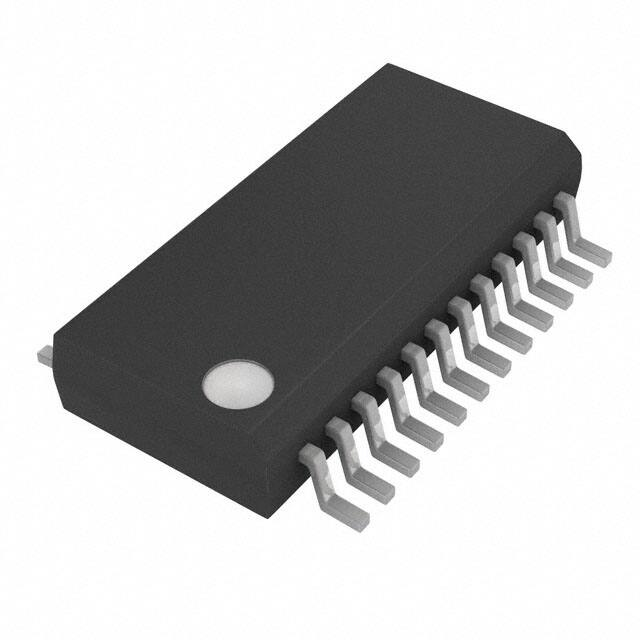

       SCAS632B − APRIL 2001 − REVISED OCTOBER 2005 D 400-MHz Differential Clock Source for D D D D D D D D D Direct Rambus Memory Systems for an 800-MHz Data Transfer Rate Synchronizes the Clock Domains of the Rambus Channel With an External System or Processor Clock Three Power Operating Modes to Minimize Power for Mobile and Other Power-Sensitive Applications Operates From a Single 3.3-V Supply and 120 mW at 300 MHz (Typ) Packaged in a Shrink Small-Outline Package (DBQ) Supports Frequency Multipliers: 4, 6, 8, 16/3 No External Components Required for PLL Supports Independent Channel Clocking Spread Spectrum Clocking Tracking Capability to Reduce EMI Designed for Use With TI’s 133-MHz Clock Synthesizers CDC924 and CDC921 D Cycle-Cycle Jitter Is Less Than 50 ps at 400 MHz D Certified by Gigatest Labs to Exceed the D Rambus DRCG Validation Requirement Supports Industrial Temperature Range of −40°C to 85°C DBQ PACKAGE (TOP VIEW) VDDIR REFCLK VDDP GNDP GNDI PCLKM SYNCLKN GNDC VDDC VDDIPD STOPB PWRDNB 1 24 2 23 3 22 4 21 5 20 6 19 7 18 8 17 9 16 10 15 11 14 12 13 S0 S1 VDDO GNDO CLK NC CLKB GNDO VDDO MULT0 MULT1 S2 NC − No internal connection description The Direct Rambus clock generator (DRCG) provides the necessary clock signals to support a Direct Rambus memory subsystem. It includes signals to synchronize the Direct Rambus channel clock to an external system or processor clock. It is designed to support Direct Rambus memory on a desktop, workstation, server, and mobile PC motherboards. DRCG also provides an off-the-shelf solution for a broad range of Direct Rambus memory applications. The DRCG provides clock multiplication and phase alignment for a Direct Rambus memory subsystem to enable synchronous communication between the Rambus channel and ASIC clock domains. In a Direct Rambus memory subsystem, a system clock source provides the REFCLK and PCLK clock references to the DRCG and memory controller, respectively. The DRCG multiplies REFCLK and drives a high-speed BUSCLK to RDRAMs and the memory controller. Gear ratio logic in the memory controller divides the PCLK and BUSCLK frequencies by ratios M and N such that PCLKM = SYNCLKN, where SYNCLK = BUSCLK/4. The DRCG detects the phase difference between PCLKM and SYNCLKN and adjusts the phase of BUSCLK such that the skew between PCLKM and SYNCLKN is minimized. This allows data to be transferred across the SYNCLK/PCLK boundary without incurring additional latency. User control is provided by multiply and mode selection terminals. The multiply terminals provide selection of one of four clock frequency multiply ratios, generating BUSCLK frequencies ranging from 267 MHz to 400 MHz with clock references ranging from 33 MHz to 100 MHz. The mode select terminals can be used to select a bypass mode where the frequency multiplied reference clock is directly output to the Rambus channel for systems where synchronization between the Rambus clock and a system clock is not required. Test modes are provided to bypass the PLL and output REFCLK on the Rambus channel and to place the outputs in a high-impedance state for board testing. The CDCR83 is characterized for operation over free-air temperatures of −40°C to 85°C. Please be aware that an important notice concerning availability, standard warranty, and use in critical applications of Texas Instruments semiconductor products and disclaimers thereto appears at the end of this data sheet. Direct Rambus and Rambus are trademarks of Rambus Inc. Copyright  2001 − 2005, Texas Instruments Incorporated          !"# $% $   ! ! &   '  $$ ()% $ !* $  #) #$ *  ## !% POST OFFICE BOX 655303 • DALLAS, TEXAS 75265 1        SCAS632B − APRIL 2001 − REVISED OCTOBER 2005 functional block diagram PWRDWNB S0 S1 S2 STOPB Test MUX Bypass MUX ByPCLK PLLCLK CLK PLL B REFCLK CLKB Phase Aligner A PACLK φD 2 PCLKM MULT0 MULT1 SYNCLKN FUNCTION TABLE† S0 S1 S2 CLK CLKB Normal 0 0 0 Phase aligned clock Phase aligned clock B Bypass 1 0 0 PLLCLK PLLCLKB Test 1 1 0 REFCLK REFCLKB Output test (OE) 0 1 X Hi-Z Hi-Z Reserved 0 0 1 — — Reserved 1 0 1 — — Hi-Z Hi-Z MODE Reserved 1 1 1 † X = don’t care, Hi-Z = high impedance 2 POST OFFICE BOX 655303 • DALLAS, TEXAS 75265        SCAS632B − APRIL 2001 − REVISED OCTOBER 2005 Terminal Functions TERMINAL NAME NO. I/O DESCRIPTION CLK 20 O Output clock CLKB 18 O Output clock (complement) GNDC 8 GND for phase aligner GNDI 5 GND for control inputs GNDO 17, 21 GND for clock outputs GNDP 4 MULT0 15 I PLL multiplier select MULT1 14 I PLL multiplier select NC 19 PCLKM 6 I Phase detector input PWRDNB 12 I Active low power down REFCLK 2 I Reference clock S0 24 I Mode control S1 23 I Mode control S2 13 I Mode control STOPB 11 I Active low output disable SYNCLKN 7 I Phase detector input VDDC VDDIPD 9 GND for PLL Not used 10 VDD for phase aligner Reference voltage for phase detector inputs and STOPB 1 Reference voltage for REFCLK VDDIR VDDO 16, 22 VDDP 3 VDD for clock outputs VDD for PLL POST OFFICE BOX 655303 • DALLAS, TEXAS 75265 3        SCAS632B − APRIL 2001 − REVISED OCTOBER 2005 PLL divider selection Table 1 lists the supported REFCLK and BUSCLK frequencies. Other REFCLK frequencies are permitted, provided that (267 MHz < BUSCLK < 400 MHz) and (33 MHz < REFCLK < 100 MHz). Table 1. REFCLK and BUSCLK Frequencies MULT0 MULT1 REFCLK (MHz) MULTIPLY RATIO BUSCLK (MHz) 0 0 67 4 267 0 1 50 6 300 0 1 67 6 400 1 1 33 8 267 1 1 50 8 400 1 0 67 16/3 356 Table 2. Clock Output Driver States STATE PWRDNB STOPB CLK CLKB Powerdown 0 X GND GND CLK stop 1 0 Normal 1 1 VX, STOP PACLK/PLLCLK/ REFCLK† VX, STOP PACLKB/PLLCLKB/ REFCLKB † Depending on the state of S0, S1, and S2 absolute maximum ratings over operating free-air temperature (unless otherwise noted)† Supply voltage range, VDD (see Note 1) . . . . . . . . . . . . . . . . . . . . . . . . . . . . . . . . . . . . . . . . . . . . . . −0.5 V to 4 V Output voltage range, VO, at any output terminal . . . . . . . . . . . . . . . . . . . . . . . . . . . . . . . . −0.5 V to VDD + 0.5 V Input voltage range,VI, at any input terminal . . . . . . . . . . . . . . . . . . . . . . . . . . . . . . . . . . . . −0.5 V to VDD + 0.5 V Continuous total power dissipation . . . . . . . . . . . . . . . . . . . . . . . . . . . . . . . . . . . . . . see Dissipation Rating Table Operating free-air temperature range, TA . . . . . . . . . . . . . . . . . . . . . . . . . . . . . . . . . . . . . . . . . . . . −40°C to 85°C Storage temperature range, Tstg . . . . . . . . . . . . . . . . . . . . . . . . . . . . . . . . . . . . . . . . . . . . . . . . . . . −65°C to 150°C Lead temperature 1,6 mm (1/16 inch) from case for 10 seconds . . . . . . . . . . . . . . . . . . . . . . . . . . . . . . . 260°C † Stresses beyond those listed under “absolute maximum ratings” may cause permanent damage to the device. These are stress ratings only, and functional operation of the device at these or any other conditions beyond those indicated under “recommended operating conditions” is not implied. Exposure to absolute-maximum-rated conditions for extended periods may affect device reliability. NOTE 1: All voltage values are with respect to the GND terminals. DISSIPATION RATING TABLE PACKAGE TA ≤ 25°C POWER RATING DERATING FACTOR ABOVE TA = 25°C‡ TA = 70°C POWER RATING TA = 85°C POWER RATING DBQ 1400 mW 11 mW/°C 905 mW 740 mW ‡ This is the inverse of the junction-to-ambient thermal resistance when board-mounted and with no air flow. 4 POST OFFICE BOX 655303 • DALLAS, TEXAS 75265        SCAS632B − APRIL 2001 − REVISED OCTOBER 2005 recommended operating conditions Supply voltage, VDD MIN NOM MAX UNIT 3.135 3.3 3.465 V 0.7 × VDD High-level input voltage, VIH (CMOS) V 0.3 × VDD Low-level input voltage, VIL (CMOS) −0.5 × tc(PD) Initial phase error at phase detector inputs (required range for phase aligner) V 0.5 × tc(PD) 0.3 × VDDIR REFCLK low-level input voltage, VIL V 0.7 × VDDIR REFCLK high-level input voltage, VIH V 0.3 × VDDIPD Input signal low voltage, VIL (STOPB) V 0.7 × VDDIPD Input signal high voltage, VIH (STOPB) V Input reference voltage for (REFCLK) (VDDIR) 1.235 3.465 Input reference voltage for (PCLKM and SYSCLKN) (VDDIPD) 1.235 3.465 High-level output current, IOH V −16 mA 16 mA 85 °C MIN MAX UNIT 10 40 ns 250 ps 40% 60% 30 33 Low-level output current, IOL Operating free-air temperature, TA V −40 timing requirements Input cycle time, tc(in) Input cycle-to-cycle jitter Input duty cycle over 10,000 cycles Input frequency modulation, fmod Modulation index, nonlinear maximum 0.5% kHz 0.6% Phase detector input cycle time (PCLKM and SYNCLKN) 30 Input slew rate, SR Input duty cycle (PCLKM and SYNCLKN) POST OFFICE BOX 655303 • DALLAS, TEXAS 75265 100 1 4 25% 75% ns V/ns 5        SCAS632B − APRIL 2001 − REVISED OCTOBER 2005 electrical characteristics over recommended operating free-air temperature range (unless otherwise noted) TEST CONDITIONS† PARAMETER MIN TYP‡ MAX UNIT VO(STOP) Output voltage during CLK Stop (STOPB = 0) See Figure 1 1.1 2 VO(X) VO Output crossing-point voltage See Figure 1 and Figure 6 1.3 1.8 V Output voltage swing See Figure 1 0.4 0.6 V VIK Input clamp voltage VDD = 3.135 V, See Figure 1 II = −18 mA −1.2 V IOH = −1 mA IOH = −16 mA 2 VOH High-level output voltage VDD = min to max, VDD = 3.135 V, VOL Low-level output voltage VDD = min to max, VDD = 3.135 V, IOL = 1 mA IOL = 16 mA VDD = 3.135 V, VDD = 3.3 V, VDD = 3.465 V, VO = 1 V VO = 1.65 V See Figure 1 IOH IOL High-level output current VO = 3.135 V VO = 1.95 V High-impedance-state output current S0 = 0, IOZ(STOP) High-impedance-state output current during CLK stop Stop = 0, VO = GND or VDD IOZ(PD) High-impedance-state output current in power-down state PWRDNB = 0, VO = GND or VDD IIH High-level input current IIL ZO −52 −51 −14.5 43 mA −21 61.5 65 25.5 S1 = 1 −10 mA 36 ± 10 µA ± 100 µA 100 µA VI = VDD 10 PWRDNB, S0, S1, S2, MULT0, MULT1 VDD = 3.465 V, VI = VDD 10 REFCLK, PCLKM, SYNCLKN, STOPB VDD = 3.465 V, VI = 0 −10 PWRDNB, S0, S1, S2, MULT0, MULT1 VDD = 3.465 V, VI = 0 −10 µA A A µA Output impedance High state RI at IO −14.5 mA to −16.5 mA 15 35 50 Low state RI at IO 14.5 mA to 16.5 mA 11 17 35 Reference current VDDIR, VDDIPD VDD = 3.465 V CO Output capacitance 50 µA PWRDNB = 1 0.5 mA VI = VDD or GND VO = VDD or GND Supply current in power-down state REFCLK = 0 MHz to 100 MHz, PWDNB = 0, STOPB = 1 POST OFFICE BOX 655303 Ω PWRDNB = 0 IDD(CLKSTOP) Supply current in CLK stop state BUSCLK configured for 400 MHz IDD(NORMAL) Supply current in normal state BUSCLK = 400 MHz † VDD refers to any of the following; VDD, VDDIPD, VDDIR, VDDO, VDDC, and VDDP ‡ All typical values are at VDD = 3.3 V, TA = 25°C. 6 −32 VDD = 3.465 V, Input capacitance V 0.5 REFCLK, PCLKM, SYNCLKN, STOPB CI IDD(PD) 0.1 VO = 1.65 V VO = 0.4 V IOZ Low-level input current V 1 VDD = 3.135 V, VDD = 3.3 V, VDD = 3.465 V, Low-level output current VDD − 0.1 V 2.4 • DALLAS, TEXAS 75265 2 pF 3 pF 100 µA 30 mA 70 mA        SCAS632B − APRIL 2001 − REVISED OCTOBER 2005 switching characteristics over recommended operating free-air temperature range (unless otherwise noted) PARAMETER tc(out) Clock output cycle time t(jitter) Total cycle jitter over 1, 2, 3, 4, 5, or 6 clock cycles TEST CONDITIONS MIN TYP† 2.5 267 MHz Infinite and stopped phase alignment 60 400 MHz Static phase error} −100 PLL output phase error when tracking SSC Dynamic phase error} t(DC) Output duty cycle over 10,000 cycles See Figure 4 100 ps −100 100 ps 45% 55% 267 MHz Output cycle-to-cycle duty cycle error 80 300 MHz 356 MHz ps 50 Phase detector phase error for distributed loop t(DC, err) ns 70 See Figure 3 t(phase) t(phase, SSC) Infinite and stopped phase alignment UNIT 3.75 80 300 MHz 356 MHz MAX 70 See Figure 5 60 400 MHz ps 50 tr, tf Output rise and fall times (measured at 20%−80% of output voltage) See Figure 7 ∆t Difference between rise and fall times on a single device (20%−80%) |tf − tr| See Figure 7 160 400 ps 100 ps MAX UNIT † All typical values are at VDD = 3.3 V, TA = 25°C. ‡ Assured by design state transition latency specifications PARAMETER t(powerup) FROM Delay time, PWRDNB↑ to CLK/CLKB output settled (excluding t(DISTLOCK)) Delay time, PWRDNB↑ to internal PLL and clock are on and settled TO See Figure 8 Powerdown Delay time, power up to internal PLL and clock are on and settled t(MULT) MULT0 and MULT1 change to CLK/CLKB output resettled (excluding t(DISTLOCK)) t(CLKON) MIN TYP† 3 Normal ms 3 Delay time, power up to CLK/CLKB output settled t(VDDpowerup) TEST CONDITIONS See Figure 8 VDD 3 Normal ms 3 Normal Normal See Figure 9 1 ms STOPB↑ to CLK/CLKB glitch-free clock edges CLK Stop Normal See Figure 10 10 ns t(CLKSETL) STOPB↑ to CLK/CLKB output settled to within 50 ps of the phase before STOPB was disabled CLK Stop Normal See Figure 10 20 cycles t(CLKOFF) STOPB↓ to CLK/CLKB output disabled CLK Stop See Figure 10 5 ns Normal † All typical values are at VDD = 3.3 V, TA = 25°C. POST OFFICE BOX 655303 • DALLAS, TEXAS 75265 7        SCAS632B − APRIL 2001 − REVISED OCTOBER 2005 state transition latency specifications (continued) PARAMETER FROM TO TEST CONDITIONS t(powerdown) Delay time, PWRDNB↓ to the device in the power-down mode Normal Powerdown See Figure 8 t(STOP) Maximum time in CLKSTOP (STOPB = 0) before reentering normal mode (STOPB = 1) STOPB Normal See Figure 10 t(ON) Minimum time in normal mode (STOPB = 1) before reentering CLKSTOP (STOPB = 0) Normal CLK stop See Figure 10 Time from when CLK/CLKB output is settled to when the phase error between SYNCLKN and PCLKM falls within t(phase) † All typical values are at VDD = 3.3 V, TA = 25°C. t(DISTLOCK) 8 Unlocked POST OFFICE BOX 655303 Locked • DALLAS, TEXAS 75265 MIN TYP† MAX UNIT 1 ms 100 µs 100 ms 5 ms        SCAS632B − APRIL 2001 − REVISED OCTOBER 2005 PARAMETER MEASUREMENT INFORMATION 68 Ω, ±5% 39 Ω, ±5% 10 pF 39 Ω, ±5% 68 Ω, ±5% RT = 28 Ω RT = 28 Ω 100 pF 10 pF Figure 1. Test Load and Voltage Definitions (VO(STOP), VO(X), VO, VOH, VOL) CLK CLKB tc(1) tc(2) Cycle-to-cycle jitter = | tc(1) − tc(2)| over 10000 consecutive cycles Figure 2. Cycle-to-Cycle Jitter CLK CLKB tc(3) tc(4) Cycle-to-cycle jitter = | tc(3) − tc(4)| over 10000 consecutive cycles Figure 3. Short Term Cycle-to-Cycle Jitter Over Four Cycles POST OFFICE BOX 655303 • DALLAS, TEXAS 75265 9        SCAS632B − APRIL 2001 − REVISED OCTOBER 2005 PARAMETER MEASUREMENT INFORMATION CLK CLKB tpd(1) tc(5) Duty cycle = (tpd(1)/tc(5)) Figure 4. Output Duty Cycle CLK CLKB tpd(2) tpd(3) tc(6) tc(7) Duty cycle error = tpd(2) − tpd(3) Figure 5. Duty Cycle Error (Cycle-to-Cycle) CLK VO(X)+ VO(X), nom VO(X)− CLKB Figure 6. Crossing-Point Voltage VOH 80% 20% VOL tr tf Figure 7. Voltage Waveforms PWRDNB ÎÎÎÎÎÎÎÎ ÎÎÎÎÎÎÎÎ t(power down) t(power up) CLK/CLKB Figure 8. PWRDNB Transition Timings 10 POST OFFICE BOX 655303 • DALLAS, TEXAS 75265 ÎÎ ÎÎ        SCAS632B − APRIL 2001 − REVISED OCTOBER 2005 PARAMETER MEASUREMENT INFORMATION MULT0 and/or MULT1 ÎÎÎÎÎÎÎ ÎÎÎÎÎÎÎ CLK/CLKB t(MULT) Figure 9. MULT Transition Timings t(ON) t(STOP) STOPB t(CLKSETL) t(CLKON) (see Note A) CLK/CLKB ÎÎÎÎ ÎÎÎÎ Output clock not specified glitches ok Clock enabled and glitch free ÎÎÎ ÎÎÎ t(CLKOFF) (see Note A) Clock output settled within 50 ps of the phase before disabled NOTE A: Vref = VO ± 200 mV Figure 10. STOPB Transition Timings POST OFFICE BOX 655303 • DALLAS, TEXAS 75265 11        SCAS632B − APRIL 2001 − REVISED OCTOBER 2005 MECHANICAL DATA DBQ (R-PDSO-G**) PLASTIC SMALL-OUTLINE PACKAGE 24-PIN SHOWN 0.012 (0,30) 0.008 (0,20) 0.025 (0,64) 24 0.005 (0,13) M 13 0.244 (6,20) 0.228 (5,80) 0.008 (0,20) NOM 0.157 (3,99) 0.150 (3,81) 1 Gage Plane 12 A 0.010 (0,25) 0°−ā 8° 0.035 (0,89) 0.016 (0,40) Seating Plane 0.069 (1,75) MAX 0.010 (0,25) 0.004 (0,10) 0.004 (0,10) PINS ** 16 20 24 A MAX 0.197 (5,00) 0.344 (8,74) 0.344 (8,74) A MIN 0.188 (4,78) 0.337 (8,56) 0.337 (8,56) DIM 4073301/C 02/97 NOTES: A. B. C. D. 12 All linear dimensions are in inches (millimeters). This drawing is subject to change without notice. Body dimensions do not include mold flash or protrusion not to exceed 0.006 (0,15). Falls within JEDEC MO-137 POST OFFICE BOX 655303 • DALLAS, TEXAS 75265 PACKAGE OPTION ADDENDUM www.ti.com 18-Jul-2006 PACKAGING INFORMATION Orderable Device Status (1) Package Type Package Drawing Pins Package Eco Plan (2) Qty CDCR83DBQ NRND SSOP/ QSOP DBQ 24 50 Green (RoHS & no Sb/Br) CU NIPDAU Level-2-260C-1 YEAR CDCR83DBQG4 NRND SSOP/ QSOP DBQ 24 50 Green (RoHS & no Sb/Br) CU NIPDAU Level-2-260C-1 YEAR CDCR83DBQR NRND SSOP/ QSOP DBQ 24 2500 Green (RoHS & no Sb/Br) CU NIPDAU Level-2-260C-1 YEAR CDCR83DBQRG4 NRND SSOP/ QSOP DBQ 24 2500 Green (RoHS & no Sb/Br) CU NIPDAU Level-2-260C-1 YEAR Lead/Ball Finish MSL Peak Temp (3) (1) The marketing status values are defined as follows: ACTIVE: Product device recommended for new designs. LIFEBUY: TI has announced that the device will be discontinued, and a lifetime-buy period is in effect. NRND: Not recommended for new designs. Device is in production to support existing customers, but TI does not recommend using this part in a new design. PREVIEW: Device has been announced but is not in production. Samples may or may not be available. OBSOLETE: TI has discontinued the production of the device. (2) Eco Plan - The planned eco-friendly classification: Pb-Free (RoHS), Pb-Free (RoHS Exempt), or Green (RoHS & no Sb/Br) - please check http://www.ti.com/productcontent for the latest availability information and additional product content details. TBD: The Pb-Free/Green conversion plan has not been defined. Pb-Free (RoHS): TI's terms "Lead-Free" or "Pb-Free" mean semiconductor products that are compatible with the current RoHS requirements for all 6 substances, including the requirement that lead not exceed 0.1% by weight in homogeneous materials. Where designed to be soldered at high temperatures, TI Pb-Free products are suitable for use in specified lead-free processes. Pb-Free (RoHS Exempt): This component has a RoHS exemption for either 1) lead-based flip-chip solder bumps used between the die and package, or 2) lead-based die adhesive used between the die and leadframe. The component is otherwise considered Pb-Free (RoHS compatible) as defined above. Green (RoHS & no Sb/Br): TI defines "Green" to mean Pb-Free (RoHS compatible), and free of Bromine (Br) and Antimony (Sb) based flame retardants (Br or Sb do not exceed 0.1% by weight in homogeneous material) (3) MSL, Peak Temp. -- The Moisture Sensitivity Level rating according to the JEDEC industry standard classifications, and peak solder temperature. Important Information and Disclaimer:The information provided on this page represents TI's knowledge and belief as of the date that it is provided. TI bases its knowledge and belief on information provided by third parties, and makes no representation or warranty as to the accuracy of such information. Efforts are underway to better integrate information from third parties. TI has taken and continues to take reasonable steps to provide representative and accurate information but may not have conducted destructive testing or chemical analysis on incoming materials and chemicals. TI and TI suppliers consider certain information to be proprietary, and thus CAS numbers and other limited information may not be available for release. In no event shall TI's liability arising out of such information exceed the total purchase price of the TI part(s) at issue in this document sold by TI to Customer on an annual basis. Addendum-Page 1 PACKAGE MATERIALS INFORMATION www.ti.com 11-Mar-2008 TAPE AND REEL INFORMATION *All dimensions are nominal Device CDCR83DBQR Package Package Pins Type Drawing SSOP/ QSOP DBQ 24 SPQ Reel Reel Diameter Width (mm) W1 (mm) 2500 330.0 16.4 Pack Materials-Page 1 A0 (mm) B0 (mm) K0 (mm) P1 (mm) 6.5 9.0 2.1 8.0 W Pin1 (mm) Quadrant 16.0 Q1 PACKAGE MATERIALS INFORMATION www.ti.com 11-Mar-2008 *All dimensions are nominal Device Package Type Package Drawing Pins SPQ Length (mm) Width (mm) Height (mm) CDCR83DBQR SSOP/QSOP DBQ 24 2500 346.0 346.0 33.0 Pack Materials-Page 2 IMPORTANT NOTICE Texas Instruments Incorporated and its subsidiaries (TI) reserve the right to make corrections, modifications, enhancements, improvements, and other changes to its products and services at any time and to discontinue any product or service without notice. Customers should obtain the latest relevant information before placing orders and should verify that such information is current and complete. All products are sold subject to TI’s terms and conditions of sale supplied at the time of order acknowledgment. TI warrants performance of its hardware products to the specifications applicable at the time of sale in accordance with TI’s standard warranty. Testing and other quality control techniques are used to the extent TI deems necessary to support this warranty. Except where mandated by government requirements, testing of all parameters of each product is not necessarily performed. TI assumes no liability for applications assistance or customer product design. Customers are responsible for their products and applications using TI components. To minimize the risks associated with customer products and applications, customers should provide adequate design and operating safeguards. TI does not warrant or represent that any license, either express or implied, is granted under any TI patent right, copyright, mask work right, or other TI intellectual property right relating to any combination, machine, or process in which TI products or services are used. Information published by TI regarding third-party products or services does not constitute a license from TI to use such products or services or a warranty or endorsement thereof. Use of such information may require a license from a third party under the patents or other intellectual property of the third party, or a license from TI under the patents or other intellectual property of TI. Reproduction of TI information in TI data books or data sheets is permissible only if reproduction is without alteration and is accompanied by all associated warranties, conditions, limitations, and notices. Reproduction of this information with alteration is an unfair and deceptive business practice. TI is not responsible or liable for such altered documentation. Information of third parties may be subject to additional restrictions. Resale of TI products or services with statements different from or beyond the parameters stated by TI for that product or service voids all express and any implied warranties for the associated TI product or service and is an unfair and deceptive business practice. TI is not responsible or liable for any such statements. TI products are not authorized for use in safety-critical applications (such as life support) where a failure of the TI product would reasonably be expected to cause severe personal injury or death, unless officers of the parties have executed an agreement specifically governing such use. Buyers represent that they have all necessary expertise in the safety and regulatory ramifications of their applications, and acknowledge and agree that they are solely responsible for all legal, regulatory and safety-related requirements concerning their products and any use of TI products in such safety-critical applications, notwithstanding any applications-related information or support that may be provided by TI. Further, Buyers must fully indemnify TI and its representatives against any damages arising out of the use of TI products in such safety-critical applications. TI products are neither designed nor intended for use in military/aerospace applications or environments unless the TI products are specifically designated by TI as military-grade or "enhanced plastic." Only products designated by TI as military-grade meet military specifications. Buyers acknowledge and agree that any such use of TI products which TI has not designated as military-grade is solely at the Buyer's risk, and that they are solely responsible for compliance with all legal and regulatory requirements in connection with such use. TI products are neither designed nor intended for use in automotive applications or environments unless the specific TI products are designated by TI as compliant with ISO/TS 16949 requirements. Buyers acknowledge and agree that, if they use any non-designated products in automotive applications, TI will not be responsible for any failure to meet such requirements. Following are URLs where you can obtain information on other Texas Instruments products and application solutions: Products Amplifiers Data Converters DSP Clocks and Timers Interface Logic Power Mgmt Microcontrollers RFID RF/IF and ZigBee® Solutions amplifier.ti.com dataconverter.ti.com dsp.ti.com www.ti.com/clocks interface.ti.com logic.ti.com power.ti.com microcontroller.ti.com www.ti-rfid.com www.ti.com/lprf Applications Audio Automotive Broadband Digital Control Medical Military Optical Networking Security Telephony Video & Imaging Wireless www.ti.com/audio www.ti.com/automotive www.ti.com/broadband www.ti.com/digitalcontrol www.ti.com/medical www.ti.com/military www.ti.com/opticalnetwork www.ti.com/security www.ti.com/telephony www.ti.com/video www.ti.com/wireless Mailing Address: Texas Instruments, Post Office Box 655303, Dallas, Texas 75265 Copyright © 2008, Texas Instruments Incorporated

物料型号:CDCR83
器件简介: - 该器件是一个Direct Rambus时钟发生器(DRCG),提供必要的时钟信号以支持Direct Rambus内存子系统。 - 它包括同步Direct Rambus通道时钟与外部系统或处理器时钟的信号。 - 设计用于支持桌面、工作站、服务器和移动PC主板上的Direct Rambus内存。 - 还提供了一个现成的解决方案,用于广泛的Direct Rambus内存应用。
引脚分配: - CLK(引脚20):输出时钟 - CLKB(引脚18):输出时钟(互补) - GNDC(引脚8):相位对齐器的地 - GNDI(引脚5):控制输入的地 - GNDO(引脚17、21):时钟输出的地 - MULT0(引脚15)和MULT1(引脚14):PLL乘数选择 - PCLKM(引脚6):相位检测器输入 - PWRDNB(引脚12):低电平有效的电源关闭 - REFCLK(引脚2):参考时钟 - SO(引脚24)、S1(引脚23)、S2(引脚13):模式控制 - STOPB(引脚11):低电平有效的输出禁用 - SYNCLKN(引脚7):相位检测器输入 - VDDC(引脚9)、VDDIPD(引脚10)、VDDO(引脚16、22)、VDDP(引脚3):不同的电源电压
参数特性: - 工作温度范围:-40°C 至 85°C - 电源电压范围:3.135V至3.465V - 输出电压摆幅:0.4V至0.6V - 输入电容:2pF - 输出电容:3pF - 电源关闭状态下的电源电流:100uA - 正常状态下的电源电流:70mA(在400MHz BUSCLK时)
功能详解: - 提供时钟倍增和相位对齐,以实现Rambus通道和ASIC时钟域之间的同步通信。 - 用户可以通过乘数和模式选择终端进行控制。 - 提供了绕过模式,其中倍增的参考时钟直接输出到Rambus通道,用于不需要Rambus时钟和系统时钟同步的系统。 - 提供测试模式以绕过PLL并将REFCLK输出到Rambus通道,并将输出置于高阻态以进行板测试。
应用信息: - 设计用于与TI的133MHz时钟合成器CDC924和CDC921一起使用。
封装信息: - 封装在收缩小外形封装(DBQ)中。 - 引脚数:24 - 封装类型:SSOP/QSOP
