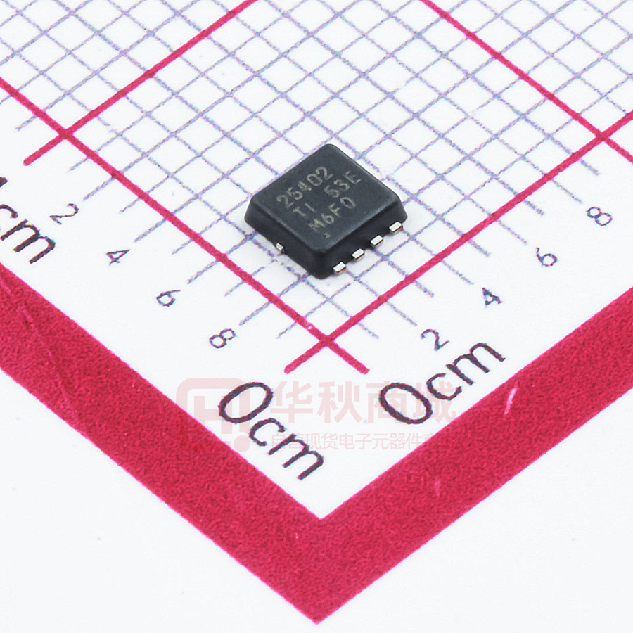

CSD25402Q3A 数据手册
Sample & Buy Product Folder Support & Community Tools & Software Technical Documents Reference Design CSD25402Q3A SLPS454B – DECEMBER 2013 – REVISED JANUARY 2016 CSD25402Q3A –20 V P-Channel NexFET™ Power MOSFET 1 Features • • • • • • 1 Product Summary Ultra-Low Qg and Qgd Low Thermal Resistance Low RDS(on) Pb and Halogen Free RoHS Compliant SON 3.3 mm × 3.3 mm Plastic Package TA = 25°C • • • • –20 V Qg Gate charge total (–4.5 V) 7.5 nC Qgd Gate charge gate to drain Vth DC-DC Converters Battery Management Load Switch Battery Protection UNIT Drain-to-source voltage RDS(on) 2 Applications TYPICAL VALUE VDS 1.1 Drain-to-source on resistance nC VGS = –1.8 V 74 mΩ VGS = –2.5 V 13.3 mΩ VGS = –4.5 V 7.7 mΩ Threshold voltage –0.9 V Ordering Information(1) DEVICE QTY CSD25402Q3A MEDIA 2500 13-Inch Reel CSD25402Q3AT 250 7-Inch Reel PACKAGE SHIP SON 3.3 mm × 3.3 mm Plastic Package Tape and Reel 3 Description (1) For all available packages, see the orderable addendum at the end of the data sheet. This –20-V, 7.7-mΩ NexFET™ power MOSFET is designed to minimize losses in power conversion load management applications with a SON 3.3 mm × 3.3 mm package that offers an excellent thermal performance for the size of the device. TA = 25°C Top View D VALUE UNIT VDS Drain-to-source voltage –20 V VGS Gate-to-source voltage +12 or –12 V Continuous drain current, TC = 25°C –76 A Continuous drain current (package limit) –35 A Continuous drain current(1) –15 A Pulsed drain current(2) –148 A ID 8 1 Absolute Maximum Ratings S IDM D 2 7 D 3 6 S Power dissipation PD 4 S (1) 2.8 Power dissipation, TC = 25°C S W 69 TJ Operating junction temperature –55 to 150 °C Tstg Storage temperature –55 to 150 °C 5 G S 2 (1) Typical RθJA = 45°C/W on 1 inch Cu (2 oz.) on 0.060 inch thick FR4 PCB. (2) Max RθJC = 2.3°C/W, pulse duration ≤100 μs, duty cycle ≤1% RDS(on) vs VGS Gate Charge 8 TC = 25° C, I D = -10 A TC = 125° C, I D = -10 A 21 -VGS - Gate-to-Source Voltage (V) RDS(on) - On-State Resistance (m:) 24 18 15 12 9 6 3 0 ID = -10 A VDS = -10 V 7 6 5 4 3 2 1 0 0 2 4 6 8 10 -VGS - Gate-To-Source Voltage (V) 12 D007 0 2 4 6 8 10 Qg - Gate Charge (nC) 12 14 D004 1 An IMPORTANT NOTICE at the end of this data sheet addresses availability, warranty, changes, use in safety-critical applications, intellectual property matters and other important disclaimers. PRODUCTION DATA. CSD25402Q3A SLPS454B – DECEMBER 2013 – REVISED JANUARY 2016 www.ti.com Table of Contents 1 2 3 4 5 Features .................................................................. Applications ........................................................... Description ............................................................. Revision History..................................................... Specifications......................................................... 1 1 1 2 3 5.1 Electrical Characteristics........................................... 3 5.2 Thermal Information .................................................. 3 5.3 Typical MOSFET Characteristics.............................. 4 6 Device and Documentation Support.................... 7 6.1 6.2 6.3 6.4 7 Community Resources.............................................. Trademarks ............................................................... Electrostatic Discharge Caution ................................ Glossary .................................................................... 7 7 7 7 Mechanical, Packaging, and Orderable Information ............................................................. 8 7.1 7.2 7.3 7.4 Q3A Package Dimensions ........................................ 8 Q3A Recommended PCB Pattern ............................ 9 Q3A Recommended Stencil Pattern ......................... 9 Q3A Tape and Reel Information ............................. 10 4 Revision History NOTE: Page numbers for previous revisions may differ from page numbers in the current version. Changes from Revision A (July 2015) to Revision B Page • Updated Package Dimensions drawing.................................................................................................................................. 8 • Updated PCB drawing. .......................................................................................................................................................... 9 • Updated Stencil Pattern drawing. .......................................................................................................................................... 9 Changes from Original (December 2013) to Revision A Page • Added part number to title. .................................................................................................................................................... 1 • Added 7-inch reel to Ordering Information table .................................................................................................................... 1 • Lowered typical RθJA from 55 to 45°C/W in Absolute Maximum Ratings Table footnote. ..................................................... 1 • Increased max pulsed current to –148 A. ............................................................................................................................. 1 • Added line for max power dissipation with the case temperature held to 25°C in Absolute Maximum Ratings Table. ........ 1 • Updated pulsed current conditions. ....................................................................................................................................... 1 • Updated Figure 1 to a normalized RθJC curve. ...................................................................................................................... 4 • Updated SOA in Figure 10 ..................................................................................................................................................... 6 2 Submit Documentation Feedback Copyright © 2013–2016, Texas Instruments Incorporated Product Folder Links: CSD25402Q3A CSD25402Q3A www.ti.com SLPS454B – DECEMBER 2013 – REVISED JANUARY 2016 5 Specifications 5.1 Electrical Characteristics (TA = 25°C unless otherwise stated) PARAMETER TEST CONDITIONS MIN TYP MAX UNIT STATIC CHARACTERISTICS BVDSS Drain-to-source voltage VGS = 0 V, ID = –250 μA IDSS Drain-to-source leakage current VGS = 0 V, VDS = –16 V –1 μA IGSS Gate-to-source leakage current VDS = 0 V, VGS = ±12 V –100 nA VGS(th) Gate-to-source threshold voltage VDS = VGS, ID = –250 μA –20 –0.65 V –0.90 –1.15 74 300 mΩ VGS = –2.5 V, ID = –10 A 13.3 15.9 mΩ VGS = –4.5 V, ID = –10 A 7.7 8.9 mΩ VDS = –10 V, ID = –10 A 59 VGS = –1.8 V, ID = –1 A RDS(on) Drain-to-source on resistance gfs Transconductance V S DYNAMIC CHARACTERISTICS CISS Input capacitance VGS = 0 V, VDS = –10 V, ƒ = 1 MHz 1380 1790 pF COSS Output capacitance 763 992 pF CRSS Reverse transfer capacitance 39 51 pF RG Series gate resistance 3.7 7.4 Ω Qg Gate charge total (–4.5 V) 7.5 9.7 nC Qgd Gate charge gate to drain 1.1 nC Qgs Gate charge gate to source 2.4 nC Qg(th) Gate charge at Vth 1.0 nC QOSS Output charge 7.6 nC td(on) Turn on delay time 10 ns tr Rise time 7 ns td(off) Turn off delay time 25 ns tf Fall time 12 ns VDS = –10 V, ID = –10 A VDS = –10 V, VGS = 0 V VDS = –10 V, VGS = –4.5 V, ID = –10 A , RG = 5 Ω DIODE CHARACTERISTICS VSD Diode forward voltage Qrr Reverse recovery charge trr Reverse recovery time IS = –10 A, VGS = 0 V –0.8 VDS = –8.5 V, IF = –10 A, di/dt = 200 A/μs 10.3 –1 nC V 21 ns 5.2 Thermal Information (TA = 25°C unless otherwise stated) MAX UNIT RθJC Junction-to-case thermal resistance (1) THERMAL METRIC 2.3 °C/W RθJA Junction-to-ambient thermal resistance (1) (2) 55 °C/W (1) (2) MIN TYP RθJC is determined with the device mounted on a 1 inch2 (6.45 cm2), 2 oz. (0.071 mm thick) Cu pad on a 1.5 inch × 1.5 inch (3.81 cm × 3.81 cm), 0.06 inch (1.52 mm) thick FR4 PCB. RθJC is specified by design, whereas RθJA is determined by the user’s board design. Device mounted on FR4 material with 1 inch2 (6.45 cm2), 2 oz. (0.071 mm thick) Cu. Submit Documentation Feedback Copyright © 2013–2016, Texas Instruments Incorporated Product Folder Links: CSD25402Q3A 3 CSD25402Q3A SLPS454B – DECEMBER 2013 – REVISED JANUARY 2016 GATE www.ti.com GATE DRAIN DRAIN Max RθJA = 175°C/W when mounted on minimum pad area of 2 oz. Cu. Max RθJA = 55°C/W when mounted on 1 inch2 of 2 oz. Cu. SOURCE SOURCE M0137-02 M0137-01 5.3 Typical MOSFET Characteristics (TA = 25°C unless otherwise stated) Figure 1. Transient Thermal Impedance 4 Submit Documentation Feedback Copyright © 2013–2016, Texas Instruments Incorporated Product Folder Links: CSD25402Q3A CSD25402Q3A www.ti.com SLPS454B – DECEMBER 2013 – REVISED JANUARY 2016 Typical MOSFET Characteristics (continued) (TA = 25°C unless otherwise stated) 100 VGS = -1.8 V VGS = -2.5 V VGS = -4.5 V 90 80 70 60 50 40 30 20 10 TC = 125° C TC = 25° C TC = -55° C 90 -IDS - Drain-To-Source Current (A) -IDS - Drain-to-Source Current (A) 100 80 70 60 50 40 30 20 10 0 0 0 0.2 0.4 0.6 0.8 1 1.2 1.4 1.6 -VDS - Drain-to-Source Voltage (V) 1.8 2 0 0.5 D002 1 1.5 2 2.5 3 -VGS - Gate-To-Source Voltage (V) 3.5 4 D003 VDS = –5 V Figure 2. Saturation Characteristics Figure 3. Transfer Characteristics 10000 7 6 C - Capacitance (pF) -VGS - Gate-to-Source Voltage (V) 8 5 4 3 2 1000 Ciss = Cgd + Cgs Coss = Cds + Cgd Crss = Cgd 100 1 10 0 0 2 4 6 8 10 Qg - Gate Charge (nC) ID = –10 A 12 0 14 2 4 D004 Figure 4. Gate Charge 20 D005 Figure 5. Capacitance 24 RDS(on) - On-State Resistance (m:) 1.2 -VGS(th) - Threshold Voltage (V) 18 VDS = –10 V 1.3 1.1 1 0.9 0.8 0.7 0.6 0.5 0.4 -75 6 8 10 12 14 16 -VDS - Drain-to-Source Voltage (V) TC = 25° C, I D = -10 A TC = 125° C, I D = -10 A 21 18 15 12 9 6 3 0 -50 -25 0 25 50 75 100 TC - Case Temperature (qC) 125 150 175 0 D006 2 4 6 8 10 -VGS - Gate-To-Source Voltage (V) 12 D007 ID = –250 µA Figure 6. Threshold Voltage vs Temperature Figure 7. On-State Resistance vs Gate-to-Source Voltage Submit Documentation Feedback Copyright © 2013–2016, Texas Instruments Incorporated Product Folder Links: CSD25402Q3A 5 CSD25402Q3A SLPS454B – DECEMBER 2013 – REVISED JANUARY 2016 www.ti.com Typical MOSFET Characteristics (continued) (TA = 25°C unless otherwise stated) 100 1.3 VGS = -2.5 V VGS = -4.5 V -ISD - Source-To-Drain Current (A) Normalized On-State Resistance 1.4 1.2 1.1 1 0.9 0.8 0.7 -75 TC = 25qC TC = 125qC 10 1 0.1 0.01 0.001 0.0001 -50 -25 0 25 50 75 100 TC - Case Temperature (qC) 125 150 0 175 0.2 0.4 0.6 0.8 -VSD - Source-To-Drain Voltage (V) D008 1 D009 ID = –10 A Figure 8. Normalized On-State Resistance vs Temperature Figure 9. Typical Diode Forward Voltage 40 -IDS - Drain-to-Source Current (A) -IDS - Drain-to-Source Current (A) 1000 100 10 1 DC 10 ms 0.1 0.1 1 ms 100 µs 1 10 -VDS - Drain-to-Source Voltage (V) 50 35 30 25 20 15 10 5 0 -50 -25 D010 0 25 50 75 100 125 TC - Case Temperature (qC) 150 175 D011 Single Pulse, Max RθJC = 2.3°C/W Figure 10. Maximum Safe Operating Area 6 Figure 11. Maximum Drain Current vs Temperature Submit Documentation Feedback Copyright © 2013–2016, Texas Instruments Incorporated Product Folder Links: CSD25402Q3A CSD25402Q3A www.ti.com SLPS454B – DECEMBER 2013 – REVISED JANUARY 2016 6 Device and Documentation Support 6.1 Community Resources The following links connect to TI community resources. Linked contents are provided "AS IS" by the respective contributors. They do not constitute TI specifications and do not necessarily reflect TI's views; see TI's Terms of Use. TI E2E™ Online Community TI's Engineer-to-Engineer (E2E) Community. Created to foster collaboration among engineers. At e2e.ti.com, you can ask questions, share knowledge, explore ideas and help solve problems with fellow engineers. Design Support TI's Design Support Quickly find helpful E2E forums along with design support tools and contact information for technical support. 6.2 Trademarks NexFET, E2E are trademarks of Texas Instruments. All other trademarks are the property of their respective owners. 6.3 Electrostatic Discharge Caution These devices have limited built-in ESD protection. The leads should be shorted together or the device placed in conductive foam during storage or handling to prevent electrostatic damage to the MOS gates. 6.4 Glossary SLYZ022 — TI Glossary. This glossary lists and explains terms, acronyms, and definitions. Submit Documentation Feedback Copyright © 2013–2016, Texas Instruments Incorporated Product Folder Links: CSD25402Q3A 7 CSD25402Q3A SLPS454B – DECEMBER 2013 – REVISED JANUARY 2016 www.ti.com 7 Mechanical, Packaging, and Orderable Information The following pages include mechanical, packaging, and orderable information. This information is the most current data available for the designated devices. This data is subject to change without notice and revision of this document. For browser-based versions of this data sheet, refer to the left-hand navigation. 7.1 Q3A Package Dimensions 3.1 2.9 B A PIN 1 INDEX AREA 3.25 3.05 2X 0.15 MAX 2X (0.2) 3.5 TYP 3.1 C 0.9 MAX SEATING PLANE 0.05 0.00 (0.2) 1.74±0.1 4X 0.52 0.32 0.565±0.1 (0.15) TYP EXPOSED THERMAL PAD NOTE 3 4 5 9 2X 1.95 2.45±0.1 0.65 TYP 8 1 4X 0.55 0.25 8X 4X 1.45 2X NOTE 4 0.35 0.25 0.1 0.05 C B C A 4222499/A 12/2015 1. All linear dimensions are in millimeters. Any dimensions in parenthesis are for reference only. Dimensioning and tolerancing per ASME Y14.5M. 2. This drawing is subject to change without notice. 3. The package thermal pad must be soldered to the printed circuit board for thermal and mechanical performance. 4. Metalized features are supplier options and may not be on the package. 5. All dimensions do not include mold flash or protrusions. 8 Submit Documentation Feedback Copyright © 2013–2016, Texas Instruments Incorporated Product Folder Links: CSD25402Q3A CSD25402Q3A www.ti.com SLPS454B – DECEMBER 2013 – REVISED JANUARY 2016 7.2 Q3A Recommended PCB Pattern (1.775) PKG 0.05 MIN ALL SIDES (0.635) TYP (0.56) 4X (0.3) 4X (0.6) 1 8 4X (0.3) (R0.05) TYP (0.975) TYP 9 SYMM (2.45) 3X (0.65) 3X (0.65) 4 5 (R0.05) TYP SOLDER MASK OPENING (0.207) METAL UNDER SOLDER MASK (0.245) ( 0.2) VIA TYP (0.905) TYP (1.55) LAND PATTERN EXAMPLE 1. This package is designed to be soldered to a thermal pad on the board. For more information, see QFN/SON PCB Attachment application report, SLUA271. 2. Vias are optional depending on application, refer to device data sheet. If some or all are implemented, recommended via locations are shown. text added for spacing For recommended circuit layout for PCB designs, see application note SLPA005 – Reducing Ringing Through PCB Layout Techniques. 7.3 Q3A Recommended Stencil Pattern (0.905) PKG 8X (0.6) (0.208) SOLDER MASK EDGE 1 8 8X (0.3) (0.663) SYMM 9 (1.325) 6X (0.65) 4X 1.125 5 4 (R0.05) TYP 4X 0.705 METAL TYP (3.1) 1. Laser cutting apertures with trapezoidal walls and rounded corners may offer better paste release. IPC-7525 may have alternate design recommendations. Submit Documentation Feedback Copyright © 2013–2016, Texas Instruments Incorporated Product Folder Links: CSD25402Q3A 9 CSD25402Q3A SLPS454B – DECEMBER 2013 – REVISED JANUARY 2016 www.ti.com 1.75 ±0.10 7.4 Q3A Tape and Reel Information 4.00 ±0.10 (See Note 1) Ø 1.50 +0.10 –0.00 1.30 3.60 5.50 ±0.05 12.00 +0.30 –0.10 8.00 ±0.10 2.00 ±0.05 3.60 M0144-01 Notes: 1. 10-sprocket hole-pitch cumulative tolerance ±0.2 2. Camber not to exceed 1 mm in 100 mm, noncumulative over 250 mm 3. Material: black static-dissipative polystyrene 4. All dimensions are in mm, unless otherwise specified 5. Thickness: 0.30 ±0.05 mm 6. MSL1 260°C (IR and convection) PbF reflow compatible 10 Submit Documentation Feedback Copyright © 2013–2016, Texas Instruments Incorporated Product Folder Links: CSD25402Q3A PACKAGE OPTION ADDENDUM www.ti.com 10-Dec-2020 PACKAGING INFORMATION Orderable Device Status (1) Package Type Package Pins Package Drawing Qty Eco Plan (2) Lead finish/ Ball material MSL Peak Temp Op Temp (°C) Device Marking (3) (4/5) (6) CSD25402Q3A ACTIVE VSONP DNH 8 2500 RoHS & Green SN Level-1-260C-UNLIM -55 to 150 25402 CSD25402Q3AT ACTIVE VSONP DNH 8 250 RoHS & Green SN Level-1-260C-UNLIM -55 to 150 25402 (1) The marketing status values are defined as follows: ACTIVE: Product device recommended for new designs. LIFEBUY: TI has announced that the device will be discontinued, and a lifetime-buy period is in effect. NRND: Not recommended for new designs. Device is in production to support existing customers, but TI does not recommend using this part in a new design. PREVIEW: Device has been announced but is not in production. Samples may or may not be available. OBSOLETE: TI has discontinued the production of the device. (2) RoHS: TI defines "RoHS" to mean semiconductor products that are compliant with the current EU RoHS requirements for all 10 RoHS substances, including the requirement that RoHS substance do not exceed 0.1% by weight in homogeneous materials. Where designed to be soldered at high temperatures, "RoHS" products are suitable for use in specified lead-free processes. TI may reference these types of products as "Pb-Free". RoHS Exempt: TI defines "RoHS Exempt" to mean products that contain lead but are compliant with EU RoHS pursuant to a specific EU RoHS exemption. Green: TI defines "Green" to mean the content of Chlorine (Cl) and Bromine (Br) based flame retardants meet JS709B low halogen requirements of
