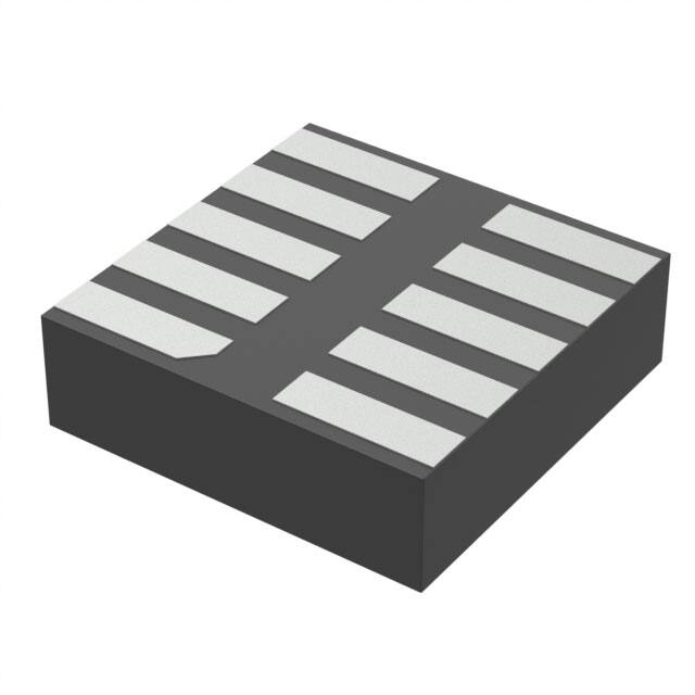

    DAC80502 双通道、1LSB INL、16 位、SPI 电压输出数模转换器 (DAC)
DAC80502DRXT 数据手册
Order Now Product Folder Support & Community Tools & Software Technical Documents DAC80502, DAC70502, DAC60502 SBAS793A – NOVEMBER 2019 – REVISED APRIL 2020 DACx0502, Dual, 16-Bit, 14-Bit, and 12-Bit, 1-LSB INL, Voltage-Output DACs With Precision Internal Reference 1 Features 3 Description • • • • • • The 16-bit DAC80502, 14-bit DAC70502, and 12-bit DAC60502 (DACx0502) digital-to-analog converters (DACs) are highly accurate, low-power devices with voltage output. 1 • • • • • 16-bit performance: 1-LSB INL and DNL (max) Low glitch energy: 4 nV-s Wide power supply: 2.7 V to 5.5 V Buffered output range: 5 V, 2.5 V, or 1.25 V Low power: 1 mA per channel at 5.5 V Integrated 5-ppm/˚C (max), 2.5-V precision reference Pin-selectable serial interface – 3-wire, SPI compatible up to 50-MHz – 2-wire, I2C compatible Power-on-reset: zero scale or midscale 1.62-V VIH with VDD = 5.5 V Temperature range: –40˚C to +125˚C Package: Tiny 10-pin WSON The DACx0502 offer linearity of < 1 LSB. The high accuracy combined with tiny package make the DACx0502 an excellent choice for applications such as gain and offset calibration, current or voltage set point generation, and power-supply control. These devices include a 2.5-V, 5-ppm/°C internal reference, giving full-scale output voltage ranges of 1.25 V, 2.5 V, or 5 V. The DACx0502 incorporate a poweron-reset circuit that makes sure the DAC output powers up at zero scale or midscale based on the status of RSTSEL pin, and remains at that scale until a valid code is written to the device. The digital interface of the DACx0502 can be configured to SPI or I2C mode using the SPI2C pin. In SPI mode, the DACx0502 use a versatile 3-wire serial interface that operates at clock rates up to 50 MHz. In I2C mode, the DACx0502 operate in standard (100 kbps), fast (400 kbps), and fast+ (1.0 Mbps) modes. 2 Applications • • • • • • • • • Oscilloscope (DSO) Battery test Semiconductor test Data acquisition (DAQ) LCD test Small cell base station Analog output module Process analytics (pH, gas, concentration, force and humidity) DC power supply, ac source, electronic load Device Information(1) PART NUMBER PACKAGE BODY SIZE (NOM) DAC80502 DAC70502 WSON (10) 2.50 mm × 2.50 mm DAC60502 (1) For all available packages, see the package option addendum at the end of the data sheet. Functional Block Diagram VREFIO VDD Internal Reference SCLK or SCL SDIN or SDA SYNC or A0 Interface Logic SPI2C DAC Buffer DAC Register DAC BUF VOUTA Channel A VOUTB Channel B RSTSEL Power On Reset Power Down Logic Resistive Network AGND 1 An IMPORTANT NOTICE at the end of this data sheet addresses availability, warranty, changes, use in safety-critical applications, intellectual property matters and other important disclaimers. PRODUCTION DATA. DAC80502, DAC70502, DAC60502 SBAS793A – NOVEMBER 2019 – REVISED APRIL 2020 www.ti.com Table of Contents 1 2 3 4 5 6 7 Features .................................................................. Applications ........................................................... Description ............................................................. Revision History..................................................... Device Comparison Table..................................... Pin Configuration and Functions ......................... Specifications......................................................... 7.1 7.2 7.3 7.4 7.5 7.6 7.7 7.8 7.9 7.10 8 1 1 1 2 3 3 4 Absolute Maximum Ratings ...................................... 4 ESD Ratings.............................................................. 4 Recommended Operating Conditions....................... 4 Thermal Information .................................................. 5 Electrical Characteristics........................................... 5 Timing Requirements : SPI Mode ............................. 9 Timing Requirements : I2C Standard Mode .............. 9 Timing Requirements : I2C Fast Mode...................... 9 Timing Requirements : I2C Fast-Mode Plus ........... 10 Typical Characteristics .......................................... 11 Detailed Description ............................................ 20 8.1 8.2 8.3 8.4 Overview ................................................................. Functional Block Diagram ....................................... Feature Description................................................. Device Functional Modes........................................ 20 20 20 22 8.5 Programming........................................................... 23 8.6 Register Maps ......................................................... 29 9 Application and Implementation ........................ 34 9.1 9.2 9.3 9.4 9.5 Application Information............................................ Typical Application .................................................. System Examples .................................................. What To Do and What Not To Do........................... Initialization Setup ................................................... 34 34 36 37 37 10 Power Supply Recommendations ..................... 38 11 Layout................................................................... 38 11.1 Layout Guidelines ................................................. 38 11.2 Layout Example .................................................... 38 12 Device and Documentation Support ................. 39 12.1 12.2 12.3 12.4 12.5 12.6 12.7 Documentation Support ........................................ Related Links ........................................................ Receiving Notification of Documentation Updates Support Resources ............................................... Trademarks ........................................................... Electrostatic Discharge Caution ............................ Glossary ................................................................ 39 39 39 39 39 39 39 13 Mechanical, Packaging, and Orderable Information ........................................................... 39 4 Revision History Changes from Original (November 2019) to Revision A • 2 Page Changed devices from advanced information (preview) to production data (active) ............................................................. 1 Submit Documentation Feedback Copyright © 2019–2020, Texas Instruments Incorporated Product Folder Links: DAC80502 DAC70502 DAC60502 DAC80502, DAC70502, DAC60502 www.ti.com SBAS793A – NOVEMBER 2019 – REVISED APRIL 2020 5 Device Comparison Table DEVICE RESOLUTION REFERENCE DAC80502 16-bit Internal (default) or external DAC70502 14-bit Internal (default) or external DAC60502 12-bit Internal (default) or external 6 Pin Configuration and Functions DRX Package 10-Pin WSON Top View VDD 1 10 VREFIO VOUTA 2 9 VOUTB RSTSEL 3 8 SDIN/SDA AGND 4 7 SYNC/A0 SPI2C 5 6 SCLK/SCL Not to scale Pin Functions PIN TYPE DESCRIPTION NAME NO. AGND 4 Ground RSTSEL 3 Input Reset select pin. DACs power up to zero scale if RSTSEL = AGND. DACs power up to midscale if RSTSEL = VDD SCLK/SCL 6 Input Serial interface clock. SPI or I2C mode. SDIN/SDA 8 Input/Output SPI2C 5 Input Interface select pin. The SPI2C pin must be kept static after device powers up. If SPI2C = 0, the digital interface is in SPI mode If SPI2C = 1, the digital interface is in I2C mode SYNC/A0 7 Input SPI mode: Active low serial data enable. This input is the frame-synchronization signal for the serial data. When the signal goes low, the serial interface input shift register is enabled. I2C mode: Four-state address input. VDD 1 Power Analog supply voltage (2.7 V to 5.5 V) VOUTA 2 Output Analog output voltage from DAC A VOUTB 9 Output Analog output voltage from DAC B VREFIO 10 Input/Output Ground reference point for all circuitry on the device SPI mode: Serial interface data input. Data are clocked into the input shift register on each falling edge of the SCLK pin. I2C mode: Data are clocked into or out of the input register. This pin is a bidirectional, SDA drain data line that must be connected to the supply voltage with an external pull-up resistor. When using the internal reference, this pin is the reference output voltage pin (default). When operating with an external reference, this pin is the reference input to the device. Copyright © 2019–2020, Texas Instruments Incorporated Product Folder Links: DAC80502 DAC70502 DAC60502 Submit Documentation Feedback 3 DAC80502, DAC70502, DAC60502 SBAS793A – NOVEMBER 2019 – REVISED APRIL 2020 www.ti.com 7 Specifications 7.1 Absolute Maximum Ratings over operating free-air temperature range (unless otherwise noted) (1) MIN MAX VDD to AGND –0.3 6 VREFIO to AGND –0.3 VDD + 0.3 Digital input(s) to AGND –0.3 VDD + 0.3 Output voltage VOUTx to AGND –0.3 VDD + 0.3 Input current Current into any pin –10 10 Junction temperature (TJ) –40 150 Storage temperature (Tstg) –65 150 Input voltage Temperature (1) UNIT V V mA °C Stresses beyond those listed under Absolute Maximum Ratings may cause permanent damage to the device. These are stress ratings only, which do not imply functional operation of the device at these or any other conditions beyond those indicated under Recommended Operating Conditions. Exposure to absolute-maximum-rated conditions for extended periods may affect device reliability. 7.2 ESD Ratings VALUE V(ESD) (1) (2) Electrostatic discharge Human body model (HBM), per ANSI/ESDA/JEDEC JS001, all pins (1) ±2000 Charged device model (CDM), per JEDEC specification JESD22-C101, all pins (2) ±1000 UNIT V JEDEC document JEP155 states that 500-V HBM allows safe manufacturing with a standard ESD control process. JEDEC document JEP157 states that 250-V CDM allows safe manufacturing with a standard ESD control process. 7.3 Recommended Operating Conditions over operating free-air temperature range (unless otherwise noted) MIN NOM MAX UNIT POWER SUPPLY VDD to AGND Positive supply voltage to ground 2.7 5.5 V DIGITAL INPUTS VIH Input high voltage VIL Input low voltage 1.62 V 0.45 V REFERENCE INPUT VREFIO to AGND 2.7 V ≤ VDD < 3.3 V, reference divider disabled (REF-DIV bit = 0) 1.2 0.5 × (VDD – 0.2) V VREFIO to AGND 2.7 V ≤ VDD < 3.3 V, reference divider enabled (REF-DIV bit = 1) 2.4 (VDD – 0.2) V VREFIO to AGND 3.3 V ≤ VDD ≤ 5.5 V, reference divider disabled (REF-DIV bit = 0) 1.2 0.5 × VDD V VREFIO to AGND 3.3 V ≤ VDD ≤ 5.5 V, reference divider enabled (REF-DIV bit = 1) 2.4 VDD V Operating temperature –40 125 °C TEMPERATURE TA 4 Submit Documentation Feedback Copyright © 2019–2020, Texas Instruments Incorporated Product Folder Links: DAC80502 DAC70502 DAC60502 DAC80502, DAC70502, DAC60502 www.ti.com SBAS793A – NOVEMBER 2019 – REVISED APRIL 2020 7.4 Thermal Information DACx0502 THERMAL METRIC (1) DRX (WSON) UNIT 10 PINS RθJA Junction-to-ambient thermal resistance 99.7 °C/W RθJC(top) Junction-to-case (top) thermal resistance 49.9 °C/W RθJB Junction-to-board thermal resistance 35.9 °C/W ΨJT Junction-to-top characterization parameter 1.7 °C/W ΨJB Junction-to-board characterization parameter 35.7 °C/W (1) For more information about traditional and new thermal metrics, see the Semiconductor and IC Package Thermal Metrics application report. 7.5 Electrical Characteristics all minimum and maximum values at TA = –40°C to +125°C and all typcal values at TA = 25°C, 2.7 V ≤ VDD ≤ 5.5 V, external or internal VREFIO = 1.25 V to 5.5 V , RLOAD = 2 kΩ to AGND, CLOAD = 200 pF to AGND, and digital inputs at VDD or AGND (unless otherwise noted) PARAMETER TEST CONDITIONS MIN TYP MAX UNIT STATIC PERFORMANCE Resolution DAC80502 16 DAC70502 14 DAC60502 12 Bits INL Integral nonlinearity (1) –1 1 DNL Differential nonlinearity (1) –1 1 TUE Total unadjusted error (1) Zero code error (1) DAC loaded with zero scale code 0.04 0.1 %FSR –1.5 0.5 1.5 mV ±2 –1.5 Offset error temperature coefficient (1) –0.1 Gain error temperature coefficient (1) 1.5 0.04 –0.1 Full-scale error temperature coefficient (1) 0.04 ±2 mV µV/°C 0.1 %FSR ppm FSR/°C ±1 Full-scale error (1) (1) 0.5 µV/°C ±2 Gain error (1) LSB –0.1 Zero code error temperature coefficient (1) Offset error (1) LSB 0.1 %FSR ppm FSR/°C End point fit between code 256 to code 64,511 for 16-bit, code 64 to code 16,127 for 14-bit, code 16 to code 4031 for 12-bit, DAC output unloaded, performance under resistive and capacitive load conditions are specified by design and characterization, DAC output range ≥ 2.5 V. Copyright © 2019–2020, Texas Instruments Incorporated Product Folder Links: DAC80502 DAC70502 DAC60502 Submit Documentation Feedback 5 DAC80502, DAC70502, DAC60502 SBAS793A – NOVEMBER 2019 – REVISED APRIL 2020 www.ti.com Electrical Characteristics (continued) all minimum and maximum values at TA = –40°C to +125°C and all typcal values at TA = 25°C, 2.7 V ≤ VDD ≤ 5.5 V, external or internal VREFIO = 1.25 V to 5.5 V , RLOAD = 2 kΩ to AGND, CLOAD = 200 pF to AGND, and digital inputs at VDD or AGND (unless otherwise noted) PARAMETER TEST CONDITIONS MIN TYP MAX UNIT OUTPUT CHARACTERISTICS VO Output voltage BUFF-GAIN bit set to 1, REF-DIV bit set to 0 0 2× VREFIO BUFF-GAIN bit set to 1, REF-DIV bit set to 1 0 VREFIO 0 0.5 × VREFIO BUFF-GAIN bit set to 0, REF-DIV bit set to 1 RLOAD Resistive load (2) CLOAD Capacitive load (2) ZO VDD = 2.7 V 0.25 VDD = 5.5 V 0.5 kΩ RLOAD = infinite 2 RLOAD = 2 kΩ 10 Load regulation DAC at midscale, –10 mA ≤ IOUT ≤ 10 mA 80 Short circuit current Full scale output shorted to AGND (per channel) 30 Zero output shorted to VDD (per channel) 30 Output voltage headroom to VDD, DAC at full code, IOUT = 10 mA (sourcing) 0.3 Output voltage footroom to AGND, DAC at zero code, IOUT = 10 mA (sinking) 0.3 DC small signal output impedance DAC at code 256 10 Output voltage drift vs time mA V V 0.1 Power supply rejection ratio (DC) nF µV/mA 0.1 DAC at midscale DAC at code 65279 V Ω 10 DAC at midscale; VDD = 5 V ± 10% 0.15 TA = 35°C, VOUT = midscale, 1900 hr mV/V 20 ppm of FSR 100 kΩ 5 pF VOLTAGE REFERENCE INPUT ZVREFIO Reference input impedance (VREFIO) CVREFIO Reference input capacitance (VREFIO) VOLTAGE REFERENCE OUTPUT Output (initial accuracy) Output drift TA = 25°C 2.4975 5 DAC70502, DAC60502 10 Output impedance Output noise 0.1 Hz to 10 Hz Output noise density Measured at 10 kHz, reference load = 10 nF Load current Load regulation Sourcing and sinking Line regulation Output voltage drift vs time Thermal hysteresis (2) 6 2.5025 DAC80502 TA = 35°C, 1900 hr 1st cycle Additional cycle V ppm/℃ 0.1 Ω 14 µVPP 140 nV/√Hz ±5 mA 90 µV/mA 20 µV/V 20 µV 480 ppm 25 ppm Not production tested. Submit Documentation Feedback Copyright © 2019–2020, Texas Instruments Incorporated Product Folder Links: DAC80502 DAC70502 DAC60502 DAC80502, DAC70502, DAC60502 www.ti.com SBAS793A – NOVEMBER 2019 – REVISED APRIL 2020 Electrical Characteristics (continued) all minimum and maximum values at TA = –40°C to +125°C and all typcal values at TA = 25°C, 2.7 V ≤ VDD ≤ 5.5 V, external or internal VREFIO = 1.25 V to 5.5 V , RLOAD = 2 kΩ to AGND, CLOAD = 200 pF to AGND, and digital inputs at VDD or AGND (unless otherwise noted) PARAMETER TEST CONDITIONS MIN TYP MAX UNIT DYNAMIC PERFORMANCE Output voltage settling time (3) ts Vn 5 10-mV settling to ±2 LSB, VDD = 5.5 V, VREFIO = 2.5 V 3 Slew rate (3) VDD = 5.5 V, VREFIO = 2.5 V Power on glitch magnitude CLOAD = 50 pF Output noise (3) Vn ¼ to ¾ scale and ¾ to ¼ scale settling to ±2 LSB, VDD = 5.5 V, VREFIO = 2.5 V Output noise density µs 2 V/µs 200 mV 0.1 Hz to 10 Hz, DAC at midscale, VDD = 5.5 V, external VREFIO = 2.5 V 14 µVPP 100-kHz Bandwidth, DAC at midscale, VDD = 5.5 V, external VREFIO = 2.5 V 23 µVrms Measured at 1 kHz, DAC at midscale, VDD = 5.5 V, external VREFIO = 2.5 V, gain = 2X (BUFF-GAIN bit = 1) 78 Measured at 10 kHz, DAC at midscale, VDD = 5.5 V, external VREFIO = 2.5 V, gain = 2X (BUFF-GAIN bit = 1) 74 Measured at 1 kHz, DAC at full scale, VDD = 2.7 V, external VREFIO = 2.5 V, gain = 1X (BUFF-GAIN bit = 0) 55 Measured at 10 kHz, DAC at full scale, VDD = 2.7 V, external VREFIO = 2.5 V, gain = 1X (BUFF-GAIN bit = 0) 50 nV/√Hz SFDR Spurious free dynamic range 1-kHz sinusiod at DAC output, DAC updated at 500 kHz, include up to 7th harmonics, no filter on DAC output 70 dB THD Total harmonic distortion 1-kHz sinusiod at DAC output, DAC updated at 500 kHz, include up to 7th harmonics, no filter on DAC output 70 dB Power supply rejection ratio (ac) 200-mV, 50-Hz to 60-Hz sine wave on VDD, DAC at midscale. 85 dB Code change glitch impulse Midcode ±1 LSB (including feedthrough) 4 nV-s Code change glitch magnitude Midcode ±1 LSB (including feedthrough) gain = 1X (BUFF-GAIN bit = 0) 7.5 mV Channel to channel ac crosstalk Full scale swing on adjacent channel, measured channel at midscale 4 nV-s Channel to channel dc crosstalk Full scale swing on adjacent channel, measured channel at midscale 1 LSB Digital feedthrough At SCLK = 1 MHz, DAC output at midscale 4 nV-s DIGITAL INPUTS Hysteresis voltage 0.4 Input current Pin capacitance (3) –5 Per pin V 5 10 µA pF Output buffer in gain = 2X setting (BUFF-GAIN bit = 1). Copyright © 2019–2020, Texas Instruments Incorporated Product Folder Links: DAC80502 DAC70502 DAC60502 Submit Documentation Feedback 7 DAC80502, DAC70502, DAC60502 SBAS793A – NOVEMBER 2019 – REVISED APRIL 2020 www.ti.com Electrical Characteristics (continued) all minimum and maximum values at TA = –40°C to +125°C and all typcal values at TA = 25°C, 2.7 V ≤ VDD ≤ 5.5 V, external or internal VREFIO = 1.25 V to 5.5 V , RLOAD = 2 kΩ to AGND, CLOAD = 200 pF to AGND, and digital inputs at VDD or AGND (unless otherwise noted) PARAMETER TEST CONDITIONS MIN TYP MAX UNIT Normal mode, internal reference enabled, all DACs at full scale, SPI static 1.9 2.6 Normal mode, external reference = 2.5 V, all DACs at full scale, SPI static 1.5 1.9 All DACs and Internal reference power-down 15 µA 0-V to 5-V range, midscale code 25 µA POWER IVDD Current flowing into VDD IVREFIO Current flowing into VREFIO 8 Submit Documentation Feedback mA Copyright © 2019–2020, Texas Instruments Incorporated Product Folder Links: DAC80502 DAC70502 DAC60502 DAC80502, DAC70502, DAC60502 www.ti.com SBAS793A – NOVEMBER 2019 – REVISED APRIL 2020 7.6 Timing Requirements : SPI Mode all input signals are specified with tR = tF = 1 ns/V and timed from a voltage level of (VIL + VIH) / 2. 2.7 V ≤ VDD ≤ 5.5 V, VIH = 1.62 V, VIL = 0.15 V, VREFIO = 1.25 V to 5.5 V, and TA = –40°C to +125°C (unless otherwise noted) MIN NOM MAX UNIT 50 MHz fSCLK SCLK frequency tSCLKHIGH SCLK high time 9 ns tSCLKLOW SCLK low time 9 ns tSDIS SDIN setup 5 ns tSDIH SDIN hold 10 ns tSYNCS SYNC falling edge to SCLK falling edge setup 13 ns tSYNCH SCLK falling edge to SYNC rising edge 10 ns tSYNCHIGH SYNC high time 160 ns tSYNCIGNORE SCLK falling edge to SYNC ignore 15 ns tDACWAIT Sequential DAC update wait time 1 µs 7.7 Timing Requirements : I2C Standard Mode all input signals are specified with tR = tF = 1 ns/V and timed from a voltage level of (VIL + VIH) / 2. 2.7 V ≤ VDD ≤ 5.5 V, VIH = 1.62 V, VIL = 0.45 V, VREFIO = 1.25 V to 5.5 V, and TA = – 40°C to +125°C (unless otherwise noted) MIN NOM MAX UNIT 0.1 MHz fSCLK SCL frequency tBUF Bus free time between stop and start conditions tHDSTA Hold time after repeated start tSUSTA Repeated start setup time tSUSTO Stop condition setup time 4 µs tHDDAT Data hold time tSUDAT Data setup time tLOW 4.7 µs 4 µs 4.7 µs 0 ns 250 ns SCL clock low period 4700 ns tHIGH SCL clock high period 4000 tR Clock and data fall time 300 tF Clock and data rise time 1000 tUPDATE Sequential DAC update wait time ns ns ns 1 µs 7.8 Timing Requirements : I2C Fast Mode all input signals are specified with tR = tF = 1 ns/V and timed from a voltage level of (VIL + VIH) / 2. 2.7 V ≤ VDD ≤ 5.5 V, VIH = 1.62 V, VIL = 0.45 V, VREFIO = 1.25 V to 5.5 V, and TA = – 40°C to +125°C (unless otherwise noted) MIN NOM MAX UNIT 0.4 MHz fSCLK SCL frequency tBUF Bus free time between stop and start conditions 1.3 µs tHDSTA Hold time after repeated start 0.6 µs tSUSTA Repeated start setup time 0.6 µs tSUSTO Stop condition setup time 0.6 µs tHDDAT Data hold time 0 ns tSUDAT Data setup time 100 ns tLOW SCL clock low period 1300 ns tHIGH SCL clock high period 600 tR Clock and data fall time 300 ns tF Clock and data rise time 300 ns tUPDATE Sequential DAC update wait time Copyright © 2019–2020, Texas Instruments Incorporated Product Folder Links: DAC80502 DAC70502 DAC60502 ns 1 Submit Documentation Feedback µs 9 DAC80502, DAC70502, DAC60502 SBAS793A – NOVEMBER 2019 – REVISED APRIL 2020 www.ti.com 7.9 Timing Requirements : I2C Fast-Mode Plus all input signals are specified with tR = tF = 1 ns/V and timed from a voltage level of (VIL + VIH) / 2. 2.7 V ≤ VDD ≤ 5.5 V, VIH = 1.62 V, VIL = 0.45 V, VREFIO = 1.25 V to 5.5 V, and TA = – 40°C to +125°C (unless otherwise noted) MIN fSCLK SCL frequency tBUF Bus free time between stop and start conditions tHDSTA NOM MAX UNIT 1 MHz 0.5 µs Hold time after repeated start 0.26 µs tSUSTA Repeated start setup time 0.26 µs tSUSTO Stop condition setup time 0.26 µs tHDDAT Data hold time 0 ns tSUDAT Data setup time 50 ns tLOW SCL clock low period 500 ns tHIGH SCL clock high period 260 tR Clock and data fall time tF Clock and data rise time tUPDATE Sequential DAC update wait time ns 120 120 1 ns ns µs tSYNC HIGH tSYNC H tSYNC S SYNC tSYNC IGN OR E tSCL KLOW SCLK tSCL KHIGH SDIN Bit 23 tSDIS Bit 1 Bit 0 tSDIH Figure 1. SPI Mode Timing Low byte ACK cycle tLOW tR tF SCL tHD STA tHIGH tHD DAT tSUSTA tSUSTO tSUD AT tHD STA SDA tBUF P S S P Figure 2. I2C Mode Timing 10 Submit Documentation Feedback Copyright © 2019–2020, Texas Instruments Incorporated Product Folder Links: DAC80502 DAC70502 DAC60502 DAC80502, DAC70502, DAC60502 www.ti.com SBAS793A – NOVEMBER 2019 – REVISED APRIL 2020 7.10 Typical Characteristics at TA = 25°C, VDD = 5.5 V, internal reference = 2.5 V, REF-DIV = 0 and BUFF-GAIN = 1, channel A shown, and DAC outputs unloaded (unless otherwise noted) 1 1 DACA Unloaded DACA 5 k: || 200 pF DACB Unloaded DACB 5 k: || 200 pF 0.6 0.4 0.2 0 -0.2 -0.4 -0.6 -0.8 0.4 0.2 0 -0.2 -0.4 -0.6 -1 0 8192 16384 24576 32768 40960 49152 57344 65536 Code D001 0 Figure 3. Integral Linearity Error vs Digital Input Code 8192 16384 24576 32768 40960 49152 57344 65536 Code D002 Figure 4. Differential Linearity Error vs Digital Input Code 0.08 1 DACA Unloaded DACA 5 k: || 200 pF DACB Unloaded DACB 5 k: || 200 pF 0.06 0.04 INL Max, Unloaded INL Min, Unloaded INL Max, 5 k: || 200 pF INL Min, 5 k: || 200 pF 0.75 Integral Linearity Error (LSB) Total Unadjusted Error (%FSR) 0.6 -0.8 -1 0.02 0 -0.02 -0.04 0.5 0.25 0 -0.25 -0.5 -0.75 -0.06 -1 -40 -0.08 0 8192 16384 24576 32768 40960 49152 57344 65536 Code D003 -10 5 20 35 50 65 Temperature (oC) 80 95 110 125 D004 0.08 1 0.5 Total Unadjusted Error (%FSR) DNL Max, Unloaded DNL Min, Unloaded DNL Max, 5 k: || 200 pF DNL Min, 5 k: || 200 pF 0.75 0.25 0 -0.25 -0.5 -0.75 -1 -40 -25 Figure 6. Integral Linearity Error vs Temperature Figure 5. Total Unadjusted Error vs Digital Input Code Differential Linearity Error (LSB) DACA Unloaded DACA 5 k: || 200 pF DACB Unloaded DACB 5 k: || 200 pF 0.8 Differential Linearity Error (LSB) Integral Linearity Error (LSB) 0.8 -25 -10 5 20 35 50 65 Temperature (oC) 80 95 110 125 Unloaded 5 k: || 200 pF 0.06 0.04 0.02 0 -0.02 -0.04 -0.06 -0.08 -40 -25 -10 5 D005 Figure 7. Differential Linearity Error vs Temperature 20 35 50 65 Temperature (oC) 80 95 110 125 D006 Figure 8. Total Unadjusted Error vs Temperature Copyright © 2019–2020, Texas Instruments Incorporated Product Folder Links: DAC80502 DAC70502 DAC60502 Submit Documentation Feedback 11 DAC80502, DAC70502, DAC60502 SBAS793A – NOVEMBER 2019 – REVISED APRIL 2020 www.ti.com Typical Characteristics (continued) 1.5 1.5 1.25 1 Offset Error (mV) Zero-Code Error (mV) at TA = 25°C, VDD = 5.5 V, internal reference = 2.5 V, REF-DIV = 0 and BUFF-GAIN = 1, channel A shown, and DAC outputs unloaded (unless otherwise noted) 1 0.75 0.5 0.25 0 -40 0.5 0 -0.5 -1 -25 -10 5 20 35 50 65 Temperature (oC) 80 95 -1.5 -40 110 125 80 95 110 125 D008 Unloaded 5 k: || 200 pF 0.04 0.04 Gain Error (%FSR) Full-Scale Error (%FSR) 20 35 50 65 Temperature (oC) 0.06 0.02 0 -0.02 0.02 0 -0.02 -0.04 -0.04 -0.06 -0.06 -25 -10 5 20 35 50 65 Temperature (oC) 80 95 -0.08 -40 110 125 -25 -10 5 D009 Data Figure 11. Full-Scale Error vs Temperature 20 35 50 65 Temperature (oC) 80 95 110 125 D010 Figure 12. Gain Error vs Temperature 1 1 Differential Linearity Error (LSB) Max INL Min INL 0.75 Integral Linearity Error (LSB) 5 0.08 Unloaded 5 k: || 200 pF 0.06 0.5 0.25 0 -0.25 -0.5 -0.75 3.1 3.5 3.9 4.3 4.7 Supply Voltage, VDD (V) 5.1 5.5 D011 REF-DIV = 0 and BUFF-GAIN = 0 Figure 13. Integral Linearity Error vs Supply Voltage 12 -10 Figure 10. Offset Error vs Temperature 0.08 -1 2.7 -25 D007 Figure 9. Zero-Code Error vs Temperature -0.08 -40 Unloaded 5 k: || 200 pF Submit Documentation Feedback Max DNL Min DNL 0.75 0.5 0.25 0 -0.25 -0.5 -0.75 -1 2.7 3.1 3.5 3.9 4.3 4.7 Supply Voltage, VDD (V) 5.1 5.5 D012 REF-DIV = 0 and BUFF-GAIN = 0 Figure 14. Differential Linearity Error vs Supply Voltage Copyright © 2019–2020, Texas Instruments Incorporated Product Folder Links: DAC80502 DAC70502 DAC60502 DAC80502, DAC70502, DAC60502 www.ti.com SBAS793A – NOVEMBER 2019 – REVISED APRIL 2020 Typical Characteristics (continued) at TA = 25°C, VDD = 5.5 V, internal reference = 2.5 V, REF-DIV = 0 and BUFF-GAIN = 1, channel A shown, and DAC outputs unloaded (unless otherwise noted) 1.5 REF-DIV = 1, BUFF-GAIN = 1 REF-DIV = 0, BUFF-GAIN = 0 0.06 0.04 0.02 0 -0.02 -0.04 0.5 0 -0.5 -1 -0.06 -0.08 2.7 REF-DIV = 1, BUFF-GAIN = 1 REF-DIV = 0, BUFF-GAIN = 0 1 Zero-Code Error (mV) Total Unadjusted Error (%FSR) 0.08 3.1 3.5 3.9 4.3 4.7 Supply Voltage, VDD (V) 5.1 -1.5 2.7 5.5 3.1 3.5 3.9 4.3 4.7 Supply Voltage, VDD (V) D013 Figure 15. Total Unadjusted Error vs Supply Voltage 5.1 5.5 D014 Figure 16. Zero-Code Error vs Supply Voltage 0.08 1.5 REF-DIV = 1, BUFF-GAIN = 1 REF-DIV = 0, BUFF-GAIN = 0 1 REF-DIV = 1, BUFF-GAIN = 1 REF-DIV = 0, BUFF-GAIN = 0 0.06 Gain Error (%FSR) Offset Error (mV) 0.04 0.5 0 -0.5 0.02 0 -0.02 -0.04 -1 -1.5 2.7 -0.06 3.1 3.5 3.9 4.3 4.7 Supply Voltage, VDD (V) 5.1 -0.08 2.7 5.5 Figure 17. Offset Error vs Supply Voltage 5.1 5.5 D016 1 REF-DIV = 1, BUFF-GAIN = 1 REF-DIV = 0, BUFF-GAIN = 0 Max, REFDIV = 0 Max, REFDIV = 1 Min, REFDIV = 0 Min, REFDIV = 1 0.75 Integral Linearity Error (LSB) 0.06 Full-Scale Error (%FSR) 3.5 3.9 4.3 4.7 Supply Voltage, VDD (V) Figure 18. Gain Error vs Supply Voltage 0.08 0.04 0.02 0 -0.02 -0.04 -0.06 -0.08 2.7 3.1 D015 0.5 0.25 0 -0.25 -0.5 -0.75 3.1 3.5 3.9 4.3 4.7 Supply Voltage, VDD (V) 5.1 Figure 19. Full-Scale Error vs Supply Voltage 5.5 D017 -1 1.25 2 2.75 3.5 4.25 Supply Volltage, VREFIN (V) 5 5.5 D018 Figure 20. Integral Linearity Error vs Reference Voltage Copyright © 2019–2020, Texas Instruments Incorporated Product Folder Links: DAC80502 DAC70502 DAC60502 Submit Documentation Feedback 13 DAC80502, DAC70502, DAC60502 SBAS793A – NOVEMBER 2019 – REVISED APRIL 2020 www.ti.com Typical Characteristics (continued) at TA = 25°C, VDD = 5.5 V, internal reference = 2.5 V, REF-DIV = 0 and BUFF-GAIN = 1, channel A shown, and DAC outputs unloaded (unless otherwise noted) 0.08 Max, REFDIV = 0 Max, REFDIV = 1 Min, REFDIV = 0 Min, REFDIV = 1 0.75 0.5 Total Unadjusted Error (%FSR) Differential Linearity Error (LSB) 1 0.25 0 -0.25 -0.5 -0.75 -1 1.25 2 2.75 3.5 4.25 Supply Volltage, VREFIN (V) 5 0.04 0.02 0 -0.02 -0.04 -0.06 -0.08 1.25 5.5 5 5.5 D020 1.5 REF-DIV = 0, BUFF-GAIN = 0 REF-DIV = 1, BUFF-GAIN = 1 1 REF-DIV = 0, BUFF-GAIN = 0 REF-DIV = 1, BUFF-GAIN = 1 Offset Error (mV) 1 0.5 0 -0.5 -1 0.5 0 -0.5 -1 -1.5 1.25 2 2.75 3.5 4.25 Supply Volltage, VREFIN (V) 5 -1.5 1.25 5.5 Figure 23. Zero-Code Error vs Reference Voltage 2.75 3.5 4.25 Supply Volltage, VREFIN (V) 5 5.5 D022 Figure 24. Offset Error vs Reference Voltage 0.08 REF-DIV = 0, BUFF-GAIN = 0 REF-DIV = 1, BUFF-GAIN = 1 REF-DIV = 0, BUFF-GAIN = 0 REF-DIV = 1, BUFF-GAIN = 1 0.06 Full-Scale Error (%FSR) 0.06 0.04 0.02 0 -0.02 -0.04 -0.06 -0.08 1.25 2 D021 0.08 Gain Error (%FSR) 2.75 3.5 4.25 Supply Volltage, VREFIN (V) Figure 22. Total Unadjusted Error vs Reference Voltage 1.5 0.04 0.02 0 -0.02 -0.04 -0.06 2 2.75 3.5 4.25 Supply Volltage, VREFIN (V) 5 Figure 25. Gain Error vs Reference Voltage 14 2 D019 Figure 21. Differential Linearity Error vs Reference Voltage Zero-Code Error (mV) REFDIV = 0 REFDIV = 1 0.06 Submit Documentation Feedback 5.5 D023 -0.08 1.25 2 2.75 3.5 4.25 Supply Volltage, VREFIN (V) 5 5.5 D024 Figure 26. Full-Scale Error vs Reference Voltage Copyright © 2019–2020, Texas Instruments Incorporated Product Folder Links: DAC80502 DAC70502 DAC60502 DAC80502, DAC70502, DAC60502 www.ti.com SBAS793A – NOVEMBER 2019 – REVISED APRIL 2020 Typical Characteristics (continued) 2 2 1.75 1.75 Supply Current, IVDD (mA) Supply Current, IVDD (mA) at TA = 25°C, VDD = 5.5 V, internal reference = 2.5 V, REF-DIV = 0 and BUFF-GAIN = 1, channel A shown, and DAC outputs unloaded (unless otherwise noted) 1.5 1.25 1 0.75 0.5 Internal Reference, BUFF-GAIN = 0 Internal Reference, BUFF-GAIN = 1 External Reference, BUFF-GAIN = 0 External Reference, BUFF-GAIN = 1 0.25 1.25 1 0.75 0.5 Internal Reference, BUFF-GAIN = 0 Internal Reference, BUFF-GAIN = 1 External Reference, BUFF-GAIN = 0 External Reference, BUFF-GAIN = 1 0.25 0 0 1.5 0 -40 8192 16384 24576 32768 40960 49152 57344 65536 Code D025 -25 -10 5 20 35 50 65 Temperature (qC) 80 95 110 125 D026 DAC code at midscale Figure 27. Supply Current vs Digital Input Code Figure 28. Supply Current vs Temperature 3 12 Supply Current, IVDD (mA) 2.5 Power-Down Current, IVDD (PA) Internal Reference, BUFF-GAIN = 0 Internal Reference, BUFF-GAIN = 1 External Reference, BUFF-GAIN = 0 External Reference, BUFF-GAIN = 1 2 1.5 1 0.5 0 2.7 3.1 3.5 3.9 4.3 4.7 Supply Voltage, VDD (V) 5.1 10 8 6 4 2 0 -40 5.5 DAC code at midscale -10 5 20 35 50 65 Temperature (qC) 80 95 110 125 D028 REF-DIV = 0 and BUFF-GAIN = 0 Figure 29. Supply Current vs Supply Voltage Figure 30. Power-Down Current vs Temperature 15 2.5 12 Sourcing, VDD = 2.7, REF-DIV = 1, BUFF-GAIN = 1 Sourcing, VDD = 5.5, REF-DIV = 0, BUFF-GAIN = 0 Sinking VDD = 2.7,REF-DIV = 1, BUFF-GAIN = 1 Sinking VDD = 5.5, REF-DIV = 0, BUFF-GAIN = 0 2 DAC Output (V) Power-Down Current, IVDD (PA) -25 D027 9 6 3 1.5 1 0.5 0 2.7 0 3.1 3.5 3.9 4.3 4.7 Supply Voltage, VDD (V) 5.1 5.5 0 5 10 15 Load Current (mA) D029 External reference = 2.5 V, REF-DIV = 1 and BUFF-GAIN = 0 Figure 31. Power Down Current vs Supply Voltage 20 25 D030 External reference = 2.5 V Figure 32. Headroom and Footroom vs Load Current Copyright © 2019–2020, Texas Instruments Incorporated Product Folder Links: DAC80502 DAC70502 DAC60502 Submit Documentation Feedback 15 DAC80502, DAC70502, DAC60502 SBAS793A – NOVEMBER 2019 – REVISED APRIL 2020 www.ti.com Typical Characteristics (continued) at TA = 25°C, VDD = 5.5 V, internal reference = 2.5 V, REF-DIV = 0 and BUFF-GAIN = 1, channel A shown, and DAC outputs unloaded (unless otherwise noted) 8 7 0xFFFF 0xC000 0x8000 0x4000 0x0 DAC Output (V) 5 0xFFFF 0xC000 0x8000 7 6 DAC Output (V) 6 4 3 2 1 0x4000 0x0 5 4 3 2 1 0 0 -1 -50 -40 -30 -20 -10 0 10 20 Load Current (mA) 30 40 50 -1 -50 -40 -30 -20 D031 REF-DIV = 0 and BUFF-GAIN = 0 -10 0 10 20 Load Current (mA) 30 40 50 D032 REF-DIV = 0 and BUFF-GAIN = 1 Figure 33. Source and Sink Capability Figure 34. Source and Sink Capability 7 0xFFFF 0xC000 0x8000 0x4000 0x0 6 DAC Output (V) 5 4 3 3 nV-s 2 1 VOUT (2.5 mV/div) CS (5 V/div) 0 -1 -50 -40 -30 -20 -10 0 10 20 Load Current (mA) 30 40 50 Time (0.5 Ps/div) D034 D033 DAC code transition from midscale – 1 to midscale LSB, REF-DIV = 0 and BUFF-GAIN = 0 REF-DIV = 1 and BUFF-GAIN = 0 Figure 36. Glitch Impulse, Rising Edge, 1-LSB Step Figure 35. Source and Sink Capability Small Singal VOUT (3 LSB/div) Large Singal VOUT (2 V/div) CS (5 V/div) 2 nV-s VOUT (2.5mV/div) CS (5 V/div) Time (0.5 Ps/div) Time (2 Ps/div) D035 DAC code transition from midscale to midscale – 1 LSB, REF-DIV = 0 and BUFF-GAIN = 0 Figure 37. Glitch Impulse, Falling Edge, 1-LSB Step 16 Submit Documentation Feedback D036 REF-DIV = 0 and BUFF-GAIN = 0 Figure 38. Full-Scale Settling Time, Rising Edge Copyright © 2019–2020, Texas Instruments Incorporated Product Folder Links: DAC80502 DAC70502 DAC60502 DAC80502, DAC70502, DAC60502 www.ti.com SBAS793A – NOVEMBER 2019 – REVISED APRIL 2020 Typical Characteristics (continued) at TA = 25°C, VDD = 5.5 V, internal reference = 2.5 V, REF-DIV = 0 and BUFF-GAIN = 1, channel A shown, and DAC outputs unloaded (unless otherwise noted) Small Singal VOUT (3 LSB/div) Large Singal VOUT (2 V/div) CS (5 V/div) VDD (2 V/div) DAC Output (40 mV/div) Time (2 Ps/div) Time (1 ms/div) D037 D038 REF-DIV = 0 and BUFF-GAIN = 0 REF-DIV = 0 and BUFF-GAIN = 0 Figure 39. Full-Scale Settling Time, Falling Edge Figure 40. Power-On Glitch 0 VDD (2 V/div) DAC Output (40 mV/div) -10 -20 AC PSRR (dB) -30 -40 -50 -60 -70 -80 -90 -100 -110 -120 1 Time (1 ms/div) 10 100 1000 Frequency (Hz) D039 10000 100000 D040 DAC code at midscale, VDD = 5.0 V + 0.2 VPP, REF-DIV = 0 and BUFF-GAIN = 0 REF-DIV = 0 and BUFF-GAIN = 0 Figure 42. DAC Output AC PSRR vs Frequency Figure 41. Power-Off Glitch 20 300 0 DAC Code = 0x0 DAC Code = 0x8000 DAC Code = 0xFFFF 250 Noise (nV/—Hz) Noise (dB) -20 -40 -60 -80 200 150 100 -100 50 -120 -140 0 4000 8000 12000 Frequency (Hz) 16000 20000 D041 fo = 1 kHz, fs = 400 kHz, includes 7 harmonics, measurement bandwidth = 20 kHz, external reference = 2.5 V, REF-DIV = 0 and BUFF-GAIN = 0 Figure 43. DAC Output THD+N vs Frequency 0 10 2030 50 100 200 5001000 Frequency (Hz) 10000 100000 D042 Gain = 1X (REF-DIV = 1 and BUFF-GAIN = 1), external reference = 2.5 V, REF-DIV = 0 and BUFF-GAIN = 0 Figure 44. DAC Output Noise Spectral Density Copyright © 2019–2020, Texas Instruments Incorporated Product Folder Links: DAC80502 DAC70502 DAC60502 Submit Documentation Feedback 17 DAC80502, DAC70502, DAC60502 SBAS793A – NOVEMBER 2019 – REVISED APRIL 2020 www.ti.com Typical Characteristics (continued) DAC Output Noise (2 PV/div) DAC Output Noise (2 PV/div) at TA = 25°C, VDD = 5.5 V, internal reference = 2.5 V, REF-DIV = 0 and BUFF-GAIN = 1, channel A shown, and DAC outputs unloaded (unless otherwise noted) D043 D044 DAC code at midscale, external reference = 2.5 V, REF-DIV = 0 and BUFF-GAIN = 0 DAC code at midscale, internal reference = 2.5 V, REF-DIV = 0 and BUFF-GAIN = 0 Figure 45. DAC Output Noise: 0.1 Hz to 10 Hz Figure 46. DAC Output Noise: 0.1 Hz to 10 Hz 2.505 Internal Reference Voltage (V) SCLK (5 V/div) VOUT (1 mV/div) 2.5025 2.5 2.4975 2.495 -40 Time (5 Ps/div) -25 -10 5 D045 SCLK = 1 MHz, DAC code at midscale, external reference = 2.5 V, REF-DIV = 0 and BUFF-GAIN = 0 20 35 50 65 Temperature (oC) 80 95 110 125 D046 30 units Figure 47. Clock Feedthrough Figure 48. Internal Reference Voltage vs Temperature 100 2.505 2.5025 Reference Drift (ppm) Internal Reference Voltage (V) 75 2.5 2.4975 50 25 0 -25 -50 -75 2.495 2.7 -100 3.1 3.5 3.9 4.3 4.7 Supply Voltage, VDD (V) 5.1 5.5 Figure 49. Internal Reference Voltage vs Supply Voltage 18 Submit Documentation Feedback 0 200 400 D047 600 800 Time (Hours) 1000 1200 D048 Figure 50. Internal Reference Voltage vs Time Copyright © 2019–2020, Texas Instruments Incorporated Product Folder Links: DAC80502 DAC70502 DAC60502 DAC80502, DAC70502, DAC60502 www.ti.com SBAS793A – NOVEMBER 2019 – REVISED APRIL 2020 Typical Characteristics (continued) at TA = 25°C, VDD = 5.5 V, internal reference = 2.5 V, REF-DIV = 0 and BUFF-GAIN = 1, channel A shown, and DAC outputs unloaded (unless otherwise noted) Internal Reference Noise (2 PV/div) 800 700 Noise (nV/—Hz) 600 500 400 300 200 100 0 10 2030 50 100 200 500 1000 Frequency (Hz) 10000 100000 D050 D049 Figure 52. Internal Reference Noise: 0.1 Hz to 10 Hz Figure 51. Internal Reference Noise Density vs Frequency 55 100% 50 90% 45 80% Percentage of Units Number of Units 40 35 30 25 20 15 Presolder Heat Reflow Postsolder Heat Reflow 70% 60% 50% 40% 30% 10 20% 5 10% 0 0 0 1 2 3 4 Temperature Drift (ppm/qC) 5 2.4975 2.4980 2.4985 2.4990 2.4995 2.5000 2.5005 2.5010 VREFOUT (V) D051 Percentage of Units Figure 53. Internal Reference Temperature Drift Histogram D053 Figure 54. Internal Reference Initial Accuracy (Pre- and Post-Solder) Histogram 28% 26% 24% 22% 20% 18% 16% 14% 12% 10% 8% 6% 4% 2% 0 -3 -2.5 -2 -1.5 -1 -0.5 0 0.5 1 1.5 VREFOUT Drift Delta (ppm/qC) 2 2.5 3 D054 Figure 55. Internal Reference Temperature Drift (Pre-Solder and Post-Solder) Histogram Copyright © 2019–2020, Texas Instruments Incorporated Product Folder Links: DAC80502 DAC70502 DAC60502 Submit Documentation Feedback 19 DAC80502, DAC70502, DAC60502 SBAS793A – NOVEMBER 2019 – REVISED APRIL 2020 www.ti.com 8 Detailed Description 8.1 Overview The DAC80502, DAC70502, DAC60502 (DACx0502) family of devices are dual-channel, buffered voltage output, 16-bit, 14-bit, or 12-bit digital-to-analog converters (DACs), respectively. These devices include a 2.5-V, 5ppm/˚C internal reference, giving full-scale output voltage ranges of 1.25 V, 2.5 V, or 5 V. The DACx0502 devices incorporate a power-on-reset circuit that makes sure that the DAC output powers up at zero scale or midscale, depending on status of the RSTSEL pin, and remains at that scale until a valid code is written to the device. The digital interface of the DACx0502 can be configured to SPI or I2C mode using the SPI2C pin. In SPI mode, the DACx0502 family uses a 3-wire serial interface that operates at clock rates up to 50 MHz. In I2C mode, the DACx0502 devices operate in standard (100 kbps), fast (400 kbps), and fast+ (1.0 Mbps) modes. 8.2 Functional Block Diagram VREFIO VDD Internal Reference SCLK or SCL SDIN or SDA SYNC or A0 Interface Logic SPI2C DAC Buffer DAC Register BUF DAC VOUTA Channel A VOUTB Channel B RSTSEL Power Down Logic Power On Reset Resistive Network AGND 8.3 Feature Description 8.3.1 Digital-to-Analog Converter (DAC) Architecture Each output channel in the DACx0502 family of devices consists of a rail-to-rail ladder architecture with an output buffer amplifier. The devices include an internal 2.5-V reference. Figure 56 shows a block diagram of the DAC architecture. 2.5 V Reference VREFIO REF di vide r (x1 or x0.5) Ser ial i nte rface DAC da ta reg ister DAC buffer r egister REF-DIV bit BUFF-GAIN bit DAC acti ve regi ster R-2R Gai n (x1 or x2) VOUT DAC output AGND Figure 56. DACx0502 DAC Block Diagram 20 Submit Documentation Feedback Copyright © 2019–2020, Texas Instruments Incorporated Product Folder Links: DAC80502 DAC70502 DAC60502 DAC80502, DAC70502, DAC60502 www.ti.com SBAS793A – NOVEMBER 2019 – REVISED APRIL 2020 Feature Description (continued) 8.3.1.1 DAC Transfer Function The input data writes to the individual DAC data registers in straight binary format. After a power-on or a reset event, all DAC registers are set to zero code (RSTSEL = 0) or midscale code (RSTSEL = 1). The DAC transfer function is shown by Equation 1. VOUT DAC_DATA N 2 u VREFIO u GAIN DIV where: • • • • • N = resolution in bits = either 12 (DAC60502), 14 (DAC70502) or 16 (DAC80502). DAC_DATA = decimal equivalent of the binary code that is loaded to the DAC register (address 8h), DAC_DATA ranges from 0 to 2N – 1. VREFIO = DAC reference voltage. Either VREFIO from the internal 2.5-V reference or VREFIO from an external reference. DIV = 1 (default) or 2 as set by the REF-DIV bit in the GAIN register (address 4h). GAIN = 1 or 2 (default) as set by the BUFF-GAIN bit for that DAC channel in the GAIN register (address 4h). (1) 8.3.1.2 DAC Register Structure Data written to the DAC data registers are initially stored in the DAC buffer registers. The update mode of the DAC output is determined by the status of the DAC_SYNC_EN bit (address 2h). In asynchronous mode (default, DAC_SYNC_EN = 0), a write to the DAC buffer register results in an immediate update of the DAC active register. In SPI mode, the DAC output (VOUTx pin) updates on the rising edge of SYNC. In I2C mode, the DAC output (VOUT pin) updates on the falling edge of SCL on the last acknowledge bit. In synchronous mode (DAC_SYNC_EN = 1), writing to the DAC buffer register does not automatically update the DAC active register. Instead, the update occurs only after a software LDAC trigger event. A software LDAC trigger generates through the LDAC bit in the TRIGGER register (address 5h). When the host reads from a DAC buffer register, the value held in the DAC buffer register is returned (not the value held in the DAC active register). 8.3.1.3 Output Amplifier The output buffer amplifier generates rail-to-rail voltages on the output, giving a maximum output range of 0 V to VDD. Equation 1 shows that the full-scale output range of the DAC output is determined by the voltage on the VREFIO pin, the reference divider setting (DIV) as set by the REF-DIV bit (address 4h), and the gain configuration for that channel set by the corresponding BUFF-GAIN bit (address 4h). 8.3.2 Internal Reference The DAx0502 family of devices includes a 2.5-V precision band-gap reference enabled by default. Operation from an external reference is supported by disabling the internal reference in the REF_PWDWN bit (address 3h). The internal reference is externally available at the VREFIO pin and sources up to 5 mA. For noise filtering, use a minimum 150-nF capacitor between the reference output and AGND. The reference voltage to the device, either from the internal reference or an external one, can be divided by a factor of two by setting the REF-DIV bit (address 4h) to 1. The REF-DIV bit provides additional flexibility in setting the full-scale output range of the DAC output. Make sure to configure REF-DIV so that there is sufficient headroom from VDD to the DAC operating reference voltage, VREFIO (see Equation 1). See the Recommended Operating Conditions for more information. Improper configuration of the reference divider triggers a reference alarm condition. In this case, the reference buffer is shut down, and all the DAC outputs go to 0 V. The DAC data registers are unaffected by the alarm condition, and thus enable the DAC output to return to normal operation after the reference divider is configured correctly. 8.3.2.1 Solder Heat Reflow A known behavior of IC reference voltage circuits is the shift induced by the soldering process. Figure 54 and Figure 55 show the effect of solder heat reflow for the DACx0502 internal reference. Copyright © 2019–2020, Texas Instruments Incorporated Product Folder Links: DAC80502 DAC70502 DAC60502 Submit Documentation Feedback 21 DAC80502, DAC70502, DAC60502 SBAS793A – NOVEMBER 2019 – REVISED APRIL 2020 www.ti.com Feature Description (continued) 8.3.3 Power-On Reset (POR) The DACx0502 family of devices includes a power-on reset function that controls the output voltage at power up. After the VDD supply has been established, a POR event is issued. The POR causes all registers to initialize to default values, and communication with the device is valid only after a 250-µs, power-on-reset delay. The default value for all DACs is zero code if RSTSEL = 0, and midscale code if RSTSEL = 1. Each DAC channel remains at the power-up voltage until a valid command is written to a channel. When the device powers up, a POR circuit sets the device to the default mode. The POR circuit requires specific VDD levels, as indicated in Figure 57, in order to make sure that the internal capacitors discharge and reset the device on power up. In order to make sure that a POR occurs, VDD must be less than 0.7 V for at least 1 ms. When VDD drops to less than 2.2 V but remains greater than 0.7 V (shown as the undefined region), the device may or may not reset under all specified temperature and power-supply conditions. In this case, initiate a POR. When VDD remains greater than 2.2 V, a POR does not occur. VDD (V) 5.50 No power-on reset Spe cified supply voltage range 2.70 2.20 Undefined 0.70 Power-on reset 0.00 Figure 57. Threshold Levels for the VDD POR Circuit 8.3.4 Software Reset A device software reset event is initiated by writing the reserved code 0x1010 to the SOFT-RESET bit in the TRIGGER register (address 5h). A software reset initiates a POR event. 8.4 Device Functional Modes The DACx0502 have two modes of operation: normal and power-down. 8.4.1 Power-Down Mode The DACx0502 output amplifiers and internal reference can be independently powered down through the CONFIG register (3h). At power up, the DAC output and the internal reference are active by default. In powerdown mode, the DACs output (VOUTx pin) is internally connected to AGND through a 1-kΩ resistor. 22 Submit Documentation Feedback Copyright © 2019–2020, Texas Instruments Incorporated Product Folder Links: DAC80502 DAC70502 DAC60502 DAC80502, DAC70502, DAC60502 www.ti.com SBAS793A – NOVEMBER 2019 – REVISED APRIL 2020 8.5 Programming 8.5.1 Serial Interface The DACx0502 family of devices is controlled through either a 3-wire SPI or a 2-wire I2C interface. The type of interface is determined at device power up based on the logic level of the SPI2C pin. A logic 0 on the SPI2C pin puts the DACx0502 in SPI mode; whereas, logic 1 on SPI2C puts the DACx0502 in I2C mode. The SPI2C pin must be kept static after the device powers up. 8.5.1.1 SPI Mode The DACx0502 digital interface is programmed to work in SPI mode when the logic level of the SPI2C pin is 0 at power up. Table 1 shows the frame format for SPI mode. In SPI mode, the DACx0502 have a 3-wire serial interface: SYNC, SCLK, and SDIN. The serial interface is compatible with SPI, QSPI, and Microwire interface standards, and most digital signal processors (DSPs). The serial interface operates at up to 50 MHz. The input shift register is 24-bits wide. Table 1. SPI Mode Frame Format BIT DESC 23 22 R/W 21 20 19 18 17 16 15 14 13 12 11 10 9 8 7 6 5 4 3 2 1 0 16-Bit MSB-Aligned DAC Data: DAC80502 {15:0}, DAC70502 {13:0, x, x}, DAC60502 {11:0, x, x, x, x} Register Address - Command Byte Serial clock SCLK is a continuous or a gated clock. The first falling edge of SYNC starts the operation cycle. When SYNC is high, the SCLK and SDIN signals are blocked. The device internal registers are updated from the shift register on the rising edge of SYNC. 8.5.1.1.1 SYNC Interrupt For SPI-mode operation, the SYNC line stays low for at least 24 falling edges of SCLK, and the addressed DAC register updates on the SYNC rising edge. However, if the SYNC line is brought high before the 24th SCLK falling edge, this event acts as an interrupt to the write sequence. The shift register resets and the write sequence is discarded. The data buffer contents and the DAC register contents do not update, and the the operating mode does not change, as shown in Figure 58. SCLK 1 2 24 SYNC SDIN DB23 DB0 Inva lid/Inte rrupted wr ite sequen ce SCLK 1 2 24 SYNC SDIN DB23 DB0 Vali d write se quence Figure 58. SYNC Interrupt Copyright © 2019–2020, Texas Instruments Incorporated Product Folder Links: DAC80502 DAC70502 DAC60502 Submit Documentation Feedback 23 DAC80502, DAC70502, DAC60502 SBAS793A – NOVEMBER 2019 – REVISED APRIL 2020 www.ti.com 8.5.1.2 I2C Mode The DACx0502 digital interface is programmed to work in I2C mode when the logic level of the SPI2C pin is 1 at power up. In I2C mode, the DACx0502 have a 2-wire serial interface: SCL, SDA, and one address pin, A0. The I2C bus consists of a data line (SDA) and a clock line (SCL) with pull-up structures. When the bus is idle, both the SDA and SCL lines are pulled high. All the I2C-compatible devices connect to the I2C bus through open-drain I/O pins SDA and SCL. The I2C specification states that the device that controls communication is called a master, and the devices that are controlled by the master are called slaves. The master device generates the SCL signal. The master device also generates special timing conditions (start condition, repeated start condition, and stop condition) on the bus to indicate the start or stop of a data transfer. Device addressing is completed by the master. The master device on an I2C bus is typically a microcontroller or DSP. The DACx0502 operate as a slave device on the I2C bus. A slave device acknowledges master commands, and upon master control, receives or transmits data. Typically, the DACx0502 operate as a slave receiver. A master device writes to the DACx0502, a slave receiver. However, if a master device requires the DACx0502 internal register data, the DACx0502 operate as a slave transmitter. In this case, the master device reads from the DACx0502 According to I2C terminology, read and write refer to the master device. The DACx0502 are slave devices that support the following data transfer modes: 1. Standard mode (100 kbps) 2. Fast mode (400 kbps) 3. Fast-mode plus (1.0 Mbps) The data transfer protocol for standard and fast modes is exactly the same; therefore, these modes are referred to as F/S-mode in this document. The fast-mode plus protocol is supported in terms of data transfer speed, but not output current. The low-level output current would be 3 mA, similar to the case of standard and fast modes. The DACx0502 support 7-bit addressing. The 10-bit addressing mode is not supported. These devices support the general call reset function. Sending the following sequence initiates a software reset within the device: start/repeated start, 0x00, 0x06, stop. The reset is asserted within the device on the falling edge of the ACK bit, following the second byte. Other than specific timing signals, the I2C interface works with serial bytes. At the end of each byte, a ninth clock cycle generates and detects an acknowledge signal. Acknowledge is when the SDA line is pulled low during the high period of the ninth clock cycle. A not-acknowledge is when the SDA line is left high during the high period of the ninth clock cycle as shown in Figure 59. Data ou tpu t by Tran smitte r Not acknowledge Data ou tpu t by Receiver Acknowledge 1 SCL fro m Master 2 9 8 S Start condition Clock pulse fo r acknowledgemen t Figure 59. Acknowledge and Not Acknowledge on the I2C Bus 24 Submit Documentation Feedback Copyright © 2019–2020, Texas Instruments Incorporated Product Folder Links: DAC80502 DAC70502 DAC60502 DAC80502, DAC70502, DAC60502 www.ti.com SBAS793A – NOVEMBER 2019 – REVISED APRIL 2020 8.5.1.2.1 F/S Mode Protocol 1. The master initiates data transfer by generating a start condition. The start condition is when a high to-low transition occurs on the SDA line while SCL is high, as shown in Figure 60. All I2C-compatible devices recognize a start condition. SDA SCL S P Start condition Stop condition Figure 60. Start and Stop Conditions SDA SCL Data lin e stable Data valid Chang e of data allo wed Figure 61. Bit Transfer on the I2C Bus 2. The master then generates the SCL pulses, and transmits the 7-bit address and the read/write direction bit (R/W) on the SDA line. During all transmissions, the master makes sure that data are valid. A valid data condition requires the SDA line to be stable during the entire high period of the clock pulse, as shown in Figure 61. All devices recognize the address sent by the master and compare it to their internal fixed addresses. Only the slave device with a matching address generates an acknowledge by pulling the SDA line low during the entire high period of the 9th SCL cycle, as shown in Figure 59. Upon detecting this acknowledge, the master knows the communication link with a slave has been established. 3. The master generates further SCL cycles to transmit (R/W bit 0) or receive (R/W bit 1) data to the slave. In either case, the receiver must acknowledge the data sent by the transmitter so that the acknowledge signal can be generated by the master or by the slave, depending on which one is the receiver. The 9-bit valid data sequences consists of eight data bits and one acknowledge-bit, and can continue for as long as necessary. 4. To signal the end of the data transfer, the master generates a stop condition by pulling the SDA line from low-to-high while the SCL line is high (see Figure 60). This action releases the bus and stops the communication link with the addressed slave. All I2C-compatible devices recognize the stop condition. Upon receipt of a stop condition, the bus is released, and all slave devices then wait for a start condition followed by a matching address. Copyright © 2019–2020, Texas Instruments Incorporated Product Folder Links: DAC80502 DAC70502 DAC60502 Submit Documentation Feedback 25 DAC80502, DAC70502, DAC60502 SBAS793A – NOVEMBER 2019 – REVISED APRIL 2020 www.ti.com 8.5.1.2.2 DACx0502 I2C Update Sequence For a single update, the DACx0502 requires a start condition, a valid I2C address byte, a command byte, and two data bytes (the most significant data byte, MSDB, and least significant data byte, LSDB), as listed in Table 2. Table 2. Update Sequence MSB .... LSB ACK MSB ... LSB ACK MSB ... LSB ACK MSB ... LSB Address (A) byte Command byte MSDB LSDB DB [31:24] DB [23:16] DB [15:8] DB [7:0] ACK After each byte is received, the DACx0502 acknowledges the byte by pulling the SDA line low during the high period of a single clock pulse, as shown in Figure 62. These four bytes and acknowledge cycles make up the 36 clock cycles required for a single update to occur. A valid I2C™ address byte selects the DACx0502 devices. Recognize START or REPEA TE D START condition Recognize STOP or REPEA TE D START condition Gen erate ACK NO WLEDGE signal P SDA MSB Add ress SCL Sr Acknowledge men t signal from Sl ave 1 R/W 7 8 9 1 2-8 9 Sr or P S or Sr ACK ACK START or REPEA TE D START condition REPEA TE D START or STOP condition Clock line hel d lo w while interrup ts a re ser viced Figure 62. I2C Bus Protocol The command byte sets the operating mode of the selected DACx0502 device. When the operating mode is selected by this byte, the DACx0502 series must receive two data bytes, the most significant data byte (MSDB) and least significant data byte (LSDB), for a data update to occur. The DACx0502 devices perform an update on the falling edge of the acknowledge signal that follows the LSDB. When using fast mode (clock = 400 kHz), the maximum DAC update rate is limited to 22.22 kSPS. Using the fast-mode plus (clock = 1 MHz), the maximum DAC update rate is limited to 55.55 kSPS. When a stop condition is received, the DACx0502 family releases the I2C bus and awaits a new start condition. 26 Submit Documentation Feedback Copyright © 2019–2020, Texas Instruments Incorporated Product Folder Links: DAC80502 DAC70502 DAC60502 DAC80502, DAC70502, DAC60502 www.ti.com SBAS793A – NOVEMBER 2019 – REVISED APRIL 2020 8.5.1.2.2.1 DACx0502 Address Byte The address byte, as shown in Table 3, is the first byte received following the start condition from the master device. The first four bits (MSBs) of the address are factory preset to 1001. The next three bits of the address are controlled by the A0 pin. The A0 pin input can be connected to VDD, AGND, SCL, or SDA. The A0 pin is sampled during the first byte of each data frame to determine the address. The device latches the value of the address pin and consequently responds to that particular address according to Table 4. Table 3. DACx0502 Address Byte B31 B30 B29 B28 AD6 AD5 AD4 AD3 1 0 0 1 B27 B26 B25 AD2 AD1 AD0 B24 COMMENT R/W See Table 4 (slave address column) 0 or 1 General address Table 4. Address Format SLAVE ADDRESS A0 PIN 1001 000 AGND 1001 001 VDD 1001 010 SDA 1001 011 SCL 8.5.1.2.2.2 DACx0502 Command Byte The DACx0502 command byte (shown in Table 5) controls which command is executed and which register is being accessed when writing to or reading from the DACx0502 series. Table 5. DACx0502 Command Byte B23 B22 B21 B20 B19 B18 B17 B16 0 0 0 0 0 0 0 0 NOOP 0 0 0 0 0 0 0 1 DEVID 0 0 0 0 0 0 1 0 SYNC 0 0 0 0 0 0 1 1 CONFIG 0 0 0 0 0 1 0 0 GAIN 0 0 0 0 0 1 0 1 TRIGGER 0 0 0 0 0 1 1 0 BRDCAST 0 0 0 0 0 1 1 1 STATUS 0 0 0 0 1 0 0 0 DAC-A DATA 0 0 0 0 1 0 0 1 DAC-B DATA Copyright © 2019–2020, Texas Instruments Incorporated Product Folder Links: DAC80502 DAC70502 DAC60502 REGISTER Submit Documentation Feedback 27 DAC80502, DAC70502, DAC60502 SBAS793A – NOVEMBER 2019 – REVISED APRIL 2020 www.ti.com 8.5.1.2.2.3 DACx0502 Data Byte (MSDB and LSDB) The MSDB and LSDB contain the data that are passed to the register(s) specified by the command byte, as shown in Table 6. The DACx0502 updates at the falling edge of the acknowledge signal that follows the LSDB[0] bit. Table 6. DACx0502 Data Byte REGISTER NAME B15 B14 B13 B12 B11 B10 B9 B8 B7 B6 B5 B4 MSDB B3 B2 B1 B0 LSDB NOOP NOOP - No operation DEVID 0 RESOLUTION SYNC 0 0 1 RESERVED 0 0 DAC-BDAC-ABRDCST BRDCST -EN -EN 0 0 1 0 1 0 1 RESERVED DAC-BSYNCEN DAC-ASYNCEN CONFIG RESERVED REFPWDWN RESERVED DAC-BPWDWN DAC-APWDWN GAIN RESERVED REF-DIV RESERVED BUF-BGAIN BUF-AGAIN TRIGGER LDAC BRDCAST SOFT-RESET [3:0] BROADCAST-DAC-DATA [15:0] / BROADCAST-DAC-DATA [13:0] / BROADCAST-DAC-DATA [11:0] -- left Aligned STATUS REFALARM RESERVED DAC-A DAC-A-DATA [15:0] for 16-bit / DAC-A-DATA [13:0] for 14-bit / DAC-A-DATA [11:0] for 12-bit -- left Aligned DAC-B DAC-B-DATA [15:0] for 16-bit / DAC-B-DATA [13:0] for 14-bit / DAC-B-DATA [11:0] for 12-bit -- left Aligned 8.5.1.2.3 DACx0502 I2C Read Sequence To read any register the following command sequence must be used: 1. Send a start or repeated start command with a slave address and the R/W bit set to 0 for writing. The device acknowledges this event. 2. Send a command byte for the register to be read. The device acknowledges this event again. 3. Send a repeated start with the slave address and the R/W bit set to 1 for reading. The device acknowledges this event. 4. The device writes the MSDB byte of the addressed register. The master must acknowledge this byte. 5. Finally, the device writes out the LSDB of the register An alternative reading method allows for reading back the value of the last register written. The sequence is a start or repeated start with the slave address and the R/W bit set to 1, and the two bytes of the last register are read out. All the registers in DACx0502 family can be read out with the exception of SOFT-RESET register. Table 6 shows the read command set. Table 7. Read Sequence S MSB ... R/W(0) ACK ADDRESS BYTE From Master 28 MSB ... LSB ACK COMMAND BYTE Slave From Master Submit Documentation Feedback Sr Sr Slave MSB ... R/W(1) ACK ADDRESS BYTE From Master MSB ... LSB ACK MSDB Slave From Slave MSB ... LSB NACK LSDB Mast er From Slave Master Copyright © 2019–2020, Texas Instruments Incorporated Product Folder Links: DAC80502 DAC70502 DAC60502 DAC80502, DAC70502, DAC60502 www.ti.com SBAS793A – NOVEMBER 2019 – REVISED APRIL 2020 8.6 Register Maps 8.6.1 Registers Table 8. DACx0502 Register Map Offset Register Name Section 0h No Operation NOOP Register 1h Device Identification DEVID Register 2h Synchronization SYNC Register 3h Configuration CONFIG Register 4h Gain GAIN Register 5h Trigger TRIGGER Register 6h Broadcast BRDCAST Register 7h Device Status STATUS Register 8h DAC-A DAC-A Register 9h DAC-B DAC-B Register 8.6.1.1 NOOP Register (offset = 0h) [reset = 0000h] Figure 63. NOOP Register 15 14 13 12 11 10 9 8 7 6 5 4 3 2 1 0 NOOP W-0h Table 9. NOOP Register Field Descriptions Bit 15-0 Field Type Reset Description No operation W 0h No Operation command 8.6.1.2 DEVID Register (offset = 1h) [reset = 0214h for DAC80502, 1214h for DAC70502, 2214h for DAC60502] Figure 64. DEVID Register 15 0 R-0h 14 13 12 RESOLUTION R/W-0000h (DAC80502) or 0001h (DAC70502) or 0020h (DAC60502) 11 0 R-0h 10 0 R-0h 9 1 R-1h 8 0 R-0h 7 0 R-0h 6 0 R-0h 5 0 R-0h 4 1 R-1h 3 0 R-0h 2 1 R-1h 1 0 R-0h 0 1 R-1h Table 10. DEVID Register Field Descriptions Bit Field Type Reset Description 15 RESERVED R 0h RESERVED 14-12 RESOLUTION R 0000h (DAC80502) 0001h (DAC70502) 0020h (DAC60502) DAC Resolution: 0000h (DAC80502 16-bit) 0001h (DAC70502 14-bit) 0020h (DAC60502 12-bit) 11-0 RESERVED R 0215h RESERVED Copyright © 2019–2020, Texas Instruments Incorporated Product Folder Links: DAC80502 DAC70502 DAC60502 Submit Documentation Feedback 29 DAC80502, DAC70502, DAC60502 SBAS793A – NOVEMBER 2019 – REVISED APRIL 2020 www.ti.com 8.6.1.3 SYNC Register (offset = 2h) [reset = 0300h] Figure 65. SYNC Register 15 14 13 12 RESERVED 11 10 9 DAC-BBRDCASTEN R/W-1h R/W-0h 8 DAC-ABRDCASTEN R/W-1h 7 6 5 4 RESERVED 3 2 R/W-0h 1 DAC-BSYNC-EN 0 DAC-ASYNC-EN R/W-0h R/W-0h Table 11. SYNC Register Field Descriptions Bit 15-10 9 Field Type Reset Description RESERVED RW 0h RESERVED DAC-B-BRDCAST-EN RW 1h When set to 1 the corresponding DAC is set to update its output after a serial interface write to the BRDCAST register. When cleared to 0 the corresponding DAC output remains unaffected after a serial interface write to the BRDCAST register. 8 DAC-A-BRDCAST-EN RW 1h When set to 1 the corresponding DAC is set to update its output after a serial interface write to the BRDCAST register. When cleared to 0 the corresponding DAC output remains unaffected after a serial interface write to the BRDCAST register. 7-2 1 RESERVED RW 0h RESERVED DAC-B-SYNC-EN RW 0h When set to 1, the DAC output is set to update in response to an LDAC trigger (synchronous mode). When cleared to 0 ,the DAC output is set to update immediately (asynchronous mode), default. 0 DAC-A-SYNC-EN RW 0h When set to 1, the DAC output is set to update in response to an LDAC trigger (synchronous mode). When cleared to 0 ,the DAC output is set to update immediately (asynchronous mode), default. 8.6.1.4 CONFIG Register (offset = 3h) [reset = 0000h] Figure 66. CONFIG Register 15 14 13 12 11 RESERVED 10 9 8 REF-PWDWN R/W-0h R/W-0h 7 6 5 4 RESERVED 3 R/W-0h 2 1 DAC-BPWDWN R/W-0h 0 DAC-APWDWN R/W-0h Table 12. CONFIG Register Field Descriptions Bit Field Type Reset Description RESERVED RW 0h RESERVED REF-PWDWN RW 0h When set to 1 disables the device internal reference RESERVED RW 0h RESERVED 1 DAC-B-PWDWN RW 0h When set to 1, the corresponding DAC in power-down mode and output is connected to GND through a 1-kΩ internal resistor. 0 DAC-A-PWDWN RW 0h When set to 1, the corresponding DAC in power-down mode and output is connected to GND through a 1-kΩ internal resistor. 15-9 8 7-2 30 Submit Documentation Feedback Copyright © 2019–2020, Texas Instruments Incorporated Product Folder Links: DAC80502 DAC70502 DAC60502 DAC80502, DAC70502, DAC60502 www.ti.com SBAS793A – NOVEMBER 2019 – REVISED APRIL 2020 8.6.1.5 GAIN Register (offset = 4h) [reset = 0003h] Figure 67. GAIN Register 15 14 13 12 11 RESERVED 10 9 8 REF-DIV R/W-0h 7 6 R/W-0h 5 4 RESERVED 3 2 1 BUFF-BGAIN R/W-1h R/W-0h 0 BUFF-AGAIN R/W-1h Table 13. GAIN Register Field Descriptions Bit 15-9 8 Field Type Reset Description RESERVED RW 0h RESERVED REF-DIV RW 0h The reference voltage to the device (either from the internal or external reference) can be divided by a factor of two by setting the REF-DIV bit to 1. Make sure to configure REF-DIV so that there is sufficient headroom from VDD to the DAC operating reference voltage. Improper configuration of the reference divider triggers a reference alarm condition. In the case of an alarm condition, the reference buffer is shut down, and all the DAC outputs go to 0 V. The DAC data registers are unaffected by the alarm condition, and thus enable the DAC output to return to normal operation after the reference divider is configured correctly. When set to 1 the reference voltage is internally divided by a factor of 2. When cleared to 0 the reference voltage is unaffected. 7-2 1 RESERVED RW 0h RESERVED BUFF-B-GAIN RW 1h When set to 1 the buffer amplifier for corresponding DAC has a gain of 2. When cleared to 0 the buffer amplifier for corresponding DAC has a gain of 1. 0 BUFF-A-GAIN RW 1h When set to 1 the buffer amplifier for corresponding DAC has a gain of 2. When cleared to 0 the buffer amplifier for corresponding DAC has a gain of 1. 8.6.1.6 TRIGGER Register (offset = 5h) [reset = 0000h] Figure 68. TRIGGER Register 15 14 13 12 11 10 9 RESERVED R/W-0h 8 7 6 5 4 LDAC W-0h 3 2 1 SOFT-RESET [3:0] W-0h 0 Table 14. TRIGGER Register Field Descriptions Bit 15-5 4 3-0 Field Type Reset Description RESERVED RW 0h RESERVED LDAC W 0h Set this bit to 1 to synchronously load those DACs who have been set in synchronous mode in the SYNC register. This is a self resetting bit. SOFT-RESET [3:0] W 0h When set to the reserved code 1010 resets the device to its default state. This is a self resetting bit. Copyright © 2019–2020, Texas Instruments Incorporated Product Folder Links: DAC80502 DAC70502 DAC60502 Submit Documentation Feedback 31 DAC80502, DAC70502, DAC60502 SBAS793A – NOVEMBER 2019 – REVISED APRIL 2020 www.ti.com 8.6.1.7 BRDCAST Register (offset = 6h) [reset = 0000h for RSTSEL = 0, or reset = 8000h for RSTSEL = 1] Figure 69. BRDCAST Register 15 14 13 12 11 10 9 8 7 6 5 4 DAC-DATA [15:0] W-0000h when RSTSEL = 0 or reset = 8000h when RSTSEL = 1 3 2 1 0 Table 15. BRDCAST Register Field Descriptions Bit 15-0 Field Type Reset Description BRDCAST-DATA [15:0] W 0000h when RSTSEL = 0 or 8000h when RSTSEL = 1 Writing to the BRDCAST register forces those DAC channels who have been set to broadcast in the SYNC register to update its active register data to the BRDCAST-DATA one. Data is MSB aligned in straight binary format and follows the format below: DAC80502: { DATA[15:0] } DAC70502: { DATA[13:0], x, x } DAC60502: { DATA[11:0], x, x, x, x} x – Don’t care bits 8.6.1.8 STATUS Register (offset = 7h) [reset = 0000h] Figure 70. STATUS Register 15 14 13 12 11 10 9 8 7 RESERVED R/W-0h 6 5 4 3 2 1 0 REF-ALARM R-0h Table 16. STATUS Register Field Descriptions Bit 32 Field Type Reset Description 15-1 RESERVED RW 0h RESERVED 0 REF-ALARM R 0 REF-ALARM bit. Reads 1 when the difference between the reference and supply pins is below a minimum analog threshold. Reads 0 otherwise. When 1, the reference buffer is shut down, and the DAC outputs are all 0 V. The DAC codes are unaffected, and the DAC output returns to normal when the difference is above the analog threshold. Submit Documentation Feedback Copyright © 2019–2020, Texas Instruments Incorporated Product Folder Links: DAC80502 DAC70502 DAC60502 DAC80502, DAC70502, DAC60502 www.ti.com SBAS793A – NOVEMBER 2019 – REVISED APRIL 2020 8.6.1.9 DAC-n Register (offset = 8h–9h) [reset = 0000h for RSTSEL = 0, or reset = 8000h for RSTSEL = 1] Figure 71. DAC-n Register 15 14 13 12 11 10 9 8 7 6 5 4 DAC-n-DATA [15:0] R/W-0000h when RSTSEL = 0 or reset = 8000h when RSTSEL = 1 3 2 1 0 Table 17. DAC-A Data Register Field Descriptions (8h) Bit 15-0 Field Type Reset Description DAC-A-DATA [15:0] RW 0000h when RSTSEL = 0 or 8000h when RSTSEL = 1 Data is MSB aligned in straight binary format and follows the format below: DAC80502: { DATA[15:0] } DAC70502: { DATA[13:0], x, x } DAC60502: { DATA[11:0], x, x, x, x} x – Don’t care bits Table 18. DAC-B Data Register Field Descriptions (9h) Bit 15-0 Field Type Reset Description DAC-B-DATA [15:0] RW 0000h when RSTSEL = 0 or 8000h when RSTSEL = 1 Data is MSB aligned in straight binary format and follows the format below: DAC80502: { DATA[15:0] } DAC70502: { DATA[13:0], x, x } DAC60502: { DATA[11:0], x, x, x, x} x – Don’t care bits Copyright © 2019–2020, Texas Instruments Incorporated Product Folder Links: DAC80502 DAC70502 DAC60502 Submit Documentation Feedback 33 DAC80502, DAC70502, DAC60502 SBAS793A – NOVEMBER 2019 – REVISED APRIL 2020 www.ti.com 9 Application and Implementation NOTE Information in the following applications sections is not part of the TI component specification, and TI does not warrant its accuracy or completeness. TI’s customers are responsible for determining suitability of components for their purposes. Customers should validate and test their design implementation to confirm system functionality. 9.1 Application Information Generating accurate, stable programmable dc voltages is a key requirement in most precision end equipment. The DACx0502 family of precision DACs are an excellent choice for such applications. The DACx0502 tiny package, high resolution, and simple interface makes these devices a great choice for applications such as offset and gain control, VCO tuning, programmable reference, and more. With the aforementioned features, this family of DACs caters to a wide range of end equipment, such as battery testers, communications equipment, factory automation and control, test and measurement, and more. 9.2 Typical Application Battery test equipment requires a two-channel DAC for every channel of battery test output. A battery tester operates in constant-current (CC) and constant-voltage (CV) modes. The two DAC channels are used to set the voltage and current for battery charge and discharge control. The low INL of the DACx0502 makes system calibration simple. The integrated reference and the small package make the design very compact. VDD VSE T DACx050 2 ISET Battery Charge/ Discha rge Circuit RSENS E Figure 72. Battery Test Equipment 9.2.1 Design Requirements • • • DAC output range: 0 V to 2.5 V DAC output accuracy after calibration: 0.05%FSR Operating temperature: 0°C to 100°C 9.2.2 Detailed Design Procedure Figure 72 shows a simplified circuit diagram of a battery test system. Use the internal reference (2.5 V) and gain of 1 for an output range of 2.5 V. The reference divider is 1. Select the 16-bit DAC80502 for the best accuracy. The typical value of the TUE is 0.02%FSR, as specified in the Typical Characteristics table. The absolute error at the DAC output includes the error from the reference, the error from the DAC, and the temperatures drifts of offset error, gain error, and reference. Ignore the load regulation, line regulation, and long-term drift of the reference as compared to the initial accuracy and temperature drift. Write the total TUE at the DAC output, as given in Equation 2. 34 Submit Documentation Feedback Copyright © 2019–2020, Texas Instruments Incorporated Product Folder Links: DAC80502 DAC70502 DAC60502 DAC80502, DAC70502, DAC60502 www.ti.com SBAS793A – NOVEMBER 2019 – REVISED APRIL 2020 Typical Application (continued) 2 TUETOTAL = TUE (TCOE )2 (TCGE )2 (EREF u GAIN)2 (TCREF u GAIN)2 where • • • • • TCOE is the temperature drift of the offset error. TCGE is the temperature drift of the gain error. EREF is the initial accuracy of the reference. TCREF is the temperature drift of the reference. GAIN is the gain setting of the DAC in combination with the reference divider. (2) Convert the INL value in LSB to %FSR using Equation 3. %FSR= LSB 2N u 100 (3) Convert the temperature drift values in ppm/°C to %FSR using Equation 4. %FSR PPM / qC u 'T 104 where • ∆T is the temperature range. (4) Calculate the total error after the offset and gain of DAC are calibrated using Equation 5 TUETOTAL = INL 2 (TCOE )2 (TCGE )2 (TCREF u GAIN)2 (5) The total error at the DAC output calculated using the previous equations is 0.112%FSR before calibration, and 0.05%FSR after calibration. For better accuracy, perform a temperature calibration. Figure 73 and Figure 74 show the drift in the internal reference voltage and TUE, respectively over 0°C to 100°C. 9.2.3 Application Curves Figure 73. Internal Reference vs Temperature Figure 74. TUE vs Temperature Copyright © 2019–2020, Texas Instruments Incorporated Product Folder Links: DAC80502 DAC70502 DAC60502 Submit Documentation Feedback 35 DAC80502, DAC70502, DAC60502 SBAS793A – NOVEMBER 2019 – REVISED APRIL 2020 www.ti.com 9.3 System Examples The DACx0502 come with a pin-selectable SPI or I2C interface. This configuration makes the system design generic. Pull the SPI2C pin low for SPI or high for I2C. The RSTSEL pin provides a known output at the DAC channels at power up, which helps the system achieve a predictable behavior during start up. When using a processor with multiple power-supply domains, make sure the input/output power (IOVDD) never exceeds the VDD voltage of the DAC. Switching on the IOVDD before VDD can violate the absolute maximum ratings. When there is no power-supply sequencing implemented on the system between the processor and the DAC, use a series resistor on the digital lines so that the current flow on the digital lines is limited to ±10 mA on any pin. 9.3.1 SPI Connection to a Processor The DACx0502 provides a 3-wire serial peripheral interface (SPI). The connections can be made to a processor, as shown in Figure 75. Connect the SPI2C pin to ground either directly or through a pulldown resistor. Pull the RSTSEL pin low or high based on the desired output state at power-up. Use a pullup resistor on the SYNC signal so that the signal is high by default. Use termination resistors at the digital source so that the transmission line reflections are minimized. The source termination resistors also help in slowing down the rise and fall times of the digital signals, and in turn, help in minimizing the digital feedthrough of the DAC. IOVDD RPUL LU P IOVDD VDD RS SCLK SCLK RS MOSI SDIN RS PROCESS OR CS SYNC DACx050 2 RSTSEL SPI2C Figure 75. SPI Connection to a Processor 9.3.2 I2C Interface Connection to a Processor The I2C interface on DACx0502 provides a slave address selection pin A0 in addition to the standard SCL and SDA signals. The A0 can be configured to provide four slave addresses, as specified in Table 3. Pull up the SCL and SDA pins, as shown in Figure 76. The pullup resistor must be selected considering the parasitic capacitance of the I2C bus on the printed circuit board (PCB). A small resistance provides better speed, but at the cost of increased power consumption. IOVDD RPUL LU P IOVDD VDD SCL SCL SDA SDA PROCESS OR A0 IOVDD DACx050 2 RSTSEL SPI2C Figure 76. I2C Interface Connection to a Processor 36 Submit Documentation Feedback Copyright © 2019–2020, Texas Instruments Incorporated Product Folder Links: DAC80502 DAC70502 DAC60502 DAC80502, DAC70502, DAC60502 www.ti.com SBAS793A – NOVEMBER 2019 – REVISED APRIL 2020 9.4 What To Do and What Not To Do 9.4.1 What To Do • • • When using an external reference, disable the internal reference. This step must be the first step after power on, especially when the external reference is greater than the 2.5-V internal reference. Maintain the required headroom between the reference voltage and VDD. Use the reference divider when the headroom exceeds the limit. 9.4.2 What Not To Do • Do not use an external reference when the internal reference is on. There is no current limit on the internal reference. 9.5 Initialization Setup The DACx0502 requires a simple software initialization process based on the interface, power supply, and reference selection. The initialization steps are as follows: 1. When using an external reference, disable the internal reference. 2. Divide the reference by two when the reference voltage exceeds the headroom required from VDD. For example, when using 3.3-V VDD and the internal reference of 2.5 V, the DAC outputs are disabled unless the reference is divided by two. 3. Set the output gain. 4. Write to the DAC register. The following text shows the pseudocode to get started with the DACx0502: //SPI Settings //Mode: Mode-1 (CPOL: 0, CPHA: 1) //CS Type: Active Low, Per Packet //Frame length: 24 //SYNTAX: , //Disable internal reference (only in case of external reference) WRITE CONFIG (0x03), 0x0100 //Select REFDIV=1 (reference divided by 2) and GAIN=1 (gain at both the DAC outputs is 2) WRITE GAIN (0x04), 0x0103 //Write mid-code to DACA WRITE DAC-A (0x08), 0x7FFF //Write Full-code to DACB WRITE DAC-B (0x09), 0xFFFF Copyright © 2019–2020, Texas Instruments Incorporated Product Folder Links: DAC80502 DAC70502 DAC60502 Submit Documentation Feedback 37 DAC80502, DAC70502, DAC60502 SBAS793A – NOVEMBER 2019 – REVISED APRIL 2020 www.ti.com 10 Power Supply Recommendations The DACx0502 operate within the specified VDD supply range of 2.7 V to 5.5 V. The DACx0502 do not require specific supply sequencing. The VDD supply must be well regulated and low noise. Switching power supplies and DC/DC converters often have high-frequency glitches or spikes riding on the output voltage. In addition, digital components create similar high-frequency spikes. This noise can easily couple into the DAC output voltage through various paths between the power connections and analog output. To further minimize noise from the power supply, include a 1-μF to 10- μF capacitor and 0.1-μF bypass capacitor. The current consumption on the VDD pin, the short-circuit current limit, and the load current for the device is listed in the Electrical Characteristics section. The power supply must meet the aforementioned current requirements. 11 Layout 11.1 Layout Guidelines A precision analog component requires careful layout. The following list provides some insight into good layout practices. • Bypass the VDD to ground with a low ESR ceramic bypass capacitor. The typical recommended bypass capacitance is 0.1-µF to 0.22-µF ceramic capacitor, with a X7R or NP0 dielectric. • Place power supplies and REF bypass capacitors close to the pins to minimize inductance and optimize performance. • Use a high-quality, ceramic-type NP0 or X7R for optimal performance across temperature, and a very low dissipation factor. • The digital and analog sections must have proper placement with respect to the digital pins and analog pins of the DACx0502 devices. The separation of analog and digital blocks minimizes coupling into neighboring blocks, as well as interaction between analog and digital return currents. 11.2 Layout Example GND Decouplin g Capacitor GND Reference Bypass Capacitor DACx050 2 Optiona l REFIN or REFOUT VDD 1 10 VOUTA 2 9 VOUTB 3 8 4 7 SDIN/SDA Pull-up 5 6 GND VDD GND SYNC/A0 SCLK/SCL Pull-down fo r SPI Mo de (Note: Gro und and Power plan es omitted for cla rity) Figure 77. Layout Example 38 Submit Documentation Feedback Copyright © 2019–2020, Texas Instruments Incorporated Product Folder Links: DAC80502 DAC70502 DAC60502 DAC80502, DAC70502, DAC60502 www.ti.com SBAS793A – NOVEMBER 2019 – REVISED APRIL 2020 12 Device and Documentation Support 12.1 Documentation Support 12.1.1 Related Documentation For related documentation see the following: DAC80502EVM user's guide 12.2 Related Links Table 19 lists quick access links. Categories include technical documents, support and community resources, tools and software, and quick access to sample or buy. Table 19. Related Links PARTS PRODUCT FOLDER ORDER NOW TECHNICAL DOCUMENTS TOOLS & SOFTWARE SUPPORT & COMMUNITY DAC80502 Click here Click here Click here Click here Click here DAC70502 Click here Click here Click here Click here Click here DAC60502 Click here Click here Click here Click here Click here 12.3 Receiving Notification of Documentation Updates To receive notification of documentation updates, navigate to the device product folder on ti.com. In the upper right corner, click on Alert me to register and receive a weekly digest of any product information that has changed. For change details, review the revision history included in any revised document. 12.4 Support Resources TI E2E™ support forums are an engineer's go-to source for fast, verified answers and design help — straight from the experts. Search existing answers or ask your own question to get the quick design help you need. Linked content is provided "AS IS" by the respective contributors. They do not constitute TI specifications and do not necessarily reflect TI's views; see TI's Terms of Use. 12.5 Trademarks E2E is a trademark of Texas Instruments. All other trademarks are the property of their respective owners. 12.6 Electrostatic Discharge Caution This integrated circuit can be damaged by ESD. Texas Instruments recommends that all integrated circuits be handled with appropriate precautions. Failure to observe proper handling and installation procedures can cause damage. ESD damage can range from subtle performance degradation to complete device failure. Precision integrated circuits may be more susceptible to damage because very small parametric changes could cause the device not to meet its published specifications. 12.7 Glossary SLYZ022 — TI Glossary. This glossary lists and explains terms, acronyms, and definitions. 13 Mechanical, Packaging, and Orderable Information The following pages include mechanical, packaging, and orderable information. This information is the most current data available for the designated devices. This data is subject to change without notice and revision of this document. For browser-based versions of this data sheet, refer to the left-hand navigation. Copyright © 2019–2020, Texas Instruments Incorporated Product Folder Links: DAC80502 DAC70502 DAC60502 Submit Documentation Feedback 39 PACKAGE OPTION ADDENDUM www.ti.com 10-Dec-2020 PACKAGING INFORMATION Orderable Device Status (1) Package Type Package Pins Package Drawing Qty Eco Plan (2) Lead finish/ Ball material MSL Peak Temp Op Temp (°C) Device Marking (3) (4/5) (6) DAC60502DRXR ACTIVE WSON DRX 10 3000 RoHS & Green NIPDAUAG Level-2-260C-1 YEAR -40 to 125 D652 DAC60502DRXT ACTIVE WSON DRX 10 250 RoHS & Green NIPDAUAG Level-2-260C-1 YEAR -40 to 125 D652 DAC70502DRXR ACTIVE WSON DRX 10 3000 RoHS & Green NIPDAUAG Level-2-260C-1 YEAR -40 to 125 D752 DAC70502DRXT ACTIVE WSON DRX 10 250 RoHS & Green NIPDAUAG Level-2-260C-1 YEAR -40 to 125 D752 DAC80502DRXR ACTIVE WSON DRX 10 3000 RoHS & Green NIPDAUAG Level-2-260C-1 YEAR -40 to 125 D852 DAC80502DRXT ACTIVE WSON DRX 10 250 RoHS & Green NIPDAUAG Level-2-260C-1 YEAR -40 to 125 D852 (1) The marketing status values are defined as follows: ACTIVE: Product device recommended for new designs. LIFEBUY: TI has announced that the device will be discontinued, and a lifetime-buy period is in effect. NRND: Not recommended for new designs. Device is in production to support existing customers, but TI does not recommend using this part in a new design. PREVIEW: Device has been announced but is not in production. Samples may or may not be available. OBSOLETE: TI has discontinued the production of the device. (2) RoHS: TI defines "RoHS" to mean semiconductor products that are compliant with the current EU RoHS requirements for all 10 RoHS substances, including the requirement that RoHS substance do not exceed 0.1% by weight in homogeneous materials. Where designed to be soldered at high temperatures, "RoHS" products are suitable for use in specified lead-free processes. TI may reference these types of products as "Pb-Free". RoHS Exempt: TI defines "RoHS Exempt" to mean products that contain lead but are compliant with EU RoHS pursuant to a specific EU RoHS exemption. Green: TI defines "Green" to mean the content of Chlorine (Cl) and Bromine (Br) based flame retardants meet JS709B low halogen requirements of
