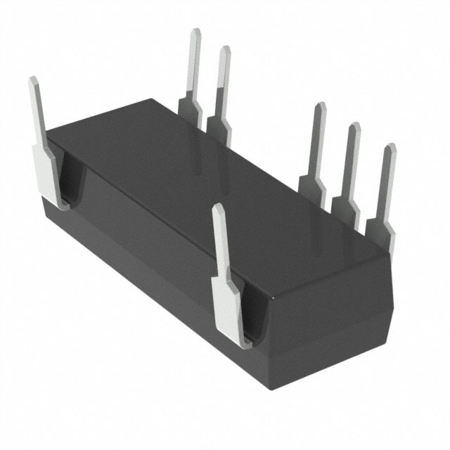

DCP010505B, DCP010512B, DCP010515B, DCP012405B, DCP010505DB, DCP010507DB, DCP010505B, DCP010512B, DCP010515B,DCP011512DB, DCP012405B, DCP010505DB, DCP010512DB, DCP010515DB, DCP011515DB,DCP010507DB, DCP012415DB DCP010512DB, DCP010515DB,SBVS012I DCP011512DB, DCP011515DB, – DECEMBER 2000 – REVISED DCP012415DB SEPTEMBER 2020 www.ti.com SBVS012I – DECEMBER 2000 – REVISED SEPTEMBER 2020 DCP01 Series, 1-W, 1000-VRMS Isolated, Unregulated DC/DC Converter Modules 1 Features 3 Description • • The DCP01B series is a family of 1-W, isolated, unregulated DC/DC converter modules. Requiring a minimum of external components and including onchip device protection, the DCP01B series of devices provide extra features such as output disable and synchronization of switching frequencies. • • • • • • • • • 1-kV Isolation (operational): 1-second test Continuous voltage applied across isolation barrier: 60 VDC / 42.5 VAC UL1950 recognized component EN55022 class B EMC performance 7-Pin PDIP and 7-pin SOP packages Input voltage: 5 V, 15 V, or 24 V Output voltage: ±5 V, ±6.5 V, ±12 V, or ±15 V Device-to-device synchronization Thermal protection Short-circuit protection High efficiency This combination of features and small size makes the DCP01B series of devices suitable for a wide range of applications, and is an easy-to-use solution in applications requiring signal path isolation. WARNING: This product has operational isolation and is intended for signal isolation only. It should not be used as a part of a safety isolation circuit requiring reinforced isolation. See definitions in Feature Description. 2 Applications • • • • • Signal path isolation Ground loop elimination Data acquisition Industrial control and instrumentation Test equipment Device Information PART NUMBER PDIP (7) DCP01xxxxB (1) PACKAGE(1) 19.18 mm × 10.60 mm SOP (7) For all available packages, see the orderable addendum at the end of the data sheet. SYNCOUT SYNCOUT SYNCIN Oscillator 800 kHz Divide-by-2 Reset Watchdog Startup SYNCIN +VOUT Power Stage BODY SIZE (NOM) Oscillator 800 kHz Divide-by-2 Reset ±VOUT Watchdog Startup +VOUT Power Stage ±VOUT COM PSU Thermal Shutdown Thermal Shutdown +VS +VS Power Controller Power Controller ±VS ±VS Single Output Block Diagram Dual Output Block Diagram An IMPORTANT NOTICE at the end of this data sheet addresses availability, warranty, changes, use in safety-critical applications, Submit Document Feedback Copyright © 2020 Texas Instruments Incorporated intellectual property matters and other important disclaimers. PRODUCTION DATA. Product Folder Links: DCP010505B DCP010512B DCP010515B DCP012405B DCP010505DB DCP010507DB DCP010512DB DCP010515DB DCP011512DB DCP011515DB DCP012415DB 1 DCP010505B, DCP010512B, DCP010515B, DCP012405B, DCP010505DB, DCP010507DB, DCP010512DB, DCP010515DB, DCP011512DB, DCP011515DB, DCP012415DB SBVS012I – DECEMBER 2000 – REVISED SEPTEMBER 2020 www.ti.com Table of Contents 1 Features............................................................................1 2 Applications..................................................................... 1 3 Description.......................................................................1 4 Revision History.............................................................. 2 5 Pin Configuration and Functions...................................4 Pin Functions.................................................................... 4 6 Specifications.................................................................. 5 6.1 Absolute Maximum Ratings........................................ 5 6.2 ESD Ratings............................................................... 5 6.3 Recommended Operating Conditions.........................5 6.4 Thermal Information....................................................5 6.5 Electrical Characteristics.............................................6 6.6 Switching Characteristics............................................6 6.7 Typical Characteristics................................................ 7 7 Detailed Description......................................................12 7.1 Overview................................................................... 12 7.2 Functional Block Diagrams....................................... 12 7.3 Feature Description...................................................13 7.4 Device Functional Modes..........................................16 8 Application and Implementation.................................. 18 8.1 Application Information............................................. 18 8.2 Typical Application.................................................... 18 9 Power Supply Recommendations................................22 10 Layout...........................................................................23 10.1 Layout Guidelines................................................... 23 10.2 Layout Example...................................................... 23 11 Device and Documentation Support..........................25 11.1 Device Support........................................................25 11.2 Documentation Support.......................................... 25 11.3 Receiving Notification of Documentation Updates.. 25 11.4 Support Resources................................................. 25 11.5 Trademarks............................................................. 25 11.6 Glossary.................................................................. 25 11.7 Electrostatic Discharge Caution.............................. 25 12 Mechanical, Packaging, and Orderable Information.................................................................... 25 4 Revision History NOTE: Page numbers for previous revisions may differ from page numbers in the current version. Changes from Revision H (May 2019) to Revision I (April 2020) Page • Updated the numbering format for tables, figures and cross-references throughout the document. .................1 • Added links to Section 2 .................................................................................................................................... 1 Changes from Revision G (February 2017) to Revision H (May 2019) Page • Added Section 7.3.6 ........................................................................................................................................ 14 • Added Section 7.3.7 ........................................................................................................................................ 14 • Added Section 7.3.10 ...................................................................................................................................... 15 Changes from Revision F (October 2015) to Revision G (February 2017) Page • Adjusted Operating temperature specification to "ambient temperature range, TA" in Section 6.3 ................... 5 Changes from Revision E (December 2000) to Revision F (Octobert 2015) Page • Added Figure 3-1 ............................................................................................................................................... 1 • Renamed pin "0V" to "COM" (output side common pin) in Section Pin Functions ............................................ 4 • Renamed pin "VS " to "+VS " (input voltage pin) in Section Pin Functions .........................................................4 • Renamed pin "0V" to "–VS " (input side common pin) in Section Pin Functions ................................................4 • Added Section 6.3 ............................................................................................................................................. 5 • Added Section 6.4 ............................................................................................................................................. 5 • Added information to the ISOLATION section of Section 6.5 ............................................................................ 6 • Added Section 7.3.1 to Section 7.3 ................................................................................................................. 13 • Added a typical application design to Section 8.1 ........................................................................................... 18 • Added Section 9 .............................................................................................................................................. 22 2 Submit Document Feedback Copyright © 2020 Texas Instruments Incorporated Product Folder Links: DCP010505B DCP010512B DCP010515B DCP012405B DCP010505DB DCP010507DB DCP010512DB DCP010515DB DCP011512DB DCP011515DB DCP012415DB DCP010505B, DCP010512B, DCP010515B, DCP012405B, DCP010505DB, DCP010507DB, DCP010512DB, DCP010515DB, DCP011512DB, DCP011515DB, DCP012415DB www.ti.com SBVS012I – DECEMBER 2000 – REVISED SEPTEMBER 2020 Device Comparison Table at TA = 25°C, +VS = nominal, CIN = 2.2 µF, COUT = 0.1 µF, (unless otherwise noted) OUTPUT VOLTAGE VNOM AT VS (TYP) (V) 75% LOAD INPUT VOLTAGE VS (V) DEVICE NUMBER MIN TYP MAX DEVICE OUTPUT CURRENT (mA) (3) LOAD REGULATION 10% TO 100% LOAD (1) NO LOAD CURRENT IQ (mA) 0% LOAD EFFICIENCY (%) 100% LOAD BARRIER CAPACITANCE CISO (pF) VISO = 750Vrms MIN TYP MAX MAX TYP MAX TYP TYP TYP 4.75 5 5.25 200 19 31 20 80 3.6 DCP010505DBP DCP010505DBP-U ±4.25 ±5 ±5.75 200(2) 18 32 22 81 3.8 DCP010507DBP DCP010507DBP-U ±5.75 ±6.5 ±7.25 153(2) 21 35 38 81 3.0 11.4 12 12.6 83 21 38 29 85 5.1 DCP010512DBP DCP010512DBP-U ±11.4 ±12 ±12.6 83(2) 19 37 40 82 4.0 DCP010515BP DCP010515BP-U 14.25 15 15.75 66 26 42 34 82 3.8 ±15 ±15.75 66(2) 19 41 42 85 4.7 ±12.6 83 11 39 19 78 2.5 ±15 ±15.75 66(2) 12 39 20 80 2.5 5.25 200 13 23 14 77 2.5 ±15 ±15.75 66(2) 10 35 17 76 3.8 DCP010505BP DCP010505BP-U DCP010512BP DCP010512BP-U 4.5 5 5.5 DCP010515DBP DCP010515DBP-U DCP011512DBP DCP011512DBP-U DCP011515DBP DCP011515DBP-U DCP012405BP DCP012405BP-U DCP012415DBP DCP012415DBP-U (1) (2) (3) ±14.25 ±11.4 13.5 15 ±14.25 4.75 21.6 24 ±12 16.5 5 26.4 ±14.25 Load regulation = (VOUT at 10% load – VOUT at 100%)/VOUT at 75% load IOUT1 + IOUT2 POUT(max) = 1 W Copyright © 2020 Texas Instruments Incorporated Submit Document Feedback Product Folder Links: DCP010505B DCP010512B DCP010515B DCP012405B DCP010505DB DCP010507DB DCP010512DB DCP010515DB DCP011512DB DCP011515DB DCP012415DB 3 DCP010505B, DCP010512B, DCP010515B, DCP012405B, DCP010505DB, DCP010507DB, DCP010512DB, DCP010515DB, DCP011512DB, DCP011515DB, DCP012415DB SBVS012I – DECEMBER 2000 – REVISED SEPTEMBER 2020 www.ti.com 5 Pin Configuration and Functions +VS 1 –VS 2 14 SYNCIN 8 SYNCOUT DCP01B –VOUT 5 +VOUT 6 NC 7 Figure 5-1. 7-Pin PDIP and SOP (Single Output) NVA and DUA Package (Top View) +VS 1 –VS 2 14 SYNCIN 8 SYNCOUT DCP01B COM 5 +VOUT 6 –VOUT 7 Figure 5-2. 7-Pin PDIP and SOP (Dual Output) NVA and DUA Package (Top View) Pin Functions PIN NUMBER PIN NAME DUALOUTPUT I/O (1) DESCRIPTION COM — 5 O Output side common NC 7 — — No connection SYNCIN 14 14 I Synchronization. Synchronize multiple devices by connecting the SYNC pins of each. Pulling this pin low disables the internal oscillator. SYNCOUT 8 8 O Synchronization output. Unrectified transformer output +VOUT 6 6 O Positive output voltage +VS 1 1 I Input voltage –VOUT 5 7 O Negative output voltage –VS 2 2 I Input side common (1) 4 SINGLEOUTPUT I = Input, O = Output Submit Document Feedback Copyright © 2020 Texas Instruments Incorporated Product Folder Links: DCP010505B DCP010512B DCP010515B DCP012405B DCP010505DB DCP010507DB DCP010512DB DCP010515DB DCP011512DB DCP011515DB DCP012415DB DCP010505B, DCP010512B, DCP010515B, DCP012405B, DCP010505DB, DCP010507DB, DCP010512DB, DCP010515DB, DCP011512DB, DCP011515DB, DCP012415DB www.ti.com SBVS012I – DECEMBER 2000 – REVISED SEPTEMBER 2020 6 Specifications 6.1 Absolute Maximum Ratings over operating free-air temperature range (unless otherwise noted) (1) MIN MAX 5-V input devices Input voltage 15-V input devices 18 24-V input devices 29 Lead temperature (soldering, 10 s) Storage temperature, Tstg (1) UNIT 7 –60 V 270 °C 125 °C Stresses beyond those listed under Absolute Maximum Ratings may cause permanent damage to the device. These are stress ratings only, which do not imply functional operation of the device at these or any other conditions beyond those indicated under Recommended Operating Conditions. Exposure to absolute-maximum-rated conditions for extended periods may affect device reliability. 6.2 ESD Ratings VALUE V(ESD) (1) (2) Electrostatic discharge Human-body model (HBM), per ANSI/ESDA/JEDEC JS-001 (1) ±1000 Charged-device model (CDM), per JEDEC specification JESD22-C101 (2) ±250 UNIT V JEDEC document JEP155 states that 500-V HBM allows safe manufacturing with a standard ESD control process. JEDEC document JEP157 states that 250-V CDM allows safe manufacturing with a standard ESD control process. 6.3 Recommended Operating Conditions over operating free-air temperature range (unless otherwise noted) Input voltage MIN NOM MAX 5-V input devices 4.5 5 5.5 15-V input devices 13.5 15 16.5 24-V input devices 21.6 24 26.4 Operating ambient temperature range, TA –40 100 UNIT V °C 6.4 Thermal Information THERMAL METRIC (1) DCP01B DCP01B NVA (PDIP) DUA (SOP) 7 PINS 7 PINS UNIT RθJA Junction-to-ambient thermal resistance 61 61 °C/W RθJC(top) Junction-to-case (top) thermal resistance 26 26 °C/W RθJB Junction-to-board thermal resistance 24 24 °C/W ψJT Junction-to-top characterization parameter 7 7 °C/W ψJB Junction-to-board characterization parameter 24 24 °C/W RθJC(bot) Junction-to-case (bottom) thermal resistance N/A N/A °C/W (1) For more information about traditional and new thermal metrics, see the Semiconductor and IC Package Thermal Metrics application report, SPRA953. Copyright © 2020 Texas Instruments Incorporated Submit Document Feedback Product Folder Links: DCP010505B DCP010512B DCP010515B DCP012405B DCP010505DB DCP010507DB DCP010512DB DCP010515DB DCP011512DB DCP011515DB DCP012415DB 5 DCP010505B, DCP010512B, DCP010515B, DCP012405B, DCP010505DB, DCP010507DB, DCP010512DB, DCP010515DB, DCP011512DB, DCP011515DB, DCP012415DB www.ti.com SBVS012I – DECEMBER 2000 – REVISED SEPTEMBER 2020 6.5 Electrical Characteristics at TA = 25°C, +VS = nominal, CIN = 2.2 µF, COUT = 0.1 µF, (unless otherwise noted) PARAMETER TEST CONDITIONS MIN TYP MAX UNIT OUTPUT POUT Output power ILOAD = 100% (full load) VRIPPLE Output voltage ripple COUT = 1 μF, ILOAD = 50% Voltage vs. Temperature 1 W 20 mVPP –40°C ≤ TA ≤ 25°C 0.046 %/°C 25°C ≤ TA ≤ 100°C 0.016 %/°C INPUT VS Input voltage range –10% 10% ISOLATION Voltage 1-second flash test VISO Isolation 1 kVrms dV/dt 500 V/s Leakage current 30 µA DC 60 VDC AC 42.5 VAC Continuous working voltage across isolation barrier LINE REGULATION VOUT Output voltage IOUT ≥ 10% load current and constant, VS (min) to VS (typ) 1% 15% IOUT ≥ 10% load current and constant, VS (typ) to VS (max) 1% 15% RELIABILITY Demonstrated TA = 55°C 55 FITS 150 °C 3 mA THERMAL SHUTDOWN TSD Die temperature at shutdown ISD Shutdown current 6.6 Switching Characteristics at TA = +25°C, +VS = nominal, CIN = 2.2 µF, COUT = 0.1 µF, (unless otherwise noted) PARAMETER fOSC VIL Low-level input voltage, SYNC ISYNC Input current, SYNC tDISABLE Disable time CSYNC Capacitance loading on SYNC pin (1) (1) 6 Oscillator frequency TEST CONDITIONS MIN fSW = fOSC/2 TYP 0 VSYNC = 2 V MAX 800 UNIT kHz 0.4 V 75 µA 2 µs External 3 pF The application report External Synchronization of the DCP01/02 Series of DC/DC Converters (SBAA035) describes this configuration. Submit Document Feedback Copyright © 2020 Texas Instruments Incorporated Product Folder Links: DCP010505B DCP010512B DCP010515B DCP012405B DCP010505DB DCP010507DB DCP010512DB DCP010515DB DCP011512DB DCP011515DB DCP012415DB DCP010505B, DCP010512B, DCP010515B, DCP012405B, DCP010505DB, DCP010507DB, DCP010512DB, DCP010515DB, DCP011512DB, DCP011515DB, DCP012415DB www.ti.com SBVS012I – DECEMBER 2000 – REVISED SEPTEMBER 2020 6.7 Typical Characteristics At TA = 25°C, V+VS = nominal, (unless otherwise noted) 60 60 Standard Limits Class A Class B 40 30 20 10 0 Standard Limits 50 Emission Level, Peak (dBµA) Emission Level, Peak (dBµA) 50 10 40 30 20 10 0 ±10 20 0.15 1 Frequency(MHz) DCP010505B 10 ±20 0.15 30 125% Load 1 Frequency(MHz) DCP010505B Figure 6-1. Conducted Emissions 10 30 8% Load Figure 6-2. Conducted Emissions 5.5 50 5.4 1-mF Ceramic 4.7-mF Ceramic 10-mF Ceramic 45 40 5.3 35 Output Voltage (V) Ripple (mVPP) Class A Class B 30 25 20 15 10 5.2 5.1 5.0 4.9 4.8 4.7 4.6 5 4.5 0 10 20 30 40 50 60 70 80 90 4.4 4.5 100 4.6 4.7 4.8 Load (%) DCP010505B 4.9 5.0 5.1 5.2 5.3 5.4 5.5 Input Voltage (V) 20-MHz BW DCP010505B Figure 6-3. Output Ripple versus Load Figure 6-4. Line Regulation 5.8 85 5.7 5.6 Output Voltage (V) Efficiency (%) 80 75 70 65 5.5 5.4 5.3 5.2 5.1 5.0 4.9 60 4.8 55 10 20 30 40 50 60 70 80 90 100 4.7 10 20 DCP010505B Figure 6-5. Efficiency versus Load Copyright © 2020 Texas Instruments Incorporated 30 40 50 60 70 80 90 100 Load (%) Load (%) DCP010505B Note: Operations under 10% Load Figure 6-6. Load Regulation Submit Document Feedback Product Folder Links: DCP010505B DCP010512B DCP010515B DCP012405B DCP010505DB DCP010507DB DCP010512DB DCP010515DB DCP011512DB DCP011515DB DCP012415DB 7 DCP010505B, DCP010512B, DCP010515B, DCP012405B, DCP010505DB, DCP010507DB, DCP010512DB, DCP010515DB, DCP011512DB, DCP011515DB, DCP012415DB SBVS012I – DECEMBER 2000 – REVISED SEPTEMBER 2020 5.8 85 +VOUT 5.7 80 ±VOUT 5.6 Output Voltage (V) Efficiency (%) www.ti.com 75 70 65 5.5 5.4 5.3 5.2 5.1 5.0 4.9 60 4.8 55 10 20 30 40 50 60 70 80 90 4.7 10 100 20 30 40 50 60 70 80 90 100 Load (%) Load (%) DCP010505DB DCP010505DB Note: Operations under 10% Load Figure 6-8. Load Regulation Figure 6-7. Efficiency versus Load 85 7.6 80 7.4 +VOUT 7.2 Output Voltage (V) 75 Efficiency (%) ±VOUT 70 65 60 7 6.8 6.6 6.4 55 6.2 6 10 50 20 30 40 50 60 70 80 90 100 20 30 40 DCP010507DB DCP010507DB 90 14.5 85 14.0 Output Voltage (V) 80 Efficiency (%) 60 70 80 90 100 Note: Operations under 10% Load Figure 6-10. Load Regulation Figure 6-9. Efficiency versus Load 75 70 65 60 13.5 13.0 12.5 12.0 11.5 55 50 10 20 30 40 50 60 70 80 90 100 11.0 10 20 Load (%) DCP010512B Figure 6-11. Efficiency versus Load 8 50 Load (%) Load (%) Submit Document Feedback 30 40 50 60 70 80 90 100 Load (%) DCP010512B Note: Operations under 10% Load Figure 6-12. Load Regulation Copyright © 2020 Texas Instruments Incorporated Product Folder Links: DCP010505B DCP010512B DCP010515B DCP012405B DCP010505DB DCP010507DB DCP010512DB DCP010515DB DCP011512DB DCP011515DB DCP012415DB DCP010505B, DCP010512B, DCP010515B, DCP012405B, DCP010505DB, DCP010507DB, DCP010512DB, DCP010515DB, DCP011512DB, DCP011515DB, DCP012415DB www.ti.com SBVS012I – DECEMBER 2000 – REVISED SEPTEMBER 2020 14.5 85 14.0 80 13.5 13.0 VOUT (V) Efficiency (%) 75 70 65 12.5 12.0 11.5 60 11.0 55 +VOUT -VOUT 10.5 10.00 50 10 20 30 40 50 60 70 80 90 10 100 20 30 40 DCP010512DB DCP010512DB Figure 6-13. Efficiency versus Load 60 70 80 90 100 Note: Operations under 10% Load Figure 6-14. Load Regulation 85 17.5 80 17.0 75 16.5 Output Voltage (V) Efficiency (%) 50 Load (%) Load (%) 70 65 60 16.0 15.5 15.0 14.5 55 50 10 14.0 20 30 40 50 60 70 80 90 10 100 20 30 40 50 60 70 80 90 100 Load (%) Load (%) DCP010515B DCP010515B Note: Operations under 10% Load Figure 6-16. Load Regulation Figure 6-15. Efficiency versus Load 18 90 85 17 75 VOUT (V) Efficiency (%) 80 70 16 65 15 60 +VOUT -VOUT 55 14 50 10 20 30 40 50 60 70 80 90 100 10 20 DCP010515DB Figure 6-17. Efficiency versus Load Copyright © 2020 Texas Instruments Incorporated 30 40 50 60 70 80 90 100 Load (%) Load (%) DCP010515DB Note: Operations under 10% Load Figure 6-18. Load Regulation Submit Document Feedback Product Folder Links: DCP010505B DCP010512B DCP010515B DCP012405B DCP010505DB DCP010507DB DCP010512DB DCP010515DB DCP011512DB DCP011515DB DCP012415DB 9 DCP010505B, DCP010512B, DCP010515B, DCP012405B, DCP010505DB, DCP010507DB, DCP010512DB, DCP010515DB, DCP011512DB, DCP011515DB, DCP012415DB SBVS012I – DECEMBER 2000 – REVISED SEPTEMBER 2020 13.5 80 +VOUT 75 Output Voltage (V) 65 Efficiency (%) ±VOUT 13.0 70 60 55 50 45 40 www.ti.com 12.5 12.0 11.5 11.0 35 30 10 20 30 40 50 60 70 80 90 10.5 10 100 20 30 40 50 60 70 80 90 100 Load (%) Load (%) DCP011512DB DCP011512DB Note: Operations under 10% Load Figure 6-20. Load Regulation Figure 6-19. Efficiency versus Load 17 90 +VOUT 16.5 80 ±VOUT Output Voltage (V) 16 Efficiency (%) 70 60 50 15.5 15 14.5 14 40 13.5 30 10 20 30 40 50 60 70 80 90 13 10 100 20 30 40 50 Load (%) DCP011515DB DCP011515DB 90 5.60 80 5.50 70 80 90 100 Note: Operations under 10% Load 5.40 60 VOUT (V) Efficiency (%) 70 Figure 6-22. Load Regulation Figure 6-21. Efficiency versus Load 50 40 5.30 5.20 5.10 30 20 5.00 10 4.90 0 4.80 10 20 30 40 50 60 70 80 90 100 10 20 DCP012405B Figure 6-23. Efficiency versus Load Submit Document Feedback 30 40 50 60 70 80 100 Load (%) Load (%) 10 60 Load (%) DCP012405B Note: Operations under 10% Load Figure 6-24. Load Regulation Copyright © 2020 Texas Instruments Incorporated Product Folder Links: DCP010505B DCP010512B DCP010515B DCP012405B DCP010505DB DCP010507DB DCP010512DB DCP010515DB DCP011512DB DCP011515DB DCP012415DB DCP010505B, DCP010512B, DCP010515B, DCP012405B, DCP010505DB, DCP010507DB, DCP010512DB, DCP010515DB, DCP011512DB, DCP011515DB, DCP012415DB www.ti.com SBVS012I – DECEMBER 2000 – REVISED SEPTEMBER 2020 16.5 90 +VOUT 80 Output Voltage (V) 70 Efficiency (%) ±VOUT 16 60 50 40 15.5 15 14.5 14 30 20 10 13.5 20 30 40 50 60 70 80 90 100 10 20 DCP012415DB Figure 6-25. Efficiency versus Load Copyright © 2020 Texas Instruments Incorporated 30 40 50 60 70 80 90 100 Load (%) Load (%) DCP012415DB Note: Operations under 10% Load Figure 6-26. Load Regulation Submit Document Feedback Product Folder Links: DCP010505B DCP010512B DCP010515B DCP012405B DCP010505DB DCP010507DB DCP010512DB DCP010515DB DCP011512DB DCP011515DB DCP012415DB 11 DCP010505B, DCP010512B, DCP010515B, DCP012405B, DCP010505DB, DCP010507DB, DCP010512DB, DCP010515DB, DCP011512DB, DCP011515DB, DCP012415DB SBVS012I – DECEMBER 2000 – REVISED SEPTEMBER 2020 www.ti.com 7 Detailed Description 7.1 Overview The DCP01B offers up to 1 W of isolated, unregulated output power from a 5-V, 15-V, or 24-V input source with a typical efficiency of up to 85%. This efficiency is achieved through highly integrated packaging technology and the implementation of a custom power stage and control device. The DCP01B devices are specified for operational isolation only. The circuit design uses an advanced BiCMOS and DMOS process. 7.2 Functional Block Diagrams SYNCOUT SYNCIN Oscillator 800 kHz Divide-by-2 Reset Watchdog Startup +VOUT Power Stage ±VOUT Thermal Shutdown +VS Power Controller ±VS Figure 7-1. Single Output Device SYNCOUT SYNCIN Oscillator 800 kHz Divide-by-2 Reset Watchdog Startup +VOUT Power Stage ±VOUT COM PSU Thermal Shutdown +VS Power Controller ±VS Figure 7-2. Dual Output Device 12 Submit Document Feedback Copyright © 2020 Texas Instruments Incorporated Product Folder Links: DCP010505B DCP010512B DCP010515B DCP012405B DCP010505DB DCP010507DB DCP010512DB DCP010515DB DCP011512DB DCP011515DB DCP012415DB DCP010505B, DCP010512B, DCP010515B, DCP012405B, DCP010505DB, DCP010507DB, DCP010512DB, DCP010515DB, DCP011512DB, DCP011515DB, DCP012415DB www.ti.com SBVS012I – DECEMBER 2000 – REVISED SEPTEMBER 2020 7.3 Feature Description 7.3.1 Isolation Underwriters Laboratories, UL™ defines several classes of isolation that are used in modern power supplies. Safety extra low voltage (SELV) is defined by UL (UL1950 E199929) as a secondary circuit which is so designated and protected that under normal and single fault conditions the voltage between any two accessible parts, or between an accessible part and the equipment earthing terminal for operational isolation does not exceed steady state 42.5 V peak or 60 VDC for more than one second. 7.3.1.1 Operation or Functional Isolation Operational or functional isolation is defined by the use of a high-potential (hipot) test only. Typically, this isolation is defined as the use of insulated wire in the construction of the transformer as the primary isolation barrier. The hipot one-second duration test (dielectric voltage, withstand test) is a production test used to verify that the isolation barrier is functioning. Products with operational isolation must never be used as an element in a safety-isolation system. 7.3.1.2 Basic or Enhanced Isolation Basic or enhanced isolation is defined by specified creepage and clearance limits between the primary and secondary circuits of the power supply. Basic isolation is the use of an isolation barrier in addition to the insulated wire in the construction of the transformer. Input and output circuits must also be physically separated by specified distances. 7.3.1.3 Continuous Voltage For a device that has no specific safety agency approvals (operational isolation), the continuous voltage that can be applied across the part in normal operation is less than 42.5 VRMS, or 60 VDC. Ensure that both input and output voltages maintain normal SELV limits. The isolation test voltage represents a measure of immunity to transient voltages. WARNING Do not use the device as an element of a safety isolation system that exceeds the SELV limit. If the device is expected to function correctly with more than 42.5 VRMS or 60 VDC applied continuously across the isolation barrier, then the circuitry on both sides of the barrier must be regarded as operating at an unsafe voltage, and further isolation or insulation systems must form a barrier between these circuits and any useraccessible circuitry according to safety standard requirements. 7.3.1.4 Isolation Voltage The terms Hipot test, flash-tested, withstand voltage, proof voltage, dielectric withstand voltage, and isolation test voltage all describe a similar idea. They describe a test voltage applied for a specified time across a component designed to provide electrical isolation to verify the integrity of that isolation. TI’s DCP01B series of DC/DC converters are all 100% production tested at 1.0 kVAC for one second. 7.3.1.5 Repeated High-Voltage Isolation Testing Repeated high-voltage isolation testing of a barrier component can degrade the isolation capability, depending on materials, construction, and environment. The DCP01B series of DC/DC converters have toroidal, enameled, wire isolation transformers with no additional insulation between the primary and secondary windings. While a device can be expected to withstand several times the stated test voltage, the isolation capability depends on the wire insulation. Any material, including this enamel (typically polyurethane), is susceptible to eventual chemical degradation when subject to very-high applied voltages. Therefore, strictly limit the number of highvoltage tests and repeated high-voltage isolation testing. However, if it is absolutely required, reduce the voltage by 20% from specified test voltage with a duration limit of one second per test. Copyright © 2020 Texas Instruments Incorporated Submit Document Feedback Product Folder Links: DCP010505B DCP010512B DCP010515B DCP012405B DCP010505DB DCP010507DB DCP010512DB DCP010515DB DCP011512DB DCP011515DB DCP012415DB 13 DCP010505B, DCP010512B, DCP010515B, DCP012405B, DCP010505DB, DCP010507DB, DCP010512DB, DCP010515DB, DCP011512DB, DCP011515DB, DCP012415DB SBVS012I – DECEMBER 2000 – REVISED SEPTEMBER 2020 www.ti.com 7.3.2 Power Stage The DCP01B series of devices uses a push-pull, center-tapped topology. The DCP01B devices switch at 400 kHz (divide-by-2 from an 800-kHz oscillator). 7.3.3 Oscillator And Watchdog Circuit The onboard, 800-kHz oscillator generates the switching frequency by a divide-by-2 circuit. The oscillator can be synchronized to other DCP01B series device circuits or an external source, and is used to minimize system noise. A watchdog circuit checks the operation of the oscillator circuit. The oscillator can be disabled by pulling the SYNCIN pin low. When the SYNCIN pin goes low, the output pins transition into tri-state mode, which occurs within 2 μs. 7.3.4 Thermal Shutdown The DCP01B series of devices are protected by a thermal-shutdown circuit. If the on-chip temperature rises above 150°C, the device shuts down. Normal operation resumes as soon as the temperature falls below 150°C. While the over temperature condition continues, operation randomly cycles on and off. This cycling continues until the temperature is reduced. 7.3.5 Synchronization When more than one DC/DC converter is needed onboard, beat frequencies and other electrical interference can be generated. This interference occurs because of the small variations in switching frequencies between the DC/DC converters. The DCP01B series of devices overcomes this interference by allowing devices to synchronize to one another. Synchronize up to eight devices by connecting the SYNC pins of each device, taking care to minimize the capacitance of tracking. Stray capacitance (greater than 3 pF) reduces the switching frequency, or can sometimes stop the oscillator circuit. The maximum recommended voltage applied to the SYNC pin is 3.0 V. For an application that uses more than eight synchronized devices, use an external device to drive the SYNC pins. The application report External Synchronization of the DCP01/02 Series of DC/DC Converters describes this configuration. Note During the start-up period, all synchronized devices draw maximum current from the input simultaneously. If the input voltage falls below approximately 4 V, the devices may not start up. A 2.2-μF capacitor should be connected close to each device input pin. 7.3.6 Light Load Operation (< 10%) Operation below 10% load can cause the output voltage to increase up to double the typical output voltage. For applications that operate less than 10% of rated output current, it is recommended to add a minimum load to ensure the output voltage of the device is within the load regulation range. For example, connect a 250-Ω preload resistor to meet the 10% minimum load condition for the DCP010505BP. 7.3.7 Load Regulation (10% to 100%) The load regulation of the DCP01B series of devices is specified at 10% to 100% load. Placing a minimum 10% load will ensure the output voltage is within the range specified in Section 6.5. For more information regarding operation below 10% load, see Section 7.3.6. 7.3.8 Construction The basic construction of the DCP01B series of devices is the same as standard integrated circuits. The molded package contains no substrate. The DCP01B series of devices are constructed using an IC, rectifier diodes, and a wound magnetic toroid on a lead frame. Because the package contains no solder, the devices do not require any special printed circuit board (PCB) assembly processing. This architecture results in an isolated DC/DC converter with inherently high reliability. 14 Submit Document Feedback Copyright © 2020 Texas Instruments Incorporated Product Folder Links: DCP010505B DCP010512B DCP010515B DCP012405B DCP010505DB DCP010507DB DCP010512DB DCP010515DB DCP011512DB DCP011515DB DCP012415DB www.ti.com DCP010505B, DCP010512B, DCP010515B, DCP012405B, DCP010505DB, DCP010507DB, DCP010512DB, DCP010515DB, DCP011512DB, DCP011515DB, DCP012415DB SBVS012I – DECEMBER 2000 – REVISED SEPTEMBER 2020 7.3.9 Thermal Management Due to the high power density of these devices, it is advisable to provide ground planes on the input and output rails. 7.3.10 Power-Up Characteristics The DCP01B series of devices do not include a soft-start feature. Therefore, a high in-rush current during power up is expected. Refer to the DCPA1 series of devices for a 1-W, isolated, unregulated DC/DC converter module with soft start included. Figure 7-3 shows the typical start-up waveform for a DCP010505BP, operating from a 5V input with no load on the output. Figure 7-4 shows the start-up waveform for a DCP010505BP starting up into a 10% load. Figure 7-5 shows the start-up waveform starting up into a full (100%) load. Figure 7-3. DCP010505BP Start-Up at No Load Figure 7-4. DCP010505BP Start-Up at 10% Load Figure 7-5. DCP010505BP Start-Up at 100% Load Copyright © 2020 Texas Instruments Incorporated Submit Document Feedback Product Folder Links: DCP010505B DCP010512B DCP010515B DCP012405B DCP010505DB DCP010507DB DCP010512DB DCP010515DB DCP011512DB DCP011515DB DCP012415DB 15 DCP010505B, DCP010512B, DCP010515B, DCP012405B, DCP010505DB, DCP010507DB, DCP010512DB, DCP010515DB, DCP011512DB, DCP011515DB, DCP012415DB SBVS012I – DECEMBER 2000 – REVISED SEPTEMBER 2020 www.ti.com 7.4 Device Functional Modes 7.4.1 Disable and Enable (SYNCIN Pin) Each of the DCP01B series devices can be disabled or enabled by driving the SYNCIN pin using an open-drain CMOS gate. If the SYNCIN pin is pulled low, the DCP01B becomes disabled. The disable time depends upon the external loading. The internal disable function is implemented within 2 μs. Removal of the pulldown causes the DCP01B to be enabled. Capacitive loading on the SYNCIN pin must be minimized (≤ 3 pF) to prevent a reduction in the oscillator frequency. The application report External Synchronization of the DCP01/02 Series of DC/DC Converters describes disable and enable control circuitry. 7.4.2 Decoupling 7.4.2.1 Ripple Reduction The high switching frequency of 400 kHz allows simple filtering. To reduce ripple, it is recommended that a minimum of 1-μF capacitor be used on the +VOUT pin. For dual output devices, decouple both of the outputs to the COM pin. The required 2.2-μF, low ESR ceramic input capacitor also helps reduce ripple and noise, (24-V input voltage versions require only 0.47 µF of input capacitance). See application report DC-to-DC Converter Noise Reduction. 7.4.2.2 Connecting the DCP01B in Series Multiple DCP01B isolated 1-W DC/DC converters can be connected in series to provide non-standard voltage rails. This configuration is possible by using the floating outputs provided by the galvanic isolation of the DCP01. Connect the +VOUT from one DCP01B to the –VOUT of another (see Figure 7-6). If the SYNCIN pins are tied together, the self-synchronization feature of the DCP01B prevents beat frequencies on the voltage rails. The synchronization feature of the DCP01B allows easy series connection without external filtering, thus minimizing cost. VIN +VS CIN SYNCIN CIN +VOUT1 DCP COUT 1.0 µF 01B –VS –VOUT1 VS +VOUT2 SYNCIN DCP –VS VOUT1 + VOUT2 COUT 1.0 µF 01B –VOUT2 Figure 7-6. Multiple DCP01B Devices Connected in Series The outputs of a dual-output DCP01B can also be connected in series to provide two times the magnitude of +VOUT, as shown in Figure 7-7. For example, connect a dual-output, 15-V, DCP012415DB device to provide a 30-V rail. VIN +VS CIN +VOUT DCP –VS 01B +VOUT COUT 1.0 µF –VOUT –VOUT COUT 1.0 µF COM Figure 7-7. Dual Output Devices Connected in Series 16 Submit Document Feedback Copyright © 2020 Texas Instruments Incorporated Product Folder Links: DCP010505B DCP010512B DCP010515B DCP012405B DCP010505DB DCP010507DB DCP010512DB DCP010515DB DCP011512DB DCP011515DB DCP012415DB DCP010505B, DCP010512B, DCP010515B, DCP012405B, DCP010505DB, DCP010507DB, DCP010512DB, DCP010515DB, DCP011512DB, DCP011515DB, DCP012415DB www.ti.com SBVS012I – DECEMBER 2000 – REVISED SEPTEMBER 2020 7.4.2.3 Connecting the DCP01B in Parallel If the output power from one DCP01B is not sufficient, it is possible to parallel the outputs of multiple DCP01Bs, as shown in Figure 7-8 (applies to single output devices only). The synchronization feature allows easy synchronization to prevent power-rail beat frequencies at no additional filtering cost. VIN +VS SYNCIN CIN +VOUT1 DCP 01B –VS COUT 1.0 µF –VOUT1 2 × Power Out +VS CIN SYNCIN –VS +VOUT2 DCP COUT 1.0 µF 01B –VOUT2 GND Figure 7-8. Multiple DCP01B Devices Connected in Parallel Copyright © 2020 Texas Instruments Incorporated Submit Document Feedback Product Folder Links: DCP010505B DCP010512B DCP010515B DCP012405B DCP010505DB DCP010507DB DCP010512DB DCP010515DB DCP011512DB DCP011515DB DCP012415DB 17 DCP010505B, DCP010512B, DCP010515B, DCP012405B, DCP010505DB, DCP010507DB, DCP010512DB, DCP010515DB, DCP011512DB, DCP011515DB, DCP012415DB SBVS012I – DECEMBER 2000 – REVISED SEPTEMBER 2020 www.ti.com 8 Application and Implementation Note Information in the following applications sections is not part of the TI component specification, and TI does not warrant its accuracy or completeness. TI’s customers are responsible for determining suitability of components for their purposes. Customers should validate and test their design implementation to confirm system functionality. 8.1 Application Information 8.2 Typical Application VIN +VOUT +VS CIN 2.2 µF SYNC +VOUT DCP01B –VS COUT 1.0 µF –VOUT –VOUT Figure 8-1. Typical DCP010505 Application 8.2.1 Design Requirements For this design example, use the parameters listed in Table 8-1 and follow the design procedures shown in the Section 8.2.2. Table 8-1. Design Example Parameters PARAMETER VALUE UNIT V(+VS) Input voltage 5 V V(+VOUT) Output voltage 5 V IOUT Output current rating 200 mA fSW Operating frequency 400 kHz 8.2.2 Detailed Design Procedure 8.2.2.1 Input Capacitor For all 5-V and 15-V input voltage designs, select a 2.2-μF low-ESR ceramic input capacitor to ensure a good startup performance. 24-V input applications require only 0.47-μF of input capacitance. 8.2.2.2 Output Capacitor For any DCP01B design, select a 1.0-μF low-ESR ceramic output capacitor to reduce output ripple. 8.2.2.3 SYNCIN Pin In a stand-alone application, leave the SYNCIN pin floating. 18 Submit Document Feedback Copyright © 2020 Texas Instruments Incorporated Product Folder Links: DCP010505B DCP010512B DCP010515B DCP012405B DCP010505DB DCP010507DB DCP010512DB DCP010515DB DCP011512DB DCP011515DB DCP012415DB DCP010505B, DCP010512B, DCP010515B, DCP012405B, DCP010505DB, DCP010507DB, DCP010512DB, DCP010515DB, DCP011512DB, DCP011515DB, DCP012415DB www.ti.com SBVS012I – DECEMBER 2000 – REVISED SEPTEMBER 2020 8.2.3 DCP010505 Application Curves 5.8 85 5.7 5.6 Output Voltage (V) Efficiency (%) 80 75 70 65 5.5 5.4 5.3 5.2 5.1 5.0 4.9 60 4.8 55 10 20 30 40 50 60 70 80 90 100 4.7 10 20 30 40 50 60 70 80 90 100 Load (%) Load (%) DCP010505B DCP010505B Note: Operations under 10% Load Figure 8-3. Load Regulation Figure 8-2. Efficiency versus Load 8.2.4 PCB Design The copper losses (resistance and inductance) can be minimized by the use of mutual ground and power planes (tracks) where possible. If that is not possible, use wide tracks to reduce the losses. If several devices are being powered from a common power source, a star-connected system for the track must be deployed. Do not connect the devices in series, because that type of connection cascades the resistive losses. The position of the decoupling capacitors is important. They must be as close to the devices as possible in order to reduce losses. See Section 10 for more details. 8.2.5 Decoupling Ceramic Capacitors Capacitor Impedance (Ÿ ) All capacitors have losses because of internal equivalent series resistance (ESR), and to a lesser degree, equivalent series inductance (ESL). Values for ESL are not always easy to obtain. However, some manufacturers provide graphs of frequency versus capacitor impedance. These graphs typically show the capacitor impedance falling as frequency is increased (as shown in Figure 8-4). In Figure 8-4, XC is the reactance due to the capacitance, X L is the reactance due to the ESL, and f0 is the resonant frequency. As the frequency increases, the impedance stops decreasing and begins to rise. The point of minimum impedance indicates the resonant frequency of the capacitor. This frequency is where the components of capacitance and inductance reactance are of equal magnitude. Beyond this point, the capacitor is not effective as a capacitor. Z XC XL 0 Frequency (Hz) f0 Figure 8-4. Capacitor Impedance versus Frequency However, there is a 180° phase difference resulting in cancellation of the imaginary component. The resulting effect is that the impedance at the resonant point is the real part of the complex impedance, namely, the value of Copyright © 2020 Texas Instruments Incorporated Submit Document Feedback Product Folder Links: DCP010505B DCP010512B DCP010515B DCP012405B DCP010505DB DCP010507DB DCP010512DB DCP010515DB DCP011512DB DCP011515DB DCP012415DB 19 DCP010505B, DCP010512B, DCP010515B, DCP012405B, DCP010505DB, DCP010507DB, DCP010512DB, DCP010515DB, DCP011512DB, DCP011515DB, DCP012415DB SBVS012I – DECEMBER 2000 – REVISED SEPTEMBER 2020 www.ti.com the ESR. The output capacitor's resonant frequency must be higher than the default switching frequency (800 kHz) of the device to properly decouple noise at and below the switching frequency. 20 Submit Document Feedback Copyright © 2020 Texas Instruments Incorporated Product Folder Links: DCP010505B DCP010512B DCP010515B DCP012405B DCP010505DB DCP010507DB DCP010512DB DCP010515DB DCP011512DB DCP011515DB DCP012415DB DCP010505B, DCP010512B, DCP010515B, DCP012405B, DCP010505DB, DCP010507DB, DCP010512DB, DCP010515DB, DCP011512DB, DCP011515DB, DCP012415DB www.ti.com SBVS012I – DECEMBER 2000 – REVISED SEPTEMBER 2020 The effect of the ESR is to cause a voltage drop within the capacitor. The value of this voltage drop is simply the product of the ESR and the transient load current, as shown in Equation 1. VIN = VPK – (ESR × ITR) (1) where • • • VIN is the voltage at the device input VPK is the maximum value of the voltage on the capacitor during charge ITR is the transient load current The other factor that affects the performance is the value of the capacitance. However, for the input and the full wave outputs (single-output voltage devices), ESR is the dominant factor. 8.2.6 Input Capacitor and the Effects of ESR If the input decoupling capacitor is not ceramic (and has an ESR greater than 20 mΩ), then at the instant the power transistors switch on, the voltage at the input pins falls momentarily. If the voltage falls below approximately 4 V, the device detects an undervoltage condition and switches the internal drive circuits to a momentary off state. This detection is carried out as a precaution against a genuine low input voltage condition that could slow down or even stop the internal circuits from operating correctly. A slow-down or stoppage results in the drive transistors being turned on too long, causing saturation of the transformer and destruction of the device. Following detection of a low input voltage condition, the device switches off the internal drive circuits until the input voltage returns to a safe value, at which time the device tries to restart. If the input capacitor is still unable to maintain the input voltage, shutdown recurs. This process repeats until the input capacitor charges sufficiently to start the device correctly. Normal start-up should occur in approximately 1 ms after power is applied to the device. If a considerably longer start-up duration time is encountered, it is likely that either (or both) the input supply or the capacitors are not performing adequately. For 5-V to 15-V input devices, a 2.2-μF, low-ESR ceramic capacitor ensures good startup performance. For 24-V input voltage devices, 0.47-μF ceramic capacitors are recommended. Tantalum capacitors are not recommended, since most do not have low-ESR values and will degrade performance. If tantalum capacitors must be used, close attention must be paid to both the ESR and voltage as derated by the vendor. Note During the start-up period, these devices may draw maximum current from the input supply. If the input voltage falls below approximately 4 V, the devices may not start up. Connect a 2.2-μF ceramic capacitor close to the input pins. 8.2.7 Ripple and Noise A good quality, low-ESR ceramic capacitor placed as close as practical across the input reduces reflected ripple and ensures a smooth start-up. A good quality, low-ESR ceramic capacitor placed as close as practical across the rectifier output terminal and output ground gives the best ripple and noise performance. See application report DC-to-DC Converter Noise Reduction for more information on noise rejection. 8.2.7.1 Output Ripple Calculation Example The following example shows that increasing the capacitance has a much smaller effect on the output ripple voltage than does reducing the value of the ESR for the filter capacitor. To calculate the output ripple for a DCP010505 device: • • VOUT = 5 V IOUT = 0.2 A Copyright © 2020 Texas Instruments Incorporated Submit Document Feedback Product Folder Links: DCP010505B DCP010512B DCP010515B DCP012405B DCP010505DB DCP010507DB DCP010512DB DCP010515DB DCP011512DB DCP011515DB DCP012415DB 21 DCP010505B, DCP010512B, DCP010515B, DCP012405B, DCP010505DB, DCP010507DB, DCP010512DB, DCP010515DB, DCP011512DB, DCP011515DB, DCP012415DB SBVS012I – DECEMBER 2000 – REVISED SEPTEMBER 2020 • • • www.ti.com At full output power, the load resistor is 25 Ω Ceramic output capacitor of 1 μF, ESR of 0.1 Ω Capacitor discharge time 1% of 800 kHz (ripple frequency) tDIS = 0.0125 μs τ = C × RLOAD τ = 1 × 10-6 × 12.5 = 12.5 μs VDIS = VO(1 – EXP(–tDIS / τ)) VDIS = 5 mV By contrast, the voltage dropped because of ESR: VESR = ILOAD × ESR VESR = 20 mV Ripple voltage = 25 mV 8.2.8 Dual DCP01B Output Voltage The voltage output for dual DCP01B devices is half wave rectified; therefore, the discharge time is 1.25 μs. Repeating the above calculations using the 100% load resistance of 50 Ω (0.1 A per output), the results are: τ = 25 μs tDIS = 1.25 μs VDIS = 244 mV VESR = 10 mV Ripple Voltage = 133 mV This time, it is the capacitor discharging that contributes to the largest component of ripple. Changing the output filter to 10 μF, and repeating the calculations, the result is: Ripple voltage = 25 mV This value is composed of almost equal components. The previous calculations are offered as a guideline only. Capacitor parameters usually have large tolerances and can be susceptible to environmental conditions. 8.2.9 Optimizing Performance Optimum performance can only be achieved if the device is correctly supported. The very nature of a switching converter requires power to be instantly available when it switches on. If the converter has DMOS switching transistors, the fast edges will create a high current demand on the input supply. This transient load placed on the input is supplied by the external input decoupling capacitor, thus maintaining the input voltage. Therefore, the input supply does not see this transient (this is an analogy to high-speed digital circuits). The positioning of the capacitor is critical and must be placed as close as possible to the input pins and connected via a lowimpedance path. The optimum performance primarily depends on two factors: • • Connection of the input and output circuits for minimal loss. The ability of the decoupling capacitors to maintain the input and output voltages at a constant level. 9 Power Supply Recommendations The DCP01B is a switching power supply, and as such can place high peak current demands on the input supply. To avoid the supply falling momentarily during the fast switching pulses, ground and power planes must be used to connect the power to the input of DCP01 device. If this connection is not possible, then the supplies must be connected in a star formation with the traces made as wide as possible. 22 Submit Document Feedback Copyright © 2020 Texas Instruments Incorporated Product Folder Links: DCP010505B DCP010512B DCP010515B DCP012405B DCP010505DB DCP010507DB DCP010512DB DCP010515DB DCP011512DB DCP011515DB DCP012415DB DCP010505B, DCP010512B, DCP010515B, DCP012405B, DCP010505DB, DCP010507DB, DCP010512DB, DCP010515DB, DCP011512DB, DCP011515DB, DCP012415DB www.ti.com SBVS012I – DECEMBER 2000 – REVISED SEPTEMBER 2020 10 Layout 10.1 Layout Guidelines Due to the high power density of these devices, provide ground planes on the input and output rails. Figure 10-1 and Figure 10-2 show the schematic for the two DIP through-hole packages, and two SOP surfacemount packages for the DCP family of products which include DCP01B, DCP02, DCV01, DCR01, and DCR02. Figure 10-3 and Figure 10-4 illustrate a printed circuit board (PCB) layout for the schematics. Including input power and ground planes provides a low-impedance path for the input power. For the output, the COM signal connects via a ground plane, while the connections for the positive and negative voltage outputs conduct via wide traces in order to minimize losses. The output should be taken from the device using ground and power planes, thereby ensuring minimum losses. The location of the decoupling capacitors in close proximity to their respective pins ensures low losses due to the effects of stray inductance, thus improving the ripple performance. This location is of particular importance to the input decoupling capacitor, because this capacitor supplies the transient current associated with the fast switching waveforms of the power drive circuits. Allow the unused SYNC pin, to remain configured as a floating pad. It is advisable to place a guard ring (connected to input ground) or annulus connected around this pin to avoid any noise pick up. When connecting a SYNC pin to one or more SYNC design the linking trace to be short and narrow to avoid stray capacitance. Ensure that no other trace is in close proximity to this trace SYNC trace to decrease the stray capacitance on this pin. The stray capacitance affects the performance of the oscillator. 10.2 Layout Example CON1 VS1 1 +VS SYNC 14 CON3 JP1 VS3 1 C1 +VS SYNC 28 JP1 C11 NC 27 0V1 2 0V3 –VS DCP02xxxxP +V1 6 C3 C2-1 +VOUT +V3 C2 2 –VS 3 –VS 13 +VOUT C13 R1 C12 R5 5 COM1 C5 C4-1 NC 26 DCP02xxxxU COM 12 COM C4 COM3 C14 R2 C15 R6 – V1 7 –VOUT – V3 14 –VOUT CON2 VS2 1 +VS SYNC 14 CON4 JP2 VS4 1 C6 +VS SYNC 28 JP2 C16 NC 27 0V2 2 –VS 0V4 DCP02xxxxP +V2 6 C8 C7-1 +VOUT C7 +V4 C10 C9-1 12 COM COM4 R4 – V2 NC 26 DCP02xxxxU COM C9 –VS C18 R7 COM2 –VS 3 13 +VOUT C17 R3 5 2 C20 C19 R8 7 –VOUT Figure 10-1. PCB Schematic, P Package Copyright © 2020 Texas Instruments Incorporated – V4 14 –VOUT Figure 10-2. PCB Schematic, U Package Submit Document Feedback Product Folder Links: DCP010505B DCP010512B DCP010515B DCP012405B DCP010505DB DCP010507DB DCP010512DB DCP010515DB DCP011512DB DCP011515DB DCP012415DB 23 DCP010505B, DCP010512B, DCP010515B, DCP012405B, DCP010505DB, DCP010507DB, DCP010512DB, DCP010515DB, DCP011512DB, DCP011515DB, DCP012415DB SBVS012I – DECEMBER 2000 – REVISED SEPTEMBER 2020 www.ti.com Figure 10-3. PCB Layout Example, Component-Side View Figure 10-4. PCB Layout Example, Non-Component-Side View 24 Submit Document Feedback Copyright © 2020 Texas Instruments Incorporated Product Folder Links: DCP010505B DCP010512B DCP010515B DCP012405B DCP010505DB DCP010507DB DCP010512DB DCP010515DB DCP011512DB DCP011515DB DCP012415DB DCP010505B, DCP010512B, DCP010515B, DCP012405B, DCP010505DB, DCP010507DB, DCP010512DB, DCP010515DB, DCP011512DB, DCP011515DB, DCP012415DB www.ti.com SBVS012I – DECEMBER 2000 – REVISED SEPTEMBER 2020 11 Device and Documentation Support 11.1 Device Support 11.1.1 Device Nomenclature DCP01 05 05 (D) B (P) Basic model number: 1-W product Voltage input: 5, 15, or 24 Voltage output: 5, 7, 12 or 15 Output type: S (single) or D (dual) Series Series B Package code: P = 7-pin PDIP (NVA package) P-U = 7-pin SOP (DUA package) Figure 11-1. Supplemental Ordering Information 11.2 Documentation Support 11.2.1 Related Documentation • • • DC-to-DC Converter Noise Reduction External Synchronization of the DCP01/02 Series of DC/DC Converters Optimizing Performance of the DCP01/02 Series of DC/DC Converters 11.3 Receiving Notification of Documentation Updates To receive notification of documentation updates, navigate to the device product folder on ti.com. Click on Subscribe to updates to register and receive a weekly digest of any product information that has changed. For change details, review the revision history included in any revised document. 11.4 Support Resources TI E2E™ support forums are an engineer's go-to source for fast, verified answers and design help — straight from the experts. Search existing answers or ask your own question to get the quick design help you need. Linked content is provided "AS IS" by the respective contributors. They do not constitute TI specifications and do not necessarily reflect TI's views; see TI's Terms of Use. 11.5 Trademarks Underwriters Laboratories, UL™ is a trademark of UL LLC. TI E2E™ is a trademark of Texas Instruments. All other trademarks are the property of their respective owners. 11.6 Glossary TI Glossary This glossary lists and explains terms, acronyms, and definitions. 11.7 Electrostatic Discharge Caution This integrated circuit can be damaged by ESD. Texas Instruments recommends that all integrated circuits be handled with appropriate precautions. Failure to observe proper handling and installation procedures can cause damage. ESD damage can range from subtle performance degradation to complete device failure. Precision integrated circuits may be more susceptible to damage because very small parametric changes could cause the device not to meet its published specifications. 12 Mechanical, Packaging, and Orderable Information The following pages include mechanical, packaging, and orderable information. This information is the most current data available for the designated devices. This data is subject to change without notice and revision of this document. For browser-based versions of this data sheet, refer to the left-hand navigation. Copyright © 2020 Texas Instruments Incorporated Submit Document Feedback Product Folder Links: DCP010505B DCP010512B DCP010515B DCP012405B DCP010505DB DCP010507DB DCP010512DB DCP010515DB DCP011512DB DCP011515DB DCP012415DB 25 PACKAGE OPTION ADDENDUM www.ti.com 14-Oct-2022 PACKAGING INFORMATION Orderable Device Status (1) Package Type Package Pins Package Drawing Qty Eco Plan (2) Lead finish/ Ball material MSL Peak Temp Op Temp (°C) (3) Device Marking Samples (4/5) (6) DCP010505BP ACTIVE PDIP NVA 7 25 RoHS & Non-Green NIPDAU N / A for Pkg Type -40 to 100 DCP010505BP Samples DCP010505BP-U ACTIVE SOP DUA 7 25 RoHS & Non-Green NIPDAU Level-3-260C-168 HR -40 to 100 DCP010505BP-U Samples DCP010505BP-U/700 ACTIVE SOP DUA 7 700 RoHS & Non-Green NIPDAU Level-3-260C-168 HR -40 to 100 DCP010505BP-U Samples DCP010505BP-U/7E4 ACTIVE SOP DUA 7 700 RoHS & Non-Green NIPDAU Level-3-260C-168 HR -40 to 100 DCP010505BP-U Samples DCP010505BP-UE4 ACTIVE SOP DUA 7 25 RoHS & Non-Green NIPDAU Level-3-260C-168 HR -40 to 100 DCP010505BP-U Samples DCP010505DBP ACTIVE PDIP NVA 7 25 RoHS & Non-Green NIPDAU N / A for Pkg Type -40 to 100 DCP010505DBP Samples DCP010505DBP-U ACTIVE SOP DUA 7 25 RoHS & Non-Green NIPDAU Level-3-260C-168 HR -40 to 100 DCP010505DBP-U Samples DCP010505DBP-U/700 ACTIVE SOP DUA 7 700 RoHS & Non-Green NIPDAU Level-3-260C-168 HR -40 to 100 DCP010505DBP-U Samples DCP010507DBP-U/7E4 ACTIVE SOP DUA 7 700 RoHS & Non-Green NIPDAU Level-3-260C-168 HR -40 to 100 DCP010507DBP-U Samples DCP010507DBP-UE4 ACTIVE SOP DUA 7 25 RoHS & Non-Green NIPDAU Level-3-260C-168 HR -40 to 100 DCP010507DBP-U Samples DCP010507DBPE4 ACTIVE PDIP NVA 7 25 RoHS & Non-Green NIPDAU N / A for Pkg Type -40 to 100 DCP010507DBP Samples DCP010512BP ACTIVE PDIP NVA 7 25 RoHS & Non-Green NIPDAU N / A for Pkg Type -40 to 100 DCP010512BP Samples DCP010512BP-U ACTIVE SOP DUA 7 25 RoHS & Non-Green NIPDAU Level-3-260C-168 HR -40 to 100 DCP010512BP-U Samples DCP010512BP-U/700 ACTIVE SOP DUA 7 700 RoHS & Non-Green NIPDAU Level-3-260C-168 HR -40 to 100 DCP010512BP-U Samples DCP010512DBP ACTIVE PDIP NVA 7 25 RoHS & Non-Green NIPDAU N / A for Pkg Type -40 to 100 DCP010512DBP Samples DCP010512DBP-U ACTIVE SOP DUA 7 25 RoHS & Non-Green NIPDAU Level-3-260C-168 HR -40 to 100 DCP010512DBP-U Samples Addendum-Page 1 PACKAGE OPTION ADDENDUM www.ti.com Orderable Device 14-Oct-2022 Status (1) Package Type Package Pins Package Drawing Qty Eco Plan (2) Lead finish/ Ball material MSL Peak Temp Op Temp (°C) (3) Device Marking Samples (4/5) (6) DCP010512DBP-U/700 ACTIVE SOP DUA 7 700 RoHS & Non-Green NIPDAU Level-3-260C-168 HR -40 to 100 DCP010512DBP-U Samples DCP010512DBPE4 ACTIVE PDIP NVA 7 25 RoHS & Non-Green NIPDAU N / A for Pkg Type -40 to 100 DCP010512DBP Samples DCP010515BP ACTIVE PDIP NVA 7 25 RoHS & Non-Green NIPDAU N / A for Pkg Type -40 to 100 DCP010515BP Samples DCP010515BP-U ACTIVE SOP DUA 7 25 RoHS & Non-Green NIPDAU Level-3-260C-168 HR -40 to 100 DCP010515BP-U Samples DCP010515BP-U/700 ACTIVE SOP DUA 7 700 RoHS & Non-Green NIPDAU Level-3-260C-168 HR -40 to 100 DCP010515BP-U Samples DCP010515DBP ACTIVE PDIP NVA 7 25 RoHS & Non-Green NIPDAU N / A for Pkg Type -40 to 100 DCP010515DBP Samples DCP010515DBP-U ACTIVE SOP DUA 7 25 RoHS & Non-Green NIPDAU Level-3-260C-168 HR -40 to 100 DCP010515DBP-U Samples DCP010515DBP-U/700 ACTIVE SOP DUA 7 700 RoHS & Non-Green NIPDAU Level-3-260C-168 HR -40 to 100 DCP010515DBP-U Samples DCP011512DBP ACTIVE PDIP NVA 7 25 RoHS & Non-Green NIPDAU N / A for Pkg Type -40 to 100 DCP011512DBP Samples DCP011512DBP-U ACTIVE SOP DUA 7 25 RoHS & Non-Green NIPDAU Level-3-260C-168 HR -40 to 100 DCP011512DBP-U Samples DCP011515DBP ACTIVE PDIP NVA 7 25 RoHS & Non-Green NIPDAU N / A for Pkg Type -40 to 100 DCP011515DBP Samples DCP011515DBP-U ACTIVE SOP DUA 7 25 RoHS & Non-Green NIPDAU Level-3-260C-168 HR -40 to 100 DCP011515DBP-U Samples DCP011515DBP-U/700 ACTIVE SOP DUA 7 700 RoHS & Non-Green NIPDAU Level-3-260C-168 HR -40 to 100 DCP011515DBP-U Samples DCP012405BP ACTIVE PDIP NVA 7 25 RoHS & Non-Green NIPDAU N / A for Pkg Type -40 to 100 DCP012405BP Samples DCP012405BP-U ACTIVE SOP DUA 7 25 RoHS & Non-Green NIPDAU Level-3-260C-168 HR -40 to 100 DCP012405BP-U Samples DCP012415DBP ACTIVE PDIP NVA 7 25 RoHS & Non-Green NIPDAU N / A for Pkg Type -40 to 100 DCP012415DBP Samples DCP012415DBP-U ACTIVE SOP DUA 7 25 RoHS & Non-Green NIPDAU Level-3-260C-168 HR -40 to 100 DCP012415DBP-U Samples Addendum-Page 2 PACKAGE OPTION ADDENDUM www.ti.com Orderable Device 14-Oct-2022 Status (1) Package Type Package Pins Package Drawing Qty Eco Plan (2) Lead finish/ Ball material MSL Peak Temp Op Temp (°C) (3) Device Marking Samples (4/5) (6) DCP012415DBP-U/700 ACTIVE SOP DUA 7 700 RoHS & Non-Green NIPDAU Level-3-260C-168 HR -40 to 100 DCP012415DBP-U (1) The marketing status values are defined as follows: ACTIVE: Product device recommended for new designs. LIFEBUY: TI has announced that the device will be discontinued, and a lifetime-buy period is in effect. NRND: Not recommended for new designs. Device is in production to support existing customers, but TI does not recommend using this part in a new design. PREVIEW: Device has been announced but is not in production. Samples may or may not be available. OBSOLETE: TI has discontinued the production of the device. (2) RoHS: TI defines "RoHS" to mean semiconductor products that are compliant with the current EU RoHS requirements for all 10 RoHS substances, including the requirement that RoHS substance do not exceed 0.1% by weight in homogeneous materials. Where designed to be soldered at high temperatures, "RoHS" products are suitable for use in specified lead-free processes. TI may reference these types of products as "Pb-Free". RoHS Exempt: TI defines "RoHS Exempt" to mean products that contain lead but are compliant with EU RoHS pursuant to a specific EU RoHS exemption. Green: TI defines "Green" to mean the content of Chlorine (Cl) and Bromine (Br) based flame retardants meet JS709B low halogen requirements of

物料型号: - DCP010505B - DCP010512B - DCP010515B - DCP012405B - DCP010505DB - DCP010507DB - DCP010512DB - DCP010515DB - DCP011512DB - DCP011515DB - DCP012415DB
器件简介: DCP01系列是1瓦特、隔离型、未稳压的DC/DC转换模块。这些模块具有1千伏的隔离电压,UL1950认证组件,EN55022 B级EMC性能,7脚PDIP和7脚SOP封装。输入电压可以是5伏、15伏或24伏,输出电压可以是±5伏、±6.5伏、±12伏或±15伏。这些模块适用于信号路径隔离、消除地环流、数据采集、工业控制和仪器测试设备等应用场景。
引脚分配: - +VS:输入电压 - +VOUT:正输出电压 - –VOUT:负输出电压 - –VS:输入侧公共端 - SYNCIN:同步输入 - SYNCOUT:同步输出 - COM:输出侧公共端(对于双输出设备)
参数特性: - 隔离电压:1千伏(操作) - 效率:高达85% - 输出功率:高达1瓦特 - 工作频率:400 kHz(由800 kHz振荡器分频得到)
功能详解: - 热保护和短路保护 - 设备间同步功能,以减少系统噪声 - 热关机保护,当芯片温度超过150°C时触发 - 轻载操作(小于10%负载)时,输出电压可能会翻倍 - 负载调整率在10%至100%负载下指定
应用信息: - 信号路径隔离 - 地环消除 - 数据采集 - 工业控制和仪器测试设备
封装信息: - 7脚PDIP封装 - 7脚SOP封装
