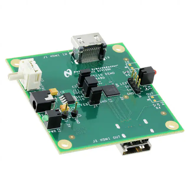

DS16EV51-AEVKH HDMI Extender Demo Kit for HDMI Cables General Description The DS16EV51-AEVKH HDMI Cable Extender Demo Kit provides a complete HDMI system extension solution using National’s DS16EV5110A - a Video Equalizer for HDMI cables. Two HDMI female connectors are used as the input and the output connections for a HDMI system. The DDC signals, Hot Plug, 5V Power and 5V Ground are directly connected between the HDMI connectors, making this demo kit HDCP compliant. A 3.3V VCC 1-pin header (J4) and a GND 1-pin header (J5) are used for the power supply. Alternately, an AC/DC power adapter (>800mA) is required for the evaluation kit to provide 5V DC voltage for easy portability. A 1.8mm DC Power Jack is used to connect the AC/DC Power Adapter. National’s LP3965, a 3.3V, 1500mA, Fast, Ultra Low Dropout Linear Regulator, converts the 5V power supply voltage to a 3.3V power supply voltage that powers the DS16EV5110A. Features • • • • • • • • • • Compatible with DTV Resolutions 480i, 480p, 720i, 720p, 1080i, 1080p, and 1080p with 12 bit deep color depth. Compatible with Computer Resolutions of VGA, SVGA, XGA, SXGA, UXGA Supports TMDS HDMI Single Link Adjustable rotary switch for easy custom EQ boost level setting to reach maximum length of TMDS Interface with Twisted Pair , HDMI, or DVI Cables Single 3.3V Supply Ultra Portable with AC/DC Power Adapter (not included in the kit) 500 mW Typical Power Consumption > 6kV ESD Rating -40 to 85C Industrial Temperature Range The DS16EV5110A demo kit extends TMDS with the 28 AWG STP HDMI cable as follows: SDTV (480p) HDTV (720p) HDTV (1080i) HDTV (1080p) HDTV (1080p) 12 bit Deep Color Depth Resolution 704 x 480 1280 x 720 1920 x1080 1920 x1080 Pixel bandwidth (MPixel/s) 60Hz LCD with 20% blanking 25 66.4 75 150 Per channel bandwidth (Gb/s) 60Hz LCD with 20% blanking 0.25 0.664 0.75 1.5 28 AWG HDMI Cable Length > 45 m > 35 m > 35 m > 25 m 1920 x1080 225 2.25 > 20 m Applications High Definition Displays and Televisions High Definition Front- Projectors LCD Computer Monitors HDMI Cable Extender Ordering Information PART: DS16EV5110ASQ HDMI Demo Board for HDMI Cables: DS16EV51-AEVKH DS16EV51-AEVKH User Guide Rev A August, 2008 © National Semiconductor Corporation 1 Typical Repeater Application HDMI Video Source DS16EV51-AEVKH High Definition Display Greater than 25 m HDMI Cable, 28 AWG STP, at 1080p Bill of Materials DESIGNATION C2, C4, C8, C10 C1, C3, C7, C9, C11 C5 C6 D1 D2 R5 R1, R2 R7 J1, J2 J3 J4, J5 J7, J8, J10, J11 J9 D3, D4, R3, R4 U1 U2 U3 DS16EV51-AEVKH User Guide Rev A August, 2008 © National Semiconductor Corporation QTY 4 5 1 1 1 1 1 2 1 2 1 2 4 1 4 1 1 1 DESCRIPTION 0.01uF +10% Ceramic Capacitor 0402 0.1uF +10% Ceramic Capacitor 0402 33uF +10% Tantalum Capacitor 3528-12 68uF +10% Tantalum Capacitor 3528-12 LED Green LED Red 0 ohm +5% Resistor 0402 453 ohm +5% Resistor 0402 10K ohm +5% Resistor 0402 HDMI Receptacle Female DC Power Jack 1.8 mm 1 pin header (J4: VDD=3.3V, J5:GND) 1X2 pin header 1X4 pin header Optional National DS16EV5110A National LP3965 – 3.3V -1500mA 94HBB08RAT Rotary Dip Switch 2 Quick Start Guide: 1. Connect 3.3V DC power to J4 and ground to J5 from the power supply. Or, plug the AC/DC power adapter to the DC power Jack AC/DC power adapter requirement: Output DC 4V~6V, Output current > 800mA 2. 3. Attach two HDMI cables to the HDMI Input and Output Connectors Turn on the DVD/Computer and the Monitor/HDTV. Adjustment and Control Description Component Name D1 PWR D2 SD J3 5V DC J4 3.3V J5 GND J7 FEB J8 CS J10, J11 SDA, SDC J9 Loop Back Control U3 Rotary Switch DS16EV51-AEVKH User Guide Rev A August, 2008 © National Semiconductor Corporation Function The LED turns on when 5V DC applies The LED turns on when the DS16EV5110A does not detect clock signal Optional DC Power Jack for 1.5 mm Adaptor Plug 3.3V VCC power supply GND Optional SMBus Control. See Datasheet. Optional SMBus Control. See Datasheet Optional SMBus access. See Datasheet Connect “LED” and “SD” to enable D2 function. Connect “SD” and “EN” to enable look back control function. When the clock signal is not detected, the DS16EV5110A sets to power down mode. Turn the switch to control the EQ boost setting. “0” on the switch refers to the boost setting of “0X00”, “7” on the switch refers to the boost setting of “0X07”. See datasheet for detail Boost setting information. 3 Schematics DS16EV51-AEVKH User Guide Rev A August, 2008 © National Semiconductor Corporation 4 Layout Considerations • • • Keep the clock and data transmission lines as short as possible with controlled 50 ohm single-ended impedance. Or, use differentially coupled traces with 100 ohm impedance. Avoid using vias on the clock and data transmission lines on the input side of the DS16EV5110A. Place power supply decoupling capacitors close to the VCC pins. DS16EV51-AEVKH User Guide Rev A August, 2008 © National Semiconductor Corporation 5 IMPORTANT NOTICE Texas Instruments Incorporated and its subsidiaries (TI) reserve the right to make corrections, modifications, enhancements, improvements, and other changes to its products and services at any time and to discontinue any product or service without notice. Customers should obtain the latest relevant information before placing orders and should verify that such information is current and complete. All products are sold subject to TI’s terms and conditions of sale supplied at the time of order acknowledgment. TI warrants performance of its hardware products to the specifications applicable at the time of sale in accordance with TI’s standard warranty. Testing and other quality control techniques are used to the extent TI deems necessary to support this warranty. Except where mandated by government requirements, testing of all parameters of each product is not necessarily performed. TI assumes no liability for applications assistance or customer product design. Customers are responsible for their products and applications using TI components. To minimize the risks associated with customer products and applications, customers should provide adequate design and operating safeguards. TI does not warrant or represent that any license, either express or implied, is granted under any TI patent right, copyright, mask work right, or other TI intellectual property right relating to any combination, machine, or process in which TI products or services are used. Information published by TI regarding third-party products or services does not constitute a license from TI to use such products or services or a warranty or endorsement thereof. Use of such information may require a license from a third party under the patents or other intellectual property of the third party, or a license from TI under the patents or other intellectual property of TI. Reproduction of TI information in TI data books or data sheets is permissible only if reproduction is without alteration and is accompanied by all associated warranties, conditions, limitations, and notices. Reproduction of this information with alteration is an unfair and deceptive business practice. TI is not responsible or liable for such altered documentation. Information of third parties may be subject to additional restrictions. Resale of TI products or services with statements different from or beyond the parameters stated by TI for that product or service voids all express and any implied warranties for the associated TI product or service and is an unfair and deceptive business practice. TI is not responsible or liable for any such statements. TI products are not authorized for use in safety-critical applications (such as life support) where a failure of the TI product would reasonably be expected to cause severe personal injury or death, unless officers of the parties have executed an agreement specifically governing such use. Buyers represent that they have all necessary expertise in the safety and regulatory ramifications of their applications, and acknowledge and agree that they are solely responsible for all legal, regulatory and safety-related requirements concerning their products and any use of TI products in such safety-critical applications, notwithstanding any applications-related information or support that may be provided by TI. Further, Buyers must fully indemnify TI and its representatives against any damages arising out of the use of TI products in such safety-critical applications. TI products are neither designed nor intended for use in military/aerospace applications or environments unless the TI products are specifically designated by TI as military-grade or "enhanced plastic." Only products designated by TI as military-grade meet military specifications. Buyers acknowledge and agree that any such use of TI products which TI has not designated as military-grade is solely at the Buyer's risk, and that they are solely responsible for compliance with all legal and regulatory requirements in connection with such use. TI products are neither designed nor intended for use in automotive applications or environments unless the specific TI products are designated by TI as compliant with ISO/TS 16949 requirements. Buyers acknowledge and agree that, if they use any non-designated products in automotive applications, TI will not be responsible for any failure to meet such requirements. Following are URLs where you can obtain information on other Texas Instruments products and application solutions: Products Applications Audio www.ti.com/audio Automotive and Transportation www.ti.com/automotive Amplifiers amplifier.ti.com Communications and Telecom www.ti.com/communications Data Converters dataconverter.ti.com Computers and Peripherals www.ti.com/computers DLP® Products www.dlp.com Consumer Electronics www.ti.com/consumer-apps DSP dsp.ti.com Energy and Lighting www.ti.com/energy Clocks and Timers www.ti.com/clocks Industrial www.ti.com/industrial Interface interface.ti.com Medical www.ti.com/medical Logic logic.ti.com Security www.ti.com/security Power Mgmt power.ti.com Space, Avionics and Defense www.ti.com/space-avionics-defense Microcontrollers microcontroller.ti.com Video and Imaging www.ti.com/video RFID www.ti-rfid.com OMAP Mobile Processors www.ti.com/omap Wireless Connectivity www.ti.com/wirelessconnectivity TI E2E Community Home Page e2e.ti.com Mailing Address: Texas Instruments, Post Office Box 655303, Dallas, Texas 75265 Copyright © 2012, Texas Instruments Incorporated
