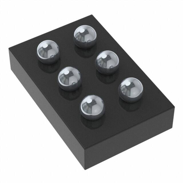

INA191, INA2191 SLYS020C – FEBRUARY 2019 – REVISED AUGUST 2021 INAx191 40-V, Bidirectional, Ultra-Precise Current Sense Amplifier With picoamp IB and ENABLE in WCSP Package 1 Features 3 Description • The INAx191 is a low-power, voltage-output, current-shunt monitor (also called a current-sense amplifier) that is commonly used for overcurrent protection, precision-current measurement for system optimization, or in closed-loop feedback circuits. This device can sense drops across shunts at commonmode voltages from –0.2 V to +40 V, independent of the supply voltage. The low input bias current of the INAx191 permits the use of larger currentsense resistors, and thus provides accurate current measurements in the µA range. Five fixed gains are available: 25 V/V, 50 V/V, 100 V/V, 200 V/V, or 500 V/V. The low offset voltage of the zero-drift architecture extends the dynamic range of the current measurement, and allows for smaller sense resistors with lower power loss while still providing accurate current measurements. • • • • • • Low power: – Supply voltage, VS: 1.7 V to 5.5 V – Shutdown current: 100 nA (max INA191) – Quiescent current: 43 μA at 25 °C (INA191) Low input bias currents: 100 pA (typical) (enables microamp current measurement) Bidirectional current measurement (INA2191) Accuracy: – ±0.25% max gain error (A2 to A5 devices) – 7-ppm/°C gain drift (maximum) – ±12 μV (maximum) offset voltage – 0.13-μV/°C offset drift (maximum) Wide common-mode voltage: –0.2 V to +40 V Gain options: – INAx191A1: 25 V/V – INAx191A2: 50 V/V – INAx191A3: 100 V/V – INAx191A4: 200 V/V – INAx191A5: 500 V/V Packages: – INA191: 0.895-mm2 DSBGA – INA2191: 1.79-mm2 DSBGA 2 Applications • • • • • • Notebook computers Cell phones Battery-powered devices Telecom equipment Power management Battery chargers Bus Voltage up to 40 V 100 pA (typical) The INA191 operates from a single 1.7-V to 5.5V power supply, drawing a maximum of 65 µA of supply current when enabled and only 100 nA when disabled. The device is specified over the operating temperature range of –40 °C to +125 °C, and offered in a DSBGA-6 (INA191) and DSBGA-12 (INA2191) packages. Device Information(1) PART NUMBER PACKAGE BODY SIZE (NOM) INA191 DSBGA (6) 1.17 mm × 0.765 mm INA2191 DSBGA (12) 1.17 mm × 1.53 mm (1) For all available packages, see the package option addendum at the end of the data sheet. Supply Voltage 1.7 V to 5.5 V RSENSE LOAD 0.1 …F 100 pA (typical) ENABLE VS IN± INA191 OUT INA2191 (½) IN+ ADC Microcontroller REF(1) GND (1) REF pin only available on INA2191 Simplified Schematic An IMPORTANT NOTICE at the end of this data sheet addresses availability, warranty, changes, use in safety-critical applications, intellectual property matters and other important disclaimers. PRODUCTION DATA. INA191, INA2191 www.ti.com SLYS020C – FEBRUARY 2019 – REVISED AUGUST 2021 Table of Contents 1 Features............................................................................1 2 Applications..................................................................... 1 3 Description.......................................................................1 4 Revision History.............................................................. 2 5 Pin Configuration and Functions...................................3 6 Specifications.................................................................. 5 6.1 Absolute Maximum Ratings ....................................... 5 6.2 ESD Ratings .............................................................. 5 6.3 Recommended Operating Conditions ........................5 6.4 Thermal Information ...................................................5 6.5 Electrical Characteristics ............................................6 6.6 Typical Characteristics................................................ 8 7 Detailed Description......................................................15 7.1 Overview................................................................... 15 7.2 Functional Block Diagram......................................... 15 7.3 Feature Description...................................................16 7.4 Device Functional Modes..........................................18 8 Application and Implementation.................................. 22 8.1 Application Information............................................. 22 8.2 Typical Application.................................................... 27 9 Power Supply Recommendations................................28 10 Layout...........................................................................29 10.1 Layout Guidelines................................................... 29 10.2 Layout Examples.................................................... 29 11 Device and Documentation Support..........................31 11.1 Documentation Support.......................................... 31 11.2 Receiving Notification of Documentation Updates.. 31 11.3 Support Resources................................................. 31 11.4 Trademarks............................................................. 31 11.5 Electrostatic Discharge Caution.............................. 31 11.6 Glossary.................................................................. 31 12 Mechanical, Packaging, and Orderable Information.................................................................... 31 4 Revision History Changes from Revision B (February 2021) to Revision C (August 2021) Page • Changed data sheet status from Production Mixed to Production Data............................................................. 1 • Changed INA2191 device status from Advanced Information to Production Data ............................................ 1 • Added INA191 and INA2191 test conditions to gain error, gain error drift, swing to VS, and enable logic parameters..........................................................................................................................................................6 • Changed INA191 and INA2191 test conditions for output leakage disabled parameters...................................6 • Changed INA2191 values for the quiescent current parameters for production data.........................................6 • Changed the Typical Characteristics section......................................................................................................8 • Changed INA2191 information in the Low Quiescent Current With Output Enable section............................. 16 • Changed INA2191 information in the Unidirectional Mode section.................................................................. 18 • Changed Figure 8-3 and the filtering information in the Signal Conditioning section....................................... 24 Changes from Revision A (April 2019) to Revision B (February 2021) Page • Changed data sheet status from Production Data to Production Mixed............................................................. 1 • Added Advanced Information INA2191 device to the data sheet....................................................................... 1 Changes from Revision * (February 2019) to Revision A (April 2019) Page • Changed device from advanced information to production data (active)............................................................1 2 Submit Document Feedback Copyright © 2021 Texas Instruments Incorporated Product Folder Links: INA191 INA2191 INA191, INA2191 www.ti.com SLYS020C – FEBRUARY 2019 – REVISED AUGUST 2021 5 Pin Configuration and Functions 1 2 3 A IN+ VS OUT B IN± GND ENABLE Not to scale Figure 5-1. INA191 YFD Package 6-Pin DSBGA Top View Table 5-1. Pin Functions (INA191) PIN NAME NO. TYPE DESCRIPTION Enable pin. When this pin is driven to VS, the device is on and functions as a current sense amplifier. When this pin is driven to GND, the device is off, the supply current is reduced, and the output is placed in a high-impedance state. This pin must be driven externally, or connected to VS if not used. ENABLE B3 Digital input GND B2 Analog IN+ A1 Analog input Current-shunt monitor positive input. For high-side applications, connect this pin to the bus voltage side of the sense resistor. For low-side applications, connect this pin to the load side of the sense resistor. IN– B1 Analog input Current-shunt monitor negative input. For high-side applications, connect this pin to the load side of the sense resistor. For low-side applications, connect this pin to the ground side of the sense resistor. OUT A3 Analog output VS A2 Analog Ground. This pin provides an analog voltage output that is the amplified voltage difference from the IN+ to the IN– pins. Power supply, 1.7 V to 5.5 V. Submit Document Feedback Copyright © 2021 Texas Instruments Incorporated Product Folder Links: INA191 INA2191 3 INA191, INA2191 www.ti.com SLYS020C – FEBRUARY 2019 – REVISED AUGUST 2021 1 2 3 A IN+1 VS OUT1 B IN-1 EN1 REF1 C IN-2 EN2 REF2 D IN+2 GND OUT2 Figure 5-2. INA2191 YBJ Package 12-Pin DSBGA Top View Table 5-2. Pin Functions (INA2191) PIN 4 TYPE DESCRIPTION B2 Digital input Enable pin for output 1. When this pin is driven to VS, channel 1 is on and functions as a current sense amplifier. When both enable pins are driven to GND, the device is off and the supply current is reduced. This pin must be driven externally, or connected to VS if not used. ENABLE2 C2 Digital input Enable pin for output 2. When this pin is driven to VS, channel 2 is on and functions as a current sense amplifier. When both enable pins are driven to GND, the device is off and the supply current is reduced. This pin must be driven externally, or connected to VS if not used. GND D2 Analog IN+1 A1 Analog input Current-shunt monitor positive input for channel 1. For high-side applications, connect this pin to the bus voltage side of the sense resistor. For low-side applications, connect this pin to the load side of the sense resistor. IN+2 D1 Analog input Current-shunt monitor positive input for channel 2. For high-side applications, connect this pin to the bus voltage side of the sense resistor. For low-side applications, connect this pin to the load side of the sense resistor. IN–1 B1 Analog input Current-shunt monitor negative input for channel 1. For high-side applications, connect this pin to the load side of the sense resistor. For low-side applications, connect this pin to the ground side of the sense resistor. IN–2 C1 Analog input Current-shunt monitor negative input for channel 2. For high-side applications, connect this pin to the load side of the sense resistor. For low-side applications, connect this pin to the ground side of the sense resistor. OUT1 A3 Analog output This pin provides an analog voltage output that is the amplified voltage difference from the IN+1 to the IN–1 pins, and is offset by the voltage applied to the REF1 pin. OUT2 D3 Analog output This pin provides an analog voltage output that is the amplified voltage difference from the IN+2 to the IN–2 pins, and is offset by the voltage applied to the REF2 pin. REF1 B3 Analog input Reference input for channel 1. Enables bidirectional current sensing for channel 1 with an externally applied voltage. REF2 C3 Analog input Reference input for channel 2. Enables bidirectional current sensing for channel 2 with an externally applied voltage. VS A2 Analog NAME NO. ENABLE1 Ground. Power supply, 1.7 V to 5.5 V. Submit Document Feedback Copyright © 2021 Texas Instruments Incorporated Product Folder Links: INA191 INA2191 INA191, INA2191 www.ti.com SLYS020C – FEBRUARY 2019 – REVISED AUGUST 2021 6 Specifications 6.1 Absolute Maximum Ratings over operating free-air temperature range (unless otherwise noted)(1) MIN VS MAX Supply voltage )(2) Differential (VIN+) – (VIN– VIN+, VIN– Analog inputs VENABLE VIN+, VIN–, with respect to GND(3) –42 42 GND – 0.3 42 ENABLE GND – 0.3 6 REF, OUT(3) GND – 0.3 (VS) + 0.3 Input current into any pin(3) TA Operating temperature TJ Junction temperature Tstg Storage temperature (1) (2) (3) UNIT 6 –55 –65 V V V V 5 mA 150 °C 150 °C 150 °C Stresses beyond those listed under Absolute Maximum Ratings may cause permanent damage to the device. These are stress ratings only, which do not imply functional operation of the device at these or any other conditions beyond those indicated under Recommended Operating Conditions. Exposure to absolute-maximum-rated conditions for extended periods may affect device reliability. VIN+ and VIN– are the voltages at the IN+ and IN– pins, respectively. Input voltage at any pin may exceed the voltage shown if the current at that pin is limited to 5 mA. 6.2 ESD Ratings VALUE V(ESD) (1) (2) Electrostatic discharge Human-body model (HBM), per ANSI/ESDA/JEDEC JS-001(1) ±2000 Charged-device model (CDM), per JEDEC specification JESD22-C101(2) ±1000 UNIT V JEDEC document JEP155 states that 500-V HBM allows safe manufacturing with a standard ESD control process. JEDEC document JEP157 states that 250-V CDM allows safe manufacturing with a standard ESD control process. 6.3 Recommended Operating Conditions over operating free-air temperature range (unless otherwise noted) MIN NOM MAX UNIT VCM Common-mode input range – 0.2 40 V VIN+, VIN– Input pin voltage range – 0.2 40 V VS Operating supply voltage 1.7 5.5 V VREF Reference pin voltage range 0 VS V TA Operating free-air temperature –40 125 °C 6.4 Thermal Information THERMAL METRIC(1) INA191 INA2191 YFD (DSBGA) YBJ (DSBGA) 6 PINS 12 PINS 141.4 94.1 °C/W UNIT RθJA Junction-to-ambient thermal resistance RθJC(top) Junction-to-case (top) thermal resistance 1.1 0.6 °C/W RθJB Junction-to-board thermal resistance 45.7 23.8 °C/W ΨJT Junction-to-top characterization parameter 0.4 0.3 °C/W ΨJB Junction-to-board characterization parameter 45.3 23.8 °C/W RθJC(bot) Junction-to-case (bottom) thermal resistance N/A N/A °C/W (1) For more information about traditional and new thermal metrics, see the Semiconductor and IC Package Thermal Metrics application report. Submit Document Feedback Copyright © 2021 Texas Instruments Incorporated Product Folder Links: INA191 INA2191 5 INA191, INA2191 www.ti.com SLYS020C – FEBRUARY 2019 – REVISED AUGUST 2021 6.5 Electrical Characteristics at TA = 25°C, VSENSE = VIN+ – VIN–, VS = 1.8 V to 5.0 V, VIN+ = 12 V, VREF = VS / 2 (INA2191), and VENABLE = VS (unless otherwise noted) PARAMETER CONDITIONS MIN TYP 132 150 MAX UNIT INPUT CMRR Common-mode rejection ratio, RTI(1) RTI(1) VIN+ = –0.1 V to 40 V, TA = –40°C to +125°C VOS Offset voltage, dVOS/dT Offset drift, RTI VS = 1.8 V PSRR Power-supply rejection VS = 1.7 V to 5.5 V ratio, RTI IIB Input bias current IIO Input offset current dB –2.5 ±12 µV 10 130 nV/°C –1 ±5 µV/V VSENSE = 0 mV 0.1 3 nA VSENSE = 0 mV ±0.07 TA = –40°C to +125°C nA OUTPUT G Gain A1 devices 25 A2 devices 50 A3 devices 100 A4 devices 200 A5 devices EG RVRR Gain error 500 VOUT = 0.1 V to VS – 0.1 V Gain error drift TA = –40°C to +125°C Nonlinearity error VOUT = 0.1 V to VS – 0.1 V Reference voltage rejection ratio INA2191 only, VREF = 100 mV to VS – 100 mV, TA = –40°C to +125°C A1 devices, INA191 –0.17% ±0.35% A1 devices, INA2191 +0.05% ±0.25% A2, A3, A4, A5 devices –0.04% ±0.25% 2 7 ppm/°C ±0.01% A1 devices ±2 ±12 A2 devices ±1 ±6 A3 devices ±0.5 ±4 ±0.25 ±3 A4, A5 devices Maximum capacitive load V/V No sustained oscillation 1 µV/V nF VOLTAGE OUTPUT VSP Swing to VS powersupply rail VS = 1.8 V, RL = 10 kΩ to GND, TA = –40°C to +125°C (VS) – 23 (VS) – 40 mV VSN Swing to GND VS = 1.8 V, RL = 10 kΩ to GND, TA = –40°C to +125°C, VSENSE = –10 mV, VREF = 0 V (INA2191) (VGND) + 0.05 (VGND) + 1 mV A1, A2, A3 devices VS = 1.8 V, RL = 10 kΩ to GND, TA = –40°C to +125°C, VSENSE = 0 mV, A4 devices for INA2191 VREF = 0 V A5 devices (VGND) + 3 mV Zero current output voltage (VGND) + 1 VZL (VGND) + 2 (VGND) + 4 mV (VGND) + 3 (VGND) + 7 mV FREQUENCY RESPONSE BW Bandwidth CLOAD = 10 pF A1 devices 45 A2 devices 37 A3 devices 35 A4 devices 33 A5 devices 6 kHz 27 SR Slew rate VS = 5.0 V, VOUT = 0.5 V to 4.5 V 0.3 V/µs tS Settling time From current step to within 1% of final value 30 µs Submit Document Feedback Copyright © 2021 Texas Instruments Incorporated Product Folder Links: INA191 INA2191 INA191, INA2191 www.ti.com SLYS020C – FEBRUARY 2019 – REVISED AUGUST 2021 at TA = 25°C, VSENSE = VIN+ – VIN–, VS = 1.8 V to 5.0 V, VIN+ = 12 V, VREF = VS / 2 (INA2191), and VENABLE = VS (unless otherwise noted) PARAMETER CONDITIONS MIN TYP MAX UNIT NOISE, RTI(1) Voltage noise density 75 nV/√Hz ENABLE IEN Leakage input current 100 nA VIH High-level input voltage TA = –40°C to +125°C 1.35 5.5 V VIL Low-level input voltage TA = –40°C to +125°C 0 0.4 VHYS Hysteresis IODIS 0 V ≤ VENABLE ≤ VS 1 100 V mV Output leakage disabled VS = 1.8 V, VOUT = 0 V to 1.8 V, VENABLE = 0 V 1 5 µA Output leakage disabled (INA2191) VS = 5 V, VOUT = 0 V to 5.0 V, VENABLE = 0 V 1 5 µA 43 65 µA 85 µA 130 µA 180 µA POWER SUPPLY IQ Quiescent current (INA191) VS = 1.8 V, VSENSE = 0 mV Quiescent current (INA2191) VS = 1.8 V, VSENSE = 0 mV (Dual Channel) VS = 1.8 V, VSENSE = 0 mV, TA = –40°C to +125°C 96 VS = 1.8 V, VSENSE = 0 mV, TA = –40°C to +125°C IQDIS Quiescent current disabled (INA191) VENABLE < 0.4 V, VSENSE = 0 mV (Single Channel) 10 100 nA IQDIS Quiescent current disabled (INA2191) VENABLE1 < 0.4 V, VENABLE2 = < 0.4 V, VSENSE = 0 mV 20 200 nA (1) RTI = referred-to-input. Submit Document Feedback Copyright © 2021 Texas Instruments Incorporated Product Folder Links: INA191 INA2191 7 INA191, INA2191 www.ti.com SLYS020C – FEBRUARY 2019 – REVISED AUGUST 2021 6.6 Typical Characteristics at TA = 25 °C, VS = 1.8 V, VIN+ = 12 V, VENABLE = VS, VREF = GND and all gain options (unless otherwise noted) 15 Population Offset Voltage (PV) 10 5 0 -5 -12 -10.8 -9.6 -8.4 -7.2 -6 -4.8 -3.6 -2.4 -1.2 0 1.2 2.4 3.6 4.8 6 7.2 8.4 9.6 10.8 12 -10 Input Offset Voltage (PV) -15 -50 D118 Figure 6-1. Input Offset Voltage Production Distribution 25 50 75 Temperature (qC) 100 125 150 D006 0.1 Common-Mode Rejection Ratio (PV/V) 30000 27000 24000 21000 18000 15000 12000 9000 6000 3000 -0.25 -0.225 -0.2 -0.175 -0.15 -0.125 -0.1 -0.075 -0.05 -0.025 0 0.025 0.05 0.075 0.1 0.125 0.15 0.175 0.2 0.225 0.25 0 D119 0.08 0.06 0.04 0.02 0 -0.02 -0.04 -0.06 -0.08 -0.1 -50 -25 Common-Mode Rejection Ratio (PV/V) 0 25 50 75 Temperature (qC) 100 125 150 D012 Figure 6-4. Common-Mode Rejection Ratio vs. Temperature D116 -0.25 -0.225 -0.2 -0.175 -0.15 -0.125 -0.1 -0.075 -0.05 -0.025 0 0.025 0.05 0.075 0.1 0.125 0.15 0.175 0.2 0.225 0.25 -0.35 -0.33 -0.31 -0.29 -0.27 -0.25 -0.23 -0.21 -0.19 -0.17 -0.15 -0.13 -0.11 -0.09 -0.07 -0.05 -0.03 -0.01 0.01 0.03 0.05 Population Population Figure 6-3. Common-Mode Rejection Production Distribution Gain Error (%) Gain Error (%) A1 Devices A1 devices Figure 6-5. Gain Error Production Distribution (INA191) 8 0 Figure 6-2. Offset Voltage vs. Temperature 33000 Population -25 Figure 6-6. Gain Error Production Distribution (INA2191) Submit Document Feedback Copyright © 2021 Texas Instruments Incorporated Product Folder Links: INA191 INA2191 INA191, INA2191 www.ti.com SLYS020C – FEBRUARY 2019 – REVISED AUGUST 2021 0.2 0.16 0.12 Population Gain Error (%) 0.08 0.04 0 -0.04 -0.08 -0.12 -0.25 -0.225 -0.2 -0.175 -0.15 -0.125 -0.1 -0.075 -0.05 -0.025 0 0.025 0.05 0.075 0.1 0.125 0.15 0.175 0.2 0.225 0.25 -0.16 -0.2 -50 -25 0 25 50 75 Temperature (qC) D117 100 125 150 D018 Gain Error (%) Figure 6-8. Gain Error vs. Temperature A2, A3, A4, A5 devices Figure 6-7. Gain Error Production Distribution 60 140 Power-Supply Rejection Ratio (dB) 50 Gain (dB) 40 30 20 10 0 -10 -20 10 A1 A2 A3 A4 A5 100 1k 10k Frequency (Hz) 100k 120 100 80 60 40 20 0 10 1M 100 1k 10k Frequency (Hz) D019 VS = 5 V 1M D020 VS = 5 V Figure 6-9. Gain vs. Frequency Figure 6-10. Power-Supply Rejection Ratio vs. Frequency Vs 160 140 -40°C 25°C 125°C Vs-0.4 120 100 80 Vs-0.8 Y Output Swing (V) Common-Mode Rejection Ratio (dB) 100k GND+0.8 GND+0.4 60 GND 40 10 0 100 1k 10k Frequency (Hz) 100k 1 1M 3 4 5 6 7 Output Current (mA) 8 9 10 11 D010 VS = 1.8 V D021 Figure 6-11. Common-Mode Rejection Ratio vs. Frequency 2 Figure 6-12. Output Voltage Swing vs. Output Current Submit Document Feedback Copyright © 2021 Texas Instruments Incorporated Product Folder Links: INA191 INA2191 9 INA191, INA2191 www.ti.com SLYS020C – FEBRUARY 2019 – REVISED AUGUST 2021 Vs 0.2 0.15 Input Bias Current (nA) Vs-1 Vs-2 Y Output Swing (V) 0.25 -40°C 25°C 125°C GND+2 GND+1 0.1 0.05 0 -0.05 -0.1 -0.15 -0.2 GND 0 5 10 15 20 25 Output Current (mA) 30 35 -0.25 0 D009 5 10 VS = 5.0 V Figure 6-13. Output Voltage Swing vs. Output Current 0.2 6 Input Bias Current (nA) Input Bias Current (nA) 0.15 0 -0.05 -0.1 -0.15 D024 5 4 3 2 1 0 -0.2 -0.25 0 5 10 15 20 25 30 Common-Mode Voltage (V) 35 -1 -50 40 -25 0 D025 VENABLE = 0 V, VSENSE = 0 V 125 150 D026 90 VS = 1.8V VS = 3.3V VS = 5V 80 Quiescent Current (PA) 60 100 Figure 6-16. Input Bias Current vs. Temperature 70 65 25 50 75 Temperature (qC) VSENSE = 0 V Figure 6-15. Input Bias Current vs. Common-Mode Voltage (Shutdown) Quiescent Current (PA) 40 Figure 6-14. Input Bias Current vs. Common-Mode Voltage 7 0.05 35 VS = 5.0 V, VSENSE = 0 V 0.25 0.1 15 20 25 30 Common-Mode Voltage (V) 55 50 45 40 35 VS = 1.8V VS = 3.3V VS = 5V 70 60 50 40 30 25 -50 30 -50 -25 0 25 50 75 Temperature (qC) 100 125 D101 VENABLE = VS Figure 6-17. Quiescent Current vs. Temperature (INA191) 10 -25 150 0 25 50 75 Temperature (qC) 100 125 150 Single channel enabled, VREF = VS /2 Figure 6-18. Quiescent Current vs. Temperature (INA2191 ) Submit Document Feedback Copyright © 2021 Texas Instruments Incorporated Product Folder Links: INA191 INA2191 INA191, INA2191 www.ti.com SLYS020C – FEBRUARY 2019 – REVISED AUGUST 2021 240 160 Quiescent Current (PA) 140 VS = 1.8V VS = 3.3V VS = 5V 210 180 Quiescent Current (nA) 150 130 120 110 100 90 80 150 120 90 60 30 70 60 -50 VS = 1.8 V VS = 3.3 V VS = 5.0 V 0 -25 0 25 50 75 Temperature (qC) 100 125 -30 -50 150 -25 0 25 50 75 Temperature (qC) VENABLE1 = VENABLE2 = VS , VREF = VS /2 Quiescent Current (PA) Quiescent Current (PA) VS = 1.8V VS = 5V 55 200 150 100 50 0 50 45 40 35 -25 0 25 50 75 Temperature (qC) 100 125 30 -5 150 0 VENABLE1 = VENABLE2 = 0 V, VREF = VS /2 Figure 6-21. Quiescent Current vs. Temperature (INA2191 Disabled) 5 10 15 20 25 30 Common-Mode Voltage (V) 35 40 D103 Figure 6-22. Quiescent Current vs. Common-Mode Voltage (INA191) 120 110 105 100 95 0 5 10 15 20 25 Common-Mode Voltage (V) 30 35 40 VREF = VS /2 Figure 6-23. Quiescent Current vs. Common-Mode Voltage (INA2191) Input-Referred Voltage Noise (nV/—Hz) 500 VS = 1.8V VS = 5V 115 Quiescent Current (PA) D002 60 VS = 1.8V VS = 3.3V VS = 5V 250 90 -5 150 Figure 6-20. Quiescent Current vs. Temperature (INA191 Disabled) 350 -50 -50 125 VENABLE = 0 V Figure 6-19. Quiescent Current vs. Temperature (INA2191 ) 300 100 300 200 100 70 50 30 20 10 10 100 1k Frequency (Hz) 10k 100k Figure 6-24. Input-Referred Voltage Noise vs. Frequency Submit Document Feedback Copyright © 2021 Texas Instruments Incorporated Product Folder Links: INA191 INA2191 11 INA191, INA2191 www.ti.com Input Voltage 5 mV/div Referred-to-Input Voltage Noise (0.5 PV/div) Output Voltage 500 mV/div SLYS020C – FEBRUARY 2019 – REVISED AUGUST 2021 0V 0V Time (20Ps/div) Time (1 s/div) D111 D031 VS = 5.0 V, 10-mVPP input step Figure 6-25. 0.1-Hz to 10-Hz Input-Referred Voltage Noise Figure 6-26. Step Response Inverting Input Output VCM VOUT 50 40 20 10 0 -10 -20 Voltage (1 V/div) 30 VOUT (250 mV/div) Common-Mode Voltage (10 V/div) 60 -30 -40 0V -50 -60 Time (500 Ps/div) Time (20 Ps/div) D114 Figure 6-27. Common-Mode Voltage Transient Response Figure 6-28. Inverting Differential Input Overload Recovery Voltage (1V/div) Supply Voltage Output Voltage Voltage (1 V/div) Noninverting Input Output 0V 0V Time (20 Ps/div) Time (10Ps/div) D113 D108 VS = 5.0 V VS = 5.0 V, A2 device Figure 6-29. Noninverting Differential Input Overload Recovery 12 Figure 6-30. Start-Up Response Submit Document Feedback Copyright © 2021 Texas Instruments Incorporated Product Folder Links: INA191 INA2191 INA191, INA2191 www.ti.com SLYS020C – FEBRUARY 2019 – REVISED AUGUST 2021 Enable Output Voltage (1 V/div) Voltage (1 V/div) Supply Voltage Output Voltage 0V 0V Time (250 Ps/div) Time (100Ps/div) D021 D110 VS = 5.0 V, A3 device VS = 5.0 V, A3 device Figure 6-32. Enable and Disable Response Figure 6-31. Brownout Recovery 30 120 IBN IBP 100 20 60 Input Bias Current (nA) Input Bias Current (nA) 80 IBP IBN 40 20 0 -20 -40 -60 -80 10 0 -10 -20 -100 -120 -30 0 20 40 60 80 100 120 140 160 Differential Input Voltage (mV) 180 200 0 5 VS = 5.0 V, A1 device 15 20 25 30 35 40 Differential Input Voltage (mV) 45 50 55 D007 VS = 5.0 V, A2, A3, A4, A5 devices Figure 6-33. IB+ and IB– vs. Differential Input Voltage (INA191) Figure 6-34. IB+ and IB– vs. Differential Input Voltage (INA191) 120 35 IBN IBP 100 60 40 20 0 -20 -40 -60 IBN IBP 25 Input Bias Current (nA) 80 Input Bias Current (nA) 10 D120 15 5 -5 -15 -25 -80 -100 -120 -110 -90 -70 -50 -30 -10 10 30 50 Differential Input Voltage (mV) 70 90 110 -35 -60 -40 -20 0 20 Differential Input Voltage (mV) 40 60 VS = 5.0 V, VREF = VS /2, A2, A3, A4, A5 devices VS = 5.0 V, VREF = VS /2, A1 device Figure 6-35. IB+ and IB– vs. Differential Input Voltage (INA2191) Figure 6-36. IB+ and IB– vs. Differential Input Voltage (INA2191) Submit Document Feedback Copyright © 2021 Texas Instruments Incorporated Product Folder Links: INA191 INA2191 13 INA191, INA2191 www.ti.com SLYS020C – FEBRUARY 2019 – REVISED AUGUST 2021 5.5 2.75 -40qC 25qC 125qC 2.25 -40qC 25qC 125qC 5 Output Leakage Current (PA) Output Leakage Current (PA) 2.5 2 1.75 1.5 1.25 1 0.75 0.5 4.5 4 3.5 3 2.5 2 1.5 1 0.5 0.25 0 0 0 0.5 1 1.5 2 2.5 3 3.5 Output Voltage (V) 4 4.5 0 5 2 2.5 3 3.5 Output Voltage (V) 4 4.5 5 D107 Figure 6-38. Output Leakage vs. Output Voltage 1.25 3 -40qC 25qC 125qC 0.75 25qC -40qC 125qC 2.5 Output Leakage Current (PA) 1 Output Leakage Current (PA) 1.5 VS = 5.0 V, VENABLE = 0 V, A4, A5 devices Figure 6-37. Output Leakage vs. Output Voltage 0.5 0.25 0 -0.25 -0.5 -0.75 2 1.5 1 0.5 0 -0.5 -1 -1.5 -2 -1 0 0.5 1 1.5 2 2.5 3 3.5 Output Voltage (V) 4 4.5 -2.5 5 0 1 1.5 2 2.5 3 3.5 Output Voltage (V) 4 4.5 5 D048 VS = 5.0 V, VENABLE = 0 V, VREF = 2.5 V, A4, A5 devices Figure 6-39. Output Leakage vs. Output Voltage (INA2191) Figure 6-40. Output Leakage vs. Output Voltage (INA2191) 160 5000 A4 A3 100 10 A1 1 100 1k A2 10k 100k Frequency (Hz) Gain Variants A1 A2 A3 A4 A5 1M VS = 5.0 V, VCM = 0 V 10M Channel Separation (dB) A5 1000 0.1 10 0.5 D040 VS = 5.0 V, VENABLE = 0 V, VREF = 2.5 V, A1, A2, A3 devices Output Impedance (:) 1 D105 VS = 5.0 V, VENABLE = 0 V, A1, A2, A3 devices 140 120 100 80 60 10 100 1k Frequency (Hz) 10k 100k VS = 5.0 V, VCM = 0 V, VREF = VS /2 Figure 6-41. Output Impedance vs. Frequency 14 0.5 Figure 6-42. Channel Separation vs. Frequency (INA2191) Submit Document Feedback Copyright © 2021 Texas Instruments Incorporated Product Folder Links: INA191 INA2191 INA191, INA2191 www.ti.com SLYS020C – FEBRUARY 2019 – REVISED AUGUST 2021 7 Detailed Description 7.1 Overview The INAx191 is a low bias current, 40-V common-mode, current-sensing amplifier with an enable pin. When disabled, the output goes to a high-impedance state, and the supply current draw is reduced to less than 0.1 µA per channel. The INAx191 is intended for use in either low-side and high-side current-sensing configurations where high accuracy and low current consumption are required. The INAx191 is a specially designed currentsensing amplifier, that accurately measure voltages developed across current-sensing resistors on commonmode voltages that far exceed the supply voltage. Current can be measured on input voltage rails as high as 40 V, with a supply voltage (VS) as low as 1.7 V. 7.2 Functional Block Diagram VS ENABLE INA191 IN+ + ± ± + ± OUT + IN± GND Figure 7-1. INA191 Diagram VS INA2191 ENABLE1 IN+1 + ± ± ± + + OUT1 IN±1 REF1 ENABLE2 IN+2 + ± ± + ± OUT2 + IN±2 REF2 GND Figure 7-2. INA2191 Diagram Submit Document Feedback Copyright © 2021 Texas Instruments Incorporated Product Folder Links: INA191 INA2191 15 INA191, INA2191 SLYS020C – FEBRUARY 2019 – REVISED AUGUST 2021 www.ti.com 7.3 Feature Description 7.3.1 Precision Current Measurement The INAx191 provides accurate current measurements over a wide dynamic range. The high accuracy of the device is attributable to the low gain error and offset specifications. The offset voltage of the INAx191 is less than 12 µV. In this case, the low offset improves the accuracy at light loads when VIN+ approaches VIN–. Another advantage of low offset is the ability to use a lower-value shunt resistor that reduces the power loss in the current-sense circuit, and improves the power efficiency of the end application. The maximum gain error of the INAx191 is specified to be within 0.25% for most gain options. As the sensed voltage becomes much larger than the offset voltage, the gain error becomes the dominant source of error in the current-sense measurement. When the device monitors currents near the full-scale output range, the total measurement error approaches the value of the gain error. 7.3.2 Low Input Bias Current The INAx191 is different from many current-sense amplifiers because this device offers very low input bias current. The low input bias current of the INAx191 has three primary benefits. The first benefit is the reduction of the current consumed by the device in both the enabled and disabled states. Classical current-sense amplifier topologies typically consume tens of microamps of current at the inputs. For these amplifiers, the input current is the result of the resistor network that sets the gain and additional current to bias the input amplifier. To reduce the bias current to near zero, the INAx191 uses a capacitively coupled amplifier on the input stage, followed by a difference amplifier on the output stage. The second benefit of low bias current is the ability to use input filters to reject high-frequency noise before the signal is amplified. In a traditional current-sense amplifier, the addition of input filters comes at the cost of reduced accuracy. However, as a result of the low bias currents, input filters have little effect on the measurement accuracy of the INAx191. The third benefit of low bias current is the ability to use a larger current-sense resistor. This ability allows the device to accurately monitor currents as low as 1 µA. 7.3.3 Low Quiescent Current With Output Enable The device features low quiescent current (IQ), while still providing sufficient small-signal bandwidth to be usable in most applications. The quiescent current of the INA191 is only 43 µA (typical), while providing a small-signal bandwidth of 35 kHz in a gain of 100. The low IQ and good bandwidth allow the device to be used in many portable electronic systems without excessive drain on the battery. Because many applications only need to periodically monitor current, the INAx191 features an enable pin for each output that turns off the device until needed. When in the disabled state, the INAx191 typically draws 10 nA of total supply current per channel. 7.3.4 Bidirectional Current Monitoring (INA2191 Only) The INA2191 can sense current flow through a sense resistor in both directions. The bidirectional currentsensing capability is achieved by applying a voltage at the REF pin to offset the desired output voltage. A positive differential voltage sensed at the inputs results in an output voltage that is greater than the applied reference voltage. Likewise, a negative differential voltage at the inputs results in output voltage that is less than the applied reference voltage. The output voltage of the current-sense amplifier is shown in Equation 1. Equation variables such as VOUT are valid for either VOUT1 or VOUT2 depending on which channel used. VOUT I LOAD u RSENSE u GAIN VREF (1) where • • • • 16 ILOAD is the load current to be monitored. RSENSE is the current-sense resistor. GAIN is the gain option of the selected device. VREF is the voltage applied to the REF pin. Submit Document Feedback Copyright © 2021 Texas Instruments Incorporated Product Folder Links: INA191 INA2191 INA191, INA2191 www.ti.com SLYS020C – FEBRUARY 2019 – REVISED AUGUST 2021 7.3.5 High-Side and Low-Side Current Sensing The INAx191 supports input common-mode voltages from –0.2 V to +40 V. Because of the internal topology, the common-mode range is not restricted by the power-supply voltage (VS). The ability to operate with commonmode voltages greater or less than VS allows the INAx191 to be used in high-side and low-side current-sensing applications, as shown in Figure 7-3. Bus Suppl y up to +40 V IN+ R SENS E High-Side Se nsing Commo n-mode volta ge (VCM ) is b us-voltage depen dent. IN± LOA D IN+ R SENS E Low-Side Se nsing Commo n-mode volta ge (VCM ) is a lwa ys n ear groun d a nd is isolated fro m bus-voltage sp ikes. IN± Figure 7-3. High-Side and Low-Side Sensing Connections 7.3.6 High Common-Mode Rejection The INAx191 uses a capacitively coupled amplifier on the front end. Therefore, dc common-mode voltages are blocked from downstream circuits, resulting in very high common-mode rejection. The common-mode rejection of the INAx191 is 150 dB (typical). The ability to reject changes in the DC common-mode voltage allows the INAx191 to monitor both high- and low-voltage rail currents with very little change in the offset voltage. 7.3.7 Rail-to-Rail Output Swing The INAx191 supports linear current-sensing operation with the output close to the supply rail and ground. The maximum specified output swing to the positive rail is VS – 40 mV, and the maximum specified output swing to GND is only GND + 1 mV with –10 mV of differential overdrive. For cases where the sense current is zero, the swing to ground is determined by the zero current output specification. The value of the zero current output voltage can differ from the specified value depending on the common-mode voltage, supply voltage, and output load. The close-to-rail output swing maximizes the usable output range, particularly when operating the device from a 1.8-V supply. Submit Document Feedback Copyright © 2021 Texas Instruments Incorporated Product Folder Links: INA191 INA2191 17 INA191, INA2191 www.ti.com SLYS020C – FEBRUARY 2019 – REVISED AUGUST 2021 7.4 Device Functional Modes 7.4.1 Normal Operation The INAx191 is in normal operation when the following conditions are met: • • • • • The power-supply voltage (VS) is between 1.7 V and 5.5 V. The common-mode voltage (VCM) is within the specified range of –0.2 V to +40 V. The maximum differential input signal times the gain plus VREF is less than the positive output voltage swing VSP. VREF = 0 V for INA191. The ENABLE pin is driven or connected to VS. The minimum differential input signal times the gain plus VREF is greater than the swing to GND, VZL (see Section 7.3.7). VREF = 0 V for INA191. During normal operation, this device produces an output voltage that is the amplified representation of the difference voltage from IN+ to IN– plus the voltage applied to the REF pin. For devices without a REF pin the REF voltage is 0 V. 7.4.2 Unidirectional Mode The INA191 always monitors current flow in a single direction, however, the INA2191 can be configured to monitor current flowing in one direction (unidirectional) or in both directions (bidirectional) depending on how the REF pin is connected. The most common case is unidirectional where the output is set to ground when no current is flowing by connecting the REF pin to ground, as shown in Figure 7-4. When the current flows from the bus supply to the load, the input voltage from IN+ to IN– increases and causes the output voltage at the OUT pin to increase. Pin names such as OUT apply to either OUT1 or OUT2 in the diagrams below depending on which channel is used. Bus Voltage up to 40 V RSENSE VS 1.7 V to 5.5 V Load CBYPASS 0.1 µF ISENSE ENABLE VS INA2191 (½) IN± Capacitively Coupled Amplifier ± OUT VOUT + REF IN+ GND Figure 7-4. Typical Unidirectional Application The linear range of the output stage is limited by how close the output voltage can approach ground under zero input conditions. The zero current output voltage of the INA2191 is very small and for most unidirectional applications the REF pin is simply grounded. However, if the measured current multiplied by the current sense resistor and device gain is less than the zero current output voltage then bias the REF pin to a convenient value above the zero current output voltage to get the output into the linear range of the device. To limit reference rejection errors, buffer the reference voltage connected to the REF pin. A less-frequently used output biasing method is to connect the REF pin to the power-supply voltage, VS. This method results in the output voltage saturating at 40 mV less than the supply voltage when no differential input voltage is present. This method is similar to the output saturated low condition with no differential input voltage 18 Submit Document Feedback Copyright © 2021 Texas Instruments Incorporated Product Folder Links: INA191 INA2191 INA191, INA2191 www.ti.com SLYS020C – FEBRUARY 2019 – REVISED AUGUST 2021 when the REF pin is connected to ground. The output voltage in this configuration only responds to currents that develop negative differential input voltage relative to the device IN– pin. Under these conditions, when the negative differential input signal increases, the output voltage moves downward from the saturated supply voltage. The voltage applied to the REF pin must not exceed VS. Another use for the REF pin in unidirectional operation is to level shift the output voltage. Figure 7-5 shows an application where the device ground is set to a negative voltage so currents biased to negative supplies, as seen in optical networking cards, can be measured. The GND of the INA2191 can be set to negative voltages, as long as the inputs do not violate the common-mode range specification and the voltage difference between VS and GND does not exceed 5.5 V. In this example, the output of the INA2191 is fed into a positive-biased ADC. By grounding the REF pin, the voltages at the output will be positive and not damage the ADC. To make sure the output voltage never goes negative, the supply sequencing must be the positive supply first, followed by the negative supply. + 1.8 V -3.3 V CBYPASS 0.1 µF RSENSE Load ENABLE VS INA2191 (½) IN- Capacitively Coupled Amplifier ± OUT ADC + REF IN+ GND - 3.3 V Figure 7-5. Using the REF Pin to Level-Shift Output Voltage Submit Document Feedback Copyright © 2021 Texas Instruments Incorporated Product Folder Links: INA191 INA2191 19 INA191, INA2191 www.ti.com SLYS020C – FEBRUARY 2019 – REVISED AUGUST 2021 7.4.3 Bidirectional Mode (INA2191 Only) The INA2191 is a dual channel bidirectional current-sense amplifier capable of measuring currents through a resistive shunt in two directions. This bidirectional monitoring is common in applications that include charging and discharging operations where the current flowing through the resistor can change directions. Bus Voltage up to 40 V RSENSE VS 1.7 V to 5.5 V Load CBYPASS 0.1 µF ISENSE ENABLE VS INA2191 (½) IN± Reference Voltage Capacitively Coupled Amplifier ± OUT VOUT + ± GND + REF IN+ Figure 7-6. Bidirectional Application The ability to measure this current flowing in both directions is achieved by applying a voltage to the REF pin, as shown in Figure 7-6. The voltage applied to REF (VREF) sets the output state that corresponds to the zero-input level state. The output then responds by increasing above VREF for positive differential signals (relative to the IN– pin) and responds by decreasing below VREF for negative differential signals. This reference voltage applied to the REF pin can be set anywhere between 0 V to VS. For bidirectional applications, VREF is typically set at VS/2 for equal signal range in both current directions. In some cases, VREF is set at a voltage other than VS/2, like when the bidirectional current and corresponding output signal do not need to be symmetrical. 7.4.4 Input Differential Overload If the differential input voltage (VIN+ – VIN–) times gain (plus VREF for INA2191) exceeds the voltage swing specification, the INAx191 drives the output as close as possible to the positive supply or ground, and does not provide accurate measurement of the differential input voltage. If this input overload occurs during normal circuit operation, then reduce the value of the shunt resistor or use a lower-gain version with the chosen sense resistor to avoid this mode of operation. If a differential overload occurs in a fault event, then the output of the INAx191 returns to the expected value approximately 40 µs after the fault condition is removed. When the differential voltage exceeds approximately 300 mV, the differential input impedance reduces to 3.3 kΩ, and results in a rapid increase in bias currents as the differential voltage increases. A 3.3-kΩ resistance exists between IN+ and IN– during a differential overload condition; therefore, currents flowing into the IN+ pin flow out of the IN– pin. An increase in bias currents during a input differential overload occurs even with the device is powered down. Input differential overloads less than the absolute maximum voltage rating do not damage the device or result in an output inversion. 7.4.5 Shutdown The INAx191 features an active-high ENABLE pin(s) that shuts down the device when pulled to ground. When the device is shut down, the quiescent current is reduced to 10 nA per channel (typical), the input bias currents are further reduced, and the disabled output goes to a high-impedance state. When disabled, the low quiescent and input currents extend the battery lifetime when the current measurement is not needed. When the ENABLE pin is driven above the enable threshold voltage, the device turns back on. When enabled, the typical output settling time is 130 µs. 20 Submit Document Feedback Copyright © 2021 Texas Instruments Incorporated Product Folder Links: INA191 INA2191 INA191, INA2191 www.ti.com SLYS020C – FEBRUARY 2019 – REVISED AUGUST 2021 The output of the INAx191 goes to a high-impedance state when disabled; therefore, it is possible to connect multiple outputs of the INAx191 together to a single ADC or measurement device, as shown in Figure 7-7. When connected in this way, enable only one INAx191 at a time, and make sure both devices have the same supply voltage. Using the INA2191 with the same approach as shown in Figure 7-7 provides the capability to monitor two currents with a single device. Bus Voltage1 up to 40 V RSENSE Supply Voltage 1.7 V to 5.5 V LOAD 0.1 F ENABLE GPIO1 VS IN± TI Device ADC OUT Microcontroller IN+ GND GPIO2 Bus Voltage2 up to 40 V RSENSE Supply Voltage 1.7 V to 5.5 V LOAD 0.1 F ENABLE VS IN± TI Device OUT IN+ GND Figure 7-7. Multiplexing Multiple Devices With the ENABLE Pin Submit Document Feedback Copyright © 2021 Texas Instruments Incorporated Product Folder Links: INA191 INA2191 21 INA191, INA2191 www.ti.com SLYS020C – FEBRUARY 2019 – REVISED AUGUST 2021 8 Application and Implementation Note Information in the following applications sections is not part of the TI component specification, and TI does not warrant its accuracy or completeness. TI’s customers are responsible for determining suitability of components for their purposes, as well as validating and testing their design implementation to confirm system functionality. 8.1 Application Information The INAx191 amplifies the voltage developed across a current-sensing resistor as current flows through the resistor to the load or ground. 8.1.1 Basic Connections Figure 8-1 shows the basic connections of the INAx191. Connect the input pins (IN+ and IN–) as closely as possible to the shunt resistor to minimize any resistance in series with the shunt resistor. The ENABLE pin must be controlled externally or connected to VS if not used. Bus Voltage up to 40 V 100 pA (typical) Supply Voltage 1.7 V to 5.5 V RSENSE LOAD 0.1 …F 100 pA (typical) ENABLE VS IN± INA191 OUT INA2191 (½) IN+ ADC Microcontroller REF(1) GND (1) REF pin only available on INA2191 Figure 8-1. Basic Connections for the INAx191 A power-supply bypass capacitor of at least 0.1 µF is required for proper operation. Applications with noisy or high-impedance power supplies may require additional decoupling capacitors to reject power-supply noise. Connect bypass capacitors close to the device pins. 22 Submit Document Feedback Copyright © 2021 Texas Instruments Incorporated Product Folder Links: INA191 INA2191 INA191, INA2191 www.ti.com SLYS020C – FEBRUARY 2019 – REVISED AUGUST 2021 8.1.2 RSENSE and Device Gain Selection The accuracy of any current-sense amplifier is maximized by choosing the current-sense resistor to be as large as possible. A large sense resistor maximizes the differential input signal for a given amount of current flow and reduces the error contribution of the offset voltage. However, there are practical limits as to how large the current-sense resistor can be in a given application because of the resistor size and maximum allowable power dissipation. Equation 2 gives the maximum value for the current-sense resistor for a given power dissipation budget: RSENSE PDMAX IMAX2 (2) where: • • PDMAX is the maximum allowable power dissipation in RSENSE. IMAX is the maximum current that flows through RSENSE. An additional limitation on the size of the current-sense resistor and device gain is due to the power-supply voltage, VS, and device swing-to-rail limitations. In order to make sure that the current-sense signal is properly passed to the output, both positive and negative output swing limitations must be examined. Equation 3 provides the maximum values of RSENSE and GAIN to keep the device from hitting the positive swing limitation. IMAX u RSENSE u GAIN < VSP VREF (3) where: • • • • IMAX is the maximum current that flows through RSENSE. GAIN is the gain of the current-sense amplifier. VSP is the positive output swing as specified in the data sheet. VREF is the reference input. This is node is internally grounded for the INA191 and a value of 0 V should be used for that device. To avoid positive output swing limitations when selecting the value of RSENSE, there is always a trade-off between the value of the sense resistor and the gain of the device under consideration. If the sense resistor selected for the maximum power dissipation is too large, then it is possible to select a lower-gain device in order to avoid positive swing limitations. The zero current output voltage places a limit on how small of a sense resistor can be used in a given application. Equation 4 provides the limit on the minimum size of the sense resistor. IMIN × RSENSE × GAIN > VZL - VREF (4) where: • • • • IMIN is the minimum current flows through RSENSE. GAIN is the gain of the current-sense amplifier. VZL is the zero current output voltage of the device (see the Section 7.3.7 section for more information). VREF is the reference input. This node is internally grounded for the INA191 and a value of 0 V should be used for that device. Submit Document Feedback Copyright © 2021 Texas Instruments Incorporated Product Folder Links: INA191 INA2191 23 INA191, INA2191 www.ti.com SLYS020C – FEBRUARY 2019 – REVISED AUGUST 2021 8.1.3 Signal Conditioning When performing accurate current measurements in noisy environments, the current-sensing signal is often filtered. The INAx191 features low input bias currents. Therefore, it is possible to add a differential mode filter to the input without sacrificing the current-sense accuracy. Filtering at the input is advantageous because this action attenuates differential noise before the signal is amplified. Figure 8-2 provides an example of how to use a filter on the input pins of the device. Bus Voltage up to 40 V VS 1.7 V to 5.5 V RSENSE Load f3dB 1 4SRFCF CF VS ENABLE Capacitively Coupled Amplifier IN± RF ± RDIFF OUT VOUT + RF IN+ TI Device Figure 8-2. Filter at the Input Pins The differential input impedance (RDIFF) shown in Figure 8-2 limits the maximum value for RF. The value of RDIFF is a function of the device temperature and gain option, as shown in Figure 8-3. 4 A1 A2, A3, A4, A5 Input Impedance (M:) 3.5 3 2.5 2 1.5 1 -50 -25 0 25 50 75 Temperature (qC) 100 125 150 Figure 8-3. Differential Input Impedance vs. Temperature 24 Submit Document Feedback Copyright © 2021 Texas Instruments Incorporated Product Folder Links: INA191 INA2191 INA191, INA2191 www.ti.com SLYS020C – FEBRUARY 2019 – REVISED AUGUST 2021 As the voltage drop across the sense resistor (VSENSE) increases, the amount of voltage dropped across the input filter resistors (RF) also increases. The increased voltage drop results in additional gain error. The error caused by these resistors is calculated by the resistor divider equation shown in Equation 5. Error(%) § RDIFF ¨1 ¨ RSENSE RDIFF © 2 u RF · ¸ u 100 ¸ ¹ (5) where: • • • RSENSE is the current sense resistor, as defined in Equation 2. RDIFF is the differential input impedance. RF is the added value of the series filter resistance. The input stage of the INAx191 uses a capacitive feedback amplifier topology in order to achieve high DC precision. As a result, periodic high-frequency shunt voltage (or current) transients of significant amplitude (10 mV or greater) and duration (hundreds of nanoseconds or greater) may be amplified by the INAx191, even though the transients are greater than the device bandwidth. Use a differential input filter in these applications to minimize disturbances at the INAx191 output. The high input impedance and low bias current of the INAx191 provides flexibility in the input filter design without impacting the accuracy of current measurement. For example, set RF = 100 Ω and CF = 22 nF to achieve a low-pass filter corner frequency of 36.2 kHz. These filter values significantly attenuate most unwanted high-frequency signals at the input without severely impacting the current-sensing bandwidth or precision. If a lower corner frequency is desired, increase the value of CF. Filtering at the input reduces differential noise across the sense resistor. If high-frequency, common-mode noise is a concern, add an RC filter from the OUT pin to ground. The RC filter helps filter out both differential and common mode noise, as well as internally generated noise from the device. The value for the resistance of the RC filter is limited by the impedance of the output load. Any current drawn by the load manifests as an external voltage drop from the INAx191 OUT pin to the load input. To select the optimal values for the output filter when driving SAR ADCs or other dynamic loads, use Output Impedance vs. Frequency and see the Closed-Loop Analysis of Load-Induced Amplifier Stability Issues Using ZOUT Application Report Submit Document Feedback Copyright © 2021 Texas Instruments Incorporated Product Folder Links: INA191 INA2191 25 INA191, INA2191 www.ti.com SLYS020C – FEBRUARY 2019 – REVISED AUGUST 2021 8.1.4 Common-Mode Voltage Transients With a small amount of additional circuitry, the INAx191 can be used in circuits subject to transients that exceed the absolute maximum voltage ratings. The most simple way to protect the inputs from negative transients is to add resistors in series to the IN– and IN+ pins. Use resistors that are 1 kΩ or less, and limit the current in the ESD structures to less than 5 mA. For example, using 1-kΩ resistors in series with the INAx191 allows voltages as low as –5 V, while limiting the ESD current to less than 5 mA. If protection from high-voltage or more-negative, common-voltage transients is needed, use the circuits shown in Figure 8-4 and Figure 8-5. When implementing these circuits, use only Zener diodes or Zener-type transient absorbers (sometimes referred to as transzorbs); any other type of transient absorber has an unacceptable time delay. Start by adding a pair of resistors as a working impedance for the Zener diode, as shown in Figure 8-4. Keep these resistors as small as possible; most often, use around 100 Ω. Larger values can be used with an effect on gain that is discussed in Section 8.1.3. This circuit limits only short-term transients; therefore, many applications are satisfied with a 100-Ω resistor along with conventional Zener diodes of the lowest acceptable power rating. This combination uses the least amount of board space. These diodes can be found in packages as small as SOT-523 or SOD-523. Bus Voltage up to 40 V VS 1.7 V to 5.5 V RSENSE Load TI Device RPROTECT ENABLE CBYPASS 0.1 µF VS IN± < 1 k: Capacitively Coupled Amplifier ± OUT VOUT + RPROTECT < 1 k: IN+ GND Figure 8-4. Transient Protection Using Dual Zener Diodes In the event that low-power Zener diodes do not have sufficient transient absorption capability, a higher-power transzorb must be used. The most package-efficient solution involves using a single transzorb and back-to-back diodes between the device inputs, as shown in Figure 8-5. The most space-efficient solutions are dual, seriesconnected diodes in a single SOT-523 or SOD-523 package. In either of the examples shown in Figure 8-4 and Figure 8-5, the total board area required by the INA191 with all protective components is less than that of an SO-8 package, and only slightly greater than that of an VSSOP-8 package. Bus Voltage up to 40 V VS 1.7 V to 5.5 V RSENSE Load TI Device RPROTECT ENABLE CBYPASS 0.1 µF VS IN± < 1 k: Capacitively Coupled Amplifier Transorb ± OUT VOUT + RPROTECT < 1 k: IN+ GND Figure 8-5. Transient Protection Using a Single Transzorb and Input Clamps For more information, see Current Shunt Monitor With Transient Robustness Reference Design. 26 Submit Document Feedback Copyright © 2021 Texas Instruments Incorporated Product Folder Links: INA191 INA2191 INA191, INA2191 www.ti.com SLYS020C – FEBRUARY 2019 – REVISED AUGUST 2021 8.2 Typical Application 8.2.1 Microamp Current Measurement The low input bias current of the INAx191 provides accurate monitoring of small-value currents. To accurately monitor currents in the microamp range, increase the value of the sense resistor to increase the sense voltage so that the error introduced by the offset voltage is small. The circuit configuration to monitor low-value currents is shown in Figure 8-6. As a result of the differential input impedance of the INAx191, limit the value of RSENSE to 1 kΩ or less for best accuracy. RSENSE ” 1 kO 12 V LOAD 5V 0.1 F ENABLE VS IN± INA191 INA2191 (½) OUT IN+ GND REF(1) (1) REF pin only available on INA2191 Figure 8-6. Measuring Microamp Currents 8.2.1.1 Design Requirements The design requirements for the circuit shown in Figure 8-6, are listed in Table 8-1 Table 8-1. Design Parameters DESIGN PARAMETER EXAMPLE VALUE Power-supply voltage (VS) 5V Bus supply rail (VCM) 12 V Minimum sense current (IMIN) 1 µA Maximum sense current (IMAX) 150 µA Device gain (GAIN) 25 V/V Unidirectional Application VREF = 0 V 8.2.1.2 Detailed Design Procedure The maximum value of the current-sense resistor is calculated based on choice of gain, value of the maximum current the be sensed (IMAX), and the power supply voltage (VS). When operating at the maximum current, the output voltage must not exceed the positive output swing specification, VSP. For the given design parameters, the maximum value for RSENSE calculated in Equation 6 is 1.321 kΩ. RSENSE < VSP IMAX u GAIN (6) However, because this value exceeds the maximum recommended value for RSENSE, a resistance value of 1 kΩ must be used. When operating at the minimum current value, IMIN the output voltage must be greater than the swing to GND (VSN), specification. For this example, the output voltage at the minimum current (VOUTMIN) calculated in Equation 7 is 25 mV, which is greater than the value for VSN. VOUTMIN IMIN u RSENSE u GAIN (7) Submit Document Feedback Copyright © 2021 Texas Instruments Incorporated Product Folder Links: INA191 INA2191 27 INA191, INA2191 www.ti.com SLYS020C – FEBRUARY 2019 – REVISED AUGUST 2021 8.2.1.3 Application Curve Figure 8-7 shows the output of the device when disabled and enabled while measuring a 40-µA load current. When disabled, the current draw from the device supply and inputs is less than 106 nA. Voltage (1 V/div) Enable Output 0V Time (250 Ps/div) D030 Figure 8-7. Output Disable and Enable Response 9 Power Supply Recommendations The input circuitry of the INAx191 accurately measures beyond the power-supply voltage, VS. For example, VS can be 5 V, whereas the bus supply voltage at IN+ and IN– can be as high as 40 V. However, the output voltage range of the OUT pin is limited by the voltage on the VS pin. The INAx191 also withstands the full differential input signal range up to 40 V at the IN+ and IN– input pins, regardless of whether or not the device has power applied at the VS pin. There is no sequencing requirement for VS and VIN+ or VIN–. 28 Submit Document Feedback Copyright © 2021 Texas Instruments Incorporated Product Folder Links: INA191 INA2191 INA191, INA2191 www.ti.com SLYS020C – FEBRUARY 2019 – REVISED AUGUST 2021 10 Layout 10.1 Layout Guidelines • • • Connect the input pins to the sensing resistor using a Kelvin or 4-wire connection. This connection technique makes sure that only the current-sensing resistor impedance is detected between the input pins. Poor routing of the current-sensing resistor commonly results in additional resistance present between the input pins. Given the very low ohmic value of the current resistor, any additional high-current carrying impedance can cause significant measurement errors. Place the power-supply bypass capacitor as close as possible to the device power supply and ground pins. The recommended value of this bypass capacitor is 0.1 µF. To compensate for noisy or high-impedance power supplies, add more decoupling capacitance. When routing the connections from the current-sense resistor to the device, keep the trace lengths as short as possible. Place input filter capacitor CF as close as possible to the input pins of the device. 10.2 Layout Examples RSHUNT RF(1) RF(1) CF(1) VIA to Ground Plane IN± B1 A1 IN+ GND B2 A2 VS ENABLE B3 A3 OUT Connect to Supply (1.7 V to 5.5 V) CBYPASS Current Sense Output Connect to Control or VS (Do not float) Figure 10-1. Recommended Layout DSBGA (YFD) Package Submit Document Feedback Copyright © 2021 Texas Instruments Incorporated Product Folder Links: INA191 INA2191 29 INA191, INA2191 www.ti.com SLYS020C – FEBRUARY 2019 – REVISED AUGUST 2021 RSHUNT1 RF1(1) RF1(1) Connect to Supply (1.7 V to 5.5 V) Standard VIA Filled VIA CBYPASS Top Layer Trace CF1(1) VIA to Ground Plane Bottom/Mid Layer Trace Connect to external control if enable feature is used. Connect to VS if enable is not needed. Do not leave floating. IN+1 VS OUT1 IN-1 EN1 REF1 IN-2 EN2 REF2 IN+2 GND OUT2 CF2(1) Current Sense Output Channel 1 Connect to GND for unidirectional measurement or external reference for bidirectional measurements. Current Sense Output Channel 2 VIA to Ground Plane (1) RF2(1) RF and CF components are optional in low noise/ripple environments. RF2(1) RSHUNT2 Figure 10-2. Recommended Layout Dual Channel DSBGA (YBJ) Package 30 Submit Document Feedback Copyright © 2021 Texas Instruments Incorporated Product Folder Links: INA191 INA2191 INA191, INA2191 www.ti.com SLYS020C – FEBRUARY 2019 – REVISED AUGUST 2021 11 Device and Documentation Support 11.1 Documentation Support 11.1.1 Related Documentation For related documentation see the following: Texas Instruments, INA191EVM user's guide 11.2 Receiving Notification of Documentation Updates To receive notification of documentation updates, navigate to the device product folder on ti.com. Click on Subscribe to updates to register and receive a weekly digest of any product information that has changed. For change details, review the revision history included in any revised document. 11.3 Support Resources TI E2E™ support forums are an engineer's go-to source for fast, verified answers and design help — straight from the experts. Search existing answers or ask your own question to get the quick design help you need. Linked content is provided "AS IS" by the respective contributors. They do not constitute TI specifications and do not necessarily reflect TI's views; see TI's Terms of Use. 11.4 Trademarks TI E2E™ is a trademark of Texas Instruments. All trademarks are the property of their respective owners. 11.5 Electrostatic Discharge Caution This integrated circuit can be damaged by ESD. Texas Instruments recommends that all integrated circuits be handled with appropriate precautions. Failure to observe proper handling and installation procedures can cause damage. ESD damage can range from subtle performance degradation to complete device failure. Precision integrated circuits may be more susceptible to damage because very small parametric changes could cause the device not to meet its published specifications. 11.6 Glossary TI Glossary This glossary lists and explains terms, acronyms, and definitions. 12 Mechanical, Packaging, and Orderable Information The following pages include mechanical, packaging, and orderable information. This information is the most current data available for the designated devices. This data is subject to change without notice and revision of this document. For browser-based versions of this data sheet, refer to the left-hand navigation. Submit Document Feedback Copyright © 2021 Texas Instruments Incorporated Product Folder Links: INA191 INA2191 31 INA191, INA2191 www.ti.com SLYS020C – FEBRUARY 2019 – REVISED AUGUST 2021 PACKAGE OUTLINE YFD0006-C02 DSBGA - 0.4 mm max height SCALE 14.000 DIE SIZE BALL GRID ARRAY A 1.20 1.14 B BALL A1 CORNER 0.80 0.73 0.4 MAX C SEATING PLANE 0.175 0.125 BALL TYP 0.8 TYP B SYMM 0.4 TYP A 6X 0.015 0.285 0.185 C A B 2 1 3 SYMM 0.4 TYP 4224626/B 02/2019 NOTES: 1. All linear dimensions are in millimeters. Any dimensions in parenthesis are for reference only. Dimensioning and tolerancing per ASME Y14.5M. 2. This drawing is subject to change without notice. www.ti.com 32 Submit Document Feedback Copyright © 2021 Texas Instruments Incorporated Product Folder Links: INA191 INA2191 INA191, INA2191 www.ti.com SLYS020C – FEBRUARY 2019 – REVISED AUGUST 2021 EXAMPLE BOARD LAYOUT YFD0006-C02 DSBGA - 0.4 mm max height DIE SIZE BALL GRID ARRAY (0.4) TYP 6X ( 0.225) 1 2 A (0.4) TYP B SYMM LAND PATTERN EXAMPLE EXPOSED METAL SHOWN SCALE:50X 0.05 MAX ( 0.225) METAL EXPOSED METAL SOLDER MASK OPENING ( 0.225) SOLDER MASK OPENING 0.05 MIN EXPOSED METAL NON-SOLDER MASK DEFINED (PREFERRED) METAL UNDER SOLDER MASK SOLDER MASK DEFINED SOLDER MASK DETAILS NOT TO SCALE 4224626/B 02/2019 NOTES: (continued) 3. Final dimensions may vary due to manufacturing tolerance considerations and also routing constraints. Refer to Texas Instruments Literature No. SNVA009 (www.ti.com/lit/snva009). www.ti.com Submit Document Feedback Copyright © 2021 Texas Instruments Incorporated Product Folder Links: INA191 INA2191 33 INA191, INA2191 www.ti.com SLYS020C – FEBRUARY 2019 – REVISED AUGUST 2021 EXAMPLE STENCIL DESIGN YFD0006-C02 DSBGA - 0.4 mm max height DIE SIZE BALL GRID ARRAY (0.4) TYP (R0.05) TYP 6X ( 0.25) 1 3 2 A SYMM (0.4) TYP B METAL TYP SOLDER PASTE EXAMPLE BASED ON 0.1 mm THICK STENCIL SCALE:50X 4224626/B 02/2019 NOTES: (continued) www.ti.com 34 Submit Document Feedback Copyright © 2021 Texas Instruments Incorporated Product Folder Links: INA191 INA2191 INA191, INA2191 www.ti.com SLYS020C – FEBRUARY 2019 – REVISED AUGUST 2021 PACKAGE OUTLINE YBJ0012 DSBGA - 0.35 mm max height SCALE 10.000 DIE SIZE BALL GRID ARRAY B A E BALL A1 CORNER D C 0.35 MAX SEATING PLANE 0.135 0.075 BALL TYP 0.05 C SYMM D 1.2 TYP C SYMM B 0.4 TYP A 0.20 0.16 0.015 C A B 1 2 3 12X 0.4 TYP 4224042/A 11/2017 NOTES: 1. All linear dimensions are in millimeters. Any dimensions in parenthesis are for reference only. Dimensioning and tolerancing per ASME Y14.5M. 2. This drawing is subject to change without notice. www.ti.com Submit Document Feedback Copyright © 2021 Texas Instruments Incorporated Product Folder Links: INA191 INA2191 35 INA191, INA2191 www.ti.com SLYS020C – FEBRUARY 2019 – REVISED AUGUST 2021 EXAMPLE BOARD LAYOUT YBJ0012 DSBGA - 0.35 mm max height DIE SIZE BALL GRID ARRAY (0.4) TYP 12X ( 0.2) 1 2 3 A (0.4) TYP B SYMM C D SYMM LAND PATTERN EXAMPLE EXPOSED METAL SHOWN SCALE: 40X 0.05 MAX 0.05 MIN METAL UNDER SOLDER MASK ( 0.2) METAL SOLDER MASK OPENING EXPOSED METAL ( 0.2) SOLDER MASK OPENING EXPOSED METAL SOLDER MASK DEFINED NON-SOLDER MASK DEFINED (PREFERRED) SOLDER MASK DETAILS NOT TO SCALE 4224042/A 11/2017 NOTES: (continued) 3. Final dimensions may vary due to manufacturing tolerance considerations and also routing constraints. See Texas Instruments Literature No. SNVA009 (www.ti.com/lit/snva009). www.ti.com 36 Submit Document Feedback Copyright © 2021 Texas Instruments Incorporated Product Folder Links: INA191 INA2191 INA191, INA2191 www.ti.com SLYS020C – FEBRUARY 2019 – REVISED AUGUST 2021 EXAMPLE STENCIL DESIGN YBJ0012 DSBGA - 0.35 mm max height DIE SIZE BALL GRID ARRAY (0.4) TYP (R0.05) TYP 12X ( 0.21) 1 2 3 A (0.4) TYP B SYMM METAL TYP C D SYMM SOLDER PASTE EXAMPLE BASED ON 0.1 mm THICK STENCIL SCALE: 40X 4224042/A 11/2017 NOTES: (continued) 4. Laser cutting apertures with trapezoidal walls and rounded corners may offer better paste release. www.ti.com Submit Document Feedback Copyright © 2021 Texas Instruments Incorporated Product Folder Links: INA191 INA2191 37 PACKAGE OPTION ADDENDUM www.ti.com 23-Aug-2021 PACKAGING INFORMATION Orderable Device Status (1) Package Type Package Pins Package Drawing Qty Eco Plan (2) Lead finish/ Ball material MSL Peak Temp Op Temp (°C) Device Marking (3) (4/5) (6) INA191A1IYFDR ACTIVE DSBGA YFD 6 3000 RoHS & Green SNAGCU Level-1-260C-UNLIM -40 to 125 1E3 INA191A2IYFDR ACTIVE DSBGA YFD 6 3000 RoHS & Green SNAGCU Level-1-260C-UNLIM -40 to 125 1E2 INA191A3IYFDR ACTIVE DSBGA YFD 6 3000 RoHS & Green SNAGCU Level-1-260C-UNLIM -40 to 125 1E4 INA191A4IYFDR ACTIVE DSBGA YFD 6 3000 RoHS & Green SNAGCU Level-1-260C-UNLIM -40 to 125 1E5 INA191A5IYFDR ACTIVE DSBGA YFD 6 3000 RoHS & Green SNAGCU Level-1-260C-UNLIM -40 to 125 1E6 INA2191A1IYBJR ACTIVE DSBGA YBJ 12 3000 RoHS & Green Call TI Level-1-260C-UNLIM -40 to 125 29J1 INA2191A2IYBJR ACTIVE DSBGA YBJ 12 3000 RoHS & Green Call TI Level-1-260C-UNLIM -40 to 125 29K1 INA2191A3IYBJR ACTIVE DSBGA YBJ 12 3000 RoHS & Green Call TI Level-1-260C-UNLIM -40 to 125 29L1 INA2191A4IYBJR ACTIVE DSBGA YBJ 12 3000 RoHS & Green Call TI Level-1-260C-UNLIM -40 to 125 29M1 INA2191A5IYBJR ACTIVE DSBGA YBJ 12 3000 RoHS & Green Call TI Level-1-260C-UNLIM -40 to 125 29N1 (1) The marketing status values are defined as follows: ACTIVE: Product device recommended for new designs. LIFEBUY: TI has announced that the device will be discontinued, and a lifetime-buy period is in effect. NRND: Not recommended for new designs. Device is in production to support existing customers, but TI does not recommend using this part in a new design. PREVIEW: Device has been announced but is not in production. Samples may or may not be available. OBSOLETE: TI has discontinued the production of the device. (2) RoHS: TI defines "RoHS" to mean semiconductor products that are compliant with the current EU RoHS requirements for all 10 RoHS substances, including the requirement that RoHS substance do not exceed 0.1% by weight in homogeneous materials. Where designed to be soldered at high temperatures, "RoHS" products are suitable for use in specified lead-free processes. TI may reference these types of products as "Pb-Free". RoHS Exempt: TI defines "RoHS Exempt" to mean products that contain lead but are compliant with EU RoHS pursuant to a specific EU RoHS exemption. Green: TI defines "Green" to mean the content of Chlorine (Cl) and Bromine (Br) based flame retardants meet JS709B low halogen requirements of
