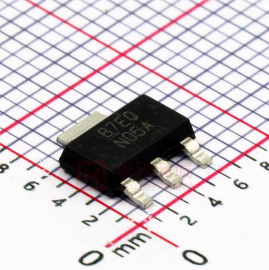

LM1117MPX-3.3/NOPB
LM1117MPX-3.3/NOPB
    BURR-BROWN(德州仪器)
    SOT-223-4
    线性稳压器/LDO 3.3V 800mA SOT223-4 0℃~+125℃
LM1117MPX-3.3/NOPB 数据手册
Product Folder Sample & Buy Technical Documents Support & Community Tools & Software Reference Design LM1117 SNOS412N – FEBRUARY 2000 – REVISED JANUARY 2016 LM1117 800-mA Low-Dropout Linear Regulator 1 Features 3 Description • The LM1117 is a low dropout voltage regulator with a dropout of 1.2 V at 800 mA of load current. 1 • • • • • • Available in 1.8 V, 2.5 V, 3.3 V, 5 V, and Adjustable Versions Space-Saving SOT-223 and WSON Packages Current Limiting and Thermal Protection Output Current 800 mA Line Regulation 0.2% (Maximum) Load Regulation 0.4% (Maximum) Temperature Range – LM1117: 0°C to 125°C – LM1117I: −40°C to 125°C 2 Applications • • • • • Post Regulator for Switching DC–DC Converter High Efficiency Linear Regulators Battery Chargers Portable Instrumentation Active SCSI Termination Regulator The LM1117 is available in an adjustable version, which can set the output voltage from 1.25 to 13.8 V with only two external resistors. In addition, it is available in five fixed voltages, 1.8 V, 2.5 V, 3.3 V, and 5 V. The LM1117 offers current limiting and thermal shutdown. Its circuit includes a Zener trimmed bandgap reference to assure output voltage accuracy to within ±1%. A minimum of 10-µF tantalum capacitor is required at the output to improve the transient response and stability. Device Information(1) PART NUMBER LM1117, LM1117I PACKAGE BODY SIZE (NOM) SOT-223 (4) 6.50 mm × 3.50 mm TO-220 (3) 14.986 mm × 10.16 mm TO-252 (3) 6.58 mm × 6.10 mm WSON (8) 4.00 mm × 4.00 mm TO-263 (3) 10.18 mm × 8.41 mm (1) For all available packages, see the orderable addendum at the end of the data sheet. Adjustable Output Regulator 1 An IMPORTANT NOTICE at the end of this data sheet addresses availability, warranty, changes, use in safety-critical applications, intellectual property matters and other important disclaimers. PRODUCTION DATA. LM1117 SNOS412N – FEBRUARY 2000 – REVISED JANUARY 2016 www.ti.com Table of Contents 1 2 3 4 5 6 7 Features .................................................................. Applications ........................................................... Description ............................................................. Revision History..................................................... Pin Configuration and Functions ......................... Specifications......................................................... 1 1 1 2 3 4 6.1 6.2 6.3 6.4 6.5 6.6 6.7 4 4 4 4 5 7 9 Absolute Maximum Ratings ...................................... ESD Ratings.............................................................. Recommended Operating Conditions....................... Thermal Information .................................................. LM1117 Electrical Characteristics............................. LM1117I Electrical Characteristics............................ Typical Characteristics .............................................. Detailed Description ............................................ 11 7.1 Overview ................................................................. 11 7.2 Functional Block Diagram ....................................... 11 7.3 Feature Description................................................. 11 7.4 Device Functional Modes........................................ 12 8 Application and Implementation ........................ 14 8.1 Application Information............................................ 14 8.2 Typical Application .................................................. 14 8.3 System Examples ................................................... 16 9 Power Supply Recommendations...................... 17 10 Layout................................................................... 17 10.1 Layout Guidelines ................................................. 17 10.2 Layout Example .................................................... 21 11 Device and Documentation Support ................. 22 11.1 11.2 11.3 11.4 Community Resources.......................................... Trademarks ........................................................... Electrostatic Discharge Caution ............................ Glossary ................................................................ 22 22 22 22 12 Mechanical, Packaging, and Orderable Information ........................................................... 22 4 Revision History NOTE: Page numbers for previous revisions may differ from page numbers in the current version. Changes from Revision M (March 2013) to Revision N Page • Added Pin Configuration and Functions section, ESD Ratings table, Feature Description section, Device Functional Modes, Application and Implementation section, Power Supply Recommendations section, Layout section, Device and Documentation Support section, and Mechanical, Packaging, and Orderable Information section .............................. 1 • Removed LM1117-N-2.85 option after part became inactive................................................................................................. 1 • Removed TO-263 Pinout Side View image ........................................................................................................................... 3 Changes from Revision L (July 2012) to Revision M • 2 Page Changed layout of National Data Sheet to TI format ........................................................................................................... 16 Submit Documentation Feedback Copyright © 2000–2016, Texas Instruments Incorporated Product Folder Links: LM1117 LM1117 www.ti.com SNOS412N – FEBRUARY 2000 – REVISED JANUARY 2016 5 Pin Configuration and Functions DCY Package 4-Pin SOT Top View KTT Package 3-Pin TO-263 Top View NDE Package 3-Pin TO-220 Top View NDP Package 3-Pin TO-252 Top View NGN Package 8-Pin WSON Top View ADJ/GND 1 VIN 2 8 NOT CONNECTED 7 VOUT VOUT VIN 3 6 VOUT VIN 4 5 VOUT When using the WSON package Pins 2, 3 and 4 must be connected together and Pins 5, 6 and 7 must be connected together Pin Functions PIN NAME I/O DESCRIPTION TO-252 WSON SOT-223 TO-263 TO-220 ADJ/GND 1 1 1 1 1 — VIN 3 2, 3, 4 3 3 3 I Input voltage pin for the regulator 2 , TAB 5, 6, 7, TAB 2, 4 2, TAB 2, TAB O Output voltage pin for the regulator VOUT Adjust pin for adjustable output option. Ground pin for fixed output option. Submit Documentation Feedback Copyright © 2000–2016, Texas Instruments Incorporated Product Folder Links: LM1117 3 LM1117 SNOS412N – FEBRUARY 2000 – REVISED JANUARY 2016 www.ti.com 6 Specifications 6.1 Absolute Maximum Ratings over operating free-air temperature range (unless otherwise noted) (1) MIN Maximum Input Voltage (VIN to GND) Power Dissipation (2) (2) V 150 TO-220 (T) Package, 10 s 260 SOT-223 (MP) Package, 4 s 260 Storage Temperature, Tstg (1) UNIT 20 Internally Limited Junction Temperature (TJ) (2) Lead Temperature MAX –65 °C °C 150 °C Stresses beyond those listed under Absolute Maximum Ratings may cause permanent damage to the device. These are stress ratings only, which do not imply functional operation of the device at these or any other conditions beyond those indicated under Recommended Operating Conditions. Exposure to absolute-maximum-rated conditions for extended periods may affect device reliability. The maximum power dissipation is a function of TJ(max) , RθJA, and TA. The maximum allowable power dissipation at any ambient temperature is PD = (TJ(max)–TA)/RθJA. All numbers apply for packages soldered directly into a PCB. 6.2 ESD Ratings V(ESD) (1) Human-body model (HBM), per ANSI/ESDA/JEDEC JS-001 (1) Electrostatic discharge VALUE UNIT ±2000 V JEDEC document JEP155 states that 500-V HBM allows safe manufacturing with a standard ESD control process. Pins listed as ±2000 V may actually have higher performance. 6.3 Recommended Operating Conditions over operating free-air temperature range (unless otherwise noted) MIN Input Voltage (VIN to GND) Junction Temperature (TJ) (1) (1) MAX UNIT 15 V °C LM1117 0 125 LM1117I −40 125 The maximum power dissipation is a function of TJ(max) , RθJA, and TA. The maximum allowable power dissipation at any ambient temperature is PD = (TJ(max)–TA)/RθJA. All numbers apply for packages soldered directly into a PCB. 6.4 Thermal Information LM1117, LM1117I THERMAL METRIC (1) DCY (SOT-223) NDE (TO-220) NDP (TO-252) NGN (WSON) KTT (TO-263) UNIT 4 PINS 3 PINS 3 PINS 8 PINS 3 PINS RθJA Junction-to-ambient thermal resistance 61.6 23.8 45.1 39.3 41.3 °C/W RθJC(top) Junction-to-case (top) thermal resistance 42.5 16.6 52.1 31.4 44.1 °C/W RθJB Junction-to-board thermal resistance 10.4 5.3 29.8 16.5 24.2 °C/W ψJT Junction-to-top characterization parameter 2.9 3.1 4.5 0.3 10.9 °C/W ψJB Junction-to-board characterization parameter 10.3 5.3 29.4 16.7 23.2 °C/W RθJC(bot) Junction-to-case (bottom) thermal resistance — 1.5 1.3 5.6 1.3 °C/W (1) 4 For more information about traditional and new thermal metrics, see the Semiconductor and IC Package Thermal Metrics application report, SPRA953. Submit Documentation Feedback Copyright © 2000–2016, Texas Instruments Incorporated Product Folder Links: LM1117 LM1117 www.ti.com SNOS412N – FEBRUARY 2000 – REVISED JANUARY 2016 6.5 LM1117 Electrical Characteristics unless otherwise specified, TJ = 25°C. PARAMETER TEST CONDITIONS LM1117-ADJ IOUT = 10 mA, VIN – VOUT = 2 V, TJ = 25°C VREF Reference Voltage LM1117-ADJ 10 mA ≤ IOUT ≤ 800 mA, 1.4 V ≤ VIN – VOUT ≤ 10 V over the junction temperature range 0°C to 125°C VOUT Output Voltage over the junction temperature range 0°C to 125°C over the junction temperature range 0°C to 125°C LM1117-5.0 IOUT = 10 mA, VIN = 7 V, TJ = 25°C Line Regulation (3) TJ = 25°C LM1117-ADJ IOUT = 10mA, 1.5V ≤ VIN-VOUT ≤ 13.75V TJ = 25°C LM1117-3.3 IOUT = 0 mA, 4.75 V ≤ VIN ≤ 15 V LM1117-5.0 IOUT = 0 mA, 6.5 V ≤ VIN ≤ 15 V LM1117-ADJ VIN – VOUT = 3 V, 10 ≤ IOUT ≤ 800 mA LM1117-1.8 VIN = 3.2 V, 0 ≤ IOUT ≤ 800 mA ΔVOUT Load Regulation (3) LM1117-2.5 VIN = 3.9 V, 0 ≤ IOUT ≤ 800 mA LM1117-3.3 VIN = 4.75 V, 0 ≤ IOUT ≤ 800 mA LM1117-5.0 VIN = 6.5 V, 0 ≤ IOUT ≤ 800 mA (1) (2) (3) 1.262 1.25 1.225 1.782 over the junction temperature range 0°C to 125°C 1.27 1.8 1.746 2.475 2.5 2.45 3.3 3.235 5 4.9 0.2% 1 6 over the junction temperature range 0°C to 125°C mV 1 6 mV 1 6 mV 1 10 mV 0.2% 0.4% 1 10 mV 1 10 mV 1 over the junction temperature range 0°C to 125°C TJ = 25°C V 0.035% over the junction temperature range 0°C to 125°C TJ = 25°C 5.05 5.1 over the junction temperature range 0°C to 125°C TJ = 25°C V 5 over the junction temperature range 0°C to 125°C TJ = 25°C 3.333 3.365 over the junction temperature range 0°C to 125°C TJ = 25°C V 3.3 over the junction temperature range 0°C to 125°C TJ = 25°C 2.525 2.55 over the junction temperature range 0°C to 125°C TJ = 25°C V 2.5 over the junction temperature range 0°C to 125°C TJ = 25°C 1.818 1.854 over the junction temperature range 0°C to 125°C TJ = 25°C UNIT V 1.8 4.95 LM1117-5.0 0 ≤ IOUT ≤ 800 mA, 6.5 V ≤ VIN ≤ 12 V LM1117-2.5 IOUT = 0 mA, 3.9 V ≤ VIN ≤ 10 V 1.25 3.267 TJ = 25°C LM1117-3.3 0 ≤ IOUT ≤ 800 mA, 4.75 V ≤ VIN ≤ over the junction temperature range 10 V 0°C to 125°C ΔVOUT 1.238 TJ = 25°C LM1117-3.3 IOUT = 10 mA, VIN = 5 V TJ = 25°C LM1117-1.8 IOUT = 0 mA, 3.2 V ≤ VIN ≤ 10 V MAX (1) TJ = 25°C LM1117-2.5 IOUT = 10 mA, VIN = 4.5 V, TJ = 25°C LM1117-2.5 0 ≤ IOUT ≤ 800 mA, 3.9 V ≤ VIN ≤ 10 V TYP (2) TJ = 25°C LM1117-1.8 IOUT = 10 mA, VIN = 3.8 V, TJ = 25°C LM1117-1.8 0 ≤ IOUT ≤ 800 mA, 3.2 V ≤ VIN ≤ 10 V MIN (1) 10 mV 1 15 mV All limits are ensured by testing or statistical analysis. Typical Values represent the most likely parametric normal. Load and line regulation are measured at constant junction room temperature. Submit Documentation Feedback Copyright © 2000–2016, Texas Instruments Incorporated Product Folder Links: LM1117 5 LM1117 SNOS412N – FEBRUARY 2000 – REVISED JANUARY 2016 www.ti.com LM1117 Electrical Characteristics (continued) unless otherwise specified, TJ = 25°C. PARAMETER MIN (1) TEST CONDITIONS TJ = 25°C IOUT = 100 mA VIN – V over the junction temperature range 0°C to 125°C OUT IOUT = 500 mA 1.2 1.25 TJ = 25°C ILIMIT Current Limit Minimum Load Current (5) VIN – VOUT = 5 V, TJ = 25°C Adjust Pin Current Change (5) 6 mA mA mA 5 10 mA 5 over the junction temperature range 0°C to 125°C 10 TJ = 25°C mA 5 over the junction temperature range 0°C to 125°C 10 TA = 25°C, 30-ms pulse 0.01 TJ = 25°C 0.1 mA %/W 75 over the junction temperature range 0°C to 125°C TJ = 25°C dB 60 60 over the junction temperature range 0°C to 125°C 120 TJ = 25°C μA 0.2 over the junction temperature range 0°C to 125°C Temperature Stability (4) 10 TJ = 25°C 10 ≤ IOUT ≤ 80 0mA, 1.4 V ≤ VIN – VOUT ≤ 10 V V 5 over the junction temperature range 0°C to 125°C fRIPPLE = 1 20 Hz, VIN – VOUT = 3 V VRIPPLE = 1 VPP 1500 5 TJ = 25°C LM1117-5.0 VIN ≤ 15 V Adjust Pin Current 1200 over the junction temperature range 0°C to 125°C LM1117-3.3 VIN ≤ 15 V V 1.7 TJ = 25°C Quiescent Current Ripple Regulation 800 over the junction temperature range 0°C to 125°C LM1117-2.5 VIN ≤ 15 V Thermal Regulation 1.3 TJ = 25°C LM1117-1.8 VIN ≤ 15 V V 1.2 over the junction temperature range 0°C to 125°C LM1117-ADJ VIN = 15 V UNIT 1.15 over the junction temperature range 0°C to 125°C IOUT = 800 mA MAX (1) 1.1 TJ = 25°C Dropout Voltage (4) TYP (2) 5 µA 0.5% Long Term Stability TA = 125°C, 1000 Hrs RMS Output Noise (% of VOUT), 10 Hz ≤ f ≤ 10 kHz 0.3% 0.003% The dropout voltage is the input/output differential at which the circuit ceases to regulate against further reduction in input voltage. It is measured when the output voltage has dropped 100 mV from the nominal value obtained at VIN = VOUT + 1.5 V. The minimum output current required to maintain regulation. Submit Documentation Feedback Copyright © 2000–2016, Texas Instruments Incorporated Product Folder Links: LM1117 LM1117 www.ti.com SNOS412N – FEBRUARY 2000 – REVISED JANUARY 2016 6.6 LM1117I Electrical Characteristics unless otherwise specified, TJ = 25°C. PARAMETER TEST CONDITIONS LM1117I-ADJ IOUT = 10 mA, VIN – VOUT = 2 V, TJ = 25°C VREF Reference Voltage LM1117I-ADJ 10 mA ≤ IOUT ≤ 800 mA, 1.4 V ≤ VIN – VOUT ≤ 10 V VOUT Output Voltage over the junction temperature range –40°C to 125°C LM1117I-ADJ IOUT = 10 mA, 1.5 V ≤ VIN – VOUT ≤ 13.75 V Line Regulation (3) LM1117I-3.3 IOUT = 0 mA, 4.75 V ≤ VIN ≤ 15 V over the junction temperature range –40°C to 125°C LM1117I-ADJ VIN – VOUT = 3 V, 10 ≤ IOUT ≤ 800 mA ΔVOUT Load Regulation LM1117I-3.3 VIN = 4.75 V, 0 ≤ IOUT ≤ 800 mA over the junction temperature range –40°C to 125°C TJ = 25°C (1) (2) (3) 1.25 1.2 3.3 3.168 3.333 V 3.432 5 5.05 5 4.8 V 5.2 0.035% 0.3% 1 10 mV 1 over the junction temperature range –40°C to 125°C 15 mV 0.2% over the junction temperature range –40°C to 125°C 0.5% 1 over the junction temperature range –40°C to 125°C over the junction temperature range –40°C to 125°C V 3.3 over the junction temperature range –40°C to 125°C TJ = 25°C UNIT 1.29 over the junction temperature range –40°C to 125°C TJ = 25°C LM1117I-5.0 VIN = 6.5 V, 0 ≤ IOUT ≤ 800 mA 1.262 TJ = 25°C TJ = 25°C (3) 1.25 4.95 TJ = 25°C LM1117I-5.0 IOUT = 0 mA, 6.5 V ≤ VIN ≤ 15 V 1.238 TJ = 25°C TJ = 25°C ΔVOUT MAX (1) 3.267 LM1117I-5.0 IOUT = 10 mA, VIN = 7 V, TJ = 25°C LM1117I-5.0 0 ≤ IOUT ≤ 800 mA, 6.5 V ≤ VIN ≤ 12 V TYP (2) TJ = 25°C LM1117I-3.3 IOUT = 10 mA, VIN = 5 V, TJ = 25°C LM1117I-3.3 0 ≤ IOUT ≤ 800 mA, 4.75 V ≤ VIN ≤ 10 V MIN (1) 15 mV 1 20 mV All limits are ensured by testing or statistical analysis. Typical Values represent the most likely parametric normal. Load and line regulation are measured at constant junction room temperature. Submit Documentation Feedback Copyright © 2000–2016, Texas Instruments Incorporated Product Folder Links: LM1117 7 LM1117 SNOS412N – FEBRUARY 2000 – REVISED JANUARY 2016 www.ti.com LM1117I Electrical Characteristics (continued) unless otherwise specified, TJ = 25°C. PARAMETER TEST CONDITIONS MIN (1) TJ = 25°C 1.3 TJ = 25°C VIN-V OUT Dropout Voltage 1.35 TJ = 25°C ILIMIT Current Limit VIN – VOUT = 5 V, TJ = 25°C 1.4 800 TJ = 25°C Minimum Load Current (5) LM1117I-ADJ VIN = 15 V 15 15 Thermal Regulation TA = 25°C, 30ms Pulse 0.01 TJ = 25°C Adjust Pin Current over the junction temperature range –40°C to 125°C TJ = 25°C (5) 8 mA %/W 120 μA 0.2 10 µA 0.5% Long Term Stability TA = 125°C, 1000 Hrs (4) mA dB 60 over the junction temperature range –40°C to 125°C Temperature Stability RMS Output Noise 0.1 60 10 ≤ IOUT ≤ 800 mA, 1.4 V ≤ VIN – VOUT ≤ 10 V mA 75 over the junction temperature range –40°C to 125°C TJ = 25°C Adjust Pin Current Change mA 5 over the junction temperature range –40°C to 125°C fRIPPLE = 120 Hz, VIN – VOUT = 3 V VRIPPLE = 1 VPP V 5 TJ = 25°C LM1117I-5.0 VIN ≤ 15 V 1500 5 over the junction temperature range –40°C to 125°C Quiescent Current V 1.7 TJ = 25°C Ripple Regulation 1200 over the junction temperature range –40°C to 125°C LM1117I-3.3 VIN ≤ 15 V V 1.2 over the junction temperature range –40°C to 125°C IOUT = 800 mA UNIT 1.15 over the junction temperature range –40°C to 125°C IOUT = 500 mA MAX (1) 1.1 over the junction temperature range –40°C to 125°C IOUT = 100 mA (4) TYP (2) 0.3% (% of VOUT), 10 Hz ≤ f ≤ 10 kHz 0.003% The dropout voltage is the input/output differential at which the circuit ceases to regulate against further reduction in input voltage. It is measured when the output voltage has dropped 100 mV from the nominal value obtained at VIN = VOUT + 1.5 V. The minimum output current required to maintain regulation. Submit Documentation Feedback Copyright © 2000–2016, Texas Instruments Incorporated Product Folder Links: LM1117 LM1117 www.ti.com SNOS412N – FEBRUARY 2000 – REVISED JANUARY 2016 6.7 Typical Characteristics Figure 1. Dropout Voltage (VIN – V OUT) Figure 2. Short-Circuit Current Figure 3. Load Regulation Figure 4. LM1117-ADJ Ripple Rejection Figure 5. LM1117-ADJ Ripple Rejection vs Current Figure 6. Temperature Stability Submit Documentation Feedback Copyright © 2000–2016, Texas Instruments Incorporated Product Folder Links: LM1117 9 LM1117 SNOS412N – FEBRUARY 2000 – REVISED JANUARY 2016 www.ti.com Typical Characteristics (continued) Figure 7. Adjust Pin Current Figure 8. LM1117-5.0 Load Transient Response Figure 9. LM1117-5.0 Line Transient Response 10 Submit Documentation Feedback Copyright © 2000–2016, Texas Instruments Incorporated Product Folder Links: LM1117 LM1117 www.ti.com SNOS412N – FEBRUARY 2000 – REVISED JANUARY 2016 7 Detailed Description 7.1 Overview The LM1117 adjustable version develops a 1.25V reference voltage, VREF, between the output and the adjust terminal. As shown in Figure 10, this voltage is applied across resistor R1 to generate a constant current I1. The current IADJ from the adjust terminal could introduce error to the output. But since it is very small (60µA) compared with the I1 and very constant with line and load changes, the error can be ignored. The constant current I1 then flows through the output set resistor R2 and sets the output voltage to the desired level. For fixed voltage devices, R1 and R2 are integrated inside the devices. Figure 10. Basic Adjustable Regulator 7.2 Functional Block Diagram 7.3 Feature Description 7.3.1 Load Regulation The LM1117 regulates the voltage that appears between its output and ground pins, or between its output and adjust pins. In some cases, line resistances can introduce errors to the voltage across the load. To obtain the best load regulation, a few precautions are needed. Submit Documentation Feedback Copyright © 2000–2016, Texas Instruments Incorporated Product Folder Links: LM1117 11 LM1117 SNOS412N – FEBRUARY 2000 – REVISED JANUARY 2016 www.ti.com Feature Description (continued) Figure 11, shows a typical application using a fixed output regulator. The Rt1 and Rt2 are the line resistances. It is obvious that the VLOAD is less than the VOUT by the sum of the voltage drops along the line resistances. In this case, the load regulation seen at the RLOAD would be degraded from the data sheet specification. To improve this, the load should be tied directly to the output terminal on the positive side and directly tied to the ground terminal on the negative side. Figure 11. Typical Application Using Fixed Output Regulator When the adjustable regulator is used (Figure 12), the best performance is obtained with the positive side of the resistor R1 tied directly to the output terminal of the regulator rather than near the load. This eliminates line drops from appearing effectively in series with the reference and degrading regulation. For example, a 5V regulator with 0.05Ω resistance between the regulator and load will have a load regulation due to line resistance of 0.05Ω x IL. If R1 (=125Ω) is connected near the load, the effective line resistance will be 0.05Ω (1+R2/R1) or in this case, it is 4 times worse. In addition, the ground side of the resistor R2 can be returned near the ground of the load to provide remote ground sensing and improve load regulation. Figure 12. Best Load Regulation Using Adjustable Output Regulator 7.4 Device Functional Modes 7.4.1 Protection Diodes Under normal operation, the LM1117 regulators do not need any protection diode. With the adjustable device, the internal resistance between the adjust and output terminals limits the current. No diode is needed to divert the current around the regulator even with capacitor on the adjust terminal. The adjust pin can take a transient signal of ±25V with respect to the output voltage without damaging the device. When a output capacitor is connected to a regulator and the input is shorted to ground, the output capacitor will discharge into the output of the regulator. The discharge current depends on the value of the capacitor, the output voltage of the regulator, and rate of decrease of VIN. In the LM1117 regulators, the internal diode between the output and input pins can withstand microsecond surge currents of 10A to 20A. With an extremely large output capacitor (≥1000 µF), and with input instantaneously shorted to ground, the regulator could be damaged. In this case, an external diode is recommended between the output and input pins to protect the regulator, as shown in Figure 13. 12 Submit Documentation Feedback Copyright © 2000–2016, Texas Instruments Incorporated Product Folder Links: LM1117 LM1117 www.ti.com SNOS412N – FEBRUARY 2000 – REVISED JANUARY 2016 Device Functional Modes (continued) Figure 13. Regulator With Protection Diode Submit Documentation Feedback Copyright © 2000–2016, Texas Instruments Incorporated Product Folder Links: LM1117 13 LM1117 SNOS412N – FEBRUARY 2000 – REVISED JANUARY 2016 www.ti.com 8 Application and Implementation NOTE Information in the following applications sections is not part of the TI component specification, and TI does not warrant its accuracy or completeness. TI’s customers are responsible for determining suitability of components for their purposes. Customers should validate and test their design implementation to confirm system functionality. 8.1 Application Information The LM1117 is a versatile and high performance linear regulator with a wide temperature range and tight line/load regulation operation. An output capacitor is required to further improve transient response and stability. For the adjustable option, the ADJ pin can also be bypassed to achieve very high ripple-rejection ratios. The LM1117 is versatile in its applications, including its uses as a post regulator for DC/DC converters, battery chargers, and microprocessor supplies. 8.2 Typical Application Figure 14. 1.25-V to 10-V Adjustable Regulator With Improved Ripple Rejection 8.2.1 Design Requirements The device component count is very minimal, employing two resistors as part of a voltage divider circuit and an output capacitor for load regulation. A 10-μF tantalum on the input is a suitable input capacitor for almost all applications. An optional bypass capacitor across R2 can also be used to improve PSRR. See Recommended Operating Conditions for more information. 8.2.2 Detailed Design Procedure The output voltage is set based on the selection of the two resistors, R1 and R2, as shown in Figure 14. For details on capacitor selection, refer to External Capacitors. 8.2.2.1 External Capacitors 8.2.2.1.1 Input Bypass Capacitor An input capacitor is recommended. A 10-µF tantalum on the input is a suitable input capacitor for almost all applications. 14 Submit Documentation Feedback Copyright © 2000–2016, Texas Instruments Incorporated Product Folder Links: LM1117 LM1117 www.ti.com SNOS412N – FEBRUARY 2000 – REVISED JANUARY 2016 Typical Application (continued) 8.2.2.1.2 Adjust Terminal Bypass Capacitor The adjust terminal can be bypassed to ground with a bypass capacitor (CADJ) to improve ripple rejection. This bypass capacitor prevents ripple from being amplified as the output voltage is increased. At any ripple frequency, the impedance of the CADJ should be less than R1 to prevent the ripple from being amplified: 1/(2π × fRIPPLE × CADJ) < R1 (1) The R1 is the resistor between the output and the adjust pin. Its value is normally in the range of 100-200Ω. For example, with R1 = 124Ω and fRIPPLE = 120Hz, the CADJ should be > 11µF. 8.2.2.1.3 Output Capacitor The output capacitor is critical in maintaining regulator stability, and must meet the required conditions for both minimum amount of capacitance and equivalent series resistance (ESR). The minimum output capacitance required by the LM1117 is 10 µF, if a tantalum capacitor is used. Any increase of the output capacitance will merely improve the loop stability and transient response. The ESR of the output capacitor should range between 0.3 Ω to 22 Ω. In the case of the adjustable regulator, when the CADJ is used, a larger output capacitance (22-µF tantalum) is required. 8.2.3 Application Curve As shown in Figure 15, the dropout voltage will vary with output current and temperature. Care should be taken during design to ensure the dropout voltage requirement is met across the entire operating temperature and output current range. Figure 15. Dropout Voltage (VIN – VOUT) Submit Documentation Feedback Copyright © 2000–2016, Texas Instruments Incorporated Product Folder Links: LM1117 15 LM1117 SNOS412N – FEBRUARY 2000 – REVISED JANUARY 2016 www.ti.com 8.3 System Examples Several circuits can be realized with the LM1117. The circuit diagrams in this section demonstrate multiple system examples that can be utilized in many applications. Figure 16. Fixed Output Regulator Figure 17. Adjusting Output of Fixed Regulators Figure 18. Regulator With Reference Figure 19. 5-V Logic Regulator With Electronic Shutdown* Figure 20. Battery Backed-Up Regulated Supply Figure 21. Low Dropout Negative Supply 16 Submit Documentation Feedback Copyright © 2000–2016, Texas Instruments Incorporated Product Folder Links: LM1117 LM1117 www.ti.com SNOS412N – FEBRUARY 2000 – REVISED JANUARY 2016 9 Power Supply Recommendations The input supply to the LM1117 must be kept at a voltage level such that its maximum rating is not exceeded. The minimum dropout voltage must also be met with extra headroom when possible to keep the LM1117 in regulation. An input capacitor is recommended. For more information regarding capacitor selection, refer to External Capacitors. 10 Layout 10.1 Layout Guidelines Some layout guidelines must be followed to ensure proper regulation of the output voltage with minimum noise. Traces carrying the load current must be wide to reduce the amount of parasitic trace inductance and the feedback loop from VOUT to ADJ must be kept as short as possible. To improve PSRR, a bypass capacitor can be placed at the ADJ pin and must be located as close as possible to the IC. In cases when VIN shorts to ground, an external diode must be placed from VOUT to VIN to divert the surge current from the output capacitor and protect the IC. The diode must be placed close to the corresponding IC pins to increase their effectiveness. 10.1.1 Heatsink Requirements When an integrated circuit operates with an appreciable current, its junction temperature is elevated. It is important to quantify its thermal limits in order to achieve acceptable performance and reliability. This limit is determined by summing the individual parts consisting of a series of temperature rises from the semiconductor junction to the operating environment. A one-dimensional steady-state model of conduction heat transfer is demonstrated in Figure 22. The heat generated at the device junction flows through the die to the die attach pad, through the lead frame to the surrounding case material, to the printed circuit board, and eventually to the ambient environment. Below is a list of variables that may affect the thermal resistance and in turn the need for a heatsink. Table 1. Component and Application Variables RθJC (COMPONENT VARIABLES) RθJA (APPLICATION VARIABLES) Leadframe Size and Material Mounting Pad Size, Material, and Location No. of Conduction Pins Placement of Mounting Pad Die Size PCB Size and Material Die Attach Material Traces Length and Width Molding Compound Size and Material Adjacent Heat Sources Volume of Air Ambient Temperatue Shape of Mounting Pad The case temperature is measured at the point where the leads contact with the mounting pad surface Figure 22. Cross-Sectional View of Integrated Circuit Mounted on a Printed Circuit Board Submit Documentation Feedback Copyright © 2000–2016, Texas Instruments Incorporated Product Folder Links: LM1117 17 LM1117 SNOS412N – FEBRUARY 2000 – REVISED JANUARY 2016 www.ti.com The LM1117 regulators have internal thermal shutdown to protect the device from over-heating. Under all possible operating conditions, the junction temperature of the LM1117 must be within the range of 0°C to 125°C. A heatsink may be required depending on the maximum power dissipation and maximum ambient temperature of the application. To determine if a heatsink is needed, the power dissipated by the regulator, PD , must be calculated: IIN = IL + IG PD = (VIN-VOUT)I L + VINIG (2) (3) Figure 23 shows the voltages and currents which are present in the circuit. Figure 23. Power Dissipation Diagram The next parameter which must be calculated is the maximum allowable temperature rise, TR(max): TR(max) = TJ(max)-TA(max) where • • TJ(max) is the maximum allowable junction temperature (125°C) which will be encountered in the application TA(max) is the maximum ambient temperature which will be encountered in the application (4) Using the calculated values for TR(max) and PD, the maximum allowable value for the junction-to-ambient thermal resistance (RθJA) can be calculated: RθJA = TR(max)/PD (5) For the maximum allowable value for θJA, refer to the Thermal Information table. As a design aid, Table 2 shows the value of the θJA of SOT-223 and TO-252 for different heatsink area. Figure 24 and Figure 25 reflects the same test results as what are in the Table 2 Figure 26 and Figure 27 shows the maximum allowable power dissipation vs. ambient temperature for the SOT223 and TO-252 device. Figure 28 and Figure 29 shows the maximum allowable power dissipation vs. copper area (in2) for the SOT-223 and TO-252 devices. Please see AN1028 for power enhancement techniques to be used with SOT-223 and TO-252 packages. Application Note AN-1187 (SNOA401) discusses improved thermal performance and power dissipation for the WSON. Table 2. RθJA Different Heatsink Area LAYOUT COPPER AREA THERMAL RESISTANCE Top Side (in2) (1) Bottom Side (in2) (θJA,°C/W) SOT-223 (θJA,°C/W) TO-252 1 0.0123 0 136 103 2 0.066 0 123 87 3 0.3 0 84 60 4 0.53 0 75 54 5 0.76 0 69 52 6 1 0 66 47 7 0 0.2 115 84 8 0 0.4 98 70 9 0 0.6 89 63 10 0 0.8 82 57 (1) Tab of device attached to topside copper 18 Submit Documentation Feedback Copyright © 2000–2016, Texas Instruments Incorporated Product Folder Links: LM1117 LM1117 www.ti.com SNOS412N – FEBRUARY 2000 – REVISED JANUARY 2016 Table 2. RθJA Different Heatsink Area (continued) LAYOUT COPPER AREA THERMAL RESISTANCE 11 0 1 79 57 12 0.066 0.066 125 89 13 0.175 0.175 93 72 14 0.284 0.284 83 61 15 0.392 0.392 75 55 16 0.5 0.5 70 53 Figure 24. RθJA vs 1-oz Copper Area for SOT-223 Figure 25. RθJA vs 2-oz Copper Area for TO-252 Figure 26. Maximum Allowable Power Dissipation vs Ambient Temperature for SOT-223 Figure 27. Maximum Allowable Power Dissipation vs Ambient Temperature for TO-252 Figure 28. Maximum Allowable Power Dissipation vs 1-oz Copper Area for SOT-223 Figure 29. Maximum Allowable Power Dissipation vs 2-oz Copper Area for TO-252 Submit Documentation Feedback Copyright © 2000–2016, Texas Instruments Incorporated Product Folder Links: LM1117 19 LM1117 SNOS412N – FEBRUARY 2000 – REVISED JANUARY 2016 www.ti.com Figure 30. Top View of the Thermal Test Pattern in Actual Scale Figure 31. Bottom View of the Thermal Test Pattern in Actual Scale 20 Submit Documentation Feedback Copyright © 2000–2016, Texas Instruments Incorporated Product Folder Links: LM1117 LM1117 www.ti.com SNOS412N – FEBRUARY 2000 – REVISED JANUARY 2016 10.2 Layout Example Figure 32. Layout Example (SOT-223) Submit Documentation Feedback Copyright © 2000–2016, Texas Instruments Incorporated Product Folder Links: LM1117 21 LM1117 SNOS412N – FEBRUARY 2000 – REVISED JANUARY 2016 www.ti.com 11 Device and Documentation Support 11.1 Community Resources The following links connect to TI community resources. Linked contents are provided "AS IS" by the respective contributors. They do not constitute TI specifications and do not necessarily reflect TI's views; see TI's Terms of Use. TI E2E™ Online Community TI's Engineer-to-Engineer (E2E) Community. Created to foster collaboration among engineers. At e2e.ti.com, you can ask questions, share knowledge, explore ideas and help solve problems with fellow engineers. Design Support TI's Design Support Quickly find helpful E2E forums along with design support tools and contact information for technical support. 11.2 Trademarks E2E is a trademark of Texas Instruments. All other trademarks are the property of their respective owners. 11.3 Electrostatic Discharge Caution These devices have limited built-in ESD protection. The leads should be shorted together or the device placed in conductive foam during storage or handling to prevent electrostatic damage to the MOS gates. 11.4 Glossary SLYZ022 — TI Glossary. This glossary lists and explains terms, acronyms, and definitions. 12 Mechanical, Packaging, and Orderable Information The following pages include mechanical, packaging, and orderable information. This information is the most current data available for the designated devices. This data is subject to change without notice and revision of this document. For browser-based versions of this data sheet, refer to the left-hand navigation. 22 Submit Documentation Feedback Copyright © 2000–2016, Texas Instruments Incorporated Product Folder Links: LM1117 PACKAGE OPTION ADDENDUM www.ti.com 8-Mar-2019 PACKAGING INFORMATION Orderable Device Status (1) Package Type Package Pins Package Drawing Qty Eco Plan Lead/Ball Finish MSL Peak Temp (2) (6) (3) Op Temp (°C) Device Marking (4/5) LM1117DT-1.8/NOPB ACTIVE TO-252 NDP 3 75 Green (RoHS & no Sb/Br) CU SN Level-2-260C-1 YEAR 0 to 125 LM1117 DT-1.8 LM1117DT-2.5/NOPB ACTIVE TO-252 NDP 3 75 Green (RoHS & no Sb/Br) CU SN Level-2-260C-1 YEAR 0 to 125 LM1117 DT-2.5 LM1117DT-3.3/NOPB ACTIVE TO-252 NDP 3 75 Green (RoHS & no Sb/Br) CU SN Level-2-260C-1 YEAR 0 to 125 LM1117 DT-3.3 LM1117DT-5.0/NOPB ACTIVE TO-252 NDP 3 75 Green (RoHS & no Sb/Br) CU SN Level-2-260C-1 YEAR 0 to 125 LM1117 DT-5.0 LM1117DT-ADJ/NOPB ACTIVE TO-252 NDP 3 75 Green (RoHS & no Sb/Br) CU SN Level-2-260C-1 YEAR 0 to 125 LM1117 DT-ADJ LM1117DTX-1.8/NOPB ACTIVE TO-252 NDP 3 2500 Green (RoHS & no Sb/Br) CU SN Level-2-260C-1 YEAR 0 to 125 LM1117 DT-1.8 LM1117DTX-2.5/NOPB ACTIVE TO-252 NDP 3 2500 Green (RoHS & no Sb/Br) CU SN Level-2-260C-1 YEAR 0 to 125 LM1117 DT-2.5 LM1117DTX-3.3/NOPB ACTIVE TO-252 NDP 3 2500 Green (RoHS & no Sb/Br) CU SN Level-2-260C-1 YEAR 0 to 125 LM1117 DT-3.3 LM1117DTX-5.0/NOPB ACTIVE TO-252 NDP 3 2500 Green (RoHS & no Sb/Br) CU SN Level-2-260C-1 YEAR 0 to 125 LM1117 DT-5.0 LM1117DTX-ADJ/NOPB ACTIVE TO-252 NDP 3 2500 Green (RoHS & no Sb/Br) CU SN Level-2-260C-1 YEAR 0 to 125 LM1117 DT-ADJ LM1117IDT-3.3/NOPB ACTIVE TO-252 NDP 3 75 Green (RoHS & no Sb/Br) CU SN Level-2-260C-1 YEAR -40 to 125 LM1117 IDT-3.3 LM1117IDT-5.0/NOPB ACTIVE TO-252 NDP 3 75 Green (RoHS & no Sb/Br) CU SN Level-2-260C-1 YEAR -40 to 125 LM1117 IDT-5.0 LM1117IDT-ADJ/NOPB ACTIVE TO-252 NDP 3 75 Green (RoHS & no Sb/Br) CU SN Level-2-260C-1 YEAR -40 to 125 LM1117 IDT-ADJ LM1117IDTX-3.3/NOPB ACTIVE TO-252 NDP 3 2500 Green (RoHS & no Sb/Br) CU SN Level-2-260C-1 YEAR -40 to 125 LM1117 IDT-3.3 LM1117IDTX-5.0/NOPB ACTIVE TO-252 NDP 3 2500 Green (RoHS & no Sb/Br) CU SN Level-2-260C-1 YEAR -40 to 125 LM1117 IDT-5.0 LM1117IDTX-ADJ/NOPB ACTIVE TO-252 NDP 3 2500 Green (RoHS & no Sb/Br) CU SN Level-2-260C-1 YEAR -40 to 125 LM1117 IDT-ADJ LM1117ILD-ADJ/NOPB ACTIVE WSON NGN 8 1000 Green (RoHS & no Sb/Br) CU SN Level-3-260C-168 HR -40 to 125 1117IAD Addendum-Page 1 Samples PACKAGE OPTION ADDENDUM www.ti.com Orderable Device 8-Mar-2019 Status (1) Package Type Package Pins Package Drawing Qty Eco Plan Lead/Ball Finish MSL Peak Temp (2) (6) (3) Op Temp (°C) Device Marking (4/5) LM1117IMP-3.3/NOPB ACTIVE SOT-223 DCY 4 1000 Green (RoHS & no Sb/Br) CU SN Level-1-260C-UNLIM -40 to 125 N05B LM1117IMP-5.0/NOPB ACTIVE SOT-223 DCY 4 1000 Green (RoHS & no Sb/Br) CU SN Level-1-260C-UNLIM -40 to 125 N06B LM1117IMP-ADJ/NOPB ACTIVE SOT-223 DCY 4 1000 Green (RoHS & no Sb/Br) CU SN Level-1-260C-UNLIM -40 to 125 N03B LM1117IMPX-3.3/NOPB ACTIVE SOT-223 DCY 4 2000 Green (RoHS & no Sb/Br) CU SN Level-1-260C-UNLIM -40 to 125 N05B LM1117IMPX-5.0/NOPB ACTIVE SOT-223 DCY 4 2000 Green (RoHS & no Sb/Br) CU SN Level-1-260C-UNLIM -40 to 125 N06B LM1117IMPX-ADJ/NOPB ACTIVE SOT-223 DCY 4 2000 Green (RoHS & no Sb/Br) CU SN Level-1-260C-UNLIM -40 to 125 N03B LM1117LD-1.8/NOPB ACTIVE WSON NGN 8 1000 Green (RoHS & no Sb/Br) CU SN Level-3-260C-168 HR 0 to 125 1117-18 LM1117LD-2.5/NOPB ACTIVE WSON NGN 8 1000 Green (RoHS & no Sb/Br) CU SN Level-3-260C-168 HR 0 to 125 1117-25 LM1117LD-3.3/NOPB ACTIVE WSON NGN 8 1000 Green (RoHS & no Sb/Br) CU SN Level-3-260C-168 HR 0 to 125 1117-33 LM1117LD-ADJ/NOPB ACTIVE WSON NGN 8 1000 Green (RoHS & no Sb/Br) CU SN Level-3-260C-168 HR 0 to 125 1117ADJ LM1117LDX-1.8/NOPB ACTIVE WSON NGN 8 4500 Green (RoHS & no Sb/Br) CU SN Level-3-260C-168 HR 0 to 125 1117-18 LM1117LDX-ADJ/NOPB ACTIVE WSON NGN 8 4500 Green (RoHS & no Sb/Br) CU SN Level-3-260C-168 HR 0 to 125 1117ADJ LM1117MP-1.8/NOPB ACTIVE SOT-223 DCY 4 1000 Green (RoHS & no Sb/Br) CU SN Level-1-260C-UNLIM 0 to 125 N12A LM1117MP-2.5/NOPB ACTIVE SOT-223 DCY 4 1000 Green (RoHS & no Sb/Br) CU SN Level-1-260C-UNLIM 0 to 125 N13A LM1117MP-3.3/NOPB ACTIVE SOT-223 DCY 4 1000 Green (RoHS & no Sb/Br) CU SN Level-1-260C-UNLIM 0 to 125 N05A LM1117MP-5.0/NOPB ACTIVE SOT-223 DCY 4 1000 Green (RoHS & no Sb/Br) CU SN Level-1-260C-UNLIM 0 to 125 N06A LM1117MP-ADJ/NOPB ACTIVE SOT-223 DCY 4 1000 Green (RoHS & no Sb/Br) CU SN Level-1-260C-UNLIM 0 to 125 N03A LM1117MPX-1.8/NOPB ACTIVE SOT-223 DCY 4 2000 Green (RoHS & no Sb/Br) CU SN Level-1-260C-UNLIM 0 to 125 N12A Addendum-Page 2 Samples PACKAGE OPTION ADDENDUM www.ti.com Orderable Device 8-Mar-2019 Status (1) Package Type Package Pins Package Drawing Qty Eco Plan Lead/Ball Finish MSL Peak Temp (2) (6) (3) Op Temp (°C) Device Marking (4/5) LM1117MPX-2.5/NOPB ACTIVE SOT-223 DCY 4 2000 Green (RoHS & no Sb/Br) CU SN Level-1-260C-UNLIM 0 to 125 N13A LM1117MPX-3.3 ACTIVE SOT-223 DCY 4 2000 TBD Call TI Call TI LM1117MPX-3.3/NOPB ACTIVE SOT-223 DCY 4 2000 Green (RoHS & no Sb/Br) CU SN Level-1-260C-UNLIM 0 to 125 N05A LM1117MPX-5.0/NOPB ACTIVE SOT-223 DCY 4 2000 Green (RoHS & no Sb/Br) CU SN Level-1-260C-UNLIM 0 to 125 N06A LM1117MPX-ADJ/NOPB ACTIVE SOT-223 DCY 4 2000 Green (RoHS & no Sb/Br) CU SN Level-1-260C-UNLIM 0 to 125 N03A LM1117S-ADJ/NOPB ACTIVE DDPAK/ TO-263 KTT 3 45 Pb-Free (RoHS Exempt) CU SN Level-3-245C-168 HR 0 to 125 LM1117S ADJ LM1117SX-3.3/NOPB ACTIVE DDPAK/ TO-263 KTT 3 500 Pb-Free (RoHS Exempt) CU SN Level-3-245C-168 HR 0 to 125 LM1117S 3.3 LM1117SX-5.0/NOPB ACTIVE DDPAK/ TO-263 KTT 3 500 Pb-Free (RoHS Exempt) CU SN Level-3-245C-168 HR 0 to 125 LM1117S 5.0 LM1117SX-ADJ/NOPB ACTIVE DDPAK/ TO-263 KTT 3 500 Pb-Free (RoHS Exempt) CU SN Level-3-245C-168 HR 0 to 125 LM1117S ADJ LM1117T-2.5/NOPB ACTIVE TO-220 NDE 3 45 Green (RoHS & no Sb/Br) CU SN Level-1-NA-UNLIM 0 to 125 LM1117T 2.5 LM1117T-3.3/NOPB ACTIVE TO-220 NDE 3 45 Green (RoHS & no Sb/Br) CU SN Level-1-NA-UNLIM 0 to 125 LM1117T 3.3 LM1117T-5.0/NOPB ACTIVE TO-220 NDE 3 45 Green (RoHS & no Sb/Br) CU SN Level-1-NA-UNLIM 0 to 125 LM1117T 5.0 LM1117T-ADJ/NOPB ACTIVE TO-220 NDE 3 45 Green (RoHS & no Sb/Br) CU SN Level-1-NA-UNLIM 0 to 125 LM1117T ADJ N05A (1) The marketing status values are defined as follows: ACTIVE: Product device recommended for new designs. LIFEBUY: TI has announced that the device will be discontinued, and a lifetime-buy period is in effect. NRND: Not recommended for new designs. Device is in production to support existing customers, but TI does not recommend using this part in a new design. PREVIEW: Device has been announced but is not in production. Samples may or may not be available. OBSOLETE: TI has discontinued the production of the device. (2) RoHS: TI defines "RoHS" to mean semiconductor products that are compliant with the current EU RoHS requirements for all 10 RoHS substances, including the requirement that RoHS substance do not exceed 0.1% by weight in homogeneous materials. Where designed to be soldered at high temperatures, "RoHS" products are suitable for use in specified lead-free processes. TI may reference these types of products as "Pb-Free". RoHS Exempt: TI defines "RoHS Exempt" to mean products that contain lead but are compliant with EU RoHS pursuant to a specific EU RoHS exemption. Addendum-Page 3 Samples PACKAGE OPTION ADDENDUM www.ti.com 8-Mar-2019 Green: TI defines "Green" to mean the content of Chlorine (Cl) and Bromine (Br) based flame retardants meet JS709B low halogen requirements of
