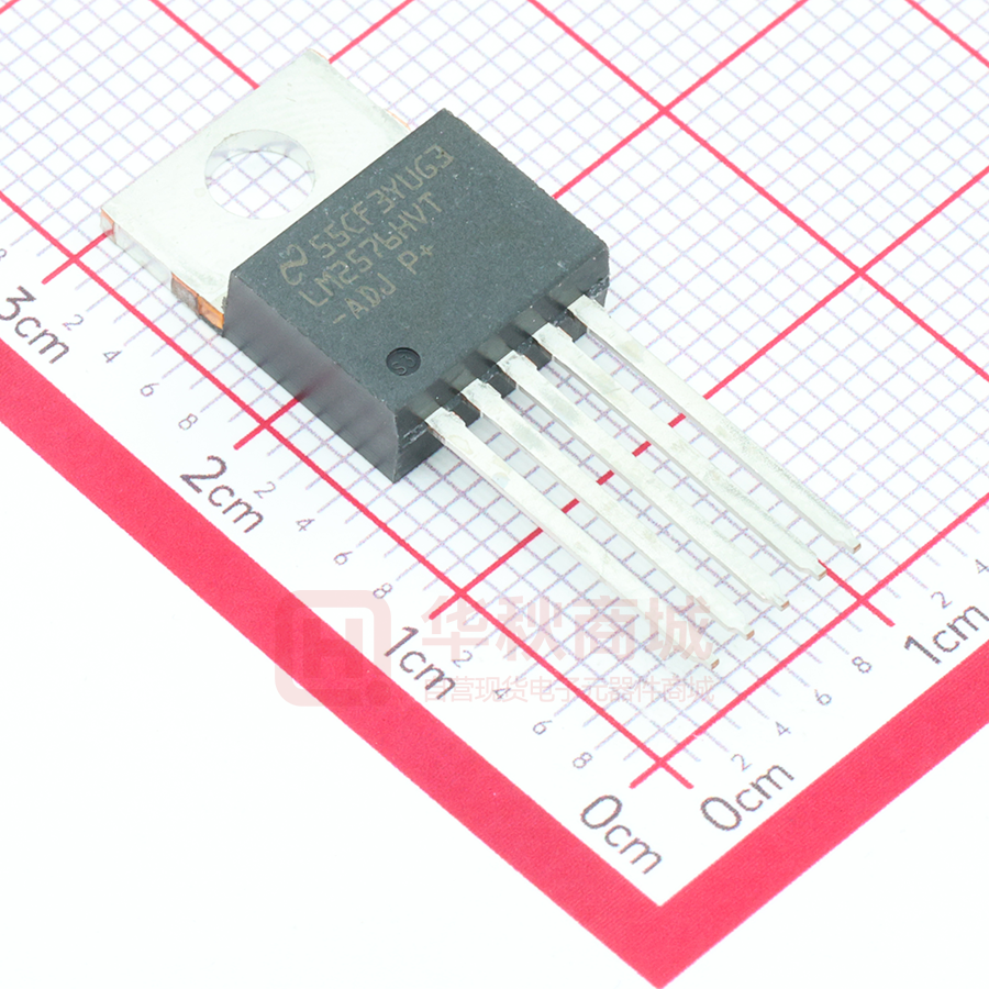

    LM2576HVTADJ/NOPB 是一款易于使用的非同步降压直流-直流转换器,具有宽输入电压范围(40V至60V),最大输出电流为3A,可调输出电压范围为1.23V至57V。该芯片需要极少的外部组件...
LM2576HVT-ADJ/NOPB 数据手册
LM2576, LM2576HV SNVS107F – JUNE 1999 – REVISED MAY 2021 LM2576xx Series SIMPLE SWITCHER® 3-A Step-Down Voltage Regulator 1 Features • • • • • • • • • • • Newer products available: – LMR33630 36-V, 3-A, 400-kHz synchronous converter – LM76003 60-V, 3.5-A, 2.2-MHz synchronous converter 3.3-V, 5-V, 12-V, 15-V, and adjustable output versions Adjustable version output voltage range,1.23 V to 37 V (57 V for HV version) ±4% maximum over line and load conditions Specified 3-A output current Wide input voltage range: 40 V Up to 60 V for HV version Requires only four external components 52-kHz fixed-frequency internal oscillator TTL-shutdown capability, low-power standby mode High efficiency Uses readily available standard inductors Create a custom design using the LMR33630 or LM76003 with the WEBENCH® Power Designer 2 Applications • • • • Motor drives Merchant network and server PSU Appliances Test and measurement equipment Requiring a minimum number of external components, these regulators are simple to use and include fault protection and a fixed-frequency oscillator. The LM2576 series offers a high-efficiency replacement for popular three-terminal linear regulators. It substantially reduces the size of the heat sink, and in some cases no heat sink is required. A standard series of inductors optimized for use with the LM2576 are available from several different manufacturers. This feature greatly simplifies the design of switch-mode power supplies. Other features include a ±4% tolerance on output voltage within specified input voltages and output load conditions, and ±10% on the oscillator frequency. External shutdown is included, featuring 50-μA (typical) standby current. The output switch includes cycle-by-cycle current limiting, as well as thermal shutdown for full protection under fault conditions. The new product, LMR33630, offers reduced BOM cost, higher efficiency, and an 85% reduction in solution size among many other features. The LM76003 requires very few external components and has a pinout designed for simple, optimum PCB layout for EMI and thermal performance. See the device comparison table to compare specs. Device Information 3 Description The LM2576 series of regulators are monolithic integrated circuits that provide all the active functions for a step-down (buck) switching regulator, capable of driving 3-A load with excellent line and load regulation. These devices are available in fixed output voltages of 3.3 V, 5 V, 12 V, 15 V, and an adjustable output version. PART NUMBER(1) LM2576 LM2576HV (1) PACKAGE BODY SIZE (NOM) TO-220 (5) 10.16 mm × 8.51 mm DDPAK/TO-263 (5) 10.16 mm × 8.42 mm For all available packages, see the orderable addendum at the end of the data sheet. Fixed Output Voltage Version Typical Application Diagram An IMPORTANT NOTICE at the end of this data sheet addresses availability, warranty, changes, use in safety-critical applications, intellectual property matters and other important disclaimers. PRODUCTION DATA. LM2576, LM2576HV www.ti.com SNVS107F – JUNE 1999 – REVISED MAY 2021 Table of Contents 1 Features............................................................................1 2 Applications..................................................................... 1 3 Description.......................................................................1 4 Revision History.............................................................. 2 5 Pin Configuration and Functions...................................3 6 Specifications.................................................................. 4 6.1 Absolute Maximum Ratings........................................ 4 6.2 ESD Ratings............................................................... 4 6.3 Recommended Operating Conditions.........................4 6.4 Thermal Information....................................................4 6.5 Electrical Characteristics: 3.3 V.................................. 5 6.6 Electrical Characteristics: 5 V..................................... 5 6.7 Electrical Characteristics: 12 V................................... 5 6.8 Electrical Characteristics: 15 V................................... 6 6.9 Electrical Characteristics: Adjustable Output Voltage.......................................................................... 6 6.10 Electrical Characteristics: All Output Voltage Versions.........................................................................6 6.11 Typical Characteristics.............................................. 8 7 Detailed Description......................................................12 7.1 Overview................................................................... 12 7.2 Functional Block Diagram......................................... 12 7.3 Feature Description...................................................12 7.4 Device Functional Modes..........................................14 8 Application and Implementation.................................. 15 8.1 Application Information............................................. 15 8.2 Typical Applications.................................................. 19 9 Power Supply Recommendations................................25 10 Layout...........................................................................26 10.1 Layout Guidelines................................................... 26 10.2 Layout Example...................................................... 27 10.3 Grounding............................................................... 27 10.4 Heat Sink and Thermal Considerations.................. 27 11 Device and Documentation Support..........................29 11.1 Device Support........................................................29 11.2 Documentation Support.......................................... 30 11.3 Support Resources................................................. 30 11.4 Receiving Notification of Documentation Updates.. 30 11.5 Trademarks............................................................. 30 11.6 Electrostatic Discharge Caution.............................. 30 11.7 Glossary.................................................................. 30 12 Mechanical, Packaging, and Orderable Information.................................................................... 30 4 Revision History NOTE: Page numbers for previous revisions may differ from page numbers in the current version. Changes from Revision E (June 2020) to Revision F (May 2021) Page • Added information for the LM76003 promotion.................................................................................................. 1 • Updated the numbering format for tables, figures, and cross-references throughout the document. ................1 Changes from Revision D (January 2016) to Revision E (June 2020) Page • Added information about the LMR33630............................................................................................................ 1 Changes from Revision C (April 2013) to Revision D (January 2016) Page • Added ESD Ratings table, Feature Description section, Device Functional Modes, Application and Implementation section, Power Supply Recommendations section, Layout section, Device and Documentation Support section, and Mechanical, Packaging, and Orderable Information section................... 1 • Moved the thermal resistance data from the Electrical Characteristics: All Output Voltage Versions table to the Thermal Information table.............................................................................................................................4 Changes from Revision B (April 2013) to Revision C (April 2013) Page • Changed layout of National Data Sheet to TI format.......................................................................................... 3 2 Submit Document Feedback Copyright © 2021 Texas Instruments Incorporated Product Folder Links: LM2576 LM2576HV LM2576, LM2576HV www.ti.com SNVS107F – JUNE 1999 – REVISED MAY 2021 5 Pin Configuration and Functions Figure 5-1. KC Package 5-Pin TO-220 Top View Figure 5-2. KTT Package 5-PIN DDPAK/TO-263 Top View Figure 5-3. DDPAK/TO-263 (S) Package 5-Lead Surface-Mount Package Top View Table 5-1. Pin Functions PIN NO. NAME I/O(1) DESCRIPTION 1 VIN I Supply input pin to collector pin of high-side transistor. Connect to power supply and input bypass capacitors CIN. Path from VIN pin to high frequency bypass CIN and GND must be as short as possible. 2 OUTPUT O Emitter pin of the power transistor. This is a switching node. Attached this pin to an inductor and the cathode of the external diode. 3 GROUND — Ground pin. Path to CIN must be as short as possible. 4 FEEDBACK I Feedback sense input pin. Connect to the midpoint of feedback divider to set VOUT for ADJ version or connect this pin directly to the output capacitor for a fixed output version. 5 ON/OFF I Enable input to the voltage regulator. High = OFF and low = ON. Connect to GND to enable the voltage regulator. Do not leave this pin float. — TAB — (1) Connected to GND. Attached to heatsink for thermal relief for TO-220 package or put a copper plane connected to this pin as a thermal relief for DDPAK package. I = INPUT, O = OUTPUT Submit Document Feedback Copyright © 2021 Texas Instruments Incorporated Product Folder Links: LM2576 LM2576HV 3 LM2576, LM2576HV www.ti.com SNVS107F – JUNE 1999 – REVISED MAY 2021 6 Specifications 6.1 Absolute Maximum Ratings over the recommended operating junction temperature range of -40°C to 125°C (unless otherwise noted)(1) (2) MIN Maximum supply voltage   45 LM2576HV 63 ON /OFF pin input voltage Output voltage to ground MAX LM2576 (Steady-state) Power dissipation −0.3V ≤ V ≤ +VIN V −1 V Maximum junction temperature, TJ (2) V Internally Limited Storage temperature, Tstg (1) UNIT −65 150 °C 150 °C Stresses beyond those listed under Absolute Maximum Ratings may cause permanent damage to the device. These are stress ratings only, which do not imply functional operation of the device at these or any other conditions beyond those indicated under Recommended Operating Conditions. Exposure to absolute-maximum-rated conditions for extended periods may affect device reliability. If Military/Aerospace specified devices are required, please contact the TI Sales Office/ Distributors for availability and specifications. 6.2 ESD Ratings V(ESD) (1) Electrostatic discharge Human-body model (HBM), per ANSI/ESDA/JEDEC JS-001(1) VALUE UNIT ±2000 V JEDEC document JEP155 states that 500-V HBM allows safe manufacturing with a standard ESD control process. 6.3 Recommended Operating Conditions over the recommended operating junction temperature range of -40°C to 125°C (unless otherwise noted) Temperature LM2576, LM2576HV Supply voltage MIN MAX UNIT −40 125 °C LM2576 40 LM2576HV 60 V 6.4 Thermal Information LM2576, LM2576HV THERMAL KTT (TO-263) KC (TO-220) 5 PINS 5 PINS UNIT RθJA Junction-to-ambient thermal resistance 42.6 32.4 °C/W RθJC(top) Junction-to-case (top) thermal resistance 43.3 41.2 °C/W RθJB Junction-to-board thermal resistance 22.4 17.6 °C/W ψJT Junction-to-top characterization parameter 10.7 7.8 °C/W ψJB Junction-to-board characterization parameter 21.3 17 °C/W RθJC(bot) Junction-to-case (bottom) thermal resistance 0.4 0.4 °C/W (1) (2) (3) 4 METRIC(1) (2) (3) For more information about traditional and new thermal metrics, see the Semiconductor and IC Package Thermal Metrics application report, SPRA953 and the Using New Thermal Metrics applications report, SBVA025. The package thermal impedance is calculated in accordance with JESD 51-7 Thermal Resistances were simulated on a 4-layer, JEDEC board. Submit Document Feedback Copyright © 2021 Texas Instruments Incorporated Product Folder Links: LM2576 LM2576HV LM2576, LM2576HV www.ti.com SNVS107F – JUNE 1999 – REVISED MAY 2021 6.5 Electrical Characteristics: 3.3 V Specifications are for TJ = 25°C (unless otherwise noted). PARAMETER TEST CONDITIONS SYSTEM PARAMETERS TEST CIRCUIT Figure 8-3 and Figure (1) TYP MAX UNIT 3.234 3.3 3.366 V 3.3 3.432 Output Voltage VIN = 12 V, ILOAD = 0.5 A Circuit of Figure 8-3 and Figure 8-9 TJ = 25°C 3.168 Output Voltage: LM2576 6 V ≤ VIN ≤ 40 V, 0.5 A ≤ ILOAD ≤3A Circuit of Figure 8-3 and Figure 8-9 Applies over full operating temperature range 3.135 TJ = 25°C 3.168 Output Voltage: LM2576HV 6 V ≤ VIN ≤ 60 V, 0.5 A ≤ ILOAD ≤3A Circuit of Figure 8-3 and Figure 8-9 Applies over full operating temperature range 3.135 Efficiency VIN = 12 V, ILOAD = 3 A VOUT η MIN 8-9(1) 3.465 3.3 V 3.45 3.482 V 75% External components such as the catch diode, inductor, input and output capacitors can affect switching regulator system performance. When the LM2576/LM2576HV is used as shown in Figure 8-3 and Figure 8-9, system performance is as shown in Section 6.10. 6.6 Electrical Characteristics: 5 V Specifications are for TJ = 25°C for the Figure 8-3 and Figure 8-9 (unless otherwise noted). PARAMETER TEST CONDITIONS SYSTEM PARAMETERS TEST CIRCUIT Figure 8-3 and Figure VOUT Output Voltage VIN = 12 V, ILOAD = 0.5 A Circuit of Figure 8-3 and Figure 8-9 VOUT 0.5 A ≤ ILOAD ≤ 3 A, 8 V ≤ VIN ≤ 40 V Circuit of Figure 8-3 and Figure 8-9 TJ = 25°C Output Voltage LM2576 VOUT 0.5 A ≤ ILOAD ≤ 3 A, 8 V ≤ VIN ≤ 60 V Circuit of Figure 8-3 and Figure 8-9 TJ = 25°C Output Voltage LM2576HV η Efficiency VIN = 12 V, ILOAD = 3 A (1) MIN TYP MAX 4.9 5 5.1 4.8 5 5.2 UNIT 8-9(1) Applies over full operating temperature range Applies over full operating temperature range 4.75 4.8 5.25 5 5.225 V V 4.75 5.275 V 77% External components such as the catch diode, inductor, input and output capacitors can affect switching regulator system performance. When the LM2576/LM2576HV is used as shown in Figure 8-3 and Figure 8-9, system performance is as shown in Section 6.10. 6.7 Electrical Characteristics: 12 V Specifications are for TJ = 25°C (unless otherwise noted). PARAMETER TEST CONDITIONS SYSTEM PARAMETERS TEST CIRCUIT Figure 8-3 and Figure MIN TYP MAX UNIT 11.76 12 12.24 V 11.52 12 12.48 8-9(1) VOUT Output Voltage VIN = 25 V, ILOAD = 0.5 A Circuit of Figure 8-3 and Figure 8-9 VOUT 0.5 A ≤ ILOAD ≤ 3 A, 15 V ≤ VIN ≤ 40 V Circuit of Figure 8-3 and Figure 8-9 and TJ = 25°C Output Voltage LM2576 VOUT 0.5 A ≤ ILOAD ≤ 3 A, 15 V ≤ VIN ≤ 60 V Circuit of Figure 8-3 and Figure 8-9 TJ = 25°C Output Voltage LM2576HV Applies over full operating temperature range Applies over full operating temperature range 11.4 11.52 11.4 12.6 12 V 12.54 12.66 V Submit Document Feedback Copyright © 2021 Texas Instruments Incorporated Product Folder Links: LM2576 LM2576HV 5 LM2576, LM2576HV www.ti.com SNVS107F – JUNE 1999 – REVISED MAY 2021 Specifications are for TJ = 25°C (unless otherwise noted). PARAMETER η (1) Efficiency TEST CONDITIONS MIN VIN = 15 V, ILOAD = 3 A TYP MAX UNIT 88% External components such as the catch diode, inductor, input and output capacitors can affect switching regulator system performance. When the LM2576/LM2576HV is used as shown in Figure 8-3 and Figure 8-9, system performance is as shown in Section 6.10. 6.8 Electrical Characteristics: 15 V over operating free-air temperature range (unless otherwise noted). PARAMETER TEST CONDITIONS MIN TYP MAX UNIT 14.7 15 15.3 V 14.4 15 15.6 SYSTEM PARAMETERS TEST CIRCUIT Figure 8-3 and Figure 8-9(1) VOUT Output Voltage VIN = 25 V, ILOAD = 0.5 A Circuit of Figure 8-3 and Figure 8-9 VOUT 0.5 A ≤ ILOAD ≤ 3 A, 18 V ≤ VIN ≤ 40 V Circuit of Figure 8-3 and Figure 8-9 TJ = 25°C Output Voltage LM2576 VOUT 0.5 A ≤ ILOAD ≤ 3 A, 18 V ≤ VIN ≤ 60 V Circuit of Figure 8-3 and Figure 8-9 TJ = 25°C Output Voltage LM2576HV η Efficiency VIN = 18 V, ILOAD = 3 A (1) Applies over full operating temperature range Applies over full operating temperature range 14.25 15.75 14.4 15 15.68 V 14.25 15.83 V 88% External components such as the catch diode, inductor, input and output capacitors can affect switching regulator system performance. When the LM2576/LM2576HV is used as shown in Figure 8-3 and Figure 8-9, system performance is as shown in Section 6.10. 6.9 Electrical Characteristics: Adjustable Output Voltage over operating free-air temperature range (unless otherwise noted). PARAMETER TEST CONDITIONS MIN TYP MAX UNIT 1.217 1.23 1.243 V 1.193 1.23 1.267 SYSTEM PARAMETERS TEST CIRCUIT Figure 8-3 and Figure 8-9(1) VOUT Feedback voltage VIN = 12 V, ILOAD = 0.5 A VOUT = 5 V, Circuit of Figure 8-3 and Figure 8-9 VOUT 0.5 A ≤ ILOAD ≤ 3 A, 8 V ≤ VIN ≤ 40 V VOUT = 5 V, Circuit of Figure 8-3 and Figure 8-9 TJ = 25°C Feedback Voltage LM2576 VOUT 0.5 A ≤ ILOAD ≤ 3 A, 8 V ≤ VIN ≤ 60 V VOUT = 5 V, Circuit of Figure 8-3 and Figure 8-9 TJ = 25°C Feedback Voltage LM2576HV η Efficiency VIN = 12 V, ILOAD = 3 A, VOUT = 5 V (1) Applies over full operating temperature range 1.18 1.193 Applies over full operating temperature range 1.28 1.23 1.18 V 1.273 1.286 V 77% External components such as the catch diode, inductor, input and output capacitors can affect switching regulator system performance. When the LM2576/LM2576HV is used as shown in Figure 8-3 and Figure 8-9, system performance is as shown in Section 6.10. 6.10 Electrical Characteristics: All Output Voltage Versions over operating free-air temperature range (unless otherwise noted) PARAMETER TEST CONDITIONS SYSTEM PARAMETERS TEST CIRCUIT Figure 8-3 and Figure 6 Ib Feedback Bias Current fO Oscillator Frequency(7) VOUT = 5 V (Adjustable Version Only) MIN TYP(1) MAX UNIT 8-9(2) TJ = 25°C 100 Applies over full operating temperature range 500 TJ = 25°C 47 Applies over full operating temperature range 42 Submit Document Feedback 50 nA 52 58 63 kHz Copyright © 2021 Texas Instruments Incorporated Product Folder Links: LM2576 LM2576HV LM2576, LM2576HV www.ti.com SNVS107F – JUNE 1999 – REVISED MAY 2021 over operating free-air temperature range (unless otherwise noted) PARAMETER TEST CONDITIONS MIN TJ = 25°C VSAT Saturation Voltage DC Max Duty Cycle (ON)(4) ICL Current Limit(3) (7) IL Output Leakage Current IQ Quiescent Current(5) ISTBY Standby Quiescent Current TYP(1) 1.4 Applies over full operating temperature range IOUT = 3 A (3) 93% 98% 4.2 5.8 Applies over full operating temperature range 3.5 2 ON /OFF Pin = 5 V (OFF) UNIT 1.8 2 TJ = 25°C Output = 0 V Output = −1 V Output = −1 V (5) (6) MAX 6.9 7.5 V A 7.5 30 mA 5 10 mA 50 200 μA ON /OFF CONTROL TEST CIRCUIT Figure 8-3 and Figure 8-9 VOUT = 0 V VIH ON /OFF Pin Logic Input Level VIL IIH IIL (1) (2) (3) (4) (5) (6) (7) ON /OFF Pin Input Current VOUT = Nominal Output Voltage TJ = 25°C 2.2 Applies over full operating temperature range 2.4 TJ = 25°C 1.4 V 1.2 Applies over full operating temperature range 1 0.8 V ON /OFF Pin = 5 V (OFF) 12 30 μA ON /OFF Pin = 0 V (ON) 0 10 μA All limits specified at room temperature (25°C) unless otherwise noted. All room temperature limits are 100% production tested. All limits at temperature extremes are specified through correlation using standard Statistical Quality Control (SQC) methods. External components such as the catch diode, inductor, input and output capacitors can affect switching regulator system performance. When the LM2576/LM2576HV is used as shown in Figure 8-3 and Figure 8-9, system performance is as shown in Section 6.10. Output pin sourcing current. No diode, inductor or capacitor connected to output. Feedback pin removed from output and connected to 0V. Feedback pin removed from output and connected to +12 V for the Adjustable, 3.3-V, and 5-V versions, and +25 V for the 12-V and 15-V versions, to force the output transistor OFF. VIN = 40 V (60 V for high voltage version). The oscillator frequency reduces to approximately 11 kHz in the event of an output short or an overload which causes the regulated output voltage to drop approximately 40% from the nominal output voltage. This self protection feature lowers the average power dissipation of the IC by lowering the minimum duty cycle from 5% down to approximately 2%. Submit Document Feedback Copyright © 2021 Texas Instruments Incorporated Product Folder Links: LM2576 LM2576HV 7 LM2576, LM2576HV www.ti.com SNVS107F – JUNE 1999 – REVISED MAY 2021 6.11 Typical Characteristics (Circuit of Figure 8-3 and Figure 8-9) 8 Figure 6-1. Normalized Output Voltage Figure 6-2. Line Regulation Figure 6-3. Dropout Voltage Figure 6-4. Current Limit Figure 6-5. Quiescent Current Figure 6-6. Standby Quiescent Current Submit Document Feedback Copyright © 2021 Texas Instruments Incorporated Product Folder Links: LM2576 LM2576HV LM2576, LM2576HV www.ti.com SNVS107F – JUNE 1999 – REVISED MAY 2021 Figure 6-7. Oscillator Frequency Figure 6-9. Efficiency Figure 6-11. Quiescent Current vs Duty Cycle Figure 6-8. Switch Saturation Voltage Figure 6-10. Minimum Operating Voltage Figure 6-12. Feedback Voltage vs Duty Cycle Submit Document Feedback Copyright © 2021 Texas Instruments Incorporated Product Folder Links: LM2576 LM2576HV 9 LM2576, LM2576HV www.ti.com SNVS107F – JUNE 1999 – REVISED MAY 2021 Figure 6-13. Minimum Operating Voltage Figure 6-14. Quiescent Current vs Duty Cycle Figure 6-15. Feedback Voltage vs Duty Cycle Figure 6-16. Feedback Pin Current If the DDPAK/TO-263 package is used, the thermal resistance can be reduced by increasing the PCB copper area thermally connected to the package. Using 0.5 square inches of copper area, θJA is 50°C/W, with 1 square inch of copper area, θJA is 37°C/W, and with 1.6 or more square inches of copper area, θJA is 32°C/W. VOUT = 15 V A: Output Pin Voltage, 50 V/div B: Output Pin Current, 2 A/div C: Inductor Current, 2 A/div D: Output Ripple Voltage, 50 mV/div, AC-CoupledHorizontal Time Base: 5 μs/div Figure 6-18. Switching Waveforms Figure 6-17. Maximum Power Dissipation (DDPAK/ TO-263) 10 Submit Document Feedback Copyright © 2021 Texas Instruments Incorporated Product Folder Links: LM2576 LM2576HV LM2576, LM2576HV www.ti.com SNVS107F – JUNE 1999 – REVISED MAY 2021 Figure 6-19. Load Transient Response Submit Document Feedback Copyright © 2021 Texas Instruments Incorporated Product Folder Links: LM2576 LM2576HV 11 LM2576, LM2576HV www.ti.com SNVS107F – JUNE 1999 – REVISED MAY 2021 7 Detailed Description 7.1 Overview The LM2576 SIMPLE SWITCHER® regulator is an easy-to-use, non-synchronous step-down DC-DC converter with a wide input voltage range from 40 V to up to 60 V for a HV version. It is capable of delivering up to 3-A DC load current with excellent line and load regulation. These devices are available in fixed output voltages of 3.3 V, 5 V, 12 V, 15 V, and an adjustable output version. The family requires few external components, and the pin arrangement was designed for simple, optimum PCB layout. 7.2 Functional Block Diagram VIN Unregulated DC Input Internal Rgulator 1 + CIN ON/OFF ON/OFF 5 4 Feedback R2 + Fixed Gain Error Amp 3 Amp Switch Comparator + R1 1k ± Driver ± OUTPUT L1 2 D1 1.23 V BAND-GAP REFERENCE 52 kHZ OSCILLATOR RESET THERMAL SHUTDOWN CURRENT LIMIT VOUT + COUT 3 L O A D GND 3.3 V R2 = 1.7 k 5 V, R2 = 3.1 k 12 V, R2 = 8.84 k 15 V, R2 = 11.3 k For ADJ. Version R1 = Open, R2 = 0 Ω Patent Pending 7.3 Feature Description 7.3.1 Undervoltage Lockout In some applications it is desirable to keep the regulator off until the input voltage reaches a certain threshold. Figure 7-1 shows an undervoltage lockout circuit that accomplishes this task, while Figure 7-2 shows the same circuit applied to a buck-boost configuration. These circuits keep the regulator off until the input voltage reaches a predetermined level. VTH ≈ VZ1 + 2VBE(Q1) 12 (1) Submit Document Feedback Copyright © 2021 Texas Instruments Incorporated Product Folder Links: LM2576 LM2576HV LM2576, LM2576HV www.ti.com SNVS107F – JUNE 1999 – REVISED MAY 2021 +VIN +VIN R1 20 k LM2576-XX 1 + CIN 20 k 5 ON/OFF 3 GND Z1 Q1 R2 10 k Complete circuit not shown. Figure 7-1. Undervoltage Lockout for Buck Circuit +VIN +VIN R1 20 k LM2576-XX 1 + CIN 20 k 5 ON/OFF 3 GND Z1 Q1 R2 10 k -VOUT Complete circuit not shown (see Figure 8-1). Figure 7-2. Undervoltage Lockout for Buck-Boost Circuit 7.3.2 Delayed Start-Up The ON /OFF pin can be used to provide a delayed start-up feature as shown in Figure 7-3. With an input voltage of 20 V and for the part values shown, the circuit provides approximately 10 ms of delay time before the circuit begins switching. Increasing the RC time constant can provide longer delay times. But excessively large RC time constants can cause problems with input voltages that are high in 60-Hz or 120-Hz ripple, by coupling the ripple into the ON /OFF pin. 7.3.3 Adjustable Output, Low-Ripple Power Supply Figure 7-4 shows a 3-A power supply that features an adjustable output voltage. An additional LC filter that reduces the output ripple by a factor of 10 or more is included in this circuit. Submit Document Feedback Copyright © 2021 Texas Instruments Incorporated Product Folder Links: LM2576 LM2576HV 13 LM2576, LM2576HV www.ti.com SNVS107F – JUNE 1999 – REVISED MAY 2021 +VIN +VIN + CD LM2576-XX 1 0.1 …F + CIN 5 ON/OFF 3 GND 100 …F RD 47 K Complete circuit not shown. Figure 7-3. Delayed Start-Up Feedback 55 V Unregulated DC Input 4 +VIN LM2576HV-ADJ 1 + CIN Output 3 GND 100 …F 5 2 ON/OFF Output Voltage L1 150 µH + D1 1N5822 COUT R2 50 k +1.2 to 50 V @3A 20 µH + 2000 …F C1 100 …F R1 1.21 k optional output ripple filter Figure 7-4. 1.2-V to 55-V Adjustable 3-A Power Supply With Low Output Ripple 7.4 Device Functional Modes 7.4.1 Shutdown Mode The ON/OFF pin provides electrical ON and OFF control for the LM2576. When the voltage of this pin is higher than 1.4 V, the device is in shutdown mode. The typical standby current in this mode is 50 μA. 7.4.2 Active Mode When the voltage of the ON/OFF pin is below 1.2 V, the device starts switching, and the output voltage rises until it reaches the normal regulation voltage. 7.4.3 Current Limit The LM2576 device has current limiting to prevent the switch current from exceeding safe values during an accidental overload on the output. This current limit value can be found in Section 6.10 under the heading of ICL. The LM2576 uses cycle-by-cycle peak current limit for overload protection. This helps to prevent damage to the device and external components. The regulator operates in current limit mode whenever the inductor current exceeds the value of ICL given in Section 6.10. This occurs if the load current is greater than 3 A, or the converter is starting up. Keep in mind that the maximum available load current depends on the input voltage, output voltage, and inductor value. The regulator also incorporates short-circuit protection to prevent inductor current run-away. When the voltage on the FB pin (ADJ) falls below about 0.58 V the switching frequency is dropped to about 11 kHz. This allows the inductor current to ramp down sufficiently during the switch OFF-time to prevent saturation. 14 Submit Document Feedback Copyright © 2021 Texas Instruments Incorporated Product Folder Links: LM2576 LM2576HV LM2576, LM2576HV www.ti.com SNVS107F – JUNE 1999 – REVISED MAY 2021 8 Application and Implementation Note Information in the following applications sections is not part of the TI component specification, and TI does not warrant its accuracy or completeness. TI’s customers are responsible for determining suitability of components for their purposes, as well as validating and testing their design implementation to confirm system functionality. 8.1 Application Information 8.1.1 Input Capacitor (CIN) To maintain stability, the regulator input pin must be bypassed with at least a 100-μF electrolytic capacitor. The capacitor's leads must be kept short, and placed near the regulator. If the operating temperature range includes temperatures below −25°C, the input capacitor value may need to be larger. With most electrolytic capacitors, the capacitance value decreases and the ESR increases with lower temperatures and age. Paralleling a ceramic or solid tantalum capacitor increases the regulator stability at cold temperatures. For maximum capacitor operating lifetime, the RMS ripple current rating of the capacitor must be greater than: (2) 8.1.2 Inductor Selection All switching regulators have two basic modes of operation: continuous and discontinuous. The difference between the two types relates to the inductor current, whether it is flowing continuously, or if it drops to zero for a period of time in the normal switching cycle. Each mode has distinctively different operating characteristics, which can affect the regulator performance and requirements. The LM2576 (or any of the SIMPLE SWITCHER® family can be used for both continuous and discontinuous modes of operation. The inductor value selection guides in Figure 8-4 through Figure 8-8 are designed for buck regulator designs of the continuous inductor current type. When using inductor values shown in the inductor selection guide, the peak-to-peak inductor ripple current is approximately 20% to 30% of the maximum DC current. With relatively heavy load currents, the circuit operates in the continuous mode (inductor current always flowing), but under light load conditions, the circuit is forced to the discontinuous mode (inductor current falls to zero for a period of time). This discontinuous mode of operation is perfectly acceptable. For light loads (less than approximately 300 mA), it may be desirable to operate the regulator in the discontinuous mode, primarily because of the lower inductor values required for the discontinuous mode. The selection guide chooses inductor values suitable for continuous mode operation, but if the inductor value chosen is prohibitively high, the designer should investigate the possibility of discontinuous operation. Inductors are available in different styles such as pot core, toriod, E-frame, bobbin core, and so on, as well as different core materials, such as ferrites and powdered iron. The bobbin core is the least expensive type, and consists of wire wrapped on a ferrite rod core. This type of construction makes for an inexpensive inductor; however, because the magnetic flux is not completely contained within the core, the bobbin core generates more electromagnetic interference (EMI). This EMI can cause problems in sensitive circuits, or can give incorrect scope readings because of induced voltages in the scope probe. The inductors listed in the selection chart include ferrite pot core construction for AIE, powdered iron toroid for Pulse Engineering, and ferrite bobbin core for Renco. Submit Document Feedback Copyright © 2021 Texas Instruments Incorporated Product Folder Links: LM2576 LM2576HV 15 LM2576, LM2576HV www.ti.com SNVS107F – JUNE 1999 – REVISED MAY 2021 An inductor must not operate beyond its maximum-rated current because it may saturate. When an inductor begins to saturate, the inductance decreases rapidly, and the inductor begins to look mainly resistive (the DC resistance of the winding), causing the switch current to rise very rapidly. Different inductor types have different saturation characteristics, and this must be considered when selecting an inductor. The inductor manufacturer's data sheets include current and energy limits to avoid inductor saturation. 8.1.3 Inductor Ripple Current When the switcher is operating in the continuous mode, the inductor current waveform ranges from a triangular to a sawtooth type of waveform (depending on the input voltage). For a given input voltage and output voltage, the peak-to-peak amplitude of this inductor current waveform remains constant. As the load current rises or falls, the entire sawtooth current waveform also rises or falls. The average DC value of this waveform is equal to the DC load current (in the buck regulator configuration). If the load current drops to a low enough level, the bottom of the sawtooth current waveform reaches zero, and the switcher changes to a discontinuous mode of operation. This is a perfectly acceptable mode of operation. Any buck switching regulator (no matter how large the inductor value is) is forced to run discontinuous if the load current is light enough. 8.1.4 Output Capacitor An output capacitor is required to filter the output voltage and is needed for loop stability. The capacitor must be placed near the LM2576 using short PCB traces. Standard aluminum electrolytics are usually adequate, but TI recommends low ESR types for low output ripple voltage and good stability. The ESR of a capacitor depends on many factors, including: the value, the voltage rating, physical size, and the type of construction. In general, low value or low voltage (less than 12 V) electrolytic capacitors usually have higher ESR numbers. The amount of output ripple voltage is primarily a function of the ESR (Equivalent Series Resistance) of the output capacitor and the amplitude of the inductor ripple current (ΔIIND). See Section 8.1.3. The lower capacitor values (220 μF to 1000 μF) allows typically 50 mV to 150 mV of output ripple voltage, while larger-value capacitors reduces the ripple to approximately 20 mV to 50 mV. Output Ripple Voltage = (ΔIIND) (ESR of COUT) (3) To further reduce the output ripple voltage, several standard electrolytic capacitors may be paralleled, or a higher-grade capacitor may be used. Such capacitors are often called high-frequency, low-inductance, or lowESR. These reduces the output ripple to 10 mV or 20 mV. However, when operating in the continuous mode, reducing the ESR below 0.03 Ω can cause instability in the regulator. Tantalum capacitors can have a very low ESR, and must be carefully evaluated if it is the only output capacitor. Because of their good low temperature characteristics, a tantalum can be used in parallel with aluminum electrolytics, with the tantalum making up 10% or 20% of the total capacitance. The ripple current rating of the capacitor at 52 kHz should be at least 50% higher than the peak-to-peak inductor ripple current. 8.1.5 Catch Diode Buck regulators require a diode to provide a return path for the inductor current when the switch is off. This diode must be placed close to the LM2576 using short leads and short printed-circuit traces. Because of their fast switching speed and low forward voltage drop, Schottky diodes provide the best efficiency, especially in low output voltage switching regulators (less than 5 V). Fast-recovery, high-efficiency, or ultra-fast recovery diodes are also suitable, but some types with an abrupt turnoff characteristic may cause instability and EMI problems. A fast-recovery diode with soft recovery characteristics is a better choice. Standard 60-Hz diodes (for example, 1N4001 or 1N5400, and so on) are also not suitable. See Table 8-3 for Schottky and soft fast-recovery diode selection guide. 16 Submit Document Feedback Copyright © 2021 Texas Instruments Incorporated Product Folder Links: LM2576 LM2576HV LM2576, LM2576HV www.ti.com SNVS107F – JUNE 1999 – REVISED MAY 2021 8.1.6 Output Voltage Ripple and Transients The output voltage of a switching power supply contains a sawtooth ripple voltage at the switcher frequency, typically about 1% of the output voltage, and may also contain short voltage spikes at the peaks of the sawtooth waveform. The output ripple voltage is due mainly to the inductor sawtooth ripple current multiplied by the ESR of the output capacitor (see Section 8.1.2). The voltage spikes are present because of the fast switching action of the output switch, and the parasitic inductance of the output filter capacitor. To minimize these voltage spikes, special low inductance capacitors can be used, and their lead lengths must be kept short. Wiring inductance, stray capacitance, as well as the scope probe used to evaluate these transients, all contribute to the amplitude of these spikes. An additional small LC filter (20 μH and 100 μF) can be added to the output (as shown in Figure 7-4) to further reduce the amount of output ripple and transients. A 10 × reduction in output ripple voltage and transients is possible with this filter. 8.1.7 Feedback Connection The LM2576 (fixed voltage versions) feedback pin must be wired to the output voltage point of the switching power supply. When using the adjustable version, physically locate both output voltage programming resistors near the LM2576 to avoid picking up unwanted noise. Avoid using resistors greater than 100 kΩ because of the increased chance of noise pickup. 8.1.8 ON /OFF INPUT For normal operation, the ON /OFF pin must be grounded or driven with a low-level TTL voltage (typically below 1.6 V). To put the regulator into standby mode, drive this pin with a high-level TTL or CMOS signal. The ON /OFF pin can be safely pulled up to +VIN without a resistor in series with it. The ON /OFF pin must not be left open. 8.1.9 Inverting Regulator Figure 8-1 shows a LM2576-12 in a buck-boost configuration to generate a negative 12-V output from a positive input voltage. This circuit bootstraps the ground pin of the regulator to the negative output voltage, then by grounding the feedback pin, the regulator senses the inverted output voltage and regulates it to −12 V. For an input voltage of 12 V or more, the maximum available output current in this configuration is approximately 700 mA. At lighter loads, the minimum input voltage required drops to approximately 4.7 V. The switch currents in this buck-boost configuration are higher than in the standard buck-mode design, thus lowering the available output current. Also, the start-up input current of the buck-boost converter is higher than the standard buck-mode regulator, and this may overload an input power source with a current limit less than 5 A. Using a delayed turn-on or an undervoltage lockout circuit (described in Section 8.1.10) would allow the input voltage to rise to a high enough level before the switcher would be allowed to turn on. Because of the structural differences between the buck and the buck-boost regulator topologies, the buck regulator design procedure section can not be used to select the inductor or the output capacitor. The recommended range of inductor values for the buck-boost design is between 68 μH and 220 μH, and the output capacitor values must be larger than what is normally required for buck designs. Low input voltages or high output currents require a large value output capacitor (in the thousands of micro Farads). The peak inductor current, which is the same as the peak switch current, can be calculated in Equation 4: (4) where • fosc = 52 kHz Submit Document Feedback Copyright © 2021 Texas Instruments Incorporated Product Folder Links: LM2576 LM2576HV 17 LM2576, LM2576HV www.ti.com SNVS107F – JUNE 1999 – REVISED MAY 2021 Under normal continuous inductor current operating conditions, the minimum VIN represents the worst case. Select an inductor that is rated for the peak current anticipated. +12 To +45 V Unregulated DC Input Feedback 4 +VIN LM2576HV-ADJ + L1 Output 1 CIN 100 …F 3 GND 2 ON/OFF 5 68 µH + D1 1N5822 COUT 2200 …F -12 @ 0.7 A REGULATED DC INPUT Figure 8-1. Inverting Buck-Boost Develops −12 V Also, the maximum voltage appearing across the regulator is the absolute sum of the input and output voltage. For a −12-V output, the maximum input voltage for the LM2576 is +28 V, or +48 V for the LM2576HV. 8.1.10 Negative Boost Regulator Another variation on the buck-boost topology is the negative boost configuration. The circuit in Figure 8-2 accepts an input voltage ranging from −5 V to −12 V and provides a regulated −12-V output. Input voltages greater than −12 V causes the output to rise above −12 V, but does not damage the regulator. + Feedback VIN LM2576-12 1 4 Output LOW ESR 2 + 3 GND CIN 5 ON/OFF COUT 2200 PF 1N5820 100 PF VOUT = -12 V 100 PH -VIN -5 V to -12 V Typical Load Current 400 mA for VIN = −5.2 V 750 mA for VIN = −7 V Heat sink may be required. Figure 8-2. Negative Boost Because of the boosting function of this type of regulator, the switch current is relatively high, especially at low input voltages. Output load current limitations are a result of the maximum current rating of the switch. Also, boost regulators can not provide current-limiting load protection in the event of a shorted load, so some other means (such as a fuse) may be necessary. 18 Submit Document Feedback Copyright © 2021 Texas Instruments Incorporated Product Folder Links: LM2576 LM2576HV LM2576, LM2576HV www.ti.com SNVS107F – JUNE 1999 – REVISED MAY 2021 8.2 Typical Applications 8.2.1 Fixed Output Voltage Version Feedback +VIN LM2576HVFixed Output 4 Output 1 VIN UNREGULATED DC INPUT 2 + 100 …F GND 3 CIN ON/OFF VOUT L1 100 µH 5 D1 MBR360 + COUT 1000 µF L O A D CIN — 100-μF, 75-V, Aluminum Electrolytic COUT — 1000-μF, 25-V, Aluminum Electrolytic D1 — Schottky, MBR360 L1 — 100 μH, Pulse Eng. PE-92108 R1 — 2 k, 0.1% R2 — 6.12 k, 0.1% Figure 8-3. Fixed Output Voltage Versions 8.2.1.1 Design Requirements Table 8-1 lists the design parameters of this example. Table 8-1. Design Parameters DESIGN PARAMETER EXAMPLE VALUE Regulated Output Voltage (3.3 V, 5 V, 12 V, or 15 V), VOUT 5V Maximum Input Voltage, VIN(Max) 15 V Maximum Load Current, ILOAD(Max) 3A 8.2.1.2 Detailed Design Procedure 8.2.1.2.1 Custom Design with WEBENCH Tools Click here to create a custom design using the WEBENCH® Power Designer. 1. Start by entering your VIN, VOUT and IOUT requirements. 2. Optimize your design for key parameters like efficiency, footprint and cost using the optimizer dial and compare this design with other possible solutions from Texas Instruments. 3. WEBENCH Power Designer provides you with a customized schematic along with a list of materials with real time pricing and component availability. 4. In most cases, you will also be able to: • Run electrical simulations to see important waveforms and circuit performance, • Run thermal simulations to understand the thermal performance of your board, • Export your customized schematic and layout into popular CAD formats, • Print PDF reports for the design, and share your design with colleagues. 8.2.1.2.2 Inductor Selection (L1) 1. Select the correct Inductor value selection guide from Figure 8-4, Figure 8-5, Figure 8-6, or Figure 8-7. (Output voltages of 3.3 V, 5 V, 12 V or 15 V respectively). For other output voltages, see the design procedure for the adjustable version. Use the selection guide shown in Figure 8-5. Submit Document Feedback Copyright © 2021 Texas Instruments Incorporated Product Folder Links: LM2576 LM2576HV 19 LM2576, LM2576HV www.ti.com SNVS107F – JUNE 1999 – REVISED MAY 2021 2. From the inductor value selection guide, identify the inductance region intersected by VIN(Max) and ILOAD(Max), and note the inductor code for that region. From the selection guide, the inductance area intersected by the 15-V line and 3-A line is L100. 3. Identify the inductor value from the inductor code, and select an appropriate inductor from the table shown in Figure 8-4. Part numbers are listed for three inductor manufacturers. The inductor chosen must be rated for operation at the LM2576 switching frequency (52 kHz) and for a current rating of 1.15 × ILOAD. For additional inductor information, see Section 8.1.2. Inductor value required is 100 μH from the table in Figure 8-4. Choose AIE 415-0930, Pulse Engineering PE92108, or Renco RL2444. 8.2.1.2.3 Output Capacitor Selection (COUT) 1. The value of the output capacitor together with the inductor defines the dominate pole-pair of the switching regulator loop. For stable operation and an acceptable output ripple voltage, (approximately 1% of the output voltage) TI recommends a value between 100 μF and 470 μF. We choose COUT = 680-μF to 2000-μF standard aluminum electrolytic. 2. The voltage rating of the capacitor must be at least 1.5 times greater than the output voltage. For a 5-V regulator, a rating of at least 8 V is appropriate, and a 10-V or 15-V rating is recommended. Capacitor voltage rating = 20 V. Higher voltage electrolytic capacitors generally have lower ESR numbers, and for this reason it may be necessary to select a capacitor rated for a higher voltage than would normally be needed. 8.2.1.2.4 Catch Diode Selection (D1) 1. The catch-diode current rating must be at least 1.2 times greater than the maximum load current. Also, if the power supply design must withstand a continuous output short, the diode should have a current rating equal to the maximum current limit of the LM2576. The most stressful condition for this diode is an overload or shorted output condition. For this example, a 3-A current rating is adequate. 2. The reverse voltage rating of the diode should be at least 1.25 times the maximum input voltage. Use a 20-V 1N5823 or SR302 Schottky diode, or any of the suggested fast-recovery diodes shown in Table 8-3. 8.2.1.2.5 Input Capacitor (CIN) An aluminum or tantalum electrolytic bypass capacitor located close to the regulator is needed for stable operation. A 100-μF, 25-V aluminum electrolytic capacitor located near the input and ground pins provides sufficient bypassing. 20 Submit Document Feedback Copyright © 2021 Texas Instruments Incorporated Product Folder Links: LM2576 LM2576HV LM2576, LM2576HV www.ti.com SNVS107F – JUNE 1999 – REVISED MAY 2021 8.2.1.3 Application Curves Figure 8-4. LM2576(HV)-3.3 Figure 8-5. LM2576(HV)-5.0 Figure 8-6. LM2576(HV)-12 Figure 8-7. LM2576(HV)-15 Figure 8-8. LM2576(HV)-ADJ Submit Document Feedback Copyright © 2021 Texas Instruments Incorporated Product Folder Links: LM2576 LM2576HV 21 LM2576, LM2576HV www.ti.com SNVS107F – JUNE 1999 – REVISED MAY 2021 8.2.2 Adjusted Output Voltage Version Feedback +VIN LM2576HVADJ 4 Output 1 7 V ± 60 V UNREGULATED DC INPUT 2 + 100 …F GND CIN 3 ON/OFF VOUT 5V L1 100 µH + 5 D1 MBR360 COUT 1000 µF R2 R1 L O A D where VREF = 1.23 V, R1 between 1 k and 5 k Figure 8-9. Adjustable Output Voltage Version 8.2.2.1 Design Requirements Table 8-2 lists the design parameters of this example. Table 8-2. Design Parameters DESIGN PARAMETER EXAMPLE VALUE Regulated Output Voltage, VOUT 10 V Maximum Input Voltage, VIN(Max) 25 V Maximum Load Current, ILOAD(Max) 3A Switching Frequency, F Fixed at 52 kHz 8.2.2.2 Detailed Design Procedure 8.2.2.2.1 Programming Output Voltage Select R1 and R2, as shown in Figure 8-9. Use Equation 5 to select the appropriate resistor values. (5) R1 can be between 1k and 5k. (For best temperature coefficient and stability with time, use 1% metal film resistors) (6) (7) R2 = 1 k (8.13 − 1) = 7.13 k, closest 1% value is 7.15 k 8.2.2.2.2 Inductor Selection (L1) 1. Calculate the inductor Volt • microsecond constant, E • T (V • μs), from Equation 8: 22 Submit Document Feedback Copyright © 2021 Texas Instruments Incorporated Product Folder Links: LM2576 LM2576HV LM2576, LM2576HV www.ti.com EuT SNVS107F – JUNE 1999 – REVISED MAY 2021 VIN V OUT V OUT VIN u 1000 F in kHz Vu V (8) Calculate E • T (V • μs) EuT 25 10 u 10 1000 u 25 52 115 V u V (9) 2. Use the E • T value from the previous formula and match it with the E • T number on the vertical axis of the Inductor value selection guide shown in Figure 8-8. E • T = 115 V • μs 3. On the horizontal axis, select the maximum load current. ILOAD(Max) = 3 A 4. Identify the inductance region intersected by the E • T value and the maximum load current value, and note the inductor code for that region. Inductance Region = H150 5. Identify the inductor value from the inductor code, and select an appropriate inductor from the table shown in Table 8-4. Part numbers are listed for three inductor manufacturers. The inductor chosen must be rated for operation at the LM2576 switching frequency (52 kHz) and for a current rating of 1.15 × ILOAD. For additional inductor information, see Section 8.1.2. Inductor Value = 150 μH Choose from AIE part #415-0936, Pulse Engineering part #PE-531115, or Renco part #RL2445. 8.2.2.2.3 Output Capacitor Selection (COUT) 1. The value of the output capacitor together with the inductor defines the dominate pole-pair of the switching regulator loop. For stable operation, the capacitor must satisfy Equation 10: COUT t 13,300 VIN Max V OUT u L + ) Equation 10 yields capacitor values between 10 μF and 2200 μF that satisfies the loop requirements for stable operation. But to achieve an acceptable output ripple voltage, (approximately 1% of the output voltage) and transient response, the output capacitor may need to be several times larger than Equation 10 yields. COUT t 13,300 25 10 u 150 22.2 ) However, for acceptable output ripple voltage select COUT ≥ 680 μF COUT = 680-μF electrolytic capacitor 2. The capacitor's voltage rating must be at last 1.5 times greater than the output voltage. For a 10-V regulator, a rating of at least 15 V or more is recommended. Higher voltage electrolytic capacitors generally have lower ESR numbers, and for this reason it may be necessary to select a capacitor rate for a higher voltage than would normally be needed. 8.2.2.2.4 Catch Diode Selection (D1) 1. The catch-diode current rating must be at least 1.2 times greater than the maximum load current. Also, if the power supply design must withstand a continuous output short, the diode must have a current rating equal to the maximum current limit of the LM2576. The most stressful condition for this diode is an overload or shorted output. See Table 8-3. For this example, a 3.3-A current rating is adequate. Submit Document Feedback Copyright © 2021 Texas Instruments Incorporated Product Folder Links: LM2576 LM2576HV 23 LM2576, LM2576HV www.ti.com SNVS107F – JUNE 1999 – REVISED MAY 2021 2. The reverse voltage rating of the diode should be at least 1.25 times the maximum input voltage. Use a 30-V 31DQ03 Schottky diode, or any of the suggested fast-recovery diodes in Table 8-3. 8.2.2.2.5 Input Capacitor (CIN) An aluminum or tantalum electrolytic bypass capacitor located close to the regulator is needed for stable operation. A 100-μF aluminum electrolytic capacitor located near the input and ground pins provides sufficient bypassing. Table 8-3. Diode Selection Guide SCHOTTKY VR 3A FAST RECOVERY 4 A to 6 A 3A 4 A to 6 A The following diodes are all rated to 100-V 31DF1 HER302 The following diodes are all rated to 100-V 50WF10 MUR410 HER602 1N5820 20 V MBR320P 1N5823 SR302 1N5821 MBR330 30 V 50WQ03 1N5824 31DQ03 SR303 1N5822 MBR340 50WQ04 1N5825 MBR340 40 V 31DQ04 SR304 MBR350 31DQ05 50 V 50WQ05 SR305 MBR360 50WR06 50SQ060 DQ06 60 V SR306 Table 8-4. Inductor Selection by Manufacturer's Part Number (1) (2) (3) 24 INDUCTOR CODE INDUCTOR VALUE SCHOTT(1) PULSE ENG.(2) RENCO(3) L47 47 μH 671 26980 PE-53112 RL2442 L68 68 μH 671 26990 PE-92114 RL2443 L100 100 μH 671 27000 PE-92108 RL2444 L150 150 μH 671 27010 PE-53113 RL1954 L220 220 μH 671 27020 PE-52626 RL1953 L330 330 μH 671 27030 PE-52627 RL1952 L470 470 μH 671 27040 PE-53114 RL1951 L680 680 μH 671 27050 PE-52629 RL1950 H150 150 μH 671 27060 PE-53115 RL2445 H220 220 μH 671 27070 PE-53116 RL2446 H330 330 μH 671 27080 PE-53117 RL2447 H470 470 μH 671 27090 PE-53118 RL1961 H680 680 μH 671 27100 PE-53119 RL1960 H1000 1000 μH 671 27110 PE-53120 RL1959 H1500 1500 μH 671 27120 PE-53121 RL1958 H2200 2200 μH 671 27130 PE-53122 RL2448 Schott Corporation, (612) 475-1173, 1000 Parkers Lake Road, Wayzata, MN 55391. Pulse Engineering, (619) 674-8100, P.O. Box 12235, San Diego, CA 92112. Renco Electronics Incorporated, (516) 586-5566, 60 Jeffryn Blvd. East, Deer Park, NY 11729. Submit Document Feedback Copyright © 2021 Texas Instruments Incorporated Product Folder Links: LM2576 LM2576HV LM2576, LM2576HV www.ti.com SNVS107F – JUNE 1999 – REVISED MAY 2021 9 Power Supply Recommendations As in any switching regulator, layout is very important. Rapidly switching currents associated with wiring inductance generate voltage transients which can cause problems. For minimal inductance and ground loops, the length of the leads indicated by heavy lines should be kept as short as possible. Single-point grounding (as indicated) or ground plane construction should be used for best results. When using the adjustable version, physically locate the programming resistors near the regulator, to keep the sensitive feedback wiring short. Submit Document Feedback Copyright © 2021 Texas Instruments Incorporated Product Folder Links: LM2576 LM2576HV 25 LM2576, LM2576HV www.ti.com SNVS107F – JUNE 1999 – REVISED MAY 2021 10 Layout 10.1 Layout Guidelines Board layout is critical for the proper operation of switching power supplies. First, the ground plane area must be sufficient for thermal dissipation purposes. Second, appropriate guidelines must be followed to reduce the effects of switching noise. Switch mode converters are very fast switching devices. In such cases, the rapid increase of input current combined with the parasitic trace inductance generates unwanted L di/dt noise spikes. The magnitude of this noise tends to increase as the output current increases. This noise may turn into electromagnetic interference (EMI) and can also cause problems in device performance. Therefore, take care in layout to minimize the effect of this switching noise. The most important layout rule is to keep the AC current loops as small as possible. Figure 10-1 shows the current flow in a buck converter. The top schematic shows a dotted line which represents the current flow during the top-switch ON-state. The middle schematic shows the current flow during the top-switch OFF-state. The bottom schematic shows the currents referred to as AC currents. These AC currents are the most critical because they are changing in a very short time period. The dotted lines of the bottom schematic are the traces to keep as short and wide as possible. This also yields a small loop area reducing the loop inductance. To avoid functional problems due to layout, review the PCB layout example. Best results are achieved if the placement of the LM2576 device, the bypass capacitor, the Schottky diode, RFBB, RFBT, and the inductor are placed as shown in Figure 10-2.TI also recommends using 2-oz copper boards or heavier to help thermal dissipation and to reduce the parasitic inductances of board traces. See application note AN-1229 SIMPLE SWITCHER® PCB Layout Guidelines (SNVA054) for more information. Figure 10-1. Current Flow in Buck Application 26 Submit Document Feedback Copyright © 2021 Texas Instruments Incorporated Product Folder Links: LM2576 LM2576HV LM2576, LM2576HV www.ti.com SNVS107F – JUNE 1999 – REVISED MAY 2021 10.2 Layout Example Figure 10-2. LM2576xx Layout Example 10.3 Grounding To maintain output voltage stability, the power ground connections must be low-impedance (see Figure 8-3 and Figure 8-9). For the 5-lead TO-220 and DDPAK/TO-263 style package, both the tab and pin 3 are ground and either connection may be used, as they are both part of the same copper lead frame. 10.4 Heat Sink and Thermal Considerations In many cases, only a small heat sink is required to keep the LM2576 junction temperature within the allowed operating range. For each application, to determine whether or not a heat sink is required, the following must be identified: 1. Maximum ambient temperature (in the application). 2. Maximum regulator power dissipation (in application). 3. Maximum allowed junction temperature (125°C for the LM2576). For a safe, conservative design, a temperature approximately 15°C cooler than the maximum temperatures must be selected. 4. LM2576 package thermal resistances θJA and θJC. Total power dissipated by the LM2576 can be estimated in Equation 10: PD = (VIN)(IQ) + (VO/VIN)(ILOAD)(VSAT) (12) where • • IQ (quiescent current) and VSAT can be found in Section 6.11 shown previously, VIN is the applied minimum input voltage, VO is the regulated output voltage, Submit Document Feedback Copyright © 2021 Texas Instruments Incorporated Product Folder Links: LM2576 LM2576HV 27 LM2576, LM2576HV www.ti.com SNVS107F – JUNE 1999 – REVISED MAY 2021 • and ILOAD is the load current. The dynamic losses during turnon and turnoff are negligible if a Schottky type catch diode is used. When no heat sink is used, the junction temperature rise can be determined by Equation 11: ΔTJ = (PD) (θJA) (13) To arrive at the actual operating junction temperature, add the junction temperature rise to the maximum ambient temperature. TJ = ΔTJ + TA (14) If the actual operating junction temperature is greater than the selected safe operating junction temperature determined in step 3, then a heat sink is required. When using a heat sink, the junction temperature rise can be determined by Equation 12: ΔTJ = (PD) (θJC + θinterface + θHeat sink) (15) The operating junction temperature is: TJ = TA + ΔTJ (16) As in Equation 14, if the actual operating junction temperature is greater than the selected safe operating junction temperature, then a larger heat sink is required (one that has a lower thermal resistance). 28 Submit Document Feedback Copyright © 2021 Texas Instruments Incorporated Product Folder Links: LM2576 LM2576HV LM2576, LM2576HV www.ti.com SNVS107F – JUNE 1999 – REVISED MAY 2021 11 Device and Documentation Support 11.1 Device Support 11.1.1 Device Nomenclature 11.1.1.1 Definition of Terms BUCK REGULATOR A switching regulator topology in which a higher voltage is converted to a lower voltage. Also known as a step-down switching regulator. BUCK-BOOST REGULATOR A switching regulator topology in which a positive voltage is converted to a negative voltage without a transformer. DUTY CYCLE (D) Ratio of the output switch's on-time to the oscillator period. (17) CATCH DIODE OR The diode which provides a return path for the load current when the LM2576 switch is CURRENT STEERING OFF. DIODE EFFICIENCY (η) The proportion of input power actually delivered to the load. (18) CAPACITOR EQUIVALENT SERIES RESISTANCE (ESR) The purely resistive component of a real capacitor's impedance (see Figure 11-1). It causes power loss resulting in capacitor heating, which directly affects the capacitor's operating lifetime. When used as a switching regulator output filter, higher ESR values result in higher output ripple voltages. Figure 11-1. Simple Model of a Real Capacitor Most standard aluminum electrolytic capacitors in the 100 μF–1000 μF range have 0.5Ω to 0.1Ω ESR. Higher-grade capacitors (low-ESR, high-frequency, or lowinductance) in the 100 μF to 1000 μF range generally have ESR of less than 0.15Ω. EQUIVALENT SERIES INDUCTANCE (ESL) The pure inductance component of a capacitor (see Figure 11-1). The amount of inductance is determined to a large extent on the capacitor's construction. In a buck regulator, this unwanted inductance causes voltage spikes to appear on the output. OUTPUT RIPPLE VOLTAGE The AC component of the switching regulator's output voltage. It is usually dominated by the output capacitor's ESR multiplied by the inductor's ripple current (ΔIIND). The peak-to-peak value of this sawtooth ripple current can be determined by reading Section 8.1.3. CAPACITOR RIPPLE RMS value of the maximum allowable alternating current at which a capacitor can be CURRENT operated continuously at a specified temperature. STANDBY QUIESCENT CURRENT (ISTBY) Supply current required by the LM2576 when in the standby mode ( ON /OFF pin is driven to TTL-high voltage, thus turning the output switch OFF). INDUCTOR RIPPLE CURRENT (ΔIIND) The peak-to-peak value of the inductor current waveform, typically a sawtooth waveform when the regulator is operating in the continuous mode (vs. discontinuous mode). Submit Document Feedback Copyright © 2021 Texas Instruments Incorporated Product Folder Links: LM2576 LM2576HV 29 LM2576, LM2576HV www.ti.com SNVS107F – JUNE 1999 – REVISED MAY 2021 CONTINUOUS/ DISCONTINUOUS MODE OPERATION Relates to the inductor current. In the continuous mode, the inductor current is always flowing and never drops to zero, vs. the discontinuous mode, where the inductor current drops to zero for a period of time in the normal switching cycle. INDUCTOR SATURATION The condition which exists when an inductor cannot hold any more magnetic flux. When an inductor saturates, the inductor appears less inductive and the resistive component dominates. Inductor current is then limited only by the DC resistance of the wire and the available source current. OPERATING VOLT MICROSECOND CONSTANT (E•Top) The product (in VoIt•μs) of the voltage applied to the inductor and the time the voltage is applied. This E•Top constant is a measure of the energy handling capability of an inductor and is dependent upon the type of core, the core area, the number of turns, and the duty cycle. 11.1.2 Custom Design with WEBENCH Tools Create a Custom Design with WEBENCH Tools 11.2 Documentation Support 11.2.1 Related Documentation For related documentation, see the following: AN-1229 SIMPLE SWITCHER® PCB Layout Guidelines (SNVA054) 11.3 Support Resources TI E2E™ support forums are an engineer's go-to source for fast, verified answers and design help — straight from the experts. Search existing answers or ask your own question to get the quick design help you need. Linked content is provided "AS IS" by the respective contributors. They do not constitute TI specifications and do not necessarily reflect TI's views; see TI's Terms of Use. 11.4 Receiving Notification of Documentation Updates To receive notification of documentation updates, navigate to the device product folder on ti.com. Click on Subscribe to updates to register and receive a weekly digest of any product information that has changed. For change details, review the revision history included in any revised document. 11.5 Trademarks TI E2E™ is a trademark of Texas Instruments. SIMPLE SWITCHER® is a registered trademark of TI. WEBENCH® is a registered trademark of Texas Instruments. is a registered trademark of Texas Instruments. All trademarks are the property of their respective owners. 11.6 Electrostatic Discharge Caution This integrated circuit can be damaged by ESD. Texas Instruments recommends that all integrated circuits be handled with appropriate precautions. Failure to observe proper handling and installation procedures can cause damage. ESD damage can range from subtle performance degradation to complete device failure. Precision integrated circuits may be more susceptible to damage because very small parametric changes could cause the device not to meet its published specifications. 11.7 Glossary TI Glossary This glossary lists and explains terms, acronyms, and definitions. 12 Mechanical, Packaging, and Orderable Information The following pages include mechanical, packaging, and orderable information. This information is the most current data available for the designated devices. This data is subject to change without notice and revision of this document. For browser-based versions of this data sheet, refer to the left-hand navigation. 30 Submit Document Feedback Copyright © 2021 Texas Instruments Incorporated Product Folder Links: LM2576 LM2576HV PACKAGE OPTION ADDENDUM www.ti.com 13-May-2022 PACKAGING INFORMATION Orderable Device Status (1) Package Type Package Pins Package Drawing Qty Eco Plan (2) Lead finish/ Ball material MSL Peak Temp Op Temp (°C) Device Marking (3) Samples (4/5) (6) LM2576HVS-12 NRND DDPAK/ TO-263 KTT 5 45 Non-RoHS & Green Call TI Level-3-235C-168 HR -40 to 125 LM2576 HVS-12 P+ LM2576HVS-12/NOPB ACTIVE DDPAK/ TO-263 KTT 5 45 RoHS-Exempt & Green SN Level-3-245C-168 HR -40 to 125 LM2576 HVS-12 P+ Samples LM2576HVS-3.3/NOPB ACTIVE DDPAK/ TO-263 KTT 5 45 RoHS-Exempt & Green SN Level-3-245C-168 HR -40 to 125 LM2576 HVS-3.3 P+ Samples LM2576HVS-5.0 NRND DDPAK/ TO-263 KTT 5 45 Non-RoHS & Green Call TI Level-3-235C-168 HR -40 to 125 LM2576 HVS-5.0 P+ LM2576HVS-5.0/NOPB ACTIVE DDPAK/ TO-263 KTT 5 45 RoHS-Exempt & Green SN Level-3-245C-168 HR -40 to 125 LM2576 HVS-5.0 P+ LM2576HVS-ADJ NRND DDPAK/ TO-263 KTT 5 45 Non-RoHS & Green Call TI Level-3-235C-168 HR -40 to 125 LM2576 HVS-ADJ P+ LM2576HVS-ADJ/NOPB ACTIVE DDPAK/ TO-263 KTT 5 45 RoHS-Exempt & Green SN Level-3-245C-168 HR -40 to 125 LM2576 HVS-ADJ P+ LM2576HVSX-12 NRND DDPAK/ TO-263 KTT 5 500 Non-RoHS & Green Call TI Level-3-235C-168 HR -40 to 125 LM2576 HVS-12 P+ LM2576HVSX-12/NOPB ACTIVE DDPAK/ TO-263 KTT 5 500 RoHS-Exempt & Green SN Level-3-245C-168 HR -40 to 125 LM2576 HVS-12 P+ Samples LM2576HVSX-3.3/NOPB ACTIVE DDPAK/ TO-263 KTT 5 500 RoHS-Exempt & Green SN Level-3-245C-168 HR -40 to 125 LM2576 HVS-3.3 P+ Samples LM2576HVSX-5.0 NRND DDPAK/ TO-263 KTT 5 500 Non-RoHS & Green Call TI Level-3-235C-168 HR -40 to 125 LM2576 HVS-5.0 P+ LM2576HVSX-5.0/NOPB ACTIVE DDPAK/ TO-263 KTT 5 500 RoHS-Exempt & Green SN Level-3-245C-168 HR -40 to 125 LM2576 HVS-5.0 P+ LM2576HVSX-ADJ NRND DDPAK/ TO-263 KTT 5 500 Non-RoHS & Green Call TI Level-3-235C-168 HR -40 to 125 LM2576 HVS-ADJ P+ LM2576HVSX-ADJ/NOPB ACTIVE DDPAK/ TO-263 KTT 5 500 RoHS-Exempt & Green SN Level-3-245C-168 HR -40 to 125 LM2576 HVS-ADJ P+ LM2576HVT-12 NRND TO-220 KC 5 45 Non-RoHS & Green Call TI Level-1-NA-UNLIM -40 to 125 LM2576HVT -12 P+ LM2576HVT-12/LF03 ACTIVE TO-220 NDH 5 45 RoHS & Green SN Level-1-NA-UNLIM LM2576HVT-12/NOPB ACTIVE TO-220 KC 5 45 RoHS & Green SN Level-1-NA-UNLIM Addendum-Page 1 -40 to 125 Samples Samples Samples Samples LM2576HVT -12 P+ Samples LM2576HVT Samples PACKAGE OPTION ADDENDUM www.ti.com 13-May-2022 Orderable Device Status (1) Package Type Package Pins Package Drawing Qty Eco Plan (2) Lead finish/ Ball material MSL Peak Temp Op Temp (°C) Device Marking (3) Samples (4/5) (6) -12 P+ LM2576HVT-15/LB03 NRND TO-220 NDH 5 45 Non-RoHS & Green Call TI Level-1-NA-UNLIM LM2576HVT -15 P+ LM2576HVT-15/LF03 ACTIVE TO-220 NDH 5 45 RoHS & Green SN Level-1-NA-UNLIM LM2576HVT -15 P+ Samples LM2576HVT-15/NOPB ACTIVE TO-220 KC 5 45 RoHS & Green SN Level-1-NA-UNLIM -40 to 125 LM2576HVT -15 P+ Samples LM2576HVT-5.0 NRND TO-220 KC 5 45 Non-RoHS & Green Call TI Level-1-NA-UNLIM -40 to 125 LM2576HVT -5.0 P+ LM2576HVT-5.0/LB03 NRND TO-220 NDH 5 45 Non-RoHS & Green Call TI Level-1-NA-UNLIM LM2576HVT -5.0 P+ LM2576HVT-5.0/LF02 ACTIVE TO-220 NEB 5 45 RoHS & Green SN Level-1-NA-UNLIM LM2576HVT -5.0 P+ Samples LM2576HVT-5.0/LF03 ACTIVE TO-220 NDH 5 45 RoHS & Green SN Level-1-NA-UNLIM LM2576HVT -5.0 P+ Samples LM2576HVT-5.0/NOPB ACTIVE TO-220 KC 5 45 RoHS & Green SN Level-1-NA-UNLIM -40 to 125 LM2576HVT -5.0 P+ Samples LM2576HVT-ADJ NRND TO-220 KC 5 45 Non-RoHS & Green Call TI Level-1-NA-UNLIM -40 to 125 LM2576HVT -ADJ P+ LM2576HVT-ADJ/LB03 NRND TO-220 NDH 5 45 Non-RoHS & Green Call TI Level-1-NA-UNLIM LM2576HVT -ADJ P+ LM2576HVT-ADJ/LF03 ACTIVE TO-220 NDH 5 45 RoHS & Green SN Level-1-NA-UNLIM LM2576HVT -ADJ P+ Samples LM2576HVT-ADJ/NOPB ACTIVE TO-220 KC 5 45 RoHS & Green SN Level-1-NA-UNLIM -40 to 125 LM2576HVT -ADJ P+ Samples LM2576S-12 NRND DDPAK/ TO-263 KTT 5 45 Non-RoHS & Green Call TI Level-3-235C-168 HR -40 to 125 LM2576S -12 P+ LM2576S-12/NOPB ACTIVE DDPAK/ TO-263 KTT 5 45 RoHS-Exempt & Green SN Level-3-245C-168 HR -40 to 125 LM2576S -12 P+ Samples LM2576S-3.3/NOPB ACTIVE DDPAK/ TO-263 KTT 5 45 RoHS-Exempt & Green SN Level-3-245C-168 HR -40 to 125 LM2576S -3.3 P+ Samples LM2576S-5.0 NRND DDPAK/ TO-263 KTT 5 45 Non-RoHS & Green Call TI Level-3-235C-168 HR -40 to 125 LM2576S -5.0 P+ LM2576S-5.0/NOPB ACTIVE DDPAK/ TO-263 KTT 5 45 RoHS-Exempt & Green SN Level-3-245C-168 HR -40 to 125 LM2576S -5.0 P+ Addendum-Page 2 Samples PACKAGE OPTION ADDENDUM www.ti.com 13-May-2022 Orderable Device Status (1) Package Type Package Pins Package Drawing Qty Eco Plan (2) Lead finish/ Ball material MSL Peak Temp Op Temp (°C) Device Marking (3) Samples (4/5) (6) LM2576S-ADJ/NOPB ACTIVE DDPAK/ TO-263 KTT 5 45 RoHS-Exempt & Green SN Level-3-245C-168 HR -40 to 125 LM2576S -ADJ P+ Samples LM2576SX-3.3/NOPB ACTIVE DDPAK/ TO-263 KTT 5 500 RoHS-Exempt & Green SN Level-3-245C-168 HR -40 to 125 LM2576S -3.3 P+ Samples LM2576SX-5.0/NOPB ACTIVE DDPAK/ TO-263 KTT 5 500 RoHS-Exempt & Green SN Level-3-245C-168 HR -40 to 125 LM2576S -5.0 P+ Samples LM2576SX-ADJ/NOPB ACTIVE DDPAK/ TO-263 KTT 5 500 RoHS-Exempt & Green SN Level-3-245C-168 HR -40 to 125 LM2576S -ADJ P+ Samples LM2576T-12 NRND TO-220 KC 5 45 Non-RoHS & Green Call TI Level-1-NA-UNLIM -40 to 125 LM2576T -12 P+ LM2576T-12/LB03 NRND TO-220 NDH 5 45 Non-RoHS & Green Call TI Level-1-NA-UNLIM LM2576T -12 P+ LM2576T-12/LF03 ACTIVE TO-220 NDH 5 45 RoHS & Green SN Level-1-NA-UNLIM LM2576T -12 P+ Samples LM2576T-12/NOPB ACTIVE TO-220 KC 5 45 RoHS & Green SN Level-1-NA-UNLIM LM2576T -12 P+ Samples LM2576T-15/LF03 ACTIVE TO-220 NDH 5 45 RoHS & Green SN Level-1-NA-UNLIM LM2576T -15 P+ Samples LM2576T-15/NOPB ACTIVE TO-220 KC 5 45 RoHS & Green SN Level-1-NA-UNLIM LM2576T -15 P+ Samples LM2576T-3.3/LF03 ACTIVE TO-220 NDH 5 45 RoHS & Green SN Level-1-NA-UNLIM LM2576T -3.3 P+ Samples LM2576T-3.3/NOPB ACTIVE TO-220 KC 5 45 RoHS & Green SN Level-1-NA-UNLIM -40 to 125 LM2576T -3.3 P+ Samples LM2576T-5.0 NRND TO-220 KC 5 45 Non-RoHS & Green Call TI Level-1-NA-UNLIM -40 to 125 LM2576T -5.0 P+ LM2576T-5.0/LB03 NRND TO-220 NDH 5 45 Non-RoHS & Green Call TI Level-1-NA-UNLIM LM2576T -5.0 P+ LM2576T-5.0/LF02 ACTIVE TO-220 NEB 5 45 RoHS & Green SN Level-1-NA-UNLIM LM2576T -5.0 P+ Samples LM2576T-5.0/LF03 ACTIVE TO-220 NDH 5 45 RoHS & Green SN Level-1-NA-UNLIM LM2576T -5.0 P+ Samples LM2576T-5.0/NOPB ACTIVE TO-220 KC 5 45 RoHS & Green SN Level-1-NA-UNLIM LM2576T -5.0 P+ Samples Addendum-Page 3 -40 to 125 -40 to 125 -40 to 125 PACKAGE OPTION ADDENDUM www.ti.com Orderable Device 13-May-2022 Status (1) Package Type Package Pins Package Drawing Qty Eco Plan (2) Lead finish/ Ball material MSL Peak Temp Op Temp (°C) Device Marking (3) Samples (4/5) (6) LM2576T-ADJ NRND TO-220 KC 5 45 Non-RoHS & Green Call TI Level-1-NA-UNLIM -40 to 125 LM2576T-ADJ/LB03 NRND TO-220 NDH 5 45 Non-RoHS & Green Call TI Level-1-NA-UNLIM LM2576T -ADJ P+ LM2576T-ADJ/LF02 ACTIVE TO-220 NEB 5 45 RoHS & Green SN Level-1-NA-UNLIM LM2576T -ADJ P+ Samples LM2576T-ADJ/LF03 ACTIVE TO-220 NDH 5 45 RoHS & Green SN Level-1-NA-UNLIM LM2576T -ADJ P+ Samples LM2576T-ADJ/NOPB ACTIVE TO-220 KC 5 45 RoHS & Green SN Level-1-NA-UNLIM LM2576T -ADJ P+ Samples -40 to 125 LM2576T -ADJ P+ (1) The marketing status values are defined as follows: ACTIVE: Product device recommended for new designs. LIFEBUY: TI has announced that the device will be discontinued, and a lifetime-buy period is in effect. NRND: Not recommended for new designs. Device is in production to support existing customers, but TI does not recommend using this part in a new design. PREVIEW: Device has been announced but is not in production. Samples may or may not be available. OBSOLETE: TI has discontinued the production of the device. (2) RoHS: TI defines "RoHS" to mean semiconductor products that are compliant with the current EU RoHS requirements for all 10 RoHS substances, including the requirement that RoHS substance do not exceed 0.1% by weight in homogeneous materials. Where designed to be soldered at high temperatures, "RoHS" products are suitable for use in specified lead-free processes. TI may reference these types of products as "Pb-Free". RoHS Exempt: TI defines "RoHS Exempt" to mean products that contain lead but are compliant with EU RoHS pursuant to a specific EU RoHS exemption. Green: TI defines "Green" to mean the content of Chlorine (Cl) and Bromine (Br) based flame retardants meet JS709B low halogen requirements of
LM2576HVT-ADJ/NOPB
物料型号: - LM2576:标准型降压型电压调节器。 - LM2576HV:高输入电压版本的降压型电压调节器。
器件简介: - LM2576 系列是单片集成电路,提供所有主动功能的降压(buck)开关调节器,能够驱动3A负载,并具有出色的线路和负载调节性能。 - 设备提供固定输出电压版本,包括3.3V、5V、12V、15V,以及可调输出版本。
引脚分配: - VIN:输入电压引脚。 - GROUND:地线引脚。 - OUTPUT:输出电压引脚。 - ON/OFF:使能输入引脚,用于控制电压调节器的开关。 - FEEDBACK:反馈引脚,用于设定输出电压。
参数特性: - 可调输出电压范围:1.23V 至 37V(HV 版本为 57V)。 - 固定的内部振荡器频率:52kHz。 - TTL 级别的关闭能力,低功耗待机模式。 - 高效率,使用标准电感器。
功能详解: - LM2576 系列提供了高效率的替代方案,相比传统的三端线性调节器,大大减小了散热器的尺寸,在某些情况下甚至不需要散热器。 - 设备包括故障保护和固定频率的振荡器。 - 输出电压公差为±4%,在规定的输入电压和输出负载条件下,振荡器频率公差为±10%。
应用信息: - 适用于电机驱动、商业网络和服务器电源、家用电器、测试和测量设备等领域。
封装信息: - LM2576 通常采用 TO-220(5) 封装,尺寸为 10.16mm x 8.51mm。 - LM2576HV 通常采用 DDPAK/TO-263(5) 封装,尺寸为 10.16mm x 8.42mm。
