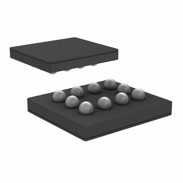

LM2619 www.ti.com SNVS212B – NOVEMBER 2002 – REVISED MAY 2013 500-mA Sub-Miniature Step-Down DC-DC Converter Check for Samples: LM2619 FEATURES DESCRIPTION • • • The LM2619 step down DC-DC converter is optimized for powering circuits from a single lithiumion cell. It steps down an input voltage of 2.8V to 5.5V to an output of 1.5V to 3.6V at up to 500mA. Output voltage is set using resistor feedback dividers. 1 2 • • • • Sub-Miniature 10-Bump Thin DSBGA Package Uses Small Ceramic Capacitors 5-mV (Typical) PWM Mode Output Voltage Ripple (COUT = 22 µF) Internal Soft Start Current Overload Protection Thermal Shutdown External Compensation KEY SPECIFICATIONS • • • • • • • • • • Operates from a single Li-ion cell : 2.8V to 5.5V Output voltage : 1.5V to 3.6V DC feedback voltage precision: ±1% Maximum Load Capability: 500mA PWM Mode Quiescent Current: 600µA typ Shutdown Current: 0.02 µA typ PWM switching frequency: 600kHz SYNC input for PWM mode frequency synchronization from 0.5MHz to 1MHz High efficiency (96% typical at 3.9 VIN, 3.6 VOUT and 200 mA) in PWM mode from internal synchronous rectification 100% Maximum Duty Cycle for Lowest Dropout The device offers three modes for mobile phones and similar portable applications. Fixed-frequency PWM mode minimizes RF interference. A SYNC input allows synchronizing the switching frequency in a range of 500 kHz to 1 MHz. Low-current hysteretic PFM mode reduces quiescent current to 160 µA (typical). Shutdown mode turns the device off and reduces battery consumption to 0.02 µA (typical). Current limit and thermal shutdown features protect the device and system during fault conditions. The LM2619 is available in a 10-bump DSBGA package. This packaging uses chip-scale DSBGA technology and offers the smallest possible size. A high switching frequency (600 kHz) allows use of tiny surface-mount components. The device features external compensation to tailor the response to a wide range of operating conditions. APPLICATIONS • • • • Mobile Phones Hand-Held Radios RF PC Cards Wireless LAN Cards Typical Application Circuits VIN 2.8V to 5. 5V 10PF EN ON/OFF VDD VOU T 1.8 V PVIN SW 1 0 PH SYNC/ MODE 10PF EN ON/OFF LM2619 FB PWM/PFM EAOUT VIN 3.2V to 5. 5V EANEG SGND PGND 6.65k 22PF 33.2k Figure 1. Typical Circuit for 1.8-V Output Voltage VOU T 2.5V PVIN SW 10 PH SYNC/ MODE LM2619 FB PWM/PFM EAOUT EANEG SGND PGND 22.1k 22PF 33.2k 68.1k 39.2k 330pF VDD 330pF Figure 2. Typical Circuit for 2.5-V Output Voltage 1 2 Please be aware that an important notice concerning availability, standard warranty, and use in critical applications of Texas Instruments semiconductor products and disclaimers thereto appears at the end of this data sheet. All trademarks are the property of their respective owners. PRODUCTION DATA information is current as of publication date. Products conform to specifications per the terms of the Texas Instruments standard warranty. Production processing does not necessarily include testing of all parameters. Copyright © 2002–2013, Texas Instruments Incorporated LM2619 SNVS212B – NOVEMBER 2002 – REVISED MAY 2013 VIN 2.8V to 5.5V www.ti.com 10PF VDD EN SW ON/OFF SYNC/ MODE PWM/PFM V OU T 1.5V 10PH PVIN LM2619 FB 22PF EANEG SGND PGND EAOUT 22.1k 680pF Figure 3. Typical Circuit for 1.5-V Output Voltage Connection Diagrams 10-Bump DSBGA Package SGND SGND A1 FB B3 B1 EANEG SW C3 C1 EAOUT PGND D3 D1 SYNC/ MODE A3 VDD VDD A3 B1 B3 PVIN PVIN EAOUT C1 C3 SW SYNC/ MODE D1 D3 PGND FB A1 EANEG A2 D2 EN A2 D2 EN Figure 4. YPA Package Top View Figure 5. YPA Package Bottom View Pin Functions Table 1. Pin Description 2 Pin No. Pin Name A1 FB Function B1 EANEG Inverting input of error amplifier. C1 EAOUT Output of error amplifier. D1 SYNC/MODE Synchronization Input. Use this digital input for frequency selection or modulation control. Set: SYNC/MODE = high for low-noise 600kHz PWM mode SYNC/MODE = low for low-current PFM mode SYNC/MODE = a 500kHz–1MHz external clock for synchronization in PWM mode. (See OPERATING MODE SELECTION and FREQUENCY SYNCHRONIZATION in Device Information.) D2 EN Enable Input. Set this Schmitt trigger digital input high for normal operation. For shutdown, set low. Set EN low during system power-up and other low supply voltage conditions. (See SHUTDOWN MODE in Device Information.) D3 PGND C3 SW B3 PVIN Power Supply Voltage Input to the internal PFET switch. Connect to the input filter capacitor. A3 VDD Analog Supply Input. If board layout is not optimum, an optional 0.1µF ceramic capacitor is suggested. A2 SGND Feedback Analog Input. Power Ground. Switching Node connection to the internal PFET switch and NFET synchronous rectifier. Connect to an inductor with a saturation current rating that exceeds the max Switch Peak Current Limit of the LM2619. Analog and Control Ground. Submit Documentation Feedback Copyright © 2002–2013, Texas Instruments Incorporated Product Folder Links: LM2619 LM2619 www.ti.com SNVS212B – NOVEMBER 2002 – REVISED MAY 2013 These devices have limited built-in ESD protection. The leads should be shorted together or the device placed in conductive foam during storage or handling to prevent electrostatic damage to the MOS gates. Absolute Maximum Ratings (1) −0.2V to +6V PVIN, VDD to SGND −0.2V to +0.2V PGND to SGND, PVIN to VDD −0.2V to +6V EN, EAOUT, EANEG, SYNC/MODE to SGND (GND −0.2V) to (VDD +0.2V) FB, SW −45°C to +150°C Storage temperature range Lead temperature (soldering, 10 sec.) Junction temperature 260°C (2) −25°C to +125°C Minimum ESD rating (Human Body Model, C = 100 pF, R = 1.5 kΩ) Thermal resistance (θJA) (1) ±2 kV (3) 140°C/W Absolute Maximum Ratings indicate limits beyond which damage to the device may occur. Operating Ratings indicate conditions for which the device is functional. For specifications and associated test conditions, see the Min and Max limits and Conditions in the Electrical Characteristics table. Typical (typ) specifications are mean or average values at 25°C. Thermal shutdown will occur if the junction temperature exceeds 150°C. Thermal resistance specified with 2 layer PCB (0.5/0.5 oz. cu). (2) (3) Electrical Characteristics Specifications with standard typeface are for TA = TJ = 25°C, and those in boldface type apply over the full Operating Temperature Range of TA = TJ = −25°C to +85°C. Unless otherwise specified, PVIN = VDD = EN = SYNC/MODE = 3.6V. Symbol Parameter VIN Input voltage range VFB Feedback voltage Conditions PVIN = VDD = VIN (1) Min Typ Max Unit 2.8 3.6 5.5 V 1.485 1.50 1.515 V (2) VHYST PFM comparator hysteresis voltage PFM Mode (SYNC/MODE = 0V) ISHDN Shutdown supply current VIN = 3.6V, EN = 0V 0.02 3 µA IQ1_PWM DC bias current into VDD SYNC/MODE = VIN, FB = 2V 600 725 µA SYNC/MODE = 0V, FB = 2V IQ2_PFM 24 mV 160 195 µA RDSON (P) Pin-pin resistance for PFET 395 550 mΩ RDSON (N) Pin-pin resistance for NFET 330 500 mΩ RDSON (TC) FET resistance temperature coefficient ILIM Switch peak current limit VIH Logic high input, EN, SYNC/MODE VIL Logic low input, EN, SYNC/MODE FSYNC SYNC/MODE clock frequency range FOSC Internal oscillator frequency Tmin Minimum on-time of PFET switch in PWM mode (1) (2) (3) (4) 0.5 (3) 620 0.4 (4) PWM Mode 1100 mA 0.95 1.3 V 0.80 500 468 %/C 810 600 V 1000 kHz 732 kHz 200 ns The LM2619 is designed for mobile phone applications where turn-on after system power-up is controlled by the system controller. Thus, it should be kept in shutdown by holding the EN pin low until the input voltage exceeds 2.8V. The hysteresis voltage is the minimum voltage swing on the FB pin that causes the internal feedback and control circuitry to turn the internal PFET switch on and then off during PFM mode. When resistor dividers are used like in the operating circuit of Figure 20, the hysteresis at the output will be the value of the hysteresis at the feedback pin times the resistor divider ratio. In this case, 24mV (typ) x ((46.4k + 33.2k)/33.2k). Current limit is built-in, fixed, and not adjustable. If the current limit is reached while the voltage at the FB pin is pulled below 0.7V, the internal PFET switch turns off for 2.5µs to allow the inductor current to diminish. SYNC driven with an external clock switching between VIN and GND. When an external clock is present at SYNC; the IC is forced to be in PWM mode at the external clock frequency. The LM2619 synchronizes to the rising edge of the external clock. Submit Documentation Feedback Copyright © 2002–2013, Texas Instruments Incorporated Product Folder Links: LM2619 3 LM2619 SNVS212B – NOVEMBER 2002 – REVISED MAY 2013 www.ti.com Typical Performance Characteristics LM2619ATL, Circuit of Figure 3, VIN = 3.6V, TA = 25°C, unless otherwise noted. Shutdown Quiescent Current vs Temperature (Circuit in Figure 3) Quiescent Supply Current vs Supply Voltage 800 VFB = 2V SUPPLY CURRENT (PA) 700 600 PWM 500 400 300 200 PFM 100 0 2.5 3.0 3.5 4.0 4.5 5.0 5.5 6.0 SUPPLY VOLTAGE (V) Figure 6. Figure 7. Output Voltage vs Supply Voltage (VOUT = 1.5V, PWM MODE) Output Voltage vs Supply Voltage (VOUT = 1.5V, PFM MODE) 1.5030 1.0035 1.5015 1.5010 1.5005 1.5000 1.4995 300mA 1.4990 3.0 3.5 4.0 4.5 5.0 1.0020 VIN = 3.6V 1.0015 1.0010 VIN = 2.8V 1.0005 0.9995 5.5 6.0 0 100 200 300 Figure 8. Figure 9. Output Voltage vs Output Current (VOUT = 1.5V, PWM MODE) Output Voltage vs Output Current (VOUT = 1.5V, PFM MODE) 1.5015 400 OUTPUT CURRENT (mA) SUPPLY VOLTAGE (V) SYNC = VIN VOUT = 1.5V 1.5010 OUTPUT VOLTAGE (V) VIN = 4.2V 1.0025 1.0000 SYNC = VIN VOUT = 1.5V 1.4985 1.4980 2.5 SYNC = VIN VOUT = 1.0V 1.0030 100mA 1.5020 OUTPUT VOLTAGE (V) OUTPUT VOLTAGE (V) 1.5025 VIN = 4.2V 1.5005 1.5000 VIN = 3.6V 1.4995 VIN = 2.8V 1.4990 1.4985 1.4980 1.4975 0 100 200 300 400 OUTPUT CURRENT (mA) Figure 10. 4 Figure 11. Submit Documentation Feedback Copyright © 2002–2013, Texas Instruments Incorporated Product Folder Links: LM2619 LM2619 www.ti.com SNVS212B – NOVEMBER 2002 – REVISED MAY 2013 Typical Performance Characteristics (continued) LM2619ATL, Circuit of Figure 3, VIN = 3.6V, TA = 25°C, unless otherwise noted. Output Voltage vs Output Current (VOUT = 3.6V, PWM MODE) (Circuit in Figure 20) Output Voltage vs Output Current (VOUT = 3.6V, PWM MODE) (Circuit in Figure 20) 3.7 VIN = 4.2V OUTPUT VOLTAGE (V) 3.5 VIN = 3.6V 3.3 3.1 2.9 2.7 2.5 2.3 100 VIN = 2.8V VCON = 0V SYNC = VIN 200 300 400 500 OUTPUT CURRENT (mA) Figure 12. Figure 13. Switching Frequency vs Temperature (Circuit in Figure 3, PWM MODE) Feedback Bias Current vs Temperature (Circuit in Figure 3) Figure 14. Figure 15. Submit Documentation Feedback Copyright © 2002–2013, Texas Instruments Incorporated Product Folder Links: LM2619 5 LM2619 SNVS212B – NOVEMBER 2002 – REVISED MAY 2013 www.ti.com Typical Performance Characteristics (continued) LM2619ATL, Circuit of Figure 3, VIN = 3.6V, TA = 25°C, unless otherwise noted. Efficiency vs Output Current (VOUT = 1.5V, PWM MODE) Efficiency vs Output Current (VOUT = 1.5V, PWM MODE, with Diode) 100 100 VIN = 2.8V VIN = 2.8V 90 80 EFFICIENCY (%) EFFICIENCY (%) 90 VIN = 5.5V VIN = 4.2V 70 VIN = 3.6V 60 50 0 VIN = 3.6V 70 60 50 SYNC = VIN VOUT = 1.5V 40 VIN = 5.5V VIN = 4.2V 80 50 100 150 200 250 300 350 400 450 SYNC = VIN VOUT = 1.5V D1 = MBRM120 40 0 OUTPUT CURRENT (mA) OUTPUT CURRENT (mA) Figure 16. Figure 17. Efficiency vs Output Current (VOUT = 3.6V, PWM MODE) (Circuit in Figure 20) Efficiency vs Output Current (VOUT = 3.6V, PWM MODE, with Diode) (Circuit in Figure 20) 100 100 VIN = 3.9V VIN = 3.9V 95 EFFICIENCY (%) EFFICIENCY (%) 95 90 VIN = 5.5V VIN = 4.2V 85 80 75 70 SYNC = VIN VOUT = 3.6V 0 50 100 150 200 250 300 350 400 450 OUTPUT CURRENT (mA) 90 VIN = 5.5V VIN = 4.2V 85 80 SYNC = VIN VOUT = 3.6V D1 = MBRM120 75 70 0 50 100 150 200 250 300 350 400 450 OUTPUT CURRENT (mA) Figure 18. 6 50 100 150 200 250 300 350 400 450 Figure 19. Submit Documentation Feedback Copyright © 2002–2013, Texas Instruments Incorporated Product Folder Links: LM2619 LM2619 www.ti.com SNVS212B – NOVEMBER 2002 – REVISED MAY 2013 DEVICE INFORMATION The LM2619 is a simple, step-down DC-DC converter optimized for powering circuits in mobile phones, portable communicators, and similar battery powered RF devices. It is based on a current-mode buck architecture, with synchronous rectification in PWM mode for high efficiency. It is designed for a maximum load capability of 500mA in PWM mode. Maximum load range may vary from this depending on input voltage, output voltage and the inductor chosen. The device has all three of the pin-selectable operating modes required for powering circuits in mobile phones and other sophisticated portable devices with complex power management needs. Fixed-frequency PWM operation offers full output current capability at high efficiency while minimizing interference with sensitive IF and data acquisition circuits. During standby operation, hysteretic PFM mode reduces quiescent current to 160µA typ. to maximize battery life. Shutdown mode turns the device off and reduces battery consumption to 0.02µA (typ). DC PWM mode feedback voltage precision is ±1%. Efficiency is typically 96% for a 200mA load with 3.6V output, 3.9V input. The efficiency can be further increased by using a schottky diode like MBRM120L as shown in Figure 20. PWM mode quiescent current is 600µA typ. The output voltage can be set from 1.5V to 3.6V by using external feedback resistors. Additional features include soft-start, current overload protection, over voltage protection and thermal shutdown protection. The LM2619 is constructed using a chip-scale 10-pin thin DSBGA package. This package offers the smallest possible size, for space-critical applications such as cell phones, where board area is an important design consideration. Use of a high switching frequency (600kHz) reduces the size of external components. Board area required for implementation is only 0.58in2(375mm2). Use of a DSBGA package requires special design considerations for implementation. (See DSBGA PACKAGE ASSEMBLY AND USE in Application Information.) Its fine bump-pitch requires careful board design and precision assembly equipment. VIN 3.9V to 5.5V C3* 0.1PF C1 10PF V DD L1 10PH PVIN SW D1** SYSTEM CONTROLLER PWM/PFM ON/OFF VOUT 3.6V LM2619 SYNC/MODE FB R3 68.1k C2 10PF EANEG C5 10pF EN SGND R1 46.4k PGND EAOUT C4 220pF *C3 IS OPTIONAL R2 33.2k **D1 IS OPTIONAL FOR HIGHER EFFICIENCY Figure 20. Typical Operating Circuit for 3.6V Output Voltage CIRCUIT OPERATION Referring to Figure 20, Figure 21, Figure 22, and Figure 23, the LM2619 operates as follows. During the first part of each switching cycle, the control block in the LM2619 turns on the internal PFET switch. This allows current to flow from the input through the inductor to the output filter capacitor and load. The inductor limits the current to a ramp with a slope of (VIN–VOUT)/L, by storing energy in a magnetic field. During the second part of each cycle, the controller turns the PFET switch off, blocking current flow from the input, and then turns the NFET synchronous rectifier on. In response, the inductor's magnetic field collapses, generating a voltage that forces current from ground through the synchronous rectifier to the output filter capacitor and load. As the stored energy is transferred back into the circuit and depleted, the inductor current ramps down with a slope of VOUT/L. If the inductor current reaches zero before the next cycle, the synchronous rectifier is turned off to prevent current reversal. The output filter capacitor stores charge when the inductor current is high, and releases it when low, smoothing the voltage across the load. Submit Documentation Feedback Copyright © 2002–2013, Texas Instruments Incorporated Product Folder Links: LM2619 7 LM2619 SNVS212B – NOVEMBER 2002 – REVISED MAY 2013 www.ti.com The output voltage is regulated by modulating the PFET switch on time to control the average current sent to the load. The effect is identical to sending a duty-cycle modulated rectangular wave formed by the switch and synchronous rectifier at SW to a low-pass filter formed by the inductor and output filter capacitor. The output voltage is equal to the average voltage at the SW pin. VDD SYNC/ MODE OSCILLATOR AND MODE CONTROL 6 PVIN CURRENT SENSE EAOUT EANEG PWM COMP. 5k MOSFET CONTROL LOGIC OVP COMP. FB PFM COMP. 1.5V REF SW ZERO CROSSING DETECTOR SHUTDOWN CONTROL SOFT START EN PGND SGND Figure 21. Simplified Functional Diagram PWM OPERATION While in PWM (Pulse Width Modulation) mode, the output voltage is regulated by switching at a constant frequency and then modulating the energy per cycle to control power to the load. Energy per cycle is set by modulating the PFET switch on-time pulse-width to control the peak inductor current. This is done by comparing the signal from the current-sense amplifier with a slope compensated error signal from the voltage-feedback error amplifier. At the beginning of each cycle, the clock turns on the PFET switch, causing the inductor current to ramp up. When the current sense signal ramps past the error amplifier signal, the PWM comparator turns off the PFET switch and turns on the NFET synchronous rectifier, ending the first part of the cycle. If an increase in load pulls the output voltage down, the error amplifier output increases, which allows the inductor current to ramp higher before the comparator turns off the PFET. This increases the average current sent to the output and adjusts for the increase in the load. Before going to the PWM comparator, the error signal is summed with a slope compensation ramp from the oscillator for stability of the current feedback loop. During the second part of the cycle, a zero crossing detector turns off the NFET synchronous rectifier if the inductor current ramps to zero. The minimum on time of the PFET in PWM mode is about 200ns. 8 Submit Documentation Feedback Copyright © 2002–2013, Texas Instruments Incorporated Product Folder Links: LM2619 LM2619 www.ti.com SNVS212B – NOVEMBER 2002 – REVISED MAY 2013 PWM Mode Switching Waveform A: Inductor Current, 500mA/div B: SW Pin, 2V/div C: VOUT, 10mV/div, AC Coupled PFM Mode Switching Waveform A: Inductor Current, 500mA/div B: SW Pin, 2V/div C: VOUT, 50mV/div, AC Coupled Figure 22. Figure 23. PFM OPERATION Connecting the SYNC/MODE to SGND sets the LM2619 to hysteretic PFM operation. While in PFM (Pulse Frequency Modulation) mode, the output voltage is regulated by switching with a discrete energy per cycle and then modulating the cycle rate, or frequency, to control power to the load. This is done by using an error comparator to sense the output voltage. The device waits as the load discharges the output filter capacitor, until the output voltage drops below the lower threshold of the PFM error-comparator. Then the device initiates a cycle by turning on the PFET switch. This allows current to flow from the input, through the inductor to the output, charging the output filter capacitor. The PFET is turned off when the output voltage rises above the regulation threshold of the PFM error comparator. Thus, the output voltage ripple in PFM mode is proportional to the hysteresis of the error comparator. In PFM mode, the device only switches as needed to service the load. This lowers current consumption by reducing power consumed during the switching action in the circuit, due to transition losses in the internal MOSFETs, gate drive currents, eddy current losses in the inductor, etc. It also improves light-load voltage regulation. During the second half of the cycle, the intrinsic body diode of the NFET synchronous rectifier conducts until the inductor current ramps to zero. OPERATING MODE SELECTION The LM2619 is designed for digital control of the operating modes by the system controller. This prevents the spurious switch over from low-noise PWM mode between transmission intervals in mobile phone applications that can occur in other products. The SYNC/MODE digital input pin is used to select the operating mode. Setting SYNC/MODE high (above 1.3V) selects 600kHz current-mode PWM operation. PWM mode is optimized for low-noise, high-power operation for use when the load is active. Setting SYNC/MODE low (below 0.4V) selects hysteretic voltage-mode PFM operation. PFM mode is optimized for reducing power consumption and extending battery life when the load is in a low-power standby mode. In PFM mode, quiescent current into the VDD pin is 160µA typ. In contrast, PWM mode VDD-pin quiescent current is 600µA typ. PWM operation is intended for use with loads of 50mA or more, when low noise operation is desired. Below 100mA, PFM operation can be used to allow precise regulation, and reduced current consumption. The LM2619 has an over-voltage feature that prevents the output voltage from rising too high, when the device is left in PWM mode under low-load conditions. See Overvoltage Protection, for more information. Switch modes with the SYNC/MODE pin, using a signal with a slew rate faster than 5V/100µs. Use a comparator, Schmitt trigger or logic gate to drive the SYNC/MODE pin. Do not leave the pin floating or allow it to linger between thresholds. These measures will prevent output voltage errors in response to an indeterminate logic state. The LM2619 switches on each rising edge of SYNC. Ensure a minimum load to keep the output voltage in regulation when switching modes frequently. Submit Documentation Feedback Copyright © 2002–2013, Texas Instruments Incorporated Product Folder Links: LM2619 9 LM2619 SNVS212B – NOVEMBER 2002 – REVISED MAY 2013 www.ti.com FREQUENCY SYNCHRONIZATION The SYNC/MODE input can also be used for frequency synchronization. During synchronization, the LM2619 initiates cycles on the rising edge of the clock. When synchronized to an external clock, it operates in PWM mode. The device can synchronize to a 50% duty-cycle clock over frequencies from 500kHz to 1MHz. If a different duty cycle is used other than 50% the range for acceptable duty cycles is 30% to 70%. Use the following waveform and duty cycle guidelines when applying an external clock to the SYNC/MODE pin. Clock under/overshoot should be less than 100mV below GND or above VDD. When applying noisy clock signals, especially sharp edged signals from a long cable during evaluation, terminate the cable at its characteristic impedance and add an RC filter to the SYNC pin, if necessary, to soften the slew rate and over/undershoot. Note that sharp edged signals from a pulse or function generator can develop under/overshoot as high as 10V at the end of an improperly terminated cable. OVERVOLTAGE PROTECTION The LM2619 has an over-voltage comparator that prevents the output voltage from rising too high when the device is left in PWM mode under low-load conditions. When the output voltage rises by about 100mV (Figure 3) over its regulation threshold, the OVP comparator inhibits PWM operation to skip pulses until the output voltage returns to the regulation threshold. When resistor dividers are used the OVP threshold at the output will be the value of the threshold at the feedback pin times the resistor divider ratio. In over voltage protection, output voltage and ripple will increase. SHUTDOWN MODE Setting the EN digital input pin low (
