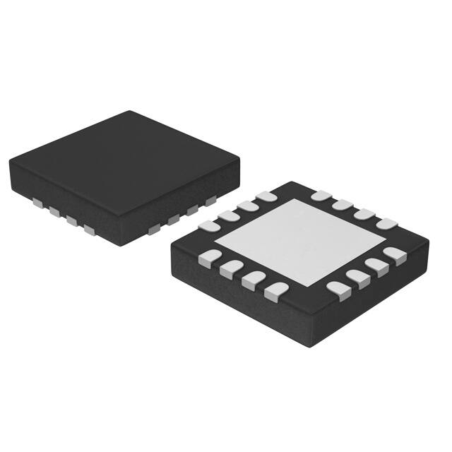

LM26420Q1XSQ/NOPB 数据手册
Product Folder Order Now Support & Community Tools & Software Technical Documents Reference Design LM26420 SNVS579L – FEBRUARY 2009 – REVISED MAY 2018 LM26420 Dual 2-A, High-Efficiency Synchronous DC/DC Converter 1 Features 3 Description • The LM26420 regulator is a monolithic, highefficiency dual PWM step-down DC/DC converter. This device has the ability to drive two 2-A loads with an internal 75-mΩ PMOS top switch and an internal 50-mΩ NMOS bottom switch using state-of-the-art BICMOS technology results in the best power density available. The world-class control circuitry allow on times as low as 30 ns, thus supporting exceptionally high-frequency conversion over the entire 3-V to 5.5V input operating range down to the minimum output voltage of 0.8 V. 1 • • • • • • • • • • • • • Compliant with CISPR25 Class 5 Conducted Emissions Input Voltage Range of 3 V to 5.5 V Output Voltage Range of 0.8 V to 4.5 V 2-A Output Current per Regulator High Switching Frequency: 2.2 MHz (LM26420X) 0.55 MHz (LM26420Y) 0.8 V, 1.5% Internal Voltage Reference Internal Soft Start Independent Power Good and Precision Enable for Each Output Current Mode, PWM Operation Thermal Shutdown Overvoltage Protection Start-up into Prebiased Output Loads Regulators are 180° Out of Phase Create a Custom Design Using the LM26420 With the WEBENCH® Power Designer 2 Applications • • • • Local 5 V to Vcore of FPGAs Core Power in HDDs and Set-Top Boxes USB Powered Devices Powering Core and I/O Voltages for CPUs and ASICs space LM26420 Dual Buck DC/DC Converter VIN 3 V to 5.5 V Although the operating frequency is high, efficiencies up to 93% are easy to achieve. External shutdown is included, featuring an ultra-low standby current. The LM26420 utilizes current-mode control and internal compensation to provide high performance regulation over a wide range of operating conditions. Device Information(1) PART NUMBER LM26420 PACKAGE BODY SIZE (NOM) HTSSOP (20) 6.50 mm × 4.40 mm WQFN (16) 4.00 mm × 4.00 mm (1) For all available packages, see the orderable addendum at the end of the data sheet. LM26420 Efficiency (Up to 93%) VIN VOUT1 2.5 V/2 A PG2 EN1 SW1 LM26420 Buck 1 PG1 EN2 Buck 2 VOUT2 1.2 V/2 A SW2 FB2 FB1 GND Copyright © 2016, Texas Instruments Incorporated 1 An IMPORTANT NOTICE at the end of this data sheet addresses availability, warranty, changes, use in safety-critical applications, intellectual property matters and other important disclaimers. PRODUCTION DATA. LM26420 SNVS579L – FEBRUARY 2009 – REVISED MAY 2018 www.ti.com Table of Contents 1 2 3 4 5 6 7 Features .................................................................. Applications ........................................................... Description ............................................................. Revision History..................................................... Pin Configuration and Functions ......................... Specifications......................................................... 1 1 1 2 4 6 6.1 6.2 6.3 6.4 6.5 6.6 6 6 6 6 7 8 Absolute Maximum Ratings ...................................... ESD Ratings (LM26420X/Y) .................................... Recommended Operating Conditions....................... Thermal Information .................................................. Electrical Characteristics Per Buck ........................... Typical Characteristics .............................................. Detailed Description ............................................ 13 7.1 7.2 7.3 7.4 Overview ................................................................. Functional Block Diagram ....................................... Feature Description................................................. Device Functional Modes........................................ 13 14 14 15 8 Application and Implementation ........................ 16 8.1 Application Information............................................ 16 8.2 Typical Applications ............................................... 19 9 Power Supply Recommendations...................... 32 10 Layout................................................................... 32 10.1 Layout Guidelines ................................................. 32 10.2 Layout Example .................................................... 33 10.3 Thermal Considerations ........................................ 33 11 Device and Documentation Support ................. 36 11.1 11.2 11.3 11.4 11.5 11.6 11.7 Device Support...................................................... Documentation Support ........................................ Receiving Notification of Documentation Updates Community Resources.......................................... Trademarks ........................................................... Electrostatic Discharge Caution ............................ Glossary ................................................................ 36 36 36 36 36 37 37 12 Mechanical, Packaging, and Orderable Information ........................................................... 37 4 Revision History Changes from Revision K (April 2016) to Revision L Page • Split automotive data sheet to separate document (SNVSB35) and remove automotive-specific content from SNVS579 ............................................................................................................................................................................... 1 • Added links for WEBENCH .................................................................................................................................................... 1 Changes from Revision J (September 2015) to Revision K Page • Changed RθJA value from 35°C/W to 38.5°C/W for PWP package and from 40°C/W to 36.2°C/W; replaced RθJC values with 2 new rows (and new values); added additional thermal values......................................................................... 6 • Changed "C1" to "C2" on Figure 42 ..................................................................................................................................... 20 • Changed "C1" to "C2" on Figure 51 ..................................................................................................................................... 29 • Deleted "C7" and "C8" from Table 6 ................................................................................................................................... 30 Changes from Revision I (June 2015) to Revision J Page • fixed error in WQFN Pin Functions - shifted "Description" column down one row and added back description for VIND1 pin ................................................................................................................................................................................ 4 • Changed reference from "Typical Applications" to "Table 1". ............................................................................................. 22 • Deleted definition for RDS (not part of equation 15) ............................................................................................................. 22 Changes from Revision H (August 2014) to Revision I Page • Changed "Frequency" to "Efficiency" in title; add new Feature bullet re: CISPR25............................................................... 1 • Changed moved Storage temperature to Absolute Maximum Ratings table ......................................................................... 6 • Changed figure 36 caption .................................................................................................................................................. 13 • Added part number to caption wording ................................................................................................................................ 14 • Added application note ........................................................................................................................................................ 16 • Changed title of Thermal Guidelines to Thermal Considerations and moved the section to the correct location................ 33 2 Submit Documentation Feedback Copyright © 2009–2018, Texas Instruments Incorporated Product Folder Links: LM26420 LM26420 www.ti.com • SNVS579L – FEBRUARY 2009 – REVISED MAY 2018 Added Related Documentation and Community Resources subsections ............................................................................ 36 Changes from Revision G (July 2014) to Revision H • Page Changed percent sign to suffix .............................................................................................................................................. 7 Changes from Revision F (March 2013) to Revision G Page • Changed formatting to match new TI datasheet guidelines; added Device Information and Handling Ratings tables, Layout, and Device and Documentation Support sections; reformatted Functional Description to Detailed Description and Applications to Applications and Implementation sections........................................................................... 1 • Changed to new equation..................................................................................................................................................... 34 Submit Documentation Feedback Copyright © 2009–2018, Texas Instruments Incorporated Product Folder Links: LM26420 3 LM26420 SNVS579L – FEBRUARY 2009 – REVISED MAY 2018 www.ti.com 5 Pin Configuration and Functions RUM Package 16-Pin WQFN Top View 4 3 2 PWP Package 20-Pin HTSSOP Top View 1 20 19 18 17 16 15 14 13 12 11 1 2 3 4 5 6 7 8 9 10 16 5 15 6 DAP 7 14 8 13 9 10 11 12 Pin Functions: 16-Pin WQFN PIN NUMBER NAME 1,2 TYPE DESCRIPTION VIND1 P Power input supply for Buck 1. 3 SW1 P Output switch for Buck 1. Connect to the inductor. 4 PGND1 G Power ground pin for Buck 1. 5 FB1 A Feedback pin for Buck 1. Connect to external resistor divider to set output voltage. 6 PG1 G Power Good Indicator for Buck 1. Pin is connected through a resistor to an external supply (open drain output). 7 PG2 G Power Good Indicator for Buck 2. Pin is connected through a resistor to an external supply (open drain output). 8 FB2 A Feedback pin for Buck 2. Connect to external resistor divider to set output voltage. 9 PGND2 G Power ground pin for Buck 2. 10 SW2 P Output switch for Buck 2. Connect to the inductor. VIND2 A Power Input supply for Buck 2. 13 EN2 A Enable control input. Logic high enable operation for Buck 2. Do not allow this pin to float or be greater than VIN + 0.3 V. 14 AGND G Signal ground pin. Place the bottom resistor of the feedback network as close as possible to pin. 15 VINC A Input supply for control circuitry. 16 EN1 A Enable control input. Logic high enable operation for Buck 1. Do not allow this pin to float or be greater than VIN + 0.3 V. Die Attach Pad — Connect to system ground for low thermal impedance and as a primary electrical GND connection. 11, 12 DAP 4 Submit Documentation Feedback Copyright © 2009–2018, Texas Instruments Incorporated Product Folder Links: LM26420 LM26420 www.ti.com SNVS579L – FEBRUARY 2009 – REVISED MAY 2018 Pin Functions 20-Pin HTSSOP PIN TYPE DESCRIPTION NUMBER NAME 1 VINC A Input supply for control circuitry. 2 EN1 A Enable control input. Logic high enable operation for Buck 1. Do not allow this pin to float or be greater than VIN + 0.3 V. VIND1 A Power Input supply for Buck 1. SW1 P Output switch for Buck 1. Connect to the inductor. PGND1 G Power ground pin for Buck 1. 3, 4 5 6,7 8 FB1 A Feedback pin for Buck 1. Connect to external resistor divider to set output voltage. 9 PG1 G Power Good Indicator for Buck 1. Pin is connected through a resistor to an external supply (open drain output). Die Attach Pad — Connect to system ground for low thermal impedance, but it cannot be used as a primary GND connection. PG2 G Power Good Indicator for Buck 2. Pin is connected through a resistor to an external supply (open drain output). 10, 11, DAP 12 13 14, 15 16 17, 18 FB2 A Feedback pin for Buck 2. Connect to external resistor divider to set output voltage. PGND2 G Power ground pin for Buck 2. SW2 P Output switch for Buck 2. Connect to the inductor. VIND2 A Power Input supply for Buck 2. 19 EN2 A Enable control input. Logic high enable operation for Buck 2. Do not allow this pin to float or be greater than VIN + 0.3 V. 20 AGND G Signal ground pin. Place the bottom resistor of the feedback network as close as possible to pin. Submit Documentation Feedback Copyright © 2009–2018, Texas Instruments Incorporated Product Folder Links: LM26420 5 LM26420 SNVS579L – FEBRUARY 2009 – REVISED MAY 2018 www.ti.com 6 Specifications 6.1 Absolute Maximum Ratings Over operating free-air temperature range (unless otherwise noted) (1) MIN MAX VIN –0.5 7 FB –0.5 3 EN –0.5 7 Output voltages SW –0.5 7 V Infrared or convection reflow (15 sec) Soldering Information 220 °C 150 °C Input voltages Storage temperature Tstg (1) –65 UNIT V Stresses beyond those listed under Absolute Maximum Ratings may cause permanent damage to the device. These are stress ratings only, which do not imply functional operation of the device at these or any other conditions beyond those indicated under Recommended Operating Conditions. Exposure to absolute-maximum-rated conditions for extended periods may affect device reliability. 6.2 ESD Ratings (LM26420X/Y) VALUE V(ESD) (1) (2) Electrostatic discharge Human-body model (HBM), per ANSI/ESDA/JEDEC JS-001 (1) ±2000 Charged-device model (CDM), per JEDEC specification JESD22-C101 (2) ±750 UNIT V JEDEC document JEP155 states that 500-V HBM allows safe manufacturing with a standard ESD control process. JEDEC document JEP157 states that 250-V CDM allows safe manufacturing with a standard ESD control process. 6.3 Recommended Operating Conditions Over operating free-air temperature range (unless otherwise noted) MIN VIN MAX 3 5.5 Junction temperature (Q1) –40 125 Junction temperature (Q0) –40 150 UNIT V °C 6.4 Thermal Information LM26420 THERMAL METRIC (1) PWP (HTSSOP) RUM (WQFN) UNIT 20 PINS 16 PINS RθJA Junction-to-ambient thermal resistance 38.5 36.2 °C/W RθJC(top) Junction-to-case thermal resistance 21.0 32.7 °C/W RθJB Junction-to-board thermal resistance 19.9 14.1 °C/W ψJT Junction-to-top characterization parameter 0.7 0.3 °C/W ψJB Junction-to-board characterization parameter 19.7 14.2 °C/W RθJC(bot) Junction-to-case (bottom) thermal resistance 3.5 4.1 °C/W (1) 6 For more information about traditional and new thermal metrics, see the Semiconductor and IC Package Thermal Metrics application report. Submit Documentation Feedback Copyright © 2009–2018, Texas Instruments Incorporated Product Folder Links: LM26420 LM26420 www.ti.com SNVS579L – FEBRUARY 2009 – REVISED MAY 2018 6.5 Electrical Characteristics Per Buck Over operating free-air temperature range (unless otherwise noted) PARAMETER VFB Feedback Voltage ΔVFB/VIN Feedback Voltage Line Regulation IB Feedback Input Bias Current UVLO Undervoltage Lockout TEST CONDITIONS MIN 0.788 VIN = 3 V to 5.5 V MAX 0.8 0.812 0.05 VIN Rising VIN Falling TYP 2 UVLO Hysteresis UNIT V %/V 0.4 100 nA 2.628 2.9 V 2.3 V 330 mV FSW Switching Frequency LM26420-X 1.85 2.2 2.65 FSW Switching Frequency LM26420-Y 0.4 0.55 0.7 FFB Frequency Foldback LM26420-X 300 FFB Frequency Foldback LM26420-Y 150 DMAX Maximum Duty Cycle LM26420-X 86% 91.5% DMAX Maximum Duty Cycle LM26420-Y 90% 98% MHz kHz WQFN-16 Package 75 135 HTSSOP-20 Package 70 135 WQFN-16 Package 55 100 TSSOP-20 Package 45 80 RDSON_TOP TOP Switch On Resistance RDSON_BOT BOTTOM Switch On Resistance ICL_TOP TOP Switch Current Limit VIN = 3.3 V 2.4 3.3 A ICL_BOT BOTTOM Switch Reverse Current Limit VIN = 3.3 V 0.4 0.75 A ΔΦ Phase Shift Between SW1 and SW2 160 180 200 Enable Threshold Voltage 0.97 1.04 1.12 VEN_TH Enable Threshold Hysteresis 0.15 ISW_TOP Switch Leakage IEN Enable Pin Current Sink/Source VPG-TH-U Upper Power Good Threshold FB Pin Voltage Rising 848 Upper Power Good Hysteresis VPG-TH-L Lower Power Good Threshold Lower Power Good Hysteresis 656 mΩ ° V –0.7 µA 5 nA 925 1,008 40 FB Pin Voltage Rising mΩ 710 mV mV 791 40 mV mV VINC Quiescent Current (nonswitching) with both outputs on LM26420X/Y VFB = 0.9 V 3.3 5 VINC Quiescent Current (switching) with both outputs on LM26420X/Y VFB = 0.7 V 4.7 6.2 VINC Quiescent Current (shutdown) All Options VEN = 0 V VIND Quiescent Current (nonswitching) LM26420X/Y VFB = 0.9 V 0.9 1.5 VIND Quiescent Current (switching) LM26420X VFB = 0.7 V 11 15 IQVIND VIND Quiescent Current (switching) LM26420Y VFB = 0.7 V 3.7 7.5 IQVIND VIND Quiescent Current (shutdown) All Options VEN = 0 V 0.1 µA TSD Thermal Shutdown Temperature 165 °C IQVINC IQVIND 0.05 mA µA mA Submit Documentation Feedback Copyright © 2009–2018, Texas Instruments Incorporated Product Folder Links: LM26420 mA 7 LM26420 SNVS579L – FEBRUARY 2009 – REVISED MAY 2018 www.ti.com 6.6 Typical Characteristics All curves taken at VIN = 5 V with configuration in typical application circuits shown in Application and Implementation. TJ = 25°C, unless otherwise specified. 8 Figure 1. Efficiency vs Load, X Option Figure 2. Efficiency Vs Load, Y Option Figure 3. Efficiency vs Load, X Option Figure 4. Efficiency vs Load, Y Option Figure 5. Efficiency vs Load, X Option Figure 6. Efficiency vs Load, Y Option Submit Documentation Feedback Copyright © 2009–2018, Texas Instruments Incorporated Product Folder Links: LM26420 LM26420 www.ti.com SNVS579L – FEBRUARY 2009 – REVISED MAY 2018 Typical Characteristics (continued) All curves taken at VIN = 5 V with configuration in typical application circuits shown in Application and Implementation. TJ = 25°C, unless otherwise specified. Figure 8. Efficiency vs Load, Y Option Figure 9. Efficiency vs Load, X Option Figure 10. Efficiency vs Load, Y Option 1.808 1.808 1.807 1.807 1.806 1.806 OUTPUT (V) OUTPUT (V) Figure 7. Efficiency vs Load, X Option 1.805 1.804 1.805 1.804 1.803 1.803 1.802 1.802 1.801 0.0 0.25 0.5 0.75 1.0 1.25 1.5 1.75 2.0 1.801 0.0 0.25 0.5 0.75 1.0 1.25 1.5 1.75 2.0 LOAD (A) VIN = 5 V LOAD (A) VOUT = 1.8 V VIN = 3 V Figure 11. Load Regulation (All Options) VOUT = 1.8 V Figure 12. Load Regulation (All Options) Submit Documentation Feedback Copyright © 2009–2018, Texas Instruments Incorporated Product Folder Links: LM26420 9 LM26420 SNVS579L – FEBRUARY 2009 – REVISED MAY 2018 www.ti.com Typical Characteristics (continued) 1.798 1.808 1.797 1.807 1.796 1.806 OUTPUT (V) OUTPUT (V) All curves taken at VIN = 5 V with configuration in typical application circuits shown in Application and Implementation. TJ = 25°C, unless otherwise specified. 1.795 1.794 1.805 1.804 1.793 1.792 1.803 3.0 3.5 4.0 4.5 5.0 1.802 3.0 5.5 3.5 INPUT VOLTAGE (V) VOUT = 1.8 V IOUT = 1000 mA VOUT = 1.8 V 4.5 5.0 5.5 IOUT = 1000 mA Figure 13. Line Regulation, X Option Figure 14. Line Regulation - Y Option Figure 15. Oscillator Frequency vs Temperature,, X Option Figure 16. Oscillator Frequency vs Temperature, Y Option 80 WQFN - BOTTOM FET - R DSON (mΩ) WQFN - TOP FET - R DSON (mΩ) 110 100 90 80 70 60 50 -50 -25 0 25 50 75 100 70 60 50 40 30 -50 125 -25 0 25 50 75 100 125 TEMPERATURE (°C) TEMPERATURE (°C) Figure 17. RDSON Top Vs Temperature (WQFN-16 Package) 10 4.0 INPUT VOLTAGE (V) Submit Documentation Feedback Figure 18. RDSON Bottom Vs Temperature (WQFN-16 Package) Copyright © 2009–2018, Texas Instruments Incorporated Product Folder Links: LM26420 LM26420 www.ti.com SNVS579L – FEBRUARY 2009 – REVISED MAY 2018 Typical Characteristics (continued) All curves taken at VIN = 5 V with configuration in typical application circuits shown in Application and Implementation. TJ = 25°C, unless otherwise specified. 80 TSSOP - BOTTOM FET - R DSON (mΩ) TSSOP - TOP FET - R DSON (mΩ) 110 100 90 80 70 60 50 -50 -25 0 25 50 75 100 70 60 50 40 30 20 -50 125 -25 0 25 50 100 125 Figure 20. RDSON Bottom vs Temperature (TSSOP-20 Package) Figure 19. RDSON Top Vs Temperature (TSSOP-20 Package) 11.6 3.9 X Version Y Version IQ SWITCHING - VIND (mA) IQ SWITCHING - VIND (mA) 75 TEMPERATURE (°C) TEMPERATURE (°C) 11.4 11.2 11.0 10.8 10.6 -50 -25 0 25 50 75 100 3.8 3.7 3.6 3.5 3.4 -50 125 -25 0 25 50 75 100 125 TEMPERATURE (°C) TEMPERATURE (°C) Figure 21. IQ (Quiescent Current Switching), X Option Figure 22. IQ (Quiescent Current Switching), Y Option 3.50 CURRENT LIMIT (A) 3.45 3.40 3.35 3.30 3.25 3.20 3.15 3.10 -50 -25 0 25 50 75 100 125 TEMPERATURE (°C) VIN = 5 V and 3.3 V Figure 24. Current Limit vs Temperature Figure 23. VFB vs Temperature Submit Documentation Feedback Copyright © 2009–2018, Texas Instruments Incorporated Product Folder Links: LM26420 11 LM26420 SNVS579L – FEBRUARY 2009 – REVISED MAY 2018 www.ti.com Typical Characteristics (continued) All curves taken at VIN = 5 V with configuration in typical application circuits shown in Application and Implementation. TJ = 25°C, unless otherwise specified. REVERSE CURRENT LIMIT (A) 0.78 0.77 0.76 0.75 0.74 0.73 0.72 0.71 0.70 -50 -25 0 25 50 75 100 125 TEMPERATURE (°C) Figure 25. Reverse Current Limit vs Temperature 12 Submit Documentation Feedback Figure 26. Short Circuit Waveforms Copyright © 2009–2018, Texas Instruments Incorporated Product Folder Links: LM26420 LM26420 www.ti.com SNVS579L – FEBRUARY 2009 – REVISED MAY 2018 7 Detailed Description 7.1 Overview The LM26420 is a constant frequency dual PWM buck synchronous regulator device that can supply two loads at up to 2 A each. The regulator has a preset switching frequency of either 2.2 MHz or 550 kHz. This high frequency allows the LM26420 to operate with small surface mount capacitors and inductors, resulting in a DC/DC converter that requires a minimum amount of board space. The LM26420 is internally compensated, so it is simple to use and requires few external components. The LM26420 uses current-mode control to regulate the output voltage. The following operating description of the LM26420 refers to the Functional Block Diagram, which depicts the functional blocks for one of the two channels, and to the waveforms in Figure 27. The LM26420 supplies a regulated output voltage by switching the internal PMOS and NMOS switches at constant frequency and variable duty cycle. A switching cycle begins at the falling edge of the reset pulse generated by the internal clock. When this pulse goes low, the output control logic turns on the internal PMOS control switch (TOP Switch). During this on-time, the SW pin voltage (VSW) swings up to approximately VIN, and the inductor current (IL) increases with a linear slope. IL is measured by the current sense amplifier, which generates an output proportional to the switch current. The sense signal is summed with the regulator’s corrective ramp and compared to the error amplifier’s output, which is proportional to the difference between the feedback voltage and VREF. When the PWM comparator output goes high, the TOP Switch turns off and the NMOS switch (BOTTOM Switch) turns on after a short delay, which is controlled by the Dead-Time-Control Logic, until the next switching cycle begins. During the top switch off-time, inductor current discharges through the BOTTOM Switch, which forces the SW pin to swing to ground. The regulator loop adjusts the duty cycle (D) to maintain a constant output voltage. VSW D = TON/TSW VIN SW Voltage TOFF TON 0 t IL TSW IPK Inductor Current t 0 Figure 27. LM26420 Basic Operation of the PWM Comparator Submit Documentation Feedback Copyright © 2009–2018, Texas Instruments Incorporated Product Folder Links: LM26420 13 LM26420 SNVS579L – FEBRUARY 2009 – REVISED MAY 2018 www.ti.com 7.2 Functional Block Diagram VIN EN ThermalSHDN + + - ILIMIT ENABLE and UVLO VREF x 1.15 + OVPSHDN + ISENSE Control Logic RAMPArtificial Clock 2.2 MHz/550 kHz ISENSE S FB + - + R R Q P-FET DeadTimeControl Logic SW DRIVERS N-FET InternalComp Q VREF=0.8 V R Internal - LDO S + - SOFT-START IREVERSE-LIMIT Pgood 880 mV 720 mV + - + - GND Copyright © 2016, Texas Instruments Incorporated 7.3 Feature Description 7.3.1 Soft Start This function forces VOUT to increase at a controlled rate during start-up in a controlled fashion, which helps reduce inrush current and eliminate overshoot on VOUT. During soft start, reference voltage of the error amplifier ramps from 0 V to its nominal value of 0.8 V in approximately 600 µs. If the converter is turned on into a prebiased load, then the feedback begins ramping from the prebias voltage but at the same rate as if it had started from 0 V. The two outputs start up ratiometrically if enabled at the same time, see Figure 28 below. 14 Submit Documentation Feedback Copyright © 2009–2018, Texas Instruments Incorporated Product Folder Links: LM26420 LM26420 www.ti.com SNVS579L – FEBRUARY 2009 – REVISED MAY 2018 Feature Description (continued) RATIOMETRIC START UP VOUT1 VOLTAGE VOUT2 VEN1,2 TIME Figure 28. LM26420 Soft-Start 7.3.2 Power Good The LM26420 features an open drain power good (PG) pin to sequence external supplies or loads and to provide fault detection. This pin requires an external resistor (RPG) to pull PG high when the output is within the PG tolerance window. Typical values for this resistor range from 10 kΩ to 100 kΩ. 7.3.3 Precision Enable The LM26420 features independent precision enables that allow the converter to be controlled by an external signal. This feature allows the device to be sequenced either by a external control signal or the output of another converter in conjunction with a resistor divider network. It can also be set to turn on at a specific input voltage when used in conjunction with a resistor divider network connected to the input voltage. The device is enabled when the EN pin exceeds 1.04 V and has a 150-mV hysteresis. 7.4 Device Functional Modes 7.4.1 Output Overvoltage Protection The overvoltage comparator compares the FB pin voltage to a voltage that is approximately 15% greater than the internal reference VREF. Once the FB pin voltage goes 15% above the internal reference, the internal PMOS switch is turned off, which allows the output voltage to decrease toward regulation. 7.4.2 Undervoltage Lockout Undervoltage lockout (UVLO) prevents the LM26420 from operating until the input voltage exceeds 2.628 V (typical). The UVLO threshold has approximately 330 mV of hysteresis, so the device operates until VIN drops below 2.3 V (typical). Hysteresis prevents the part from turning off during power up if VIN is non-monotonic. 7.4.3 Current Limit The LM26420 uses cycle-by-cycle current limiting to protect the output switch. During each switching cycle, a current limit comparator detects if the output switch current exceeds 3.3 A (typical), and turns off the switch until the next switching cycle begins. 7.4.4 Thermal Shutdown Thermal shutdown limits total power dissipation by turning off the output switch when the device junction temperature exceeds 165°C. After thermal shutdown occurs, the output switch does not turn on until the junction temperature drops to approximately 150°C. Submit Documentation Feedback Copyright © 2009–2018, Texas Instruments Incorporated Product Folder Links: LM26420 15 LM26420 SNVS579L – FEBRUARY 2009 – REVISED MAY 2018 www.ti.com 8 Application and Implementation NOTE Information in the following applications sections is not part of the TI component specification, and TI does not warrant its accuracy or completeness. TI’s customers are responsible for determining suitability of components for their purposes. Customers should validate and test their design implementation to confirm system functionality. 8.1 Application Information 8.1.1 Programming Output Voltage The output voltage is set using Equation 1 where R2 is connected between the FB pin and GND, and R1 is connected between VOUT and the FB pin. A good value for R2 is 10 kΩ. When designing a unity gain converter (VOUT = 0.8 V), R1 must be between 0 Ω and 100 Ω, and R2 must be on the order of 5 kΩ to 50 kΩ. 10 kΩ is the suggested value where R1 is the top feedback resistor and R2 is the bottom feedback resistor. VOUT R1 = VREF - 1 x R2 (1) (2) VREF = 0.80V LOUT LM26420 VIND VINC EN VOUT SW R1 COUT FB AGND PGND R2 Copyright © 2016, Texas Instruments Incorporated Figure 29. Programming VOUT To determine the maximum allowed resistor tolerance, use Equation 3: 1 V= VFB 1 1 + 2x VOUT TOL I where • TOL is the set point accuracy of the regulator, is the tolerance of VFB. (3) Example: VOUT = 2.5 V, with a setpoint accuracy of ±3.5%. 1 V= 0.8V 2.5V 1 + 2x 3.5% 1.5% 1 = 1.4% (4) Choose 1% resistors. If R2 = 10 kΩ, then R1 is 21.25 kΩ. 16 Submit Documentation Feedback Copyright © 2009–2018, Texas Instruments Incorporated Product Folder Links: LM26420 LM26420 www.ti.com SNVS579L – FEBRUARY 2009 – REVISED MAY 2018 Application Information (continued) 8.1.2 VINC Filtering Components Additional filtering is required between VINC and AGND in order to prevent high frequency noise on VIN from disturbing the sensitive circuitry connected to VINC. A small RC filter can be used on the VINC pin as shown in Figure 30. VIN LM26420 VIND1,2 SW VINC RF CIN CF FB EN AGND PGND Copyright © 2016, Texas Instruments Incorporated Figure 30. RC Filter On VINC In general, RF is typically between 1 Ω and 10 Ω so that the steady state voltage drop across the resistor due to the VINC bias current does not affect the UVLO level. CF can range from 0.22 µF to 1 µF in X7R or X5R dielectric, where the RC time constant should be at least 2 µs. CF must be placed as close to the device as possiblewith a direct connection from VINC and AGND. 8.1.3 Using Precision Enable and Power Good The LM26420 device precision EN and PG pins address many of the sequencing requirements required in today's challenging applications. Each output can be controlled independently and have independent power good. This allows for a multitude of ways to control each output. Typically, the enables to each output are tied together to the input voltage and the outputs ratiometrically ramp up when the input voltage reaches above UVLO rising threshold. There may be instances where it is desired that the second output (VOUT2) does not turn on until the first output (VOUT1) has reached 90% of the desired setpoint. This is easily achieved with an external resistor divider attached from VOUT1 to EN2, see Figure 31. Figure 31. VOUT1 Controlling VOUT2 with Resistor Divider If it is not desired to have a resistor divider to control VOUT2 with VOUT1, then the PG1 can be connected to the EN2 pin to control VOUT2, see Figure 32. RPG1 is a pullup resistor on the range of 10 kΩ to 100 kΩ, 50 kΩ is the suggested value. This turns on VOUT2 when VOUT1 is approximately 90% of the programmed output. NOTE This also turns off VOUT2 when VOUT1 is outside the ±10% of the programmed output. Submit Documentation Feedback Copyright © 2009–2018, Texas Instruments Incorporated Product Folder Links: LM26420 17 LM26420 SNVS579L – FEBRUARY 2009 – REVISED MAY 2018 www.ti.com Application Information (continued) Figure 32. PG1 Controlling VOUT2 Another example might be that the output is not to be turned on until the input voltage reaches 90% of desired voltage setpoint. This verifies that the input supply is stable before turning on the output. Select REN1 and REN2 such that the voltage at the EN pin is greater than 1.12 V when reaching the 90% desired set-point. VIN LM26420 VIND SW REN1 VINC RF CIN REN2 EN FB CF AGND PGND Copyright © 2016, Texas Instruments Incorporated Figure 33. VOUT Controlling VIN The power good feature of the LM26420 is designed with hysteresis in order to ensure no false power good flags are asserted during large transient. Once power good is asserted high, it is not pulled low until the output voltage exceeds ±14% of the setpoint for a during of approximately 7.5 µs (typical), see Figure 34. VOUT +14% +10% -10% -14% ~7.5 Ps t VPG t Figure 34. Power Good Hysteresis Operation 18 Submit Documentation Feedback Copyright © 2009–2018, Texas Instruments Incorporated Product Folder Links: LM26420 LM26420 www.ti.com SNVS579L – FEBRUARY 2009 – REVISED MAY 2018 Application Information (continued) 8.1.4 Overcurrent Protection When the switch current reaches the current limit value, it is turned off immediately. This effectively reduces the duty cycle and therefore the output voltage dips and continues to droop until the output load matches the peak current limit inductor current. As the FB voltage drops below 480 mV the operating frequency begins to decrease until it hits full on frequency foldback, which is set to approximately 150 kHz for the Y version and 300 kHz for the X version. Frequency foldback helps reduce the thermal stress in the device by reducing the switching losses and to prevent runaway of the inductor current when the output is shorted to ground. It is important to note that when recovering from a overcurrent condition the converter does not go through the soft-start process. There may be an overshoot due to the sudden removal of the overcurrent fault. The reference voltage at the non-inverting input of the error amplifier always sits at 0.8 V during the overcurrent condition, therefore when the fault is removed the converter bring the FB voltage back to 0.8 V as quickly as possible. The overshoot depend on whether there is a load on the output after the removal of the overcurrent fault, the size of the inductor, and the amount of capacitance on the output. The smaller the inductor and the larger the capacitance on the output the smaller the overshoot. NOTE Overcurrent protection for each output is independent. 8.2 Typical Applications 8.2.1 LM26420X 2.2-MHz, 0.8-V Typical High-Efficiency Application Circuit VIN 3 V to 5.5 V R7 C3 C5 C4 R5 R6 VIN1 VINc VIN2 PG1 PG2 LM26420 EN1 VOUT1 1.8 V/2 A EN2 VOUT2 L1 0.8 V/2 A L2 SW1 SW2 FB1 FB2 R2 R1 C1 R3 PGND1, PGND2, AGND, DAP C2 C6 R4 Copyright © 2016, Texas Instruments Incorporated Figure 35. LM26420X (2.2 MHz): VIN = 5 V, VOUT1 = 1.8 V at 2 A and VOUT2 = 0.8 V at 2 A Submit Documentation Feedback Copyright © 2009–2018, Texas Instruments Incorporated Product Folder Links: LM26420 19 LM26420 SNVS579L – FEBRUARY 2009 – REVISED MAY 2018 www.ti.com Typical Applications (continued) 8.2.1.1 Design Requirements Example requirements for typical synchronous DC/DC converter applications: Table 1. Design Parameters DESIGN PARAMETER VALUE VOUT Output voltage VIN (minimum) Maximum input voltage VIN (maximum) Minimum input voltage IOUT (maximum) Maximum output current ƒSW Switching frequency 8.2.1.2 Detailed Design Procedure 8.2.1.2.1 Custom Design With WEBENCH® Tools Click here to create a custom design using the LM26420 device with the WEBENCH® Power Designer. 1. Start by entering the input voltage (VIN), output voltage (VOUT), and output current (IOUT) requirements. 2. Optimize the design for key parameters such as efficiency, footprint, and cost using the optimizer dial. 3. Compare the generated design with other possible solutions from Texas Instruments. The WEBENCH Power Designer provides a customized schematic along with a list of materials with real-time pricing and component availability. In most cases, these actions are available: • Run electrical simulations to see important waveforms and circuit performance • Run thermal simulations to understand board thermal performance • Export customized schematic and layout into popular CAD formats • Print PDF reports for the design, and share the design with colleagues Get more information about WEBENCH tools at www.ti.com/WEBENCH. Table 2. Bill Of Materials 20 PART ID PART VALUE MANUFACTURER PART NUMBER U1 2-A buck regulator TI LM26420X C3, C4 15 µF, 6.3 V, 1206, X5R TDK C3216X5R0J156M C1 33 µF, 6.3 V, 1206, X5R TDK C3216X5R0J336M C2, C6 22 µF, 6.3 V, 1206, X5R TDK C3216X5R0J226M C5 0.47 µF, 10 V, 0805, X7R Vishay VJ0805Y474KXQCW1BC L1 1.0 µH, 7.9 A TDK RLF7030T-1R0M6R4 L2 0.7 µH, 3.7 A Coilcraft LPS4414-701ML R3, R4 10.0 kΩ, 0603, 1% Vishay CRCW060310K0F R5, R6 49.9 kΩ, 0603, 1% Vishay CRCW060649K9F R1 12.7 kΩ, 0603, 1% Vishay CRCW060312K7F R7, R2 4.99 Ω, 0603, 1% Vishay CRCW06034R99F Submit Documentation Feedback Copyright © 2009–2018, Texas Instruments Incorporated Product Folder Links: LM26420 LM26420 www.ti.com SNVS579L – FEBRUARY 2009 – REVISED MAY 2018 8.2.1.2.2 Inductor Selection The duty cycle (D) can be approximated as the ratio of output voltage (VOUT) to input voltage (VIN): D= VOUT VIN (5) The voltage drop across the internal NMOS (SW_BOT) and PMOS (SW_TOP) must be included to calculate a more accurate duty cycle. Calculate D by using the following formulas: D= VOUT + VSW_BOT VIN + VSW_BOT ± VSW_TOP (6) VSW_TOP and VSW_BOT can be approximated by: VSW_TOP = IOUT × RDSON_TOP VSW_BOT = IOUT × RDSON_BOT (7) (8) The inductor value determines the output ripple voltage. Smaller inductor values decrease the size of the inductor, but increase the output ripple voltage. An increase in the inductor value decreases the output ripple current. One must ensure that the minimum current limit (2.4 A) is not exceeded, so the peak current in the inductor must be calculated. The peak current (ILPK) in the inductor is calculated by: ILPK = IOUT + ΔiL (9) 'i L I OUT VIN - VOUT VOUT L L DTS TS t Figure 36. Inductor Current VIN - VOUT L = 2'iL DTS (10) In general, ΔiL = 0.1 × (IOUT) → 0.2 × (IOUT) (11) If ΔiL = 20% of 2 A, the peak current in the inductor is 2.4 A. The minimum ensured current limit over all operating conditions is 2.4 A. One can either reduce ΔiL, or make the engineering judgment that zero margin is safe enough. The typical current limit is 3.3 A. The LM26420 operates at frequencies allowing the use of ceramic output capacitors without compromising transient response. Ceramic capacitors allow higher inductor ripple without significantly increasing output ripple voltage. See Output Capacitor section for more details on calculating output voltage ripple. Now that the ripple current is determined, the inductance is calculated by: L= DTS x (VIN - VOUT) 2'iL (12) Where TS = 1 fS (13) Submit Documentation Feedback Copyright © 2009–2018, Texas Instruments Incorporated Product Folder Links: LM26420 21 LM26420 SNVS579L – FEBRUARY 2009 – REVISED MAY 2018 www.ti.com When selecting an inductor, make sure that it is capable of supporting the peak output current without saturating. Inductor saturation results in a sudden reduction in inductance and prevent the regulator from operating correctly. The peak current of the inductor is used to specify the maximum output current of the inductor and saturation is not a concern due to the exceptionally small delay of the internal current limit signal. Ferrite based inductors are preferred to minimize core losses when operating with the frequencies used by the LM26420. This presents little restriction because the variety of ferrite-based inductors is huge. Lastly, inductors with lower series resistance (RDCR) provides better operating efficiency. For recommended inductors see Table 2. 8.2.1.2.3 Input Capacitor Selection The input capacitors provide the AC current needed by the nearby power switch so that current provided by the upstream power supply does not carry a lot of AC content, generating less EMI. To the buck regulator in question, the input capacitor also prevents the drain voltage of the FET switch from dipping when the FET is turned on, therefore providing a healthy line rail for the LM26420 to work with. Because typically most of the AC current is provided by the local input capacitors, the power loss in those capacitors can be a concern. In the case of the LM26420 regulator, because the two channels operate 180° out of phase, the AC stress in the input capacitors is less than if they operated in phase. The measure for the AC stress is called input ripple RMS current. It is strongly recommended that at least one 10µF ceramic capacitor be placed next to each of the VIND pins. Bulk capacitors such as electrolytic capacitors or OSCON capacitors can be added to help stabilize the local line voltage, especially during large load transient events. As for the ceramic capacitors, use X7R or X5R types. They maintain most of their capacitance over a wide temperature range. Try to avoid sizes smaller than 0805. Otherwise significant drop in capacitance may be caused by the DC bias voltage. See Output Capacitor section for more information. The DC voltage rating of the ceramic capacitor should be higher than the highest input voltage. Capacitor temperature is a major concern in board designs. While using a 10-µF or higher MLCC as the input capacitor is a good starting point, it is a good idea to check the temperature in the real thermal environment to make sure the capacitors are not overheated. Capacitor vendors may provide curves of ripple RMS current vs. temperature rise, based on a designated thermal impedance. In reality, the thermal impedance may be very different. So it is always a good idea to check the capacitor temperature on the board. Because the duty cycles of the two channels may overlap, calculation of the input ripple RMS current is a little tedious — use Equation 14: Iirrms = (I1 - Iav )2 d1+ (I2 - Iav )2 d 2 + (I1 + I2 - Iav )2 d3 where • • • • • • I1 is Channel 1's maximum output current I2 is Channel 2's maximum output current d1 is the non-overlapping portion of Channel 1's duty cycle D1 d2 is the non-overlapping portion of Channel 2's duty cycle D2 d3 is the overlapping portion of the two duty cycles. Iav is the average input current (14) Iav= I1 × D1 + I2 × D2. To quickly determine the values of d1, d2 and d3, refer to the decision tree in Figure 37. To determine the duty cycle of each channel, use D = VOUT/VIN for a quick result or use the following equation for a more accurate result. D= VOUT + VSW_BOT + IOUT x RDC VIN + VSW_BOT - VSW_TOP where • RDC is the winding resistance of the inductor. (15) Example: VIN = 5 V, VOUT1 = 3.3 V, IOUT1 = 2 A, VOUT2 = 1.2 V, IOUT2 = 1.5 A, RDS = 170 mΩ, RDC = 30 mΩ. (IOUT1 is the same as I1 in the input ripple RMS current equation, IOUT2 is the same as I2). First, find out the duty cycles. Plug the numbers into the duty cycle equation and we get D1 = 0.75, and D2 = 0.33. Next, follow the decision tree in Figure 37 to find out the values of d1, d2 and d3. In this case, d1 = 0.5, d2 = D2 + 0.5 – D1 = 0.08, and d3 = D1 – 0.5 = 0.25. Iav = IOUT1 × D1 + IOUT2 × D2 = 1.995 A. Plug all the numbers into the input ripple RMS current equation and the result is IIR(rms) = 0.77 A. 22 Submit Documentation Feedback Copyright © 2009–2018, Texas Instruments Incorporated Product Folder Links: LM26420 LM26420 www.ti.com SNVS579L – FEBRUARY 2009 – REVISED MAY 2018 Figure 37. Determining D1, D2, And D3 8.2.1.2.4 Output Capacitor The output capacitor is selected based upon the desired output ripple and transient response. The initial current of a load transient is provided mainly by the output capacitor. The output ripple of the converter is approximately: 'VOUT = 'IL RESR + 1 8 x FSW x COUT (16) When using MLCCs, the ESR is typically so low that the capacitive ripple may dominate. When this occurs, the output ripple is approximately sinusoidal and 90° phase shifted from the switching action. Given the availability and quality of MLCCs and the expected output voltage of designs using the LM26420, there is really no need to review any other capacitor technologies. Another benefit of ceramic capacitors is their ability to bypass high frequency noise. A certain amount of switching edge noise couples through parasitic capacitances in the inductor to the output. A ceramic capacitor bypasss this noise while a tantalum capacitor does not. Because the output capacitor is one of the two external components that control the stability of the regulator control loop, most applications require a minimum of 22 µF of output capacitance. Capacitance often, but not always, can be increased significantly with little detriment to the regulator stability. Like the input capacitor, recommended multilayer ceramic capacitors are X7R or X5R types. 8.2.1.2.5 Calculating Efficiency and Junction Temperature The complete LM26420 DC/DC converter efficiency can be estimated in the following manner. K= POUT PIN (17) Or K= POUT POUT + PLOSS (18) Calculations for determining the most significant power losses follow here. Other losses totaling less than 2% are not discussed. Power loss (PLOSS) is the sum of two basic types of losses in the converter: switching and conduction. Conduction losses usually dominate at higher output loads, whereas switching losses remain relatively fixed and dominate at lower output loads. The first step in determining the losses is to calculate the duty cycle (D): D= VOUT + VSW_BOT VIN + VSW_BOT ± VSW_TOP (19) VSW_TOP is the voltage drop across the internal PFET when it is on, and is equal to: VSW_TOP = IOUT × RDSON_TOP (20) Submit Documentation Feedback Copyright © 2009–2018, Texas Instruments Incorporated Product Folder Links: LM26420 23 LM26420 SNVS579L – FEBRUARY 2009 – REVISED MAY 2018 www.ti.com VSW_BOT is the voltage drop across the internal NFET when it is on, and is equal to: VSW_BOT = IOUT × RDSON_BOT (21) If the voltage drop across the inductor (VDCR) is accounted for, the equation becomes: D= VOUT + VSW_BOT + VDCR VIN + VSW_BOT + VDCR ± VSW_TOP (22) Another significant external power loss is the conduction loss in the output inductor. The equation can be simplified to: PIND = IOUT2 × RDCR (23) The LM26420 conduction loss is mainly associated with the two internal FETs: 2 PCOND_TOP = (IOUT x D) 1 + 2 'iL 1 x 3 IOUT PCOND_BOT = (IOUT x (1-D)) 1 + 2 'iL 1 x 3 IOUT RDSON_TOP 2 RDSON_BOT (24) If the inductor ripple current is fairly small, the conduction losses can be simplified to: PCOND_TOP = (IOUT2 × RDSON_TOP × D) PCOND_BOT = (IOUT2 × RDSON_BOT × (1-D)) PCOND = PCOND_TOP + PCOND_BOT (25) (26) (27) Switching losses are also associated with the internal FETs. They occur during the switch on and off transition periods, where voltages and currents overlap resulting in power loss. The simplest means to determine this loss is to empirically measuring the rise and fall times (10% to 90%) of the switch at the switch node. Switching Power Loss is calculated as follows: PSWR = 1/2(VIN × IOUT × FSW × TRISE) PSWF = 1/2(VIN × IOUT × FSW × TFALL) PSW = PSWR + PSWF (28) (29) (30) Another loss is the power required for operation of the internal circuitry: PQ = IQ × VIN (31) IQ is the quiescent operating current, and is typically around 8.4 mA (IQVINC = 4.7 mA + IQVIND = 3.7 mA) for the 550-kHz frequency option. Due to Dead-Time-Control Logic in the converter, there is a small delay (~4 nsec) between the turn ON and OFF of the TOP and BOTTOM FET. During this time, the body diode of the BOTTOM FET is conducting with a voltage drop of VBDIODE (~0.65 V). This allows the inductor current to circulate to the output, until the BOTTOM FET is turned ON and the inductor current passes through the FET. There is a small amount of power loss due to this body diode conducting and it can be calculated as follows: PBDIODE = 2 × (VBDIODE × IOUT × FSW × TBDIODE) (32) Typical Application power losses are: PLOSS = ΣPCOND + PSW + PBDIODE + PIND + PQ PINTERNAL = ΣPCOND + PSW+ PBDIODE + PQ 24 Submit Documentation Feedback (33) (34) Copyright © 2009–2018, Texas Instruments Incorporated Product Folder Links: LM26420 LM26420 www.ti.com SNVS579L – FEBRUARY 2009 – REVISED MAY 2018 Table 3. Power Loss Tabulation DESIGN PARAMETER VALUE DESIGN PARAMETER VALUE VIN 5V VOUT 1.2 V IOUT 2A POUT 2.4 W FSW 550 kHz VBDIODE 0.65 V PBDIODE 5.7 mW IQ 8.4 mA PQ 42 mW TRISE 1.5 nsec PSWR 4.1 mW TFALL 1.5 nsec PSWF 4.1 mW RDSON_TOP 75 mΩ PCOND_TOP 81 mW RDSON_BOT 55 mΩ PCOND_BOT 167 mW INDDCR 20 mΩ PIND 80 mW D 0.262 PLOSS 384 mW η 86.2% PINTERNAL 304 mW These calculations assume a junction temperature of 25°C. The RDSON values are larger due to internal heating; therefore, the internal power loss (PINTERNAL) must be first calculated to estimate the rise in junction temperature. Submit Documentation Feedback Copyright © 2009–2018, Texas Instruments Incorporated Product Folder Links: LM26420 25 LM26420 SNVS579L – FEBRUARY 2009 – REVISED MAY 2018 www.ti.com 8.2.1.3 Application Curves VOUT = 1.2 V 25-100% Load Transient VOUT = 1.2 V Figure 38. Load Transient Response, X Option Figure 39. Load Transient Response, Y Option VIN = 5 V VIN = 5 V VOUT = 1.8 V at 1 A Figure 40. Start-Up (Soft Start) 26 25-100% Load Transient VOUT = 1.8 V at 1 A Figure 41. Enable - Disable Submit Documentation Feedback Copyright © 2009–2018, Texas Instruments Incorporated Product Folder Links: LM26420 LM26420 www.ti.com SNVS579L – FEBRUARY 2009 – REVISED MAY 2018 8.2.2 LM26420X 2.2-MHz, 1.8-V Typical High-Efficiency Application Circuit Vin 4.5 V to 5.5 V C3 R7 C4 C5 R5 R6 VIN1 VINc VIN2 PG1 PG2 LM26420 EN1 VOUT1 EN2 VOUT2 L1 3.3 V/2 A L2 SW1 SW2 FB1 FB2 R1 1.8 V/2 A R2 C1 C2 PGND1, PGND2, AGND, DAP R3 R4 Copyright © 2016, Texas Instruments Incorporated Figure 42. LM26420X (2.2 MHz): VIN = 5 V, VOUT1 = 3.3 V at 2 A and VOUT2 = 1.8 V at 2 A 8.2.2.1 Design Requirements See Design Requirements above. 8.2.2.2 Detailed Design Procedure Table 4. Bill Of Materials PART ID PART VALUE MANUFACTURER U1 2-A Buck Regulator TI PART NUMBER LM26420X C3, C4 15 µF, 6.3 V, 1206, X5R TDK C3216X5R0J156M C1 22 µF, 6.3 V, 1206, X5R TDK C3216X5R0J226M C2 33 µF, 6.3 V, 1206, X5R TDK C3216X5R0J336M C5 0.47 µF, 10 V, 0805, X7R Vishay VJ0805Y474KXQCW1BC L1, L2 1.0 µH, 7.9 A TDK RLF7030T-1R0M6R4 R3, R4 10.0 kΩ, 0603, 1% Vishay CRCW060310K0F R2 12.7 kΩ, 0603, 1% Vishay CRCW060312K7F R5, R6 49.9 kΩ, 0603, 1% Vishay CRCW060649K9F R1 31.6 kΩ, 0603, 1% Vishay CRCW060331K6F R7 4.99 Ω, 0603, 1% Vishay CRCW06034R99F Submit Documentation Feedback Copyright © 2009–2018, Texas Instruments Incorporated Product Folder Links: LM26420 27 LM26420 SNVS579L – FEBRUARY 2009 – REVISED MAY 2018 www.ti.com Also see Detailed Design Procedure above. 8.2.2.3 Application Curves See Application Curves above. 8.2.3 LM26420X 2.2-MHz, 2.5-V Typical High-Efficiency Application Circuit Vin 3 V to 5.5 V C3 R7 C4 C5 R5 R6 VIN1 VINc VIN2 PG1 PG2 LM26420 EN1 VOUT1 EN2 VOUT2 L1 1.2 V/2 A L2 SW1 SW2 FB1 FB2 R1 2.5 V/2 A R2 C1 C2 PGND1, PGND2, AGND, DAP R3 R4 Copyright © 2016, Texas Instruments Incorporated Figure 43. LM26420X (2.2 MHz): VIN = 5 V, VOUT1 = 1.2 V at 2 A and VOUT2 = 2.5 V at 2 A 8.2.3.1 Design Requirements See Design Requirements above. 8.2.3.2 Detailed Design Procedure Table 5. Bill Of Materials 28 PART ID PART VALUE MANUFACTURER U1 2-A buck regulator TI PART NUMBER LM26420X C3, C4 15 µF, 6.3 V, 1206, X5R TDK C3216X5R0J156M C1 33 µF, 6.3 V, 1206, X5R TDK C3216X5R0J336M C2 22 µF, 6.3 V, 1206, X5R TDK C3216X5R0J226M C5 0.47 µF, 10 V, 0805, X7R Vishay VJ0805Y474KXQCW1BC L1 1.0 µH, 7.9A TDK RLF7030T-1R0M6R4 L2 1.5 µH, 6.5A TDK RLF7030T-1R5M6R1 R3, R4 10.0 kΩ, 0603, 1% Vishay CRCW060310K0F R1 4.99 kΩ, 0603, 1% Vishay CRCW06034K99F R5, R6 49.9 kΩ, 0603, 1% Vishay CRCW060649K9F R2 21.5 kΩ, 0603, 1% Vishay CRCW060321K5F R7 4.99 Ω, 0603, 1% Vishay CRCW06034R99F Submit Documentation Feedback Copyright © 2009–2018, Texas Instruments Incorporated Product Folder Links: LM26420 LM26420 www.ti.com SNVS579L – FEBRUARY 2009 – REVISED MAY 2018 Also see Detailed Design Procedure above. 8.2.3.3 Application Curves See Application Curves above. 8.2.4 LM26420Y 550 kHz, 0.8-V Typical High-Efficiency Application Circuit VIN 3 V to 5.5 V R7 C3 C5 C4 R5 R6 VIN1 VINc VIN2 PG1 PG2 LM26420 EN1 VOUT1 1.8 V/2 A EN2 VOUT2 L1 0.8 V/2 A L2 SW1 SW2 FB1 FB2 R2 R1 C1 R3 PGND1, PGND2, AGND, DAP C2 C6 R4 Copyright © 2016, Texas Instruments Incorporated Figure 44. LM26420Y (550 kHz): VIN = 5 V, VOUT1 = 1.8 V at 2 A and VOUT2 = 0.8 V at 2 A 8.2.4.1 Design Requirements See Design Requirements above. Submit Documentation Feedback Copyright © 2009–2018, Texas Instruments Incorporated Product Folder Links: LM26420 29 LM26420 SNVS579L – FEBRUARY 2009 – REVISED MAY 2018 www.ti.com 8.2.4.2 Detailed Design Procedure Table 6. Bill Of Materials PART ID PART VALUE MANUFACTURER PART NUMBER U1 2-A buck regulator TI LM26420Y C3, C4 22 µF, 6.3 V, 1206, X5R TDK C3216X5R0J226M C1, C2, C6 47 µF, 6.3 V, 1206, X5R TDK C3216X5R0J476M C5 0.47 µF, 10 V, 0805, X7R Vishay VJ0805Y474KXQCW1BC L1 5 µH, 2.82 A Coilcraft MSS7341-502NL L2 3.3 µH, 3.28 A Coilcraft MSS7341-332NL R3, R4 10.0 kΩ, 0603, 1% Vishay CRCW060310K0F R5, R6 49.9 kΩ, 0603, 1% Vishay CRCW060649K9F R1 12.7 kΩ, 0603, 1% Vishay CRCW060312K7F R7, R2 4.99 Ω, 0603, 1% Vishay CRCW06034R99F Also see Detailed Design Procedure above. 8.2.4.3 Application Curves See Application Curves above. 8.2.5 LM26420Y 550-kHz, 1.8-V Typical High-Efficiency Application Circuit Vin 4.5 V to 5.5 V C3 R7 C4 C5 R5 R6 VIN1 VINc VIN2 PG1 PG2 LM26420 EN1 VOUT1 3.3 V/2 A EN2 VOUT2 L1 L2 SW1 SW2 FB1 FB2 R1 1.8 V/2 A R2 C1 R3 PGND1, PGND2, AGND, DAP C2 R4 Copyright © 2016, Texas Instruments Incorporated Figure 45. LM26420Y (550 kHz): VIN = 5 V, VOUT1 = 3.3 V at 2 A and VOUT2 = 1.8 V at 2 A 8.2.5.1 Design Requirements See Design Requirements above. 30 Submit Documentation Feedback Copyright © 2009–2018, Texas Instruments Incorporated Product Folder Links: LM26420 LM26420 www.ti.com SNVS579L – FEBRUARY 2009 – REVISED MAY 2018 8.2.5.2 Detailed Design Procedure Table 7. Bill Of Materials PART ID PART VALUE MANUFACTURER PART NUMBER U1 2-A buck regulator TI LM26420Y C3, C4 22 µF, 6.3 V, 1206, X5R TDK C3216X5R0J226M C1, C2, C6 47 µF, 6.3 V, 1206, X5R TDK C3216X5R0J476M VJ0805Y474KXQCW1BC C5 0.47 µF, 10 V, 0805, X7R Vishay L1, L2 5 µH, 2.82 A Coilcraft MSS7341-502NL R3, R4 10 kΩ, 0603, 1% Vishay CRCW060310K0F R2 12.7 kΩ, 0603, 1% Vishay CRCW060312K7F R5, R6 49.9 kΩ, 0603, 1% Vishay CRCW060649K9F R1 31.6 kΩ, 0603, 1% Vishay CRCW060331K6F R7 4.99 Ω, 0603, 1% Vishay CRCW06034R99F Also see Detailed Design Procedure above. 8.2.5.3 Application Curves See Application Curves above. 8.2.6 LM26420Y 550-kHz, 2.5-V Typical High-Efficiency Application Circuit Vin 3 V to 5.5 V C3 R7 C4 C5 R5 R6 VIN1 VINc VIN2 PG1 PG2 LM26420 VOUT1 1.2 V/2 A EN1 EN2 VOUT2 L1 L2 SW1 SW2 FB1 FB2 R1 2.5 V/2 A R2 C1 R3 PGND1, PGND2, AGND, DAP C2 R4 Copyright © 2016, Texas Instruments Incorporated Figure 46. LM26420Y (550 kHz): VIN = 5 V, VOUT1 = 1.2 V at 2 A and VOUT2 = 2.5 V at 2 A 8.2.6.1 Design Requirements See Design Requirements above. Submit Documentation Feedback Copyright © 2009–2018, Texas Instruments Incorporated Product Folder Links: LM26420 31 LM26420 SNVS579L – FEBRUARY 2009 – REVISED MAY 2018 www.ti.com 8.2.6.2 Detailed Design Procedure Table 8. Bill Of Materials PART ID PART VALUE MANUFACTURER PART NUMBER U1 2-A buck regulator TI LM26420Y C3, C4 22 µF, 6.3 V, 1206, X5R TDK C3216X5R0J226M C1, C6, C7 33 µF, 6.3 V, 1206, X5R TDK C3216X5R0J336M C2 47 µF, 6.3 V, 1206, X5R TDK C3216X5R0J476M C5 0.47 µF, 10 V, 0805, X7R Vishay VJ0805Y474KXQCW1BC L1 3.3 µH, 3.28 A Coilcraft MSS7341-332NL L2 5 µH, 2.82 A Coilcraft MSS7341-502NL R3, R4 10 kΩ, 0603, 1% Vishay CRCW060310K0F R1 4.99 kΩ, 0603, 1% Vishay CRCW06034K99F R5, R6 49.9 kΩ, 0603, 1% Vishay CRCW060649K9F R2 21.5 kΩ, 0603, 1% Vishay CRCW060321K5F R7 4.99 Ω, 0603, 1% Vishay CRCW06034R99F Also see Detailed Design Procedure above. 8.2.6.3 Application Curves See Application Curves above. 9 Power Supply Recommendations The LM26420 is designed to operate from an input voltage supply range between 3 V and 5.5 V. This input supply must be well regulated and able to withstand maximum input current and maintain a stable voltage. The resistance of the input supply rail must be low enough that an input current transient does not cause a high enough drop at the LM26420 supply voltage that can cause a false UVLO fault triggering and system reset. If the input supply is located more than a few inches from the LM26420, additional bulk capacitance may be required in addition to the ceramic bypass capacitors. The amount of bulk capacitance is not critical, but a 47-μF or 100-μF electrolytic capacitor is a typical choice. 10 Layout 10.1 Layout Guidelines When planning layout there are a few things to consider when trying to achieve a clean, regulated output. The most important consideration is the close coupling of the GND connections of the input capacitor and the PGND pin. These ground ends must be close to one another and be connected to the GND plane with at least two through-holes. Place these components as close to the device as possible. Next in importance is the location of the GND connection of the output capacitor, which must be near the GND connections of VIND and PGND. There must be a continuous ground plane on the bottom layer of a two-layer board except under the switching node island. The FB pin is a high impedance node, and care must be taken to make the FB trace short to avoid noise pickup and inaccurate regulation. The feedback resistors must be placed as close to the device as possible, with the GND of R1 placed as close to the GND of the device as possible. The VOUT trace to R2 must be routed away from the inductor and any other traces that are switching. High AC currents flow through the VIN, SW, and VOUT traces, so they must be as short and wide as possible. However, making the traces wide increases radiated noise, so the designer must make this trade-off. Radiated noise can be decreased by choosing a shielded inductor. The remaining components must also be placed as close as possible to the device. See AN-1229 SIMPLE SWITCHER® PCB Layout Guidelines for further considerations, and the LM26420 demo board as an example of a four-layer layout. 32 Submit Documentation Feedback Copyright © 2009–2018, Texas Instruments Incorporated Product Folder Links: LM26420 LM26420 www.ti.com SNVS579L – FEBRUARY 2009 – REVISED MAY 2018 Layout Guidelines (continued) Figure 47. Internal Connection For certain high power applications, the PCB land may be modified to a dog bone shape (see Figure 48). By increasing the size of ground plane, and adding thermal vias, the RθJA for the application can be reduced. 10.2 Layout Example VIN CINC RINC L1 Place bypass cap close to VINC and DAP VINC 1 20 AGND EN1 2 19 EN2 VIND1 3 18 VIND1 4 17 SW1 5 16 Place ceramic VIND2 bypass caps close to VIND and PGND pins VIND2 L2 CIN2 SW2 PGND1 6 15 PGND2 PGND1 7 14 PGND2 FB1 8 13 FB2 PG1 9 12 PG2 CIN1 COUT1 COUT2 VOUT2 VOUT1 RFBT1 VOUT distribution point is away from inductor and past COUT RFBB1 Thermal Vias under DAP DAP 10 RFBT2 RFBB2 11 DAP GND GND As much copper area as possible for GND, for better thermal performance Figure 48. Typical Layout For DC/DC Converter 10.3 Thermal Considerations TJ = Chip junction temperature TA = Ambient temperature RθJC = Thermal resistance from chip junction to device case RθJA = Thermal resistance from chip junction to ambient air Heat in the LM26420 due to internal power dissipation is removed through conduction and/or convection. Conduction: Heat transfer occurs through cross sectional areas of material. Depending on the material, the transfer of heat can be considered to have poor to good thermal conductivity properties (insulator vs conductor). Heat Transfer goes as: Submit Documentation Feedback Copyright © 2009–2018, Texas Instruments Incorporated Product Folder Links: LM26420 33 LM26420 SNVS579L – FEBRUARY 2009 – REVISED MAY 2018 www.ti.com Thermal Considerations (continued) Silicon → package → lead frame → PCB Convection: Heat transfer is by means of airflow. This could be from a fan or natural convection. Natural convection occurs when air currents rise from the hot device to cooler air. Thermal impedance is defined as: RT = 'T Power (35) Thermal impedance from the silicon junction to the ambient air is defined as: RTJA = TJ - TA PINTERNAL (36) The PCB size, weight of copper used to route traces and ground plane, and number of layers within the PCB can greatly affect RθJA. The type and number of thermal vias can also make a large difference in the thermal impedance. Thermal vias are necessary in most applications. They conduct heat from the surface of the PCB to the ground plane. Five to eight thermal vias must be placed under the exposed pad to the ground plane if the WQFN package is used. Up to 12 thermal vias must be used in the HTSSOP-20 package for optimum heat transfer from the device to the ground plane. Thermal impedance also depends on the thermal properties of the application's operating conditions (VIN, VOUT, IOUT, etc.), and the surrounding circuitry. 10.3.1 Method 1: Silicon Junction Temperature Determination To accurately measure the silicon temperature for a given application, two methods can be used. The first method requires the user to know the thermal impedance of the silicon junction to top case temperature. Some clarification needs to be made before we go any further. RθJC is the thermal impedance from silicon junction to the exposed pad. RθJT is the thermal impedance from top case to the silicon junction. In this data sheet RθJT is used so that it allows the user to measure top case temperature with a small thermocouple attached to the top case. RθJT is approximately 20°C/W for the 16-pin WQFN package with the exposed pad. Knowing the internal dissipation from the efficiency calculation given previously, and the case temperature, which can be empirically measured on the bench we have: RTJT = TJ - TT PINTERNAL (37) Therefore: TJ = (RθJT × PINTERNAL) + TC (38) From the previous example: TJ = 20°C/W × 0.304W + TC (39) 10.3.2 Thermal Shutdown Temperature Determination The second method, although more complicated, can give a very accurate silicon junction temperature. The first step is to determine RθJA of the application. The LM26420 has over-temperature protection circuitry. When the silicon temperature reaches 165°C, the device stops switching. The protection circuitry has a hysteresis of about 15°C. Once the silicon junction temperature has decreased to approximately 150°C, the device starts to switch again. Knowing this, the RθJA for any application can be characterized during the early stages of the design one may calculate the RθJA by placing the PCB circuit into a thermal chamber. Raise the ambient temperature in the given working application until the circuit enters thermal shutdown. If the SW pin is monitored, it is obvious when the internal FETs stop switching, indicating a junction temperature of 165°C. Knowing the internal power dissipation from the above methods, the junction temperature, and the ambient temperature RθJA can be determined. 34 Submit Documentation Feedback Copyright © 2009–2018, Texas Instruments Incorporated Product Folder Links: LM26420 LM26420 www.ti.com SNVS579L – FEBRUARY 2009 – REVISED MAY 2018 Thermal Considerations (continued) RTJA = 165° - T A PINTERNAL (40) Once this is determined, the maximum ambient temperature allowed for a desired junction temperature can be found. An example of calculating RθJA for an application using the LM26420 WQFN demonstration board is shown below. The four layer PCB is constructed using FR4 with 1 oz copper traces. The copper ground plane is on the bottom layer. The ground plane is accessed by eight vias. The board measures 3 cm × 3 cm. It was placed in an oven with no forced airflow. The ambient temperature was raised to 152°C, and at that temperature, the device went into thermal shutdown. From the previous example: PINTERNAL = 304 mW RTJA = (41) 165oC - 152oC = 42.8o C/W 304 mW (42) If the junction temperature was to be kept below 125°C, then the ambient temperature could not go above 112°C. TJ – (RθJA × PINTERNAL) = TA 125°C – (42.8°C/W × 304 mW) = 112.0°C (43) (44) Submit Documentation Feedback Copyright © 2009–2018, Texas Instruments Incorporated Product Folder Links: LM26420 35 LM26420 SNVS579L – FEBRUARY 2009 – REVISED MAY 2018 www.ti.com 11 Device and Documentation Support 11.1 Device Support 11.1.1 Third-Party Products Disclaimer TI'S PUBLICATION OF INFORMATION REGARDING THIRD-PARTY PRODUCTS OR SERVICES DOES NOT CONSTITUTE AN ENDORSEMENT REGARDING THE SUITABILITY OF SUCH PRODUCTS OR SERVICES OR A WARRANTY, REPRESENTATION OR ENDORSEMENT OF SUCH PRODUCTS OR SERVICES, EITHER ALONE OR IN COMBINATION WITH ANY TI PRODUCT OR SERVICE. 11.1.2 Custom Design With WEBENCH® Tools Click here to create a custom design using the LM26420 device with the WEBENCH® Power Designer. 1. Start by entering the input voltage (VIN), output voltage (VOUT), and output current (IOUT) requirements. 2. Optimize the design for key parameters such as efficiency, footprint, and cost using the optimizer dial. 3. Compare the generated design with other possible solutions from Texas Instruments. The WEBENCH Power Designer provides a customized schematic along with a list of materials with real-time pricing and component availability. In most cases, these actions are available: • Run electrical simulations to see important waveforms and circuit performance • Run thermal simulations to understand board thermal performance • Export customized schematic and layout into popular CAD formats • Print PDF reports for the design, and share the design with colleagues Get more information about WEBENCH tools at www.ti.com/WEBENCH. 11.2 Documentation Support 11.2.1 Related Documentation AN-1229 SIMPLE SWITCHER® PCB Layout Guidelines (SNVA054) 11.3 Receiving Notification of Documentation Updates To receive notification of documentation updates, navigate to the device product folder on ti.com. In the upper right corner, click on Alert me to register and receive a weekly digest of any product information that has changed. For change details, review the revision history included in any revised document. 11.4 Community Resources The following links connect to TI community resources. Linked contents are provided "AS IS" by the respective contributors. They do not constitute TI specifications and do not necessarily reflect TI's views; see TI's Terms of Use. TI E2E™ Online Community TI's Engineer-to-Engineer (E2E) Community. Created to foster collaboration among engineers. At e2e.ti.com, you can ask questions, share knowledge, explore ideas and help solve problems with fellow engineers. Design Support TI's Design Support Quickly find helpful E2E forums along with design support tools and contact information for technical support. 11.5 Trademarks E2E is a trademark of Texas Instruments. WEBENCH is a registered trademark of Texas Instruments. All other trademarks are the property of their respective owners. 36 Submit Documentation Feedback Copyright © 2009–2018, Texas Instruments Incorporated Product Folder Links: LM26420 LM26420 www.ti.com SNVS579L – FEBRUARY 2009 – REVISED MAY 2018 11.6 Electrostatic Discharge Caution These devices have limited built-in ESD protection. The leads should be shorted together or the device placed in conductive foam during storage or handling to prevent electrostatic damage to the MOS gates. 11.7 Glossary SLYZ022 — TI Glossary. This glossary lists and explains terms, acronyms, and definitions. 12 Mechanical, Packaging, and Orderable Information The following pages include mechanical, packaging, and orderable information. This information is the most current data available for the designated devices. This data is subject to change without notice and revision of this document. For browser-based versions of this data sheet, refer to the left-hand navigation. Submit Documentation Feedback Copyright © 2009–2018, Texas Instruments Incorporated Product Folder Links: LM26420 37 PACKAGE OPTION ADDENDUM www.ti.com 10-Dec-2020 PACKAGING INFORMATION Orderable Device Status (1) Package Type Package Pins Package Drawing Qty Eco Plan (2) Lead finish/ Ball material MSL Peak Temp Op Temp (°C) Device Marking (3) (4/5) (6) LM26420XMH/NOPB ACTIVE HTSSOP PWP 20 73 RoHS & Green SN Level-1-260C-UNLIM -40 to 125 LM26420 XMH LM26420XMHX/NOPB ACTIVE HTSSOP PWP 20 2500 RoHS & Green SN Level-1-260C-UNLIM -40 to 125 LM26420 XMH LM26420XSQ/NOPB ACTIVE WQFN RUM 16 1000 RoHS & Green SN Level-3-260C-168 HR -40 to 125 L26420X LM26420XSQX/NOPB ACTIVE WQFN RUM 16 4500 RoHS & Green SN Level-3-260C-168 HR -40 to 125 L26420X LM26420YMH/NOPB ACTIVE HTSSOP PWP 20 73 RoHS & Green SN Level-1-260C-UNLIM -40 to 125 LM26420 YMH LM26420YMHX/NOPB ACTIVE HTSSOP PWP 20 2500 RoHS & Green SN Level-1-260C-UNLIM -40 to 125 LM26420 YMH LM26420YSQ/NOPB ACTIVE WQFN RUM 16 1000 RoHS & Green SN Level-3-260C-168 HR -40 to 125 L26420Y LM26420YSQX/NOPB ACTIVE WQFN RUM 16 4500 RoHS & Green SN Level-3-260C-168 HR -40 to 125 L26420Y (1) The marketing status values are defined as follows: ACTIVE: Product device recommended for new designs. LIFEBUY: TI has announced that the device will be discontinued, and a lifetime-buy period is in effect. NRND: Not recommended for new designs. Device is in production to support existing customers, but TI does not recommend using this part in a new design. PREVIEW: Device has been announced but is not in production. Samples may or may not be available. OBSOLETE: TI has discontinued the production of the device. (2) RoHS: TI defines "RoHS" to mean semiconductor products that are compliant with the current EU RoHS requirements for all 10 RoHS substances, including the requirement that RoHS substance do not exceed 0.1% by weight in homogeneous materials. Where designed to be soldered at high temperatures, "RoHS" products are suitable for use in specified lead-free processes. TI may reference these types of products as "Pb-Free". RoHS Exempt: TI defines "RoHS Exempt" to mean products that contain lead but are compliant with EU RoHS pursuant to a specific EU RoHS exemption. Green: TI defines "Green" to mean the content of Chlorine (Cl) and Bromine (Br) based flame retardants meet JS709B low halogen requirements of
