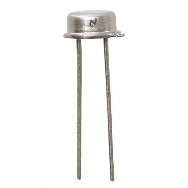

LM185-1.2-N, LM285-1.2-N, LM385-1.2-N www.ti.com SNVS742E – JANUARY 2000 – REVISED APRIL 2013 LM185-1.2-N/LM285-1.2-N/LM385-1.2-N Micropower Voltage Reference Diode Check for Samples: LM185-1.2-N, LM285-1.2-N, LM385-1.2-N FEATURES 1 • • • • • • 2 • ±1% and 2% Initial Tolerance Operating Current of 10μA to 20mA 1Ω Dynamic Impedance Low Temperature Coefficient Low Voltage Reference—1.235V 2.5V Device and Adjustable Device Also Available LM185-2.5 Series and LM185 Series, respectively DESCRIPTION The LM185-1.2-N/LM285-1.2-N/LM385-1.2-N are micropower 2-terminal band-gap voltage regulator diodes. Operating over a 10μA to 20mA current range, they feature exceptionally low dynamic impedance and good temperature stability. On-chip trimming is used to provide tight voltage tolerance. Since the LM185-1.2-N band-gap reference uses only transistors and resistors, low noise and good long term stability result. Careful design of the LM185-1.2-N has made the device exceptionally tolerant of capacitive loading, making it easy to use in almost any reference application. The wide dynamic operating range allows its use with widely varying supplies with excellent regulation. The extremely low power drain of the LM185-1.2-N makes it useful for micropower circuitry. This voltage reference can be used to make portable meters, regulators or general purpose analog circuitry with battery life approaching shelf life. Further, the wide operating current allows it to replace older references with a tighter tolerance part. The LM185-1.2-N is rated for operation over a −55°C to 125°C temperature range while the LM285-1.2-N is rated −40°C to 85°C and the LM385-1.2-N 0°C to 70°C. The LM185-1.2-N/LM285-1.2-N are available in a hermetic TO package and the LM285-1.2-N/LM3851.2-N are also available in a low-cost TO-92 molded package, as well as SOIC and SOT-23. CONNECTION DIAGRAM Figure 1. T0-92 Package (LP) (Bottom View) Figure 3. SOIC Package * Pin 3 is attached to the Die Attach Pad (DAP) and should be connected to Pin 2 or left floating. Figure 2. SOT-23 Figure 4. TO Package (NDV) (Bottom View) 1 2 Please be aware that an important notice concerning availability, standard warranty, and use in critical applications of Texas Instruments semiconductor products and disclaimers thereto appears at the end of this data sheet. All trademarks are the property of their respective owners. PRODUCTION DATA information is current as of publication date. Products conform to specifications per the terms of the Texas Instruments standard warranty. Production processing does not necessarily include testing of all parameters. Copyright © 2000–2013, Texas Instruments Incorporated LM185-1.2-N, LM285-1.2-N, LM385-1.2-N SNVS742E – JANUARY 2000 – REVISED APRIL 2013 www.ti.com These devices have limited built-in ESD protection. The leads should be shorted together or the device placed in conductive foam during storage or handling to prevent electrostatic damage to the MOS gates. ABSOLUTE MAXIMUM RATINGS (1) (2) (3) Reverse Current 30mA Forward Current 10mA Operating Temperature Range (4) LM185-1.2-N −55°C to +125°C LM285-1.2-N −40°C to +85°C LM385-1.2-N ESD Susceptibility 0°C to 70°C (5) 2kV −55°C to +150°C Storage Temperature Soldering Information TO-92 package: 10 sec. 260°C TO package:10 sec. 300°C SOIC and SOT-23 Pkg. Vapor phase (60 sec.) 215°C Infrared (15 sec.) 220°C See AN-450 “Surface Mounting Methods and Their Effect on Product Reliability” for other methods of soldering surface mount devices. (1) (2) (3) (4) (5) Absolute Maximum Ratings indicate limits beyond which damage to the device may occur. Operating Ratings indicate conditions for which the device is intended to be functional. For specifications and test conditions, see the Electrical Characteristics. The specifications apply only for the test conditions listed. Refer to RETS185H-1.2 for military specifications. If Military/Aerospace specified devices are required, please contact the TI Sales Office/Distributors for availability and specifications. For elevated temperature operation, see Table 1. The human body model is a 100 pF capacitor discharged through a 1.5 kΩ resistor into each pin. Table 1. TJ(max) for Elevated Temperature Operation 2 Submit Documentation Feedback DEVICE TJ(max) (°C) LM185-1.2-N 150 LM285-1.2-N 125 LM385-1.2-N 100 Copyright © 2000–2013, Texas Instruments Incorporated Product Folder Links: LM185-1.2-N LM285-1.2-N LM385-1.2-N LM185-1.2-N, LM285-1.2-N, LM385-1.2-N www.ti.com SNVS742E – JANUARY 2000 – REVISED APRIL 2013 ELECTRICAL CHARACTERISTICS (1) LM185-1.2-N Parameter Conditions Typ LM185BX-1.2-N LM385B-1.2-N LM185BY-1.2-N LM385BX-1.2-N LM285-1.2-N LM385BY-1.2-N LM385-1.2-N Units (Limit) LM285BX-1.2-N LM285BY-1.2-N Tested Limit (2) (3) Reverse Breakdown TA = 25°C, Voltage 10μA ≤ IR ≤ 20mA Minimum Operating Current Reverse Breakdown Voltage Change with Current 1.23 5 Design Limit (4) 1.223 10 Design Limit (4) 1.223 1.247 8 Tested Limit (2) 1 1.5 V(Min) 1.260 15 20 LM385M3-1.2-N 10μA ≤ IR ≤ 1mA Design Limit (4) 1.205 1.247 20 Tested Limit (2) 1 1.5 V(Max) 15 20 μA 10 15 (Max) 1 1.5 mV (Max) 1mA ≤ IR ≤ 20mA 10 20 20 25 20 25 mV (Max) IR = 100μA, f = 20Hz 1 Ω Wideband Noise IR = 100μA, 60 μV (rms) 10Hz ≤ f ≤ 10kHz Long Term Stability IR = 100μA, T = 1000 Hr, 20 ppm Reverse Dynamic Impedance TA = 25°C ±0.1°C Average Temperature Coefficient (5) IR = 100μA X Suffix 30 30 ppm/°C Y Suffix 50 50 ppm/°C All Others 150 150 150 ppm/°C (Max) (1) (2) (3) (4) (5) Parameters identified with boldface type apply at temperature extremes. All other numbers apply at TA = TJ = 25°C. Production tested. A military RETS electrical specification is available on request. Specified by design. Not production tested. These limits are not used to calculate average outgoing quality levels. The average temperature coefficient is defined as the maximum deviation of reference voltage at all measured temperatures between the operating TMAX and TMIN, divided by TMAX − TMIN. The measured temperatures are −55°C, −40°C, 0°C, 25°C, 70°C, 85°C, 125°C. THERMAL CHARACTERISTICS Thermal Resistance θJA (junction to ambient) θJC (junction to case) Copyright © 2000–2013, Texas Instruments Incorporated TO-92 TO SOIC SOT-23 180°C/W (0.4″ leads) 170°C/W (0.125″ leads) 440°C/W 165°C/W 283°C/W N/A 80°C/W N/A N/A Submit Documentation Feedback Product Folder Links: LM185-1.2-N LM285-1.2-N LM385-1.2-N 3 LM185-1.2-N, LM285-1.2-N, LM385-1.2-N SNVS742E – JANUARY 2000 – REVISED APRIL 2013 www.ti.com TYPICAL PERFORMANCE CHARACTERISTICS 4 Reverse Characteristics Reverse Characteristics Figure 5. Figure 6. Forward Characteristics Temperature Drift of 3 Representative Units Figure 7. Figure 8. Reverse Dynamic Impedance Reverse Dynamic Impedance Figure 9. Figure 10. Submit Documentation Feedback Copyright © 2000–2013, Texas Instruments Incorporated Product Folder Links: LM185-1.2-N LM285-1.2-N LM385-1.2-N LM185-1.2-N, LM285-1.2-N, LM385-1.2-N www.ti.com SNVS742E – JANUARY 2000 – REVISED APRIL 2013 TYPICAL PERFORMANCE CHARACTERISTICS (continued) Noise Voltage Filtered Output Noise Figure 11. Figure 12. Response Time Figure 13. Copyright © 2000–2013, Texas Instruments Incorporated Submit Documentation Feedback Product Folder Links: LM185-1.2-N LM285-1.2-N LM385-1.2-N 5 LM185-1.2-N, LM285-1.2-N, LM385-1.2-N SNVS742E – JANUARY 2000 – REVISED APRIL 2013 www.ti.com TYPICAL APPLICATIONS Figure 14. Wide Input Range Reference Figure 15. Micropower Reference from 9V Battery Figure 16. Reference from 1.5V Battery *IQ ≃ 30μA Figure 17. Micropower* 5V Regulator 6 Submit Documentation Feedback Copyright © 2000–2013, Texas Instruments Incorporated Product Folder Links: LM185-1.2-N LM285-1.2-N LM385-1.2-N LM185-1.2-N, LM285-1.2-N, LM385-1.2-N www.ti.com SNVS742E – JANUARY 2000 – REVISED APRIL 2013 *IQ ≃20μA standby current Figure 18. Micropower* 10V Reference Figure 19. Copyright © 2000–2013, Texas Instruments Incorporated Figure 20. Precision 1μA to 1mA Current Sources Submit Documentation Feedback Product Folder Links: LM185-1.2-N LM285-1.2-N LM385-1.2-N 7 LM185-1.2-N, LM285-1.2-N, LM385-1.2-N SNVS742E – JANUARY 2000 – REVISED APRIL 2013 www.ti.com METER THERMOMETERS Calibration 1. Short LM385-1.2-N, adjust R3 for IOUT= temp at 1μA/°K 2. Remove short, adjust R2 for correct reading in centigrade †IQ at 1.3V≃500μA IQ at 1.6V≃2.4mA Figure 21. 0°C−100°C Thermometer Figure 22. *2N3638 or 2N2907 select for inverse HFE ≃ 5 †Select for operation at 1.3V ‡IQ ≃ 600μA to 900μA Figure 23. Lower Power Thermometer 8 Submit Documentation Feedback Copyright © 2000–2013, Texas Instruments Incorporated Product Folder Links: LM185-1.2-N LM285-1.2-N LM385-1.2-N LM185-1.2-N, LM285-1.2-N, LM385-1.2-N www.ti.com SNVS742E – JANUARY 2000 – REVISED APRIL 2013 Calibration 1. Short LM385-1.2-N, adjust R3 for IOUT= temp at 1.8μA/°K 2. Remove short, adjust R2 for correct reading in °F Figure 24. 0°F−50°F Thermometer Adjustment Procedure 1. Adjust TC ADJ pot until voltage across R1 equals Kelvin temperature multiplied by the thermocouple Seebeck coefficient. 2. Adjust zero ADJ pot until voltage across R2 equals the thermocouple Seebeck coefficient multiplied by 273.2. Figure 25. Micropower Thermocouple Cold Junction Compensator Copyright © 2000–2013, Texas Instruments Incorporated Submit Documentation Feedback Product Folder Links: LM185-1.2-N LM285-1.2-N LM385-1.2-N 9 LM185-1.2-N, LM285-1.2-N, LM385-1.2-N SNVS742E – JANUARY 2000 – REVISED APRIL 2013 www.ti.com Thermocouple Seebeck R1 R2 Voltage Voltage Type Coefficient (Ω) (Ω) Across R1 Across R2 @ 25°C (mV) (μV/°C) (mV) J 52.3 523 1.24k 15.60 14.32 T 42.8 432 1k 12.77 11.78 K 40.8 412 953Ω 12.17 11.17 S 6.4 63.4 150Ω 1.908 1.766 Typical supply current 50μA Calibration 1. Adjust R1 so that V1 = temp at 1mV/°K 2. Adjust V2 to 273.2mV †IQ for 1.3V to 1.6V battery voltage = 50μA to 150μA Figure 26. Centigrade Thermometer 10 Submit Documentation Feedback Copyright © 2000–2013, Texas Instruments Incorporated Product Folder Links: LM185-1.2-N LM285-1.2-N LM385-1.2-N LM185-1.2-N, LM285-1.2-N, LM385-1.2-N www.ti.com SNVS742E – JANUARY 2000 – REVISED APRIL 2013 SCHEMATIC DIAGRAM Copyright © 2000–2013, Texas Instruments Incorporated Submit Documentation Feedback Product Folder Links: LM185-1.2-N LM285-1.2-N LM385-1.2-N 11 LM185-1.2-N, LM285-1.2-N, LM385-1.2-N SNVS742E – JANUARY 2000 – REVISED APRIL 2013 www.ti.com REVISION HISTORY Changes from Revision D (April 2013) to Revision E • 12 Page Changed layout of National Data Sheet to TI format .......................................................................................................... 11 Submit Documentation Feedback Copyright © 2000–2013, Texas Instruments Incorporated Product Folder Links: LM185-1.2-N LM285-1.2-N LM385-1.2-N PACKAGE OPTION ADDENDUM www.ti.com 6-Aug-2022 PACKAGING INFORMATION Orderable Device Status (1) Package Type Package Pins Package Drawing Qty Eco Plan (2) Lead finish/ Ball material MSL Peak Temp Op Temp (°C) Device Marking (3) Samples (4/5) (6) LM185BYH-1.2/NOPB ACTIVE TO NDU 2 1000 RoHS & Green SNAGCU Level-1-NA-UNLIM -55 to 125 ( LM185BYH1.2, LM1 85BYH1.2) Samples LM185H-1.2/NOPB ACTIVE TO NDU 2 1000 RoHS & Green SNAGCU Level-1-NA-UNLIM -55 to 125 ( LM185H1.2, LM185 H1.2) Samples LM285BXM-1.2/NOPB ACTIVE SOIC D 8 95 RoHS & Green SN Level-1-260C-UNLIM -40 to 85 285BX M1.2 Samples LM285BXMX-1.2/NOPB ACTIVE SOIC D 8 2500 RoHS & Green SN Level-1-260C-UNLIM -40 to 85 285BX M1.2 Samples LM285BXZ-1.2/LFT4 ACTIVE TO-92 LP 3 2000 RoHS & Green Call TI N / A for Pkg Type 285BX Z-1.2 Samples LM285BXZ-1.2/NOPB ACTIVE TO-92 LP 3 1800 RoHS & Green Call TI N / A for Pkg Type -40 to 85 285BX Z-1.2 Samples LM285BYM-1.2/NOPB ACTIVE SOIC D 8 95 RoHS & Green SN Level-1-260C-UNLIM -40 to 85 285BY M1.2 Samples LM285BYMX-1.2/NOPB ACTIVE SOIC D 8 2500 RoHS & Green SN Level-1-260C-UNLIM -40 to 85 285BY M1.2 Samples LM285M-1.2/NOPB ACTIVE SOIC D 8 95 RoHS & Green SN Level-1-260C-UNLIM -40 to 85 LM285 M1.2 Samples LM285MX-1.2/NOPB ACTIVE SOIC D 8 2500 RoHS & Green SN Level-1-260C-UNLIM -40 to 85 LM285 M1.2 Samples LM285Z-1.2/NOPB ACTIVE TO-92 LP 3 1800 RoHS & Green Call TI N / A for Pkg Type -40 to 85 LM28 5Z-1.2 Samples LM385BM-1.2/NOPB ACTIVE SOIC D 8 95 RoHS & Green SN Level-1-260C-UNLIM 0 to 70 LM385 BM1.2 Samples LM385BMX-1.2 NRND SOIC D 8 2500 Non-RoHS & Green Call TI Level-1-235C-UNLIM 0 to 70 LM385 BM1.2 LM385BMX-1.2/NOPB ACTIVE SOIC D 8 2500 RoHS & Green SN Level-1-260C-UNLIM 0 to 70 LM385 BM1.2 Samples LM385BXM-1.2/NOPB ACTIVE SOIC D 8 95 RoHS & Green SN Level-1-260C-UNLIM 0 to 70 385BX M1.2 Samples LM385BXMX-1.2/NOPB ACTIVE SOIC D 8 2500 RoHS & Green SN Level-1-260C-UNLIM 0 to 70 385BX M1.2 Samples LM385BXZ-1.2/NOPB ACTIVE TO-92 LP 3 1800 RoHS & Green Call TI N / A for Pkg Type 0 to 70 385BX Samples Addendum-Page 1 PACKAGE OPTION ADDENDUM www.ti.com 6-Aug-2022 Orderable Device Status (1) Package Type Package Pins Package Drawing Qty Eco Plan (2) Lead finish/ Ball material MSL Peak Temp Op Temp (°C) Device Marking (3) Samples (4/5) (6) Z-1.2 LM385BYM-1.2/NOPB ACTIVE SOIC D 8 95 RoHS & Green SN Level-1-260C-UNLIM 0 to 70 385BY M1.2 Samples LM385BYMX-1.2/NOPB ACTIVE SOIC D 8 2500 RoHS & Green SN Level-1-260C-UNLIM 0 to 70 385BY M1.2 Samples LM385BYZ-1.2/NOPB ACTIVE TO-92 LP 3 1800 RoHS & Green Call TI N / A for Pkg Type 0 to 70 385BY Z-1.2 Samples LM385BZ-1.2/NOPB ACTIVE TO-92 LP 3 1800 RoHS & Green Call TI N / A for Pkg Type 0 to 70 LM385 BZ1.2 Samples LM385M-1.2 NRND SOIC D 8 95 Non-RoHS & Green Call TI Level-1-235C-UNLIM 0 to 70 LM385 M1.2 LM385M-1.2/NOPB ACTIVE SOIC D 8 95 RoHS & Green SN Level-1-260C-UNLIM 0 to 70 LM385 M1.2 LM385M3-1.2 NRND SOT-23 DBZ 3 1000 Non-RoHS & Green Call TI Level-1-260C-UNLIM 0 to 70 R11 LM385M3-1.2/NOPB ACTIVE SOT-23 DBZ 3 1000 RoHS & Green SN Level-1-260C-UNLIM 0 to 70 R11 LM385M3X-1.2 NRND SOT-23 DBZ 3 3000 Non-RoHS & Green Call TI Level-1-260C-UNLIM 0 to 70 R11 LM385M3X-1.2/NOPB ACTIVE SOT-23 DBZ 3 3000 RoHS & Green SN Level-1-260C-UNLIM 0 to 70 R11 Samples LM385MX-1.2/NOPB ACTIVE SOIC D 8 2500 RoHS & Green SN Level-1-260C-UNLIM 0 to 70 LM385 M1.2 Samples LM385Z-1.2/LFT3 ACTIVE TO-92 LP 3 2000 RoHS & Green SN N / A for Pkg Type LM385 Z-1.2 Samples LM385Z-1.2/LFT4 ACTIVE TO-92 LP 3 2000 RoHS & Green SN N / A for Pkg Type LM385 Z-1.2 Samples LM385Z-1.2/NOPB ACTIVE TO-92 LP 3 1800 RoHS & Green Call TI N / A for Pkg Type LM385 Z-1.2 Samples (1) The marketing status values are defined as follows: ACTIVE: Product device recommended for new designs. LIFEBUY: TI has announced that the device will be discontinued, and a lifetime-buy period is in effect. NRND: Not recommended for new designs. Device is in production to support existing customers, but TI does not recommend using this part in a new design. PREVIEW: Device has been announced but is not in production. Samples may or may not be available. OBSOLETE: TI has discontinued the production of the device. Addendum-Page 2 0 to 70 Samples Samples PACKAGE OPTION ADDENDUM www.ti.com 6-Aug-2022 (2) RoHS: TI defines "RoHS" to mean semiconductor products that are compliant with the current EU RoHS requirements for all 10 RoHS substances, including the requirement that RoHS substance do not exceed 0.1% by weight in homogeneous materials. Where designed to be soldered at high temperatures, "RoHS" products are suitable for use in specified lead-free processes. TI may reference these types of products as "Pb-Free". RoHS Exempt: TI defines "RoHS Exempt" to mean products that contain lead but are compliant with EU RoHS pursuant to a specific EU RoHS exemption. Green: TI defines "Green" to mean the content of Chlorine (Cl) and Bromine (Br) based flame retardants meet JS709B low halogen requirements of
LM285H-1.2/NOPB
物料型号: - LM185-1.2-N - LM285-1.2-N - LM385-1.2-N
器件简介: 这些是德州仪器生产的微功耗2端带隙电压调节二极管。它们在10μA至20mA的电流范围内工作,具有极低的动态阻抗和良好的温度稳定性。芯片上的微调功能提供了严格的电压容差。由于LM185-1.2-N带隙基准只使用晶体管和电阻器,因此具有低噪声和良好的长期稳定性。
引脚分配: - T0-92封装的引脚3连接到芯片安装垫(DAP),应连接到引脚2或保持浮动。 - SOT-23封装的引脚分配未在文档中明确说明。
参数特性: - 初始容差:±1%和2% - 工作电流:10μA至20mA - 动态阻抗:1Ω - 低温度系数 - 低电压基准:1.235V - 也提供2.5V设备和可调设备
功能详解: LM185-1.2-N微功耗电压基准可用作便携式仪表、调节器或具有接近货架寿命的电池寿命的通用模拟电路。其宽动态工作范围允许其与变化很大的电源一起使用,并具有出色的调节性能。
应用信息: 这些电压基准可用于多种应用,包括宽输入范围参考、微功耗参考、精密电流源和温度计等。
封装信息: - LM185-1.2-N/LM285-1.2-N提供在密封的TO封装中 - LM285-1.2-N/LM385-1.2-N也提供在低成本的TO-92模塑封装中,以及SOIC和SOT-23封装
