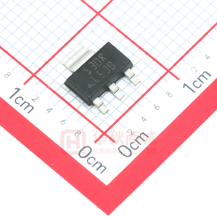

    Linear Voltage Regulator IC Positive Fixed 1 Output 5V 1A SOT-223-4
