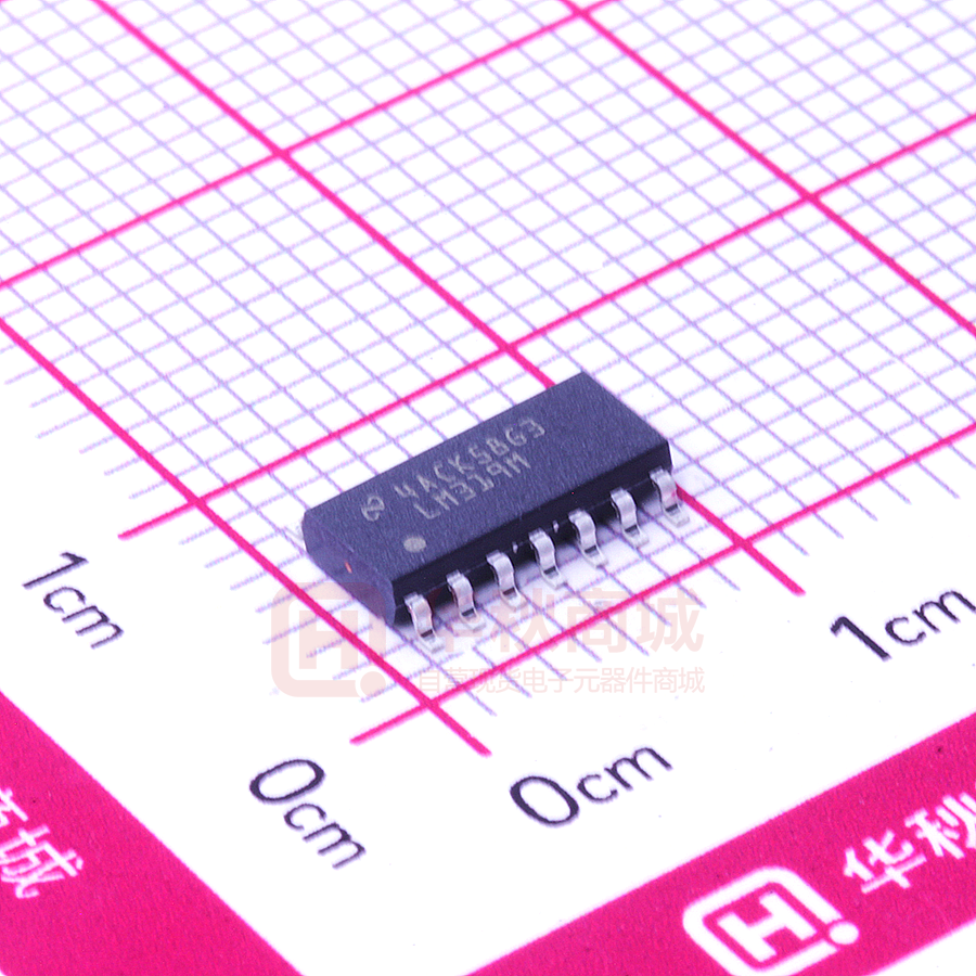

Sample & Buy Product Folder Technical Documents Support & Community Tools & Software LM119, LM219, LM319 SNOSBJ2B – AUGUST 2000 – REVISED JANUARY 2016 LMx19 High Speed Dual Comparator 1 Features 2 Description • • • • • The LM119 series are precision high-speed dual comparators fabricated on a single monolithic chip. They are designed to operate over a wide range of supply voltages down to a single 5-V logic supply and ground. They have higher gain and lower input currents than devices such as the LM710. The uncommitted collector of the output stage makes the LM119 compatible with RTL, DTL, and TTL, as well as capable of driving lamps and relays at currents of up to 25 mA. 1 • • Two Independent Comparators Operates from a Single 5-V Supply Typically 80-ns Response Time at ±15 V Minimum Fan-out of 2 Each Side Maximum Input Current of 1 μA Over Temperature Inputs and Outputs can be Isolated from System Ground High Common-Mode Slew Rate Connection Diagram The LM319A offers improved precision over the standard LM319, with tighter tolerances on offset voltage, offset current, and voltage gain. Although designed primarily for applications requiring operation from digital logic supplies, the LM119 series are fully specified for power supplies up to ±15 V. The series features faster response than the LM111, at the expense of higher power dissipation. However, the high-speed, wide operating voltage range and low package count make the LM119 more versatile than older devices such as the LM711. The LM119 is specified from −55°C to +125°C, the LM219 is specified from −25°C to +85°C, and the LM319A and LM319 are specified from 0°C to +70°C. Device Information(1) PART NUMBER Typical Application - Relay Driver LM119, LM219, LM319 PACKAGE BODY SIZE (NOM) TO-100 (10) 8.96 mm × 8.96 mm CDIP (14) 6.67 mm × 19.56 mm (1) For all available packages, see the orderable addendum at the end of the data sheet. 1 An IMPORTANT NOTICE at the end of this data sheet addresses availability, warranty, changes, use in safety-critical applications, intellectual property matters and other important disclaimers. PRODUCTION DATA. LM119, LM219, LM319 SNOSBJ2B – AUGUST 2000 – REVISED JANUARY 2016 www.ti.com Table of Contents 1 2 3 4 5 Features .................................................................. Description ............................................................. Revision History..................................................... Pin Configuration and Functions ......................... Specifications......................................................... 1 1 2 3 4 5.1 5.2 5.3 5.4 5.5 5.6 4 4 4 5 6 7 Absolute Maximum Ratings ...................................... ESD Ratings.............................................................. Thermal Information .................................................. Electrical Characteristics LM119, LM219.................. Electrical Characteristics LM319, LM319A ............... Typical Characteristics .............................................. 6 Detailed Description ............................................ 10 7 Application and Implementation ........................ 11 8 Device and Documentation Support.................. 12 6.1 Functional Block Diagram ....................................... 10 7.1 Typical Applications ................................................ 11 8.1 8.2 8.3 8.4 8.5 9 Related Links .......................................................... Community Resources............................................ Trademarks ............................................................. Electrostatic Discharge Caution .............................. Glossary .................................................................. 12 12 12 12 12 Mechanical, Packaging, and Orderable Information ........................................................... 12 3 Revision History Changes from Revision A (May 2004) to Revision B Page • Changed datasheet to new TI format from National. ............................................................................................................. 1 • Added Pin Functions and Thermal Information tables, the Device and Documentation Support section, and Mechanical, Packaging, and Orderable Information section .................................................................................................. 1 2 Submit Documentation Feedback Copyright © 2000–2016, Texas Instruments Incorporated Product Folder Links: LM119 LM219 LM319 LM119, LM219, LM319 www.ti.com SNOSBJ2B – AUGUST 2000 – REVISED JANUARY 2016 4 Pin Configuration and Functions D, J, or NFF Package 14-Pins CDIP and PDIP Top View LME Package 10-Pins TO-100 (Metal Can Package) Top View NAD Package 10-Pins CFP Top View Pin Functions PIN NAME I/O DESCRIPTION NO. (D, J, NFF 14) NO. (LME 10) NO. (NAD 10) OUTPUT 1 1 12 1 O Comparator 1 output GND 1 2 3 2 G Comparator 1 ground connection INPUT 1+ 3 4 3 I Comparator 1 input INPUT 1- 4 5 4 I Comparator 1 input V- 5 6 5 P Negative supply voltage OUTPUT 2 6 7 6 O Comparator 2 output GND 2 7 8 7 G Comparator 2 ground connection INPUT 2+ 8 9 8 I Comparator 2 input INPUT 2- 9 10 9 I Comparator 2 input V+ 10 11 10 P Positive supply voltage NC 1,2,13,14 No connect. Do not connect to ground. Copyright © 2000–2016, Texas Instruments Incorporated Product Folder Links: LM119 LM219 LM319 Submit Documentation Feedback 3 LM119, LM219, LM319 SNOSBJ2B – AUGUST 2000 – REVISED JANUARY 2016 www.ti.com 5 Specifications 5.1 Absolute Maximum Ratings over operating free-air temperature range (unless otherwise noted) (1) (2) (3) MAX UNIT Total supply voltage MIN 36 V Output to negative supply voltage 36 V Ground to negative supply voltage 25 V Ground to positive supply voltage 18 V V Differential input voltage –5 +5 Input voltage (4) –15 +15 V 500 mW Output short circuit duration 10 sec Lead temperature (soldering, 10 sec.) 260 °C Power dissipation (5) Soldering information (6) Dual-In-Line Package Soldering (10 seconds) 260 Small Outline Package Vapor Phase (60 seconds) 215 Small Outline Package Infrared (15 seconds) Operating temperature 220 LM119 –55 125 LM219 –25 85 0 70 –65 150 LM319A, LM319 Storage temperature, Tstg (1) (2) (3) (4) (5) (6) °C °C °C Stresses beyond those listed under Absolute Maximum Ratings may cause permanent damage to the device. These are stress ratings only, which do not imply functional operation of the device at these or any other conditions beyond those indicated under Recommended Operating Conditions. Exposure to absolute-maximum-rated conditions for extended periods may affect device reliability. If Military/Aerospace specified devices are required, please contact the Texas Instruments Sales Office/ Distributors for availability and specifications. Refer to RETS119X for LM119H/883 and LM119J/883 specifications. For supply voltages less than ±15 V the absolute maximum input voltage is equal to the supply voltage. The maximum junction temperature of the LM119 is 150°C, while that of the LM219 is 110°C. For operating at elevated temperatures, devices in the H10 package must be derated based on a thermal resistance of 160°C/W, junction to ambient, or 19°C/W, junction to case. The thermal resistance of the J14 and N14 packages is 100°C/W, junction to ambient. See AN-450 “Surface Mounting Methods and Their Effect on Product Reliability” for other methods of soldering surface mount devices. 5.2 ESD Ratings V(ESD) (1) Electrostatic discharge Human body model (HBM), per ANSI/ESDA/JEDEC JS-001 (1) VALUE UNIT ±800 V JEDEC document JEP155 states that 500-V HBM allows safe manufacturing with a standard ESD control process. 5.3 Thermal Information LM119, LM219, LM319 THERMAL METRIC (1) TO-100 (LME) PDIP (NFF) CDIP (J) 10 PINS 14 PINS 14 PINS UNIT RθJA Junction-to-ambient thermal resistance 160 100 100 °C/W RθJC(top) Junction-to-case (top) thermal resistance 19 NA NA °C/W (1) 4 For more information about traditional and new thermal metrics, see the Semiconductor and IC Package Thermal Metrics application report, SPRA953. Submit Documentation Feedback Copyright © 2000–2016, Texas Instruments Incorporated Product Folder Links: LM119 LM219 LM319 LM119, LM219, LM319 www.ti.com SNOSBJ2B – AUGUST 2000 – REVISED JANUARY 2016 5.4 Electrical Characteristics LM119, LM219 These specifications apply for VS = ±15 V, and the Ground pin at ground, and −55°C ≤ TA ≤ +125°C, unless otherwise stated. With the LM219, all temperature specifications are limited to −25°C ≤ TA ≤ +85°C. The offset voltage, offset current and bias current specifications apply for any supply voltage from a single 5-V supply up to ±15-V supplies. Do not operate the device with more than 16 V from ground to VS. PARAMETER TEST CONDITIONS (1) MIN TYP MAX UNIT TA = 25°C, RS ≤ 5k 0.7 4 mV Input Offset Current (1) TA = 25°C 30 75 nA Input Bias Current TA = 25°C 150 500 nA Input Offset Voltage (2) Voltage Gain TA = 25°C Response Time (3) TA = 25°C, VS = ±15 V Saturation Voltage VIN ≤ −5 mV, IOUT = 25 mA TA = 25°C Output Leakage Current VIN ≥ 5 mV, VOUT = 35 V TA = 25°C Input Offset Voltage (1) RS ≤ 5k Input Offset Current 10 40 V/mV 80 ns 0.75 1.5 V 0.2 2 µA 7 mV 100 nA 1000 nA (1) Input Bias Current VS = ±15 V Input Voltage Range V+ = 5 V, V- = 0 –12 ±13 1 +12 3 V V+ ≥ 4.5 V, V− = 0 VIN ≤ −6 mV, ISINK ≤ 3.2 mA Saturation Voltage TA ≥ 0°C 0.23 TA ≤ 0°C VIN ≥ 5 mV, VOUT = 35 V, V− = VGND =0V Output Leakage Current 0.4 V 0.6 1 Differential Input Voltage 10 ±5 µA V Positive Supply Current TA = 25°C, V+ = 5 V, V− = 0 Positive Supply Current TA = 25°C, VS = ±15 V 8 11.5 mA Negative Supply Current TA = 25°C, VS = ±15 V 3 4.5 mA (1) (2) (3) 4.3 mA The offset voltages and offset currents given are the maximum values required to drive the output within a volt of either supply with a 1mA load. Thus, these parameters define an error band and take into account the worst case effects of voltage gain and input impedance. Output is pulled up to 15 V through a 1.4-kW resistor. The response time specified is for a 100-mV input step with 5-mV overdrive. Copyright © 2000–2016, Texas Instruments Incorporated Product Folder Links: LM119 LM219 LM319 Submit Documentation Feedback 5 LM119, LM219, LM319 SNOSBJ2B – AUGUST 2000 – REVISED JANUARY 2016 www.ti.com 5.5 Electrical Characteristics LM319, LM319A These specifications apply for VS = ±15 V, and 0°C ≤ TA ≤ 70°C, unless otherwise stated. The offset voltage, offset current, and bias current specifications apply for any supply voltage from a single 5-V supply up to ±15-V supplies. Do not operate the device with more than 16 V from ground to VS. PARAMETER Input Offset Voltage (1) Input Offset Current (1) TEST CONDITIONS LM319A MIN TA = 25°C, RS ≤ 5k LM319 TYP MAX 0.5 1 MIN UNIT TYP MAX 2 8 mV nA TA = 25°C 20 40 80 200 Input Bias Current TA = 25°C 150 500 250 1000 Voltage Gain TA = 25°C (2) Response Time (3) TA = 25°C, VS = ±15 V Saturation Voltage VIN ≤ −10 mV, IOUT = 25 mA TA = 25°C 0.75 1.5 0.75 1.5 V Output Leakage Current VIN ≥ 10 mV, VOUT = 35 V V− = VGND = 0 V, TA = 25°C 0.2 10 0.2 10 µA Input Offset Voltage (1) RS ≤ 5k 10 10 mV 300 300 nA 1200 nA 20 40 80 Input Offset Current (1) Input Bias Current Input Voltage Range 8 V/mV 80 ns 1000 VS = ±15 V ±13 V+ = 5 V, V- = 0 1 ±13 3 nA 40 1 3 V V+ ≥ 4.5 V, V− = 0 VIN ≤ −10 mV, ISINK ≤ 3.2 mA 0.3 Positive Supply Current TA = 25°C, V+ = 5 V, V− = 0 4.3 Positive Supply Current TA = 25°C, VS = ±15 V 8 12.5 8 12.5 mA Negative Supply Current TA = 25°C, VS = ±15 V 3 5 3 5 mA Saturation Voltage Differential Input Voltage (1) (2) (3) 6 0.4 0.3 ±5 0.4 ±5 4.3 V V mA The offset voltages and offset currents given are the maximum values required to drive the output within a volt of either supply with a 1mA load. Thus, these parameters define an error band and take into account the worst case effects of voltage gain and input impedance. Output is pulled up to 15 V through a 1.4-kW resistor. The response time specified is for a 100-mV input step with 5-mV overdrive. Submit Documentation Feedback Copyright © 2000–2016, Texas Instruments Incorporated Product Folder Links: LM119 LM219 LM319 LM119, LM219, LM319 www.ti.com SNOSBJ2B – AUGUST 2000 – REVISED JANUARY 2016 5.6 Typical Characteristics 5.6.1 Typical Characteristics – LM119, LM119A, LM219 Figure 1. Input Currents Figure 2. Common-Mode Limits Figure 3. Transfer Function Figure 4. Response Time for Various Input Overdrives Figure 5. Response Time for Various Input Overdrives Figure 6. Input Characteristics Figure 7. Response Time for Various Input Overdrives Figure 8. Response Time for Various Input Overdrives Copyright © 2000–2016, Texas Instruments Incorporated Product Folder Links: LM119 LM219 LM319 Submit Documentation Feedback 7 LM119, LM219, LM319 SNOSBJ2B – AUGUST 2000 – REVISED JANUARY 2016 www.ti.com Typical Characteristics – LM119, LM119A, LM219 (continued) Figure 9. Output Saturation Voltage Figure 10. Supply Current Figure 11. Supply Current Figure 12. Output Limiting Characteristics 5.6.2 Typical Characteristics – LM319, LM319A 8 Figure 13. Input Currents Figure 14. Supply Currents Figure 15. Transfer Function Figure 16. Response Time for Various Input Overdrives Submit Documentation Feedback Copyright © 2000–2016, Texas Instruments Incorporated Product Folder Links: LM119 LM219 LM319 LM119, LM219, LM319 www.ti.com SNOSBJ2B – AUGUST 2000 – REVISED JANUARY 2016 Typical Characteristics – LM319, LM319A (continued) Figure 17. Response Time for Various Input Overdrives Figure 18. Input Characteristics Figure 19. Response Time for Various Input Overdrives Figure 20. Response Time for Various Input Overdrives Figure 21. Output Saturation Voltage Figure 22. Supply Current Figure 23. Common-Mode Limits Figure 24. Output Limiting Characteristics Copyright © 2000–2016, Texas Instruments Incorporated Product Folder Links: LM119 LM219 LM319 Submit Documentation Feedback 9 LM119, LM219, LM319 SNOSBJ2B – AUGUST 2000 – REVISED JANUARY 2016 www.ti.com 6 Detailed Description 6.1 Functional Block Diagram DS005705-1 ∗Do not operate the LM119 with more than 16V between GND and V+ 10 Submit Documentation Feedback Copyright © 2000–2016, Texas Instruments Incorporated Product Folder Links: LM119 LM219 LM319 LM119, LM219, LM319 www.ti.com SNOSBJ2B – AUGUST 2000 – REVISED JANUARY 2016 7 Application and Implementation NOTE Information in the following applications sections is not part of the TI component specification, and TI does not warrant its accuracy or completeness. TI’s customers are responsible for determining suitability of components for their purposes. Customers should validate and test their design implementation to confirm system functionality. 7.1 Typical Applications 7.1.1 Relay Driver Figure 25. Relay Driver 7.1.2 Window Detector Figure 26. Window Detector Copyright © 2000–2016, Texas Instruments Incorporated Product Folder Links: LM119 LM219 LM319 Submit Documentation Feedback 11 LM119, LM219, LM319 SNOSBJ2B – AUGUST 2000 – REVISED JANUARY 2016 www.ti.com 8 Device and Documentation Support 8.1 Related Links The table below lists quick access links. Categories include technical documents, support and community resources, tools and software, and quick access to sample or buy. Table 1. Related Links PARTS PRODUCT FOLDER SAMPLE & BUY TECHNICAL DOCUMENTS TOOLS & SOFTWARE SUPPORT & COMMUNITY LM119 Click here Click here Click here Click here Click here LM219 Click here Click here Click here Click here Click here LM319 Click here Click here Click here Click here Click here 8.2 Community Resources The following links connect to TI community resources. Linked contents are provided "AS IS" by the respective contributors. They do not constitute TI specifications and do not necessarily reflect TI's views; see TI's Terms of Use. TI E2E™ Online Community TI's Engineer-to-Engineer (E2E) Community. Created to foster collaboration among engineers. At e2e.ti.com, you can ask questions, share knowledge, explore ideas and help solve problems with fellow engineers. Design Support TI's Design Support Quickly find helpful E2E forums along with design support tools and contact information for technical support. 8.3 Trademarks E2E is a trademark of Texas Instruments. All other trademarks are the property of their respective owners. 8.4 Electrostatic Discharge Caution These devices have limited built-in ESD protection. The leads should be shorted together or the device placed in conductive foam during storage or handling to prevent electrostatic damage to the MOS gates. 8.5 Glossary SLYZ022 — TI Glossary. This glossary lists and explains terms, acronyms, and definitions. 9 Mechanical, Packaging, and Orderable Information The following pages include mechanical, packaging, and orderable information. This information is the most current data available for the designated devices. This data is subject to change without notice and revision of this document. For browser-based versions of this data sheet, refer to the left-hand navigation. 12 Submit Documentation Feedback Copyright © 2000–2016, Texas Instruments Incorporated Product Folder Links: LM119 LM219 LM319 PACKAGE OPTION ADDENDUM www.ti.com 13-Aug-2022 PACKAGING INFORMATION Orderable Device Status (1) Package Type Package Pins Package Drawing Qty Eco Plan (2) Lead finish/ Ball material MSL Peak Temp Op Temp (°C) Device Marking (3) Samples (4/5) (6) LM119H ACTIVE TO-100 LME 10 500 Non-RoHS & Non-Green Call TI Call TI -55 to 125 ( LM119H, LM119H) Samples LM119H/NOPB ACTIVE TO-100 LME 10 500 RoHS & Green Call TI Level-1-NA-UNLIM -55 to 125 ( LM119H, LM119H) Samples LM119J ACTIVE CDIP J 14 25 Non-RoHS & Green Call TI Level-1-NA-UNLIM -55 to 125 LM119J Samples LM319AM ACTIVE SOIC D 14 55 Non-RoHS & Green Call TI Level-1-235C-UNLIM 0 to 70 LM319AM Samples LM319AM/NOPB ACTIVE SOIC D 14 55 RoHS & Green SN Level-1-260C-UNLIM 0 to 70 LM319AM Samples LM319AMX/NOPB ACTIVE SOIC D 14 2500 RoHS & Green SN Level-1-260C-UNLIM 0 to 70 LM319AM Samples LM319M ACTIVE SOIC D 14 55 Non-RoHS & Green Call TI Level-1-235C-UNLIM 0 to 70 LM319M Samples LM319M/NOPB ACTIVE SOIC D 14 55 RoHS & Green SN Level-1-260C-UNLIM 0 to 70 LM319M Samples LM319MX/NOPB ACTIVE SOIC D 14 2500 RoHS & Green SN Level-1-260C-UNLIM 0 to 70 LM319M Samples LM319N/NOPB ACTIVE PDIP N 14 25 RoHS & Green NIPDAU Level-1-NA-UNLIM 0 to 70 LM319N Samples (1) The marketing status values are defined as follows: ACTIVE: Product device recommended for new designs. LIFEBUY: TI has announced that the device will be discontinued, and a lifetime-buy period is in effect. NRND: Not recommended for new designs. Device is in production to support existing customers, but TI does not recommend using this part in a new design. PREVIEW: Device has been announced but is not in production. Samples may or may not be available. OBSOLETE: TI has discontinued the production of the device. (2) RoHS: TI defines "RoHS" to mean semiconductor products that are compliant with the current EU RoHS requirements for all 10 RoHS substances, including the requirement that RoHS substance do not exceed 0.1% by weight in homogeneous materials. Where designed to be soldered at high temperatures, "RoHS" products are suitable for use in specified lead-free processes. TI may reference these types of products as "Pb-Free". RoHS Exempt: TI defines "RoHS Exempt" to mean products that contain lead but are compliant with EU RoHS pursuant to a specific EU RoHS exemption. Green: TI defines "Green" to mean the content of Chlorine (Cl) and Bromine (Br) based flame retardants meet JS709B low halogen requirements of
