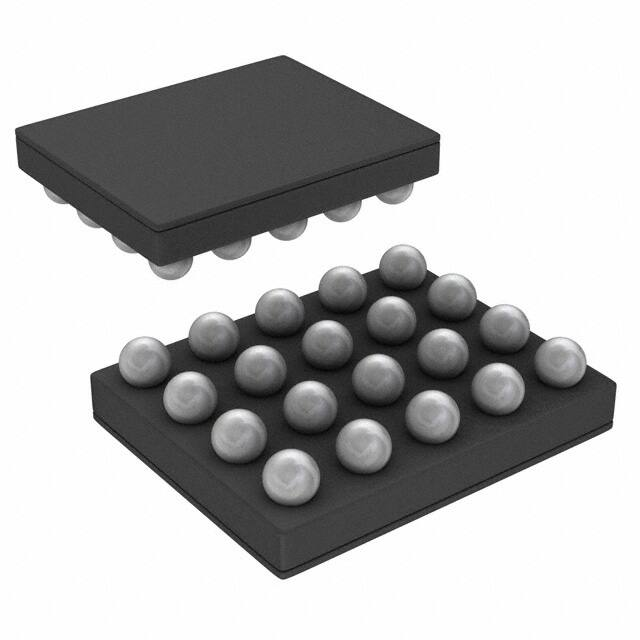

LM3370 www.ti.com SNVS406N – NOVEMBER 2005 – REVISED MAY 2013 LM3370 Dual Synchronous Step-Down DC-DC Converter with Dynamic Voltage Scaling Function Check for Samples: LM3370 FEATURES APPLICATIONS 1 • 2 • • • • • • • • • • • 2 I C-compatible interface – VOUT1 = 1V to 2V in 50 mV Steps – VOUT2 = 1.8V to 3.3V in 100 mV Steps – Automatic PFM/PWM Mode Switching and Forced PWM Mode for Low Noise Operation – Spread Spectrum Capability Using I2C 600mA Load Per Channel 2MHz PWM Fixed Switching Frequency (Typ.) The Bucks Operate 180° Out-of-Phase Timing Offset for Noise and Input Surge Current Abatement Internal Synchronous Rectification for High Efficiency Internal Soft Start Power-on-Reset Function for Both Outputs 2.7V ≤ VIN ≤ 5.5V Operates from a Single Li-Ion Cell or 3 Cell NiMH/NiCd Batteries and 3.3V/5.5V Fixed Rails 2.2µH Inductor, 4.7µF Input and 10µF Output Capacitor Per Channel 16-lead WSON Package (4 mm x 5 mm x 0.8 mm) 20-Bump DSBGA Package (3.0 mm x 2.0 mm x 0.6 mm) • • • • Baseband Processors Application Processors (Video, Audio) I/O Power FPGA Power and CPLD DESCRIPTION The LM3370 is a dual step-down DC-DC converter optimized for powering ultra-low voltage circuits from a single Li-Ion battery and input rail ranging from 2.7V to 5.5V. It provides two outputs with 600mA load per channel. The output voltage range varies from 1V to 3.3V and can be dynamically controlled using the I2Ccompatible interface. This dynamic voltage scaling function allows processors to achieve maximum performance at the lowest power level. The I2Ccompatible interface can also be used to control auto PFM-PWM/PWM mode selection and other performance enhancing features. The LM3370 offers superior features and performance for portable systems with complex power management requirements. Automatic intelligent switching between PWM low-noise and PFM low-current mode offers improved system efficiency. Internal synchronous rectification enhances the converter efficiency without the use of further external devices. Typical Application Circuit CIN1 4.7 PF FB1 VIN1 SDA SW1 SCL PGND1 VIN1 nPOR1 VIN2 nPOR2 2.7V to 5.5V VOUT1 L1:2.2 PH 10 PF SGND LM3370 COUT1 VDD * 4.7 PF EN1 PGND2 EN2 SW2 FB2 VIN2 L2:2.2 PH VIN1 VOUT2 2.7V to 5.5V CIN2 COUT2 10 PF 4.7 PF * Optional Capacitor 1 2 Please be aware that an important notice concerning availability, standard warranty, and use in critical applications of Texas Instruments semiconductor products and disclaimers thereto appears at the end of this data sheet. All trademarks are the property of their respective owners. PRODUCTION DATA information is current as of publication date. Products conform to specifications per the terms of the Texas Instruments standard warranty. Production processing does not necessarily include testing of all parameters. Copyright © 2005–2013, Texas Instruments Incorporated LM3370 SNVS406N – NOVEMBER 2005 – REVISED MAY 2013 www.ti.com DESCRIPTION (CONTINUED) There is a power-on-reset function that monitors the level of the output voltage to avoid unexpected power losses. The independent enable pin for each output allows for simple and effective power sequencing. LM3370 is available in a 4mm by 5mm 16-lead non-pullback WSON and a 20-bump DSBGA, 3.0mm x 2.0mm x 0.6mm, package. A high switching frequency—2 MHz (typ)—allows use of tiny surface-mount components including a 2.2µH inductor. Default fixed voltages for the 2 output voltages combination can be customized to fit system requirements by contacting Texas Instruments. Functional Block Diagram FB1 FB1 SDA buck1 control 2 I C Registers EPROM SCL OR2 EN_I2C VIN1 SW SW1 EN1 SDA SCL VIN1 Buck1 buck2 control POR1 PGND PGND1 EN_bk1 EN_bk2 SGND nPOR1 U1 VDD 1 nPOR2 2 U2 AND EN1 EN2 POR2 PGND Buck2 AND PGND2 SW2 SW2 VIN2 VIN2 EN2 FB2 FB2 Typical Performance Curve 2 Submit Documentation Feedback Copyright © 2005–2013, Texas Instruments Incorporated Product Folder Links: LM3370 LM3370 www.ti.com SNVS406N – NOVEMBER 2005 – REVISED MAY 2013 VIN2 1 16 FB2 SW2 2 15 EN2 PGND2 3 14 EN1 VDD 4 13 nPOR2 SGND 5 12 nPOR1 PGND1 6 11 SCL SW1 7 10 SDA VIN1 8 9 FB1 Figure 1. WSON Connection Diagram (See Package Number NHR0016B) PIN DESCRIPTIONS (WSON) Pin # Name 1 VIN2 Power supply voltage input to PFET and NFET switches for Buck 2 Description 2 SW2 Buck 2 Switch Pin 3 PGND2 4 VDD 5 SGND Signal GND 6 PGND1 Buck 1 Power Ground 7 SW1 Buck 1 Switch Pin 8 VIN1 Power supply voltage input to PFET and NFET switches for Buck 1 9 FB1 Analog Feedback Input for Buck 1 10 SDA I2C-Compatible Data, a 2 kΩ pull up resistor is required 11 SCL I2C-Compatible Clock, a 2 kΩ pull up resistor is required 12 nPOR1 Power ON Reset for Buck 1, Open drain output Low when Buck 1 output is 92% of target output. A 100 kΩ pull up resistor is required 13 nPOR2 Power ON Reset for Buck 2, Open drain output Low when Buck 2 output is 92% of target output. A 100 kΩ pull up resistor is required 14 EN1 Buck 1 Enable 15 EN2 Buck 2 Enable 16 FB2 Analog feedback for Buck 2 Buck 2 Power Ground Signal supply voltage input, VDD must be equal or greater of the two inputs (VIN1 and VIN2) Submit Documentation Feedback Copyright © 2005–2013, Texas Instruments Incorporated Product Folder Links: LM3370 3 LM3370 SNVS406N – NOVEMBER 2005 – REVISED MAY 2013 A B C 1 2 3 4 4 3 2 1 SW1 VIN1 SGND FB1 FB1 SGND VIN1 SW1 A1 A2 A3 A4 A4 A3 A2 A1 PGND1 PGND1_S SDA SCL SCL SDA PGND1_S PGND1 B2 B3 B4 B4 B3 B2 VDD SGND NPOR1 NPOR2 NPOR2 NPOR1 SGND VDD C1 C2 C3 C4 C4 C3 C2 C1 EN2 EN1 EN1 EN2 B1 PGND2 PGND2_S D E www.ti.com B1 A B C PGND2_S PGND2 D1 D2 D3 D4 D4 D3 D2 D1 SW2 VIN2 SGND FB2 FB2 SGND VIN2 SW2 E1 E2 E3 E4 E4 E3 E2 E1 D E Bottom View Top View Figure 2. DSBGA Connection Diagram (See Package Number YZR0020DWA) PIN DESCRIPTIONS (DSBGA) 4 Pin # Name Description A1 SW1 Buck 1 Switch Pin A2 VIN1 Power supply voltage input to PFET and NFET switches for Buck 1 A3 SGND A4 FB1 Signal GND Analog Feedback Input for Buck 1 B1 PGND1 B2 PGND1_S Buck 1 Power Ground B3 SDA I2C-Compatible Data, a 2 kΩ pullup resistor is required B4 SCL I2C-Compatible Clock, a 2 kΩ pullup resistor is required C1 VDD Signal supply voltage input, VDD must be equal or greater of the two inputs ( VIN1 and VIN2) C2 SGND Signal GND C3 nPOR1 Power ON Reset for Buck 1, Open drain output Low when Buck 1 output is 92% of target output. A 100 kΩ pullup resistor is required C4 nPOR2 Power ON Reset for Buck 2, Open drain output Low when Buck 2 output is 92% of target output. A 100 kΩ pullup resistor is required D1 PGND2 Buck 2 Power Ground D2 PGND2_S D3 EN2 Buck 2 Enable D4 EN1 Buck 1 Enable E1 SW2 Buck 2 Switch Pin E2 VIN2 Power supply voltage input to PFET and NFET switches for Buck 2 E3 SGND E4 FB2 Buck 1 Power Ground Sense Buck 2 Power Ground Sense Signal GND Analog feedback for Buck 2 Submit Documentation Feedback Copyright © 2005–2013, Texas Instruments Incorporated Product Folder Links: LM3370 LM3370 www.ti.com SNVS406N – NOVEMBER 2005 – REVISED MAY 2013 I2C Controlled Features Features Parameter Comments Output Voltage VOUT1 and VOUT2 Output voltage is controlled via I2Ccompatible Modes Buck 1 and Buck 2 Mode can be controlled via I2C compatible by either forcing device in Auto mode or forced PWM mode Spread Spectrum Buck 1 and Buck 2 Spread Spectrum capability via I2Ccompatible for noise reduction These devices have limited built-in ESD protection. The leads should be shorted together or the device placed in conductive foam during storage or handling to prevent electrostatic damage to the MOS gates. ORDERING INFORMATION (1) (2) Ordering Information Voltage Option (V) LM3370 (WSON) LM3370SD-3013 1.2 and 2.5 LM3370SDX-3013 LM3370SD-3021 1.2 and 3.3 LM3370SDX-3021 LM3370SD-3416 1.4 and 2.8 LM3370SDX-3416 LM3370SD-3621 1.5 and 3.3 LM3370SDX-3621 LM3370SD-3806 1.6 and 1.8 LM3370SDX-3806 LM3370SD-4221 1.8 and 3.3 LM3370SDX-4221 LM3370 (DSBGA) LM3370TL-2613/NOPB LM3370TLX-2613/NOPB LM3370TL-3607/NOPB LM3370TLX-3607/NOPB LM3370TL-3008/NOPB LM3370TLX-3008/NOPB LM3370TL-3006/NOPB LM3370TLX-3006/NOPB LM3370TL-3806/NOPB LM3370TLX-3806/NOPB LM3370TL-3206/NOPB LM3370TLX-3206/NOPB LM3370TL-3022/NOPB LM3370TLX-3022/NOPB (1) (2) 1.0 and 2.5 1.5 and 1.9 1.2 and 2.0 1.2 and 1.8 1.6 and 1.8 1.3 and 1.8 1.2 and 1.85 For the most current package and ordering information, see the Package Option Addendum at the end of this document, or see the TI web site at www.ti.com. Package drawings, thermal data, and symbolization are available at www.ti.com/packaging. Submit Documentation Feedback Copyright © 2005–2013, Texas Instruments Incorporated Product Folder Links: LM3370 5 LM3370 SNVS406N – NOVEMBER 2005 – REVISED MAY 2013 www.ti.com Absolute Maximum Ratings (1) (2) (3) −0.2V to 6V VIN1 , VIN2 VDD to PGND and SGND −0.2V to +0.2V PGND to SGND SDA, SCL, EN, EN2, nPOR1, nPOR2, SW1, SW2, FB1 and FB2 Maximum Continuous Power Dissipation (PD_MAX) (4) (GND - 0.2) to (VIN + 0.2V) Internally Limited Junction Temperature (TJ-MAX) 125°C Storage Temperature Range −65°C to +150°C Maximum Lead Temperature (Soldering) (5) ESD Ratings (1) (2) (3) (4) (5) (6) (6) All Pins 2 kV HBM 200V MM Absolute Maximum Ratings are limits beyond which damage to the device may occur. Operating Ratings are conditions under which operation of the device is ensured. Operating Ratings do not imply ensured performance limits. For ensured performance limits and associated test conditions, see Electrical Characteristics. All voltages are with respect to the potential at the GND pin. If Military/Aerospace specified devices are required, please contact the Texas Instruments Sales Office/ Distributors for availability and specifications. Internal thermal shutdown circuitry protects the device from permanent damage. The thermal shutdown engages at TJ = 150°C (typ.) and disengages at TJ = 140°C(typ.). For detailed soldering specifications and information, please refer to Texas Instruments Application Note 1187: Leadless Leadframe Package (LLP) (SNOA401). The Human body model is a 100 pF capacitor discharged through a 1.5 kΩ resistor into each pin. (MIL-STD-883 3015.7) The machine model is a 200 pF capacitor discharged directly into each pin. (EAIJ) Operating Ratings (1) (2) Input Voltage Range ( (3)) 2.7V to 5.5V Recommended Load Current Per Channel 0 mA to 600 mA −30°C to +125°C Junction Temperature (TJ) Range Ambient Temperature (TA) Range (1) (2) (3) (4) 6 (4) −30°C to +85°C Absolute Maximum Ratings are limits beyond which damage to the device may occur. Operating Ratings are conditions under which operation of the device is ensured. Operating Ratings do not imply ensured performance limits. For ensured performance limits and associated test conditions, see Electrical Characteristics. All voltages are with respect to the potential at the GND pin. Input voltage range for all voltage options is 2.7V to 5.5V. The voltage range recommended for the specified output voltages: VIN = 2.7V to 5.5V for 1V ≤ VOUT ≤ 1.7V and for VOUT = 1.8V or greater, VIN = VOUT + 1VorVIN,MIN = ILOAD * (RDSON_PFET + RDCR_INDUCTOR) + VOUT In applications where high power dissipation and/or poor package thermal resistance is present, the maximum ambient temperature may have to be de-rated. Maximum ambient temperature (TA-MAX) is dependent on the maximum operating junction temperature (TJ-MAX-OP = 125ºC), the maximum power dissipation of the device in the application (PD-MAX), and the junction-to-ambient thermal resistance of the part/package in the application (θJA), as given by the following equation: TA-MAX = TJ-MAX-OP – (θJA × PD-MAX). Submit Documentation Feedback Copyright © 2005–2013, Texas Instruments Incorporated Product Folder Links: LM3370 LM3370 www.ti.com SNVS406N – NOVEMBER 2005 – REVISED MAY 2013 Thermal Properties (1) Junction-to-Ambient Thermal Resistance θJA (WSON-16) 26°C/W θJA (20-Bump DSBGA) (1) 50°C/W Junction-to-ambient thermal resistance (θJA) is taken from a thermal modeling result, performed under the conditions and guidelines set forth in the JEDEC standard JESD51-7. The test board is a 4-layer FR-4 board measuring 102 mm x 76 mm x 1.6 mm with a 2 x 1 array of thermal vias. Thickness of copper layers are 2/1/1/2oz. Junction-to-ambient thermal resistance is highly application and board-layout dependent. In applications where high maximum power dissipation exists, special care must be paid to thermal dissipation issues in board design.The value of θJA of this product can vary significantly, depending on PCB material, layout, and environmental conditions. In applications where high maximum power dissipation exists (high VIN, high IOUT), special care must be paid to thermal dissipation issues. For more information on these topics, please refer to Application Note 1187: Leadless Leadframe Package (LLP) (SNOA401). Electrical Characteristics (1) (2) (3) Typical limits appearing in normal type apply for TJ = 25°C. Limits appearing in boldface type apply over the entire junction temperature range (TA = TJ = −30°C to +85°C). Unless otherwise noted, VIN1 = VIN2 = 3.6V. Symbol Parameter Conditions Min (4) Typ −3.5 Max Units VFB Feedback Voltage VOUT Line Regulation 2.7V ≤ VIN ≤ 5.5V IO = 10 mA, VOUT = 1.8V 0.031 %/V Load Regulation 100 mA ≤ IO ≤ 600 mA VIN = 3.6V, VOUT = 1.8V 0.0013 %/mA IQ PFM Quiescent Current “On” PFM Mode, Both Bucks ON 34 IQ SD Quiescent Current “Off” EN1 = EN2 = 0V 0.2 3 µA ILIM Peak Switching Current Limit VIN = 3.6V 1200 1400 mA RDS_ON (WSON) PFET VIN = 3.6V, ISW = 200 mA 390 500 NFET VIN = 3.6V, ISW = 200 mA 240 350 RDS_ON (DSBGA) PFET VIN = 3.6V, ISW = 200 mA 350 400 NFET VIN = 3.6V, ISW = 200 mA 170 210 FOSC Internal Oscillator Frequency 2.0 2.4 MHz IEN Enable (EN) Input Current 0.01 1 µA VIL Enable Logic Low 0.4 V VIH Enable Logic High 850 1.5 +3.5 % µA mΩ mΩ 1.0 V POWER ON RESET THRESHOLD/FUNCTION (POR) nPOR1 and nPOR2 Delay Time nPOR1 = Power ON Reset for Buck 1 50 mS (default) nPOR2 = Power ON Reset for Buck 2 Can be pre-trimmd to 50 uS, 100 mS and 200 mS POR Threshold Percentage of Target VOUT VOUT Rising 94 VOUT Falling, 85% (default), Can be pre-trimmed to 70% or 94% 85 (1) (2) (3) (4) 50 mS % All voltages are with respect to the potential at the GND pin. Min. and Max are specified by design, test and/or statistical analysis. All electrical characteristics having room-temperature limits are tested during production with TJ = 25°C. All hot and cold limits are ensured by correlating the electrical characteristics to process and temperature variations and applying statistical process control. Input voltage range for all voltage options is 2.7V to 5.5V. The voltage range recommended for the specified output voltages: VIN = 2.7V to 5.5V for 1V ≤ VOUT ≤ 1.7V and for VOUT = 1.8V or greater, VIN = VOUT + 1VorVIN,MIN = ILOAD * (RDSON_PFET + RDCR_INDUCTOR) + VOUT Test condition: for VOUT less than 2.5V, VIN = 3.6V; for VOUT greater than or equal to 2.5V, VIN = VOUT + 1V. Dissipation Rating Table θJA TA = 60°C Power Rating 26°C/W (4-Layer Board) WSON-16 50°C/W (4-Layer Board) 20-bump DSBGA TA = 85°C Power Rating 1538 mW 1300 mW 800 mW Submit Documentation Feedback Copyright © 2005–2013, Texas Instruments Incorporated Product Folder Links: LM3370 7 LM3370 SNVS406N – NOVEMBER 2005 – REVISED MAY 2013 www.ti.com Typical Performance Characteristics LM3370, Circuit of Typical Application Circuit, VIN = 3.6V, VOUT1 = 1.5V and VOUT2 = 2.5V, L = 2.2 µH (NR3015T2R2M), CIN = 4.7 µF (0805) and COUT = 10 µF (0805) and TA = 25°C, unless otherwise noted. IQ_PFM (Non Switching) Both Channels IQ_PWM (Non Switching) Both Channels 1 0.06 0.05 85oC 0.8 IQ_PWM (mA) IQ_PFM (mA) 85oC 0.04 25oC -30oC 0.03 0.02 25oC -30oC 0.4 0.2 0.01 0 2.7 0.6 3.4 4.1 4.8 0 2.7 5.5 3.4 4.1 4.8 5.5 VIN (V) VIN (V) Figure 3. Figure 4. IQ_PWM (Switching) Both Channels IQ_SD (EN1 = EN2 = 0V) 0.5 14 0.45 -30oC 12 0.4 25oC 0.35 85oC 8 IQ_SD (PA) IQ_PWM (mA) 10 6 0.3 0.25 0.2 0.15 4 0.1 2 0.05 0 2.7 3.4 4.1 4.8 0 2.7 5.5 3.4 4.1 VIN (V) 500 Figure 5. Figure 6. RDS_ON (PFET) vs. Temperature VIN = 3.6V RDS_ON (NFET) vs. Temperature VIN = 3.6V 350 450 5.5 300 RDS_ON (m:) RDS_ON (m:) 4.8 VIN (V) 400 LLP 350 micro SMD 250 LLP 200 300 micro SMD 150 250 200 -40 -20_ 0 20 40 60 80 -20 0 20 40 60 80 TEMPERATURE (°C) TEMPERATURE (°C) Figure 7. 8 100 -40 Figure 8. Submit Documentation Feedback Copyright © 2005–2013, Texas Instruments Incorporated Product Folder Links: LM3370 LM3370 www.ti.com SNVS406N – NOVEMBER 2005 – REVISED MAY 2013 Typical Performance Characteristics (continued) LM3370, Circuit of Typical Application Circuit, VIN = 3.6V, VOUT1 = 1.5V and VOUT2 = 2.5V, L = 2.2 µH (NR3015T2R2M), CIN = 4.7 µF (0805) and COUT = 10 µF (0805) and TA = 25°C, unless otherwise noted. RDS_ON (WSON) vs. VIN Current Limit vs. VIN 1200 500 450 1150 400 1100 PFET ILIMIT (mA) 300 250 NFET 200 1050 85°C 1000 25°C 950 -40°C 900 150 850 100 800 750 50 0 2.7 3.4 4.1 4.8 700 2.7 5.5 3.2 3.7 4.2 Figure 9. VIN 1.4 2.25 Buck1 = Buck2 5.5 Output Voltage vs. Output Current = 3.6V (Forced PWM) 1.9 1.35 2.16 1.8V 1.8 1.3 VOUT (V) SWITCH FREQUENCY (MHz) 5.2 Figure 10. Switching Frequency vs. VIN 2.07 1.98 1.25 1.2V 1.7 1.2 1.15 1.6 1.1 1.89 1.05 1.8 2.7 1 3.4 4.1 4.8 5.5 0 100 200 VIN (V) 100 300 400 500 1.5 600 LOAD (mA) Figure 11. Figure 12. Efficiency vs. Output Current Forced PWM Mode, VOUT1 = 1.2V Efficiency vs. Output Current Forced PWM Mode, VOUT1 = 1.8V 100 90 90 80 70 60 4.5V 3.6V 50 5.5V 40 30 70 30 10 100.00 1000.00 5.5V 40 20 10.00 4.5V 50 10 1.00 3.6V 60 20 0 0.10 2.7V 80 2.7V EFFICIENCY (%) EFFICIENCY (%) 4.7 VIN (V) VIN (V) VOUT (V) RDS_ON (m:) 350 0 0.10 1.00 10.00 LOAD (mA) LOAD (mA) Figure 13. Figure 14. 100.00 1000.00 Submit Documentation Feedback Copyright © 2005–2013, Texas Instruments Incorporated Product Folder Links: LM3370 9 LM3370 SNVS406N – NOVEMBER 2005 – REVISED MAY 2013 www.ti.com Typical Performance Characteristics (continued) LM3370, Circuit of Typical Application Circuit, VIN = 3.6V, VOUT1 = 1.5V and VOUT2 = 2.5V, L = 2.2 µH (NR3015T2R2M), CIN = 4.7 µF (0805) and COUT = 10 µF (0805) and TA = 25°C, unless otherwise noted. 100 Efficiency vs. Output Current Auto Mode, VOUT1 = 1.5V Efficiency vs. Output Current Auto Mode, VOUT2 = 1.9V Figure 15. Figure 16. Efficiency vs. Output Current Auto Mode, VOUT2 = 3.3V Efficiency vs. Output Current Forced PWM Mode, VOUT2 = 3.3V 100 90 90 60 5.5V 50 40 30 70 4.5V 60 40 30 20 10 10 1.00 10.00 100.00 1000.00 5.5V 50 20 0 0.10 10 80 4.5V 70 EFFICIENCY (%) EFFICIENCY (%) 80 0 0.10 1.00 10.00 100.00 1000.00 LOAD (mA) LOAD (mA) Figure 17. Figure 18. Typical Operation Waveform VIN = 3.6V, VOUT1 = 1.8V and VOUT2 = 1.8V Load = 400 mA Typical Operation Waveform VIN = 4.8V, VOUT1 = 1V and VOUT2 = 3.3V Load = 400 mA Figure 19. Figure 20. Submit Documentation Feedback Copyright © 2005–2013, Texas Instruments Incorporated Product Folder Links: LM3370 LM3370 www.ti.com SNVS406N – NOVEMBER 2005 – REVISED MAY 2013 Typical Performance Characteristics (continued) LM3370, Circuit of Typical Application Circuit, VIN = 3.6V, VOUT1 = 1.5V and VOUT2 = 2.5V, L = 2.2 µH (NR3015T2R2M), CIN = 4.7 µF (0805) and COUT = 10 µF (0805) and TA = 25°C, unless otherwise noted. Typical Operation Waveform VIN = 3.6V, VOUT1 = 1.5V, VOUT2 = 2.5V, Load = 600 mA Each Startup at PWM for BUCK1 (VIN = 3.6V, VOUT = 1.5V, Load = 200 mA) Figure 21. Figure 22. Startup at PWM for BUCK2 (VIN = 3.6V, VOUT = 2.5V, Load = 200 mA) Line Transient (VOUT1 = 1.2V) Figure 23. Figure 24. Line Transient (VOUT2 = 1.8V) Load Transient in PFM MODE (VOUT1 = 1.5V) Figure 25. Figure 26. Submit Documentation Feedback Copyright © 2005–2013, Texas Instruments Incorporated Product Folder Links: LM3370 11 LM3370 SNVS406N – NOVEMBER 2005 – REVISED MAY 2013 www.ti.com Typical Performance Characteristics (continued) LM3370, Circuit of Typical Application Circuit, VIN = 3.6V, VOUT1 = 1.5V and VOUT2 = 2.5V, L = 2.2 µH (NR3015T2R2M), CIN = 4.7 µF (0805) and COUT = 10 µF (0805) and TA = 25°C, unless otherwise noted. 12 Load Transient in PFM MODE (VOUT1 = 1.5V) Load Transient in PFM MODE (VOUT1 = 1.8V) Figure 27. Figure 28. Load Transient in PFM MODE (VOUT1 = 1.8V) Load Transient in PWM MODE (VIN = 3.6V, VOUT1 = 1.2V) Figure 29. Figure 30. Load Transient in PWM MODE (VIN = 3.6V, VOUT1 = 1.5V) Load Transient in PWM MODE (VIN = 3.6V, VOUT2 = 2.5V) Figure 31. Figure 32. Submit Documentation Feedback Copyright © 2005–2013, Texas Instruments Incorporated Product Folder Links: LM3370 LM3370 www.ti.com SNVS406N – NOVEMBER 2005 – REVISED MAY 2013 Typical Performance Characteristics (continued) LM3370, Circuit of Typical Application Circuit, VIN = 3.6V, VOUT1 = 1.5V and VOUT2 = 2.5V, L = 2.2 µH (NR3015T2R2M), CIN = 4.7 µF (0805) and COUT = 10 µF (0805) and TA = 25°C, unless otherwise noted. Spread Spectrum Enabling (VOUT Signal at 2 MHz) VOUT Stepping (From 1.8V to 3.3V) BUCK2 at 100 mV/STEP No Spread Spectrum 3.3V 11 dB With Spread Spectrum 5 dB/DIV 1.8V RBW = 1 kHz 1.92 1.94 1.96 1.98 2.0 2.02 2.04 2.06 2.08 2.1 2.12 100 Ps/DIV 20 kHz/DIV Figure 33. Figure 34. VOUT Stepping (From 3.3V to 1.8V) BUCK2 at 100 mV/STEP 3.3V 1.8V 100 Ps/DIV Figure 35. Submit Documentation Feedback Copyright © 2005–2013, Texas Instruments Incorporated Product Folder Links: LM3370 13 LM3370 SNVS406N – NOVEMBER 2005 – REVISED MAY 2013 www.ti.com OPERATION DESCRIPTION Device Information The LM3370, a dual high efficiency step-down DC-DC converter, delivers regulated voltages from input rails between 2.7V to 5.5V. Using voltage mode architecture with synchronous rectification, the LM3370 has the ability to deliver up to 600 mA per channel. The performance is optimized for systems where efficiency and space are critical. There are three modes of operation depending on the current required: PWM, PFM, and shutdown. PWM mode handles loads of approximately 70 mA or higher with 90% efficiency or better. Lighter loads cause the device to automatically switch into PFM mode to maintain high efficiency with low supply current (IQ = 20µA typ.) per channel. The LM3370 can operate up to a 100% duty cycle (PFET switch always on) for low drop out control of the output voltage. In this way the output voltage will be controlled down to the lowest possible input voltage. Additional features include soft-start, under-voltage lock-out, current overload protection, and thermal overload protection. Circuit Operation During the first portion of each switching cycle, the control block in the LM3370 turns on the internal PFET switch. This allows current to flow from the input through the inductor to the output filter capacitor and load. The inductor limits the current to a ramp with a slope of VIN -VOUT L (1) by storing energy in a magnetic field. During the second portion of each cycle, the controller turns the PFET switch off, blocking current flow from the input, and then turns the NFET synchronous rectifier on. The inductor draws current from ground through the NFET to the output filter capacitor and load, which ramps the inductor current down with a slope of -VOUT L (2) The output filter stores charge when the inductor current is high, and releases it when low, smoothing the voltage across the load. PWM Operation During PWM operation the converter operates as a voltage-mode controller with input voltage feed forward. This allows the converter to achieve excellent load and line regulation. The DC gain of the power stage is proportional to the input voltage. To eliminate this dependence, feed forward inversely proportional to the input voltage is introduced. Internal Synchronous Rectification While in PWM mode, the LM3370 uses an internal NFET as a synchronous rectifier to reduce rectifier forward voltage drop and associated power loss. Synchronous rectification provides a significant improvement in efficiency whenever the output voltage is relatively low compared to the voltage drop across an ordinary rectifier diode. Current Limiting A current limit feature allows the LM3370 to protect itself and external components during overload conditions. PWM mode implements cycle-by-cycle current limiting using an internal comparator that trips at 1200 mA (typ.). If the outputs are shorted to ground the device enters a timed current limit mode where the NFET is turned on for a longer duration until the inductor current falls below a low threshold, ensuring inductor has more time to decay, thereby preventing runaway. 14 Submit Documentation Feedback Copyright © 2005–2013, Texas Instruments Incorporated Product Folder Links: LM3370 LM3370 www.ti.com SNVS406N – NOVEMBER 2005 – REVISED MAY 2013 PFM Operation At very light loads, the converter enters PFM mode and operates with reduced switching frequency and supply current to maintain high efficiency. The part will automatically transition into PFM mode when either of two conditions are true, for a duration of 32 or more clock cycles: 1. The NFET current reaches zero. 2. The peak PFET switch current drops below the IMODE level . (Typically IMODE < 66 mA + VIN 160: ) (3) Supply current during this PFM mode is less than 20 µA per channel, which allows the part to achieve high efficiency under extremely light load conditions. When the output drops below the ‘low’ PFM threshold, the cycle repeats to restore the output voltage to ∼1.2% above the nominal PWM output voltage. If the load current should increase during PFM mode (see Figure 36) causing the output voltage to fall below the ‘low2’ PFM threshold, the part will automatically transition into fixed-frequency PWM mode. During PFM operation, the converter positions the output voltage slightly higher than the nominal output voltage during PWM operation, allowing additional headroom for voltage drop during a load transient from light to heavy load. The PFM comparators sense the output voltage via the feedback pin and control the switching of the output FETs such that the output voltage ramps between 0.8% and 1.6% (typical) above the nominal PWM output voltage. If the output voltage is below the ‘high’ PFM comparator threshold, the PFET power switch is turned on. It remains on until the output voltage exceeds the ‘high’ PFM threshold or the peak current exceeds the IPFM level set for PFM mode. The typical peak current in PFM mode is: IPFM = 115 mA + VIN/57Ω (4) Once the PFET power switch is turned off, the NFET power switch is turned on until the inductor current ramps to zero. When the NFET zero-current condition is detected, the NFET power switch is turned off. If the output voltage is below the ‘high’ PFM comparator threshold (see Figure 36), the PFET switch is again turned on and the cycle is repeated until the output reaches the desired level. Once the output reaches the ‘high’ PFM threshold, the NFET switch is turned on briefly to ramp the inductor current to zero and then both output switches are turned off and the part enters an extremely low power mode. Forced PWM Mode The LM3370 auto mode can be bypassed by forcing the device to operate in PWM mode, this can be implemented through the I2C-compatible interface, see Table 3. Soft-Start The LM3370 has a soft start circuit that limits in-rush current during start up. Soft start is activated only if EN goes from logic low to logic high after VIN reaches 2.7V. LDO - Low Drop Out Operation The LM3370 can operate at 100% duty cycle (no switching, PFET switch completely on) for low drop out support of the output voltage. In this way the output voltage will be controlled down to the lowest possible input voltage. The minimum input voltage needed to support the output voltage is VIN,MIN = ILOAD*(RDSON,PFET + RINDUCTOR) + VOUT where • • • ILOAD load current • RDSON/PFET drain to source resistance of PFET switch in the triode region • RINDUCTOR inductor resistance (5) Submit Documentation Feedback Copyright © 2005–2013, Texas Instruments Incorporated Product Folder Links: LM3370 15 LM3370 SNVS406N – NOVEMBER 2005 – REVISED MAY 2013 www.ti.com High PFM Threshold ~1.016*Vout PFM Mode at Light Load Load current increases ZAx is High PFM Voltage Threshold reached, go into sleep mode Nfet on drains conductor current until I inductor=0 Current load increases, draws Vout towards Low2 PFM Threshold Low PFM Threshold, turn on PFET Low2 PFM Threshold Vout Low2 PFM Threshold, switch back to PWM mode xis Z-A Pfet on until Ipfm limit reached Low1 PFM Threshold ~1.008*Vout PWM Mode at Moderate to Heavy Loads Figure 36. Operation in PFM Mode and Transfer to PWM Mode Table 1. I2C-Compatible Interface Electrical Specifications (1) Symbol FCLK Parameter Conditions Min Typ Clock Frequency Max Units 400 kHz tBF Bus-Free Time between Start and Stop (2) 1.3 µS tHOLD Hold Time Repeated Start Condition (2) 0.6 µS tCLKLP CLK Low Period (2) 1.3 µS tCLKHP CLK High Period (2) 0.6 µS tSU Set Up Time Repeated Start Condition (2) 0.6 µS tDATAHLD Data Hold Time (2) 200 nS tCLKSU Data Set Up Time (2) 200 nS TSU Set Up Time for Start Condition (2) 0.6 TTRANS Maximum Pulse Width of Spikes that Must be Suppressed by the Input Filter of Both DATA and CLK signals. (2) VDD_I2C I2C Logic High Level (1) (2) µS 50 1 nS VIN V Unless otherwise noted, VBATT = 2.7V to 5.5V. Typical values and limits appearing in normal type apply for TJ = 25°C. Limits appearing in boldface type apply over the entire junction temperature range for operation, −30°C to +125°C. Input voltage range for all voltage options is 2.7V to 5.5V. The voltage range recommended for the specified output voltages: VIN = 2.7V to 5.5V for 1V ≤ VOUT ≤ 1.7V and for VOUT = 1.8V or greater, VIN = VOUT + 1VorVIN,MIN = ILOAD * (RDSON_PFET + RDCR_INDUCTOR) + VOUT I2C-Compatible Interface In I2C-compatible mode, the SCL pin is used for the I2C clock and the SDA pin is used for the I2C data. Both these signals need a pull-up resistor according to I2C specification. The values of the pull-up resistor are determined by the capacitance of the bus (typ. ∼1.8k). Signal timing specifications are according to the I2C bus specification. Maximum frequency is 400 kHz. I2C-Compatible Data Validity The data on SDA line must be stable during the HIGH period of the clock signal (SCL). In other words, state of the data line can only be changed when CLK is LOW. 16 Submit Documentation Feedback Copyright © 2005–2013, Texas Instruments Incorporated Product Folder Links: LM3370 LM3370 www.ti.com SNVS406N – NOVEMBER 2005 – REVISED MAY 2013 SCL SDA data change allowed data valid data change allowed data valid data change allowed Figure 37. I2C-Compatible START and STOP Conditions START and STOP bits classify the beginning and the end of the I2C session. START condition is defined as SDA signal transitioning from HIGH to LOW while SCL line is HIGH. STOP condition is defined as the SDA transitioning from LOW to HIGH while SCL is HIGH. The I2C master always generates START and STOP bits. The I2C bus is considered to be busy after START condition and free after STOP condition. During data transmission, I2C master can generate repeated START conditions. First START and repeated START conditions are equivalent, function-wise. SDA SCL S P START condition STOP condition Figure 38. Transferring Data Every byte put on the SDA line must be eight bits long, with the most significant bit (MSB) being transferred first. The number of bytes that can be transmitted per transfer is unrestricted. Each byte of data has to be followed by an acknowledge bit. The acknowledge related clock pulse is generated by the master. The transmitter releases the SDA line (HIGH) during the acknowledge clock pulse. The receiver must pull down the SDA line during the 9th clock pulse, signifying an acknowledge. A receiver which has been addressed must generate an acknowledge after each byte has been received. After the START condition, I2C master sends a chip address. This address is seven bits long followed by an eighth bit which is a data direction bit (R/W). For the eighth bit, a “0” indicates a WRITE and a “1” indicates a READ. The second byte selects the register to which the data will be written. The third byte contains data to write to the selected register. Submit Documentation Feedback Copyright © 2005–2013, Texas Instruments Incorporated Product Folder Links: LM3370 17 LM3370 SNVS406N – NOVEMBER 2005 – REVISED MAY 2013 www.ti.com I2C-Compatible Write Cycle ack from slave start msb Chip Address lsb w ack ack from slave msb Register Add lsb ack ack from slave msb DATA lsb ack stop ack stop SCL SDA id = K¶xx start addr = K¶02 w ack ack DGGUHVV K¶02 data W = write (SDA = “0”) r = read (SDA = “1”) ack = acknowledge (SDA pulled down by either master or slave) rs = repeated startxx=36h Figure 39. However, if a READ function is to be accomplished, a WRITE function must precede the READ function, as shown in I2C-Compatible Read Cycle I2C-Compatible Read Cycle ack from slave start msb Chip Address lsb w ack ack from slave repeated start msb Register Add lsb ack from slave ack rs msb Chip Address lsb r ack ack rs id = K¶xx r ack data from slave msb DATA ack from master lsb ack stop SCL SDA start id = K¶xx w ack addr = K¶00 DGGUHVV K¶00 data ack stop Figure 40. Device Register Information Table 2. Register Information Register Name Location Type Function Control 00 R/W Control signal for Buck 1 and Buck 2 Buck 1 01 R/W Output setting and Mode selection for Buck 1 Buck 2 02 R/W Output setting and Mode selection for Buck 2 and POR disable 18 Submit Documentation Feedback Copyright © 2005–2013, Texas Instruments Incorporated Product Folder Links: LM3370 LM3370 www.ti.com SNVS406N – NOVEMBER 2005 – REVISED MAY 2013 I2C Chip Address Information MSB LSB ADR6 ADR5 ADR4 ADR3 ADR2 ADR1 ADR0 bit7 bit6 bit5 bit4 bit3 bit2 bit1 0 1 0 0 0 0 1 R/W bit0 2 I C SLAVE address (chip address) Figure 41. Register 00 MSB LSB 7 6 5 4 3 2 1 0 EN1 for Buck 1 (default = 1) Bit0 = 1 to enable EN2 for Buck 2 (default = 1) Bit1 = 1 to enable Spread Spectrum (SS) Enable Bit2 = 1 to enable SS_fmod (SS Frequency Modulator) ss_fmod = 1 1 kHz (default) ss_fmod = 0 2 kHz Pstep Enable for Buck1 Pstep = 0 (default) not enable Pstep = 1 50 mV/step at 32 Ps/step Pstep Enable for Buck2 Pstep = 0 (default) not enable Pstep = 1 100 mV/step at 32 Ps/step Bit 6 & 7 are not used Register 01 MSB 7 LSB 6 5 4 3 2 1 0 Vout for Buck 1 00101 = 1V (Min.) 11111 = 2V (Max.) Forced PWM Mode (FPWM1) Auto = 0 (default) FPWM1 = 1 (PWM mode only) Bit 6 and 7 are not used Figure 42. Submit Documentation Feedback Copyright © 2005–2013, Texas Instruments Incorporated Product Folder Links: LM3370 19 LM3370 SNVS406N – NOVEMBER 2005 – REVISED MAY 2013 www.ti.com Register 02 MSB 7 LSB 6 5 4 3 2 1 0 Vout for Buck 2 00001 = 1.8V (Min.) 11111 = 3.3V (Max.) Forced PWM Mode (FPWM2) Auto = 0 (default) FPWM2 = 1 (PWM mode only) Disable Por function (DISPOR) DISPOR = 0 enable Por (default) DISPOR = 1 disable Por Bit 7 is not used Figure 43. Table 3. Output Selection Table via I2C Programing Buck Output Voltage Selection Codes (1) 20 Data Code Buck_1 (V) Buck_2 (V) 00000 NA NA 00001 NA 1.8 00010 NA 1.85 or 1.9 (1) 00011 NA 2.0 00100 NA 2.1 00101 1.00 2.2 00110 1.05 2.3 00111 1.10 2.4 01000 1.15 2.5 01001 1.20 2.6 01010 1.25 2.7 01011 1.30 2.8 01100 1.35 2.9 01101 1.40 3.0 01110 1.45 3.1 01111 1.50 3.2 10000 1.55 3.3 10001 1.60 NA 10010 1.65 NA 10011 1.70 NA 10100 1.75 NA 10101 1.80 NA 10110 1.85 NA 10111 1.90 NA 11000 1.95 NA 11001 2.00 NA Can be trimmed at the factory at 1.85V or 1.9V using the same trim code. Submit Documentation Feedback Copyright © 2005–2013, Texas Instruments Incorporated Product Folder Links: LM3370 LM3370 www.ti.com SNVS406N – NOVEMBER 2005 – REVISED MAY 2013 Application Information Setting Output Voltage via I2C-Compatible The outputs of the LM3370 can be programmed through Buck 1 and Buck 2 registers via I2C. Buck 1 output voltage can be dynamically adjusted between 1V to 2V in 50 mV steps and Buck 2 output voltage can be adjusted between 1.8V to 3.3V in 100 mV steps. Finer adjustments to the output of Buck 2 can be achieved with the placement of a resistor between VOUT2 and the FB2 pin. Typically by placing a 20 KΩ resistor, R, between these nodes will result in the programmed Output Voltage increasing by approximately 45 mV,ΔVTYP. ΔVTYP= R × 500mV / 234KΩ (6) Please refer to for programming the desire output voltage. If the I2C-compatible feature is not used, the default output voltage will be the pre-trimmed voltage. For example, LM3370SD-3021 refers to 1.2V for Buck 1 and 3.3V for Buck 2. VDD Pin VDD is the power supply to the internal control circuit, if VDD pin is not tied to VIN during normal operating condition, VDD must be set equal or greater of the two inputs ( VIN1 or VIN2 ). An optional capacitor can be used for better noise immunity at VDD pin or when VDD is not tied to either VIN pins. Additionally, for reasons of noise suppression, it is advisable to tie the EN1/EN2 pins to VDD rather than VIN . SDA, SCL Pins When not using I2C the SDA and SCL pins should be tied directly to the VDD pin. Micro-Stepping: The Micro-Stepping feature minimizes output voltage overshoot/undershoot during large output transients. If Micro-stepping is enabled through I2C, the output voltage automatically ramps at 50 mV per step for Buck 1 and 100 mV per step for Buck 2. The steps are summarized as follow: • Buck 1: 50 mV/step and 32 µs/step • Buck 2: 100 mV/step and 32 µs/step For example if changing Buck 1 voltage from 1V to 1.8V yields 20 steps [(1.8 - 1)/ 0.05 = 20]. This translates to 640 μs [(20 x 32 µs) = 640 µs] needed to reach the final target voltage. Inductor Selection There are two main considerations when choosing an inductor; the inductor should not saturate, and the inductor current ripple is small enough to achieve the desired output voltage ripple. There are two methods to choose the inductor current rating. method 1: The total current is the sum of the load and the inductor ripple current. This can be written as IMAX = ILOAD + ( = ILOAD + ( IRIPPLE ) 2 VIN - VOUT 2*L )*( VOUT VIN )*( 1 ) f where • • • • ILOAD load current VIN input voltage L inductor f switching frequency (7) method 2: A more conservative approach is to choose an inductor that can handle the maximum current limit of 1400 mA. Given a peak-to-peak current ripple (IPP) the inductor needs to be at least Submit Documentation Feedback Copyright © 2005–2013, Texas Instruments Incorporated Product Folder Links: LM3370 21 LM3370 SNVS406N – NOVEMBER 2005 – REVISED MAY 2013 L >= ( VIN - VOUT IPP )*( VOUT VIN )*( www.ti.com 1 ) f (8) A 2.2 µH inductor with a saturation current rating of at least 1400 mA is recommended for most applications. The inductor’s resistance should be less than around 0.2Ω for good efficiency. Table 4 lists suggested inductors and suppliers. For low-cost applications, an unshielded bobbin inductor is suggested. For noise critical applications, a toroidal or shielded-bobbin inductor should be used. A good practice is to lay out the board with overlapping footprints of both types for design flexibility. This allows substitution of a low-noise toroidal inductor, in the event that noise from low-cost bobbin models is unacceptable. Below are some suggested inductor manufacturers that include but are not limited to: Table 4. Suggested Inductors and Suppliers Model Vendor Dimensions (mm) ISAT DO3314-222 Coilcraft 3.3 x 3.3 x 1.4 1.6A LPO3310-222 3.3 x 3.3 x 1.0 1.1A SD3114-2R2 Cooper 3.1 x 3.1 x 1.4 1.48A NR3010T2R2M Taiyo Yuden 3.0 x 3.0 x 1.0 1.1A 3.0 x 3.0 x 1.5 1.48A 2.6 x 2.8 x 1.0 1.0A NR3015T2R2M VLF3010AT- 2R2M1R0 TDK Input Capacitor Selection A ceramic input capacitor of 4.7 μF, 6.3V is sufficient for most applications. A larger value may be used for improved input voltage filtering. The input filter capacitor supplies current to the PFET switch of the LM3370 in the first half of each cycle and reduces voltage ripple imposed on the input power source. A ceramic capacitor's low ESR provides the best noise filtering of the input voltage spikes due to this rapidly changing current. Select an input filter capacitor with a surge current rating sufficient for the power-up surge from the input power source. The power-up surge current is approximately the capacitor’s value (µF) times the voltage rise rate (V/µs). The input current ripple can be calculated as: VOUT IRMS = IOUTMAX * VIN § *¨1© VOUT · VIN ¸ ¹ The worst case IRMS is: IOUTMAX (duty cycle = 50%) IRMS = 2 (9) Output Capacitor Selection DC bias characteristics of ceramic capacitors must be considered when selecting case sizes like 0805 and 0603. DC bias characteristics vary from manufacturer to manufacturer and dc bias curves should be requested from them as part of the capacitor selection process. The output filter capacitor smooths out current flow from the inductor to the load, helps maintain a steady output voltage during transient load changes and reduces output voltage ripple. These capacitors must be selected with sufficient capacitance and sufficiently low ESR to perform these functions. The output ripple voltage can be calculated as: Voltage peak-to-peak ripple due to capacitance = VPP-C = 22 IPP f*8*C (10) Submit Documentation Feedback Copyright © 2005–2013, Texas Instruments Incorporated Product Folder Links: LM3370 LM3370 www.ti.com SNVS406N – NOVEMBER 2005 – REVISED MAY 2013 Voltage peak-to-peak ripple due to ESR = VPP-ESR = IPP*RESR Voltage peak-to-peak ripple, root mean squared = VPP-RMS = VPP-C2 + VPP-ESR2 (11) Note that the output ripple is dependent on the current ripple and the equivalent series resistance of the output capacitor (RESR). The RESR is frequency dependent (as well as temperature dependent); make sure that the frequency of the RESR given is the same order of magnitude as the switching frequency. Table 5. Suggested Capacitors and Their Suppliers Model Description Case Size Vendor TDK 4.7 µF for CIN C1608X5R0J475 Ceramic, X5R, 6.3V Rating 0603 C2012X5R0J475 Ceramic, X5R, 6.3V Rating 0805 JMK212BJ475 Ceramic, X5R, 6.3V Rating 0805 GRM21BR60J475 Ceramic, X5R, 6.3V Rating 0805 GRM219R60J475KE19D Ceramic, X5R, 6.3V Rating 0805(Thin)

物料型号:LM3370
器件简介:LM3370是一款由德州仪器(Texas Instruments)生产的双同步降压DC-DC转换器,具有动态电压缩放功能。它专为从单节锂离子电池和2.7V至5.5V的输入电压范围供电的超低电压电路而优化。每个通道可提供高达600mA的负载电流。
引脚分配:LM3370有16个引脚,包括电源输入(VIN1和VIN2)、开关输出(SW1和SW2)、模拟反馈输入(FB1和FB2)、地(PGND1和PGND2)、信号地(SGND)、I2C接口(SDA和SCL)等。
参数特性: - 工作频率:2MHz(典型值) - 输入电压范围:2.7V至5.5V - 输出电压范围:1V至3.3V,可动态控制 - 负载电流:每个通道高达600mA - 固定开关频率:2MHz(典型值) - 封装类型:16引脚WSON和20引脚DSBGA
功能详解: - LM3370提供两个可编程输出电压,可通过I2C接口动态控制。 - 支持自动PFM/PWM模式切换和强制PWM模式,以实现低噪声运行。 - 具备扩展频谱能力,可通过I2C接口实现。 - 内部同步整流提高效率。 - 内置软启动和电源开启重置功能。
应用信息:适用于基带处理器、应用处理器(视频、音频)I/O电源、FPGA和CPLD电源等。
封装信息:LM3370提供16引脚WSON封装和20引脚DSBGA封装,具体尺寸和引脚排列请参考数据手册中的详细图纸。
