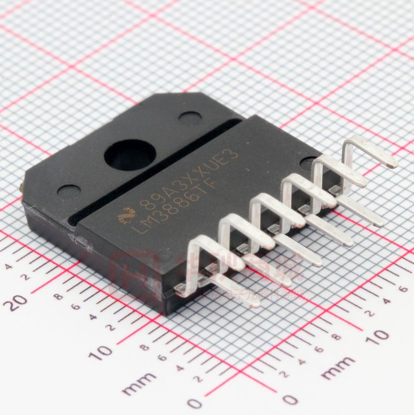

LM3886TF/NOPB
LM3886TF/NOPB
    BURR-BROWN(德州仪器)
    TO220-11
    带静音功能的 68W、单通道、20V 至 94V 电源立体声 AB 类放大器
LM3886TF/NOPB 数据手册
LM3886 www.ti.com SNAS091C – MAY 1999 – REVISED MARCH 2013 LM3886 Overture™ Audio Power Amplifier Series High-Performance 68W Audio Power Amplifier w/Mute Check for Samples: LM3886 FEATURES DESCRIPTION • The LM3886 is a high-performance audio power amplifier capable of delivering 68W of continuous average power to a 4Ω load and 38W into 8Ω with 0.1% THD+N from 20Hz–20kHz. 1 23 • • • • • • • • • • 68W Cont. Avg. Output Power into 4Ω at VCC = ±28V 38W Cont. Avg. Output Power into 8Ω at VCC = ±28V 50W Cont. Avg. Output Power into 8Ω at VCC = ±35V 135W Instantaneous Peak Output Power Capability Signal-to-Noise Ratio ≥ 92dB An Input Mute Function Output Protection from a Short to Ground or to the Supplies via Internal Current Limiting Circuitry Output Over-Voltage Protection against Transients from Inductive Loads Supply Under-Voltage Protection, not Allowing Internal Biasing to Occur when |VEE| + |VCC| ≤ 12V, thus Eliminating Turn-On and Turn-Off Transients 11-Lead TO-220 Package Wide Supply Range 20V - 94V The performance of the LM3886, utilizing its Self Peak Instantaneous Temperature (°Ke) (SPiKe) protection circuitry, puts it in a class above discrete and hybrid amplifiers by providing an inherently, dynamically protected Safe Operating Area (SOA). SPiKe protection means that these parts are completely safeguarded at the output against overvoltage, undervoltage, overloads, including shorts to the supplies, thermal runaway, and instantaneous temperature peaks. The LM3886 maintains an excellent signal-to-noise ratio of greater than 92dB with a typical low noise floor of 2.0µV. It exhibits extremely low THD+N values of 0.03% at the rated output into the rated load over the audio spectrum, and provides excellent linearity with an IMD (SMPTE) typical rating of 0.004%. APPLICATIONS • • • • • Component stereo Compact stereo Self-powered speakers Surround-sound amplifiers High-end stereo TVs 1 2 3 Please be aware that an important notice concerning availability, standard warranty, and use in critical applications of Texas Instruments semiconductor products and disclaimers thereto appears at the end of this data sheet. Overture is a trademark of dcl_owner. All other trademarks are the property of their respective owners. PRODUCTION DATA information is current as of publication date. Products conform to specifications per the terms of the Texas Instruments standard warranty. Production processing does not necessarily include testing of all parameters. Copyright © 1999–2013, Texas Instruments Incorporated LM3886 SNAS091C – MAY 1999 – REVISED MARCH 2013 www.ti.com Typical Application *Optional components dependent upon specific design requirements. Refer to External Components Description for a component functional description. Figure 1. Typical Audio Amplifier Application Circuit Connection Diagram Top View Preliminary: call your local Texas Instruments Sales Rep. or distributor for availability Figure 2. TO-220 and PFM Plastic Packages See Package Number NDJ0011B for Staggered Lead Non-Isolated Package or NDA0011B for Staggered Lead Isolated Package (1) (1) 2 The LM3886T package TA11B is a non-isolated package, setting the tab of the device and the heat sink at V− potential when the LM3886 is directly mounted to the heat sink using only thermal compound. If a mica washer is used in addition to thermal compound, θCS (case to sink) is increased, but the heat sink will be isolated from V−. Submit Documentation Feedback Copyright © 1999–2013, Texas Instruments Incorporated Product Folder Links: LM3886 LM3886 www.ti.com SNAS091C – MAY 1999 – REVISED MARCH 2013 These devices have limited built-in ESD protection. The leads should be shorted together or the device placed in conductive foam during storage or handling to prevent electrostatic damage to the MOS gates. Absolute Maximum Ratings (1) (2) (3) Supply Voltage |V+|+|V−| (No Signal) Supply Voltage |V+|+|V−| (Input Signal) 84V (V+ or V−) and |V+| + |V−| ≤ 80V Common Mode Input Voltage Differential Input Voltage 94V (4) 60V Output Current Internally Limited Power Dissipation (5) 125W ESD Susceptibility (6) 3000V Junction Temperature (7) 150°C Soldering Information T Package (10 seconds) −40°C to +150°C Storage Temperature Thermal Resistance (1) (2) (3) (4) (5) (6) (7) 260°C θJC 1°C/W θJA 43°C/W All voltages are measured with respect to the GND pin (pin 7), unless otherwise specified. Absolute Maximum Ratings indicate limits beyond which damage to the device may occur. Operating Ratings indicate conditions for which the device is functional. Electrical Characteristics state DC and AC electrical specifications under particular test conditions and specific performance limits. This assumes that the device is within the Operating Ratings. The typical value is a good indication of device performance. If Military/Aerospace specified devices are required, please contact the Texas Instruments Sales Office/ Distributors for availability and specifications. The Differential Input Voltage Absolute Maximum Rating is based on supply voltages of V+ = +40V and V− = −40V. For operating at case temperatures above 25°C, the device must be derated based on a 150°C maximum junction temperature and a thermal resistance of θJC = 1.0 °C/W (junction to case). Refer to Figure 50 in Application Information under THERMAL CONSIDERATIONS. Human body model, 100 pF discharged through a 1.5 kΩ resistor. The operating junction temperature maximum is 150°C, however, the instantaneous Safe Operating Area temperature is 250°C. Operating Ratings (1) (2) (3) Temperature Range TMIN ≤ TA ≤ TMAX −20°C ≤ TA ≤ +85°C Supply Voltage |V+| + |V−| (1) (2) (3) 20V to 84V All voltages are measured with respect to the GND pin (pin 7), unless otherwise specified. Absolute Maximum Ratings indicate limits beyond which damage to the device may occur. Operating Ratings indicate conditions for which the device is functional. Electrical Characteristics state DC and AC electrical specifications under particular test conditions and specific performance limits. This assumes that the device is within the Operating Ratings. The typical value is a good indication of device performance. Operation is specified up to 84V, however, distortion may be introduced from SPIKe Protection Circuitry if proper thermal considerations are not taken into account. Refer to THERMAL CONSIDERATIONS for more information. (See Figure 5) Submit Documentation Feedback Copyright © 1999–2013, Texas Instruments Incorporated Product Folder Links: LM3886 3 LM3886 SNAS091C – MAY 1999 – REVISED MARCH 2013 Electrical Characteristics www.ti.com (1) (2) The following specifications apply for V+ = +28V, V− = −28V, IMUTE = −0.5 mA with RL = 4Ω unless otherwise specified. Limits apply for TA = 25°C. Parameter |V+| + |V−| Power Supply Voltage AM Mute Attenuation PO (6) (5) Output Power (Continuous Average) Instantaneous Peak Output Power THD + N Total Harmonic Distortion Plus Noise (6) Slew Rate Typical Vpin7 − V− ≥ 9V Pin 8 Open or at 0V, Mute: On Current out of Pin 8 > 0.5 mA, Mute: Off Peak PO SR LM3886 Test Conditions (7) THD + N = 0.1% (max) f = 1 kHz; f = 20 kHz |V+| = |V−| = 28V, RL = 4Ω |V+| = |V−| = 28V, RL = 8Ω |V+| = |V−| = 35V, RL = 8Ω (3) Limit Units (Limits) 18 20 84 V (min) V (max) 115 80 dB (min) 68 38 50 60 30 W (min) W (min) W 135 60W, RL = 4Ω, 30W, RL = 8Ω, 20 Hz ≤ f ≤ 20 kHz AV = 26 dB (4) W % % 0.03 0.03 VIN = 2.0Vp-p, tRISE = 2 ns 19 8 V/μs (min) I Total Quiescent Power Supply Current VCM = 0V, Vo = 0V, Io = 0A 50 85 mA (max) VOS (8) Input Offset Voltage VCM = 0V, Io = 0 mA 1 10 mV (max) IB Input Bias Current VCM = 0V, Io = 0 mA 0.2 1 μA (max) IOS Input Offset Current VCM = 0V, Io = 0 mA 0.01 0.2 μA (max) Io Output Current Limit |V+| = |V−| = 20V, tON = 10 ms, VO = 0V 11.5 7 A (min) Vod (8) Output Dropout Voltage |V+–VO|, V+ = 28V, Io = +100 mA |VO–V−|, V− = −28V, Io = −100 mA 1.6 2.5 2.0 3.0 V (max) V (max) V+ = 40V to 20V, V− = −40V, VCM = 0V, Io = 0 mA V+ = 40V, V− = −40V to −20V, VCM = 0V, Io = 0 mA 120 85 dB (min) 105 85 dB (min) + (6) PSRR (8) (9) Power Supply Rejection Ratio Common Mode Rejection Ratio V+ = 60V to 20V, V− = −20V to −60V, VCM = 20V to −20V, Io = 0 mA 110 85 dB (min) AVOL (8) Open Loop Voltage Gain |V+| = |V−| = 28V, RL = 2 kΩ, ΔVO = 40V 115 90 dB (min) GBWP Gain-Bandwidth Product |V+| = |V−| = 30V fO = 100 kHz, VIN = 50 mVrms 8 2 MHz (min) eIN (6) Input Noise IHF—A Weighting Filter RIN = 600Ω (Input Referred) 2.0 10 μV (max) SNR Signal-to-Noise Ratio PO = 1W, A-Weighted, Measured at 1 kHz, RS = 25Ω 92.5 dB PO = 60W, A-Weighted, Measured at 1 kHz, RS = 25Ω 110 dB 0.004 0.009 % CMRR IMD (1) (2) (3) (4) (5) (6) (7) (8) (9) 4 (8) Intermodulation Distortion Test 60 Hz, 7 kHz, 4:1 (SMPTE) 60 Hz, 7 kHz, 1:1 (SMPTE) All voltages are measured with respect to the GND pin (pin 7), unless otherwise specified. Absolute Maximum Ratings indicate limits beyond which damage to the device may occur. Operating Ratings indicate conditions for which the device is functional. Electrical Characteristics state DC and AC electrical specifications under particular test conditions and specific performance limits. This assumes that the device is within the Operating Ratings. The typical value is a good indication of device performance. Typicals are measured at 25°C and represent the parametric norm. Limits are speficied to AOQL (Average Outgoing Quality Level). V− must have at least −9V at its pin with reference to ground in order for the under-voltage protection circuitry to be disabled. AC Electrical Test; refer to Test Circuit #2 -AC Electrical Test Circuit. The feedback compensation network limits the bandwidth of the closed-loop response and so the slew rate will be reduced due to the high frequency roll-off. Without feedback compensation, the slew rate is typically larger. DC Electrical Test; refer to Test Circuit #1- DC Electrical Test Circuit. The output dropout voltage is the supply voltage minus the clipping voltage. Refer to Figure 14 in Typical Performance Characteristics. Submit Documentation Feedback Copyright © 1999–2013, Texas Instruments Incorporated Product Folder Links: LM3886 LM3886 www.ti.com SNAS091C – MAY 1999 – REVISED MARCH 2013 Test Circuit #1- DC Electrical Test Circuit Test Circuit #2 -AC Electrical Test Circuit Submit Documentation Feedback Copyright © 1999–2013, Texas Instruments Incorporated Product Folder Links: LM3886 5 LM3886 SNAS091C – MAY 1999 – REVISED MARCH 2013 www.ti.com Single Supply Application Circuit *Optional components dependent upon specific design requirements. Refer to the External Components Description for a component functional description. Figure 3. Typical Single Supply Audio Amplifier Application Circuit 6 Submit Documentation Feedback Copyright © 1999–2013, Texas Instruments Incorporated Product Folder Links: LM3886 LM3886 www.ti.com SNAS091C – MAY 1999 – REVISED MARCH 2013 Equivalent Schematic (excluding active protection circuitry) Submit Documentation Feedback Copyright © 1999–2013, Texas Instruments Incorporated Product Folder Links: LM3886 7 LM3886 SNAS091C – MAY 1999 – REVISED MARCH 2013 www.ti.com (excluding active protection circuitry) External Components Description (See Figure 1 and Figure 3) Components Functional Description 1. RIN Acts as a volume control by setting the voltage level allowed to the amplifier's input terminals. 2. RA Provides DC voltage biasing for the single supply operation and bias current for the positive input terminal. 3. CA Provides bias filtering. 4. C Provides AC coupling at the input and output of the amplifier for single supply operation. 5. RB Prevents currents from entering the amplifier's non-inverting input which may be passed through to the load upon powerdown of the system due to the low input impedance of the circuitry when the under-voltage circuitry is off. This phenomenon occurs when the supply voltages are below 1.5V. 6. CC (1) Reduces the gain (bandwidth of the amplifier) at high frequencies to avoid quasi-saturation oscillations of the output transistor. The capacitor also suppresses external electromagnetic switching noise created from fluorescent lamps. 7. Ri Inverting input resistance to provide AC Gain in conjunction with Rf1. 8. Ci (1) Feedback capacitor. Ensures unity gain at DC. Also a low frequency pole (highpass roll-off) at: fc = 1/(2πRi Ci) 9. Rf1 Feedback resistance to provide AC Gain in conjunction with Ri. 10. Rf2 (1) At higher frequencies feedback resistance works with Cf to provide lower AC Gain in conjunction with Rf1 and Ri. A high frequency pole (lowpass roll-off) exists at: 11. Cf (1) Compensation capacitor that works with Rf1 and Rf2 to reduce the AC Gain at higher frequencies. 12. RM Mute resistance set up to allow 0.5 mA to be drawn from pin 8 to turn the muting function off. fc = [Rf1 Rf2 (s + 1/Rf2Cf)]/[(Rf1 + Rf2)(s + 1/Cf(Rf1 + Rf2))] →RM is calculated using: RM ≤ (|VEE| − 2.6V)/I8 where I8 ≥ 0.5 mA. Refer to the Figure 44 and Figure 45 in Typical Performance Characteristics. 13. CM 14. RSN (1) Mute capacitance set up to create a large time constant for turn-on and turn-off muting. Works with CSN to stabilize the output stage by creating a pole that eliminates high frequency oscillations. 15. CSN (1) Works with RSN to stabilize the output stage by creating a pole that eliminates high frequency oscillations. 16. L (1) 17. R (1) 18. CS Provides power supply filtering and bypassing. 19. S1 Mute switch that mutes the music going into the amplifier when opened. fc = 1/(2πRSNCSN) (1) Provides high impedance at high frequencies so that R may decouple a highly capacitive load and reduce the Q of the series resonant circuit due to capacitive load. Also provides a low impedance at low frequencies to short out R and pass audio signals to the load. Optional components dependent upon specific design requirements. Refer to Application Information for more information. OPTIONAL EXTERNAL COMPONENT INTERACTION Although the optional external components have specific desired functions that are designed to reduce the bandwidth and eliminate unwanted high frequency oscillations they may cause certain undesirable effects when they interact. Interaction may occur for components whose reactances are in close proximity to one another. One example would be the coupling capacitor, CC, and the compensation capacitor, Cf. These two components act as low impedances to certain frequencies which will couple signals from the input to the output. Please take careful note of basic amplifier component functionality when designing in these components. The optional external components shown in Figure 3 and described above are applicable in both single and split voltage supply configurations. 8 Submit Documentation Feedback Copyright © 1999–2013, Texas Instruments Incorporated Product Folder Links: LM3886 LM3886 www.ti.com SNAS091C – MAY 1999 – REVISED MARCH 2013 Typical Performance Characteristics Safe Area SPiKe Protection Response Figure 4. Figure 5. Supply Current vs Supply Voltage Pulse Thermal Resistance Figure 6. Figure 7. Pulse Thermal Resistance Supply Current vs Output Voltage Figure 8. Figure 9. Submit Documentation Feedback Copyright © 1999–2013, Texas Instruments Incorporated Product Folder Links: LM3886 9 LM3886 SNAS091C – MAY 1999 – REVISED MARCH 2013 www.ti.com Typical Performance Characteristics (continued) 10 Pulse Power Limit Pulse Power Limit Figure 10. Figure 11. Supply Current vs Case Temperature Input Bias Current vs Case Temperature Figure 12. Figure 13. Clipping Voltage vs Supply Voltage Clipping Voltage vs Supply Voltage Figure 14. Figure 15. Submit Documentation Feedback Copyright © 1999–2013, Texas Instruments Incorporated Product Folder Links: LM3886 LM3886 www.ti.com SNAS091C – MAY 1999 – REVISED MARCH 2013 Typical Performance Characteristics (continued) THD + N vs Frequency THD + N vs Frequency Figure 16. Figure 17. THD + N vs Frequency THD + N vs Output Power Figure 18. Figure 19. THD + N vs Output Power THD + N vs Output Power Figure 20. Figure 21. Submit Documentation Feedback Copyright © 1999–2013, Texas Instruments Incorporated Product Folder Links: LM3886 11 LM3886 SNAS091C – MAY 1999 – REVISED MARCH 2013 www.ti.com Typical Performance Characteristics (continued) 12 THD + N vs Output Power THD + N vs Output Power Figure 22. Figure 23. THD + N vs Output Power THD + N vs Output Power Figure 24. Figure 25. THD + N vs Output Power THD + N vs Output Power Figure 26. Figure 27. Submit Documentation Feedback Copyright © 1999–2013, Texas Instruments Incorporated Product Folder Links: LM3886 LM3886 www.ti.com SNAS091C – MAY 1999 – REVISED MARCH 2013 Typical Performance Characteristics (continued) THD + N Distribution THD + N Distribution Figure 28. Figure 29. THD + N Distribution THD + N Distribution Figure 30. Figure 31. THD + N Distribution Output Power vs Load Resistance Figure 32. Figure 33. Submit Documentation Feedback Copyright © 1999–2013, Texas Instruments Incorporated Product Folder Links: LM3886 13 LM3886 SNAS091C – MAY 1999 – REVISED MARCH 2013 www.ti.com Typical Performance Characteristics (continued) Max Heatsink Thermal Resistance (°C/W) at the Specified Ambient Temperature (°C) Maximum Power Dissipation vs Supply Voltage Note: The maximum heat sink thermal resistance values, øSA, in the table above were calculated using a øCS = 0.2°C/W due to thermal compound. Figure 34. 14 Power Dissipation vs Output Power Power Dissipation vs Output Power Figure 35. Figure 36. Output Power vs Supply Voltage IMD 60 Hz, 4:1 Figure 37. Figure 38. Submit Documentation Feedback Copyright © 1999–2013, Texas Instruments Incorporated Product Folder Links: LM3886 LM3886 www.ti.com SNAS091C – MAY 1999 – REVISED MARCH 2013 Typical Performance Characteristics (continued) IMD 60 Hz, 7 kHz, 4:1 IMD 60 Hz, 7 kHz, 4:1 Figure 39. Figure 40. IMD 60 Hz, 1:1 IMD 60 Hz, 7 kHz 1:1 Figure 41. Figure 42. IMD 60 Hz, 7 kHz, 1:1 Mute Attenuation vs Mute Current Figure 43. Figure 44. Submit Documentation Feedback Copyright © 1999–2013, Texas Instruments Incorporated Product Folder Links: LM3886 15 LM3886 SNAS091C – MAY 1999 – REVISED MARCH 2013 www.ti.com Typical Performance Characteristics (continued) Mute Attenuation vs Mute Current Large Signal Response Figure 45. Figure 46. Power Supply Rejection Ratio Common-Mode Rejection Ratio Figure 47. Figure 48. Open Loop Frequency Response Figure 49. 16 Submit Documentation Feedback Copyright © 1999–2013, Texas Instruments Incorporated Product Folder Links: LM3886 LM3886 www.ti.com SNAS091C – MAY 1999 – REVISED MARCH 2013 APPLICATION INFORMATION GENERAL FEATURES Mute Function: The muting function of the LM3886 allows the user to mute the music going into the amplifier by drawing less than 0.5 mA out of pin 8 of the device. This is accomplished as shown in the Typical Application Circuit where the resistor RM is chosen with reference to your negative supply voltage and is used in conjuction with a switch. The switch (when opened) cuts off the current flow from pin 8 to V−, thus placing the LM3886 into mute mode. Refer to Figure 44 and Figure 45 in Typical Performance Characteristics for values of attenuation per current out of pin 8. The resistance RM is calculated by the following equation: RM (|VEE| − 2.6V)/I8 where • I8 ≥ 0.5 mA. (1) Under-Voltage Protection: Upon system power-up the under-voltage protection circuitry allows the power supplies and their corresponding caps to come up close to their full values before turning on the LM3886 such that no DC output spikes occur. Upon turn-off, the output of the LM3886 is brought to ground before the power supplies such that no transients occur at power-down. Over-Voltage Protection: The LM3886 contains overvoltage protection circuitry that limits the output current to approximately 11Apeak while also providing voltage clamping, though not through internal clamping diodes. The clamping effect is quite the same, however, the output transistors are designed to work alternately by sinking large current spikes. SPiKe Protection: The LM3886 is protected from instantaneous peak-temperature stressing by the power transistor array. Figure 4 in Typical Performance Characteristics shows the area of device operation where the SPiKe Protection Circuitry is not enabled. The waveform to the right of the SOA graph exemplifies how the dynamic protection will cause waveform distortion when enabled. Thermal Protection: The LM3886 has a sophisticated thermal protection scheme to prevent long-term thermal stress to the device. When the temperature on the die reaches 165°C, the LM3886 shuts down. It starts operating again when the die temperature drops to about 155°C, but if the temperature again begins to rise, shutdown will occur again at 165°C. Therefore the device is allowed to heat up to a relatively high temperature if the fault condition is temporary, but a sustained fault will cause the device to cycle in a Schmitt Trigger fashion between the thermal shutdown temperature limits of 165°C and 155°C. This greatly reduces the stress imposed on the IC by thermal cycling, which in turn improves its reliability under sustained fault conditions. Since the die temperature is directly dependent upon the heat sink, the heat sink should be chosen as discussed in THERMAL CONSIDERATIONS, such that thermal shutdown will not be reached during normal operation. Using the best heat sink possible within the cost and space constraints of the system will improve the long-term reliability of any power semiconductor device. THERMAL CONSIDERATIONS Heat Sinking The choice of a heat sink for a high-power audio amplifier is made entirely to keep the die temperature at a level such that the thermal protection circuitry does not operate under normal circumstances. The heat sink should be chosen to dissipate the maximum IC power for a given supply voltage and rated load. With high-power pulses of longer duration than 100 ms, the case temperature will heat up drastically without the use of a heat sink. Therefore the case temperature, as measured at the center of the package bottom, is entirely dependent on heat sink design and the mounting of the IC to the heat sink. For the design of a heat sink for your audio amplifier application refer to Determining the Correct Heat Sink. Since a semiconductor manufacturer has no control over which heat sink is used in a particular amplifier design, we can only inform the system designer of the parameters and the method needed in the determination of a heat sink. With this in mind, the system designer must choose his supply voltages, a rated load, a desired output power level, and know the ambient temperature surrounding the device. These parameters are in addition to knowing the maximum junction temperature and the thermal resistance of the IC, both of which are provided by Texas Instruments. Submit Documentation Feedback Copyright © 1999–2013, Texas Instruments Incorporated Product Folder Links: LM3886 17 LM3886 SNAS091C – MAY 1999 – REVISED MARCH 2013 www.ti.com As a benefit to the system designer we have provided Figure 34 for various loads in Typical Performance Characteristics, giving an accurate figure for the maximum thermal resistance required for a particular amplifier design. This data was based on θJC = 1°C/W and θCS = 0.2°C/W. We also provide a section regarding heat sink determination for any audio amplifier design where θCS may be a different value. It should be noted that the idea behind dissipating the maximum power within the IC is to provide the device with a low resistance to convection heat transfer such as a heat sink. Therefore, it is necessary for the system designer to be conservative in his heat sink calculations. As a rule, the lower the thermal resistance of the heat sink the higher the amount of power that may be dissipated. This is of course guided by the cost and size requirements of the system. Convection cooling heat sinks are available commercially, and their manufacturers should be consulted for ratings. Proper mounting of the IC is required to minimize the thermal drop between the package and the heat sink. The heat sink must also have enough metal under the package to conduct heat from the center of the package bottom to the fins without excessive temperature drop. A thermal grease such as Wakefield type 120 or Thermalloy Thermacote should be used when mounting the package to the heat sink. Without this compound, thermal resistance will be no better than 0.5°C/W, and probably much worse. With the compound, thermal resistance will be 0.2°C/W or less, assuming under 0.005 inch combined flatness runout for the package and heat sink. Proper torquing of the mounting bolts is important and can be determined from heat sink manufacturer's specification sheets. Should it be necessary to isolate V− from the heat sink, an insulating washer is required. Hard washers like beryluum oxide, anodized aluminum and mica require the use of thermal compound on both faces. Two-mil mica washers are most common, giving about 0.4°C/W interface resistance with the compound. Silicone-rubber washers are also available. A 0.5°C/W thermal resistance is claimed without thermal compound. Experience has shown that these rubber washers deteriorate and must be replaced should the IC be dismounted. Determining Maximum Power Dissipation Power dissipation within the integrated circuit package is a very important parameter requiring a thorough understanding if optimum power output is to be obtained. An incorrect maximum power dissipation (PD) calculation may result in inadequate heat sinking, causing thermal shutdown circuitry to operate and limit the output power. The following equations can be used to accurately calculate the maximum and average integrated circuit power dissipation for your amplifier design, given the supply voltage, rated load, and output power. These equations can be directly applied to Figure 35 in Typical Performance Characteristics. Equation 2 exemplifies the maximum power dissipation of the IC and Equation 3, Equation 4 exemplify the average IC power dissipation expressed in different forms. PDMAX = VCC2/2π2RL where • VCC is the total supply voltage PDAVE = (VOpk/RL)[VCC/π − VOpk/2] (2) where • VCC is the total supply voltage and VOpk = VCC/π PDAVE = VCC VOpk/πRL − VOpk2/2RL (3) where • VCC is the total supply voltage (4) Determining the Correct Heat Sink Once the maximum IC power dissipation is known for a given supply voltage, rated load, and the desired rated output power the maximum thermal resistance (in °C/W) of a heat sink can be calculated. This calculation is made using Equation 6 and is based on the fact that thermal heat flow parameters are analogous to electrical current flow properties. It is also known that typically the thermal resistance, θJC (junction to case), of the LM3886 is 1°C/W and that using Thermalloy Thermacote thermal compound provides a thermal resistance, θCS (case to heat sink), of about 0.2°C/W as explained in Heat Sinking. 18 Submit Documentation Feedback Copyright © 1999–2013, Texas Instruments Incorporated Product Folder Links: LM3886 LM3886 www.ti.com SNAS091C – MAY 1999 – REVISED MARCH 2013 Referring to the figure below, it is seen that the thermal resistance from the die (junction) to the outside air (ambient) is a combination of three thermal resistances, two of which are known, θJC and θCS. Since convection heat flow (power dissipation) is analogous to current flow, thermal resistance is analogous to electrical resistance, and temperature drops are analogous to voltage drops, the power dissipation out of the LM3886 is equal to the following: PDMAX = (TJmax − TAmb)/θJA where • θJA = θJC + θCS + θSA (5) Figure 50. But since we know PDMAX, θJC, and θSC for the application and we are looking for θSA, we have the following: θSA = [(TJmax − TAmb) − PDMAX (θJC + θCS)]/PDMAX (6) Again it must be noted that the value of θSA is dependent upon the system designer's amplifier application and its corresponding parameters as described previously. If the ambient temperature that the audio amplifier is to be working under is higher than the normal 25°C, then the thermal resistance for the heat sink, given all other things are equal, will need to be smaller. Equation 2 and Equation 6 are the only equations needed in the determination of the maximum heat sink thermal resistance. This is of course given that the system designer knows the required supply voltages to drive his rated load at a particular power output level and the parameters provided by the semiconductor manufacturer. These parameters are the junction to case thermal resistance, θJC, TJmax = 150°C, and the recommended Thermalloy Thermacote thermal compound resistance, θCS. SIGNAL-TO-NOISE RATIO In the measurement of the signal-to-noise ratio, misinterpretations of the numbers actually measured are common. One amplifier may sound much quieter than another, but due to improper testing techniques, they appear equal in measurements. This is often the case when comparing integrated circuit designs to discrete amplifier designs. Discrete transistor amps often “run out of gain” at high frequencies and therefore have small bandwidths to noise as indicated below. Integrated circuits have additional open loop gain allowing additional feedback loop gain in order to lower harmonic distortion and improve frequency response. It is this additional bandwidth that can lead to erroneous signal-to-noise measurements if not considered during the measurement process. In the typical example above, the difference in bandwidth appears small on a log scale but the factor of 10 in bandwidth, (200 kHz to 2 MHz) can result in a 10 dB theoretical difference in the signal-to-noise ratio (white noise is proportional to the square root of the bandwidth in a system). In comparing audio amplifiers it is necessary to measure the magnitude of noise in the audible bandwidth by using a “weighting” filter (see Note below). A “weighting” filter alters the frequency response in order to compensate for the average human ear's sensitivity to the frequency spectra. The weighting filters at the same time provide the bandwidth limiting as discussed in the previous paragraph. Submit Documentation Feedback Copyright © 1999–2013, Texas Instruments Incorporated Product Folder Links: LM3886 19 LM3886 SNAS091C – MAY 1999 – REVISED MARCH 2013 www.ti.com NOTE CCIR/ARM: A Practical Noise Measurement Method; by Ray Dolby, David Robinson and Kenneth Gundry, AES Preprint No. 1353 (F-3). In addition to noise filtering, differing meter types give different noise readings. Meter responses include: 1. RMS reading, 2. average responding, 3. peak reading, and 4. quasi peak reading. Although theoretical noise analysis is derived using true RMS based calculations, most actual measurements are taken with ARM (Average Responding Meter) test equipment. Typical signal-to-noise figures are listed for an A-weighted filter which is commonly used in the measurement of noise. The shape of all weighting filters is similar, with the peak of the curve usually occurring in the 3 kHz–7 kHz region as shown below. Figure 51. SUPPLY BYPASSING The LM3886 has excellent power supply rejection and does not require a regulated supply. However, to eliminate possible oscillations all op amps and power op amps should have their supply leads bypassed with lowinductance capacitors having short leads and located close to the package terminals. Inadequate power supply bypassing will manifest itself by a low frequency oscillation known as “motorboating” or by high frequency instabilities. These instabilities can be eliminated through multiple bypassing utilizing a large tantalum or electrolytic capacitor (10 μF or larger) which is used to absorb low frequency variations and a small ceramic capacitor (0.1 μF) to prevent any high frequency feedback through the power supply lines. If adequate bypassing is not provided the current in the supply leads which is a rectified component of the load current may be fed back into internal circuitry. This signal causes low distortion at high frequencies requiring that the supplies be bypassed at the package terminals with an electrolytic capacitor of 470 μF or more. LEAD INDUCTANCE Power op amps are sensitive to inductance in the output lead, particularly with heavy capacitive loading. Feedback to the input should be taken directly from the output terminal, minimizing common inductance with the load. Lead inductance can also cause voltage surges on the supplies. With long leads to the power supply, energy is stored in the lead inductance when the output is shorted. This energy can be dumped back into the supply bypass capacitors when the short is removed. The magnitude of this transient is reduced by increasing the size of the bypass capacitor near the IC. With at least a 20 μF local bypass, these voltage surges are important only if the lead length exceeds a couple feet (>1 μH lead inductance). Twisting together the supply and ground leads minimizes the effect. 20 Submit Documentation Feedback Copyright © 1999–2013, Texas Instruments Incorporated Product Folder Links: LM3886 LM3886 www.ti.com SNAS091C – MAY 1999 – REVISED MARCH 2013 LAYOUT, GROUND LOOPS AND STABILITY The LM3886 is designed to be stable when operated at a closed-loop gain of 10 or greater, but as with any other high-current amplifier, the LM3886 can be made to oscillate under certain conditions. These usually involve printed circuit board layout or output/input coupling. When designing a layout, it is important to return the load ground, the output compensation ground, and the low level (feedback and input) grounds to the circuit board common ground point through separate paths. Otherwise, large currents flowing along a ground conductor will generate voltages on the conductor which can effectively act as signals at the input, resulting in high frequency oscillation or excessive distortion. It is advisable to keep the output compensation components and the 0.1 μF supply decoupling capacitors as close as possible to the LM3886 to reduce the effects of PCB trace resistance and inductance. For the same reason, the ground return paths should be as short as possible. In general, with fast, high-current circuitry, all sorts of problems can arise from improper grounding which again can be avoided by returning all grounds separately to a common point. Without isolating the ground signals and returning the grounds to a common point, ground loops may occur. “Ground Loop” is the term used to describe situations occurring in ground systems where a difference in potential exists between two ground points. Ideally a ground is a ground, but unfortunately, in order for this to be true, ground conductors with zero resistance are necessary. Since real world ground leads possess finite resistance, currents running through them will cause finite voltage drops to exist. If two ground return lines tie into the same path at different points there will be a voltage drop between them. The first figure below shows a common ground example where the positive input ground and the load ground are returned to the supply ground point via the same wire. The addition of the finite wire resistance, R2, results in a voltage difference between the two points as shown below. The load current IL will be much larger than input bias current II, thus V1 will follow the output voltage directly, i.e. in phase. Therefore the voltage appearing at the non-inverting input is effectively positive feedback and the circuit may oscillate. If there were only one device to worry about then the values of R1 and R2 would probably be small enough to be ignored; however, several devices normally comprise a total system. Any ground return of a separate device, whose output is in phase, can feedback in a similar manner and cause instabilities. Out of phase ground loops also are troublesome, causing unexpected gain and phase errors. The solution to most ground loop problems is to always use a single-point ground system, although this is sometimes impractical. The third figure below is an example of a single-point ground system. Submit Documentation Feedback Copyright © 1999–2013, Texas Instruments Incorporated Product Folder Links: LM3886 21 LM3886 SNAS091C – MAY 1999 – REVISED MARCH 2013 www.ti.com The single-point ground concept should be applied rigorously to all components and all circuits when possible. Violations of single-point grounding are most common among printed circuit board designs, since the circuit is surrounded by large ground areas which invite the temptation to run a device to the closest ground spot. As a final rule, make all ground returns low resistance and low inductance by using large wire and wide traces. Occasionally, current in the output leads (which function as antennas) can be coupled through the air to the amplifier input, resulting in high-frequency oscillation. This normally happens when the source impedance is high or the input leads are long. The problem can be eliminated by placing a small capacitor, CC, (on the order of 50 pF to 500 pF) across the LM3886 input terminals. Refer to External Components Description relating to component interaction with Cf. REACTIVE LOADING It is hard for most power amplifiers to drive highly capacitive loads very effectively and normally results in oscillations or ringing on the square wave response. If the output of the LM3886 is connected directly to a capacitor with no series resistance, the square wave response will exhibit ringing if the capacitance is greater than about 0.2 μF. If highly capacitive loads are expected due to long speaker cables, a method commonly employed to protect amplifiers from low impedances at high frequencies is to couple to the load through a 10Ω resistor in parallel with a 0.7 μH inductor. The inductor-resistor combination as shown in Typical Application isolates the feedback amplifier from the load by providing high output impedance at high frequencies thus allowing the 10Ω resistor to decouple the capacitive load and reduce the Q of the series resonant circuit. The LR combination also provides low output impedance at low frequencies thus shorting out the 10Ω resistor and allowing the amplifier to drive the series RC load (large capacitive load due to long speaker cables) directly. GENERALIZED AUDIO POWER AMPLIFIER DESIGN The system designer usually knows some of the following parameters when starting an audio amplifier design: Desired Power Output Input Level Input Impedance Load Impedance Maximum Supply Voltage Bandwidth The power output and load impedance determine the power supply requirements, however, depending upon the application some system designers may be limited to certain maximum supply voltages. If the designer does have a power supply limitation, he should choose a practical load impedance which would allow the amplifier to provide the desired output power, keeping in mind the current limiting capabilities of the device. In any case, the output signal swing and current are found from (where PO is the average output power): (7) (8) To determine the maximum supply voltage the following parameters must be considered. Add the dropout voltage (4V for LM3886) to the peak output swing, Vopeak, to get the supply rail value (i.e. ± (Vopeak + Vod) at a current of Iopeak). The regulation of the supply determines the unloaded voltage, usually about 15% higher. Supply voltage will also rise 10% during high line conditions. Therefore, the maximum supply voltage is obtained from the following equation: Max. supplies ≊ ± (Vopeak + Vod)(1 + regulation)(1.1) (9) The input sensitivity and the output power specs determine the minimum required gain as depicted below: (10) Normally the gain is set between 20 and 200; for a 40W, 8Ω audio amplifier this results in a sensitivity of 894 mV and 89 mV, respectively. Although higher gain amplifiers provide greater output power and dynamic headroom capabilities, there are certain shortcomings that go along with the so called “gain.” The input referred noise floor is increased and hence the SNR is worse. With the increase in gain, there is also a reduction of the power bandwidth which results in a decrease in feedback thus not allowing the amplifier to respond quickly enough to nonlinearities. This decreased ability to respond to nonlinearities increases the THD + N specification. 22 Submit Documentation Feedback Copyright © 1999–2013, Texas Instruments Incorporated Product Folder Links: LM3886 LM3886 www.ti.com SNAS091C – MAY 1999 – REVISED MARCH 2013 The desired input impedance is set by RIN. Very high values can cause board layout problems and DC offsets at the output. The value for the feedback resistance, Rf1, should be chosen to be a relatively large value (10 kΩ–100 kΩ), and the other feedback resistance, Ri, is calculated using standard op amp configuration gain equations. Most audio amplifiers are designed from the non-inverting amplifier configuration. DESIGN A 40W/4Ω AUDIO AMPLIFIER Given: Power Output 40W Load Impedance 4Ω Input Level 1V(max) Input Impedance 100 kΩ Bandwidth 20 Hz–20 kHz ± 0.25 dB Equation 7 and Equation 8 give: 40W/4Ω Vopeak = 17.9V Iopeak = 4.5A Therefore the supply required is: ±21.0V at 4.5A With 15% regulation and high line the final supply voltage is ±26.6V using Equation 9. At this point it is a good idea to check the Power Output vs Supply Voltage to ensure that the required output power is obtainable from the device while maintaining low THD + N. It is also good to check the Power Dissipation vs Supply Voltage to ensure that the device can handle the internal power dissipation. At the same time designing in a relatively practical sized heat sink with a low thermal resistance is also important. Refer to Typical Performance Characteristics graphs and THERMAL CONSIDERATIONS for more information. The minimum gain from Equation 10 is: AV ≥ 12.6 We select a gain of 13 (Non-Inverting Amplifier); resulting in a sensitivity of 973 mV. Letting RIN equal 100 kΩ gives the required input impedance, however, this would eliminate the “volume control” unless an additional input impedance was placed in series with the 10 kΩ potentiometer that is depicted in Figure 1. Adding the additional 100 kΩ resistor would ensure the minumum required input impedance. For low DC offsets at the output we let Rf1 = 100 kΩ. Solving for Ri (Non-Inverting Amplifier) gives the following: Ri = Rf1/(AV − 1) = 100k/(13 − 1) = 8.3 kΩ; use 8.2 kΩ The bandwidth requirement must be stated as a pole, i.e., the 3 dB frequency. Five times away from a pole gives 0.17 dB down, which is better than the required 0.25 dB. Therefore: fL = 20 Hz/5 = 4 Hz fH = 20 kHz × 5 = 100 kHz (11) (12) At this point, it is a good idea to ensure that the Gain-Bandwidth Product for the part will provide the designed gain out to the upper 3 dB point of 100 kHz. This is why the minimum GBWP of the LM3886 is important. GBWP ≥ AV × f3 dB = 13 × 100 kHz = 1.3 MHz GBWP = 2.0 MHz (min) for the LM3886 (13) (14) Solving for the low frequency roll-off capacitor, Ci, we have: Ci ≥ 1/(2π Ri fL) = 4.85 μF; use 4.7 μF. (15) Definition of Terms Input Offset Voltage: The absolute value of the voltage which must be applied between the input terminals through two equal resistances to obtain zero output voltage and current. Input Bias Current: The absolute value of the average of the two input currents with the output voltage and current at zero. Input Offset Current: The absolute value of the difference in the two input currents with the output voltage and current at zero. Input Common-Mode Voltage Range (or Input Voltage Range): The range of voltages on the input terminals Submit Documentation Feedback Copyright © 1999–2013, Texas Instruments Incorporated Product Folder Links: LM3886 23 LM3886 SNAS091C – MAY 1999 – REVISED MARCH 2013 www.ti.com for which the amplifier is operational. Note that the specifications are not specified over the full commonmode voltage range unless specifically stated. Common-Mode Rejection: The ratio of the input common-mode voltage range to the peak-to-peak change in input offset voltage over this range. Power Supply Rejection: The ratio of the change in input offset voltage to the change in power supply voltages producing it. Quiescent Supply Current: The current required from the power supply to operate the amplifier with no load and the output voltage and current at zero. Slew Rate: The internally limited rate of change in output voltage with a large amplitude step function applied to the input. Class B Amplifier: The most common type of audio power amplifier that consists of two output devices each of which conducts for 180° of the input cycle. The LM3886 is a Quasi-AB type amplifier. Crossover Distortion: Distortion caused in the output stage of a class B amplifier. It can result from inadequate bias current providing a dead zone where the output does not respond to the input as the input cycle goes through its zero crossing point. Also for ICs an inadequate frequency response of the output PNP device can cause a turn-on delay giving crossover distortion on the negative going transition through zero crossing at the higher audio frequencies. THD + N: Total Harmonic Distortion plus Noise refers to the measurement technique in which the fundamental component is removed by a bandreject (notch) filter and all remaining energy is measured including harmonics and noise. Signal-to-Noise Ratio: The ratio of a system's output signal level to the system's output noise level obtained in the absence of a signal. The output reference signal is either specified or measured at a specified distortion level. Continuous Average Output Power: The minimum sine wave continuous average power output in watts (or dBW) that can be delivered into the rated load, over the rated bandwidth, at the rated maximum total harmonic distortion Music Power: A measurement of the peak output power capability of an amplifier with either a signal duration sufficiently short that the amplifier power supply does not sag during the measurement, or when high quality external power supplies are used. This measurement (an IHF standard) assumes that with normal music program material the amplifier power supplies will sag insignificantly. Peak Power: Most commonly referred to as the power output capability of an amplifier that can be delivered to the load; specified by the part's maximum voltage swing. Headroom: The margin between an actual signal operating level (usually the power rating of the amplifier with particular supply voltages, a rated load value, and a rated THD + N figure) and the level just before clipping distortion occurs, expressed in decibels. Large Signal Voltage Gain: The ratio of the output voltage swing to the differential input voltage required to drive the output from zero to either swing limit. The output swing limit is the supply voltage less a specified quasi-saturation voltage. A pulse of short enough duration to minimize thermal effects is used as a measurement signal. Output-Current Limit: The output current with a fixed output voltage and a large input overdrive. The limiting current drops with time once SPiKe protection circuitry is activated. Output Saturation Threshold (Clipping Point): The output swing limit for a specified input drive beyond that required for zero output. It is measured with respect to the supply to which the output is swinging. Output Resistance: The ratio of the change in output voltage to the change in output current with the output around zero. Power Dissipation Rating: The power that can be dissipated for a specified time interval without activating the protection circuitry. For time intervals in excess of 100 ms, dissipation capability is determined by heat sinking of the IC package rather than by the IC itself. Thermal Resistance: The peak, junction-temperature rise, per unit of internal power dissipation (units in °C/W), above the case temperature as measured at the center of the package bottom. 24 Submit Documentation Feedback Copyright © 1999–2013, Texas Instruments Incorporated Product Folder Links: LM3886 LM3886 www.ti.com SNAS091C – MAY 1999 – REVISED MARCH 2013 The DC thermal resistance applies when one output transistor is operating continuously. The AC thermal resistance applies with the output transistors conducting alternately at a high enough frequency that the peak capability of neither transistor is exceeded. Power Bandwidth: The power bandwidth of an audio amplifier is the frequency range over which the amplifier voltage gain does not fall below 0.707 of the flat band voltage gain specified for a given load and output power. Power bandwidth also can be measured by the frequencies at which a specified level of distortion is obtained while the amplifier delivers a power output 3 dB below the rated output. For example, an amplifier rated at 60W with ≤ 0.25% THD + N, would make its power bandwidth measured as the difference between the upper and lower frequencies at which 0.25% distortion was obtained while the amplifier was delivering 30W. Gain-Bandwidth Product: The Gain-Bandwidth Product is a way of predicting the high-frequency usefulness of an op amp. The Gain-Bandwidth Product is sometimes called the unity-gain frequency or unity-gain cross frequency because the open-loop gain characteristic passes through or crosses unity gain at this frequency. Simply, we have the following relationship: ACL1 × f1 = ACL2 × f2 Assuming that at unity-gain (ACL1 = 1 or (0 dB)) fu = fi = GBWP, then we have the following: GBWP = ACL2 × f2 This says that once fu (GBWP) is known for an amplifier, then the open-loop gain can be found at any frequency. This is also an excellent equation to determine the 3 dB point of a closed-loop gain, assuming that you know the GBWP of the device. Refer to Figure 52. Biamplification: The technique of splitting the audio frequency spectrum into two sections and using individual power amplifiers to drive a separate woofer and tweeter. Crossover frequencies for the amplifiers usually vary between 500 Hz and 1600 Hz. “Biamping” has the advantages of allowing smaller power amps to produce a given sound pressure level and reducing distortion effects produced by overdrive in one part of the frequency spectrum affecting the other part. C.C.I.R./A.R.M.: Literally: International Radio Consultative Committee/Average Responding Meter This refers to a weighted noise measurement for a Dolby B type noise reduction system. A filter characteristic is used that gives a closer correlation of the measurement with the subjective annoyance of noise to the ear. Measurements made with this filter cannot necessarily be related to unweighted noise measurements by some fixed conversion factor since the answers obtained will depend on the spectrum of the noise source. S.P.L.: Sound Pressure Level—usually measured with a microphone/meter combination calibrated to a pressure level of 0.0002 μBars (approximately the threshold hearing level). S.P.L. = 20 Log 10P/0.0002 dB where P is the R.M.S. sound pressure in microbars. (1 Bar = 1 atmosphere = 14.5 lb/in2 = 194 dB S.P.L.). Figure 52. Submit Documentation Feedback Copyright © 1999–2013, Texas Instruments Incorporated Product Folder Links: LM3886 25 LM3886 SNAS091C – MAY 1999 – REVISED MARCH 2013 www.ti.com REVISION HISTORY Changes from Revision B (March 2013) to Revision C • 26 Page Changed layout of National Data Sheet to TI format .......................................................................................................... 25 Submit Documentation Feedback Copyright © 1999–2013, Texas Instruments Incorporated Product Folder Links: LM3886 PACKAGE OPTION ADDENDUM www.ti.com 21-May-2013 PACKAGING INFORMATION Orderable Device Status (1) Package Type Package Pins Package Drawing Qty Eco Plan Lead/Ball Finish (2) MSL Peak Temp Op Temp (°C) Device Marking (3) (4/5) LM3886T/NOPB ACTIVE TO-220 NDJ 11 20 Green (RoHS & no Sb/Br) CU SN Level-1-NA-UNLIM 0 to 70 LM3886T LM3886TF ACTIVE TO-220 NDA 11 20 TBD Call TI Call TI 0 to 70 LM3886TF LM3886TF/NOPB ACTIVE TO-220 NDA 11 20 Pb-Free (RoHS Exempt) CU SN Level-1-NA-UNLIM 0 to 70 LM3886TF (1) The marketing status values are defined as follows: ACTIVE: Product device recommended for new designs. LIFEBUY: TI has announced that the device will be discontinued, and a lifetime-buy period is in effect. NRND: Not recommended for new designs. Device is in production to support existing customers, but TI does not recommend using this part in a new design. PREVIEW: Device has been announced but is not in production. Samples may or may not be available. OBSOLETE: TI has discontinued the production of the device. (2) Eco Plan - The planned eco-friendly classification: Pb-Free (RoHS), Pb-Free (RoHS Exempt), or Green (RoHS & no Sb/Br) - please check http://www.ti.com/productcontent for the latest availability information and additional product content details. TBD: The Pb-Free/Green conversion plan has not been defined. Pb-Free (RoHS): TI's terms "Lead-Free" or "Pb-Free" mean semiconductor products that are compatible with the current RoHS requirements for all 6 substances, including the requirement that lead not exceed 0.1% by weight in homogeneous materials. Where designed to be soldered at high temperatures, TI Pb-Free products are suitable for use in specified lead-free processes. Pb-Free (RoHS Exempt): This component has a RoHS exemption for either 1) lead-based flip-chip solder bumps used between the die and package, or 2) lead-based die adhesive used between the die and leadframe. The component is otherwise considered Pb-Free (RoHS compatible) as defined above. Green (RoHS & no Sb/Br): TI defines "Green" to mean Pb-Free (RoHS compatible), and free of Bromine (Br) and Antimony (Sb) based flame retardants (Br or Sb do not exceed 0.1% by weight in homogeneous material) (3) MSL, Peak Temp. -- The Moisture Sensitivity Level rating according to the JEDEC industry standard classifications, and peak solder temperature. (4) There may be additional marking, which relates to the logo, the lot trace code information, or the environmental category on the device. (5) Multiple Device Markings will be inside parentheses. Only one Device Marking contained in parentheses and separated by a "~" will appear on a device. If a line is indented then it is a continuation of the previous line and the two combined represent the entire Device Marking for that device. Important Information and Disclaimer:The information provided on this page represents TI's knowledge and belief as of the date that it is provided. TI bases its knowledge and belief on information provided by third parties, and makes no representation or warranty as to the accuracy of such information. Efforts are underway to better integrate information from third parties. TI has taken and continues to take reasonable steps to provide representative and accurate information but may not have conducted destructive testing or chemical analysis on incoming materials and chemicals. TI and TI suppliers consider certain information to be proprietary, and thus CAS numbers and other limited information may not be available for release. In no event shall TI's liability arising out of such information exceed the total purchase price of the TI part(s) at issue in this document sold by TI to Customer on an annual basis. Addendum-Page 1 Samples PACKAGE OPTION ADDENDUM www.ti.com 21-May-2013 Addendum-Page 2 MECHANICAL DATA NDA0011B TF11B (Rev D) www.ti.com MECHANICAL DATA NDJ0011B TA11B (Rev B) www.ti.com IMPORTANT NOTICE Texas Instruments Incorporated and its subsidiaries (TI) reserve the right to make corrections, enhancements, improvements and other changes to its semiconductor products and services per JESD46, latest issue, and to discontinue any product or service per JESD48, latest issue. Buyers should obtain the latest relevant information before placing orders and should verify that such information is current and complete. All semiconductor products (also referred to herein as “components”) are sold subject to TI’s terms and conditions of sale supplied at the time of order acknowledgment. TI warrants performance of its components to the specifications applicable at the time of sale, in accordance with the warranty in TI’s terms and conditions of sale of semiconductor products. Testing and other quality control techniques are used to the extent TI deems necessary to support this warranty. Except where mandated by applicable law, testing of all parameters of each component is not necessarily performed. TI assumes no liability for applications assistance or the design of Buyers’ products. Buyers are responsible for their products and applications using TI components. To minimize the risks associated with Buyers’ products and applications, Buyers should provide adequate design and operating safeguards. TI does not warrant or represent that any license, either express or implied, is granted under any patent right, copyright, mask work right, or other intellectual property right relating to any combination, machine, or process in which TI components or services are used. Information published by TI regarding third-party products or services does not constitute a license to use such products or services or a warranty or endorsement thereof. Use of such information may require a license from a third party under the patents or other intellectual property of the third party, or a license from TI under the patents or other intellectual property of TI. Reproduction of significant portions of TI information in TI data books or data sheets is permissible only if reproduction is without alteration and is accompanied by all associated warranties, conditions, limitations, and notices. TI is not responsible or liable for such altered documentation. Information of third parties may be subject to additional restrictions. Resale of TI components or services with statements different from or beyond the parameters stated by TI for that component or service voids all express and any implied warranties for the associated TI component or service and is an unfair and deceptive business practice. TI is not responsible or liable for any such statements. Buyer acknowledges and agrees that it is solely responsible for compliance with all legal, regulatory and safety-related requirements concerning its products, and any use of TI components in its applications, notwithstanding any applications-related information or support that may be provided by TI. Buyer represents and agrees that it has all the necessary expertise to create and implement safeguards which anticipate dangerous consequences of failures, monitor failures and their consequences, lessen the likelihood of failures that might cause harm and take appropriate remedial actions. Buyer will fully indemnify TI and its representatives against any damages arising out of the use of any TI components in safety-critical applications. In some cases, TI components may be promoted specifically to facilitate safety-related applications. With such components, TI’s goal is to help enable customers to design and create their own end-product solutions that meet applicable functional safety standards and requirements. Nonetheless, such components are subject to these terms. No TI components are authorized for use in FDA Class III (or similar life-critical medical equipment) unless authorized officers of the parties have executed a special agreement specifically governing such use. Only those TI components which TI has specifically designated as military grade or “enhanced plastic” are designed and intended for use in military/aerospace applications or environments. Buyer acknowledges and agrees that any military or aerospace use of TI components which have not been so designated is solely at the Buyer's risk, and that Buyer is solely responsible for compliance with all legal and regulatory requirements in connection with such use. TI has specifically designated certain components as meeting ISO/TS16949 requirements, mainly for automotive use. In any case of use of non-designated products, TI will not be responsible for any failure to meet ISO/TS16949. Products Applications Audio www.ti.com/audio Automotive and Transportation www.ti.com/automotive Amplifiers amplifier.ti.com Communications and Telecom www.ti.com/communications Data Converters dataconverter.ti.com Computers and Peripherals www.ti.com/computers DLP® Products www.dlp.com Consumer Electronics www.ti.com/consumer-apps DSP dsp.ti.com Energy and Lighting www.ti.com/energy Clocks and Timers www.ti.com/clocks Industrial www.ti.com/industrial Interface interface.ti.com Medical www.ti.com/medical Logic logic.ti.com Security www.ti.com/security Power Mgmt power.ti.com Space, Avionics and Defense www.ti.com/space-avionics-defense Microcontrollers microcontroller.ti.com Video and Imaging www.ti.com/video RFID www.ti-rfid.com OMAP Applications Processors www.ti.com/omap TI E2E Community e2e.ti.com Wireless Connectivity www.ti.com/wirelessconnectivity Mailing Address: Texas Instruments, Post Office Box 655303, Dallas, Texas 75265 Copyright © 2013, Texas Instruments Incorporated
