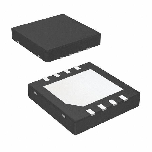

Product Folder Order Now Support & Community Tools & Software Technical Documents LM5007 SNVS252H – SEPTEMBER 2003 – REVISED NOVEMBER 2018 LM5007 75-V, 0.5-A DC/DC Buck Converter With 80-V Integrated Power MOSFET 1 Features 3 Description • The LM5007 0.5-A step-down switching converter features all of the functions needed to implement a low-cost and efficient buck regulator. This highvoltage converter has an integrated 80-V, 0.7-A Nchannel buck switch and operates over an input voltage range of 9 V to 75 V. The device is easy to implement and is provided in 8-pin VSSOP and thermally enhanced 8-pin WSON packages. 1 • • • • • • • Versatile Synchronous Buck DC/DC Converter – Operating Input Voltage Range of 9 V to 75 V – Integrated 80-V, 0.7-A N-Channel Buck Switch – Internal High-Voltage VCC Regulator – Adjustable Output Voltage – High Efficiency Operation Adaptive Constant On-Time Control Architecture – Ultra-Fast Transient Response – No Control Loop Compensation Required Nearly Constant Switching Frequency – PWM On-Time Varies Inversely with Input Voltage Precision 2.5-V Reference Low Input Quiescent Current Inherent Protection Features for Robust Design – Intelligent Current Limit Protection – VCC and Gate Drive UVLO Protection – Thermal Shutdown Protection With Hysteresis – External Shutdown Control 8-Pin VSSOP and WSON Packages Create a Custom Regulator Design Using WEBENCH® Power Designer Device Information(1) PART NUMBER PACKAGE LM5007 BODY SIZE (NOM) VSSOP (8) 3.00 mm × 3.00 mm WSON (8) 4.00 mm × 4.00 mm (1) For all available packages, see the orderable addendum at the end of the data sheet. 2 Applications • • • The converter uses a hysteretic control scheme with a PWM on-time inversely proportional to VIN. This feature allows the operating frequency to remain relatively constant with load and input voltage variations. The hysteretic control requires no loop compensation and provides fast transient response. An intelligent current limit is implemented with forced off-time that is inversely proportional to VOUT. This current limiting scheme ensures short-circuit protection while providing reduced load current foldback. Other protection features include thermal shutdown with automatic recovery, VCC and gate drive undervoltage lockout, and maximum duty cycle limiter. Non-Isolated DC/DC Buck Regulator Secondary High-Voltage Post Regulator 48-V Automotive Systems Typical Application Schematic 8 VIN VIN 9 V to 75 V BST 2 6 RON CIN Shutdown SW 1 LM5007 7 3 VOUT D1 VCC RC RFB2 CVCC RCL CBST LO RON COUT FB 5 RCL RTN 4 RFB1 1 An IMPORTANT NOTICE at the end of this data sheet addresses availability, warranty, changes, use in safety-critical applications, intellectual property matters and other important disclaimers. PRODUCTION DATA. LM5007 SNVS252H – SEPTEMBER 2003 – REVISED NOVEMBER 2018 www.ti.com Table of Contents 1 2 3 4 5 6 7 Features .................................................................. Applications ........................................................... Description ............................................................. Revision History..................................................... Pin Configuration and Functions ......................... Specifications......................................................... 1 1 1 2 3 4 6.1 6.2 6.3 6.4 6.5 6.6 4 4 4 4 5 6 Absolute Maximum Ratings ...................................... ESD Ratings.............................................................. Recommended Operating Conditions....................... Thermal Information .................................................. Electrical Characteristics........................................... Typical Characteristics .............................................. Detailed Description .............................................. 7 7.1 Overview ................................................................... 7 7.2 Functional Block Diagram ......................................... 7 7.3 Feature Description................................................... 8 7.4 Device Functional Modes........................................ 12 8 Application and Implementation ........................ 13 8.1 Application Information............................................ 13 8.2 Typical Application ................................................. 13 9 Power Supply Recommendations...................... 17 10 Layout................................................................... 18 10.1 Layout Guidelines ................................................. 18 10.2 Layout Example .................................................... 18 11 Device and Documentation Support ................. 19 11.1 11.2 11.3 11.4 11.5 11.6 Device Support...................................................... Documentation Support ........................................ Community Resources.......................................... Trademarks ........................................................... Electrostatic Discharge Caution ............................ Glossary ................................................................ 19 19 20 20 20 20 12 Mechanical, Packaging, and Orderable Information ........................................................... 21 4 Revision History NOTE: Page numbers for previous revisions may differ from page numbers in the current version. Changes from Revision G (October 2015) to Revision H Page • Changed Features, editorial ................................................................................................................................................... 1 • Changed Typical Application Schematic, editorial.................................................................................................................. 1 • Changed Overcurrent Protection, editorial .......................................................................................................................... 10 • Changed Figure 7, editorial .................................................................................................................................................. 13 • Changed Power Supply Recommendations, editorial .......................................................................................................... 17 • Changed Layout Example to specify recommended component placement ....................................................................... 18 • Changed Device Support to include new content ................................................................................................................ 19 • Changed Documentation Support to include new content ................................................................................................... 19 Changes from Revision F (March 2013) to Revision G Page • Added Device Information table, ESD Ratings table, Thermal Information table, Application Information, Design Requirements, Application Curves, Power Supply Recommendations, Layout, and Community Resources. ..................... 1 • Added Typical Application Schematic ................................................................................................................................... 1 • Updated pinout drawing description ...................................................................................................................................... 3 Changes from Revision E (March 2013) to Revision F • 2 Page Changed layout of National Semiconductor Data Sheet to TI format .................................................................................. 11 Submit Documentation Feedback Copyright © 2003–2018, Texas Instruments Incorporated Product Folder Links: LM5007 LM5007 www.ti.com SNVS252H – SEPTEMBER 2003 – REVISED NOVEMBER 2018 5 Pin Configuration and Functions DGK Package and NGT Package 8-Pin VSSOP and 8-Pin WSON Top View 1 8 SW VIN BST VCC RCL RON 2 3 4 7 6 5 RTN FB Pin Functions PIN NAME TYPE 1 SW O Switching node. Power switching node. Connect to the LC output filter. 2 BST I Boost bootstrap capacitor input. An external capacitor is required between the BST and SW pins. A 0.01-µF ceramic capacitor is recommended. An internal diode between VCC and BST completes the buck gate drive bias network. 3 RCL I Current Limit OFF-time programming pin tOFF = 10-5 / (0.59 + (VFB / 7.22 × 10− 6 × RCL)) A resistor between this pin and RTN determines the variation of off-time along with the FB pin voltage per cycle while in current limit. The off-time is preset to 17 µs if FB = 0 V and decreases as the FB voltage increases. 4 RTN — 5 FB I Feedback signal from regulated output. This pin is connected to the inverting input of the internal regulation comparator. The regulation threshold is 2.5 V. 6 RON I On-time set pin tON = 1.42 × 10-10 RON / VIN A resistor between this pin and VIN sets the switch on-time as a function of VIN. The minimum recommended on-time is 300 ns at the maximum input voltage. 7 VCC O Output from the internal high-voltage bias regulator. VCC is nominally regulated to 7 V. If an auxiliary voltage is available to raise the voltage on this pin, above the regulation set point (7V), the internal series pass regulator will shutdown, reducing the IC power dissipation. Do not exceed 14V. This output provides gate drive power for the internal buck switch. An internal diode is provided between this pin and the BST pin. A local 0.1-uF decoupling capacitor is recommended. The series pass regulator is current limited to 10 mA. 8 VIN I Input supply voltage. Recommended operating range: 9 V to 75 V. — EP — Exposed PAD, underside of the WSON-8 package option. Internally bonded to the die substrate. Connect to GND potential for low thermal impedance. NO . DESCRIPTION APPLICATION INFORMATION Circuit ground. Submit Documentation Feedback Copyright © 2003–2018, Texas Instruments Incorporated Product Folder Links: LM5007 3 LM5007 SNVS252H – SEPTEMBER 2003 – REVISED NOVEMBER 2018 www.ti.com 6 Specifications 6.1 Absolute Maximum Ratings Over operating free-air temperature range (unless otherwise noted) (1). MIN VIN to RTN BST to RTN SW to RTN (steady state) V 94 V V BST to VCC 80 V BST to SW 14 V VCC to RTN 14 V 7 V 260 °C 150 °C –0.3 Lead temperature (soldering 4 sec) (1) UNIT 80 –1 All other inputs to RTN Tstg MAX Storage temperature –55 Stresses beyond those listed under Absolute Maximum Ratings may cause permanent damage to the device. These are stress ratings only, which do not imply functional operation of the device at these or any other conditions beyond those indicated under Recommended Operating Conditions. Exposure to absolute-maximum-rated conditions for extended periods may affect device reliability. 6.2 ESD Ratings VALUE V(ESD) (1) (2) Electrostatic discharge Human-body model (HBM), per ANSI/ESDA/JEDEC JS-001 (1) (2) ±2000 Machine model (MM) ±200 UNIT V JEDEC document JEP155 states that 500-V HBM allows safe manufacturing with a standard ESD control process. The human body model is a 100-pF capacitor discharge through a 1.5-kΩ resistor into each pin. The machine model is a 200-pF capacitor discharged directly into each pin. The machine model ESD compliance level for Pin 5 is 150 V. The human body ESD compliance level for Pin 7 and 8 is 1000 V. 6.3 Recommended Operating Conditions Over operating free-air temperature range (unless otherwise noted). MIN VIN Input voltage TJ Junction temperature NOM MAX UNIT 9 75 V −40 125 °C 6.4 Thermal Information LM5007 THERMAL METRIC (1) DGK (VSSOP) NGT (WSON) 8 PINS 8 PINS UNIT RθJA Junction-to-ambient thermal resistance 158.3 38.1 °C/W RθJC(top) Junction-to-case (top) thermal resistance 51.3 27.8 °C/W RθJB Junction-to-board thermal resistance 78.5 15.1 °C/W ψJT Junction-to-top characterization parameter 4.9 0.2 °C/W ψJB Junction-to-board characterization parameter 77.2 15.3 °C/W RθJC(bot) Junction-to-case (bottom) thermal resistance N/A 4.5 °C/W (1) 4 For more information about traditional and new thermal metrics, see the Semiconductor and IC Package Thermal Metrics application report (SPRA953). Submit Documentation Feedback Copyright © 2003–2018, Texas Instruments Incorporated Product Folder Links: LM5007 LM5007 www.ti.com SNVS252H – SEPTEMBER 2003 – REVISED NOVEMBER 2018 6.5 Electrical Characteristics At TJ = 25°C, VIN = 48 V (unless otherwise noted) (1). PARAMETER TEST CONDITIONS MIN TYP MAX 7 7.4 UNIT STARTUP REGULATOR VCC VCC Regulator Output IVCC-CL VCC Current Limit (2) 6.6 11 VCC-UVLO VCC Undervoltage Lockout Voltage (VCC increasing) 6.3 VCC-UVLO-HYS VCC Undervoltage Hysteresis 206 V mA VCC SUPPLY tVCC-UV-DELAY VCC UVLO Delay (filter) V mV 3 µs ICC-OPER ICC Operating Current Not switching, VFB = 3 V 500 675 µA ISHD Shutdown/Standby Current VRON = 0 V 100 200 µA 0.74 1.34 Ω 4.5 5.5 V SWITCH CHARACTERISTICS RDS(on)1 Buck Switch On-State Resistance ISW = 0.2 A, VBST – VSW = 6.3 V (3) VGATE-UV Gate Drive UVLO (VBST – VSW) Rising 3.4 VGATE-UV-HYS Gate Drive UVLO Hysteresis VDS((max) Breakdown Voltage, VIN to RTN TJ = 25°C 80 V TJ = –40°C to 125°C 76 V VBST-VCC(max) Breakdown voltage, BST to VCC TJ = 25°C 80 V TJ = –40°C to 125°C 76 V 400 mV CURRENT LIMIT ICL Current Limit Threshold 535 tCL-RESP Current Limit Response Time ISW overdrive = 0.1 A, time to switch off tCL-OFF1 OFF-Time Generator (test 1) VFB = 0 V, RCL = 100 kΩ tCL-OFF2 OFF-Time Generator (test 2) VFB = 2.3 V, RCL = 100 kΩ 725 900 mA 225 ns 17 µs 2.65 µs ON-TIME GENERATOR tON1 TON-1 VIN = 10 V, RON = 200 kΩ 2.15 2.77 3.5 µs tON2 TON-2 VIN = 75 V, RON = 200 kΩ 290 390 490 ns VSHD Remote Shutdown Threshold Rising 0.45 0.7 1.1 VSHD-HYS Remote Shutdown Hysteresis V 40 mV 300 ns MINIMUM OFF-TIME tOFF(min) Minimum Off-Timer VFB = 0 V REGULATION AND OV COMPARATORS VREF FB Reference Threshold Internal reference, trip point for switch ON VOV-REF FB Overvoltage Threshold Trip point for switch OFF IFB FB Bias Current 2.445 2.5 2.550 V 2.875 V 100 nA 165 °C 25 °C THERMAL SHUTDOWN TSHD Thermal Shutdown Temperature THYS Thermal Shutdown Hysteresis (1) (2) (3) All electrical characteristics having room temperature limits are tested during production with TA = TJ = 25°C. All hot and cold limits are specified by correlating the electrical characteristics to process and temperature variations and applying statistical process control. The VCC output is intended as a self bias for the internal gate drive power and control circuits. Device thermal limitations limit external loading. For devices in the WSON-8 package, the MOSFET RDS(on) limits are specified by design characterization data only. Submit Documentation Feedback Copyright © 2003–2018, Texas Instruments Incorporated Product Folder Links: LM5007 5 LM5007 SNVS252H – SEPTEMBER 2003 – REVISED NOVEMBER 2018 www.ti.com 6.6 Typical Characteristics 20 100 95 18 VIN = 15V 600k 16 14 85 80 (Ps) T OFF EFFICIENCY (%) 90 VIN = 30V VIN = 50V 75 VIN = 70V 400k 200k 12 10 8 6 70 4 65 2 60 0 0 0.1 0.2 0.3 0.4 100k 0 0.5 50k 0.5 1 V LOAD (A) 1.5 FB 2 2.5 (V) RCL = 50 kΩ – 600 kΩ Figure 2. Current Limit TOFF vs. VFB Figure 1. Converter Efficiency at 10-V Output 5 4.5 4 (us) T ON 3.5 3 2.5 300k 2 200k 1.5 100k 1 0.5 0 0 10 20 30 40 V IN 50 60 70 80 (V) RON = 100kΩ, 200kΩ, 300kΩ Figure 3. TON vs. VIN 6 Submit Documentation Feedback Copyright © 2003–2018, Texas Instruments Incorporated Product Folder Links: LM5007 LM5007 www.ti.com SNVS252H – SEPTEMBER 2003 – REVISED NOVEMBER 2018 7 Detailed Description 7.1 Overview The LM5007 regulator is an easy-to-use buck DC/DC converter that operates from 9-V to 75-V supply voltage. The device is intended for step-down conversions from 12-V, 24-V, and 48-V unregulated, semi-regulated and fully-regulated supply rails. With integrated 80-V, 0.7-A buck power MOSFET, the LM5007 delivers up to 500-mA DC load current with exceptional efficiency and low input quiescent current in a very small solution size. The device is easy to use and is provided in VSSOP-8 and thermally-enhanced WSON-8 packages. Designed for simple implementation, a nearly fixed-frequency, constant on-time (COT) operation with discontinuous conduction mode (DCM) at light loads is ideal for low-noise, high current, fast transient load requirements. Control loop compensation is not required, reducing design time and external component count. An intelligent current limit scheme is implemented in the LM5007 with forced off-time after current limit detection, which is inversely proportional to VOUT. This current limiting scheme reduces load current foldback. The LM5007 incorporates numerous other features for comprehensive system requirements, including VCC undervoltage lockout (UVLO), gate drive UVLO, maximum duty cycle limiter, intelligent current limit off-timer, and thermal shutdown with automatic recovery. These features enable a flexible and easy-to-use platform for a wide range of applications, such as 48-V telecom and the 48-V automotive power bus designs. The pin arrangement is designed for simple and optimized PCB layout, requiring only a few external components. 7.2 Functional Block Diagram 7V SERIES REGULATOR LM5007 VCC VIN SD THERMAL SHUTDOWN UVLO ON TIMER START COMPLETE SD / RON BST Ron START OVER-VOLTAGE COMPARATOR + - 2.875V UVLO 300nS MIN OFF TIMER VIN SD DRIVER COMPLETE LEVEL SHIFT 2.5V SW SET + FB REGULATION COMPARATOR FB RCL Q S Q R CLR COMPLETE RCL + - START CURRENT LIMIT OFF TIMER 0.725A BUCK SWITCH CURRENT SENSE RTN Submit Documentation Feedback Copyright © 2003–2018, Texas Instruments Incorporated Product Folder Links: LM5007 7 LM5007 SNVS252H – SEPTEMBER 2003 – REVISED NOVEMBER 2018 www.ti.com 7.3 Feature Description 7.3.1 Hysteretic Control Circuit Overview The LM5007 is a buck DC/DC converter that uses a constant on-time (COT) control scheme. The on-time is programmed by an external resistor and varies inversely with line input voltage (VIN). The core regulation elements of the LM5007 are the feedback comparator and the programmed on-time one-shot. The regulator output voltage is sensed at the feedback pin (FB) and compared to an internal reference voltage (2.5 V). If the FB voltage is below the reference voltage, the buck switch is turned on for a fixed time interval determined by the input voltage and a programming resistor (RON). Following the on period, the switch remains off for at least the minimum off-time interval of 300 ns. If the FB voltage is still below the reference after the 300-ns off-time, the switch turns on again for another on-time interval. This switching behavior continues until the FB voltage reaches the reference voltage level. The LM5007 operates in discontinuous conduction mode (DCM) at light load currents and continuous conduction mode (CCM) at heavier load currents. In DCM, current through the output inductor starts at zero and ramps up to a peak value during the buck switch on-time and then back to zero during the off-time. The inductor current remains at zero until the next on-time interval begins when FB falls below the internal reference voltage. The operating frequency in DCM is relatively low and varies with load. Thus, the conversion efficiency is maintained at light loads, since the switching losses decrease with the reduction in load current and switching frequency. Calculate the approximate switching frequency in DCM with Equation 1. 2 FSW(DCM) VOUT ˜ LO RLOAD ˜ RON 2 ˜ 10 20 (1) In CCM, current flows continuously through the inductor and never ramps down to zero. The switching frequency in CCM is greater than that in DCM and remains relatively constant with load and line variations. Calculate the approximate switching frequency in CCM with Equation 2. FSW(CCM) VOUT 1.42 ˜ 10 10 ˜ RON (2) The output voltage (VOUT) can be programmed by two external resistors as shown in Figure 4. Calculate the output voltage setpoint using Equation 3. VOUT § R1 · 2.5 V ˜ ¨ 1 ¸ R 2 ¹ © (3) The feedback comparator in hysteretic regulators depend upon the output ripple voltage to switch the power MOSFET on and off at regular intervals. In order for the internal comparator to respond quickly to changes in output voltage, proportional to inductor current, a minimum amount of capacitor Equivalent Series Resistance (ESR) is required. A ripple voltage of 25 mV to 50 mV is recommended at the feedback pin (FB) for stable operation. In cases where the intrinsic capacitor ESR is too small, additional series resistance may be added. For applications where lower output voltage ripple is required, the load can be connected directly to the low ESR output capacitor as shown in Figure 4. The series resistor (R) will degrade the load regulation. Another technique for enhancing the ripple voltage at FB is to place a capacitor in parallel with the upper feedback resistor, R1. The addition of this feedforward capacitor reduces the attenuation of the ripple voltage from the feedback divider. 7.3.2 High-Voltage Bias Supply Regulator The LM5007 contains an internal high-voltage bias supply regulator. The input pin (VIN) can be connected directly to line voltages from 9 V to 75 V. To avoid supply voltage transients due to long lead inductances on the input pin (VIN), it is always recommended to connect a low-ESR ceramic capacitor (≈ 0.1 µF) between VIN and RTN, located close to the respective pins of the LM5007. The bias regulator is internally current limited to 10 mA. Upon power up, the regulator is enabled and sources current into an external capacitor connected to the VCC pin. When the VCC voltage reaches the regulation point of 7 V, the controller output is enabled. An external auxiliary supply voltage can be applied to the VCC pin. If this auxiliary voltage is greater than 7 V, the internal regulator will essentially shutoff, thus reducing internal power dissipation. 8 Submit Documentation Feedback Copyright © 2003–2018, Texas Instruments Incorporated Product Folder Links: LM5007 LM5007 www.ti.com SNVS252H – SEPTEMBER 2003 – REVISED NOVEMBER 2018 Feature Description (continued) VIN L SW R1 R FB + R2 + REF 2.5V VOUT COUT LM5007 Figure 4. Low Output Ripple Voltage Configuration 7V SERIES REGULATOR VCC + 0.1PF SELF-BIAS DIODE BST VIN + 0.01PF SW 10V LM5007 30k + 10k Figure 5. Self-Biased Configuration with VOUT Feeding VCC Through a Diode 7.3.3 Overvoltage Comparator The overvoltage comparator is provided to protect the output from overvoltage conditions due to sudden input line voltage changes or output loading changes. The overvoltage comparator monitors the FB voltage relative to an internal 2.875-V reference, VOV-REF. If the voltage at FB rises above VOV-REF, the comparator immediately terminates the buck switch on-time pulse. Submit Documentation Feedback Copyright © 2003–2018, Texas Instruments Incorporated Product Folder Links: LM5007 9 LM5007 SNVS252H – SEPTEMBER 2003 – REVISED NOVEMBER 2018 www.ti.com Feature Description (continued) 7.3.4 On-Time Generator and Shutdown The on-time of the LM5007 is set inversely proportional to the input voltage by an external resistor connected between VIN and RON. The RON pin is a low impedance input biased at approximately 1.5 V. Thus, the current through the resistor and into the RON pin is approximately proportional to VIN and used internally to control the on-timer. This scheme of input voltage feedforward hysteretic operation achieves nearly constant switching frequency over varying line and load conditions. Equation 4 specifies the on-time equation for the LM5007. t ON 1.42 ˜ 10 10 ˜ RON VIN (4) The RON pin of the LM5007 also provides a shutdown function that disables the converter and significantly decreases quiescent power dissipation. Pulling the voltage at RON below a 0.7-V logic threshold activates a lowpower shutdown mode. The VIN quiescent current in this shutdown mode is approximately 100 µA internal to the LM5007 plus the current in the RON resistor. 7V SERIES REGULATOR VIN VIN ON TIMER RON VIN START RON RON COMPLETE STOP RUN LM5007 Figure 6. Shutdown Implementation 7.3.5 Overcurrent Protection The LM5007 contains an intelligent current limit off-timer intended to reduce the foldback characteristic inherent with fixed off-time overcurrent protection (OCP) schemes. If the current in the buck switch exceeds 725 mA, the present cycle on-time is immediately terminated (cycle-by-cycle current limit). Following the termination of the cycle a non-resettable current limit off-timer is initiated. The duration of the off-time is a function of the external resistor (RCL) and the FB voltage. When the FB voltage equals zero, the current limit off-time is internally preset to 17 µs. This condition occurs during a short-circuit condition when a maximum amount of off-time is required. In case of output overload (not a complete short circuit), the current limit off-time is reduced as a function of the output voltage (measured at the FB pin). Scaling the off-time with smaller overloads reduces the amount of foldback and also reduces the initial start-up time. Calculate the current limit off-time for a given FB voltage and RCL resistor using Equation 5. t OFF(CL) 10 ˜ 0.59 5 VFB 7.22 ˜ 10 10 6 ˜ RCL (5) Submit Documentation Feedback Copyright © 2003–2018, Texas Instruments Incorporated Product Folder Links: LM5007 LM5007 www.ti.com SNVS252H – SEPTEMBER 2003 – REVISED NOVEMBER 2018 Feature Description (continued) Select the current limit off-time such that it is less than the MOSFET off-time during normal steady-state switching operation. Applications utilizing low-resistance inductors and/or a low-voltage-drop freewheeling power diodes may require special evaluation at high line, short-circuited conditions. In this special case the preset 17-µs off-time (VFB = 0 V) may be insufficient to provide inductor volt-seconds balance. Additional inductor resistance, output resistance or a larger voltage drop diode may be necessary to balance inductor volt-seconds and limit the short-circuit current. 7.3.6 N-Channel Buck Switch and Driver The LM5007 integrates an N-channel buck switch and associated floating high voltage gate driver. This gate driver circuit works in conjunction with an external bootstrap capacitor and an internal high voltage diode. The bootstrap capacitor is charged by VCC through the internal high voltage diode. A 0.01-µF ceramic capacitor connected between BST and SW is recommended. During each cycle when the buck switch turns off, the SW voltage is approximately 0 V. When the SW voltage is low, the bootstrap capacitor is charged from VCC through the internal bootstrap diode. The minimum off-timer, set to 300 ns, ensures that there is a minimum interval every switching cycle to recharge the bootstrap capacitor. An external recirculating diode from the SW to RTN is necessary to carry the inductor current after the internal buck switch turns off. This external diode must be an ultra-fast switching or Schottky type to reduce turn-on losses and switch current overshoot. The reverse voltage rating of the recirculating diode must be greater than the maximum line input voltage. 7.3.7 Thermal Protection Internal thermal shutdown circuitry is provided to protect the integrated circuit in the event the maximum junction temperature is exceeded. When thermal protection is activated, typically at 165°C, the converter is forced into a low power reset state, disabling the output driver. This feature is provided to prevent catastrophic failures from accidental device overheating. 7.3.8 Minimum Load Current A minimum load current of 1 mA is required to maintain proper operation. If the load current falls below that level, the bootstrap capacitor may discharge during the long off-time, and the circuit will either shutdown or cycle on and off at a low frequency. If the load current is expected to drop below 1 mA in the application, choose the feedback resistors with sufficiently low value to provide the minimum required load current at nominal VOUT. 7.3.9 Ripple Configuration The LM5007 uses an adaptive constant on-time (COT) control in which the conduction time of the buck MOSFET is terminated by an on-timer and the off-time is terminated by the feedback voltage (VFB) falling below the reference voltage (VREF). Therefore, for stable operation, the feedback voltage must decrease monotonically and in phase with the inductor current during the off-time interval. Furthermore, this change in feedback voltage (VFB) during the off-time must be larger than any noise component present at the feedback node. Table 1 shows three different methods for generating appropriate voltage ripple at the feedback node. Type 1 and Type 2 ripple circuits couple the ripple at the output of the converter to the feedback node (FB). The output voltage ripple has two components: 1. Capacitive ripple caused by the inductor current ripple charging/discharging the output capacitor. 2. Resistive ripple caused by the inductor current ripple flowing through the ESR of the output capacitor. The capacitive ripple is not in phase with the inductor current. As a result, the capacitive ripple does not decrease monotonically during the off-time. The resistive ripple is in phase with the inductor current and decreases monotonically during the off-time. The resistive ripple must exceed the capacitive ripple at the output node (VOUT) for stable operation. If this condition is not satisfied, unstable switching behavior is observed in COT converters with multiple on-time bursts in close succession followed by a long off-time. Submit Documentation Feedback Copyright © 2003–2018, Texas Instruments Incorporated Product Folder Links: LM5007 11 LM5007 SNVS252H – SEPTEMBER 2003 – REVISED NOVEMBER 2018 www.ti.com Feature Description (continued) Type 3 ripple method uses Rr and Cr and the switch node (SW) voltage to generate a triangular ramp. This triangular ramp is ac coupled using Cac to the feedback node (FB). Since this circuit does not use the output voltage ripple, it is ideally suited for applications where low output voltage ripple is required. See AN-1481 Controlling Output Ripple and Achieving ESR Independence in Constant On-Time (COT) Regulator Designs (SNVA166) for more details for each ripple generation method. Table 1. Ripple Configuration TYPE 1 LOWEST COST CONFIGURATION TYPE 2 REDUCED RIPPLE CONFIGURATION VOUT TYPE 3 MINIMUM RIPPLE CONFIGURATION VOUT L1 VOUT L1 L1 R FB2 Cac R FB2 RC To FB C OUT COUT R FB2 GND C OUT R FB1 To FB R FB1 GND GND Cac t 25mV VOUT ˜ 'IL(min) VREF Cr Cac To FB R FB1 RC Rr RC (6) RC Cr 5 3.3nF FSW ˜ RFB1 RFB2 Cac 25mV 'IL(min) Rr ˜ Cr (7) 100nF VIN(min) VOUT ˜ t ON 25mV (8) 7.4 Device Functional Modes 7.4.1 Standby Mode with VIN The LM5007 is intended to operate with input voltages above 9 V. The minimum operating input voltage is determined by the VCC undervoltage lockout threshold of 6.3 V (typ). If VIN is too low to support a VCC voltage greater than the VCC UVLO threshold, the converter switches to its standby mode with the buck switch in the off state. 7.4.2 Shutdown Mode The LM5007 is in shutdown mode when the RON pin is pulled below 0.7 V (typ). In this mode, the buck MOSFET is held off and the VCC regulator is disabled. 12 Submit Documentation Feedback Copyright © 2003–2018, Texas Instruments Incorporated Product Folder Links: LM5007 LM5007 www.ti.com SNVS252H – SEPTEMBER 2003 – REVISED NOVEMBER 2018 8 Application and Implementation NOTE Information in the following applications sections is not part of the TI component specification, and TI does not warrant its accuracy or completeness. TI’s customers are responsible for determining suitability of components for their purposes. Customers should validate and test their design implementation to confirm system functionality. 8.1 Application Information The LM5007 requires only a few external components to convert from a wide range of supply voltages to a fixed output voltage. To expedite and streamline the process of designing a LM5007-based converter, a comprehensive LM5007 quick-start calculator is available for download to assist the designer with component selection for a given application. WEBENCH® online software is also available to generate complete designs, leveraging iterative design procedures and access to comprehensive component databases. The following sections discuss a design procedure using a typical application example. Figure 7 shows the LM5007 in a configuration suitable for several application use cases. See the LM5007 EVM for more details. 8.2 Typical Application The application schematic of an LM5007-based buck converter is shown in Figure 7. For an output voltage (VOUT) above the maximum regulation threshold of VCC (see Electrical Characteristics), the VCC pin can be supplied from VOUT through a diode for higher efficiency and lower power dissipation in the IC. BST 2 8 VIN VIN RON 12 V to 75 V CIN 1 µF CBYP 0.1 µF CBST 0.01 µF LM5007 200 NŸ 6 RON L1 SW 1 Shutdown 7 CVCC 0.1 µF 3 RCL 100 NŸ D1 VCC RFB2 3.01 NŸ FB 5 RCL RTN 4 VOUT 100 µH RC 1Ÿ 10V COUT 15 µF RFB1 1 NŸ Figure 7. 12-V to 75-V Input and 10-V, 400-mA Output Buck Converter 8.2.1 Design Requirements For this design example, use the parameters listed in Table 2 as the input parameters. Table 2. Design Parameters DESIGN PARAMETERS VALUE Input Voltage 12 V to 75 V Output Voltage 10 V Maximum Output Current 400 mA Nominal Switching Frequency 380 kHz Submit Documentation Feedback Copyright © 2003–2018, Texas Instruments Incorporated Product Folder Links: LM5007 13 LM5007 SNVS252H – SEPTEMBER 2003 – REVISED NOVEMBER 2018 www.ti.com 8.2.2 Detailed Design Procedure 8.2.2.1 Custom Design With WEBENCH® Tools Click here to create a custom design using the LM5007 device with WEBENCH® Power Designer. 1. Start by entering the input voltage (VIN), output voltage (VOUT), and output current (IOUT) requirements. 2. Optimize the design for key parameters such as efficiency, footprint, and cost using the optimizer dial. 3. Compare the generated design with other possible solutions from Texas Instruments. The WEBENCH Power Designer provides a customized schematic along with a list of materials with real-time pricing and component availability. In most cases, these actions are available: • Run electrical simulations to see important waveforms and circuit performance • Run thermal simulations to understand board thermal performance • Export customized schematic and layout into popular CAD formats • Print PDF reports for the design, and share the design with colleagues Get more information about WEBENCH tools at www.ti.com/WEBENCH. 8.2.2.2 Custom Design With Excel Quickstart Tool Select components based on the converter specifications using the LM5007 quick-start calculator available for download from the LM5007 product folder. 8.2.2.3 Feedback Resistors, RFB1 and RFB2 VOUT = VFB x (RFB2/RFB1 + 1), and since VFB = 2.5 V in regulation, the ratio of RFB2 to RFB1 is 3 : 1. Select standard values of RFB1 = 1 kΩ and RFB2 = 3.01 kΩ. Other values can be chosen as long as the 3 : 1 ratio is maintained. 8.2.2.4 Switching Frequency Selection, RON Set the switching frequency by resistor RON using Equation 9. VOUT RON 1.42 ˜ 10 10 ˜ FSW (9) Selecting FSW = 380 kHz results in RON= 185 kΩ. Choose a standard value of 200 kΩ for this design. 8.2.2.5 Buck Inductor, L1 The inductor is selected to provide a current ripple of 40% to 50% of the full-load current. In addition, the peak inductor current at maximum load must be smaller than the minimum current limit threshold provided in Electrical Characteristics. The inductor current ripple is given by Equation 10. 'IL VIN VOUT VOUT ˜ L1 ˜ FSW VIN (10) The maximum ripple is observed at the maximum input voltage. Using VIN = 75 V and ΔIL= 50% x IOUT(max) results in L1 = 114 µH. Select a standard inductor value of 100 µH. The inductor current ripple ranges from 88 mA to 228 mA depending on input voltage. The peak inductor and switch current at full load are given by Equation 11. IL1(peak) IOUT(max) 'IL 2 (11) At maximum VIN, the peak inductor current is 514 mA, which is lower than the minimum current limit threshold of 535 mA. The selected inductor should be able to operate at the maximum current limit of 900 mA without saturation during startup and overload conditions. 14 Submit Documentation Feedback Copyright © 2003–2018, Texas Instruments Incorporated Product Folder Links: LM5007 LM5007 www.ti.com SNVS252H – SEPTEMBER 2003 – REVISED NOVEMBER 2018 8.2.2.6 Output Capacitor, COUT Select the output capacitor to minimize the capacitive ripple. The maximum ripple is observed at the maximum input voltage and is given by Equation 12. COUT 'IL 8 ˜ FSW ˜ 'VCOUT where • • ΔVCOUT is the voltage ripple across the capacitor, ΔIL is the peak-to-peak inductor ripple current. (12) Substituting VIN = 75 V and targeting ΔVCOUT= 10 mV gives COUT = 7.5 µF. Select a standard 15-µF value for COUT with X5R or X7R dielectric and a voltage rating of 16 V or higher. 8.2.2.7 Type I Ripple Circuit, RC Choose a type I ripple circuit, as described in Ripple Configuration, for this example. For a constant on-time (COT) converter to be stable, the injected in-phase ripple must be larger than the capacitive ripple on COUT. Using the type I ripple circuit equations with minimum FB pin ripple of 25 mV, calculate the value of series resistor RC using Equation 13. 25mV VOUT ˜ 'IL(min) VREF RC (13) Based on the calculated value of 1.1 Ω, select a standard value of 1 Ω. 8.2.2.8 Input Capacitor, CIN The input capacitor should be large enough to limit the input voltage ripple that can be calculated using Equation 14. IOUT(max) ˜ D ˜ 1 D CIN FSW ˜ 'VCIN (14) The input ripple reaches its maximum at D = 0.5. Targeting a ΔVCIN = 0.5 V at using a duty cycle of D = 0.5 results in CIN = 0.526 µF. A standard value of 1 µF is selected. The input capacitor should be rated for the maximum input voltage under all conditions. A 100-V, X7R type capacitor is selected for this design. The input capacitor should be placed close to the VIN pin and the anode of the diode (D1) as it supplies high-frequency switching current. Also place a 0.1-µF bypass capacitor (CBYP) very close to VIN and RTN pins of the IC to reduce switching power loop parasitic inductance and mitigate SW node overshoot and ringing. 8.2.2.9 Current Limit, RCL Resistor RCL sets the current limit off-timer according to Equation 5. The useable values tend to be in the range of 100 kΩ to 1 MΩ. Equation 15 specifies the off-time required for volt-second balance on the inductor in current limit. t OFF(ILIM) VIN(max) ˜ 225ns VOUT VF ILIM ˜ RDCR where • • • • • 225 ns is the current limit response time, VF is the forward voltage drop of the freewheeling power diode, VOUT is the output voltage, ILIM is the current limit, RDCR is the inductor DC resistance. (15) Submit Documentation Feedback Copyright © 2003–2018, Texas Instruments Incorporated Product Folder Links: LM5007 15 LM5007 SNVS252H – SEPTEMBER 2003 – REVISED NOVEMBER 2018 www.ti.com The programmed current limit off-time should be higher than the off-time needed for volt-second balance on the inductor. For a short at the output (VOUT = 0 V) and VF = 0.7 V, an inductor DCR of 390 mΩ or higher is needed to achieve volt-second balance at the maximum programmed current limit off-time of 17 µs. Using Equation 5, an RCL of greater than 10 kΩ can be used. Select a conservative value of 100 kΩ for this design. For step-by-step design procedures, circuit schematics, bill of materials, PCB files, simulation and test results of LM5007-powered implementations, refer to the TI Designs reference design library. 8.2.3 Application Curves VOUT = 10 V CH1: Switch Node VIN = 20 V CH2: VOUT (AC) IOUT = 250 mA CH4: Inductor Current VOUT = 10 V CH1: Switch Node Figure 8. Switching Waveforms, VIN = 20 V 16 Submit Documentation Feedback VIN = 75 V CH2: VOUT (AC) IOUT = 250 mA CH4: Inductor Current Figure 9. Switching Waveforms, VIN = 75 V Copyright © 2003–2018, Texas Instruments Incorporated Product Folder Links: LM5007 LM5007 www.ti.com SNVS252H – SEPTEMBER 2003 – REVISED NOVEMBER 2018 9 Power Supply Recommendations The LM5007 converter is designed to operate from a wide input voltage range from 9 V to 75 V. The characteristics of the input supply must be compatible with the Absolute Maximum Ratings and Recommended Operating Conditions. In addition, the input supply must be capable of delivering the required input current to the fully-loaded regulator. Estimate the average input current with Equation 16. VOUT ˜ IOUT VIN ˜ K IIN where • η is the efficiency (16) If the converter is connected to an input supply through long wires or PCB traces with large impedance, achieving stable performance requires special care. The parasitic inductance and resistance of the input cables may have an adverse affect on converter operation. The parasitic inductance in combination with the low-ESR ceramic input capacitors form an underdamped resonant circuit. This circuit can cause overvoltage transients at VIN each time the input supply is cycled ON and OFF. The parasitic resistance causes the input voltage to dip during a load transient. If the regulator is operating close to the minimum input voltage, this dip can cause false UVLO fault triggering and a system reset. The best way to solve such issues is to reduce the distance from the input supply to the regulator and use an aluminum or tantalum input capacitor in parallel with the ceramics. The moderate ESR of the electrolytic capacitors helps to damp the input resonant circuit and reduce any voltage overshoots. A capacitance in the range of 10 µF to 47 µF is usually sufficient to provide input damping and helps to hold the input voltage steady during large load transients. An EMI input filter is often used in front of the regulator that, unless carefully designed, can lead to instability as well as some of the effects mentioned above. The user's guide Simple Success with Conducted EMI for DC-DC Converters (SNVA489) provides helpful suggestions when designing an input filter for any switching regulator. Submit Documentation Feedback Copyright © 2003–2018, Texas Instruments Incorporated Product Folder Links: LM5007 17 LM5007 SNVS252H – SEPTEMBER 2003 – REVISED NOVEMBER 2018 www.ti.com 10 Layout 10.1 Layout Guidelines The LM5007 regulation and overvoltage comparators are very fast, and as such respond to short-duration noise pulses. Layout considerations are therefore critical for optimum performance: 1. Minimize the area of the high di/dt switching current loop consisting of the VIN and SW pins, freewheeling power diode, and input ceramic capacitor. Keep the input capacitor(s) close to the VIN pin of the LM5007. Place the cathode of the freewheeling diode close to the SW pin and and its anode near the return terminal of the input capacitor as illustrated in Figure 10. Route a short, direct connection to the RTN pin using polygon copper pours under the IC. 2. Place the inductor close to the SW pin of the LM5007. Minimize SW node copper area to reduce radiated noise related to high dv/dt. 3. Locate CBST, RCL, RON and CVCC components as physically close as possible to their respective pins, thereby minimizing noise pickup in the printed-circuit tracks. 4. Locate the VOUT sense trace away from noise sources such as inductors. Place both feedback resistors close to the FB pin to minimize the length of the FB trace. 5. Place a solid GND plane on layer 2 of the PCB. If the internal dissipation of the LM5007 converter produces excessive junction temperatures during normal operation, optimal use of the PCB ground plane can help considerably to dissipate heat. The exposed pad on the bottom of the WSON-8 package can be soldered to a ground plane on the PCB, and that plane should extend out from beneath the IC to help dissipate the heat. Additionally, the use of wide PCB traces for power connection can also help conduct heat away from the IC. Judicious positioning of the LM5007 converter within the end product, along with use of any available air flow (forced or natural convection), can help reduce the operating junction temperature. 10.2 Layout Example Locate D1 close to the SW pin and position its anode towards CIN Via to Ground Plane VOUT CA COUT GND Minimize the area of this critical loop L1 VIN SW VIN VCC CVCC RCL RON RON RTN FB RFB2 BST LM5007 Via to VIN RCL Locate CBST close to the SW and BST pins CBST RA Use minimum SW node copper area by keeping L1 close to the LM5007 Locate CIN close to the VIN pin and the anode of D1 CIN D1 RFB1 Locate CVCC, RON, RFB1 and RFB2 close to their respective pins CB Figure 10. PCB Layout Example NOTE It is critical to minimize switching loop parasitic inductance by locating the input capacitor close to the VIN pin of the LM5007. Also, place the freewheeling power diode near the SW pin with its anode adjacent to the input capacitor as shown in Figure 10. 18 Submit Documentation Feedback Copyright © 2003–2018, Texas Instruments Incorporated Product Folder Links: LM5007 LM5007 www.ti.com SNVS252H – SEPTEMBER 2003 – REVISED NOVEMBER 2018 11 Device and Documentation Support 11.1 Device Support 11.1.1 Third-Party Products Disclaimer TI'S PUBLICATION OF INFORMATION REGARDING THIRD-PARTY PRODUCTS OR SERVICES DOES NOT CONSTITUTE AN ENDORSEMENT REGARDING THE SUITABILITY OF SUCH PRODUCTS OR SERVICES OR A WARRANTY, REPRESENTATION OR ENDORSEMENT OF SUCH PRODUCTS OR SERVICES, EITHER ALONE OR IN COMBINATION WITH ANY TI PRODUCT OR SERVICE. 11.1.2 Custom Design With WEBENCH® Tools Click here to create a custom design using the LM5007 device with the WEBENCH® Power Designer. 1. Start by entering the input voltage (VIN), output voltage (VOUT), and output current (IOUT) requirements. 2. Optimize the design for key parameters such as efficiency, footprint, and cost using the optimizer dial. 3. Compare the generated design with other possible solutions from Texas Instruments. The WEBENCH Power Designer provides a customized schematic along with a list of materials with real-time pricing and component availability. In most cases, these actions are available: • Run electrical simulations to see important waveforms and circuit performance • Run thermal simulations to understand board thermal performance • Export customized schematic and layout into popular CAD formats • Print PDF reports for the design, and share the design with colleagues Get more information about WEBENCH tools at www.ti.com/WEBENCH. 11.1.3 Development Support For development support see the following: • For TI's reference design library, visit TI Designs • For TI's WEBENCH Design Environments, visit WEBENCH® Design Center 11.2 Documentation Support 11.2.1 Related Documentation For related documentation see the following: • LM5007 Quick-start Calculator • LM5007EVAL Evaluation Board • LM5007SD-EVAL Evaluation Board • LM5006EVAL Evaluation Board • LM5008EVAL Evaluation Board • LM5008AEVAL Evaluation Board • LM5009EVAL Evaluation Board • LM5010-EVAL Evaluation Board • LM5010AEVAL Evaluation Board • Buck Regulator Topologies for Wide Input/Output Voltage Differentials (SNVA594) • AN-1481 Controlling Output Ripple and Achieving ESR Independence in Constant On-Time (COT) Regulator Designs (SNVA166) • White Papers: – Valuing Wide VIN, Low EMI Synchronous Buck Circuits for Cost-driven, Demanding Applications (SLYY104) – An Overview of Conducted EMI Specifications for Power Supplies (SLYY136) – An Overview of Radiated EMI Specifications for Power Supplies (SLYY142) Submit Documentation Feedback Copyright © 2003–2018, Texas Instruments Incorporated Product Folder Links: LM5007 19 LM5007 SNVS252H – SEPTEMBER 2003 – REVISED NOVEMBER 2018 www.ti.com Documentation Support (continued) • TI – – – – – Designs: PoE PSE Type 2 (30W) IEEE 802.3at Fully Autonomous Quad Port Solution 8 Channel, 2-A High-Side Driver Reference Design for Digital Output Modules Low Side 0.5A 8ch Digital Output Module for PLC High Fidelity 175W Class-D Audio Amplifier with Digital Inputs and Processing Reference Design Bidirectional DC-DC Converter Reference Design for 12-V/48-V Automotive Systems 11.2.1.1 PCB Layout Resources • AN-1149 Layout Guidelines for Switching Power Supplies (SNVA021) • AN-1229 Simple Switcher PCB Layout Guidelines (SNVA054) • Constructing Your Power Supply – Layout Considerations (SLUP230) • Low Radiated EMI Layout Made SIMPLE with LM4360x and LM4600x (SNVA721) • AN-2162 Simple Success With Conducted EMI From DC-DC Converters (SNVA489) • Reduce Buck-Converter EMI and Voltage Stress by Minimizing Inductive Parasitics (SLYT682) • Power House Blogs: – High-Density PCB Layout of DC/DC Converters 11.2.1.2 Thermal Design Resources • AN-2020 Thermal Design By Insight, Not Hindsight (SNVA419) • AN-1520 A Guide to Board Layout for Best Thermal Resistance for Exposed Pad Packages (SNVA183) • Semiconductor and IC Package Thermal Metrics (SPRA953) • Thermal Design Made Simple with LM43603 and LM43602 (SNVA719) • PowerPAD™Thermally Enhanced Package (SLMA002) • PowerPAD Made Easy (SLMA004) • Using New Thermal Metrics (SBVA025) 11.3 Community Resources The following links connect to TI community resources. Linked contents are provided "AS IS" by the respective contributors. They do not constitute TI specifications and do not necessarily reflect TI's views; see TI's Terms of Use. TI E2E™ Online Community TI's Engineer-to-Engineer (E2E) Community. Created to foster collaboration among engineers. At e2e.ti.com, you can ask questions, share knowledge, explore ideas and help solve problems with fellow engineers. Design Support TI's Design Support Quickly find helpful E2E forums along with design support tools and contact information for technical support. 11.4 Trademarks PowerPAD, E2E are trademarks of Texas Instruments. WEBENCH is a registered trademark of Texas Instruments. 11.5 Electrostatic Discharge Caution These devices have limited built-in ESD protection. The leads should be shorted together or the device placed in conductive foam during storage or handling to prevent electrostatic damage to the MOS gates. 11.6 Glossary SLYZ022 — TI Glossary. This glossary lists and explains terms, acronyms, and definitions. 20 Submit Documentation Feedback Copyright © 2003–2018, Texas Instruments Incorporated Product Folder Links: LM5007 LM5007 www.ti.com SNVS252H – SEPTEMBER 2003 – REVISED NOVEMBER 2018 12 Mechanical, Packaging, and Orderable Information The following pages include mechanical, packaging, and orderable information. This information is the most current data available for the designated devices. This data is subject to change without notice and revision of this document. For browser-based versions of this data sheet, refer to the left-hand navigation. Submit Documentation Feedback Copyright © 2003–2018, Texas Instruments Incorporated Product Folder Links: LM5007 21 PACKAGE OPTION ADDENDUM www.ti.com 30-Sep-2021 PACKAGING INFORMATION Orderable Device Status (1) Package Type Package Pins Package Drawing Qty Eco Plan (2) Lead finish/ Ball material MSL Peak Temp Op Temp (°C) Device Marking (3) (4/5) (6) LM5007MM NRND VSSOP DGK 8 1000 Non-RoHS & Green Call TI Level-1-260C-UNLIM -40 to 125 S81B LM5007MM/NOPB ACTIVE VSSOP DGK 8 1000 RoHS & Green SN Level-1-260C-UNLIM -40 to 125 S81B LM5007MMX/NOPB ACTIVE VSSOP DGK 8 3500 RoHS & Green SN Level-1-260C-UNLIM -40 to 125 S81B LM5007SD NRND WSON NGT 8 1000 Non-RoHS & Green Call TI Level-1-260C-UNLIM -40 to 125 L00031B LM5007SD/NOPB ACTIVE WSON NGT 8 1000 RoHS & Green NIPDAU | SN Level-1-260C-UNLIM -40 to 125 L00031B LM5007SDX/NOPB ACTIVE WSON NGT 8 4500 RoHS & Green NIPDAU | SN Level-1-260C-UNLIM -40 to 125 L00031B (1) The marketing status values are defined as follows: ACTIVE: Product device recommended for new designs. LIFEBUY: TI has announced that the device will be discontinued, and a lifetime-buy period is in effect. NRND: Not recommended for new designs. Device is in production to support existing customers, but TI does not recommend using this part in a new design. PREVIEW: Device has been announced but is not in production. Samples may or may not be available. OBSOLETE: TI has discontinued the production of the device. (2) RoHS: TI defines "RoHS" to mean semiconductor products that are compliant with the current EU RoHS requirements for all 10 RoHS substances, including the requirement that RoHS substance do not exceed 0.1% by weight in homogeneous materials. Where designed to be soldered at high temperatures, "RoHS" products are suitable for use in specified lead-free processes. TI may reference these types of products as "Pb-Free". RoHS Exempt: TI defines "RoHS Exempt" to mean products that contain lead but are compliant with EU RoHS pursuant to a specific EU RoHS exemption. Green: TI defines "Green" to mean the content of Chlorine (Cl) and Bromine (Br) based flame retardants meet JS709B low halogen requirements of
