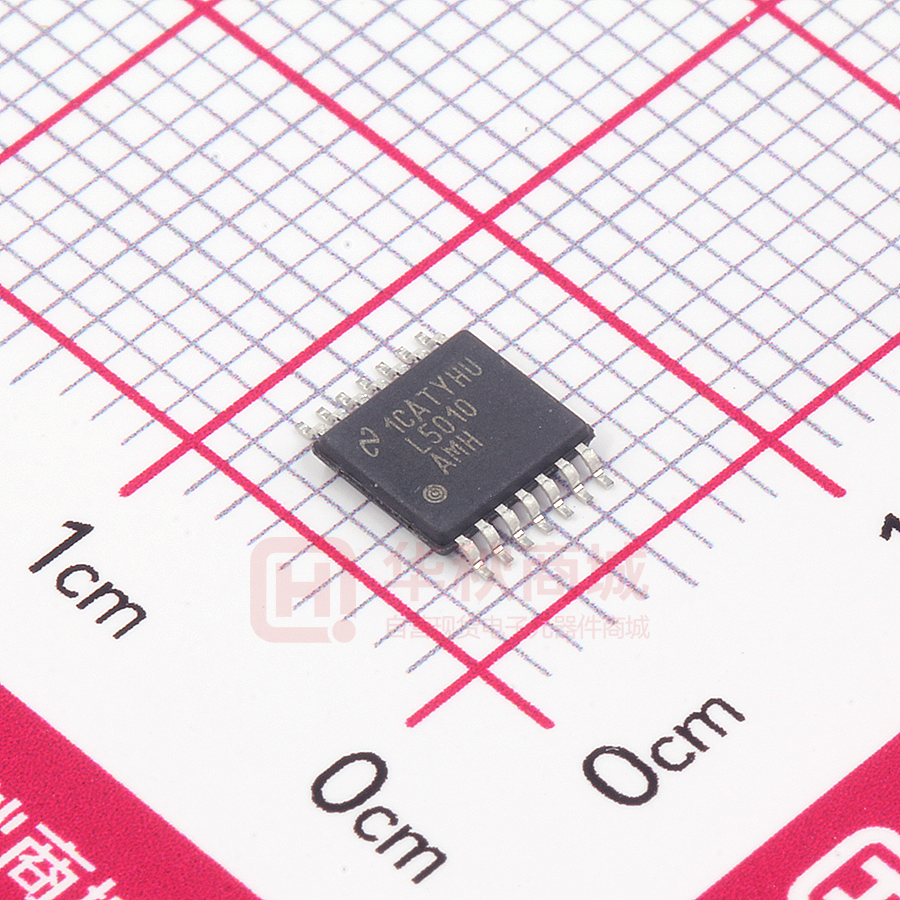

LM5010AMHX/NOPB
LM5010AMHX/NOPB
    BURR-BROWN(德州仪器)
    HTSSOP14_5X4.4MM_EP
    降压型-40℃~+150℃@(TJ)1降压可调2.5V~70V 1A 6V~75V 1MHz HTSSOP14_5X4.4MM_EP DC-DC转换器ROHS
