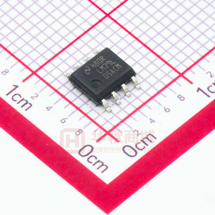

LM79L05AC is OBSOLETE LM79L05, LM79L12, LM79L12AC LM79L15, LM79L15AC www.ti.com SNOSBR8K – JULY 1999 – REVISED APRIL 2013 LM79LXXAC Series 3-Terminal Negative Regulators Check for Samples: LM79L05, LM79L12, LM79L12AC, LM79L15, LM79L15AC FEATURES DESCRIPTION • The LM79LXXAC series of 3-terminal negative voltage regulators features fixed output voltages of −5V, −12V, and −15V with output current capabilities in excess of 100mA. These devices were designed using the latest computer techniques for optimizing the packaged IC thermal/electrical performance. The LM79LXXAC series, when combined with a minimum output capacitor of 0.1μF, exhibits an excellent transient response, a maximum line regulation of 0.07% VO/V, and a maximum load regulation of 0.01% VO/mA. 1 2 • • • • • • • Preset Output Voltage Error is Less than ±5% Over Load, Line and Temperature Specified at an Output Current of 100mA Easily Compensated with a Small 0.1μF Output Capacitor Internal Short-Circuit, Thermal and Safe Operating Area Protection Easily Adjustable to Higher Output Voltages Maximum Line Regulation Less than 0.07% VOUT/V Maximum Load Regulation Less than 0.01% VOUT/mA See AN-1112 (SNVA009) for DSBGA Considerations The LM79LXXAC series also includes, as selfprotection circuitry: safe operating area circuitry for output transistor power dissipation limiting, a temperature independent short circuit current limit for peak output current limiting, and a thermal shutdown circuit to prevent excessive junction temperature. Although designed primarily as fixed voltage regulators, these devices may be combined with simple external circuitry for boosted and/or adjustable voltages and currents. The LM79LXXAC series is available in the 3-lead TO package, the 8-lead SOIC package, and the 6-Bump DSBGA package. For output voltages other than the pre-set -5V, -12V and -15V, the LM137L series provides an adjustable output voltage range from -1.2V to -47V. Typical Applications *Required if the regulator is located far from the power supply filter. A 1μF aluminum electrolytic may be substituted. **Required for stability. A 1μF aluminum electrolytic may be substituted. Figure 1. Fixed Output Regulator −V0 = −5V − (5V/R1 + IQ) • R2, 5V/R1 > 3 IQ Figure 2. Adjustable Output Regulator 1 2 Please be aware that an important notice concerning availability, standard warranty, and use in critical applications of Texas Instruments semiconductor products and disclaimers thereto appears at the end of this data sheet. All trademarks are the property of their respective owners. PRODUCTION DATA information is current as of publication date. Products conform to specifications per the terms of the Texas Instruments standard warranty. Production processing does not necessarily include testing of all parameters. Copyright © 1999–2013, Texas Instruments Incorporated LM79L05AC is OBSOLETE LM79L05, LM79L12, LM79L12AC LM79L15, LM79L15AC SNOSBR8K – JULY 1999 – REVISED APRIL 2013 www.ti.com These devices have limited built-in ESD protection. The leads should be shorted together or the device placed in conductive foam during storage or handling to prevent electrostatic damage to the MOS gates. Connection Diagram 1 -VIN 2 -VIN 3 NC 4 LM79LXXACM -VOUT 8 NC 7 -VIN 6 -VIN 5 GND Pins labeled 'NC' on LM79LXXACM 8-Lead SOIC (pin 4 and pin 8) are Open, no internal connection. Figure 3. 8-Lead SOIC Narrow (D) Top View Figure 4. 3–Lead TO-226 (LP) Bottom View GND -VOUT -VIN A2 B2 C2 A1 B1 C1 GND -VOUT -VIN Figure 5. 6-Bump DSBGA Top View (Bump Side Down) 2 Submit Documentation Feedback Copyright © 1999–2013, Texas Instruments Incorporated Product Folder Links: LM79L05 LM79L12 LM79L12AC LM79L15 LM79L15AC LM79L05AC is OBSOLETE LM79L05, LM79L12, LM79L12AC LM79L15, LM79L15AC www.ti.com SNOSBR8K – JULY 1999 – REVISED APRIL 2013 Absolute Maximum Ratings (1) (2) Input Voltage VO = −5V, −12V, −15V Internal Power Dissipation −35V (3) Internally Limited Operating Temperature Range 0°C to +70°C Maximum Junction Temperature +125°C −55°C to +150°C Storage Temperature Range Lead Temperature (Soldering, 10 sec.) (1) (2) (3) 260°C Absolute Maximum Ratings indicate limits beyond which damage to the device may occur. Operating Ratings indicate conditions for which the device is functional. If Military/Aerospace specified devices are required, please contact the Texas Instruments Sales Office/Distributors for availability and specifications. Thermal resistance of TO-226 (LP) package is 60°C/W θJC, 232°C/W θJA at still air, and 88°C/W at 400 ft/min of air. The θJA of the LM78LXX in the 6-Bump DSBGA package is 114°C/W when mounted on a 4-Layer JEDEC test board (JESD 51-7). The θJA of the LM78LXX in the SOIC-8 (D) package is 180°C/W in still air. The maximum junction temperature shall not exceed 125°C on electrical parameters. Electrical Characteristics (1) TA = 0°C to +70°C unless otherwise noted. −5V Output Voltage −10V Input Voltage (unless otherwise noted) Symbol VO Parameter Output Voltage Conditions Line Regulation Min Typ Max Min Typ Max TJ = 25°C, IO = 100mA −5.2 −5 −4.8 −12.5 −12 −11.5 −15.6 −15 −14.4 1mA ≤ IO ≤ 100mA −5.25 −4.75 −12.6 −11.4 −15.7 5 VMIN ≤ VIN ≤ VMAX (−20 ≤ VIN ≤ −7.5) 1mA ≤ IO ≤ 40mA −5.25 VMIN ≤ VIN ≤ VMAX (−20 ≤ VIN ≤ −7) VMIN ≤ VIN ≤ VMAX −4.75 (−30 ≤ VIN ≤ −18) −12.6 −15.7 5 −11.4 (−27 ≤ VIN ≤ −14.5) (−20 ≤ VIN ≤ −7.3) 60 TJ = 25°C Load Regulation ΔVO Long Term Stability IO = 100mA 20 IQ Quiescent Current IO = 100mA 2 ΔIQ Quiescent Current Change (−30 ≤ VIN ≤ −17.5) 45 (−30 ≤ VIN ≤ −17.7) 45 (−27 ≤ VIN ≤ −14.5) 50 V −14.25 45 (−27 ≤ VIN ≤ −14.6) (−20 ≤ VIN ≤ −7) Units −14.25 (−27 ≤ VIN ≤ −14.8) 60 TJ = 25°C, IO = 40mA 45 (−30 ≤ VIN ≤ −17.5) 100 125 mV V mV V mV 1mA ≤ IO ≤ 100mA 48 6 mV/kh rs 60 2 6 2 6 mA 1mA ≤ IO ≤ 100mA 0.3 0.3 0.3 1mA ≤ IO ≤ 40mA 0.1 0.1 0.1 mA 0.25 mA IO = 100mA VMIN ≤ VIN ≤ VMAX (1) −20V Max ΔVO ΔVIN/ΔVO −17V Typ VMIN ≤ VIN ≤ VMAX Vn −15V Min TJ = 25°C, IO = 100mA ΔVO −12V 0.25 (−20 ≤ VIN ≤ −7.5) 0.25 (−27 ≤ VIN ≤ −14.8) (−30 ≤ VIN ≤ −18) V Output Noise Voltage TJ = 25°C, IO = 100mA f = 10Hz − 10kHz Ripple Rejection TJ = 25°C, IO = 100mA f = 120Hz Input Voltage Required to TJ = 25°C, IO = 100mA −7.3 −14.6 −17.7 V Maintain Line Regulation IO = 40mA −7.0 −14.5 −17.5 V 40 96 50 μV 120 52 50 dB To ensure constant junction temperature, low duty cycle pulse testing is used. Copyright © 1999–2013, Texas Instruments Incorporated Submit Documentation Feedback Product Folder Links: LM79L05 LM79L12 LM79L12AC LM79L15 LM79L15AC 3 LM79L05AC is OBSOLETE LM79L05, LM79L12, LM79L12AC LM79L15, LM79L15AC SNOSBR8K – JULY 1999 – REVISED APRIL 2013 www.ti.com Typical Performance Characteristics 4 Maximum Average Power Dissipation (TO-226) Peak Output Current Figure 6. Figure 7. Short Circuit Output Current Dropout Voltage Figure 8. Figure 9. Ripple Rejection Output Voltage vs. Temperature (Normalized to 1V @ 25°C) Figure 10. Figure 11. Submit Documentation Feedback Copyright © 1999–2013, Texas Instruments Incorporated Product Folder Links: LM79L05 LM79L12 LM79L12AC LM79L15 LM79L15AC LM79L05AC is OBSOLETE LM79L05, LM79L12, LM79L12AC LM79L15, LM79L15AC www.ti.com SNOSBR8K – JULY 1999 – REVISED APRIL 2013 Typical Performance Characteristics (continued) Quiescent Current Output Impedance Figure 12. Figure 13. Copyright © 1999–2013, Texas Instruments Incorporated Submit Documentation Feedback Product Folder Links: LM79L05 LM79L12 LM79L12AC LM79L15 LM79L15AC 5 LM79L05AC is OBSOLETE LM79L05, LM79L12, LM79L12AC LM79L15, LM79L15AC SNOSBR8K – JULY 1999 – REVISED APRIL 2013 www.ti.com TYPICAL APPLICATIONS Figure 14. ±15V, 100mA Dual Power Supply Schematic Diagrams Figure 15. −5V Schematic Diagram 6 Submit Documentation Feedback Copyright © 1999–2013, Texas Instruments Incorporated Product Folder Links: LM79L05 LM79L12 LM79L12AC LM79L15 LM79L15AC LM79L05AC is OBSOLETE LM79L05, LM79L12, LM79L12AC LM79L15, LM79L15AC www.ti.com SNOSBR8K – JULY 1999 – REVISED APRIL 2013 Figure 16. −12V and −15V Schematic Diagram Copyright © 1999–2013, Texas Instruments Incorporated Submit Documentation Feedback Product Folder Links: LM79L05 LM79L12 LM79L12AC LM79L15 LM79L15AC 7 LM79L05AC is OBSOLETE LM79L05, LM79L12, LM79L12AC LM79L15, LM79L15AC SNOSBR8K – JULY 1999 – REVISED APRIL 2013 www.ti.com REVISION HISTORY Changes from Revision J (April 2013) to Revision K • 8 Page Changed layout of National Data Sheet to TI format ............................................................................................................ 7 Submit Documentation Feedback Copyright © 1999–2013, Texas Instruments Incorporated Product Folder Links: LM79L05 LM79L12 LM79L12AC LM79L15 LM79L15AC PACKAGE OPTION ADDENDUM www.ti.com 14-May-2022 PACKAGING INFORMATION Orderable Device Status (1) Package Type Package Pins Package Drawing Qty Eco Plan (2) Lead finish/ Ball material MSL Peak Temp Op Temp (°C) Device Marking (3) Samples (4/5) (6) LM79L05ACM NRND SOIC D 8 95 Non-RoHS & Green Call TI Level-1-235C-UNLIM 0 to 70 LM79L 05ACM LM79L05ACM/NOPB ACTIVE SOIC D 8 95 RoHS & Green SN Level-1-260C-UNLIM 0 to 70 LM79L 05ACM Samples LM79L05ACMX/NOPB ACTIVE SOIC D 8 2500 RoHS & Green SN Level-1-260C-UNLIM 0 to 70 LM79L 05ACM Samples LM79L05ACTL/NOPB ACTIVE DSBGA YZR 6 250 RoHS & Green SNAGCU Level-1-260C-UNLIM 0 to 70 P B Samples LM79L05ACTLX/NOPB ACTIVE DSBGA YZR 6 3000 RoHS & Green SNAGCU Level-1-260C-UNLIM 0 to 70 P B Samples LM79L05ACZ/LFT1 ACTIVE TO-92 LP 3 2000 RoHS & Green SN N / A for Pkg Type 320L 79L05 Samples LM79L05ACZ/NOPB ACTIVE TO-92 LP 3 1800 RoHS & Green SN N / A for Pkg Type 0 to 70 320L 79L05 Samples LM79L12ACM NRND SOIC D 8 95 Non-RoHS & Green Call TI Level-1-235C-UNLIM 0 to 70 LM79L 12ACM LM79L12ACM/NOPB ACTIVE SOIC D 8 95 RoHS & Green SN Level-1-260C-UNLIM 0 to 70 LM79L 12ACM Samples LM79L12ACMX/NOPB ACTIVE SOIC D 8 2500 RoHS & Green SN Level-1-260C-UNLIM 0 to 70 LM79L 12ACM Samples LM79L12ACZ/LFT4 ACTIVE TO-92 LP 3 2000 RoHS & Green SN N / A for Pkg Type 320L 79L12 Samples LM79L12ACZ/NOPB ACTIVE TO-92 LP 3 1800 RoHS & Green SN N / A for Pkg Type 0 to 70 320L 79L12 Samples LM79L15ACM NRND SOIC D 8 95 Non-RoHS & Green Call TI Level-1-235C-UNLIM 0 to 70 LM79L 15ACM LM79L15ACM/NOPB ACTIVE SOIC D 8 95 RoHS & Green SN Level-1-260C-UNLIM 0 to 70 LM79L 15ACM Samples LM79L15ACMX/NOPB ACTIVE SOIC D 8 2500 RoHS & Green SN Level-1-260C-UNLIM 0 to 70 LM79L 15ACM Samples (1) The marketing status values are defined as follows: ACTIVE: Product device recommended for new designs. LIFEBUY: TI has announced that the device will be discontinued, and a lifetime-buy period is in effect. Addendum-Page 1 PACKAGE OPTION ADDENDUM www.ti.com 14-May-2022 NRND: Not recommended for new designs. Device is in production to support existing customers, but TI does not recommend using this part in a new design. PREVIEW: Device has been announced but is not in production. Samples may or may not be available. OBSOLETE: TI has discontinued the production of the device. (2) RoHS: TI defines "RoHS" to mean semiconductor products that are compliant with the current EU RoHS requirements for all 10 RoHS substances, including the requirement that RoHS substance do not exceed 0.1% by weight in homogeneous materials. Where designed to be soldered at high temperatures, "RoHS" products are suitable for use in specified lead-free processes. TI may reference these types of products as "Pb-Free". RoHS Exempt: TI defines "RoHS Exempt" to mean products that contain lead but are compliant with EU RoHS pursuant to a specific EU RoHS exemption. Green: TI defines "Green" to mean the content of Chlorine (Cl) and Bromine (Br) based flame retardants meet JS709B low halogen requirements of
LM79L05ACMX/NOPB
物料型号:LM79L05AC, LM79L12, LM79L12AC, LM79L15, LM79L15AC
器件简介: - LM79LXXAC系列是3端负电压稳压器,提供-5V, -12V, 和 -15V的固定输出电压。 - 设计用于超过100mA的输出电流能力。 - 采用最新的计算机技术优化了封装IC的热/电性能。
引脚分配: - 3端子包括输入电压(-VIN)、输出电压(-VOUT)和地(GND)。 - 8引脚SOIC封装中,第4和第8引脚标为NC(无内部连接)。
参数特性: - 预设输出电压误差小于±5%,涵盖负载、线路和温度变化。 - 内部短路、热和安全工作区保护。 - 易于通过外部电路调整到更高的输出电压。
功能详解: - 设备具有优异的瞬态响应和低至0.07% VOUT/V的最大线路调节以及0.01% VOUT/mA的最大负载调节。 - 设计了限流保护、热关闭电路以防止结温过高。
应用信息: - 主要设计为固定电压稳压器,但可以与简单的外部电路组合使用,以提供增强和/或可调的电压和电流。 - 适用于需要固定负电压输出的场合。
封装信息: - 提供3引脚TO封装、8引脚SOIC封装和6球DSBGA封装。
绝对最大额定值: - 输入电压:-35V(对于Vo = -5V, -12V, -15V) - 内部功耗:内部限制 - 工作温度范围:0°C至+70°C - 最大结温:+125°C - 存储温度范围:-55°C至+150°C - 引脚温度(焊接,10秒):260°C
电气特性: - 输出电压:在25°C、100mA负载时,-5V型号的输出电压范围为-5.2V至-4.8V,-12V型号为-12.5V至-11.5V,-15V型号为-15.6V至-14.4V。 - 线路调节:在25°C、100mA负载时,-5V型号的线路调节小于60mV,-12V型号小于45mV,-15V型号小于45mV。
