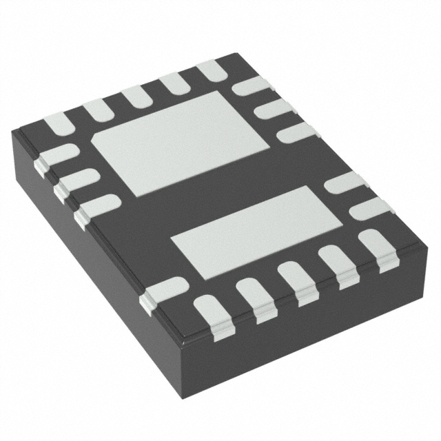

Product Folder Order Now Support & Community Tools & Software Technical Documents LMG1210 SNOSD12D – NOVEMBER 2018 – REVISED JANUARY 2019 LMG1210 200-V, 1.5-A, 3-A half-bridge MOSFET and GaN FET driver with adjustable dead time for applications up to 50 MHz 1 Features 3 Description • • • • • The LMG1210 is a 200-V, half-bridge MOSFET and Gallium Nitride Field Effect Transistor (GaN FET) driver designed for ultra-high frequency, highefficiency applications that features adjustable deadtime capability, very small propagation delay, and 3.4-ns high-side low-side matching to optimize system efficiency. This part also features an internal LDO which ensures a gate-drive voltage of 5-V regardless of supply voltage. 1 • • • • • • • Up to 50-MHz operation 10-ns typical propagation delay 3.4-ns high-side to low-side matching Minimum pulse width of 4 ns Two control input options – Single PWM input with adjustable dead time – Independent input mode 1.5-A peak source and 3-A peak sink currents External bootstrap diode for flexibility Internal LDO for adaptability to voltage rails High 300-V/ns CMTI HO to LO capacitance less than 1 pF UVLO and overtemperature protection Low-inductance WQFN package To enable best performance in a variety of applications, the LMG1210 allows the designer to choose the optimal bootstrap diode to charge the high-side bootstrap capacitor. An internal switch turns the bootstrap diode off when the low side is off, effectively preventing the high-side bootstrap from overcharging and minimizing the reverse recovery charge. Additional parasitic capacitance across the GaN FET is minimized to less than 1 pF to reduce additional switching losses. 2 Applications • • • • • The LMG1210 features two control input modes: Independent Input Mode (IIM) and PWM mode. In IIM each of the outputs is independently controlled by a dedicated input. In PWM mode the two complementary output signals are generated from a single input and the user can adjust the dead time from 0 to 20 ns for each edge. The LMG1210 operates over a wide temperature range from –40°C to 125°C and is offered in a low-inductance WQFN package. High-speed DC-DC converters RF envelope tracking Class-D audio amplifiers Class-E wireless charging High-precision motor control Device Information(1) PART NUMBER PACKAGE LMG1210 WQFN (19) BODY SIZE (NOM) 3.00 mm × 4.00 mm (1) For all available packages, see the orderable addendum at the end of the data sheet. Simplified Typical Application BST 200 V HB 6 ± 18 V VIN HO LDO HS UVLO OTP EN PWM EN PWM VDD Dead Time DHL Delay Match 5V LO VSS DLH 1 An IMPORTANT NOTICE at the end of this data sheet addresses availability, warranty, changes, use in safety-critical applications, intellectual property matters and other important disclaimers. PRODUCTION DATA. LMG1210 SNOSD12D – NOVEMBER 2018 – REVISED JANUARY 2019 www.ti.com Table of Contents 1 2 3 4 5 6 Features .................................................................. Applications ........................................................... Description ............................................................. Revision History..................................................... Pin Configuration and Functions ......................... Specifications......................................................... 6.1 6.2 6.3 6.4 6.5 6.6 6.7 6.8 7 1 1 1 2 3 4 Absolute Maximum Ratings ...................................... 4 ESD Ratings ............................................................ 4 Recommended Operating Conditions....................... 4 Thermal Information ................................................. 5 Electrical Characteristics........................................... 5 Switching Characteristics .......................................... 7 Typical Characteristics .............................................. 8 Timing Diagrams ..................................................... 10 Detailed Description ............................................ 11 7.1 Overview ................................................................. 11 7.2 Functional Block Diagram ....................................... 11 7.3 Feature Description................................................. 11 4 7.4 Device Functional Modes........................................ 15 8 Application and Implementation ........................ 16 8.1 Application Information............................................ 16 8.2 Typical Application ................................................. 16 8.3 Do's and Don'ts ...................................................... 20 9 Power Supply Recommendations...................... 20 10 Layout................................................................... 21 10.1 Layout Guidelines ................................................. 21 10.2 Layout Example .................................................... 21 11 Device and Documentation Support ................. 22 11.1 11.2 11.3 11.4 11.5 11.6 22 22 22 22 22 22 12 Mechanical, Packaging, and Orderable Information ........................................................... 22 Revision History Changes from Revision C (December 2018) to Revision D • Documentation Support ....................................... Receiving Notification of Documentation Updates Community Resources.......................................... Trademarks ........................................................... Electrostatic Discharge Caution ............................ Glossary ................................................................ Page Changed Maximum High-side dynamic current from 0.61mA/MHz to 0.7mA/MHz .............................................................. 5 Changes from Revision B (November 2018) to Revision C Page • Changed mismatch from 2.5 ns to 3.4 ns ............................................................................................................................. 1 • Changed minimum pulse width from 3 ns to 4 ns ................................................................................................................. 1 • Changed Reordered Pin Functions table in alphabetical order.............................................................................................. 3 • Added Figure 14 IIM Timing Diagram ................................................................................................................................. 10 • Added CMTI performance reference app note..................................................................................................................... 13 • Added charge per cycle removed from the bootstrap due to dynamic high side current .................................................... 17 • Added Power Consumption Calculation reference app note ............................................................................................... 19 Changes from Revision A (May 2018) to Revision B • 2 Page Changed marketing status from Product Preview to final. Initial release. .............................................................................. 1 Submit Documentation Feedback Copyright © 2018–2019, Texas Instruments Incorporated Product Folder Links: LMG1210 LMG1210 www.ti.com SNOSD12D – NOVEMBER 2018 – REVISED JANUARY 2019 5 Pin Configuration and Functions HS NC NC1 HS HB NC RVR Package 19-Pin WQFN Top View 15 14 13 12 11 (HS) 16 BST 17 EN/HI 18 PWM/LI 19 Thermal Pad 10 HO 9 HS 8 LO 7 VSS 6 DLH (VSS) 3 4 VDD 5 DHL 2 VSS NC 1 VIN Thermal Pad Pin Functions PIN NAME BST NO. I/O DESCRIPTION 17 O Bootstrap diode anode connection point. 5 I Sets the dead time for a high-to-low transition in PWM mode by connecting a resistor to VSS. If using IIM this pin can be left floating, tied to GND, tied to VDD. 6 I Sets the dead time for a low-to-high transition in PWM mode by connecting a resistor to VSS. Tie to VDD to select IIM. 18 I Enable input or high-side driver control. In PWM mode this is the EN pin. In IIM mode this is the HI pin. 19 I PWM input or low-side driver control. In PWM mode this is the PWM pin. In IIM mode this is the LI pin. 12 I High-side driver supply. Bootstrap diode cathode connection point. HO 10 O High-side driver output. HS 9,13,16 I Switch node and high-side driver ground. These pins are internally connected. LO 8 O Low-side driver output. NC 1,11,15 — Not internally connected. NC1 14 I Thermal Pad (HS) 21 I Thermal Pad (VSS) 20 I VDD 4 O Low-side driver supply and LDO output. 5 V 6 V to 18 V input to LDO. If LDO is not required, connect to VDD. DHL DLH EN/HI PWM/LI HB VIN 2 I VSS 3,7 — For proper operation, this pin should be either unconnected or tied to HS. Connected to HS. Connected to VSS. Low-side ground return: all low-side signals are referenced to this ground. Submit Documentation Feedback Copyright © 2018–2019, Texas Instruments Incorporated Product Folder Links: LMG1210 3 LMG1210 SNOSD12D – NOVEMBER 2018 – REVISED JANUARY 2019 www.ti.com 6 Specifications 6.1 Absolute Maximum Ratings Over operating free-air temperature range (unless otherwise noted) (1) MIN MAX -0.5 20 V -0.5 5.5 V -300 300 V 5.5 V -0.5 10 V -0.5 VDD + 0.5 V Low-side gate driver output -0.5 VDD + 0.5 V VHO High-side gate driver output VHS-0.5 VHB+ 0.5 V VBST Bootstrap pin voltage -0.5 VDD + 0.5 V TJ Operating Junction Temperature Range -40 150 °C TSTG Storage Temperature -55 150 °C VIN Input Supply Voltage VDD 5V Supply Voltage VHS High Side Voltage Without Bootstrap Diode VHB-VHS Bootstrap supply voltage, continuous -0.5 VLI/PWM, VHI/EN Input Pin Voltage on LI or HI VDHL, VDHL Voltage on DLH and DHL pins VLO (1) UNIT Stresses beyond those listed under Absolute Maximum Ratings may cause permanent damage to the device. These are stress ratings only, which do not imply functional operation of the device at these or any other conditions beyond those indicated under Recommended Operating Conditions. Exposure to absolute-maximum-rated conditions for extended periods may affect device reliability. 6.2 ESD Ratings VALUE V(ESD) (1) (2) Electrostatic discharge Human-body model (HBM), per ANSI/ESDA/JEDEC JS-001 (1) ±2000 Charged-device model (CDM), per JEDEC specification JESD22C101 (2) ±500 UNIT V JEDEC document JEP155 states that 500-V HBM allows safe manufacturing with a standard ESD control process. Manufacturing with less than 500-V HBM is possible with the necessary precautions. Pins listed as ±XXX V may actually have higher performance. JEDEC document JEP157 states that 250-V CDM allows safe manufacturing with a standard ESD control process. Manufacturing with less than 250-V CDM is possible with the necessary precautions. Pins listed as ±YYY V may actually have higher performance. 6.3 Recommended Operating Conditions over operating free-air temperature range (unless otherwise noted) MIN VIN Input Supply Voltage (if using internal LDO) VDD 5V Supply Voltage (if bypassing internal LDO) 4.75 VHS-VSS High-Side Voltage Without Bootstrap diode (1) VHB-VHS VLI,VHI NOM MAX UNIT 18 V 5.25 V -200 200 V Bootstrap Supply Voltage 3.80 5.25 V Input Pin Voltage -0.3 10 V TJ Operating Junction Temperature Range -40 125 °C CMTI High Side Slew Rate 300 V/ns RDHL, RDLH Dead Time Adjustment External Resistance 20 1800 kΩ VDT Dead Time Voltage Range 0.8 1.8 (1) 4 6 5.00 V If using a bootstrap diode, actual negative HS pin voltage may be more limited, see Section 7.3.6 for details. Submit Documentation Feedback Copyright © 2018–2019, Texas Instruments Incorporated Product Folder Links: LMG1210 LMG1210 www.ti.com SNOSD12D – NOVEMBER 2018 – REVISED JANUARY 2019 6.4 Thermal Information LMG1210 THERMAL METRIC (1) RVR (QFN) UNIT 19 PINS RθJA Junction-to-ambient thermal resistance RθJC(top) Junction-to-case (top) thermal resistance RθJB Junction-to-board thermal resistance ψJT Junction-to-top characterization parameter 2.9 °C/W ψJB Junction-to-board characterization parameter 16.4 °C/W (1) 40.5 °C/W 40 °C/W 16.2 °C/W For more information about traditional and new thermal metrics, see the Semiconductor and IC Package Thermal Metrics application report. 6.5 Electrical Characteristics VDD=5V, HB-HS=4.6V, outputs unloaded over operating junction temperature range (unless otherwise noted) PARAMETER TEST CONDITIONS MIN TYP MAX UNIT SUPPLY CURRENT Quiescent Current for Low-Side Circuits Only, Vin=6V, powered through LDO LI, HI=0V, Independent Mode 300 475 μA IDD EN=0V, PWM=X, PWM Input Mode, RDHL and RDLH = 1.78MΩ 380 550 μA IHB HB Quiescent Current HI=0V, Independent Mode 520 850 μA IHBS HB to VSS Quiescent Current VHS=100V 1 IHBSO HB to VSS Operating Current VHS=100V, FSW=1MHz 1 ILSDyn Low-side dynamic current Unloaded, PWM Mode 1 1.25 mA/MHz IHSDyn High-side dynamic current Unloaded 0.5 0.7 mA/MHz nA nA LOW-SIDE TO HIGH-SIDE CAPACITANCE Capacitance from High to Low Side Low Side Pins Shorted Together, High Side Pins Shorted Together V5V LDO Output VIN=10V VDO Dropout Voltage IO=100mA ILDOM Maximum Current VIN=12V 100 ISC Short Circuit Current VIN=12V 105 COUT Minimum Required Output Capacitance (1) Effective Capacitance at Bias Voltage CISO 0.25 pF 5V LDO 4.75 5.00 5.25 V 400 750 mV mA 250 mA 0.3 µF DIGITAL INPUT PINS (LI/PWM & HI/EN) VIR Input Rising Edge Threshold 1.70 2.45 V VIF Input Falling Edge Threshold 0.70 1.30 V VIHYS Input Hysteresis RIPD Input Pull-Down Resistance 1 VLI, VHI=1V V 100 200 300 kΩ V UNDERVOLTAGE LOCKOUT VDDR VDD Rising Threshold 4.00 4.25 4.50 VDDF VDD Falling Threshold 3.8 4.05 4.3 VDDH VDD Hysteresis VHBR HB-HS Rising Threshold 3.40 3.55 3.8 VHBF HB-HS Falling Threshold 3.30 3.45 3.65 VHBH HB-HS Hysteresis 200 V mV V V 130 mV 0.4 Ω BOOTSTRAP DIODE SWITCH RSW Diode Switch On Resistance ID=100mA GATE DRIVER VOL (1) Low-Level Output Voltage IOL=100mA 0.16 V Ensured by design Submit Documentation Feedback Copyright © 2018–2019, Texas Instruments Incorporated Product Folder Links: LMG1210 5 LMG1210 SNOSD12D – NOVEMBER 2018 – REVISED JANUARY 2019 www.ti.com Electrical Characteristics (continued) VDD=5V, HB-HS=4.6V, outputs unloaded over operating junction temperature range (unless otherwise noted) PARAMETER TEST CONDITIONS MIN TYP MAX UNIT VDD-VOH High-Level Output Voltage IOH= -100mA 0.30 V IOL Peak Sink Current VLO,VHO=5V 2.0 3.1 4.3 A IOH Peak Source Current VLO,VHO=0V 0.85 1.58 2.4 A VCLAMP Unpowered Gate Clamp Voltage VDD, VHB Floating, 1 mA pull-up applied to LO/HO 0.55 0.8 V THERMAL SHUTDOWN TSD Thermal Shutdown Switching, Rising Edge (2) 150 °C TSD_LDO Thermal Shut Down LDO, Rising Edge (2) 160 °C THYS_SD Thermal Hysteresis, LDO & Switching (2) TSD_HS Thermal Shutdown for High-Side, Rising Edge (2) 3 10 °C 160 °C DEADTIME CONTROL RESISTORS RPU (2) 6 Internal Pullup Resistor 23.5 25 27 kΩ Ensured by design Submit Documentation Feedback Copyright © 2018–2019, Texas Instruments Incorporated Product Folder Links: LMG1210 LMG1210 www.ti.com SNOSD12D – NOVEMBER 2018 – REVISED JANUARY 2019 6.6 Switching Characteristics VDD=5V, VHB-HS=4.6V, outputs unloaded over operating junction temperature range (unless otherwise noted) PARAMETER TEST CONDITIONS MIN TYP MAX UNIT INDEPENDENT INPUT MODE tPHL Turn-Off Delay 10 18 ns tPLH Turn-On Delay 10 18 ns tMTCH High-Off to Low-On and Low-Off to High-On Delay Mismatch 1 3.4 ns 11 21 ns -0.55 0.8 3.1 ns 16 20 26 ns 11 20 ns Over temperature, TjHI=TjLO PWM INPUT MODE tPHL Turn-Off Delay PWM rising to LO falling and PWM falling to HO falling tDEAD_MIN Minimum Dead Time Rext=1.78 MΩ tDEAD_MAX Maximum Dead Time Rext=20 kΩ tEN Enable Propagation Time OTHER CHARACTERISTICS tOR Output Rise Time, Unloaded 10%-90% 0.5 ns tOF Output Fall Time, Unloaded 90%-10% 0.5 ns tORL Output Rise Time, Loaded CO=1nF, 10%-90% 3.5 5.6 ns tOFL Output Fall Time, Loaded CO=1nF, 90%-10% 2.3 3.3 ns tPW Minimum Input Pulse Width (1) Minimum input pulse width which changes the output 1.8 4.0 ns tPW,ext H-L-H Pulse extender width (1) Unloaded (2) 4.5 10 ns tSTLS Start-Up Time of low side after VDD- Independent Control Mode GND goes over UVLO threshold. PWM Control Mode 25 60 µs 100 150 µs tSTHS Start-Up Time of High-Side After VHB-VHS Goes Above UVLO 16 28 µs tPWD Pulse-Width Distortion 1 3 ns (1) (2) |tPLH-tPHL|, Independent Input Mode Ensured by design Pulses longer than tPW, but shorter than tPW,ext get extended to tPW,ext Submit Documentation Feedback Copyright © 2018–2019, Texas Instruments Incorporated Product Folder Links: LMG1210 7 LMG1210 SNOSD12D – NOVEMBER 2018 – REVISED JANUARY 2019 www.ti.com 6.7 Typical Characteristics 1.75 4 1.5 3.5 3 Current (A) Current (A) 1.25 1 0.75 0.5 2.5 2 1.5 1 0.25 0.5 0 0 0 0.5 1 1.5 2 2.5 3 LO, HO (V) 3.5 4 4.5 5 0 Figure 1. Peak Source Current vs Output Voltage 2 2.5 3 LO, HO (V) 3.5 4 4.5 5 D002 -40 qC 25 qC 125 qC 24 IHBO (mA) IDD (mA) 1.5 30 -40 qC 25 qC 125 qC 30 20 18 12 6 10 0 0.05 1 Figure 2. Peak Sink Current vs Output Voltage 50 40 0.5 D001 0.1 0.2 0.3 0.5 1 2 3 4 5 67 10 Frequency (MHz) 0 0.05 20 30 50 0.1 0.2 0.3 0.5 1 2 3 4 5 67 10 Frequency (MHz) D003 Figure 3. IDD vs Frequency, Unloaded 20 30 50 D004 Figure 4. IHBO vs Frequency, Unloaded 315 700 310 305 650 295 IHB (PA) IDD (PA) 300 290 285 600 550 280 275 500 270 265 -40 -20 0 20 40 60 80 100 Temperature (qC) 120 140 160 450 -40 -20 D005 Figure 5. IDD vs Temperature 8 0 20 40 60 80 100 Temperature (qC) 120 140 160 D006 Figure 6. IHB vs Temperature Submit Documentation Feedback Copyright © 2018–2019, Texas Instruments Incorporated Product Folder Links: LMG1210 LMG1210 www.ti.com SNOSD12D – NOVEMBER 2018 – REVISED JANUARY 2019 Typical Characteristics (continued) 1.1 13 DHL DLH Minimum Dead Time (ns) Propagation Delay (ns) 1 12 11 10 9 -40 Low Side TPLH Low Side TPHL High Side TPLH High Side TPHL -20 0 20 40 60 80 Temperature (qC) 100 120 0.9 0.8 0.7 0.6 0.5 0.4 -40 140 Figure 7. Propagation Delay vs Temperature 20 40 60 80 Temperature (qC) 100 120 140 D008 12 0.7 50 V/ns 100 V/ns 300 V/ns 11.6 0.6 Propagation Delay (ns) Propagation Delay Change (ns) 0 Figure 8. Minimum Dead Time vs Temperature 0.8 0.5 0.4 0.3 0.2 0.1 11.2 10.8 10.4 10 0 9.6 -0.1 -0.2 3.5 3.75 4 4.25 4.5 4.75 Bootstrap Voltage (V) 5 5.25 9.2 -20 5.5 -15 D009 -10 -5 0 5 10 Phase of CMTI Relative to Signal (ns) 15 20 D010 Figure 10. Propagation Delay vs relative phase of CMTI Phase Figure 9. Propagation Delay Change vs Bootstrap voltage 4.5 4.5 LO Sink LO Source HO Sink HO Source 4 3.5 HO Rise Time LO Rise Time LO Fall Time HO Fall Time 4 Rise/Fall Time (ns) Ouput Current (A) -20 D007 3 2.5 2 3.5 3 2.5 1.5 1 -40 -20 0 20 40 60 80 Temperature (qC) 100 120 140 2 -40 -20 D011 Figure 11. LO and HO Output Current vs Temperature 0 20 40 60 80 Temperature (qC) 100 120 140 D012 Figure 12. 1 nF Loaded Rise and Fall Time vs Temperature Submit Documentation Feedback Copyright © 2018–2019, Texas Instruments Incorporated Product Folder Links: LMG1210 9 LMG1210 SNOSD12D – NOVEMBER 2018 – REVISED JANUARY 2019 www.ti.com 6.8 Timing Diagrams TPHL TPLH TOR TOF 50% PWM TON 90% 50% HO 10% TDLH TDHL LO Figure 13. Timing diagram of LMG1210 in PWM mode under no load condition HI LI HO LO tPHL tPLH tMTCH tPHL tMTCH tPWD = |tPLH t tPHL| tPHL Figure 14. Timing diagram of LMG1210 in IIM mode under no load condition 10 Submit Documentation Feedback Copyright © 2018–2019, Texas Instruments Incorporated Product Folder Links: LMG1210 LMG1210 www.ti.com SNOSD12D – NOVEMBER 2018 – REVISED JANUARY 2019 7 Detailed Description 7.1 Overview The LMG1210 is a high-speed half-bridge driver specifically designed to work with enhancement mode GaN FETs. Designed to operate up to 50 MHz, the LMG1210 is optimized for maximum performance and highly efficient operation. This includes reducing additional capacitance at the switch node (HS) to less than 1 pF and increased dV/dt noise immunity up to 300 V/ns on the HS pin to minimize additional switching losses. By having a 21 ns maximum propagation delay with 3.4 ns maximum mismatch, excessive dead times can be greatly reduced. Auxiliary input voltages applied above 5 V enables an internal LDO to precisely regulate the output voltage at 5V, preventing damage on the gate. An external bootstrap diode allows the designer to select an optimal diode. An integrated switch in series with the bootstrap diode stops overcharging of the bootstrap capacitor and decreases Qrr losses in the diode. The LMG1210 comes in a low-inductance WQFN package designed for small gate drive loops with minimal voltage overshoot. 7.2 Functional Block Diagram BST HB VIN LDO HO HS EN VDD Dead Time PWM Delay Match LO VSS 1.8 V 1.8 V UVLO OTP DHL DLH 7.3 Feature Description The LMG1210 provides numerous features optimized for driving external GaN FETs. 7.3.1 Bootstrap Diode Operation An internal low impedance switch enables the bootstrap only when the low-side GaN FET is on. If used in a converter where the low-side FET operates in third quadrant conduction during the dead times, this provides two main benefits. First, it stops the bootstrap diode from overcharging the high-side bootstrap rail. Second, if using a p-n junction diode with Qrr as the bootstrap diode, it decreases the Qrr losses of the diode. There is a 1 kΩ resistor connected between the drain and source of this internal bootstrap switch to allow the bootstrap capacitor to slowly charge at start-up before the low-side FET is turned on. Submit Documentation Feedback Copyright © 2018–2019, Texas Instruments Incorporated Product Folder Links: LMG1210 11 LMG1210 SNOSD12D – NOVEMBER 2018 – REVISED JANUARY 2019 www.ti.com Feature Description (continued) The part does not have an actual clamp on the high-side bootstrap supply. The bootstrap switch disables conduction during the dead times, and the actual bootstrap capacitor voltage is set by the operating conditions of the circuit during the low-side on-time. The bootstrap voltage can be approximately calculated in Equation 1 through Equation 3. The bootstrap voltage is given by Equation 1: VBST = VDD – VF – VHS where • VF is the forward voltage drop of the bootstrap diode and series bootstrap switch. (1) VHS is calculated in Equation 2: VHS = –IL × RDSON where • • IL is the inductor current defined as flowing out of the half-bridge and RDSON is the FET on resistance. (2) Substituting (2) into (1) gives the expression for the bootstrap voltage as Equation 3: VBST = VDD – VF + IL × RDSON (3) From (3) one can determine that in an application where the current flows out of the half-bridge (IL is positive) the bootstrap voltage can be charged up to a voltage higher than VDD if IL × RDSON is greater than VF. Take care not to overcharge the bootstrap too much in this application by choosing a diode with a larger VF or limiting the IL × RDSON product. In an application where IL is negative, the IL × RDSON product subtracts from the available bootstrap cap voltage. In this case using a smaller VF diode is recommended if IL × RDSON is large. 7.3.2 LDO Operation An internal LDO allows the driver to run off higher voltages from 6 V to 18 V and regulates the supply to 5 V, so the LMG1210 can run off of higher input voltages with wide tolerances. To maintain stability of the internal LDO, care must be taken to make sure a capacitor of at least 0.3 µF from VDD to VSS with an ESR below 500 mΩ is used. A high-quality ceramic capacitor with an X7R dielectric is recommended. There is no maximum limit on the capacitance allowed on the output of the LDO. If the input supply is already 5 V ±5%, then the LDO can be bypassed. This is achieved by connecting the 5 V supply directly to the VDD pin. The VIN pin should be tied to the VDD pin, and the capacitor on the VIN pin can be removed. Do not ground the VIN pin. 12 Submit Documentation Feedback Copyright © 2018–2019, Texas Instruments Incorporated Product Folder Links: LMG1210 LMG1210 www.ti.com SNOSD12D – NOVEMBER 2018 – REVISED JANUARY 2019 Feature Description (continued) 7.3.3 Dead Time Selection In PWM mode the dead time can be set with a resistor placed between DHL/DLH and VSS. For a desired dead time (tdt), the corresponding required resistance can be calculated in Equation 4 with tdt in ns and Rext in kΩ. Rext = (900/tdt ) – 25 (4) The maximum dead time is 20 ns, which gives a minimum resistor value of 20 kΩ. The minimum dead time is 0.5ns, which gives a maximum resistor value of 1.8 MΩ. There is an internal pull-up resistor at DHL/DLH pin, which forms a voltage divider with the external resistor. This voltage decides the final dead time. The calculation between dead time tDT in ns and VDT is shown in Equation 5. tdt = (1.8-VDT ) x20 (5) Before being used to generate the dead times, the voltages on the DHL and DLH pins are first filtered through an internal RC filter with a nominal corner frequency of 10 kHz to attenuate switching noise. The pulse widths of the HO and LO outputs are decreased from the PWM input by the chosen dead-times. The timing diagram under no load condition is shown in Figure 13 and Figure 14. PWM mode and Independent mode configurations can be found in Figure 16 . 7.3.4 Overtemperature Protection The LMG1210 has three separate overtemperature thresholds: two on the low-side and one on the high-side. The lowest overtemperature threshold is the low-side switching threshold at 150 degrees minimum. When exceeded, this disables switching on both the low and high sides. However, the 5 V LDO continues to operate. If the low-side temperature continues to rise, due to a short or external load on the 5 V LDO, then at 10 degrees higher, the low-side shuts down the 5 V LDO. The high-side has an independent overtemperature threshold at 160 minimum. When triggered, it only shuts off the high-side while the low-side may continue to operate. If it is undesirable in an application to have only the high side shut off and not the low side, TI recommends designing the thermal cooling of the board in a way to make the low-side die hotter. This can be achieved by controlling the size of the thermal planes connected to each thermal pad. 7.3.5 High-Performance Level Shifter The LMG1210 uses a high-performance level shifter to translate the signal from the low side to the high side. The level shifter is built using TI's proprietary high-voltage capacitor technology, which showcases best-in-class CMTI (common-mode transient immunity), or dV/dt on the HS pin. The level shifter can handle very high CMT (common-mode transient) rates while simultaneously providing low propagation time which does not vary depending on CMT rate. For more information on LMG1210 CMTI performance refer to section 2.4 from Design Considerations for LMG1205 Advanced GaN FET Driver During High-Frequency Operation. 7.3.6 Negative HS Voltage Handling The LMG1210 by itself can operate with -200V on the HS pin as stated in the recommended operating conditions table. However, if using a bootstrap diode, the system will be more limited based on the potential of high-currents flowing through the bootstrap diode. HS goes most negative during the dead times when the low-side FET is off. This also means the bootstrap switch is off so the BST pin is relatively high impedance. Therefore as HS goes negative, the bootstrap diode becomes forward biased and pulls the voltage at BST down with it. Because the bootstrap switch is off, very little current will flow until the bootstrap diode attempts to pull the BST pin below ground at which point the ESD diode on the BST pin will clamp the voltage at a diode drop below ground. The point where significant current begins to flow through the bootstrap diode is given in Equation 6 VHS = – VBST – VESD – (VHB – VHS) (6) Where VBST is the forward voltage drop of the selected bootstrap diode and VESD is the forward voltage drop of the ESD diode of the BST pin which is typically 0.7V at room temp. Figure 15 shows a schematic of this current path. Submit Documentation Feedback Copyright © 2018–2019, Texas Instruments Incorporated Product Folder Links: LMG1210 13 LMG1210 SNOSD12D – NOVEMBER 2018 – REVISED JANUARY 2019 www.ti.com Feature Description (continued) VDD Bootstrap Switch (open) BST Bootstrap Diode HB CBST ESD Diode HS Current Path Figure 15. Current Path Across Bootstrap Diode Once this negative voltage is exceeded, large currents will begin to flow out of the BST pin and through the bootstrap diode. The currents may be limited by the following: resistance of the BST ESD diode, resistance of the bootstrap diode, inductance of the bootstrap loop, or additional resistance purposely added in series with the bootstrap diode. If this current is too high, damage to the bootstrap diode or the LMG1210 can result. If this current delivers significant enough total charge, this can over-charge the bootstrap rail as well. The BST pin ESD diode has been specifically designed to be robust to carry up to a couple amps surge current without damage. 14 Submit Documentation Feedback Copyright © 2018–2019, Texas Instruments Incorporated Product Folder Links: LMG1210 LMG1210 www.ti.com SNOSD12D – NOVEMBER 2018 – REVISED JANUARY 2019 7.4 Device Functional Modes The mode of operation is determined by the state of DHL and DLH pins during power up. The state of the pins is sampled at power up and cannot be changed during operation. There are two different modes: independent operation where separate HI and LI signals are required, and PWM mode where one PWM input signal is required and the LMG1210 generates the complementary HI and LI signals. For PWM input, the dead time for the low-to-high and high-to-low switch-node transition is independently set by an external resistor at DHL and DLH. For independent input mode, DLH is tied to VDD and DHL is internally set to high-impedance and can be tied to VDD, tied to ground or left floating. Operating Mode DLH DHL PWM Independent Input Mode Leave Floating or Tie to VSS VDD Figure 16. Operation Mode Selection Table 1 lists the functional modes for the LMG1210. Table 1. LMG1210 Truth Table INPUTS PWM MODE INDEPENDENT MODE EN/HI PWM/LI HO LO HO LO 0 0 0 0 0 0 0 1 0 0 0 1 1 0 0 1 1 0 1 1 1 0 1 1 Submit Documentation Feedback Copyright © 2018–2019, Texas Instruments Incorporated Product Folder Links: LMG1210 15 LMG1210 SNOSD12D – NOVEMBER 2018 – REVISED JANUARY 2019 www.ti.com 8 Application and Implementation NOTE Information in the following applications sections is not part of the TI component specification, and TI does not warrant its accuracy or completeness. TI’s customers are responsible for determining suitability of components for their purposes. Customers should validate and test their design implementation to confirm system functionality. 8.1 Application Information The LMG1210 is designed to optimally drive GaN FETs in half-bridge configurations, such as synchronous buck and boost converters, as well as more complex topologies. By integrating the level shifting and bootstrap operation the complexities of driving the high-side device are solved for the designer. The list below shows some sample values for a typical 48 V to 12 V application synchronous buck. • • • • • • • Input Voltage: 48 V Output Voltage: 12 V Output Current: 10 A Bias Voltage: 6 V Duty Cycle: 25 % Switching Frequency: 1 MHz Inductor: 4.7 µH 8.2 Typical Application 0 ± 200 V BST HB 6 ± 18 V VIN HO LDO HS VDD 5V EN Dead Time PWM LO VSS LMG1210 DHL DLH Controller Figure 17. Simplified LMG1210 Configured as Synchronous Buck Converter 16 Submit Documentation Feedback Copyright © 2018–2019, Texas Instruments Incorporated Product Folder Links: LMG1210 LMG1210 www.ti.com SNOSD12D – NOVEMBER 2018 – REVISED JANUARY 2019 Typical Application (continued) 8.2.1 Design Requirements When designing a multi-MHz application that incorporates the LMG1210 gate driver and GaN power FETs, some design considerations must be evaluated first to make the most appropriate selection. Among these considerations are layout optimization, circuit voltages, passive components, operating frequency, and controller selection. 8.2.2 Detailed Design Procedure 8.2.2.1 Bypass Capacitor To properly drive the GaN FETs, TI recommends placing high-quality ceramic bypass capacitors as close as possible between the HB to HS and VDD to VSS. If using the LDO, the VDD-VSS capacitor is required to be at least 0.3 µF at bias for stability. However, a larger capacitor may be required for many applications. The bootstrap capacitor must be large enough to support charging the high-side FET and supplying the high-side quiescent current when the high-side FET is on. The required capacitance can be calculated as Equation 7: (0.5 nC + Qrr + QgH + IHB × ton)/ΔV = CBST,min where • • • • • • QgH is the gate charge of the high-side GaN FET, IHB is the quiescent current of the high-side driver, tON is the maximum on time period of the high side, Qrr is the reverse recovery of the bootstrap diode, 0.5 nC is the additional charge per cycle removed from the bootstrap due to high side dynamic current, and ΔV is the acceptable droop on the bootstrap capacitor voltage. (7) When using larger bootstrap capacitors, TI recommends that the VDD-VSS capacitor also be increased to keep the ratio at least 5 to 1. If this is not maintained, the charging of the bootstrap capacitor can pull the VDD-VSS rail down sufficiently to cause UVLO conditions and potentially unwanted behavior. 8.2.2.2 Bootstrap Diode Selection The bootstrap diode blocks the high voltage from the gate drive circuitry when the switch node swings high, with the rated blocking voltage equal to the maximum Vds of the GaN FET. For low or moderate frequency operation ultra-fast recovery diodes (
