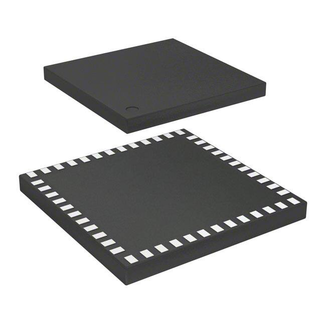

    LMH0387 3GBPS HD/SD SDI 可配置 I/O 自适应电缆均衡器/电缆驱动器
LMH0387SL/NOPB 数据手册
Product Folder Sample & Buy Support & Community Tools & Software Technical Documents LMH0387 SNLS315H – APRIL 2010 – REVISED AUGUST 2015 LMH0387 3 Gbps HD/SD SDI Configurable I/O Adaptive Cable Equalizer / Cable Driver 1 Features 3 Description • The LMH0387 3 Gbps HD/SD SDI Configurable I/O Adaptive Cable Equalizer / Cable Driver provides a single chip interface to a BNC. The device can be configured either in the input mode as an equalizer to receive data over coaxial cable or in the output mode as a cable driver to transmit data over coaxial cable. The same I/O pin is used both for the input and the output functions of the device, allowing the system designer the flexibility to use a BNC attached to the device as either an input or an output. 1 ST 424, ST 292, ST 344, and ST 259 Compliant (1) • • • • • • • • • • • • Supports DVB-ASI at 270 Mbps Data Rates: 125 Mbps to 2.97 Gbps when Receiving (DC to 2.97 Gbps when Driving Cable) Equalizes up to 120 Meters of Belden 1694A at 2.97 Gbps, up to 200 Meters of Belden 1694A at 1.485 Gbps, or up to 400 Meters of Belden 1694A at 270 Mbps Integrated Return Loss Network (No External Components Required) Power Saving Modes Cable Driver Selectable Slew Rate Internally Terminated 100-Ω LVDS Receiver Outputs With Programmable Common Mode Voltage and Swing Programmable Launch Amplitude Optimization for Receiver Cable Length Indication Single 3.3-V Supply Operation 48-Pin Laminate TLGA Package Industrial Temperature Range: −40°C to 85°C 2 Applications • • • • ST 424 (SMPTE 424M), ST 292 (SMPTE 292M), and ST 259 (SMPTE 259M) Serial Digital Interfaces (1) Digital Video Servers and Modular Equipment Video Encoders and Decoders Distribution Amplifiers The device operates over a wide range of data rates from 125 Mbps to 2.97 Gbps (DC to 2.97 Gbps when driving cable) and supports ST 424, ST 292, ST 344, and ST 259. The return loss network is integrated within the device so no external components are required to meet the SMPTE return loss specification. The LMH0387 offers designers flexibility in system design and quicker time to market. In the input mode, the LMH0387 features include a power-saving sleep mode, programmable output common mode voltage and swing, cable length indication, launch amplitude optimization, input signal detection, and an SPI interface. In the output mode, the LMH0387 features include two selectable slew rates for ST 424 / 292 and ST 259 compliance, and output driver power-down control. The device is available in a 7-mm × 7-mm 48-pin laminate Thin Laminate Grid Array (TLGA) Package. Device Information(1) PART NUMBER LMH0387 PACKAGE TLGA (48) BODY SIZE (NOM) 7.00 mm × 7.00 mm (1) For all available packages, see the orderable addendum at the end of the data sheet. Typical Application Existing Solution LMH0387 Solution VCC Cable Driver (1) Due to SMPTE naming convention, all SMPTE Engineering Documents will be numbered as a two-letter prefix and a number. Documents and references with the same root number and year are functionally identical; for example ST 424-2006 and SMPTE 424M-2006 refer to the same document. FPGA LMH0387 Configurable I/O FPGA Cable Equalizer 1 An IMPORTANT NOTICE at the end of this data sheet addresses availability, warranty, changes, use in safety-critical applications, intellectual property matters and other important disclaimers. PRODUCTION DATA. LMH0387 SNLS315H – APRIL 2010 – REVISED AUGUST 2015 www.ti.com Table of Contents 1 2 3 4 5 6 Features .................................................................. Applications ........................................................... Description ............................................................. Revision History..................................................... Pin Configuration and Functions ......................... Specifications......................................................... 6.1 6.2 6.3 6.4 6.5 6.6 1 1 1 2 3 5 Absolute Maximum Ratings ...................................... 5 ESD Ratings.............................................................. 5 Recommended Operating Conditions....................... 5 Thermal Information .................................................. 5 Control Pin Electrical Characteristics........................ 6 Input Mode (Equalizer) DC Electrical Characteristics ........................................................... 6 6.7 Output Mode (Cable Driver) DC Electrical Characteristics ........................................................... 7 6.8 Input Mode (Equalizer) AC Electrical Characteristics ........................................................... 7 6.9 Output Mode (Cable Driver) AC Electrical Characteristics ........................................................... 8 6.10 Input Mode (Equalizer) SPI Interface AC Electrical Characteristics ........................................................... 8 6.11 Typical Characteristics .......................................... 10 7 Detailed Description ............................................ 11 7.1 7.2 7.3 7.4 7.5 7.6 8 Overview ................................................................. Functional Block Diagram ....................................... Feature Description................................................. Device Functional Modes........................................ Programming........................................................... Register Maps ......................................................... 11 11 11 14 14 17 Application and Implementation ........................ 19 8.1 Application Information............................................ 19 8.2 Typical Application ................................................. 19 9 Power Supply Recommendations...................... 21 10 Layout................................................................... 21 10.1 Layout Guidelines ................................................. 21 10.2 Layout Example .................................................... 22 11 Device and Documentation Support ................. 23 11.1 11.2 11.3 11.4 11.5 Documentation Support ........................................ Community Resources.......................................... Trademarks ........................................................... Electrostatic Discharge Caution ............................ Glossary ................................................................ 23 23 23 23 23 12 Mechanical, Packaging, and Orderable Information ........................................................... 23 4 Revision History NOTE: Page numbers for previous revisions may differ from page numbers in the current version. Changes from Revision G (April 2013) to Revision H • Added ESD Ratings table, Feature Description section, Device Functional Modes, Application and Implementation section, Power Supply Recommendations section, Layout section, Device and Documentation Support section, and Mechanical, Packaging, and Orderable Information section ................................................................................................. 1 Changes from Revision F (April 2013) to Revision G • 2 Page Page Changed layout of National Data Sheet to TI format ........................................................................................................... 18 Submit Documentation Feedback Copyright © 2010–2015, Texas Instruments Incorporated Product Folder Links: LMH0387 LMH0387 www.ti.com SNLS315H – APRIL 2010 – REVISED AUGUST 2015 5 Pin Configuration and Functions RSVD RSVD RSVD TERMTX SD/HD VCCTX RSVD VEE TX_EN MOSI SCK VEE NPD Package 48-Pin TLGA Top View 48 47 46 45 44 43 42 41 40 39 38 37 RSVD 1 36 RREF VCCTX 2 35 VEE VCCTX 3 34 SDI RSVD 4 33 SDI RSVD 5 32 VEE RSVD 6 31 VEE RSVD 7 30 VCCRX BNC_IO 8 29 MISO RSVD 9 28 SDO RSVD 10 27 SDO RSVD 11 26 SS RSVD 12 25 VEE 15 16 17 18 19 20 21 22 RSVD RSVD RSVD TERMRX SPI_EN VEE AEC+ AEC- CD 23 24 VEE 14 CDTHRESH 13 RSVD LMH0387 (Top View) Submit Documentation Feedback Copyright © 2010–2015, Texas Instruments Incorporated Product Folder Links: LMH0387 3 LMH0387 SNLS315H – APRIL 2010 – REVISED AUGUST 2015 www.ti.com Pin Functions PIN NAME NO. I/O, TYPE DESCRIPTION 20, 21 I/O, Analog AEC loop filter external capacitor for equalizer (1 µF connected between AEC+ and AEC-). BNC_IO 8 I/O, Analog Serial digital interface input or output for connection to a BNC. Connect this pin to the BNC through an AC coupling capacitor (nominally 4.7 μF). CD 22 O, LVCMOS Carrier detect for BNC_IO pin. H = No input signal detected on BNC_IO pin. L = Input signal detected on BNC_IO pin. CDTHRESH 23 I, Analog MISO (SPI) 29 O, LVCMOS SPI Master Input / Slave Output. LMH0387 control data transmit. MOSI (SPI) 39 I, LVCMOS SPI Master Output / Slave Input. LMH0387 control data receive. RREF 36 I, Analog RSVD 1, 4-7, 9–16, 42, 46-48 N/A SCK (SPI) 38 I, LVCMOS SPI serial clock input. SD/HD 44 I, LVCMOS BNC_IO output slew rate control. SD/HD has an internal pulldown. H = BNC_IO output rise/fall time complies with SMPTE 259M (SD). L = BNC_IO output rise/fall time complies with SMPTE 424M / 292M (3G/HD). SDI, SDI 33, 34 I, Analog Serial data differential input for transmitter (cable driver). SDO, SDO 27, 28 O, LVDS Serial data differential output from receiver (equalizer). SPI_EN 18 I, LVCMOS SPI register access enable (equalizer). This pin should always be high; it must be pulled high while operating in the input mode and may optionally be pulled high while operating in the output mode. This pin has an internal pulldown. SS (SPI) 26 I, LVCMOS SPI slave select. This pin has an internal pullup. TERMRX 17 I, Analog Termination for unused receiver (equalizer) input. This network should consist of a 1-µF capacitor followed by a 220-Ω resistor to ground. TERMTX 45 O, Analog Termination for unused transmitter (cable driver) output. This network should consist of a 4.7-µF capacitor followed by a 75-Ω resistor to ground. 40 I, LVCMOS Transmitter output driver enable. TX_EN has an internal pullup. H = BNC_IO output driver is enabled. L = BNC_IO output driver is powered off. To configure the LMH0387 as a receiver, the BNC_IO output driver must be disabled by tying TX_EN low. To configure the LMH0387 as a transmitter, the output driver must be enabled by tying TX_EN high and the receiver may be powered down using the sleep mode setting through the SPI. AEC+, AEC- TX_EN VCCTX VEE VCCRX 4 Carrier detect threshold input. Sets the threshold for CD. CDTHRESH may be either unconnected or connected to ground for normal CD operation. BNC_IO output driver level control. Connect a resistor (nominally 715 Ω) to VCC to set the output voltage swing for the BNC_IO pin. Do not connect. 2, 3, 43 Power Positive power supply for transmitter (3.3 V). 19, 24, 25, 31, 32, 35, 37, 41 Power Negative power supply (ground). 30 Power Positive power supply for receiver (3.3 V). Submit Documentation Feedback Copyright © 2010–2015, Texas Instruments Incorporated Product Folder Links: LMH0387 LMH0387 www.ti.com SNLS315H – APRIL 2010 – REVISED AUGUST 2015 6 Specifications 6.1 Absolute Maximum Ratings over operating free-air temperature range (unless otherwise noted) (1) MIN MAX UNIT 4 V Supply Voltage −0.3 Input Voltage (all inputs) VCC+0.3 V 125 °C 150 °C Junction Temperature −65 Storage Temperature (1) Stresses beyond those listed under Absolute Maximum Ratings may cause permanent damage to the device. These are stress ratings only, which do not imply functional operation of the device at these or any other conditions beyond those indicated under Recommended Operating Conditions. Exposure to absolute-maximum-rated conditions for extended periods may affect device reliability. 6.2 ESD Ratings VALUE V(ESD) (1) (2) Electrostatic discharge Human-body model (HBM), per ANSI/ESDA/JEDEC JS-001 (1) ±6000 Charged-device model (CDM), per JEDEC specification JESD22C101 (2) ±2500 Machine model ±300 UNIT V JEDEC document JEP155 states that 500-V HBM allows safe manufacturing with a standard ESD control process. JEDEC document JEP157 states that 250-V CDM allows safe manufacturing with a standard ESD control process. 6.3 Recommended Operating Conditions Supply Voltage (VCC – VEE) MIN NOM MAX 3.14 3.3 3.46 BNC_IO Input / Output Coupling Capacitance UNIT V 4.7 AEC Capacitor (Connected between AEC+ and AEC-) µF 1 µF −40 Operating Free Air Temperature (TA) 85 °C 6.4 Thermal Information LMH0387 THERMAL METRIC (1) NPD (TLGA) UNIT 48 PINS RθJA Junction-to-ambient thermal resistance 64.5 °C/W RθJC(top) Junction-to-case (top) thermal resistance 20.8 °C/W RθJB Junction-to-board thermal resistance 32.3 °C/W ψJT Junction-to-top characterization parameter 0.9 °C/W ψJB Junction-to-board characterization parameter 32 °C/W RθJC(bot) Junction-to-case (bottom) thermal resistance N/A °C/W (1) For more information about traditional and new thermal metrics, see the Semiconductor and IC Package Thermal Metrics application report, SPRA953. Submit Documentation Feedback Copyright © 2010–2015, Texas Instruments Incorporated Product Folder Links: LMH0387 5 LMH0387 SNLS315H – APRIL 2010 – REVISED AUGUST 2015 www.ti.com 6.5 Control Pin Electrical Characteristics Over Supply Voltage and Operating Temperature ranges, unless otherwise specified (1) (2). PARAMETER TEST CONDITIONS MIN TYP MAX UNIT VIH Input Voltage High Level 2 VCC V VIL Input Voltage Low Level VEE 0.8 V VOH Output Voltage High Level IOH = –2 mA VOL Output Voltage Low Level IOL = 2 mA (1) (2) 2.4 V 0.4 V Current flow into device pins is defined as positive. Current flow out of device pins is defined as negative. All voltages are stated referenced to VEE = 0 Volts. Typical values are stated for VCC = +3.3 V and TA = 25°C. 6.6 Input Mode (Equalizer) DC Electrical Characteristics Over Supply Voltage and Operating Temperature ranges, unless otherwise specified (1) (2). PARAMETER MIN TYP MAX UNIT 720 800 950 mVP−P Differential Output Voltage, P-P 500 700 900 mVP-P VOD Differential Output Voltage 250 350 450 mV ΔVOD Change in Magnitude of VOD for complementary Output States 50 mV VOS Offset Voltage ΔVOS Change in Magnitude of VOS for complementary Output States 50 mV IOS Output Short Circuit Current 30 mA CDTHRESH CDTHRESH DC Voltage (floating) 1.3 V CDTHRNG CDTHRESH Range 0.8 V VIN Input Voltage Swing VSSP-P ICC (1) (2) (3) (4) (5) 6 Supply Current TEST CONDITIONS 0-m cable length (3) 100-Ω load, default register settings, Figure 1 (4) 1.125 1.25 1.375 V Equalizing cable > 120 m (Belden 1694A), TX_EN = 0 91 Equalizing cable ≤ 120 m (Belden 1694A), TX_EN = 0 (5) 71 mA Power save mode (equalizer in sleep mode, TX_EN = 0) 11 mA 113 mA Current flow into device pins is defined as positive. Current flow out of device pins is defined as negative. All voltages are stated referenced to VEE = 0 Volts. Typical values are stated for VCC = +3.3 V and TA = 25°C. The LMH0387 equalizer can be optimized for different launch amplitudes through the SPI. The differential output voltage and offset voltage are adjustable through the SPI. The equalizer automatically shifts equalization stages at cable lengths less than or equal to 120 m (Belden 1694A) to reduce power consumption. This power saving is also achieved by setting Extended 3G Reach Mode = 1 through the SPI. (Note: Forcing the Extended 3G Reach Mode in this way increases the cable reach for 3G data rates but also limits the achievable cable lengths at HD and SD data rates). Submit Documentation Feedback Copyright © 2010–2015, Texas Instruments Incorporated Product Folder Links: LMH0387 LMH0387 www.ti.com SNLS315H – APRIL 2010 – REVISED AUGUST 2015 6.7 Output Mode (Cable Driver) DC Electrical Characteristics Over Supply Voltage and Operating Temperature ranges, unless otherwise specified (1) (2). PARAMETER TEST CONDITIONS VCMOUT BNC_IO Output Common Mode Voltage VOUT BNC_IO Output Voltage Swing VCMIN SDI, SDI Input Common Mode Voltage VID SDI, SDI Input Voltage Swing ICC MIN TYP 720 800 0.9 + VID/2 Differential 100 (2) V 880 mVP-P VCC – VID/2 V 2200 mVP-P SD/HD = 0, equalizer in sleep mode 57 SD/HD = 1, equalizer in sleep mode 50 mA Power save mode (TX_EN = 0, equalizer in sleep mode) 11 mA 117 mA Loopback mode (Tx and Rx both enabled), SD/HD = 0 (1) UNIT VCC – VOUT RREF = 715 Ω ±1% Supply Current MAX 71 mA Current flow into device pins is defined as positive. Current flow out of device pins is defined as negative. All voltages are stated referenced to VEE = 0 Volts. Typical values are stated for VCC = +3.3 V and TA = 25°C. 6.8 Input Mode (Equalizer) AC Electrical Characteristics Over Supply Voltage and Operating Temperature ranges, unless otherwise specified (1). PARAMETER DRMIN Minimum Input Data Rate DRMAX Maximum Input Data Rate TEST CONDITIONS MIN TYP 0.35 1.485 Gbps, Belden 1694A, 0-170 meters (2) (3) 1.485 Gbps, Belden 1694A, 170-200 meters (3) 0.3 Output Rise Time, Fall Time Δtr, Δtf Mismatch in Rise/Fall Time (4) tOS Output Overshoot (4) RLIN BNC_IO Return Loss (1) (2) (3) (4) (5) 0.2 20% – 80%, 100 Ω load, Figure 1 (4) 80 . UI UI 0.2 270 Mbps, Belden 1694A, 350-400 meters (3) UI UI 0.25 270 Mbps, Belden 1694A, 0-350 meters (2) (3) tr, tf Mbps 0.3 2.97 Gbps, Belden 1694A, 100-120 meters (3) tjit UNIT Mbps 2970 2.97 Gbps, Belden 1694A, 0-100 meters (2) (3) Equalizer Jitter for Various Cable Lengths (SDO, SDO) MAX 125 UI UI 130 ps 2 15 ps 1% 5% 5 MHz - 1.5 GHz (4) (5) 15 dB (4) (5) 10 dB 1.5 GHz - 3 GHz Typical values are stated for VCC = +3.3 V and TA = 25°C. Based on design and characterization data over the full range of recommended operating conditions of the device. Jitter is measured in accordance with ST RP 184, ST RP 192, and the applicable serial data transmission standard: ST 424, ST 292, or ST 259. LMH0387 equalizer launch amplitude fine tuning set to nominal through the SPI by writing 30h (“00110000 binary”) to SPI register 02h. Specification is ensured by characterization. Return loss is dependent on board design. The LMH0387 exceeds this specification on the SD387EVK evaluation board. Submit Documentation Feedback Copyright © 2010–2015, Texas Instruments Incorporated Product Folder Links: LMH0387 7 LMH0387 SNLS315H – APRIL 2010 – REVISED AUGUST 2015 www.ti.com 6.9 Output Mode (Cable Driver) AC Electrical Characteristics Over Supply Voltage and Operating Temperature ranges, unless otherwise specified (1). PARAMETER DRMAX tjit Output Rise Time, Fall Time Δtr, Δtf Mismatch in Rise/Fall Time Duty Cycle Distortion tOS Output Overshoot RLOUT (1) (2) (3) (4) MIN TYP Maximum Input Data Rate Additive Jitter tr, tf TEST CONDITIONS BNC_IO Output Return Loss MAX UNIT 2970 Mbps 2.97 Gbps (2) 20 psP-P 1.485 Gbps (2) 18 psP-P 270 Mbps (2) 15 psP-P SD/HD = 0, 20% – 80% 130 ps 800 ps SD/HD = 0 30 ps SD/HD = 1 50 ps SD/HD = 0 (3) 30 ps SD/HD = 1 (3) 100 ps (3) 10% SD/HD = 1, 20% – 80% SD/HD = 0 65 400 SD/HD = 1 (3) 8% 5 MHz - 1.5 GHz (3) (4) 15 dB 1.5 GHz - 3 GHz (3) (4) 10 dB Typical values are stated for VCC = +3.3 V and TA = 25°C. Cable driver additive jitter is measured with the input AC coupled. Specification is ensured by characterization. Return loss is dependent on board design. The LMH0387 exceeds this specification on the SD387EVK evaluation board. 6.10 Input Mode (Equalizer) SPI Interface AC Electrical Characteristics Over Supply Voltage and Operating Temperature ranges, unless otherwise specified PARAMETER fSCK SCK Frequency tPH SCK Pulse Width High tPL SCK Pulse Width Low tSU MOSI Setup Time tH MOSI Hold Time tSSSU SS Setup Time tSSH SS Hold Time tSSOF SS Off Time tODZ MISO Driven-to-Tristate Time tOZD MISO Tristate-to-Driven Time tOD MISO Output Delay Time (1) 8 TEST CONDITIONS Figure 2, Figure 3 Figure 2, Figure 3 Figure 2, Figure 3 Figure 3 (1) . MIN TYP MAX UNIT 20 MHz 40% SCK period 40% SCK period 4 ns 4 ns 4 ns 4 ns 10 ns 15 ns 15 ns 15 ns Typical values are stated for VCC = +3.3 V and TA = 25°C. Submit Documentation Feedback Copyright © 2010–2015, Texas Instruments Incorporated Product Folder Links: LMH0387 LMH0387 www.ti.com SNLS315H – APRIL 2010 – REVISED AUGUST 2015 VODVOS VOD+ 80% 80% + VOD VSSP-P 0V differential 20% - VOD 20% VSSP-P = (VOD+) – (VOD-) tr tf Figure 1. LVDS Output Voltage, Offset, and Timing Parameters SS (host) tSSSU tPH tPL tSSH SCK (host) tH tSU MOSI (host) MISO (device) tSSOF 0 A6 A5 A4 A3 A2 A1 A0 D7 D6 D5 D4 D3 D2 D1 D0 Hi-Z Figure 2. SPI Write Operation SS (host) tSSSU tPH tPL tSSH SCK (host) tH tSU MOSI (host) Hi-Z 1 A6 A5 A4 A3 A2 A1 A0 tOZD MISO (device) tSSOF Hi-Z D7 D6 tOD D5 D4 D3 tODZ D2 D1 D0 Hi-Z Figure 3. SPI Read Operation Submit Documentation Feedback Copyright © 2010–2015, Texas Instruments Incorporated Product Folder Links: LMH0387 9 LMH0387 SNLS315H – APRIL 2010 – REVISED AUGUST 2015 www.ti.com 6.11 Typical Characteristics 120m 0f B1694A at 2.97 Gbps, PRBS10 H: 100 ps / div, V: 50 mV / div (SDO Output Shown) Figure 4. Differential Serial Data Output After Equalizing H: 62.5 ps / div, V: 100 mV / div (BNC_IO Output Shown) Figure 5. Cable Driver Output at 2.97 Gbps, PRBS10 Figure 6. BNC_IO Return Loss 10 Submit Documentation Feedback Copyright © 2010–2015, Texas Instruments Incorporated Product Folder Links: LMH0387 LMH0387 www.ti.com SNLS315H – APRIL 2010 – REVISED AUGUST 2015 7 Detailed Description 7.1 Overview The LMH0387 3 Gbps HD/SD SDI Configurable I/O Adaptive Cable Equalizer / Cable Driver provides a single chip interface to a BNC. The same I/O pin is used both for the input and the output functions of the device, allowing the system designer to use a BNC attached to the device as either an input or an output. The LMH0387 operates over a wide range of data rates from 125 Mbps to 2.97 Gbps and supports ST 424, ST 292, ST 344, ST 259, and DVB/ASI standards. The LMH0387 includes passive components for the return loss network – simplifying board design and development time. SD/HD TX_EN RREF TERMTX 7.2 Functional Block Diagram SDI Cable Driver SDI BNC_IO SDO Cable Equalizer SCK MOSI MISO SS CDTHRESH CD SPI_EN AEC– AEC+ TERMTX SDO 7.3 Feature Description The LMH0387 can be configured either in the input mode as an equalizer to receive data over coaxial cable or in the output mode as a cable driver to transmit data over coaxial cable. The LMH0387 requires register programming to operate either in Input Mode (Equalizer) or Output Mode (Cable Driver). 7.3.1 Input Mode (Equalizer) Description SPI register access is required while operating the LMH0387 in the input mode. The equalizer launch amplitude fine tuning must be set to nominal through the SPI for correct equalizer operation. To do this, write 30h (“00110000 binary”) to SPI register 02h. The SPI registers provide access to many other useful LMH0387 features while in the input mode. Refer to the Input Mode (Equalizer) SPI Register Access section for details. 7.3.1.1 Input Interfacing The LMH0387 accepts a single-ended input at the BNC_IO pin. The input must be AC coupled as shown in Figure 9 . The TERMRX input must be properly terminated with a 1-µF capacitor followed by a 220-Ω resistor to ground. The LMH0387 BNC_IO input can be optimized for different launch amplitudes through the SPI (see Launch Amplitude Optimization (Register 02h) in the Input Mode (Equalizer) SPI Register Access section). The LMH0387 correctly handles equalizer pathological signals for standard and high definition serial digital video, as described in ST RP 178 and RP 198, respectively. Submit Documentation Feedback Copyright © 2010–2015, Texas Instruments Incorporated Product Folder Links: LMH0387 11 LMH0387 SNLS315H – APRIL 2010 – REVISED AUGUST 2015 www.ti.com Feature Description (continued) 7.3.1.2 Output Interfacing The LMH0387 equalizer outputs, SDO and SDO, are internally terminated 100-Ω LVDS outputs. These outputs can be DC coupled to most common differential receivers. The default output common mode voltage (VOS) is 1.25 V. The output common mode voltage may be adjusted through the SPI in 200 mV increments, from 1.05 V to 1.85 V (see Output Driver Adjustments (Register 01h) in the Input Mode (Equalizer) SPI Register Access section). This adjustable output common mode voltage offers flexibility for interfacing to many types of receivers. The default differential output swing (VSSP-P) is 700 mVP-P. The differential output swing may be adjusted through the SPI in 100 mV increments from 400 mVP-P to 800 mVP-P (see Output Driver Adjustments (Register 01h) in the Input Mode (Equalizer) SPI Register Access section). The LMH0387 equalizer output should be DC coupled to the input of the receiving device as long as the common mode ranges of both devices are compatible. 100-Ω differential transmission lines should be used to connect between the LMH0387 outputs and the input of the receiving device where possible. The LMH0387 allows flexibility when interfacing to low voltage crosspoint switches (that is, 1.8 V) and other devices with limited input ranges. The LMH0387 equalizer outputs can be DC coupled to these devices in most cases. The LMH0387 may be AC coupled to the receiving device when necessary. For example, the LMH0387 equalizer outputs are not strictly compatible with 3.3 V CML and thus should not be connected through 50-Ω resistors to 3.3 V. If the input common mode range of the receiving device is not compatible with the output common mode range of the LMH0387, then AC coupling is required. Following the AC coupling capacitors, the signal may have to be biased at the input of the receiving device. 7.3.1.3 Carrier Detect (CD) Carrier detect CD indicates if a valid signal is present at the LMH0387 BNC_IO pin. If CDTHRESH is used, the carrier detect threshold will be altered accordingly. CD provides a high voltage when no signal is present at the LMH0387 BNC_IO pin. CD is low when a valid input signal is detected. 7.3.1.4 Carrier Detect Threshold (CDTHRESH) The CDTHRESH pin sets the threshold for the carrier detect. The carrier detect threshold is set by applying a voltage inversely proportional to the length of cable to equalize before loss of carrier is triggered. The applied voltage must be greater than the CDTHRESH floating voltage (typically 1.3 V) to change the CD threshold. As the applied CDTHRESH voltage is increased, the amount of cable that will be equalized before carrier detect is deasserted is decreased. CDTHRESH may be left unconnected or connected to ground for normal CD operation. Figure 7 shows the minimum CDTHRESH input voltage required to force carrier detect to inactive vs. Belden 1694A cable length. The results shown are valid for Belden 1694A cable lengths of 0 m to 120 m at 2.97 Gbps, 0 m to200 m at 1.485 Gbps, and 0 m to 400 m at 270 Mbps. 12 Submit Documentation Feedback Copyright © 2010–2015, Texas Instruments Incorporated Product Folder Links: LMH0387 LMH0387 www.ti.com SNLS315H – APRIL 2010 – REVISED AUGUST 2015 Feature Description (continued) 3.2 CDTHRESH (V) 3.0 2.8 2.6 2.4 2.2 2.0 0 50 100 150 200 250 300 350 400 BELDEN 1694A CABLE LENGTH (m) Figure 7. CDTHRESH vs Belden 1694A Cable Length 7.3.1.5 Auto Sleep The LMH0387 equalizer is set for auto sleep operation by default. The equalizer portion of the LMH0387 powers down when no input signal is detected on the BNC_IO pin. The equalizer powers on again once an input signal is detected. The auto sleep functionality can be changed to force sleep or turned off completely through the SPI registers. In auto sleep mode, the time to power down the equalizer when the input signal is removed is less than 200 µs and should not have any impact on the system timing requirements. The equalizer will wake up automatically once an input signal is detected, and the delay between signal detection and full functionality of the equalizer is negligible. The overall system will be limited only by the settling time constant of the equalizer adaptation loop. 7.3.2 Output Mode (Cable Driver) Description 7.3.2.1 Input Interfacing The LMH0387 cable driver accepts differential input signals which can be DC or AC coupled. 7.3.2.2 Output Interfacing The LMH0387 cable driver uses 75-Ω internally terminated current mode outputs. The output level is 800 mVP-P with an RREF resistor of 715 Ω. The RREF resistor is connected between the RREF pin and VCC, and should be placed as close as possible to the RREF pin. The output should be AC coupled as shown in the Figure 9. The TERMTX output must be properly terminated with a 4.7-µF capacitor followed by a 75-Ω resistor to ground as shown. 7.3.2.3 Output Slew Rate Control The LMH0387 cable driver output rise and fall times are selectable for either ST 259 or ST 424 / 292 compliance through the SD/HD pin. For slower rise and fall times, or ST 259 compliance, SD/HD is set high. For faster rise and fall times, or ST 424 and ST 292 compliance, SD/HD is set low. SD/HD has an internal pulldown. 7.3.2.4 Output Enable The LMH0387 cable driver can be enabled or disabled with the TX_EN pin. When set low, the cable driver is powered off. TX_EN has an internal pullup to enable the cable driver by default. When using the LMH0387 in the input mode (as an equalizer), the cable driver must be disabled by setting the TX_EN pin low. Submit Documentation Feedback Copyright © 2010–2015, Texas Instruments Incorporated Product Folder Links: LMH0387 13 LMH0387 SNLS315H – APRIL 2010 – REVISED AUGUST 2015 www.ti.com 7.4 Device Functional Modes SPI register access is required while operating the LMH0387 in the input mode. The equalizer launch amplitude fine tuning must be set to nominal through the SPI for correct equalizer operation. To do this, write 30h (“00110000 binary”) to SPI register 02h. The SPI registers provide access to many other useful LMH0387 features while in the input mode. To configure the LMH0387 in the output mode, the cable driver must be enabled. The equalizer may either be disabled for power savings or enabled to provide a loopback path for the data being transmitted. For the normal output mode (equalizer disabled for power savings) follow these steps: 1. Disable the equalizer by forcing it to sleep through the SPI. To do this, write “10” (force sleep) to bits [4:3] of SPI register 00h. 2. Enable the cable driver by pulling the TX_EN pin high. 7.5 Programming The LMH0387 3 Gbps HD/SD SDI Configurable I/O Adaptive Cable Equalizer / Cable Driver is used at the input or output port of digital video equipment. It is designed to allow the sharing of a single BNC connector for either input or output. The LMH0387 must be configured in either the output mode as a cable driver, or the input mode as an equalizer. 7.5.1 Output Mode (Cable Driver) To configure the LMH0387 in the output mode, the cable driver must be enabled. The equalizer may either be disabled for power savings or enabled to provide a loopback path for the data being transmitted. For the normal output mode (equalizer disabled for power savings) follow these steps: 1. Disable the equalizer by forcing it to sleep through the SPI. To do this, write “10” (force sleep) to bits [4:3] of SPI register 00h. 2. Enable the cable driver by pulling the TX_EN pin high. To configure the LMH0387 for the output mode with the loopback path, the equalizer can be enabled in output mode by writing either “01” (auto sleep – default) or “00” (never sleep) to bits [4:3] of SPI register 00h. In this case, the LMH0387 input/output mode may be configured simply by toggling the TX_EN pin because the equalizer remains active in either mode (TX_EN set low for input mode and high for output mode). 7.5.2 Input Mode (Equalizer) To configure the LMH0387 in the input mode, the equalizer must be enabled and the cable driver must be disabled as described in the following steps: 1. Disable the cable driver by pulling the TX_EN pin low. 2. Enable the equalizer by setting the sleep mode through the SPI to either auto sleep or disabled (never sleep). To do this, write either “01” (auto sleep – default) or “00” (never sleep) to bits [4:3] of SPI register 00h. 3. Set the equalizer launch amplitude fine tuning to the nominal setting through the SPI. To do this, write 30h (“00110000” binary) to SPI register 02h. 7.5.3 Input Mode (Equalizer) SPI Register Access SPI register access is required for correct input mode (equalizer) operation. The SPI registers provide access to all of the equalizer features along with a cable length indicator, programmable output common mode voltage and swing, and launch amplitude optimization. There are four supported 8-bit registers in the device (see SPI Registers). Note: The SPI_EN pin must always be pulled high while using the LMH0387 in the input mode (equalizer), and may optionally be pulled high while using the LMH0387 in the output mode (cable driver) as well. 7.5.3.1 SPI Write The SPI write is shown in Figure 2. The MOSI payload consists of a “0” (write command), seven address bits, and eight data bits. The SS signal is driven low, and the 16 bits are sent to the LMH0387's MOSI input. Data is latched on the rising edge of SCK. The MISO output is normally tri-stated during this operation. After the SPI write, SS must return high. 14 Submit Documentation Feedback Copyright © 2010–2015, Texas Instruments Incorporated Product Folder Links: LMH0387 LMH0387 www.ti.com SNLS315H – APRIL 2010 – REVISED AUGUST 2015 Programming (continued) 7.5.3.2 SPI Read The SPI read is shown in Figure 3. The MOSI payload consists of a “1” (read command) and seven address bits. The SS signal is driven low, and the eight bits are sent to the LMH0387's MOSI input. The addressed location is accessed immediately after the rising edge of the 8th clock and the eight data bits are shifted out on MISO starting with the falling edge of the 8th clock. MOSI must be tri-stated immediately after the rising edge of the 8th clock. After the SPI read, SS must return high. 7.5.3.3 Output Driver Adjustments (Register 01h) The equalizer output driver swing (amplitude) and offset voltage (common mode voltage) are adjustable through SPI register 01h. 7.5.3.3.1 Output Swing The output swing is adjustable through bits [7:5] of SPI register 01h. The default value for these register bits is “011” for a peak-to-peak differential output voltage of 700 mVP-P. The output swing can be adjusted in 100 mV increments from 400 mVP-P to 800 mVP-P. 7.5.3.3.2 Offset Voltage The offset voltage is adjustable through bits [4:2] of SPI register 01h. The default value for these register bits is “001” for an output offset of 1.25 V. The output common mode voltage may be adjusted in 200 mV increments, from 1.05 V to 1.85 V. It can also be set to “101” for the maximum offset voltage. At this maximum offset voltage setting, the outputs are referenced to the positive supply and the offset voltage is around 2.1 V. 7.5.3.4 Launch Amplitude Optimization (Register 02h) The LMH0387 can compensate for attenuation of the input signal before the equalizer. This compensation is useful for applications with a passive splitter at the equalizer input or a non-ideal input termination network, and is controlled by SPI register 02h. NOTE For correct equalizer operation with the default SMPTE 800 mVP-P launch amplitude and no external attenuation, the equalizer launch amplitude fine tuning must be set to the “nominal” setting through the SPI. To do this, write 30h (“00110000” binary) to SPI register 02h. 7.5.3.4.1 Coarse Control Bit 7 of SPI register 02h is used for coarse control of the launch amplitude setting. At the default setting of “0”, the equalizer operates normally and expects a launch amplitude of 800 mVP-P. Bit 7 may be set to “1” to optimize the equalizer for input signals with 6 dB of attenuation (400 mVP-P). 7.5.3.4.2 Fine Control Once the coarse control is set, the equalizer input compensation may be further fine tuned by bits [6:3] of SPI register 02h. These bits may be used to tweak the input gain stage -2% to 60% around the coarse control setting. For typical equalizer operation, bits [6:3] of SPI register 02h should be changed from the default setting of “0000” to the nominal setting of “0110”. 7.5.3.5 Cable Length Indicator (CLI (Register 03h) The Cable Length Indicator (CLI) provides an indication of the length of cable attached to the equalizer input. CLI is accessible through bits [7:3] of SPI register 03h. The 5-bit CLI ranges in decimal value from 0 to 25 (“00000” to “11001” binary) and increases as the cable length is increased. Figure 8 shows typical CLI values vs. Belden 1694A cable length. CLI is valid for Belden 1694A cable lengths of 0 m to 120 m at 2.97 Gbps, 0 m to 200 m at 1.485 Gbps, and 0 m to 400 m at 270 Mbps. Submit Documentation Feedback Copyright © 2010–2015, Texas Instruments Incorporated Product Folder Links: LMH0387 15 LMH0387 SNLS315H – APRIL 2010 – REVISED AUGUST 2015 www.ti.com Programming (continued) 30 CLI (decimal value) 25 20 15 10 5 0 0 50 100 150 200 250 300 350 400 BELDEN 1694A CABLE LENGTH (m) Figure 8. CLI vs. Belden 1694A Cable Length 7.5.4 Input Mode (Equalizer) SPI Register Access 7.5.4.1 General Control (Register 00h) SPI Register 00h, General Control, provides access to many basic features of the equalizer, including the carrier detect status and the mute, sleep mode, and extended 3G reach mode controls. 7.5.4.1.1 Carrier Detect This bit shows the status of the carrier detect for the BNC_IO pin. 7.5.4.1.2 Mute The mute control can be used to manually mute or enable SDO and SDO. Setting this bit to “1” will mute the equalizer outputs by forcing them to logic zero. Setting the mute bit to “0” will force the equalizer outputs to be active. 7.5.4.1.3 Sleep Mode The sleep mode is used to automatically or selectively power down the equalizer for power savings when it is not needed. The auto sleep mode allows the equalizer to power down when no input signal is detected, and is activated by default or by writing “01” to bits [4:3] of SPI register 00h. If the auto sleep mode is active, the equalizer goes into a deep power save mode when no input signal is detected on the BNC_IO pin. The device powers on again once an input signal is detected. The sleep functionality can be turned off completely (equalizer will never sleep) by writing “00” to bits [4:3] of SPI register 00h. Additionally, the equalizer can be forced to power down regardless of whether there is an input signal or not by writing “10” to bits [4:3] of SPI register 00h. The sleep mode has precedence over the mute mode. 7.5.4.1.4 Extended 3G Reach Mode The LMH0387 equalizer provides a mode to extend the 3G cable reach in systems that have margin in the jitter budget. This allows for additional cable reach at 2.97 Gbps at the expense of slightly higher output jitter. The extended 3G reach mode provides 10m of additional Belden 1694A cable reach, with an increase of output jitter at this longer cable length of 0.05 to 0.1 UI. (Note: In Extended 3G Reach Mode, the maximum equalizable cable lengths for HD and SD data rates will be limited to less than what can be achieved in normal mode). 16 Submit Documentation Feedback Copyright © 2010–2015, Texas Instruments Incorporated Product Folder Links: LMH0387 LMH0387 www.ti.com SNLS315H – APRIL 2010 – REVISED AUGUST 2015 7.6 Register Maps 7.6.1 SPI Registers Table 1. SPI Register Descriptions ADDRESS 00h R/W R/W NAME General Control BITS 7 Carrier Detect 6 Mute 5 Reserved 4:3 R/W DEFAULT Extended 3G Reach Mode 1:0 Reserved 0 0: Normal operation. 1: Equalizer outputs muted. 0 Reserved as 0. Always write 0 to this bit. 01 Equalizer sleep mode control. Sleep has precedence over Mute. 00: Never sleep. Disable sleep mode (force equalizer to stay enabled). 01: Auto sleep. Sleep mode active when no input signal detected. 10: Force sleep. Force equalizer into sleep mode (powered down) regardless of whether there is an input signal or not. 11: Reserved. 0 Extended 3G reach mode to extend the equalizable cable length for 2.97 Gbps applications. 0: Normal operation. 1: Extended 3G reach mode. 00 Equalizer output driver swing (VSSP-P). 000: VSSP-P = 400 mVP-P. 001: VSSP-P = 500 mVP-P. 010: VSSP-P = 600 mVP-P. 011: VSSP-P = 700 mVP-P. 100: VSSP-P = 800 mVP-P. 101, 110, 111: Reserved. 001 Equalizer output driver offset voltage (common mode voltage). 000: VOS = 1.05V. 001: VOS = 1.25V. 010: VOS = 1.45V. 011: VOS = 1.65V. 100: VOS = 1.85V. 101: VOS referenced to positive supply. 110, 111: Reserved. 00 Reserved as 00. Always write 00 to these bits. Output Driver Offset Voltage 1:0 Reserved Reserved as 00. Always write 00 to these bits. 011 Output Swing 4:2 DESCRIPTION Read only. 0: No carrier detected on BNC_IO pin. 1: Carrier detected on BNC_IO pin. Sleep Mode 2 7:5 01h FIELD Submit Documentation Feedback Copyright © 2010–2015, Texas Instruments Incorporated Product Folder Links: LMH0387 17 LMH0387 SNLS315H – APRIL 2010 – REVISED AUGUST 2015 www.ti.com Register Maps (continued) Table 1. SPI Register Descriptions (continued) ADDRESS R/W NAME BITS 7 02h 03h 18 R/W R FIELD DEFAULT Coarse launch amplitude optimization for equalizer input. 0: Normal optimization with no external attenuation (800 mVP-P launch amplitude). 1: Optimized for -6 dB external attenuation (400 mVP-P launch amplitude). 0000 Launch amplitude optimization fine tuning for equalizer input. 0000: +20% from nominal. 0001: +16% from nominal. 0010: +12% from nominal. 0011: +9% from nominal. 0100: +6% from nominal. 0101: +3% from nominal. 0110: Nominal. (The default setting must be changed to this nominal setting for most applications). 0111: -2% from nominal. 1001: +24% from nominal. 1010: +29% from nominal. 1011: +34% from nominal. 1100: +40% from nominal. 1101: +46% from nominal. 1110: +53% from nominal. 1111: +60% from nominal. 1000: Reserved. 000 Reserved as 000. Always write 000 to these bits. Coarse Control Launch Amplitude CLI 6:3 Fine Control 2:0 Reserved 7:3 CLI 2:0 Reserved Submit Documentation Feedback DESCRIPTION 0 Cable Length Indicator. Provides an indication of the length of cable attached to the equalizer input. CLI increases as the cable length increases. 000 Reserved. Copyright © 2010–2015, Texas Instruments Incorporated Product Folder Links: LMH0387 LMH0387 www.ti.com SNLS315H – APRIL 2010 – REVISED AUGUST 2015 8 Application and Implementation NOTE Information in the following applications sections is not part of the TI component specification, and TI does not warrant its accuracy or completeness. TI’s customers are responsible for determining suitability of components for their purposes. Customers should validate and test their design implementation to confirm system functionality. 8.1 Application Information The LMH0387 is a single channel SDI cable driver and equalizer that supports different application spaces. The following sections describe the typical use cases and common implementation practices. 8.1.1 General Guidance for Applications The LMH0387 supports SPI interface for configuring the device. Registers must be programmed (see Programming) for proper operation of the device. Attention must be paid to the PCB layout for the high speed signals to facilitate the SMPTE specification compliance. SMPTE specifies requirements for the Serial Digital Interface to transport digital video over coaxial cable. SMPTE specifies the use of AC coupling capacitors for transporting uncompressed serial data with heavy low-frequency content. This specification requires the use of a 4.7-μF AC coupling capacitor to avoid low-frequency DC wander. The 75-Ω trace impedance is required to meet SMPTE specified rise/fall requirements to facilitate highest eye opening for the receiving device. 8.2 Typical Application To meet SMPTE requirements, the optimal placement of the LMH0387 is to be as close to the BNC as possible. Figure 9 shows the application circuit for the LMH0387. VCC 4.7 PF TX_EN 715: SD/HD RREF TERMTX 75: TX_EN SD/HD LMH0387 4.7 PF SDI Configurable SDI In/Out Cable Driver 100: SDI 4.7 PF 4.7 PF BNC_IO SDO Cable Equalizer 4.7 PF SCK MOSI MISO SS CDTHRESH CD AEC- SPI_EN AEC+ TERMRX SDO To FPGA 4.7 PF 1.0 PF SCK MOSI 220: MISO 1.0 PF SS VCC CDTHRESH CD Figure 9. Typical Application Schematic Submit Documentation Feedback Copyright © 2010–2015, Texas Instruments Incorporated Product Folder Links: LMH0387 19 LMH0387 SNLS315H – APRIL 2010 – REVISED AUGUST 2015 www.ti.com Typical Application (continued) 8.2.1 Design Requirements Table 2 lists the key design parameters of the LMH0387. Table 2. Design Parameters DESIGN PARAMETER REQUIREMENTS Input AC coupling capacitor Required. A common type of AC coupling capacitor is 4.7-µF ±10% X7R ceramic capacitor (0402 or 0201 size). Trace or via under the device No trace or via under the device. Distance from device to BNC Keep this distance as short as possible to minimize the parasitic. BNC_IO, TERMTX, TERMRX trace impedance Design single-ended trace impedance with 75 Ω ± 5%. SDI, SDI and SDO, SDO differential trace impedance Design differential trace impedance with 100 Ω ± 5%. DC power supply coupling capacitors To minimize power supply noise, use 0.1-µF shunt across 10-µF capacitors as close to the device as possible. 8.2.2 Detailed Design Procedure To begin the design process, determine the followings: • Maximum power consumption for PCB regulator selection: Use maximum current consumption in the data sheet to compute the maximum power consumption. • Closely compare schematic against typical connection diagram in the data sheet. • With layout guideline in mind (see Layout Guidelines ) plan out the PCB layout and component placement to minimize parasitic. • Consult the BNC vendor for optimum BNC landing pattern. 8.2.3 Application Curve Figure 10. Differential Serial Data Output After Equalizing 200m of B1694A at 1.485 Gbps, PRBS10 20 Submit Documentation Feedback Copyright © 2010–2015, Texas Instruments Incorporated Product Folder Links: LMH0387 LMH0387 www.ti.com SNLS315H – APRIL 2010 – REVISED AUGUST 2015 9 Power Supply Recommendations Follow these general guidelines when designing the power supply: • The power supply should be designed to provide the recommended operating conditions in terms of DC voltage and maximum current consumption. • The maximum current draw for the LMH0387 is provided in the data sheet. This number can be used to calculate the maximum current the supply must provide. • The LMH0387 does not require any special power supply filtering, provided the recommended operating conditions are met. Use 0.1-µF capacitors as close to the device VCCRX and VCCTX pins as possible. 10 Layout 10.1 Layout Guidelines For information on layout and soldering of the laminate TLGA package, refer to the following application note: AN-1125 (SNAA002), Laminate CSP/FBGA. NOTE For a CSP package, it is a general requirement not to have any metal (traces or vias) on the top layer in the area directly underneath the device, other than the footprint. This is intended to provide a flat planar surface for the package. The ST 424, 292, and 259 standards have stringent requirements for the input and output return loss of receivers and transmitters, which essentially specify how closely they must resemble a 75-Ω network. Any non-idealities in the network between the BNC and the LMH0387 will degrade the return loss. Take care to minimize impedance discontinuities both for the BNC footprint and for the trace between the BNC and the LMH0387 to ensure that the characteristic impedance is 75 Ω. Best return loss performance is achieved with the LMH0387 placed closely to the BNC to minimize the trace length between the BNC and the LMH0387's BNC_IO pin. Consider the following PCB recommendations: • Place the LMH0387 in close proximity to the BNC. • Use surface mount components, and use the smallest components available. In addition, use the smallest size component pads. • Select trace widths that minimize the impedance mismatch between the BNC and the LMH0387. • Select a board stack up that supports both 75-Ω single-ended traces and 100-Ω loosely-coupled differential traces. • Maintain symmetry on the complementary signals. • Route 100-Ω traces uniformly (keep trace widths and trace spacing uniform along the trace). • Avoid sharp bends in the signal path; use 45° or radial bends. • Place bypass capacitors close to each power pin, and use the shortest path to connect device power and ground pins to the respective power or ground planes. • Remove ground plane under input/output components to minimize parasitic capacitance. Submit Documentation Feedback Copyright © 2010–2015, Texas Instruments Incorporated Product Folder Links: LMH0387 21 LMH0387 SNLS315H – APRIL 2010 – REVISED AUGUST 2015 www.ti.com 10.2 Layout Example GND and VCC relief under BNC and component pad Figure 11. Ground and VCC Relief Under Controlled Impedance Component Pads No metal (traces or vias) in this area Figure 12. Top Etch Routing Restriction 22 Submit Documentation Feedback Copyright © 2010–2015, Texas Instruments Incorporated Product Folder Links: LMH0387 LMH0387 www.ti.com SNLS315H – APRIL 2010 – REVISED AUGUST 2015 11 Device and Documentation Support 11.1 Documentation Support 11.1.1 Related Documentation For related documentation see the following: • AN-1125 Laminate CSP/FBGA, SNAA002 11.2 Community Resources The following links connect to TI community resources. Linked contents are provided "AS IS" by the respective contributors. They do not constitute TI specifications and do not necessarily reflect TI's views; see TI's Terms of Use. TI E2E™ Online Community TI's Engineer-to-Engineer (E2E) Community. Created to foster collaboration among engineers. At e2e.ti.com, you can ask questions, share knowledge, explore ideas and help solve problems with fellow engineers. Design Support TI's Design Support Quickly find helpful E2E forums along with design support tools and contact information for technical support. 11.3 Trademarks E2E is a trademark of Texas Instruments. All other trademarks are the property of their respective owners. 11.4 Electrostatic Discharge Caution These devices have limited built-in ESD protection. The leads should be shorted together or the device placed in conductive foam during storage or handling to prevent electrostatic damage to the MOS gates. 11.5 Glossary SLYZ022 — TI Glossary. This glossary lists and explains terms, acronyms, and definitions. 12 Mechanical, Packaging, and Orderable Information The following pages include mechanical, packaging, and orderable information. This information is the most current data available for the designated devices. This data is subject to change without notice and revision of this document. For browser-based versions of this data sheet, refer to the left-hand navigation. Submit Documentation Feedback Copyright © 2010–2015, Texas Instruments Incorporated Product Folder Links: LMH0387 23 PACKAGE OPTION ADDENDUM www.ti.com 17-Jun-2022 PACKAGING INFORMATION Orderable Device Status (1) Package Type Package Pins Package Drawing Qty Eco Plan (2) Lead finish/ Ball material MSL Peak Temp Op Temp (°C) Device Marking (3) Samples (4/5) (6) LMH0387SL/NOPB ACTIVE TLGA NPD 48 1000 RoHS & Green NIAU Level-3-260C-168 HR -40 to 85 LMH0387SL Samples LMH0387SLE/NOPB ACTIVE TLGA NPD 48 250 RoHS & Green NIAU Level-3-260C-168 HR -40 to 85 LMH0387SL Samples (1) The marketing status values are defined as follows: ACTIVE: Product device recommended for new designs. LIFEBUY: TI has announced that the device will be discontinued, and a lifetime-buy period is in effect. NRND: Not recommended for new designs. Device is in production to support existing customers, but TI does not recommend using this part in a new design. PREVIEW: Device has been announced but is not in production. Samples may or may not be available. OBSOLETE: TI has discontinued the production of the device. (2) RoHS: TI defines "RoHS" to mean semiconductor products that are compliant with the current EU RoHS requirements for all 10 RoHS substances, including the requirement that RoHS substance do not exceed 0.1% by weight in homogeneous materials. Where designed to be soldered at high temperatures, "RoHS" products are suitable for use in specified lead-free processes. TI may reference these types of products as "Pb-Free". RoHS Exempt: TI defines "RoHS Exempt" to mean products that contain lead but are compliant with EU RoHS pursuant to a specific EU RoHS exemption. Green: TI defines "Green" to mean the content of Chlorine (Cl) and Bromine (Br) based flame retardants meet JS709B low halogen requirements of
