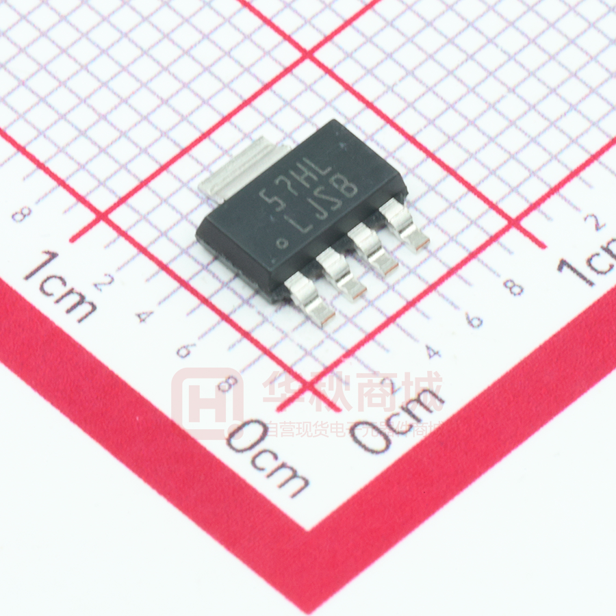

Sample & Buy Product Folder Support & Community Tools & Software Technical Documents Reference Design LP38690, LP38692 SNVS322M – DECEMBER 2004 – REVISED DECEMBER 2015 LP38690, LP38692 1-A Low Dropout CMOS Linear Regulators Stable with Ceramic Output Capacitors 1 Features 3 Description • • • The LP38690 and LP38692 low-dropout CMOS linear regulators provide tight output tolerance (2.5% typical), extremely low dropout voltage (450 mV at a 1-A load current, VOUT = 5 V), and excellent AC performance utilizing ultra low ESR ceramic output capacitors. 1 • • • • • • • • • Wide Input Voltage Range (2.7 V to 10 V) 2.5% Output Accuracy (25°C) Low Dropout Voltage: 450 mV at 1 A (typical, 5 VOUT) Precision (Trimmed) Bandgap Reference Ensured Specifications for –40°C to 125°C 1-µA Off-State Quiescent Current Thermal Overload Protection Foldback Current Limiting 3-Lead TO-252, 5-Lead SOT-223, and 6-Bump WSON Packages Enable Pin (LP38692) Ground Pin Current: 55 µA (typical) at Full Load Precision Output Voltage: 2.5% (25°C) Accuracy The use of a PMOS power transistor means that no DC base drive current is required to bias it allowing ground pin current to remain below 100 µA regardless of load current, input voltage, or operating temperature. Device Information(1) PART NUMBER 2 Applications • • • • The low thermal resistance of the WSON, SOT-223, and TO-252 packages allow the full operating current to be used even in high ambient temperature environments. LP38690 Hard Disk Drives Notebook Computers Battery Powered Devices Portable Instrumentation LP38692 VIN VOUT WSON (6) 3.00 mm x 3.00 mm SOT-223 (5) 6.50 mm x 3.56 mm WSON (6) 3.00 mm x 3.00 mm Simplified Schematic for LP38692 VOUT VIN IN OUT LP38690 EN SNS** 1 µF* BODY SIZE (NOM) 6.58 mm x 6.10 mm (1) For all available packages, see the orderable addendum at the end of the data sheet. Simplified Schematic for LP38690 IN PACKAGE TO-252 (3) GND * Minimum value required for stability. **WSON package devices only. OUT LP38692 SNS** VEN 1 µF* 1 PF * GND 1 PF * * Minimum value required for stability. **WSON package devices only. 1 An IMPORTANT NOTICE at the end of this data sheet addresses availability, warranty, changes, use in safety-critical applications, intellectual property matters and other important disclaimers. PRODUCTION DATA. LP38690, LP38692 SNVS322M – DECEMBER 2004 – REVISED DECEMBER 2015 www.ti.com Table of Contents 1 2 3 4 5 6 7 1 1 1 2 3 4 9 Power Supply Recommendations...................... 18 10 Layout................................................................... 18 6.1 6.2 6.3 6.4 6.5 6.6 4 4 4 4 5 6 11 Device and Documentation Support ................. 21 Absolute Maximum Ratings ...................................... ESD Ratings.............................................................. Recommended Operating Conditions....................... Thermal Information .................................................. Electrical Characteristics........................................... Typical Characteristics .............................................. Detailed Description ............................................ 11 7.1 7.2 7.3 7.4 8 8.1 Application Information............................................ 14 8.2 Typical Applications ................................................ 15 Features .................................................................. Applications ........................................................... Description ............................................................. Revision History..................................................... Pin Configuration and Functions ......................... Specifications......................................................... Overview ................................................................. Functional Block Diagrams ..................................... Feature Description................................................. Device Functional Modes........................................ 11 11 13 13 Application and Implementation ........................ 14 10.1 10.2 10.3 10.4 10.5 11.1 11.2 11.3 11.4 11.5 11.6 PCB Layout ........................................................... Layout Examples................................................... WSON Mounting ................................................... RFI/EMI Susceptibility ........................................... Output Noise ......................................................... Documentation Support ....................................... Related Links ........................................................ Community Resources.......................................... Trademarks ........................................................... Electrostatic Discharge Caution ............................ Glossary ................................................................ 18 19 19 20 20 21 21 21 21 21 21 12 Mechanical, Packaging, and Orderable Information ........................................................... 21 4 Revision History NOTE: Page numbers for previous revisions may differ from page numbers in the current version. Changes from Revision L (March 2015) to Revision M Page • Added top navigator icon for TI Designs ............................................................................................................................... 1 • Added Caution note to Foldback Current Limiting subsection ............................................................................................ 13 Changes from Revision K (December 2014) to Revision L • Changed "mA" back to "mV" - error from SDS conversion. ................................................................................................... 5 Changes from Revision J (April 2013) to Revision K • 2 Page Changed Device Information and ESD Rating tables, Feature Description, Device Functional Modes, Application and Implementation, Power Supply Recommendations, Layout, Device and Documentation Support, and Mechanical, Packaging, and Orderable Information sections; update Thermal Values moved some curves to Application Curves section; change package name PFM to TO-252 (National to TI nomenclature) and pin names from VIN, VOUT to IN, OUT. ................................................................................................................................................. 1 Changes from Revision I (April 2013) to Revision J • Page Page Changed layout of National Data Sheet to TI format ........................................................................................................... 20 Submit Documentation Feedback Copyright © 2004–2015, Texas Instruments Incorporated Product Folder Links: LP38690 LP38692 LP38690, LP38692 www.ti.com SNVS322M – DECEMBER 2004 – REVISED DECEMBER 2015 5 Pin Configuration and Functions LP38690 TO-252 (NDP) 3 Pins Top View LP38690 WSON (NGG) 6 Pins Top View IN 1 GND 2 N/C 3 LP38690/92 SOT-223 (NDC) 5 Pins Top View Exposed Pad on Bottom (DAP) 6 IN 5 SNS 4 OUT LP38692 WSON (NGG) 6 Pins Top View EN 1 IN 1 GND 2 EN 3 6 IN 5 SNS 4 OUT N/C 2 5 GND OUT 3 IN 4 Exposed Pad on Bottom (DAP) Pin Functions PIN NAME LP38690 LP38692 TYPE DESCRIPTION TO-252 WSON SOT-223 WSON EN — — 1 3 I The Enable (EN) pin allows the part to be turned ON and OFF by pulling this pin HIGH or LOW. GND TAB 2 5 2 — Circuit ground for the regulator. For the TO-252 and SOT-223 packages this is thermally connected to the die and functions as a heat sink when soldered down to a large copper plane. IN 3 1, 6 4 1, 6 I This is the input supply voltage to the regulator. For WSON devices, both IN pins must be tied together for full current operation (500 mA maximum per pin). OUT 1 4 3 4 O Regulated output voltage. SNS — 5 — 5 I WSON only - Output sense pin allows remote sensing at the load which eliminates the error in output voltage due to voltage drops caused by the resistance in the traces between the regulator and the load. This pin must be tied to VOUT. DAP — X — X — WSON only - The DAP (Exposed Pad) functions as a thermal connection when soldered to a copper plane. See WSON Mounting section in Layout for more information. Submit Documentation Feedback Copyright © 2004–2015, Texas Instruments Incorporated Product Folder Links: LP38690 LP38692 3 LP38690, LP38692 SNVS322M – DECEMBER 2004 – REVISED DECEMBER 2015 www.ti.com 6 Specifications 6.1 Absolute Maximum Ratings over operating free-air temperature range (unless otherwise noted) (1) V(max) All pins (with respect to GND) IOUT MIN MAX UNIT –0.3 12 V (2) Internally limited −40 Junction temperature 150 Lead temperature (soldering, 5 seconds) Power dissipation (3) Internally limited Storage temperature, Tstg (1) (2) (3) °C 260 –65 150 °C Stresses beyond those listed under Absolute Maximum Ratings may cause permanent damage to the device. These are stress ratings only, which do not imply functional operation of the device at these or any other conditions beyond those indicated under Recommended Operating Conditions. Exposure to absolute-maximum-rated conditions for extended periods may affect device reliability. If used in a dual-supply system where the regulator load is returned to a negative supply, the output pin must be diode clamped to ground. At elevated temperatures, device power dissipation must be derated based on package thermal resistance and heatsink values (if a heatsink is used). When using the WSON package, refer to TI Application Report AN-1187 Leadless Leadframe Package (LLP) (SNOA401) and the WSON Mounting section in this datasheet. If power dissipation causes the junction temperature to exceed specified limits, the device goes into thermal shutdown. 6.2 ESD Ratings V(ESD) (1) Electrostatic discharge Human-body model (HBM), per ANSI/ESDA/JEDEC JS-001 (1) VALUE UNIT ±2000 V JEDEC document JEP155 states that 500-V HBM allows safe manufacturing with a standard ESD control process. 6.3 Recommended Operating Conditions over operating free-air temperature range (unless otherwise noted) MIN VIN supply voltage Operating junction temperature NOM MAX UNIT 2.7 10 V −40 125 °C 6.4 Thermal Information THERMAL METRIC (1) LP38690 LP38690/92 LP38692 TO-252 WSON SOT-223 3 PINS 6 PINS 5 PINS UNIT RθJA (2) Junction-to-ambient thermal resistance 50.5 50.6 68.5 °C/W RθJC(top) Junction-to-case (top) thermal resistance 52.6 44.4 52.2 °C/W RθJB Junction-to-board thermal resistance 29.7 24.9 13.0 °C/W ψJT Junction-to-top characterization parameter 4.8 0.4 5.5 °C/W ψJB Junction-to-board characterization parameter 29.3 25.1 12.8 °C/W RθJC(bot) Junction-to-case (bottom) thermal resistance 1.5 5.4 n/a °C/W (1) (2) 4 For more information about traditional and new thermal metrics, see the Semiconductor and IC Package Thermal Metrics application report, SPRA953. Junction-to-ambient thermal resistance, High-K. Submit Documentation Feedback Copyright © 2004–2015, Texas Instruments Incorporated Product Folder Links: LP38690 LP38692 LP38690, LP38692 www.ti.com SNVS322M – DECEMBER 2004 – REVISED DECEMBER 2015 6.5 Electrical Characteristics Unless otherwise specified: VIN = VOUT + 1 V, CIN = COUT = 10 µF, ILOAD = 10 mA, and limits are for TJ = 25°C. Minimum (MIN) and maximum (MAX) limits are specified through testing, statistical correlation, or design. PARAMETER VOUT ΔVOUT/ΔVIN ΔVOUT/ΔIL Output voltage tolerance Output voltage line regulation (2) Output voltage load regulation (3) TEST CONDITIONS 100 µA < IL < 1 A VO + 1 V ≤ VIN ≤ 10 V −40°C ≤ TJ ≤ 125°C VOUT + 0.5 V ≤ VIN ≤ 10 V IL = 25 mA MIN TYP (1) 2.5 –5 5 %/A 1.8 V 1 mA < IL < 1 A VIN = VOUT + 1 V −40°C ≤ TJ ≤ 125°C 5 VOUT = 1.8 V IL = 1 A 950 VOUT = 1.8 V IL = 1 A −40°C ≤ TJ ≤ 125°C VIN – VOUT Dropout voltage (4) VOUT = 3.3 V VOUT = 3.3 V −40°C ≤ TJ ≤ 125°C VOUT = 5 V VOUT = 5 V, −40°C ≤ TJ ≤ 125°C 1600 IL = 0.1 A IL = 1 A Quiescent current 80 800 IL = 0.1 A 145 IL = 1 A IL = 0.1 A IL = 1 A 1300 650 110 IL = 1 A IL = 0.1 A IL = 1 A 1000 45 450 IL = 0.1 A 100 IL = 1 A 800 55 VIN ≤ 10 V, IL = 100 µA to 1 A −40°C ≤ TJ ≤ 125°C VEN ≤ 0.4 V (LP38692 only) 100 VIN – VOUT ≤ 4 V −40°C ≤ TJ ≤ 125°C Minimum load current IFB Foldback current limit PSRR Ripple rejection TSD Thermal shutdown activation (junction temp) 160 TSD (HYST) Thermal shutdown hysteresis (junction temp) 10 en Output noise VOUT = 3.3 V, BW = 10 Hz to 10 kHz 0.7 VOUT (LEAK) Output leakage current VOUT = VOUT(NOM) + 1 V at 10 VIN 0.5 (1) (2) (3) (4) µA 0.001 IL(MIN) 100 VIN – VOUT > 5 V 450 VIN – VOUT < 4 V 1500 VIN = VOUT + 2 V(DC), with 1V(p-p) / 120 Hz ripple mV 65 IL = 0.1 A VIN ≤ 10 V, IL = 100 µA to 1 A IQ %VOUT 1 1 mA < IL < 1 A VIN = VOUT + 1 V VOUT = 2.5 V −40°C ≤ TJ ≤ 125°C UNIT 0.03 VOUT + 0.5 V ≤ VIN ≤ 10 V IL = 25 mA −40°C ≤ TJ ≤ 125°C VOUT = 2.5 V MAX –2.5 mA 55 dB °C µV/√Hz 12 µA Typical numbers represent the most likely parametric norm for 25°C operation. Output voltage line regulation is defined as the change in output voltage from nominal value resulting from a change in input voltage. Output voltage load regulation is defined as the change in output voltage from nominal value as the load current increases from 1 mA to full load. Dropout voltage is defined as the minimum input to output differential required to maintain the output within 100 mV of nominal value. Submit Documentation Feedback Copyright © 2004–2015, Texas Instruments Incorporated Product Folder Links: LP38690 LP38692 5 LP38690, LP38692 SNVS322M – DECEMBER 2004 – REVISED DECEMBER 2015 www.ti.com Electrical Characteristics (continued) Unless otherwise specified: VIN = VOUT + 1 V, CIN = COUT = 10 µF, ILOAD = 10 mA, and limits are for TJ = 25°C. Minimum (MIN) and maximum (MAX) limits are specified through testing, statistical correlation, or design. PARAMETER TEST CONDITIONS TYP (1) MIN MAX Output = OFF, −40°C ≤ TJ ≤ 125°C Enable voltage (LP38692 only) VEN IEN Enable pin leakage UNIT 0.4 Output = ON, VIN = 4 V −40°C ≤ TJ ≤ 125°C 1.8 Output = ON, VIN = 6 V −40°C ≤ TJ ≤ 125°C 3 Output = ON, VIN = 10 V −40°C ≤ TJ ≤ 125°C 4 VEN = 0 V or 10 V, VIN = 10 V V –1 0.001 1 µA 6.6 Typical Characteristics Unless otherwise specified: TJ = 25°C, CIN = COUT = 10 µF, EN pin is tied to VIN (LP38692 only), VOUT = 1.8 V, VIN = VOUT + 1 V, IL = 10 mA. 1.0 1.2 COUT = 10 PF COUT = 1 PF Hz) 0.8 0.8 NOISE (PV/ NOISE/ (PV Hz) 1.0 0.6 0.4 0.6 0.4 0.2 0.2 0.0 0.0 10 100 1k 10k 100k 10 100 FREQUENCY (Hz) 1.5 100k 60 COUT = 100 PF 50 RIPPLE REJECTION (dB) Hz) 10k Figure 2. Noise vs Frequency Figure 1. Noise vs Frequency NOISE (PV/ 1k FREQUENCY (Hz) 1.0 0.5 40 30 COUT = 10 PF 20 VIN(DC) = 5.3V VIN(AC) = 1V(p-p) 10 VOUT = 3.3V 0.0 0 10 100 1k 10k 100k 10 1k 10k 100k FREQUENCY (Hz) FREQUENCY (Hz) Figure 3. Noise vs Frequency 6 100 Submit Documentation Feedback Figure 4. Ripple Rejection Copyright © 2004–2015, Texas Instruments Incorporated Product Folder Links: LP38690 LP38692 LP38690, LP38692 www.ti.com SNVS322M – DECEMBER 2004 – REVISED DECEMBER 2015 Typical Characteristics (continued) 60 60 50 50 RIPPLE REJECTION (dB) 40 30 COUT = 100 PF 20 VIN(DC) = 5.3V VIN(AC) = 1V(p-p) 10 40 30 COUT = 1 PF 20 VIN(DC) = 5.3V VIN(AC) = 1V(p-p) 10 VOUT = 3.3V VOUT = 3.3V 0 0 10 100 1k 10k 100k 10 100 1k 10k FREQUENCY (Hz) FREQUENCY (Hz) Figure 5. Ripple Rejection Figure 6. Ripple Rejection VOUT = 3.3V VOUT 'VOUT (mV) 0 -10 COUT = 10 PF 50 VOUT 0 -50 -100 -20 5 5 4 VIN VIN (V) VIN 4 3 3 200 Ps/DIV 100 Ps/DIV Figure 7. Line Transient Response Figure 8. Line Transient Response 100 VOUT = 3.3V 'VOUT (mV) 100 COUT = 1 PF 'VOUT (mV) VIN (V) 'VOUT (mV) 10 VOUT = 3.3V 100 COUT = 100 PF 20 100k 50 VOUT 0 -50 50 VOUT 0 COUT = 100 PF -50 -100 -100 1 ILOAD 4 VIN (V) 5 VIN 0.01 ILOAD (A) RIPPLE REJECTION (dB) Unless otherwise specified: TJ = 25°C, CIN = COUT = 10 µF, EN pin is tied to VIN (LP38692 only), VOUT = 1.8 V, VIN = VOUT + 1 V, IL = 10 mA. 3 100 Ps/DIV 200 Ps/DIV Figure 9. Line Transient Response Figure 10. Load Transient Response Submit Documentation Feedback Copyright © 2004–2015, Texas Instruments Incorporated Product Folder Links: LP38690 LP38692 7 LP38690, LP38692 SNVS322M – DECEMBER 2004 – REVISED DECEMBER 2015 www.ti.com Typical Characteristics (continued) Unless otherwise specified: TJ = 25°C, CIN = COUT = 10 µF, EN pin is tied to VIN (LP38692 only), VOUT = 1.8 V, VIN = VOUT + 1 V, IL = 10 mA. 200 COUT = 10 PF COUT = 10 PF 200 'VOUT (mV) 'VOUT (mV) 400 0 VOUT -200 100 0 VOUT -100 -200 -400 0.01 ILOAD (A) ILOAD ILOAD (A) 0.5 1 ILOAD 0.01 40 Ps/DIV 40 Ps/DIV Figure 11. Load Transient Response Figure 12. Load Transient Response 400 400 COUT = 1 PF 'VOUT (mV) 'VOUT (mV) COUT = 1 PF 200 VOUT 0 -200 -400 200 0 VOUT -200 -400 0.01 ILOAD 0.01 10 Ps/DIV 10 Ps/DIV Figure 13. Load Transient Response Figure 14. Load Transient Response 0.4 0.4 0.2 0.2 0 0 % DEVIATION % DEVIATION ILOAD (A) ILOAD ILOAD (A) 0.5 1 -0.2 -0.4 -0.6 -0.2 -0.4 -0.6 -0.8 -0.8 -1 -1.2 -50 8 -1 -50 -25 0 25 50 75 100 -25 0 25 50 75 100 125 125 o TEMPERATURE (oC) TEMPERATURE ( C) Figure 15. VOUT vs Temperature (5 V) Figure 16. VOUT vs Temperature (3.3 V) Submit Documentation Feedback Copyright © 2004–2015, Texas Instruments Incorporated Product Folder Links: LP38690 LP38692 LP38690, LP38692 www.ti.com SNVS322M – DECEMBER 2004 – REVISED DECEMBER 2015 Typical Characteristics (continued) Unless otherwise specified: TJ = 25°C, CIN = COUT = 10 µF, EN pin is tied to VIN (LP38692 only), VOUT = 1.8 V, VIN = VOUT + 1 V, IL = 10 mA. 0.1 0.2 0 0.1 0 % DEVIATION % DEVIATION -0.1 -0.2 -0.3 -0.4 -0.5 -0.1 -0.2 -0.3 -0.4 -0.5 -0.6 -0.6 -0.7 -50 -25 0 25 50 75 100 -0.7 -50 125 -25 0 TEMPERATURE (oC) 25 50 75 100 125 TEMPERATURE (oC) Figure 17. VOUT vs Temperature (2.5 V) Figure 18. VOUT vs Temperature (1.8 V) Figure 20. VOUT vs VIN (Power-Up) Figure 19. VOUT vs VIN (1.8 V) 1000 1600 900 125°C 1400 VOUT = 3.3V 800 VDROPOUT (mV) VDROPOUT (mV) 1200 1000 800 25°C -40°C 600 400 700 125°C 600 500 400 300 -40°C 200 200 25°C 100 0 0 0 200 400 600 800 1000 0 200 400 600 800 1000 IOUT (mA) IOUT (mA) Figure 21. Dropout Voltage vs IOUT Figure 22. Dropout Voltage vs IOUT Submit Documentation Feedback Copyright © 2004–2015, Texas Instruments Incorporated Product Folder Links: LP38690 LP38692 9 LP38690, LP38692 SNVS322M – DECEMBER 2004 – REVISED DECEMBER 2015 www.ti.com Typical Characteristics (continued) Unless otherwise specified: TJ = 25°C, CIN = COUT = 10 µF, EN pin is tied to VIN (LP38692 only), VOUT = 1.8 V, VIN = VOUT + 1 V, IL = 10 mA. -1.0 2.3 VIN = 10V 2.1 -1.5 'VOUT/'IOUT (%/A) 1.9 VEN (V) 1.7 VIN = 6V 1.5 1.3 1.1 0.9 VIN = 4V -2.0 -2.5 -3.0 0.7 0.5 -50 -25 0 25 50 75 100 -3.5 -50 125 -25 0 25 50 75 100 125 o o TEMPERATURE ( C) TEMPERATURE ( C) Figure 23. Enable Voltage vs Temperature Figure 24. Load Regulation vs Temperature 0.034 'VOUT/'VIN (%/V) 0.032 0.03 0.028 0.026 0.024 0.022 0.02 -50 -25 0 25 50 75 100 125 o TEMPERATURE ( C) Figure 25. Line Regulation vs Temperature 10 Submit Documentation Feedback Copyright © 2004–2015, Texas Instruments Incorporated Product Folder Links: LP38690 LP38692 LP38690, LP38692 www.ti.com SNVS322M – DECEMBER 2004 – REVISED DECEMBER 2015 7 Detailed Description 7.1 Overview The LP38690 and LP38692 devices are designed to meet the requirements of portable, battery-powered digital systems providing an accurate output voltage with fast start-up. When disabled via a low logic signal at the enable pin (EN), the power consumption is reduced to virtually zero (LP38692 only). The LP38690 and LP38692 perform well with a single 1-μF input capacitor and a single 1-μF ceramic output capacitor. 7.2 Functional Block Diagrams IN P-FET + ENABLE LOGIC P-FET MOSFET DRIVER FOLDBACK CURRENT LIMITING THERMAL SHUTDOWN OUT R 1 1.25V REFERENCE R 2 GND Figure 26. LP38690 Functional Diagram (TO-252) IN P-FET N/C + ENABLE LOGIC P-FET MOSFET DRIVER FOLDBACK CURRENT LIMITING OUT SNS THERMAL SHUTDOWN 1.25 V REFERENCE R1 R2 GND Figure 27. LP38690 Functional Diagram (WSON) Submit Documentation Feedback Copyright © 2004–2015, Texas Instruments Incorporated Product Folder Links: LP38690 LP38692 11 LP38690, LP38692 SNVS322M – DECEMBER 2004 – REVISED DECEMBER 2015 www.ti.com Functional Block Diagrams (continued) IN P-FET EN ENABLE LOGIC + P-FET MOSFET DRIVER FOLDBACK CURRENT LIMITING THERMAL SHUTDOWN OUT 1.25V REFERENCE R1 R2 GND Figure 28. LP38692 Functional Diagram (SOT-223) IN P-FET EN ENABLE LOGIC + P-FET MOSFET DRIVER FOLDBACK CURRENT LIMITING THERMAL SHUTDOWN OUT R 1 1.25V REFERENCE SNS R 2 GND Figure 29. LP38692 Functional Diagram (WSON) 12 Submit Documentation Feedback Copyright © 2004–2015, Texas Instruments Incorporated Product Folder Links: LP38690 LP38692 LP38690, LP38692 www.ti.com SNVS322M – DECEMBER 2004 – REVISED DECEMBER 2015 7.3 Feature Description 7.3.1 Enable (EN) The LP38692 has an Enable pin (EN) which allows an external control signal to turn the regulator output On and Off. The Enable On/Off threshold has no hysteresis. The voltage signal must rise and fall cleanly, and promptly, through the ON and OFF voltage thresholds. The EN pin voltage must be higher than the VEN(MIN) threshold to ensure that the device is fully enabled under all operating conditions. The EN pin voltage must be lower than the VEN(MAX) threshold to ensure that the device is fully disabled. The Enable pin has no internal pull-up or pull-down to establish a default condition and, as a result, this pin must be terminated either actively or passively. If the Enable pin is driven from a source that actively pulls high and low, the drive voltage should not be allowed to go below ground potential or higher than VIN. If the application does not require the Enable function, the pin should be connected directly to the IN pin. 7.3.2 Thermal Shutdown Protection (TSD) Thermal shutdown disables the output when the junction temperature rises to approximately 160°C which allows the device to cool. When the junction temperature cools to approximately 150°C, the output circuitry enables. Based on power dissipation, thermal resistance, and ambient temperature, the thermal protection circuit may cycle on and off. This thermal cycling limits the dissipation of the regulator and protects it from damage as a result of overheating. The TSD circuitry of the LP38692 has been designed to protect against temporary thermal overload conditions. The TSD circuitry was not intended to replace proper heat-sinking. Continuously running the LP38692 device into thermal shutdown degrades device reliability. 7.3.3 Foldback Current Limiting Foldback current limiting is built into the LP38690 and LP38692 which reduces the amount of output current the part can deliver as the output voltage is reduced. The amount of load current is dependent on the differential voltage between VIN and VOUT. Typically, when this differential voltage exceeds 5 V, the load current limits at about 450 mA. When the VIN – VOUT differential is reduced below 4 V, load current is limited to about 1500 mA. CAUTION When toggling the LP38692 Enable (EN) after the input voltage (VIN) is applied, the foldback current limit circuitry is functional the first time that the EN pin is taken high. The foldback current limit circuitry is non-functional the second, and subsequent, times that the EN pin is taken high. Depending on the input and output capacitance values the input inrush current may be higher than expected which can cause the input voltage to droop. If the EN pin is connected to the IN pin, the foldback current limit circuitry is functional when VIN is applied if VIN starts from less than 0.4 V. 7.4 Device Functional Modes 7.4.1 Enable (EN) The EN pin voltage must be higher than the VEN(MIN) threshold to ensure that the device is fully enabled under all operating conditions. 7.4.2 Minimum Operating Input Voltage (VIN) The LP38690 and LP38692 devices do not include any dedicated UVLO circuitry. The LP38690 and LP38692 internal circuitry is not fully functional until VIN is at least 2.7 V. The output voltage is not regulated until VIN ≥ (VOUT + VDO), or 2.7 V, whichever is higher. Submit Documentation Feedback Copyright © 2004–2015, Texas Instruments Incorporated Product Folder Links: LP38690 LP38692 13 LP38690, LP38692 SNVS322M – DECEMBER 2004 – REVISED DECEMBER 2015 www.ti.com 8 Application and Implementation NOTE Information in the following applications sections is not part of the TI component specification, and TI does not warrant its accuracy or completeness. TI’s customers are responsible for determining suitability of components for their purposes. Customers should validate and test their design implementation to confirm system functionality. 8.1 Application Information 8.1.1 Reverse Voltage A reverse voltage condition exists when the voltage at the output pin is higher than the voltage at the input pin. Typically this happens when VIN is abruptly taken low and COUT continues to hold a sufficient charge such that the input to output voltage becomes reversed. A less common condition is when an alternate voltage source is connected to the output. There are two possible paths for current to flow from the output pin back to the input during a reverse voltage condition. 1. While VIN is high enough to keep the control circuitry alive, and the EN pin (LP38692 only) is above the VEN(ON) threshold, the control circuitry attempts to regulate the output voltage. If the input voltage is less than the programmed output voltage, the control circuit drives the gate of the pass element to the full ON condition. In this condition, reverse current flows from the output pin to the input pin, limited only by the RDS(ON) of the pass element and the output to input voltage differential. Discharging an output capacitor up to 1000 μF in this manner does not damage the device as the current will rapidly decay. However, continuous reverse current should be avoided. When the EN pin is low this condition is prevented. 2. The internal PFET pass element has an inherent parasitic diode. During normal operation, the input voltage is higher than the output voltage and the parasitic diode is reverse biased. However, when VIN is below the value where the control circuitry is alive, or the EN pin is low (LP38692 only), and the output voltage is more than 500 mV (typical) above the input voltage the parasitic diode becomes forward biased and current flows from the output pin to the input pin through the diode. The current in the parasitic diode should be limited to less than 1 A continuous and 5 A peak. If used in a dual-supply system where the regulator output load is returned to a negative supply, the output pin must be diode clamped to ground to limit the negative voltage transition. A Schottky diode is recommended for this protective clamp. 14 Submit Documentation Feedback Copyright © 2004–2015, Texas Instruments Incorporated Product Folder Links: LP38690 LP38692 LP38690, LP38692 www.ti.com SNVS322M – DECEMBER 2004 – REVISED DECEMBER 2015 8.2 Typical Applications VIN VOUT IN OUT LP38690 SNS** 1 µF* GND 1 µF* * Minimum value required for stability. **WSON package devices only. Figure 30. LP38690 Typical Application VOUT VIN IN EN OUT LP38692 SNS** VEN 1 PF * GND 1 PF * * Minimum value required for stability. **WSON package devices only. Figure 31. LP38692 Typical Application 8.2.1 Design Requirements For typical CMOS voltage regulator applications, use the parameters listed in Table 1. Table 1. Design Parameters DESIGN PARAMETER EXAMPLE VALUE Input voltage range 2.7 to 10 V Output voltage 1.8 V Output current 1A Output capacitor range 1 µF Input/output capacitor ESR range 5 mΩ to 500 mΩ Submit Documentation Feedback Copyright © 2004–2015, Texas Instruments Incorporated Product Folder Links: LP38690 LP38692 15 LP38690, LP38692 SNVS322M – DECEMBER 2004 – REVISED DECEMBER 2015 www.ti.com 8.2.2 Detailed Design Procedure 8.2.2.1 Power Dissipation and Device Operation The permissible power dissipation for any package is a measure of the capability of the device to pass heat from the power source, the junctions of the device, to the ultimate heat sink, the ambient environment. Thus, the power dissipation is dependent on the ambient temperature and the thermal resistance across the various interfaces between the die junction and ambient air. The permissible power dissipation for any package is a measure of the capability of the device to pass heat from the power source, the junctions of the device, to the ultimate heat sink, the ambient environment. Thus, the power dissipation is dependent on the ambient temperature and the thermal resistance across the various interfaces between the die junction and ambient air. The maximum allowable power dissipation for the device in a given package can be calculated using Equation 1: PD-MAX = ((TJ-MAX – TA) / RθJA) (1) The actual power being dissipated in the device can be represented by Equation 2: PD = (VIN – VOUT) × IOUT (2) These two equations establish the relationship between the maximum power dissipation allowed due to thermal consideration, the voltage drop across the device, and the continuous current capability of the device. These two equations should be used to determine the optimum operating conditions for the device in the application. In applications where lower power dissipation (PD) and/or excellent package thermal resistance (RθJA) is present, the maximum ambient temperature (TA-MAX) may be increased. In applications where high power dissipation and/or poor package thermal resistance is present, the maximum ambient temperature (TA-MAX) may have to be derated. TA-MAX is dependent on the maximum operating junction temperature (TJ-MAX-OP = 125°C), the maximum allowable power dissipation in the device package in the application (PD-MAX), and the junction-to ambient thermal resistance of the part/package in the application (RθJA), as given by Equation 3: TA-MAX = (TJ-MAX-OP – (RθJA × PD-MAX)) (3) Alternately, if TA-MAX can not be derated, the PD value must be reduced. This can be accomplished by reducing VIN in the VIN – VOUT term as long as the minimum VIN is met, or by reducing the IOUT term, or by some combination of the two. 8.2.2.2 External Capacitors In common with most regulators, the LP38690 and LP38692 require external capacitors for regulator stability. The LP38690 and LP38692 are specifically designed for portable applications requiring minimum board space and smallest components. These capacitors must be correctly selected for good performance. 8.2.2.2.1 Input Capacitor An input capacitor is required for stability. It is recommended that a 1-μF capacitor be connected between the LP38690 or LP38692 IN pin and GND pin (this capacitance value may be increased without limit). This capacitor must be located a distance of not more than 1 cm from the IN pin and returned to a clean analogue ground. Any good quality ceramic, tantalum, or film capacitor may be used at the input. Important: To ensure stable operation it is essential that good PCB design practices are employed to minimize ground impedance and keep input inductance low. If these conditions cannot be met, or if long leads are used to connect the battery or other power source to the LP38690 or LP38692, then it is recommended that the input capacitor is increased. Also, tantalum capacitors can suffer catastrophic failures due to surge current when connected to a low-impedance source of power (like a battery or a very large capacitor). If a tantalum capacitor is used at the input, it must be ensured by the manufacturer to have a surge current rating sufficient for the application. There are no requirements for the equivalent series resistance (ESR) on the input capacitor, but tolerance and temperature coefficient must be considered when selecting the capacitor to ensure the capacitance remains approximately 1 μF over the entire operating temperature range. 16 Submit Documentation Feedback Copyright © 2004–2015, Texas Instruments Incorporated Product Folder Links: LP38690 LP38692 LP38690, LP38692 www.ti.com SNVS322M – DECEMBER 2004 – REVISED DECEMBER 2015 8.2.2.2.2 Output Capacitor The LP38690 and LP38692 are designed specifically to work with very small ceramic output capacitors. A 1-μF ceramic capacitor (temperature types Z5U, Y5V or X7R/X5R) with ESR between 5 mΩ to 500 mΩ, is suitable in the LP38690 or LP38692 application circuit. For this device the output capacitor should be connected between the OUT pin and GND pin. It is also possible to use tantalum or film capacitors at the device output, but these are not as attractive for reasons of size and cost (see Capacitor Characteristics). The output capacitor must meet the requirement for the minimum value of capacitance and also have an ESR value that is within the range 5 mΩ to 500 mΩ for stability. 8.2.2.2.3 No Load Stability The LP38690 and LP38692 remain stable and in regulation with no external load. This is an important consideration in some circuits, for example CMOS RAM keep-alive applications. 8.2.2.2.4 Capacitor Characteristics The LP38690 and LP38692 are designed to work with ceramic capacitors on the output to take advantage of the benefits they offer. For capacitance values in the range of 0.47 μF to 4.7 μF, ceramic capacitors are the smallest, least expensive and have the lowest ESR values, thus making them best for eliminating high frequency noise. The ESR of a typical 1-μF ceramic capacitor is in the range of 20 mΩ to 40 mΩ, which easily meets the ESR requirement for stability for the LP38690 or LP38692. For both input and output capacitors, careful interpretation of the capacitor specification is required to ensure correct device operation. The capacitor value can change greatly, depending on the operating conditions and capacitor type. CAP VALUE (% of NOMINAL 1 PF) In particular, the output capacitor selection should take account of all the capacitor parameters, to ensure that the specification is met within the application. The capacitance can vary with DC bias conditions as well as temperature and frequency of operation. Capacitor values also shows some decrease over time due to aging. The capacitor parameters are also dependent on the particular case size, with smaller sizes giving poorer performance figures in general. As an example, Figure 32 shows a typical graph comparing different capacitor case sizes in a capacitance vs DC bias plot. As shown in Figure 32, increasing the DC Bias condition can result in the capacitance value falling below the minimum value given in the recommended capacitor specifications table (0.7 μF in this case). Note that the graph shows the capacitance out of spec for the 0402 case size capacitor at higher bias voltages. It is therefore recommended that the capacitor manufacturers’ specifications for the nominal value capacitor are consulted for all conditions, as some capacitor sizes (for example, 0402) may not be suitable in the actual application. 0603, 10V, X5R 100% 80% 60% 0402, 6.3V, X5R 40% 20% 0 1.0 2.0 3.0 4.0 5.0 DC BIAS (V) Figure 32. Typical Variation In Capacitance vs DC Bias The ceramic capacitor’s value varies with temperature. The capacitor type X7R, which operates over a temperature range of –55°C to 125°C, only varies the capacitance to within ±15%. The capacitor type X5R has a similar tolerance over a reduced temperature range of –55°C to 85°C. Many large value ceramic capacitors, larger than 1 μF are manufactured with Z5U or Y5V temperature characteristics. Their capacitance can drop by more than 50% as the temperature varies from 25°C to 85°C. Therefore, X7R and X5R types are recommended over Z5U and Y5V in applications where the ambient temperature changes significantly above or below 25°C. Submit Documentation Feedback Copyright © 2004–2015, Texas Instruments Incorporated Product Folder Links: LP38690 LP38692 17 LP38690, LP38692 SNVS322M – DECEMBER 2004 – REVISED DECEMBER 2015 www.ti.com Tantalum capacitors are less desirable than ceramic for use as output capacitors because they are more costly when comparing equivalent capacitance and voltage ratings in the 0.47-μF to 4.7-μF range. Another important consideration is that tantalum capacitors have higher ESR values than equivalent size ceramic capacitors. This means that while it may be possible to find a tantalum capacitor with an ESR value within the stable range, it would have to be larger in capacitance (which means bigger and more costly) than a ceramic capacitor with the same ESR value. It should also be noted that the ESR of a typical tantalum increases about 2:1 as the temperature goes from 25°C down to -40°C, so some guard band must be allowed. 8.2.3 Application Curves Figure 33. VOUT vs VEN, On (LP38692 Only) Figure 34. VOUT vs VEN, Off (LP38692 Only) 9 Power Supply Recommendations The LP38690 and LP38692 are designed to operate from an input supply voltage range of 2.7 V to 10 V. The input supply must be well regulated and free of spurious noise. To ensure that the LP38690 or LP38692 output voltage is well regulated, the input supply must be at least VOUT + 0.5 V, or 2.7 V, whichever is higher. A minimum capacitor value of 1-μF is required to be within 1 cm of the IN pin. 10 Layout 10.1 PCB Layout The dynamic performance of the LP38690 and LP38692 devices is dependent on the layout of the PCB. PCB layout practices that are adequate for typical LDOs may degrade the load regulation, PSRR, noise, or transient performance of the LP38690 or LP38692. Best performance is achieved by placing CIN and COUT on the same side of the PCB as the LP38690 or LP38692, and as close to the package as is practical. The ground connections for CIN and COUT must be back to the LP38690 or LP38692 GND pin using as wide and short a copper trace as is practical. Connections using long trace lengths, narrow trace widths, or connections through vias must be avoided. These add parasitic inductances and resistance that result in inferior performance especially during transient conditions. A ground plane, either on the opposite side of a two-layer PCB, or embedded in a multi-layer PCB, is strongly recommended. This ground plane serves two purposes: 1. Provides a circuit reference plane to assure accuracy, and 2. provides a thermal plane to remove heat from the LP38690 or LP38692 WSON package through thermal vias under the package DAP. 18 Submit Documentation Feedback Copyright © 2004–2015, Texas Instruments Incorporated Product Folder Links: LP38690 LP38692 LP38690, LP38692 www.ti.com SNVS322M – DECEMBER 2004 – REVISED DECEMBER 2015 10.2 Layout Examples COUT Power Ground VOUT EN COUT OUT NC GND OUT GND VOUT IN VIN IN VIN Power Ground CIN CIN Figure 35. LP38690 TO-252 Package Figure 36. LP38692 SOT-223 Package VIN CIN IN 1 Power Ground 2 N/C 3 Thermal Pad 6 IN 5 SNS 4 OUT CIN IN Power Ground EN COUT Figure 37. LP38690 WSON Package 1 2 3 Thermal Pad 6 IN 5 SNS 4 OUT COUT Figure 38. LP38692 WSON Package 10.3 WSON Mounting The NGG0006A (No Pullback) 6-Lead WSON package requires specific mounting techniques which are detailed in the TI Application Report AN-1187 Leadless Leadframe Package (LLP) (SNOA401). Referring to the section PCB Design Recommendations (Page 5), it should be noted that the pad style which should be used with the WSON package is the NSMD (non-solder mask defined) type. Additionally, it is recommended the PCB terminal pads to be 0.2 mm longer than the package pads to create a solder fillet to improve reliability and inspection. The input current is split between two IN pins, 1 and 6. The two IN pins must be connected together to ensure that the device can meet all specifications at the rated current. The thermal dissipation of the WSON package is directly related to the printed circuit board construction and the amount of additional copper area connected to the DAP. The DAP (exposed pad) on the bottom of the WSON package is connected to the die substrate with a conductive die attach adhesive. The DAP has no direct electrical (wire) connection to any of the pins. There is a parasitic PN junction between the die substrate and the device ground. As such, it is strongly recommend that the DAP be connected directly to the ground at device lead 2 (such as GND). Alternately, but not recommended, the DAP may be left floating (that is, no electrical connection). The DAP must not be connected to any potential other than ground. Submit Documentation Feedback Copyright © 2004–2015, Texas Instruments Incorporated Product Folder Links: LP38690 LP38692 19 LP38690, LP38692 SNVS322M – DECEMBER 2004 – REVISED DECEMBER 2015 www.ti.com 10.4 RFI/EMI Susceptibility Radio frequency interference (RFI) and electromagnetic interference (EMI) can degrade any integrated circuit’s performance because of the small dimensions of the geometries inside the device. In applications where circuit sources are present which generate signals with significant high frequency energy content (> 1 MHz), care must be taken to ensure that this does not affect the device regulator. If RFI/EMI noise is present on the input side of the regulator (such as applications where the input source comes from the output of a switching regulator), good ceramic bypass capacitors must be used at the IN pin of the device. If a load is connected to the device output which switches at high speed (such as a clock), the high-frequency current pulses required by the load must be supplied by the capacitors on the device output. Since the bandwidth of the regulator loop is less than 100 kHz, the control circuitry cannot respond to load changes above that frequency. This means the effective output impedance of the device at frequencies above 100 kHz is determined only by the output capacitors. In applications where the load is switching at high speed, the output of the device may need RF isolation from the load. It is recommended that some inductance be placed between the output capacitor and the load, and good RF bypass capacitors be placed directly across the load. PCB layout is also critical in high noise environments, since RFI/EMI is easily radiated directly into PC traces. Noisy circuitry should be isolated from clean circuits where possible, and grounded through a separate path. At MHz frequencies, ground planes begin to look inductive and RFI/ EMI can cause ground bounce across the ground plane. In multi-layer PCB applications, care should be taken in layout so that noisy power and ground planes do not radiate directly into adjacent layers which carry analog power and ground. 10.5 Output Noise Noise is specified in two ways: Spot Noise or Output Noise Density is the RMS sum of all noise sources, measured at the regulator output, at a specific frequency (measured with a 1-Hz bandwidth). This type of noise is usually plotted on a curve as a function of frequency. Total Output Noise or Broad-Band Noise is the RMS sum of spot noise over a specified bandwidth, usually several decades of frequencies. Attention should be paid to the units of measurement. Spot noise is measured in units µV/√Hz or nV/√Hz and total output noise is measured in µVRMS The primary source of noise in low-dropout regulators is the internal reference. Noise can be reduced in two ways: by increasing the transistor area or by increasing the current drawn by the internal reference. Increasing the area decreases the chance of fitting the die into a smaller package. Increasing the current drawn by the internal reference increases the total supply current (GND pin current). 20 Submit Documentation Feedback Copyright © 2004–2015, Texas Instruments Incorporated Product Folder Links: LP38690 LP38692 LP38690, LP38692 www.ti.com SNVS322M – DECEMBER 2004 – REVISED DECEMBER 2015 11 Device and Documentation Support 11.1 Documentation Support 11.1.1 Related Documentation For related documentation, see the following: TI Application Report AN-1187 Leadless Leadframe Package (LLP) (SNOA401) 11.2 Related Links Table 2 below lists quick access links. Categories include technical documents, support and community resources, tools and software, and quick access to sample or buy. Table 2. Related Links PARTS PRODUCT FOLDER SAMPLE & BUY TECHNICAL DOCUMENTS TOOLS & SOFTWARE SUPPORT & COMMUNITY LP38690 Click here Click here Click here Click here Click here LP38692 Click here Click here Click here Click here Click here 11.3 Community Resources The following links connect to TI community resources. Linked contents are provided "AS IS" by the respective contributors. They do not constitute TI specifications and do not necessarily reflect TI's views; see TI's Terms of Use. TI E2E™ Online Community TI's Engineer-to-Engineer (E2E) Community. Created to foster collaboration among engineers. At e2e.ti.com, you can ask questions, share knowledge, explore ideas and help solve problems with fellow engineers. Design Support TI's Design Support Quickly find helpful E2E forums along with design support tools and contact information for technical support. 11.4 Trademarks E2E is a trademark of Texas Instruments. All other trademarks are the property of their respective owners. 11.5 Electrostatic Discharge Caution These devices have limited built-in ESD protection. The leads should be shorted together or the device placed in conductive foam during storage or handling to prevent electrostatic damage to the MOS gates. 11.6 Glossary SLYZ022 — TI Glossary. This glossary lists and explains terms, acronyms, and definitions. 12 Mechanical, Packaging, and Orderable Information The following pages include mechanical, packaging, and orderable information. This information is the most current data available for the designated devices. This data is subject to change without notice and revision of this document. For browser-based versions of this data sheet, refer to the left-hand navigation. Submit Documentation Feedback Copyright © 2004–2015, Texas Instruments Incorporated Product Folder Links: LP38690 LP38692 21 PACKAGE OPTION ADDENDUM www.ti.com 27-Jul-2022 PACKAGING INFORMATION Orderable Device Status (1) Package Type Package Pins Package Drawing Qty Eco Plan (2) Lead finish/ Ball material MSL Peak Temp Op Temp (°C) Device Marking (3) Samples (4/5) (6) LP38690DT-1.8/NOPB ACTIVE TO-252 NDP 3 75 RoHS & Green SN Level-2-260C-1 YEAR -40 to 125 LP38690 DT-1.8 Samples LP38690DT-2.5/NOPB ACTIVE TO-252 NDP 3 75 RoHS & Green SN Level-2-260C-1 YEAR -40 to 125 LP38690 DT-2.5 Samples LP38690DT-3.3 NRND TO-252 NDP 3 75 Non-RoHS & Green Call TI Level-1-235C-UNLIM -40 to 125 LP38690 DT-3.3 LP38690DT-3.3/NOPB ACTIVE TO-252 NDP 3 75 RoHS & Green SN Level-2-260C-1 YEAR -40 to 125 LP38690 DT-3.3 Samples LP38690DT-5.0/NOPB ACTIVE TO-252 NDP 3 75 RoHS & Green SN Level-2-260C-1 YEAR -40 to 125 LP38690 DT-5.0 Samples LP38690DTX-1.8/NOPB ACTIVE TO-252 NDP 3 2500 RoHS & Green SN Level-2-260C-1 YEAR -40 to 125 LP38690 DT-1.8 Samples LP38690DTX-2.5/NOPB ACTIVE TO-252 NDP 3 2500 RoHS & Green SN Level-2-260C-1 YEAR -40 to 125 LP38690 DT-2.5 Samples LP38690DTX-3.3/NOPB ACTIVE TO-252 NDP 3 2500 RoHS & Green SN Level-2-260C-1 YEAR -40 to 125 LP38690 DT-3.3 Samples LP38690DTX-5.0/NOPB ACTIVE TO-252 NDP 3 2500 RoHS & Green SN Level-2-260C-1 YEAR -40 to 125 LP38690 DT-5.0 Samples LP38690SD-1.8 NRND WSON NGG 6 1000 Non-RoHS & Green Call TI Level-1-260C-UNLIM -40 to 125 L113B LP38690SD-1.8/NOPB ACTIVE WSON NGG 6 1000 RoHS & Green NIPDAU | SN Level-1-260C-UNLIM -40 to 125 L113B Samples LP38690SD-2.5/NOPB ACTIVE WSON NGG 6 1000 RoHS & Green SN Level-1-260C-UNLIM -40 to 125 L114B Samples LP38690SD-3.3/NOPB ACTIVE WSON NGG 6 1000 RoHS & Green NIPDAU | SN Level-1-260C-UNLIM -40 to 125 L115B Samples LP38690SD-5.0/NOPB ACTIVE WSON NGG 6 1000 RoHS & Green NIPDAU | SN Level-1-260C-UNLIM -40 to 125 L116B Samples LP38690SDX-3.3/NOPB ACTIVE WSON NGG 6 4500 RoHS & Green NIPDAU | SN Level-1-260C-UNLIM -40 to 125 L115B Samples LP38690SDX-5.0/NOPB ACTIVE WSON NGG 6 4500 RoHS & Green NIPDAU | SN Level-1-260C-UNLIM -40 to 125 L116B Samples LP38692MP-1.8/NOPB ACTIVE SOT-223 NDC 5 1000 RoHS & Green SN Level-1-260C-UNLIM -40 to 125 LJPB Samples LP38692MP-2.5 NRND SOT-223 NDC 5 1000 Non-RoHS & Green Call TI Level-1-260C-UNLIM -40 to 125 LJRB Addendum-Page 1 PACKAGE OPTION ADDENDUM www.ti.com Orderable Device 27-Jul-2022 Status (1) Package Type Package Pins Package Drawing Qty Eco Plan (2) Lead finish/ Ball material MSL Peak Temp Op Temp (°C) Device Marking (3) Samples (4/5) (6) LP38692MP-2.5/NOPB ACTIVE SOT-223 NDC 5 1000 RoHS & Green SN Level-1-260C-UNLIM -40 to 125 LJRB LP38692MP-3.3 NRND SOT-223 NDC 5 1000 Non-RoHS & Green Call TI Level-1-260C-UNLIM -40 to 125 LJSB LP38692MP-3.3/NOPB ACTIVE SOT-223 NDC 5 1000 RoHS & Green SN Level-1-260C-UNLIM -40 to 125 LJSB LP38692MP-5.0 NRND SOT-223 NDC 5 1000 Non-RoHS & Green Call TI Level-1-260C-UNLIM -40 to 125 LJTB LP38692MP-5.0/NOPB ACTIVE SOT-223 NDC 5 1000 RoHS & Green SN Level-1-260C-UNLIM -40 to 125 LJTB Samples LP38692MPX-1.8/NOPB ACTIVE SOT-223 NDC 5 2000 RoHS & Green SN Level-1-260C-UNLIM -40 to 125 LJPB Samples LP38692MPX-3.3/NOPB ACTIVE SOT-223 NDC 5 2000 RoHS & Green SN Level-1-260C-UNLIM -40 to 125 LJSB Samples LP38692MPX-5.0/NOPB ACTIVE SOT-223 NDC 5 2000 RoHS & Green SN Level-1-260C-UNLIM -40 to 125 LJTB Samples LP38692SD-1.8/NOPB ACTIVE WSON NGG 6 1000 RoHS & Green SN Level-1-260C-UNLIM -40 to 125 L123B Samples LP38692SD-2.5/NOPB ACTIVE WSON NGG 6 1000 RoHS & Green SN Level-1-260C-UNLIM -40 to 125 L124B Samples LP38692SD-3.3/NOPB ACTIVE WSON NGG 6 1000 RoHS & Green SN Level-1-260C-UNLIM -40 to 125 L125B Samples LP38692SD-5.0/NOPB ACTIVE WSON NGG 6 1000 RoHS & Green SN Level-1-260C-UNLIM -40 to 125 L126B Samples LP38692SDX-3.3/NOPB ACTIVE WSON NGG 6 4500 RoHS & Green SN Level-1-260C-UNLIM -40 to 125 L125B Samples LP38692SDX-5.0/NOPB ACTIVE WSON NGG 6 4500 RoHS & Green SN Level-1-260C-UNLIM -40 to 125 L126B Samples (1) The marketing status values are defined as follows: ACTIVE: Product device recommended for new designs. LIFEBUY: TI has announced that the device will be discontinued, and a lifetime-buy period is in effect. NRND: Not recommended for new designs. Device is in production to support existing customers, but TI does not recommend using this part in a new design. PREVIEW: Device has been announced but is not in production. Samples may or may not be available. OBSOLETE: TI has discontinued the production of the device. (2) RoHS: TI defines "RoHS" to mean semiconductor products that are compliant with the current EU RoHS requirements for all 10 RoHS substances, including the requirement that RoHS substance do not exceed 0.1% by weight in homogeneous materials. Where designed to be soldered at high temperatures, "RoHS" products are suitable for use in specified lead-free processes. TI may reference these types of products as "Pb-Free". RoHS Exempt: TI defines "RoHS Exempt" to mean products that contain lead but are compliant with EU RoHS pursuant to a specific EU RoHS exemption. Addendum-Page 2 Samples Samples PACKAGE OPTION ADDENDUM www.ti.com 27-Jul-2022 Green: TI defines "Green" to mean the content of Chlorine (Cl) and Bromine (Br) based flame retardants meet JS709B low halogen requirements of

物料型号: - LP38690 - LP38692
器件简介: 德州仪器(Texas Instruments)生产的LP38690和LP38692是低dropout CMOS线性稳压器,具有1A的输出电流能力,并且能够与陶瓷输出电容器稳定工作。这些稳压器在2.7V至10V的宽输入电压范围内工作,具有2.5%的典型输出精度和低至450mV的低dropout电压。
引脚分配: - LP38690和LP38692有不同的封装选项,包括3引脚的TO-252、5引脚的SOT-223和6引脚的WSON封装。 - 引脚功能包括使能(EN)、地(GND)、输入(IN)、输出(OUT)和输出感测(SNS)。
参数特性: - 输出电压容差:-2.5%至+2.5%(25°C) - 输出电压精度:2.5%(25°C) - 最大输入电压:10V - 工作温度范围:-40°C至125°C
功能详解: - 这些稳压器具备热过载保护、限流回退保护和1μA的关闭状态下的静态电流。 - LP38692具有使能引脚,可以通过高电平或低电平信号来控制稳压器的开启和关闭。
应用信息: - 适用于硬盘驱动器、笔记本电脑、电池供电设备和便携式仪器等应用。
封装信息: - 提供了不同尺寸和类型的封装选项,包括TO-252、SOT-223和WSON封装,每种封装都有其特定的机械和热特性。
