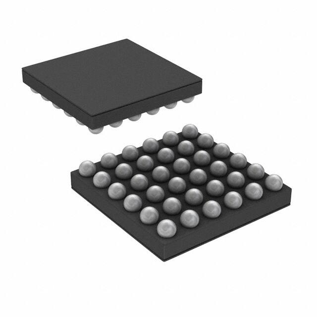

LP39542RL/NOPB
LP39542RL/NOPB
    BURR-BROWN(德州仪器)
    WFBGA36
    IC LED DRIVER RGLTR DIM 36DSBGA
LP39542RL/NOPB 数据手册
LP39542 www.ti.com SNVS503B – APRIL 2007 – REVISED MAY 2013 Advanced Lighting Management Unit Check for Samples: LP39542 FEATURES APPLICATIONS • • • • 1 2 • • • • • • • • • Audio Synchronization for Color/RGB LEDs Command-Based PWM-Controlled RGB LED Drivers Programmable ON/OFF Blinking Sequences for RGB LED High-Current Driver for Flash LED With Built-In Timing and Safety Feature 4+2 or 6 Low-Voltage Constant-Current White LED Drivers With Programmable 8-Bit Adjustment (0...25 mA/LED) High-Efficiency Boost DC-DC Converter I2C Compatible Interface Possibility for External PWM Dimming Control Possibility for Clock Synchronization for RGB Timing Ambient Light and Temperature Sensing Possibility Small package – DSBGA-36, 3.0x3.0x0.6mm Cellular Phones PDAs, MP3 players DESCRIPTION LP39542 is an advanced lighting management unit for handheld devices. It drives any phone lights including display backlights, RGB, keypad and camera flash LEDs. The boost DC-DC converter drives high current loads with high efficiency. White LED backlight drivers are high efficiency low voltage structures with excellent matching and automatic fade in/ fade out function. The stand-alone command based RGB controller is feature rich and easy to configure. Built-in audio synchronization feature allows user to synchronize the color LEDs to audio input. Integrated high current driver can drive camera flash LED or motor/vibra. Internal ADC can be used for ambient light or temperature sensing. The flexible I2C interface allows easy control of LP39542. Small DSBGA package together with minimum number of external components is a best fit for handheld devices. 1 2 Please be aware that an important notice concerning availability, standard warranty, and use in critical applications of Texas Instruments semiconductor products and disclaimers thereto appears at the end of this data sheet. All trademarks are the property of their respective owners. PRODUCTION DATA information is current as of publication date. Products conform to specifications per the terms of the Texas Instruments standard warranty. Production processing does not necessarily include testing of all parameters. Copyright © 2007–2013, Texas Instruments Incorporated LP39542 SNVS503B – APRIL 2007 – REVISED MAY 2013 www.ti.com Typical Applications + CIN CVDD - 10 PF 100 nF CVDDA BATTERY 1 éF L1 4.7 PH D1 FB SW COUT IMAX = 400 mA 10 PF VOUT = 4...5.3V VDD1 VDD2 VDDA CREF VREF 100 nF RRGB IRGB WLED1 WLED2 WLED3 MAIN BACKLIGHT 0...25 mA/LED WLED4 RRT IRT RFLASH WLED5 IFLASH ADDR_SEL NRST SCL MCU WLED6 LP39542 SUB BACKLIGHT 0...25 mA/LED R1 SDA SYNC/PWM G1 VDDIO RGB1 Up to 40 mA/LED B1 CVDDIO 100 nF R2 FLASH_EN CAMERA G2 TEMP SENSOR RGB2 Up to 40 mA/LED B2 or ASE LIGHT SENSOR FLASH or AUDIO INPUT FLASH Up to 400 mA GNDs or 2 Submit Documentation Feedback Copyright © 2007–2013, Texas Instruments Incorporated Product Folder Links: LP39542 LP39542 www.ti.com SNVS503B – APRIL 2007 – REVISED MAY 2013 Connection Diagrams DSBGA-36 Package, 3.0 x 3.0 x 0.6 mm, 0.5 mm pitch, Package Number YZR0036 or DSBGA-36 Package, 3.0 x 3.0 x 0.65 mm, 0.5 mm pitch, Package Number YPG0036 6 6 B1 G1 R1 FLASH FB SW SW FB FLASH R1 G1 B1 5 GND_ RGB IRGB SDA VDDIO GND GND_ SW GND_ SW GND VDDIO SDA IRGB GND_ RGB 5 4 R2 NRST ADDR_ SEL SYNC_ PWM IFLASH GND_ WLED GND_ WLED IFLASH SYNC_ PWM ADDR_ SEL NRST R2 4 3 G2 SCL FLASH _EN VDD1 WLED 6 WLED 5 WLED 5 WLED 6 VDD1 FLASH _EN SCL G2 3 2 B2 GNDT IRT ASE WLED 4 WLED 3 WLED 3 WLED 4 ASE IRT GNDT B2 2 1 VDD2 VDDA VREF GNDA WLED 2 WLED 1 WLED 1 WLED 2 GNDA VREF VDDA VDD2 1 B C D E F E D C A F TOP VIEW B A BOTTOM VIEW Submit Documentation Feedback Copyright © 2007–2013, Texas Instruments Incorporated Product Folder Links: LP39542 3 LP39542 SNVS503B – APRIL 2007 – REVISED MAY 2013 www.ti.com PIN DESCRIPTIONS 4 Pin No. Name Type Description 6F SW Output 6E FB Input Boost Converter Power Switch Boost Converter Feedback 6D FLASH Output High Current Flash Output 6C R1 Output Red LED 1 Output 6B G1 Output Green LED 1 Output 6A B1 Output Blue LED 1 Output 5F GND_SW Ground Power Switch Ground 5E GND Ground Ground 5D VDDIO Power Supply Voltage for Logic Input/Output Buffers and Drivers 5C SDA Logic Input/Output Serial Data In/Out (I2C) 5B IRGB Input 5A GND_RGB Ground Bias Current Set Resistor for RGB Drivers Ground for RGB Currents 4F GND_WLED Ground Ground for WLED Currents 4E IFLASH Input 4D SYNC_PWM Logic Input High Current Flash Current Set Resistor External PWM Control for LEDs or External Clock for RGB Sync 4C ADDR_SEL Logic Input Address Select (I2C) 4B NRST Logic Input Reset Pin 4A R2 Output Red LED 2 Output 3F WLED5 Output White LED 5 Output 3E WLED6 Output White LED 6 Output Supply Voltage 3D VDD1 Power 3C FLASH_EN Logic Input Enable for High Current Flash 3B SCL Logic Input Clock (I2C) 3A G2 Output Green LED 2 Output 2F WLED3 Output White LED 3 Output 2E WLED4 Output White LED 4 Output 2D ASE Input Audio Synchronization Input Oscillator Frequency Resistor 2C IRT Input 2B GNDT Ground Ground 2A B2 Output Blue LED 2 Output 1F WLED1 Output White LED 1 Output 1E WLED2 Output White LED 2 Output 1D GNDA Ground Ground for Analog Circuitry 1C VREF Output Reference Voltage 1B VDDA Power Internal LDO Output 1A VDD2 Power Supply Voltage Submit Documentation Feedback Copyright © 2007–2013, Texas Instruments Incorporated Product Folder Links: LP39542 LP39542 www.ti.com SNVS503B – APRIL 2007 – REVISED MAY 2013 These devices have limited built-in ESD protection. The leads should be shorted together or the device placed in conductive foam during storage or handling to prevent electrostatic damage to the MOS gates. Absolute Maximum Ratings (1) (2) (3) V (SW, FB, R1-2, G1-2, B1-2, FLASH, WLED1-6) (4) (5) -0.3V to +7.2V VDD1, VDD2, VDDIO, VDDA -0.3V to +6.0V Voltage on ASE, IRT, IFLASH, IRGB, VREF -0.3V to VDD1+0.3V with 6.0V max Voltage on Logic Pins -0.3V to VDDIO +0.3V with 6.0V max V(all other pins): Voltage to GND -0.3V to 6.0V 10 μA I (VREF) I(R1, G1, B1, R2, G2, B2) 100 mA I(FLASH) (6) 400 mA Continuous Power Dissipation (7) Internally Limited Junction Temperature (TJ-MAX) 150°C Storage Temperature Range Maximum Lead Temperature (Soldering) -65°C to +150°C (8) (1) (2) (3) (4) (5) (6) (7) (8) (9) 260°C Human Body Model (9) ESD Rating 2 kV Absolute Maximum Ratings indicate limits beyond which damage to the component may occur. Operating Ratings are conditions under which operation of the device is ensured. Operating Ratings do not imply performance limits. For performance limits and associated test conditions, see the Electrical Characteristics tables. All voltages are with respect to the potential at the GND pins. If Military/Aerospace specified devices are required, please contact the TI Sales Office/Distributors for availability and specifications. Battery/Charger voltage should be above 6V no more than 10% of the operational lifetime. Voltage tolerance of LP39542 above 6.0V relies on fact that VDD1 and VDD2 (2.8V) are available (ON) at all conditions. If VDD1 and VDD2 are not available (ON) at all conditions, Texas Instuments does not ensure any parameters or reliability for this device. The total load current of the boost converter in worst-case conditions is limited to 300 mA (min. input and max. output voltage). Internal thermal shutdown circuitry protects the device from permanent damage. Thermal shutdown engages at TJ=160°C (typ.) and disengages at TJ=140°C (typ.). For detailed soldering specifications and information, see Application Note AN-1112 : DSBGA Wafer Level Chip Scale Package SNVA009or Application Note AN-1412: Micro DSBGA Wafer Lever Chip Scale Package SNVA131 The Human body model is a 100 pF capacitor discharged through a 1.5 kΩ resistor into each pin. Operating Ratings (1) (2) V (SW, FB, WLED1-6, R1-2, G1-2, B1-2, FLASH) 0 to 6.0V VDD1,2 with external LDO 2.7 to 5.5V VDD1,2 with internal LDO 3.0 to 5.5V VDDA 2.7 to 2.9V VDDIO 1.65V to VDD1 Voltage on ASE 0.1V to VDDA –0.1V Recommended Load Current 0 mA to 400 mA Junction Temperature (TJ) -30°C to +125°C Ambient Temperature (TA) (3) (1) (2) (3) -30°C to +85°C Absolute Maximum Ratings indicate limits beyond which damage to the component may occur. Operating Ratings are conditions under which operation of the device is ensured. Operating Ratings do not imply performance limits. For performance limits and associated test conditions, see the Electrical Characteristics tables. All voltages are with respect to the potential at the GND pins. In applications where high power dissipation and/or poor package thermal resistance is present, the maximum ambient temperature may have to be derated. Maximum ambient temperature (TA-MAX) is dependent on the maximum operating junction temperature (TJ-MAX-OP = 125°C), the maximum power dissipation of the device in the application (PD-MAX), and the junction-to ambient thermal resistance of the part/package in the application (θJA), as given by the following equation: TA-MAX = TJ-MAX-OP – (θJA × PD-MAX). Thermal Properties Junction-to-Ambient Thermal Resistance(θJA) (1) (1) 60°C/W Junction-to-ambient thermal resistance is highly application and board-layout dependent. In applications where high maximum power dissipation exists, special care must be paid to thermal dissipation issues in board design. Submit Documentation Feedback Copyright © 2007–2013, Texas Instruments Incorporated Product Folder Links: LP39542 5 LP39542 SNVS503B – APRIL 2007 – REVISED MAY 2013 Electrical Characteristics www.ti.com (1) (2) Limits in standard typeface are for TJ = 25°C. Limits in boldface type apply over the operating ambient temperature range (30°C < TA < +85°C). Unless otherwise noted, specifications apply to the LP39542 Block Diagram with: VDD1 = VDD2 = 3.6V, VDDIO = 2.8V, CVDD = CVDDIO = 100 nF, COUT = CIN = 10 μF, CVDDA = 1 μF, CREF = 100 nF, L1 = 4.7 μH, RFLASH = 910Ω, RRGB = 5.6 kΩ and RRT = 82 kΩ (3). Symbol IVDD 6 Test Conditions Min Typ Max Unit 1 8 μA Standby supply current (VDD1 + VDD2) NSTBY (bit) = L, NRST (pin) = H SCL=H, SDA = H No-boost supply current (VDD1 + VDD2) NSTBY (bit) = H, EN_BOOST(bit) = L SCL = H, SDA = H Audio sync and LEDs OFF 450 μA No-load supply current (VDD1 + VDD2) NSTBY (bit) = H, EN_BOOST (bit) = H SCL = H, SDA = H Audio sync and LEDs OFF Autoload OFF 1 mA RGB drivers (VDD1 + VDD2) CC mode at R1, G1, B1 and R2, G2, B2 set to 15 mA 150 SW mode 150 WLED drivers (VDD1 + VDD2) 4+2 banks IOUT = 25.5 mA per LED 500 μA Audio synchronization (VDD1 + VDD2) Audio sync ON VDD1,2 = 2.8V 390 μA VDD1,2 = 3.6V 700 Flash (VDD1 + VDD2) I(RFLASH) = 1 mA Peak current during flash IVDDIO VDDIO standby supply current NSTBY (bit)=L SCL = H, SDA = H IEXT_LDO External LDO output current (VDD1, VDD2, VDDA) 7V tolerant application only IBOOST = 300 mA Output voltage of internal LDO for analog parts See VDDA (1) (2) (3) (4) Parameter (4) μA 2 2.72 2.80 -3 mA 1 μA 6.5 mA 2.88 V +3 % All voltages are with respect to the potential at the GND pins. Min and Max limits are specified by design, test, or statistical analysis. Typical numbers represent the most likely norm. Low-ESR Surface-Mount Ceramic Capacitors (MLCCs) used in setting electrical characteristics. VDDA output is not recommended for external use. Submit Documentation Feedback Copyright © 2007–2013, Texas Instruments Incorporated Product Folder Links: LP39542 LP39542 www.ti.com SNVS503B – APRIL 2007 – REVISED MAY 2013 BLOCK DIAGRAM L1 4.7 µH IMAX = 400 mA VOUT = 4...5.3 V D1 + SW - CVDD CIN 10 µF 100 nF COUT 10 µF FB VDD1 VDD2 Logic supply BG PWM Li-Ion Battery Or Charger VDDA LDO POR GND_SW VREF BOOST REF CVDDA 1 µF THSD WLED1 CREF 100 nF 8-Bit IDAC WLED2 IRGB BIAS OSC D IRT WLED3 A MAIN BACKLIGHT 0...25 mA/LED WLED4 GND_WLED RRGB RRT 8-Bit IDAC SCL SDA SYNC/PWM VDDIO INTERFACE MCU I2C R1 RGB1 Up to 40 mA/LED G1 OUTPUT SELECTOR COMMAND BASED PATTERN GENERATOR ASE SUB BACKLIGHT 0...25 mA/LED A CVDDIO 100 nF SINGLE ENDED ANALOG AUDIO WLED6 D CONTROL NRST ADDR_SEL WLED5 B1 R2 RGB2 Up to 40 mA/LED G2 B2 AUDIO SYNC GND_RGB FLASH CAMERA EN_FLASH FLASH Up to 400 mA FLASH CT CTRL RL FLASH LOGIC IFLASH GNDA GND GNDT RFLASH Submit Documentation Feedback Copyright © 2007–2013, Texas Instruments Incorporated Product Folder Links: LP39542 7 LP39542 SNVS503B – APRIL 2007 – REVISED MAY 2013 www.ti.com DETAILED DESCRIPTION Modes of Operation RESET: In the RESET mode all the internal registers are reset to the default values and the chip goes to STANDBY mode after reset. NSTBY control bit is low after reset by default. Reset is active always if NRST input pin is low or internal Power On Reset is active. LP39542 can be also reset by writing any data to Reset Register in address 60H. Power On Reset (POR) will activate during the chip startup or when the supply voltage VDD2 falls below 1.5V. Once VDD2 rises above 1.5V, POR will inactivate and the chip will continue to the STANDBY mode. STANDBY: The STANDBY mode is entered if the register bit NSTBY is LOW. This is the low power consumption mode, when all circuit functions are disabled. Registers can be written in this mode and the control bits are effective immediately after power up. STARTUP: When NSTBY bit is written high, the INTERNAL STARTUP SEQUENCE powers up all the needed internal blocks (Vref, Bias, Oscillator etc..). To ensure the correct oscillator initialization, a 10 ms delay is generated by the internal state-machine. If the chip temperature rises too high, the Thermal Shutdown (TSD) disables the chip operation and STARTUP mode is entered until no thermal shutdown event is present. BOOST STARTUP: Soft start for boost output is generated in the BOOST STARTUP mode. The boost output is raised in PFM mode during the 10 ms delay generated by the state-machine. The Boost startup is entered from Internal Startup Sequence if EN_BOOST is HIGH or from Normal mode when EN_BOOST is written HIGH. During the 10 ms Boost Startup time all LED outputs are switched off to ensure smooth start-up. NORMAL: During NORMAL mode the user controls the chip using the Control Registers. The registers can be written in any sequence and any number of bits can be altered in a register in one write RESET 2 NSTBY (bit) = L and NRST = H I C reset or NRST = L or POR = H STANDBY NSTBY (bit) = H and NRST = H NSTBY (bit) = L and NRST = H INTERNAL STARTUP SEQUENCE TSD = H VREF = 95% OK* ~10 ms Delay EN_BOOST (bit) = H* EN_BOOST (bit) = L* BOOST STARTUP EN_BOOST (bit) rising edge* ~10 ms Delay NORMAL MODE 8 Submit Documentation Feedback * TSD = L Copyright © 2007–2013, Texas Instruments Incorporated Product Folder Links: LP39542 LP39542 www.ti.com SNVS503B – APRIL 2007 – REVISED MAY 2013 Magnetic Boost DC/DC Converter The LP39542 Boost DC/DC Converter generates a 4.0 – 5.3V voltage for the LEDs from single Li-Ion battery (3V…4.5V). The output voltage is controlled with an 8-bit register in 9 steps. The converter is a magnetic switching PWM mode DC/DC converter with a current limit. The converter has three options for switching frequency, 1 MHz, 1.67 MHz and 2 MHz (default), when timing resistor RT is 82 kΩ. Timing resistor defines the internal oscillator frequency and thus directly affects boost frequency and all circuit's internally generated timing (RGB, Flash, WLED fading). The LP39542 Boost Converter uses pulse-skipping elimination to stabilize the noise spectrum. Even with light load or no load a minimum length current pulse is fed to the inductor. An active load is used to remove the excess charge from the output capacitor at very light loads. At very light load and when input and output voltages are very close to each other, the pulse skipping is not completely eliminated. Output voltage should be at least 0.5V higher than input voltage to avoid pulse skipping. Reducing the switching frequency will also reduce the required voltage difference. Active load can be disabled with the en_autoload bit. Disabling will increase the efficiency at light loads, but the downside is that pulse skipping will occur. The Boost Converter should be stopped when there is no load to minimise the current consumption. The topology of the magnetic boost converter is called CPM control, current programmed mode, where the inductor current is measured and controlled with the feedback. The user can program the output voltage of the boost converter. The output voltage control changes the resistor divider in the feedback loop. Figure 1 shows the boost topology with the protection circuitry. Four different protection schemes are implemented: 1. Over voltage protection, limits the maximum output voltage – Keeps the output below breakdown voltage. – Prevents boost operation if battery voltage is much higher than desired output. 2. Over current protection, limits the maximum inductor current – Voltage over switching NMOS is monitored; too high voltages turn the switch off. 3. Feedback break protection. Prevents uncontrolled operation if FB pin gets disconnected. 4. Duty cycle limiting, done with digital control. 2 MHz clock VIN Duty control VOUT SW FBNCCOMP FB + - R S R OVPCOMP SWITCH + - R RESETCOMP + ERRORAMP SLOPER + - + - R + - R OLPCOMP ACTIVE LOAD LOOPC Figure 1. Boost Converter Topology Submit Documentation Feedback Copyright © 2007–2013, Texas Instruments Incorporated Product Folder Links: LP39542 9 LP39542 SNVS503B – APRIL 2007 – REVISED MAY 2013 www.ti.com Magnetic Boost DC/DC Converter Electrical Characteristics Symbol Parameter Test Conditions Min Typ Max 3.0V ≤ VIN VOUT = 5V 0 300 3.0V ≤ VIN VOUT = 4V 0 400 Output Voltage Accuracy (FB Pin) 3.0V ≤ VIN ≤ VOUT - 0.5 VOUT = 5.0V −5 +5 Output Voltage (FB Pin) 1 mA ≤ ILOAD ≤ 300 mA VIN > 5V + V(SCHOTTKY) RDSON Switch ON Resistance VDD1,2 = 2.8V, ISW = 0.5A fboost PWM Mode Switching Frequency RT = 82 kΩ freq_sel[2:0] = 1XX Frequency Accuracy 2.7 ≤ VDDA ≤ 2.9 −6 RT = 82 kΩ −9 ILOAD Load Current VOUT Unit mA VIN–V(SCHOTTKY) 0.4 V 0.8 2 ±3 % Ω MHz +6 +9 % tPULSE Switch Pulse Minimum Width no load 25 ns tSTARTUP Startup Time Boost startup from STANDBY 10 ms ISW_MAX SW Pin Current Limit 700 800 550 900 950 mA BOOST STANDBY MODE User can stop the Boost Converter operation by writing the Enables register bit EN_BOOST low. When EN_BOOST is written high, the converter starts for 10 ms in PFM mode and then goes to PWM mode. BOOST OUTPUT VOLTAGE CONTROL User can control the boost output voltage by boost output 8-bit register. Boost Output [7:0] Register 0DH 10 Boost Output Voltage (typical) Bin Hex 0000 0000 00 4.00 0000 0001 01 4.25 0000 0011 03 4.40 0000 0111 07 4.55 0000 1111 0F 4.70 0001 1111 1F 4.85 0011 1111 3F 5.00 Default 0111 1111 7F 5.15 1111 1111 FF 5.30 Submit Documentation Feedback Copyright © 2007–2013, Texas Instruments Incorporated Product Folder Links: LP39542 LP39542 www.ti.com SNVS503B – APRIL 2007 – REVISED MAY 2013 Figure 2. Boost Output Voltage Control OUTPUT VOLTAGE (200 mV/DIV) 5. 4 5. 2 5. 0 4. 8 4. 6 4. 4 VIN = 3.6V I LOAD = 50 mA 4. 2 Control = 00»FF»00 4. 0 0 0.2 0.4 0.6 0.8 1.0 1.2 1. 4 TIME ( 200 Ps/ DIV) BOOST FREQUENCY CONTROL (1) freq_sel[2:0] (1) frequency 1XX 2.00 MHz 01X 1.67 MHz 001 1.00 MHz Register ‘boost freq’ (address 0EH). Register default value after reset is 07H. Boost Converter Typical Performance Characteristics Vin = 3.6V, Vout = 5.0V if not otherwise stated Boost Typical Waveforms at 100mA Load (5V/DIV) VSWITCH ICOIL 100 mA AVERAGE (100 mA/DIV) VOUT = 5.0V (10 mV/DIV) Boost Converter Efficiency TIME (200 ns/DIV) Submit Documentation Feedback Copyright © 2007–2013, Texas Instruments Incorporated Product Folder Links: LP39542 11 LP39542 SNVS503B – APRIL 2007 – REVISED MAY 2013 www.ti.com Vin = 3.6V, Vout = 5.0V if not otherwise stated 12 Battery Current vs Voltage Battery Current vs Voltage Boost Line Regulation Boost Startup with No Load Boost Load Transient, 50 mA–100 mA Boost Switching Frequency Submit Documentation Feedback Copyright © 2007–2013, Texas Instruments Incorporated Product Folder Links: LP39542 LP39542 www.ti.com SNVS503B – APRIL 2007 – REVISED MAY 2013 Vin = 3.6V, Vout = 5.0V if not otherwise stated Efficiency at Low Load vs Autoload 5.2 90 5.0 80 4.8 70 EFFICIENCY (%) OUTPUT VOLTAGE (V) Output Voltage vs Load Current 4.6 VIN = 3V 4.4 f = 2 MHz L - TDK VLF0410 4.7 PH CIN = COUT = 10 PF 4.2 60 50 40 Autoload ON Autoload OFF 4.0 30 3.8 20 3.6 0 100 200 300 400 0 500 5 10 15 20 30 25 LOAD CURRENT (mA) OUTPUT CURRENT (mA) Functionality of Color LED Outputs (R1, G1, B1; R2, G2, B2) LP39542 has 2 sets of RGB/color LED outputs. Both sets have 3 outputs and the sets can be controlled in 4 different ways: 1. Command based pattern generator control (internal PWM) 2. Audio synchronization control 3. Programmable ON/OFF blinking sequences for RGB1 4. External PWM control By using command based pattern generator user can program any kind of color effect patterns. LED intensity, blinking cycles and slopes are independently controlled with 8 16-bit commands. Also real time commands are possible as well as loops and step by step control. If analog audio is available on system, the user can use audio synchronization for synchronizing LED blinking to the music. The different modes together with the various sub modes generate very colorful and interesting lighting effects. Direct ON/OFF control is mainly for switching on and off LEDs. External PWM control is for applications where external PWM signal is available and required to control the color LEDs. PWM signal can be connected to any color LED separately as shown later. COLOR LED CONTROL MODE SELECTION The RGB_SEL[1:0] bits in the Enables register (08H) control the output modes for RGB1 (R1, G1, B1) and RGB2 (R2, G2, B2) outputs as seen in the following table. RGB_SEL[1:0] Audio sync Pattern generator 00 - RGB1 & RGB2 Blinking control - 01 - RGB2 RGB1 10 RGB2 RGB1 - 11 RGB1 & RGB2 - - RGB Control register (00H) has control bits for direct on/off control of all color LEDs. Note that the LEDs have to be turned on in order to control them with audio synchronization or pattern generator. The external PWM signal can control any LED depending on the control register setup. External PWM signal is connected to PWM/SYNC pin. The controls are in the Ext. PWM Control register (address 07H) except the FLASH control in HC_Flash (10H) register as follows: Submit Documentation Feedback Copyright © 2007–2013, Texas Instruments Incorporated Product Folder Links: LP39542 13 LP39542 SNVS503B – APRIL 2007 – REVISED MAY 2013 www.ti.com Ext. PWM Control (07H) (1) wled1-4_pwm bit 7 PWM controls WLED 1-4 wled5-6_pwm bit 6 PWM controls WLED 5-6 r1_pwm bit 5 PWM controls R1 output g1_pwm bit 4 PWM controls G1 output b1_pwm bit 3 PWM controls B1 output r2_pwm bit 2 PWM controls R2 output g2_pwm bit 1 PWM controls G2 output b2_pwm bit 0 PWM controls B2 output hc_pwm bit 5 PWM controls FLASH HC_Flash (10H) (1) Note: If DISPL=1, wled1-4pwm controls WLED1-6 Note: Maximum external PWM frequency is 1kHz. If during the external PWM control the internal PWM is on, the result will be product of both functions. CURRENT CONTROL OF COLOR LED OUTPUTS (R1, R2, G1, G2, B1, B2) Both RGB output sets can be separately controlled as constant current sinks or as switches. This is done using cc_rgb1/2 bits in the RGB control register. In constant current mode one or both RGB output sets are controlled with constant current sinks (no external ballast resistors required). The maximum output current for both drivers is set by one external resistor RRGB. User can decrease the maximum current for an individual LED driver by programming as shown later. The maximum current for all RGB drivers is set with RRGB. The equation for calculating the maximum current is IMAX = 100 × 1.23V / (RRGB + 50Ω) (1) where IMAX - maximum RGB current in any RGB output in constant current mode 1.23V - reference voltage 100 - internal current mirror multiplier RRGB- resistor value in Ohms 50Ω - internal resistor in the IRGB input For example if 22mA is required for maximum RGB current RRGB equals to RRGB=100×1.23V / IMAX–50Ω=123V / 0.022A–50Ω=5.54kΩ (2) Each individual RGB output has a separate maximum current programming. The control bits are in registers RGB1 max current and RGB2 max current (12H and 13H) and programming is shown in table below. The default value after reset is 00b. IR1[1:0], IG1[1:0], IB1[1:0], IR2[1:0], IG2[1:0], IB2[1:0] Maximum current/output 00 0.25 × IMAX 01 0.50 × IMAX 10 0.75 × IMAX 11 1.00 × IMAX SWITCH MODE The switch mode is used if there is a need to connect parallel LEDs to output or if the RGB output current needs to be increased. Please note that the switch mode requires an external ballast resistors at each output to limit the LED current. The switch/current mode and on/off controls for RGB are in the RGB_ctrl register (00H). 14 Submit Documentation Feedback Copyright © 2007–2013, Texas Instruments Incorporated Product Folder Links: LP39542 LP39542 www.ti.com SNVS503B – APRIL 2007 – REVISED MAY 2013 Table 1. RGB_ctrl register (00H) CC_RGB1 bit7 CC_RGB2 bit6 r1sw bit5 g1sw bit4 b1sw bit3 r2sw bit2 g2sw bit1 b2sw bit0 1 R1, G1 and B1 are switches → limit current with ballast resistor 0 R1, G1 and B1 are constant current sinks, current limited internally 1 R2, G2 and B2 are switches → limit current with ballast resistor 0 R2, G2 and B2 are constant current sinks, current limited internally 1 R1 is on 0 R1 is off 1 G1 is on 0 G1 is off 1 B1 is on 0 B1 is off 1 R2 is on 0 R2 is off 1 G2 is on 0 G2 is off 1 B2 is on 0 B2 is off VOUT R1 R1 RR2 R1 control G1 VOUT RR1 R1 control RG1 G1 RG2 G1 control G1 control B1 RB1 B1 RB2 B1 control B1 control RGB1 output as switch (SW) RGB1 output as a constant current sink (CC) Command Based Pattern Generator for Color LEDs The LP39542 has an unique stand-alone command based pattern generator with 8 user controllable 16-bit commands. Since registers are 8-bit long one command requires 2 write cycles. Each command has intensity level for each LED, command execution time (CET) and transition time (TT) as seen in Figure 3. Submit Documentation Feedback Copyright © 2007–2013, Texas Instruments Incorporated Product Folder Links: LP39542 15 LP39542 SNVS503B – APRIL 2007 – REVISED MAY 2013 www.ti.com 16 bits RED[2:0] GREEN[2:0] CET [3:0] BLUE[2:0] TT[2:0] 16 bits ADDESS[7:0] RED[2:0] GREEN[2:0] CET[3:2] 16 bits CET[1:0] NEXT ADDESS[7:0] BLUE[2:0] TT[2:0] Figure 3. COMMAND REGISTER WITH 8 COMMANDS COMMAND 1 COMMAND 2 COMMAND 3 COMMAND 4 ADDRESS 50H R2 R1 R0 G2 G1 G0 CET3 CET2 ADDRESS 51H CET1 CET0 B2 B1 B0 TT2 TT1 TT0 CET2 ADDRESS 52H R2 R1 R0 G2 G1 G0 CET3 ADDRESS 53H CET1 CET0 B2 B1 B0 TT2 TT1 TT0 ADDRESS 54H R2 R1 R0 G2 G1 G0 CET3 CET2 ADDRESS 55H CET1 CET0 B2 B1 B0 TT2 TT1 TT0 CET2 ADDRESS 56H R2 R1 R0 G2 G1 G0 CET3 ADDRESS 57H CET1 CET0 B2 B1 B0 TT2 TT1 TT0 COMMAND 5 ADDRESS 58H R2 R1 R0 G2 G1 G0 CET3 CET2 ADDRESS 59H CET1 CET0 B2 B1 B0 TT2 TT1 TT0 COMMAND 6 ADDRESS 5AH R2 R1 R0 G2 G1 G0 CET3 CET2 ADDRESS 5BH CET1 CET0 B2 B1 B0 TT2 TT1 TT0 CET2 COMMAND 7 COMMAND 8 ADDRESS 5CH R2 R1 R0 G2 G1 G0 CET3 ADDRESS 5DH CET1 CET0 B2 B1 B0 TT2 TT1 TT0 ADDRESS 5EH R2 R1 R0 G2 G1 G0 CET3 CET2 ADDRESS 5FH CET1 CET0 B2 B1 B0 TT2 TT1 TT0 COLOR INTENSITY CONTROL Each color has 3-bit intensity level. Level control is logarithmic, 2 curves are selectable. The LOG bit in register 11H defines the curve used as seen in the following table. R[2:0], G[2:0], B[2:0] LOG=0 LOG=1 0 0 001 7 1 010 14 2 011 21 4 100 32 10 101 46 21 110 71 46 111 100 100 000 16 CURRENT [% × IMAX(COLOR)] Submit Documentation Feedback Copyright © 2007–2013, Texas Instruments Incorporated Product Folder Links: LP39542 LP39542 www.ti.com SNVS503B – APRIL 2007 – REVISED MAY 2013 100 LOG=0 % IMAX 80 LOG=1 60 40 20 0 000 001 010 011 100 101 110 111 R[2:0], G[2:0], B[2:0] COMMAND EXECUTION TIME (CET) AND TRANSITION TIME (TT) The command execution CET time is the duration of one single command. Command execution times CET are defined as follows, when RT=82kΩ: CET [3:0] CET duration, ms 0000 197 0001 393 0010 590 0011 786 0100 983 0101 1180 0110 1376 0111 1573 1000 1769 1001 1966 1010 2163 1011 2359 1100 2556 1101 2753 1110 2949 1111 3146 Transition time TT is duration of transition from the previous RGB value to programmed new value. Transition times TT are defined as follows: TT [2:0] Transition time, ms 000 0 001 55 010 110 011 221 100 442 101 885 110 1770 111 3539 Submit Documentation Feedback Copyright © 2007–2013, Texas Instruments Incorporated Product Folder Links: LP39542 17 LP39542 SNVS503B – APRIL 2007 – REVISED MAY 2013 www.ti.com Figure 4 shows an example of RGB CET and TT times. COMMAND EXECUTION TIME = CET1 CET2 TT2 TRANSITION TIME = TT1 CET3 TT3 BLUE GREEN RED TT < CET Figure 4. The command execution time also may be less than the transition time – Figure 5 illuminates this case. TRANSITION TIME = TT1 COMMAND EXECUTION TIME = CET1 CET3 CET2 TT2 TT3 Target values BLUE GREEN RED TT1 > CET1 TT2 < CET2 TT3 < CET3 Figure 5. LOOP CONTROL Pattern generator commands can be looped using the LOOP bit (D1) in Pattern gen ctrl register (11H). If LOOP=1 the program will be looped from the command 8 register or if there is 0000 0000 and 0000 0000 in one command register. The loop will start from command 1 and continue until stopped by writing rgb_start=0 or loop=0. The example of loop is shown in Figure 6. 18 Submit Documentation Feedback Copyright © 2007–2013, Texas Instruments Incorporated Product Folder Links: LP39542 LP39542 www.ti.com SNVS503B – APRIL 2007 – REVISED MAY 2013 IF 0000 0000 and 0000 0000 then Æ LOOP LOOP=1 ADDRESS 50H COMMAND 1 ADDRESS 51H ADDRESS 52H COMMAND 2 ADDRESS 53H ADDRESS 54H 0 0 0 0 0 0 0 0 ADDRESS 55H 0 0 0 0 0 0 0 0 COMMAND 3 Figure 6. SINGLE PROGRAM If control bit LOOP=0 the program will start from Command 1 and run to either last command or to empty “0000 0000 / 0000 0000” command. IF 0000 0000 and 0000 0000 then Æ STOP LOOP=0 ADDRESS 50H start COMMAND 1 ADDRESS 51H ADDRESS 52H COMMAND 2 ADDRESS 53H stop ADDRESS 54H 0 0 0 0 0 0 0 0 ADDRESS 55H 0 0 0 0 0 0 0 0 COMMAND 3 Figure 7. The LEDs maintain the brightness of the last command when the single program stops. Changes in command register will not be effective in this phase. The RGB_START bit has to be toggled off and on to make changes effective. START BIT Pattern_gen_ctrl register’s RGB_START bit will enable command execution starting from Command 1. Pattern gen ctrl register (11H) rgb_start Bit 2 0 – Pattern generator disabled 1 – execution pattern starting from command 1 loop Bit 1 0 – pattern generator loop disabled (single pattern) 1 – pattern generator loop enabled (execute until stopped) log Bit 0 0 – color intensity mode 0 1 – color intensity mode 1 Audio Synchronization The color LEDs connected to RGB outputs can be synchronized to incoming audio with Audio Synchronization feature. Audio Sync has 2 modes. Amplitude mode synchronizes color LEDs based on input signal’s peak amplitude. In the amplitude mode the user can select between 3 different amplitude mapping modes and 4 different speed configurations. The frequency mode synchronizes the color LEDs based on bass, middle and treble amplitudes (= low pass, band pass and high pass filters). User can select between 2 different frequency responses and 4 different speed configurations for best audio-visual user experience. Programmable gain and AGC function are also available for adjustment of input signal amplitude to light response. The Audio Sync functionality is described more closely below. Submit Documentation Feedback Copyright © 2007–2013, Texas Instruments Incorporated Product Folder Links: LP39542 19 LP39542 SNVS503B – APRIL 2007 – REVISED MAY 2013 www.ti.com USING A DIGITAL PWM AUDIO SIGNAL AS AN AUDIO SYNCHRONIZATION SOURCE If the input signal is a PWM signal, use a first or second order low pass filter to convert the digital PWM audio signal into an analog waveform. There are two parameters that need to be known to get the filter to work successfully: frequency of the PWM signal and the voltage level of the PWM signal. Suggested cut-off frequency (-3 dB) should be around 2 kHz to 4 kHz and the stop-band attenuation at sampling frequency should be around -48 dB or better. Use a resistor divider to reduce the digital signal amplitude to meet the specification of the analog audio input. Because a low-order low-pass filter attenuates the high-frequency components from audio signal, MODE_CTRL=01b selection is recommended when frequency synchronization mode is enabled. Application example 5 shows an example of a second order RC-filter for 29 kHz PWM signal with 3.3V amplitude. Active filters, such as a Sallen-Key filter, may also be applied. An active filter gives better stop-band attenuation and cut-off frequency can be higher than for a RC-filter. To make sure that the filter rolls off sufficiently quickly, connect your filter circuit to the audio input(s), turn on the audio synchronization feature, set manual gain to maximum, apply the PWM signal to the filter input and keep an eye on LEDs. If they are blinking without an audio signal (modulation), a sharper roll-off after the cut-off frequency, more stop-band attenuation, or smaller amplitude of the PWM signal is required. AUDIO SYNCHRONIZATION SIGNAL PATH LP39542 audio synchronization is mainly done digitally and it consists of the following signal path blocks: • Input Buffers • AD Converter • DC Remover • Automatic Gain Control (AGC) • Programmable Gain • 3 Band Digital Filter • Peak Detector • Look-up Tables (LUT) • Mode Selector • Integrators • PWM Generator • Output Drivers EN GAIN SPEED 3 FILTERS ASE BUFFER ADC DC REMOVER MODE HIGH / LOW LUT INT AGC PEAK DETECTOR PW M LED DRIVER R G B LUT Figure 8. The digitized input signal has DC component that is removed by digital DC REMOVER (-3 dB @ 400 Hz). Since the light response of input audio signal is very much amplitude dependent the AGC adjusts the input signal to suitable range automatically. User can disable AGC and the gain can be set manually with PROGRAMMABLE GAIN. LP39542 has 2 audio synchronization modes: amplitude and frequency. For amplitude based synchronization the PEAK DETECTION method is used. For frequency based synchronization 3 BAND FILTER separates high pass, low pass and band bass signals. For both modes the predefined LUT is used to optimize the audio visual effect. MODE SELECTOR selects the synchronization mode. Different response times to music beat can be selected using INTEGRATOR speed variables. Finally PWM GENERATOR sets the driver FET duty cycles. 20 Submit Documentation Feedback Copyright © 2007–2013, Texas Instruments Incorporated Product Folder Links: LP39542 LP39542 www.ti.com SNVS503B – APRIL 2007 – REVISED MAY 2013 INPUT SIGNAL TYPE AND BUFFERING LP39542 supports single ended audio input as shown in Figure 9. The electric parameters of the buffer are described in the Audio Synch table. The buffer is rail-to-rail input operational amplifier connected as a voltage follower. DC level of the input signal is set by a simple resistor divider VDDA 1 M: 10 nF ASE 1 M: GNDA Figure 9. AUDIO SYNCHRONIZATION ELECTRICAL PARAMETERS Symbol Parameter Conditions ZIN Input Impedance of ASE AIN Audio Input Level Range (peak-to-peak) f3dB Crossover Frequencies (-3 dB) Gain = 21 dB Min Typical 250 500 Wide Frequency Response Unit kΩ 0.1 V Gain = 0 dB Narrow Frequency Response Max VDDA-0.1 Low Pass 0.5 Band Pass 1.0 and 1.5 High Pass 2.0 Low Pass 1.0 Band Pass 2.0 and 3.0 High Pass 4.0 kHz CONTROL OF ADC AND AUDIO SYNCHRONIZATION The following table describes the controls required for audio synchronization. Audio_sync_CTRL1 (2AH) Input signal gain control. Range 0...21 dB, step 3 dB: GAIN_SEL[2:0] Bits 7-5 [000] = 0 dB (default) [011] = 9 dB [110] = 18 dB [001] = 3 dB [100] = 12 dB [111] = 21 dB [010] = 6 dB [101] = 15 dB SYNC_MODE Bit 4 Synchronization mode selector. SYNCMODE = 0 → Amplitude Mode (default) SYNCMODE = 1 → Frequency Mode EN_AGC Bit 3 Automatic Gain Control enable 1 = enabled 0 = disabled (Gain Select enabled) (default) EN_SYNC Bit 2 Audio synchronization enable 1 = Enabled Note : If AGC is enabled, AGC gain starts from current GAIN_SEL gain value. 0 = Disabled (default) INPUT_SEL[1:0] Bits 1-0 [00] = Single ended input signal, ASE. [01] = Temperature measurement [10] = Ambient light measurement [11] = No input (default) Submit Documentation Feedback Copyright © 2007–2013, Texas Instruments Incorporated Product Folder Links: LP39542 21 LP39542 SNVS503B – APRIL 2007 – REVISED MAY 2013 www.ti.com Audio_sync_CTRL2 (2BH) 0 – averaging disabled (not applicable in audio sync mode) 1 – averaging enabled (not applicable in audio sync mode) EN_AVG Bit 4 MODE_CTRL[1:0] Bits 3-2 See below: Mode control Bits 1-0 Sets the LEDs light response time to audio input. [00] = FASTEST (default) [01] = FAST [10] = MEDIUM [11] = SLOW (For SLOW setting in amplitude mode fMAX= 3.8 Hz, Frequency mode fMAX = 7.6 Hz) SPEED_CTRL[1:0] MODE CONTROL IN FREQUENCY MODE Mode control has two setups based on audio synchronization mode select: the frequency mode and the amplitude mode. During the frequency mode user can select two filter options by MODE_CTRL as shown below. User can select the filters based on the music type and light effect requirements. In the first mode the frequency range extends to 8 kHz in the secont to 4 kHz. The lowpass filter is used for the red, the bandpass filter for the blue and the hipass filter for the green LED. Figure 10. Higher frequency mode MODE_CTRL = 00 and SYNC_MODE = 1 0 -10 BANDPASS LOWPASS HIPASS -20 -30 dB -40 -50 -60 -70 -80 -90 -100 0 1.0 2.0 3.0 4.0 5.0 6.0 7.0 8.0 kHz Figure 11. Lower frequency mode MODE_CTRL = 01 and SYNC_MODE = 1 0 -10 BANDPASS LOWPASS HIPASS -20 -30 dB -40 -50 -60 -70 -80 -90 -100 0 0.5 1.0 1.5 2.0 2.5 3.0 3.5 4.0 kHz 22 Submit Documentation Feedback Copyright © 2007–2013, Texas Instruments Incorporated Product Folder Links: LP39542 LP39542 www.ti.com SNVS503B – APRIL 2007 – REVISED MAY 2013 MODE CONTROL IN AMPLITUDE MODE During the amplitude synchronization mode user can select between three different amplitude mappings by using MODE_CTRL select. These three mapping options give different light response. The modes are presented in the following graphs. Non-overlapping mode MODE_CTRL[1:0] = [01] Partly overlapping mode MODE_CTRL[1:0] = [00] 100 100 90 90 BLUE GREEN RED 70 60 50 40 30 GREEN RED 70 60 50 40 30 20 20 10 10 0 0 0 10 20 30 40 50 60 70 80 90 100 0 10 20 30 40 50 60 70 80 90 100 INPUT AMPLITUDE (%) INPUT AMPLITUDE (%) Overlapping mode MODE_CTRL[1:0] = [10] Peak Input Signal Level Range vs Gain Setting 5.00 100 GREEN PEAK INPUT SIGNAL VPP (V) BLUE 90 80 INTENSITY (%) BLUE 80 INTENSITY (%) INTENSITY (%) 80 70 60 50 40 30 20 RED 10 3.00 2.50 2.00 1.50 1.00 0.50 0.30 0.25 0.20 0.15 0.10 0.05 0 0 10 20 30 40 50 60 70 80 90 100 0 3 6 9 12 15 18 21 GAIN (dB) INPUT AMPLITUDE (%) RGB Output Synchronization to External Clock The RGB pattern generator and high current flash driver timing can be synchronized to external clock with following configuration. 1. Set PWM_SYNC bit in Enables register to 1 2. Feed SYNC/PWM pin with 5 MHz clock By this the internal 5 MHz clock is disabled from pattern generator and flash timing circuitry. The external clock signal frequency will fully determine the timings related to RGB and Flash. Note: The boost converter will use internal 5 MHz clock even if the external clock is available. Submit Documentation Feedback Copyright © 2007–2013, Texas Instruments Incorporated Product Folder Links: LP39542 23 LP39542 SNVS503B – APRIL 2007 – REVISED MAY 2013 www.ti.com RGB LED Blinking Control LP39542 has a possibility to drive indicator LEDs with RGB1 outputs with programmable blinking time. Blinking function is enabled with RGB_SEL[1:0] bits set as 01b in 0BH register. R1_CYCLE_EN, G1_CYCLE_EN and B1_CYCLE_EN bits in cycle registers (02H, 04H and 06H) enable/disable blinking function for corresponding output. When EN_BLINK bit is written high in register 11H, the blinking sequences for all outputs (which has CYCLE_EN bit enabled) starts simultaneously. EN_BLINK bit should be written high after selecting wanted blinking sequences and enabling CYCLE_EN bits, to synchronize outputs to get desired lighting effect. R1SW, G1SW and B1SW bits can be used to enable and disable outputs when wanted. RGB1 blinking sequence is set with R1, G1 and B1 blink registers (01H, 03H and 05H) by setting the appropriate OFF-ON times. Blinking cycle times are set with R1_CYCLE[2:0], G1_CYCLE[2:0] and B1_CYCLE[2:0] bits in R1, G1 and B1 CYCLE registers (02H, 04H and 06H). OFF/ON time is a percentage of the selected cycle time. Values for setting OFF/ON time can be seen in following table. Table 2. R1, G1, and B1 Blink Registers (01H, 03H and 05H) Name Bit Description R1_ON[3:0], R1_OFF[3:0] G1_ON[3:0], G1_OFF[3:0] B1_ON[3:0], B1_OFF[3:0] 7-4, 3-0 RGB1 ON and OFF time Bits ON/OFF time 0000 0% 0001 1% 0010 2.5% 0011 5% 0100 7.5% 0101 10% 0110 15% 0111 20% 1000 30% 1001 40% 1010 50% 1011 60% 1100 70% 1101 80% 1110 90% 1111 100% Blinking ON/OFF cycle is defined so that there will be first OFF-period then ON-period after which follows an offperiod for the remaining cycle time that can not be set. If OFF and ON times are together more than 100% the first OFF time will be as set and the ON time is cut to meet 100%. For example, if 50% OFF time is set and ON time is set greater than 50%, only 50% ON time is used, the exceeding ON time is ignored. If OFF and ON times are together less than 100% the remaining cycle time output is OFF. 24 Submit Documentation Feedback Copyright © 2007–2013, Texas Instruments Incorporated Product Folder Links: LP39542 LP39542 www.ti.com SNVS503B – APRIL 2007 – REVISED MAY 2013 Blinking cycle time R1 output OFF ON 10% 10% G1 output OFF 20% Remaining OFF time 100 - 10 - 10 = 80% ON 20% OFF 40% B1 output OFF ON 10% 10% OFF 20% 100 - 20 - 20 = 60% ON 10% 100 - 40 - 10 = 50% R1SW bit G1SW bit B1SW bit EN_BLINK bit R1, G1, B1 CYCLE EN bits Values for setting the blinking cycle for RGB1 can be seen in following table: Table 3. R1, G1 and B1 Cycle Registers (02H, 04H and 06H) Name Bit R1_CYCLE_EN G1_CYCLE_EN B1_CYCLE_EN 3 R1_CYCLE[2:0] G1_CYCLE[2:0] B1_CYCLE[2:0] 2-0 Decription Blinking enable 0 = disabled 1 = enabled, output state is defined with blinking cycle RGB1 cycle time Bits Blinking cycle time Blinking frequency 000 0.1s 10 Hz 001 0.25s 4 Hz 010 0.5s 2 Hz 011 1s 1 Hz 100 2s 0.5 Hz 101 3s 0.33 Hz 110 4s 0.25 Hz 111 5s 0.2 Hz Table 4. PATTERN_GEN_CTRL Register (11H): Name Bit EN_BLINK 3 Description Blinking sequence start bit 0 = disabled 1 = enabled Submit Documentation Feedback Copyright © 2007–2013, Texas Instruments Incorporated Product Folder Links: LP39542 25 LP39542 SNVS503B – APRIL 2007 – REVISED MAY 2013 www.ti.com RGB Driver Electrical Characteristics (R1, G1, B1, R2, G2, B2 Outputs) Symbol Parameter ILEAKAGE R1, G1, B1, R2, G2, B2 pin leakage current Condition Min Typ Max Unit 0.1 1 μA IRGB Maximum recommended sink current (1) CC mode 40 mA SW mode 50 Accuracy @ 37mA RRGB=3.3 kΩ ±1%, CC mode mA Current mirror ratio CC mode RGB1 and RGB2 current mismatch IRGB=37mA, CC mode ±5 RSW Switch resistance SW mode 2.5 5 Ω fRGB RGB switching frequency Accuracy proportional to internal clock freq. 20 21.8 kHz ±5 18.2 If SYNC to external 5 MHz clock is in use (1) % 1:100 20 % kHz Note: RGB current should be limited as follows: constant current mode – limit by external RRGB resistor; switch mode – limit by external ballast resistors Output Current vs Pin Voltage (Current Sink Mode) Pin Voltage vs Output Current (Switch Mode) Output Current vs RRGB (Current Sink Mode) 26 Submit Documentation Feedback Copyright © 2007–2013, Texas Instruments Incorporated Product Folder Links: LP39542 LP39542 www.ti.com SNVS503B – APRIL 2007 – REVISED MAY 2013 Single High Current Driver LP39542 has internal constant current driver that is capable of driving high current LED, mainly targeted for FLASH LED in camera phone applications. MAXIMUM CURRENT SETUP FOR FLASH The user sets the maximum current of FLASH with RFLASH resistor based on following equation: IMAX = 300 × 1.23V / (RFLASH + 50Ω), (3) where Imax = maximum flash current in Amps (ie. 0.3A) 1.23V = reference voltage 300 = internal current mirror multiplier RFLASH = Resistor value in Ohms 50Ω = Internal resistor in the IFLASH input For example if 400mA is required for the maximum flash current, RFLASH equals to RFLASH = 300 × 1.23V / IMAX – 50Ω = 369V / 0.4A – 50Ω = 873Ω e.g. 910Ω resistor can be used (4) CURRENT CONTROL FOR FLASH To minimize the internal current consumption, the flash function has an enable bit EN_HCFLASH in the HC_Flash register. EN_ HCFLASH MODE 0 FLASH disabled, no extra current consumption through RFLASH 1 FLASH enabled, IFLASH set by HC_SW[1:0] (see below) HC[1:0] bits in the HC_Flash register control the FLASH current as show in following table. HC[1:0] I(FLASH) 00 0.25 × IMAX(FLASH) 01 0.50 × IMAX(FLASH) 10 0.75 × IMAX(FLASH) 11 1.00 × IMAX(FLASH) Figure 12 shows the internal structure for the FLASH driver. VDD VOUT FLASH LED 1 mA 1 mA 1.23V + - FLASH up to 400 mA IRFLASH 1 mA RFLASH Figure 12. Submit Documentation Feedback Copyright © 2007–2013, Texas Instruments Incorporated Product Folder Links: LP39542 27 LP39542 SNVS503B – APRIL 2007 – REVISED MAY 2013 www.ti.com FLASH TIMING Flash output is turned on in lower current View finder mode when the EN_HCFLASH bit is written high. The actual flash at maximum current starts when the FLASH_EN digital input pin goes high. The Flash length can be selected from 3 pre-defined values or the FLASH_EN pin pulse length can determine how long the flash pulse is. After flash pulse the flash is shut down completely. To enable flash again, EN_HCFLASH bit must be set to 0 and then 1.The pulse length is controlled by the FT_T[1:0] bits in register 10H as show in the table below. FL_T[1:0] Flash duration typ Current during view finder/focusing Current during FLASH 00 200ms Set by HC[1:0] HC[11] = IMAX(FLASH) 01 400ms Set by HC[1:0] HC[11] = IMAX(FLASH) 10 600ms Set by HC[1:0] HC[11] = IMAX(FLASH) 11 EN_FLASH on duration Set by HC[1:0] HC[11] = IMAX(FLASH) After the flash pulse the EN_HCFLASH bit has to be written low, the LP39542 does not clear this bit automatically. If 11b is selected in the FL_T[1:0] register, then it is possible to use safety bit EN_SAFETY in register 10H. When EN_SAFETY is 1, then the flash is shut down automatically, if the FLASH_EN pulse duration is longer than 1.2 seconds (typ.). This prevents any damage to the application circuitry, if the FLASH_EN pin is stuck high because of user or program error. Figure 13 shows the functionality of the built-in flash Current HIGH CURRENT FLASH VIEW FINDER / FOCUS HC[1:0] = 11 FL_T[1:0] HC[1:0] = 10 HC[1:0] = 01 HC[11] = IMAX HC[1:0] = 00 HC[1:0] For mode Time FL_T[1:0]=11 FLASH_EN input EN_HCFLASH bit Figure 13. Flash LED can be controlled also with external PWM signal: Table 5. HC_FLASH Register (10H): 28 Name Bit HC_PWM 5 Description Flash external PWM control 0 = Flash external PWM control disabled 1 = Flash external PWM control enabled Submit Documentation Feedback Copyright © 2007–2013, Texas Instruments Incorporated Product Folder Links: LP39542 LP39542 www.ti.com SNVS503B – APRIL 2007 – REVISED MAY 2013 High Current Driver Electrical Characteristics Symbol Parameter ILEAKAGE FLASH pin leakage current Condition IMAX(FLASH) Maximum Sink Current Accuracy Min Max 0.1 2 μA 400 mA 10 5 % -10 -5 RFLASH = 910Ω Current mirror ratio tSAFETY Typ Unit 1:300 Flash safety time EN_SAFETY = 1, FL_T = 11b 1.2 s Backlight Drivers LP39542 has 2 independent backlight drivers. Both drivers are regulated constant current sinks. LED current for both LED banks (WLED1…4 and WLED5…6) are controlled by 8-bit current mode DACs with 0.1 mA step. WLED1…4 and WLED5…6 can be also controlled with one DAC for better matching allowing the use of larger displays having up to 6 white LEDs in parallel. Display configuration is controlled with DISPL bit as shown in the following table. Sub display up to 2 LEDs Good btw WLED5…6 Large display up to 6 LEDs Good btw WLED 1…6 1 External PWM & WLED1-4_pwm WLED4 Good btw WLED1…4 WLED3 Matching WLED2 0 Configuration Main display up to 4 LEDs WLED1 DISPL 8-Bit IDAC WLED1-4 WLED1-4[7:0] EN_W1-4 WLED5-6[7:0] & WLED6 External PWM WLED5-6_pwm WLED5 Figure 14. Main display up to 4 LEDs (WLED1…4) 8-Bit IDAC WLED5-6 EN_W5-6 Figure 15. Sub display driver up to 2 LEDs (WLED5…6) Submit Documentation Feedback Copyright © 2007–2013, Texas Instruments Incorporated Product Folder Links: LP39542 29 LP39542 WLED6 WLED5 WLED4 & WLED2 External PWM WLED1-4_pwm WLED3 www.ti.com WLED1 SNVS503B – APRIL 2007 – REVISED MAY 2013 8-Bit IDAC WLED1-4 WLED1-4[7:0] EN_W1-4 Figure 16. Main display up to 6 LEDs (WLED1…6) (DISPL=1) FADE IN / FADE OUT LP39542 has an automatic fade in and out for main and sub backlight. The fade function is enabled to main and sub backlights with EN_FADE_W1_4 and EN_FADE_W5_6 register bits. Register bits SLOPE_W1_4 and SLOPE_W5_6 set the slope of the fade curve. The fading times are shown in the graphs, which corresponds the full range current change (0-255). Note that when large display mode is selected (DISPL = 1), then EN_FADE_W5_6 and SLOPE_W5_6 bits do not have any effect. WLED dimming, SLOPE=0 WLED dimming, SLOPE=1 100 100 FADE OUT FADE OUT 80 80 FADE IN CURRENT (%) CURRENT (%) FADE IN 60 40 20 60 40 20 0 0 0 0.1 0.2 0.3 0.4 0.5 0.6 0.7 0 0.2 0.4 TIME (s) 0.6 0.8 0.1 1.2 1.4 TIME (s) Table 6. WLED Control Register (08H) Name 30 Bit Description SLOPE_W5_6 6 Slope for WLED5-6 0 = Full range fade execution time 1.30s 1 = Full range fade execution time 0.65s SLOPE_W1_4 5 Slope for WLED1-4 0 = Full range fade execution time 1.30s 1 = Full range fade execution time 0.65s EN_FADE_W5_6 4 Enable fade for WLED5-6 0 = Fade disabled 1 = Fade enabled EN_FADE_W1_4 3 Enable fade for WLED1-4 0 = Fade disabled 1 = Fade enabled DISPL 2 Large display mode enable 0 = WLED1-4 and WLED5-6 are controlled separately 1 = WLED1-4 and WLED5-6 are controlled with WLED1-4 controls Submit Documentation Feedback Copyright © 2007–2013, Texas Instruments Incorporated Product Folder Links: LP39542 LP39542 www.ti.com SNVS503B – APRIL 2007 – REVISED MAY 2013 Table 6. WLED Control Register (08H) (continued) EN_W1_4 1 Enable WLED1-4 0 = WLED1-4 disabled 1 = WLED1-4 enabled EN_W5_6 0 Enable WLED5-6 0 = WLED5-6 disabled 1 = WLED5-6 enabled ADJUSTMENT WLED1-4[7:0] WLED5-6[7:0] Driver current, mA (typical) 0000 0000 0 0000 0001 0.1 0000 0010 0.2 0000 0011 0.3 … … … … 1111 1101 25.3 1111 1110 25.4 1111 1111 25.5 Figure 17. WLED Output Current vs. Voltage 30 25oC WLED CURRENT (mA) 25 85oC 20 -40oC 15 10 5 0 0 0.05 0.10 0.15 0.20 0.25 0.30 WLED OUTPUT VOLTAGE (V) Backlight Driver Electrical Characteristics Symbol IMAX Parameter Conditions Maximum Sink Current Min Typ Max Unit 21.3 25.5 29.4 mA 0.03 1 μA 12.8 14.78 mA +16 % Ileakage Leakage Current IWLED1 WLED1 Current tolerance IWLED1 set to 12.8 mA (80H) Imatch1-4 Sink Current Matching (1) ISINK = 13 mA, Between WLED1…4 0.2 % Imatch5-6 Sink Current Matching ISINK = 13 mA, Between WLED5…6 0.2 % Imatch1-6 Sink Current Matching ISINK = 13 mA, Between WLED1…6 0.3 % 10.52 -18 (1) Note: Matching is the maximum difference from the average. Submit Documentation Feedback Copyright © 2007–2013, Texas Instruments Incorporated Product Folder Links: LP39542 31 LP39542 SNVS503B – APRIL 2007 – REVISED MAY 2013 www.ti.com Ambient Light and Temperature Measurement with LP39542 The Analog-to-Digital converter (ADC) in the Audio Syncronization block can be also used for ambient light measurement or temperature measurement. The selection between these modes is controlled with input selector bits INPUT_SEL[1:0] in register 2AH as seen on the following table. Internal averaging function can be used to filter unwanted noise from the measured signal. Averaging function can be enabled with EN_AVG bit in register 2BH. INPUT_SEL[1:0] Mode 00 Audio synchronization 01 Temperature measurement (voltage input) 10 Ambient light measurement (current input) 11 No input EN_AVG = 0 Averaging disabled. fsample = 122 Hz, data in register changes every 8.2 ms. EN_AVG = 1 Averaging enabled. fsample = 244 Hz, averaging of 64 samples, data in register changes every 262 ms (3.2Hz). AMBIENT LIGHT MEASUREMENT The ambient light measurement requires only one external component: Ambient light sensor (photo transistor or diode). The ADC reads the current level at ASE pin and converts the result into a digital word. User can read the ADC output from the ADC output register. The known ambient light condition allows user to set the backlight current to optimal level thus saving power especially in low light and bright sunlight condition. VDDA AMBIENT LIGHT SENSOR IBIAS 1 PA R S2 ADC ASE - S1 S3 + VDDA Figure 18. ASE Input Configuration for Light Measurement 32 Submit Documentation Feedback Copyright © 2007–2013, Texas Instruments Incorporated Product Folder Links: LP39542 LP39542 www.ti.com SNVS503B – APRIL 2007 – REVISED MAY 2013 FF E0 ADC CODE C0 A0 80 60 40 20 00 0 1 2 3 4 5 6 7 INPUT CURRENT (PA) Figure 19. ADC Code vs Input Current in Light Measurement Mode TEMPERATURE MEASUREMENT The temperature measurement requires two external components: resistor and thermistor (resistor that has known temperature vs resistance curve). The ADC reads the voltage level at ASE pin and converts the result into a digital word. User can read the ADC output from register. The known temperature allows for example to monitor the temperature inside the display module and decrease the current level of the LEDs if temperature raises too high. This function may increase lifetime of LEDs in some applications. R ADC + VDDA TEMPERATURE SENSOR VDDA ASE S1 S2 Figure 20. Temperature sensor connection example Submit Documentation Feedback Copyright © 2007–2013, Texas Instruments Incorporated Product Folder Links: LP39542 33 LP39542 SNVS503B – APRIL 2007 – REVISED MAY 2013 www.ti.com FF RESISTANCE VALUE R(T) / R(25) 100 E0 ADC CODE C0 A0 80 60 40 20 0.2 0.4 0.6 0.8 1 0.1 0.01 -40 00 0 10 1 -20 0 20 40 60 80 100 120 TEMPERATURE (°C) INPUT VOLTAGE × VDDA Figure 21. ADC Code vs Input Voltage in temperature measurement mode Figure 22. Example curve for thermistor EXAMPLE TEMP SENSOR READING AT DIFFERENT TEMPERATURES (R25°C = 1MΩ) T(°C) R(MΩ) Rt(MΩ) V(ASE) -40 1 60 2.7540984 2.24 0 1 4 25 1 1 1.4 60 1 0.2 0.4666667 100 1 0.04 0.1076923 7V Shielding To shield LP39542 from high input voltages 6…7.2V the use of external 2.8V LDO is required. This 2.8V voltage protects internally the device against high voltage condition. The recommended connection is as shown in the picture below. Internally both logic and analog circuitry works at 2.8V supply voltage. Both supply voltage pins should have separate filtering capacitors. 4.7 PH BATTERY + - CIN 10 PF Digital supply voltage VDD1 VDD2 2.8V LDO 2.8V CVDD CVDDA 1 PF 100 nF VDDA SW LDO Analog supply voltage LP3954 In cases where high voltage is not an issue the connection is as shown below 34 Submit Documentation Feedback Copyright © 2007–2013, Texas Instruments Incorporated Product Folder Links: LP39542 LP39542 www.ti.com SNVS503B – APRIL 2007 – REVISED MAY 2013 4.7 H BATTERY + - CIN 10 F CVDD 100 nF Digital supply voltage VDD1 VDD2 2.8V VDDA CVDDA 1 PF SW LDO Analog supply voltage LP3954 Logic Interface Electrical Characteristics (1.65V ≤ VDDIO ≤ VDD1,2V) (Unless otherwise noted). Symbol Parameter Test Conditions Min Typ Max Unit 0.2×VDDIO V 1.0 μA 400 kHz LOGIC INPUTS ADDR_SEL, NRST, SCL, SYNC_PWM, FLASH_EN, SDA VIL Input Low Level VIH Input High Level IL Logic Input Current fSCL Clock Frequency 0.8×VDDIO V −1.0 LOGIC OUTPUT SDA VOL Output Low Level ISDA = 3 mA IL Output Leakage Current VSDA = 2.8V 0.3 0.5 V 1.0 μA Note: Any unused digital input pin has to be connected to GND to avoid floating and extra current consumption. I2C Compatible Interface INTERFACE BUS OVERVIEW The I2C compatible synchronous serial interface provides access to the programmable functions and registers on the device. This protocol uses a two-wire interface for bi-directional communications between the devices connected to the bus. The two interface lines are the Serial Data Line (SDA), and the Serial Clock Line (SCL). These lines should be connected to a positive supply, via a pull-up resistor and remain HIGH even when the bus is idle. Every device on the bus is assigned a unique address and acts as either a Master or a Slave depending on whether it generates or receives the serial clock (SCL). DATA TRANSACTIONS One data bit is transferred during each clock pulse. Data is sampled during the high state of the serial clock (SCL). Consequently, throughout the clock’s high period, the data should remain stable. Any changes on the SDA line during the high state of the SCL and in the middle of a transaction, aborts the current transaction. New data should be sent during the low SCL state. This protocol permits a single data line to transfer both command/control information and data using the synchronous serial clock. I2C DATA VALIDITY The data on SDA line must be stable during the HIGH period of the clock signal (SCL). In other words, state of the data line can only be changed when CLK is LOW. Submit Documentation Feedback Copyright © 2007–2013, Texas Instruments Incorporated Product Folder Links: LP39542 35 LP39542 SNVS503B – APRIL 2007 – REVISED MAY 2013 www.ti.com SCL SDA data change allowed data valid data change allowed data change allowed data valid Figure 23. I2C Signals: Data Validity I2C START AND STOP CONDITIONS START and STOP bits classify the beginning and the end of the I2C session. START condition is defined as SDA signal transitioning from HIGH to LOW while SCL line is HIGH. STOP condition is defined as the SDA transitioning from LOW to HIGH while SCL is HIGH. The I2C master always generates START and STOP bits. The I2C bus is considered to be busy after START condition and free after STOP condition. During data transmission, I2C master can generate repeated START conditions. First START and repeated START conditions are equivalent, function-wise. SDA SCL S P START condition STOP condition TRANSFERRING DATA Every byte put on the SDA line must be eight bits long, with the most significant bit (MSB) being transferred first. Each byte of data has to be followed by an acknowledge bit. The acknowledge related clock pulse is generated by the master. The transmitter releases the SDA line (HIGH) during the acknowledge clock pulse. The receiver must pull down the SDA line during the 9th clock pulse, signifying an acknowledge. A receiver which has been addressed must generate an acknowledge after each byte has been received. After the START condition, the I2C master sends a chip address. This address is seven bits long followed by an eighth bit which is a data direction bit (R/W). The LP39542 address is 54h or 55H as selected with ADDR_SEL pin. I2C address for LP39542 is 54H when ADDR_SEL=0 and 55H when ADDR_SEL=1. For the eighth bit, a “0” indicates a WRITE and a “1” indicates a READ. The second byte selects the register to which the data will be written. The third byte contains data to write to the selected register. MSB ADR6 Bit7 LSB ADR5 bit6 ADR4 bit5 ADR3 bit4 ADR2 bit3 ADR1 bit2 ADR0 bit1 R/W bit0 2 I C SLAVE address (chip address) Figure 24. I2C Chip Address Register changes take an effect at the SCL rising edge during the last ACK from slave. 36 Submit Documentation Feedback Copyright © 2007–2013, Texas Instruments Incorporated Product Folder Links: LP39542 LP39542 www.ti.com SNVS503B – APRIL 2007 – REVISED MAY 2013 ack from slave ack from slave msb Chip Address lsb start w ack msb Register Add lsb ack w ack addr = 02h ack ack from slave msb DATA lsb ack stop address 02h data ack stop SCL SDA start Id = 54h w = write (SDA = “0”) r = read (SDA = “1”) ack = acknowledge (SDA pulled down by either master or slave) rs = repeated start id = 7-bit chip address, 54H (ADDR_SEL=0) or 55H (ADDR_SEL=1) for LP39542. Figure 25. I2C Write Cycle When a READ function is to be accomplished, a WRITE function must precede the READ function, as shown in the Read Cycle waveform. ack from slave repeated start ack from slave msb Chip Address lsb start w msb Register Add lsb ack from slave data from slave ack from master rs msb Chip Address lsb rs Id = 54h r msb DATA lsb stop SCL SDA start Id = 54h w ack addr = h00 ack r ack Address 00h data ack stop Figure 26. I2C Read Cycle SDA 10 8 7 6 1 8 2 7 SCL 1 5 3 4 9 Figure 27. I2C Timing Diagram I2C Timing Parameters VDD1,2 = 3.0 to 4.5V, VDD_IO = 1.65V to VDD1,2 Symbol Limit (1) Parameter Min (1) Unit Max Specified by design. Not production tested. Submit Documentation Feedback Copyright © 2007–2013, Texas Instruments Incorporated Product Folder Links: LP39542 37 LP39542 SNVS503B – APRIL 2007 – REVISED MAY 2013 www.ti.com 1 Hold Time (repeated) START Condition 0.6 μs 2 Clock Low Time 1.3 μs 3 Clock High Time 600 ns 4 Setup Time for a Repeated START Condition 600 5 Data Hold Time (Output direction, delay generated by LP39542) 300 900 ns 5 Data Hold Time (Input direction, delay generated by the Master) 0 900 ns 6 Data Setup Time 7 Rise Time of SDA and SCL 20+0.1Cb 300 ns 8 Fall Time of SDA and SCL 15+0.1Cb 300 ns ns 100 ns 9 Set-up Time for STOP condition 600 ns 10 Bus Free Time between a STOP and a START Condition 1.3 μs Cb Capacitive Load for Each Bus Line 10 200 pF Autoincrement mode is available, with this mode it is possible to read or write bytes with autoincreasing addresses. LP39542 has empty spaces in address register map, and it is recommended to use autoincrement mode only for writing in pattern command registers. Recommended External Components OUTPUT CAPACITOR, COUT The output capacitor COUT directly affects the magnitude of the output ripple voltage. In general, the higher the value of COUT, the lower the output ripple magnitude. Multilayer ceramic capacitors with low ESR are the best choice. At the lighter loads, the low ESR ceramics offer a much lower Vout ripple that the higher ESR tantalums of the same value. At the higher loads, the ceramics offer a slightly lower Vout ripple magnitude than the tantalums of the same value. However, the dv/dt of the Vout ripple with the ceramics is much lower than the tantalums under all load conditions. Capacitor voltage rating must be sufficient, 10V or greater is recommended. Some ceramic capacitors, especially those in small packages, exhibit a strong capacitance reduction with the increased applied DC voltage, so called DC bias effect. The capacitance value can fall to below half of the nominal capacitance. Too low output capacitance will increase noise and it can make the boost converter unstable. Recommended maximum DC bias effect at 5V DC voltage is -50%. INPUT CAPACITOR, CIN The input capacitor CIN directly affects the magnitude of the input ripple voltage and to a lesser degree the VOUT ripple. A higher value CIN will give a lower VIN ripple. Capacitor voltage rating must be sufficient, 10V or greater is recommended. OUTPUT DIODE, D1 A schottky diode should be used for the output diode. Peak repetitive current rating of the schottky diode should be larger than the peak inductor current (ca. 1A). Average current rating of the schottky diode should be higher than maximum output current (400 mA). Schottky diodes with a low forward drop and fast switching speeds are ideal for increasing efficiency in portable applications. Choose a reverse breakdown of the schottky diode larger than the output voltage. Do not use ordinary rectifier diodes, since slow switching speeds and long recovery times cause the efficiency and the load regulation to suffer. INDUCTOR, L1 The LP39542’s high switching frequency enables the use of the small surface mount inductor. A 4.7 μH shielded inductor is suggested for 2 MHz operation, 10 μH should be used at 1 MHz. The inductor should have a saturation current rating higher than the peak current it will experience during circuit operation (ca. 1A). Less than 300 mΩ ESR is suggested for high efficiency. Open core inductors cause flux linkage with circuit components and interfere with the normal operation of the circuit. This should be avoided. For high efficiency, choose an inductor with a high frequency core material such as ferrite to reduce the core losses. To minimize radiated noise, use a toroid, pot core or shielded core inductor. The inductor should be connected to the SW pin as close to the IC as possible. Examples of suitable inductors are: TDK VLF4012AT-4R7M1R1 and Panasonic ELLVEG4R7N. 38 Submit Documentation Feedback Copyright © 2007–2013, Texas Instruments Incorporated Product Folder Links: LP39542 LP39542 www.ti.com SNVS503B – APRIL 2007 – REVISED MAY 2013 LIST OF RECOMMENDED EXTERNAL COMPONENTS Symbol Symbol explanation Value Unit Type CVDD1 C between VDD1 and GND 100 nF Ceramic, X7R / X5R CVDD2 C between VDD2 and GND 100 nF Ceramic, X7R / X5R CVDDIO C between VDDIO and GND 100 nF Ceramic, X7R / X5R CVDDA C between VDDA and GND 1 μF Ceramic, X7R / X5R COUT C between FB and GND 10 μF Ceramic, X7R / X5R, 10V CIN C between battery voltage and GND 10 μF Ceramic, X7R / X5R L1 L between SW and VBAT at 2 MHz 4.7 μH Shielded, low ESR, Isat 1A CVREF C between VREF and GND 100 nF Ceramic, X7R CVDDIO C between VDDIO and GND 100 nF Ceramic, X7R RFLASH R between IFLASH and GND 1.2 kΩ ±1% RRBG R between IRGB and GND 5.6 kΩ ±1% RRT R between IRT and GND 82 kΩ ±1% D1 Rectifying Diode (Vf @ maxload) 0.3 V Schottky diode CASE C between Audio input and ASE 100 nF LEDs DLIGHT Ceramic, X7R / X5R User defined Light Sensor TDK BSC2015 Submit Documentation Feedback Copyright © 2007–2013, Texas Instruments Incorporated Product Folder Links: LP39542 39 LP39542 SNVS503B – APRIL 2007 – REVISED MAY 2013 www.ti.com Application Examples EXAMPLE 1 - IMAX = 300...400 mA L1 4.7 éH + CIN 10 éF D1 CVDD1 100 nF BATTERY SW VDD2 FB WLED1 VDD1 WLED2 MAIN and SUB BACKLIGHT WLED3 VDDA CVDDA 1 éF VOUT = 4...5.3V COUT 10 éF WLED4 VREF CREF 100 nF WLED5 WLED6 IRGB IRT R1 RRGB RRT LP39542 ADDR_SEL FUNLIGHTS G1 NRST MCU SCL B1 SDA SYNC/PWM VDDIO VBAT R2 CVDDIO 100 nF RGB INDICATION LED G2 B2 CAMERA FLASH_EN SINGLE WHITE FLASH LED 300 mA AUDIO FLASH ASE IFLASH GNDS GND RFLASH • MAIN BACKLIGHT • SUB BACKLIGHT • AUDIO SYNCHRONIZED FUNLIGHTS • RGB INDICATION LIGHT • FLASH LED Figure 28. FLIP PHONE 40 Submit Documentation Feedback Copyright © 2007–2013, Texas Instruments Incorporated Product Folder Links: LP39542 LP39542 www.ti.com SNVS503B – APRIL 2007 – REVISED MAY 2013 EXAMPLE 2 IMAX = 300...400 mA + L1 4.7 éH - CIN 10 éF CVDD1 100 nF BATTERY D1 SW VDD2 FB WLED1 VDD1 WLED2 SMART PHONE BACKLIGHT WLED3 VDDA CVDDA 1 éF VOUT = 4...5.3V COUT 10 éF WLED4 VREF WLED5 CREF 100 nF WLED6 IRGB IRT RRGB R1 RRT LP39542 KEYPAD LEDS G1 NRST SCL MCU B1 SDA SYNC/PWM VDDIO ADDR_SEL CVDDIO 100 nF VBAT R2 RGB INDICATION LED G2 B2 FLASH_EN CAMERA SINGLE WHITE FLASH LED 300 mA LDO 2.8V TEMPERATURE SENSOR FLASH ASE IFLASH GNDS RFLASH • 6 WHITE LED BACKLIGHT • KEYPAD LIGHTS • RGB INDICATION LED • WHITE SINGLE LED FLASH • TEMPERATURE SENSOR Figure 29. SMART PHONE Submit Documentation Feedback Copyright © 2007–2013, Texas Instruments Incorporated Product Folder Links: LP39542 41 LP39542 SNVS503B – APRIL 2007 – REVISED MAY 2013 www.ti.com EXAMPLE 3 + L1 4.7 éH - CIN 10 éF CVDD1 100 nF BATTERY IMAX = 300...400 mA D1 SW VDD2 COUT 10 éF FB WLED1 VDD1 WLED2 MAIN BACKLIGHT WLED3 VDDA CVDDA 1 éF VOUT = 4...5.3V WLED4 VREF CREF 100 nF WLED5 IRGB KEYPAD LEDS IRT RRGB RRT LP39542 NRST WLED6 R1 SCL MCU G1 SDA SYNC/PWM CVDDIO 100 nF AUDIO SYNC FUNLIGHTS B1 VDDIO R2 ADDR_SEL G2 B2 FLASH_EN AUDIO FLASH VIBRA ASE IFLASH GNDS GND RFLASH • MAIN BACKLIGHT • KEYPAD LIGHTS • AUDIO SYNCHRONIZED FUNLIGHTS • VIBRA Figure 30. CANDYBAR PHONE 42 Submit Documentation Feedback Copyright © 2007–2013, Texas Instruments Incorporated Product Folder Links: LP39542 LP39542 www.ti.com SNVS503B – APRIL 2007 – REVISED MAY 2013 EXAMPLE 4 IMAX = 300...400 mA L1 4.7 éH CVDD1 100 nF BATTERY SW VDD2 CVDDA 1 éF CREF 100 nF FB VOUT = 4...5.3V COUT 10 éF WLED1 VDD1 WLED2 VDDA WLED3 VREF WLED4 RRGB IRGB WLED5 RRT IRT SDA SYNC/PWM VDDIO ADDR_SEL CVDDIO 100 nF R1 G1 B1 FLASH_EN R4 100k R3 100k AUDIO VDDA R2 LMV321 + - G2 ASE C2 10 nF R1 C1 100 nF 10k FUNLIGHTS SCL MCU LP39542 NRST WLED6 B2 R2 100k VBAT RGB INDICATOR LED CIN 10 éF - D1 MAIN and SUB BACKLIGHT + FLASH IFLASH GNDS • MAIN BACKLIGHT • SUB BACKLIGHT • AUDIO SYNCHRONIZED FUNLIGHTS • RGB INDICATION LIGHT There may be cases where the audio input signal going into the LP39542 is too weak for audio synchronization. This figure presents a single-supply inverting amplifier connected to the ASE input for audio signal amplification. The amplification is +20 dB, which is well enough for 20 mVp-p audio signal. Because the amplifier (LMV321) is operating in single supply voltage, a voltage divider using R3 and R4 is implemented to bias the amplifier so the input signal is within the input common-mode voltage range of the amplifier. The capacitor C1 is placed between the inverting input and resistor R1 to block the DC signal going into the audio signal source. The values of R1 and C1 affect the cutoff frequency, fc = 1/(2π*R1*C1), in this case it is around 160 Hz. As a result, the LMV321 output signal is centered around mid-supply, that is VDDA/2. The output can swing to both rails, maximizing the signal-to-noise ratio in a low voltage system Figure 31. USING EXTRA AMPLIFIER Submit Documentation Feedback Copyright © 2007–2013, Texas Instruments Incorporated Product Folder Links: LP39542 43 LP39542 SNVS503B – APRIL 2007 – REVISED MAY 2013 www.ti.com EXAMPLE 5 IMAX = 300...400 mA L1 4.7 PH CVDD1 100 nF BATTERY SW VDD2 CVDDA 1 PF CREF 100 nF VOUT = 4...5.3V COUT 10 PF FB WLED1 VDD1 WLED2 VDDA WLED3 VREF WLED4 MAIN and SUB BACKLIGHT CIN 10 PF - D1 RRGB IRGB WLED5 IRT MCU SDA SYNC/PWM VDDIO ADDR_SEL CVDDIO 100 nF LP39542 NRST SCL WLED6 R1 G1 B1 FLASH_EN PWM AUDIO SIGNAL R1 10k R2 10k C1 10 nF R2 VBAT G2 ASE C3 10 nF FUNLIGHTS RRT B2 C2 10 nF RGB INDICATOR LED + FLASH IFLASH GNDS • MAIN BACKLIGHT • SUB BACKLIGHT • AUDIO SYNCHRONIZED FUNLIGHTS • RGB INDICATION LIGHT Here, a second order RC-filter is used on the ASE input to convert a PWM signal to an analog waveform. Figure 32. USING PWM SIGNAL More application information is available in the document "LP39542 Evaluation Kit". 44 Submit Documentation Feedback Copyright © 2007–2013, Texas Instruments Incorporated Product Folder Links: LP39542 LP39542 www.ti.com SNVS503B – APRIL 2007 – REVISED MAY 2013 LP39542 Registers Table 7. LP39542 Control Register Names and Default Values ADDR (HEX) REGISTER 00 RGB Ctrl 01 02 03 04 05 06 07 R1 blink D7 D6 D5 D4 D3 D2 D1 D0 cc_rgb1 cc_rgb2 r1sw g1sw b1sw r2sw g2sw b2sw 1 1 0 0 0 0 0 0 r1_on[3] r1_on[2] r1_on[1] r1_on[0] r1_off[3] r1_off[2] r1_off[1] r1_off[0] 0 0 0 0 R1 cycle G1 blink g1_on[3] g1_on[2] g1_on[1] g1_on[0] 0 0 0 0 G1 cycle B1 blink b1_on[3] b1_on[2] b1_on[1] b1_on[0] 0 0 0 0 B1 cycle Ext. PWM control wled1_4_pw wled5_6_pw m m 0 08 09 0A 0B 0C 0D 0E 10 11 12 13 2A 2B 50 51 0 WLED control WLED1-4 WLED5-6 Enables ADC output Boost output r1_pwm g1_pwm 0 0 0 0 r1_cycle en r1_cycle[2] r1_cycle[1] r1_cycle[0] 0 0 0 0 g1_off[3] g1_off[2] g1_off[1] g1_off[0] 0 0 0 0 g1_cycle en g1_cycle[2] g1_cycle[1] g1_cycle[0] 0 0 0 0 b1_off[3] b1_off[2] b1_off[1] b1_off[0] 0 0 0 0 b1_cycle en b1_cycle[2] b1_cycle[1] b1_cycle[0] 0 0 0 0 b1_pwm r2_pwm g2_pwm b2_pwm 0 0 0 0 0 0 slope_w5_6 slope_w1_4 en_fade_w5 _6 en_fade_w1 _4 displ en_w1_4 en_w5_6 0 0 0 0 0 0 0 0 0 0 0 0 0 wled1_4[7:0] 0 0 0 0 wled5_6[7:0] 0 0 0 pwm_sync nstby en_boost 0 0 0 0 0 en_autoload 1 0 0 0 0 0 0 1 1 1 1 data[7:0] 0 0 0 0 boost[7:0] 0 0 1 1 freq_sel[2:0] Boost_frq 1 HC_Flash en_safety hc_pwm 0 0 fl_t[1:0] 0 0 ir1[1:0] RGB1 max current 0 0 gain_sel[2:0] 0 0 0 Command 1A Command 1B 0 0 0 0 0 0 0 ib2[1:0] 0 0 en_agc en_sync 0 0 0 mode_ctrl[1:0] 0 0 0 0 input_sel[1:0] 1 0 0 0 0 0 1 speed_ctrl[1:0] 0 0 cet[3:2] 0 b[2:0] 0 0 ib1[1:0] g[2:0] cet[1:0] 0 0 log 0 0 0 0 loop sync_mode r[2:0] 0 0 rgb_start ig2[1:0] en_avg Audio sync CTRL2 1 en_hcflash ig1[1:0] ir2[1:0] RGB2 max current 1 hc[1:0] Pattern gen ctrl Audio sync CTRL1 0 rgb_sel[1:0] 0 0 0 0 Submit Documentation Feedback Copyright © 2007–2013, Texas Instruments Incorporated Product Folder Links: LP39542 0 tt[2:0] 0 45 LP39542 SNVS503B – APRIL 2007 – REVISED MAY 2013 www.ti.com Table 7. LP39542 Control Register Names and Default Values (continued) ADDR (HEX) REGISTER 52 Command 2A 53 54 55 56 57 58 59 5A 5B 5C 5D 5E D7 0 0 0 0 0 0 0 0 0 0 0 r[2:0] 0 0 0 0 0 0 0 r[2:0] 0 0 0 0 0 0 0 r[2:0] 0 0 0 0 0 0 0 r[2:0] 0 0 0 0 0 0 0 0 r[2:0] 0 0 0 0 0 0 0 0 0 0 0 0 0 0 cet[3:2] 0 0 0 tt[2:0] 0 0 0 0 0 cet[3:2] 0 0 0 tt[2:0] 0 0 0 0 0 cet[3:2] 0 0 0 tt[2:0] 0 0 0 0 0 cet[3:2] 0 0 0 tt[2:0] 0 0 0 0 0 cet[3:2] 0 b[2:0] 0 0 tt[2:0] g[2:0] cet[1:0] 0 cet[3:2] b[2:0] 0 0 g[2:0] cet[1:0] Command 8A 0 b[2:0] 0 Command 7B 0 g[2:0] cet[1:0] 0 tt[2:0] b[2:0] 0 D0 cet[3:2] g[2:0] cet[1:0] Command 7A 0 b[2:0] 0 Command 6B 0 g[2:0] cet[1:0] Command 6A 0 b[2:0] 0 Command 5B D1 g[2:0] cet[1:0] Command 5A D2 b[2:0] 0 Command 4B D3 g[2:0] r[2:0] Command 4A Reset 0 0 Command 3B 60 D4 cet[1:0] Command 3A Command 8B D5 r[2:0] 0 Command 2B 5F D6 0 0 tt[2:0] 0 0 0 0 Writing any data to Reset Register resets LP39542 REGISTER BIT EXPLANATIONS Each register is shown with a key indicating the accessibility of the each individual bit, and the initial condition: Register Bit Accessibility and Initial Condition Key Bit Accessibility rw Read/write r Read only –0,–1 Condition after POR 46 Submit Documentation Feedback Copyright © 2007–2013, Texas Instruments Incorporated Product Folder Links: LP39542 LP39542 www.ti.com SNVS503B – APRIL 2007 – REVISED MAY 2013 RGB CTRL (00H) – RGB LEDS CONTROL REGISTER D7 D6 D5 D4 D3 D2 D1 D0 cc_rgb1 cc_rgb2 r1sw g1sw b1sw r2sw g2sw b2sw rw-1 rw-1 rw-0 rw-0 rw-0 rw-0 rw-0 rw-0 D1 D0 cc_rgb1 Bit 7 0 - R1, G1 and B1 are constant current sinks, current limited internally 1 - R1, G1 and B1 are switches, limit current with external ballast resistor cc_rgb2 Bit 6 0 – R2, G2 and B2 are constant current sinks, current limited internally 1 – R2, G2 and B2 are switches, limit current with external ballast resistor r1sw Bit 5 0 – R1 disabled 1 – R1 enabled g1sw Bit 4 0 – G1 disabled 1 – G1 enabled b1sw Bit 3 0 – B1 disabled 1 – B1 enabled r2sw Bit 2 0 – R2 disabled 1 – R2 enabled g2sw Bit 1 0 – G2 disabled 1 – G2 enabled b2sw Bit 0 0 – B2 disabled 1 – B2 enabled R1/G1/B1 BLINK (01H, 03H, 05H) – BLINKING ON/OFF TIME CONTROL REGISTER D7 D6 rw-0 rw-0 D5 D4 D3 D2 rw-0 rw-0 rw-0 R1/G1/B1_ON[3:0] rw-0 R1/G1/B1_OFF[3:0] rw-0 rw-0 RGB1 ON and OFF time R1_ON[3:0], R1_OFF[3:0] G1_ON[3:0], G1_OFF[3:0] B1_ON[3:0], B1_OFF[3:0] Bits 7-4, 3-0 Bits ON/OFF time 0000 0% 0001 1% 0010 2.5% 0011 5% 0100 7.5% 0101 10% 0110 15% 0111 20% 1000 30% 1001 40% 1010 50% 1011 60% 1100 70% 1101 80% 1110 90% 1111 100% R1/G1/B1 CYCLE(02H, 04H, 06H) – BLINKING CYCLE CONTROL REGISTER D7 D6 D5 D4 D3 D2 R1/G1/B1_CYCL E_EN r-0 r-0 r-0 r-0 rw-0 D1 D0 R1/G1/B1_CYCLE[2:0] rw-0 rw-0 rw-0 Submit Documentation Feedback Copyright © 2007–2013, Texas Instruments Incorporated Product Folder Links: LP39542 47 LP39542 SNVS503B – APRIL 2007 – REVISED MAY 2013 R1_CYCLE_EN G1_CYCLE_EN B1_CYCLE_EN Bit 3 R1_CYCLE[2:0] G1_CYCLE[2:0] B1_CYCLE[2:0] Bits 2-0 www.ti.com Blinking enable 0 = disabled, output state is defined with RGB registers 1 = enabled, output state is defined with blinking cycle RGB1 cycle time Bits Blinking cycle time Blinking frequency 000 0.1s 10 Hz 001 0.25s 4 Hz 010 0.5s 2 Hz 011 1s 1 Hz 100 2s 0.5 Hz 101 3s 0.33 Hz 110 4s 0.25 Hz 111 5s 0.2 Hz EXT_PWM_CONTROL (07H) – EXTERNAL PWM CONTROL REGISTER D7 D6 D5 D4 D3 D2 D1 D0 wled1_4_pwm wled5_6_pwm r1_pwm g1_pwm b1_pwm r2_pwm g2_pwm b2_pwm rw-0 rw-0 rw-0 rw-0 rw-0 rw-0 rw-0 rw-0 48 wled1_4_pwm Bit 7 0 – WLED1…WLED4 PWM control disabled 1 – WLED1…WLED4 PWM control enabled wled5_6_pwm Bit 6 0 – WLED5, WLED6 PWM control disabled 1 – WLED5, WLED6 PWM control enabled r1_pwm Bit 5 0 – R1 PWM control disabled 1 – R1 PWM control enabled g1_pwm Bit 4 0 – G1 PWM control disabled 1 – G1 PWM control enabled b1_pwm Bit 3 0 – RB PWM control disabled 1 – B1 PWM control enabled r2_pwm Bit 2 0 – R2 PWM control disabled 1 – R2 PWM control enabled g2_pwm Bit 1 0 – G2 PWM control disabled 1 – G2 PWM control enabled b2_pwm Bit 0 0 – B2 PWM control disabled 1 – B2 PWM control enabled Submit Documentation Feedback Copyright © 2007–2013, Texas Instruments Incorporated Product Folder Links: LP39542 LP39542 www.ti.com SNVS503B – APRIL 2007 – REVISED MAY 2013 WLED CONTROL (08H) – WLED CONTROL REGISTER D7 D6 D5 D4 D3 D2 D1 D0 slope_w5_6 slope_w1_4 en_fade_w5_6 en_fade_w1_4 displ en_w1_4 en_w5_6 rw-0 rw-0 rw-0 rw-0 rw-0 rw-0 rw-0 r-0 slope_w5_6 Bit 6 0 – WLED5-6 full range fade execution time 1.3s 1 – WLED5-6 full range fade execution time 0.65s slope_w1_4 Bit 5 0 – WLED1-4 full range fade execution time 1.3s 1 – WLED1-4 full range fade execution time 0.65s en_fade_w5_6 Bit 4 0 – disable fade for WLED5-6 1 – enable fade for WLED5-6 en_fade_w1_4 Bit 3 0 – disable fade for WLED1-4 1 – enable fade for WLED1-4 displ Bit 2 0 – WLED1-4 and WLED5-6 are controlled separately 1 – WLED1-4 and WLED5-6 are controlled with WLED1-4 controls en_w1_4 Bit 1 0 – WLED1-4 disabled 1 – WLED1-4 enabled en_w5_6 Bit 0 0 – WLED5-6 disabled 1 – WLED5-6 enabled WLED1-4 (09H) – WLED1…WLED4 BRIGHTNESS CONTROL REGISTER D7 D6 D5 D4 D3 D2 D1 D0 rw-0 rw-0 rw-0 rw-0 wled1_4[7:0] rw-0 rw-0 rw-0 rw-0 Adjustment wled1_4[7:0] Bits 7-0 wled1_4[7:0] Typical driver current (mA) 0000 0000 0 0000 0001 0.1 0000 0010 0.2 0000 0011 0.3 0000 0100 0.4 … … 1111 1101 25.3 1111 1110 25.4 1111 1111 25.5 Submit Documentation Feedback Copyright © 2007–2013, Texas Instruments Incorporated Product Folder Links: LP39542 49 LP39542 SNVS503B – APRIL 2007 – REVISED MAY 2013 www.ti.com WLED5-6 (0AH) – WLED5, WLED6 BRIGHTNESS CONTROL REGISTER D7 D6 D5 D4 rw-0 rw-0 rw-0 rw-0 D3 D2 D1 D0 rw-0 rw-0 rw-0 rw-0 wled5_6[7:0] Adjustment wled5_6[7:0] wled5_6[7:0] Bits 7-0 Typical driver current (mA) 0000 0000 0 0000 0001 0.1 0000 0010 0.2 0000 0011 0.3 0000 0100 0.4 … … 1111 1101 25.3 1111 1110 25.4 1111 1111 25.5 ENABLES (0BH) – ENABLES REGISTER D7 D6 D5 pwm_sync nstby en_boost rw-0 rw-0 rw-0 D4 D3 r-0 r-0 D2 D1 en_autoload pwm_sync Bit 7 0 – synchronization to external clock disabled 1 – synchronization to external clock enabled nstby Bit 6 0 – LP39542 standby mode 1 – LP39542 active mode en_boost Bit 5 0 – boost converter disabled 1 – boost converter enabled en_autoload Bit 2 0 – internal boost converter loader off 1 – internal boost converter loader on rw-1 D0 rgb_sel[1:0] rw-0 rw-0 Color LED control mode selection rgb_sel[1:0] rgb_sel[1:0] Audio sync Pattern generator 00 - RGB1 & RGB2 - 01 - RGB2 RGB1 10 RGB2 RGB1 - 11 RGB1 & RGB2 - - Bits 1-0 Blinking sequence ADC_OUTPUT (0CH) – ADC DATA REGISTER D7 D6 D5 D4 D3 D2 D1 D0 r-0 r-0 r-0 r-0 data[7:0] r-0 data[7:0] 50 r-0 Bits 7-0 r-0 r-0 Data register ADC (Audio input, light or temperature sensors) Submit Documentation Feedback Copyright © 2007–2013, Texas Instruments Incorporated Product Folder Links: LP39542 LP39542 www.ti.com SNVS503B – APRIL 2007 – REVISED MAY 2013 BOOST_OUTPUT (0DH) – BOOST OUTPUT VOLTAGE CONTROL REGISTER D7 D6 D5 D4 rw-0 rw-0 rw-1 rw-1 D3 D2 D1 D0 rw-1 rw-1 rw-1 rw-1 Boost[7:0] Adjustment Boost[7:0] Bits 7-0 Boost[7:0] Typical boost output (V) 0000 0000 4.00 0000 0001 4.25 0000 0011 4.40 0000 0111 4.55 0000 1111 4.70 0001 1111 4.85 0011 1111 5.00 (default) 0111 1111 5.15 1111 1111 5.30 BOOST_FRQ (0EH) – BOOST FREQUENCY CONTROL REGISTER D7 D6 D5 D4 D3 D2 r-0 r-0 r-0 r-0 r-0 rw-1 D1 D0 freq_sel[2:0] rw-1 rw-1 Adjustment freq_sel[2:0] Bits 7-0 freq_sel[2:0] Frequency 1xx 2.00 MHz 01x 1.67 MHz 00x 1.00 MHz Submit Documentation Feedback Copyright © 2007–2013, Texas Instruments Incorporated Product Folder Links: LP39542 51 LP39542 SNVS503B – APRIL 2007 – REVISED MAY 2013 www.ti.com HC_FLASH (10H) – HIGH CURRENT FLASH DRIVER CONTROL REGISTER D7 r-0 D6 D5 en_safety hc_pwm rw-0 rw-0 D4 D3 D2 rw-0 rw-0 D1 fl_t[1:0] rw-0 hc[1:0] en_safety Bit 6 0 - flash timeout feature disabled 1 - flash timeout feature enabled hc_pwm Bit 5 0 – ext. PWM for high current flash driver disabled 1 – ext. PWM for high current flash driver enabled D0 en_hcflash rw-0 rw-0 Flash duration for high current driver fl_t[1:0] Bits 4-3 fl_t[1:0] Typical flash duration 00 200 ms 01 400 ms 10 600 ms 11 EN_FLASH pin on duration Current control for high current flash driver hc[1:0] Bits 2-1 en_hcflash hc[1:0] current 00 0.25×IMAX(FLASH) 01 0.50×IMAX(FLASH) 10 0.75×IMAX(FLASH) 11 1.00×IMAX(FLASH) 0 – high current flash driver disabled 1 – high current flash driver enabled Bit 0 PATTERN_GEN_CTRL (11H) – PATTERN GENERATOR CONTROL REGISTER 52 D7 D6 D5 D4 r-0 r-0 r-0 r-0 D3 D2 D1 en_blink rgb_start loop log rw-0 rw-0 rw-0 rw-0 en_blink Bit 3 0 - blinking sequences start bit disabled 1 - blinking sequences start bit enabled rgb_start Bit 2 0 – pattern generator disabled 1 – execution pattern starting from command 1 loop Bit 1 0 – pattern generator loop disabled (single pattern) 1 – pattern generator loop enabled (execute until stopped) log Bit 0 0 – color intensity mode 0 1 – color intensity mode 1 Submit Documentation Feedback D0 Copyright © 2007–2013, Texas Instruments Incorporated Product Folder Links: LP39542 LP39542 www.ti.com SNVS503B – APRIL 2007 – REVISED MAY 2013 RGB1_MAX_CURRENT (12H) – RGB1 DRIVER INDIVIDUAL MAXIMUM CURRENT CONTROL REGISTER D7 D6 D5 r-0 r-0 rw-0 D4 D3 rw-0 rw-0 ir1[1:0] D2 D1 rw-0 rw-0 ig1[1:0] D0 ib1[1:0] rw-0 Maximum current for R1 driver ir1[1:0] ir1[2:0] Maximum output current 00 0.25×IMAX 01 0.50×IMAX 10 0.75×IMAX Bits 5-4 11 1.00×IMAX Maximum current for G1 driver ig1[1:0] ig2[1:0] Maximum output current 00 0.25×IMAX 01 0.50×IMAX 10 0.75×IMAX Bits 3-2 11 1.00×IMAX Maximum current for B1 driver ib1[1:0] ib1[1:0] Maximum output current 00 0.25×IMAX 01 0.50×IMAX 10 0.75×IMAX 11 1.00×IMAX Bits 1-0 RGB2_MAX_CURRENT (13H) – RGB2 DRIVER INDIVIDUAL MAXIMUM CURRENT CONTROL REGISTER D7 D6 D5 r-0 r-0 rw-0 D4 D3 rw-0 rw-0 ir2[1:0] D2 D1 rw-0 rw-0 ig2[1:0] D0 ib2[1:0] rw-0 Maximum current for R2 driver ir2[1:0] Bits 5-4 ir2[2:0] Maximum output current 00 0.25×IMAX 01 0.50×IMAX 10 0.75×IMAX 11 1.00×IMAX Maximum current for G2 driver ig2[1:0] Bits 3-2 ig2[1:0] Maximum output current 00 0.25×IMAX 01 0.50×IMAX 10 0.75×IMAX 11 1.00×IMAX Maximum current for B2 driver ib2[1:0] Bits 1-0 ib2[1:0] Maximum output current 00 0.25×IMAX 01 0.50×IMAX 10 0.75×IMAX 11 1.00×IMAX Submit Documentation Feedback Copyright © 2007–2013, Texas Instruments Incorporated Product Folder Links: LP39542 53 LP39542 SNVS503B – APRIL 2007 – REVISED MAY 2013 www.ti.com AUDIO_SYNC_CTRL1 (2AH) – AUDIO SYNCHRONIZATION AND ADC CONTROL REGISTER 1 D7 D6 D5 gain_sel[2:0] rw-0 rw-0 rw-0 D4 D3 D2 D1 sync_mode en_agc en_sync rw-0 rw-0 rw-0 D0 input_sel[1:0] rw-1 rw-1 Input signal gain control gain_sel[2:0] Bits 7-5 gain_sel[2:0] gain, dB 000 0 (default) 001 3 010 6 011 9 100 12 101 15 110 18 111 21 sync_mode Bit 4 Input filter mode control 0 – Amplitude mode 1 – Frequency mode en_agc Bit 3 0 – automatic gain control disabled 1 – automatic gain control enabled en_sync Bit 2 0 – audio synchronization disabled 1 – audio synchronization enabled ADC input selector input_sel[1:0] Bits 1-0 input_sel[1:0] Input 00 Single ended input signal (ASE) 01 Temperature measurement 10 Ambient light measurement 11 No input (default) AUDIO_SYNC_CTRL2 (2BH) – AUDIO SYNCHRONIZATION AND ADC CONTROL REGISTER 2 D7 D6 D5 D4 D3 en_avg r-0 r-0 r-0 en_avg Bit 4 mode_ctrl[1:0] Bits 3-2 D2 mode_ctrl[1:0] rw-0 rw-0 rw-0 D1 D0 speed_ctrl[1:0] rw-0 rw-0 0 – averaging disabled. fsample = 122 Hz, data in register changes every 8.2 ms. 1 – averaging enabled. fsample = 244 Hz, averaging of 64 samples, data in register changes every 262 ms (3.2Hz). Filtering mode control LEDs light response time to audio input speed_ctrl[1:0] 54 Bits 1-0 speed_ctrl[1:0] Response 00 FASTEST (default) 01 FAST 10 MEDIUM 11 SLOW Submit Documentation Feedback Copyright © 2007–2013, Texas Instruments Incorporated Product Folder Links: LP39542 LP39542 www.ti.com SNVS503B – APRIL 2007 – REVISED MAY 2013 PATTERN CONTROL REGISTERS Command_[1:8]A – Pattern Control Register A D7 D6 D5 D4 r[2:0] D3 D2 D1 D0 g[2:0] rw-0 rw-0 rw-0 D7 D6 D5 rw-0 rw-0 cet[3:2] rw-0 rw-0 rw-0 D1 D0 Command_[1:8]B – Pattern Control Register B D4 cet[1:0] rw-0 D3 D2 b[2:0] rw-0 rw-0 rw-0 tt[2:0] rw-0 rw-0 rw-0 rw-0 Red color intensity r[2:0] current, % log=0 r[2:0] Bits 7-5A log=1 000 0×IMAX 0×IMAX 001 7%×IMAX 1%×IMAX 010 14%×IMAX 2%×IMAX 011 21%×IMAX 4%×IMAX 100 32%×IMAX 10%×IMAX 101 46%×IMAX 21%×IMAX 110 71%×IMAX 46%×IMAX 111 100%×IMAX 100%×IMAX Green color intensity g[2:0] g[2:0] Bits 4-2A current, % log=0 log=1 000 0×IMAX 0×IMAX 001 7%×IMAX 1%×IMAX 010 14%×IMAX 2%×IMAX 011 21%×IMAX 4%×IMAX 100 32%×IMAX 10%×IMAX 101 46%×IMAX 21%×IMAX 110 71%×IMAX 46%×IMAX 111 100%×IMAX 100%×IMAX Submit Documentation Feedback Copyright © 2007–2013, Texas Instruments Incorporated Product Folder Links: LP39542 55 LP39542 SNVS503B – APRIL 2007 – REVISED MAY 2013 www.ti.com Command execution time cet[3:0] cet[3:0] CET duration, ms 0000 197 0001 393 0010 590 0011 786 Bits 1-0A 7-6B 0100 983 0101 1180 0110 1376 0111 1573 1000 1769 1001 1966 1010 2163 1011 2359 1100 2556 1101 2753 1110 2949 1111 3146 Blue color intensity b[2:0] current, % log=0 log=1 0×IMAX 0×IMAX 001 7%×IMAX 1%×IMAX 010 14%×IMAX 2%×IMAX 011 21%×IMAX 4%×IMAX 100 32%×IMAX 10%×IMAX 101 46%×IMAX 21%×IMAX 110 71%×IMAX 46%×IMAX 111 100%×IMAX 100%×IMAX 000 b[2:0] Bits 5-3B Transition time tt[2:0] Bits 2-0B tt[2:0] Transition time, ms 000 0 001 55 010 110 011 221 100 442 101 885 110 1770 111 3539 RESET (60H) - RESET REGISTER D7 D6 w-0 w-0 D5 D4 D3 D2 D1 D0 w-0 w-0 Writing any data to Reset Register in address 60H can reset LP39542 56 w-0 w-0 w-0 Submit Documentation Feedback w-0 Copyright © 2007–2013, Texas Instruments Incorporated Product Folder Links: LP39542 LP39542 www.ti.com SNVS503B – APRIL 2007 – REVISED MAY 2013 REVISION HISTORY Changes from Revision A (May 2013) to Revision B • Page Changed layout of National Data Sheet to TI format .......................................................................................................... 56 Submit Documentation Feedback Copyright © 2007–2013, Texas Instruments Incorporated Product Folder Links: LP39542 57 PACKAGE OPTION ADDENDUM www.ti.com 29-Aug-2015 PACKAGING INFORMATION Orderable Device Status (1) Package Type Package Pins Package Drawing Qty Eco Plan Lead/Ball Finish MSL Peak Temp (2) (6) (3) Op Temp (°C) Device Marking (4/5) LP39542RL/NOPB ACTIVE DSBGA YPG 36 TBD Call TI Call TI D60B LP39542RLX/NOPB ACTIVE DSBGA YPG 36 TBD Call TI Call TI D60B LP39542TL/NOPB ACTIVE DSBGA YZR 36 TBD Call TI Call TI -30 to 85 D58B LP39542TLX/NOPB ACTIVE DSBGA YZR 36 TBD Call TI Call TI -30 to 85 D58B (1) The marketing status values are defined as follows: ACTIVE: Product device recommended for new designs. LIFEBUY: TI has announced that the device will be discontinued, and a lifetime-buy period is in effect. NRND: Not recommended for new designs. Device is in production to support existing customers, but TI does not recommend using this part in a new design. PREVIEW: Device has been announced but is not in production. Samples may or may not be available. OBSOLETE: TI has discontinued the production of the device. (2) Eco Plan - The planned eco-friendly classification: Pb-Free (RoHS), Pb-Free (RoHS Exempt), or Green (RoHS & no Sb/Br) - please check http://www.ti.com/productcontent for the latest availability information and additional product content details. TBD: The Pb-Free/Green conversion plan has not been defined. Pb-Free (RoHS): TI's terms "Lead-Free" or "Pb-Free" mean semiconductor products that are compatible with the current RoHS requirements for all 6 substances, including the requirement that lead not exceed 0.1% by weight in homogeneous materials. Where designed to be soldered at high temperatures, TI Pb-Free products are suitable for use in specified lead-free processes. Pb-Free (RoHS Exempt): This component has a RoHS exemption for either 1) lead-based flip-chip solder bumps used between the die and package, or 2) lead-based die adhesive used between the die and leadframe. The component is otherwise considered Pb-Free (RoHS compatible) as defined above. Green (RoHS & no Sb/Br): TI defines "Green" to mean Pb-Free (RoHS compatible), and free of Bromine (Br) and Antimony (Sb) based flame retardants (Br or Sb do not exceed 0.1% by weight in homogeneous material) (3) MSL, Peak Temp. - The Moisture Sensitivity Level rating according to the JEDEC industry standard classifications, and peak solder temperature. (4) There may be additional marking, which relates to the logo, the lot trace code information, or the environmental category on the device. (5) Multiple Device Markings will be inside parentheses. Only one Device Marking contained in parentheses and separated by a "~" will appear on a device. If a line is indented then it is a continuation of the previous line and the two combined represent the entire Device Marking for that device. (6) Lead/Ball Finish - Orderable Devices may have multiple material finish options. Finish options are separated by a vertical ruled line. Lead/Ball Finish values may wrap to two lines if the finish value exceeds the maximum column width. Addendum-Page 1 Samples PACKAGE OPTION ADDENDUM www.ti.com 29-Aug-2015 Important Information and Disclaimer:The information provided on this page represents TI's knowledge and belief as of the date that it is provided. TI bases its knowledge and belief on information provided by third parties, and makes no representation or warranty as to the accuracy of such information. Efforts are underway to better integrate information from third parties. TI has taken and continues to take reasonable steps to provide representative and accurate information but may not have conducted destructive testing or chemical analysis on incoming materials and chemicals. TI and TI suppliers consider certain information to be proprietary, and thus CAS numbers and other limited information may not be available for release. In no event shall TI's liability arising out of such information exceed the total purchase price of the TI part(s) at issue in this document sold by TI to Customer on an annual basis. Addendum-Page 2 PACKAGE MATERIALS INFORMATION www.ti.com 11-Oct-2013 TAPE AND REEL INFORMATION *All dimensions are nominal Device Package Package Pins Type Drawing SPQ Reel Reel A0 Diameter Width (mm) (mm) W1 (mm) B0 (mm) K0 (mm) P1 (mm) LP39542RL/NOPB DSBGA YPG 36 250 178.0 12.4 LP39542RLX/NOPB DSBGA YPG 36 1000 178.0 LP39542TL/NOPB DSBGA YZR 36 250 178.0 LP39542TLX/NOPB DSBGA YZR 36 1000 178.0 3.21 3.21 0.76 8.0 12.0 Q1 12.4 3.21 3.21 0.76 8.0 12.0 Q1 12.4 3.21 3.21 0.76 8.0 12.0 Q1 12.4 3.21 3.21 0.76 8.0 12.0 Q1 Pack Materials-Page 1 W Pin1 (mm) Quadrant PACKAGE MATERIALS INFORMATION www.ti.com 11-Oct-2013 *All dimensions are nominal Device Package Type Package Drawing Pins SPQ Length (mm) Width (mm) Height (mm) LP39542RL/NOPB DSBGA YPG 36 250 210.0 185.0 35.0 LP39542RLX/NOPB DSBGA YPG 36 1000 210.0 185.0 35.0 LP39542TL/NOPB DSBGA YZR 36 250 210.0 185.0 35.0 LP39542TLX/NOPB DSBGA YZR 36 1000 210.0 185.0 35.0 Pack Materials-Page 2 MECHANICAL DATA YPG0036xxx D 0.650±0.075 E RLA36XXX (Rev A) 4214895/A NOTES: A. All linear dimensions are in millimeters. Dimensioning and tolerancing per ASME Y14.5M-1994. B. This drawing is subject to change without notice. www.ti.com 12/12 MECHANICAL DATA YZR0036xxx D 0.600±0.075 E TLA36XXX (Rev D) 4215058/A NOTES: A. All linear dimensions are in millimeters. Dimensioning and tolerancing per ASME Y14.5M-1994. B. This drawing is subject to change without notice. www.ti.com 12/12 IMPORTANT NOTICE Texas Instruments Incorporated and its subsidiaries (TI) reserve the right to make corrections, enhancements, improvements and other changes to its semiconductor products and services per JESD46, latest issue, and to discontinue any product or service per JESD48, latest issue. Buyers should obtain the latest relevant information before placing orders and should verify that such information is current and complete. All semiconductor products (also referred to herein as “components”) are sold subject to TI’s terms and conditions of sale supplied at the time of order acknowledgment. TI warrants performance of its components to the specifications applicable at the time of sale, in accordance with the warranty in TI’s terms and conditions of sale of semiconductor products. Testing and other quality control techniques are used to the extent TI deems necessary to support this warranty. Except where mandated by applicable law, testing of all parameters of each component is not necessarily performed. TI assumes no liability for applications assistance or the design of Buyers’ products. Buyers are responsible for their products and applications using TI components. To minimize the risks associated with Buyers’ products and applications, Buyers should provide adequate design and operating safeguards. TI does not warrant or represent that any license, either express or implied, is granted under any patent right, copyright, mask work right, or other intellectual property right relating to any combination, machine, or process in which TI components or services are used. Information published by TI regarding third-party products or services does not constitute a license to use such products or services or a warranty or endorsement thereof. Use of such information may require a license from a third party under the patents or other intellectual property of the third party, or a license from TI under the patents or other intellectual property of TI. Reproduction of significant portions of TI information in TI data books or data sheets is permissible only if reproduction is without alteration and is accompanied by all associated warranties, conditions, limitations, and notices. TI is not responsible or liable for such altered documentation. Information of third parties may be subject to additional restrictions. Resale of TI components or services with statements different from or beyond the parameters stated by TI for that component or service voids all express and any implied warranties for the associated TI component or service and is an unfair and deceptive business practice. TI is not responsible or liable for any such statements. Buyer acknowledges and agrees that it is solely responsible for compliance with all legal, regulatory and safety-related requirements concerning its products, and any use of TI components in its applications, notwithstanding any applications-related information or support that may be provided by TI. Buyer represents and agrees that it has all the necessary expertise to create and implement safeguards which anticipate dangerous consequences of failures, monitor failures and their consequences, lessen the likelihood of failures that might cause harm and take appropriate remedial actions. Buyer will fully indemnify TI and its representatives against any damages arising out of the use of any TI components in safety-critical applications. In some cases, TI components may be promoted specifically to facilitate safety-related applications. With such components, TI’s goal is to help enable customers to design and create their own end-product solutions that meet applicable functional safety standards and requirements. Nonetheless, such components are subject to these terms. No TI components are authorized for use in FDA Class III (or similar life-critical medical equipment) unless authorized officers of the parties have executed a special agreement specifically governing such use. Only those TI components which TI has specifically designated as military grade or “enhanced plastic” are designed and intended for use in military/aerospace applications or environments. Buyer acknowledges and agrees that any military or aerospace use of TI components which have not been so designated is solely at the Buyer's risk, and that Buyer is solely responsible for compliance with all legal and regulatory requirements in connection with such use. TI has specifically designated certain components as meeting ISO/TS16949 requirements, mainly for automotive use. In any case of use of non-designated products, TI will not be responsible for any failure to meet ISO/TS16949. Products Applications Audio www.ti.com/audio Automotive and Transportation www.ti.com/automotive Amplifiers amplifier.ti.com Communications and Telecom www.ti.com/communications Data Converters dataconverter.ti.com Computers and Peripherals www.ti.com/computers DLP® Products www.dlp.com Consumer Electronics www.ti.com/consumer-apps DSP dsp.ti.com Energy and Lighting www.ti.com/energy Clocks and Timers www.ti.com/clocks Industrial www.ti.com/industrial Interface interface.ti.com Medical www.ti.com/medical Logic logic.ti.com Security www.ti.com/security Power Mgmt power.ti.com Space, Avionics and Defense www.ti.com/space-avionics-defense Microcontrollers microcontroller.ti.com Video and Imaging www.ti.com/video RFID www.ti-rfid.com OMAP Applications Processors www.ti.com/omap TI E2E Community e2e.ti.com Wireless Connectivity www.ti.com/wirelessconnectivity Mailing Address: Texas Instruments, Post Office Box 655303, Dallas, Texas 75265 Copyright © 2015, Texas Instruments Incorporated
