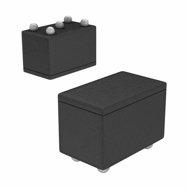

LP3985 Micropower, 150mA Low-Noise Ultra Low-Dropout CMOS Voltage Regulator General Description The LP3985 is designed for portable and wireless applications with demanding performance and space requirements. The LP3985 is stable with a small 1µF ± 30% ceramic or high-quality tantalum output capacitor. The micro SMD requires the smallest possible PC board area - the total application circuit area can be less than 2.0mm x 2.5mm, a fraction of a 1206 case size. The LP3985’s performance is optimized for battery powered systems to deliver ultra low noise, extremely low dropout voltage and low quiescent current. Regulator ground current increases only slightly in dropout, further prolonging the battery life. An optional external bypass capacitor reduces the output noise without slowing down the load transient response. Fast start-up time is achieved by utilizing an internal power-on circuit that actively pre-charges the bypass capacitor. Power supply rejection is better than 50 dB at low frequencies and starts to roll off at 1kHz. High power supply rejection is maintained down to low input voltage levels common to battery operated circuits. The device is ideal for mobile phone and similar battery powered wireless applications. It provides up to 150 mA, from a 2.5V to 6V input. The LP3985 consumes less than 1.5µA in disable mode and has fast turn-on time less than 200µs. The LP3985 is available in a 5 bump small bump micro SMD, a 5 bump large bump micro SMD, a 5 bump thin micro SMD and a 5 pin SOT-23 package. Performance is specified for −40˚C to +125˚C temperature range and is available in 2.5V, 2.6V, 2.7V, 2.8V, 2.85V, 2.9V, 3.0V. 3.1V, 3.2V, 3.3V, 4.7V, 4.75V, 4.8V and 5.0V output voltages. For other output voltage options between 2.5V to 5.0V or for a dual LP3985, please contact National Semiconductor sales office. Key Specifications n n n n n n n n n 2.5 to 6.0V input range 150mA guaranteed output 50dB PSRR at 1kHz @ VIN = VOUT + 0.2V ≤1.5µA quiescent current when shut down Fast Turn-On time: 200 µs (typ.) 100mV maximum dropout with 150mA load 30µVrms output noise (typ) over 10Hz to 100kHz −40 to +125˚C junction temperature range for operation 2.5V, 2.6V, 2.7V, 2.8V, 2.85V, 2.9V, 3.0V, 3.1V, 3.2V, 3.3V, 4.7V, 4.75V, 4.8V and 5.0V outputs standard Features n n n n n Miniature 5-I/O micro SMD and SOT-23-5 package Logic controlled enable Stable with ceramic and high quality tantalum capacitors Fast turn-on Thermal shutdown and short-circuit current limit Applications n n n n CDMA cellular handsets Wideband CDMA cellular handsets GSM cellular handsets Portable information appliances Typical Application Circuit 10136402 Note: Pin Numbers in parenthesis indicate micro SMD package. * Optional Noise Reduction Capacitor. © 2005 National Semiconductor Corporation DS101364 www.national.com LP3985 Micropower, 150mA Low-Noise Ultra Low-Dropout CMOS Voltage Regulator August 2005 LP3985 Block Diagram 10136401 Pin Description Name * micro SMD SOT VEN A1 3 Enable Input Logic, Enable High Function GND B2 2 Common Ground VOUT C1 5 Output Voltage of the LDO VIN C3 1 Input Voltage of the LDO BYPASS A3 4 Optional Bypass Capacitor for Noise Reduction * The pin numbering scheme for the micro SMD package was revised in April 2002 to conform to JEDEC standard. Only the pin numbers were revised. No changes to the physical location of the inputs/outputs were made. For reference purposes, the obsolete numbering scheme had VEN as pin 1, GND as pin 2, VOUT as pin 3, VIN as pin 4, and BYPASS as pin 5. Connection Diagrams SOT 23-5 Package (MF) 5 Bump micro SMD Package (BPA05, BLA05, TLA05) 10136407 Top View See NS Package Number MF05A 10136470 Top View See NS Package Number BPA05, BLA05, TLA05 www.national.com 2 LP3985 Ordering Information BP refers to 0.170mm bump size, 0.900mm height for micro SMD Package Output Voltage (V) Grade LP3985 Supplied as 250 Units, Tape and Reel LP3985 Supplied as 3000 Units, Tape and Reel 2.5 STD LP3985IBP-2.5 LP3985IBPX-2.5 2.6 STD LP3985IBP-2.6 LP3985IBPX-2.6 2.7 STD LP3985IBP-2.7 LP3985IBPX-2.7 LP3985IBPX-2.8 2.8 STD LP3985IBP-2.8 2.85 STD LP3985IBP-285 LP3985IBPX-285 2.9 STD LP3985IBP-2.9 LP3985IBPX-2.9 3.0 STD LP3985IBP-3.0 LP3985IBPX-3.0 3.1 STD LP3985IBP-3.1 LP3985IBPX-3.1 3.2 STD LP3985IBP-3.2 LP3985IBPX-3.2 3.3 STD LP3985IBP-3.3 LP3985IBPX-3.3 4.7 STD LP3985IBP-4.7 LP3985IBPX-4.7 5.0 STD LP3985IBP-5.0 LP3985IBPX-5.0 BL refers to 0.300mm bump size, 0.995mm height for micro SMD Package Output Voltage (V) Grade LP3985 Supplied as 250 Units, Tape and Reel LP3985 Supplied as 3000 Units, Tape and Reel 2.5 STD LP3985IBL-2.5 LP3985IBLX-2.5 2.6 STD LP3985IBL-2.6 LP3985IBLX-2.6 2.7 STD LP3985IBL-2.7 LP3985IBLX-2.7 2.8 STD LP3985IBL-2.8 LP3985IBLX-2.8 2.85 STD LP3985IBL-285 LP3985IBLX-285 2.9 STD LP3985IBL-2.9 LP3985IBLX-2.9 3.0 STD LP3985IBL-3.0 LP3985IBLX-3.0 3.1 STD LP3985IBL-3.1 LP3985IBLX-3.1 3.2 STD LP3985IBL-3.2 LP3985IBLX-3.2 3.3 STD LP3985IBL-3.3 LP3985IBLX-3.3 4.8 STD LP3985IBL-4.8 LP3985IBLX-4.8 5.0 STD LP3985IBL-5.0 LP3985IBLX-5.0 TL refers to 0.300mm bump size, 0.600mm height for micro SMD Package Output Voltage (V) Grade LP3985 Supplied as 250 Units, Tape and Reel 2.5 STD LP3985ITL-2.5 LP3985ITLX-2.5 2.6 STD LP3985ITL-2.6 LP3985ITLX-2.6 2.7 STD LP3985ITL-2.7 LP3985ITLX-2.7 2.8 STD LP3985ITL-2.8 LP3985ITLX-2.8 2.85 STD LP3985ITL-285 LP3985ITLX-285 2.9 STD LP3985ITL-2.9 LP3985ITLX-2.9 3.0 STD LP3985ITL-3.0 LP3985ITLX-3.0 3.1 STD LP3985ITL-3.1 LP3985ITLX-3.1 3.2 STD LP3985ITL-3.2 LP3985ITLX-3.2 3.3 STD LP3985ITL-3.3 LP3985ITLX-3.3 4.75 STD LP3985ITL-4.75 LP3985ITLX-4.75 4.8 STD LP3985ITL-4.8 LP3985ITLX-4.8 5.0 STD LP3985ITL-5.0 LP3985ITLX-5.0 3 LP3985 Supplied as 3000 Units, Tape and Reel www.national.com LP3985 Ordering Information (Continued) For SOT Package Output Voltage (V) Grade 2.5 STD LP3985IM5-2.5 LP3985IM5X-2.5 LCSB 2.6 STD LP3985IM5-2.6 LP3985IM5X-2.6 LCTB 2.7 STD LP3985IM5-2.7 LP3985IM5X-2.7 LCUB 2.8 STD LP3985IM5-2.8 LP3985IM5X-2.8 LCJB 2.85 STD LP3985IM5-285 LP3985IM5X-285 LCXB 2.9 STD LP3985IM5-2.9 LP3985IM5X-2.9 LCYB 3.0 STD LP3985IM5-3.0 LP3985IM5X-3.0 LCRB 3.1 STD LP3985IM5-3.1 LP3985IM5X-3.1 LCZB 3.2 STD LP3985IM5-3.2 LP3985IM5X-3.2 LDPB 3.3 STD LP3985IM5-3.3 LP3985IM5X-3.3 LDQB 4.7 STD LP3985IM5-4.7 LP3985IM5X-4.7 LDRB 5.0 STD LP3985IM5-5.0 LP3985IM5X-5.0 LDSB www.national.com LP3985 Supplied as 1000 Units, Tape and Reel 4 LP3985 Supplied as 3000 Units, Tape and Reel Package Marking Operating Ratings (Notes 1, 2) If Military/Aerospace specified devices are required, please contact the National Semiconductor Sales Office/ Distributors for availability and specifications. VIN VIN, VEN Junction Temperature −0.3 to 6.5V Junction Temperature 150˚C Storage Temperature −65˚C to +150˚C Lead Temp. 235˚C Pad Temp. (Note 3) 235˚C Maximum Power Dissipation SOT23-5 (Note 4) micro SMD (Note 4) ESD Rating(Note 5) Human Body Model Machine Model −40˚C to +125˚C Thermal Resistance θJA (SOT23-5) θJA (micro SMD) -0.3 to (VIN+0.3) ≤ 6.5V VOUT 2.5 to 6V 0 to (VIN+0.3) ≤ 6V VEN 220˚C/W 255˚C/W Maximum Power Dissipation SOT23-5 (Note 6) micro SMD (Note 6) 250mW 244mW 364mW 355mW 2kV 150V Electrical Characteristics Unless otherwise specified: VIN = VOUT(nom) + 0.5V, CIN = 1 µF, IOUT = 1mA, COUT = 1 µF, CBYPASS = 0.01µF. Typical values and limits appearing in standard typeface are for TJ = 25˚C. Limits appearing in boldface type apply over the entire junction temperature range for operation, −40˚C to +125˚C. (Note 7) (Note 8) Symbol Parameter Conditions Output Voltage Tolerance IOUT = 1mA Line Regulation Error VIN = (VOUT(nom) + 0.5V) to 6.0V, For 4.7 to 5.0 options For all other options ∆VOUT Typ Load Regulation Error (Note 9) IOUT = 1 mA to 150 mA LP3985IM5 (SOT23-5) 0.0025 LP3985 (micro SMD) 0.0004 Output AC Line Regulation VIN = VOUT(nom) + 1V, IOUT = 150 mA (Figure 1) 1.5 VIN = VOUT(nom) + 0.2V, f = 1 kHz, IOUT = 50 mA (Figure 2) 50 VIN = VOUT(nom) + 0.2V, f = 10 kHz, IOUT = 50 mA (Figure 2) 40 PSRR Power Supply Rejection Ratio IQ Quiescent Current Dropout Voltage (Note 10) Limit Max −2 −3 2 3 % of VOUT(nom) −0.19 −0.1 0.19 0.1 %/V 0.005 %/mA 0.002 mVP-P dB VEN = 1.4V, IOUT = 0 mA For 4.7 to 5.0 options For all other options 100 85 165 150 VEN = 1.4V, IOUT = 0 to 150 mA For 4.7 to 5.0 options For all other options 155 140 250 200 VEN = 0.4V 0.003 1.5 IOUT = 1 mA 0.4 2 IOUT = 50 mA 20 35 IOUT = 100 mA 45 70 IOUT = 150 mA 60 100 µA ISC Short Circuit Current Limit Output Grounded (Steady State) 600 IOUT(PK) Peak Output Current VOUT ≥ VOUT(nom) - 5% 550 5 Units Min mV mA 300 mA www.national.com LP3985 Absolute Maximum Ratings (Notes 1, 2) LP3985 Electrical Characteristics (Continued) Unless otherwise specified: VIN = VOUT(nom) + 0.5V, CIN = 1 µF, IOUT = 1mA, COUT = 1 µF, CBYPASS = 0.01µF. Typical values and limits appearing in standard typeface are for TJ = 25˚C. Limits appearing in boldface type apply over the entire junction temperature range for operation, −40˚C to +125˚C. (Note 7) (Note 8) Symbol Parameter Conditions Typ Limit Min Max Units TON Turn-On Time (Note 11) CBYPASS = 0.01 µF 200 en Output Noise Voltage(Note 12) BW = 10 Hz to 100 kHz, COUT = 1µF 30 µVrms Output Noise Density CBP = 0 230 nV/ ±1 IEN Maximum Input Current at EN VEN = 0.4 and VIN = 6.0 VIL Maximum Low Level Input Voltage at EN VIN = 2.5 to 6.0V VIH Minimum High Level Input Voltage at EN VIN = 2.5 to 6.0V TSD µs nA 0.4 1.4 V V Thermal Shutdown Temperature 160 ˚C Thermal Shutdown Hysteresis 20 ˚C Note 1: Absolute Maximum Ratings are limits beyond which damage to the device may occur. Operating Ratings are conditions under which operation of the device is guaranteed. Operating Ratings do not imply guaranteed performance limits. For guaranteed performance limits and associated test conditions, see the Electrical Characteristics tables. Note 2: All voltages are with respect to the potential at the GND pin. Note 3: Additional information on lead temperature and pad temperature can be found in National Semiconductor Application Note (AN-1112). Note 4: The Absolute Maximum power dissipation depends on the ambient temperature and can be calculated using the formula: PD = (TJ - TA)/θJA, where TJ is the junction temperature, TA is the ambient temperature, and θ JA is the junction-to-ambient thermal resistance. The 364mW rating for SOT23-5 appearing under Absolute Maximum Ratings results from substituting the Absolute Maximum junction temperature, 150˚C, for TJ, 70˚C for TA, and 220˚C/W for θJA. More power can be dissipated safely at ambient temperatures below 70˚C . Less power can be dissipated safely at ambient temperatures above 70˚C. The Absolute Maximum power dissipation can be increased by 4.5mW for each degree below 70˚C, and it must be derated by 4.5mW for each degree above 70˚C. Note 5: The human body model is 100pF discharged through 1.5kΩ resistor into each pin. The machine model is a 200 pF capacitor discharged directly into each pin. Note 6: Like the Absolute Maximum power dissipation, the maximum power dissipation for operation depends on the ambient temperature. The 250mW rating for SOT23-5 appearing under Operating Ratings results from substituting the maximum junction temperature for operation, 125˚C, for TJ, 70˚C for TA, and 220˚C/W for θJA into (Note 4) above. More power can be dissipated at ambient temperatures below 70˚C . Less power can be dissipated at ambient temperatures above 70˚C. The maximum power dissipation for operation can be increased by 4.5mW for each degree below 70˚C, and it must be derated by 4.5mW for each degree above 70˚C. Note 7: All limits are guaranteed. All electrical characteristics having room-temperature limits are tested during production with TJ = 25˚C or correlated using Statistical Quality Control (SQC) methods. All hot and cold limits are guaranteed by correlating the electrical characteristics to process and temperature variations and applying statistical process control. Note 8: The target output voltage, which is labeled VOUT(nom), is the desired voltage option. Note 9: An increase in the load current results in a slight decrease in the output voltage and vice versa. Note 10: Dropout voltage is the input-to-output voltage difference at which the output voltage is 100mV below its nominal value. This specification does not apply for input voltages below 2.5V. Note 11: Turn-on time is time measured between the enable input just exceeding VIH and the output voltage just reaching 95% of its nominal value. Note 12: The output noise varies with output voltage option. The 30µVrms is measured with 2.5V voltage option. To calculate an approximated output noise for other options, use the equation: (30µVrms)(X)/2.5, where X is the voltage option value. Recommended Output Capacitor Symbol COUT Parameter Output Capacitor Conditions Capacitance(Note 13) ESR Limit Nominal Value Min 1.0 0.7 5 Max Units 500 mΩ µF Note 13: The minimum value of capacitance for stability and correct operation is 0.7µF. The Capacitor tolerance should be ± 30% or better over the temperature range. The full range of operating conditions for the capacitor in the application should be considered during device selection to ensure this minimum capacitance specification is met. The recommended capacitor type is X7R to meet the full device temperature spec of -40oC to 125oC. See the capacitor section in Application Hints. www.national.com 6 LP3985 10136408 FIGURE 1. Line Transient Input Test Signal 10136409 FIGURE 2. PSRR Input Test Signal Typical Performance Characteristics Unless otherwise specified, CIN = COUT = 1 µF Ceramic, CBYPASS = 0.01 µF, VIN = VOUT + 0.2V, TA = 25˚C, Enable pin is tied to VIN. Output Voltage Change vs Temperature Dropout Voltage vs Load Current 10136433 10136441 Ground Current vs VIN @ 25˚C Ground Current vs Load Current 10136440 10136435 7 www.national.com LP3985 Typical Performance Characteristics Unless otherwise specified, CIN = COUT = 1 µF Ceramic, CBYPASS = 0.01 µF, VIN = VOUT + 0.2V, TA = 25˚C, Enable pin is tied to VIN. (Continued) Ground Current vs VIN @ −40˚C Ground Current vs VIN @ 125˚C 10136437 10136439 Short Circuit Current (micro SMD) Short Circuit Current (micro SMD) 10136445 10136446 Short Circuit Current (SOT) Short Circuit Current (SOT) 10136447 www.national.com 10136448 8 Short Circuit Current (SOT) Short Circuit Current (SOT) 10136450 10136449 Short Circuit Current (micro SMD) Short Circuit Current (micro SMD) 10136452 10136451 Output Noise Spectral Density Ripple Rejection (VIN = VOUT + 0.2V) 10136410 10136411 9 www.national.com LP3985 Typical Performance Characteristics Unless otherwise specified, CIN = COUT = 1 µF Ceramic, CBYPASS = 0.01 µF, VIN = VOUT + 0.2V, TA = 25˚C, Enable pin is tied to VIN. (Continued) LP3985 Typical Performance Characteristics Unless otherwise specified, CIN = COUT = 1 µF Ceramic, CBYPASS = 0.01 µF, VIN = VOUT + 0.2V, TA = 25˚C, Enable pin is tied to VIN. (Continued) Ripple Rejection (VIN = VOUT + 1V) Ripple Rejection (VIN = 5.0V) 10136412 10136413 Start Up Time (VIN = VOUT + 0.2V) Start Up Time (VIN = 4.2V) 10136414 10136415 Start Up Time (VIN = VOUT + 0.2V) Start Up Time (VIN = 4.2V) 10136417 10136416 www.national.com 10 Start Up Time (VIN = VOUT + 0.2V) Start Up Time (VIN = 4.2V) 10136418 10136419 Line Transient Response Line Transient Response 10136420 10136421 Load Transient Response (VIN = 3.2V) Load Transient Response (VIN = 4.2V) 10136423 10136422 11 www.national.com LP3985 Typical Performance Characteristics Unless otherwise specified, CIN = COUT = 1 µF Ceramic, CBYPASS = 0.01 µF, VIN = VOUT + 0.2V, TA = 25˚C, Enable pin is tied to VIN. (Continued) LP3985 Typical Performance Characteristics Unless otherwise specified, CIN = COUT = 1 µF Ceramic, CBYPASS = 0.01 µF, VIN = VOUT + 0.2V, TA = 25˚C, Enable pin is tied to VIN. (Continued) Load Transient Response (VIN = 3.2V) Load Transient Response (VIN = 4.2V) 10136424 10136425 Enable Response (VIN = VOUT + 0.2V) Enable Response (VIN = 4.2V) 10136453 10136454 Enable Response (VIN = VOUT + 0.2V) Enable Response (VIN = 4.2V) 10136455 www.national.com 10136456 12 Output Impedance (VIN = 4.2V) Output Impedance (VIN = VOUT + 0.2V) 10136465 10136466 may be used but have a narrower temperature range. With these and other capacitor types (Y5V, Z6U) that may be used, selection is dependant on the range of operating conditions and temperature range for that application. (see section on Capacitor Characteristics). It may also be possible to use tantalum or film capacitors at the output, but these are not as attractive for reasons of size and cost (see next section Capacitor Characteristics). It is also recommended that the output capacitor be placed within 1cm from the output pin and returned to a clean ground line. Application Hints EXTERNAL CAPACITORS Like any low-dropout regulator, the LP3985 requires external capacitors for regulator stability. The LP3985 is specifically designed for portable applications requiring minimum board space and smallest components. These capacitors must be correctly selected for good performance. INPUT CAPACITOR An input capacitance of ) 1µF is required between the LP3985 input pin and ground (the amount of the capacitance may be increased without limit). This capacitor must be located a distance of not more than 1cm from the input pin and returned to a clean analog ground. A ceramic capacitor is recommended although a good quality tantalum or film capacitor may be used at the input. CAPACITOR CHARACTERISTICS The LP3985 is designed to work with ceramic capacitors on the output to take advantage of the benefits they offer: for capacitance values in the range of 1µF to 4.7µF range, ceramic capacitors are the smallest, least expensive and have the lowest ESR values (which makes them best for eliminating high frequency noise). The ESR of a typical 1µF ceramic capacitor is in the range of 20 mΩ to 40 mΩ, which easily meets the ESR requirement for stability by the LP3985. For both input and output capacitors careful interpretation of the capacitor specification is required to ensure correct device operation. The capacitor value can change greatly dependant on the conditions of operation and capacitor type. In particular the output capacitor selection should take account of all the capacitor parameters to ensure that the specification is met within the application. Capacitance value can vary with DC bias conditions as well as temperature and frequency of operation. Capacitor values will also show some decrease over time due to aging. The capacitor parameters are also dependant on the particular case size with smaller sizes giving poorer performance figures in general. As an example Figure 3 shows a typical graph showing a comparison of capacitor case sizes in a Capacitance vs. DC Bias plot. As shown in the graph, as a result of the DC Bias condition the capacitance value may drop below the minimum capacitance value given in the recommended capacitor table (0.7µF in this case). Note that the graph shows the capacitance out of spec for the 0402 case size capacitor at higher bias voltages. It is therefore recommended that the capacitor manufacturers’ specifications for the nominal value Important: Tantalum capacitors can suffer catastrophic failures due to surge current when connected to a lowimpedance source of power (like a battery or a very large capacitor). If a tantalum capacitor is used at the input, it must be guaranteed by the manufacturer to have a surge current rating sufficient for the application. There are no requirements for the ESR on the input capacitor, but tolerance and temperature coefficient must be considered when selecting the capacitor to ensure the capacitance will remain within the operational range over the full range of temperature and operating conditions. OUTPUT CAPACITOR Correct selection of the output capacitor is important to ensure stable operation in the intended application. The output capacitor must meet all the requirements specified in the recommended capacitor table over all conditions in the application. These conditions include DC-bias, frequency and temperature. Unstable operation will result if the capacitance drops below the minimum specified value. (See the next section Capacitor Characteristics). The LP3985 is designed specifically to work with very small ceramic output capacitors. A 1.0µF ceramic capacitor (dialectric type X7R) with ESR between 5mΩ to 500mΩ is suitable in the LP3985 application circuit. X5R capacitors 13 www.national.com LP3985 Typical Performance Characteristics Unless otherwise specified, CIN = COUT = 1 µF Ceramic, CBYPASS = 0.01 µF, VIN = VOUT + 0.2V, TA = 25˚C, Enable pin is tied to VIN. (Continued) LP3985 Application Hints The types of capacitors best suited for the noise bypass capacitor are ceramic and film. High-quality ceramic capacitors with either NPO or COG dielectric typically have very low leakage. Polypropolene and polycarbonate film capacitors are available in small surface-mount packages and typically have extremely low leakage current. (Continued) capacitor are consulted for all conditions as some capacitor sizes (e.g. 0402) may not be suitable in the actual application. Unlike many other LDO’s, addition of a noise reduction capacitor does not effect the load transient response of the device. NO-LOAD STABILITY The LP3985 will remain stable and in regulation with no external load. This is specially important in CMOS RAM keep-alive applications. ON/OFF INPUT OPERATION The LP3985 is turned off by pulling the VEN pin low, and turned on by pulling it high. If this feature is not used, the VEN pin should be tied to VIN to keep the regulator output on at all time. To assure proper operation, the signal source used to drive the VEN input must be able to swing above and below the specified turn-on/off voltage thresholds listed in the Electrical Characteristics section under VIL and VIH. 10136467 FAST ON-TIME The LP3985 output is turned on after Vref voltage reaches its final value (1.23V nomial). To speed up this process, the noise reduction capacitor at the bypass pin is charged with an internal 70uA current source. The current source is turned off when the bandgap voltage reaches approximately 95% of its final value. The turn on time is determined by the time constant of the bypass capacitor. The smaller the capacitor value, the shorter the turn on time, but less noise gets reduced. As a result, turn on time and noise reduction need to be taken into design consideration when choosing the value of the bypass capacitor. FIGURE 3. Graph Showing A Typical Variation in Capacitance vs DC Bias The ceramic capacitor’s capacitance can vary with temperature. The capacitor type X7R, which operates over a temperature range of -55˚C to +125˚C, will only vary the capacitance to within ± 15%. The capacitor type X5R has a similar tolerance over a reduced temperature range of -55˚C to +85˚C. Most large value ceramic capacitors () 2.2µF) are manufactured with Z5U or Y5V temperature characteristics. Their capacitance can drop by more than 50% as the temperature goes from 25˚C to 85˚C. Therefore X7R is recommended over Z5U and Y5V in applications where the ambient temperature will change significantly above or below 25˚C. micro SMD MOUNTING The micro SMD package requires specific mounting techniques which are detailed in National Semiconductor Application Note (AN-1112). Referring to the section Surface Mount Technology (SMT) Assembly Considerations, it should be noted that the pad style which must be used with the 5 pin package is NSMD (non-solder mask defined) type. For best results during assembly, alignment ordinals on the PC board may be used to facilitate placement of the micro SMD device. Tantalum capacitors are less desirable than ceramic for use as output capacitors because they are more expensive when comparing equivalent capacitance and voltage ratings in the 1µF to 4.7µF range. Another important consideration is that tantalum capacitors have higher ESR values than equivalent size ceramics. This means that while it may be possible to find a tantalum capacitor with an ESR value within the stable range, it would have to be larger in capacitance (which means bigger and more costly ) than a ceramic capacitor with the same ESR value. It should also be noted that the ESR of a typical tantalum will increase about 2:1 as the temperature goes from 25˚C down to −40˚C, so some guard band must be allowed. micro SMD LIGHT SENSITIVITY Exposing the micro SMD device to direct sunlight will cause misoperation of the device. Light sources such as halogen lamps can effect electrical performance if brought near to the device. The wavelengths which have most detrimental effect are reds and infra-reds, which means that the fluorescent lighting used inside most buildings has very little effect on performance. A micro SMD test board was brought to within 1cm of a fluorescent desk lamp and the effect on the regulated output voltage was negligible, showing a deviation of less than 0.1% from nominal. NOISE BYPASS CAPACITOR Connecting a 0.01µF capacitor between the CBYPASS pin and ground significantly reduces noise on the regulator output. This cap is connected directly to a high impedance node in the band gap reference circuit. Any significant loading on this node will cause a change on the regulated output voltage. For this reason, DC leakage current through this pin must be kept as low as possible for best output voltage accuracy. www.national.com 14 LP3985 Physical Dimensions inches (millimeters) unless otherwise noted 5-Lead Small Outline Package (MF) NS Package Number MF05A micro SMD, 5 Bump, Package (BPA05) NS Package Number BPA05DNC The dimensions for X1, X2 and X3 are as given: X1 = 0.853 +/− 0.03mm X2 = 1.412 +/− 0.03mm X3 = 0.900 +/− 0.10mm 15 www.national.com LP3985 Physical Dimensions inches (millimeters) unless otherwise noted (Continued) micro SMD, 5 Bump, Package (BLA05) NS Package Number BLA05AEC The dimensions for X1, X2 and X3 are as given: X1 = 1.006 +/- 0.03mm X2 = 1.463 +/- 0.03mm X3 = 0.995 +/- 0.10mm www.national.com 16 inches (millimeters) unless otherwise noted (Continued) thin micro SMD, 5 Bump, Package (TLA05) NS Package Number TLA05AEA The dimensions for X1, X2 and X3 are as given: X1 = 1.006 +/- 0.03mm X2 = 1.463 +/- 0.03mm X3 = 0.6 +/- 0.075mm National does not assume any responsibility for use of any circuitry described, no circuit patent licenses are implied and National reserves the right at any time without notice to change said circuitry and specifications. For the most current product information visit us at www.national.com. LIFE SUPPORT POLICY NATIONAL’S PRODUCTS ARE NOT AUTHORIZED FOR USE AS CRITICAL COMPONENTS IN LIFE SUPPORT DEVICES OR SYSTEMS WITHOUT THE EXPRESS WRITTEN APPROVAL OF THE PRESIDENT AND GENERAL COUNSEL OF NATIONAL SEMICONDUCTOR CORPORATION. As used herein: 1. Life support devices or systems are devices or systems which, (a) are intended for surgical implant into the body, or (b) support or sustain life, and whose failure to perform when properly used in accordance with instructions for use provided in the labeling, can be reasonably expected to result in a significant injury to the user. 2. A critical component is any component of a life support device or system whose failure to perform can be reasonably expected to cause the failure of the life support device or system, or to affect its safety or effectiveness. BANNED SUBSTANCE COMPLIANCE National Semiconductor manufactures products and uses packing materials that meet the provisions of the Customer Products Stewardship Specification (CSP-9-111C2) and the Banned Substances and Materials of Interest Specification (CSP-9-111S2) and contain no ‘‘Banned Substances’’ as defined in CSP-9-111S2. Leadfree products are RoHS compliant. National Semiconductor Americas Customer Support Center Email: new.feedback@nsc.com Tel: 1-800-272-9959 www.national.com National Semiconductor Europe Customer Support Center Fax: +49 (0) 180-530 85 86 Email: europe.support@nsc.com Deutsch Tel: +49 (0) 69 9508 6208 English Tel: +44 (0) 870 24 0 2171 Français Tel: +33 (0) 1 41 91 8790 National Semiconductor Asia Pacific Customer Support Center Email: ap.support@nsc.com National Semiconductor Japan Customer Support Center Fax: 81-3-5639-7507 Email: jpn.feedback@nsc.com Tel: 81-3-5639-7560 LP3985 Micropower, 150mA Low-Noise Ultra Low-Dropout CMOS Voltage Regulator Physical Dimensions

物料型号:LP3985 器件简介:LP3985是一款超低噪声、超低dropout电压的微功耗CMOS电压调节器,专为便携式和无线应用设计,具有高性能和空间要求。 引脚分配:VEN(使能输入逻辑),GND(公共地),VoUT(LDO输出电压),VIN(LDO输入电压),BYPASS(可选的降噪旁路电容)。 参数特性:输入电压范围2.5V至6.0V,保证输出150mA,低频下电源抑制比大于50dB,1kHz时开始下降。在低输入电压下保持高电源抑制比。工作结温范围为-40°C至+125°C。 功能详解:LP3985为电池供电系统优化,提供超低噪声、极低dropout电压和低静态电流。在dropout时,调节器地电流仅轻微增加,进一步延长电池寿命。可选的外部旁路电容可降低输出噪声,而不减慢负载瞬态响应。通过使用内部上电电路主动预充电路电容,实现了快速启动时间。 应用信息:适用于移动电话和类似的电池供电无线应用,提供高达150mA的电流,输入电压范围从2.5V至6V。LP3985在禁用模式下消耗少于1.5µA,并且具有小于200µs的快速开启时间。 封装信息:LP3985提供5个焊点的小型焊盘微SMD、大型焊盘微SMD、薄型微SMD和5引脚SOT-23封装。
