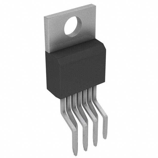

O PA 452 OPA 4 52 OPA 452 OPA452 OPA453 SBOS127C – JULY 2000 – REVISED NOVEMBER 2003 80V, 50mA OPERATIONAL AMPLIFIERS FEATURES DESCRIPTION ● WIDE POWER-SUPPLY RANGE: ±10V to ±40V ● HIGH OUTPUT LOAD DRIVE: 50mA Continuous ● WIDE OUTPUT VOLTAGE SWING: 1V to Rail ● FULLY PROTECTED: Thermal Shutdown Output Current-Limited ● WIDE OPERATING TEMPERATURE RANGE: –40°C TO +125°C ● PACKAGE OPTIONS: TO220-7 DDPACK-7 Surface-Mount The OPA452 and OPA453 are low-cost operational amplifiers with high-voltage (80V) and high-current capabilities (50mA). The OPA452 is unity-gain stable and has a gain bandwidth product of 1.8MHz, whereas the OPA453 is optimized for gains greater than 5 and has a 7.5MHz bandwidth. The OPA452 and OPA453 are internally protected against over-temperature conditions and current overloads. Power supplies in the range of ±10V to ±40V can be used. Unlike most other power op amps, the OPA452 and OPA453 have ensured specifications over the entire power-supply range. These laser-trimmed, monolithic integrated circuits provide excellent low-level accuracy along with wide output swing. Special design considerations assure that the product is easy to use and free from phase inversion problems often found in other amplifiers. APPLICATIONS ● ● ● ● ● The OPA452 and OPA453 are available in TO220-7 and DDPAK-7 options. They are specified for a junction temperature range of –40°C to +125°C. PIEZOELECTRIC CELLS TEST EQUIPMENT AUDIO AMPLIFIERS TRANSDUCER DRIVERS SERVO DRIVERS 7-Lead Straight-Formed TO-220 (TA) 7-Lead Stagger-Formed TO-220 (TA-1) 1 2 3 4 5 6 7 7-Lead DDPAK (FA) Surface-Mount 1 2 3 4 5 6 7 1 2 3 4 5 6 7 VIN+ NC V+ Flag VIN– V– VO VIN+ NC V+ Flag VIN– V– VO VIN+ NC V+ Flag VIN– V– VO NOTE: Tabs are electrically connected to V– supply. Please be aware that an important notice concerning availability, standard warranty, and use in critical applications of Texas Instruments semiconductor products and disclaimers thereto appears at the end of this data sheet. Copyright © 2000-2003, Texas Instruments Incorporated PRODUCTION DATA information is current as of publication date. Products conform to specifications per the terms of Texas Instruments standard warranty. Production processing does not necessarily include testing of all parameters. www.ti.com ABSOLUTE MAXIMUM RATINGS(1) Supply Voltage, V+ to V– ................................................................... 80V Signal Input Terminals, Voltage(2) .................. (V–) – 0.5V to (V+) + 0.5V Current(2) ...................................................... 5mA Output Short-Circuit ................................................................. Continuous Operating Temperature .................................................. –55°C to +125°C Storage Temperature ..................................................... –65°C to +150°C Junction Temperature .................................................................... +150°C Lead Temperature (soldering 10s, TO-220) ................................... 300°C (soldering 3s, DDPAK) ..................................... 240°C NOTES: (1) Stresses above these ratings may cause permanent damage. Exposure to absolute maximum conditions for extended periods may degrade device reliability. (2) Input terminals are diode-clamped to the power-supply rails. Input signals that can swing more than 0.5V beyond the supply rails should be current limited to 5mA or less. ELECTROSTATIC DISCHARGE SENSITIVITY This integrated circuit can be damaged by ESD. Texas Instruments recommends that all integrated circuits be handled with appropriate precautions. Failure to observe proper handling and installation procedures can cause damage. ESD damage can range from subtle performance degradation to complete device failure. Precision integrated circuits may be more susceptible to damage because very small parametric changes could cause the device not to meet its published specifications. PACKAGE/ORDERING INFORMATION For the most current package and ordering information, see the Package Option Addendum located at the end of this data sheet. 2 OPA452, 453 www.ti.com SBOS127C ELECTRICAL CHARACTERISTICS: OPA452; VS = ±10V to ±40V Boldface limits apply over the specified junction temperature range, TJ = –40°C to +125°C. At TJ = +25°C, RL = 3.8kΩ connected to ground, and VOUT = 0V, unless otherwise noted. OPA452TA, FA PARAMETER OFFSET VOLTAGE Input Offset Voltage over Temperature Drift vs Power Supply over Temperature CONDITION VOS VS = ±40V, VCM = 0V, IO = 0V dVOS/dT PSRR VS = ±10V to ±40V, VCM = 0V MIN TYP MAX UNITS ±1 ±3 ±6 5 30 45 mV mV µV/°C µV/V µV/V ±100 ±100 pA pA ±5 INPUT BIAS CURRENT(1) Input Bias Current Input Offset Current NOISE Input Voltage Noise Density Current Noise Density INPUT VOLTAGE RANGE Common-Mode Voltage Range Common-Mode Rejection Ratio over Temperature IB IOS VS = ±40V, VCM = 0V VS = ±40V, VCM = 0V ±7 ±1 en in f = 1kHz f = 1kHz 21 9 VCM CMRR INPUT IMPEDANCE Differential Common-Mode OPEN-LOOP GAIN Open-Loop Voltage Gain over Temperature OUTPUT Voltage Output over Temperature Voltage Output over Temperature Output Current Short-Circuit Current Capacitive Load Drive AOL GBW SR THD+N VOUT TEMPERATURE RANGE Specified Range (junction) Operating Range (junction) Storage Range (ambient) Thermal Resistance TO200-7 DDPAK-7 IO = 10mA, –VS + 2V < VO < +VS – 2V IO = 10mA, –VS + 2V < VO < +VS – 2V IO = 50mA, –VS + 4V < VO < +VS – 4V IO = 50mA, –VS + 5V < VO < +VS – 5.5V 105 96 VS = ±40V VS = ±40V VS = ±40V, G = +1, 10V Step, CL = 100pF VS = ±40V, G = +1, 10V Step, CL = 100pF VIN • Gain = VS VS = ±40V, VO = 30Vp-p, G = 5 f = 1kHz, RL = 2kΩ IO = 50mA IO = 50mA IO = 10mA IO = 10mA 94 (V+) – 0.5 V dB dB 1013 || 2 1013 || 6 Ω || pF Ω || pF 110 107 110 105 dB dB dB dB 1.8 +7.2 /–10 2 5 1 0.0008 MHz V/µs µs µs µs % (V–) + 4.0 (V–) + 5 (V–) + 2 (V–) + 2 ±50 (V+) – 4 (V+) – 5.5 (V+) – 2 (V+) – 2 ±125 See Typical Characteristic ISC CLOAD SHUTDOWN FLAG Thermal Shutdown Status Output Normal Operation Thermally Shutdown Junction Temperature Shutdown Reset from Shutdown POWER SUPPLY Supply Voltage Range Quiescent Current (per amplifier) over Temperature (V–) + 5 86 76 VS = ±40V, –35V < VCM < 39.5V over Temperature FREQUENCY RESPONSE Gain-Bandwidth Product Slew Rate Settling Time: 0.1% 0.01% Overload Recovery Time Total Harmonic Distortion + Noise VS = ±40V, –35V < VCM < 39.5V VS = ±40V, –35V < VCM < 39.5V nV/ √Hz fA/ √Hz VS = ±40V VS = ±40V 100 0.1 140 1.0 165 ±10 IO = 0 TJ TJ TA θJC ±5.5 –40 –55 –65 µA µA °C °C +160 +145 VS IQ V V V V mA mA ±40 ±6.5 ±7.5 V mA mA +125 +125 +150 °C °C °C 3 3 °C/W °C/W NOTE: (1) All tests are high-speed tested at +25°C ambient temperature. Effective junction temperature is +25°C, unless otherwise noted. OPA452, 453 SBOS127C www.ti.com 3 ELECTRICAL CHARACTERISTICS: OPA453; VS = ±10V to ±40V Boldface limits apply over the specified junction temperature range, TJ = –40°C to +125°C. At TJ = +25°C, RL = 3.8kΩ connected to ground, and VOUT = 0V, unless otherwise noted. OPA453TA, FA PARAMETER OFFSET VOLTAGE Input Offset Voltage over Temperature Drift vs Power Supply over Temperature CONDITION VOS VS = ±40V, VCM = 0V, IO = 0V dVOS/dT PSRR VS = ±10V to ±40V, VCM = 0V MIN TYP MAX UNITS ±1 ±3 ±6 5 30 45 mV mV µV/°C µV/V µV/V ±100 ±100 pA pA ±5 INPUT BIAS CURRENT(1) Input Bias Current Input Offset Current NOISE Input Voltage Noise Density Current Noise Density INPUT VOLTAGE RANGE Common-Mode Voltage Range Common-Mode Rejection Ratio over Temperature IB IOS VS = ±40V, VCM = 0V VS = ±40V, VCM = 0V ±7 ±1 en in f = 1kHz f = 1kHz 21 9 VCM CMRR INPUT IMPEDANCE Differential Common-Mode OPEN-LOOP GAIN Open-Loop Voltage Gain over Temperature OUTPUT Voltage Output over Temperature Voltage Output over Temperature Output Current Short-Circuit Current Capacitive Load Drive AOL GBW SR THD+N VOUT TEMPERATURE RANGE Specified Range (junction) Operating Range (junction) Storage Range (ambient) Thermal Resistance TO200-7 DDPAK-7 IO = 10mA, –VS + 2V < VO < +VS – 2V IO = 10mA, –VS + 2V < VO < +VS – 2V IO = 50mA, –VS + 4V < VO < +VS – 4V IO = 50mA, –VS + 5V < VO < +VS – 5.5V 105 96 VS = ±40V VS = ±40V VS = ±40V, G = +5, 10V Step, CL = 100pF VS = ±40V, G = +5, 10V Step, CL = 100pF VIN • Gain = VS VS = ±40V, VO = 30Vp-p, G = 5 f = 1kHz, RL = 2kΩ IO = 50mA IO = 50mA IO = 10mA IO = 10mA 94 (V+) – 0.5 V dB dB 1013 || 2 1013 || 6 Ω || pF Ω || pF 110 107 110 105 dB dB dB dB 7.5 +23 / –38 1 1.5 1 0.0008 MHz V/µs µs µs µs % (V–) + 4.0 (V–) + 5 (V–) + 2 (V–) + 2 ±50 (V+) – 4 (V+) – 5.5 (V+) – 2 (V+) – 2 ±125 See Typical Characteristic ISC CLOAD SHUTDOWN FLAG Thermal Shutdown Status Output Normal Operation Thermally Shutdown Junction Temperature Shutdown Reset from Shutdown POWER SUPPLY Supply Voltage Range Quiescent Current (per amplifier) over Temperature (V–) + 5 86 76 VS = ±40V, –35V < VCM < 39.5V over Temperature FREQUENCY RESPONSE Gain-Bandwidth Product Slew Rate Settling Time: 0.1% 0.01% Overload Recovery Time Total Harmonic Distortion + Noise VS = ±40V, –35V < VCM < 39.5V VS = ±40V, –35V < VCM < 39.5V nV/ √Hz fA/ √Hz VS = ±40V VS = ±40V 100 0.1 140 µA µA 1.0 165 °C °C +160 +145 VS IQ ±10 IO = 0 TJ TJ TA ±5.5 –40 –55 –65 θJC V V V V mA mA ±40 ±6.5 ±7.5 V mA mA +125 +125 +150 °C °C °C °C/W °C/W 3 3 NOTE: (1) All tests are high-speed tested at +25°C ambient temperature. Effective junction temperature is +25°C, unless otherwise noted. 4 OPA452, 453 www.ti.com SBOS127C TYPICAL CHARACTERISTICS At TJ = +25°C, VS = ±40V, and RL = 3.8kΩ, unless otherwise noted. All temperatures are junction temperatures unless otherwise noted. Refer to the Applications Information section to calculate junction temperatures from ambient temperatures for a specific configuration. OPEN-LOOP GAIN AND PHASE vs FREQUENCY OPEN-LOOP GAIN AND PHASE vs FREQUENCY 140 0 140 –20 120 100 –40 100 80 –60 80 0 OPA453 60 –80 40 –100 20 0 –40 –60 Phase 60 –80 40 –100 –120 20 –120 –140 0 –140 –20 –160 –20 –160 –40 –180 10M –40 1 10 100 1k 10k 100k 1M 1 10 100 Frequency (Hz) 10k 100k 1M –180 10M POWER-SUPPLY REJECTION RATIO vs FREQUENCY 120 140 100 120 80 100 PSRR (dB) CMRR (dB) 1k Frequency (Hz) COMMON-MODE REJECTION RATIO vs FREQUENCY 60 +PSRR 80 –PSRR 40 60 20 40 0 20 1 10 100 1k 10k 100k 1M 10M 1 10 100 1k 10k 100k 1M Frequency (Hz) Frequency (Hz) INPUT VOLTAGE AND CURRENT NOISE SPECTRAL DENSITY vs FREQUENCY TOTAL HARMONIC DISTORTION + NOISE vs FREQUENCY 100 1 in AV = +5 VO = 30Vp-p RL = 600Ω, 2kΩ en 0.1 THD+N (%) Voltage Noise (nV/√Hz) Current Noise (fA/√Hz) –20 Gain 10 10M OPA452 600Ω 2kΩ 0.01 OPA453 600Ω 0.001 2kΩ 0.0001 1 10 100 1k 10k 100k 1M 10 Frequency (Hz) 1k 10k 100k Frequency (Hz) OPA452, 453 SBOS127C 100 www.ti.com 5 Phase (°) Phase Phase (°) Gain (dB) Gain Gain (dB) OPA452 120 TYPICAL CHARACTERISTICS (Cont.) At TJ = +25°C, VS = ±40V, and RL = 3.8kΩ, unless otherwise noted. All temperatures are junction temperatures unless otherwise noted. Refer to the Applications Information section to calculate junction temperatures from ambient temperatures for a specific configuration. MAXIMUM OUTPUT VOLTAGE SWING vs FREQUENCY OUTPUT VOLTAGE SWING vs OUTPUT CURRENT (V+) 40 35 OPA452 30 OPA453 25 20 15 10 (V+) – 4 +25°C (V–) – 8 –55°C (V–) + 4 +25°C Without Slew-Induced Distortion 5 +85°C (V+) – 6 (V–) + 2 0 +85°C (V–) 1k 10k 100k 1M 0 20 40 60 80 100 Frequency (Hz) Output Current (mA) OPEN-LOOP GAIN, POWER-SUPPLY REJECTION RATIO, AND COMMON-MODE REJECTION RATIO vs TEMPERATURE INPUT BIAS CURRENT AND INPUT OFFSET CURRENT vs TEMPERATURE 120 120 10000 AOL 110 1000 PSRR Current (pA) AOL, PSRR, and CMRR (dB) –55°C (V+) – 2 Output Voltage Swing (V) Maximum Output Voltage (Vp-p) 45 100 CMRR 90 100 +IB –IB 10 80 1 IOS 70 –55 –35 –15 5 25 45 65 85 105 0.1 –55 125 –35 –15 5 25 45 65 85 Temperature (°C) Temperature (°C) QUIESCENT CURRENT AND SHORT-CIRCUIT CURRENT vs TEMPERATURE GAIN BANDWIDTH PRODUCT vs TEMPERATURE 160 10 140 8 105 125 105 125 120 5.7 IQ 100 5.5 80 5.3 60 –55 –35 –15 5 25 45 65 85 105 125 6 4 OPA452 2 0 –55 –35 –15 5 25 45 65 85 Temperature (°C) Temperature (°C) 6 Gain Bandwidth (MHz) +ISC –ISC Quiescent Current (mA) Short-Circuit Current (mA) OPA453 OPA452, 453 www.ti.com SBOS127C TYPICAL CHARACTERISTICS (Cont.) At TJ = +25°C, VS = ±40V, and RL = 3.8kΩ, unless otherwise noted. All temperatures are junction temperatures unless otherwise noted. Refer to the Applications Information section to calculate junction temperatures from ambient temperatures for a specific configuration. INPUT BIAS CURRENT AND INPUT OFFSET CURRENT vs COMMON-MODE VOLTAGE SLEW RATE vs TEMPERATURE 20 45 –Slew (OPA453) 15 +IB Current (pA) Slew Rate (V/µs) 35 +Slew (OPA453) 25 –IB 10 5 IOS 15 +Slew (OPA452) 5 –55 –35 –15 0 –Slew (OPA452) 5 25 45 65 85 105 –5 –40 125 –30 –20 QUIESCENT CURRENT AND SHORT-CIRCUIT CURRENT vs TEMPERATURE 10 20 30 40 15 +ISC 110 6 Quiescent Current (mA) 120 Percentage of Amplifiers (%) –ISC Short-Circuit Current (mA) 0 OFFSET VOLTAGE PRODUCTION DISTRIBUTION 130 IQ 5 –55 10 20 30 10 5 0 40 –3 –2 Temperature (°C) –1 0 1 2 3 Offset Voltage (mV) SETTLING TIME vs CLOSED-LOOP GAIN OFFSET VOLTAGE DRIFT DISTRIBUTION 100 20 Settling Time (µs) 15 Amplifiers (%) –10 Common-Mode Voltage (V) Temperature (°C) 10 10 0.01% 0.01% OPA452 5 0.1% 0.1% OPA453 1 0 1 0 1 2 3 4 5 6 7 8 9 10 11 12 13 14 15 16 17 18 OPA452, 453 SBOS127C 10 100 Gain (V/V) Offset Voltage Drift (µV/°C) www.ti.com 7 TYPICAL CHARACTERISTICS (Cont.) At TJ = +25°C, VS = ±40V, and RL = 3.8kΩ, unless otherwise noted. All temperatures are junction temperatures unless otherwise noted. Refer to the Applications Information section to calculate junction temperatures from ambient temperatures for a specific configuration. LARGE-SIGNAL STEP RESPONSE (G = 1, CL = 100pF) SMALL-SIGNAL OVERSHOOT vs LOAD CAPACITANCE 60 OPA452 OPA453 50 OPA452 10V/div Overshoot (%) G = –1 40 G = –4 30 G = –2 20 G = +1 10 G = –6 0 0.01 G = –8 0.1 1 10 2.5µs/div 32 Load Capacitance LARGE-SIGNAL STEP RESPONSE (G = 5, CL = 100pF) SMALL-SIGNAL STEP RESPONSE (G = 1, CL = 100pF) 20V/div OPA452 10V/div OPA453 2.5µs/div 1µs/div SMALL-SIGNAL STEP RESPONSE (G = 5, CL = 100pF) SMALL-SIGNAL STEP RESPONSE (G = –1, CL = 1000pF) 20V/div OPA452 20V/div OPA453 500ns/div 8 2.5µs/div OPA452, 453 www.ti.com SBOS127C APPLICATIONS INFORMATION Figure 1 shows the OPA452 connected as a basic noninverting amplifier. The OPA452 can be used in virtually any op amp configuration. The OPA453 is designed for use in configurations with gains of 5 or greater. Power-supply terminals should be bypassed with 0.1µF capacitors, or greater, near the power-supply pins. Be sure that the capacitors are appropriately rated for the power-supply voltage used. The OPA452 and OPA453 can supply output currents up to 50mA with excellent performance. G = 1+ + R2 R1 0.1µF R2 R1 VO OPA452 VIN The OPA452 and OPA453 are designed with internal current-limiting circuitry that limits the output current to approximately 125mA. The current limit varies slightly with increasing junction temperature and supply voltage, as shown in the Typical Characteristics. Current limit, in combination with the thermal protection circuitry, provides protection from most types of overload conditions including short-circuit to ground. THERMAL PROTECTION The OPA452 and OPA453 have thermal shutdown circuitry that protects the amplifier from damage caused by overload conditions. The thermal protection circuitry disables the output when the junction temperature reaches approximately 160°C, allowing the device to cool. When the junction temperature cools to approximately 140°C, the output circuitry is automatically re-enabled. V+ 10µF CURRENT LIMIT ZL Flag The thermal shutdown function is not intended to replace proper heat sinking. Activation of the thermal shutdown circuitry is an indication of excessive power dissipation or an inadequate heat sink. Continuously running the amplifier into thermal shutdown can degrade reliability. The Thermal Shutdown Indicator (Flag) pin can be monitored to determine if shutdown is occurring. During normal operation, the current output from the flag pin is typically 50nA. During shutdown, the current output from the flag pin increases to 140µA (typical). This current output allows for easy interfacing to external logic. Figure 2 shows two examples implementing this function. (optional) 0.1µF 10µF + V– FIGURE 1. Basic Circuit Connections. VOUT OPA452 Flag 100µA to 165µA HCT logic has relatively wellcontrolled logic level. A properly chosen resistor value can assure proper logic high level throughout the full range of flag output current. +5V +5V HCT 19.1kΩ VOUT OPA452 Interface to virtually any CMOS logic gate by choosing a resistor value that provides an assured logic high voltage with the minimum (100µA) flag current. Logic Ground CMOS 39kΩ Logic Ground Interfacing with HCT Logic Interfacing with CMOS Logic FIGURE 2. Thermal Shutdown Indicator. OPA452, 453 SBOS127C www.ti.com 9 POWER SUPPLIES Where, The OPA452 and OPA453 may be operated from power supplies of ±10V to ±40V, or a total of 80V with excellent performance. Most behavior remains unchanged throughout the full operating voltage range. Parameters that vary significantly with operating voltage are shown in the Typical Characteristics. VO = output voltage For applications that do not require symmetrical output voltage swing, power-supply voltages do not need to be equal. The OPA452 and OPA453 can operate with as little as 20V between the supplies or with up to 80V between the supplies. For example, the positive supply could be set to 70V with the negative supply at –10V or vice-versa. TA = ambient temperature (°C) The tabs of the DDPAK-7 and TO220 packages are electrically connected to the negative supply (V–), however, these connections should not be used to carry current. For best thermal performance, the tab should be soldered directly to the circuit board copper area (see Heat Sinking section). POWER DISSIPATION Internal power dissipation of these op amps can be quite large. All of the specifications for the OPA452 and OPA453 may change with junction temperature. If the device is not subjected to internal self-heating, the junction temperature will be the same as the ambient. However, in practical applications, the device will self-heat and the junction temperature will be significantly higher than ambient. The following calculation can be performed to establish junction temperature as a function of ambient temperature and the conditions of the application. Consider the OPA452 in a circuit configuration where the load is 600Ω and the output voltage is 20V. The supplies are at ±40V and the ambient temperature (TA) is 40°C. The θJA for the package plus heat sink is 30°C/W. First, the quiescent heating of the op amp is as follows: PD(internal) = IQ • VS = 6mA • 80V = 480mW The output current (IO) can be calculated: IO = VO/RL = 20V/600Ω = 33.33mA The power being dissipated (PD) in the output transistor of the amplifier can be calculated: VS = supply voltage IO = output current RL = load resistance TJ = junction temperature (°C) θJA = junction-to-air thermal resistance (°C/W) To estimate the margin of safety in a complete design (including heat sink), increase the ambient temperature until the thermal protection is activated. Use worst-case load and signal conditions. For good reliability, the thermal protection should trigger more than +35°C above the maximum expected ambient condition of your application. This ensures a maximum junction temperature of +125°C at the maximum expected ambient condition. Operation from a single power supply (or unbalanced power supplies) can produce even larger power dissipation because a larger voltage can be impressed across the conducting output transistor. Consult Application Bulletin SBOA022 at www.ti.com for further information on how to calculate or measure power dissipation. Power dissipation can be minimized by using the lowest possible supply voltage. For example, with a 50mA load, the output will swing to within 5.0V of the power-supply rails. Power supplies set to no more than 5.0V above the maximum output voltage swing required by the application will minimize the power dissipation. SAFE OPERATING AREA The Safe Operating Area (SOA curves, Figure 3) shows the permissible range of voltage and current. The safe output current decreases as the voltage across the output transistor (VS – VO) increases. For further insight on SOA, consult Application Report SBOA022. Output short circuits are a very demanding case for SOA. A short-circuit to ground forces the full power-supply voltage (V+ or V–) across the conducting transistor and produces a SAFE OPERATING AREA PD(output stage) = IO • (VS – VO) = 33.3mA • (40 – 20) = 667mW 100 PD(total) = PD(internal) + PD(output stage) = 480mW + 667mW = 1147mW 50 The resulting junction temperature can be calculated: TJ = TA + PD θJA +85°C, θ = 40 10 IO (mA) TJ = 40°C + 1147mW • 30°C/W = 74.4°C +85°C, θ =θ20 θ is total thermal resistance including junction-to-case. +25°C, θ = 40 1 This graph is for +125°C max operating temperature. +25°C,θθ = 3 0.1 10 80 100 | VS | – | VO | (V) FIGURE 3. DDPAK-7 and TO220-7 Safe Operating Area. 10 OPA452, 453 www.ti.com SBOS127C typical output current of 125mA. With ±40V power supplies, this creates an internal dissipation of 10W. This far exceeds practical heat sinking and is not recommended. If operation in this region is unavoidable, use the part with a heat sink. HEAT SINKING Power dissipated in the OPA452 or OPA453 will cause the junction temperature to rise. For reliable operation, the junction temperature should be limited to +125°C. Many applications will require a heat sink to assure that the maximum operating junction temperature is not exceeded. The heat sink required depends on the power dissipated and on ambient conditions. CAPACITIVE LOADS The dynamic characteristics of the OPA452 and OPA453 have been optimized for commonly encountered gains, loads, and operating conditions. The combination of low closedloop gain and capacitive load will decrease the phase margin and may lead to gain peaking or oscillations. Figure 5 shows a circuit that preserves phase margin with capacitive load. Figure 6 shows the small-signal step response for the circuit in Figure 5. Consult Application Bulletin SBOA015, at www.ti.com, for more information. For heat sinking purposes, the tab of the DDPAK is typically soldered directly to a circuit board copper area. Increasing the copper area improves heat dissipation. Figure 4 shows typical thermal resistance from junction-to-ambient as a function of copper area. +40V OPA452 Depending on conditions, additional heat sinking may be required. Aavid Thermal Products Inc. manufactures surface-mountable heat sinks designed specifically for use with these packages. Further information is available on Aavid’s web site, www.aavid.com. RG 5kΩ RF 5kΩ 10nF VI CF 270pF CS 1.8nF –40V THERMAL RESISTANCE vs CIRCUIT BOARD COPPER AREA Thermal Resistance, θJA (°C/W) 50 FIGURE 5. Driving Large Capacitive Loads. OPA452FA, OPA453FA Surface-Mount Package 1oz. copper 40 30 SMALL-SIGNAL STEP RESPONSE (G = –1, CL = 10nF) 20 OPA452 10 0 1 2 3 4 20mV/div 0 5 Copper Area (inches2) Circuit Board Copper Area 2.5µs/div FIGURE 6. Small-Signal Step Response for Figure 5. OPA452FA, OPA453FA Surface-Mount Package FIGURE 4. DDPAK Thermal Resistance versus Circuit Board Copper Area. OPA452, 453 SBOS127C www.ti.com 11 INCREASING OUTPUT CURRENT INPUT PROTECTION In those applications where the 50mA of output current is not sufficient to drive the desired load, output current can be increased by connecting two or more OPA452s or OPA453s in parallel, as shown in Figure 7. Amplifier A1 is the master amplifier and may be configured in virtually any op amp circuit. Amplifier A2, the slave, is configured as a unity gain buffer. Alternatively, external output transistors can be used to boost output current. The circuit in Figure 8 is capable of supplying output currents up to 1A. Alternatively, the OPA547, OPA548, and OPA549 series power op amps should be considered for high output current drive, along with programmable current limit and output disable capability. The OPA452 and OPA453 feature internal clamp diodes to protect the inputs when voltages beyond the supply rails are encountered. However, input current should be limited to 5mA. In some cases, an external series resistor may be required. Many input signals are inherently current-limited, therefore, a limiting resistor may not be required. Please consider that a large series resistor, in conjunction with the input capacitance, can affect stability. R1 R2 “MASTER” RS(1) 10Ω OPA452 VIN OPA452 RL NOTE: (1) RS resistors minimize the circulating current that can flow between the two devices due to VOS errors. FIGURE 7. Parallel Amplifiers Increase Output Current Capability. R1 R2 +40V TIP29C CF R3(1) 100Ω R4 0.2Ω VO OPA452 VIN The OPA453 is intended for applications with signal gains of 5 or greater, but it is possible to take advantage of its high slew rate in lower gains using an external compensation technique in an inverting configuration. This technique maintains low noise characteristics of the OPA453 architecture at low frequencies. Depending on the application, a small increase in high-frequency noise may result. This technique shapes the loop gain for good stability while giving an easily controlled 2nd-order low-pass frequency response. Considering only the noise gain (noninverting signal gain) for the circuit of Figure 9, the low-frequency noise gain (NG1) will be set by the resistor ratios, whereas the high-frequency noise gain (NG2) will be set by the capacitor ratios. The capacitor values set both the transition frequencies and the high-frequency noise gain. If this noise gain, determined by NG2 = 1 + CS/CF, is set to a value greater than the recommended minimum stable gain for the op amp and the noise gain pole, set by 1/RFCF, is placed correctly, a very well controlled, 2nd-order low-pass frequency response will result. RS(1) 10Ω “SLAVE” USING THE OPA453 IN LOW GAINS R4 0.2Ω LOAD TIP30C To choose the values for both CS and CF, two parameters and only three equations need to be solved. First, the target for the high-frequency noise gain (NG2) should be greater than the minimum stable gain for the OPA453. In the circuit in Figure 9, a target NG2 of 10 is used. Second, the signal gain of –1 in Figure 10 sets the low-frequency noise gain to NG1 = 1 + RF/RG (= 2 in this example). Using these two gains, knowing the Gain Bandwidth Product (GBP) for the OPA453 (7.5MHz), and targeting a maximally flat 2nd-order, low-pass Butterworth frequency response (Q = 0.707), the key frequency in the compensation can be found. For the values in Figure 9, the f–3dB will be approximately 180kHz. This is less than that predicted by simply dividing the GBP by NG1. The compensation network controls the bandwidth to a lower value while providing good slew rate at the output and an exceptional distortion performance due to increased loop gain at frequencies below NG1 • Z0. The capacitor values in Figure 10 are calculated for NG1 = 2 and NG2 = 10 with no adjustment for parasitics. Actual circuit values can be optimized by checking the smallsignal step response with actual load conditions. See Figure 9 for the small-signal step response of this OPA453, G = –1 circuit with a 1000pF load. It is well-behaved with no tendency to oscillate. If CS and CF were removed, the circuit would be unstable. –40V NOTE: (1) R3 provides current limit and allows the amplifier to drive the load when the output is between 0.7V and –0.7V. FIGURE 8. External Output Transistors Boost Output Current Up to 1 Amp. 12 OPA452, 453 www.ti.com SBOS127C SMALL-SIGNAL STEP RESPONSE (G = –1, CL = 1000pF) +40V OPA453 OPA453 20mV/div RG 5kΩ VOUT RF 5kΩ VIN CS 1.8nF CF 200pF –40V NG1 = 1 + RF/RG = 2 NG2 = 1 + CS/CF = 10 FIGURE 9. Compensation of the OPA453 for G = –1. 2.5µs/div FIGURE 10. Small-Signal Step Response for Figure 9. OPA452, 453 SBOS127C www.ti.com 13 PACKAGE OPTION ADDENDUM www.ti.com 13-Aug-2021 PACKAGING INFORMATION Orderable Device Status (1) Package Type Package Pins Package Drawing Qty Eco Plan (2) Lead finish/ Ball material MSL Peak Temp Op Temp (°C) Device Marking (3) (4/5) (6) OPA452FA/500 ACTIVE DDPAK/ TO-263 KTW 7 500 RoHS & Green Call TI | SN Level-3-245C-168 HR -40 to 125 OPA452F OPA452FAKTWT ACTIVE DDPAK/ TO-263 KTW 7 250 RoHS & Green Call TI | SN Level-3-245C-168 HR -40 to 125 OPA452F OPA452FAKTWTG3 ACTIVE DDPAK/ TO-263 KTW 7 250 RoHS & Green SN Level-3-245C-168 HR -40 to 125 OPA452F OPA453FAKTWT ACTIVE DDPAK/ TO-263 KTW 7 250 RoHS & Green Call TI | SN Level-3-245C-168 HR -40 to 125 OPA453F OPA453TA ACTIVE TO-220 KC 7 50 RoHS & Green Call TI | SN N / A for Pkg Type -40 to 125 OPA453T OPA453TA-1 ACTIVE TO-220 KVT 7 50 RoHS & Green Call TI | SN N / A for Pkg Type -40 to 125 OPA453T (1) The marketing status values are defined as follows: ACTIVE: Product device recommended for new designs. LIFEBUY: TI has announced that the device will be discontinued, and a lifetime-buy period is in effect. NRND: Not recommended for new designs. Device is in production to support existing customers, but TI does not recommend using this part in a new design. PREVIEW: Device has been announced but is not in production. Samples may or may not be available. OBSOLETE: TI has discontinued the production of the device. (2) RoHS: TI defines "RoHS" to mean semiconductor products that are compliant with the current EU RoHS requirements for all 10 RoHS substances, including the requirement that RoHS substance do not exceed 0.1% by weight in homogeneous materials. Where designed to be soldered at high temperatures, "RoHS" products are suitable for use in specified lead-free processes. TI may reference these types of products as "Pb-Free". RoHS Exempt: TI defines "RoHS Exempt" to mean products that contain lead but are compliant with EU RoHS pursuant to a specific EU RoHS exemption. Green: TI defines "Green" to mean the content of Chlorine (Cl) and Bromine (Br) based flame retardants meet JS709B low halogen requirements of
