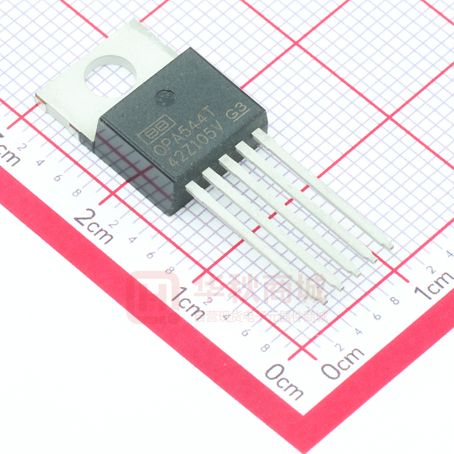

® OPA544 High-Voltage, High-Current OPERATIONAL AMPLIFIER FEATURES q HIGH OUTPUT CURRENT: 2A min q WIDE POWER SUPPLY RANGE: ±10 to ±35V q SLEW RATE: 8V/µs q INTERNAL CURRENT LIMIT q THERMAL SHUTDOWN PROTECTION q FET INPUT: IB = 100pA max q 5-LEAD TO-220 PLASTIC PACKAGE q 5-LEAD SURFACE MOUNT PACKAGE DESCRIPTION The OPA544 is a high-voltage/high-current operational amplifier suitable for driving a wide variety of high power loads. High performance FET op amp circuitry and high power output stage are combined on a single monolithic chip. The OPA544 is protected by internal current limit and thermal shutdown circuits. The OPA544 is available in industry-standard 5-lead TO-220 and 5-lead surface-mount power packages. Its copper tab allows easy mounting to a heat sink for excellent thermal performance. It is specified for operation over the extended industrial temperature range, –40°C to +85°C. APPLICATIONS q MOTOR DRIVER q PROGRAMMABLE POWER SUPPLY q SERVO AMPLIFIER q VALVES, ACTUATOR DRIVER q MAGNETIC DEFLECTION COIL DRIVER q AUDIO AMPLIFIER Tab is connected to V– supply. 5-Lead TO-220 and Stagger-Formed TO-220 Tab is connected to V– supply. 5-Lead Surface Mount 12345 12345 + VIN V– V+ – VIN VO + VIN V– V+ – VIN VO International Airport Industrial Park • Mailing Address: PO Box 11400, Tucson, AZ 85734 • Street Address: 6730 S. Tucson Blvd., Tucson, AZ 85706 • Tel: (520) 746-1111 • Twx: 910-952-1111 Internet: http://www.burr-brown.com/ • FAXLine: (800) 548-6133 (US/Canada Only) • Cable: BBRCORP • Telex: 066-6491 • FAX: (520) 889-1510 • Immediate Product Info: (800) 548-6132 ©1994 Burr-Brown Corporation PDS-1250B Printed in U.S.A. September, 1995 SPECIFICATIONS At TCASE = +25°C, VS = ±35V, unless otherwise noted. OPA544T OPA544T-1 OPA544F PARAMETER OFFSET VOLTAGE Input Offset Voltage vs Temperature vs Power Supply INPUT BIAS CURRENT(1) Input Bias Current vs Temperature Input Offset Current NOISE Input Voltage Noise Noise Density, f = 1kHz Current Noise Density, f = 1kHz INPUT VOLTAGE RANGE Common-Mode Input Range, Positive Negative Common-Mode Rejection INPUT IMPEDANCE Differential Common-Mode OPEN-LOOP GAIN Open-Loop Voltage Gain FREQUENCY RESPONSE Gain Bandwidth Product Slew Rate Full-Power Bandwidth Settling Time 0.1% Total Harmonic Distortion OUTPUT Voltage Output, Positive Negative Positive Negative Current Output Short-Circuit Current POWER SUPPLY Specified Operating Voltage Operating Voltage Range Quiescent Current TEMPERATURE RANGE Operating Storage Thermal Resistance, θJC Thermal Resistance, θJC Thermal Resistance, θJA NOTES: (1) High-speed test at TJ = 25°C. VO = ±30V, RL = 1kΩ RL = 15Ω 60Vp-p, RL = 15Ω G = –10, 60V Step 90 Linear Operation Linear Operation VCM = ±VS –6V (V+) –6 (V–) +6 90 CONDITION MIN TYP ±1 ±10 ±10 ±15 See Typical Curve ±10 MAX ±5 ±100 ±100 ±100 UNITS mV µV/°C µV/V pA pA Specified Temperature Range VS = ±10V to ±35V VCM = 0V VCM = 0V 36 3 (V+) –4 (V–) +4 106 1012 || 8 1012 || 10 103 1.4 8 See Typical Curve 25 See Typical Curve (V+) –4.4 (V–) +3.8 (V+) –3.8 (V–) +3.1 See SOA Curves 4 ±35 ±12 nV/√Hz fA/√Hz V V dB Ω || pF Ω || pF dB MHz V/µs µs 5 IO = 2A IO = 2A IO = 0.5A IO = 0.5A (V+) –5 (V–) +5 (V+) –4.2 (V–) +4 V V V V A V V mA °C °C °C/W °C/W °C/W ±10 IO = 0 –40 –40 f > 50Hz DC No Heat Sink ±35 ±15 +85 +125 2.7 3 65 The information provided herein is believed to be reliable; however, BURR-BROWN assumes no responsibility for inaccuracies or omissions. BURR-BROWN assumes no responsibility for the use of this information, and all use of such information shall be entirely at the user’s own risk. Prices and specifications are subject to change without notice. No patent rights or licenses to any of the circuits described herein are implied or granted to any third party. BURR-BROWN does not authorize or warrant any BURR-BROWN product for use in life support devices and/or systems. ® OPA544 2 CONNECTION DIAGRAMS Top View PACKAGE/ORDERING INFORMATION Tab is connected to V– supply. 5-Lead Surface Mount Tab is connected to V– supply. 5-Lead TO-220 and Stagger-Formed TO-220 PRODUCT OPA544T PACKAGE 5-Lead TO-220 PACKAGE DRAWING NUMBER(1) 315 323 325 OPA544T-1 5-Lead Stagger-Formed TO-220 OPA544F 5-Lead Surface-Mount 12345 NOTE: (1) For detailed drawing and dimension table, please see end of data sheet, or Appendix C of Burr-Brown IC Data Book. 12345 + VIN V– V+ – VIN VO ELECTROSTATIC DISCHARGE SENSITIVITY This integrated circuit can be damaged by ESD. Burr-Brown recommends that all integrated circuits be handled with appropriate precautions. Failure to observe proper handling and installation procedures can cause damage. ESD damage can range from subtle performance degradation to complete device failure. Precision integrated circuits may be more susceptible to damage because very small parametric changes could cause the device not to meet its published specifications. + VIN V– V+ – VIN VO ABSOLUTE MAXIMUM RATINGS Supply Voltage, V+ to V– ................................................................... 70V Output Current ................................................................. See SOA Curve Input Voltage .................................................... (V–) –0.7V to (V+) +0.7V Operating Temperature ................................................. –40°C to +125°C Storage Temperature ..................................................... –40°C to +125°C Junction Temperature ...................................................................... 150°C Lead Temperature (soldering –10s)(1) ............................................................... 300°C NOTE: (1) Vapor-phase or IR reflow techniques are recommended for soldering the OPA544F surface mount package. Wave soldering is not recommended due to excessive thermal shock and “shadowing” of nearby devices. ® 3 OPA544 TYPICAL PERFORMANCE CURVES At TCASE = +25°C, VS = ±35V, unless otherwise noted. OPEN-LOOP GAIN AND PHASE vs FREQUENCY 120 100 80 Gain (dB) 10n INPUT BIAS CURRENT vs TEMPERATURE 0 RL = 15Ω –45 –90 –135 –180 Phase (°) Input Bias Current (A) 1n IB 100p 60 40 20 0 –20 1 10 100 1k 10k 100k 1M 10p IOS 1p 10M –75 –50 –25 0 25 50 75 100 125 Frequency (Hz) Temperature (°C) CURRENT LIMIT vs TEMPERATURE 5 13 QUIESCENT CURRENT vs TEMPERATURE Quiescent Current (mA) 4 Limit Current (A) 12 VS = ±35V 11 3 2 1 10 VS = ±10V 0 –75 –50 –25 0 25 50 75 100 125 Temperature (°C) 9 –75 –50 –25 0 25 50 75 100 125 Temperature (°C) VOLTAGE NOISE DENSITY vs FREQUENCY 100 Common-Mode Rejection (dB) COMMON-MODE REJECTION vs FREQUENCY 110 100 90 80 70 60 50 40 80 Voltage Noise (nV/√Hz) 60 40 20 10 1 10 100 1k 10k 100k Frequency (Hz) 100 1k 10k Frequency (Hz) 100k 1M ® OPA544 4 TYPICAL PERFORMANCE CURVES (CONT) At TCASE = +25°C, VS = ±35V, unless otherwise noted. POWER SUPPLY REJECTION vs FREQUENCY 120 GAIN-BANDWIDTH PRODUCT AND SLEW RATE vs TEMPERATURE 2.5 100 V+ Supply 80 V– Supply Gain-Bandwidth Product (MHz) Power Supply Rejection (dB) 2.0 GBW 9 SR+ 1.5 SR– 1.0 8 60 7 40 20 1 10 100 1k Frequency (Hz) 10k 100k 1M 0.5 –75 –50 –25 0 25 50 75 100 Temperature (°C) 6 125 MAXIMUM OUTPUT VOLTAGE vs FREQUENCY 35 Clipping 30 Output Voltage (V) 1 10 TOTAL HARMONIC DISTORTION + NOISE vs FREQUENCY RL = 15Ω 100mW 2W 25 20 15 10 5 0 20k THD + N (%) Slew Rate Limited 0.1 30W 0.01 0.001 100k Frequency (Hz) 200k 20 100 1k Frequency (Hz) 10k 20k OUTPUT VOLTAGE SWING vs OUTPUT CURRENT 5 (V+) – VO 4 |VSUPPLY| – |VOUT| (V) |VSUPPLY| – |VOUT| (V) OUTPUT VOLTAGE SWING vs TEMPERATURE 6 5 4 3 2 1 0 IO = +2A IO = –2A 3 |(V–) –VO| 2 IO = +0.5A IO = –0.5A 1 0 0 1 2 Output Current (A) 3 –75 –50 –25 0 25 50 75 100 125 Temperature (°C) Slew Rate (V/µS) ® 5 OPA544 TYPICAL PERFORMANCE CURVES (CONT) At TCASE = +25°C, VS = ±35V, unless otherwise noted. SMALL SIGNAL RESPONSE G = 3, CL = 1nF 200MV/div 5V/div 2µs/div APPLICATIONS INFORMATION Figure 1 shows the OPA544 connected as a basic noninverting amplifier. The OPA544 can be used in virtually any op amp configuration. Power supply terminals should be bypassed with low series impedance capacitors. The technique shown, using a ceramic and tantalum type in parallel is recommended. Power supply wiring should have low series impedance and inductance. +35V V+ 10µF + 0.1µF R1 5kΩ R2 10kΩ G = 1+ The safe output current decreases as VS–VO increases. Output short-circuits are a very demanding case for SOA. A short-circuit to ground forces the full power supply voltage (V+ or V–) across the conducting transistor. With VS = ±35V the safe output current is 1.5A (at 25˚C). The short-circuit current is approximately 4A which exceeds the SOA. This situation will activate the thermal shutdown circuit in the OPA544. For further insight on SOA, consult Application Bulletin AB-039. SAFE OPERATING AREA 10 Current-Limited TC = 25°C Output current may be limited to less than 4A—see text. TC = 85°C 0.4 TC = 125°C 4 Output Current (A) ZL R2 =3 R1 1 OPA544 VO VIN 0.1µF 10µF + 0.1 1 2 5 10 |VS – VO| (V) 20 50 100 FIGURE 2. Safe Operating Area. CURRENT LIMIT The OPA544 has an internal current limit set for approximately 4A. This current limit decreases with increasing junction temperature as shown in the typical curve, Current Limit vs Temperature. This, in combination with the thermal shutdown circuit, provides protection from many types of overload. It may not, however, protect for short-circuit to ground, depending on the power supply voltage, ambient temperature, heat sink and signal conditions. V– –35V FIGURE 1. Basic Circuit Connections. SAFE OPERATING AREA Stress on the output transistors is determined by the output current and the voltage across the conducting output transistor, VS–VO. The power dissipated by the output transistor is equal to the product of the output current and the voltage across the conducting transistor, VS–VO. The Safe Operating Area (SOA curve, Figure 2) shows the permissible range of voltage and current. ® OPA544 6 POWER DISSIPATION Power dissipation depends on power supply, signal and load conditions. For dc signals, power dissipation is equal to the product of output current times the voltage across the conducting output transistor. Power dissipation can be minimized by using the lowest possible power supply voltage necessary to assure the required output voltage swing. For resistive loads, the maximum power dissipation occurs at a dc output voltage of one-half the power supply voltage. Dissipation with ac signals is lower. Application Bulletin AB-039 explains how to calculate or measure power dissipation with unusual signals and loads. HEATSINKING Most applications require a heat sink to assure that the maximum junction temperature is not exceeded. The heat sink required depends on the power dissipated and on ambient conditions. Consult Application Bulletin AB-038 for information on determining heat sink requirements. The mounting tab of the surface-mount package version should be soldered to a circuit board copper area for good heat dissipation. Figure 3 shows typical thermal resistance from junction to ambient as a function of the copper area. THERMAL PROTECTION The OPA544 has thermal shutdown that protects the amplifier from damage. Any tendency to activate the thermal shutdown circuit during normal operation is indication of excessive power dissipation or an inadequate heat sink. The thermal protection activates at a junction temperature of approximately 155˚C. For reliable operation, junction temperature should be limited to 150˚C, maximum. To estimate the margin of safety in a complete design (including heat sink), increase the ambient temperature until the thermal protection is activated. Use worst-case load and signal conditions. For good reliability, the thermal protection should trigger more than 25˚C above the maximum expected ambient condition of your application. This produces a junction temperature of 125˚C at the maximum expected ambient condition. THERMAL RESISTANCE vs CIRCUIT BOARD COPPER AREA 50 Thermal Resistance, θJA (°C/W) Depending on load and signal conditions, the thermal protection circuit may produce a duty-cycle modulated output signal. This limits the dissipation in the amplifier, but the rapidly varying output waveform may be damaging to some loads. The thermal protection may behave differently depending on whether internal dissipation is produced by sourcing or sinking output current. OUTPUT STAGE COMPENSATION The complex load impedances common in power op amp applications can cause output stage instability. Figure 3 shows an output series R/C compensation network (1Ω in series with 0.01µF) which generally provides excellent stability. Some variation in circuit values may be required with certain loads. UNBALANCED POWER SUPPLIES Some applications do not require equal positive and negative output voltage swing. The power supply voltages of the OPA544 do not need to be equal. For example, a –6V negative power supply voltage assures that the inputs of the OPA544 are operated within their linear common-mode range, and that the output can swing to 0V. The V+ power supply could range from 15V to 65V. The total voltage (V– to V+) can range from 20V to 70V. With a 65V positive supply voltage, the device may not be protected from damage during short-circuits because of the larger VCE during this condition. OUTPUT PROTECTION Reactive and EMF-generating loads can return load current to the amplifier, causing the output voltage to exceed the power supply voltage. This damaging condition can be avoided with clamp diodes from the output terminal to the power supplies as shown in Figure 4. Fast-recovery rectifier diodes with a 4A or greater continuous rating are recommended. Circuit Board Copper Area 40 OPA544F Surface Mount Package 1oz copper 30 20 10 OPA544 Surface Mount Package 0 0 1 2 3 4 5 Copper Area (inches2) FIGURE 3. Thermal Resistance vs Circuit Board Copper Area. ® 7 OPA544 V+ R2 = –4 R1 R1 5kΩ VIN R2 20kΩ G=– D1 OPA544 D2 1Ω 0.01µF Motor V– D1, D2 : Motorola MUR420 Fast Recovery Rectifier. FIGURE 4. Motor Drive Circuit. +30V REF102 10V +5V 20pF 8-bit data port (8 + 4 bits) 0-1mA 10kΩ OPA602 DAC7801 12-bit M-DAC 4.7kΩ 470pF 20kΩ +30V 40kΩ 10Ω OPA544 10kΩ Output series L/R network helps assure stability with very high capacitance loads. VO ±20V at 2A 1µH 1Ω 0.01µF –30V FIGURE 5. Digitally Programmable Power Supply. ® OPA544 8
