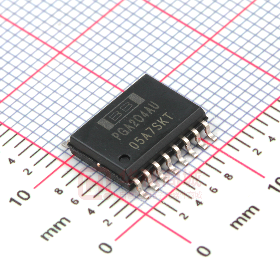

PGA204AU
PGA204AU
    BURR-BROWN(德州仪器)
    SOIC-16_10.3X7.5MM
    运放类型:Instrumentation 放大器组数:1 压摆率(SR):0.7 V/us 电源电压:9V ~ 36V, ±4.5V ~ 18V 各通道供电电流:5.2mA
PGA204AU 数据手册
® PGA204 PGA205 Programmable Gain INSTRUMENTATION AMPLIFIER FEATURES DESCRIPTION ● DIGITALLY PROGRAMMABLE GAIN: The PGA204 and PGA205 are low cost, general purpose programmable-gain instrumentation amplifiers offering excellent accuracy. Gains are digitally selected: PGA204—1, 10, 100, 1000, and PGA205—1, 2, 4, 8V/V. The precision and versatility, and low cost of the PGA204 and PGA205 make them ideal for a wide range of applications. PGA204: G=1, 10, 100, 1000V/V PGA205: G=1, 2, 4, 8V/V ● LOW OFFSET VOLTAGE: 50µV max ● LOW OFFSET VOLTAGE DRIFT: 0.25µV/°C ● LOW INPUT BIAS CURRENT: 2nA max Gain is selected by two TTL or CMOS-compatible address lines, A0 and A1. Internal input protection can withstand up to ±40V on the analog inputs without damage. ● LOW QUIESCENT CURRENT: 5.2mA typ ● NO LOGIC SUPPLY REQUIRED ● 16-PIN PLASTIC DIP, SOL-16 PACKAGES The PGA204 and PGA205 are laser trimmed for very low offset voltage (50µV), drift (0.25µV/°C) and high common-mode rejection (115dB at G=1000). They operate with power supplies as low as ±4.5V, allowing use in battery operated systems. Quiescent current is 5mA. APPLICATIONS ● DATA ACQUISITION SYSTEM ● GENERAL PURPOSE ANALOG BOARDS The PGA204 and PGA205 are available in 16-pin plastic DIP, and SOL-16 surface-mount packages, specified for the –40°C to +85°C temperature range. ● MEDICAL INSTRUMENTATION VO1 1 – VIN 4 V+ 13 PGA204 PGA205 Over-Voltage Protection A1 25kΩ A1 A0 Digital Ground + VIN 25kΩ Feedback 12 16 Digitally Selected Feedback Network 15 A3 11 VO 14 5 A2 Over-Voltage Protection 25kΩ 6 7 9 VOS Adj VO2 25kΩ 10 Ref 8 V– International Airport Industrial Park • Mailing Address: PO Box 11400 • Tucson, AZ 85734 • Street Address: 6730 S. Tucson Blvd. • Tucson, AZ 85706 Tel: (520) 746-1111 • Twx: 910-952-1111 • Cable: BBRCORP • Telex: 066-6491 • FAX: (520) 889-1510 • Immediate Product Info: (800) 548-6132 ® © SBOS022 1991 Burr-Brown Corporation PDS-1176A 1 Printed in U.S.A. October, 1993 PGA204/205 SPECIFICATIONS ELECTRICAL PGA204 G=1, 10, 100, 1000V/V At TA = +25°C, VS = ±15V, and RL = 2kΩ unless otherwise noted. PGA204BP, BU PARAMETER CONDITIONS INPUT Offset Voltage, RTI vs Temperature vs Power Supply Long-Term Stability Impedance, Differential Common-Mode Input Common-Mode Range Safe Input Voltage Common-Mode Rejection MIN TA=+25°C TA=TMIN to TMAX VS=±4.5V to ±18V VO=0V (see text) VCM=±10V, ∆RS=1kΩ G=1 G=10 G=100 G=1000 ±10.5 TYP ±10+20/G ±50+100/G ±0.1+0.5/G ±0.25+5/G 0.5+2/G 3+10/G ±0.2+0.5/G 1010||6 1010||6 ±12.7 ±40 80 96 110 115 99 114 123 123 ±0.5 ±8 ±0.5 ±8 BIAS CURRENT vs Temperature Offset Current vs Temperature NOISE, Voltage, RTI(1): f=10Hz f=100Hz f=1kHz fB=0.1Hz to 10Hz Noise Current f=10Hz f=1kHz fB=0.1Hz to 10Hz G≥100, G≥100, G≥100, G≥100, GAIN, Error OUTPUT Voltage, Positive(2) Negative(2) Load Capacitance Stability Short Circuit Current FREQUENCY RESPONSE Bandwidth, –3dB Slew Rate Settling Time(3), 0.1% 0.01% Overload Recovery RS=0Ω RS=0Ω RS=0Ω RS=0Ω IO=5mA, TMIN to TMAX IO=–5mA, TMIN to TMAX G=1 G=10 G=100 G=1000 VO=±10V, G=10 G=1 G=10 G=100 G=1000 G=1 G=10 G=100 G=1000 50% Overdrive DIGITAL LOGIC Digital Ground Voltage, VDG Digital Low Voltage Digital Input Current Digital High Voltage POWER SUPPLY, Voltage Current TEMPERATURE RANGE Specification Operating θJA (V+)–1.5 (V–)+1.5 TYP MAX UNITS ±125+500/G ±1+10/G * * ±25+30/G ±0.25+5/G * * * * * µV µV/°C µV/V µV/mo Ω || pF Ω || pF V V * 75 90 106 106 ±2 ±5 * nA pA/°C nA pA/°C nV/√Hz nV/√ Hz nV/√Hz µVp-p 0.4 0.2 18 * * * pA/√Hz pA/√Hz pAp-p ±0.024 ±0.024 ±0.024 ±0.05 ±10 ±0.001 ±0.002 ±0.002 ±0.01 * * * * * * * * * * * 1 80 10 1 0.7 22 23 100 1000 23 28 140 1300 70 * (V+)–4 VDG+0.8V * * V+ * ±18 ±6.5 * +85 +125 * * 1 VDG +2 VIN=0V dB dB dB dB * * * * V– V– ±4.5 90 106 110 110 * * * * ±2 (V+)–1.3 (V–)+1.3 1000 +23/–17 0.3 MIN 16 13 13 0.4 ±0.005 ±0.01 ±0.01 ±0.02 ±2.5 ±0.0004 ±0.0004 ±0.0004 ±0.0008 G=1 G=10 G=100 G=1000 G=1 to 1000 G=1 G=10 G=100 G=1000 Gain vs Temperature Nonlinearity PGA204AP, AU MAX ±15 +5.2/–4.2 –40 –40 80 ±0.05 ±0.05 ±0.05 ±0.1 * ±0.002 ±0.004 ±0.004 ±0.02 % % % % ppm/°C % of FSR % of FSR % of FSR % of FSR * * * * V V pF mA * * * * * * * * * * * * * * MHz kHz kHz kHz V/µs µs µs µs µs µs µs µs µs µs * * * V V µA V * ±7.5 V mA * * °C °C °C/W * * * * * Specification same as PGA204BP. NOTES: (1) Input-referred noise voltage varies with gain. See typical curves. (2) Output voltage swing is tested for ±10V min on ±11.4V power supplies. (3) Includes time to switch to a new gain. ® PGA204/205 2 SPECIFICATIONS ELECTRICAL PGA205 G=1, 2, 4, 8V/V At TA = +25°C, VS = ±15V, and RL = 2kΩ unless otherwise noted. PGA205BP, BU PARAMETER CONDITIONS INPUT Offset Voltage, RTI vs Temperature vs Power Supply Long-Term Stability Impedance, Differential Common-Mode Input Common-Mode Range Safe Input Voltage Common-Mode Rejection MIN TA=+25°C TA=TMIN to TMAX VS=±4.5V to ±18V VO=0V (see text) VCM=±10V, ∆RS=1kΩ G=1 G=2 G=4 G=8 ±10.5 TYP ±10+20/G ±50+100/G ±0.1+0.5/G ±0.25+5/G 0.5+2/G 3+10/G ±0.2+0.5/G 1010||6 1010||6 ±12.7 ±40 80 85 90 95 94 100 106 112 ±0.5 ±8 ±0.5 ±8 BIAS CURRENT vs Temperature Offset Current vs Temperature Noise Voltage, RTI(1): f=10Hz f=100Hz f=1kHz fB=0.1Hz to 10Hz Noise Current f=10Hz f=1kHz fB=0.1Hz to 10Hz GAIN, Error Gain vs Temperature Nonlinearity OUTPUT Voltage, Positive(2) Negative(2) Load Capacitance Stability Short Circuit Current FREQUENCY RESPONSE Bandwidth, –3dB Slew Rate Settling Time(3), 0.1% 0.01% Overload Recovery G=8, G=8, G=8, G=8, RS=0Ω RS=0Ω RS=0Ω RS=0Ω IO=5mA, TMIN to TMAX IO=–5mA, TMIN to TMAX G=1 G=2 G=4 G=8 VO=±10V, G=8 G=1 G=2 G=4 G=8 G=1 G=2 G=4 G=8 50% overdrive DIGITAL LOGIC INPUTS Digital Ground Voltage, VDG Digital Low Voltage Digital Low Current Digital High Voltage POWER SUPPLY, Voltage Current TEMPERATURE RANGE Specification Operating θJA (V+)–1.5 (V–)+1.5 TYP MAX UNITS ±125+500/G ±1+10/G * * ±25+30/G ±0.25+5/G * * * * * µV µV/°C µV/V µV/mo Ω||pF Ω||pF V V * 75 80 85 89 ±2 ±5 * nA pA/°C nA pA/°C nV/√Hz nV/√Hz nV/√Hz µVp-p 0.4 0.2 18 * * * pA/√Hz pA/√Hz pAp-p ±0.024 ±0.024 ±0.024 ±0.024 ±10 ±0.001 ±0.002 ±0.002 ±0.002 * * * * * * * * * * * 1 400 200 100 0.7 22 22 23 23 23 23 25 28 70 * (V+)–4 VDG+0.8V * * V+ * ±18 ±6.5 * +85 +125 * * 1 VDG+2 VIN=0V dB dB dB dB * * * * V– V– ±4.5 88 94 100 106 * * * * ±2 (V+)–1.3 (V–)+1.3 1000 +23/–17 0.3 MIN 19 15 15 0.5 ±0.005 ±0.01 ±0.01 ±0.01 ±2.5 ±0.00024 ±0.00024 ±0.00024 ±0.00024 G=1 G=2 G=4 G=8 G=1 to 8 G=1 G=2 G=4 G=8 PGA205AP, AU MAX ±15 +5.2/–4.2 –40 –40 80 ±0.05 ±0.05 ±0.05 ±0.05 * ±0.002 ±0.004 ±0.004 ±0.004 % % % % ppm/°C % of FSR % of FSR % of FSR % of FSR * * * * V V pF mA * * * * * * * * * * * * * * MHz kHz kHz kHz V/µs µs µs µs µs µs µs µs µs µs * * * V V µA V * ±7.5 V mA * * °C °C °C/W * * * * * Specification same as PGA204BP. NOTES: (1) Input-referred noise voltage varies with gain. See typical curves. (2) Output voltage swing is tested for ±10V min on ±11.4V power supplies. (3) Includes time to switch to a new gain. ® 3 PGA204/205 PACKAGE INFORMATION MODEL ABSOLUTE MAXIMUM RATINGS Supply Voltage .................................................................................. ±18V Analog Input Voltage Range ............................................................. ±40V Logic Input Voltage Range .................................................................. ±VS Output Short-Circuit (to ground) .............................................. Continuous Operating Temperature ................................................. –40°C to +125°C Storage Temperature ..................................................... –40°C to +125°C Junction Temperature .................................................................... +150°C Lead Temperature (soldering –10s) .............................................. +300°C PACKAGE DRAWING NUMBER(1) PACKAGE PGA204AP PGA204BP PGA204AU PGA204BU 16-Pin Plastic 16-Pin Plastic SOL-16 Surface SOL-16 Surface DIP DIP Mount Mount 180 180 211 211 PGA205AP PGA205BP PGA205AU PGA205BU 16-Pin Plaseic DIP 16-Pin Plastic DIP SOL-16 Surface Mount SOL-16 Surface Mount 180 180 211 211 NOTE: (1) For detailed drawing and dimension table, please see end of data sheet, or Appendix D of Burr-Brown IC Data Book. ORDERING INFORMATION MODEL GAINS PACKAGE TEMPERATURE RANGE PGA204AP PGA204BP 1, 10, 100, 1000V/V 1, 10, 100, 1000V/V 16-Pin Plastic DIP 16-Pin Plastic DIP –40 to +85°C –40 to +85°C PGA204AU PGA204BU 1, 10, 100, 1000V/V 1, 10, 100, 1000V/V SOL-16 Surface-Mount SOL-16 Surface-Mount –40 to +85°C –40 to +85°C PGA205AP PGA205BP 1, 2, 4, 8V/V 1, 2, 4, 8V/V 16-Pin Plastic DIP 16-Pin Plastic DIP –40 to +85°C –40 to +85°C PGA205AU PGA205BU 1, 2, 4, 8V/V 1, 2, 4, 8V/V SOL-16 Surface-Mount SOL-16 Surface-Mount –40 to +85°C –40 to +85°C ® PGA204/205 4 DICE INFORMATION FPO PAD FUNCTION PAD FUNCTION 1 2 3 4 5 6 7 8 VO1 — — V–IN V+IN VOS Adj VOS Adj V– 9 10 11 12 13 14 15 16 VO2 Ref VO Feedback V+ Dig. Ground A0 A1 Substrate Bias: Internally connected to V– power supply. MECHANICAL INFORMATION Die Size Die Thickness Min. Pad Size MILS (0.001") MILLIMETERS 186 x 130 ±5 20 ±3 4x4 4.72 x 3.30 ±0.13 0.51 ±0.08 0.1 x 0.1 Backing Gold PGA204/205 DIE TOPOGRAPHY ELECTROSTATIC DISCHARGE SENSITIVITY PIN CONFIGURATION Top View VO1 1 16 A1 NC 2 15 A0 NC 3 14 Dig. Ground V–IN 4 13 V+ V+IN 5 12 Feedback VOS Adjust 6 11 VO VOS Adjust 7 10 Ref V– 8 9 This integrated circuit can be damaged by ESD. Burr-Brown recommends that all integrated circuits be handled with appropriate precautions. Failure to observe proper handling and installation procedures can cause damage. ESD damage can range from subtle performance degradation to complete device failure. Precision integrated circuits may be more susceptible to damage because very small parametric changes could cause the device not to meet its published specifications. VO2 NC: No Internal Connection. ® 5 PGA204/205 TYPICAL PERFORMANCE CURVES At TA = +25°C, and VS = ±15V, unless otherwise noted. GAIN vs FREQUENCY COMMON-MODE REJECTION vs FREQUENCY 140 Common-Mode Rejection (dB) G = 1k,100 G=1k Gain (V/V) 1k G=100 100 G=10 10 G=1 1 G = 10 120 “B” Grade G=1 100 G = 1k G = 100 80 G = 10 60 G=1 40 100 Common-Mode Voltage (V) 15 1k 10k 100k – VO + – + VCM (Any Gain) A3 + Output Swing Limit A3 – Output Swing Limit Lim it – O ed by utpu A t Sw 2 ing –10 by A 1 g in ited Lim put Sw ut O – –5 0 5 10 120 G = 1k 100 G = 100 80 60 G = 10 G=1 40 20 10 100 1k 10k 100k Output Voltage (V) Frequency (Hz) NEGATIVE POWER SUPPLY REJECTION vs FREQUENCY INPUT- REFERRED NOISE VOLTAGE vs FREQUENCY Input-Referred Noise Voltage (nV/√ Hz) 120 G = 1k 100 G = 100 80 G = 10 60 G=1 40 1M 0 15 140 Power Supply Rejection (dB) 100k 140 Limit + Ou ed by A tput Swin2 g VD/2 0 –15 –15 10k POSITIVE POWER SUPPLY REJECTION vs FREQUENCY VD/2 –10 1k INPUT COMMON-MODE VOLTAGE RANGE vs OUTPUT VOLTAGE 5 –5 100 Frequency (Hz) y A1 ed b Limit ut Swing p t u +O 10 10 1M Frequency (Hz) Power Supply Rejection (dB) 10 20 0 1M 1k 100 G=1 G = 10 10 G = 100, 1k G = 1k BW Limit 1 10 100 1k 10k 100k 1M 1 Frequency (Hz) 100 Frequency (Hz) ® PGA204/205 10 6 1k 10k TYPICAL PERFORMANCE CURVES (CONT) At TA = +25°C, and VS = ±15V, unless otherwise noted. INPUT-REFERRED OFFSET VOLTAGE WARM-UP vs TIME INPUT BIAS AND INPUT OFFSET CURRENT vs TEMPERATURE Input Bias and Input Offset Current (nA) Offset Voltage Change (µV) 6 4 G > 100 2 0 –2 –4 –6 0 15 30 45 60 75 90 105 120 2 1 ±IB 0 IOS –1 –2 –75 –50 –25 0 25 50 75 100 Time from Power Supply Turn-on (s) Temperature (°C) INPUT BIAS CURRENT vs DIFFERENTIAL INPUT VOLTAGE INPUT BIAS CURRENT vs COMMON-MODE INPUT VOLTAGE 3 3 2 2 125 Input Bias Current (mA) Input Current (mA) Both Inputs 1 0 –1 G=1 G = 10 –2 –3 –45 –30 One Input 1 0 –15 0 15 30 Over-Voltage Protection Normal Operation One Input –3 –45 45 Over-Voltage Protection –1 –2 G = 100, 1k |Ib1| + |Ib2| Both Inputs –30 Differential Overload Voltage (V) MAXIMUM OUTPUT VOLTAGE vs FREQUENCY –15 0 15 Common-Mode Voltage (V) 30 45 SLEW RATE vs TEMPERATURE 32 1.0 0.8 G ≤ 10 24 Slew Rate (V/µs) Output Voltage (Vp-p) 28 20 16 12 8 G=8 or 10 0.6 0.4 0.2 4 0 10 100 1k 10k 100k 0 –75 1M Frequency (Hz) –50 –25 0 25 50 75 100 125 Temperature (°C) ® 7 PGA204/205 TYPICAL PERFORMANCE CURVES (CONT) At TA = +25°C, and VS = ±15V, unless otherwise noted. QUIESCENT CURRENT vs TEMPERATURE OUTPUT CURRENT LIMIT vs TEMPERATURE 6.0 Quiescent Current (mA) Short Circuit Current (mA) 30 25 +|ICL| 20 –|ICL| 15 10 –40 –15 10 35 60 5.5 5.0 4.5 4.0 –75 85 –50 –25 QUIESCENT CURRENT vs POWER SUPPLY VOLTAGE 25 50 75 100 125 POSITIVE OUTPUT SWING vs TEMPERATURE 5.2 16 VS = ±15V 14 V+ Output Voltage (V) 5.0 4.5 4.0 12 VS = 11.4 10 8 6 VS = ±4.5 4 V– 2 3.5 ±5 0 ±10 ±15 0 –75 ±20 –50 –25 Power Supply Voltage (V) 0 NEGATIVE OUTPUT SWING vs TEMPERATURE VS = ±15V –14 –12 VS = 11.4 –10 –8 –6 VS = ±4.5 –4 –2 0 –75 –50 –25 0 25 50 Temperature (°C) ® PGA204/205 25 50 Temperature (°C) –16 Output Voltage (V) Quiescent Current (mA) 0 Temperature (°C) Temperature (°C) 8 75 100 125 75 100 125 TYPICAL PERFORMANCE CURVES (CONT) At TA = +25°C, and VS = ±15V, unless otherwise noted. LARGE-SIGNAL RESPONSE, G = 1 SMALL-SIGNAL RESPONSE, G = 1 +200mV +10V –200mV –10V SMALL-SIGNAL RESPONSE, G = 10 LARGE-SIGNAL RESPONSE, G = 10 +200mV +10V –200mV –10V SMALL-SIGNAL RESPONSE, G = 1000 LARGE-SIGNAL RESPONSE, G = 1000 +200mV +10V –200mV –10V ® 9 PGA204/205 TYPICAL PERFORMANCE CURVES (CONT) At TA = +25°C, and VS = ±15V, unless otherwise noted. INPUT-REFERRED NOISE, 0.1 TO 10Hz, G = 1000 NOISE, 0.1 TO 10Hz, G = 1 0.5µV/Div 0.2µV/Div 1s/Div 1s/Div APPLICATION INFORMATION be used to sense the output voltage directly at the load for best accuracy. Figure 1 shows the basic connections required for operation of the PGA204/205. Applications with noisy or high impedance power supplies may require decoupling capacitors close to the device pins as shown. The output is referred to the output reference (Ref) terminal which is normally grounded. This must be a low-impedance connection to assure good common-mode rejection. A resistance of 5Ω in series with the Ref pin will cause a typical device to degrade to approximately 80dB CMR (G=1). DIGITAL INPUTS The digital inputs A0 and A1 select the gain according to the logic table in Figure 1. Logic “1” is defined as a voltage greater than 2V above digital ground potential (pin 14). Digital ground can be connected to any potential from the V– power supply to 4V less than V+. Digital ground is normally connected to ground. The digital inputs interface directly CMOS and TTL logic components. The PGA204/205 has an output feedback connection (pin 12). Pin 12 must be connected to the output terminal (pin 11) for proper operation. The output Feedback connection can Approximately 1µA flows out of the digital input pins when a logic “0” is applied. Logic input current is nearly zero with a logic “1” input. A constant current of approximately +15V 1µF VO1 1 – VIN 4 PGA204 PGA205 Over-Voltage Protection Feedback A1 25kΩ 12 25kΩ 16 Digitally Selected Feedback Network 15 A3 11 VO 14 + – VO = G (VIN – VIN ) + VIN 5 25kΩ 6 PGA204 PGA205 1 2 4 8 1 10 100 1000 7 VOS Adj GAIN Ref A2 Over-Voltage Protection 9 8 – VIN 0 1 0 1 +15V PGA204 + VIN A1 A0 FIGURE 1. Basic Connections. ® PGA204/205 Sometimes shown in simplified form: 1µF VO2 A 1 A0 0 0 1 1 10 25kΩ 10 VO Some applications select gain of the PGA204/205 with switches or jumpers. Figure 2 shows pull-up resistors connected to assure a noise-free logic “1” when the switch, jumper or open-collector logic is open or off. Fixed-gain applications can connect the logic inputs directly to V+ or V– (or other valid logic level); no resistor is required. V+ 4 – VIN 100kΩ Over-Voltage Protection A1 100kΩ 16 Digitally Selected Feedback Network 15 OFFSET VOLTAGE Voltage offset of the PGA204/205 consists of two components—input stage offset and output stage offset. Both components are specified in the specification table in equation form: 14 + VIN 5 Switches, jumpers or open-collector logic output. A2 Over-Voltage Protection 6 Digital ground can alternatively be connected to V– power supply. 7 9 VOS = VOSI + VOSO / G VO2 VOS Adj where: VOS total is the combined offset, referred to the input. FIGURE 2. Switch or Jumper-Selected Digital Inputs. VOSI is the offset voltage of the input stage, A1 and A2. VOSO is the offset voltage of the output difference amplifier, A3. 1.3mA flows in the digital ground pin. It is good practice to return digital ground through a separate connection path so that analog ground is not affected by the digital ground current. VOSI and VOSO do not change with gain. The composite offset voltage VOS changes with gain because of the gain term in equation 1. Input stage offset dominates in high gain (G≥100); both sources of offset may contribute at low gain (G=1 to 10). The digital inputs, A0 and A1, are not latched; a change in logic inputs immediately selects a new gain. Switching time of the logic is approximately 1µs. The time to respond to gain change is effectively the time it takes the amplifier to settle to a new output voltage in the newly selected gain (see settling time specifications). OFFSET TRIMMING Both the input and output stages are laser trimmed for very low offset voltage and drift. Many applications require no external offset adjustment. Many applications use an external logic latch to access gain control data from a high speed data bus (see Figure 7). Using an external latch isolates the high speed digital bus from sensitive analog circuitry. Locate the latch circuitry as far as practical from analog circuitry. VO1 4 13 PGA204 PGA205 Over-Voltage Protection A1 25kΩ A1 A0 Digital Ground + VIN Figure 3 shows an optional input offset voltage trim circuit. This circuit should be used to adjust only the input stage offset voltage of the PGA204/205. Do this by programming V+ 1 – VIN 25kΩ Feedback 12 Resistors can be substituted for REF200. Power supply rejection will be degraded. 16 Digitally Selected Feedback Network 15 A3 11 14 5 25kΩ 7 6 9 VO2 Input Offset Adjustment Trim Range ≈ ±250µV + – VO = G (VIN – VIN ) + VREF V+ 100µA 1/2 REF200 VREF A2 Over-Voltage Protection (1) 25kΩ 10 100Ω OPA177 8 10kΩ ±10mV Adjustment Range V– 200kΩ to 1MΩ 100Ω Output Offset Adjustment 100µA 1/2 REF200 V+ V– FIGURE 3. Optional Offset Voltage Trim Circuit. ® 11 PGA204/205 it to its highest gain and trimming the output voltage to zero with the inputs grounded. Drift performance usually improves slightly when the input offset is nulled with this procedure. Microphone, Hydrophone etc. Do not use the input offset adjustment to trim system offset or offset produced by a sensor. Nulling offset that is not produced by the input amplifiers will increase temperature drift by approximately 3.3µV/°C per 1mV of offset adjustment. Many applications that need input stage offset adjustment do not need output stage offset adjustment. Figure 3 also shows a circuit for adjusting output offset voltage. First, adjust the input offset voltage as discussed above. Then program the device for G=1 and adjust the output to zero. Because of the interaction of these two adjustments at G=8, the PGA205 may require iterative adjustment. 47kΩ 47kΩ Thermocouple PGA204 10kΩ The output offset adjustment can be used to trim sensor or system offsets without affecting drift. The voltage applied to the Ref terminal is summed with the output signal. Low impedance must be maintained at this node to assure good common-mode rejection. This is achieved by buffering the trim voltage with an op amp as shown. PGA204 VR NOISE PERFORMANCE The PGA204/205 provides very low noise in most applications. Low frequency noise is approximately 0.4µVp-p measured from 0.1 to 10Hz. This is approximately one-tenth the noise of “low noise” chopper-stabilized amplifiers. Center-tap provides bias current return. Bridge PGA204 Bias current return inherrently provided by source. INPUT BIAS CURRENT RETURN PATH The input impedance of the PGA204/205 is extremely high— approximately 1010Ω. However, a path must be provided for the input bias current of both inputs. This input bias current is typically less than ±1nA (it can be either polarity due to cancellation circuitry). High input impedance means that this input bias current changes very little with varying input voltage. FIGURE 4. Providing an Input Common-Mode Current Path. INPUT COMMON-MODE RANGE The linear common-mode range of the input op amps of the PGA204/205 is approximately ±12.7V (or 2.3V from the power supplies). As the output voltage increases, however, the linear input range will be limited by the output voltage swing of the input amplifiers, A1 and A2. The commonmode range is related to the output voltage of the complete amplifier—see performance curve “Input Common-Mode Range vs Output Voltage”. Input circuitry must provide a path for this input bias current if the PGA204/205 is to operate properly. Figure 4 shows provisions for an input bias current path. Without a bias current return path, the inputs will float to a potential which exceeds the common-mode range of the PGA204/205 and the input amplifiers will saturate. If the differential source resistance is low, bias current return path can be connected to one input (see thermocouple example in Figure 4). With higher source impedance, using two resistors provides a balanced input with possible advantages of lower input offset voltage due bias current and better common-mode rejection. A combination of common-mode and differential input voltage can cause the output of A1 or A2 to saturate. Figure 5 shows the output voltage swing of A1 and A2 expressed in terms of a common-mode and differential input voltages. Output swing capability of these internal amplifiers is the same as the output amplifier, A3. For applications where input common-mode range must be maximized, limit the output voltage swing by selecting a lower gain of the PGA204/205 (see performance curve “Input Common-Mode Voltage Range vs Output Voltage”). If necessary, add gain after the PGA204/205 to increase the voltage swing. Many sources or sensors inherently provide a path for input bias current (e.g. the bridge sensor shown in Figure 4). These applications do not require additional resistor(s) for proper operation. ® PGA204/205 PGA204 12 VCM – 4 G • VD 2 VO1 V+ 1 13 PGA204 PGA205 Over-Voltage Protection A1 25kΩ Feedback 12 25kΩ VD 2 A1 A0 VD 2 VCM Digital Ground 16 Digitally Selected Feedback Network 15 A3 VO 11 14 5 A2 Over-Voltage Protection 25kΩ 9 VCM + G • VD 2 Ref 10 25kΩ 8 VO2 V– FIGURE 5. Voltage Swing of A1 and A2. Input-overload often produces an output voltage that appears normal. For example, consider an input voltage of +20V on one input and +40V on the other input will obviously exceed the linear common-mode range of both input amplifiers. Since both input amplifiers are saturated to the nearly the same output voltage limit, the difference voltage measured by the output amplifier will be near zero. The output of the PGA204/205 will be near 0V even though both inputs are overloaded. V+ 47kΩ 47kΩ – VIN A1 A0 PGA204 PGA205 + VIN INPUT PROTECTION The inputs of the PGA204/205 are individually protected for voltages up to ±40V. For example, a condition of –40V on one input and +40V on the other input will not cause damage. Internal circuitry on each input provides low series impedance under normal signal conditions. To provide equivalent protection, series input resistors would contribute excessive noise. If the input is overloaded, the protection circuitry limits the input current to a safe value (approximately 1.5mA). The typical performance curve “Input Bias Current vs Common-Mode Input Voltage” shows this input current limit behavior. The inputs are protected even if no power supply voltage is present. B C X D A D1, D2: IN4148, IN914, etc. GAIN SWITCH POSITION PGA204 PGA205 A B C D 1 10 100 1000 1 2 4 8 FIGURE 6. Switch-Selected PGIA. The information provided herein is believed to be reliable; however, BURR-BROWN assumes no responsibility for inaccuracies or omissions. BURR-BROWN assumes no responsibility for the use of this information, and all use of such information shall be entirely at the user’s own risk. Prices and specifications are subject to change without notice. No patent rights or licenses to any of the circuits described herein are implied or granted to any third party. BURR-BROWN does not authorize or warrant any BURR-BROWN product for use in life support devices and/or systems. ® 13 PGA204/205 +15V 14 VO1 2 1 HI-509 4 4 5 13 PGA204 PGA205 Over-Voltage Protection A1 8 – V+ 25kΩ VIN 25kΩ Feedback 12 6 7 13 A1 16 A0 15 Digitally Selected Feedback Network A3 VO 11 14 12 9 + VIN 11 5 10 A0 3 15 1 A2 Over-Voltage Protection 25kΩ 7 6 A1 16 9 VO2 VOS Adj 25kΩ Ref 10 8 V– –15V Data Out 74HC574 Data In To Address Decoding Logic CK Data Bus FIGURE 7. Multiplexed-Input Programmable Gain IA. A0 A1 VO1 – VIN PGA204 PGA205 + VIN VO Ref VO2 A1 A0 220Ω 20kΩ 20kΩ OPA177 FIGURE 8. Shield Drive Circuit. + VIN A1 A1 AO PGA205 AO PGA205 VO – – VIN VO PGA204 PGA205 VIN + Ref C1 0.1µF R1 1MΩ A1 A0 GAIN A3 A2 A1 A0 1 2 4 8 16 32 64 0 0 1 1 1 1 1 0 1 0 1 1 1 1 0 0 0 0 0 1 1 0 0 0 0 1 0 1 OPA602 1 2πR1C1 = 1.59Hz FIGURE 9. Binary Gain Steps, G=1 to G=64. FIGURE 10. AC-Coupled PGIA. ® PGA204/205 f–3dB = 14 PACKAGE OPTION ADDENDUM www.ti.com 14-Oct-2022 PACKAGING INFORMATION Orderable Device Status (1) Package Type Package Pins Package Drawing Qty Eco Plan (2) Lead finish/ Ball material MSL Peak Temp Op Temp (°C) Device Marking (3) Samples (4/5) (6) PGA204AP ACTIVE PDIP N 16 25 RoHS & Green Call TI N / A for Pkg Type PGA204AP Samples PGA204AU ACTIVE SOIC DW 16 40 RoHS & Green NIPDAU Level-3-260C-168 HR -40 to 85 PGA204AU Samples PGA204AU/1K ACTIVE SOIC DW 16 1000 RoHS & Green Call TI Level-3-260C-168 HR -40 to 85 PGA204AU Samples PGA204AU/1KE4 ACTIVE SOIC DW 16 1000 RoHS & Green Call TI Level-3-260C-168 HR -40 to 85 PGA204AU Samples PGA204AUE4 ACTIVE SOIC DW 16 40 RoHS & Green NIPDAU Level-3-260C-168 HR -40 to 85 PGA204AU Samples PGA204BP ACTIVE PDIP N 16 25 RoHS & Green Call TI N / A for Pkg Type PGA204BP Samples PGA204BU ACTIVE SOIC DW 16 40 RoHS & Green Call TI Level-3-260C-168 HR PGA204BU Samples PGA204BU/1K ACTIVE SOIC DW 16 1000 RoHS & Green Call TI Level-3-260C-168 HR PGA204BU Samples PGA205AP ACTIVE PDIP N 16 25 RoHS & Green Call TI N / A for Pkg Type -40 to 85 PGA205AP Samples PGA205AU ACTIVE SOIC DW 16 40 RoHS & Green Call TI Level-3-260C-168 HR -40 to 85 PGA205AU Samples PGA205AU/1K ACTIVE SOIC DW 16 1000 RoHS & Green Call TI Level-3-260C-168 HR -40 to 85 PGA205AU Samples PGA205BP ACTIVE PDIP N 16 25 RoHS & Green Call TI N / A for Pkg Type -40 to 85 PGA205BP Samples PGA205BU ACTIVE SOIC DW 16 40 RoHS & Green Call TI Level-3-260C-168 HR -40 to 85 PGA205BU Samples PGA205BUG4 ACTIVE SOIC DW 16 40 RoHS & Green Call TI Level-3-260C-168 HR -40 to 85 PGA205BU Samples (1) The marketing status values are defined as follows: ACTIVE: Product device recommended for new designs. LIFEBUY: TI has announced that the device will be discontinued, and a lifetime-buy period is in effect. NRND: Not recommended for new designs. Device is in production to support existing customers, but TI does not recommend using this part in a new design. PREVIEW: Device has been announced but is not in production. Samples may or may not be available. OBSOLETE: TI has discontinued the production of the device. (2) RoHS: TI defines "RoHS" to mean semiconductor products that are compliant with the current EU RoHS requirements for all 10 RoHS substances, including the requirement that RoHS substance do not exceed 0.1% by weight in homogeneous materials. Where designed to be soldered at high temperatures, "RoHS" products are suitable for use in specified lead-free processes. TI may reference these types of products as "Pb-Free". Addendum-Page 1 PACKAGE OPTION ADDENDUM www.ti.com 14-Oct-2022 RoHS Exempt: TI defines "RoHS Exempt" to mean products that contain lead but are compliant with EU RoHS pursuant to a specific EU RoHS exemption. Green: TI defines "Green" to mean the content of Chlorine (Cl) and Bromine (Br) based flame retardants meet JS709B low halogen requirements of
