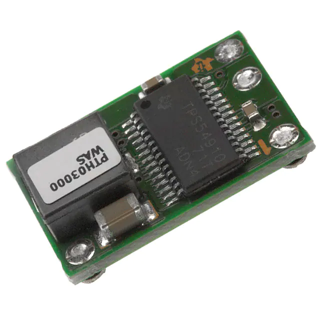

PTH03000W —3.3-V Input 6-A, 3.3-V Input Non-Isolated Wide-Output Adjust Power Module SLTS200C – MAY 2003 – REVISED DECEMBER 2003 Features NOMINAL SIZE = 0.75 in x 0.5 in (19,05 mm x 12,7 mm) • Up to 6-A Output Current • 3.3 V Input Voltage • Wide-Output Voltage Adjust (0.9 V to 2.5 V) • Efficiencies up to 95 % • 115 W/in³ Power Density • On/Off Inhibit • Under-Voltage Lockout • • • • • Output Current Limit Over-Temperature Protection Operating Temp: –40 to +85 °C Surface Mount Package Safety Agency Approvals (Pending): UL 1950, CSA 22.2 950, EN60950 & VDE Description Pin Configuration The PTH03000 series of non-isolated power modules are small in size and high on performance. Using double-sided surface mount construction and synchronous rectification technology, these regulators deliver up to 6 A of output current while occupying a PCB area of about half the size of a standard postage stamp. They are an ideal choice for applications where space, performance and cost are important design constraints. The series operates from an input voltage of 3.3 V to provide step-down power conversion to any output voltage over the range, 0.9 V to 2.5 V. The output voltage of the PTH03000W is set within this range using a single resistor. Operating features include an on/off inhibit, output voltage adjust (trim), an output current limit, and over-temperature protection. Target applications include telecom, industrial, and general purpose circuits, including low-power dual-voltage systems that use a DSP, microprocessor, or ASIC. Package options include both throughhole and surface mount configurations. Pin 1 2 3 4 5 * Denotes negative logic: Open = Output On Ground = Output Off Standard Application Rset = Required to set the output voltage to a value higher than 0.9 V (see spec. table for values) Cin = Required 100 µF capacitor Cout = Optional 100 µF capacitor 1 VIN 2 PTH03000W (Top View) 3 CIN 100 µF (Required) VOUT 5 4 RSET 1 %, 0.1 W (Required) COUT 100 µF Electrolytic (Optional) Inhibit GND For technical support and further information visit http://power.ti.com Function GND Vin Inhibit * Vo Adjust Vout GND PTH03000W —3.3-V Input 6-A, 3.3-V Input Non-Isolated Wide-Output Adjust Power Module SLTS200C – MAY 2003 – REVISED DECEMBER 2003 Ordering Information Output Voltage (PTH03000Hxx) Package Options (PTH03000xHH) (1) Code W Code Voltage 0.9 V – 2.5 V (Adjust) AH AS Description Pkg Ref. Horiz. T/H SMD, Standard (3) (2) (EUS) (EUT) Notes: (1) Add “T” to end of part number for tape and reel on SMD packages only. (2) Reference the applicable package reference drawing for the dimensions and PC board layout (3) “Standard” option specifies 63/37, Sn/Pb pin solder material. Pin Descriptions Vin: The positive input voltage power node to the module, which is referenced to common GND. Vout: The regulated positive power output with respect to the GND node. GND: This is the common ground connection for the ‘Vin’ and ‘Vout’ power connections. It is also the 0 VDC reference for the ‘Inhibit’ and ‘Vo Adjust’ control inputs. Inhibit: The Inhibit pin is an open-collector/drain negative logic input that is referenced to GND. Applying a lowlevel ground signal to this input disables the module’s output and turns off the output voltage. When the Inhibit control is active, the input current drawn by the regulator is significantly reduced. If the Inhibit pin is left opencircuit, the module will produce an output whenever a valid input source is applied. Vo Adjust: A 0.1 W 1 % resistor must be directly connected between this pin and the GND pin to set the output voltage to a value higher than 0.9 V. The temperature stability of the resistor should be 100 ppm/°C (or better). The set point range for the output voltage is from 0.9 V to 2.5 V. The resistor required for a given output voltage may be calculated from the following formula. If left open circuit, the output voltage will default to its lowest value. For further information on output voltage adjustment, consult the related application note. Rset = 10 kΩ · 0.891 V Vout – 0.9 V – 4.99 kΩ The specification table gives the preferred resistor values for a number of standard output voltages. For technical support and further information visit http://power.ti.com PTH03000W —3.3-V Input 6-A, 3.3-V Input Non-Isolated Wide-Output Adjust Power Module SLTS200C– MAY 2003 – REVISED DECEMBER 2003 Environmental & Absolute Maximum Ratings Characteristics Symbols Conditions Min Typ Max Units Operating Temperature Range Solder Reflow Temperature Storage Temperature Over Temperature Protection Mechanical Shock Ta Treflow Ts OTP Over Vin Range Surface temperature of module body or pins — IC junction temperature Per Mil-STD-883D, Method 2002.3 1 msec, ½ sine, mounted Mil-STD-883D, Method 2007.2 20-2000 Hz –40 (i) — –40 — — — 150 500 +85 235 (ii) +125 — — °C °C °C °C G’s — 20 — G’s — 2 — grams Mechanical Vibration Weight Flammability — — Meets UL 94V-O Notes: (i) During reflow of SMD package version do not elevate peak temperature of the module, pins or internal components above the stated maximum. Electrical Specifications Unless otherwise stated, T a =25 °C, V in =3.3 V, Vo =2 V, C in =100 µF, C out =0 µF, and Io =Iomax Characteristics Symbols Conditions Output Current Io 0.9 V ≤ Vo ≤ 2.5 V, Input Voltage Range Set-Point Voltage Tolerance Temperature Variation Line Regulation Load Regulation Total Output Variation Vin Vo tol ∆Regtemp ∆Regline ∆Regload ∆Regtot Over Io range Efficiency η Vo Ripple (pk-pk) Transient Response Vr Current Limit Under-Voltage Lockout ttr ∆Vtr Ilim UVLO Inhibit Control (pin 3) Input High Voltage Input Low Voltage Input Low Current VIH VIL IIL Standby Input Current Switching Frequency External Input Capacitance External Output Capacitance Iin inh ƒs Cin Cout Reliability MTBF Min Ta =60 °C, 200 LFM airflow Ta =25 °C, natural convection –40 °C 2800 mA >2400mA 7×8 6.3×9.8 7.3×5.7 1 1 1 ≤3 ≤2 ≤2 10SVP120M 16SPS100M 10TPE220ML 10 V 10 V 100 µF 220 µF 0.100 Ω 0.100 Ω >1090 mA >1414 mA 7.3L ×4.3W ×4.1H 1 1 ≤3 ≤3 TPSD107M010R0100 TPSV227M010R0100 Kemet T520, Poly-Alum (SMD) T495,Tantalum (SMD) A700-Poly-Alum. (SMD) 10 V 10 V 6.3 V 100 µF 100 µF 100 µF 0.080 Ω 0.100 Ω 0.018 Ω 1200 mA >1100 mA 2900 mA 7.3L ×5.7W ×4.0H 1 1 1 ≤4 ≤4 ≤2 T520D107M010AS T495X107M010AS A700D107M006AT Vishay-Sprague 594D, Tantalum (SMD) 595D, Tantalum (SMD) 94SA, Os-con (Radial) 10 V 10 V 10 V 150 µF 120 µF 100 µF 0.090 Ω 0.140 Ω 0.030 Ω 1100 mA >1000 mA 2670 mA 7.3L ×6.0W ×4.1H 8×10.5 1 1 1 ≤4 ≤4 ≤2 594D157X0010C2T 595D127X0010D2T 94SA107X0010EBP Kemet, Ceramic X5R (SMD) 16 V 6.3 V 10 47 0.002 Ω 0.002 Ω — 1210 case 3225 mm 1 2 [1] ≤5 ≤2 C1210C106M4PAC C1210C476K9PAC Murata, Ceramic X5R (SMD) 6.3 V 6.3 V 16 V 16 V 100 47 22 10 0.002 Ω — 1210 case 3225 mm 1 2 [1] 5 1 [2] ≤1 ≤2 ≤3 ≤5 GRM32ER60J107M GRM32ER60J476M GRM32ER61C226K GRM32DR61C106K TDK, Ceramic X5R (SMD) 6.3 V 6.3 V 16 V 16 V 100 47 22 10 0.002 Ω — 1210 case 3225 mm 1 2 [1] 5 1 [2] ≤1 ≤2 ≤3 ≤5 C3225X5R0J107MT C3225X5R0J476MT C3225X5R1C226MT C3225X5R1C106MT AVX, Tantalum TPS (SMD) Vendor Number [1] A total capacitance of 94 µF is acceptable based on the combined ripple current rating. [2] A ceramic capacitor may be used to complement electrolytic types at the input to further reduce high-frequency ripple current. For technical support and further information visit http://power.ti.com Application Notes PTH03000W Adjusting the Output Voltage of the PTH03000W Wide-Output Adjust Power Modules The Vo Adjust control (pin 4) sets the output voltage of the PTH03000Wproduct. The adjustment range is from 0.9 V to 2.5 V. The adjustment method requires the addition of a single external resistor, Rset, that must be connected directly between the Vo Adjust and GND pins 1. Table 2-1 gives the preferred value of the external resistor for a number of standard voltages, along with the actual output voltage that this resistance value provides. For other output voltages the value of the required resistor can either be calculated using the following formula, or simply selected from the range of values given in Table 2-2. Figure 2-1 shows the placement of the required resistor. Rset = 10 kΩ · 0.891 V Vout – 0.9 V – 4.99 kΩ Table 2-1; Preferred Values of Rset for Standard Output Voltages Vout (Standard) Rset (Pref’d Value) 2.5 V 2V 1.8 V 1.5 V 1.2 V 1V 0.9 V 576 Ω 3.09 kΩ 4.87 kΩ 9.76 kΩ 24.3 kΩ 82.5 kΩ Open Vout (Actual) 2.501V 2.003 V 1.804 V 1.504 V 1.204 V 1.002 V 0.9 V 4 PTH03000W Inhibit CIN 100µF (Required) 3 VO 5 VOUT GND 1 RSET 0.1 W, 1 % + VIN 0.900 0.925 0.950 0.975 1.000 1.025 1.050 1.075 1.100 1.125 1.150 1.175 1.200 1.225 1.250 1.275 1.300 1.325 1.350 1.375 1.400 1.425 1.450 1.475 Rset Open 351 kΩ 173 kΩ 114 kΩ 84.1 kΩ 66.3 kΩ 54.4 kΩ 45.9 kΩ 39.6 kΩ 34.6 kΩ 30.7 kΩ 27.4 kΩ 24.7 kΩ 22.4 kΩ 20.5 kΩ 18.8 kΩ 17.3 kΩ 16.0 kΩ 14.8 kΩ 13.8 kΩ 12.8 kΩ 12.0 kΩ 11.2 kΩ 10.5 kΩ Va Req’d 1.50 1.55 1.60 1.65 1.70 1.75 1.80 1.85 1.90 1.95 2.00 2.05 2.10 2.15 2.20 2.25 2.30 2.35 2.40 2.45 2.50 Rset 9.86 kΩ 8.72 kΩ 7.74 kΩ 6.89 kΩ 6.15 kΩ 5.49 kΩ 4.91 kΩ 4.39 kΩ 3.92 kΩ 3.50 kΩ 3.11 kΩ 2.76 kΩ 2.44 kΩ 2.14 kΩ 1.86 kΩ 1.61 kΩ 1.37 kΩ 1.15 kΩ 950 Ω 758 Ω 579 Ω 2. Never connect capacitors from Vo Adjust to either GND or Vout. Any capacitance added to the Vo Adjust pin will affect the stability of the regulator. V O Adj 2 Va Req’d Notes: 1. Use a 0.1 W resistor. The tolerance should be 1 %, with a temperature stability of 100 ppm/°C (or better). Place the resistor as close to the regulator as possible. Connect the resistor directly between pins 4 and 1 using dedicated PCB traces. Figure 2-1; Vo Adjust Resistor Placement VIN Table 2-2; Output Voltage Set-Point Resistor Values COUT 100µF (Optional) + Inhibit GND For technical support and further information visit http://power.ti.com GND Application Notes PTH03000 & PTH05000 Series Power-Up Characteristics When configured per their standard application, the PTH03000 and PTH05000 series of power modules will produce a regulated output voltage following the application of a valid input source voltage. During power up, internal soft-start circuitry slows the rate that the output voltage rises, thereby limiting the amount of in-rush current that can be drawn from the input source. The soft-start circuitry introduces a short time delay (typically 10 ms) into the power-up characteristic. This is from the point that a valid input source is recognized. Figure 3-1 shows the power-up waveforms for a PTH05000W (5-V input), with the output voltage set point adjusted for a 2-V output. The waveforms were measured with a 5-A resistive load. The initial rise in input current when the input voltage first starts to rise is the charge current drawn by the input capacitors. Figure 3-1 Vin (2 V/Div) Output On/Off Inhibit For applications requiring output voltage on/off control, the PTH03000W & PTH05000W power modules incorporate an output on/off Inhibit control (pin 3). The inhibit feature can be used wherever there is a requirement for the output voltage from the regulator to be turned off. The power module functions normally when the Inhibit pin is left open-circuit, providing a regulated output whenever a valid source voltage is connected to Vin with respect to GND. Figure 3-2 shows the typical application of the inhibit function. Note the discrete transistor (Q1). The Inhibit control has its own internal pull-up to Vin potential. An open-collector or open-drain device is recommended to control this input. Turning Q1 on applies a low voltage to the Inhibit control pin and disables the output of the module. If Q1 is then turned off, the module will execute a soft-start power-up sequence. A regulated output voltage is produced within 20 msec. Figure 3-3 shows the typical rise in the output voltage, following the turn-off of Q1. The turn off of Q1 corresponds to the fall in the waveform, Q1 Vgs. The waveforms were measured with a 5-A resistive load. Vo (1 V/Div) Figure 3-2 4 VO Adj VIN =5 V 2 PTH05000W Inhibit + HORIZ SCALE: 5 ms/Div Current Limit Protection The PTHxx000W modules protect against load faults with a continuous current limit characteristic. Under a load fault condition the output current cannot exceed the current limit value. Attempting to draw current that exceeds the current limit value causes the output voltage to be progressively reduced. Current is continuously supplied to the fault until it is removed. Upon removal of the fault, the output voltage will promptly recover. Thermal Shutdown Thermal shutdown protects the module’s internal circuitry against excessively high temperatures. A rise in temperature may be the result of a drop in airflow, a high ambient temperature, or a sustained current limit condition. If the junction temperature of the internal components exceed 150 °C, the module will shutdown. This reduces the output voltage to zero. The module will start up automatically, by initiating a soft-start power up when the sensed temperature decreases 10 °C below the thermal shutdown trip point. For technical support and further information visit http://power.ti.com VO =2 V 5 VIN CIN 330 µF (Required) Q1 BSS138 3 VO GND + Iin (2 A/Div) 1 COUT 100 µF (Optional) 4k87 0.1 W, 1 % Inhibit GND GND Figure 3-3 Vo (1 V/Div) Q1 Vgs (10 V/Div) HORIZ SCALE: 5 ms/Div L O A D PACKAGE OPTION ADDENDUM www.ti.com 19-Dec-2019 PACKAGING INFORMATION Orderable Device Status (1) Package Type Package Pins Package Drawing Qty Eco Plan Lead/Ball Finish MSL Peak Temp (2) (6) (3) Op Temp (°C) Device Marking (4/5) PTH03000WAD ACTIVE ThroughHole Module EUS 5 56 RoHS (In Work) & Green (In Work) SN N / A for Pkg Type PTH03000WAH ACTIVE ThroughHole Module EUS 5 56 RoHS (In Work) & Green (In Work) SN N / A for Pkg Type -40 to 85 PTH03000WAS ACTIVE Surface Mount Module EUT 5 49 Non-RoHS & Green (In Work) SNPB Level-1-235C-UNLIM/ Level-3-260C-168HRS -40 to 85 PTH03000WAST ACTIVE Surface Mount Module EUT 5 250 Non-RoHS & Green (In Work) SNPB Level-1-235C-UNLIM/ Level-3-260C-168HRS PTH03000WAZ ACTIVE Surface Mount Module EUT 5 49 RoHS (In Work) & Green (In Work) SNAGCU Level-3-260C-168 HR -40 to 85 PTH03000WAZT ACTIVE Surface Mount Module EUT 5 250 RoHS (In Work) & Green (In Work) SNAGCU Level-3-260C-168 HR -40 to 85 (1) The marketing status values are defined as follows: ACTIVE: Product device recommended for new designs. LIFEBUY: TI has announced that the device will be discontinued, and a lifetime-buy period is in effect. NRND: Not recommended for new designs. Device is in production to support existing customers, but TI does not recommend using this part in a new design. PREVIEW: Device has been announced but is not in production. Samples may or may not be available. OBSOLETE: TI has discontinued the production of the device. (2) RoHS: TI defines "RoHS" to mean semiconductor products that are compliant with the current EU RoHS requirements for all 10 RoHS substances, including the requirement that RoHS substance do not exceed 0.1% by weight in homogeneous materials. Where designed to be soldered at high temperatures, "RoHS" products are suitable for use in specified lead-free processes. TI may reference these types of products as "Pb-Free". RoHS Exempt: TI defines "RoHS Exempt" to mean products that contain lead but are compliant with EU RoHS pursuant to a specific EU RoHS exemption. Green: TI defines "Green" to mean the content of Chlorine (Cl) and Bromine (Br) based flame retardants meet JS709B low halogen requirements of
