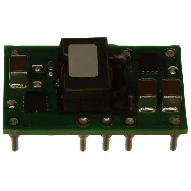

    PTH05060Y 用于 DDR/QDR 存储器的 10A 输出 5V 输入的总线终端电源模块
PTH05060YAH 数据手册
PTH03060Y PTH05060Y, PTH12060Y www.ti.com SLTS222A – MARCH 2004 – REVISED OCTOBER 2005 10-A NON-ISOLATED DDR/QDR MEMORY BUS TERMINATION MODULES FEATURES • • • • • • • • • VTT Bus Termination Output (Output Tracks the System VREF) 10 A Output Current 3.3-V, 5-V or 12-V Input Voltage DDR and QDR Compatible On/Off Inhibit (for VTT Standby) Undervoltage Lockout Operating Temperature: –40°C to 85°C Efficiencies up to 91% Output Overcurrent Protection (Non-Latching, Auto-Reset) • • • 57 W/in3 Power Density Safety Agency Approvals: UL/cUL60950, EN60950, VDE Point-of-Load Alliance (POLA™) Compatible NOMINAL SIZE 1 in. x 0.62 in (25,4 mm x 15,75 mm) DESCRIPTION The PTHxx060Y are a series of ready-to-use switching regulator modules from Texas Instruments designed specifically for bus termination in DDR and QDR memory applications. Operating from either a 3.3-V, 5-V or 12-V input, the modules generate a VTT output that will source or sink up to 10 A of current to accurately track their VREF input. VTT is the required bus termination supply voltage, and VREF is the reference voltage for the memory and chipset bus receiver comparators. VREF is usually set to half the VDDQ power supply voltage. Both the PTHxx060Y series employs an actively switched synchronous rectifier output to provide state-of-the-art stepdown switching conversion. The products are small in size (1 in × 0.62 in), and are an ideal choice where space, performance, and high efficiency are desired, along with the convenience of a ready-to-use module. Operating features include an on/off inhibit and output over-current protection (source mode only). The on/off inhibit feature allows the VTT bus to be turned off to save power in a standby mode of operation. To ensure tight load regulation, an output remote sense is also provided. Package options include both throughhole and surface mount configurations. STANDARD APPLICATION VIN VREF VDDQ 1k 1% 1 10 9 8 VTT 7 PTHxx060Y (Top View) 1k 1% 2 Con hf−Ceramic 6 3 4 5 Standby Q1 BSS138 (Optional) GND Co1 Low−ESR (Required) Co2 Ceramic (Optional) VTT Termination Island CIN (Required) SSTL−2 Bus CIN = Required Capacitor; 330µF (3.3 ± 5 V Input), 560 µF (12 V Input). Co1 = Required Low-ESR Electrolyitic Capacitor; 470 µF (3.3 ± 5 V Input), 940 µF (12 V Input). Co2 = Ceramic Capacitance for Optimum Response to a 3 A (+ 1.5 A) Load Transient; 200 µF (3.3 ± 5 V Input), 400 µF (12 V Input). Con = Distributed hf-Ceramic Decoupling Capacitors for VTT bus; as Recommended for DDR Memory Applications. Please be aware that an important notice concerning availability, standard warranty, and use in critical applications of Texas Instruments semiconductor products and disclaimers thereto appears at the end of this data sheet. POLA is a trademark of Texas Instruments. PRODUCTION DATA information is current as of publication date. Products conform to specifications per the terms of the Texas Instruments standard warranty. Production processing does not necessarily include testing of all parameters. Copyright © 2004–2005, Texas Instruments Incorporated PTH03060Y PTH05060Y, PTH12060Y www.ti.com SLTS222A – MARCH 2004 – REVISED OCTOBER 2005 ORDERING INFORMATION PTHXX060Y (Base Part Number) Input Voltage Part Number 3.3 V 5V 12 V (1) (2) (3) (4) (1) DESCRIPTION Pb – free and RoHS (3) Mechanical Package (2) PTH03060YAH Horizontal T/H Yes PTH03060YAS Standard SMD No (4) EUW EUY EUY PTH03060YAZ Optional SMD Yes (3) PTH05060YAH Horizontal T/H Yes (3) EUW PTH05060YAS Standard SMD No (4) EUY EUY PTH05060YAZ Optional SMD Yes (3) PTH12060YAH Horizontal T/H Yes (3) EUW PTH12060YAS Standard SMD No (4) EUY PTH12060YAZ Optional SMD Yes (3) EUY Add T to end of part number for tape and reel on SMD packages only. Reference the applicable package reference drawing for the dimensions and PC board layout. Lead (Pb) –free option specifies Sn/Ag pin solder material. Standard option specifies 63/37, Sn/Pb pin solder material. ENVIRONMENTAL AND ABSOLUTE MAXIMUM RATINGS voltages are with respect to GND UNIT VREF Control input voltage TA Operating temperature range Over VIN range Twave Wave solder temperature Surface temperature of module body or pins (5 seconds) Treflow Solder reflow temperature Surface temperature of module body or pins Ts Storage temperature –0.3 V to Vin+03 V 2 260°C (2) PTHXX060YAS 235°C (2) PTHXX060YAZ 260°C (2) –40°C to 125°C Per Mil-STD-883D, Method 2002.3 1 msec, 1/2 Sine, mounted 500 G Mechanical vibration Mil-STD-883D, Method 2007.2 20-2000 Hz 20 G Flammability (2) PTHXX060YAH Mechanical shock Weight (1) –40°C to 85°C (1) 3.7 grams Meets UL 94V-O For operation below 0°C, the external capacitors must have stable characteristics, use either a low ESR tantalum, Os-Con, or ceramic capacitor. During soldering of package version, do not elevate peak temperature of the module, pins or internal components above the stated maximum. PTH03060Y PTH05060Y, PTH12060Y www.ti.com SLTS222A – MARCH 2004 – REVISED OCTOBER 2005 ELECTRICAL SPECIFICATIONS TA = 25°C; nominal VIN; VREF = 1.25 V; CIN, CO1, and CO2 = typical values; and IO = IOmax (unless otherwise stated) PARAMETER Output current IO TEST CONDITIONS Over ∆VREF range Continuous PTH03060Y Input voltage range VIN Over IO range ∆VREF Tracking range for VREF |VTT– VREF| Tracking tolerance to VREF Over line, load and temperature η Efficiency Io = 8 A MIN MAX UNIT 0 TYP ±10 (1) A 2.95 3.65 PTH05060Y 4.5 5.5 PTH12060Y 10.8 13.2 0.55 1.8 V –10 10 mV PTH03060Y 86% PTH05060Y 86% PTH12060Y 83% V Vr Vo Ripple (pk-pk) 20 MHz bandwidth 20 Io trip Overcurrent threshold Reset, followed by auto recovery 20 A 30 µsec ttr Load transient response Vtr 15 A/µs load step, from: –1.5 A to 1.5 A VIN Increasing UVLO Under-voltage lockout VIN Dncreasing Recovery time VO over/undershoot 25 40 PTH03060Y 2.45 2.8 PTH05060Y 4.3 4.45 PTH12060Y 9.5 10.4 PTH03060Y 2.0 2.40 PTH05060Y 3.4 3.7 8.8 9 PTH12060Y Inhibit control (pin 4) Input high voltage VIH Referenced to GND VIL Inhibit control (pin 4) Input low voltage IIL inhibit Inhibit control (pin 4) Input low curent Pin to GND IIN inh Input standby current Inhibit control (pin 4) to GND fs Switching frequency CIN External input capacitance Over VIN and IO ranges CO1, CO2 External output capacitance Capacitance value: Ceramic (1) (2) (3) (4) (5) (6) Reliability Open (2) –0.2 0.6 10 350 PTH12060Y 200 250 300 330 (3) PTH03060Y/PTH05060Y 470 (4) 5500 (5) PTH12060Y 940 (4) 5500 (5) PTH03060Y/PTH05060Y 200 (4) 300 PTH12060Y 400 (4) 600 6 V kHz µF 560 4 (6) V mA 300 Per Bellcore TR-332 50 % stress, TA = 40°C, ground benign V µA 250 Equuivanent series resistance (non-ceramic) MTBF VIN–0.5 PTH03060Y/PTH05060Y PTH12060Y mV V 130 PTH03060Y/PTH05060Y Capacitance value: Nonceramic mVpp µF µF mΩ 106 Hrs Rating is conditional on the module being directly soldered to a 4-layer PCB with 1 oz. copper. See the SOA curves or contact the factory for appropriate derating. This control pin has an internal pull-up to the input voltage VIN. If it is left open-circuit the module will operate when input power is applied. A small low-leakage (
