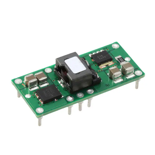

PTH03010Y PTH05010Y PTH12010Y www.ti.com SLTS223A – MARCH 2004 – REVISED OCTOBER 2005 15-A NON-ISOLATED DDR/QDR MEMORY BUS TERMINATION MODULES FEATURES • • • • • • • • • VTT Bus Termination Output (Output Tracks the System VREF) 15 A Output Current (12 A for 12-V Input) 3.3-V, 5-V or 12-V Input Voltage DDR and QDR Compatible On/Off Inhibit (for VTT Standby) Undervoltage Lockout Operating Temperature: –40°C to 85°C • • • Efficiencies up to 91% Output Overcurrent Protection (Nonlatching, Auto-Reset) 62 W/in3 Power Density Safety Agency Approvals UL/cUL60950, EN60950, VDE Point-of-Load Alliance (POLA™) Compatible Nominal Size 1.37 in x 0.62 in (34,8 mm x 15,75 mm) DESCRIPTION The PTHxx010Y are a series of ready-to-use switching regulator modules from Texas Instruments designed specifically for bus termination in DDR and QDR memory applications. Operating from either a 3.3-V, 5-V or 12-V input, the modules generate a VTT output that will source or sink up to 15 A of current (12 A for 12-V input) to accurately track their VREF input. VTT is the required bus termination supply voltage, and VREF is the reference voltage for the memory and chipset bus receiver comparators. VREF is usually set to half the VDDQ power supply voltage. Both the PTHxx010Y series employs an actively switched synchronous rectifier output to provide state-of-the-art stepdown switching conversion. The products are small in size (1.37 in × 0.62 in), and are an ideal choice where space, performance, and high efficiency are desired, along with the convenience of a ready-to-use module. Operating features include an on/off inhibit and output over-current protection (source mode only). The on/off inhibit feature allows the VTT bus to be turned off to save power in a standby mode of operation. To ensure tight load regulation, an output remote sense is also provided. Package options include both throughhole and surface mount configurations. STANDARD APPLICATION V IN V REF V DDQ 1k 1% 1 10 9 8 1k 1% V TT Con hf−Ceramic (Top View) 2 Q1 BSS138 (Optional) 6 3 4 5 Co1 Low−ESR (Required) Co2 Ceramic (Optional) V TTTermination Island CIN (Required) Standby 7 PTHxx010Y SSTL−2 Bus GND CIN = Required Capacitor; 470 µF (3.3 ± 5 V Input), 560 µF (12 V Input). Co1 = Required Low-ESR Electrolyitic Capacitor; 470 µF (3.3 ± 5 V Input), 940 µF (12 V Input). Co2 = Ceramic Capacitance for Optimum Response to a 3 A (± 1.5 A) Load Transient; 200 µF (3.3 ± 5 V Input), 400 µF (12 V Input). Con = Distributed hf-Ceramic Decoupling Capacitors for VTT bus; as Recommended for DDR Memory Applications. Please be aware that an important notice concerning availability, standard warranty, and use in critical applications of Texas Instruments semiconductor products and disclaimers thereto appears at the end of this data sheet. POLA is a trademark of Texas Instruments. PRODUCTION DATA information is current as of publication date. Products conform to specifications per the terms of the Texas Instruments standard warranty. Production processing does not necessarily include testing of all parameters. Copyright © 2004–2005, Texas Instruments Incorporated PTH03010Y PTH05010Y PTH12010Y www.ti.com SLTS223A – MARCH 2004 – REVISED OCTOBER 2005 ORDERING INFORMATION PTHXX010Y (Base Part Number) Input Voltage Part Number 3.3 V 5V 12 V (1) (2) (3) (4) (1) DESCRIPTION Pb – free and RoHS (3) Mechanical Package (2) PTH03010YAH Horizontal T/H Yes PTH03010YAS Standard SMD No (4) EUH EUJ EUJ PTH03010YAZ Optional SMD Yes (3) PTH05010YAH Horizontal T/H Yes (3) EUH PTH05010YAS Standard SMD No (4) EUJ EUJ PTH05010YAZ Optional SMD Yes (3) PTH12010YAH Horizontal T/H Yes (3) EUH PTH12010YAS Standard SMD No (4) EUJ PTH12010YAZ Optional SMD Yes (3) EUJ Add T to end of part number for tape and reel on SMD packages only. Reference the applicable package reference drawing for the dimensions and PC board layout. Lead (Pb) –free option specifies Sn/Ag pin solder material. Standard option specifies 63/37, Sn/Pb pin solder material. ENVIRONMENTAL AND ABSOLUTE MAXIMUM RATINGS voltages are with respect to GND UNIT VREF Control input voltage TA Operating temperature range Over VIN range Twave Wave solder temperature Surface temperature of module body or pins (5 seconds) Treflow Solder reflow temperature Surface temperature of module body or pins Ts –0.3 V to Vin+03 V 2 260°C (2) PTHXX010YAS 235°C (2) PTHXX010YAZ 260°C (2) Storage temperature –40°C to 125°C Per Mil-STD-883D, Method 2002.3 1 msec, 1/2 Sine, mounted 500 G Mechanical vibration Mil-STD-883D, Method 2007.2 20-2000 Hz 20 G Flammability (2) PTHXX010YAH Mechanical shock Weight (1) –40°C to 85°C (1) 3.7 grams Meets UL 94V-O For operation below 0°C the external capacitors must bave stable characteristics, use either a low ESR tantalum, Os-Con, or ceramic capacitor. During soldering of package version, do not elevate peak temperature of the module, pins or internal components above the stated maximum. PTH03010Y PTH05010Y PTH12010Y www.ti.com SLTS223A – MARCH 2004 – REVISED OCTOBER 2005 ELECTRICAL SPECIFICATIONS TA = 25°C; nominal VIN; VREF = 1.25 V; CIN, CO1, and CO2 = typical values; and IO = IOmax (unless otherwise stated) PARAMETER TEST CONDITIONS IO Output current Over ∆VREF range VIN Input voltage range Over IO range ∆VREF Tracking range for VREF |VTT– VREF| Tracking tolerance to VREF Over line, load and temperature η Efficiency Io = 10 A Vr Vo Ripple (pk-pk) 20 MHz bandwidth Io trip ttr Overcurrent threshold Load transient response Vtr Reset, followed by auto recovery 15 A/µs load step, from –1.5 A to 1.5 A Under-voltage lockout VIN Dncreasing Inhibit control (pin 4) Input high voltage VIH Inhibit control (pin 4) Input low voltage IIL inhibit Inhibit control (pin 4) Input low curent Pin to GND IIN inh Input standby current Inhibit (pin 3) to GND Switching frequency CIN External input capacitance Over VIN and IO ranges Capacitance value: Nonceramic CO1, CO2 External output capacitance Capacitance value: Ceramic (1) (2) (3) (4) (5) (6) Reliability MAX UNIT ±15 (1) A ±12 (1) PTH03010Y 2.95 PTH05010Y 4.5 5.5 PTH12010Y 10.8 13.2 0.55 1.8 V –10 10 mV 3.65 PTH03010Y 88% PTH05010Y 88% PTH12010Y 85% PTH03010Y/PTH05010Y 27.5 20 A 20 30 VO over/undershoot 30 40 PTH03010Y 2.45 2.8 PTH05010Y 4.3 4.45 PTH12010Y 9.5 10.4 PTH03010Y 2.0 2.40 PTH05010Y 3.4 3.7 PTH12010Y 8.8 9 µsec VIN–0.5 Open (2) –0.2 0.6 10 V V mA 250 300 350 PTH12010Y 200 250 300 PTH03010Y/PTH05010Y 470 (3) PTH12010Y 560 (3) PTH03010Y/PTH05010Y 470 (4) 8200 (5) PTH12010Y 940 (4) 6600 (5) kHz µF PTH03010Y/PTH05010Y 200 (4) 300 PTH12010Y 400 (4) 600 6 V µA PTH03010Y/PTH05010Y 4 (6) mV V 130 Per Bellcore TR-332 50 % stress, TA = 40°C, ground benign V mVpp Recovery time Equiv. series resistance (non-ceramic) MTBF TYP 0 PTH12010Y Referenced to GND VIL fs MIN PTH12010Y VIN Increasing UVLO PTH03010Y/PTH05010Y µF µF mΩ 106 Hrs Rating is conditional on the module being directly soldered to a 4-layer PCB with 1 oz. copper. See the SOA curves or contact the factory for appropriate derating. This control pin has an internal pull-up to the input voltage VIN. If it is left open-circuit the module will operate when input power is applied. A small low-leakage (
