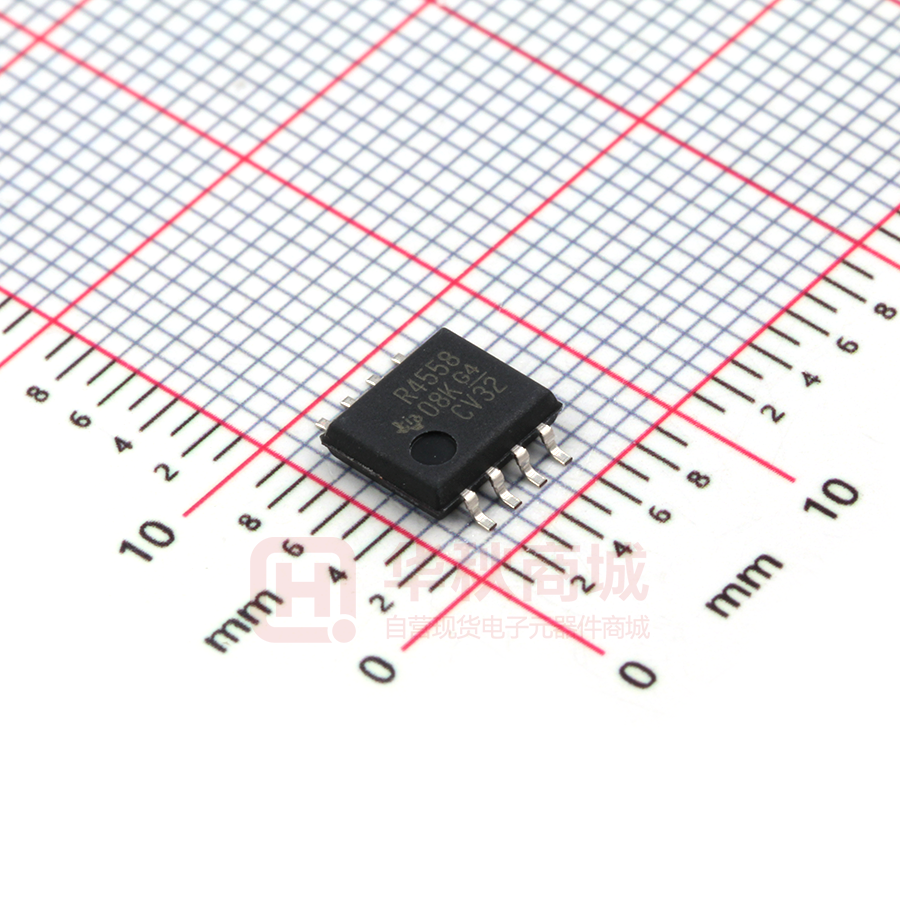

RC4558PSR
RC4558PSR
    BURR-BROWN(德州仪器)
    SOIC-8
    双路,30-V,3-MHz,低噪音(8-nV/√Hz)运算放大器
RC4558PSR 数据手册
Product Folder Sample & Buy Tools & Software Technical Documents Support & Community RC4558 SLOS073G – MARCH 1976 – REVISED OCTOBER 2014 RC4558 Dual General-Purpose Operational Amplifier 1 Features 3 Description • • The RC4558 device is a dual general-purpose operational amplifier, with each half electrically similar to the μA741, except that offset null capability is not provided. 1 • • • • • • Continuous Short-Circuit Protection Wide Common-Mode and Differential Voltage Ranges No Frequency Compensation Required Low Power Consumption No Latch-Up Unity-Gain Bandwidth: 3 MHz Typ Gain and Phase Match Between Amplifiers Low Noise: 8 nV/√Hz Typ at 1 kHz The high common-mode input voltage range and the absence of latch-up make this amplifier ideal for voltage-follower applications. The device is shortcircuit protected, and the internal frequency compensation ensures stability without external components. Device Information(1) 2 Applications • • PART NUMBER DVD Recorders and Players Pro Audio Mixers RC4558 PACKAGE (PIN) BODY SIZE SOIC (8) 4.90 mm × 3.91 mm SOIC (8) 3.00 mm × 3.00 mm PDIP (8) 9.81 mm × 6.35 mm TSSOP (8) 3.00 mm × 4.40 mm SOP (8) 6.20 mm × 5.30 mm (1) For all available packages, see the orderable addendum at the end of the datasheet. Noninverting Amplifier Schematic VIN RIN RG + VOUT RF 1 An IMPORTANT NOTICE at the end of this data sheet addresses availability, warranty, changes, use in safety-critical applications, intellectual property matters and other important disclaimers. PRODUCTION DATA. RC4558 SLOS073G – MARCH 1976 – REVISED OCTOBER 2014 www.ti.com Table of Contents 1 2 3 4 5 6 7 Features .................................................................. Applications ........................................................... Description ............................................................. Revision History..................................................... Pin Configuration and Functions ......................... Specifications......................................................... 1 1 1 2 3 4 6.1 6.2 6.3 6.4 6.5 6.6 6.7 4 4 4 4 5 5 6 Absolute Maximum Ratings ..................................... Handling Ratings....................................................... Recommended Operating Conditions....................... Thermal Information .................................................. Electrical Characteristics........................................... Operating Characteristics.......................................... Typical Characteristics .............................................. Detailed Description .............................................. 9 7.1 Overview ................................................................... 9 7.2 Functional Block Diagram ......................................... 9 7.3 Feature Description................................................... 9 7.4 Device Functional Modes.......................................... 9 8 Application and Implementation ........................ 10 8.1 Typical Application ................................................. 10 9 Power Supply Recommendations...................... 13 10 Layout................................................................... 14 10.1 Layout Guidelines ................................................. 14 10.2 Layout Example .................................................... 14 11 Device and Documentation Support ................. 15 11.1 Trademarks ........................................................... 15 11.2 Electrostatic Discharge Caution ............................ 15 11.3 Glossary ................................................................ 15 12 Mechanical, Packaging, and Orderable Information ........................................................... 15 4 Revision History Changes from Revision F (September 2010) to Revision G Page • Added Applications, Device Information table, Handling Ratings table, Feature Description section, Device Functional Modes, Application and Implementation section, Power Supply Recommendations section, Layout section, Device and Documentation Support section, and Mechanical, Packaging, and Orderable Information section. ..... 1 • Removed Ordering Information table. .................................................................................................................................... 1 2 Submit Documentation Feedback Copyright © 1976–2014, Texas Instruments Incorporated Product Folder Links: RC4558 RC4558 www.ti.com SLOS073G – MARCH 1976 – REVISED OCTOBER 2014 5 Pin Configuration and Functions D, DGK, P, PS, OR PW PACKAGE (TOP VIEW) 1OUT 1IN− 1IN+ VCC− 1 8 2 7 3 6 4 5 VCC+ 2OUT 2IN− 2IN+ Pin Functions PIN NAME NO. TYPE DESCRIPTION 1IN+ 3 I Noninverting input 1IN- 2 I Inverting Input 1OUT 1 O Output 2IN+ 5 I Noninverting input 2IN- 6 I Inverting Input 2OUT 7 O Output VCC+ 8 — Positive Supply VCC- 4 — Negative Supply Submit Documentation Feedback Copyright © 1976–2014, Texas Instruments Incorporated Product Folder Links: RC4558 3 RC4558 SLOS073G – MARCH 1976 – REVISED OCTOBER 2014 www.ti.com 6 Specifications 6.1 Absolute Maximum Ratings over operating free-air temperature range (unless otherwise noted) (1) MIN VCC+ VCC– MAX 18 Supply voltage (2) –18 UNIT V VID Differential input voltage (3) ±30 V VI Input voltage (any input) (2) (4) ±15 V Duration of output short circuit to ground, one amplifier at a time TJ (1) (2) (3) (4) (5) (5) Unlimited Operating virtual junction temperature 150 °C Stresses beyond those listed under Absolute Maximum Ratings may cause permanent damage to the device. These are stress ratings only, and functional operation of the device at these or any other conditions beyond those indicated under Recommended Operating Conditions is not implied. Exposure to absolute-maximum-rated conditions for extended periods may affect device reliability. All voltage values, unless otherwise noted, are with respect to the midpoint between VCC+ and VCC–. Differential voltages are at IN+ with respect to IN–. The magnitude of the input voltage must never exceed the magnitude of the supply voltage or 15 V, whichever is less. Temperature and/or supply voltages must be limited to ensure that the dissipation rating is not exceeded. 6.2 Handling Ratings Tstg Storage temperature range V(ESD) (1) (2) Electrostatic discharge MIN MAX UNIT -65 150 °C 0 500 0 1000 Human body model (HBM), per AEC Q100-002 (1) Charged device model (CDM), per AEC Q100-011 (2) V JEDEC document JEP155 states that 500-V HBM allows safe manufacturing with a standard ESD control process. JEDEC document JEP157 states that 250-V CDM allows safe manufacturing with a standard ESD control process. 6.3 Recommended Operating Conditions VCC+ VCC– TA MIN MAX 5 15 –5 –15 RC4558 0 70 RC4558I –40 85 Supply voltage Operating free-air temperature UNIT V °C 6.4 Thermal Information RC4558 THERMAL METRIC (1) D DGK Junction-to-ambient thermal resistance 97 172 P PS PW UNIT 95 149 °C/W 8 PINS RθJA (1) 4 85 For more information about traditional and new thermal metrics, see the IC Package Thermal Metrics application report, SPRA953. Submit Documentation Feedback Copyright © 1976–2014, Texas Instruments Incorporated Product Folder Links: RC4558 RC4558 www.ti.com SLOS073G – MARCH 1976 – REVISED OCTOBER 2014 6.5 Electrical Characteristics at specified free-air temperature, VCC+ = 15 V, VCC– = –15 V TEST CONDITIONS (1) PARAMETER VIO Input offset voltage VO = 0 IIO Input offset current VO = 0 IIB Input bias current VO = 0 VICR Common-mode input voltage range Maximum output voltage swing (2) 25°C ±12 ±14 ±12 ±14 ±13 25°C ±10 Full range ±10 25°C 20 Full range 15 25°C ri Input resistance 25°C CMRR Common-mode rejection ratio 25°C Equivalent input noise voltage (closed loop) AVD = 100, RS = 100 Ω, f = 1 kHz, BW = 1 Hz ICC Supply current (both amplifiers) VO = 0, No load PD VO1/VO2 (1) (2) VO = 0, No load Total power dissipation (both amplifiers) Open loop Crosstalk attenuation AVD = 100 RS = 1 kΩ, f = 10 kHz 6 mV 200 nA 500 nA 800 25°C Unity-gain bandwidth Vn 150 25°C B1 UNIT 300 25°C RL ≥ 2 kΩ, VO = ±10 V Supply-voltage sensitivity (ΔVIO/ΔVCC) 5 Full range Large-signal differential voltage amplification MAX 7.5 Full range AVD kSVS TYP 0.5 25°C RL = 2 kΩ VCC = ±15 V to ±9 V MIN Full range RL = 10 kΩ VOM TA V V 300 V/mV 3 MHz 0.3 5 MΩ 70 90 dB 25°C 30 25°C 8 25°C μV/V 150 nV/√Hz 2.5 5.6 TA min 3 6.6 TA max 2.3 5 25°C 75 170 TA min 90 200 TA max 70 150 85 25°C mA mW dB 105 All characteristics are measured under open-loop conditions with zero common-mode input voltage, unless otherwise specified. Full range is 0°C to 70°C for RC4558 and –40°C to 85°C for RC4558I. 6.6 Operating Characteristics VCC+ = 15 V, VCC– = –15 V, TA = 25°C PARAMETER tr SR TEST CONDITIONS MIN Rise time VI = 20 mV, RL = 2 kΩ, CL = 100 pF Overshoot VI = 20 mV, RL = 2 kΩ, CL = 100 pF Slew rate at unity gain VI = 10 V, RL = 2 kΩ, CL = 100 pF TYP MAX 0.13 Product Folder Links: RC4558 ns 5% 1.1 1.7 Submit Documentation Feedback Copyright © 1976–2014, Texas Instruments Incorporated UNIT V/μs 5 RC4558 SLOS073G – MARCH 1976 – REVISED OCTOBER 2014 www.ti.com 6 6 5 5 ICC – Supply Current – mA 4 3 2 1 4 3 2 1 0 0 2 4 6 8 10 12 14 16 18 0 -55 20 VCC – Supply Voltage – V -35 -15 5 25 45 65 Figure 1. Supply Current vs Supply Voltage (TA = 25°C) 40 40 30 -20 -60 10 -100 -120 Phase -60 Gain 10 0 -140 -160 -10 -40 20 Gain – dB -80 Gain Phase – deg 20 Gain – dB 30 -40 Phase -160 -180 -200 10000 -20 100 10 25 VOM – Output Voltage Swing – V VOM – Output Voltage Swing – V 30 5 0 -5 -10 -15 12 14 16 20 15 10 5 0 1.E+00 1.E+01 1.E+02 1.E+03 1.E+04 1.E+05 10 100 10k 100k 1.E+06 1 1k 1M 18 VCC – Supply Voltage – V f – Frequency – Hz Figure 5. Output Voltage Swing vs Supply Voltage (RL = 2 kΩ, TA = 25°C) 6 -200 10000 Figure 4. Gain and Phase vs Frequency (VCC = ±15 V, RL = 10 kΩ, CL = 22 pF) 15 10 1000 f – Frequency – kHz Figure 3. Gain and Phase vs Frequency (VCC = ±15 V, RL = 2 kΩ, CL = 22 pF) 8 -120 -140 -10 f – Frequency – kHz 6 -80 -100 -180 1000 125 0 -20 -20 100 105 Figure 2. Supply Current vs Temperature (VCC = ±15 V) 0 0 85 TA – Temperature – °C Phase – deg ICC – Supply Current – mA 6.7 Typical Characteristics Figure 6. Output Voltage Swing vs Frequency (VCC = ±15 V, RL = 2 kΩ, TA = 25°C) Submit Documentation Feedback Copyright © 1976–2014, Texas Instruments Incorporated Product Folder Links: RC4558 RC4558 www.ti.com SLOS073G – MARCH 1976 – REVISED OCTOBER 2014 Typical Characteristics (continued) 15 32 14.75 28 VOM – Output Voltage Swing – V VOM – Output Voltage Swing – V 30 26 24 22 20 18 16 14.5 14.25 14 13.75 13.5 13.25 14 12 100 1000 13 -55 10000 -35 -15 5 25 45 65 85 105 125 TA – Temperature – °C RloadR– –Load LoadResistance Resistance–– W L Figure 7. Output Voltage Swing vs Load Resistance (VCC = ±15 V, TA = 25°C) Figure 8. Output Voltage Swing vs Temperature (VCC = ±15 V, RL = 10 kΩ) 120 -12 110 100 -12.5 G M – Open Loop Gain – dB –V OM – Output Voltage Swing – V -12.25 -12.75 -13 -13.25 -13.5 90 80 70 60 50 40 30 20 -13.75 10 -14 -55 -35 -15 5 25 45 65 85 0 100 1.E+02 105 125 1k 1.E+03 TA – Temperature – °C 10k 1.E+04 100k 1.E+05 1M 1.E+06 10M 1.E+07 f – Frequency – Hz Figure 9. Negative Output Voltage Swing vs Temperature (VCC = ±15 V, RL = 10 kΩ) Figure 10. Open Loop Gain vs Frequency (VCC = ±15 V, RL = 2 kΩ, CL = 22 pF, TA = 25°C) 200 0.003 190 0.002 VIO – Input Offset Voltage – V IIB – Input Bias Current – nA 180 170 160 150 140 130 120 0.001 0 -0.001 -0.002 110 100 -55 -35 -15 5 25 45 65 85 -0.003 -55 105 125 -35 -15 5 25 45 65 85 105 125 TA – Temperature – °C TA – Temperature – °C Figure 11. Input Bias Current vs Temperature (VCC = ±15 V) Figure 12. Input Offset Voltage vs Temperature (VCC = ±15 V) Submit Documentation Feedback Copyright © 1976–2014, Texas Instruments Incorporated Product Folder Links: RC4558 7 RC4558 SLOS073G – MARCH 1976 – REVISED OCTOBER 2014 www.ti.com Typical Characteristics (continued) – Input NoiseVoltage Voltage––nV/rt(Hz) nV/ÖHz Vn V–n Input Noise 14 12 10 8 6 4 2 0 10 1.E+01 100 1.E+02 1k 1.E+03 10k 1.E+04 100k 1.E+05 f – Frequency – Hz Figure 13. Input Noise Voltage vs Frequency (VCC = ±15 V, TA = 25°C) 8 Submit Documentation Feedback Copyright © 1976–2014, Texas Instruments Incorporated Product Folder Links: RC4558 RC4558 www.ti.com SLOS073G – MARCH 1976 – REVISED OCTOBER 2014 7 Detailed Description 7.1 Overview The RC4558 device is a dual general-purpose operational amplifier, with each half electrically similar to the μA741, except that offset null capability is not provided. The high common-mode input voltage range and the absence of latch-up make this amplifier ideal for voltagefollower applications. The device is short-circuit protected, and the internal frequency compensation ensures stability without external components. 7.2 Functional Block Diagram VCC+ IN− IN+ OUT VCC− 7.3 Feature Description 7.3.1 Unity-Gain Bandwidth The unity-gain bandwidth is the frequency up to which an amplifier with a unity gain may be operated without greatly distorting the signal. The RC4558 device has a 3-MHz unity-gain bandwidth. 7.3.2 Common-Mode Rejection Ratio The common-mode rejection ratio (CMRR) of an amplifier is a measure of how well the device rejects unwanted input signals common to both input leads. It is found by taking the ratio of the change in input offset voltage to the change in the input voltage, then converting to decibels. Ideally the CMRR is infinite, but in practice, amplifiers are designed to have it as high as possible. The CMRR of the RC4558 device is 90 dB. 7.3.3 Slew Rate The slew rate is the rate at which an operational amplifier can change its output when there is a change on the input. The RC4558 device has a 1.7 V/μs slew rate. 7.4 Device Functional Modes The RC4558 device is powered on when the supply is connected. Each of these devices can be operated as a single supply operational amplifier or dual supply amplifier depending on the application. Submit Documentation Feedback Copyright © 1976–2014, Texas Instruments Incorporated Product Folder Links: RC4558 9 RC4558 SLOS073G – MARCH 1976 – REVISED OCTOBER 2014 www.ti.com 8 Application and Implementation NOTE Information in the following applications sections is not part of the TI component specification, and TI does not warrant its accuracy or completeness. TI’s customers are responsible for determining suitability of components for their purposes. Customers should validate and test their design implementation to confirm system functionality. 8.1 Typical Application Some applications require differential signals. Figure 14 shows a simple circuit to convert a single-ended input of 2 V to 10 V into differential output of ±8 V on a single 15-V supply. The output range is intentionally limited to maximize linearity. The circuit is composed of two amplifiers. One amplifier acts as a buffer and creates a voltage, VOUT+. The second amplifier inverts the input and adds a reference voltage to generate VOUT–. Both VOUT+ and VOUT– range from 2 V to 10 V. The difference, VDIFF, is the difference between VOUT+ and VOUT–. R2 15 V R1 VOUT+ R3 VREF 12 V + R4 VDIFF ± VOUT+ + VIN Figure 14. Schematic for Single-Ended Input to Differential Output Conversion 10 Submit Documentation Feedback Copyright © 1976–2014, Texas Instruments Incorporated Product Folder Links: RC4558 RC4558 www.ti.com SLOS073G – MARCH 1976 – REVISED OCTOBER 2014 Typical Application (continued) 8.1.1 Design Requirements The design requirements are as follows: • Supply voltage: 15 V • Reference voltage: 12V • Input: 2 V to 10 V • Output differential: ±8 V 8.1.2 Detailed Design Procedure The circuit in Figure 14 takes a single-ended input signal, VIN, and generates two output signals, VOUT+ and VOUT– using two amplifiers and a reference voltage, VREF. VOUT+ is the output of the first amplifier and is a buffered version of the input signal, VIN (see Equation 1). VOUT– is the output of the second amplifier which uses VREF to add an offset voltage to VIN and feedback to add inverting gain. The transfer function for VOUT– is Equation 2. VOUT+ = VIN (1) æ R 44 ö æ R22 ö R2 VOUT - VINin ´ 2 out - = VREF ref ´ ç ÷ ´ ç1 + ÷ + R 44 ø è R11 ø R11 è R33+ (2) The differential output signal, VDIFF, is the difference between the two single-ended output signals, VOUT+ and VOUT–. Equation 3 shows the transfer function for VDIFF. By applying the conditions that R1 = R2 and R3 = R4, the transfer function is simplified into Equation 6. Using this configuration, the maximum input signal is equal to the reference voltage and the maximum output of each amplifier is equal to the VREF. The differential output range is 2×VREF. Furthermore, the common mode voltage will be one half of VREF (see Equation 7). æ öæ æ R ö R4 R2 ö VD IF F = V O U T + - V O U T - = VIN ´ ç 1 + 2 ÷ - VR E F ´ ç ÷ ç1 + ÷ R1 ø R1 ø è è R3 + R4 ø è VOUT+ = VIN VOUT– = VREF – VIN VDIFF = 2×VIN – VREF (3) (4) (5) (6) + VOUT - ö 1 æV Vcm = ç OUT + ÷ = VREF 2 è ø 2 (7) 8.1.2.1 Amplifier Selection Linearity over the input range is key for good dc accuracy. The common mode input range and the output swing limitations determine the linearity. In general, an amplifier with rail-to-rail input and output swing is required. Bandwidth is a key concern for this design. Because RC4558 has a bandwidth of 3 MHz, this circuit will only be able to process signals with frequencies of less than 3 MHz. 8.1.2.2 Passive Component Selection Because the transfer function of VOUT– is heavily reliant on resistors (R1, R2, R3, and R4), use resistors with low tolerances to maximize performance and minimize error. This design used resistors with resistance values of 36 kΩ with tolerances measured to be within 2%. But, if the noise of the system is a key parameter, the user can select smaller resistance values (6 kΩ or lower) to keep the overall system noise low. This ensures that the noise from the resistors is lower than the amplifier noise. Submit Documentation Feedback Copyright © 1976–2014, Texas Instruments Incorporated Product Folder Links: RC4558 11 RC4558 SLOS073G – MARCH 1976 – REVISED OCTOBER 2014 www.ti.com Typical Application (continued) 8.1.3 Application Curves The measured transfer functions in Figure 15, Figure 16, and Figure 17 were generated by sweeping the input voltage from 0 V to 12 V. However, this design should only be used between 2 V and 10 V for optimum linearity. 16 16 12 14 12 VOUT+ (V) VDIFF (V) 8 4 0 10 8 6 ±4 4 ±8 2 0 ±12 0 2 4 6 8 10 VIN (V) 0 12 2 4 6 VIN (V) C003 Figure 15. Differential Output Voltage Node vs Input Voltage 8 10 12 C001 Figure 16. Positive Output Voltage Node vs Input Voltage 12 10 VOUTt (V) 8 6 4 2 0 0 2 4 6 8 VIN (V) 10 12 C002 Figure 17. Positive Output Voltage Node vs Input Voltage 12 Submit Documentation Feedback Copyright © 1976–2014, Texas Instruments Incorporated Product Folder Links: RC4558 RC4558 www.ti.com SLOS073G – MARCH 1976 – REVISED OCTOBER 2014 9 Power Supply Recommendations The RC4558 device is specified for operation from ±5 V to ±15 V; many specifications apply from –0°C to 70°C. The Typical Characteristics section presents parameters that can exhibit significant variance with regard to operating voltage or temperature. CAUTION Supply voltages outside of the ±18-V range can permanently damage the device (see the Absolute Maximum Ratings ). Place 0.1-μF bypass capacitors close to the power-supply pins to reduce errors coupling in from noisy or high impedance power supplies. For more detailed information on bypass capacitor placement, refer to the Layout Guidelines. Submit Documentation Feedback Copyright © 1976–2014, Texas Instruments Incorporated Product Folder Links: RC4558 13 RC4558 SLOS073G – MARCH 1976 – REVISED OCTOBER 2014 www.ti.com 10 Layout 10.1 Layout Guidelines For best operational performance of the device, use good PCB layout practices, including: Noise can propagate into analog circuitry through the power pins of the circuit as a whole and the operational amplifier. Bypass capacitors are used to reduce the coupled noise by providing low impedance power sources local to the analog circuitry. – Connect low-ESR, 0.1-μF ceramic bypass capacitors between each supply pin and ground, placed as close to the device as possible. A single bypass capacitor from V+ to ground is applicable for single supply applications. Separate grounding for analog and digital portions of circuitry is one of the simplest and most-effective methods of noise suppression. One or more layers on multilayer PCBs are usually devoted to ground planes. A ground plane helps distribute heat and reduces EMI noise pickup. Make sure to physically separate digital and analog grounds, paying attention to the flow of the ground current. For more detailed information, refer to Circuit Board Layout Techniques, (SLOA089). To reduce parasitic coupling, run the input traces as far away from the supply or output traces as possible. If it is not possible to keep them separate, it is much better to cross the sensitive trace perpendicular as opposed to in parallel with the noisy trace. Place the external components as close to the device as possible. Keeping RF and RG close to the inverting input minimizes parasitic capacitance, as shown in Layout Example. Keep the length of input traces as short as possible. Always remember that the input traces are the most sensitive part of the circuit. Consider a driven, low-impedance guard ring around the critical traces. A guard ring can significantly reduce leakage currents from nearby traces that are at different potentials. • • • • • • 10.2 Layout Example VIN RIN RG + VOUT RF Figure 18. Operational Amplifier Schematic for Noninverting Configuration Place components close to device and to each other to reduce parasitic errors Run the input traces as far away from the supply lines as possible VS+ RF OUT1 VCC+ GND IN1í OUT2 VIN IN1+ IN2í VCCí IN2+ RG GND RIN Use low-ESR, ceramic bypass capacitor Only needed for dual-supply operation GND VS(or GND for single supply) Ground (GND) plane on another layer Figure 19. Operational Amplifier Board Layout for Noninverting Configuration 14 Submit Documentation Feedback Copyright © 1976–2014, Texas Instruments Incorporated Product Folder Links: RC4558 RC4558 www.ti.com SLOS073G – MARCH 1976 – REVISED OCTOBER 2014 11 Device and Documentation Support 11.1 Trademarks All trademarks are the property of their respective owners. 11.2 Electrostatic Discharge Caution This integrated circuit can be damaged by ESD. Texas Instruments recommends that all integrated circuits be handled with appropriate precautions. Failure to observe proper handling and installation procedures can cause damage. ESD damage can range from subtle performance degradation to complete device failure. Precision integrated circuits may be more susceptible to damage because very small parametric changes could cause the device not to meet its published specifications. 11.3 Glossary SLYZ022 — TI Glossary. This glossary lists and explains terms, acronyms and definitions. 12 Mechanical, Packaging, and Orderable Information The following pages include mechanical packaging and orderable information. This information is the most current data available for the designated devices. This data is subject to change without notice and revision of this document. For browser based versions of this data sheet, refer to the left hand navigation. Submit Documentation Feedback Copyright © 1976–2014, Texas Instruments Incorporated Product Folder Links: RC4558 15 PACKAGE OPTION ADDENDUM www.ti.com 14-Aug-2021 PACKAGING INFORMATION Orderable Device Status (1) Package Type Package Pins Package Drawing Qty Eco Plan (2) Lead finish/ Ball material MSL Peak Temp Op Temp (°C) Device Marking (3) (4/5) (6) RC4558D ACTIVE SOIC D 8 75 RoHS & Green NIPDAU Level-1-260C-UNLIM 0 to 70 RC4558 RC4558DE4 ACTIVE SOIC D 8 75 RoHS & Green NIPDAU Level-1-260C-UNLIM 0 to 70 RC4558 RC4558DGKR ACTIVE VSSOP DGK 8 2500 RoHS & Green NIPDAU | NIPDAUAG Level-1-260C-UNLIM 0 to 70 (YRP, YRS, YRU) RC4558DGKRG4 ACTIVE VSSOP DGK 8 2500 RoHS & Green NIPDAU Level-1-260C-UNLIM 0 to 70 (YRP, YRS, YRU) RC4558DR ACTIVE SOIC D 8 2500 RoHS & Green NIPDAU | SN Level-1-260C-UNLIM 0 to 70 RC4558 RC4558DRG3 ACTIVE SOIC D 8 2500 RoHS & Green SN Level-1-260C-UNLIM 0 to 70 RC4558 RC4558DRG4 ACTIVE SOIC D 8 2500 RoHS & Green NIPDAU Level-1-260C-UNLIM 0 to 70 RC4558 RC4558ID ACTIVE SOIC D 8 75 RoHS & Green NIPDAU Level-1-260C-UNLIM -40 to 85 R4558I RC4558IDGKR ACTIVE VSSOP DGK 8 2500 RoHS & Green NIPDAU | NIPDAUAG Level-1-260C-UNLIM -40 to 85 (YSP, YSS, YSU) RC4558IDGKRG4 ACTIVE VSSOP DGK 8 2500 RoHS & Green NIPDAU Level-1-260C-UNLIM -40 to 85 (YSP, YSS, YSU) RC4558IDR ACTIVE SOIC D 8 2500 RoHS & Green NIPDAU Level-1-260C-UNLIM -40 to 85 R4558I RC4558IDRG4 ACTIVE SOIC D 8 2500 RoHS & Green NIPDAU Level-1-260C-UNLIM -40 to 85 R4558I RC4558IP ACTIVE PDIP P 8 50 RoHS & Green NIPDAU N / A for Pkg Type -40 to 85 RC4558IP RC4558IPW ACTIVE TSSOP PW 8 150 RoHS & Green NIPDAU Level-1-260C-UNLIM -40 to 85 R4558I RC4558IPWR ACTIVE TSSOP PW 8 2000 RoHS & Green NIPDAU | SN Level-1-260C-UNLIM -40 to 85 R4558I RC4558P ACTIVE PDIP P 8 50 RoHS & Green NIPDAU N / A for Pkg Type 0 to 70 RC4558P RC4558PE4 ACTIVE PDIP P 8 50 RoHS & Green NIPDAU N / A for Pkg Type 0 to 70 RC4558P RC4558PSR ACTIVE SO PS 8 2000 RoHS & Green NIPDAU Level-1-260C-UNLIM 0 to 70 R4558 RC4558PSRG4 ACTIVE SO PS 8 2000 RoHS & Green NIPDAU Level-1-260C-UNLIM 0 to 70 R4558 RC4558PW ACTIVE TSSOP PW 8 150 RoHS & Green NIPDAU Level-1-260C-UNLIM 0 to 70 R4558 Addendum-Page 1 Samples PACKAGE OPTION ADDENDUM www.ti.com 14-Aug-2021 Orderable Device Status (1) Package Type Package Pins Package Drawing Qty Eco Plan (2) Lead finish/ Ball material RoHS & Green NIPDAU | SN MSL Peak Temp Op Temp (°C) Device Marking (3) (4/5) (6) RC4558PWR ACTIVE TSSOP PW 8 2000 Level-1-260C-UNLIM 0 to 70 R4558 (1) The marketing status values are defined as follows: ACTIVE: Product device recommended for new designs. LIFEBUY: TI has announced that the device will be discontinued, and a lifetime-buy period is in effect. NRND: Not recommended for new designs. Device is in production to support existing customers, but TI does not recommend using this part in a new design. PREVIEW: Device has been announced but is not in production. Samples may or may not be available. OBSOLETE: TI has discontinued the production of the device. (2) RoHS: TI defines "RoHS" to mean semiconductor products that are compliant with the current EU RoHS requirements for all 10 RoHS substances, including the requirement that RoHS substance do not exceed 0.1% by weight in homogeneous materials. Where designed to be soldered at high temperatures, "RoHS" products are suitable for use in specified lead-free processes. TI may reference these types of products as "Pb-Free". RoHS Exempt: TI defines "RoHS Exempt" to mean products that contain lead but are compliant with EU RoHS pursuant to a specific EU RoHS exemption. Green: TI defines "Green" to mean the content of Chlorine (Cl) and Bromine (Br) based flame retardants meet JS709B low halogen requirements of
