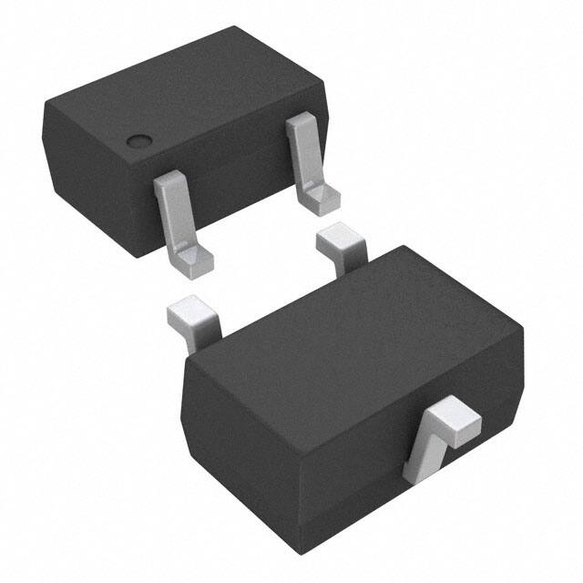

REF3312AIDCKT
REF3312AIDCKT
    BURR-BROWN(德州仪器)
    SOT-323(SC70)
    电压基准 IC 0.15% SC70-3
REF3312AIDCKT 数据手册
Order Now Product Folder Support & Community Tools & Software Technical Documents REF3312, REF3318, REF3320, REF3325, REF3330, REF3333 SBOS392H – AUGUST 2007 – REVISED AUGUST 2019 REF33xx 3.9-μA, SC70-3, SOT-23-3, and UQFN-8, 30-ppm/°C Drift Voltage Reference 1 Features 3 Description • • • • • • • • The REF33xx is a low-power, precision, low-dropout voltage reference family available in tiny SC70-3 and SOT-23-3 packages, and in a 1.5-mm × 1.5-mm UQFN-8 package. Small size and low power consumption (5-μA max) make the REF33xx ideal for a wide variety of portable and battery-powered applications. 1 Microsize Packages: SC70-3, SOT-23-3, UQFN-8 Low Supply Current: 3.9 μA (typ) Extremely Low Dropout Voltage: 110 mV (typ) High Output Current: ±5 mA Low Temperature Drift: 30 ppm/°C (max) High Initial Accuracy: ±0.15% (max) 0.1-Hz to 10-Hz Noise: 35 μVPP (REF3312) Voltage Options: 1.2 V, 1.8 V, 2.5 V, 3 V, 3.3 V 2 Applications • • • • • • • Portable Equipment Tablets and Smartphones Hard Disk Drives Sensor Modules Data Acquisition Systems Medical Equipment Test Equipment The REF33xx can be operated at a supply voltage 180 mV above the specified output voltage under normal load conditions, with the exception of the REF3312, which has a minimum supply voltage of 1.7 V. All models are specified for the wide temperature range of –40°C to +125°C. Device Information(1) PART NUMBER REF33xx BODY SIZE (NOM) SOT-23 (3) 2.92 mm × 1.30 mm SC70 (3) 2.00 mm × 1.25 mm UQFN (8) 1.50 mm × 1.50 mm (1) For all available packages, see the package option addendum at the end of the datasheet. REF3312 in a Single-Supply Signal Chain Dropout Voltage vs Load Current 200 +2.7V R3 PACKAGE R2 180 +2.7V MSP430x20x3PW Enable (1) P1.2 R1 66.5W A0+ C1 1.5nF VIN OPA333, OPA363, or OPA369 REF3312 VREF C2 1mF 16-Bit ADC VSS Dropout Voltage (mV) VCC 160 +125°C 140 120 100 80 60 +25°C 40 -40°C 20 0 -5 -4 -3 -2 -1 0 1 2 3 4 5 Load Current (mA) 1 An IMPORTANT NOTICE at the end of this data sheet addresses availability, warranty, changes, use in safety-critical applications, intellectual property matters and other important disclaimers. PRODUCTION DATA. REF3312, REF3318, REF3320, REF3325, REF3330, REF3333 SBOS392H – AUGUST 2007 – REVISED AUGUST 2019 www.ti.com Table of Contents 1 2 3 4 5 6 7 Features .................................................................. Applications ........................................................... Description ............................................................. Revision History..................................................... Device Comparison ............................................... Pin Configuration and Functions ......................... Specifications......................................................... 1 1 1 2 4 4 5 7.1 7.2 7.3 7.4 7.5 7.6 5 5 5 5 6 8 Absolute Maximum Ratings ...................................... ESD Ratings.............................................................. Recommended Operating Conditions....................... Thermal Information .................................................. Electrical Characteristics........................................... Typical Characteristics .............................................. 8 Parameter Measurement Information ................ 10 9 Detailed Description ............................................ 11 8.1 Thermal Hysteresis ................................................. 10 9.1 Overview ................................................................. 11 9.2 Functional Block Diagram ....................................... 11 9.3 Feature Description................................................. 11 9.4 Device Functional Modes........................................ 12 10 Applications and Implementation...................... 13 10.1 Application Information.......................................... 13 10.2 Typical Applications .............................................. 13 11 Power-Supply Recommendations ..................... 18 12 Layout................................................................... 19 12.1 Layout Guidelines ................................................. 19 12.2 Layout Example .................................................... 19 13 Device and Documentation Support ................. 20 13.1 13.2 13.3 13.4 13.5 13.6 13.7 Documentation Support ........................................ Related Links ........................................................ Receiving Notification of Documentation Updates Community Resources.......................................... Trademarks ........................................................... Electrostatic Discharge Caution ............................ Glossary ................................................................ 20 20 20 20 20 20 20 14 Mechanical, Packaging, and Orderable Information ........................................................... 21 4 Revision History NOTE: Page numbers for previous revisions may differ from page numbers in the current version. Changes from Revision G (December 2016) to Revision H Page • Changed maximum operating current value in Recommended Operating Conditions section.............................................. 5 • Changed table title to REF33xx (REF3312, REF3320, REF3325, REF3330, REF3333, REF3340) .................................... 6 Changes from Revision F (November 2016) to Revision G • Page Added Long-term stability parameter and associated footnote to REF33xx section of Electrical Characteristics table ........ 6 Changes from Revision E (October 2014) to Revision F Page • Changed minimum supply voltage value in second paragraph of Description section ......................................................... 1 • Changed Device Information table ........................................................................................................................................ 1 • Changed ESD Ratings table: changed title and format, moved Tstg parameter to Absolute Maximum Ratings table .......... 5 • Changed supply voltage value in footnote of Recommended Operating Conditions table .................................................... 5 • Changed supply voltage value in footnote 1 of Electrical Characteristics table .................................................................... 6 • Changed minimum supply voltage value in Device Functional Modes section ................................................................... 12 • Changed minimum supply voltage value in Power-Supply Recommendations section ...................................................... 18 Changes from Revision D (June 2014) to Revision E Page • Added REF3325 UQFN package to data sheet ..................................................................................................................... 1 • Added note to Applications and Implementation section...................................................................................................... 13 2 Submit Documentation Feedback Copyright © 2007–2019, Texas Instruments Incorporated Product Folder Links: REF3312 REF3318 REF3320 REF3325 REF3330 REF3333 REF3312, REF3318, REF3320, REF3325, REF3330, REF3333 www.ti.com SBOS392H – AUGUST 2007 – REVISED AUGUST 2019 Changes from Revision C (March 2014) to Revision D Page • Added note to Recommended Operating Conditions............................................................................................................. 5 • Moved Thermal Hysteresis section to Parameter Measurement Information section.......................................................... 10 • Changed Applications and Implementation section to latest standard; added new sections .............................................. 13 Changes from Revision B (February 2014) to Revision C • Page Changed Recommended Operating Conditions supply input voltage range maximum value from 55 to 5.5........................ 5 Changes from Revision A (September 2007) to Revision B Page • Changed document format to meet latest data sheet standards; added new sections and moved existing sections........... 1 • Moved package figures from front page to Pin Configuration and Functions ........................................................................ 1 • Added new figures to front page ........................................................................................................................................... 1 • Deleted Ordering Information table; see Package Option Addendum for most current ordering information........................ 4 • Added RSE pin configuration ................................................................................................................................................. 4 • Added Thermal Information table ........................................................................................................................................... 5 • Deleted Thermal Resistance parameter in Electrical Characteristics; see new Thermal Information table........................... 7 Copyright © 2007–2019, Texas Instruments Incorporated Submit Documentation Feedback Product Folder Links: REF3312 REF3318 REF3320 REF3325 REF3330 REF3333 3 REF3312, REF3318, REF3320, REF3325, REF3330, REF3333 SBOS392H – AUGUST 2007 – REVISED AUGUST 2019 www.ti.com 5 Device Comparison PRODUCT DESCRIPTION REF3312 1.25 V REF3318 1.8 V REF3320 2.048 V REF3325 2.5 V REF3330 3.0 V REF3333 3.3 V 6 Pin Configuration and Functions REF3312, REF3318, REF3320, REF3325, REF3330, REF3333 DBZ Package and DCK Package SOT-23-3, SC70-3 (Top View) REF3312, REF3318, REF3320, REF3325, REF3330, REF3333 RSE Package UQFN-8 (Top View) OUT IN 1 8 3 OUT GND NC 1 7 NC NC 2 6 NC NC 3 5 IN 4 2 GND Table 1. Pin Functions PIN NAME DBZ, DCK RSE GND 3 4 Ground IN 1 5 Input supply voltage NC — 1, 2, 3, 6, 7 Not connected OUT 2 8 Output voltage 4 Submit Documentation Feedback DESCRIPTION Copyright © 2007–2019, Texas Instruments Incorporated Product Folder Links: REF3312 REF3318 REF3320 REF3325 REF3330 REF3333 REF3312, REF3318, REF3320, REF3325, REF3330, REF3333 www.ti.com SBOS392H – AUGUST 2007 – REVISED AUGUST 2019 7 Specifications 7.1 Absolute Maximum Ratings over operating free-air temperature range (unless otherwise noted). (1) MIN Voltage 180 Operating –50 mA 150 Junction, TJ 150 Storage, Tstg (2) V 5 Output short-circuit, ISC (2) Temperature UNIT 7.5 Output voltage Current (1) MAX Input voltage –65 °C 150 Stresses beyond those listed under Absolute Maximum Ratings may cause permanent damage to the device. These are stress ratings only, which do not imply functional operation of the device at these or any other conditions beyond those indicated under Recommended Operating Conditions. Exposure to absolute-maximum-rated conditions for extended periods may affect device reliability. See the Power-Supply Recommendations section of this data sheet. 7.2 ESD Ratings VALUE V(ESD) (1) (2) Electrostatic discharge Human body model (HBM), per ANSI/ESDA/JEDEC JS-001 (1) ±4000 Charged device model (CDM), per JEDEC specification JESD22-C101 (2) ±1000 Machine model (MM) ±200 UNIT V JEDEC document JEP155 states that 500-V HBM allows safe manufacturing with a standard ESD control process. JEDEC document JEP157 states that 250-V CDM allows safe manufacturing with a standard ESD control process. 7.3 Recommended Operating Conditions over operating free-air temperature range (unless otherwise noted). MIN VIN Supply input voltage (1) IOUT Output current range (1) NOM MAX VOUT + 0.2 5.5 –5 5 UNIT V mA The minimum supply voltage for the REF3312 is 1.7 V. 7.4 Thermal Information REF3325, REF3330 REF33xx THERMAL METRIC (1) DCK (SC70) DBZ (SOT-23) RSE (UQFN) UNIT 3 PINS 3 PINS 8 PINS RθJA Junction-to-ambient thermal resistance 279.7 313.1 61.2 °C/W RθJC(top) Junction-to-case (top) thermal resistance 136.3 144.0 32.6 °C/W RθJB Junction-to-board thermal resistance 56.9 109.3 16.0 °C/W ψJT Junction-to-top characterization parameter 11.0 18.2 1.3 °C/W ψJB Junction-to-board characterization parameter 56.1 107.9 16.0 °C/W RθJC(bot) Junction-to-case (bottom) thermal resistance N/A N/A N/A °C/W (1) For more information about traditional and new thermal metrics, see the Semiconductor and IC Package Thermal Metrics application report. Copyright © 2007–2019, Texas Instruments Incorporated Submit Documentation Feedback Product Folder Links: REF3312 REF3318 REF3320 REF3325 REF3330 REF3333 5 REF3312, REF3318, REF3320, REF3325, REF3330, REF3333 SBOS392H – AUGUST 2007 – REVISED AUGUST 2019 www.ti.com 7.5 Electrical Characteristics At TA = 25°C, VIN = 5 V, and ILOAD = 0 mA (unless otherwise noted). PARAMETER TEST CONDITIONS MIN TYP MAX UNIT REF3312 (1.25 V) VOUT Output voltage 1.25 Initial accuracy –0.15% Output voltage noise f = 0.1 Hz to 10 Hz V 0.15% 35 μVPP REF3318 (1.8 V) VOUT Output voltage 1.8 Initial accuracy –0.15% Output voltage noise f = 0.1 Hz to 10 Hz V 0.15% 50 μVPP REF3320 (2.048 V) VOUT Output voltage 2.048 Initial accuracy –0.15% Output voltage noise f = 0.1 Hz to 10 Hz V 0.15% 55 μVPP REF3325 (2.5 V) VOUT Output voltage 2.5 Initial accuracy –0.15% Output voltage noise f = 0.1 Hz to 10 Hz V 0.15% 70 μVPP REF3330 (3.0 V) VOUT Output voltage 3.0 Initial accuracy –0.15% Output voltage noise f = 0.1 Hz to 10 Hz V 0.15% 84 μVPP REF3333 (3.3 V) VOUT Output voltage 3.3 Initial accuracy –0.15% Output voltage noise f = 0.1 Hz to 10 Hz V 0.15% 92 μVPP REF33xx (REF3312, REF3320, REF3325, REF3330, REF3333, REF3340) dVOUT/dT Output voltage temperature drift –40°C to 85°C 9 30 –40°C to 125°C 8 30 6 50 VIN = VOUT + 200 mV to 5.5 V (1) Line regulation ΔVO(ΔVI) –50 0°C to +70°C 6 –40°C to 85°C 8 –40°C to 125°C VIN = VOUT + 200 mV (1) Load regulation ΔVO(ΔIL) Long-term stability (2) VIN – VOUT Minimum dropout voltage (1) 6 ILOAD = ±5 mA, 0°C to 70°C 10 –40°C to 85°C 20 –40°C to 125°C 20 0h to 1000h at 25°C 55 Short-circuit current ILOAD = ±5 mA 110 0°C to 70°C 120 –40°C to 85°C 135 –40°C to 125°C 180 (1) (2) (3) 6 ppm/mA ppm ppm 160 mV 70 Sourcing and sinking Capacitive load 35 0.1 Turn-on settling time 50 90 ILOAD = ±2 mA, –40°C to 85°C ISC ppm/V 30 –50 Thermal hysteresis (3) dT ppm/°C To 0.1% with CL = 1 μF mA 10 2 μF ms The minimum supply voltage for the REF3312 is 1.7 V. The long-term stability number reduces as the time increases. The thermal hysteresis procedure is explained in more detail in the Thermal Hysteresis section. Submit Documentation Feedback Copyright © 2007–2019, Texas Instruments Incorporated Product Folder Links: REF3312 REF3318 REF3320 REF3325 REF3330 REF3333 REF3312, REF3318, REF3320, REF3325, REF3330, REF3333 www.ti.com SBOS392H – AUGUST 2007 – REVISED AUGUST 2019 Electrical Characteristics (continued) At TA = 25°C, VIN = 5 V, and ILOAD = 0 mA (unless otherwise noted). PARAMETER TEST CONDITIONS MIN TYP MAX UNIT POWER SUPPLY VS Operating voltage range IQ VOUT + 0.2 (1) Specified voltage range Current 5.5 V VOUT + 0.005 5.5 V 3.9 5 –40°C to 85°C 4.4 6.5 –40°C to 125°C 4.8 8.5 ILOAD = 0 mA µA TEMPERATURE TA Specified range –40 125 Operating range –50 150 Copyright © 2007–2019, Texas Instruments Incorporated Submit Documentation Feedback Product Folder Links: REF3312 REF3318 REF3320 REF3325 REF3330 REF3333 °C 7 REF3312, REF3318, REF3320, REF3325, REF3330, REF3333 SBOS392H – AUGUST 2007 – REVISED AUGUST 2019 www.ti.com 7.6 Typical Characteristics Unit (%) 0 1 3 4 5 6 8 9 10 11 13 14 15 16 18 19 20 21 23 24 25 26 0 1 3 4 5 6 8 9 10 11 13 14 15 16 18 19 20 21 23 24 25 26 Unit (%) At TA = 25°C and VIN = 5 V, and REF3325 used for typical characteristic measurements (unless otherwise noted). Drift (ppm/°C) Drift (ppm/°C) 0°C to 70°C –40°C to 125°C Figure 1. Temperature Drift Figure 2. Temperature Drift 200 0.05 Dropout Voltage (mV) Output Voltage Accuracy (%) 180 0 -0.05 -0.10 -0.15 160 +125°C 140 120 100 80 60 +25°C 40 -0.20 -40°C 20 -0.25 0 -50 0 -25 25 50 75 100 125 -5 150 -4 -3 -2 7 1000 6 100 Output Impedance (W) Quiescent Current (mA) 0 1 2 3 4 5 Figure 4. Dropout Voltage vs Load Current Figure 3. Output Voltage Accuracy vs Temperature 5 4 3 ILOAD = 0mA CLOAD = 1mF 10 1 ILOAD = 1mA CLOAD = 1mF 0.1 2 0 -50 -25 0 25 50 75 100 125 150 Temperature (°C) Figure 5. Quiescent Current vs Temperature 8 -1 Load Current (mA) Temperature (°C) Submit Documentation Feedback 1 10 100 1k 10k 100k Frequency (Hz) Figure 6. Output Impedance vs Frequency Copyright © 2007–2019, Texas Instruments Incorporated Product Folder Links: REF3312 REF3318 REF3320 REF3325 REF3330 REF3333 REF3312, REF3318, REF3320, REF3325, REF3330, REF3333 www.ti.com SBOS392H – AUGUST 2007 – REVISED AUGUST 2019 Typical Characteristics (continued) At TA = 25°C and VIN = 5 V, and REF3325 used for typical characteristic measurements (unless otherwise noted). 90 2.503 ILOAD = 1mA CLOAD = 1mF 80 ILOAD = 0mA 2.502 2.501 +125°C 60 Output (V) PSRR (dB) 70 50 40 30 2.500 2.499 +25°C 2.498 -40°C 20 2.497 10 2.496 2.495 0 10 100 1k 10k 100k 2.5 3.0 3.5 Frequency (Hz) 4.0 4.5 5.0 5.5 Supply (V) Figure 7. Power-Supply Rejection Ratio vs Frequency 2.503 Figure 8. Output vs Supply VS = 5V VIN 2.501 +125°C 2.500 VOUT 1V/div Output Voltage (V) 2.502 2.499 +25°C 2.498 2.497 -40°C 2.496 2.495 -5.0 -2.5 0 2.5 400ms/div 5.0 CL = 1-μF Startup Load Current (mA) Figure 10. Step Response 20mV/div 20mV/div 500mV/div Figure 9. Output Voltage vs Load Current 1s/div VIN VOUT 100ms/div CL = 1 μF, IOUT = 0 mA Figure 11. 0.1-Hz to 10-Hz Noise Copyright © 2007–2019, Texas Instruments Incorporated Figure 12. Line Transient Submit Documentation Feedback Product Folder Links: REF3312 REF3318 REF3320 REF3325 REF3330 REF3333 9 REF3312, REF3318, REF3320, REF3325, REF3330, REF3333 SBOS392H – AUGUST 2007 – REVISED AUGUST 2019 www.ti.com Typical Characteristics (continued) +5mA VIN -5mA -5mA ILOAD VOUT 50mV/div 10mV/div 500mV/div At TA = 25°C and VIN = 5 V, and REF3325 used for typical characteristic measurements (unless otherwise noted). VOUT Time (400ms/div) 200ms/div CLOAD = 10 μF, IOUT = 0 mA CL = 1 μF, ±5-mA Output Pulse Figure 14. Load Transient +1mA VIN -1mA -1mA ILOAD VOUT 20mV/div 10mV/div 500mV/div Figure 13. Line Transient Time (200ms/div) CLOAD = 10 μF, IOUT = 1 mA Figure 15. Line Transient VOUT 200ms/div CL = 1 μF, ±1-mA Output Pulse Figure 16. Load Transient 8 Parameter Measurement Information 8.1 Thermal Hysteresis Thermal hysteresis for the REF33xx is defined as the change in output voltage after operating the device at 25°C, cycling the device through the specified temperature range, and returning to 25°C. It can be expressed as Equation 1: æ V - VPOST ö 6 VHYST = ç PRE ÷÷ × 10 (ppm) ç V NOM è ø where • • • • 10 VHYST = thermal hysteresis (in units of ppm). VNOM = the specified output voltage. VPRE = output voltage measured at 25°C pretemperature cycling. VPOST = output voltage measured after the device cycles from 25°C through the specified temperature range of –40°C to 125°C and returns to 25°C. (1) Submit Documentation Feedback Copyright © 2007–2019, Texas Instruments Incorporated Product Folder Links: REF3312 REF3318 REF3320 REF3325 REF3330 REF3333 REF3312, REF3318, REF3320, REF3325, REF3330, REF3333 www.ti.com SBOS392H – AUGUST 2007 – REVISED AUGUST 2019 9 Detailed Description 9.1 Overview The REF33xx is a family of low-power, precision band-gap voltage references that are specifically designed for extremely low dropout, excellent initial voltage accuracy with a high output current. A simplified block diagram of the REF33xx is shown in the Functional Block Diagram section. Figure 17 shows the typical connections for the REF33xx. A supply bypass capacitor ranging between 1 μF to 10 μF is recommended. The total capacitive load at the output must be between 0.1 μF to 10 μF to ensure output stability. VIN REF33xx VIN CBYPASS 1mF to 10mF (recommended) VOUT VOUT GND CL 0.1mF to 10mF Figure 17. Basic Connections 9.2 Functional Block Diagram VIN REF33xx VOUT Bandgap 1.2V GND 9.3 Feature Description 9.3.1 Start-Up Time The REF33xx features an advanced start-up circuit. Start-up time is almost independent of load (with a 0.1-μF to 10-μF load). Upon startup, the current boost circuit forces the output voltage. When the preset voltage is reached, the REF33xx switches to the second stage of output circuitry to precisely set the output voltage. Figure 18 shows the start-up time of the REF3325 for three different capacitive loads. In all three cases, the output voltage settles within 2 ms. 0.1mF 1V/div VIN 1 mF 10mF Time (400ms/div) Figure 18. Start-Up Time Copyright © 2007–2019, Texas Instruments Incorporated Submit Documentation Feedback Product Folder Links: REF3312 REF3318 REF3320 REF3325 REF3330 REF3333 11 REF3312, REF3318, REF3320, REF3325, REF3330, REF3333 SBOS392H – AUGUST 2007 – REVISED AUGUST 2019 www.ti.com Feature Description (continued) 9.3.2 Low Temperature Drift The REF33xx is designed for minimal drift error, defined as the change in output voltage over temperature. The drift is calculated using the box method, as described in Equation 2: æ ö VOUTMAX - VOUTMIN 6 Drift = ç ÷ × 10 (ppm) V × Temperature Range è OUT ø (2) 9.3.3 Power Dissipation The REF33xx family is specified to deliver current loads of ±5 mA over the specified input voltage range. The temperature of the device increases according to Equation 3: TJ TA PD ˜ RT JA where • • • • TJ = junction temperature (°C). TA = ambient temperature (°C). PD = power dissipation (W) = VIN × IQ + (VIN – VOUT) IOUT. RθJA = Junction-to-ambient thermal resistance (°C/W). (3) The REF33xx junction temperature must not exceed the absolute maximum rating of 150°C. 9.3.4 Noise Performance Typical 0.1-Hz to 10-Hz voltage noise for each member of the REF33xx family is specified in the Electrical Characteristics table. The noise voltage increases with output voltage and operating temperature. Use additional filtering to improve output noise levels. Give special attention to ensure that the output impedance does not degrade output voltage accuracy. 9.4 Device Functional Modes The REF33xx is powered on when the voltage on the IN pin is greater than VOUT + 0.2 V, except for the REF3312, where the minimum supply voltage is 1.7 V. The maximum input voltage for the REF33xx is 5.5 V. Use a supply bypass capacitor ranging between 1 μF to 10 μF. The total capacitive load at the output must be between 0.1 μF to 10 μF to ensure output stability. 12 Submit Documentation Feedback Copyright © 2007–2019, Texas Instruments Incorporated Product Folder Links: REF3312 REF3318 REF3320 REF3325 REF3330 REF3333 REF3312, REF3318, REF3320, REF3325, REF3330, REF3333 www.ti.com SBOS392H – AUGUST 2007 – REVISED AUGUST 2019 10 Applications and Implementation NOTE Information in the following applications sections is not part of the TI component specification, and TI does not warrant its accuracy or completeness. TI’s customers are responsible for determining suitability of components for their purposes. Customers should validate and test their design implementation to confirm system functionality. 10.1 Application Information The REF33xx is a family of low-power, precision band-gap voltage references that are specifically designed for extremely low dropout, excellent initial voltage accuracy with a high output current. The extremely small size of the SC70-3, SOT-23-3, and UQFN-8 make these references very attractive for space-constrained applications. The following section describes one common application. 10.2 Typical Applications 10.2.1 REF3312 in a Bipolar Signal-Chain Configuration The circuit in Figure 19 consists of a low-power reference and conditioning circuit. This circuit attenuates and level-shifts a bipolar input voltage within the proper input range of a single-supply, low-power, 16-bit ΔΣ analogto-digital converter (ADC), such as the one inside the MSP430 (or other similar single-supply ADCs). Precision reference circuits are used to level-shift the input signal, provide the ADC reference voltage, and create a wellregulated supply voltage for the low-power analog circuitry. A low-power, zero-drift op amp circuit is used to attenuate and level-shift the input signal. REF3330 3.3 V 3.0 V IN OUT R2 20 k +1.25 V R3 20 k R1 100 k MSP430F2013 LaunchPad + 3.3 V +3.0 V VOUT + + ± R8 1k J1.2/A1+ OPA317 C1 0.15 …F _ R4 100 k J1.3/A1± IN+ IN± R5 10 k SD_16 û-ADC VREF VIN ±5 V REF3312 +3.0 V +1.25 V J1.5/VREF IN OUT R6 47 k R7 47 k 0.625 V C2 47 …F Figure 19. Bipolar Signal-Chain Configuration Copyright © 2007–2019, Texas Instruments Incorporated Submit Documentation Feedback Product Folder Links: REF3312 REF3318 REF3320 REF3325 REF3330 REF3333 13 REF3312, REF3318, REF3320, REF3325, REF3330, REF3333 SBOS392H – AUGUST 2007 – REVISED AUGUST 2019 www.ti.com Typical Applications (continued) 10.2.1.1 Design Requirements The design requirements are as follows: • Supply voltage: 3.3 V • Maximum input voltage: ±6 V • Specified input voltage: ±5 V • ADC reference voltage: 1.25 V 10.2.1.2 Detailed Design Procedure Figure 19 depicts a simplified schematic for this design showing the MSP430 ADC inputs and full input conditioning circuitry. The ADC is configured for a bipolar measurement where final conversion result is the differential voltage, VDIFF, between the positive and negative ADC inputs, A1+ and A1–. The bipolar, groundreferenced input signal must be level-shifted and attenuated by the op amp so that the output is biased to VREF / 2 and has a differential voltage that is within the ±VREF / 2 input range of the ADC. The transfer function for the op-amp circuit simplifies to Equation 4. § R3 ¨ © R 2 R3 A1 · ¸ VREF ¹ § R2 || R3 ¨ © R1 · ¸ VIN ¹ where • • R1 = R4 R5 = R2 || R3 (4) The voltage applied to the negative ADC input, A1–, is based on the resistor divider formed by R6 and R7 and is set to VREF / 2 by setting R6 equal to R7, as shown in Equation 5. § R7 · VREF A1 ¨ ¸ VREF R R 2 7¹ © 6 (5) 10.2.1.2.1 Op Amp Level-Shift Design The ratio of R2, R3, and the VREF voltage determines the voltage on the output of the op amp when the differential input is 0 V. Select the components so that VOUT is equal to the VREF / 2 voltage when VIN is equal to 0 V, as shown in Equation 6. VREF 2 A1 § R3 · ¨ ¸ VREF © R 2 R3 ¹ where • • VIN = 0 V R2 = R3 (6) Solve for the value of R5 by setting R3 equal to R2 in Equation 4, as shown in Equation 7: R5 § R2 ˜ R2 · ¨ ¸ © R2 R2 ¹ R22 2 ˜ R2 R2 2 (7) 10.2.1.2.2 Differential Input Attenuator Design VDIFF is the difference between the two inputs, as shown in Equation 8: VDIFF 14 A1+ A1 § R3 ¨ © R 2 R3 Submit Documentation Feedback · ¸ VREF ¹ § R2 || R3 ¨ © R1 · ¸ VIN ¹ VREF 2 (8) Copyright © 2007–2019, Texas Instruments Incorporated Product Folder Links: REF3312 REF3318 REF3320 REF3325 REF3330 REF3333 REF3312, REF3318, REF3320, REF3325, REF3330, REF3333 www.ti.com SBOS392H – AUGUST 2007 – REVISED AUGUST 2019 Typical Applications (continued) When the ratio of R3 and R2 equals the ratio of R7 and R6, Equation 8 simplifies to Equation 10. That is, if: § R3 · ¨ ¸ VREF © R 2 R3 ¹ § R7 · ¨ ¸ VREF © R 6 R7 ¹ 1 VREF 2 (9) Then: VDIFF § R2 || R3 · ¨ ¸ VIN © R1 ¹ (10) Determine the ratio of R1, R2, and R3 by setting A1+ equal to the maximum VDIFF for a full-scale positive or negative input voltage, VIN_MAX, as shown in Equation 11: A1+ § R2 || R3 ¨ © R1 VDIFF_MAX · ¸ VIN_MAX ¹ (11) R2 equals R3; therefore, Equation 11 simplifies to R2 / 2, resulting in Equation 12: VDIFF_MAX § R2 · ¨ ¸ VIN_MAX © 2 ˜ R1 ¹ (12) 10.2.1.2.3 Input Filtering Both inputs feature first-order, low-pass, antialiasing filters that limit the bandwidth and noise of the input signals applied to the ADC. The A1+ filter is formed by R8 and C1 and the equation for the –3-dB cutoff frequency is shown in Equation 13: 1 f 3dB_A1+ 2 ˜ S ˜ R8 ˜ C1 (13) The A1– input filter is formed by C2 and the parallel combination of the R6 and R7 resistors, as shown in Equation 14: 1 f 3dB _ A1 §R · 2 ˜ S ˜ ¨ 6 ¸ ˜ C2 © 2 ¹ (14) 10.2.1.2.4 Component Selection 10.2.1.2.4.1 Voltage References The REF33xx series of precision low-power voltage references pair well with the low power consumption of the MSP430, while achieving the target accuracy goals. The 16-bit converter in the MSP430F2013 accepts an external reference voltage from 1 V to 1.5 V with a typical reference input of 1.25 V, as shown in Table 2. Table 2. SD16_A, External Reference Input (MSP430F20x3) (1) PARAMETER TEST CONDITIONS VREF(I) Input voltage range VCC = 3 V, SD16REFON = 0 IREF(I) Input current VCC = 3 V, SD16REFON = 0 (1) MIN TYP MAX 1 1.25 1.5 UNIT V 50 nA Over recommended ranges of supply voltage and operating free-air temperature (unless otherwise noted). The REF3312 provides the desired 1.25-V reference voltage for the MSP430 ADC. The accuracy of the REF3312 output, shown in the Electrical Characteristics, directly affects the accuracy of the entire system and must be less than the desired unadjusted error goals. The REF3312 maximum ±0.15% initial accuracy specification is equal to the unadjusted error design goal of 0.15%, indicating that most of the error budget in this design must be devoted to the reference accuracy. Copyright © 2007–2019, Texas Instruments Incorporated Submit Documentation Feedback Product Folder Links: REF3312 REF3318 REF3320 REF3325 REF3330 REF3333 15 REF3312, REF3318, REF3320, REF3325, REF3330, REF3333 SBOS392H – AUGUST 2007 – REVISED AUGUST 2019 www.ti.com The 3.3-V system supply voltage that powers the MSP430 can also supply other devices, and therefore may have regulation and noise issues. The REF3330 creates an accurate and stable 3.0 V output used by the op amp, REF3312, and other low-power analog circuitry. The REF33xx series has a drop-output voltage of VOUT + 200 mV; therefore, as long as the input supply remains above 3.2 V, the REF3330 produces a regulated 3.0 V output. The output current for the REF33xx series is specified at ±5 mA, as shown in Figure 9, and is sufficient for the REF3312 and a low-power op amp. 10.2.1.2.4.2 Op Amp The OPA317 op amp is used because of low offset voltage, low offset voltage drift, CMRR, and low power consumption. The dc specifications for the OPA317 can be seen in the OPA317 data sheet, SBOS682, available for download from www.ti.com. The maximum offset of 100 µV accounts for only 0.001% of the full-scale signal, and the low-drift reduces temperature drift effects. Therefore, as previously mentioned, most of the error in this design is from the reference accuracy and passive component tolerances. 10.2.1.2.5 Input Attenuation and Level Shifting For this design, the bipolar ±5-V input must be attenuated and level shifted so the differential voltage is within the input range of ±VREF / 2, or ±0.625 V. The accuracy of the op amp output and ADC input may degrade near the supply rails and VREF voltage, so the output is designed to produce a 0.125 V to 1.125 V output, or ±0.5 V for a ±5 V input. Scaling the output this way also increases the allowable input range to ±6 V, and allows for some underscale and overscale voltage measurement and protection. Use Equation 12 to scale the ±5-V input to a ±0.5-V differential voltage, as shown in Equation 15. R2 § · 0.5 V ¨ ¸˜5 V 2 100 k ˜ © ¹ where • R1 = R4 = 100 kΩ (15) R1 and R4 dominate the input impedance for this design and are therefore selected to be 100 kΩ. Higher values can be selected to increase the input impedance at the expense of input noise. With the value for R2 and R3 selected as 20 kΩ, the value for R5 is calculated, as shown in Equation 16: §R · R5 ¨ 2 ¸ 10 k: © 2 ¹ where • R2 = R3 = 20 kΩ (16) In order for A1– to equal to VREF / 2, R6 must equal R7. Two 47-kΩ resistors are used in order to conserve power without creating an impedance too weak to drive the ADC input. 10.2.1.2.6 Input Filtering The MSP430 ADC is configured to run from the 1.1-MHz SMCLK with an oversampling rate (OSR) of 256, yielding a sample rate of roughly 4.3 kHz. The input filter cutoff frequency is set to 1 kHz in order to limit the input signal bandwidth, as shown in Equation 17. R8 is 1 kΩ in order to provide isolation from the capacitive load of the low-pass filter, thereby reducing stability concerns. 1 f 3dB_A1+ 1 kHz 2 ˜ S ˜ R8 ˜ C1 where • C1 1 2 ˜ S ˜ 1 k ˜ N+] 159 nF (17) Reduce C1 to 150 nF so that it is a standard value. The A1– input of the delta-sigma (ΔΣ) converter is not buffered, and therefore requires a large capacitor to supply the charge for the internal sampling capacitor. A 47-μF capacitor is selected, resulting in the cutoff frequency illustrated in Equation 18. 16 Submit Documentation Feedback Copyright © 2007–2019, Texas Instruments Incorporated Product Folder Links: REF3312 REF3318 REF3320 REF3325 REF3330 REF3333 REF3312, REF3318, REF3320, REF3325, REF3330, REF3333 www.ti.com f SBOS392H – AUGUST 2007 – REVISED AUGUST 2019 1 R § 2˜S ˜¨ 6 © 2 3dB _ A1 0.144 Hz · ¸ ˜ C2 ¹ (18) In applications that cannot tolerate such a low-frequency cutoff, and therefore a long start-up time, buffer the A1– input with another OPA317 to properly drive the ADC input with a lower-input capacitor. 10.2.1.2.7 Passive Component Tolerances and Materials Resistors R1, R2, R3, R4, R5, R6, and R7 directly affect the accuracy of the circuit. To meet the unadjusted accuracy goals of 0.2%, the resistors used are 0.1%. Select 0.1% resistors for the construction of the difference amplifier circuit to provide a common-mode rejection ratio (CMRR) of at least 60 dB. 10.2.1.3 Application Curves 10.2.1.3.1 DC Performance The measured dc performance and calculated error of the circuit is shown in Figure 20 and Figure 21, respectively. By applying a two-point gain and offset calibration over the specified ±5-V input range, the calibrated error is shown in Figure 22. The uncalibrated results show errors of 138 μV, or 0.0138%FSR. The calibrated results with a simple two-point calibration show errors under 5 μV, or 0.0005%FSR, in the specified input range of ±5 V. 1.25 50 25 Output Voltage Error (µV) Output Voltage (V) 1.00 0.75 0.50 0.25 0 ±25 ±50 ±75 ±100 ±125 0.00 ±150 ±6 ±5 ±4 ±3 ±2 ±1 0 1 2 3 4 5 Input Voltage (V) 6 ±6 ±5 ±4 ±3 ±2 ±1 0 1 2 3 4 5 Input Voltage (V) C01 Figure 20. Measured DC Transfer Function with ±6-V Input 6 C01 Figure 21. Measured Output Error with ±6-V Input Calibrated Output Error ( V) 40 30 20 10 0 ±10 ±6 ±5 ±4 ±3 ±2 ±1 0 1 2 3 4 5 6 Input Voltage (V) C01 Figure 22. Calibrated Output Error with ±6-V Input Copyright © 2007–2019, Texas Instruments Incorporated Submit Documentation Feedback Product Folder Links: REF3312 REF3318 REF3320 REF3325 REF3330 REF3333 17 REF3312, REF3318, REF3320, REF3325, REF3330, REF3333 SBOS392H – AUGUST 2007 – REVISED AUGUST 2019 www.ti.com 10.2.1.3.2 AC Performance The ac transfer function for the attenuation and level-shifting circuit is shown in Figure 23. The low-frequency ac CMRR performance is measured to be 62 dB, as shown in Figure 24. 0 0 ±10 ±20 CMRR (dB) Vout (dB) ±20 ±40 ±30 ±40 ±50 ±60 ±60 ±70 ±80 ±80 1 10 100 1K 10 K Frequency (Hz) Figure 23. Measured AC Transfer Function 100 K C00 1 10 100 1K 10 K 100 K Frequency (Hz) 1,000 K C00 Figure 24. Measured AC CMRR Results 11 Power-Supply Recommendations The REF33xx family of voltage references features extremely low dropout voltage, except for the REF3312. The REF3312 has a minimum supply requirement of 1.7 V. These references can be operated with a supply 110 mV above the output voltage with a 5-mA load (typical). For loaded conditions, a typical dropout voltage versus load graph is illustrated in Figure 4 of the Typical Characteristics. If the supply voltage connected to the IN pin is rapidly moved when the REF33xx is connected to a capacitive load, a reverse voltage can discharge through the OUT pin and into the REF33xx. This voltage does not damage the REF33xx, provided that the voltage is less than or equal to 5 V. 18 Submit Documentation Feedback Copyright © 2007–2019, Texas Instruments Incorporated Product Folder Links: REF3312 REF3318 REF3320 REF3325 REF3330 REF3333 REF3312, REF3318, REF3320, REF3325, REF3330, REF3333 www.ti.com SBOS392H – AUGUST 2007 – REVISED AUGUST 2019 12 Layout 12.1 Layout Guidelines For optimal performance of this design, follow standard printed circuit board (PCB) layout guidelines, including proper decoupling close to all integrated circuits and adequate power and ground connections with large copper pours. Select a PCB size with connectors that connect directly to the MSP430 LaunchPad™. Figure 25 shows an example of a PCB layout for a data acquisition system using the REF33xx. Some key considerations are: • Connect a low-ESR, 1-μF ceramic capacitor at the IN pin for bypass, and a 0.1-µF to 10-µF ceramic capacitor at the OUT pin for stability of the REF33xx. • Decouple other active devices in the system per the device specifications. • Use a solid ground plane helps distribute heat and reduces EMI noise pickup. • Place the external components as close to the device as possible. This configuration prevents parasitic errors (such as the Seebeck effect) from occurring. • Minimize trace length between the reference and bias connections to the ADC to reduce noise pickup. • Do not run sensitive analog traces in parallel with digital traces. Avoid crossing digital and analog traces if possible, and only make perpendicular crossings when absolutely necessary. 12.2 Layout Example Input Signal GND REF33xx AIN REF OUT C C Microcontroller ADC Input IN Via to GND Plane Via to Input Power Figure 25. Layout Example Copyright © 2007–2019, Texas Instruments Incorporated Submit Documentation Feedback Product Folder Links: REF3312 REF3318 REF3320 REF3325 REF3330 REF3333 19 REF3312, REF3318, REF3320, REF3325, REF3330, REF3333 SBOS392H – AUGUST 2007 – REVISED AUGUST 2019 www.ti.com 13 Device and Documentation Support 13.1 Documentation Support 13.1.1 Related Documentation OPAx333 1.8-V, microPower, CMOS Operational Amplifiers, Zero-Drift Series (SBOS351) OPAx363, OPAx364 1.8-V, 7-MHz, 90-dB CMRR, Single-Supply, Rail-to-Rail I/O Operational Amplifier (SBOS259) OPAx369 1.8V, 700nA, Zerø-Crossover Rail-to-Rail I/O Operational Amplifier (SBOS414) INA159 Precision, Gain of 0.2 Level Translation Difference Amplifier (SBOS333) 13.2 Related Links The table below lists quick access links. Categories include technical documents, support and community resources, tools and software, and quick access to sample or buy. Table 3. Related Links PARTS PRODUCT FOLDER SAMPLE & BUY TECHNICAL DOCUMENTS TOOLS & SOFTWARE SUPPORT & COMMUNITY REF3312 Click here Click here Click here Click here Click here REF3318 Click here Click here Click here Click here Click here REF3320 Click here Click here Click here Click here Click here REF3325 Click here Click here Click here Click here Click here REF3330 Click here Click here Click here Click here Click here REF3333 Click here Click here Click here Click here Click here 13.3 Receiving Notification of Documentation Updates To receive notification of documentation updates, navigate to the device product folder on ti.com. In the upper right corner, click on Alert me to register and receive a weekly digest of any product information that has changed. For change details, review the revision history included in any revised document. 13.4 Community Resources TI E2E™ support forums are an engineer's go-to source for fast, verified answers and design help — straight from the experts. Search existing answers or ask your own question to get the quick design help you need. Linked content is provided "AS IS" by the respective contributors. They do not constitute TI specifications and do not necessarily reflect TI's views; see TI's Terms of Use. 13.5 Trademarks LaunchPad, E2E are trademarks of Texas Instruments. All other trademarks are the property of their respective owners. 13.6 Electrostatic Discharge Caution This integrated circuit can be damaged by ESD. Texas Instruments recommends that all integrated circuits be handled with appropriate precautions. Failure to observe proper handling and installation procedures can cause damage. ESD damage can range from subtle performance degradation to complete device failure. Precision integrated circuits may be more susceptible to damage because very small parametric changes could cause the device not to meet its published specifications. 13.7 Glossary SLYZ022 — TI Glossary. This glossary lists and explains terms, acronyms, and definitions. 20 Submit Documentation Feedback Copyright © 2007–2019, Texas Instruments Incorporated Product Folder Links: REF3312 REF3318 REF3320 REF3325 REF3330 REF3333 REF3312, REF3318, REF3320, REF3325, REF3330, REF3333 www.ti.com SBOS392H – AUGUST 2007 – REVISED AUGUST 2019 14 Mechanical, Packaging, and Orderable Information The following pages include mechanical packaging and orderable information. This information is the most current data available for the designated devices. This data is subject to change without notice and revision of this document. For browser-based versions of this data sheet, refer to the left-hand navigation. Copyright © 2007–2019, Texas Instruments Incorporated Submit Documentation Feedback Product Folder Links: REF3312 REF3318 REF3320 REF3325 REF3330 REF3333 21 PACKAGE OPTION ADDENDUM www.ti.com 6-Feb-2020 PACKAGING INFORMATION Orderable Device Status (1) Package Type Package Pins Package Drawing Qty Eco Plan Lead/Ball Finish MSL Peak Temp (2) (6) (3) Op Temp (°C) Device Marking (4/5) REF3312AIDBZR ACTIVE SOT-23 DBZ 3 3000 Green (RoHS & no Sb/Br) NIPDAU Level-2-260C-1 YEAR -40 to 125 R33A REF3312AIDBZRG4 ACTIVE SOT-23 DBZ 3 3000 Green (RoHS & no Sb/Br) NIPDAU Level-2-260C-1 YEAR -40 to 125 R33A REF3312AIDBZT ACTIVE SOT-23 DBZ 3 250 Green (RoHS & no Sb/Br) NIPDAU Level-2-260C-1 YEAR -40 to 125 R33A REF3312AIDBZTG4 ACTIVE SOT-23 DBZ 3 250 Green (RoHS & no Sb/Br) NIPDAU Level-2-260C-1 YEAR -40 to 125 R33A REF3312AIDCKR ACTIVE SC70 DCK 3 3000 Green (RoHS & no Sb/Br) NIPDAU Level-2-260C-1 YEAR -40 to 125 R12 REF3312AIDCKRG4 ACTIVE SC70 DCK 3 3000 Green (RoHS & no Sb/Br) NIPDAU Level-2-260C-1 YEAR -40 to 125 R12 REF3312AIDCKT ACTIVE SC70 DCK 3 250 Green (RoHS & no Sb/Br) NIPDAU Level-2-260C-1 YEAR -40 to 125 R12 REF3312AIDCKTG4 ACTIVE SC70 DCK 3 250 Green (RoHS & no Sb/Br) NIPDAU Level-2-260C-1 YEAR -40 to 125 R12 REF3312AIRSER ACTIVE UQFN RSE 8 5000 Green (RoHS & no Sb/Br) NIPDAU Level-1-260C-UNLIM -40 to 125 5G REF3312AIRSET ACTIVE UQFN RSE 8 250 Green (RoHS & no Sb/Br) NIPDAU Level-1-260C-UNLIM -40 to 125 5G REF3318AIDBZR ACTIVE SOT-23 DBZ 3 3000 Green (RoHS & no Sb/Br) NIPDAU Level-2-260C-1 YEAR -40 to 125 R33B REF3318AIDBZT ACTIVE SOT-23 DBZ 3 250 Green (RoHS & no Sb/Br) NIPDAU Level-2-260C-1 YEAR -40 to 125 R33B REF3318AIDCKR ACTIVE SC70 DCK 3 3000 Green (RoHS & no Sb/Br) NIPDAU Level-2-260C-1 YEAR -40 to 125 R18 REF3318AIDCKT ACTIVE SC70 DCK 3 250 Green (RoHS & no Sb/Br) NIPDAU Level-2-260C-1 YEAR -40 to 125 R18 REF3320AIDBZR ACTIVE SOT-23 DBZ 3 3000 Green (RoHS & no Sb/Br) NIPDAU Level-2-260C-1 YEAR -40 to 125 R33C REF3320AIDBZRG4 ACTIVE SOT-23 DBZ 3 3000 Green (RoHS & no Sb/Br) NIPDAU Level-2-260C-1 YEAR -40 to 125 R33C REF3320AIDBZT ACTIVE SOT-23 DBZ 3 250 Green (RoHS & no Sb/Br) NIPDAU Level-2-260C-1 YEAR -40 to 125 R33C Addendum-Page 1 Samples PACKAGE OPTION ADDENDUM www.ti.com Orderable Device 6-Feb-2020 Status (1) Package Type Package Pins Package Drawing Qty Eco Plan Lead/Ball Finish MSL Peak Temp (2) (6) (3) Op Temp (°C) Device Marking (4/5) REF3320AIDBZTG4 ACTIVE SOT-23 DBZ 3 250 Green (RoHS & no Sb/Br) NIPDAU Level-2-260C-1 YEAR -40 to 125 R33C REF3320AIDCKR ACTIVE SC70 DCK 3 3000 Green (RoHS & no Sb/Br) NIPDAU Level-2-260C-1 YEAR -40 to 125 R20 REF3320AIDCKT ACTIVE SC70 DCK 3 250 Green (RoHS & no Sb/Br) NIPDAU Level-2-260C-1 YEAR -40 to 125 R20 REF3320AIDCKTG4 ACTIVE SC70 DCK 3 250 Green (RoHS & no Sb/Br) NIPDAU Level-2-260C-1 YEAR -40 to 125 R20 REF3325AIDBZR ACTIVE SOT-23 DBZ 3 3000 Green (RoHS & no Sb/Br) NIPDAU Level-2-260C-1 YEAR -40 to 125 R33D REF3325AIDBZRG4 ACTIVE SOT-23 DBZ 3 3000 Green (RoHS & no Sb/Br) NIPDAU Level-2-260C-1 YEAR -40 to 125 R33D REF3325AIDBZT ACTIVE SOT-23 DBZ 3 250 Green (RoHS & no Sb/Br) NIPDAU Level-2-260C-1 YEAR -40 to 125 R33D REF3325AIDBZTG4 ACTIVE SOT-23 DBZ 3 250 Green (RoHS & no Sb/Br) NIPDAU Level-2-260C-1 YEAR -40 to 125 R33D REF3325AIDCKR ACTIVE SC70 DCK 3 3000 Green (RoHS & no Sb/Br) NIPDAU Level-2-260C-1 YEAR -40 to 125 R25 REF3325AIDCKRG4 ACTIVE SC70 DCK 3 3000 Green (RoHS & no Sb/Br) NIPDAU Level-2-260C-1 YEAR -40 to 125 R25 REF3325AIDCKT ACTIVE SC70 DCK 3 250 Green (RoHS & no Sb/Br) NIPDAU Level-2-260C-1 YEAR -40 to 125 R25 REF3325AIRSER ACTIVE UQFN RSE 8 5000 Green (RoHS & no Sb/Br) NIPDAU Level-1-260C-UNLIM -40 to 125 GN REF3330AIDBZR ACTIVE SOT-23 DBZ 3 3000 Green (RoHS & no Sb/Br) NIPDAU Level-2-260C-1 YEAR -40 to 125 R33E REF3330AIDBZT ACTIVE SOT-23 DBZ 3 250 Green (RoHS & no Sb/Br) NIPDAU Level-2-260C-1 YEAR -40 to 125 R33E REF3330AIDBZTG4 ACTIVE SOT-23 DBZ 3 250 Green (RoHS & no Sb/Br) NIPDAU Level-2-260C-1 YEAR -40 to 125 R33E REF3330AIDCKR ACTIVE SC70 DCK 3 3000 Green (RoHS & no Sb/Br) NIPDAU Level-2-260C-1 YEAR -40 to 125 R30 REF3330AIDCKRG4 ACTIVE SC70 DCK 3 3000 Green (RoHS & no Sb/Br) NIPDAU Level-2-260C-1 YEAR -40 to 125 R30 REF3330AIDCKT ACTIVE SC70 DCK 3 250 Green (RoHS & no Sb/Br) NIPDAU Level-2-260C-1 YEAR -40 to 125 R30 Addendum-Page 2 Samples PACKAGE OPTION ADDENDUM www.ti.com Orderable Device 6-Feb-2020 Status (1) Package Type Package Pins Package Drawing Qty Eco Plan Lead/Ball Finish MSL Peak Temp (2) (6) (3) Op Temp (°C) Device Marking (4/5) REF3330AIDCKTG4 ACTIVE SC70 DCK 3 250 Green (RoHS & no Sb/Br) NIPDAU Level-2-260C-1 YEAR -40 to 125 R30 REF3330AIRSER ACTIVE UQFN RSE 8 5000 Green (RoHS & no Sb/Br) NIPDAU Level-1-260C-UNLIM -40 to 125 EN REF3333AIDBZR ACTIVE SOT-23 DBZ 3 3000 Green (RoHS & no Sb/Br) NIPDAU Level-2-260C-1 YEAR -40 to 125 R33F REF3333AIDBZT ACTIVE SOT-23 DBZ 3 250 Green (RoHS & no Sb/Br) NIPDAU Level-2-260C-1 YEAR -40 to 125 R33F REF3333AIDCKR ACTIVE SC70 DCK 3 3000 Green (RoHS & no Sb/Br) NIPDAU Level-2-260C-1 YEAR -40 to 125 R33 REF3333AIDCKT ACTIVE SC70 DCK 3 250 Green (RoHS & no Sb/Br) NIPDAU Level-2-260C-1 YEAR -40 to 125 R33 REF3333AIDCKTG4 ACTIVE SC70 DCK 3 250 Green (RoHS & no Sb/Br) NIPDAU Level-2-260C-1 YEAR -40 to 125 R33 (1) The marketing status values are defined as follows: ACTIVE: Product device recommended for new designs. LIFEBUY: TI has announced that the device will be discontinued, and a lifetime-buy period is in effect. NRND: Not recommended for new designs. Device is in production to support existing customers, but TI does not recommend using this part in a new design. PREVIEW: Device has been announced but is not in production. Samples may or may not be available. OBSOLETE: TI has discontinued the production of the device. (2) RoHS: TI defines "RoHS" to mean semiconductor products that are compliant with the current EU RoHS requirements for all 10 RoHS substances, including the requirement that RoHS substance do not exceed 0.1% by weight in homogeneous materials. Where designed to be soldered at high temperatures, "RoHS" products are suitable for use in specified lead-free processes. TI may reference these types of products as "Pb-Free". RoHS Exempt: TI defines "RoHS Exempt" to mean products that contain lead but are compliant with EU RoHS pursuant to a specific EU RoHS exemption. Green: TI defines "Green" to mean the content of Chlorine (Cl) and Bromine (Br) based flame retardants meet JS709B low halogen requirements of
