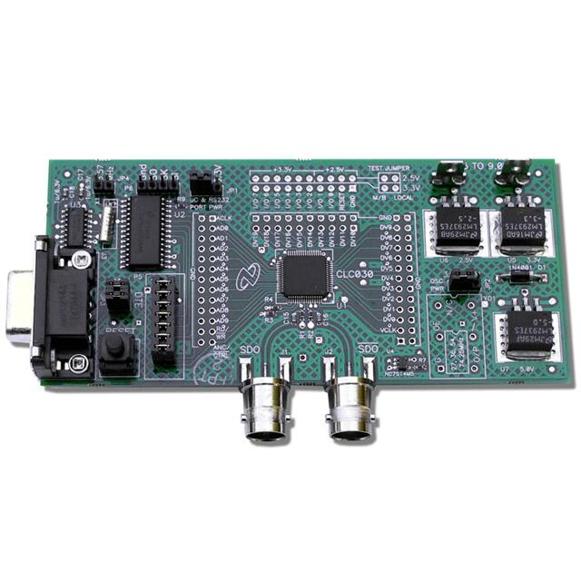

    LMH0030 - Interface, Serializer Evaluation Board
SD130EVK 数据手册
LMH0030 www.ti.com SNLS219G – JANUARY 2006 – REVISED APRIL 2013 LMH0030 SMPTE 292M/259M Digital Video Serializer with Video and Ancillary Data FIFOs and Integrated Cable Driver Check for Samples: LMH0030 FEATURES APPLICATIONS • • 1 2 • • • • • • • • • • • • • • (1) SDTV/HDTV Serial Digital Video Standard Compliant Supports 270 Mbps, 360 Mbps, 540 Mbps, 1.4835Gbps and 1.485 Gbps SDV Data Rates with Auto-Detection Low Output Jitter: 125ps max, 85ps typical Low Power: Typically 430mW No External Serial Data Rate Setting or VCO Filtering Components Required* Fast PLL Lock Time: < 150µs Typical at 1.485 Gbps Adjustable Depth Video FIFO for Timing Alignment Built-in Self-Test (BIST) and Video Test Pattern Generator (TPG)* (1) Automatic EDH/CRC Word and Flag Generation and Insertion On-Chip Ancillary Data FIFO and Insertion Control Circuitry Flexible Control and Configuration I/O Port LVCMOS Compatible Data and Control Inputs and Outputs 75Ω ECL-Compatible, Differential, Serial CableDriver Outputs 3.3V I/O Power Supply and 2.5V Logic Power Supply Operation 64-pin TQFP Package SDTV/HDTV Parallel-to-Serial Digital Video Interfaces for: – Video Cameras – VTRs – Telecines – Digital Video Routers and Switchers – Digital Video Processing and Editing Equipment – Video Test Pattern Generators and Digital Video Test Equipment – Video Signal Generators DESCRIPTION The LMH0030 SMPTE 292M/259M Digital Video Serializer with Ancillary Data FIFO and Integrated Cable Driver is a monolithic integrated circuit that encodes, serializes and transmits bit-parallel digital video data conforming to SMPTE 125M and 267M standard definition, 10-bit wide component video and SMPTE 260M, 274M, 295M and 296M high-definition, 20-bit wide component video standards. The LMH0030 operates at SMPTE 259M serial data rates of 270 Mbps, 360 Mbps, the SMPTE 344M serial data rate of 540 Mbps, and the SMPTE 292M serial data rates of 1483.5 and 1.485 Gbps. The serial data clock frequency is internally generated and requires no external frequency setting, trimming or filtering components. * Patent applications made or pending. 1 2 Please be aware that an important notice concerning availability, standard warranty, and use in critical applications of Texas Instruments semiconductor products and disclaimers thereto appears at the end of this data sheet. All trademarks are the property of their respective owners. PRODUCTION DATA information is current as of publication date. Products conform to specifications per the terms of the Texas Instruments standard warranty. Production processing does not necessarily include testing of all parameters. Copyright © 2006–2013, Texas Instruments Incorporated LMH0030 SNLS219G – JANUARY 2006 – REVISED APRIL 2013 www.ti.com DESCRIPTION (CONTINUED) The LMH0030 performs functions which include: parallel-to-serial data conversion, SMPTE standard data encoding, NRZ to NRZI data format conversion, serial data clock generation and encoding with the serial data, automatic video rate and format detection, ancillary data packet management and insertion, and serial data output driving. The LMH0030 has circuitry for automatic EDH/CRC character and flag generation and insertion per SMPTE RP-165 (standard definition) or SMPTE 292M (high definition). Optional LSB dithering is implemented which prevents pathological pattern generation. Unique to the LMH0030 are its video and ancillary data FIFOs. The video FIFO allows the video data to be delayed from 0 to 4 parallel data clock periods for video timing purposes. The ancillary data port and on-chip FIFO and control circuitry store and insert ancillary flags, data packets and checksums into the ancillary data space. The LMH0030 also has an exclusive built-in self-test (BIST) and video test pattern generator (TPG) with SD and HD component video test patterns: reference black, PLL and EQ pathologicals and color bars in 4:3 and 16:9 raster formats for NTSC and PAL standards*. The color bar patterns feature optional bandwidth limiting coding in the chroma and luma transitions. The LMH0030 has a unique multi-function I/O port for immediate access to control and configuration settings. This port may be programmed to provide external access to control functions and indicators as inputs and outputs. The designer can thus customize the LMH0030 to fit the desired application. At power-up or after a reset command, the LMH0030 is auto-configured to a default operating condition. Separate power pins for the output driver, PLL and the serializer improve power supply rejection, output jitter and noise performance. The LMH0030's internal circuitry is powered from +2.5V and the I/O circuitry from a +3.3V supply. Power dissipation is typically 430mW at 1.485 Gbps including two 75Ω AC-coupled and back-matched output loads. The device is packaged in a 64-pin TQFP. Typical Application VDD 75: 1% SMPTE Video Data Input LMH0030 SD/HD Encoder/ Serializer/ Cable Driver Parallel Ancilliary Data Input SMPTE 292M or 259M Serial Data 1PF 75: Coaxial Cable 1PF LMH0034 Adaptive Cable Equalizer 75: 1% SMPTE Video Data Output LMH0031 SD/HD Decoder/ Deserializer Parallel Ancilliary Data Output 2 Submit Documentation Feedback Copyright © 2006–2013, Texas Instruments Incorporated Product Folder Links: LMH0030 LMH0030 www.ti.com SNLS219G – JANUARY 2006 – REVISED APRIL 2013 Block Diagram RESET RESET CONTROL BUILT-IN SELF-TEST & TEST PATTERN GENERATOR PCLK PCLK TRS & FORMAT DETECTOR DV[19:10] DV[9:0] INT. RESET INPUT DATA LATCH VIDEO DATA FIFO PCLK ANC /CTRL ANCILLIARY DATA FIFO AD[9:0] MASTER BUS VCLK PCLK EDH / CRC GENERATORS ACLK CONFIGURATION & CONTROL REGISTERS RD/WR PCLK PCLK I/O[7:0] MULTI-FUNCTION I/O PORT SCLK DITHERING SMPTE SCRAMBLER NRZI CONVERTER SERIALIZER RREFLVL SDO VCLK PLL SYSTEM PCLK SCLK SYSTEM MASTER CONTROLLER SDO RREFPRE Submit Documentation Feedback Copyright © 2006–2013, Texas Instruments Incorporated Product Folder Links: LMH0030 3 LMH0030 SNLS219G – JANUARY 2006 – REVISED APRIL 2013 www.ti.com IO1 IO0 VSSPLLD VDDPLLD 11 DV0 DV5 12 DV1 DV6 13 DV2 DV7 14 DV3 DV8 15 VSSD DV9 16 DV4 VDDD Connection Diagram 10 9 8 7 6 5 4 3 2 1 VSSD 17 64 RESET DV10 18 63 VCLK DV11 19 62 VDDPLLA DV12 20 61 VSSPLLA DV13 21 60 VDDZ DV14 22 59 VSSLS VDDIO 23 58 SDO DV15 24 57 VDDLS LMH0030 DV16 25 56 SDO DV17 26 55 VSSSD DV18 27 54 VSSSD DV19 28 53 RREFLVL VSSIO 29 52 RREFPRE 37 38 39 40 41 42 43 44 45 AD1 AD3 AD4 VSSD AD5 AD6 46 47 48 AD9 36 AD8 35 AD7 34 AD2 33 AD0 49 RD/WR VDDD IO4 32 ACLK 50 ANC/CTRL IO7 IO3 31 IO6 51 VDDSD IO5 IO2 30 Figure 1. 64-Pin TQFP See Package Number PAG0064A 4 Submit Documentation Feedback Copyright © 2006–2013, Texas Instruments Incorporated Product Folder Links: LMH0030 LMH0030 www.ti.com SNLS219G – JANUARY 2006 – REVISED APRIL 2013 These devices have limited built-in ESD protection. The leads should be shorted together or the device placed in conductive foam during storage or handling to prevent electrostatic damage to the MOS gates. ABSOLUTE MAXIMUM RATINGS (1) (2) It is anticipated that this device will not be offered in a military qualified version. CMOS I/O Supply Voltage (VDDIO–VSSIO): 4.0V SDO Supply Voltage (VDDSD–VSSSD): 4.0V Digital Logic Supply Voltage (VDDD–VSSD): 3.0V PLL Digital Supply Voltage (VDDPLL–VSSPLL): 3.0V PLL Analog Supply Voltage (VDDPLLA–VSSPLLA), (VDDZ −VSSD ) : 3.0V CMOS Input Voltage (Vi): VSSIO −0.15V to VDDIO +0.15V CMOS Output Voltage (Vo): VSSIO −0.15V to VDDIO +0.15V CMOS Input Current (single input): Vi = VSSIO −0.15V: −5 mA Vi = VDDIO +0.15V: +5 mA CMOS Output Source/Sink Current: ±10 mA SDO Output Sink Current: 40 mA θJA @ 0 LFM Airflow Package Thermal Resistance 47°C/W θJA @ 500 LFM Airflow 27°C/W θJC 6.5°C/W Storage Temp. Range: −65°C to +150°C Junction Temperature: +150°C Lead Temperature (Soldering 4 Sec): +260°C ESD Rating (HBM): 2 kV ESD Rating (MM): 250V (1) (2) “Absolute Maximum Ratings” are those parameter values beyond which the life and operation of the device cannot be ensured. The stating herein of these maximums shall not be construed to imply that the device can or should be operated at or beyond these values. The table of “Electrical Characteristics” specifies acceptable device operating conditions. If Military/Aerospace specified devices are required, please contact the TI Semiconductor Sales Office / Distributors for availability and specifications. RECOMMENDED OPERATING CONDITIONS Min Typ Max Units VDDIO Symbol CMOS I/O Supply Voltage Parameter VDDIO−VSSIO Conditions Reference 3.150 3.300 3.450 V VDDSD SDO Supply Voltage VDDSD−VSSSD 3.150 3.300 3.450 V VDDD Digital Logic Supply Voltage VDDD–VSSD 2.375 2.500 2.625 V VDDPLL PLL Supply Voltage VDDPLL–VSSPLL 2.375 2.500 2.625 V VDDZ Analog Supply Voltage VDDZ–VSSD 2.375 2.500 2.625 V VIL CMOS Input Voltage, Low Level VIH CMOS Input Voltage High Level TA Operating Free Air Temperature tJIT Video Clock Jitter VSSIO V 0 VCLK VDDIO V +70 °C 30 Submit Documentation Feedback Copyright © 2006–2013, Texas Instruments Incorporated Product Folder Links: LMH0030 psP-P 5 LMH0030 SNLS219G – JANUARY 2006 – REVISED APRIL 2013 www.ti.com DC ELECTRICAL CHARACTERISTICS Over Supply Voltage and Operating Temperature ranges, unless otherwise specified (1) (2). Symbol Parameter Conditions Reference Min Max Units 2.0 VDDIO V VSSIO 0.8 V VIH Input Voltage High Level VIL Input Voltage Low Level IIH Input Current High Level VIH = VDDIO +90 +150 µA IIL Input Current Low Level VIL = VSSIO −1 −20 µA VOH CMOS Output Voltage High Level IOH = −6.6 mA 2.4 2.7 VDDIO V VOL CMOS Output Voltage Low Level IOL = +6.6 mA VSSIO VSSIO +0.3 VSSIO +0.5V V VSDO Serial Driver Output Voltage Test Circuit, Test Loads Shall Apply SDO, SDO 720 800 880 mVP-P IDD (3.3V) Power Supply Current, 3.3V Supply, Total VCLK = 27 MHz, NTSC color Bar Pattern, Test Circuit, Test Loads Shall Apply VDDIO, VDDSD 48 65 mA Power Supply Current, 3.3V Supply, Total VCLK = 74.25 MHz, NTSC color Bar Pattern, Test Circuit, Test Loads Shall Apply VDDIO, VDDSD 66 90 mA Power Supply Current, 2.5V Supply, Total VCLK = 27 MHz, NTSC color Bar Pattern, Test Circuit, Test Loads Shall Apply VDDD, VDDZ, VDDPLL 66 85 mA Power Supply Current, 2.5V Supply, Total VCLK = 74.25 MHz, NTSC color Bar Pattern, Test Circuit, Test Loads Shall Apply VDDD, VDDZ, VDDPLL 85 110 mA IDD (3.3V) IDD (2.5V) IDD (2.5V) (1) (2) All LVCMOS Inputs Typ All LVCMOS Outputs Current flow into device pins is defined as positive. Current flow out of device pins is defined as negative. All voltages are referenced to VSS = 0V. Typical values are stated for VDDIO = VDDSD = +3.3V, VDDD = VDDPLL = +2.5V and TA = +25°C. AC ELECTRICAL CHARACTERISTICS Over Supply Voltage and Operating Temperature ranges, unless otherwise specified (1). Symbol Parameter Conditions Reference Min fVCLK Parallel Video Clock Frequency VCLK 27 DCV Video Clock Duty Cycle VCLK 45 fACLK Ancillary Clock Frequency ACLK DCA Ancillary Clock Duty Cycle ACLK 45 tr, tf Input Clock and Data Rise 10%–90% Time, Fall Time VCLK, ACLK, DVN, ADN 1.0 BRSDO Serial Data Rate (2) (3) 270 SDO, SDO MHz 55 % VCLK MHz 50 55 % 1.5 3.0 ns 1,485 Mbps 270 ps 500 ps SDO, SDO 5 % tr, tf Rise Time, Fall Time 20%–80%, (2) 6 74.25 SDO, SDO 20%–80%, (1) (2) (3) (4) Units SDO, SDO Rise Time, Fall Time Output Overshoot 50 Max (3) tr, tf (4) Typ Typical values are stated for VDDIO = VDDSD = +3.3V, VDDD = VDDPLL = +2.5V and TA = +25°C. RL = 75Ω, AC-coupled @ 270 Mbps, RREFLVL = RREFPRE = 4.75 kΩ 1%, See Test Loads and Test Circuit. RL = 75Ω, AC-coupled @ 1,485 Mbps, RREFLVL = RREFPRE = 4.75 kΩ 1%, See Test Loads and Test Circuit. Specification is ensured by design. Submit Documentation Feedback Copyright © 2006–2013, Texas Instruments Incorporated Product Folder Links: LMH0030 LMH0030 www.ti.com SNLS219G – JANUARY 2006 – REVISED APRIL 2013 AC ELECTRICAL CHARACTERISTICS (continued) Over Supply Voltage and Operating Temperature ranges, unless otherwise specified(1). Symbol tj Parameter Serial Output Jitter, Intrinsic Conditions 270 Mbps, (2) (5) (6) (7) (3) (5) (6) (7) Reference SDO, SDO Typ Max Units 270 350 psP-P 85 125 psP-P tj Serial Output Jitter, Intrinsic 1,485 Mbps, tLOCK Lock Time See (2) (8) (9) (SD Rates) 15 tLOCK Lock Time See (3) (8) (9) (HD Rates) 15 tS Setup Time, Video Data Timing Diagram, (4) DVN to VCLK 1.5 2.0 ns VCLK to DVN 1.5 2.0 ns ADN to ACLK 1.5 2.0 ns ACLK to ADN 1.5 2.0 ns tH Hold Time, Video Data Timing Diagram, (4) tS Setup Time, Anc. Data Port Timing Diagram, (4) tH Hold Time, Anc. Data Port Timing Diagram, (4) (5) (6) (7) (8) (9) SDO, SDO Min ms ms Intrinsic timing jitter is measured in accordance with SMPTE RP 184-1996, SMPTE RP 192-1996 and the applicable serial data transmission standard, SMPTE 259M-1997 or SMPTE 292M-1998. A color bar test pattern is used. The value of fSCLK is 270 MHz or 360 MHz for SMPTE 259M, 540MHz for SMPTE 344M, or 1485 MHz for SMPTE 292M serial data rates. See Timing Jitter Bandpass section. Intrinsic jitter is defined in accordance with SMPTE RP 184-1996 as: jitter at an equipment output in the absence of input jitter. As applied to this device, the input port is VCLK and the output port is SDO or SDO. Specification is ensured by characterization. Measured from rising-edge of first DVCLK cycle until Lock Detect output goes high (true). Lock time includes format detection time plus PLL lock time. Average value measured between rising edges computed over at least one video field. Submit Documentation Feedback Copyright © 2006–2013, Texas Instruments Incorporated Product Folder Links: LMH0030 7 LMH0030 SNLS219G – JANUARY 2006 – REVISED APRIL 2013 www.ti.com Test Loads VDDSD VDDIO 75: 1% IOL Hi-Z test eqpt. t 5k: (attenuation 0dB) S1 CMOS outputs 75: test eqpt. (attenuation 0dB) SDO SDO CL 1.0PF IOH CL S2 VDDSD CL including probe and jig capacitance, 3pF max. S1 - open, S2 - closed for VOH measurement S1 - closed, S2 - open for VOL measurement 75: 1% SDO SDO 1.0PF CL 5.5-30pF* 50: test eqpt. (attenuation 3.5dB) 24.9: 1% * risetime compensation Timing Jitter Bandpass 0dB Passband ripple < ±1dB Jitter Bandpass slopes: 20dB/decade Stopband rejection >20dB 10Hz 8 Jitter Frequency Submit Documentation Feedback >1/10 fSCLK Copyright © 2006–2013, Texas Instruments Incorporated Product Folder Links: LMH0030 LMH0030 www.ti.com SNLS219G – JANUARY 2006 – REVISED APRIL 2013 Test Circuit +3.3 Vdc 4.7 PF 16V +2.5 Vdc 9 11 12 13 14 15 18 19 20 21 22 24 25 26 27 28 50 49 VDDIO VDDLS VDDSD VDDZ VDDPLLA VDDD IO0 IO1 3.3V Supply IO2 DV2 IO3 DV3 IO4 DV4 HD Chroma, SD Luma & Chroma DV5 IO5 IO6 DV6 IO7 DV7 ACLK DV8 AD0 DV9 AD1 DV10 AD2 LMH0030 DV11 AD3 DV12 AD4 DV13 AD5 DV14 AD6 HD Luma DV15 AD7 DV16 AD8 DV17 AD9 SDO DV19 SDO RREFLVL RD/WR RREFPRE 10, 17, 43 4 30 4.7 PF 16V (x3) 31 0.1 PF (x3) 32 33 34 35 36 38 Output loads omitted for clarity. 39 40 41 42 44 45 +3.3V 46 47 75: 1% 48 1.0 PF 58 ANC/CTRL RESET 3 56 DV18 VSSD 64 DV1 (x4) 0 Vdc 52 +3.3V 2.5V Supply 2 53 3.3V Supply 61 54, 55 29 75: 1% 1.0 PF VSSLS 8 2.5V Supply 23 57 VSSIO 7 51 VSSSD 6 DV0 60 VSSPLLA 5 VCLK VSSPLLD 63 62 VDDPLLD 1 16, 37 0.1 PF (x4) 59 4.75k 1% 4.75k 1% Submit Documentation Feedback Copyright © 2006–2013, Texas Instruments Incorporated Product Folder Links: LMH0030 9 LMH0030 SNLS219G – JANUARY 2006 – REVISED APRIL 2013 www.ti.com Timing Diagram 90% 90% VCLK (ACLK) 50% 10% tr, tf 10% tH tS 90% DV[19:0] (AD[9:0]) tr, tf 10% DEVICE OPERATION The LMH0030 SDTV/HDTV Serializer is used in digital video signal origination equipment: cameras, video tape recorders, telecines and video test and other equipment. It converts parallel SDTV or HDTV component digital video signals into serial format. Logic levels within this equipment are normally produced by LVCMOS logic devices. The encoder produces serial digital video (SDV) signals conforming to SMPTE 259M, SMPTE 344M, or SMPTE 292M. The LMH0030 operates at parallel data rates of 27.0 MHz, 36.0 MHz, 54.0 MHz, 74.176MHz and 74.25 MHz. Corresponding serial data rates are 270 Mbps, 360 Mbps, 540 Mbps, 1.4835 Gbps and 1.485 Gbps. VIDEO DATA PATH The input data register accepts 10-bit standard definition or 20-bit high definition parallel data and associated parallel clock signals having LVCMOS-compatible levels. All parallel video data inputs, DV[19:0], have internal pull-down devices. VCLK does not have an internal pull-down device. Parallel video data may conform to any of several SMPTE standards: 125M, 267M, 260M, 274M, 295M or 296M. Some segmented frame formats are not supported. For HDTV data, the upper 10 bits of the DV input are luminance (luma) information and the lower 10 bits are color difference (chrominance or chroma) information. For SDTV data, the lower order 10 bits contain both luma and chroma information. Output from this register feeds the video FIFO, video format detection circuit, TRS character detector, SMPTE scrambler, EDH/CRC generators, serializer/NRZI converter and the device control system. Data from the input data register passes into a 4-register deep video FIFO prior to encoding and other processing. The depth of this FIFO is set by the VIDEO FIFO Depth[2:0] bits of the ANC 0 control register. The video format detector automatically determines the raster characteristics (video data format) of the parallel input data and configures the LMH0030 to properly handle the data. This assures that the data will be properly formatted, that the correct data rate is selected and that ancillary data, line numbers (HD) and CRC/EDH data are correctly inserted. Indication of the standard being processed is stored in the FORMAT[4:0] bits in the FORMAT 1 control data register. This format data can be programmed for output on the multi-function I/O port. The LMH0030 normally operates in an auto-format-detection mode. It may optionally be configured to process only a single video format by writing the appropriate FORMAT SET[4:0] control data into the FORMAT 0 control register. The default state of FORMAT SET[4:0] is 0000b. Also, the LMH0030 may be configured to handle only the standard-definition data formats by setting the SD ONLY bit or only the high-definition data formats by setting the HD ONLY bit in the FORMAT 0 control register. When both of these bits are reset the part automatically selects the data rate. The TRS character detector processes the timing reference signals which control raster framing. The TRS detector supplies control signals to the system controller to identify the presence of the valid video data. The system controller supplies necessary control signals to the EDH/CRC control block. TRS character LSB-clipping as prescribed in ITU-R BT.601 is used. LSB-clipping causes all TRS characters with a value between 000h and 003h to be forced to 000h and all TRS characters with a value between 3FCh and 3FFh to be forced to 3FFh. Clipping is done prior to scrambling and EDH/CRC character generation. The LMH0030 incorporates circuitry for LSB dithering. The Dither Enable bit in the VIDEO INFO 0 register when set enables dithering. The V Dither Enable bit in the VIDEO INFO 0 control register when set enables dithering during the vertical blanking interval. The initial condition of Dither Enable and V Dither Enable is OFF. 10 Submit Documentation Feedback Copyright © 2006–2013, Texas Instruments Incorporated Product Folder Links: LMH0030 LMH0030 www.ti.com SNLS219G – JANUARY 2006 – REVISED APRIL 2013 The SMPTE scrambler accepts 10-bit standard definition or 20-bit high definition parallel video data and encodes it using the polynomial X9 + X4 + 1 as specified in the respective standard: SMPTE 259M, SMPTE 344M, or SMPTE 292M. The data is then serialized and sent to the NRZ-to-NRZI converter before being output. The transmission bit order is LSB-first. The NRZ-to-NRZI converter accepts NRZ serial data from the SMPTE scrambler. The data is converted to NRZI format using the polynomial (X + 1). The converter's output goes to the output cable driver amplifier. ANCILLARY/CONTROL DATA PATH The 10-bit, bi-directional Ancillary and Control Data Port performs two distinct functions in the LMH0030. First, it is used to selectively load ancillary data into the Ancillary Data FIFO for insertion into the video data stream. The utilization and flow of ancillary data within the device is managed by a system of control bits, masks and IDs in the control data registers. Second, this port provides read/write access to contents of the configuration and control registers. Ancillary and control data are input via the 10-bit Ancillary/Control Data Port, AD[9:0]. The state of the RD/WR control input determines whether data is read or written to the registers or written to the Ancillary Data FIFO. The state of the ANC/CTRL control input selects which of the ancillary data or control data sub-systems is accessed through the port. The ACLK input controls data flow through the port. The operation and frequency of ACLK is independent of the video data clock, VCLK. However, the frequency of ACLK must be less than or equal to VCLK. There is no low frequency limit for ACLK when it is being used for control register access. When theANC/CTRL input is a logichigh, ACLK affects only the ancillary data FIFO operation. When the ANC/CTRL input is a logic-low, ACLK affects only the control register operation. Inputs AD[9:0], RD/WR and ANC/CTRL have internal pull down devices. ACLK does not have an internal pull down device. CONTROL DATA READ FUNCTIONS Control data is written to and read from the LMH0030 using the lower-order 8 bits AD[7:0] of the Ancillary/Control Data Port. This control data initializes, monitors and controls operation of the LMH0030. The upper two bits AD[9:8] of the port are handshaking signals with the device accessing the port. AD[9:8] must be driven as 00b (0XXh, where XX are AD[7:0]) when either a control register read or write address is being written to the port. AD[9:8] must be driven as 11b (3XXh, where XX are AD[7:0]) when control data is being written to the port. When control data is being read from the port, the LMH0030 will output AD[9:8] as 10b (2XXh, where XX are output data AD[7:0]) and may be ignored by the monitoring system. NOTE When power is first applied to the device or after it is reset, the Ancillary and Control Data Port must be initialized to receive data. This is done by toggling ACLK three (3) times. Figure 2 shows the sequence of clock and control signals for reading control data from the ancillary/control data port. The Control Data Read mode is entered by making the ANC/CTRL input low and the RD/WR input high. Next, the 8-bit address of the control register set to be accessed is placed on port bits AD[7:0]. When a control register read address is being written to the port, AD[9:8] must be driven as 00b (0XXh, where XX are AD[7:0]). ACLK is then toggled. The address is captured on the rising edge of ACLK. Observe the port input hold timing specification. Data from the selected register is driven by the port within a few nanoseconds immediately following the rising edge of ACLK. To avoid contention with the port, the address driver should be turned off or tri-stated immediately after the address is clocked into the device. Data may be read by external devices at any time after the removal of the address signal. Output data will be driven until the next rising edge of ACLK. When the host system finishes reading the data, toggle ACLK again. This second clock resets the port from drive to receive mode and readies the port for another access cycle. When control data is being read from the port, the LMH0030 will output AD[9:8] as 10b (2XXh, where XX are output data AD[7:0]) and may be ignored by the monitoring system. Submit Documentation Feedback Copyright © 2006–2013, Texas Instruments Incorporated Product Folder Links: LMH0030 11 LMH0030 SNLS219G – JANUARY 2006 – REVISED APRIL 2013 www.ti.com Example: Read the Full-field Flags via the AD port. 1. Set ANC/CTRL to a logic-low. 2. Set RD/WR to a logic-high. 3. Present 001h to AD[9:0] as the register address. 4. Toggle ACLK. 5. Release the bus driving the AD port. 6. Read the data present on the AD port. The Full-field Flags are bits AD[4:0]. 7. Toggle ACLK to release the AD port. ACLK RD / WR ANC / CTRL AD[7:0] ADDR AD[9] AD[9:8] DATA ADDR DATA AD[9] DRIVEN AD[8] EXTERNAL BUS MUST RELEASE REC'D WRITE READ READ ADDR AD[9] DRIVEN REC'D AD[8] DATA AD[9:8] DRIVEN DRIVEN AD[8] INTERNAL BUS WILL RELEASE Figure 2. Control Data Read Timing (2 read and 1 write cycle shown) CONTROL DATA WRITE FUNCTIONS Figure 3 shows the sequence of clock and control signals for writing control data to the ancillary/control data port. The control data write mode is similar to the read mode. The control data write mode is started by making both the ANC/CTRL input low and the RD/WR input low. Next, the 8-bit address of the control register set to be accessed is placed on port bits AD[7:0]. When a control register write address is being written to the port, AD[9:8] must be driven as 00b (0XXh, where XX are AD[7:0]). Toggle ACLK. The address is captured on the rising edge of ACLK. Remove the address after clocking it into the device on or before the falling edge of ACLK. Observe the port input hold timing specification. Next, the control register data is placed on the AD[7:0] port. ACLK is again toggled. The data is written to the selected register on the rising edge of ACLK. When control data is being written to the port, AD[9:8] must be driven as 11b (3XXh, where XX are AD[7:0]). Remove the register data after clocking it into the device on or before the falling edge of ACLK. Observe the port input hold timing specification. Example: Setup (without enabling) the TPG Mode via the AD port using the 1125 line, 30 frame, 74.25MHz, interlaced component (SMPTE 274M) color bars as test pattern. The TPG may be enabled after setup using the Multi-function I/O port or by the control registers. 1. Set ANC/CTRL to a logic-low. 2. Set RD/WR to a logic-low. 3. Present 00Dh to AD[9:0] as the Test 0 register address. 4. Toggle ACLK. 5. Present 327h to AD[9:0] as the register data. 6. Toggle ACLK. 12 Submit Documentation Feedback Copyright © 2006–2013, Texas Instruments Incorporated Product Folder Links: LMH0030 LMH0030 www.ti.com SNLS219G – JANUARY 2006 – REVISED APRIL 2013 ACLK RD/WR ANC/CTRL WRITE AD[7:0] ADDR AD[9] AD[9:8] DATA ADDR DATA AD[9:8] DRIVEN WRITE WRITE ADDR DATA AD[9] DRIVEN AD[8] AD[8] Figure 3. Control Data Write Timing ANCILLARY DATA FUNCTIONS The LMH0030 can multiplex Ancillary Data into the serial component video data stream. The ancillary data packet structure, formatting and control words are given in standard SMPTE 291M. The data may reside in portions of the horizontal and vertical blanking intervals. The data can consist of different types of message packets including audio data. The LMH0030 supports ancillary data in the HANC and VANC areas of standard definition component video and in the chrominance channel (C’r/C’b) only for high-definition operation. As it applies to embedded (multiplexed) audio data, this function follows the recommended practice for AES/EBU default Level A data handling. Figure 4 shows the sequence of clock, data and control signals for writing Ancillary Data to the port. In ancillary data write mode, 10-bit ancillary data is written into the AD[9:0] port and subsequently into the ancillary data FIFO. From the FIFO, the ancillary data can be inserted into the ancillary data areas in the serial video data stream. Ancillary data may be written to the FIFO only when in the ancillary data mode. Ancillary data cannot be read from the FIFO through the AD Port. The process of loading ancillary data into the FIFO is done during the active video portion of the video line. Occurrence of the active video line interval is indicated by the H-bit in the fourth word of the TRS sequence. The H-bit is available on I/O Port bit-2. The ancillary data write process begins by making the ANC/CTRL input high and the RD/WR input low. Next, the data words are presented to the port in sequence as specified in SMPTE 291M beginning with the DID word. Data presented to the port within the required setup and hold time parameters will be written into the FIFO on the rising edge of ACLK. The user has the option of including a checksum in the ANC input data or of having the LMH0030 calculate and append the checksum. The LMH0030 will append the Ancillary Data Flag to each packet automatically before multiplexing with the video data. The process of writing ancillary data to the FIFO is effectively a double-buffered write operation. Therefore, in order to properly write the last word of the data packet, the CRC, whether supplied with the ANC data packet or internally generated, to the FIFO, ACLK must be toggled two additional times after the last data word is clocked into the port (or when the CRC is being generated internally and appended). In the case where multiple packets are being loaded to the FIFO, the additional clocks are issued after the last word of the final packet is received by the port. Writing of ancillary data to the FIFO, packet handling and insertion into the video data stream are controlled by a system of masking and control bits in the control registers. These and other ancillary data control functions such as CHKSUM ATTACH IN are explained in detail later in this data sheet. Submit Documentation Feedback Copyright © 2006–2013, Texas Instruments Incorporated Product Folder Links: LMH0030 13 LMH0030 SNLS219G – JANUARY 2006 – REVISED APRIL 2013 www.ti.com ACLK RD/WR ANC/CTRL WRITE AD[9:0] DATA DATA DATA DATA DATA DATA Figure 4. Ancillary Data Write Timing MULTI-FUNCTION I/O PORT The Multi-function I/O port can be configured to provide immediate access to many control and indicator functions within the LMH0030 configuration and control registers. The individual pins comprising this port may be assigned as input or output for selected bits in the control data registers. The multi-function I/O port is configured by way of an 8x6-bit register bank, I/O pin 0 CONFIG through I/O pin 7 CONFIG. The pin configuration registers contain codes which assign a control register bit to a particular I/O pin. Controls and indicators that are accessible by the port and their corresponding selection addresses are given in the I/O Pin Configuration Register Addresses, Table 6. Table 2 gives the control register bit assignments. CAUTION When writing data into the control registers via the multi-function I/O port, ACLK must be toggled to register the data as shown in Figure 5. It is not necessary to toggle ACLK when reading data from the multi-function I/O port. Example: Program multi-function I/O port bit-0 as the SAV bit output. 1. Set ANC/CTRL to a logic-low. 2. Set RD/WR to a logic-low. 3. Present 00Fh to AD[9:0] as the I/O PIN 0 CONFIG register address (see Table 3). 4. Toggle ACLK. 5. Present 30Dh to AD[9:0] as the register data (see Table 6). 6. Toggle ACLK. ACLK MULTIFUNCTION I/O PORT BIT Figure 5. I/O Port Data Write Timing 14 Submit Documentation Feedback Copyright © 2006–2013, Texas Instruments Incorporated Product Folder Links: LMH0030 LMH0030 www.ti.com SNLS219G – JANUARY 2006 – REVISED APRIL 2013 EDH/CRC SYSTEM The LMH0030 has EDH and CRC character generation and insertion circuitry. The EDH system functions as described in SMPTE Recommended Practice RP-165. The CRC system functions as specified in SMPTE 292M. The EDH/CRC polynomial generators accept parallel data from the input register and generate the EDH and CRC check words for insertion in the serial data. Incoming parallel data is checked for errors and the EDH flags are updated automatically. EDH check words and status flags for SDTV data are generated using the polynomial X16 + X12 + X6 + 1 per SMPTE RP165. EDH check words are inserted in the serial data stream at the correct positions in the ancillary data space and formatted per SMPTE 291M. Generation and automatic insertion of the EDH check words is controlled by EDH Force and EDH Enable bits in the control registers. After a reset, the initial state of all EDH and CRC check characters is 00h. The SMPTE 292M high definition video standard employs CRC (cyclic redundancy check codes) error checking instead of EDH. The CRC consists of two 18-bit words generated using the polynomial X18 + X5 + X4 + 1 per SMPTE 292M. One CRC is used for luminance and one for chrominance data. CRC data is inserted at the required place in the video data according to SMPTE 292M. The CRCs appear in the data stream following the EAV and line number characters. EDH and CRC errors are reported in the EDH0, EDH1, and EDH2 register sets of the configuration and control registers. PHASE-LOCKED LOOP SYSTEM The phase-locked loop (PLL) system generates the output serial data clock at 10x (standard definition) or 20x (high definition) the parallel data clock frequency. This system consists of a VCO, dividers, phase-frequency detector and internal loop filter. The VCO free-running frequency is internally set. The parallel data clock VCLK is the reference for the PLL. The PLL automatically generates the appropriate frequency for the serial clock rate. Loop filtering is internal to the LMH0030. The VCO has separate analog and digital power supply feeds: VDDPLLA pin 62, VSSPLLA pin 61, VDDPLLD pin 1, and VSSPLLD pin 2. These may be separately supplied power via external low-pass filters, if desired. PLL acquisition time is less than 200µs @ 1485 Mbps. The VCO halts when the VCLK signal is not present or is inactive. A LOCK DETECT indicator function is available as a bit in the VIDEO INFO 0 control registers. LOCK DETECT is a logic-1 when the PLL is locked and a valid format has been detected. It can be assigned as an output on the multifunction I/O port. By default LOCK DETECT is assigned as I/O Port bit 4 after power-on or reset . This function also includes logic to check the stability of the device after the digital logic reset is released following PLL lock. If the system is not fully stable, the logic is automatically reset. LOCK DETECT also combines the function of indicating that the LMH0030 has detected the video format being received. This format detect function involves determination of the major raster parameters such as line length, number of video lines in a frame, and so forth. This is done so that information like line numbering can be correctly inserted. The PLL itself will have locked in 200 microseconds (HD rates) or less. However, resolution of all raster parameters may take the majority of a frame. SERIAL DATA OUTPUT DRIVER The serial data outputs provide low-skew complimentary or differential signals. The output buffer is a currentmode design and is intended to drive AC-coupled and terminated, 75Ω coaxial cables. The driver automatically adjusts its output slew rate depending upon the data rate being processed. Output levels are 800 mVP-P ±10% into 75Ω AC-coupled loads. The 75Ω resistors connected to the SDO outputs function both as drain-load and back-matching resistors. Series back-matching resistors are not used with this output type. The serial output level is controlled by the value of RREFLVL and RREFPRE connected to pin 53 and pin 52, respectively. The RREFLVL resistor sets the peak-to-peak level of the output signal to the required SMPTE nominal level. The RREFPRE resistor sets the value of a pre-emphasis current which is active during the transition times of the HD-rate output signal. The value of RREFLVL is normally 4.75 KΩ, ±1%. The value of RREFPRE is normally 4.75 KΩ, ±1%. The voltage present at these pins is approximately +1.3Vdc. The transition times of this output buffer design automatically adjust and are different for the HD and SD data rate conditions. The output buffer is quiescent when the device is in an out-of-lock condition. The output will become active after the PLL is locked and a valid format has been detected. Separate power feeds are provided for the serial output driver: VSSSD, pins 54, 55, and 59; VDDSD, pin 51; and VDDLS, pin 57. Submit Documentation Feedback Copyright © 2006–2013, Texas Instruments Incorporated Product Folder Links: LMH0030 15 LMH0030 SNLS219G – JANUARY 2006 – REVISED APRIL 2013 www.ti.com CAUTION This output buffer is not designed or specified for driving 50Ω or other impedance loads. NOTE The SMPTE return loss specification is highly dependent on board design and can be challenging to meet with the LMH0030's integrated cable driver. In order to meet the SMPTE return loss specification, it is recommended to use an external cable driver such as the LMH0002 HD/SD SDI cable driver on the output of the LMH0030. POWER SUPPLIES, POWER-ON-RESET AND RESET INPUT The LMH0030 requires two power supplies, 2.5V for the core logic functions and 3.3V for the I/O functions. The supplies must be applied to the device in proper sequence. The 3.3V supply must be applied prior to or coincident with the 2.5V supply. Application of the 2.5V supply must not precede the 3.3V supply. It is recommended that the 3.3V supply be configured or designed so as to control application of the 2.5V supply in order to satisfy this sequencing requirement. The LMH0030 has an automatic, power-on-reset circuit. Reset initializes the device and clears TRS detection circuitry, all latches, registers, counters and polynomial generators, sets the EDH/CRC characters to 00h and disables the serial output. Table 1 lists the initial conditions of the configuration and control registers. An activeHIGH-true, manual reset input is available at pin 64. The reset input has an internal pull-down device and may be considered inactive when unconnected. Important: When power is first applied to the device or following a reset, the Ancillary and Control Data Port must be initialized to receive data. This is done by toggling ACLK three times. TEST PATTERN GENERATOR (TPG) AND BUILT-IN SELF-TEST (BIST) The LMH0030 includes a built-in test pattern generator (TPG). Four test pattern types are available for all data rates, all HD and SD formats, NTSC and PAL standards, and 4x3 and 16x9 raster sizes. The test patterns are: flat-field black, PLL pathological, equalizer (EQ) pathological and a 75%, 8-color vertical bar pattern. The pathologicals follow the recommendations of SMPTE RP 178-1996 regarding the test data used. The color bar pattern has optional bandwidth limiting coding in the chroma and luma data transitions between bars. The VPG FILTER ENABLE bit in the VIDEO INFO 0 control register enables the color bar filter function. The default condition of VPG FILTER ENABLE is OFF. The TPG also functions as a built-in self-test (BIST) which can verify device functionality. The BIST function performs a comprehensive go/no-go test of the device. The test may be run using any of the HD color bar test patterns or one of two SD test patterns, either a 270 Mbps NTSC full-field color bar or a PAL PLL pathological, as the test data pattern. Data is supplied internally in the input data register, processed through the device and tested for errors using either the EDH system for SD or the CRC system for HD. A go/no-go indication is logged in the Pass/Fail bit of the TEST 0 control register set. This bit may be assigned as an output on the multifunction I/O port. TPG and BIST operation is initiated by loading the code for the desired test pattern into the Test Pattern Select [5:0] bits of the TEST 0 register. Table 5 gives the available test patterns and codes. (Recall also the requirement to initialize the ancillary data port control logic by clocking ACLK at least three (3) complete cycles before attempting to load the first register address). In the default power-on state, TPG Enable appears as bit 7 on the multi-function I/O port. The TPG is run by applying the appropriate frequency at the VCLK input for the format and rate selected and then setting the TPG Enable input on the multi-function I/O port, or by setting the TPG Enable bit in the TEST 0 register. Important: If the TPG Enable input of the I/O port is in its default mapping and is not being used to enable the TPG mode, attempting to enable TPG operation by setting bit 6 of the TEST 0 register will not cause the TPG to operate. This is because the low logic level at the I/O port input pulldown overrides the high level being written to the register. The result is the TPG does not run. 16 Submit Documentation Feedback Copyright © 2006–2013, Texas Instruments Incorporated Product Folder Links: LMH0030 LMH0030 www.ti.com SNLS219G – JANUARY 2006 – REVISED APRIL 2013 The Pass/Fail bit in the TEST 0 control register indicates the test status. If no errors have been detected, this bit will be set to logic-1 approximately 2 field intervals after TPG Enable is set. If errors have been detected in the internal circuitry of the LMH0030, Pass/Fail will remain reset to a logic-0. The TPG or BIST is halted by resetting TPG Enable. The serial output data is present at the SDO outputs during TPG or BIST operation. CAUTION When attempting to use the TPG or BIST immediately after applying power or resetting the device, the TPG defaults to the 270 Mbps SD rate and expects a VCLK clock frequency of 27MHz as input. This is because the code for the test pattern in the TEST 0 register is set to 00h (525 line, 30 frame, 27MHz, NTSC 4x3 reference black). Attempting to apply a VCLK frequency higher than the device expects, according to the setting in the TEST 0 register, may result in the PLL locking up while attempting to slew to its maximum possible frequency. This situation is not recoverable by the use of the device RESET input. To recover from this condition, power must be removed and re-applied to the device. Proper conditioning of the VCLK input, which does not have an internal pull down device, is mandatory to prevent admission of noise or unwanted signals at any time, especially during power-up or reset sequences. It is strongly recommended that VCLK not be applied until device initialization and configuration is completed. Example: Enable the TPG Mode to use the NTSC 270 Mbps color bars as the BIST and TPG pattern. Enable TPG operation using the I/O port. 1. Set ANC/CTRL to a logic-low. 2. Set RD/WR to a logic-low. 3. Present 00Dh to AD[9:0] as the TEST 0 register address. 4. Toggle ACLK. 5. Present 303h to AD[9:0] as the register data (525 line, 30 frame, 27MHz, NTSC 4x3, color bars (SMPTE 125M)). 6. Toggle ACLK. 7. Set TPG ENABLE (I/O Port, bit 7) to a logic-high. 8. Toggle ACLK. 9. The PASS/FAIL indicator (I/O Port, bit 6) is monitored for the result of the test. Alternatively, the TEST 0 register may be read. Bit 7 is the Pass/Fail indicator bit. CONFIGURATION AND CONTROL REGISTERS The configuration and control registers store data which configures the operational modes of the LMH0030 or which result from its operation. Many of these registers can be mapped to the multi-function I/O bus to make them available as external I/O functions. These functions and initial values are summarized in Table 1 and detailed in Table 2. The power-on default condition for the multi-function I/O port is indicated in Table 1 and detailed in Table 6. Table 1. Configuration and Control Data Register Summary Register Function Bits Read or Write Initial Condition (1) Assignable to I/O Bus as EDH Error (SD) 1 R Full-Field Flags 5 R Reset No Active Picture Flags 5 R Reset No ANC Flags 5 R Reset No EDH Force 1 R/W OFF Input EDH Enable 1 R/W ON Input F/F Flag Error 1 R Reset Output (1) Output Notes See (1) ON = logic-1, OFF = logic-0 (positive logic). Submit Documentation Feedback Copyright © 2006–2013, Texas Instruments Incorporated Product Folder Links: LMH0030 17 LMH0030 SNLS219G – JANUARY 2006 – REVISED APRIL 2013 www.ti.com Table 1. Configuration and Control Data Register Summary (continued) Register Function Initial Condition (1) Assignable to I/O Bus as Bits Read or Write A/P Flag Error 1 R Reset Output ANC Flag Error 1 R Reset Output ANC Checksum Force 1 R/W OFF Input ANC Checksum Error 1 R Reset Output FIFO Empty 1 R Set Output FIFO Full 1 R Reset Output FIFO Overrun 1 R Reset Output Video FIFO Depth 3 R/W 000b No ANC ID 16 R/W 0000h No ANC Mask 16 R/W FFFFh No FIFO Flush Static 1 R/W OFF No Chksum Attach In 1 R/W OFF Input FIFO Insert Enable 1 R/W OFF Input ANC Parity Mask Disable 1 R/W OFF No VANC 1 R/W OFF No Switch Point 0 8 R/W 00h No Switch Point 1 8 R/W 00h No Switch Point 2 8 R/W 00h No Switch Point 3 8 R/W 00h No Format Set 5 R/W OFF No SD Only 1 R/W OFF No HD Only 1 R/W OFF Format 5 R Notes No Output Format [4] (2) (2) H 1 R Output See V 1 R Output See (2) F 1 R Output See (2) Test Pattern Select 6 R/W 00000b Input 525/27 MHz/Black TPG Enable 1 R/W OFF Input See Pass/Fail 1 R Output New Sync Position (NSP) 1 R Output SAV 1 R Output EAV 1 R Output Lock Detect 1 R Output VPG Filter Enable 1 R/W OFF Input Dither_Enable 1 R/W OFF Input Vert. Dither Enable 1 R/W OFF No Scrambler_ Enable 1 R/W ON No NRZI_Enable 1 R/W ON No LSB_Clipping 1 R/W ON No SYNC_Detect_Enabl e 1 R/W ON No I/O Bus Pin Config. 48 R/W See Table 6 No (2) 18 See (2) (2) See (2) Connected to multifunction I/O port at power-on. Submit Documentation Feedback Copyright © 2006–2013, Texas Instruments Incorporated Product Folder Links: LMH0030 LMH0030 www.ti.com SNLS219G – JANUARY 2006 – REVISED APRIL 2013 Table 2. Control Register Bit Assignments Bit 7 Bit 6 Bit 5 Bit 4 Bit 3 Bit 2 Bit 1 Bit 0 EDH ENABLE F/F FLAGS(4) F/F FLAGS(3) F/F FLAGS(2) F/F FLAGS(1) F/F FLAGS(0) reserved A/P FLAGS(4) A/P FLAGS(3) A/P FLAGS(2) A/P FLAGS(1) A/P FLAGS(0) ANC FLAG ERROR ANC FLAGS(4) ANC FLAGS(3) ANC FLAGS(2) ANC FLAGS(1) ANC FLAGS(0) VIDEO FIFO DEPTH(0) FIFO OVERRUN FIFO EMPTY FIFO FULL ANC CHECKSUM ERROR ANC CHECKSUM FORCE ANC ID(5) ANC ID(4) ANC ID(3) ANC ID(2) ANC ID(1) ANC ID(0) ANC ID(13) ANC ID(12) ANC ID(11) ANC ID(10) ANC ID(9) ANC ID(8) ANC MASK(5) ANC MASK(4) ANC MASK(3) ANC MASK(2) ANC MASK(1) ANC MASK(0) ANC MASK(13) ANC MASK(12) ANC MASK(11) ANC MASK(10) ANC MASK(9) ANC MASK(8) reserved reserved FIFO FLUSH STATIC reserved reserved reserved ANC PARITY MASK reserved reserved reserved reserved VANC LINE(4) LINE(3) LINE(2) LINE(1) LINE(0) PROTECT(1) PROTECT(0) LINE(10) LINE(9) LINE(8) LINE(4) LINE(3) LINE(2) LINE(1) LINE(0) PROTECT(2) PROTECT(1) PROTECT(0) LINE(10) LINE(9) LINE(8) HD ONLY FORMAT SET(4) FORMAT SET(3) FORMAT SET(2) FORMAT SET(1) FORMAT SET(0) H FORMAT(4) FORMAT(3) FORMAT(2) FORMAT(1) FORMAT(0) TEST PATTERN SELECT(5) TEST PATTERN SELECT(4) TEST PATTERN SELECT(3) TEST PATTERN SELECT(2) TEST PATTERN SELECT(1) TEST PATTERN SELECT(0) LOCK DETECT EAV SAV NSP reserved PIN 0 SEL[4] PIN 0 SEL[3] PIN 0 SEL[2] PIN 0 SEL[1] PIN 0 SEL[0] EDH 0 (register address 01h) EDH ERROR (SD) EDH FORCE EDH 1 (register address 02h) reserved reserved EDH 2 (register address 03h) F/F FLAG ERROR A/P FLAG ERROR ANC 0 (register address 04h) VIDEO FIFO DEPTH(2) VIDEO FIFO DEPTH(1) ANC 1 (register address 05h) DID ANC ID(7) ANC ID(6) ANC 2 (register address 06h) SDID/DBN ANC ID(15) ANC ID(14) ANC 3 (register address 07h) DID ANC MASK(7) ANC MASK(6) ANC 4 (register address 08h) SDID/DBN ANC MASK(15) ANC MASK(14) ANC 5 (register address 17h) FIFO INSERT ENABLE CHSUM ATTACH IN ANC 6 (register address 18h) reserved reserved SWITCH POINT 0 (register address 09h) LINE(7) LINE(6) LINE(5) SWITCH POINT 1 (register address 0Ah) PROTECT(4) PROTECT(3) PROTECT(2) SWITCH POINT 2 (register address 19h) LINE(7) LINE(6) LINE(5) SWITCH POINT 3 (register address 1Ah) PROTECT(4) PROTECT(3) FORMAT 0 (register address 0Bh) reserved SD ONLY FORMAT 1 (register address 0Ch) F V TEST 0 (register address 0Dh) PASS/FAIL TPG ENABLE VIDEO INFO 0 (register address 0Eh) DITHER ENABLE VERT. DITHER ENABLE VPG FILTER ENABLE MULTI-FUNCTION I/O BUS PIN CONFIGURATION I/O PIN 0 CONFIG (register address 0Fh) reserved reserved PIN 0 SEL[5] I/O PIN 1 CONFIG (register address 10h) Submit Documentation Feedback Copyright © 2006–2013, Texas Instruments Incorporated Product Folder Links: LMH0030 19 LMH0030 SNLS219G – JANUARY 2006 – REVISED APRIL 2013 www.ti.com Table 2. Control Register Bit Assignments (continued) Bit 7 Bit 6 Bit 5 Bit 4 Bit 3 Bit 2 Bit 1 Bit 0 reserved reserved PIN 1 SEL[5] PIN 1 SEL[4] PIN 1 SEL[3] PIN 1 SEL[2] PIN 1 SEL[1] PIN 1 SEL[0] PIN 2 SEL[4] PIN 2 SEL[3] PIN 2 SEL[2] PIN 2 SEL[1] PIN 2 SEL[0] PIN 3 SEL[4] PIN 3 SEL[3] PIN 3 SEL[2] PIN 3 SEL[1] PIN 3 SEL[0] PIN 4 SEL[4] PIN 4 SEL[3] PIN 4 SEL[2] PIN 4 SEL[1] PIN 4 SEL[0] PIN 5 SEL[4] PIN 5 SEL[3] PIN 5 SEL[2] PIN 5 SEL[1] PIN 5 SEL[0] PIN 6 SEL[4] PIN 6 SEL[3] PIN 6 SEL[2] PIN 6 SEL[1] PIN 6 SEL[0] PIN 7 SEL[4] PIN 7 SEL[3] PIN 7 SEL[2] PIN 7 SEL[1] PIN 7 SEL[0] LSB CLIPPING reserved NRZI ENABLE SCRAMBLER ENABLE reserved I/O PIN 2 CONFIG (register address 11h) reserved reserved PIN 2 SEL[5] I/O PIN 3 CONFIG (register address 12h) reserved reserved PIN 3 SEL[5] I/O PIN 4 CONFIG (register address 13h) reserved reserved PIN 4 SEL[5] I/P PIN 5 CONFIG (register address 14h) reserved reserved PIN 5 SEL[5] I/O PIN 6 CONFIG (register address 15h) reserved reserved PIN 6 SEL[5] I/O PIN 7 CONFIG (register address 16h) reserved reserved PIN 7 SEL[5] TEST MODE 0 (register address 55h) reserved reserved SYNC DETECT ENABLE Table 3. Control Register Addresses Address Decimal Address Hexadecimal EDH 0 1 01 EDH 1 2 02 EDH 2 3 03 ANC 0 4 04 ANC 1 5 05 ANC 2 6 06 ANC 3 7 07 ANC 4 8 08 ANC 5 23 17 ANC 6 24 18 Register Name SWITCH POINT 0 9 09 SWITCH POINT 1 10 0A SWITCH POINT 2 25 19 SWITCH POINT 3 26 1A FORMAT 0 11 0B FORMAT 1 12 0C TEST 0 13 0D VIDEO INFO 0 14 0E I/O PIN 0 CONFIG 15 0F I/O PIN 1 CONFIG 16 10 I/O PIN 2 CONFIG 17 11 I/O PIN 3 CONFIG 18 12 I/O PIN 4 CONFIG 19 13 I/O PIN 5 CONFIG 20 14 I/O PIN 6 CONFIG 21 15 I/O PIN 7 CONFIG 22 16 TEST MODE 0 85 55 20 Submit Documentation Feedback Copyright © 2006–2013, Texas Instruments Incorporated Product Folder Links: LMH0030 LMH0030 www.ti.com SNLS219G – JANUARY 2006 – REVISED APRIL 2013 EDH REGISTERS 0, 1 AND 2 (Addresses 01h through 03h) Updated EDH packets may be inserted into the serial output data by setting the EDH Force bit in the control registers. The EDH Force control bit causes the insertion of new EDH checkwords and flags into the serial output regardless of the previous condition of EDH checkwords and flags in the input parallel data. This function may be used in situations where video content has been editted thus making the previous EDH information invalid. In the case of SMPTE 292M data, the CRC check characters are recalculated and inserted automatically regardless of the presence of CRC characters in the parallel data. After the LMH0030 is reset, the initial state of the CRC check characters is 00h. The EDH Enable bit enables operation of the EDH generator function. The EDH ERROR (SD) bit when set indicates that EDH error conditions are being reported in EDH ancillary data packets present in the parallel input data. Details of the specific error conditions contained in the EDH packets are reported via the full field, active picture and ancillary flag error bits and the specific flag bits in these registers. The EDH flags F/F FLAGS[4:0] (full field), A/P FLAGS[4:0] (active picture) and ANC FLAGS[4:0] (ancillary data) are defined in SMPTE RP 165. The EDH flags are stored in the control registers. The flags are updated automatically when the EDH function is enabled and data is being received. The status of EDH flag errors in incoming SD parallel data are reported in the ffFlagError, apFlagError and ancFlagError bits. The ffFlagError, apFlagError and ancFlagError bits are the logical-OR of the corresponding EDH and EDA flags of the EDH checkwords. ANC REGISTER 0 (Address 04h) The V FIFO Depth[2:0] bits control the depth of the video FIFO which follows the input data latches. The depth can be set from 0 to 4 stages deep by writing the corresponding binary code into these bits. For example: to set the Video FIFO depth at two registers, load 11010XXXXXb into the ANC 0 control register (where X represents the other functional bits of this register). To retain other data previously stored in a register, read the register’s contents and logically-OR this with the new data. Then write the composite data back into the register. Flags for FIFO EMPTY, FIFO FULL and FIFO OVERRUN are available in the configuration and control register set. These flags can also be assigned as inputs and outputs on the multi-function I/O port. The FIFO OVERRUN flag indicates that an attempt to write data into a full FIFO has occurred. The ANC Checksum Force bit, under certain conditions, enables the overwriting of ancillary data checksums received in the parallel ancillary data. Calculation and insertion of new ancillary data checksums is controlled by the ANC Checksum Force bit. If a checksum error is detected (calculated and received checksums do not match) and the ANC Checksum Force bit is set, a new checksum will be inserted in the ancillary data replacing the previous one. If a checksum error is detected and the ANC Checksum Force bit is not set, the checksum mismatch is reported via the ANC Checksum Error bit. Ancillary data checksums may be received in the incoming parallel ancillary data. Alternatively they may be calculated and inserted automatically by the LMH0030. The CHKSUM ATTACH IN bit in the control registers when set to a logic-1 indicates that the checksum is to be supplied in the incoming data. When the CHKSUM ATTACH IN bit is set, checksums for incoming data are calculated and checked against received checksums. Calculation and insertion of new ancillary data checksum is controlled by the ANC Checksum Force bit in the configuration and control registers. If a checksum error is detected (calculated and received checksums do not match) and the ANC Checksum Force bit is set, a new checksum will be inserted in the ancillary data replacing the previous one. If a checksum error is detected and the ANC Checksum Force bit is not set, the checksum mismatch is reported via the ANC CHECKSUM ERROR bit in the control registers. The ANC Checksum Error bit indicates that the received ancillary data checksum did not agree with the LMH0030's internally generated checksum. This bit is available as an output on the multifunction I/O port. ANC REGISTERS 1 THROUGH 4 (Address 05h through 08h) Admission of ancillary data packets into the FIFO can be controlled by the ANC MASK[15:0] and ANC ID[15:0] bits in the control registers. The ANC ID[7:0] register can be set to a valid 8-bit Data Identification (DID) code used for component ancillary data packet identification as specified in SMPTE 291M. Similarly, theANC ID[15:8] register can be set to a valid 8-bit Secondary Data Identification (SDID) or Data Block Number (DBN) code. The ANC MASK[7:0] is an 8-bit word that can be used to selectively control loading of packets with specific DIDs (or DID ranges) into the FIFO. Similarly, the ANC MASK[15:8] is an 8-bit word that can be used to selectively control loading of packets with specific SDID or DBNs (or SDID or DBN ranges). Submit Documentation Feedback Copyright © 2006–2013, Texas Instruments Incorporated Product Folder Links: LMH0030 21 LMH0030 SNLS219G – JANUARY 2006 – REVISED APRIL 2013 www.ti.com When ANC MASK[7:0] or ANC MASK[15:8] is set to FFh, packets with any DID, SDID or DBN can be loaded into the FIFO. When any bit or bits of ANC MASK[7:0] or ANC MASK[15:8] are set to a logic-1, the corresponding bit or bits of ANC ID[7:0] or ANC ID[15:8], respectively are a don't-care when matching IDs of incoming packets. When ANC MASK[7:0] or ANC MASK[15:8] is set to 00h, the DID, SDID or DBN of incoming packets must match exactly, bit-for-bit, the setting of ANC ID[7:0] or ANC ID[15:8] in the control register for the packets to be loaded into the FIFO. The initial value of ANC MASK[7:0] and ANC MASK[15:8] is FFh. The initial value of ANC ID[7:0] and ANC ID[15:8] is 00h. Bits 7 through 0 of Register ANC 1, ANC ID[7:0], and Register ANC3, ANC MASK[7:0], affect DID[7:0]. BIts 7 through 0 of Register ANC2, ANC ID[15:8], and Register ANC 4, ANC MASK[15:8], affect SDID[7:0] or DBN[7:0]. ANC REGISTER 5 (Address 17h) The FIFO INSERT ENABLE bit enables insertion of ancillary data stored in the FIFO into the serial data stream. Data insertion is enabled when this bit is set to a logic-1. This bit can be used to delay automatic insertion of data into the serial data stream. Setting the FIFO FLUSH STAT bit to a logic-1 flushes the FIFO. Data may not be loaded into the FIFO during FIFO FLUSH STAT execution. Similarly, FIFO FLUSH STAT may not be set when data is being input to the FIFO. FIFO FLUSH STAT is automatically reset after this operation is complete. Execution of these FIFO operations requires toggling of ACLK. ANC REGISTER 6 (Addresses 18h) The ANC PARITY MASK bit when set disables parity checking for the DATA ID (DID) and SECONDARY DATA ID (SDID) or Data Block Number (DBN) in the ANC data packet. When reset, parity checking is enabled, and, if a parity error occurs, the packet will not be loaded. The VANC bit in the control registers, when set to a logic-1, enables insertion of ancillary data during the vertical blanking interval. SWITCH POINT REGISTERS 0 THROUGH 3 (Addresses 09h, 0Ah, 19h and 1Ah) The Line[10:0] and Protect[4:0] bits define the vertical switching point line and number of protected lines following the switching point line for fields 0 and 1 (or fields 1 and 2 as these are sometimes referred to) of highdefination formats. The vertical switching point for component digital standard definition formats is defined in SMPTE RP 168-1993. The vertical switching point for high-definition formats has the same basic definition. However, since the vertical switching point lines are not necessarily standardized among the various highdefinition rasters, these registers provide a convenient means whereby the vertical switching point line and subsequent protected lines may be specified by the user. The Switch Point registers do not operate for standard definition formats. The Line[10:0] bits of registers Switch Point 0 and 1 may be loaded with a line number ranging from 0 to 1023 which then specifies the switching point line for Field 0. The Protect[4:0] bits of register Switch Point 1 determine the number of lines from 0 to 15 after the vertical switching point line in which ancillary data may not be inserted. LINE(0) is the LSB and LINE(10) is the MSB for the Line[10:0] bits. Similar ordering holds for the Protect[4:0] bits. The Line[10:0] and Protect[4:0] bits of registers Switch Point 2 and 3 perform the same function as explained above for the vertical switching point line for Field 1. FORMAT REGISTERS 0 (Addresses 0Bh) The LMH0030 may be set to process a single video format by writing the appropriate data into the FORMAT 0 register. The Format Set[4:0] bits confine the LMH0030 to recognize and process only one of the fourteen specified types of standard or high definition formats. When the LMH0030 is set to process a single format, it will not recognize and therefore will not process other formats that it is capable of recognizing. The Format Set[4:0] bits may not be used to confine device operation to a range of standards. For normal operating situations, it is recommended that the LMH0030 be operated in automatic format detection mode, i.e. that the Format 0 register be set to 00h. 22 Submit Documentation Feedback Copyright © 2006–2013, Texas Instruments Incorporated Product Folder Links: LMH0030 LMH0030 www.ti.com SNLS219G – JANUARY 2006 – REVISED APRIL 2013 The available formats and codes are detailed in Table 4. Generally speaking, the Format Set[4:0] codes indicate or group the formats as follows: Format Set[4] is set for the HD formats and reset for the SD formats. Format Set[3] when set indicates that PAL data is being processed. When reset NTSC data is being processed. Format Set[2:0] correspond to one of the sub-standards given in the table. Note that the LMH0030 makes no distinction in formats resulting from the processing of data at 74.25MHz or 74.176MHz. The HD Only bit when set to a logic-1 locks the LMH0030 into the high definition data range and frequency. In systems designed to handle only high definition signals, enabling HD Only reduces the time required for the LMH0030 to establish frequency lock and determine the HD format being processed. The SD Only bit when set to a logic-1 locks the LMH0030 into the standard definition data ranges and frequencies. In systems designed to handle only standard definition signals, enabling SD Only reduces the time required for the LMH0030 to establish frequency lock and determine the format being processed. When SD Only and HD Only are set to logic-0, the device operates in SD/HD mode. Table 4. Video Raster Format Parameters Format Code [4,3,2,1,0] Format Specification Frame Rate Lines Active Lines Samples Active Samples 00001 SDTV, 54 SMPTE 344M 60I 525 507/487 3432 2880 00010 SDTV, 36 SMPTE 267M 60I 525 507/487 2288 1920 00011 SDTV, 27 SMPTE 125M 60I 525 507/487 1716 1440 01001 SDTV, 54 ITU-R BT 601.5 50I 625 577 3456 2880 01010 SDTV, 36 ITU-R BT 601.5 50I 625 577 2304 1920 01011 SDTV, 27 ITU-R BT 601.5 50I 625 577 1728 1440 10001 HDTV, 74.25 SMPTE 260M 30I 1125 1035 2200 1920 10010 HDTV, 74.25 SMPTE 274M 30I 1125 1080 2200 1920 10011 HDTV, 74.25 SMPTE 274M 30P 1125 1080 2200 1920 11001 HDTV, 74.25 SMPTE 274M 25I 1125 1080 2640 1920 11010 HDTV, 74.25 SMPTE 274M 25P 1125 1080 2640 1920 11100 HDTV, 74.25 SMPTE 295M 25I 1250 1080 2376 1920 11101 HDTV, 74.25 SMPTE 274M 24P 1125 1080 2750 1920 10100 HDTV, 74.25 SMPTE 296M 60P 750 720 1650 1280 FORMAT REGISTER 1 (Address 0Ch) The LMH0030 can automatically determine the format of the incoming parallel data. The result of this operation is stored in the FORMAT 1 register. The Format[4:0] bits identify which of the many possible video data standards that the LMH0030 can process is being received. These format codes follow the same arrangement as for the Format Set[4:0] bits. These formats and codes are given in Table 4. Bit Format[4] when set indicates that HD data is being processed. When reset, SD data is indicated. Format[3] when set indicates that PAL data is being processed. When reset NTSC data is being processed. Format[2:0] correspond with one of the sub-standards given in the table. The H, V, and F bits register correspond to input TRS data bits 6, 7 and 8, respectively. The meaning and function of this data is the same for both standard definition (SMPTE 125M) and high definition (SMPTE 292M luminance and color difference) video data. Polarity is logic-1 equals HIGH-true. These bits are registered for the duration of the applicable field. TEST 0 REGISTER (Address 0Dh) The Test Pattern Select bits determine which test pattern is output when the Test Pattern Generator (TPG) mode or the Built-in Self-Test (BIST) mode is enabled. Table 5 gives the codes corresponding to the various test patterns. All HD color bars test patterns are BIST data. Standard Definition BIST test patterns are: NTSC, 27MHz, 4x3 color Bars and PAL, 27MHz, 4x3 PLL Pathological. Submit Documentation Feedback Copyright © 2006–2013, Texas Instruments Incorporated Product Folder Links: LMH0030 23 LMH0030 SNLS219G – JANUARY 2006 – REVISED APRIL 2013 www.ti.com The TPG Enable bit when set to a logic-1 enables the Test Pattern Generator function and built-in self-test (BIST). This bit is mapped to I/O port bit 7 in the default condition. Note that the input pulldown on the I/O port bit has the effect of overriding the logic level of data being written into the register via the ancillary/Control Data Port. In cases where it is desired to control the state of TPG Enable through the control register instead of the multi-function I/O port, bit 7, the I/O port bit must be remapped to another bit in the control registers. Remapping to a read-only function is recommended to avoid possible conflicting data being written into the remapped location. The Pass/Fail bit indicates the result of running the built-in self-test. This bit is a logic-1 for a pass condition. The bit is mapped to I/O port bit 6 in the default condition. VIDEO INFO 0 REGISTER (Address 0Eh) The NSP (New Sync Position) bit indicates that a new or out-of-place TRS character has been detected in the input data. This bit is set to a logic-1 and remains set for at least one horizontal line period or unless re-activated by a subsequent new or out-of-place TRS. It is reset by an EAV TRS character. The EAV (end of active video) and SAV (start of active video) bits track the occurrence of the corresponding TRS characters. Lock Detect is registered as a control signal and is a logic-1 when the PLL is locked and a valid format has been detected. This bit may be programmed as an output on the multi-function I/O port. This bit is mapped to I/O port bit 4 in the default condition. This function also includes logic to check the stability of the device after the digital logic reset is released following PLL lock. If the system is not fully stable, the logic is automatically reset. LOCK DETECT also combines the function of indicating that the LMH0030 has detected the video format being received. This format detect function involves determination of the major raster parameters such as line length, number of video lines in a frame, and so forth. This is done so that information like line numbering can be correctly inserted. The PLL itself will have locked in about 50 microseconds (HD rates, 150 microseconds for SD) or less; however, resolution of all raster parameters may take the majority of a frame. The VPG Filter Enable bit when set enables operation of the Video Pattern Generator filter. Operation of this filter causes the insertion of transition codes in the chroma and luma data of color bar test patterns where these patterns change from one bar to the next. This filter reduces the magnitude of out-of-band frequency products which can be produced by abrupt transitions in the chroma and luma data when fed to D-to-A converters and picture monitors. The default condition of this bit is reset (off). A method by which the occurrence of pathological data patterns can be prevented has been proposed for SD formats. The LMH0030 implements this process for SD formats. The Dither Enable and Vertical Dither Enable bits control operation of pseudo-random dithering applied to the two LSBs of the video data. Dithering is applied to active video data when the Dither Enable bit is set. When the Vertical Dither Enable bit is set, dithering is applied to that portion of the video line corresponding to active video for lines in the vertical blanking interval. I/O PIN 0 THROUGH 7 CONFIGURATION REGISTERS (Addresses 0Fh through 16h) The Multi-function I/O Bus Pin Configuration registers are used to map the bits of the multi-function I/O port to selected bits of the Configuration and Control Registers. Table 6 details the available Configuration and Control register bit functions that may be mapped to the port and their corresponding mapping addresses. Pin # SEL[5] in each register indicates whether the port pin is input or output. The port pin will be an input when this bit is set and an output when reset. Input-only functions may not be configured as outputs and vice versa. The remaining lower-order five address bits distinguish the particular function. Example: Program, via the AD port, I/O port bit 0 as output for the SAV bit in the control registers. 1. Set ANC/CTRL to a logic-low. 2. Set RD/WR to a logic-low. 3. Present 00Fh to AD[9:0] as the I/O PIN 0 CONFIG register address (see Table 3). 4. Toggle ACLK. 5. Present 30Dh to AD[9:0] as the register data, the bit address of the SAV bit in the control registers (see Table 6). 6. Toggle ACLK. 24 Submit Documentation Feedback Copyright © 2006–2013, Texas Instruments Incorporated Product Folder Links: LMH0030 LMH0030 www.ti.com SNLS219G – JANUARY 2006 – REVISED APRIL 2013 TEST MODE 0 REGISTER (Address 55h) The four bits of this register are intended for use as test mode functions. They are not normal operating modes. The bits may be set (enabled) or reset (disabled) by writing to the register. Reading this register sets (enables) all bits to their default ON condition. The Scrambler_Enable bit enables operation of the SMPTE scrambler function. This bit is normally ON. The NRZI_Enable bit enables operation of the NRZ-to-NRZI conversion function. This bit is normally ON. The LSB_Clipping bit enables operation of the LSB clipping function. This bit is normally ON. The Sync_Detect_Enable bit enables operation of the TRS detector function. This bit is normally ON. Table 5. Test Pattern Selection Codes (1) Test Pattern Select Word Bits > Video Raster Standard Bit 5 Bit 4 Bit 3 Bit 2 Bit 1 1=HD 1=Progressive 0=Interlaced 00=Black 01=PLL Path. 0=SD 1=PAL 0=NTSC 10=EQ Path. 11=color Bars Bit 0 1125 Line, 74.25 MHz, 30 Frame Interlaced Component (SMPTE 260M) Ref. Black 1 0 0 0 0 0 PLL Path. 1 0 0 0 0 1 EQ Path. 1 0 0 0 1 0 color Bars 1 0 0 0 1 1 1125 Line, 74.25 MHz, 30 Frame Interlaced Component (SMPTE 274M) Ref. Black 1 0 0 1 0 0 PLL Path. 1 0 0 1 0 1 EQ Path. 1 0 0 1 1 0 color Bars 1 0 0 1 1 1 1125 Line, 74.25 MHz, 25 Frame Interlaced Component (SMPTE 274M) Ref. Black 1 0 1 0 0 0 PLL Path. 1 0 1 0 0 1 EQ Path. 1 0 1 0 1 0 color Bars 1 0 1 0 1 1 1125 Line, 74.25 MHz, 25 Frame Interlaced Component (SMPTE 295M) Ref. Black 1 0 1 1 0 0 PLL Path. 1 0 1 1 0 1 EQ Path. 1 0 1 1 1 0 color Bars 1 0 1 1 1 1 1125 Line, 74.25 MHz, 30 Frame Progressive Component (SMPTE 274M) Ref. Black 1 1 0 0 0 0 PLL Path. 1 1 0 0 0 1 EQ Path. 1 1 0 0 1 0 color Bars 1 1 0 0 1 1 1125 Line, 74.25 MHz, 25 Frame Progressive Component (SMPTE 274M) (1) Ref. Black 1 1 0 1 0 0 PLL Path. 1 1 0 1 0 1 EQ Path. 1 1 0 1 1 0 color Bars 1 1 0 1 1 1 Note: SD BIST patterns are NTSC 4x3 color Bars and PAL 4x3 PLL Pathological. HD BIST patterns are color bars for each format. Submit Documentation Feedback Copyright © 2006–2013, Texas Instruments Incorporated Product Folder Links: LMH0030 25 LMH0030 SNLS219G – JANUARY 2006 – REVISED APRIL 2013 www.ti.com Table 5. Test Pattern Selection Codes(1) (continued) Test Pattern Select Word Bits > Bit 5 Bit 4 Bit 3 Bit 2 Bit 1 Bit 0 1125 Line, 74.25 MHz, 24 Frame Progressive Component (SMPTE 274M) Ref. Black 1 1 1 0 0 0 PLL Path. 1 1 1 0 0 1 EQ Path. 1 1 1 0 1 0 color Bars 1 1 1 0 1 1 750 Line, 74.25 MHz, 60 Frame Progressive Component (SMPTE 296M) Ref. Black 1 1 1 1 0 0 PLL Path. 1 1 1 1 0 1 EQ Path. 1 1 1 1 1 0 color Bars 1 1 1 1 1 1 525 Line, 30 Frame, 27 MHz, NTSC 4x3 (SMPTE 125M) Ref. Black 0 0 0 0 0 0 PLL Path. 0 0 0 0 0 1 EQ Path. 0 0 0 0 1 0 color Bars (SD BIST) 0 0 0 0 1 1 625 Line, 25 Frame, 27 MHz, PAL 4x3 (ITU-T BT.601) Ref. Black 0 1 0 0 0 0 PLL Path. (SD BIST) 0 1 0 0 0 1 EQ Path. 0 1 0 0 1 0 color Bars 0 1 0 0 1 1 525 Line, 30 Frame, 36 MHz, NTSC 16x9 (SMPTE 125M) Ref. Black 0 0 0 1 0 0 PLL Path. 0 0 0 1 0 1 EQ Path. 0 0 0 1 1 0 color Bars 0 0 0 1 1 1 625 Line, 25 Frame, 36 MHz, PAL 16x9 (ITU-T BT.601) Ref. Black 0 1 0 1 0 0 PLL Path. 0 1 0 1 0 1 EQ Path. 0 1 0 1 1 0 color Bars 0 1 0 1 1 1 525 Line, 30 Frame, 54 MHz (NTSC) Ref. Black 0 0 1 0 0 0 PLL Path. 0 0 1 0 0 1 EQ Path. 0 0 1 0 1 0 color Bars 0 0 1 0 1 1 625 Line, 25 Frame, 54 MHz (PAL) 26 Ref. Black 0 1 1 0 0 0 PLL Path. 0 1 1 0 0 1 EQ Path. 0 1 1 0 1 0 color Bars 0 1 1 0 1 1 Submit Documentation Feedback Copyright © 2006–2013, Texas Instruments Incorporated Product Folder Links: LMH0030 LMH0030 www.ti.com SNLS219G – JANUARY 2006 – REVISED APRIL 2013 Table 6. I/O Configuration Register Addresses for Control Register Functions Register Bit Bit Address Pin # SEL [n] I/P or O/P [5] [4] [3] [2] [1] [0] reserved 0 0 0 0 0 0 FF Flag Error 0 0 0 0 0 1 Output AP Flag Error 0 0 0 0 1 0 Output ANC Flag Error 0 0 0 0 1 1 Output CRC Error (SD/HD) 0 0 0 1 0 0 Output Power-On Status I/O Port Bit 5 Addresses x05h through x0Ch are reserved. SAV 0 0 1 1 0 1 Output EAV 0 0 1 1 1 0 Output NSP 0 0 1 1 1 1 Output F 0 1 0 0 1 0 Output I/O Port Bit 0 V 0 1 0 0 1 1 Output I/O Port Bit 1 H 0 1 0 1 0 0 Output I/O Port Bit 2 Format[0] 0 1 0 1 0 1 Output Format[1] 0 1 0 1 1 0 Output Format[2] 0 1 0 1 1 1 Output Format[3] 0 1 1 0 0 0 Output Format[4] 0 1 1 0 0 1 Output FIFO Full 0 1 1 0 1 0 Output FIFO Empty 0 1 1 0 1 1 Output Lock Detect 0 1 1 1 0 0 Output I/O Port Bit 4 Pass/Fail 0 1 1 1 0 1 Output I/O Port Bit 6 FIFO Overrun 0 1 1 1 1 0 Output ANC Chksum Error 0 1 1 1 1 1 Output EDH Force 1 0 0 0 0 0 Input Test Pattern Select[0] 1 0 0 0 0 1 Input Test Pattern Select[1] 1 0 0 0 1 0 Input Test Pattern Select[2] 1 0 0 0 1 1 Input Test Pattern Select[3] 1 0 0 1 0 0 Input Test Pattern Select[4] 1 0 0 1 0 1 Input Test Pattern Select[5] 1 0 0 1 1 0 Input EDH Enable 1 0 0 1 1 1 Input TPG Enable 1 0 1 0 0 0 Input reserved 1 0 1 0 0 1 Chksum Attach In 1 0 1 0 1 0 reserved 1 0 1 0 1 1 VPG Filter Enable 1 0 1 1 0 0 Input Dither Enable 1 0 1 1 0 1 Input I/O Port Bit 3 (SD/HD) I/O Port Bit 7 Input Submit Documentation Feedback Copyright © 2006–2013, Texas Instruments Incorporated Product Folder Links: LMH0030 27 LMH0030 SNLS219G – JANUARY 2006 – REVISED APRIL 2013 www.ti.com Table 6. I/O Configuration Register Addresses for Control Register Functions (continued) Register Bit FIFO Insert Enable 28 Bit Address Pin # SEL [n] [5] [4] [3] [2] [1] [0] 1 0 1 1 1 1 Submit Documentation Feedback I/P or O/P Power-On Status Input Copyright © 2006–2013, Texas Instruments Incorporated Product Folder Links: LMH0030 LMH0030 www.ti.com SNLS219G – JANUARY 2006 – REVISED APRIL 2013 PIN DESCRIPTIONS (1) Pin (1) Name Description 1 VDDPLLD Positive Power Supply Input (2.5V supply, PLL Logic) 2 VSSPLLD Negative Power Supply Input (2.5V supply, PLL Logic) 3 IO0 Multi-Function I/O Port 4 IO1 Multi-Function I/O Port 5 DV0 Parallel Video Input (HD=Chroma, SD=Luma & Chroma) 6 DV1 Parallel Video Input (HD=Chroma, SD=Luma & Chroma) 7 DV2 Parallel Video Input (HD=Chroma, SD=Luma & Chroma) 8 DV3 Parallel Video Input (HD=Chroma, SD=Luma & Chroma) 9 DV4 Parallel Video Input (HD=Chroma, SD=Luma & Chroma) 10 VSSD Negative Power Supply Input (2.5V supply, Digital Logic) 11 DV5 Parallel Video Input (HD=Chroma, SD=Luma & Chroma) 12 DV6 Parallel Video Input (HD=Chroma, SD=Luma & Chroma) 13 DV7 Parallel Video Input (HD=Chroma, SD=Luma & Chroma) 14 DV8 Parallel Video Input (HD=Chroma, SD=Luma & Chroma) 15 DV9 Parallel Video Input (HD=Chroma, SD=Luma & Chroma) 16 VDDD Positive Power Supply Input (2.5V supply, Digital Logic) 17 VSSD Negative Power Supply Input (2.5V supply, Digital Logic) 18 DV10 Parallel Video Input (HD=Luma) 19 DV11 Parallel Video Input (HD=Luma) 20 DV12 Parallel Video Input (HD=Luma) 21 DV13 Parallel Video Input (HD=Luma) 22 DV14 Parallel Video Input (HD=Luma) 23 VDDIO Positive Power Supply Input (3.3V supply, I/O) 24 DV15 Parallel Video Input (HD=Luma) 25 DV16 Parallel Video Input (HD=Luma) 26 DV17 Parallel Video Input (HD=Luma) 27 DV18 Parallel Video Input (HD=Luma) 28 DV19 Parallel Video Input (HD=Luma) 29 VSSIO Negative Power Supply Input (3.3V supply, I/O) 30 IO2 Multi-Function I/O Port 31 IO3 Multi-Function I/O Port 32 IO4 Multi-Function I/O Port 33 IO5 Multi-Function I/O Port 34 IO6 Multi-Function I/O Port 35 IO7 Multi-Function I/O Port 36 ACLK Ancillary/Control Clock Input 37 VDDD Positive Power Supply Input (2.5V supply, Digital Logic) 38 AD0 Ancillary/Control Data I/O Port 39 AD1 Ancillary/Control Data I/O Port 40 AD2 Ancillary/Control Data I/O Port 41 AD3 Ancillary/Control Data I/O Port 42 AD4 Ancillary/Control Data I/O Port 43 VSSD Negative Power Supply Input (2.5V supply, Digital Logic) 44 AD5 Ancillary/Control Data I/O Port 45 AD6 Ancillary/Control Data I/O Port 46 AD7 Ancillary/Control Data I/O Port Note: All LVCMOS inputs except VCLK and ACLK have internal pull-down devices. Submit Documentation Feedback Copyright © 2006–2013, Texas Instruments Incorporated Product Folder Links: LMH0030 29 LMH0030 SNLS219G – JANUARY 2006 – REVISED APRIL 2013 www.ti.com PIN DESCRIPTIONS(1) (continued) Pin 30 Name Description 47 AD8 Ancillary/Control Data I/O Port 48 AD9 Ancillary/Control Data I/O Port 49 RD/WR Ancillary/Control Data Port Read/Write Control Input 50 ANC/CTRL Ancillary/Control Data Port Function Control Input 51 VDDSD Positive Power Supply Input (3.3V supply, Output Driver) 52 RREFPRE Output Preemphasis Reference Resistor (4.75 KΩ, 1% Nom.) 53 RREFLVL Output Level Reference Resistor (4.75 KΩ, 1% Nom.) 54 VSSSD Negative Power Supply Input (3.3V supply, Output Driver) 55 VSSSD Negative Power Supply Input (3.3V supply, Output Driver) 56 SDO Serial Data True Output 57 VDDLS Positive Power Supply Input (3.3V supply, Level Shift) 58 SDO Serial Data Complement Output 59 VSSLS Negative Power Supply Input (3.3V supply, Level Shift) 60 VDDZ Positive Power Supply Input (2.5V supply, Serializer) 61 VSSPLLA Negative Power Supply Input (2.5V supply, PLL Analog) 62 VDDPLLA Positive Power Supply Input (2.5V supply, PLL Analog) 63 VCLK Video Data Clock Input 64 Reset Manual Reset Input (High True) Submit Documentation Feedback Copyright © 2006–2013, Texas Instruments Incorporated Product Folder Links: LMH0030 LMH0030 www.ti.com SNLS219G – JANUARY 2006 – REVISED APRIL 2013 APPLICATION INFORMATION Complete details for the SD130ASM evaluation PCB are available on TI’s WEB site. This circuit demonstrates the capabilities of the LMH0030 and allows its evaluation in a native configuration. An assembled demonstration board kit, part number SD130EVK, complete with operating instructions, drawing package and list of materials is available. Contact the Interface Products Group or the Serial Digital Video and Interface Applications Group for ordering information. Complete circuit board layouts, schematics and other information for the SD130EVK are also available on TI's WEB site in the application information for this device. For latest product details and availability information, please see: www.ti.com/appinfo/interface. PCB LAYOUT AND POWER SYSTEM BYPASS RECOMMENDATIONS Circuit board layout and stack-up for the LMH0030 should be designed to provide noise-free power to the device. Good layout practice also will separate high frequency or high level inputs and outputs to minimize unwanted stray noise pickup, feedback and interference. Power system performance may be greatly improved by using thin dielectrics (4 to 10 mils) for power/ground sandwiches. This increases the intrinsic capacitance of the PCB power system which improves power supply filtering, especially at high frequencies, and makes the value and placement of external bypass capacitors less critical. External bypass capacitors should include both RF ceramic and tantalum electrolytic types. RF capacitors may use values in the range 0.01 µF to 0.1 µF. Tantalum capacitors may be in the range 2.2 µF to 10 µF. Voltage rating for tantalum capacitors should be at least 5X the power supply voltage being used. It is recommended practice to use two vias at each power pin of the LMH0030 as well as all RF bypass capacitor terminals. Dual vias reduce the interconnect inductance by up to half, thereby reducing interconnect inductance and extending the effective frequency range of the bypass components. The outer layers of the PCB may be flooded with additional VSS (ground) plane. These planes will improve shielding and isolation as well as increase the intrinsic capacitance of the power supply plane system. Naturally, to be effective, these planes must be tied to the VSS power supply plane at frequent intervals with vias. Frequent via placement also improves signal integrity on signal transmission lines by providing short paths for image currents which reduces signal distortion. The planes should be pulled back from all transmission lines and component mounting pads a distance equal to the width of the widest transmission line or the thickness of the dielectric separating the transmission line from the internal power or ground plane(s) whichever is greater. Doing so minimizes effects on transmission line impedances and reduces unwanted parasitic capacitances at component mounting pads. The LMH0030 uses two power supply voltages, 2.5 and 3.3 volts. These supplies connect to the device through seven sets of independent power input pins. The function and system supplied through these is given in the Pin Description Table. The power supply voltages normally share a common 0 volt or ground return system. Either a split plane or separate power planes can be used to supply the positive voltages to the device. In especially noisy power supply environments, such as is often the case when using switching power supplies, separate filtering may be used at the LMH0030's PLL analog, PLL digital and serial output driver power pins. The LMH0030 was designed for this situation. The digital section, PLL and output driver power supply feeds are independent. See the Pin Description Table and the Connection Diagram for details. Supply filtering may take the form of L-section or pi-section, L-C filters in series with these VDD inputs. Such filters are available in a single package from several manufacturers. Despite being independent feeds, all device power supplies should be applied simultaneously as from a common source. Submit Documentation Feedback Copyright © 2006–2013, Texas Instruments Incorporated Product Folder Links: LMH0030 31 LMH0030 SNLS219G – JANUARY 2006 – REVISED APRIL 2013 www.ti.com PROCESSING NON-SUPPORTED AND pSf RASTER FORMATS The number and type of HD raster formats has proliferated greatly since the LMH0030 was designed. Though not specifically capable of fully or automatically processing these new formats, the LMH0030 may still be capable of serializing them. The user is encouraged to experiment with processing of these formats keeping in mind that the LMH0030 has not been tested to handle raster formats other than those detailed in Table 4. Therefore, the results from attempts to process non-supported formats is not ensured. The following guidelines concerning device setup are provided to aid the user in configuring the LMH0030 to attempt limited processing of these other raster formats. In general, the device is configured to defeat its format and TRS detection function and to limit operation to a generic HD format type. (The user should consult Table 4 for guidance on the format groups similar to the non-supported one to be processed). Since these newer formats are in the HD realm, the LMH0030 should be configured to operate in HD-ONLY mode by setting bit-5 of the FORMAT 0 register (address 0Bh). Also, the device should be further configured by loading the FORMAT SET[4:0] bits of this register with a nonspecific HD sub-format code. The complete data word for this HD sub-format code with HD-ONLY bit set is 33Fh (all 10 bits of AD[9:0]). Since this format differs from those in the table, the EAV/SAV indicators are disabled. Without these indicators, line numbering and CRC insertion are disabled and ancillary data insertion will not function. Pre-processing of the parallel data ahead of the LMH0030 will be required to insert CRC data and line numbering. Among the specialized formats are so-called progressive-segmented frame formats (pSf). Refer to SMPTE 274M-2003, Annex A. These formats are composed of the video lines of progressive scan rasters rearranged in the manner of an interlaced raster. The even numbered lines are arranged to form Field 1 and the odd numbered lines form Field 2. In other respects, the format is identical to the normal interlaced format. The LMH0030 can serialize these pSf formats provided that the lines of the original progressive raster are first rearranged externally to the LMH0030 before being presented to it for processing. 32 Submit Documentation Feedback Copyright © 2006–2013, Texas Instruments Incorporated Product Folder Links: LMH0030 LMH0030 www.ti.com SNLS219G – JANUARY 2006 – REVISED APRIL 2013 REVISION HISTORY Changes from Revision F (April 2013) to Revision G • Page Changed layout of National Data Sheet to TI format .......................................................................................................... 32 Submit Documentation Feedback Copyright © 2006–2013, Texas Instruments Incorporated Product Folder Links: LMH0030 33 PACKAGE OPTION ADDENDUM www.ti.com 30-Sep-2021 PACKAGING INFORMATION Orderable Device Status (1) Package Type Package Pins Package Drawing Qty Eco Plan (2) Lead finish/ Ball material MSL Peak Temp Op Temp (°C) Device Marking (3) (4/5) (6) LMH0030VS NRND TQFP PAG 64 160 Non-RoHS & Green Call TI Level-3-260C-168 HR 0 to 70 L030 LMH0030VS/NOPB ACTIVE TQFP PAG 64 160 RoHS & Green SN Level-3-260C-168 HR 0 to 70 L030 (1) The marketing status values are defined as follows: ACTIVE: Product device recommended for new designs. LIFEBUY: TI has announced that the device will be discontinued, and a lifetime-buy period is in effect. NRND: Not recommended for new designs. Device is in production to support existing customers, but TI does not recommend using this part in a new design. PREVIEW: Device has been announced but is not in production. Samples may or may not be available. OBSOLETE: TI has discontinued the production of the device. (2) RoHS: TI defines "RoHS" to mean semiconductor products that are compliant with the current EU RoHS requirements for all 10 RoHS substances, including the requirement that RoHS substance do not exceed 0.1% by weight in homogeneous materials. Where designed to be soldered at high temperatures, "RoHS" products are suitable for use in specified lead-free processes. TI may reference these types of products as "Pb-Free". RoHS Exempt: TI defines "RoHS Exempt" to mean products that contain lead but are compliant with EU RoHS pursuant to a specific EU RoHS exemption. Green: TI defines "Green" to mean the content of Chlorine (Cl) and Bromine (Br) based flame retardants meet JS709B low halogen requirements of
