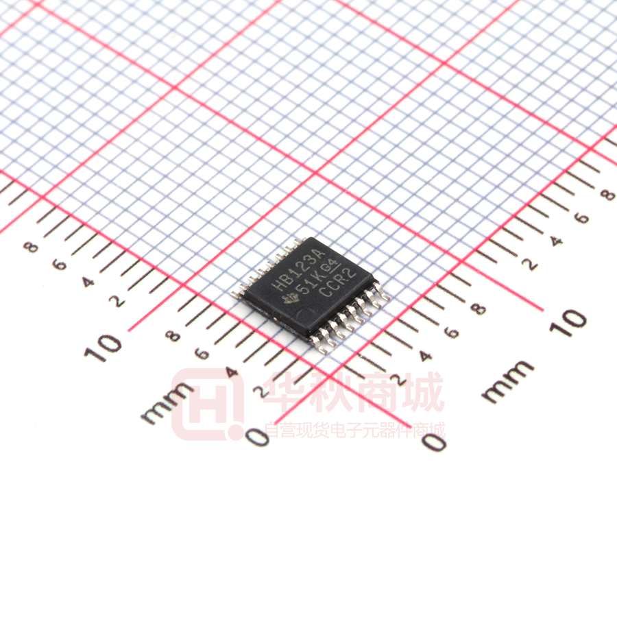

SN74AHCT123APWR 数据手册
SN54AHCT123A, SN74AHCT123A DUAL RETRIGGERABLE MONOSTABLE MULTIVIBRATORS SCLS420G – JUNE 1998 – REVISED APRIL 2003 D D D D D D D SN54AHCT123A . . . J OR W PACKAGE SN74AHCT123A . . . D, DB, DGV, N, OR PW PACKAGE (TOP VIEW) Inputs Are TTL-Voltage Compatible Schmitt-Trigger Circuitry On A, B, and CLR Inputs for Slow Input Transition Rates Edge Triggered From Active-High or Active-Low Gated Logic Inputs Retriggerable for Very Long Output Pulses Overriding Clear Terminates Output Pulse Latch-Up Performance Exceeds 100 mA Per JESD 78, Class II ESD Protection Exceeds JESD 22 – 2000-V Human-Body Model (A114-A) – 200-V Machine Model (A115-A) – 1000-V Charged-Device Model (C101) 1A 1B 1CLR 1Q 2Q 2Cext 2Rext/Cext GND 1 16 2 15 3 14 4 13 5 12 6 11 7 10 8 9 VCC 1Rext/Cext 1Cext 1Q 2Q 2CLR 2B 2A SN54AHCT123A . . . FK PACKAGE (TOP VIEW) 1B 1A NC VCC 1R ext /C ext description/ordering information These edge-triggered multivibrators feature output pulse-duration control by three methods. In the first method, the A input is low, and the B input goes high. In the second method, the B input is high, and the A input goes low. In the third method, the A input is low, the B input is high, and the clear (CLR) input goes high. 1CLR 1Q NC 2Q 2Cext 3 2 1 20 19 18 5 17 6 16 7 15 8 14 9 10 11 12 13 1Cext 1Q NC 2Q 2CLR 2R ext /Cext GND NC 2A 2B The output pulse duration is programmed by selecting external resistance and capacitance values. The external timing capacitor must be connected between Cext and Rext/Cext (positive) and an external resistor connected between Rext/Cext and VCC. To obtain variable pulse durations, connect an external variable resistance between Rext/Cext and VCC. The output pulse duration also can be reduced by taking CLR low. 4 NC – No internal connection ORDERING INFORMATION PDIP – N –55°C to 125°C TOP-SIDE MARKING Tube SN74AHCT123AN Tube SN74AHCT123AD Tape and reel SN74AHCT123ADR SSOP – DB Tape and reel SN74AHCT123ADBR HB123A TSSOP – PW Tape and reel SN74AHCT123APWR HB123A TVSOP – DGV Tape and reel SN74AHCT123ADGVR HB123A CDIP – J Tube SNJ54AHCT123AJ SNJ54AHCT123AJ CFP – W Tube SNJ54AHCT123AW SNJ54AHCT123AW LCCC – FK Tube SNJ54AHCT123AFK SNJ54AHCT123AFK SOIC – D –40°C 40°C to 85°C ORDERABLE PART NUMBER PACKAGE† TA SN74AHCT123AN AHCT123A † Package drawings, standard packing quantities, thermal data, symbolization, and PCB design guidelines are available at www.ti.com/sc/package. Please be aware that an important notice concerning availability, standard warranty, and use in critical applications of Texas Instruments semiconductor products and disclaimers thereto appears at the end of this data sheet. Copyright  2003, Texas Instruments Incorporated PRODUCTION DATA information is current as of publication date. Products conform to specifications per the terms of Texas Instruments standard warranty. Production processing does not necessarily include testing of all parameters. On products compliant to MIL-PRF-38535, all parameters are tested unless otherwise noted. On all other products, production processing does not necessarily include testing of all parameters. POST OFFICE BOX 655303 • DALLAS, TEXAS 75265 1 SN54AHCT123A, SN74AHCT123A DUAL RETRIGGERABLE MONOSTABLE MULTIVIBRATORS SCLS420G – JUNE 1998 – REVISED APRIL 2003 description/ordering information(continued) Pulse triggering occurs at a particular voltage level and is not directly related to the transition time of the input pulse. The A, B, and CLR inputs have Schmitt triggers with sufficient hysteresis to handle slow input transition rates with jitter-free triggering at the outputs. Once triggered, the basic pulse duration can be extended by retriggering the gated low-level-active (A) or high-level-active (B) input. Pulse duration can be reduced by taking CLR low. CLR input can be used to override A or B inputs. The input/output timing diagram illustrates pulse control by retriggering the inputs and early clearing. The variance in output pulse duration from device to device typically is less than ±0.5% for given external timing components. An example of this distribution for the ’AHCT123A is shown in Figure 10. Variations in output pulse duration versus supply voltage and temperature are shown in Figure 6. During power up, Q outputs are in the low state, and Q outputs are in the high state. The outputs are glitch free, without applying a reset pulse. For additional application information on multivibrators, see the application report, Designing With the SN74AHC123A and SN74AHCT123A, literature number SCLA014. FUNCTION TABLE (each multivibrator) INPUTS OUTPUTS CLR A B Q Q L X X X H X L L† H H† X X L L† H† H L ↑ H # H ↑ L H † These outputs are based on the assumption that the indicated steady-state conditions at the A and B inputs have been set up long enough to complete any pulse started before the setup. logic diagram, each multivibrator (positive logic) Rext/Cext A Cext B Q CLR 2 R POST OFFICE BOX 655303 • DALLAS, TEXAS 75265 Q SN54AHCT123A, SN74AHCT123A DUAL RETRIGGERABLE MONOSTABLE MULTIVIBRATORS SCLS420G – JUNE 1998 – REVISED APRIL 2003 input/output timing diagram trr A B CLR Rext/Cext Q Q tw tw tw + trr absolute maximum ratings over operating free-air temperature (unless otherwise noted)† Supply voltage range, VCC (see Note 1) . . . . . . . . . . . . . . . . . . . . . . . . . . . . . . . . . . . . . . . . . . . . . . –0.5 V to 7 V Input voltage range, VI (see Note 2) . . . . . . . . . . . . . . . . . . . . . . . . . . . . . . . . . . . . . . . . . . . . . . . . . . –0.5 V to 7 V Output voltage range, VO (see Note 1) . . . . . . . . . . . . . . . . . . . . . . . . . . . . . . . . . . . . . . . . –0.5 V to VCC + 0.5 V Input clamp current, IIK (VI < 0) . . . . . . . . . . . . . . . . . . . . . . . . . . . . . . . . . . . . . . . . . . . . . . . . . . . . . . . . . . . –20 mA Output clamp current, IOK (VO < 0 or VO > VCC) . . . . . . . . . . . . . . . . . . . . . . . . . . . . . . . . . . . . . . . . . . . . ±20 mA Continuous output current, IO (VO = 0 to VCC) . . . . . . . . . . . . . . . . . . . . . . . . . . . . . . . . . . . . . . . . . . . . . . ±25 mA Continuous current through VCC or GND . . . . . . . . . . . . . . . . . . . . . . . . . . . . . . . . . . . . . . . . . . . . . . . . . . . ±50 mA Package thermal impedance, θJA (see Note 3): D package . . . . . . . . . . . . . . . . . . . . . . . . . . . . . . . . . . . 73°C/W DB package . . . . . . . . . . . . . . . . . . . . . . . . . . . . . . . . . 82°C/W DGV package . . . . . . . . . . . . . . . . . . . . . . . . . . . . . . . 120°C/W N package . . . . . . . . . . . . . . . . . . . . . . . . . . . . . . . . . . . 67°C/W PW package . . . . . . . . . . . . . . . . . . . . . . . . . . . . . . . . 108°C/W Storage temperature range, Tstg . . . . . . . . . . . . . . . . . . . . . . . . . . . . . . . . . . . . . . . . . . . . . . . . . . . –65°C to 150°C † Stresses beyond those listed under “absolute maximum ratings” may cause permanent damage to the device. These are stress ratings only, and functional operation of the device at these or any other conditions beyond those indicated under “recommended operating conditions” is not implied. Exposure to absolute-maximum-rated conditions for extended periods may affect device reliability. NOTES: 1. Voltage values are with respect to the network ground terminal. 2. The input and output voltage ratings may be exceeded if the input and output current ratings are observed. 3. The package thermal impedance is calculated in accordance with JESD 51-7. POST OFFICE BOX 655303 • DALLAS, TEXAS 75265 3 SN54AHCT123A, SN74AHCT123A DUAL RETRIGGERABLE MONOSTABLE MULTIVIBRATORS SCLS420G – JUNE 1998 – REVISED APRIL 2003 recommended operating conditions (see Note 4) SN54AHCT123A SN74AHCT123A MIN MAX MIN MAX 4.5 5.5 4.5 5.5 UNIT VCC VIH Supply voltage VIL VI Low-level input voltage 0.8 V Input voltage 0 5.5 0 5.5 V VO IOH Output voltage 0 0 VCC –8 V High-level output current VCC –8 mA IOL Rext Low-level output current 8 8 mA ∆t/∆VCC TA Power-up ramp rate High-level input voltage 2 2 0.8 External timing resistance Operating free-air temperature V V 1k 1k Ω 1 1 ms/V –55 125 –40 85 °C NOTE 4: Unused Rext/Cext terminals should be left unconnected. All remaining unused inputs of the device must be held at VCC or GND to ensure proper device operation. Refer to the TI application report, Implications of Slow or Floating CMOS Inputs, literature number SCBA004. electrical characteristics over recommended operating free-air temperature range (unless otherwise noted) PARAMETER TEST CONDITIONS VCC VOH IOH = –50 mA IOH = –8 mA 45V 4.5 VOL IOL = 50 mA IOL = 8 mA 45V 4.5 TA = 25°C MIN TYP MAX 4.4 4.5 3.94 SN54AHCT123A MIN MAX SN74AHCT123A MIN 4.4 4.4 3.8 3.8 MAX UNIT V 0.1 0.1 0.1 0.36 0.5 0.44 V Rext/Cext† VI = VCC or GND 5.5 V ±0.25 ±2.5 ±2.5 II A, B, and CLR VI = VCC or GND 0 V to 5.5 V ±0.1 ±1* ±1 ICC Quiescent 4 40 40 mA ICC Active state (per circuit) 750 975 975 mA 1.35 1.5 1.5 mA 10 pF VI = VCC or GND, IO = 0 VI = VCC or GND, Rext/Cext = 0.5 VCC One input at 3.4 V, Other inputs at VCC or GND ∆ICC‡ 5.5 V 5.5 V 560 5.5 V Ci VI = VCC or GND 5V 1.9 10 * On products compliant to MIL-PRF-38535, this parameter is not production tested at VCC = 0 V. † This test is performed with the terminal in the off-state condition. ‡ This is the increase in supply current for each input at one of the specified TTL voltage levels rather than 0 V or VCC. mA timing requirements over recommended operating free-air temperature range, VCC = 5 V ± 0.5 V (unless otherwise noted) (see Figure 1) TEST CONDITIONS MIN SN54AHCT123A MIN MAX SN74AHCT123A MIN CLR 5 5 5 A or B trigger 5 § 60 5 § 5 § 1.5 § § tw Pulse duration trr Pulse retrigger time Rext = 1 kΩ, Cext = 100 pF Rext = 1 kΩ, Cext = 0.01 mF § See retriggering data in the application information section. 4 TA = 25°C TYP MAX POST OFFICE BOX 655303 § • DALLAS, TEXAS 75265 MAX UNIT ns ns ms SN54AHCT123A, SN74AHCT123A DUAL RETRIGGERABLE MONOSTABLE MULTIVIBRATORS SCLS420G – JUNE 1998 – REVISED APRIL 2003 switching characteristics over recommended operating free-air temperature range, VCC = 5 V ± 0.5 V (unless otherwise noted) (see Figure 1) FROM (INPUT) TO (OUTPUT) TEST CONDITIONS tPLH tPHL A or B Q or Q CL = 15 pF tPLH tPHL CLR Q or Q CL = 15 pF tPLH tPHL CLR trigger ti Q or Q CL = 15 pF tPLH tPHL A or B Q or Q CL = 50 pF tPLH tPHL CLR Q or Q CL = 50 pF tPLH tPHL CLR trigger ti Q or Q CL = 50 pF Q or Q CL = 50 pF, Cext = 28 pF, Rext = 2 kΩ CL = 50 pF, Cext = 0.01 µF, Rext = 10 kΩ CL = 50 pF, Cext = 0.1 µF, Rext = 10 kΩ PARAMETER tw† SN54AHCT123A TA = 25°C SN74AHCT123A TYP MAX MIN MAX MIN MAX 5.3* 10* 1* 13* 1 11 5.3* 10* 1* 13* 1 11 7.7* 12* 1* 15* 1 13 7.7* 12* 1* 15* 1 13 8* 13* 1* 16* 1 14 8* 13* 1* 16* 1 14 6.8 11 1 14 1 12 6.8 11 1 14 1 12 9.2 13 1 16 1 14 9.2 13 1 16 1 14 9.5 14 1 17 1 15 9.5 14 1 17 1 15 133 200 90 100 110 90 110 0.9 1 1.1 0.9 1.1 MIN ∆tw‡ 240 UNIT ns ns ns ns ns ns 240 ns 90 110 ms 0.9 1.1 ms ±1 % * On products compliant to MIL-PRF-38535, this parameter is not production tested. † tw = Pulse duration at Q and Q outputs ‡ ∆tw = Output pulse-duration variation (Q and Q) between circuits in same package operating characteristics, VCC = 5 V, TA = 25°C PARAMETER Cpd TEST CONDITIONS Power dissipation capacitance No load POST OFFICE BOX 655303 • DALLAS, TEXAS 75265 TYP 29 UNIT pF 5 SN54AHCT123A, SN74AHCT123A DUAL RETRIGGERABLE MONOSTABLE MULTIVIBRATORS SCLS420G – JUNE 1998 – REVISED APRIL 2003 PARAMETER MEASUREMENT INFORMATION From Output Under Test tw Test Point 3V CL (see Note A) 1.5 V Inputs 1.5 V 0V VOH LOAD CIRCUIT 50% VCC Outputs 50% VCC VOL VOLTAGE WAVEFORMS PULSE DURATION 3V Input A (see Note B) 1.5 V 0V 3V Input B (see Note B) 1.5 V 0V tPLH 0V VOH In-Phase Output 50% VCC In-Phase Output VOL VOH 50% VCC VOL tPHL 50% VCC tPHL tPHL Out-of-Phase Output 50% VCC NOTES: A. CL includes probe and jig capacitance. B. All input pulses are supplied by generators having the following characteristics: ZO = 50 Ω, tr C. The outputs are measured one at a time with one input transition per measurement. Figure 1. Load Circuit and Voltage Waveforms POST OFFICE BOX 655303 • DALLAS, TEXAS 75265 VOH 50% VCC VOL tPLH VOLTAGE WAVEFORMS DELAY TIMES VOLTAGE WAVEFORMS DELAY TIMES 6 1.5 V 1.5 V tPLH Out-of-Phase Output 3V Input CLR (see Note B) + 3 ns, tf + 3 ns. VOH 50% VCC VOL SN54AHCT123A, SN74AHCT123A DUAL RETRIGGERABLE MONOSTABLE MULTIVIBRATORS SCLS420G – JUNE 1998 – REVISED APRIL 2003 APPLICATION INFORMATION caution in use To prevent malfunctions due to noise, connect a high-frequency capacitor between VCC and GND, and keep the wiring between the external components and Cext and Rext/Cext terminals as short as possible. power-down considerations Large values of Cext may cause problems when powering down the ’AHCT123A devices because of the amount of energy stored in the capacitor. When a system containing this device is powered down, the capacitor may discharge from VCC through the protection diodes at pin 2 or pin 14. Current through the input protection diodes must be limited to 30 mA; therefore, the turn-off time of the VCC power supply must not be faster than t = VCC × Cext/30 mA. For example, if VCC = 5 V and Cext = 15 pF, the VCC supply must turn off no faster than t = (5 V) × (15 pF)/30mA = 2.5 ns. Usually, this is not a problem because power supplies are heavily filtered and cannot discharge at this rate. When a more rapid decrease of VCC to zero occurs, the ’AHCT123A devices may sustain damage. To avoid this possibility, use external clamping diodes. output pulse duration The output pulse duration, tw, is determined primarily by the values of the external capacitance (CT) and timing resistance (RT). The timing components are connected as shown in Figure 2. VCC RT CT To Rext/Cext Terminal To Cext Terminal Figure 2. Timing-Component Connections The pulse duration is given by: tw +K RT CT (1) if CT is ≥ 1000 pF, K = 1.0 or if CT is < 1000 pF, K can be determined from Figure 5 where: tw RT CT K = pulse duration in ns = external timing resistance in kΩ = external capacitance in pF = multiplier factor Equation 1 and Figure 3 can be used to determine values for pulse duration, external resistance, and external capacitance. POST OFFICE BOX 655303 • DALLAS, TEXAS 75265 7 SN54AHCT123A, SN74AHCT123A DUAL RETRIGGERABLE MONOSTABLE MULTIVIBRATORS SCLS420G – JUNE 1998 – REVISED APRIL 2003 APPLICATION INFORMATION retriggering data The minimum input retriggering time (tMIR) is the minimum time required after the initial signal before retriggering the input. After tMIR, the device retriggers the output. Experimentally, it also can be shown that to retrigger the output pulse, the two adjacent input signals should be tMIR apart, where tMIR = 0.30 × tw. The retrigger pulse duration is calculated as shown in Figure 3. tMIR Input tRT = tw + tPLH = (K × RT × CT) + tPLH tRT tw tPLH Output Where: tMIR = Minimum Input Retriggering Time tPLH = Propagation Delay tRT = Retrigger Time tw = Output Pulse Duration Before Retriggering Figure 3. Retrigger Pulse Duration The minimum value from the end of the input pulse to the beginning of the retriggered output should be approximately 15 ns to ensure a retriggered output (see Figure 4). Input tMRT Output tMRT = Minimum Time Between the End of the Second Input Pulse and the Beginning of the Retriggered Output tMRT = 15 ns Figure 4. Input/Output Requirements 8 POST OFFICE BOX 655303 • DALLAS, TEXAS 75265 SN54AHCT123A, SN74AHCT123A DUAL RETRIGGERABLE MONOSTABLE MULTIVIBRATORS SCLS420G – JUNE 1998 – REVISED APRIL 2003 APPLICATION INFORMATION† 1.00E+09 VCC = 5 V TA = 25°C 1.00E+08 RT = 200k Ω t w – Output Pulse Duration – ns 1.00E+07 RT = 150k Ω 1.00E+06 RT = 80k Ω 1.00E+05 RT = 10k Ω 1.00E+04 RT = 5k Ω 1.00E+03 1.00E+02 RT = 1k Ω 1.00E+01 1.00E+00 1 102 10 103 104 105 106 107 CT – External Timing Capacitance – pF Figure 5. Output Pulse Duration vs External Timing Capacitance 14% Variation in Output Pulse Duration 12% 10% 8% tw = 866 ns at: VCC = 5 V, RT = 10 kΩ CT = 50 pF TA = 25°C VCC = 2.5 V VCC = 3 V VCC = 3.5 V VCC = 4 V VCC = 5 V 6% VCC = 6 V VCC = 7 V 4% 2% 0% –2% –4% –6% –60 –40 –20 0 20 40 60 80 100 120 140 160 180 Temperature – °C Figure 6. Variations in Output Pulse Duration vs Temperature † Operation of the device at these or any other conditions beyond those indicated under “recommended operating conditions” is not implied. POST OFFICE BOX 655303 • DALLAS, TEXAS 75265 9 SN54AHCT123A, SN74AHCT123A DUAL RETRIGGERABLE MONOSTABLE MULTIVIBRATORS SCLS420G – JUNE 1998 – REVISED APRIL 2003 APPLICATION INFORMATION† OUTPUT PULSE-DURATION CONSTANT vs SUPPLY VOLTAGE MINIMUM TRIGGER TIME vs VCC CHARACTERISTICS 10.00 1.20 Output Pulse-Duration Constant – K t rr – Minimum Retrigger Time – µs RT = 1 kΩ TA = 25°C CT = 0.01 µF 1.00 CT = 1000 pF 0.10 CT = 100 pF 0.01 0 1 2 3 4 5 1.15 RT = 10 kΩ TA = 25°C tW = K × C T × R T 1.10 CT = 1000 pF 1.05 CT = 0.01 µF 1.00 0.95 0.90 1.5 6 CT = 0.1 µF 2 2.5 VCC – Supply Voltage – V 0.0001 TA = 25°C VCC = 5 V 2.50 3.00 3.50 4.00 4.50 Multiplier Factor – K Relative Frequency of Occurance CT – External Capacitor Value – µ F For Capacitor Values of 0.001 µF or Greater, K = 1.0 (K is Independent of R) 1.00 1.50 2.00 4 4.5 5 5.5 6 DISTRIBUTION OF UNITS vs OUTPUT PULSE DURATION EXTERNAL CAPACITANCE vs MULTIPLIER FACTOR 0.00001 3.5 Figure 8 Figure 7 0.001 3 VCC – Supply Voltage – V VCC = 5 V TA = 25°C CT = 50 pF RT = 10 kW Mean = 856 ns Median = 856 ns Std. Dev. = 3.5 ns –3 Std. Dev. +3 Std. Dev. Median 99% of Data Units tw – Output Pulse Duration Figure 9 Figure 10 † Operation of the device at these or any other conditions beyond those indicated under “recommended operating conditions” is not implied. 10 POST OFFICE BOX 655303 • DALLAS, TEXAS 75265 PACKAGE OPTION ADDENDUM www.ti.com 10-Jun-2022 PACKAGING INFORMATION Orderable Device Status (1) Package Type Package Pins Package Drawing Qty Eco Plan (2) Lead finish/ Ball material MSL Peak Temp Op Temp (°C) Device Marking (3) Samples (4/5) (6) 5962-9861601Q2A ACTIVE LCCC FK 20 1 Non-RoHS & Green SNPB N / A for Pkg Type -55 to 125 59629861601Q2A SNJ54AHCT 123AFK 5962-9861601QEA ACTIVE CDIP J 16 1 Non-RoHS & Green SNPB N / A for Pkg Type -55 to 125 5962-9861601QE A SNJ54AHCT123AJ 5962-9861601QFA ACTIVE CFP W 16 1 Non-RoHS & Green SNPB N / A for Pkg Type -55 to 125 5962-9861601QF A SNJ54AHCT123AW SN74AHCT123AD ACTIVE SOIC D 16 40 RoHS & Green NIPDAU Level-1-260C-UNLIM -40 to 85 AHCT123A Samples SN74AHCT123ADBR ACTIVE SSOP DB 16 2000 RoHS & Green NIPDAU Level-1-260C-UNLIM -40 to 85 HB123A Samples SN74AHCT123ADGVR ACTIVE TVSOP DGV 16 2000 RoHS & Green NIPDAU Level-1-260C-UNLIM -40 to 85 HB123A Samples SN74AHCT123ADR ACTIVE SOIC D 16 2500 RoHS & Green NIPDAU Level-1-260C-UNLIM -40 to 85 AHCT123A Samples SN74AHCT123AN ACTIVE PDIP N 16 25 RoHS & Green NIPDAU N / A for Pkg Type -40 to 85 SN74AHCT123AN Samples SN74AHCT123APWR ACTIVE TSSOP PW 16 2000 RoHS & Green NIPDAU Level-1-260C-UNLIM -40 to 85 HB123A Samples SNJ54AHCT123AFK ACTIVE LCCC FK 20 1 Non-RoHS & Green SNPB N / A for Pkg Type -55 to 125 59629861601Q2A SNJ54AHCT 123AFK SNJ54AHCT123AJ ACTIVE CDIP J 16 1 Non-RoHS & Green SNPB N / A for Pkg Type -55 to 125 5962-9861601QE A SNJ54AHCT123AJ SNJ54AHCT123AW ACTIVE CFP W 16 1 Non-RoHS & Green SNPB N / A for Pkg Type -55 to 125 5962-9861601QF A SNJ54AHCT123AW (1) The marketing status values are defined as follows: ACTIVE: Product device recommended for new designs. LIFEBUY: TI has announced that the device will be discontinued, and a lifetime-buy period is in effect. NRND: Not recommended for new designs. Device is in production to support existing customers, but TI does not recommend using this part in a new design. PREVIEW: Device has been announced but is not in production. Samples may or may not be available. Addendum-Page 1 Samples Samples Samples Samples Samples Samples PACKAGE OPTION ADDENDUM www.ti.com 10-Jun-2022 OBSOLETE: TI has discontinued the production of the device. (2) RoHS: TI defines "RoHS" to mean semiconductor products that are compliant with the current EU RoHS requirements for all 10 RoHS substances, including the requirement that RoHS substance do not exceed 0.1% by weight in homogeneous materials. Where designed to be soldered at high temperatures, "RoHS" products are suitable for use in specified lead-free processes. TI may reference these types of products as "Pb-Free". RoHS Exempt: TI defines "RoHS Exempt" to mean products that contain lead but are compliant with EU RoHS pursuant to a specific EU RoHS exemption. Green: TI defines "Green" to mean the content of Chlorine (Cl) and Bromine (Br) based flame retardants meet JS709B low halogen requirements of
