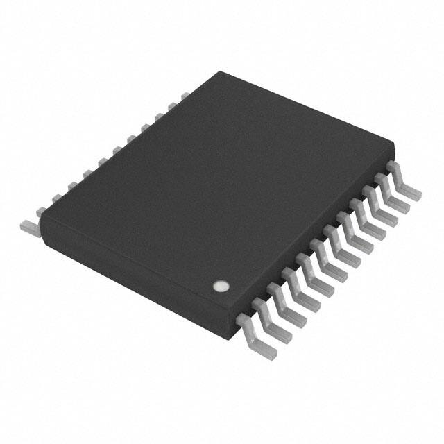

SN74AVC8T245DGVR
SN74AVC8T245DGVR
    BURR-BROWN(德州仪器)
    TVSOP24-4.4mm
    具备可配置电压转换和三态输出功能的8位双电源总线收发器
SN74AVC8T245DGVR 数据手册
Product Folder Order Now Technical Documents Support & Community Tools & Software SN74AVC8T245 SCES517J – DECEMBER 2003 – REVISED MARCH 2017 SN74AVC8T245 8-Bit Dual-Supply Bus Transceiver With Configurable Voltage Translation and 3-State Outputs 1 Features 3 Description • This 8-bit noninverting bus transceiver uses two separate configurable power-supply rails. The SN74AVC8T245 is optimized to operate with VCCA/VCCB set at 1.4 V to 3.6 V. The device is operational with VCCA/VCCB as low as 1.2 V. The A port is designed to track VCCA. VCCA accepts any supply voltage from 1.2 V to 3.6 V. The B port is designed to track VCCB. VCCB accepts any supply voltage from 1.2 V to 3.6 V. This allows for universal low-voltage bidirectional translation between any of the 1.2-V, 1.5-V, 1.8-V, 2.5-V, and 3.3-V voltage nodes. 1 • • • • • • • Latch-Up Performance Exceeds 100 mA Per JESD 78, Class II ESD Protection Exceeds JESD 22 – 8000-V Human-Body Model (A114-A) – 200-V Machine Model (A115-A) – 1000-V Charged-Device Model (C101) Control Inputs VIH/VIL Levels Are Referenced to VCCA Voltage VCC Isolation Feature – If Either VCC Input Is at GND, All I/O Ports Are in the High-Impedance State Ioff Supports Partial Power-Down Mode Operation Fully Configurable Dual-Rail Design Allows Each Port to Operate Over the Full 1.4-V to 3.6-V Power-Supply Range I/Os Are 4.6-V Tolerant Maximum Data Rates – 170 Mbps (VCCA < 1.8 V or VCCB < 1.8 V) – 320 Mbps (VCCA ≥ 1.8 V and VCCB ≥ 1.8 V) 2 Applications • • • • Personal Electronic Industrial Enterprise Telecom The SN74AVC8T245 is designed for asynchronous communication between data buses. The device transmits data from the A bus to the B bus or from the B bus to the A bus, depending on the logic level at the direction-control (DIR) input. The output-enable (OE) input can be used to disable the outputs so the buses are effectively isolated. The SN74AVC8T245 is designed so that the control pins (DIR and OE) are supplied by VCCA. The SN74AVC8T245 solution is compatible with a single-supply system and can be replaced later with a '245 function, with minimal printed circuit board redesign. This device is fully specified for partial-power-down applications using Ioff. The Ioff circuitry disables the outputs, thus preventing damaging current backflow through the device when it is powered down. 2 The VCC isolation feature ensures that if either VCC input is at GND, both ports are in the high-impedance state. 3 To ensure the high-impedance state during power up or power down, OE shall be tied to VCC through a pullup resistor; the minimum value of the resistor is determined by the current-sinking capability of the driver. Logic Diagram (Positive Logic) DIR 22 OE A1 Device Information(1) PART NUMBER 21 B1 SN74AVC8T245 To Seven Other Channels PACKAGE BODY SIZE (NOM) VQFN (24) 3.50 mm x 5.50 mm TSSOP (24) 4.40 mm x 7.80 mm TVSOP (24) 4.40 mm x 5.00 mm (1) For all available packages, see the orderable addendum at the end of the datasheet. 1 An IMPORTANT NOTICE at the end of this data sheet addresses availability, warranty, changes, use in safety-critical applications, intellectual property matters and other important disclaimers. PRODUCTION DATA. SN74AVC8T245 SCES517J – DECEMBER 2003 – REVISED MARCH 2017 www.ti.com Table of Contents 1 2 3 4 5 6 Features .................................................................. Applications ........................................................... Description ............................................................. Revision History..................................................... Pin Configuration and Functions ......................... Specifications......................................................... 6.1 6.2 6.3 6.4 6.5 6.6 6.7 6.8 6.9 6.10 6.11 6.12 7 8 1 1 1 2 3 4 Absolute Maximum Ratings ..................................... 4 ESD Ratings.............................................................. 4 Recommended Operating Conditions....................... 5 Thermal Information .................................................. 5 Electrical Characteristics........................................... 6 Switching Characteristics, VCCA = 1.2 V ................... 7 Switching Characteristics, VCCA = 1.5 V ± 0.1 V....... 7 Switching Characteristics, VCCA = 1.8 V ± 0.15 V..... 8 Switching Characteristics, VCCA = 2.5 V ± 0.2 V....... 9 Switching Characteristics, VCCA = 3.3 V ± 0.3 V... 10 Operating Characteristics...................................... 11 Typical Characteristics .......................................... 12 Parameter Measurement Information ................ 14 Detailed Description ............................................ 15 8.1 8.2 8.3 8.4 9 Overview ................................................................. Functional Block Diagram ....................................... Feature Description................................................. Device Functional Modes........................................ 15 15 15 15 Application and Implementation ........................ 16 9.1 Application Information............................................ 16 9.2 Typical Application .................................................. 16 10 Power Supply Recommendations ..................... 18 11 Layout................................................................... 19 11.1 Layout Guidelines ................................................. 19 11.2 Layout Example .................................................... 19 12 Device and Documentation Support ................. 20 12.1 12.2 12.3 12.4 12.5 12.6 Documentation Support ........................................ Receiving Notification of Documentation Updates Community Resources.......................................... Trademarks ........................................................... Electrostatic Discharge Caution ............................ Glossary ................................................................ 20 20 20 20 20 20 13 Mechanical, Packaging, and Orderable Information ........................................................... 20 4 Revision History NOTE: Page numbers for previous revisions may differ from page numbers in the current version. Changes from Revision I (December 2014) to Revision J Page • Changed MAX value for Operating free-air temperature, TA from: 85°C to: 125°C ............................................................... 5 • Added values for TA = –40°C to +125°C in Electrical Characteristics and all Switching Characteristics tables .................... 6 • Added Documentation Support section, Receiving Notification of Documentation Updates, and Community Resources section ................................................................................................................................................................ 20 Changes from Revision H (February 2007) to Revision I • 2 Page Added Pin Configuration and Functions section, ESD Rating table, Feature Description section, Device Functional Modes, Application and Implementation section, Power Supply Recommendations section, Layout section, Device and Documentation Support section, and Mechanical, Packaging, and Orderable Information section .............................. 1 Submit Documentation Feedback Copyright © 2003–2017, Texas Instruments Incorporated Product Folder Links: SN74AVC8T245 SN74AVC8T245 www.ti.com SCES517J – DECEMBER 2003 – REVISED MARCH 2017 5 Pin Configuration and Functions DGV or PW Package 24-Pin TVSOP or TSSOP Top View 3 22 4 21 5 20 6 19 7 18 8 17 9 16 10 15 11 14 12 13 VCCB VCCB OE B1 B2 B3 B4 B5 B6 B7 B8 GND DIR A1 A2 A3 A4 A5 A6 A7 A8 GND VCCB 23 1 24 23 VCCB 22 OE 2 3 21 B1 20 B2 4 5 19 B3 18 B4 6 7 17 B5 16 B6 8 9 15 B7 14 B8 10 11 12 13 GND 24 2 VCCA 1 GND VCCA DIR A1 A2 A3 A4 A5 A6 A7 A8 GND GND RHL Package 24-Pin VQFN Top View Pin Functions PIN NAME NO. I/O DESCRIPTION A1 3 I/O Input/output A1. Referenced to VCCA. A2 4 I/O Input/output A2. Referenced to VCCA. A3 5 I/O Input/output A3. Referenced to VCCA. A4 6 I/O Input/output A4. Referenced to VCCA. A5 7 I/O Input/output A5. Referenced to VCCA. A6 8 I/O Input/output A6. Referenced to VCCA. A7 9 I/O Input/output A7. Referenced to VCCA. A8 10 I/O Input/output A8. Referenced to VCCA. B1 21 I/O Input/output B1. Referenced to VCCB. B2 20 I/O Input/output B2. Referenced to VCCB. B3 19 I/O Input/output B3. Referenced to VCCB. B4 18 I/O Input/output B4. Referenced to VCCB. B5 17 I/O Input/output B5. Referenced to VCCB. B6 16 I/O Input/output B6. Referenced to VCCB. B7 15 I/O Input/output B7. Referenced to VCCB. B8 14 I/O Input/output B8. Referenced to VCCB. DIR 2 I GND 11, 12, 13 — 22 I VCCA 1 — A-port supply voltage. 1.2 V ≤ VCCA ≤ 3.6 V VCCB 23, 24 — B-port supply voltage. 1.2 V ≤ VCCA ≤ 3.6 V OE Direction-control signal Ground 3-state output-mode enables. Pull OE high to place all outputs in 3-state mode. Referenced to VCCA. Submit Documentation Feedback Copyright © 2003–2017, Texas Instruments Incorporated Product Folder Links: SN74AVC8T245 3 SN74AVC8T245 SCES517J – DECEMBER 2003 – REVISED MARCH 2017 www.ti.com 6 Specifications 6.1 Absolute Maximum Ratings over operating free-air temperature range (unless otherwise noted) (1) MIN MAX UNIT –0.5 4.6 V I/O ports (A port) –0.5 4.6 I/O ports (B port) –0.5 4.6 Control inputs –0.5 4.6 A port –0.5 4.6 B port –0.5 4.6 A port –0.5 VCCA + 0.5 B port –0.5 VCCB + 0.5 VCCA, VCCB Supply voltage VI Input voltage (2) VO Voltage range applied to any output in the high-impedance or power-off state (2) VO Voltage range applied to any output in the high or low state (2) IIK Input clamp current VI < 0 –50 mA IOK Output clamp current VO < 0 –50 mA IO Continuous output current –50 50 mA Continuous current through VCCA, VCCB, or GND –100 100 mA Storage temperature –65 150 °C Tstg (1) (2) (3) (3) V V V Stresses beyond those listed under Absolute Maximum Ratings may cause permanent damage to the device. These are stress ratings only, and functional operation of the device at these or any other conditions beyond those indicated under Recommended Operating Conditions is not implied. Exposure to absolute-maximum-rated conditions for extended periods may affect device reliability. The input voltage and output negative-voltage ratings may be exceeded if the input and output current ratings are observed. The output positive-voltage rating may be exceeded up to 4.6 V maximum if the output current rating is observed. 6.2 ESD Ratings VALUE V(ESD) (1) (2) 4 Electrostatic discharge Human-body model (HBM), per ANSI/ESDA/JEDEC JS-001 (1) ±8000 Charged-device model (CDM), per JEDEC specification JESD22-C101 (2) ±1000 Machine model (MM) ±200 UNIT V JEDEC document JEP155 states that 500-V HBM allows safe manufacturing with a standard ESD control process. JEDEC document JEP157 states that 250-V CDM allows safe manufacturing with a standard ESD control process. Submit Documentation Feedback Copyright © 2003–2017, Texas Instruments Incorporated Product Folder Links: SN74AVC8T245 SN74AVC8T245 www.ti.com SCES517J – DECEMBER 2003 – REVISED MARCH 2017 6.3 Recommended Operating Conditions (1) (2) (3) See VCCI VCCO MIN MAX UNIT VCCA Supply voltage 1.2 3.6 V VCCB Supply voltage 1.2 3.6 V High-level input voltage VIH Data inputs Low-level input voltage VIL Data inputs 1.2 V to 1.95 V VCCI × 0.65 1.95 V to 2.7 V 1.6 2.7 V to 3.6 V 2 V 1.2 V to 1.95 V VCCI × 0.35 1.95 V to 2.7 V 0.7 2.7 V to 3.6 V High-level input voltage VIH DIR (referenced to VCCA) Low-level input voltage VIL VI DIR (referenced to VCCA) Output voltage IOH VCCA × 0.65 1.95 V to 2.7 V 1.6 2.7 V to 3.6 V 2 V 1.2 V to 1.95 V VCCA × 0.35 1.95 V to 2.7 V 0.7 2.7 V to 3.6 V 0.8 0 3.6 Active state 0 VCCO 3-state 0 3.6 High-level output current IOL Low-level output current Δt/Δv Input transition rise or fall rate TA Operating free-air temperature (1) (2) (3) 0.8 1.2 V to 1.95 V Input voltage VO V 1.2 V –3 1.4 V to 1.6 V –6 1.65 V to 1.95 V –8 2.3 V to 2.7 V –9 3 V to 3.6 V –12 1.2 V 3 1.4 V to 1.6 V 6 1.65 V to 1.95 V 8 2.3 V to 2.7 V 9 3 V to 3.6 V 12 V V V mA mA 5 –40 ns/V 125 °C VCCI is the VCC associated with the input port. VCCO is the VCC associated with the output port. All unused data inputs of the device must be held at VCCI or GND to ensure proper device operation. See Implications of Slow or Floating CMOS Inputs, SCBA004. 6.4 Thermal Information SN74AVC8T245 THERMAL METRIC (1) DGV PW RHL 24 PINS 24 PINS 24 PINS RθJA Junction-to-ambient thermal resistance RθJC(top) Junction-to-case (top) thermal resistance RθJB Junction-to-board thermal resistance ψJT Junction-to-top characterization parameter 0.7 ψJB Junction-to-board characterization parameter 48.5 RθJC(bot) Junction-to-case (bottom) thermal resistance N/A N/A (1) UNIT 95.5 92 35 °C/W 27 29.3 39.9 °C/W 48.9 46.7 13.8 °C/W 1.5 0.3 °C/W 46.2 13.8 °C/W 1.4 °C/W For more information about traditional and new thermal metrics, see the Semiconductor and IC Package Thermal Metrics application report. Submit Documentation Feedback Copyright © 2003–2017, Texas Instruments Incorporated Product Folder Links: SN74AVC8T245 5 SN74AVC8T245 SCES517J – DECEMBER 2003 – REVISED MARCH 2017 www.ti.com 6.5 Electrical Characteristics over recommended operating free-air temperature range (unless otherwise noted) (1) (2) PARAMETER TEST CONDITIONS 1.2 V to 3.6 V IOH = –3 mA 1.2 V 1.2 V IOH = –6 mA 1.4 V 1.4 V 1.05 1 IOH = –8 mA 1.65 V 1.65 V 1.2 1.2 IOH = –9 mA 2.3 V 2.3 V 1.75 1.75 IOH = –12 mA 3V 3V 2.3 IOL = 100 μA 1.2 V to 3.6 V 1.2 V to 3.6 V 1.2 V 1.2 V 1.4 V VI = VIH MAX MIN MAX 0.95 V 2.3 1.65 V 1.65 V 0.45 0.45 IOL = 9 mA 2.3 V 2.3 V 0.55 0.55 IOL = 12 mA 3V 3V 0.7 0.7 1.2 V to 3.6 V 1.2 V to 3.6 V Ioff A or B port VI or VO = 0 to 3.6 V A or B port VO = VCCO or GND, VI = VCCI or GND, OE = VIH VI = VCCI or GND, VI = VCCI or GND, VI = VCCI or GND, –0.25 ±0.025 0.25 –1 1 ±1 0V 0 V to 3.6 V –1 ±0.1 1 –5 5 ±5 0V –1 ±0.1 1 –5 5 ±5 3.6 V 3.6 V ±0.5 ±2.5 ±5 ±5 1.2 V to 3.6 V 1.2 V to 3.6 V 15 15 0V 3.6 V –2 –2 3.6 V 0V 15 15 1.2 V to 3.6 V 1.2 V to 3.6 V 15 15 0V 3.6 V 15 15 3.6 V 0V –2 –2 1.2 V to 3.6 V 1.2 V to 3.6 V 25 25 IO = 0 IO = 0 0.15 0 V to 3.6 V IO = 0 UNIT VCCO – 0.2 VCCO – 0.2 0.35 VI = VIL VI = VCCA or GND ICCA + ICCB MIN 0.35 IOL = 8 mA ICCB MAX 1.4 V IOL = 6 mA ICCA TYP 0.2 II (3) MIN 0.2 Control inputs IOZ –40°C to +125°C 1.2 V to 3.6 V IOL = 3 mA VOL –40°C to +85°C VCCB IOH = –100 μA VOH TA = 25°C VCCA V μA μA μA μA μA μA Ci Control inputs VI = 3.3 V or GND 3.3 V 3.3 V 3.5 4.5 pF Cio A or B port VO = 3.3 V or GND 3.3 V 3.3 V 6 7 pF (1) (2) (3) 6 VCCO is the VCC associated with the output port. VCCI is the VCC associated with the input port. For I/O ports, the parameter IOZ includes the input leakage current. Submit Documentation Feedback Copyright © 2003–2017, Texas Instruments Incorporated Product Folder Links: SN74AVC8T245 SN74AVC8T245 www.ti.com SCES517J – DECEMBER 2003 – REVISED MARCH 2017 6.6 Switching Characteristics, VCCA = 1.2 V over recommended operating free-air temperature range, VCCA = 1.2 V (see Figure 10) PARAMETER tPLH, tPHL tPLH, tPHL FROM (INPUT) A B TO (OUTPUT) TA = –40°C to +85°C TA = –40°C to +125°C TYP TYP VCCB = 1.2 V 3.1 3.1 VCCB = 1.5 V 2.6 2.6 VCCB = 1.8 V 2.5 2.5 VCCB B A VCCB = 2.5 V 3 3 VCCB = 3.3 V 3.5 3.5 VCCB = 1.2 V 3.1 3.1 VCCB = 1.5 V 2.7 2.7 VCCB = 1.8 V 2.5 2.5 VCCB = 2.5 V 2.4 2.4 VCCB = 3.3 V 2.3 2.3 5.3 5.3 5.1 5.1 UNIT ns ns VCCB = 1.2 V VCCB = 1.5 V tPZH, tPZL OE A VCCB = 1.8 V ns VCCB = 2.5 V VCCB = 3.3 V VCCB = 1.2 V tPZH, tPZL OE B VCCB = 1.5 V 4 4 VCCB = 1.8 V 3.5 3.5 VCCB = 2.5 V 3.2 3.2 VCCB = 3.3 V 3.1 3.1 4.8 4.8 4.7 4.7 ns VCCB = 1.2 V VCCB = 1.5 V tPHZ, tPLZ OE A VCCB = 1.8 V ns VCCB = 2.5 V VCCB = 3.3 V VCCB = 1.2 V tPHZ, tPLZ OE B VCCB = 1.5 V 4 4 VCCB = 1.8 V 4.1 4.1 VCCB = 2.5 V 4.3 4.3 VCCB = 3.3 V 5.1 5.1 ns 6.7 Switching Characteristics, VCCA = 1.5 V ± 0.1 V over recommended operating free-air temperature range, VCCA = 1.5 V ± 0.1 V (see Figure 10) PARAMETER FROM (INPUT) TO (OUTPUT) VCCB TA = –40°C to +85°C MIN VCCB = 1.2 V tPLH, tPHL A B B A TA = –40°C to +125°C MAX MIN 2.7 TYP MAX UNIT 3.1 VCCB = 1.5 V ± 0.1 V 0.5 5.4 0.5 14.7 VCCB = 1.8 V ± 0.15 V 0.5 4.6 0.5 13.3 VCCB = 2.5 V ± 0.2 V 0.5 4.9 0.5 13.9 VCCB = 3.3 V ± 0.3 V 0.5 6.8 0.5 17.2 VCCB = 1.2 V tPLH, tPHL TYP 2.6 3.1 VCCB = 1.5 V ± 0.1 V 0.5 5.4 0.5 14.7 VCCB = 1.8 V ± 0.15 V 0.5 5.1 0.5 14.2 VCCB = 2.5 V ± 0.2 V 0.5 4.7 0.5 13.5 VCCB = 3.3 V ± 0.3 V 0.5 4.5 0.5 13.2 Submit Documentation Feedback Copyright © 2003–2017, Texas Instruments Incorporated Product Folder Links: SN74AVC8T245 ns ns 7 SN74AVC8T245 SCES517J – DECEMBER 2003 – REVISED MARCH 2017 www.ti.com Switching Characteristics, VCCA = 1.5 V ± 0.1 V (continued) over recommended operating free-air temperature range, VCCA = 1.5 V ± 0.1 V (see Figure 10) PARAMETER FROM (INPUT) TO (OUTPUT) VCCB TA = –40°C to +85°C MIN VCCB = 1.2 V tPZH, tPZL OE A OE B OE A 3.7 OE B TYP MAX UNIT 5.3 8.7 0.5 20.5 VCCB = 1.8 V ± 0.15 V 1.1 8.7 0.5 20.5 VCCB = 2.5 V ± 0.2 V 1.1 8.7 0.5 20.5 VCCB = 3.3 V ± 0.3 V 1.1 8.7 0.5 4.8 ns 20.5 5.1 VCCB = 1.5 V ± 0.1 V 1.1 7.6 0.5 18.6 VCCB = 1.8 V ± 0.15 V 1.1 7.1 0.5 17.7 VCCB = 2.5 V ± 0.2 V 1 5.6 0.5 15.1 VCCB = 3.3 V ± 0.3 V 1 5.2 0.5 3.1 ns 14.4 4.8 VCCB = 1.5 V ± 0.1 V 0.5 8.6 0.5 20.3 VCCB = 1.8 V ± 0.15 V 0.5 8.6 0.5 20.3 VCCB = 2.5 V ± 0.2 V 0.5 8.6 0.5 20.3 VCCB = 3.3 V ± 0.3 V 0.5 8.6 0.5 VCCB = 1.2 V tPHZ, tPLZ MIN 1.1 VCCB = 1.2 V tPHZ, tPLZ MAX VCCB = 1.5 V ± 0.1 V VCCB = 1.2 V tPZH, tPZL TYP TA = –40°C to +125°C 4.1 ns 20.3 4.7 VCCB = 1.5 V ± 0.1 V 0.5 8.4 0.5 20 VCCB = 1.8 V ± 0.15 V 0.5 7.6 0.5 18.6 VCCB = 2.5 V ± 0.2 V 0.5 7.2 0.5 17.9 VCCB = 3.3 V ± 0.3 V 0.5 7.8 0.5 18.9 ns 6.8 Switching Characteristics, VCCA = 1.8 V ± 0.15 V over recommended operating free-air temperature range, VCCA = 1.8 V ± 0.15 V (see Figure 10) PARAMETER FROM (INPUT) TO (OUTPUT) VCCB TA = –40°C to +85°C MIN VCCB = 1.2 V tPLH, tPHL A B B A 8 OE A MIN TYP MAX VCCB = 1.5 V ± 0.1 V 0.5 5.1 0.5 0.5 4.4 0.5 13 VCCB = 2.5 V ± 0.2 V 0.5 4 0.5 12.3 VCCB = 3.3 V ± 0.3 V 0.5 3.9 0.5 12.1 2.5 14.2 ns 2.5 VCCB = 1.5 V ± 0.1 V 0.5 4.6 0.5 13.3 VCCB = 1.8 V ± 0.15 V 0.5 4.4 0.5 13 VCCB = 2.5 V ± 0.2 V 0.5 3.9 0.5 12.1 VCCB = 3.3 V ± 0.3 V 0.5 3.7 0.5 3 ns 11.8 3 VCCB = 1.5 V ± 0.1 V 1 6.8 0.5 17.2 VCCB = 1.8 V ± 0.15 V 1 6.8 0.5 17.2 VCCB = 2.5 V ± 0.2 V 1 6.8 0.5 17.2 VCCB = 3.3 V ± 0.3 V 1 6.8 0.5 17.2 Submit Documentation Feedback UNIT 2.5 VCCB = 1.8 V ± 0.15 V VCCB = 1.2 V tPZH, tPZL TA = –40°C to +125°C MAX 2.5 VCCB = 1.2 V tPLH, tPHL TYP ns Copyright © 2003–2017, Texas Instruments Incorporated Product Folder Links: SN74AVC8T245 SN74AVC8T245 www.ti.com SCES517J – DECEMBER 2003 – REVISED MARCH 2017 Switching Characteristics, VCCA = 1.8 V ± 0.15 V (continued) over recommended operating free-air temperature range, VCCA = 1.8 V ± 0.15 V (see Figure 10) PARAMETER FROM (INPUT) TO (OUTPUT) VCCB TA = –40°C to +85°C MIN MAX MIN 1.1 8.2 0.5 VCCB = 1.8 V ± 0.15 V 1 6.7 0.5 17 VCCB = 2.5 V ± 0.2 V 0.5 5.1 0.5 14.2 VCCB = 3.3 V ± 0.3 V 0.5 4.5 0.5 VCCB = 1.2 V VCCB = 1.5 V ± 0.1 V tPZH, tPZL OE B 4.6 VCCB = 1.2 V tPHZ, tPLZ OE A OE B TYP UNIT MAX 4.6 2.8 19.6 ns 13.2 2.8 VCCB = 1.5 V ± 0.1 V 0.5 7.1 0.5 17.7 VCCB = 1.8 V ± 0.15 V 0.5 7.1 0.5 17.7 VCCB = 2.5 V ± 0.2 V 0.5 7.1 0.5 17.7 VCCB = 3.3 V ± 0.3 V 0.5 7.1 0.5 VCCB = 1.2 V tPHZ, tPLZ TYP TA = –40°C to +125°C 3.9 ns 17.7 3.9 VCCB = 1.5 V ± 0.1 V 0.5 7.8 0.5 18.9 VCCB = 1.8 V ± 0.15 V 0.5 6.9 0.5 17.3 VCCB = 2.5 V ± 0.2 V 0.5 6 0.5 15.8 VCCB = 3.3 V ± 0.3 V 0.5 5.8 0.5 15.4 ns 6.9 Switching Characteristics, VCCA = 2.5 V ± 0.2 V over recommended operating free-air temperature range, VCCA = 2.5 V ± 0.2 V (see Figure 10) PARAMETER FROM (INPUT) TO (OUTPUT) VCCB TA = –40°C to +85°C MIN VCCB = 1.2 V tPLH, tPHL A B B A OE A 2.4 OE B TYP MAX UNIT 2.4 4.7 0.5 13.5 VCCB = 1.8 V ± 0.15 V 0.5 3.9 0.5 12.1 VCCB = 2.5 V ± 0.2 V 0.5 3.1 0.5 10.7 VCCB = 3.3 V ± 0.3 V 0.5 2.8 0.5 3 10.2 VCCB = 1.5 V ± 0.1 V 0.5 4.9 0.5 13.9 0.5 4 0.5 12.3 VCCB = 2.5 V ± 0.2 V 0.5 3.1 0.5 10.7 VCCB = 3.3 V ± 0.3 V 0.5 2.9 0.5 10.4 2.2 0.5 4.8 0.5 13.7 VCCB = 1.8 V ± 0.15 V 0.5 4.8 0.5 13.7 VCCB = 2.5 V ± 0.2 V 0.5 4.8 0.5 13.7 VCCB = 3.3 V ± 0.3 V 0.5 4.8 0.5 4.5 ns 13.7 4.5 VCCB = 1.5 V ± 0.1 V 1.1 7.9 0.5 19.1 VCCB = 1.8 V ± 0.15 V 0.5 6.4 0.5 16.5 VCCB = 2.5 V ± 0.2 V 0.5 4.6 0.5 13.3 VCCB = 3.3 V ± 0.3 V 0.5 4 0.5 12.3 Submit Documentation Feedback Product Folder Links: SN74AVC8T245 ns 2.2 VCCB = 1.5 V ± 0.1 V Copyright © 2003–2017, Texas Instruments Incorporated ns 3 VCCB = 1.8 V ± 0.15 V VCCB = 1.2 V tPZH, tPZL MIN 0.5 VCCB = 1.2 V tPZH, tPZL TA = –40°C to +125°C MAX VCCB = 1.5 V ± 0.1 V VCCB = 1.2 V tPLH, tPHL TYP ns 9 SN74AVC8T245 SCES517J – DECEMBER 2003 – REVISED MARCH 2017 www.ti.com Switching Characteristics, VCCA = 2.5 V ± 0.2 V (continued) over recommended operating free-air temperature range, VCCA = 2.5 V ± 0.2 V (see Figure 10) PARAMETER FROM (INPUT) TO (OUTPUT) VCCB TA = –40°C to +85°C MIN VCCB = 1.2 V tPHZ, tPLZ OE A OE B MAX MIN 1.8 TYP MAX UNIT 1.8 VCCB = 1.5 V ± 0.1 V 0.5 5.1 0.5 14.2 VCCB = 1.8 V ± 0.15 V 0.5 5.1 0.5 14.2 VCCB = 2.5 V ± 0.2 V 0.5 5.1 0.5 14.2 VCCB = 3.3 V ± 0.3 V 0.5 5.1 0.5 VCCB = 1.2 V tPHZ, tPLZ TYP TA = –40°C to +125°C 3.6 ns 14.2 3.6 VCCB = 1.5 V ± 0.1 V 0.5 7.1 0.5 17.7 VCCB = 1.8 V ± 0.15 V 0.5 6.3 0.5 16.3 VCCB = 2.5 V ± 0.2 V 0.5 5.1 0.5 14.2 VCCB = 3.3 V ± 0.3 V 0.5 3.9 0.5 12.1 ns 6.10 Switching Characteristics, VCCA = 3.3 V ± 0.3 V over recommended operating free-air temperature range, VCCA = 3.3 V ± 0.3 V (see Figure 10) PARAMETER FROM (INPUT) TO (OUTPUT) VCCB TA = –40°C to +85°C MIN VCCB = 1.2 V VCCB = 1.5 V ± 0.1 V tPLH, tPHL A B B A OE A OE B 10 OE A MAX 4.5 0.5 13.2 3.7 0.5 11.1 tPHL 0.5 3.3 0.5 11.1 VCCB = 2.5 V ± 0.2 V 0.5 2.9 0.5 10.4 VCCB = 3.3 V ± 0.3 V 0.5 2.5 0.5 3.5 ns 9.7 3.5 VCCB = 1.5 V ± 0.1 V 0.5 6.8 0.5 17.2 VCCB = 1.8 V ± 0.15 V 0.5 3.9 0.5 12.1 VCCB = 2.5 V ± 0.2 V 0.5 2.8 0.5 10.2 VCCB = 3.3 V ± 0.3 V 0.5 2.5 0.5 9.7 2 ns 2 VCCB = 1.5 V ± 0.1 V 0.5 4 0.5 12.3 VCCB = 1.8 V ± 0.15 V 0.5 4 0.5 12.3 VCCB = 2.5 V ± 0.2 V 0.5 4 0.5 12.3 VCCB = 3.3 V ± 0.3 V 0.5 4 0.5 4.5 ns 12.3 4.5 VCCB = 1.5 V ± 0.1 V 1.1 7.8 0.5 18.9 VCCB = 1.8 V ± 0.15 V 0.5 6.2 0.5 16.1 VCCB = 2.5 V ± 0.2 V 0.5 4.5 0.5 13.2 VCCB = 3.3 V ± 0.3 V 0.5 3.9 0.5 12.3 1.7 ns 1.7 VCCB = 1.5 V ± 0.1 V 0.5 4 0.5 12.3 VCCB = 1.8 V ± 0.15 V 0.5 4 0.5 12.3 VCCB = 2.5 V ± 0.2 V 0.5 4 0.5 12.3 VCCB = 3.3 V ± 0.3 V 0.5 4 0.5 12.3 Submit Documentation Feedback UNIT 2.3 0.5 VCCB = 1.2 V tPHZ, tPLZ TYP 0.5 VCCB = 1.2 V tPZH, tPZL MIN tPLH VCCB = 1.8 V ± 0.15 V VCCB = 1.2 V tPZH, tPZL TA = –40°C to +125°C MAX 2.3 VCCB = 1.2 V tPLH, tPHL TYP ns Copyright © 2003–2017, Texas Instruments Incorporated Product Folder Links: SN74AVC8T245 SN74AVC8T245 www.ti.com SCES517J – DECEMBER 2003 – REVISED MARCH 2017 Switching Characteristics, VCCA = 3.3 V ± 0.3 V (continued) over recommended operating free-air temperature range, VCCA = 3.3 V ± 0.3 V (see Figure 10) PARAMETER FROM (INPUT) TO (OUTPUT) TA = –40°C to +85°C VCCB MIN TYP VCCB = 1.2 V tPHZ, tPLZ OE B TA = –40°C to +125°C MAX MIN 6.9 0.5 17.4 3.4 TYP UNIT MAX 3.4 VCCB = 1.5 V ± 0.1 V 0.5 VCCB = 1.8 V ± 0.15 V 0.5 6 0.5 15.8 VCCB = 2.5 V ± 0.2 V 0.5 4.8 0.5 13.7 VCCB = 3.3 V ± 0.3 V 0.5 4.2 0.5 12.6 ns 6.11 Operating Characteristics TA = 25°C PARAMETER A to B CpdA (1) B to A A to B CpdB (1) B to A (1) VCCA = VCCB = 1.2 V TEST CONDITIONS VCCA = VCCB = 1.5 V VCCA = VCCB = 1.8 V VCCA = VCCB = 2.5 V VCCA = VCCB = 3.3 V TYP TYP TYP TYP TYP 1 1 1 1 1 1 1 1 1 1 12 12 12 13 14 Outputs disabled 1 1 1 1 1 Outputs enabled 12 12 12 13 14 1 1 1 1 1 1 1 1 1 1 1 1 1 1 1 Outputs enabled Outputs disabled Outputs enabled Outputs disabled Outputs enabled CL = 0, f = 10 MHz, tr = tf = 1 ns UNIT pF CL = 0, f = 10 MHz, tr = tf = 1 ns pF Outputs disabled Power dissipation capacitance per transceiver Table 1. Typical Total Static Power Consumption (ICCA + ICCB) VCCB VCCA 0V 1.2 V 1.5 V 1.8 V 2.5 V 3.3 V 0V 0
