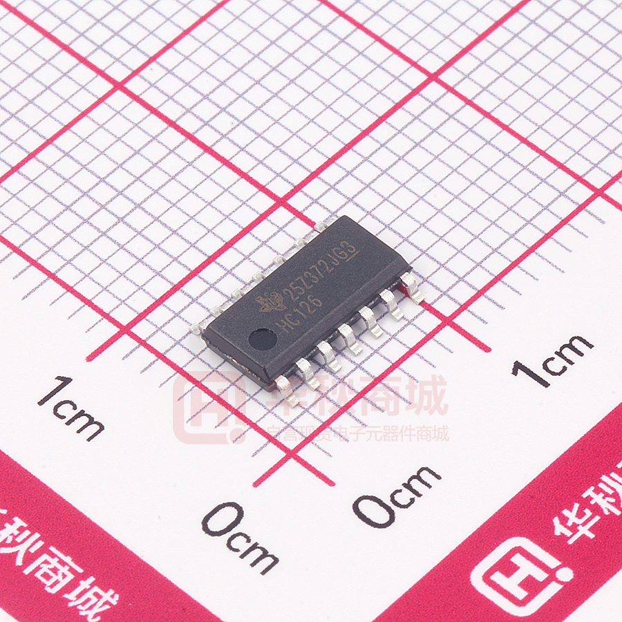

               SCLS103E − MARCH 1984 − REVISED JULY 2003 D Wide Operating Voltage Range of 2 V to 6 V D High-Current 3-State Outputs Interface D Directly With System Bus or Can Drive Up To 15 LSTTL Loads Low Power Consumption, 80-µA Max ICC D Typical tpd = 11 ns D ±6-mA Output Drive at 5 V D Low Input Current of 1 µA Max SN54HC126 . . . FK PACKAGE (TOP VIEW) 1 14 2 13 3 12 4 11 5 10 6 9 7 8 VCC 4OE 4A 4Y 3OE 3A 3Y 1Y NC 2OE NC 2A 4 3 2 1 20 19 18 5 17 6 16 7 15 8 14 9 10 11 12 13 4A NC 4Y NC 3OE 2Y GND NC 3Y 3A 1OE 1A 1Y 2OE 2A 2Y GND 1A 1OE NC VCC 4OE SN54HC126 . . . J OR W PACKAGE SN74HC126 . . . D, DB, N, NS, OR PW PACKAGE (TOP VIEW) NC − No internal connection description/ordering information These quadruple bus buffer gates feature independent line drivers with 3-state outputs. Each output is disabled when the associated output-enable (OE) input is low. To ensure the high-impedance state during power up or power down, OE should be tied to GND through a pullup resistor; the minimum value of the resistor is determined by the current-sourcing capability of the driver. ORDERING INFORMATION PACKAGE† TA PDIP − N SN74HC126N Tube of 50 SN74HC126D Reel of 2500 SN74HC126DR Reel of 250 SN74HC126DT SOP − NS Reel of 2000 SN74HC126NSR HC126 SSOP − DB Reel of 2000 SN74HC126DBR HC126 Tube of 90 SN74HC126PW Reel of 2000 SN74HC126PWR Reel of 250 SN74HC126PWT CDIP − J Tube of 25 SNJ54HC126J SNJ54HC126J CFP − W Tube of 150 SNJ54HC126W SNJ54HC126W LCCC − FK Tube of 55 SNJ54HC126FK TSSOP − PW −55°C −55 C to 125 125°C C TOP-SIDE MARKING Tube of 25 SOIC − D −40°C −40 C to 85 85°C C ORDERABLE PART NUMBER SN74HC126N HC126 HC126 SNJ54HC126FK † Package drawings, standard packing quantities, thermal data, symbolization, and PCB design guidelines are available at www.ti.com/sc/package. Please be aware that an important notice concerning availability, standard warranty, and use in critical applications of Texas Instruments semiconductor products and disclaimers thereto appears at the end of this data sheet. Copyright  2003, Texas Instruments Incorporated    !"#$%! & '("")% $& ! *(+,'$%! -$%). "!-('%& '!!"# %! &*)''$%!& *)" %/) %)"#& ! )0$& &%"(#)%& &%$-$"- 1$""$%2. "!-('%! *"!')&&3 -!)& !% )')&&$",2 ',(-) %)&%3 ! $,, *$"$#)%)"&.  *"!-('%& '!#*,$% %! 45 $,, *$"$#)%)"& $") %)&%)(,)&& !%/)"1&) !%)-.  $,, !%/)" *"!-('%& *"!-('%! *"!')&&3 -!)& !% )')&&$",2 ',(-) %)&%3 ! $,, *$"$#)%)"&. POST OFFICE BOX 655303 • DALLAS, TEXAS 75265 1                SCLS103E − MARCH 1984 − REVISED JULY 2003 FUNCTION TABLE (each buffer) INPUTS OE A OUTPUT Y H H H H L L L X Z logic diagram (positive logic) 1OE 1A 2OE 2A 1 2 3OE 3 1Y 3A 4 5 4OE 6 2Y 4A 10 9 8 3Y 13 12 11 4Y Pin numbers shown are for the D, DB, J, N, NS, PW, and W packages. absolute maximum ratings over operating free-air temperature range (unless otherwise noted)† Supply voltage range, VCC . . . . . . . . . . . . . . . . . . . . . . . . . . . . . . . . . . . . . . . . . . . . . . . . . . . . . . . . . . −0.5 V to 7 V Input clamp current, IIK (VI < 0 or VI > VCC) (see Note 1) . . . . . . . . . . . . . . . . . . . . . . . . . . . . . . . . . . . . ±20 mA Output clamp current, IOK (VO < 0 or VO > VCC) (see Note 1) . . . . . . . . . . . . . . . . . . . . . . . . . . . . . . . . ±20 mA Continuous output current, IO (VO = 0 to VCC) . . . . . . . . . . . . . . . . . . . . . . . . . . . . . . . . . . . . . . . . . . . . . . ±35 mA Continuous current through VCC or GND . . . . . . . . . . . . . . . . . . . . . . . . . . . . . . . . . . . . . . . . . . . . . . . . . . . ±70 mA Package thermal impedance, θJA (see Note 2): D package . . . . . . . . . . . . . . . . . . . . . . . . . . . . . . . . . . . 86°C/W DB package . . . . . . . . . . . . . . . . . . . . . . . . . . . . . . . . . 96°C/W N package . . . . . . . . . . . . . . . . . . . . . . . . . . . . . . . . . . . 80°C/W NS package . . . . . . . . . . . . . . . . . . . . . . . . . . . . . . . . . 76°C/W PW package . . . . . . . . . . . . . . . . . . . . . . . . . . . . . . . . 113°C/W Storage temperature range, Tstg . . . . . . . . . . . . . . . . . . . . . . . . . . . . . . . . . . . . . . . . . . . . . . . . . . . −65°C to 150°C † Stresses beyond those listed under “absolute maximum ratings” may cause permanent damage to the device. These are stress ratings only, and functional operation of the device at these or any other conditions beyond those indicated under “recommended operating conditions” is not implied. Exposure to absolute-maximum-rated conditions for extended periods may affect device reliability. NOTES: 1. The input and output voltage ratings may be exceeded if the input and output current ratings are observed. 2. The package thermal impedance is calculated in accordance with JESD 51-7. 2 POST OFFICE BOX 655303 • DALLAS, TEXAS 75265                SCLS103E − MARCH 1984 − REVISED JULY 2003 recommended operating conditions (see Note 3) SN54HC126 VCC VIH Supply voltage VCC = 2 V VCC = 4.5 V High-level input voltage VCC = 6 V VCC = 2 V VIL VI VO ∆t/∆v MIN NOM MAX 2 5 6 Input voltage MAX 2 5 6 3.15 3.15 4.2 4.2 0 VCC = 6 V UNIT V V 0.5 0.5 1.35 1.35 1.8 1.8 VCC VCC VCC = 2 V VCC = 4.5 V Input transition rise/fall time NOM 1.5 0 Output voltage MIN 1.5 VCC = 4.5 V VCC = 6 V Low-level input voltage SN74HC126 0 VCC VCC 0 1000 1000 500 500 400 400 V V V ns TA Operating free-air temperature −55 125 −40 85 °C NOTE 3: All unused inputs of the device must be held at VCC or GND to ensure proper device operation. Refer to the TI application report, Implications of Slow or Floating CMOS Inputs, literature number SCBA004. electrical characteristics over recommended operating free-air temperature range (unless otherwise noted) PARAMETER VOH VOL TEST CONDITIONS VI = VCC or 0, MIN MAX SN74HC126 MIN MAX UNIT 1.9 1.998 1.9 1.9 IOH = −20 µA 4.4 4.499 4.4 4.4 6V 5.9 5.999 5.9 5.9 IOH = −6 mA IOH = −7.8 mA 4.5 V 3.98 4.3 3.7 3.84 6V 5.48 5.8 5.2 5.34 2V 0.002 0.1 0.1 0.1 IOL = 20 µA 4.5 V 0.001 0.1 0.1 0.1 6V 0.001 0.1 0.1 0.1 4.5 V 0.17 0.26 0.4 0.33 6V 0.15 0.26 0.4 0.33 6V ±0.1 ±100 ±1000 ±1000 nA 6V ±0.01 ±0.5 ±10 ±5 µA 8 160 80 µA 10 10 10 pF IOL = 6 mA IOL = 7.8 mA ICC Ci SN54HC126 2V VI = VIH or VIL VI = VCC or 0 VO = VCC or 0 TA = 25°C MIN TYP MAX 4.5 V VI = VIH or VIL II IOZ VCC IO = 0 6V 2 V to 6 V POST OFFICE BOX 655303 3 • DALLAS, TEXAS 75265 V V 3                SCLS103E − MARCH 1984 − REVISED JULY 2003 switching characteristics over recommended operating free-air temperature range, CL = 50 pF (unless otherwise noted) (see Figure 1) TA = 25°C TYP MAX SN54HC126 SN74HC126 PARAMETER FROM (INPUT) TO (OUTPUT) VCC 2V 47 120 180 150 tpd A Y 4.5 V 14 24 36 30 6V 11 20 31 26 ten OE tdis Y OE Y tt Any MIN MIN MAX MIN MAX 2V 57 120 180 150 4.5 V 16 24 36 30 6V 12 20 31 26 2V 35 120 180 150 4.5 V 17 24 36 30 6V 15 20 31 26 2V 28 60 90 75 4.5 V 8 12 18 15 6V 6 10 15 13 UNIT ns ns ns ns switching characteristics over recommended operating free-air temperature range, CL = 150 pF (unless otherwise noted) (see Figure 1) PARAMETER tpd ten FROM (INPUT) TA = 25°C MIN TYP MAX SN54HC126 SN74HC126 TO (OUTPUT) VCC 2V 67 150 225 188 Y 4.5 V 19 30 45 38 6V 15 25 39 33 2V 100 135 202 169 4.5 V 20 27 40 36 6V 17 23 36 30 2V 45 210 315 265 4.5 V 17 42 63 53 6V 13 36 53 45 A OE Y tt Any MIN MAX MIN MAX UNIT ns ns ns operating characteristics, TA = 25°C PARAMETER Cpd 4 TEST CONDITIONS Power dissipation capacitance per gate POST OFFICE BOX 655303 No load • DALLAS, TEXAS 75265 TYP 45 UNIT pF                SCLS103E − MARCH 1984 − REVISED JULY 2003 PARAMETER MEASUREMENT INFORMATION VCC Test Point From Output Under Test PARAMETER S1 tPZH ten RL CL (see Note A) 1 kΩ tPZL tPHZ tdis S2 RL 1 kΩ CL S1 S2 50 pF or 150 pF Open Closed Closed Open Open Closed Closed Open Open Open 50 pF tPLZ tpd or tt −− LOAD CIRCUIT 50 pF or 150 pF VCC Input 50% 50% 0V tPLH In-Phase Output 50% 10% tPHL 90% VOH 50% 10% V OL tf 90% tr tPHL Out-of-Phase Output 90% tPLH 50% 10% 50% 10% 90% VOH VOL tf tr VOLTAGE WAVEFORMS PROPAGATION DELAY AND OUTPUT TRANSITION TIMES Output Control VCC 50% 50% 0V tPZL Output Waveform 1 (See Note B) tPLZ ≈VCC 50% 10% tPZH Input 50% 10% 90% VCC 90% 50% 10% 0 V tr Output Waveform 2 (See Note B) VOL tPHZ 50% 90% VOH ≈0 V tf VOLTAGE WAVEFORM INPUT RISE AND FALL TIMES VOLTAGE WAVEFORMS ENABLE AND DISABLE TIMES FOR 3-STATE OUTPUTS NOTES: A. CL includes probe and test-fixture capacitance. B. Waveform 1 is for an output with internal conditions such that the output is low except when disabled by the output control. Waveform 2 is for an output with internal conditions such that the output is high except when disabled by the output control. C. Phase relationships between waveforms were chosen arbitrarily. All input pulses are supplied by generators having the following characteristics: PRR ≤ 1 MHz, ZO = 50 Ω, tr = 6 ns, tf = 6 ns. D. The outputs are measured one at a time with one input transition per measurement. E. tPLZ and tPHZ are the same as tdis. F. tPZL and tPZH are the same as ten. G. tPLH and tPHL are the same as tpd. Figure 1. Load Circuit and Voltage Waveforms POST OFFICE BOX 655303 • DALLAS, TEXAS 75265 5 PACKAGE OPTION ADDENDUM www.ti.com 24-Aug-2018 PACKAGING INFORMATION Orderable Device Status (1) Package Type Package Pins Package Drawing Qty Eco Plan Lead/Ball Finish MSL Peak Temp (2) (6) (3) Op Temp (°C) Device Marking (4/5) 5962-86848012A ACTIVE LCCC FK 20 1 TBD POST-PLATE N / A for Pkg Type -55 to 125 596286848012A SNJ54HC 126FK 5962-8684801CA ACTIVE CDIP J 14 1 TBD A42 N / A for Pkg Type -55 to 125 5962-8684801CA SNJ54HC126J SN54HC126J ACTIVE CDIP J 14 1 TBD A42 N / A for Pkg Type -55 to 125 SN54HC126J SN74HC126D ACTIVE SOIC D 14 50 Green (RoHS & no Sb/Br) CU NIPDAU Level-1-260C-UNLIM -40 to 85 HC126 SN74HC126DBR ACTIVE SSOP DB 14 2000 Green (RoHS & no Sb/Br) CU NIPDAU Level-1-260C-UNLIM -40 to 85 HC126 SN74HC126DR ACTIVE SOIC D 14 2500 Green (RoHS & no Sb/Br) CU NIPDAU Level-1-260C-UNLIM -40 to 85 HC126 SN74HC126DRE4 ACTIVE SOIC D 14 2500 Green (RoHS & no Sb/Br) CU NIPDAU Level-1-260C-UNLIM -40 to 85 HC126 SN74HC126DRG4 ACTIVE SOIC D 14 2500 Green (RoHS & no Sb/Br) CU NIPDAU Level-1-260C-UNLIM -40 to 85 HC126 SN74HC126DT ACTIVE SOIC D 14 250 Green (RoHS & no Sb/Br) CU NIPDAU Level-1-260C-UNLIM -40 to 85 HC126 SN74HC126N ACTIVE PDIP N 14 25 Green (RoHS & no Sb/Br) CU NIPDAU N / A for Pkg Type -40 to 85 SN74HC126N SN74HC126NSR ACTIVE SO NS 14 2000 Green (RoHS & no Sb/Br) CU NIPDAU Level-1-260C-UNLIM -40 to 85 HC126 SN74HC126PW ACTIVE TSSOP PW 14 90 Green (RoHS & no Sb/Br) CU NIPDAU Level-1-260C-UNLIM -40 to 85 HC126 SN74HC126PWR ACTIVE TSSOP PW 14 2000 Green (RoHS & no Sb/Br) CU NIPDAU Level-1-260C-UNLIM -40 to 85 HC126 SN74HC126PWT ACTIVE TSSOP PW 14 250 Green (RoHS & no Sb/Br) CU NIPDAU Level-1-260C-UNLIM -40 to 85 HC126 SN74HC126PWTG4 ACTIVE TSSOP PW 14 250 Green (RoHS & no Sb/Br) CU NIPDAU Level-1-260C-UNLIM -40 to 85 HC126 SNJ54HC126FK ACTIVE LCCC FK 20 1 TBD POST-PLATE N / A for Pkg Type -55 to 125 596286848012A SNJ54HC Addendum-Page 1 Samples PACKAGE OPTION ADDENDUM www.ti.com Orderable Device 24-Aug-2018 Status (1) Package Type Package Pins Package Drawing Qty Eco Plan Lead/Ball Finish MSL Peak Temp (2) (6) (3) TBD A42 N / A for Pkg Type Op Temp (°C) Device Marking (4/5) 126FK SNJ54HC126J ACTIVE CDIP J 14 1 -55 to 125 5962-8684801CA SNJ54HC126J (1) The marketing status values are defined as follows: ACTIVE: Product device recommended for new designs. LIFEBUY: TI has announced that the device will be discontinued, and a lifetime-buy period is in effect. NRND: Not recommended for new designs. Device is in production to support existing customers, but TI does not recommend using this part in a new design. PREVIEW: Device has been announced but is not in production. Samples may or may not be available. OBSOLETE: TI has discontinued the production of the device. (2) RoHS: TI defines "RoHS" to mean semiconductor products that are compliant with the current EU RoHS requirements for all 10 RoHS substances, including the requirement that RoHS substance do not exceed 0.1% by weight in homogeneous materials. Where designed to be soldered at high temperatures, "RoHS" products are suitable for use in specified lead-free processes. TI may reference these types of products as "Pb-Free". RoHS Exempt: TI defines "RoHS Exempt" to mean products that contain lead but are compliant with EU RoHS pursuant to a specific EU RoHS exemption. Green: TI defines "Green" to mean the content of Chlorine (Cl) and Bromine (Br) based flame retardants meet JS709B low halogen requirements of
