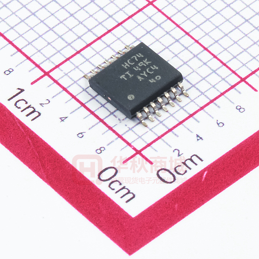

Product Folder Sample & Buy Support & Community Tools & Software Technical Documents SN54HC74, SN74HC74 SCLS094E – DECEMBER 1982 – REVISED DECEMBER 2015 SNx4HC74 Dual D-Type Positive-Edge-Triggered Flip-Flops With Clear and Preset 1 Features 3 Description • • • • • • The SNx4HC74 devices contain two independent Dtype positive-edge-triggered flip-flops. A low level at the preset (PRE) or clear (CLR) inputs sets or resets the outputs, regardless of the levels of the other inputs. When PRE and CLR are inactive (high), data at the data (D) input meeting the setup time requirements are transferred to the outputs on the positive-going edge of the clock (CLK) pulse. Clock triggering occurs at a voltage level and is not directly related to the rise time of CLK. Following the holdtime interval, data at the D input can be changed without affecting the levels at the outputs. 1 Wide Operating Voltage Range: 2 V to 6 V Outputs Can Drive Up To 10 LSTTL Loads Low Power Consumption, 40-µA Maximum ICC Typical tpd = 15 ns ±4-mA Output Drive at 5 V Very Low Input Current of 1 µA 2 Applications • • • • • • Ultrasound System Fans Lab Instrumentation Vacuum Cleaners Video Communications System IP Phone: Wired Device Information(1) PART NUMBER PACKAGE BODY SIZE (NOM) SN74HC74N PDIP (14) 19.30 mm x 6.40 mm SN74HC74NS SO (14) 10.20 mm x 5.30 mm SN74HC74D SOIC (14) 8.70 mm x 3.90 mm SN74HC74DB SSOP (14) 6.50 mm x 5.30 mm SN74HC74PW TSSOP (14) 5.00 mm x 4.40 mm SNJ54HC74J CDIP (14) 21.30 mm x 7.60 mm SNJ54HC74W CFP (14) 9.20 mm x 6.29 mm SNJ54HC74FK LCCC (20) 8.90 mm x 8.90 mm (1) For all available packages, see the orderable addendum at the end of the data sheet. Logic Diagram (Positive Logic) PRE CLK C C Q TG C C C C C D TG TG TG Q C C C CLR 1 An IMPORTANT NOTICE at the end of this data sheet addresses availability, warranty, changes, use in safety-critical applications, intellectual property matters and other important disclaimers. PRODUCTION DATA. SN54HC74, SN74HC74 SCLS094E – DECEMBER 1982 – REVISED DECEMBER 2015 www.ti.com Table of Contents 1 2 3 4 5 6 7 8 Features .................................................................. Applications ........................................................... Description ............................................................. Revision History..................................................... Pin Configuration and Functions ......................... Specifications......................................................... 1 1 1 2 3 4 6.1 6.2 6.3 6.4 6.5 6.6 6.7 6.8 4 4 4 5 5 6 7 8 Absolute Maximum Ratings ...................................... ESD Ratings ............................................................ Recommended Operating Conditions....................... Thermal Information .................................................. Electrical Characteristics........................................... Timing Requirements ................................................ Switching Characteristics .......................................... Typical Characteristics .............................................. Parameter Measurement Information .................. 9 Detailed Description ............................................ 10 8.1 Overview ................................................................. 10 8.2 Functional Block Diagram ....................................... 10 8.3 Feature Description................................................. 10 8.4 Device Functional Modes........................................ 10 9 Application and Implementation ........................ 11 9.1 Application Information .......................................... 11 9.2 Typical Application ................................................. 11 10 Power Supply Recommendations ..................... 12 11 Layout................................................................... 13 11.1 Layout Guidelines ................................................. 13 11.2 Layout Example .................................................... 13 12 Device and Documentation Support ................. 14 12.1 12.2 12.3 12.4 12.5 12.6 Documentation Support ........................................ Related Links ........................................................ Community Resources.......................................... Trademarks ........................................................... Electrostatic Discharge Caution ............................ Glossary ................................................................ 14 14 14 14 14 14 13 Mechanical, Packaging, and Orderable Information ........................................................... 14 4 Revision History Changes from Revision D (July 2003) to Revision E • 2 Page Added Applications, Device Information table, Pin Functions table, ESD Ratings table, Thermal Information table, Typical Characteristics, Feature Description section, Device Functional Modes, Application and Implementation section, Power Supply Recommendations section, Layout section, Device and Documentation Support section, and Mechanical, Packaging, and Orderable Information section. ................................................................................................. 1 Submit Documentation Feedback Copyright © 1982–2015, Texas Instruments Incorporated Product Folder Links: SN54HC74 SN74HC74 SN54HC74, SN74HC74 www.ti.com SCLS094E – DECEMBER 1982 – REVISED DECEMBER 2015 5 Pin Configuration and Functions N, NS, D, DB, PW, J, or W Package 14-Pin PDIP, SO, SOIC, SSOP, TSSOP, CDIP, or CFP Top View 14 2 13 3 12 4 11 5 10 6 9 7 8 1D 1CLR NC VCC 2CLR 1 VCC 2CLR 2D 2CLK 2PRE 2Q 2Q 1CLK NC 1PRE NC 1Q 4 3 2 1 20 19 18 5 17 6 16 7 15 8 14 9 10 11 12 13 2D NC 2CLK NC 2PRE 1Q GND NC 2Q 2Q 1CLR 1D 1CLK 1PRE 1Q 1Q GND FK Package 20-Pin LCCC Top View NC – No internal connection Pin Functions PIN NAME LCCC SOIC, SSOP, CDIP, PDIP, SO, TSSOP, CFP NO. I/O 1CLK 4 3 I Clock input 1CLR 2 1 I Clear input - Pull low to set 1Q output low 1D 3 2 I Input 1PRE 6 4 I Preset input 1Q 8 5 O Output 1Q 9 6 O Inverted output 2CLK 16 11 I Clock input 2CLR 19 13 I Clear input - Pull low to set 1Q output low 2D 18 12 I Input 2PRE 14 10 I Preset input 2Q 13 9 O Output 2Q 12 8 O Inverted output GND 10 7 — Ground — — No connect (no internal connection) 14 — Supply DESCRIPTION 1 5 NC 7 11 15 17 VCC 20 Copyright © 1982–2015, Texas Instruments Incorporated Product Folder Links: SN54HC74 SN74HC74 Submit Documentation Feedback 3 SN54HC74, SN74HC74 SCLS094E – DECEMBER 1982 – REVISED DECEMBER 2015 www.ti.com 6 Specifications 6.1 Absolute Maximum Ratings over operating free-air temperature range (unless otherwise noted) (1) VCC Supply voltage range (2) MIN MAX –0.5 7 UNIT V IIK Input clamp current VI < 0 or VI > VCC ±20 mA IOK Output clamp current (2) VO < 0 or VO > VCC ±20 mA IO Continuous output current VO = 0 to VCC ±25 mA Continuous current through VCC or GND ±50 mA Junction temperature range 150 °C 150 °C Tj Tstg Storage temperature range (1) (2) –65 Stresses beyond those listed under “absolute maximum ratings” may cause permanent damage to the device. These are stress ratings only, and functional operation of the device at these or any other conditions beyond those indicated under “recommended operating conditions” is not implied. Exposure to absolute-maximum-rated conditions for extended periods may affect device reliability. The input and output voltage ratings may be exceeded if the input and output current ratings are observed. 6.2 ESD Ratings VALUE Human-body model (HBM), per ANSI/ESDA/JEDEC JS-001 V(ESD) (1) (2) Electrostatic discharge (1) UNIT ±2000 Charged-device model (CDM), per JEDEC specification JESD22C101 (2) V ±1500 JEDEC document JEP155 states that 500-V HBM allows safe manufacturing with a standard ESD control process. Manufacturing with less than 500-V HBM is possible with the necessary precautions. JEDEC document JEP157 states that 250-V CDM allows safe manufacturing with a standard ESD control process. Manufacturing with less than 250-V CDM is possible with the necessary precautions. 6.3 Recommended Operating Conditions See (1) SN54HC74 VCC Supply voltage VIH High-level input voltage VCC = 2 V VCC = 4.5 V VCC = 6 V SN74HC74 MIN NOM MAX MIN NOM MAX 2 5 6 2 5 6 1.5 1.5 3.15 3.15 4.2 4.2 VCC = 2 V VIL Low-level input voltage VCC = 4.5 V VCC = 6 V VI Input voltage VO Output voltage 0 0 VCC = 2 V ∆t/∆v Input transition rise and fall time VCC = 4.5 V VCC = 6 V TA (1) 4 Operating free-air temperature 0.5 1.35 1.35 1.8 1.8 0 VCC 0 V VCC V 1000 500 500 125 V VCC 1000 400 –55 V V 0.5 VCC UNIT ns 400 –40 85 °C All unused inputs of the device must be held at VCC or GND to ensure proper device operation. Refer to the TI application report, Implications of Slow or Floating CMOS Inputs, SCBA004. Submit Documentation Feedback Copyright © 1982–2015, Texas Instruments Incorporated Product Folder Links: SN54HC74 SN74HC74 SN54HC74, SN74HC74 www.ti.com SCLS094E – DECEMBER 1982 – REVISED DECEMBER 2015 6.4 Thermal Information SN74HC74 THERMAL METRIC D (SOIC) (1) SN54HC74 DB N NS (SSOP) (PDIP) (SO) PW J (TSSOP) (CDIP) 14 PINS W (CFP) 14 PINS FK (LCCC) 20 PINS RθJA Junction-to-ambient thermal resistance 86 96 80 76 113 — — — RθJC(top) Junction-to-case (top) thermal resistance — — — — — 15.05 14.65 5.61 (1) UNIT °C/W For more information about traditional and new thermal metrics, see the Semiconductor and IC Package Thermal Metrics application report, SPRA953. 6.5 Electrical Characteristics over recommended operating free-air temperature range, TA = 25°C (unless otherwise noted) PARAMETER TEST CONDITIONS IOH = –20 µA VCC MIN TYP 2V 1.9 1.998 4.5 V 4.4 4.499 6V 5.9 5.999 3.98 4.3 TA = 25°C VOH VI = VIH or VIL IOH = –4 mA SN54HC74 4.5 V SN74HC74 SN54HC74 VI = VIH or VIL IOL = 4 mA SN54HC74 V 5.8 5.2 5.34 2V 0.002 0.1 4.5 V 0.001 0.1 6V 0.001 0.1 0.17 0.26 TA = 25°C VOL 3.7 5.48 6V SN74HC74 IOL = 20 µA 4.5 V 0.4 SN74HC74 SN54HC74 0.15 6V VI = VCC or 0 VI = VCC or 0, 0.33 TA = 25°C SN54HC74, SN74HC74 IO = 0 ±0.1 6V SN54HC74 Cpd No load nA 4 6V 80 SN74HC74 Ci ±100 ±1000 TA = 25°C ICC 0.26 0.4 SN74HC74 II V 0.33 TA = 25°C IOL = 5.2 mA UNIT 3.84 TA = 25°C IOH = –5.2 mA MAX µA 40 2 V to 6 V 3 2 V to 6 V 35 Copyright © 1982–2015, Texas Instruments Incorporated Product Folder Links: SN54HC74 SN74HC74 10 Submit Documentation Feedback pF pF 5 SN54HC74, SN74HC74 SCLS094E – DECEMBER 1982 – REVISED DECEMBER 2015 www.ti.com 6.6 Timing Requirements over recommended operating free-air temperature range, TA = 25°C (unless otherwise noted) fclock Clock frequency VCC TA TA = 25°C 6 2V SN54HC74 4.2 4.5 V 6V 2V PRE or CLR low 4.5 V 6V tw Pulse duration 2V CLK high or low 4.5 V 6V 2V Data 4.5 V 6V tsu Setup time before CLK↑ 2V PRE or CLR inactive 4.5 V 6V 6 Submit Documentation Feedback MIN MAX SN74HC74 5 TA = 25°C 31 SN54HC74 21 SN74HC74 25 TA = 25°C 0 36 SN54HC74 0 25 SN74HC74 0 29 TA = 25°C 100 SN54HC74 150 SN74HC74 125 TA = 25°C 20 SN54HC74 30 SN74HC74 25 TA = 25°C 14 SN54HC74 25 SN74HC74 21 TA = 25°C 80 SN54HC74 120 SN74HC74 100 TA = 25°C 16 SN54HC74 24 SN74HC74 20 TA = 25°C 14 SN54HC74 20 SN74HC74 17 TA = 25°C 100 SN54HC74 150 SN74HC74 125 TA = 25°C 20 SN54HC74 30 SN74HC74 25 TA = 25°C 17 SN54HC74 25 SN74HC74 21 TA = 25°C 25 SN54HC74 40 SN74HC74 30 TA = 25°C 5 SN54HC74 8 SN74HC74 6 TA = 25°C 4 SN54HC74 7 SN74HC74 5 UNIT MHz ns ns Copyright © 1982–2015, Texas Instruments Incorporated Product Folder Links: SN54HC74 SN74HC74 SN54HC74, SN74HC74 www.ti.com SCLS094E – DECEMBER 1982 – REVISED DECEMBER 2015 Timing Requirements (continued) over recommended operating free-air temperature range, TA = 25°C (unless otherwise noted) VCC th Hold time, data after CLK↑ TA MIN 2V 0 4.5 V 0 6V 0 MAX UNIT ns 6.7 Switching Characteristics over recommended operating free-air temperature range, CL = 50 pF (unless otherwise noted) (see Figure 2) PARAMETER FROM (INPUT) TO (OUTPUT) VCC 2V fmax 4.5 V 6V TA MIN TYP TA = 25°C 6 10 SN54HC74 4.2 SN74HC74 6 TA = 25°C 31 SN54HC74 21 SN74HC74 25 TA = 25°C 36 SN54HC74 25 SN74HC74 29 TA = 25°C 2V 50 MHz 60 70 SN54HC74 PRE or CLR Q or Q 4.5 V 290 20 SN54HC74 6V tpd Q or Q 4.5 V 59 49 70 250 SN74HC74 220 20 50 SN74HC74 44 15 SN54HC74 TA = 25°C 37 28 Q or Q 4.5 V 95 8 15 SN54HC74 22 SN74HC74 19 TA = 25°C 6V 75 110 SN74HC74 tt 30 42 SN54HC74 TA = 25°C 6 19 SN74HC74 16 Product Folder Links: SN54HC74 SN74HC74 ns 13 SN54HC74 Copyright © 1982–2015, Texas Instruments Incorporated ns 35 SN54HC74 SN74HC74 2V 175 SN54HC74 TA = 25°C 6V 39 SN74HC74 TA = 25°C CLK 58 15 SN54HC74 TA = 25°C 2V 46 69 SN74HC74 TA = 25°C 230 345 SN74HC74 TA = 25°C MAX UNIT Submit Documentation Feedback 7 SN54HC74, SN74HC74 SCLS094E – DECEMBER 1982 – REVISED DECEMBER 2015 www.ti.com 6.8 Typical Characteristics 75 60 45 tpd(ns) 30 15 0 0 1.5 3 4.5 6 7.5 VCC (V) Figure 1. Typical Propagation Delay - CLK to Q 8 Submit Documentation Feedback Copyright © 1982–2015, Texas Instruments Incorporated Product Folder Links: SN54HC74 SN74HC74 SN54HC74, SN74HC74 www.ti.com SCLS094E – DECEMBER 1982 – REVISED DECEMBER 2015 7 Parameter Measurement Information From Output Under Test Test Point VCC High-Level Pulse 50% 50% 0V CL = 50 pF (see Note A) tw VCC Low-Level Pulse LOAD CIRCUIT 50% 50% 0V VOLTAGE WAVEFORMS PULSE DURATIONS Reference Input VCC 50% Input VCC 50% 50% 0V 0V tsu Data Input 50% 10% 90% th tPLH 90% tr VCC 50% 10% 0 V In-Phase Output 90% 50% 10% 90% tr tf VOLTAGE WAVEFORMS SETUP AND HOLD AND INPUT RISE AND FALL TIMES tPHL tPHL Out-of-Phase Output VOH 50% 10% VOL tf tPLH 90% 50% 10% 50% 10% 90% tf VOH VOL tr VOLTAGE WAVEFORMS PROPAGATION DELAY AND OUTPUT TRANSITION TIMES A. CL includes probe and test-fixture capacitance. B. Phase relationships between waveforms were chosen arbitrarily. All input pulses are supplied by generators having the following characteristics: PRR ≤ 1 MHz, ZO = 50 Ω, tr = 6 ns, tf = 6 ns. C. For clock inputs, fmax is measured when the input duty cycle is 50%. D. The outputs are measured one at a time with one input transition per measurement. E. tPLH and tPHL are the same as tpd. Figure 2. Load Circuit and Voltage Waveforms Copyright © 1982–2015, Texas Instruments Incorporated Product Folder Links: SN54HC74 SN74HC74 Submit Documentation Feedback 9 SN54HC74, SN74HC74 SCLS094E – DECEMBER 1982 – REVISED DECEMBER 2015 www.ti.com 8 Detailed Description 8.1 Overview Figure 3 describes the SNx4HC74 devices. As the SNx4HC74 is a dual D-Type positive-edge-triggered flip-flop with clear and preset, the diagram below describes one of the two device flip-flops. 8.2 Functional Block Diagram PRE CLK C C Q TG C C C C C D TG TG TG Q C C C CLR Figure 3. Logic Diagram (Positive Logic) 8.3 Feature Description The SNx4HC74 inputs accept voltage levels up to 5.5 V. Refer to the Recommended Operating Conditions for appropriate input high and low logic levels. 8.4 Device Functional Modes Table 1 lists the functional modes of the SNx4HC74. Table 1. Function Table INPUTS (1) 10 OUTPUTS PRE CLR CLK D Q Q L H X X H L H L X X L H L L X X H (1) H (1) H H ↑ H H L H H ↑ L L H H H L X Q0 Q0 This configuration is nonstable; that is, it does not persist when PRE or CLR returns to its inactive (high) level. Submit Documentation Feedback Copyright © 1982–2015, Texas Instruments Incorporated Product Folder Links: SN54HC74 SN74HC74 SN54HC74, SN74HC74 www.ti.com SCLS094E – DECEMBER 1982 – REVISED DECEMBER 2015 9 Application and Implementation NOTE Information in the following applications sections is not part of the TI component specification, and TI does not warrant its accuracy or completeness. TI’s customers are responsible for determining suitability of components for their purposes. Customers should validate and test their design implementation to confirm system functionality. 9.1 Application Information A low level at the preset (PRE) or clear (CLR) input sets or resets the outputs, regardless of the levels of the other inputs. When PRE and CLR are inactive (high), data at the data (D) input meeting the setup time requirements is transferred to the outputs on the positive-going edge of the clock pulse. Clock triggering occurs at a voltage level and is not related directly to the rise time of the clock pulse. Following the hold-time interval, data at the D input can be changed without affecting the levels at the outputs. The resistor and capacitor at the CLR pin are optional. If they are not used, the CLR pin should be connected directly to VCC to be inactive. 9.2 Typical Application 5V 5V 5V SN74LVC1G17 SN74HC74 Figure 4. Device Power Button Circuit 9.2.1 Design Requirements This device uses CMOS technology and has balanced output drive. Take care to avoid bus contention because it can drive currents that would exceed maximum limits. Outputs may be combined to produce higher drive, but the high drive will also create faster edges into light loads. Because of this, routing and load conditions should be considered to prevent ringing. 9.2.2 Detailed Design Procedure 1. Recommended Input Conditions: – For rise time and fall time specifications, see (Δt/ΔV) in Recommended Operating Conditions table. – For specified high and low levels, see (VIH and VIL) in Recommended Operating Conditions table. – Inputs are overvoltage tolerant allowing them to go as high as 5.5 V at any valid VCC. 2. Recommended Output Conditions: – Load currents should not exceed 25 mA per output and 50 mA total for the part. – Series resistors on the output may be used if the user desires to slow the output edge signal or limit the output current. Copyright © 1982–2015, Texas Instruments Incorporated Product Folder Links: SN54HC74 SN74HC74 Submit Documentation Feedback 11 SN54HC74, SN74HC74 SCLS094E – DECEMBER 1982 – REVISED DECEMBER 2015 www.ti.com Typical Application (continued) 9.2.3 Application Curve 75 60 45 tpd(ns) 30 15 0 0 1.5 3 4.5 6 7.5 VCC (V) Figure 5. Typical Propagation Delay - CLR to Q 10 Power Supply Recommendations The power supply can be any voltage between the minimum and maximum supply voltage rating located in the Recommended Operating Conditions table. Each VCC terminal should have a good bypass capacitor to prevent power disturbance. For devices with a single supply, a 0.1-μF capacitor is recommended and if there are multiple VCC terminals then .01-μF or .022-μF capacitors are recommended for each power terminal. It is acceptable to parallel multiple bypass caps to reject different frequencies of noise. The 0.1-μF and 1-μF capacitors are commonly used in parallel. The bypass capacitor should be installed as close to the power terminal as possible for best results. 12 Submit Documentation Feedback Copyright © 1982–2015, Texas Instruments Incorporated Product Folder Links: SN54HC74 SN74HC74 SN54HC74, SN74HC74 www.ti.com SCLS094E – DECEMBER 1982 – REVISED DECEMBER 2015 11 Layout 11.1 Layout Guidelines When using multiple bit logic devices, inputs should not float. In many cases, functions or parts of functions of digital logic devices are unused. Some examples are when only two inputs of a triple-input AND gate are used, or when only 3 of the 4-buffer gates are used. Such input pins should not be left unconnected because the undefined voltages at the outside connections result in undefined operational states. Specified in Figure 6 are rules that must be observed under all circumstances. All unused inputs of digital logic devices must be connected to a high or low bias to prevent them from floating. The logic level that must be applied to any particular unused input depends on the function of the device. Generally they are tied to GND or VCC, whichever makes more sense or is more convenient. It is acceptable to float outputs unless the part is a transceiver. If the transceiver has an output enable pin, it disables the output section of the part when asserted. This pin keeps the input section of the I/Os from being disabled and floated. 11.2 Layout Example Vcc Input Unused Input Output Unused Input Output Input Figure 6. Layout Diagram Copyright © 1982–2015, Texas Instruments Incorporated Product Folder Links: SN54HC74 SN74HC74 Submit Documentation Feedback 13 SN54HC74, SN74HC74 SCLS094E – DECEMBER 1982 – REVISED DECEMBER 2015 www.ti.com 12 Device and Documentation Support 12.1 Documentation Support 12.1.1 Related Documentation For related documentation, see the following: Implications of Slow or Floating CMOS Inputs, SCBA004 12.2 Related Links The table below lists quick access links. Categories include technical documents, support and community resources, tools and software, and quick access to sample or buy. Table 2. Related Links PARTS PRODUCT FOLDER SAMPLE & BUY TECHNICAL DOCUMENTS TOOLS & SOFTWARE SUPPORT & COMMUNITY SN54HC74 Click here Click here Click here Click here Click here SN74HC74 Click here Click here Click here Click here Click here 12.3 Community Resources The following links connect to TI community resources. Linked contents are provided "AS IS" by the respective contributors. They do not constitute TI specifications and do not necessarily reflect TI's views; see TI's Terms of Use. TI E2E™ Online Community TI's Engineer-to-Engineer (E2E) Community. Created to foster collaboration among engineers. At e2e.ti.com, you can ask questions, share knowledge, explore ideas and help solve problems with fellow engineers. Design Support TI's Design Support Quickly find helpful E2E forums along with design support tools and contact information for technical support. 12.4 Trademarks E2E is a trademark of Texas Instruments. All other trademarks are the property of their respective owners. 12.5 Electrostatic Discharge Caution These devices have limited built-in ESD protection. The leads should be shorted together or the device placed in conductive foam during storage or handling to prevent electrostatic damage to the MOS gates. 12.6 Glossary SLYZ022 — TI Glossary. This glossary lists and explains terms, acronyms, and definitions. 13 Mechanical, Packaging, and Orderable Information The following pages include mechanical packaging and orderable information. This information is the most current data available for the designated devices. This data is subject to change without notice and revision of this document. For browser based versions of this data sheet, refer to the left hand navigation. 14 Submit Documentation Feedback Copyright © 1982–2015, Texas Instruments Incorporated Product Folder Links: SN54HC74 SN74HC74 PACKAGE OPTION ADDENDUM www.ti.com 24-Aug-2018 PACKAGING INFORMATION Orderable Device Status (1) Package Type Package Pins Package Drawing Qty Eco Plan Lead/Ball Finish MSL Peak Temp (2) (6) (3) Op Temp (°C) Device Marking (4/5) 5962-8405601VCA ACTIVE CDIP J 14 1 TBD A42 N / A for Pkg Type -55 to 125 5962-8405601VC A SNV54HC74J 5962-8405601VDA ACTIVE CFP W 14 1 TBD A42 N / A for Pkg Type -55 to 125 5962-8405601VD A SNV54HC74W 84056012A ACTIVE LCCC FK 20 1 TBD POST-PLATE N / A for Pkg Type -55 to 125 84056012A SNJ54HC 74FK 8405601CA ACTIVE CDIP J 14 1 TBD A42 N / A for Pkg Type -55 to 125 8405601CA SNJ54HC74J 8405601DA ACTIVE CFP W 14 1 TBD A42 N / A for Pkg Type -55 to 125 8405601DA SNJ54HC74W JM38510/65302B2A ACTIVE LCCC FK 20 1 TBD POST-PLATE N / A for Pkg Type -55 to 125 JM38510/ 65302B2A JM38510/65302BCA ACTIVE CDIP J 14 1 TBD A42 N / A for Pkg Type -55 to 125 JM38510/ 65302BCA JM38510/65302BDA ACTIVE CFP W 14 1 TBD A42 N / A for Pkg Type -55 to 125 JM38510/ 65302BDA M38510/65302B2A ACTIVE LCCC FK 20 1 TBD POST-PLATE N / A for Pkg Type -55 to 125 JM38510/ 65302B2A M38510/65302BCA ACTIVE CDIP J 14 1 TBD A42 N / A for Pkg Type -55 to 125 JM38510/ 65302BCA M38510/65302BDA ACTIVE CFP W 14 1 TBD A42 N / A for Pkg Type -55 to 125 JM38510/ 65302BDA SN54HC74J ACTIVE CDIP J 14 1 TBD A42 N / A for Pkg Type -55 to 125 SN54HC74J SN74HC74D ACTIVE SOIC D 14 50 Green (RoHS & no Sb/Br) CU NIPDAU Level-1-260C-UNLIM -40 to 85 HC74 SN74HC74DBR ACTIVE SSOP DB 14 2000 Green (RoHS & no Sb/Br) CU NIPDAU Level-1-260C-UNLIM -40 to 85 HC74 SN74HC74DBRG4 ACTIVE SSOP DB 14 2000 Green (RoHS & no Sb/Br) CU NIPDAU Level-1-260C-UNLIM -40 to 85 HC74 SN74HC74DE4 ACTIVE SOIC D 14 50 Green (RoHS & no Sb/Br) CU NIPDAU Level-1-260C-UNLIM -40 to 85 HC74 Addendum-Page 1 Samples PACKAGE OPTION ADDENDUM www.ti.com 24-Aug-2018 Orderable Device Status (1) Package Type Package Pins Package Drawing Qty Eco Plan Lead/Ball Finish MSL Peak Temp (2) (6) (3) Op Temp (°C) Device Marking (4/5) SN74HC74DG4 ACTIVE SOIC D 14 50 Green (RoHS & no Sb/Br) CU NIPDAU Level-1-260C-UNLIM -40 to 85 HC74 SN74HC74DR ACTIVE SOIC D 14 2500 Green (RoHS & no Sb/Br) CU NIPDAU | CU SN Level-1-260C-UNLIM -40 to 85 HC74 SN74HC74DRE4 ACTIVE SOIC D 14 2500 Green (RoHS & no Sb/Br) CU NIPDAU Level-1-260C-UNLIM -40 to 85 HC74 SN74HC74DRG4 ACTIVE SOIC D 14 2500 Green (RoHS & no Sb/Br) CU NIPDAU Level-1-260C-UNLIM -40 to 85 HC74 SN74HC74DT ACTIVE SOIC D 14 250 Green (RoHS & no Sb/Br) CU NIPDAU Level-1-260C-UNLIM -40 to 85 HC74 SN74HC74N ACTIVE PDIP N 14 25 Green (RoHS & no Sb/Br) CU NIPDAU N / A for Pkg Type -40 to 85 SN74HC74N SN74HC74NE4 ACTIVE PDIP N 14 25 Green (RoHS & no Sb/Br) CU NIPDAU N / A for Pkg Type -40 to 85 SN74HC74N SN74HC74NSR ACTIVE SO NS 14 2000 Green (RoHS & no Sb/Br) CU NIPDAU Level-1-260C-UNLIM -40 to 85 HC74 SN74HC74PW ACTIVE TSSOP PW 14 90 Green (RoHS & no Sb/Br) CU NIPDAU Level-1-260C-UNLIM -40 to 85 HC74 SN74HC74PWG4 ACTIVE TSSOP PW 14 90 Green (RoHS & no Sb/Br) CU NIPDAU Level-1-260C-UNLIM -40 to 85 HC74 SN74HC74PWR ACTIVE TSSOP PW 14 2000 Green (RoHS & no Sb/Br) CU NIPDAU Level-1-260C-UNLIM -40 to 85 HC74 SN74HC74PWRG4 ACTIVE TSSOP PW 14 2000 Green (RoHS & no Sb/Br) CU NIPDAU Level-1-260C-UNLIM -40 to 85 HC74 SN74HC74PWT ACTIVE TSSOP PW 14 250 Green (RoHS & no Sb/Br) CU NIPDAU Level-1-260C-UNLIM -40 to 85 HC74 SNJ54HC74FK ACTIVE LCCC FK 20 1 TBD POST-PLATE N / A for Pkg Type -55 to 125 84056012A SNJ54HC 74FK SNJ54HC74J ACTIVE CDIP J 14 1 TBD A42 N / A for Pkg Type -55 to 125 8405601CA SNJ54HC74J SNJ54HC74W ACTIVE CFP W 14 1 TBD A42 N / A for Pkg Type -55 to 125 8405601DA SNJ54HC74W (1) The marketing status values are defined as follows: ACTIVE: Product device recommended for new designs. LIFEBUY: TI has announced that the device will be discontinued, and a lifetime-buy period is in effect. Addendum-Page 2 Samples PACKAGE OPTION ADDENDUM www.ti.com 24-Aug-2018 NRND: Not recommended for new designs. Device is in production to support existing customers, but TI does not recommend using this part in a new design. PREVIEW: Device has been announced but is not in production. Samples may or may not be available. OBSOLETE: TI has discontinued the production of the device. (2) RoHS: TI defines "RoHS" to mean semiconductor products that are compliant with the current EU RoHS requirements for all 10 RoHS substances, including the requirement that RoHS substance do not exceed 0.1% by weight in homogeneous materials. Where designed to be soldered at high temperatures, "RoHS" products are suitable for use in specified lead-free processes. TI may reference these types of products as "Pb-Free". RoHS Exempt: TI defines "RoHS Exempt" to mean products that contain lead but are compliant with EU RoHS pursuant to a specific EU RoHS exemption. Green: TI defines "Green" to mean the content of Chlorine (Cl) and Bromine (Br) based flame retardants meet JS709B low halogen requirements of
