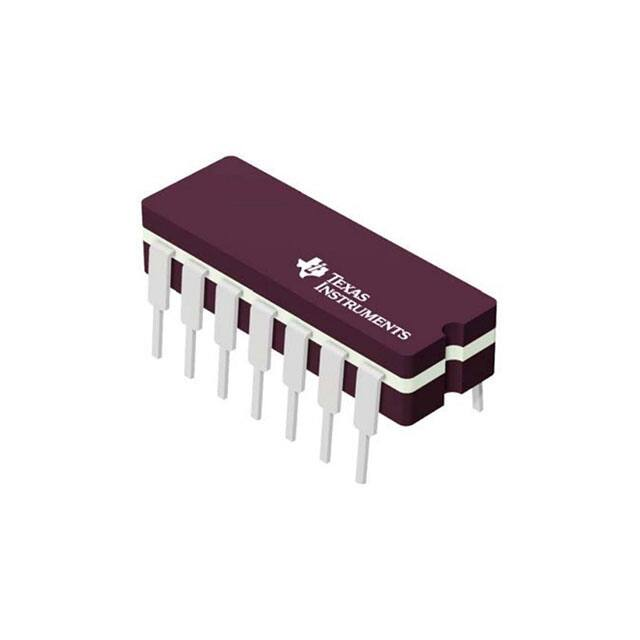

SN54HCT74, SN74HCT74 SCLS169G – DECEMBER 1982 – REVISED OCTOBER 2022 SNx4HCT74 Dual D-Type Positive-Edge-Triggered Flip-Flips With Clear and Preset 1 Features 2 Description • • • • • • • The ’HCT74 devices contain two independent D-type positive-edge-triggered flip-flops. A low level at the preset (PRE) or clear (CLR) inputs sets or resets the outputs, regardless of the levels of the other inputs. When PRE and CLR are inactive (high), data at the data (D) input meeting the setup time requirements are transferred to the outputs on the positive-going edge of the clock (CLK) pulse. Clock triggering occurs at a voltage level and is not directly related to the rise time of CLK. Following the hold-time interval, data at the D input may be changed without affecting the levels at the outputs. Operating voltage range of 4.5 V to 5.5 V Outputs can drive up to 10 LSTTL loads Low power consumption, 40-μA max ICC Typical tpd = 17 ns ±4-mA output drive at 5 V Low input current of 1 μA max Inputs are TTL-voltage compatible Device Information (1) PART NUMBER PACKAGE BODY SIZE (NOM) SN74HCT74D SOIC (14) 8.65 mm × 3.90 mm SN74HCT74DB SSOP (14) 6.20 mm × 5.30 mm SN74HCT74N PDIP (14) 19.31 mm × 6.35 mm SN74HCT74NS SO (14) 10.20 mm × 5.30 mm SN74HCT74PW TSSOP (14) 5.00 mm × 4.40 mm SNJ54HCT74FK LCCC (20) 8.89 mm × 8.45 mm SNJ54HCT74W CFP (14) 9.21 mm × 6.29 mm SNJ54HCT74J CDIP (14) 19.55 mm × 6.71 mm (1) For all available packages, see the orderable addendum at the end of the data sheet. Functional Block Diagram An IMPORTANT NOTICE at the end of this data sheet addresses availability, warranty, changes, use in safety-critical applications, intellectual property matters and other important disclaimers. PRODUCTION DATA. SN54HCT74, SN74HCT74 www.ti.com SCLS169G – DECEMBER 1982 – REVISED OCTOBER 2022 Table of Contents 1 Features............................................................................1 2 Description.......................................................................1 3 Revision History.............................................................. 2 4 Pin Configuration and Functions...................................3 5 Specifications.................................................................. 4 5.1 Absolute Maximum Ratings ....................................... 4 5.2 Recommended Operating Conditions(1) .................... 4 5.3 Thermal Information....................................................4 5.4 Electrical Characteristics.............................................5 5.5 Timing Requirements.................................................. 5 5.6 Switching Characteristics ...........................................6 5.7 Operating Characteristics........................................... 6 6 Parameter Measurement Information............................ 7 7 Detailed Description........................................................8 7.1 Overview..................................................................... 8 7.2 Functional Block Diagram........................................... 8 7.3 Device Functional Modes............................................8 8 Power Supply Recommendations..................................9 9 Layout...............................................................................9 9.1 Layout Guidelines....................................................... 9 10 Device and Documentation Support..........................10 10.1 Receiving Notification of Documentation Updates..10 10.2 Support Resources................................................. 10 10.3 Trademarks............................................................. 10 10.4 Electrostatic Discharge Caution..............................10 10.5 Glossary..................................................................10 11 Mechanical, Packaging, and Orderable Information.................................................................... 10 3 Revision History NOTE: Page numbers for previous revisions may differ from page numbers in the current version. Changes from Revision F (February 2022) to Revision G (October 2022) Page • Increased RθJA for packages: D (86 to 138.7); N (80 to 103.8); NS (76 to 129.3); PW (113 to 157.6)............. 4 2 Submit Document Feedback Copyright © 2022 Texas Instruments Incorporated Product Folder Links: SN54HCT74 SN74HCT74 SN54HCT74, SN74HCT74 www.ti.com SCLS169G – DECEMBER 1982 – REVISED OCTOBER 2022 4 Pin Configuration and Functions J, W, D, DB, N, NS, or PW package 14-Pin CDIP, CFP, SOIC, SSOP, PDIP, SO, or TSSOP Top View NC - No internal connection FK Package 20-Pin LCCC Top View Submit Document Feedback Copyright © 2022 Texas Instruments Incorporated Product Folder Links: SN54HCT74 SN74HCT74 3 SN54HCT74, SN74HCT74 www.ti.com SCLS169G – DECEMBER 1982 – REVISED OCTOBER 2022 5 Specifications 5.1 Absolute Maximum Ratings over operating free-air temperature range (unless otherwise noted)(1) VCC Supply voltage range current(2) MIN MAX –0.5 7 UNIT V IIK Input clamp VI < 0 or VI > VCC ± 20 mA IOK Output clamp current(2) VO < 0 or VO > VCC ± 20 mA IO Continuous output current VO = 0 to VCC ± 25 mA ± 50 mA 150 ℃ 150 ℃ Continuous current through VCC or GND TJ Junction temperature Tstg Storage temperature range (1) (2) –65 Stresses beyond those listed under “absolute maximum ratings” may cause permanent damage to the device. These are stress ratings only, and functional operation of the device at these or any other conditions beyond those indicated under “recommended operating conditions" is not implied. Exposure to absolute-maximum-rated conditions for extended periods may affect device reliability. The input and output voltage ratings may be exceeded if the input and output current ratings are observed. 5.2 Recommended Operating Conditions(1) SN54HCT74(2) SN74HCT74 MIN NOM MAX MIN NOM MAX 4.5 5 5.5 4.5 5 5.5 UNIT VCC Supply voltage VIH High-level input voltage Vcc = 4.5 V to 5.5 V VIL Low-level input voltage Vcc = 4.5 V to 5.5 V 0.8 V VI Input voltage 0 VCC 0 VCC V VO Output voltage 0 VCC 0 VCC V Δt/Δv Input transition rise/fall time 500 ns TA Operating free-air temperature 85 °C (1) (2) 2 V 2 V 0.8 500 −55 125 −40 All unused inputs of the device must be held at VCC or GND to ensure proper device operation. Refer to the TI application report, Implications of Slow or Floating CMOS Inputs, literature number SCBA004. SN54HCT74 is in product preview. 5.3 Thermal Information THERMAL METRIC DB (SSOP) N (PDIP) NS (SO) PW (TSSOP) 14 PINS 14 PINS 14 PINS 14 PINS 14 PINS UNIT RθJA Junction-to-ambient thermal (1) resistance 138.7 109.8 61.1 88.4 114.7 °C/W RθJC (top) Junction-to-case (top) thermal resistance 93.8 54.7 48.9 46 44.3 °C/W RθJB Junction-to-board thermal resistance 94.7 58.6 40.9 48.9 57.6 °C/W ΨJT Junction-to-top characterization parameter 49.1 15.5 28.5 13.8 4.8 °C/W ΨJB Junction-to-board characterization parameter 94.3 58 40.6 48.4 57 °C/W RθJC (bot) Junction-to-case (bottom) thermal resistance N/A N/A N/A N/A N/A °C/W (1) 4 D (SOIC) For more information about traditional and new thermal metrics, see the Semiconductor and IC package thermal metrics application report. Submit Document Feedback Copyright © 2022 Texas Instruments Incorporated Product Folder Links: SN54HCT74 SN74HCT74 SN54HCT74, SN74HCT74 www.ti.com SCLS169G – DECEMBER 1982 – REVISED OCTOBER 2022 5.4 Electrical Characteristics over recommended operating free-air temperature range (unless otherwise noted) PARAMETER TEST CONDITIONS VOH VI = VIH or VIL VOL VI = VIH or VIL II VI = VCC or 0 ICC Vi = VCC or 0, ΔICC (1) IOH = −20 μA IOL = 20 μA 4.5 V IOL = 4 mA 5.5 V IO = 0 MAX MIN SN74HCT74 MIN TYP 4.4 4.499 4.4 4.4 3.98 4.3 3.7 3.84 MAX MIN MAX UNIT V 0.001 0.1 0.1 0.1 0.17 0.26 0.4 0.33 ±0.1 ±100 ±1000 ±1000 nA 4 80 40 μA 1.4 2.4 3 2.9 mA 3 10 10 10 pF 5.5 V One input at 0.5 V or 2.4 V, Other inputs at 0 or VCC Ci (1) (2) 4.5 V IOH = −4 mA SN54HCT74(2) TA = 25°C VCC 5.5 V 4.5 V to 5.5 V V This is the increase in supply current for each input that is at one of the specified TTL voltage levels, rather than 0 V or VCC. SN54HCT74 is in product preview. 5.5 Timing Requirements overrecommended operating free-air temperature range (unless otherwise noted) VCC fclock Clock frequency PRE or CLR low tw Pulse duration CLK high or low Data tsu Setup time before CLK↑ PRE or CLR inactive th Hold time, data after CLK↑ (1) SN54HCT74 is in product preview. SN54HCT74(1) TA = 25°C MIN MAX MIN MAX SN74HCT74 MIN MAX 4.5 V 27 18 22 5.5 V 30 20 24 4.5 V 16 24 20 5.5 V 14 21 18 4.5 V 18 27 23 5.5 V 16 24 21 4.5 V 12 18 15 5.5 V 11 16 14 4.5 V 0 0 0 5.5 V 0 0 0 4.5 V 0 0 0 5.5 V 0 0 0 UNIT MHz ns ns ns Submit Document Feedback Copyright © 2022 Texas Instruments Incorporated Product Folder Links: SN54HCT74 SN74HCT74 5 SN54HCT74, SN74HCT74 www.ti.com SCLS169G – DECEMBER 1982 – REVISED OCTOBER 2022 5.6 Switching Characteristics over recommended operating free-air temperature range, CL = 50 pF (unless otherwise noted) (see Parameter Measurement Information) PARAMETER FROM (INPUT) TO (OUTPUT) VCC fmax PRE or CLR Q or Q CLK Q or Q tpd tt (1) Q or Q SN54HCT74(1) TA = 25°C MAX MIN MAX SN74HCT74 MIN TYP MIN 4.5 V 27 40 18 22 5.5 V 30 46 20 24 MAX UNIT MHz 4.5 V 21 35 53 44 5.5 V 17 31 48 40 4.5 V 20 28 42 35 5.5 V 18 25 38 31 4.5 V 8 15 22 19 5.5 V 7 14 20 17 ns ns SN54HCT74 is in product preview. 5.7 Operating Characteristics TA = 25℃ Cpd 6 PARAMETER TEST CONDITIONS Power dissipation capacitance per flip-flop No load Submit Document Feedback TYP 35 UNIT pF Copyright © 2022 Texas Instruments Incorporated Product Folder Links: SN54HCT74 SN74HCT74 SN54HCT74, SN74HCT74 www.ti.com SCLS169G – DECEMBER 1982 – REVISED OCTOBER 2022 6 Parameter Measurement Information Phase relationships between waveforms were chosen arbitrarily. All input pulses are supplied by generators having the following characteristics: PRR ≤ 1 MHz, ZO = 50 Ω, tt < 6 ns. For clock inputs, fmax is measured when the input duty cycle is 50%. The outputs are measured one at a time with one input transition per measurement. Test Point From Output Under Test CL(1) (1) CL includes probe and test-fixture capacitance. Figure 6-1. Load Circuit for Push-Pull Outputs tw 3V Clock Input 3V Input 1.3V 1.3V 1.3V 0V 0V tsu Figure 6-2. Voltage Waveforms, TTL-Compatible CMOS Inputs Pulse Duration th 3V Data Input 1.3V 1.3V 0V Figure 6-3. Voltage Waveforms, TTL-Compatible CMOS Inputs Setup and Hold Times 3V Input 1.3V 1.3V 0V tPLH(1) tPHL(1) VOH Output Waveform 1 50% 50% VOL tPHL(1) tPLH (1) VOH Output Waveform 2 50% 50% VOL (1) The greater between tPLH and tPHL is the same as tpd. Figure 6-4. Voltage Waveforms, Propagation Delays for TTL-Compatible Inputs Submit Document Feedback Copyright © 2022 Texas Instruments Incorporated Product Folder Links: SN54HCT74 SN74HCT74 7 SN54HCT74, SN74HCT74 www.ti.com SCLS169G – DECEMBER 1982 – REVISED OCTOBER 2022 7 Detailed Description 7.1 Overview The ’HCT74 devices contain two independent D-type positive-edge-triggered flip-flops. A low level at the preset (PRE) or clear (CLR) inputs sets or resets the outputs, regardless of the levels of the other inputs. When PRE and CLR are inactive (high), data at the data (D) input meeting the setup time requirements are transferred to the outputs on the positive-going edge of the clock (CLK) pulse. Clock triggering occurs at a voltage level and is not directly related to the rise time of CLK. Following the hold-time interval, data at the D input may be changed without affecting the levels at the outputs. 7.2 Functional Block Diagram 7.3 Device Functional Modes Table 7-1. Function Table INPUTS (1) 8 OUTPUT PRE CLR CLK D Q Q L H X X H L H L X X L H L L X X H(1) H(1) H H ↑ H H L H H ↑ L L H H H L X Q0 Q0 This configuration is nonstable; that is, it does not persist when PRE or CLR returns to its inactive (high) level. Submit Document Feedback Copyright © 2022 Texas Instruments Incorporated Product Folder Links: SN54HCT74 SN74HCT74 SN54HCT74, SN74HCT74 www.ti.com SCLS169G – DECEMBER 1982 – REVISED OCTOBER 2022 8 Power Supply Recommendations The power supply can be any voltage between the minimum and maximum supply voltage rating located in the Recommended Operating Conditions. Each VCC terminal should have a good bypass capacitor to prevent power disturbance. A 0.1-μF capacitor is recommended for this device. It is acceptable to parallel multiple bypass capacitors to reject different frequencies of noise. The 0.1-μF and 1-μF capacitors are commonly used in parallel. The bypass capacitor should be installed as close to the power terminal as possible for best results. 9 Layout 9.1 Layout Guidelines When using multiple-input and multiple-channel logic devices, inputs must not ever be left floating. In many cases, functions or parts of functions of digital logic devices are unused; for example, when only two inputs of a triple-input AND gate are used or only 3 of the 4 buffer gates are used. Such unused input pins must not be left unconnected because the undefined voltages at the outside connections result in undefined operational states. All unused inputs of digital logic devices must be connected to a logic high or logic low voltage, as defined by the input voltage specifications, to prevent them from floating. The logic level that must be applied to any particular unused input depends on the function of the device. Generally, the inputs are tied to GND or VCC, whichever makes more sense for the logic function or is more convenient. Submit Document Feedback Copyright © 2022 Texas Instruments Incorporated Product Folder Links: SN54HCT74 SN74HCT74 9 SN54HCT74, SN74HCT74 www.ti.com SCLS169G – DECEMBER 1982 – REVISED OCTOBER 2022 10 Device and Documentation Support TI offers an extensive line of development tools. Tools and software to evaluate the performance of the device, generate code, and develop solutions are listed below. 10.1 Receiving Notification of Documentation Updates To receive notification of documentation updates, navigate to the device product folder on ti.com. Click on Subscribe to updates to register and receive a weekly digest of any product information that has changed. For change details, review the revision history included in any revised document. 10.2 Support Resources TI E2E™ support forums are an engineer's go-to source for fast, verified answers and design help — straight from the experts. Search existing answers or ask your own question to get the quick design help you need. Linked content is provided "AS IS" by the respective contributors. They do not constitute TI specifications and do not necessarily reflect TI's views; see TI's Terms of Use. 10.3 Trademarks TI E2E™ is a trademark of Texas Instruments. All trademarks are the property of their respective owners. 10.4 Electrostatic Discharge Caution This integrated circuit can be damaged by ESD. Texas Instruments recommends that all integrated circuits be handled with appropriate precautions. Failure to observe proper handling and installation procedures can cause damage. ESD damage can range from subtle performance degradation to complete device failure. Precision integrated circuits may be more susceptible to damage because very small parametric changes could cause the device not to meet its published specifications. 10.5 Glossary TI Glossary This glossary lists and explains terms, acronyms, and definitions. 11 Mechanical, Packaging, and Orderable Information The following pages include mechanical, packaging, and orderable information. This information is the most current data available for the designated devices. This data is subject to change without notice and revision of this document. For browser-based versions of this data sheet, refer to the left-hand navigation. 10 Submit Document Feedback Copyright © 2022 Texas Instruments Incorporated Product Folder Links: SN54HCT74 SN74HCT74 PACKAGE OPTION ADDENDUM www.ti.com 21-Oct-2022 PACKAGING INFORMATION Orderable Device Status (1) Package Type Package Pins Package Drawing Qty Eco Plan (2) Lead finish/ Ball material MSL Peak Temp Op Temp (°C) Device Marking (3) Samples (4/5) (6) JM38510/65352B2A ACTIVE LCCC FK 20 1 Non-RoHS & Green SNPB N / A for Pkg Type -55 to 125 JM38510/ 65352B2A Samples JM38510/65352BCA ACTIVE CDIP J 14 1 Non-RoHS & Green SNPB N / A for Pkg Type -55 to 125 JM38510/ 65352BCA Samples JM38510/65352BDA ACTIVE CFP W 14 1 Non-RoHS & Green SNPB N / A for Pkg Type -55 to 125 JM38510/ 65352BDA Samples M38510/65352B2A ACTIVE LCCC FK 20 1 Non-RoHS & Green SNPB N / A for Pkg Type -55 to 125 JM38510/ 65352B2A Samples M38510/65352BCA ACTIVE CDIP J 14 1 Non-RoHS & Green SNPB N / A for Pkg Type -55 to 125 JM38510/ 65352BCA Samples M38510/65352BDA ACTIVE CFP W 14 1 Non-RoHS & Green SNPB N / A for Pkg Type -55 to 125 JM38510/ 65352BDA Samples SN74HCT74D ACTIVE SOIC D 14 50 RoHS & Green NIPDAU Level-1-260C-UNLIM -40 to 85 HCT74 Samples SN74HCT74DBR ACTIVE SSOP DB 14 2000 RoHS & Green NIPDAU Level-1-260C-UNLIM -40 to 85 HT74 Samples SN74HCT74DR ACTIVE SOIC D 14 2500 RoHS & Green NIPDAU | SN Level-1-260C-UNLIM -40 to 85 HCT74 Samples SN74HCT74DRE4 ACTIVE SOIC D 14 2500 RoHS & Green NIPDAU Level-1-260C-UNLIM -40 to 85 HCT74 Samples SN74HCT74DT ACTIVE SOIC D 14 250 RoHS & Green NIPDAU Level-1-260C-UNLIM -40 to 85 HCT74 Samples SN74HCT74N ACTIVE PDIP N 14 25 RoHS & Green NIPDAU N / A for Pkg Type -40 to 85 SN74HCT74N Samples SN74HCT74NE4 ACTIVE PDIP N 14 25 RoHS & Green NIPDAU N / A for Pkg Type -40 to 85 SN74HCT74N Samples SN74HCT74NSR ACTIVE SO NS 14 2000 RoHS & Green NIPDAU Level-1-260C-UNLIM -40 to 85 HCT74 Samples SN74HCT74PW ACTIVE TSSOP PW 14 90 RoHS & Green NIPDAU Level-1-260C-UNLIM -40 to 85 HT74 Samples SN74HCT74PWR ACTIVE TSSOP PW 14 2000 RoHS & Green NIPDAU | SN Level-1-260C-UNLIM -40 to 85 HT74 Samples SN74HCT74PWT ACTIVE TSSOP PW 14 250 RoHS & Green NIPDAU Level-1-260C-UNLIM -40 to 85 HT74 Samples (1) The marketing status values are defined as follows: ACTIVE: Product device recommended for new designs. LIFEBUY: TI has announced that the device will be discontinued, and a lifetime-buy period is in effect. Addendum-Page 1 PACKAGE OPTION ADDENDUM www.ti.com 21-Oct-2022 NRND: Not recommended for new designs. Device is in production to support existing customers, but TI does not recommend using this part in a new design. PREVIEW: Device has been announced but is not in production. Samples may or may not be available. OBSOLETE: TI has discontinued the production of the device. (2) RoHS: TI defines "RoHS" to mean semiconductor products that are compliant with the current EU RoHS requirements for all 10 RoHS substances, including the requirement that RoHS substance do not exceed 0.1% by weight in homogeneous materials. Where designed to be soldered at high temperatures, "RoHS" products are suitable for use in specified lead-free processes. TI may reference these types of products as "Pb-Free". RoHS Exempt: TI defines "RoHS Exempt" to mean products that contain lead but are compliant with EU RoHS pursuant to a specific EU RoHS exemption. Green: TI defines "Green" to mean the content of Chlorine (Cl) and Bromine (Br) based flame retardants meet JS709B low halogen requirements of
