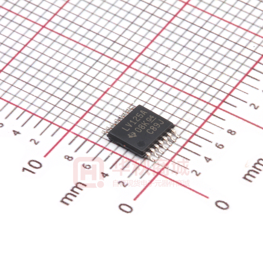

    SN74LV125A 具有三态输出的 4 路总线缓冲器门
SN74LV125APWR 数据手册
SN74LV125A SCES124O – DECEMBER 1997 – REVISED MAY 2022 SN74LV125A Quadruple Bus Buffer Gates With 3-State Outputs 1 Features 2 Applications • • • • • • • • • • • • • • 2-V to 5.5-V VCC Operation Max tpd of 6 ns at 5 V Typical VOLP (Output Ground Bounce) < 0.8 V at VCC = 3.3 V, TA = 25°C Typical VOHV (Output VOH Undershoot) > 2.3 V at VCC = 3.3 V, TA = 25°C Support Mixed-Mode Voltage Operation on All Ports Ioff Supports Partial-Power-Down Mode Operation Latch-Up Performance Exceeds 250 mA Per JESD 17 ESD Protection Exceeds JESD 22 – 4000-V Human-Body Model – 200-V Machine Model – 2000-V Charged-Device Model Flow Meters Solid State Drives (SSDs): Enterprise Power Over Ethernet (PoE) Programmable Logic Controllers Motor Drives and Controls Electronic Points of Sale 3 Description The SN74LV125A quadruple bus buffer gate is designed for 2-V to 5.5-V VCC operation. Device Information PART NUMBER(1) SN74LV125A (1) 1Y DGV (TVSOP, 14) 3.60 mm x 4.40 mm D (SOIC, 14) 8.65 mm × 3.90 mm NS (SO, 14) 10.20 mm x 5.30 mm DB (SSOP, 14) 6.20 mm x 5.30 mm PW (TSSOP, 14) 5.00 mm x 4.40 mm For all available packages, see the orderable addendum at the end of the data sheet. 3A 3Y 4OE 2OE 2A BODY SIZE (NOM) 3OE 1OE 1A PACKAGE 2Y 4A 4Y Simplified Schematic An IMPORTANT NOTICE at the end of this data sheet addresses availability, warranty, changes, use in safety-critical applications, intellectual property matters and other important disclaimers. PRODUCTION DATA. SN74LV125A www.ti.com SCES124O – DECEMBER 1997 – REVISED MAY 2022 Table of Contents 1 Features............................................................................1 2 Applications..................................................................... 1 3 Description.......................................................................1 4 Revision History.............................................................. 2 5 Pin Configuration and Functions...................................3 Pin Functions.................................................................... 3 6 Specifications.................................................................. 4 6.1 Absolute Maximum Ratings........................................ 4 6.2 ESD Ratings............................................................... 4 6.3 Recommended Operating Conditions.........................5 6.4 Thermal Information....................................................5 6.5 Electrical Characteristics.............................................6 6.6 Switching Characteristics, VCC = 2.5 V ± 0.2 V...........6 6.7 Switching Characteristics, VCC = 3.3 V ± 0.3 V...........6 6.8 Switching Characteristics, VCC = 5 V ± 0.5 V..............7 6.9 Noise Characteristics.................................................. 7 6.10 Operating Characteristics......................................... 7 6.11 Typical Characteristics.............................................. 7 7 Parameter Measurement Information............................ 8 8 Detailed Description........................................................9 8.1 Overview..................................................................... 9 8.2 Functional Block Diagram........................................... 9 8.3 Feature Description.....................................................9 8.4 Device Functional Modes............................................9 9 Application and Implementation.................................. 10 9.1 Application Information............................................. 10 9.2 Typical Application.................................................... 10 10 Power Supply Recommendations..............................11 11 Layout........................................................................... 12 11.1 Layout Guidelines................................................... 12 11.2 Layout Example...................................................... 12 12 Device and Documentation Support..........................12 12.1 Related Links.......................................................... 12 12.2 Trademarks............................................................. 12 12.3 Electrostatic Discharge Caution..............................12 12.4 Glossary..................................................................12 13 Mechanical, Packaging, and Orderable Information.................................................................... 12 4 Revision History Changes from Revision N (January 2015) to Revision O (May 2022) Page • Updated the numbering, formatting, tables, figures, and cross-references throughout the document to reflect modern data sheet standards............................................................................................................................. 4 Changes from Revision M (December 2014) to Revision N (January 2015) Page • Added Tj spec to Absolute Maximum Ratings table........................................................................................... 4 • Added text to Overview section ......................................................................................................................... 9 Changes from Revision L (April 2005) to Revision M (December 2014) Page • Added Applications, Device Information table, Pin Functions table, ESD Ratings table, Thermal Information table, Typical Characteristics, Feature Description section, Device Functional Modes, Application and Implementation section, Power Supply Recommendations section, Layout section, Device and Documentation Support section, and Mechanical, Packaging, and Orderable Information section................... 1 • Deleted Ordering Information table.....................................................................................................................1 • Changed MAX operating temperature to 125°C in Recommended Operating Conditions table. ...................... 5 2 Submit Document Feedback Copyright © 2022 Texas Instruments Incorporated Product Folder Links: SN74LV125A SN74LV125A www.ti.com SCES124O – DECEMBER 1997 – REVISED MAY 2022 5 Pin Configuration and Functions 2 13 3 12 4 11 5 10 6 9 7 8 VCC 4OE 4A 4Y 3OE 3A 3Y 1A 1Y 2OE 2A 2Y VCC 14 1 14 2 13 4OE 3 12 4A 4Y 4 11 5 10 3OE 9 3A 6 7 8 3Y 1 GND 1OE 1A 1Y 2OE 2A 2Y GND SN74LV125A . . . RGY PACKAGE (TOP VIEW) 1OE SN74LV125A . . . D, DB, DGV, N, NS, OR PW PACKAGE (TOP VIEW) Pin Functions PIN NO. NAME 1 1OE 2 3 TYPE(1) DESCRIPTION I Output Enable 1, Active Low 1A I 1A Input 1Y O 1Y Output 4 2OE I Output Enable 2, Active Low 5 2A I 2A Input 6 2Y O 2Y Output 7 GND — Ground Pin 8 3Y O 3Y Output 9 3A I 3A Input 10 3OE I Output Enable 3, Active Low 11 4Y O 4Y Output 12 4A I 4A Input 13 4OE I Output Enable 4, Active Low 14 VCC — (1) Power Pin Signal Types: I = Input, O = Output, I/O = Input or Output. Submit Document Feedback Copyright © 2022 Texas Instruments Incorporated Product Folder Links: SN74LV125A 3 SN74LV125A www.ti.com SCES124O – DECEMBER 1997 – REVISED MAY 2022 6 Specifications 6.1 Absolute Maximum Ratings over operating free-air temperature range (unless otherwise noted) VCC MIN(1) MAX –0.5 7 V –0.5 7 V –0.5 7 V –0.5 VCC + 0.5 Supply voltage range(2) VI Input voltage VO Voltage range applied to any output in the high-impedance or power-off state(2) range(2) (3) UNIT VO Output voltage IIK Input clamp current VI < 0 –20 mA V IOK Output clamp current VO < 0 –50 mA IO Continuous output current VO = 0 to VCC ±35 mA Continuous current through VCC or GND ±70 mA Tj Junction temperature 150 °C Tstg Storage temperature 150 °C (1) (2) (3) –65 Stresses beyond those listed under Absolute Maximum Ratings may cause permanent damage to the device. These are stress ratings only, and functional operation of the device at these or any other conditions beyond those indicated under Section 6.3 is not implied. Exposure to absolute-maximum-rated conditions for extended periods may affect device reliability. The input and output negative-voltage ratings may be exceeded if the input and output current ratings are observed. This value is limited to 5.5-V maximum. 6.2 ESD Ratings MAX V(ESD) (1) (2) 4 Electrostatic discharge Human body model (HBM), per ANSI/ESDA/JEDEC JS-001, all pins(1) ±4000 Charged device model (CDM), per JEDEC specification JESD22-C101, all pins(2) ±2000 Machine Model (MM) ±200 UNIT V JEDEC document JEP155 states that 500-V HBM allows safe manufacturing with a standard ESD control process. JEDEC document JEP157 states that 250-V CDM allows safe manufacturing with a standard ESD control process. Submit Document Feedback Copyright © 2022 Texas Instruments Incorporated Product Folder Links: SN74LV125A SN74LV125A www.ti.com SCES124O – DECEMBER 1997 – REVISED MAY 2022 6.3 Recommended Operating Conditions over operating free-air temperature range (unless otherwise noted)(1) SN74LV125A VCC MIN MAX 2 5.5 Supply voltage VCC = 2 V VIH High-level input voltage Low-level input voltage VI Input voltage VO Output voltage VCC × 0.7 VCC = 3 V to 3.6 V VCC × 0.7 VCC = 4.5 V to 5.5 V VCC × 0.7 V 0.5 VCC = 2.3 V to 2.7 V VCC × 0.3 VCC = 3 V to 3.6 V VCC × 0.3 VCC = 4.5 V to 5.5 V High-level output current 5.5 High or low state 0 VCC 3-state 0 5.5 –50 VCC = 2.3 V to 2.7 V VCC = 3 V to 3.6 V ∆t/∆v Input transition rise or fall rate TA Operating free-air temperature –8 50 VCC = 2.3 V to 2.7 V µA mA µA 2 VCC = 3 V to 3.6 V 8 VCC = 4.5 V to 5.5 V 16 VCC = 2.3 V to 2.7 V 200 VCC = 3 V to 3.6 V 100 VCC = 4.5 V to 5.5 V (1) V –16 VCC = 2 V Low-level output current V –2 VCC = 4.5 V to 5.5 V IOL V VCC × 0.3 0 VCC = 2 V IOH V 1.5 VCC = 2.3 V to 2.7 V VCC = 2 V VIL UNIT mA ns/V 20 –40 125 °C All unused inputs of the device must be held at VCC or GND to ensure proper device operation. Refer to the TI application report, Implications of Slow or Floating CMOS Inputs (SCBA004). 6.4 Thermal Information SN74LV125A THERMAL METRIC(1) D DB DGV N NS PW RGY UNIT 14 PINS RθJA Junction-to-ambient thermal resistance 92.7 105.0 127.6 89.2 89.6 119.8 55.0 RθJC(top) Junction-to-case (top) thermal resistance 54.1 57.5 50.7 47.0 47.2 48.6 67.4 RθJB Junction-to-board thermal resistance 47.0 52.3 60.5 47.9 48.4 61.5 31.0 ψJT Junction-to-top characterization parameter 18.9 19.1 6.1 14.1 14.0 5.7 2.6 ψJB Junction-to-board characterization parameter 46.7 51.8 59.8 47.5 48.1 61.0 31.1 RθJC(bot) Junction-to-case (bottom) thermal resistance N/A N/A N/A N/A N/A N/A 11.6 (1) °C/W For more information about traditional and new thermal metrics, see the IC Package Thermal Metrics application report (SPRA953). Submit Document Feedback Copyright © 2022 Texas Instruments Incorporated Product Folder Links: SN74LV125A 5 SN74LV125A www.ti.com SCES124O – DECEMBER 1997 – REVISED MAY 2022 6.5 Electrical Characteristics over recommended operating free-air temperature range (unless otherwise noted) PARAMETER TEST CONDITIONS TA = 25°C VCC MIN –40°C to 85°C TYP MAX MIN MAX MAX UNIT 2 V to 5.5 V IOH = –2 mA 2.3 V 2 2 2 IOH = –8 mA 3V 2.48 2.48 2.48 IOH = –16 mA 4.5 V 3.8 3.8 3.8 IOL = 50 µA 2 V to 5.5 V 0.1 0.1 0.1 IOL = 2 mA 2.3 V 0.4 0.4 0.4 IOL = 8 mA 3V 0.44 0.44 0.44 IOL = 16 mA 4.5 V 0.55 0.55 0.55 II VI = 5.5 V or GND 0 to 5.5 V ±1 ±1 ±1 µA VOL IOZ VO = VCC or GND ICC VI = VCC or GND, Ioff VI or VO = 0 to 5.5 V Ci IO = 0 VI = VCC or GND VCC – 0.1 MIN IOH = –50 µA VOH VCC – 0.1 –40°C to 125°C VCC – 0.1 V V 5.5 V ±5 ±5 ±5 µA 5.5 V 20 20 20 µA 5 5 5 µA 0 3.3 V 1.6 5V 1.6 pF 6.6 Switching Characteristics, VCC = 2.5 V ± 0.2 V over recommended operating free-air temperature range (unless otherwise noted) (see Figure 7-1) PARAMETER FROM (INPUT) TO (OUTPUT) tpd A ten OE LOAD CAPACITANCE TA = 25°C MIN –40°C to 85°C MAX MIN MAX MIN MAX Y 6.8(1) 13(1) 1 15.5 1 17 Y 7(1) 13(1) 1 15.5 1 17 14.7(1) CL = 15 pF tdis OE Y 5.1(1) 1 17 1 18 tpd A Y 8.7 16.5 1 18.5 1 20 ten OE Y 8.8 16.5 1 18.5 1 20 tdis OE Y 7.3 18.2 1 20.5 1 21.5 CL = 50 pF tsk(o) (1) –40°C to 125°C TYP 2 2 UNIT ns ns 2 On products compliant to MIL-PRF-38535, this parameter is not production tested. 6.7 Switching Characteristics, VCC = 3.3 V ± 0.3 V over recommended operating free-air temperature range(unless otherwise noted) (see Figure 7-1) PARAMETER FROM (INPUT) TO (OUTPUT) tpd A Y ten OE Y LOAD CAPACITANCE CL = 15 pF TA = 25°C MIN MIN MAX MIN 4.8(1) 8(1) 1 9.5 1 11 4.8(1) 8(1) 1 9.5 1 10.5 9.7(1) 1 11.5 1 12.5 11.5 1 13 1 14.5 6.2 11.5 1 13 1 14 5.5 13.2 1 15 1 16 tdis OE Y tpd A Y 6.1 ten OE Y tdis OE Y tsk(o) (1) 6 –40°C to 125°C MAX 4.1(1) CL = 50 pF –40°C to 85°C TYP 1.5 1.5 MAX UNIT ns ns 1.5 On products compliant to MIL-PRF-38535, this parameter is not production tested. Submit Document Feedback Copyright © 2022 Texas Instruments Incorporated Product Folder Links: SN74LV125A SN74LV125A www.ti.com SCES124O – DECEMBER 1997 – REVISED MAY 2022 6.8 Switching Characteristics, VCC = 5 V ± 0.5 V over recommended operating free-air temperature range (unless otherwise noted) (see Figure 7-1) PARAMETER FROM (INPUT) TO (OUTPUT) tpd A LOAD CAPACITANCE TA = 25°C MIN –40°C to 85°C TYP MAX MIN MAX MIN MAX Y 3.4(1) 5.5(1) 1 6.5 1 7.5 3.4(1) 5.1(1) ten OE Y 1 6 1 7 tdis OE Y 3.2(1) 6.8(1) 1 8 1 9 tpd A Y 4.3 7.5 1 8.5 1 9.5 ten OE Y 4.4 7.1 1 8 1 9 tdis OE Y 4 8.8 1 10 1 11 CL = 15 pF CL = 50 pF tsk(o) (1) –40°C to 125°C 1 1 UNIT ns ns 1 On products compliant to MIL-PRF-38535, this parameter is not production tested. 6.9 Noise Characteristics VCC = 3.3 V, CL = 50 pF, TA = 25°C SN74LV125A PARAMETER(1) MIN TYP MAX UNIT VOL(P) Quiet output, maximum dynamic VOL 0.4 0.8 V VOL(V) Quiet output, minimum dynamic VOL –0.3 –0.8 V VOH(V) Quiet output, minimum dynamic VOH 3 VIH(D) High-level dynamic input voltage VIL(D) Low-level dynamic input voltage (1) V 2.31 V 0.99 V Characteristics are for surface-mount packages only. 6.10 Operating Characteristics TA = 25°C PARAMETER Cpd Power dissipation capacitance TEST CONDITIONS Outputs enabled CL = 50 pF, f = 10 MHz VCC TYP 3.3 V 15.5 5V 17.6 UNIT pF 6.11 Typical Characteristics 7 8 6 7 6 TPD (ns) TPD (ns) 5 4 3 2 5 4 3 2 1 1 TPD in ns 0 -100 TPD in ns 0 -50 0 50 Temperature (qC) 100 150 0 1 D001 Figure 6-1. TPD vs Temperature 2 3 VCC 4 5 6 D002 Figure 6-2. TPD vs VCC at 25°C Submit Document Feedback Copyright © 2022 Texas Instruments Incorporated Product Folder Links: SN74LV125A 7 SN74LV125A www.ti.com SCES124O – DECEMBER 1997 – REVISED MAY 2022 7 Parameter Measurement Information 7.1 RL = 1 kΩ From Output Under Test Test Point From Output Under Test VCC Open S1 TEST GND S1 tPLH/tPHL tPLZ/tPZL tPHZ/tPZH Open Drain CL (see Note A) CL (see Note A) Open VCC GND VCC LOAD CIRCUIT FOR 3-STATE AND OPEN-DRAIN OUTPUTS LOAD CIRCUIT FOR TOTEM-POLE OUTPUTS VCC 50% VCC Timing Input 0V tw tsu VCC 50% VCC 50% VCC Input th VCC 50% VCC Data Input 50% VCC 0V 0V VOLTAGE WAVEFORMS SETUP AND HOLD TIMES VOLTAGE WAVEFORMS PULSE DURATION VCC 50% VCC Input 50% VCC tPLH In-Phase Output tPHL VOH 50% VCC VOL VOH 50% VCC VOL tPLZ ≈VCC 50% VCC tPZH VOL + 0.3 V VOL tPHZ Output Waveform 2 S1 at GND (see Note B) VOLTAGE WAVEFORMS PROPAGATION DELAY TIMES INVERTING AND NONINVERTING OUTPUTS 50% VCC 0V Output Waveform 1 S1 at VCC (see Note B) tPLH 50% VCC 50% VCC tPZL tPHL 50% VCC Out-of-Phase Output 0V VCC Output Control 50% VCC VOH − 0.3 V VOH ≈0 V VOLTAGE WAVEFORMS ENABLE AND DISABLE TIMES LOW- AND HIGH-LEVEL ENABLING NOTES: A. CL includes probe and jig capacitance. B. Waveform 1 is for an output with internal conditions such that the output is low, except when disabled by the output control. Waveform 2 is for an output with internal conditions such that the output is high, except when disabled by the output control. C. All input pulses are supplied by generators having the following characteristics: PRR ≤ 1 MHz, ZO = 50 Ω, tr ≤ 3 ns, tf ≤ 3 ns. D. The outputs are measured one at a time, with one input transition per measurement. E. tPLZ and tPHZ are the same as tdis. F. t PZL and tPZH are the same as ten. G. tPHL and tPLH are the same as tpd. H. All parameters and waveforms are not applicable to all devices. Figure 7-1. Load Circuit And Voltage Waveforms 8 Submit Document Feedback Copyright © 2022 Texas Instruments Incorporated Product Folder Links: SN74LV125A SN74LV125A www.ti.com SCES124O – DECEMBER 1997 – REVISED MAY 2022 8 Detailed Description 8.1 Overview The SN74LV125A quadruple bus buffer gate is designed for 2-V to 5.5-V VCC operation. These devices feature independent line drivers with 3-state outputs. Each output is disabled when the associated output-enable (OE) input is high. To ensure the high-impedance state during power up or power down, tie OE to VCC through a pullup resistor; the minimum value of the resistor is determined by the current-sinking capability of the driver. 8.2 Functional Block Diagram 3OE 1OE 1A 3A 1Y 3Y 4OE 2OE 2A 4A 2Y 4Y Figure 8-1. Logic Diagram (Positive Logic) 8.3 Feature Description • • • Wide operating voltage range – Operates from 2 V to 5.5 V Allows down-voltage translation – Inputs accept voltages to 5.5 V Ioff Feature – Supports Live Insertion, Partial Power-Down Mode, and Back-Drive Protection 8.4 Device Functional Modes Table 8-1. Function Table (Each Buffer) INPUTS(1) (1) (2) OE A OUTPUT(2) Y L H H L L L H X Z H = High Voltage Level, L = Low Voltage Level, X = Don’t Care H = Driving High, L = Driving Low, Z = High Impedance State Submit Document Feedback Copyright © 2022 Texas Instruments Incorporated Product Folder Links: SN74LV125A 9 SN74LV125A www.ti.com SCES124O – DECEMBER 1997 – REVISED MAY 2022 9 Application and Implementation Note Information in the following applications sections is not part of the TI component specification, and TI does not warrant its accuracy or completeness. TI’s customers are responsible for determining suitability of components for their purposes. Customers should validate and test their design implementation to confirm system functionality. 9.1 Application Information The SN74LV125A is a low-drive CMOS device that can be used for a multitude of bus interface type applications where output ringing is a concern. The low drive and slow edge rates minimize overshoot and undershoot on the outputs. The inputs are 5.5-V tolerant at any valid VCC, making it ideal for translating down to VCC. 9.2 Typical Application 5-V system Regulated 3.3 V or 5 V VCC 1OE 1A 4OE 1Y µC or System Logic 4A 4Y µC System Logic LEDs GND Figure 9-1. Typical Application Schematic 9.2.1 Design Requirements This device uses CMOS technology and has balanced output drive. Care should be taken to avoid bus contention because it can drive currents that would exceed maximum limits. The high drive will also create fast edges into light loads, so routing and load conditions should be considered to prevent ringing. 9.2.2 Detailed Design Procedure 1. Recommended Input Conditions • For rise time and fall time specifications, see Δt/ΔV in the Section 6.3 table. • For specified High and low levels, see VIH and VIL in the Section 6.3 table. 2. Recommend Output Conditions • Load currents should not exceed 35 mA per output and 70 mA total for the part. • Outputs should not be pulled above VCC. 10 Submit Document Feedback Copyright © 2022 Texas Instruments Incorporated Product Folder Links: SN74LV125A SN74LV125A www.ti.com SCES124O – DECEMBER 1997 – REVISED MAY 2022 9.2.3 Application Curves Figure 9-2. Switching Characteristics Comparison 10 Power Supply Recommendations The power supply can be any voltage between the MIN and MAX supply voltage rating located in the Section 6.3 table. Each VCC pin should have a good bypass capacitor to prevent power disturbance. For devices with a single supply, 0.1 μF is recommended. If there are multiple VCC pins, 0.01 μF or 0.022 μF is recommended for each power pin. It is acceptable to parallel multiple bypass caps to reject different frequencies of noise. A 0.1 μF and 1 μF are commonly used in parallel. The bypass capacitor should be installed as close to the power pin as possible for best results. Submit Document Feedback Copyright © 2022 Texas Instruments Incorporated Product Folder Links: SN74LV125A 11 SN74LV125A www.ti.com SCES124O – DECEMBER 1997 – REVISED MAY 2022 11 Layout 11.1 Layout Guidelines When using multiple bit logic devices, inputs should not float. In many cases, functions or parts of functions of digital logic devices are unused. Some examples are when only two inputs of a triple-input AND gate are used, or when only 3 of the 4-buffer gates are used. Such input pins should not be left unconnected because the undefined voltages at the outside connections result in undefined operational states. Specified in Figure 11-1 are rules that must be observed under all circumstances. All unused inputs of digital logic devices must be connected to a high or low bias to prevent them from floating. The logic level that should be applied to any particular unused input depends on the function of the device. Generally they will be tied to GND or VCC, whichever makes more sense or is more convenient. It is acceptable to float outputs unless the part is a transceiver. If the transceiver has an output enable pin, it will disable the outputs section of the part when asserted. This will not disable the input section of the I/Os so they also cannot float when disabled. 11.2 Layout Example Vcc Input Unused Input Output Output Unused Input Input Figure 11-1. Layout Diagram 12 Device and Documentation Support 12.1 Related Links The table below lists quick access links. Categories include technical documents, support and community resources, tools and software, and quick access to sample or buy. Table 12-1. Related Links PARTS PRODUCT FOLDER SAMPLE & BUY TECHNICAL DOCUMENTS TOOLS & SOFTWARE SUPPORT & COMMUNITY SN74LV125A Click here Click here Click here Click here Click here 12.2 Trademarks All trademarks are the property of their respective owners. 12.3 Electrostatic Discharge Caution This integrated circuit can be damaged by ESD. Texas Instruments recommends that all integrated circuits be handled with appropriate precautions. Failure to observe proper handling and installation procedures can cause damage. ESD damage can range from subtle performance degradation to complete device failure. Precision integrated circuits may be more susceptible to damage because very small parametric changes could cause the device not to meet its published specifications. 12.4 Glossary TI Glossary This glossary lists and explains terms, acronyms, and definitions. 13 Mechanical, Packaging, and Orderable Information The following pages include mechanical, packaging, and orderable information. This information is the most current data available for the designated devices. This data is subject to change without notice and revision of this document. For browser-based versions of this data sheet, refer to the left-hand navigation. 12 Submit Document Feedback Copyright © 2022 Texas Instruments Incorporated Product Folder Links: SN74LV125A PACKAGE OPTION ADDENDUM www.ti.com 14-Oct-2022 PACKAGING INFORMATION Orderable Device Status (1) Package Type Package Pins Package Drawing Qty Eco Plan (2) Lead finish/ Ball material MSL Peak Temp Op Temp (°C) Device Marking (3) Samples (4/5) (6) SN74LV125AD ACTIVE SOIC D 14 50 RoHS & Green NIPDAU Level-1-260C-UNLIM -40 to 125 LV125A Samples SN74LV125ADBR ACTIVE SSOP DB 14 2000 RoHS & Green NIPDAU Level-1-260C-UNLIM -40 to 125 LV125A Samples SN74LV125ADG4 ACTIVE SOIC D 14 50 RoHS & Green NIPDAU Level-1-260C-UNLIM -40 to 125 LV125A Samples SN74LV125ADGVR ACTIVE TVSOP DGV 14 2000 RoHS & Green NIPDAU Level-1-260C-UNLIM -40 to 125 LV125A Samples SN74LV125ADR ACTIVE SOIC D 14 2500 RoHS & Green NIPDAU Level-1-260C-UNLIM -40 to 125 LV125A Samples SN74LV125AN ACTIVE PDIP N 14 25 RoHS & Non-Green NIPDAU N / A for Pkg Type -40 to 125 SN74LV125AN Samples SN74LV125ANSR ACTIVE SO NS 14 2000 RoHS & Green NIPDAU Level-1-260C-UNLIM -40 to 125 74LV125A Samples SN74LV125APW ACTIVE TSSOP PW 14 90 RoHS & Green NIPDAU Level-1-260C-UNLIM -40 to 125 LV125A Samples SN74LV125APWR ACTIVE TSSOP PW 14 2000 RoHS & Green NIPDAU Level-1-260C-UNLIM -40 to 125 LV125A Samples SN74LV125APWRE4 ACTIVE TSSOP PW 14 2000 RoHS & Green NIPDAU Level-1-260C-UNLIM -40 to 125 LV125A Samples SN74LV125APWRG4 ACTIVE TSSOP PW 14 2000 RoHS & Green NIPDAU Level-1-260C-UNLIM -40 to 125 LV125A Samples SN74LV125APWT ACTIVE TSSOP PW 14 250 RoHS & Green NIPDAU Level-1-260C-UNLIM -40 to 125 LV125A Samples SN74LV125ARGYR ACTIVE VQFN RGY 14 3000 RoHS & Green NIPDAU Level-2-260C-1 YEAR -40 to 125 LV125A Samples SN74LV125ARGYRG4 ACTIVE VQFN RGY 14 3000 RoHS & Green NIPDAU Level-2-260C-1 YEAR -40 to 125 LV125A Samples (1) The marketing status values are defined as follows: ACTIVE: Product device recommended for new designs. LIFEBUY: TI has announced that the device will be discontinued, and a lifetime-buy period is in effect. NRND: Not recommended for new designs. Device is in production to support existing customers, but TI does not recommend using this part in a new design. PREVIEW: Device has been announced but is not in production. Samples may or may not be available. OBSOLETE: TI has discontinued the production of the device. (2) RoHS: TI defines "RoHS" to mean semiconductor products that are compliant with the current EU RoHS requirements for all 10 RoHS substances, including the requirement that RoHS substance do not exceed 0.1% by weight in homogeneous materials. Where designed to be soldered at high temperatures, "RoHS" products are suitable for use in specified lead-free processes. TI may reference these types of products as "Pb-Free". Addendum-Page 1 PACKAGE OPTION ADDENDUM www.ti.com 14-Oct-2022 RoHS Exempt: TI defines "RoHS Exempt" to mean products that contain lead but are compliant with EU RoHS pursuant to a specific EU RoHS exemption. Green: TI defines "Green" to mean the content of Chlorine (Cl) and Bromine (Br) based flame retardants meet JS709B low halogen requirements of
SN74LV125APWR
物料型号: - 型号:SN74LV125A
器件简介: - SN74LV125A是一款四路总线缓冲器门,具有3态输出,设计用于2V至5.5V的VCC操作。该器件具有独立的线驱动器和3态输出,每个输出在相应的输出使能(OE)输入为高电平时被禁用。
引脚分配: - 1OE:输出使能1,低电平有效 - 1A:1A输入 - 1Y:1Y输出 - 2OE:输出使能2,低电平有效 - 2A:2A输入 - 2Y:2Y输出 - GND:地引脚 - 3Y:3Y输出 - 3A:3A输入 - 3OE:输出使能3,低电平有效 - 4Y:4Y输出 - 4A:4A输入 - 4OE:输出使能4,低电平有效 - VCC:电源引脚
参数特性: - 工作电压范围:2V至5.5V - 最大传播延迟(tpd):6纳秒(典型值,5V时) - 输出低电平下的最大输出地弹跳(VOLP):小于0.8V(典型值,3.3V VCC,25°C) - 输出高电平下的最小输出过冲(VOHV):大于2.3V(典型值,3.3V VCC,25°C) - 支持所有端口的混合模式电压操作 - Ioff支持部分电源关闭模式操作 - 锁定性能超过250mA每JESD 17 - ESD保护超过JESD 22
功能详解: - SN74LV125A具有宽工作电压范围,允许下电压转换,输入在任何有效的VCC下都能接受高达5.5V的电压。 - Ioff特性支持实时插入、部分电源关闭模式和反向驱动保护。
应用信息: - SN74LV125A适用于多种总线接口类型的应用,其中输出振铃是一个问题。低驱动和慢边率最小化了输出上的过冲和下冲。输入在任何有效的VCC下都是5.5V容限的,使其成为VCC下转换的理想选择。
封装信息: - 提供多种封装选项,包括DGV (TVSOP, 14)、D(SOIC, 14)、NS (SO, 14)、DB (SSOP, 14)和PW (TSSOP, 14)。
