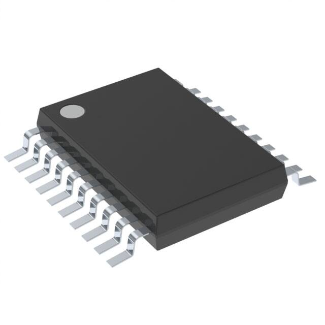

SN74LVC245ANS 数据手册
Sample & Buy Product Folder Support & Community Tools & Software Technical Documents SN74LVC245A SCAS218X – JANUARY 1993 – REVISED JANUARY 2015 SN74LVC245A Octal Bus Transceiver With 3-State Outputs 1 Features 2 Applications • • • • • • • • • • • 1 • • • • • Operates From 1.65 V to 3.6 V Inputs Accept Voltages to 5.5 V Max tpd of 6.3 ns at 3.3 V Typical VOLP (Output Ground Bounce) < 0.8 V at VCC = 3.3 V, TA = 25°C Typical VOHV (Output VOH Undershoot) > 2 V at VCC = 3.3 V, TA = 25°C Ioff Supports Live Insertion, Partial-Power-Down Mode and Back Drive protection Supports Mixed-Mode Signal Operation on All Ports (5-V Input/Output Voltage With 3.3-V VCC) Latch-Up Performance Exceeds 250 mA Per JESD 17 ESD Protection Exceeds JESD 22 – 2000-V Human-Body Model – 1000-V Charged-Device Model Cable Modem Termination Systems Servers LED Displays Network Switches Telecom Infrastructure Motor Drivers I/O Expanders 3 Description These octal bus transceivers are designed for 1.65-V to 3.6-V VCC operation. The ’LVC245A devices are designed for asynchronous communication between data buses. Device Information(1) PART NUMBER SN74LVC245A PACKAGE (PIN) BODY SIZE VQFN (20) 4.50 mm × 3.50 mm SSOP (20) 7.50 mm × 5.30 mm TSSOP (20) 6.50 mm × 4.40 mm TVSOP (20) 5.00 mm × 4.40 mm SOIC (20) 12.80 mm × 7.50 mm (1) For all available packages, see the orderable addendum at the end of the data sheet. 4 Simplified Schematic 1 DIR 19 OE A1 2 18 B1 To Seven Other Channels Pin numbers shown are for the DB, DGV, DW, N, NS, PW, and RGY packages. 1 An IMPORTANT NOTICE at the end of this data sheet addresses availability, warranty, changes, use in safety-critical applications, intellectual property matters and other important disclaimers. PRODUCTION DATA. SN74LVC245A SCAS218X – JANUARY 1993 – REVISED JANUARY 2015 www.ti.com Table of Contents 1 2 3 4 5 6 7 8 9 Features .................................................................. Applications ........................................................... Description ............................................................. Simplified Schematic............................................. Revision History..................................................... Pin Configuration and Functions ......................... Specifications......................................................... 1 1 1 1 2 3 4 7.1 7.2 7.3 7.4 7.5 7.6 7.7 7.8 4 4 5 5 6 6 7 7 Absolute Maximum Ratings ...................................... ESD Ratings.............................................................. Recommended Operating Conditions....................... Thermal Information .................................................. Electrical Characteristics........................................... Switching Characteristics .......................................... Operating Characteristics.......................................... Typical Characteristics .............................................. Parameter Measurement Information .................. 8 Detailed Description .............................................. 9 9.1 9.2 9.3 9.4 Overview ................................................................... Functional Block Diagram ......................................... Feature Description................................................... Device Functional Modes.......................................... 9 9 9 9 10 Application and Implementation........................ 10 10.1 Application Information.......................................... 10 10.2 Typical Application ............................................... 10 11 Power Supply Recommendations ..................... 11 12 Layout................................................................... 11 12.1 Layout Guidelines ................................................. 11 12.2 Layout Example .................................................... 11 13 Device and Documentation Support ................. 12 13.1 Trademarks ........................................................... 12 13.2 Electrostatic Discharge Caution ............................ 12 13.3 Glossary ................................................................ 12 14 Mechanical, Packaging, and Orderable Information ........................................................... 12 5 Revision History Changes from Revision W (May 2013) to Revision X Page • Added Applications, Device Information table, Pin Functions table, ESD Ratings table, Thermal Information table, Typical Characteristics, Feature Description section, Device Functional Modes, Application and Implementation section, Power Supply Recommendations section, Layout section, Device and Documentation Support section, and Mechanical, Packaging, and Orderable Information section. ................................................................................................. 1 • Deleted Ordering Information table. ....................................................................................................................................... 1 Changes from Revision V (September 2010) to Revision W • 2 Page Added –40°C to 125°C temperature specification to Recommended Operating Conditions table. ...................................... 5 Submit Documentation Feedback Copyright © 1993–2015, Texas Instruments Incorporated Product Folder Links: SN74LVC245A SN74LVC245A www.ti.com SCAS218X – JANUARY 1993 – REVISED JANUARY 2015 6 Pin Configuration and Functions GQN OR ZQN PACKAGE (TOP VIEW) 1 2 3 4 A B C D E 20 2 19 3 18 4 17 5 16 6 15 7 14 8 13 9 12 10 11 VCC OE B1 B2 B3 B4 B5 B6 B7 B8 A1 A2 A3 A4 A5 A6 A7 A8 VCC 1 1 20 19 OE 18 B1 2 3 17 B2 16 B3 4 5 15 B4 14 B5 6 7 13 B6 12 B7 8 9 GND 10 11 B8 DIR A1 A2 A3 A4 A5 A6 A7 A8 GND DIR RGY PACKAGE (TOP VIEW) DB, DGV, DW, N, NS, OR PW PACKAGE (TOP VIEW) Pin Functions PIN NAME DB, DGV, DW, NS, PW, and RGY GQN or ZQN A1 2 A1 I/O Transceiver I/O pin A2 3 B3 I/O Transceiver I/O pin A3 4 B1 I/O Transceiver I/O pin A4 5 C2 I/O Transceiver I/O pin A5 6 C1 I/O Transceiver I/O pin A6 7 D3 I/O Transceiver I/O pin A7 8 D1 I/O Transceiver I/O pin A8 9 E2 I/O Transceiver I/O pin B1 18 B4 I/O Transceiver I/O pin B2 17 B2 I/O Transceiver I/O pin B3 16 C4 I/O Transceiver I/O pin B4 15 C3 I/O Transceiver I/O pin B5 14 D4 I/O Transceiver I/O pin B6 13 D2 I/O Transceiver I/O pin B7 12 E4 I/O Transceiver I/O pin B8 11 E3 I/O Transceiver I/O pin DIR 1 A2 I Direction control. When high, the signal propagates from A to B. When low, the signal propagates from B to A. Output enable TYPE DESCRIPTION OE 19 A4 I GND 10 E1 — Ground VCC 20 A3 — Power pin Submit Documentation Feedback Copyright © 1993–2015, Texas Instruments Incorporated Product Folder Links: SN74LVC245A 3 SN74LVC245A SCAS218X – JANUARY 1993 – REVISED JANUARY 2015 www.ti.com 7 Specifications 7.1 Absolute Maximum Ratings over operating free-air temperature range (unless otherwise noted) (1) VCC MIN MAX Supply voltage range –0.5 6.5 UNIT V (2) VI Input voltage range –0.5 6.5 V VO Voltage range applied to any output in the high-impedance or power-off state (2) –0.5 6.5 V VO Voltage range applied to any output in the high or low state (2) (3) –0.5 VCC + 0.5 V IIK Input clamp current VI < 0 –50 mA IOK Output clamp current VO < 0 –50 mA IO Continuous output current ±50 mA ±100 mA 150 °C Continuous current through VCC or GND Tstg (1) (2) (3) Storage temperature range –65 Stresses beyond those listed under Absolute Maximum Ratings may cause permanent damage to the device. These are stress ratings only, and functional operation of the device at these or any other conditions beyond those indicated under Recommended Operating Conditions is not implied. Exposure to absolute-maximum-rated conditions for extended periods may affect device reliability. The input and output negative-voltage ratings may be exceeded if the input and output current ratings are observed. The value of VCC is provided in the Recommended Operating Conditions table. 7.2 ESD Ratings PARAMETER V(ESD) (1) (2) 4 Electrostatic discharge DEFINITION VALUE Human body model (HBM), per ANSI/ESDA/JEDEC JS-001, all pins (1) 2000 Charged device model (CDM), per JEDEC specification JESD22-C101, all pins (2) 1000 UNIT V JEDEC document JEP155 states that 500-V HBM allows safe manufacturing with a standard ESD control process. JEDEC document JEP157 states that 250-V CDM allows safe manufacturing with a standard ESD control process. Submit Documentation Feedback Copyright © 1993–2015, Texas Instruments Incorporated Product Folder Links: SN74LVC245A SN74LVC245A www.ti.com SCAS218X – JANUARY 1993 – REVISED JANUARY 2015 7.3 Recommended Operating Conditions over operating free-air temperature range (unless otherwise noted) (1) TA = 25°C VCC Supply voltage VIH High-level input voltage Operating Data retention only MIN MAX MIN MAX MIN MAX 1.65 3.6 1.65 3.6 1.65 3.6 1.5 1.5 0.65 × VCC 0.65 × VCC 0.65 × VCC VCC = 2.3 V to 2.7 V 1.7 1.7 1.7 VCC = 2.7 V to 3.6 V 2 2 2 VCC = 1.65 V to 1.95 V Low-level input voltage VI Input voltage VO Output voltage VCC = 2.3 V to 2.7 V VCC = 2.7 V to 3.6 V High-level output current IOH 0.35 × VCC 0.35 × VCC 0.7 0.7 0.7 0.8 0.8 0 5.5 0 5.5 V 0 VCC 0 VCC 0 VCC V –4 –4 –4 VCC = 2.3 V –8 –8 –8 VCC = 2.7 V –12 –12 –12 VCC = 3 V –24 –24 –24 4 4 4 VCC = 2.3 V 8 8 8 VCC = 2.7 V 12 12 12 VCC = 3 V 24 24 24 10 10 10 Low-level output current Δt/Δv Input transition rise or fall rate V 5.5 VCC = 1.65 V IOL V V 0.35 × VCC 0.8 UNIT 0 VCC = 1.65 V (1) –40°C TO 125°C 1.5 VCC = 1.65 V to 1.95 V VIL –40°C TO 85°C mA mA ns/V All unused inputs of the device must be held at VCC or GND to ensure proper device operation. Refer to the TI application report, Implications of Slow or Floating CMOS Inputs, literature number SCBA004. 7.4 Thermal Information SN74LVC245A THERMAL METRIC (1) DB (2) DGV (2) DW (2) GQN or ZQN (2) N (2) NS (2) PW (2) RGY (3) 59.2 83.6 108.1 44.0 UNI T 20 PINS RθJA Junction-to-ambient thermal resistance 106.5 124.1 92.9 RθJC(t Junction-to-case(top) thermal resistance 68.1 39.5 60.6 44.9 49.4 43.0 53.0 RθJB Junction-to-board thermal resistance 61.7 65.5 60.4 40.1 51.2 59.1 22.1 ψJT Junction-to-top characterization parameter 28.5 2.1 28.2 29.9 21.9 4.7 3.0 ψJB Junction-to-board characterization parameter 61.2 64.9 60.0 39.9 50.8 58.6 22.2 — — — — — — 16.6 op) RθJC(b Junction-to-case(bottom) thermal resistance ot) (1) (2) (3) 78 °C/ W For more information about traditional and new thermal metrics, see the IC Package Thermal Metrics application report, SPRA953. The package thermal impedance is calculated in accordance with JESD 51-7. The package thermal impedance is calculated in accordance with JESD 51-5. Submit Documentation Feedback Copyright © 1993–2015, Texas Instruments Incorporated Product Folder Links: SN74LVC245A 5 SN74LVC245A SCAS218X – JANUARY 1993 – REVISED JANUARY 2015 www.ti.com 7.5 Electrical Characteristics over recommended operating free-air temperature range (unless otherwise noted) PARAMETER VOH TEST CONDITIONS Control inputs II MIN TYP –40°C TO 85°C MAX –40°C TO 125°C MIN MAX MIN IOH = –100 μA 1.65 V to 3.6 V VCC – 0.2 VCC – 0.2 VCC – 0.2 IOH = –4 mA 1.65 V 1.29 1.2 1.1 IOH = –8 mA 2.3 V 1.9 1.7 1.6 2.7 V 2.2 2.2 2.1 IOH = –12 mA VOL TA = 25°C VCC MAX UNIT V 3V 2.4 2.4 2.3 IOH = –24 mA 3V 2.3 2.2 2.1 IOL = 100 μA 1.65 V to 3.6 V 0.1 0.2 0.2 IOL = 4 mA 1.65 V 0.24 0.45 0.60 IOL = 8 mA 2.3 V 0.3 0.7 0.75 IOL = 12 mA 2.7 V 0.4 0.4 0.6 IOL = 24 mA 3V 0.55 0.55 0.75 3.6 V ±1 ±5 ±10 μA VI = 0 to 5.5 V V Ioff VI or VO = 5.5 V 0 ±1 ±10 ±20 μA IOZ (1) VO = 0 to 5.5 V 3.6 V ±1 ±10 ±20 μA 1 10 30 1 10 30 500 500 5000 VI = VCC or GND ICC IO = 0 3.6 V ≤ VI ≤ 5.5 V (2) One input at VCC – 0.6 V, Other inputs at VCC or GND ΔICC 3.6 V 2.7 V to 3.6 V μA μA Ci Control inputs VI = VCC or GND 3.3 V 4 pF Cio A or B ports (3) VI = VCC or GND 3.3 V 5.5 pF (1) (2) (3) All typical values are at VCC = 3.3 V, TA = 25 C. This applies in the disabled state only. For I/O ports, the parameter Ioz includes the input leakage current. 7.6 Switching Characteristics over recommended operating free-air temperature range (unless otherwise noted) (see Figure 3) PARAMETER tpd ten tdis FROM (INPUT) TO (OUTPUT) A or B OE OE B or A A or B A or B VCC 6 –40°C TO 85°C –40°C TO 125°C UNIT MIN TYP MAX MIN MAX MIN MAX 1.8 V ± 0.15 V 1 6 12.2 1 12.7 1 13.7 2.5 V ± 0.2 V 1 3.9 7.8 1 8.3 1 9.1 2.7 V 1 4.2 7.1 1 7.3 1 8.3 3.3 V ± 0.3 V 1.5 3.8 6.1 1.5 6.3 1.5 7.3 1.8 V ± 0.15 V 1 7 14.8 1 15.3 1 16.8 2.5 V ± 0.2 V 1 4.5 10 1 10.5 1 12 2.7 V 1 5.4 9.3 1 9.5 1 11 3.3 V ± 0.3 V 1.5 4.4 8.3 1.5 8.5 1.5 10 1.8 V ± 0.15 V 1 7.8 16.5 1 17 1 18 2.5 V ± 0.2 V 1 4 9 1 9.5 1 10.5 2.7 V 1 4.4 8.3 1 8.5 1 9.5 1.7 4.1 7.3 1.7 7.5 1.7 8.5 3.3 V ± 0.3 V tsk(o) TA = 25°C 3.3 V ± 0.3 V Submit Documentation Feedback 1 1.5 ns ns ns ns Copyright © 1993–2015, Texas Instruments Incorporated Product Folder Links: SN74LVC245A SN74LVC245A www.ti.com SCAS218X – JANUARY 1993 – REVISED JANUARY 2015 7.7 Operating Characteristics TA = 25°C TEST CONDITIONS PARAMETER Outputs enabled Cpd Power dissipation capacitance per transceiver f = 10 MHz Outputs disabled VCC TYP 1.8 V 42 2.5 V 43 3.3 V 45 1.8 V 1 2.5 V 1 3.3 V 2 UNIT pF 7.8 Typical Characteristics 10 14 12 VCC = 3 V, TA = 25°C tpd – Propagation Delay Time – ns tpd – Propagation Delay Time – ns VCC = 3 V, TA = 25°C One Output Switching Four Outputs Switching Eight Outputs Switching 10 8 6 4 One Output Switching Four Outputs Switching Eight Outputs Switching 8 6 4 2 2 0 50 100 150 200 250 300 CL – Load Capacitance – pF Figure 1. Propagation Delay (Low to High Transition) vs Load Capacitance 0 50 100 150 200 250 300 CL – Load Capacitance – pF Figure 2. Propagation Delay (High to Low Transition) vs Load Capacitance Submit Documentation Feedback Copyright © 1993–2015, Texas Instruments Incorporated Product Folder Links: SN74LVC245A 7 SN74LVC245A SCAS218X – JANUARY 1993 – REVISED JANUARY 2015 www.ti.com 8 Parameter Measurement Information VLOAD S1 RL From Output Under Test CL (see Note A) Open GND RL TEST S1 tPLH/tPHL tPLZ/tPZL tPHZ/tPZH Open VLOAD GND LOAD CIRCUIT INPUTS VCC 1.8 V ± 0.15 V 2.5 V ± 0.2 V 2.7 V 3.3 V ± 0.3 V VI tr/tf VCC VCC 2.7 V 2.7 V ≤2 ns ≤2 ns ≤2.5 ns ≤2.5 ns VM VLOAD CL RL V∆ VCC/2 VCC/2 1.5 V 1.5 V 2 × VCC 2 × VCC 6V 6V 30 pF 30 pF 50 pF 50 pF 1 kΩ 500 Ω 500 Ω 500 Ω 0.15 V 0.15 V 0.3 V 0.3 V VI Timing Input VM 0V tw tsu VI Input VM VM th VI Data Input VM VM 0V 0V VOLTAGE WAVEFORMS SETUP AND HOLD TIMES VOLTAGE WAVEFORMS PULSE DURATION VI VM Input VM 0V VOH VM Output VM VOL VM tPLZ VLOAD/2 VM tPZH VOH Output VM 0V Output Waveform 1 S1 at VLOAD (see Note B) tPLH tPHL VM tPZL tPHL tPLH VI Output Control VM VOL VOLTAGE WAVEFORMS PROPAGATION DELAY TIMES INVERTING AND NONINVERTING OUTPUTS Output Waveform 2 S1 at GND (see Note B) VOL + V∆ VOL tPHZ VM VOH - V∆ VOH ≈0 V VOLTAGE WAVEFORMS ENABLE AND DISABLE TIMES LOW- AND HIGH-LEVEL ENABLING NOTES: A. CL includes probe and jig capacitance. B. Waveform 1 is for an output with internal conditions such that the output is low, except when disabled by the output control. Waveform 2 is for an output with internal conditions such that the output is high, except when disabled by the output control. C. All input pulses are supplied by generators having the following characteristics: PRR≤ 10 MHz, ZO = 50 Ω. D. The outputs are measured one at a time, with one transition per measurement. E. tPLZ and tPHZ are the same as tdis. F. t PZL and tPZH are the same as ten. G. tPLH and tPHL are the same as tpd. H. All parameters and waveforms are not applicable to all devices. Figure 3. Load Circuit and Voltage Waveforms 8 Submit Documentation Feedback Copyright © 1993–2015, Texas Instruments Incorporated Product Folder Links: SN74LVC245A SN74LVC245A www.ti.com SCAS218X – JANUARY 1993 – REVISED JANUARY 2015 9 Detailed Description 9.1 Overview This octal bus transceiver is designed for 1.65-V to 3.6-V VCC operation. The SN74LVC245A device is designed for asynchronous communication between data buses. This device transmits data from the A bus to the B bus or from the B bus to the A bus, depending on the logic level at the direction-control (DIR) input. The output-enable (OE) input can be used to disable the device so the buses effectively are isolated. To ensure the high-impedance state during power up or power down, OE should be tied to VCC through a pull-up resistor; the minimum value of the resistor is determined by the current-sinking capability of the driver. Inputs can be driven from either 3.3-V or 5-V devices. This feature allows the use of this device as a translator in a mixed 3.3-V/5-V system environment. This device is fully specified for partial-power-down applications using Ioff. The Ioff circuitry disables the outputs, preventing damaging current backflow through the device when it is powered down. 9.2 Functional Block Diagram 1 DIR 19 OE A1 2 18 B1 To Seven Other Channels Pin numbers shown are for the DB, DGV, DW, N, NS, PW, and RGY packages. 9.3 Feature Description • • Allows down voltage translation – 5 V to 3.3 V – 5 V or 3.3 V to 1.8 V Inputs accept voltage levels up to 5.5 V 9.4 Device Functional Modes Table 1. Function Table INPUTS OE DIR OPERATION L L B data to A bus L H A data to B bus H X Isolation Submit Documentation Feedback Copyright © 1993–2015, Texas Instruments Incorporated Product Folder Links: SN74LVC245A 9 SN74LVC245A SCAS218X – JANUARY 1993 – REVISED JANUARY 2015 www.ti.com 10 Application and Implementation NOTE Information in the following applications sections is not part of the TI component specification, and TI does not warrant its accuracy or completeness. TI’s customers are responsible for determining suitability of components for their purposes. Customers should validate and test their design implementation to confirm system functionality. 10.1 Application Information SN74LVC245A is a high drive CMOS device that can be used for a multitude of bus interface type applications where output drive or PCB trace length is a concern. The inputs can accept voltages to 5.5 V at any valid VCC making it ideal for down translation. 10.2 Typical Application Regulated 1.8 V Regulated 1.65 V to 3.6 V Regulated 5 V SN74LVC245A 1OE A1 uC SN74LVC245A 1OE VCC DIR A1 B1 VCC DIR B1 uC System Logic LEDs/Relays or Other System Boards A8 B8 uC System Logic LEDs/Relays uC System Logic LEDs/Relays A8 GND B8 GND Figure 4. Typical Application Schematic 10.2.1 Design Requirements This device uses CMOS technology and has balanced output drive. Care should be taken to avoid bus contention because it can drive currents that would exceed maximum limits. The high drive will also create fast edges into light loads so routing and load conditions should be considered to prevent ringing. 10.2.2 Detailed Design Procedure 1. Recommended Input Conditions – For rise time and fall time specifcations, see (Δt/ΔV) in the Recommended Operating Conditions table. – For specified high and low levels, see (VIH and VIL) in the Recommended Operating Conditions table. – Inputs are overvoltage tolerant allowing them to go as high as (VI max) in the Recommended Operating Conditions table at any valid VCC. 2. Recommend Output Conditions – Load currents should not exceed (IO max) per output and should not exceed (Continuous current through VCC or GND) total current for the part. These limits are located in the Absolute Maximum Ratings table. – Outputs should not be pulled above VCC. 10 Submit Documentation Feedback Copyright © 1993–2015, Texas Instruments Incorporated Product Folder Links: SN74LVC245A SN74LVC245A www.ti.com SCAS218X – JANUARY 1993 – REVISED JANUARY 2015 Typical Application (continued) 10.2.3 Application Curves 100 80 60 TA = 25°C, VCC = 3 V, VIH = 3 V, VIL = 0 V, All Outputs Switching 40 TA = 25°C, VCC = 3 V, VIH = 3 V, VIL = 0 V, All Outputs Switching 20 I OH – mA I OL – mA 60 40 0 –20 –40 20 –60 0 –80 –20 –0.2 0.0 0.2 0.4 0.6 0.8 1.0 1.2 1.4 1.6 –100 –1 –0.5 0.0 VOL – V 0.5 1.0 1.5 2.0 2.5 3.0 3.5 4.0 VOH – V Figure 5. Output Drive Current (IOL) vs LOW-level Output Voltage (VOL) Figure 6. Output Drive Current (IOH) vs HIGH-level Output Voltage (VOH) 11 Power Supply Recommendations The power supply can be any voltage between the MIN and MAX supply voltage rating located in the Recommended Operating Conditions table. Each VCC terminal should have a good bypass capacitor to prevent power disturbance. For devices with a single supply, a 0.1 μF capacitor is recommended. If there are multiple VCC terminals then 0.01 μF or 0.022 μF capacitors are recommended for each power terminal. It is ok to parallel multiple bypass capacitors to reject different frequencies of noise. Multiple bypass capacitors may be paralleled to reject different frequencies of noise. The bypass capacitor should be installed as close to the power terminal as possible for the best results. 12 Layout 12.1 Layout Guidelines When using multiple bit logic devices, inputs should not float. In many cases, functions or parts of functions of digital logic devices are unused. Some examples are when only two inputs of a triple-input AND gate are used, or when only 3 of the 4-buffer gates are used. Such input pins should not be left unconnected because the undefined voltages at the outside connections result in undefined operational states. Specified in Figure 7 are rules that must be observed under all circumstances. All unused inputs of digital logic devices must be connected to a high or low bias to prevent them from floating. The logic level that should be applied to any particular unused input depends on the function of the device. Generally they will be tied to GND or VCC, whichever makes more sense or is more convenient. 12.2 Layout Example VCC Unused Input Input Output Unused Input Output Input Figure 7. Layout Diagram Submit Documentation Feedback Copyright © 1993–2015, Texas Instruments Incorporated Product Folder Links: SN74LVC245A 11 SN74LVC245A SCAS218X – JANUARY 1993 – REVISED JANUARY 2015 www.ti.com 13 Device and Documentation Support 13.1 Trademarks All trademarks are the property of their respective owners. 13.2 Electrostatic Discharge Caution These devices have limited built-in ESD protection. The leads should be shorted together or the device placed in conductive foam during storage or handling to prevent electrostatic damage to the MOS gates. 13.3 Glossary SLYZ022 — TI Glossary. This glossary lists and explains terms, acronyms and definitions. 14 Mechanical, Packaging, and Orderable Information The following pages include mechanical packaging and orderable information. This information is the most current data available for the designated devices. This data is subject to change without notice and revision of this document. For browser based versions of this data sheet, refer to the left hand navigation. 12 Submit Documentation Feedback Copyright © 1993–2015, Texas Instruments Incorporated Product Folder Links: SN74LVC245A PACKAGE OPTION ADDENDUM www.ti.com 27-May-2022 PACKAGING INFORMATION Orderable Device Status (1) Package Type Package Pins Package Drawing Qty Eco Plan (2) Lead finish/ Ball material MSL Peak Temp Op Temp (°C) Device Marking (3) Samples (4/5) (6) (1) SN74LVC245ADBR ACTIVE SSOP DB 20 2000 RoHS & Green NIPDAU Level-1-260C-UNLIM -40 to 125 LC245A Samples SN74LVC245ADBRE4 ACTIVE SSOP DB 20 2000 RoHS & Green NIPDAU Level-1-260C-UNLIM -40 to 125 LC245A Samples SN74LVC245ADBRG4 ACTIVE SSOP DB 20 2000 RoHS & Green NIPDAU Level-1-260C-UNLIM -40 to 125 LC245A Samples SN74LVC245ADGVR ACTIVE TVSOP DGV 20 2000 RoHS & Green NIPDAU Level-1-260C-UNLIM -40 to 125 LC245A Samples SN74LVC245ADW ACTIVE SOIC DW 20 25 RoHS & Green NIPDAU Level-1-260C-UNLIM -40 to 125 LVC245A Samples SN74LVC245ADWR ACTIVE SOIC DW 20 2000 RoHS & Green NIPDAU Level-1-260C-UNLIM -40 to 125 LVC245A Samples SN74LVC245ADWRG4 ACTIVE SOIC DW 20 2000 RoHS & Green NIPDAU Level-1-260C-UNLIM -40 to 125 LVC245A Samples SN74LVC245AN ACTIVE PDIP N 20 20 RoHS & Green NIPDAU N / A for Pkg Type -40 to 125 SN74LVC245AN Samples SN74LVC245ANE4 ACTIVE PDIP N 20 20 RoHS & Green NIPDAU N / A for Pkg Type -40 to 125 SN74LVC245AN Samples SN74LVC245ANSR ACTIVE SO NS 20 2000 RoHS & Green NIPDAU Level-1-260C-UNLIM -40 to 125 LVC245A Samples SN74LVC245APW ACTIVE TSSOP PW 20 70 RoHS & Green NIPDAU Level-1-260C-UNLIM -40 to 125 LC245A Samples SN74LVC245APWE4 ACTIVE TSSOP PW 20 70 RoHS & Green NIPDAU Level-1-260C-UNLIM -40 to 125 LC245A Samples SN74LVC245APWG4 ACTIVE TSSOP PW 20 70 RoHS & Green NIPDAU Level-1-260C-UNLIM -40 to 125 LC245A Samples SN74LVC245APWR ACTIVE TSSOP PW 20 2000 RoHS & Green NIPDAU | SN Level-1-260C-UNLIM -40 to 125 LC245A Samples SN74LVC245APWRE4 ACTIVE TSSOP PW 20 2000 RoHS & Green NIPDAU Level-1-260C-UNLIM -40 to 125 LC245A Samples SN74LVC245APWRG3 ACTIVE TSSOP PW 20 2000 RoHS & Green SN Level-1-260C-UNLIM -40 to 125 LC245A Samples SN74LVC245APWRG4 ACTIVE TSSOP PW 20 2000 RoHS & Green NIPDAU Level-1-260C-UNLIM -40 to 125 LC245A Samples SN74LVC245APWT ACTIVE TSSOP PW 20 250 RoHS & Green NIPDAU Level-1-260C-UNLIM -40 to 125 LC245A Samples SN74LVC245ARGYR ACTIVE VQFN RGY 20 3000 RoHS & Green NIPDAU Level-2-260C-1 YEAR -40 to 125 LC245A Samples The marketing status values are defined as follows: Addendum-Page 1 PACKAGE OPTION ADDENDUM www.ti.com 27-May-2022 ACTIVE: Product device recommended for new designs. LIFEBUY: TI has announced that the device will be discontinued, and a lifetime-buy period is in effect. NRND: Not recommended for new designs. Device is in production to support existing customers, but TI does not recommend using this part in a new design. PREVIEW: Device has been announced but is not in production. Samples may or may not be available. OBSOLETE: TI has discontinued the production of the device. (2) RoHS: TI defines "RoHS" to mean semiconductor products that are compliant with the current EU RoHS requirements for all 10 RoHS substances, including the requirement that RoHS substance do not exceed 0.1% by weight in homogeneous materials. Where designed to be soldered at high temperatures, "RoHS" products are suitable for use in specified lead-free processes. TI may reference these types of products as "Pb-Free". RoHS Exempt: TI defines "RoHS Exempt" to mean products that contain lead but are compliant with EU RoHS pursuant to a specific EU RoHS exemption. Green: TI defines "Green" to mean the content of Chlorine (Cl) and Bromine (Br) based flame retardants meet JS709B low halogen requirements of
