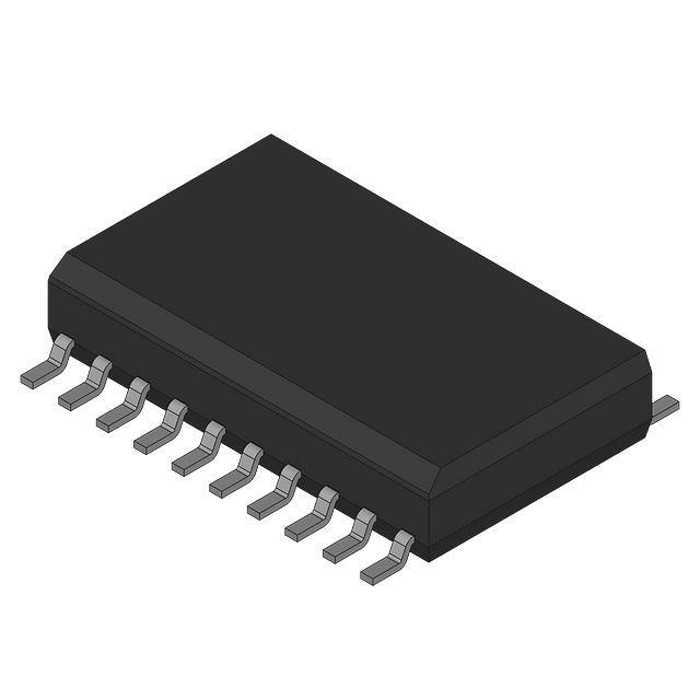

Sample & Buy Product Folder Technical Documents Support & Community Tools & Software SN54LVC541A, SN74LVC541A SCAS298N – JANUARY 1993 – REVISED JUNE 2014 SNx4LVC541A Octal Buffers/Drivers With 3-State Outputs 1 Features 2 Applications • • • • • • • • • • 1 • • • • • • Operate From 1.65 V to 3.6 V Inputs Accept Voltages to 5.5 V Max tpd of 5.1 ns at 3.3 V Typical VOLP (Output Ground Bounce) 2 V at VCC = 3.3 V, TA = 25°C Support Mixed-Mode Signal Operation on All Ports (5-V Input/Output Voltage With 3.3-V VCC) Ioff Supports Live Insertion, Partial-Power-Down Mode, and Back-Drive Protection Latch-Up Performance Exceeds 250 mA Per JESD 17 ESD Protection Exceeds JESD 22 – 2000-V Human-Body Model (A114-A) – 200-V Machine Model (A115-A) – 1000-V Charged-Device Model (C101) On Products Compliant to MIL-PRF-38535, All Parameters Are Tested Unless Otherwise Noted. On All Other Products, Production Processing Does Not Necessarily Include Testing of All Parameters. Servers PCs and Notebooks Network Switches Wearable Health and Wellness Devices Telecom Infrastructures Electronic Points of Sale 3 Description The SN54LVC541A octal buffer/driver is designed for 2.7-V to 3.6-V VCC operation, and the SN74LVC541A octal buffer/driver is designed for 1.65-V to 3.6-V VCC operation. Device Information(1) PART NUMBER SN74LVC541A PACKAGE BODY SIZE (NOM) SSOP (20) 7.20 mm × 5.30 mm TVSOP (20) 5.00 mm × 4.40 mm VQFN (20) 4.50 mm × 3.50 mm SOIC (20) 12.80 mm × 7.50 mm TSSOP (20) 6.50 mm × 4.40 mm (1) For all available packages, see the orderable addendum at the end of the data sheet. 4 Simplified Schematic OE1 OE2 A1 1 19 2 18 Y1 To Seven Other Channels 1 An IMPORTANT NOTICE at the end of this data sheet addresses availability, warranty, changes, use in safety-critical applications, intellectual property matters and other important disclaimers. PRODUCTION DATA. SN54LVC541A, SN74LVC541A SCAS298N – JANUARY 1993 – REVISED JUNE 2014 www.ti.com Table of Contents 1 2 3 4 5 6 7 Features .................................................................. Applications ........................................................... Description ............................................................. Simplified Schematic............................................. Revision History..................................................... Pin Configuration and Functions ......................... Specifications......................................................... 1 1 1 1 2 3 4 7.1 7.2 7.3 7.4 7.5 7.6 7.7 4 4 5 5 6 7 Absolute Maximum Ratings ..................................... Handling Ratings....................................................... Recommended Operating Conditions ...................... Thermal Information .................................................. Electrical Characteristics—DC Limit Changes.......... Switching Characteristics—AC Limit Changes ......... Switching Characteristics, SN74LVC541A –40°C to 85°C ........................................................................... 7.8 Switching Characteristics, SN74LVC541A –40°C to 125°C ......................................................................... 7.9 Operating Characteristics.......................................... 7.10 Typical Characteristics ............................................ 8 7 7 7 8 9 Detailed Description ............................................ 10 9.1 9.2 9.3 9.4 Overview ................................................................. Functional Block Diagram ....................................... Feature Description................................................. Device Functional Modes........................................ 10 10 10 10 10 Application and Implementation........................ 11 10.1 Application Information.......................................... 11 10.2 Typical Application ............................................... 11 11 Power Supply Recommendations ..................... 12 12 Layout................................................................... 12 12.1 Layout Guidelines ................................................. 12 12.2 Layout Example .................................................... 12 13 Device and Documentation Support ................. 13 13.1 13.2 13.3 13.4 Related Links ........................................................ Trademarks ........................................................... Electrostatic Discharge Caution ............................ Glossary ................................................................ 13 13 13 13 14 Mechanical, Packaging, and Orderable Information ........................................................... 13 Parameter Measurement Information .................. 9 5 Revision History NOTE: Page numbers for previous revisions may differ from page numbers in the current version. Changes from Revision M (May 2005) to Revision N Page • Updated document to new TI data sheet format. ................................................................................................................... 1 • Removed Ordering Information table. .................................................................................................................................... 1 • Updated Ioff Feature bullet. ..................................................................................................................................................... 1 • Updated Features to include Military Disclaimer. ................................................................................................................... 1 • Added Applications ................................................................................................................................................................ 1 • Added Device Information table. ............................................................................................................................................ 1 • Added Handling Ratings table. ............................................................................................................................................... 4 • Changed MAX operating free-air temperature from 85°C to 125°C for SN74LVC541A. ....................................................... 5 • Updated Thermal Information table. ...................................................................................................................................... 5 • Added –40°C TO 125°C temperature range to Electrical Characteristics table for SN74LVC541A. ..................................... 6 • Added Switching Characteristics table –40°C TO 125°C temperature range for SN74LVC541A. ........................................ 7 • Added Typical Characteristics. ............................................................................................................................................... 8 2 Submit Documentation Feedback Copyright © 1993–2014, Texas Instruments Incorporated Product Folder Links: SN54LVC541A SN74LVC541A SN54LVC541A, SN74LVC541A www.ti.com SCAS298N – JANUARY 1993 – REVISED JUNE 2014 6 Pin Configuration and Functions 4 17 5 16 6 15 7 14 8 13 9 12 10 11 1 20 A2 A1 OE1 VCC 18 A1 A2 A3 A4 A5 A6 A7 A8 SN54LVC541A . . . FK PACKAGE (TOP VIEW) 2 19 OE2 3 18 Y1 4 17 Y2 16 Y3 5 A3 A4 A5 A6 A7 15 Y4 14 Y5 6 7 13 Y6 12 Y7 8 9 10 11 4 3 2 1 20 19 18 5 17 6 16 7 15 8 14 9 10 11 12 13 Y1 Y2 Y3 Y4 Y5 A8 GND Y8 Y7 Y6 3 VCC OE2 Y1 Y2 Y3 Y4 Y5 Y6 Y7 Y8 VCC 19 Y8 20 2 OE1 1 GND OE1 A1 A2 A3 A4 A5 A6 A7 A8 GND SN74LVC541A . . . RGY PACKAGE (TOP VIEW) OE2 SN54LVC541A . . . J OR W PACKAGE SN74LVC541A . . . DB, DGV, DW, NS, OR PW PACKAGE (TOP VIEW) Pin Functions PIN NO. NAME I/O DESCRIPTION 1 OE1 I Output enable 2 A1 I A1 input 3 A2 I A2 input 4 A3 I A3 input 5 A4 I A4 input 6 A5 I A5 input 7 A6 I A6 input 8 A7 I A7 input A8 input 9 A8 I 10 GND — Ground pin 11 Y8 O Y8 output 12 Y7 O Y7 output 13 Y6 O Y6 output 14 Y5 O Y5 output 15 Y4 O Y4 output 16 Y3 O Y3 output 17 Y2 O Y2 output 18 Y1 O Y1 output Output enable 19 OE2 I 20 VCC — Power pin Copyright © 1993–2014, Texas Instruments Incorporated Product Folder Links: SN54LVC541A SN74LVC541A Submit Documentation Feedback 3 SN54LVC541A, SN74LVC541A SCAS298N – JANUARY 1993 – REVISED JUNE 2014 www.ti.com 7 Specifications 7.1 Absolute Maximum Ratings over operating free-air temperature range (unless otherwise noted) (1) VCC MIN MAX Supply voltage range –0.5 6.5 UNIT V (2) VI Input voltage range –0.5 6.5 V VO Voltage range applied to any output in the high-impedance or power-off state (2) –0.5 6.5 V VO Voltage range applied to any output in the high or low state (2) (3) –0.5 VCC + 0.5 V IIK Input clamp current VI < 0 –50 mA IOK Output clamp current VO < 0 –50 mA IO Continuous output current ±50 mA ±100 mA Continuous current through VCC or GND (1) (2) (3) Stresses beyond those listed under Absolute Maximum Ratings may cause permanent damage to the device. These are stress ratings only, and functional operation of the device at these or any other conditions beyond those indicated under Recommended Operating Conditions is not implied. Exposure to absolute-maximum-rated conditions for extended periods may affect device reliability. The input negative-voltage and output voltage ratings may be exceeded if the input and output current ratings are observed. The value of VCC is provided in the Recommended Operating Conditions table. 7.2 Handling Ratings Tstg V(ESD) (1) (2) 4 MIN MAX UNIT –65 150 °C Human body model (HBM), per ANSI/ESDA/JEDEC JS-001, all pins (1) 0 2000 Charged device model (CDM), per JEDEC specification JESD22-C101, all pins (2) 0 1000 Storage temperature range Electrostatic discharge V JEDEC document JEP155 states that 500-V HBM allows safe manufacturing with a standard ESD control process. JEDEC document JEP157 states that 250-V CDM allows safe manufacturing with a standard ESD control process. Submit Documentation Feedback Copyright © 1993–2014, Texas Instruments Incorporated Product Folder Links: SN54LVC541A SN74LVC541A SN54LVC541A, SN74LVC541A www.ti.com SCAS298N – JANUARY 1993 – REVISED JUNE 2014 7.3 Recommended Operating Conditions over operating free-air temperature range (unless otherwise noted) (1) SN54LVC541A VCC Operating Supply voltage Data retention only SN74LVC541A MIN MAX MIN MAX 2 3.6 1.65 3.6 1.5 High-level input voltage 0.65 × VCC VCC = 2.3 V to 2.7 V 1.7 VCC = 2.7 V to 3.6 V 2 Low-level input voltage 0.35 × VCC VCC = 2.3 V to 2.7 V 0.7 VCC = 2.7 V to 3.6 V VI Input voltage VO Output voltage IOH V 2 VCC = 1.65 V to 1.95 V VIL High-level output current 0.8 0 5.5 0 5.5 High or low state 0 VCC 0 VCC 3-state 0 5.5 0 5.5 VCC = 1.65 V –4 VCC = 2.3 V –8 VCC = 2.7 V –12 –12 VCC = 3 V –24 –24 TA (1) V V mA 4 VCC = 2.3 V Low-level output current V 0.8 VCC = 1.65 V IOL V 1.5 VCC = 1.65 V to 1.95 V VIH UNIT 8 VCC = 2.7 V 12 12 VCC = 3 V 24 24 Operating free-air temperature –55 125 –40 mA 125 °C All unused inputs of the device must be held at VCC or GND to ensure proper device operation. Refer to the TI application report, Implications of Slow or Floating CMOS Inputs, literature number SCBA004. 7.4 Thermal Information over operating free-air temperature range (unless otherwise noted) SN74LVC541A THERMAL METRIC (1) DB DGV DW NS PW UNIT 20 PINS RθJA Junction-to-ambient thermal resistance 112.1 128.9 99.4 90.3 100.8 RθJC(top) Junction-to-case (top) thermal resistance 73.6 43.8 66.9 56.6 35.2 RθJB Junction-to-board thermal resistance 67.3 70.4 66.9 57.8 51.8 ψJT Junction-to-top characterization parameter 33.3 3.2 33.8 28.7 2.2 ψJB Junction-to-board characterization parameter 66.9 69.7 66.5 57.4 51.2 RθJC(bot) Junction-to-case (bottom) thermal resistance n/a n/a n/a n/a n/a (1) °C/W For more information about traditional and new thermal metrics, see the IC Package Thermal Metrics application report, literature number SPRA953. Copyright © 1993–2014, Texas Instruments Incorporated Product Folder Links: SN54LVC541A SN74LVC541A Submit Documentation Feedback 5 SN54LVC541A, SN74LVC541A SCAS298N – JANUARY 1993 – REVISED JUNE 2014 www.ti.com 7.5 Electrical Characteristics—DC Limit Changes over recommended operating free-air temperature range (unless otherwise noted) PARAMETER TEST CONDITIONS VCC –55°C TO 125°C –40°C TO 85°C SN54LVC541A SN74LVC541A MIN 2.7 V to 3.6 V (1) (2) 6 SN74LVC541A MAX MIN VCC – 0.2 VCC – 0.3 TYP (1) UNIT MAX VCC – 0.2 1.65 V 1.20 1.20 2.3 V 1.7 1.7 2.7 V 2.2 2.2 2.2 3V 2.4 2.4 2.4 3V 2.2 2.2 2.2 1.65 V to 3.6 V IOL = 100 μA 2.7 V to 3.6 V V 0.2 0.3 0.45 0.45 0.7 0.7 0.2 IOL = 4 mA 1.65 V IOL = 8 mA 2.3 V IOL = 12 mA 2.7 V 0.4 0.4 0.4 IOL = 24 mA 3V 0.55 0.55 0.55 II VI = 0 to 5.5 V Ioff VI or VO = 5.5 V 0 IOZ VO = 0 to 5.5 V 3.6 V VI = VCC or GND 3.6 V ≤ VI ≤ 5.5 V (2) ΔICC TYP (1) IOH = –8 mA IOH = –24 mA ICC MIN IOH = –4 mA IOH = –12 mA VOL MAX 1.65 V to 3.6 V IOH = –100 μA VOH TYP (1) –40°C TO 125°C 3.6 V IO = 0 One input at VCC – 0.6 V, Other inputs at VCC or GND ±5 ±5 μA ±10 ±10 μA ±15 ±10 ±10 μA 10 10 10 10 10 10 500 500 500 ±5 3.6 V 2.7 V to 3.6 V V μA μA Ci VI = VCC or GND 3.3 V 4 4 4 pF Co VO = VCC or GND 3.3 V 5.5 5.5 5.5 pF All typical values are at VCC = 3.3 V, TA = 25°C. This applies in the disabled state only. Submit Documentation Feedback Copyright © 1993–2014, Texas Instruments Incorporated Product Folder Links: SN54LVC541A SN74LVC541A SN54LVC541A, SN74LVC541A www.ti.com SCAS298N – JANUARY 1993 – REVISED JUNE 2014 7.6 Switching Characteristics—AC Limit Changes over recommended operating free-air temperature range (unless otherwise noted) (see Figure 3) SN54LVC541A FROM (INPUT) PARAMETER TO (OUTPUT) VCC = 2.7 V MIN VCC = 3.3 V ± 0.3 V UNIT MAX MIN MAX tpd A Y 5.6 1 5.1 ns ten OE Y 7.5 1 7 ns tdis OE Y 7.7 1 7 ns 7.7 Switching Characteristics, SN74LVC541A –40°C to 85°C over recommended operating free-air temperature range (unless otherwise noted) (see Figure 3) SN74LVC541A –40°C TO 85°C PARAMETER FROM (INPUT) TO (OUTPUT) MIN MAX MIN MAX MIN MAX MIN MAX tpd A Y 1 15.7 1 7.8 1 5.6 1.5 5.1 ns ten OE Y 1 17.5 1 10.5 1 7.5 1.5 7 ns tdis OE Y 1 16.5 1 9 1 7.7 1.5 7 ns 1 ns VCC = 1.8 V ± 0.15 V VCC = 2.5 V ± 0.2 V UNIT VCC = 3.3 V ± 0.3 V VCC = 2.7 V tsk(o) 7.8 Switching Characteristics, SN74LVC541A –40°C to 125°C over recommended operating free-air temperature range (unless otherwise noted) (see Figure 3) SN74LVC541A PARAMETER FROM (INPUT) TO (OUTPUT) –40°C TO 125°C VCC = 1.8 V ± 0.15 V VCC = 2.5 V ± 0.2 V MIN MAX MIN UNIT VCC = 3.3 V ± 0.3 V VCC = 2.7 V MAX MIN MAX MIN MAX tpd A Y 1 16.3 1 8.3 1 6.1 1 5.6 ns ten OE Y 1 18.5 1 11.1 1 8 1 7.5 ns tdis OE Y 1 17.3 1 9.7 1 8.2 1 7.5 ns 1.5 ns tsk(o) 7.9 Operating Characteristics TA = 25°C TEST CONDITIONS PARAMETER Cpd Power dissipation capacitance per buffer/driver Outputs enabled Outputs disabled f = 10 MHz VCC = 1.8 V VCC = 2.5 V VCC = 3.3 V TYP TYP TYP 65 58 33 2 2 2 Copyright © 1993–2014, Texas Instruments Incorporated Product Folder Links: SN54LVC541A SN74LVC541A Submit Documentation Feedback UNIT pF 7 SN54LVC541A, SN74LVC541A SCAS298N – JANUARY 1993 – REVISED JUNE 2014 www.ti.com 7.10 Typical Characteristics 4 6 TPD 5.5 3.5 5 3 4.5 3.5 TPD - ns TPD - ns 4 3 2.5 2 1.5 2 1 1.5 1 0.5 0.5 TPD 0 0 1 2 VCC - V 3 3.5 Submit Documentation Feedback 0 -100 -50 D001 Figure 1. SN74LVC541A TPD Across VCC at 25°C 8 2.5 0 50 Temperature (qC) 100 150 D002 Figure 2. SN74LVC541A TPD Across Temperature at 3.3 V Copyright © 1993–2014, Texas Instruments Incorporated Product Folder Links: SN54LVC541A SN74LVC541A SN54LVC541A, SN74LVC541A www.ti.com SCAS298N – JANUARY 1993 – REVISED JUNE 2014 8 Parameter Measurement Information VLOAD S1 RL From Output Under Test CL (see Note A) Open GND RL TEST S1 tPLH/tPHL tPLZ/tPZL tPHZ/tPZH Open VLOAD GND LOAD CIRCUIT INPUTS VCC 1.8 V ± 0.15 V 2.5 V ± 0.2 V 2.7 V 3.3 V ± 0.3 V VI tr/tf VCC VCC 2.7 V 2.7 V ≤2 ns ≤2 ns ≤2.5 ns ≤2.5 ns VM VLOAD CL RL V∆ VCC/2 VCC/2 1.5 V 1.5 V 2 × VCC 2 × VCC 6V 6V 30 pF 30 pF 50 pF 50 pF 1 kΩ 500 Ω 500 Ω 500 Ω 0.15 V 0.15 V 0.3 V 0.3 V VI Timing Input VM 0V tw tsu VI Input VM VM th VI Data Input VM VM 0V 0V VOLTAGE WAVEFORMS SETUP AND HOLD TIMES VOLTAGE WAVEFORMS PULSE DURATION VI VM Input VM 0V VOH VM Output VM VOL VM 0V VLOAD/2 VM tPZH VOH Output VM tPLZ Output Waveform 1 S1 at VLOAD (see Note B) tPLH tPHL VM tPZL tPHL tPLH VI Output Control VM VOL VOLTAGE WAVEFORMS PROPAGATION DELAY TIMES INVERTING AND NONINVERTING OUTPUTS VOL + V∆ VOL tPHZ Output Waveform 2 S1 at GND (see Note B) VM VOH − V∆ VOH ≈0 V VOLTAGE WAVEFORMS ENABLE AND DISABLE TIMES LOW- AND HIGH-LEVEL ENABLING NOTES: A. CL includes probe and jig capacitance. B. Waveform 1 is for an output with internal conditions such that the output is low, except when disabled by the output control. Waveform 2 is for an output with internal conditions such that the output is high, except when disabled by the output control. C. All input pulses are supplied by generators having the following characteristics: PRR ≤ 10 MHz, ZO = 50 Ω. D. The outputs are measured one at a time, with one transition per measurement. E. tPLZ and tPHZ are the same as tdis. F. tPZL and tPZH are the same as ten. G. tPLH and tPHL are the same as tpd. H. All parameters and waveforms are not applicable to all devices. Figure 3. Load Circuit and Voltage Waveforms Copyright © 1993–2014, Texas Instruments Incorporated Product Folder Links: SN54LVC541A SN74LVC541A Submit Documentation Feedback 9 SN54LVC541A, SN74LVC541A SCAS298N – JANUARY 1993 – REVISED JUNE 2014 www.ti.com 9 Detailed Description 9.1 Overview The 'LVC541A devices are ideal for driving bus lines or buffering memory address registers. These devices feature inputs and outputs on opposite sides of the package to facilitate printed circuit board layout. The 3-state control gate is a 2-input AND gate with active-low inputs so that, if either output enable (OE1 or OE2) input is high, all eight outputs are in the high-impedance state. Inputs can be driven from either 3.3-V or 5-V devices. This feature allows the use of these devices as translators in a mixed 3.3-V/5-V system environment. These devices are fully specified for partial-power-down applications using Ioff. The Ioff circuitry disables the outputs, preventing damaging current backflow through the devices when they are powered down. To ensure the high-impedance state during power up or power down, OE should be tied to VCC through a pullup resistor; the minimum value of the resistor is determined by the current-sinking capability of the driver. 9.2 Functional Block Diagram OE1 OE2 A1 1 19 2 18 Y1 To Seven Other Channels 9.3 Feature Description • • • Wide operating voltage range – Operates from 1.65 V to 3.6 V Allows down voltage translation – Inputs accept voltages to 5.5 V Ioff feature – Allows voltages on the inputs and outputs when VCC is 0 V 9.4 Device Functional Modes Table 1. Function Table INPUTS 10 Submit Documentation Feedback OE1 OE2 A OUTPUT Y L L L L L L H H H X X Z X H X Z Copyright © 1993–2014, Texas Instruments Incorporated Product Folder Links: SN54LVC541A SN74LVC541A SN54LVC541A, SN74LVC541A www.ti.com SCAS298N – JANUARY 1993 – REVISED JUNE 2014 10 Application and Implementation 10.1 Application Information The SN74LVC541A is a high-drive CMOS device that can be used for a multitude of bus-interface type applications where the data needs to be retained or latched. It can produce 24 mA of drive current at 3.3 V. Therefore, this device is ideal for driving multiple outputs and for high-speed applications up to 100 Mhz. The inputs are 5.5 V tolerant allowing the device to translate down to VCC. 10.2 Typical Application Regulated 3.3 V OE1 Vcc OE2 A1 Y1 uC System Logic A8 uC or System Logic Y8 LEDs GND Figure 4. Typical Application Diagram 10.2.1 Design Requirements This device uses CMOS technology and has balanced output drive. Care should be taken to avoid bus contention because it can drive currents that would exceed maximum limits. The high drive will also create fast edges into light loads; therefore, routing and load conditions should be considered to prevent ringing. 10.2.2 Detailed Design Procedure 1. Recommended Input Conditions – Rise time and fall time specs: See (Δt/ΔV) in the Recommended Operating Conditions table. – Specified high and low levels: See (VIH and VIL) in the Recommended Operating Conditions table. – Inputs are overvoltage tolerant allowing them to go as high as 5.5 V at any valid VCC. 2. Recommend Output Conditions – Load currents should not exceed 25 mA per output and 50 mA total for the part. – Outputs should not be pulled above VCC. Copyright © 1993–2014, Texas Instruments Incorporated Product Folder Links: SN54LVC541A SN74LVC541A Submit Documentation Feedback 11 SN54LVC541A, SN74LVC541A SCAS298N – JANUARY 1993 – REVISED JUNE 2014 www.ti.com Typical Application (continued) 10.2.3 Application Curves 300 ICC 1.8 V ICC 2.5 V ICC 3.3 V 250 ICC - mA 200 150 100 50 0 0 10 20 30 Frequency 40 50 60 D003 Figure 5. ICC vs Frequency 11 Power Supply Recommendations The power supply can be any voltage between the MIN and MAX supply voltage rating located in the Recommended Operating Conditions table. Each VCC pin should have a good bypass capacitor to prevent power disturbance. For devices with a single supply, 0.1 μf is recommended; if there are multiple VCC pins, then 0.01 μf or 0.022 μf is recommended for each power pin. It is acceptable to parallel multiple bypass caps to reject different frequencies of noise. A 0.1 μf and a 1 μf are commonly used in parallel. The bypass capacitor should be installed as close to the power pin as possible for best results. 12 Layout 12.1 Layout Guidelines When using multiple bit logic devices inputs should never float. In many cases, functions or parts of functions of digital logic devices are unused, for example, when only two inputs of a triple-input AND gate are used or only 3 of the 4 buffer gates are used. Such input pins should not be left unconnected because the undefined voltages at the outside connections result in undefined operational states. Figure 6 specifies the rules that must be observed under all circumstances. All unused inputs of digital logic devices must be connected to a high or low bias to prevent them from floating. The logic level that should be applied to any particular unused input depends on the function of the device. Generally they will be tied to GND or VCC whichever make more sense or is more convenient. It is generally acceptable to float outputs, unless the part is a transceiver. If the transceiver has an output enable pin, it will disable the output section of the part when asserted. This will not disable the input section of the I/Os, so they cannot float when disabled. 12.2 Layout Example Vcc Unused Input Input Output Output Unused Input Input Figure 6. Layout Diagram 12 Submit Documentation Feedback Copyright © 1993–2014, Texas Instruments Incorporated Product Folder Links: SN54LVC541A SN74LVC541A SN54LVC541A, SN74LVC541A www.ti.com SCAS298N – JANUARY 1993 – REVISED JUNE 2014 13 Device and Documentation Support 13.1 Related Links The table below lists quick access links. Categories include technical documents, support and community resources, tools and software, and quick access to sample or buy. Table 2. Related Links PARTS PRODUCT FOLDER SAMPLE & BUY TECHNICAL DOCUMENTS TOOLS & SOFTWARE SUPPORT & COMMUNITY SN54LVC541A Click here Click here Click here Click here Click here SN74LVC541A Click here Click here Click here Click here Click here 13.2 Trademarks All trademarks are the property of their respective owners. 13.3 Electrostatic Discharge Caution These devices have limited built-in ESD protection. The leads should be shorted together or the device placed in conductive foam during storage or handling to prevent electrostatic damage to the MOS gates. 13.4 Glossary SLYZ022 — TI Glossary. This glossary lists and explains terms, acronyms and definitions. 14 Mechanical, Packaging, and Orderable Information The following pages include mechanical, packaging, and orderable information. This information is the most current data available for the designated devices. This data is subject to change without notice and revision of this document. For browser-based versions of this data sheet, refer to the left-hand navigation. Copyright © 1993–2014, Texas Instruments Incorporated Product Folder Links: SN54LVC541A SN74LVC541A Submit Documentation Feedback 13 PACKAGE OPTION ADDENDUM www.ti.com 10-Jun-2022 PACKAGING INFORMATION Orderable Device Status (1) Package Type Package Pins Package Drawing Qty Eco Plan (2) Lead finish/ Ball material MSL Peak Temp Op Temp (°C) Device Marking (3) Samples (4/5) (6) 5962-9759501Q2A ACTIVE LCCC FK 20 1 Non-RoHS & Green SNPB N / A for Pkg Type -55 to 125 59629759501Q2A SNJ54LVC 541AFK 5962-9759501QRA ACTIVE CDIP J 20 1 Non-RoHS & Green SNPB N / A for Pkg Type -55 to 125 5962-9759501QR A SNJ54LVC541AJ 5962-9759501QSA ACTIVE CFP W 20 1 Non-RoHS & Green SNPB N / A for Pkg Type -55 to 125 5962-9759501QS A SNJ54LVC541AW SN74LVC541ADBR ACTIVE SSOP DB 20 2000 RoHS & Green NIPDAU Level-1-260C-UNLIM -40 to 125 LC541A Samples SN74LVC541ADBRG4 ACTIVE SSOP DB 20 2000 RoHS & Green NIPDAU Level-1-260C-UNLIM -40 to 125 LC541A Samples SN74LVC541ADGVR ACTIVE TVSOP DGV 20 2000 RoHS & Green NIPDAU Level-1-260C-UNLIM -40 to 125 LC541A Samples SN74LVC541ADGVRE4 ACTIVE TVSOP DGV 20 2000 RoHS & Green NIPDAU Level-1-260C-UNLIM -40 to 125 LC541A Samples SN74LVC541ADGVRG4 ACTIVE TVSOP DGV 20 2000 RoHS & Green NIPDAU Level-1-260C-UNLIM -40 to 125 LC541A Samples SN74LVC541ADW ACTIVE SOIC DW 20 25 RoHS & Green NIPDAU Level-1-260C-UNLIM -40 to 125 LVC541A Samples SN74LVC541ADWR ACTIVE SOIC DW 20 2000 RoHS & Green NIPDAU Level-1-260C-UNLIM -40 to 125 LVC541A Samples SN74LVC541ADWRE4 ACTIVE SOIC DW 20 2000 RoHS & Green NIPDAU Level-1-260C-UNLIM -40 to 125 LVC541A Samples SN74LVC541ANSR ACTIVE SO NS 20 2000 RoHS & Green NIPDAU Level-1-260C-UNLIM -40 to 125 LVC541A Samples SN74LVC541APW ACTIVE TSSOP PW 20 70 RoHS & Green NIPDAU Level-1-260C-UNLIM -40 to 125 LC541A Samples SN74LVC541APWG4 ACTIVE TSSOP PW 20 70 RoHS & Green NIPDAU Level-1-260C-UNLIM -40 to 125 LC541A Samples SN74LVC541APWR ACTIVE TSSOP PW 20 2000 RoHS & Green NIPDAU | SN Level-1-260C-UNLIM -40 to 125 LC541A Samples SN74LVC541APWRE4 ACTIVE TSSOP PW 20 2000 RoHS & Green NIPDAU Level-1-260C-UNLIM -40 to 125 LC541A Samples SN74LVC541APWRG4 ACTIVE TSSOP PW 20 2000 RoHS & Green NIPDAU Level-1-260C-UNLIM -40 to 125 LC541A Samples Addendum-Page 1 Samples Samples Samples PACKAGE OPTION ADDENDUM www.ti.com Orderable Device 10-Jun-2022 Status (1) Package Type Package Pins Package Drawing Qty Eco Plan (2) Lead finish/ Ball material MSL Peak Temp Op Temp (°C) Device Marking (3) Samples (4/5) (6) SN74LVC541APWT ACTIVE TSSOP PW 20 250 RoHS & Green NIPDAU Level-1-260C-UNLIM -40 to 125 LC541A Samples SN74LVC541ARGYR ACTIVE VQFN RGY 20 3000 RoHS & Green NIPDAU Level-2-260C-1 YEAR -40 to 125 LC541A Samples SN74LVC541ARGYRG4 ACTIVE VQFN RGY 20 3000 RoHS & Green NIPDAU Level-2-260C-1 YEAR -40 to 125 LC541A Samples SNJ54LVC541AFK ACTIVE LCCC FK 20 1 Non-RoHS & Green SNPB N / A for Pkg Type -55 to 125 59629759501Q2A SNJ54LVC 541AFK SNJ54LVC541AJ ACTIVE CDIP J 20 1 Non-RoHS & Green SNPB N / A for Pkg Type -55 to 125 5962-9759501QR A SNJ54LVC541AJ SNJ54LVC541AW ACTIVE CFP W 20 1 Non-RoHS & Green SNPB N / A for Pkg Type -55 to 125 5962-9759501QS A SNJ54LVC541AW (1) The marketing status values are defined as follows: ACTIVE: Product device recommended for new designs. LIFEBUY: TI has announced that the device will be discontinued, and a lifetime-buy period is in effect. NRND: Not recommended for new designs. Device is in production to support existing customers, but TI does not recommend using this part in a new design. PREVIEW: Device has been announced but is not in production. Samples may or may not be available. OBSOLETE: TI has discontinued the production of the device. (2) RoHS: TI defines "RoHS" to mean semiconductor products that are compliant with the current EU RoHS requirements for all 10 RoHS substances, including the requirement that RoHS substance do not exceed 0.1% by weight in homogeneous materials. Where designed to be soldered at high temperatures, "RoHS" products are suitable for use in specified lead-free processes. TI may reference these types of products as "Pb-Free". RoHS Exempt: TI defines "RoHS Exempt" to mean products that contain lead but are compliant with EU RoHS pursuant to a specific EU RoHS exemption. Green: TI defines "Green" to mean the content of Chlorine (Cl) and Bromine (Br) based flame retardants meet JS709B low halogen requirements of

物料型号: - SN54LVC541A - SN74LVC541A
器件简介: 这些是德州仪器生产的八路缓冲器/驱动器,具有3态输出功能。它们设计用于2.7V至3.6V的VCC操作,而SN74LVC541A则设计用于1.65V至3.6V的VCC操作。这些设备具有多种特性,包括支持混合模式信号操作、低功耗、高静电放电(ESD)保护等。
引脚分配: - OE1和OE2:输出使能输入 - A1至A8:输入端 - Y1至Y8:输出端 - VCC:电源引脚 - GND:地线
参数特性: - 工作电压范围:1.65V至3.6V(SN74LVC541A)和2.7V至3.6V(SN54LVC541A) - 输入电压范围:可接受高达5.5V的电压 - 最大传播延迟时间tpd:典型值为5.1纳秒(3.3V供电时) - 输出低电平电压VOL:小于0.8V(3.3V供电时) - 输出高电平电压VOH:大于2V(3.3V供电时)
功能详解: 这些缓冲器/驱动器可以用于驱动总线线或缓冲存储器地址寄存器。它们的3态控制门是一个具有主动低输入的2输入与门,如果任一输出使能(OE1或OE2)输入为高电平,则所有八个输出都将处于高阻态。输入可以由3.3V或5V设备驱动,允许这些设备在混合3.3V/5V系统环境中用作转换器。
应用信息: 这些设备适用于多种总线接口类型的应用,其中数据需要被保持或锁定。它们可以在3.3V下产生24mA的驱动电流,非常适合驱动多个输出和高速应用,最高可达100MHz。输入对5.5V容忍,允许设备降低到VCC。
封装信息: 提供多种封装选项,包括SSOP(20)、TVSOP(20)、VQFN(20)、SOIC(20)和TSSOP(20),具体尺寸和引脚数量如表所示。
