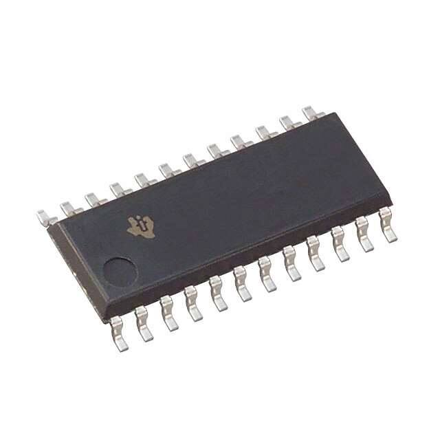

SN74LVC8T245NSR
SN74LVC8T245NSR
    BURR-BROWN(德州仪器)
    SOIC24_200MIL
    IC TRANSLATION TXRX 5.5V 24SO
SN74LVC8T245NSR 数据手册
SN74LVC8T245 SCES584C – JUNE 2005 – REVISED DECEMBER 2022 SN74LVC8T245 8-Bit Dual-Supply Bus Transceiver With Configurable Voltage Translation and 3-State Outputs 1 Features 3 Description • The SN74LVC8T245 is an eight bit non-inverting bus transceiver with configurable dual power supply rails that enables bidirectional voltage level translation. The SN74LVC8T245 is optimized to operate with VCCA and VCCB set at 1.65 V to 5.5 V. The A port is designed to track VCCA. VCCA accepts any supply voltage from 1.65 V to 5.5 V. The B port is designed to track VCCB. VCCB accepts any supply voltage from 1.65 V to 5.5 V. This allows for universal low-voltage bidirectional translation between any of the 1.8-V, 2.5V, 3.3-V, and 5.5-V voltage nodes. • • • • Control inputs VIH/VIL levels are referenced to VCCA voltage VCC isolation feature – if either VCC input is at GND, all are in the high-impedance state Fully configurable dual-rail design allows each port to operate over the full 1.65-V to 5.5-V powersupply range Latch-up performance exceeds 100 mA per JESD 78, class II ESD protection exceeds JESD 22 – 4000-V Human-Body Model (A114-A) – 100-V Machine Model (A115-A) – 1000-V Charged-Device Model (C101) 2 Applications • • • • Personal electronic Industrial Enterprise Telecom 2 DIR 22 OE 3 A1 21 B1 To Seven Other Channels Logic Diagram (Positive Logic) The SN74LVC8T245 is designed for asynchronous communication between two data buses. The logic levels of the direction-control (DIR) input and the output-enable (OE) input activate either the B-port outputs or the A-port outputs or place both output ports into the high-impedance mode. The device transmits data from the A bus to the B bus when the B-port outputs are activated, and from the B bus to the A bus when the A-port outputs are activated. The input circuitry on both A and B ports is always active and must have a logic HIGH or LOW level applied to prevent excess ICC and ICCZ. This device is fully specified for partial-power-down applications using Ioff. The Ioff circuitry disables the outputs, preventing damaging current backflow through the device when it is powered down. The VCC isolation feature ensures that if either VCC input is at GND, all outputs are in the high-impedance state. To ensure the high-impedance state during power up or power down, OE should be tied to VCC through a pullup resistor; the minimum value of the resistor is determined by the current-sinking capability of the driver. The SN74LVC8T245 is designed so that the control pins (DIR and OE) are supplied by VCCA. Package Information PART NUMBER SN74LVC8T245 (1) PACKAGE(1) BODY SIZE (NOM) DBV (SSOP, 24) 8.20 mm × 5.30 mm DBQ (SSOP, 24) 8.65 mm × 3.90 mm PW (TSSOP, 24) 7.80 mm × 4.40 mm DGV (TVSOP, 24) 5.00 mm × 4.40 mm RHL (VQFN, 24) 5.50 mm × 3.50 mm For all available packages, see the orderable addendum at the end of the data sheet. An IMPORTANT NOTICE at the end of this data sheet addresses availability, warranty, changes, use in safety-critical applications, intellectual property matters and other important disclaimers. PRODUCTION DATA. SN74LVC8T245 www.ti.com SCES584C – JUNE 2005 – REVISED DECEMBER 2022 Table of Contents 1 Features............................................................................1 2 Applications..................................................................... 1 3 Description.......................................................................1 4 Revision History.............................................................. 2 5 Pin Configuration and Functions...................................3 6 Specifications.................................................................. 4 6.1 Absolute Maximum Ratings........................................ 4 6.2 ESD Ratings............................................................... 4 6.3 Recommended Operating Conditions ........................5 6.4 Thermal Information DB, DBQ and DGV.................... 6 6.5 Thermal Information PW and RHL..............................6 6.6 Electrical Characteristics ............................................7 6.7 Switching Characteristics, VCCA = 1.8 V ± 0.15 V.......8 6.8 Switching Characteristics, VCCA = 2.5 V ± 0.2 V.........8 6.9 Switching Characteristics, VCCA = 3.3 V ± 0.3 V.........9 6.10 Switching Characteristics, VCCA = 5 V ± 0.5 V..........9 6.11 Operating Characteristics..........................................9 6.12 Typical Characteristics............................................ 10 7 Parameter Measurement Information.......................... 11 8 Detailed Description......................................................12 8.1 Overview................................................................... 12 8.2 Functional Block Diagram......................................... 12 8.3 Feature Description...................................................12 8.4 Device Functional Modes..........................................13 9 Application and Implementation.................................. 14 9.1 Application Information............................................. 14 9.2 Typical Application.................................................... 14 10 Power Supply Recommendations..............................15 11 Layout........................................................................... 16 11.1 Layout Guidelines................................................... 16 11.2 Layout Example...................................................... 16 12 Device and Documentation Support..........................17 12.1 Receiving Notification of Documentation Updates..17 12.2 Support Resources................................................. 17 12.3 Trademarks............................................................. 17 12.4 Electrostatic Discharge Caution..............................17 12.5 Glossary..................................................................17 13 Mechanical, Packaging, and Orderable Information.................................................................... 17 4 Revision History NOTE: Page numbers for previous revisions may differ from page numbers in the current version. Changes from Revision B (November 2014) to Revision C (December 2022) Page • Removed Machine Model specification.............................................................................................................. 1 • Updated the numbering format for tables, figures, and cross-references throughout the document..................1 • Updated the ESD Ratings section (was called Handling Ratings)......................................................................4 • Updated thermals in the Thermal Informations section. .................................................................................... 6 • Increased max switching characterisitics specs for VccB = 5V.......................................................................... 8 • Updated the Overview section..........................................................................................................................12 • Added the Balanced High-Drive CMOS Push-Pull Outputs and VCC Isolation sections...................................12 • Updated the Power Supply Recommendations section....................................................................................15 Changes from Revision A (June 2005) to Revision B (November 2014) Page • Added the list of Application, Pin Functions table, Handling Rating table, Feature Description section, Device Functional Modes, Application and Implementation section, Power Supply Recommendations section, Layout section, Device and Documentation Support section, and Mechanical, Packaging, and Orderable Information section. .............................................................................................................................................................. 1 • Changed Feature From: 200-V Machine Model (A115-A) To: 100-V Machine Model (A115-A) ........................ 1 Changes from Revision * (June 2005) to Revision A (August 2005) Page • Changed the device From: Product Preview To: Production.............................................................................. 1 2 Submit Document Feedback Copyright © 2022 Texas Instruments Incorporated Product Folder Links: SN74LVC8T245 SN74LVC8T245 www.ti.com SCES584C – JUNE 2005 – REVISED DECEMBER 2022 23 VCCB A1 3 22 OE A2 4 21 B1 A3 5 20 B2 A4 6 19 B3 24 2 1 DIR VCCB VCCA 5 Pin Configuration and Functions Thermal Pad B4 A6 8 17 B5 A7 9 16 B6 A8 10 15 B7 GND 11 14 B8 GND 13 18 12 7 GND Figure 5-1. DW, NS, DB, DBQ, DGV, or PW Package, 24-Pin SOIC, SO, SSOP, SSOP, TVSOP, or TSSOP (Top View) A5 Not to scale Figure 5-2. RHL Package, 24-Pin VQFN (Top View) Table 5-1. Pin Functions PIN NAME NO. TYPE(1) DESCRIPTION A1 3 I/O Input/output A1. Referenced to VCCA. A2 4 I/O Input/output A2. Referenced to VCCA. A3 5 I/O Input/output A3. Referenced to VCCA. A4 6 I/O Input/output A4. Referenced to VCCA. A5 7 I/O Input/output A5. Referenced to VCCA. A6 8 I/O Input/output A6. Referenced to VCCA. A7 9 I/O Input/output A7. Referenced to VCCA. A8 10 I/O Input/output A8. Referenced to VCCA. B1 21 I/O Input/output B1. Referenced to VCCB. B2 20 I/O Input/output B2. Referenced to VCCB. B3 19 I/O Input/output B3. Referenced to VCCB. B4 18 I/O Input/output B4. Referenced to VCCB. B5 17 I/O Input/output B5. Referenced to VCCB. B6 16 I/O Input/output B6. Referenced to VCCB. B7 15 I/O Input/output B7. Referenced to VCCB. B8 14 I/O Input/output B8. Referenced to VCCB. DIR 2 I Direction-control signal. GND 11, 12, 13 G Ground OE 22 I 3-state output-mode enables. Pull OE high to place all outputs in 3-state mode. Referenced to VCCA. VCCA 1 P A-port supply voltage. 1.65 V ≤ VCCA ≤ 5.5 V VCCB 23, 24 P B-port supply voltage. 1.65 V ≤ VCCB ≤ 5.5 V Thermal Pad(2) (1) (2) — I = input, O = output, P = power For the RHL package only Submit Document Feedback Copyright © 2022 Texas Instruments Incorporated Product Folder Links: SN74LVC8T245 3 SN74LVC8T245 www.ti.com SCES584C – JUNE 2005 – REVISED DECEMBER 2022 6 Specifications 6.1 Absolute Maximum Ratings over operating free-air temperature range (unless otherwise noted) (1) MIN MAX –0.5 6.5 I/O ports (A port) –0.5 6.5 I/O ports (B port) –0.5 6.5 Control inputs –0.5 6.5 A port –0.5 6.5 B port –0.5 6.5 A port –0.5 VCCA + 0.5 B port –0.5 VCCB + 0.5 Supply voltage range, VCCA, VCCB Input voltage range(2) VI UNIT V V VO Voltage range applied to any output in the high-impedance or power-off state(2) VO Voltage range applied to any output in the high or low state(2) (3) IIK Input clamp current VI < 0 –50 mA IOK Output clamp current VO < 0 –50 mA IO Continuous output current Continuous current through each VCCA, VCCB, and GND Tstg Storage temperature TJ Junction temperature (1) (2) (3) V V ±50 mA ±100 mA 150 °C 150 °C -65 Stresses beyond those listed under "absolute maximum ratings" may cause permanent damage to the device. These are stress ratings only, and functional operation of the device at these or any other conditions beyond those indicated under "recommended operating conditions" is not implied. Exposure to absolute-maximum-rated conditions for extended periods may affect device reliability. The input and output negative-voltage ratings may be exceeded if the input and output current ratings are observed. The output positive-voltage rating may be exceeded up to 6.5 V maximum if the output current rating is observed. 6.2 ESD Ratings V(ESD) (1) (2) 4 Electrostatic discharge MIN MAX Human body model (HBM), per ANSI/ESDA/JEDEC JS-001, all pins(1) –4000 4000 Charged device model (CDM), per JEDEC specification JESD22-C101, all pins(2) –1000 1000 UNIT V JEDEC document JEP155 states that 500-V HBM allows safe manufacturing with a standard ESD control process. JEDEC document JEP157 states that 250-V CDM allows safe manufacturing with a standard ESD control process. Submit Document Feedback Copyright © 2022 Texas Instruments Incorporated Product Folder Links: SN74LVC8T245 SN74LVC8T245 www.ti.com SCES584C – JUNE 2005 – REVISED DECEMBER 2022 6.3 Recommended Operating Conditions (1) (2) (3) (4) VCCA VCCI VCCO Supply voltage VCCB 1.65 V to 1.95 V High-level input voltage VIH MAX 1.65 5.5 1.65 5.5 1.7 3 V to 3.6 V VCCI × 0.7 1.65 V to 1.95 V Low-level input voltage Data inputs(5) VCCI × 0.35 2.3 V to 2.7 V 0.7 3 V to 3.6 V 0.8 4.5 V to 5.5 V High-level input voltage Control inputs (referenced to VCCA)(6) VCCA × 0.65 2.3 V to 2.7 V 1.7 3 V to 3.6 V VCCA × 0.7 1.65 V to 1.95 V Low-level input voltage Control inputs (referenced to VCCA)(6) VCCA × 0.35 2.3 V to 2.7 V 0.7 3 V to 3.6 V 0.8 4.5 V to 5.5 V VI VI/O Input voltage Control inputs 0 5.5 V Input/output voltage Active state 0 VCCO V 0 5.5 V 3-State High-level output current –4 2.3 V to 2.7 V –8 3 V to 3.6 V –24 4.5 V to 5.5 V –32 1.65 V to 1.95 V IOL Low-level output current Δt/Δv(7) TA (1) (2) (3) (4) (5) (6) (7) V VCCA × 0.3 1.65 V to 1.95 V IOH V 2 4.5 V to 5.5 V VIL V VCCI × 0.3 1.65 V to 1.95 V VIH V V 2 4.5 V to 5.5 V VIL UNIT VCCI × 0.65 2.3 V to 2.7 V Data inputs(5) MIN Input transition rise or fall rate Data inputs 4 2.3 V to 2.7 V 8 3 V to 3.6 V 24 4.5 V to 5.5 V 32 1.65 V to 1.95 V 20 2.3 V to 2.7 V 20 3 V to 3.6 V 10 4.5 V to 5.5 V 5 Operating free-air temperature mA –40 85 mA ns/V °C VCCI is the VCC associated with the data input port. VCCO is the VCC associated with the output port. All unused or driven (floating) data inputs (I/Os) of the device must be held at logic HIGH or LOW (preferably VCCI or GND) to ensure proper device operation and minimize power. Refer to the TI application report, Implications of Slow or Floating CMOS Inputs, literature number SCBA004. All unused control inputs must be held at VCCA or GND to ensure proper device operation and minimize power comsumption. For VCCI values not specified in the data sheet, VIH min = VCCI × 0.7 V, VIL max = VCCI × 0.3 V. For VCCA values not specified in the data sheet, VIH min = VCCA × 0.7 V, VIL max = VCCA × 0.3 V. Maximum input transition rate with < 4 channels switching simultaneously. Submit Document Feedback Copyright © 2022 Texas Instruments Incorporated Product Folder Links: SN74LVC8T245 5 SN74LVC8T245 www.ti.com SCES584C – JUNE 2005 – REVISED DECEMBER 2022 6.4 Thermal Information DB, DBQ and DGV THERMAL METRIC(1) DB DBQ DGV 24 PINS 24 PINS 24 PINS RθJA Junction-to-ambient thermal resistance 90.7 81.2 91.1 RθJC(top) Junction-to-case (top) thermal resistance 51.9 44.8 23.7 RθJB Junction-to-board thermal resistance 49.7 34.5 44.5 ψJT Junction-to-top characterization parameter 18.8 9.5 0.6 ψJB Junction-to-board characterization parameter 49.3 37.2 44.1 RθJC(bot) Junction-to-case (bottom) thermal resistance N/A N/A N/A (1) UNIT °C/W For more information about traditional and new thermal metrics, see the IC Package Thermal Metrics application report, SPRA953. 6.5 Thermal Information PW and RHL THERMAL METRIC(1) RHL 24 PINS 24 PINS RθJA Junction-to-ambient thermal resistance 100.6 48.3 RθJC(top) Junction-to-case (top) thermal resistance 44.7 46.1 RθJB Junction-to-board thermal resistance 55.8 26.1 ψJT Junction-to-top characterization parameter 6.8 4.6 ψJB Junction-to-board characterization parameter 55.4 26.0 RθJC(bot) Junction-to-case (bottom) thermal resistance N/A 15.7 (1) 6 PW UNIT °C/W For more information about traditional and new thermal metrics, see the IC Package Thermal Metrics application report, SPRA953. Submit Document Feedback Copyright © 2022 Texas Instruments Incorporated Product Folder Links: SN74LVC8T245 SN74LVC8T245 www.ti.com SCES584C – JUNE 2005 – REVISED DECEMBER 2022 6.6 Electrical Characteristics over recommended operating free-air temperature range (unless otherwise noted) PARAMETER(1) (2) VOH VOL II DIR VCCA VCCB IOH = –100 μA, TEST CONDITIONS VI = VIH 1.65 V to 4.5 V 1.65 V to 4.5 V IOH = –4 mA, VI = VIH 1.65 V 1.65 V 1.2 IOH = –8 mA, VI = VIH 2.3 V 2.3 V 1.9 IOH = –24 mA, VI = VIH 3V 3V 2.4 IOH = –32 mA, VI = VIH 4.5 V 4.5 V 3.8 IOL = 100 μA, VI = VIL 1.65 V to 4.5 V 1.65 V to 4.5 V 0.1 IOL = 4 mA, VI = VIL 1.65 V 1.65 V 0.45 IOL = 8 mA, VI = VIL 2.3 V 2.3 V 0.3 IOL = 24 mA, VI = VIL 3V 3V 0.55 IOL = 32 mA, VI = VIL 4.5 V 4.5 V 1.65 V to 5.5 V 1.65 V to 5.5 V ±1 ±2 0V 0 to 5.5 V ±1 ±2 0 to 5.5 V 0V ±1 ±2 1.65 V to 5.5 V 1.65 V to 5.5 V ±1 ±2 1.65 V to 5.5 V 1.65 V to 5.5 V 15 5V 0V 15 0V 5V –2 1.65 V to 5.5 V 1.65 V to 5.5 V 15 5V 0V –2 0V 5V 15 1.65 V to 5.5 V 1.65 V to 5.5 V 25 VI = VCCA or GND Ioff A or B port VI or VO = 0 to 5.5 V IOZ A or B port VO = VCCO or GND, OE = VIH ICCA VI = VCCI or GND, ICCB VI = VCCI or GND, ICCA + ICCB VI = VCCI or GND, IO = 0 IO = 0 IO = 0 A port One A port at VCCA – 0.6 V, DIR at VCCA, B port = open DIR DIR at VCCA – 0.6 V, B port = open, A port at VCCA or GND ΔICCB B port One B port at VCCB – 0.6 V, DIR at GND, A port = open Ci Control inputs Cio A or B port ΔICCA (1) (2) MIN TYP MAX MIN MAX UNIT VCCO – 0.1 V V 0.55 μA μA μA μA μA μA 50 3 V to 5.5 V 3 V to 5.5 V μA 50 3 V to 5.5 V 3 V to 5.5 V VI = VCCA or GND 3.3 V 3.3 V VO = VCCA/B or GND 3.3 V 3.3 V 50 μA 4 5 pF 8.5 10 pF VCCO is the VCC associated with the output port. VCCI is the VCC associated with the input port. Submit Document Feedback Copyright © 2022 Texas Instruments Incorporated Product Folder Links: SN74LVC8T245 7 SN74LVC8T245 www.ti.com SCES584C – JUNE 2005 – REVISED DECEMBER 2022 6.7 Switching Characteristics, VCCA = 1.8 V ± 0.15 V over recommended operating free-air temperature range, VCCA = 1.8 V ± 0.15 V (unless otherwise noted) (see Figure 7-1) PARAMETER tPLH tPHL tPLH tPHL tPHZ tPLZ tPHZ tPLZ tPZH tPZL tPZH tPZL FROM (INPUT) TO (OUTPUT) A VCCB = 1.8 V ± 0.15 V VCCB = 2.5 V ± 0.2 V VCCB = 3.3 V ± 0.3 V VCCB = 5 V ± 0.5 V UNIT MIN MAX MIN MAX MIN MAX MIN MAX B 1.7 21.9 1.3 9.2 1 7.4 0.8 7.1 ns B A 0.9 23.8 0.8 23.6 0.7 23.4 0.7 23.4 ns OE A 1.5 29.6 1.5 29.4 1.5 29.3 1.4 29.2 ns OE B 2.4 32.2 1.9 13.1 1.7 12 1.3 10.3 ns OE A 0.4 24 0.4 23.8 0.4 23.7 0.4 23.7 ns OE B 1.8 32 1.5 16 1.2 12.6 0.9 12 ns 6.8 Switching Characteristics, VCCA = 2.5 V ± 0.2 V over recommended operating free-air temperature range, VCCA = 2.5 V ± 0.2 V (unless otherwise noted) (see Figure 7-1) PARAMETER tPLH tPHL tPLH tPHL tPHZ tPLZ tPHZ tPLZ tPZH tPZL tPZH tPZL 8 VCCB = 1.8 V ± 0.15 V FROM (INPUT) TO (OUTPUT) A B 1.5 B A OE MIN MAX VCCB = 2.5 V ± 0.2 V VCCB = 3.3 V ± 0.3 V VCCB = 5 V ± 0.5 V UNIT MIN MAX MIN MAX MIN MAX 21.4 1.2 9 0.8 6.2 0.6 4.8 ns 1.2 9.3 1 9.1 1 8.9 0.9 8.8 ns A 1.4 9 1.4 9 1.4 9 1.4 9 ns OE B 2.3 29.6 1.8 11 1.7 9.3 0.9 6.9 ns OE A 1 10.9 1 10.9 1 10.9 1 10.9 ns OE B 1.7 28.2 1.5 12.9 1.2 9.4 1 7.5 ns Submit Document Feedback Copyright © 2022 Texas Instruments Incorporated Product Folder Links: SN74LVC8T245 SN74LVC8T245 www.ti.com SCES584C – JUNE 2005 – REVISED DECEMBER 2022 6.9 Switching Characteristics, VCCA = 3.3 V ± 0.3 V over recommended operating free-air temperature range, VCCA = 3.3 V ± 0.3 V (unless otherwise noted) (see Figure 7-1) PARAMETER tPLH tPHL tPLH tPHL tPHZ tPLZ tPHZ tPLZ tPZH tPZL tPZH tPZL VCCB = 1.8 V ± 0.15 V FROM (INPUT) TO (OUTPUT) A B 1.5 B A OE VCCB = 2.5 V ± 0.2 V MIN MAX VCCB = 3.3 V ± 0.3 V VCCB = 5 V ± 0.5 V UNIT MIN MAX MIN MAX MIN MAX 21.2 1.1 8.8 0.8 6.3 0.5 4.4 ns 0.8 7.2 0.8 6.2 0.7 6.1 0.6 6 ns A 1.6 8.2 1.6 8.2 1.6 8.2 1.6 8.2 ns OE B 2.1 29 1.7 10.3 1.5 8.6 0.8 6.3 ns OE A 0.8 8.1 0.8 8.1 0.8 8.1 0.8 8.1 ns OE B 1.8 27.7 1.4 12.4 1.1 8.8 0.9 6.8 ns 6.10 Switching Characteristics, VCCA = 5 V ± 0.5 V over recommended operating free-air temperature range, VCCA = 5 V ± 0.5 V (unless otherwise noted) (see Figure 7-1) PARAMETER tPLH tPHL tPLH tPHL tPHZ tPLZ tPHZ tPLZ tPZH tPZL tPZH tPZL FROM (INPUT) TO (OUTPUT) A VCC = 1.8 V ± 0.15 V VCC = 2.5 V ± 0.2 V VCC = 3.3 V ± 0.3 V VCC = 5 V ± 0.5 V MIN MAX UNIT MIN MAX MIN MAX MIN MAX B 1.5 21.4 1 8.8 0.7 6 0.4 4.2 ns B A 0.7 7 0.4 4.8 0.3 4.5 0.3 4.3 ns OE A 0.3 5.4 0.3 5.4 0.3 5.4 0.3 5.4 ns OE B 2 28.7 1.6 9.7 1.4 8 0.7 5.7 ns OE A 0.7 6.4 0.7 6.4 0.7 6.4 0.7 6.4 ns OE B 1.5 27.6 1.3 11.4 1 8.8 0.9 6.6 ns 6.11 Operating Characteristics TA = 25°C PARAMETER CpdA (1) CpdB (1) (1) TEST CONDITIONS A-port input, B-port output B-port input, A-port output A-port input, B-port output CL = 0, f = 10 MHz, tr = tf = 1 ns B-port input, A-port output VCCA = VCCB = 1.8 V VCCA = VCCB = 2.5 V VCCA = VCCB = 3.3 V VCCA = VCCB = 5 V TYP TYP TYP TYP 2 2 2 3 12 13 13 16 13 13 14 16 2 2 2 3 UNIT pF Power dissipation capacitance per transceiver Submit Document Feedback Copyright © 2022 Texas Instruments Incorporated Product Folder Links: SN74LVC8T245 9 SN74LVC8T245 www.ti.com SCES584C – JUNE 2005 – REVISED DECEMBER 2022 1.4 5.6 1.2 5.4 1.0 5.2 VOH Voltage (V) VOL Voltage (V) 6.12 Typical Characteristics 0.8 0.6 0.4 4.8 4.6 o -40 C o 25 C 0.2 5.0 o -40 C o 25 C 4.4 o o 85 C 85 C 4.2 0 0 20 40 60 80 100 0 -20 IOL Current (mA) Figure 6-1. Voltage vs Current 10 -40 -60 -80 -100 IOH Current (mA) Figure 6-2. Voltage vs Current Submit Document Feedback Copyright © 2022 Texas Instruments Incorporated Product Folder Links: SN74LVC8T245 SN74LVC8T245 www.ti.com SCES584C – JUNE 2005 – REVISED DECEMBER 2022 7 Parameter Measurement Information 2 × VCCO S1 RL From Output Under Test Open GND CL (see Note A) TEST S1 tpd tPLZ/tPZL tPHZ/tPZH Open 2 × VCCO GND RL tw LOAD CIRCUIT VCCI VCCI/2 Input VCCO CL RL VTP 1.8 V ± 0.15 V 2.5 V ± 0.2 V 3.3 V ± 0.3 V 5 V ± 0.5 V 15 pF 15 pF 15 pF 15 pF 2 kΩ 2 kΩ 2 kΩ 2 kΩ 0.15 V 0.15 V 0.3 V 0.3 V VCCI/2 0V VOLTAGE WAVEFORMS PULSE DURATION VCCA Output Control (low-level enabling) VCCA/2 VCCA/2 0V tPLZ tPZL VCCI Input VCCI/2 VCCI/2 0V tPLH Output tPHL VOH VCCO/2 VOL VCCO/2 VCCO Output Waveform 1 S1 at 2 × VCCO (see Note B) VCCO/2 VOL + VTP VOL tPHZ tPZH Output Waveform 2 S1 at GND (see Note B) VOLTAGE WAVEFORMS PROPAGATION DELAY TIMES VCCO/2 VOH − VTP VOH 0V VOLTAGE WAVEFORMS ENABLE AND DISABLE TIMES NOTES: A. CL includes probe and jig capacitance. B. Waveform 1 is for an output with internal conditions such that the output is low, except when disabled by the output control. Waveform 2 is for an output with internal conditions such that the output is high, except when disabled by the output control. C. All input pulses are supplied by generators having the following characteristics: PRRv10 MHz, ZO = 50 Ω, dv/dt ≥ 1 V/ns. D. The outputs are measured one at a time, with one transition per measurement. E. tPLZ and tPHZ are the same as tdis. F. tPZL and tPZH are the same as ten. G. tPLH and tPHL are the same as tpd. H. VCCI is the VCC associated with the input port. I. VCCO is the VCC associated with the output port. J. All parameters and waveforms are not applicable to all devices. Figure 7-1. Load Circuit and Voltage Waveforms Submit Document Feedback Copyright © 2022 Texas Instruments Incorporated Product Folder Links: SN74LVC8T245 11 SN74LVC8T245 www.ti.com SCES584C – JUNE 2005 – REVISED DECEMBER 2022 8 Detailed Description 8.1 Overview The SN74LVC8T245 is an eight bit non-inverting bus transceiver with configurable dual power supply rails that enables bidirectional voltage level translation. Pin Ax and direction control pin are support by VCCA and pin Bx is support by VCCB. The A port is able to accept I/O voltages ranging from 1.65 V to 5.5 V, while the B port can accept I/O voltages from 1.65 V to 5.5 V. The high on DIR allows data transmission from A to B and a low on DIR allows data transmission from B to A. For voltage level translation below 1.65 V, see TI AXC products. 8.2 Functional Block Diagram 2 DIR 22 OE 3 A1 21 B1 To Seven Other Channels 8.3 Feature Description 8.3.1 Fully Configurable Dual-Rail Design Allows Each Port to Operate Over the Full 1.65-V to 5.5-V Power-Supply Range Both VCCA and VCCB can be supplied at any voltage between 1.65 V and 5.5 V making the device suitable for translating between any of the voltage nodes (1.8 V, 2.5 V, 3.3 V, and 5 V). 8.3.2 Ioff Supports Partial-Power-Down Mode Operation Ioff prevents backflow current by disabling I/O output circuits when device is in partial-power-down mode.The inputs and outputs for this device enter a high-impedance state when the device is powered down, inhibiting current backflow into the device. The maximum leakage into or out of any input or output pin on the device is specified by Ioff in the Electrical Characteristics. 8.3.3 Balanced High-Drive CMOS Push-Pull Outputs A balanced output allows the device to sink and source similar currents. The high drive capability of this device creates fast edges into light loads so routing and load conditions should be considered to prevent ringing. Additionally, the outputs of this device are capable of driving larger currents than the device can sustain without being damaged. Two outputs can be connected together for 2X stronger output drive strength. The electrical and thermal limits defined in the Absolute Maximum Ratings must be followed at all times. 8.3.4 Vcc Isolation The I/O's of both ports will enter a high-impedance state when either of the supplies are at GND, while the other supply is still connected to the device. The maximum leakage into or out of any input or output pin on the device is specified by Ioff in the Electrical Characteristics. 12 Submit Document Feedback Copyright © 2022 Texas Instruments Incorporated Product Folder Links: SN74LVC8T245 SN74LVC8T245 www.ti.com SCES584C – JUNE 2005 – REVISED DECEMBER 2022 8.4 Device Functional Modes The SN74LVC8T245 is voltage level translator that can operate from 1.65 V to 5.5 V (VCCA and VCCB). The signal translation between 1.65 V and 5.5 V requires direction control and output enable control. When OE is low and DIR is high, data transmission is from A to B. When OE is low and DIR is low, data transmission is from B to A. When OE is high, both output ports will be high-impedance. For voltage level translation below 1.65V, see TI AXC products. Table 8-1. Function Table (Each 8-Bit Section) CONTROL INPUTS(1) OE (1) OUTPUT CIRCUITS DIR A PORT OPERATION B PORT L L Enabled Hi-Z B data to A bus L H Hi-Z Enabled A data to B bus H X Hi-Z Hi-Z Isolation Input circuits of the data I/Os are always active. Submit Document Feedback Copyright © 2022 Texas Instruments Incorporated Product Folder Links: SN74LVC8T245 13 SN74LVC8T245 www.ti.com SCES584C – JUNE 2005 – REVISED DECEMBER 2022 9 Application and Implementation Note Information in the following applications sections is not part of the TI component specification, and TI does not warrant its accuracy or completeness. TI’s customers are responsible for determining suitability of components for their purposes, as well as validating and testing their design implementation to confirm system functionality. 9.1 Application Information The SN74LVC8T245 device can be used in level-translation applications for interfacing devices or systems operating at different interface voltages with one another. The maximum output current can be up to 32 mA when device is powered by 5 V. It is recommended to tie all unused I/Os to GND. The device should not have any floating I/Os when changing translation direction. 9.2 Typical Application 1.8V 5V 0.1 F 0.1 F VCCA 1 µF VCCB DIR OE 1.8V Controller Data GND 5V System SN74LVC8T245 A1 B1 A2 B2 A3 B3 A4 B4 A5 B5 A6 B6 A7 B7 A8 B8 GND Data GND Figure 9-1. Typical Application Circuit 14 Submit Document Feedback Copyright © 2022 Texas Instruments Incorporated Product Folder Links: SN74LVC8T245 SN74LVC8T245 www.ti.com SCES584C – JUNE 2005 – REVISED DECEMBER 2022 9.2.1 Design Requirements For this design example, use the parameters listed in Table 9-1. Table 9-1. Design Parameters PARAMETERS VALUES Input voltage range 1.65 V to 5.5 V Output voltage 1.65 V to 5.5 V 9.2.2 Detailed Design Procedure To begin the design process, determine the following: • Input voltage range – Use the supply voltage of the device that is driving the SN74LVC8T245 device to determine the input voltage range. For a valid logic high, the value must exceed the VIH of the input port. For a valid logic low, the value must be less than the VIL of the input port. • Output voltage range – Use the supply voltage of the device that the SN74LVC8T245 device is driving to determine the output voltage range. 9.2.3 Application Curve Voltage (V) Output (5 V) Input (1.8 V) Time (200 ns/div) Figure 9-2. Translation Up (1.8 V to 5 V) at 2.5 MHz 10 Power Supply Recommendations The SN74LVC8T245 device uses two separate configurable power-supply rails, VCCA and VCCB. VCCA accepts any supply voltage from 1.65 V to 5.5 V and VCCB accepts any supply voltage from 1.65 V to 5.5 V. The A port and B port are designed to track VCCA and VCCB respectively allowing for low-voltage bidirectional translation between any of the 1.8-V, 2.5 -V, 3.3-V and 5-V voltage nodes. The recommendation is to first power-up the input supply rail to help avoid internal floating while the output supply rail ramps up. However, both power-supply rails can be ramped up simultaneously. Submit Document Feedback Copyright © 2022 Texas Instruments Incorporated Product Folder Links: SN74LVC8T245 15 SN74LVC8T245 www.ti.com SCES584C – JUNE 2005 – REVISED DECEMBER 2022 11 Layout 11.1 Layout Guidelines To ensure reliability of the device, following common printed-circuit board layout guidelines is recommended. • • • Bypass capacitors should be used on power supplies. Short trace lengths should be used to avoid excessive loading. Placing pads on the signal paths for loading capacitors or pullup resistors helps adjust rise and fall times of signals depending on the system requirements. 11.2 Layout Example LEGEND VIA to Power Plane Polygonal Copper Pour VIA to GND Plane (Inner Layer) VCC VCC B A Bypass Capacitor Bypass Capacitor VCC 1 VCC 24 VCC A 2 A B Keep OE high until VCCA and VCCB are powered up VCC 23 DIR B From Controller 3 A1 OE 22 From Controller 4 A2 B1 21 To System From Controller 5 A3 B2 20 To System From Controller 6 A4 B3 19 To System From Controller 7 A5 B4 18 To System From Controller 8 A6 B5 17 To System From Controller 9 A7 B6 16 To System From Controller 10 A8 B7 15 To System 11 GND B8 14 To System 12 GND GN D 13 SN74LVC8T245-Q1 Figure 11-1. SN74LVC8T245 Layout 16 Submit Document Feedback Copyright © 2022 Texas Instruments Incorporated Product Folder Links: SN74LVC8T245 SN74LVC8T245 www.ti.com SCES584C – JUNE 2005 – REVISED DECEMBER 2022 12 Device and Documentation Support TI offers an extensive line of development tools. Tools and software to evaluate the performance of the device, generate code, and develop solutions are listed below. 12.1 Receiving Notification of Documentation Updates To receive notification of documentation updates, navigate to the device product folder on ti.com. Click on Subscribe to updates to register and receive a weekly digest of any product information that has changed. For change details, review the revision history included in any revised document. 12.2 Support Resources TI E2E™ support forums are an engineer's go-to source for fast, verified answers and design help — straight from the experts. Search existing answers or ask your own question to get the quick design help you need. Linked content is provided "AS IS" by the respective contributors. They do not constitute TI specifications and do not necessarily reflect TI's views; see TI's Terms of Use. 12.3 Trademarks TI E2E™ is a trademark of Texas Instruments. All trademarks are the property of their respective owners. 12.4 Electrostatic Discharge Caution This integrated circuit can be damaged by ESD. Texas Instruments recommends that all integrated circuits be handled with appropriate precautions. Failure to observe proper handling and installation procedures can cause damage. ESD damage can range from subtle performance degradation to complete device failure. Precision integrated circuits may be more susceptible to damage because very small parametric changes could cause the device not to meet its published specifications. 12.5 Glossary TI Glossary This glossary lists and explains terms, acronyms, and definitions. 13 Mechanical, Packaging, and Orderable Information The following pages include mechanical packaging and orderable information. This information is the most current data available for the designated devices. This data is subject to change without notice and revision of this document. For browser-based versions of this data sheet, refer to the left-hand navigation. Submit Document Feedback Copyright © 2022 Texas Instruments Incorporated Product Folder Links: SN74LVC8T245 17 PACKAGE OPTION ADDENDUM www.ti.com 13-Dec-2022 PACKAGING INFORMATION Orderable Device Status (1) Package Type Package Pins Package Drawing Qty Eco Plan (2) Lead finish/ Ball material MSL Peak Temp Op Temp (°C) Device Marking (3) Samples (4/5) (6) 74LVC8T245DBQRG4 ACTIVE SSOP DBQ 24 2500 RoHS & Green NIPDAU Level-2-260C-1 YEAR -40 to 85 LVC8T245 Samples 74LVC8T245RHLRG4 ACTIVE VQFN RHL 24 1000 RoHS & Green NIPDAU Level-2-260C-1 YEAR -40 to 85 NH245 Samples SN74LVC8T245DBQR ACTIVE SSOP DBQ 24 2500 RoHS & Green NIPDAU Level-2-260C-1 YEAR -40 to 85 LVC8T245 Samples SN74LVC8T245DBR ACTIVE SSOP DB 24 2000 RoHS & Green NIPDAU Level-1-260C-UNLIM -40 to 85 NH245 Samples SN74LVC8T245DBRG4 ACTIVE SSOP DB 24 2000 RoHS & Green NIPDAU Level-1-260C-UNLIM -40 to 85 NH245 Samples SN74LVC8T245DGVR ACTIVE TVSOP DGV 24 2000 RoHS & Green NIPDAU Level-1-260C-UNLIM -40 to 85 NH245 Samples SN74LVC8T245DGVRG4 ACTIVE TVSOP DGV 24 2000 RoHS & Green NIPDAU Level-1-260C-UNLIM -40 to 85 NH245 Samples SN74LVC8T245DWR ACTIVE SOIC DW 24 2000 RoHS & Green NIPDAU Level-1-260C-UNLIM -40 to 85 LVC8T245 Samples SN74LVC8T245DWRG4 ACTIVE SOIC DW 24 2000 RoHS & Green NIPDAU Level-1-260C-UNLIM -40 to 85 LVC8T245 Samples SN74LVC8T245NSR ACTIVE SO NS 24 2000 RoHS & Green NIPDAU Level-1-260C-UNLIM -40 to 85 LVC8T245 Samples SN74LVC8T245PW ACTIVE TSSOP PW 24 60 RoHS & Green NIPDAU Level-1-260C-UNLIM -40 to 85 NH245 Samples SN74LVC8T245PWG4 ACTIVE TSSOP PW 24 60 RoHS & Green NIPDAU Level-1-260C-UNLIM -40 to 85 NH245 Samples SN74LVC8T245PWR ACTIVE TSSOP PW 24 2000 RoHS & Green NIPDAU Level-1-260C-UNLIM -40 to 85 NH245 Samples SN74LVC8T245PWRE4 ACTIVE TSSOP PW 24 2000 RoHS & Green NIPDAU Level-1-260C-UNLIM -40 to 85 NH245 Samples SN74LVC8T245PWRG4 ACTIVE TSSOP PW 24 2000 RoHS & Green NIPDAU Level-1-260C-UNLIM -40 to 85 NH245 Samples SN74LVC8T245RHLR ACTIVE VQFN RHL 24 1000 RoHS & Green NIPDAU Level-2-260C-1 YEAR -40 to 85 NH245 Samples (1) The marketing status values are defined as follows: ACTIVE: Product device recommended for new designs. LIFEBUY: TI has announced that the device will be discontinued, and a lifetime-buy period is in effect. NRND: Not recommended for new designs. Device is in production to support existing customers, but TI does not recommend using this part in a new design. PREVIEW: Device has been announced but is not in production. Samples may or may not be available. OBSOLETE: TI has discontinued the production of the device. Addendum-Page 1 PACKAGE OPTION ADDENDUM www.ti.com 13-Dec-2022 (2) RoHS: TI defines "RoHS" to mean semiconductor products that are compliant with the current EU RoHS requirements for all 10 RoHS substances, including the requirement that RoHS substance do not exceed 0.1% by weight in homogeneous materials. Where designed to be soldered at high temperatures, "RoHS" products are suitable for use in specified lead-free processes. TI may reference these types of products as "Pb-Free". RoHS Exempt: TI defines "RoHS Exempt" to mean products that contain lead but are compliant with EU RoHS pursuant to a specific EU RoHS exemption. Green: TI defines "Green" to mean the content of Chlorine (Cl) and Bromine (Br) based flame retardants meet JS709B low halogen requirements of
