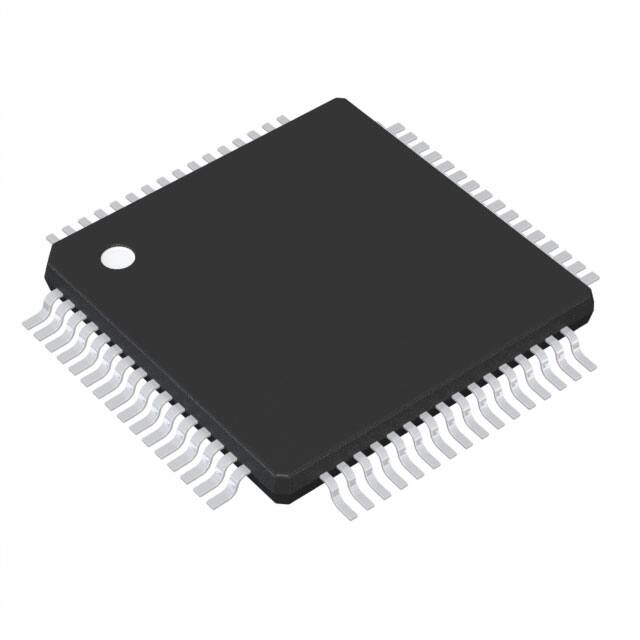

SN74V215, SN74V225, SN74V235, SN74V245 512 × 18, 1024 × 18, 2048 × 18, 4096 × 18 DSP-SYNC FIRST-IN, FIRST-OUT MEMORIES SCAS636E – APRIL 2000 – REVISED SEPTEMBER 2002 D D D D D D D D D 512 × 18-Bit Organization Array (SN74V215) 1024 × 18-Bit Organization Array (SN74V225) 2048 × 18-Bit Organization Array (SN74V235) 4096 × 18-Bit Organization Array (SN74V245) 7.5-ns Read/Write Cycle Time 3.3-V VCC, 5-V Input Tolerant First-Word or Standard Fall-Through Timing Single or Double Register-Buffered Empty and Full Flags Easily Expandable in Depth and Width D D D D D D D D Asynchronous or Coincident Read and Write Clocks Asynchronous or Synchronous Programmable Almost-Empty and Almost-Full Flags With Default Settings Half-Full Flag Capability Output Enable Puts Output Data Bus in High-Impedance State High-Performance Submicron CMOS Technology Packaged in 64-Pin Thin Quad Flat Package DSP and Microprocessor Interface Control Logic Provide a DSP Glueless Interface to Texas Instruments TMS320 DSPs description The SN74V215, SN74V225, SN74V235, and SN74V245 are very high-speed, low-power CMOS clocked first-in first-out (FIFO) memories. They support clock frequencies up to 133 MHz and have read-access times as fast as 5 ns. These DSP-Sync FIFO memories feature read and write controls for use in applications such as DSP-to-processor communication, DSP-to-analog front end (AFE) buffering, network, video, and data communications. These are synchronous FIFOs, which means each port employs a synchronous interface. All data transfers through a port are gated to the low-to-high transition of a continuous (free-running) port clock by enable signals. The continuous clocks for each port are independent of one another and can be asynchronous or coincident. The enables for each port are arranged to provide a simple interface between DSPs, microprocessors, and/or buses controlled by a synchronous interface. An output-enable (OE) input controls the 3-state output. The synchronous FIFOs have two fixed flags, empty flag/output ready (EF/OR) and full flag/input ready (FF/IR), and two programmable flags, almost-empty (PAE) and almost-full (PAF). The offset loading of the programmable flags is controlled by a simple state machine, and is initiated by asserting the load pin (LD). A half-full flag (HF) is available when the FIFO is used in a single-device configuration. Two timing modes of operation are possible with these devices: first-word fall-through (FWFT) mode and standard mode. In FWFT mode, the first word written to an empty FIFO is clocked directly to the data output lines after three transitions of the RCLK signal. A read enable (REN) does not have to be asserted for accessing the first word. In standard mode, the first word written to an empty FIFO does not appear on the data output lines unless a specific read operation is performed. A read operation, which consists of activating REN and enabling a rising RCLK edge, shifts the word from internal memory to the data output lines. These devices are depth expandable, using a daisy-chain technique or FWFT mode. The XI and XO pins are used to expand the FIFOs. In depth-expansion configuration, first load (FL) is grounded on the first device and set to high for all other devices in the daisy chain. The SN74V215, SN74V225, SN74V235, and SN74V245 are characterized for operation from 0°C to 70°C. Please be aware that an important notice concerning availability, standard warranty, and use in critical applications of Texas Instruments semiconductor products and disclaimers thereto appears at the end of this data sheet. DSP-SYNC and TMS320 are trademarks of Texas Instruments. Copyright  2002, Texas Instruments Incorporated PRODUCTION DATA information is current as of publication date. Products conform to specifications per the terms of Texas Instruments standard warranty. Production processing does not necessarily include testing of all parameters. POST OFFICE BOX 655303 • DALLAS, TEXAS 75265 1 SN74V215, SN74V225, SN74V235, SN74V245 512 × 18, 1024 × 18, 2048 × 18, 4096 × 18 DSP-SYNC FIRST-IN, FIRST-OUT MEMORIES SCAS636E – APRIL 2000 – REVISED SEPTEMBER 2002 64 63 62 61 60 59 58 57 56 55 54 53 52 51 50 49 D16 D17 GND RCLK REN LD OE RS VCC GND EF/OR Q17 Q16 GND Q15 VCC PAG PACKAGE (TOP VIEW) 1 2 3 4 5 6 7 8 9 10 11 12 13 14 15 16 48 47 46 45 44 43 42 41 40 39 38 37 36 35 34 33 PAE FL WCLK WEN WXI VCC PAF RXI FF/IR WXO/HF RXO Q0 Q1 GND Q2 Q3 17 18 19 20 21 22 23 24 25 26 27 28 29 30 31 32 D15 D14 D13 D12 D11 D10 D9 D8 D7 D6 D5 D4 D3 D2 D1 D0 2 POST OFFICE BOX 655303 • DALLAS, TEXAS 75265 Q14 Q13 GND Q12 Q11 VCC Q10 Q9 GND Q8 Q7 Q6 Q5 GND Q4 VCC SN74V215, SN74V225, SN74V235, SN74V245 512 × 18, 1024 × 18, 2048 × 18, 4096 × 18 DSP-SYNC FIRST-IN, FIRST-OUT MEMORIES SCAS636E – APRIL 2000 – REVISED SEPTEMBER 2002 functional block diagram D0–D17 LD 59 WCLK WEN 19 Input Register 20 Offset Register Write-Control Logic 25 23 54 17 26 Flag Logic RAM ARRAY 512 × 18, 1024 × 18, 2048 × 18, 4096 × 18 Write Pointer FL WXI (HF)/WXO RXI RXO RS 18 21 26 24 27 Expansion Logic 57 Reset Logic FF/IR PAF EF/OR PAE HF/(WXO) Read Pointer Read-Control Logic Output Register 58 61 RCLK OE 60 REN Q0–Q17 POST OFFICE BOX 655303 • DALLAS, TEXAS 75265 3 SN74V215, SN74V225, SN74V235, SN74V245 512 × 18, 1024 × 18, 2048 × 18, 4096 × 18 DSP-SYNC FIRST-IN, FIRST-OUT MEMORIES SCAS636E – APRIL 2000 – REVISED SEPTEMBER 2002 Terminal Functions TERMINAL DESCRIPTION NO. D0–D17 1–16, 63, 64 I Data inputs. Data inputs for an 18-bit bus. EF/OR 54 O Memory-empty/valid-data-available flag. In the standard mode, the EF function is selected. EF indicates whether the FIFO memory is empty. In FWFT mode, the OR function is selected. OR indicates whether there is valid data available at the outputs. FF/IR 25 O Memory-full/space-available flag. In the standard mode, the FF function is selected. FF indicates whether the FIFO memory is full. In the FWFT mode, the IR function is selected. IR indicates whether there is space available for writing to the FIFO memory. I Mode selection. In the single-device or width-expansion configuration, FL, together with WXI and RXI, determines if the mode is standard mode or first-word fall-through (FWFT) mode, as well as whether the PAE/PAF flags are synchronous or asynchronous (see Table 4). In the daisy-chain depth-expansion configuration, FL is grounded on the first device (first-load device) and set to high for all other devices in the daisy chain. FL GND 18 30, 35, 40, 46, 51, 55, 62 Ground LD 59 I Read/write control. When LD is low, data on the inputs D0–D11 is written to the offset and depth registers on the low-to-high transition of the WCLK, when WEN is low. When LD is low, data on the outputs Q0–Q11 is read from the offset and depth registers on the low-to-high transition of RCLK when REN is low. OE 58 I Output enable. When OE is low, the data output bus is active. If OE is high, the output data bus is in the high-impedance state. PAE 17 O Programable almost-empty flag. When PAE is low, the FIFO is almost empty, based on the offset programmed into the FIFO. The default offset at reset is 63 from empty for SN74V215, and 127 from empty for SN74V225, SN74V235, and SN74V245. PAF 23 O Programable almost-full flag. When PAF is low, the FIFO is almost full, based on the offset programmed into the FIFO. The default offset at reset is 63 from full for SN74V215, and 127 from full for SN74V225, SN74V235, and SN74V245. 28, 29, 31, 32, 34, 36–39, 41, 42, 44, 45, 47, 48, 50, 52, 53 O Data outputs. Data outputs for an 18-bit bus. RCLK 61 I Read clock. When REN is low, data is read from the FIFO on a low-to-high transition of RCLK, if the FIFO is not empty. REN 60 I Read enable. When REN is low, data is read from the FIFO on every low-to-high transition of RCLK. When REN is high, the output register holds the previous data. Data is not read from the FIFO if EF is low. RS 57 I Reset. When RS is set low, internal read and write pointers are set to the first location of the RAM array, FF and PAF go high, and PAE and EF go low. A reset is required before an initial write after power up. Q0–Q17 RXI 24 I Read expansion. In the single-device or width-expansion configuration, RXI, together with FL and WXI, determines if the mode is standard mode or FWFT mode, as well as whether the PAE/PAF flags are synchronous or asynchronous (see Table 4). In the daisy-chain depth-expansion configuration, RXI is connected to RXO (read expansion out) of the previous device. RXO 27 O Last-location-read flag. In the depth-expansion configuration, a pulse is sent from RXO to RXI of the next device when the last location in the FIFO is read. VCC 22, 33, 43, 49, 56 WCLK 4 I/O NAME 19 Supply voltage. +3.3-V power-supply pins. I Write clock. When WEN is low, data is written into the FIFO on a low-to-high transition of WCLK if the FIFO is not full. POST OFFICE BOX 655303 • DALLAS, TEXAS 75265 SN74V215, SN74V225, SN74V235, SN74V245 512 × 18, 1024 × 18, 2048 × 18, 4096 × 18 DSP-SYNC FIRST-IN, FIRST-OUT MEMORIES SCAS636E – APRIL 2000 – REVISED SEPTEMBER 2002 Terminal Functions (Continued) TERMINAL NAME WEN NO. I/O DESCRIPTION I Write enable. When WEN is low, data is written into the FIFO on every low-to-high transition of WCLK. When WEN is high, the FIFO holds the previous data. Data is not written into the FIFO if FF is low. 20 WXI 21 I Width expansion. In the single-device or width-expansion configuration, WXI, together with FL and RXI, determines if the mode is standard mode or FWFT mode, as well as whether the PAE/PAF flags are synchronous or asynchronous (see Table 4). In the daisy-chain depth-expansion configuration, WXI is connected to WXO (write expansion out) of the previous device. WXO/HF 26 O Half-full flag. In the single-device or width-expansion configuration, the device is more than half full when HF is low. In the depth-expansion configuration, a pulse is sent from WXO to WXI of the next device when the last location in the FIFO is written. detailed description INPUTS: DATA IN (D0–D17) Data inputs for 18-bit-wide data. CONTROLS: RESET (RS) Reset is accomplished when RS is taken low. During reset, both internal read and write pointers are set to the first location. A reset is required after power up before a write operation can take place. The half-full flag (HF) and programmable almost-full flag (PAF) is reset to high after tRSF. The programmable almost-empty flag (PAE) is reset to low after tRSF. The full flag (FF) resets to high. The empty flag (EF) resets to low in standard mode, but resets to high in FWFT mode. During reset, the output register is initialized to all zeros, and the offset registers are initialized to their default values. WRITE CLOCK (WCLK) A write cycle is initiated on the low-to-high transition of WCLK. Data setup and hold times must be met with respect to the low-to-high transition of WCLK. The write and read clocks can be asynchronous or coincident. WRITE ENABLE (WEN) When WEN is low, data can be loaded into the FIFO RAM array on the rising edge of every WCLK cycle if the device is not full. Data is stored in the RAM array sequentially and independently of any ongoing read operation. When WEN is high, no new data is written in the RAM array on each WCLK cycle. To prevent data overflow in the standard mode, FF goes low, inhibiting further write operations. Upon completion of a valid read cycle, FF goes high, allowing a write to occur. The FF flag is updated on the rising edge of WCLK. To prevent data overflow in the FWFT mode, IR goes high, inhibiting further write operations. Upon completion of a valid read cycle, IR goes low, allowing a write to occur. The IR flag is updated on the rising edge of WCLK. WEN is ignored when the FIFO is full in either FWFT or standard mode. READ CLOCK (RCLK) Data can be read on the outputs on the low-to-high transition of RCLK when OE is low. The write and read clocks can be asynchronous or coincident. POST OFFICE BOX 655303 • DALLAS, TEXAS 75265 5 SN74V215, SN74V225, SN74V235, SN74V245 512 × 18, 1024 × 18, 2048 × 18, 4096 × 18 DSP-SYNC FIRST-IN, FIRST-OUT MEMORIES SCAS636E – APRIL 2000 – REVISED SEPTEMBER 2002 detailed description (continued) READ ENABLE (REN) When REN is low, data is loaded from the RAM array into the output register on the rising edge of every RCLK cycle if the device is not empty. When REN is high, the output register holds the previous data and no new data is loaded into the output register. Data outputs Q0–Qn maintain the previous data value. In the standard mode, every word accessed at Qn, including the first word written to an empty FIFO, must be requested using REN. When the last word has been read from the FIFO, the empty flag (EF) goes low, inhibiting further read operations. REN is ignored when the FIFO is empty. After a write is performed, EF goes high, allowing a read to occur. The EF flag is updated on the rising edge of RCLK. In the FWFT mode, the first word written to an empty FIFO automatically goes to the outputs Qn, on the third valid low-to-high transition of RCLK + tSKEW after the first write. REN need not be asserted low. To access all other words, a read must be executed using REN. The RCLK low-to-high transition after the last word has been read from the FIFO, output ready (OR) goes high with a true read (RCLK with REN low), inhibiting further read operations. REN is ignored when the FIFO is empty. OUTPUT ENABLE (OE) When OE is low, the parallel output buffers transmit data from the output register. When OE is high, the Q-output data bus is in the high-impedance state. LOAD (LD) The SN74V215, SN74V225, SN74V235, and SN74V245 devices contain two 12-bit offset registers with data on the inputs, or read on the outputs. When LD is low and WEN is low, data on the inputs D0–D11 is written into the empty offset register on the first low-to-high transition of the write clock (WCLK). When LD and WEN are held low, data is written into the full offset register on the second low-to-high transition of WCLK (see Tables 1 and 2). The third transition of WCLK again writes to the empty-offset register. However, writing to all offset registers need not occur at one time. One or two offset registers can be written and then, by bringing LD high, the FIFO is returned to normal read/write operation. When LD is low, and WEN is low, the next offset register in sequence is written. Table 1. Writing to Offset Registers SELECTION† LD WEN WCLK L L ↑ Writing to offset registers: Empty offset Full offset L H ↑ No operation H L ↑ Write into FIFO H H ↑ No operation † The same selection sequence applies to reading from the registers. REN is enabled and read is performed on the low-to-high transition of RCLK. 6 POST OFFICE BOX 655303 • DALLAS, TEXAS 75265 SN74V215, SN74V225, SN74V235, SN74V245 512 × 18, 1024 × 18, 2048 × 18, 4096 × 18 DSP-SYNC FIRST-IN, FIRST-OUT MEMORIES SCAS636E – APRIL 2000 – REVISED SEPTEMBER 2002 detailed description (continued) Table 2. Offset Register Location and Default Values† 17 12 11 0 Empty Offset Register Default Value 003FH (74V215): 007FH (74V225/74V235/74V245) Not used 17 12 11 0 Full Offset Register Not used Default Value 003FH (74V215): 007FH (74V225/74V235/74V245) † Any bits of the offset register not being programmed should be set to zero. When LD is low and WEN is high, the WCLK input is disabled; then, a signal at this input can neither increment the write-offset-register pointer, nor execute a write. The contents of the offset registers can be read on the output lines when LD is low and REN is low; then, data can be read on the low-to-high transition of RCLK. Reading the control registers employs a dedicated read-offset-register pointer. (The read and write pointers operate independently.) Offset register content can be read out in the standard mode only. It is inhibited in the FWFT mode. A read from and a write to the offset registers should not be performed simultaneously. FIRST LOAD (FL) For the single-device mode, see Table 5 for additional information. In the daisy-chain depth-expansion configuration, FL is grounded to indicate it is the first device loaded and is set high for all other devices in the daisy chain (see Operating Configurations for further details). WRITE EXPANSION INPUT (WXI) This is a dual-purpose pin. For single-device mode, see Table 5 for additional information. WXI is connected to write expansion out (WXO) of the previous device in the daisy-chain depth-expansion mode. READ EXPANSION INPUT (RXI) This is a dual-purpose pin. For single-device mode, see Table 5 for additional information. RXI is connected to read expansion out (RXO) of the previous device in the daisy-chain depth-expansion mode. OUTPUTS: FULL FLAG/INPUT READY (FF/IR) This is a dual-purpose pin. In FWFT mode, the input ready (IR) function is selected. IR goes low when memory space is available for writing data. When there is no free space left, IR goes high, inhibiting further write operations. In standard mode, the FF function is selected. When the FIFO is full, FF goes low, inhibiting further write operations. When FF is high, the FIFO is not full. If no reads are performed after a reset, FF goes low after D writes to the FIFO. D = 512 for the SN74V215, 1024 for the SN74V225, 2048 for the SN74V235, and 4096 for the SN74V245. IR goes high after D writes to the FIFO. D = 513 for the SN74V215, 1025 for the SN74V225, 2049 for the SN74V235, and 4097 for the SN74V245. The additional word in FWFT mode is due to the capacity of the memory plus output register. FF/IR is synchronous and updated on the rising edge of WCLK. POST OFFICE BOX 655303 • DALLAS, TEXAS 75265 7 SN74V215, SN74V225, SN74V235, SN74V245 512 × 18, 1024 × 18, 2048 × 18, 4096 × 18 DSP-SYNC FIRST-IN, FIRST-OUT MEMORIES SCAS636E – APRIL 2000 – REVISED SEPTEMBER 2002 detailed description (continued) EMPTY FLAG/OUTPUT READY (EF/OR) This is a dual-purpose pin. In FWFT mode, the OR function is selected. OR goes low at the same time the first word written to an empty FIFO appears valid on the outputs. OR stays low after the RCLK low-to-high transition that shifts the last word from the FIFO memory to the outputs. OR goes high only with a true read (RCLK with REN low). The previous data stays at the outputs, indicating that the last word was read. Further data reads are inhibited until OR goes low again. In the standard mode, the EF function is selected. When the FIFO is empty, EF goes low, inhibiting further read operations. When EF is high, the FIFO is not empty. EF/OR is synchronous and updated on the rising edge of RCLK. PROGRAMMABLE ALMOST-FULL FLAG (PAF) PAF goes low when the FIFO reaches the almost-full condition. In FWFT mode, if no reads are performed, PAF goes low after 513 – m for the SN74V215, 1025 for the SN74V225, 2049 for the SN74V235, and 4097 for the SN74V245. Default values for m are in Table 3 and Table 4. In standard mode, if no reads are performed after reset (RS), PAF goes low after (512 – m) writes for the SN74V215, (1024 – m) writes for the SN74V225, (2048 – m) writes for the SN74V235, and (4096 – m) writes for the SN74V245. The offset m is defined in the full offset register. If asynchronous PAF configuration is selected, PAF is asserted low on the low-to-high transition of WCLK. PAF is reset to high on the low-to-high transition of RCLK. If synchronous PAF configuration is selected (see Table 5), PAF is updated on the rising edge of WCLK. PROGRAMMABLE ALMOST-EMPTY FLAG (PAE) PAE goes low when the FIFO reaches the almost-empty condition. In FWFT mode, PAE goes low when there are n + 1 words, or fewer, in the FIFO. In standard mode, PAE goes low when there are n words or fewer in the FIFO. The offset n is defined as the empty offset. The default values for n are noted in Table 3 and Table 4. If there is no empty offset specified, PAE is low when the device is 63 away from completely empty for SN74V215, and 127 away from completely empty for SN74V225, SN74V235, and SN74V245. If asynchronous PAE configuration is selected, PAE is asserted low on the low-to-high transition of the read clock (RCLK). PAE is reset to high on the low-to-high transition of the write clock (WCLK). If synchronous PAE configuration is selected (see Table 5), PAE is updated on the rising edge of RCLK. WRITE EXPANSION OUT/HALF-FULL FLAG (WXO/HF) This is a dual-purpose output. In the single-device and width-expansion mode, when write expansion in (WXI) and/or read expansion in (RXI) are grounded, this output acts as an indication of a half-full memory. After one-half of the memory is filled, and at the low-to-high transition of the next write cycle, the half-full flag (HF) goes low and remains set until the difference between the write pointer and read pointer is less than or equal to one-half of the total memory of the device. HF is then reset to high by the low-to-high transition of the read clock (RCLK). HF is asynchronous. In the daisy-chain depth-expansion mode, WXI is connected to WXO of the previous device. This output acts as a signal to the next device in the daisy chain by providing a pulse when the previous device writes to the last location of memory. READ EXPANSION OUT (RXO) In the daisy-chain depth-expansion configuration, read expansion in (RXI) is connected to read expansion out (RXO) of the previous device. This output acts as a signal to the next device in the daisy chain by providing a pulse when the previous device reads from the last location of memory. 8 POST OFFICE BOX 655303 • DALLAS, TEXAS 75265 SN74V215, SN74V225, SN74V235, SN74V245 512 × 18, 1024 × 18, 2048 × 18, 4096 × 18 DSP-SYNC FIRST-IN, FIRST-OUT MEMORIES SCAS636E – APRIL 2000 – REVISED SEPTEMBER 2002 detailed description (continued) DATA OUTPUTS (Q0–Q17) Q0–Q17 are data outputs for 18-bit-wide data. functional description TIMING MODES: STANDARD vs FIRST-WORD FALL-THROUGH (FWFT) MODE The SN74V215, SN74V225, SN74V235, and SN74V245 support two different timing modes. The selection of the mode of operation is determined during configuration at reset (RS). During an RS operation, the first load (FL), read expansion input ( RXI), and write-expansion input (WXI) pins are used to select the timing mode as shown in the truth table (see Table 5). In standard mode, the first word written to an empty FIFO does not appear on the data output lines unless a specific read operation is performed. A read operation, which consists of activating read enable (REN) and enabling a rising read clock (RCLK) edge, shifts the word from internal memory to the data output lines. In FWFT mode, the first word written to an empty FIFO is clocked directly to the data output lines after three transitions of the RCLK signal. A REN does not have to be asserted to access the first word. Various signals, both input and output signals, operate differently, depending on which timing mode is in effect. FIRST-WORD FALL-THROUGH MODE (FWFT) In this mode, status flags IR, PAF, HF, PAE, and OR operate in the manner outlined in Table 3. To write data into the FIFO, WEN must be low. Data presented to the data-in lines is clocked into the FIFO on subsequent transitions of WCLK. After the first write is performed, the output ready (OR) flag goes low. Subsequent writes continue to fill the FIFO. PAE goes high after n + 2 words have been loaded into the FIFO, where n is the empty offset value. The default setting for this value is stated in the footnote of Table 3. This parameter also is user programmable. See the Programmable Flag Offset Loading section. If data continues to be written into the FIFO, and no read operations are taking place, HF switches to low when the 258th (SN74V215), 514th (SN74V225), 1026th (SN74V235), and 2050th (SN74V245) word, respectively, is written into the FIFO. Continuing to write data into the FIFO causes PAF to go low. Again, if no reads are performed, PAF goes low after (513 – m) writes for the SN74V215, (1025 – m) writes for the SN74V225, (2049 – m) writes for the SN74V235, and (4097 – m) writes for the SN74V245, where m is the full offset value. The default setting for this value is stated in the footnote of Table 3. When the FIFO is full, the input ready (IR) flag goes high, inhibiting further write operations. If no reads are performed after a reset, IR goes high after D writes to the FIFO. D = 513 for the SN74V215, 1025 for the SN74V225, 2049 for the SN74V235, and 4097 for the SN74V245. The additional word in FWFT mode is due to the capacity of the memory plus output register. If the FIFO is full, the first read operation causes the IR flag to go low. Subsequent read operations cause PAF and HF to go high at the conditions described in Table 3. If further read operations occur without write operations, PAE goes low when there are n + 1 words in the FIFO, where n is the empty offset value. If there is no empty offset specified, PAE is low when the device is 64 away from empty for SN74V215, and 128 away from empty for SN74V225, SN74V235, and SN74V245. Continuing read operations cause the FIFO to be empty. When the last word has been read from the FIFO, OR goes high, inhibiting further read operations. REN is ignored when the FIFO is empty. POST OFFICE BOX 655303 • DALLAS, TEXAS 75265 9 SN74V215, SN74V225, SN74V235, SN74V245 512 × 18, 1024 × 18, 2048 × 18, 4096 × 18 DSP-SYNC FIRST-IN, FIRST-OUT MEMORIES SCAS636E – APRIL 2000 – REVISED SEPTEMBER 2002 functional description (continued) Table 3. Status Flags for FWFT Mode NUMBER OF WORDS IN FIFO IR PAF HF PAE OR 0 L H H L H 1 to (n+1)† L H H L L (n+2) to 1025 (n+2) to 2049 L H H H L 514 to [1025–(m+1)]‡ 1026 to [2049–(m+1)]‡ 2050 to [4097–(m+1)]‡ L H L H L (513–m) to 512 (1025–m) to 1024 (2049–m) to 2048 (4097–m) to 4096 L L L H L 513 1025 2049 4097 H L L H L SN74V215 SN74V225 SN74V235 SN74V245 0 0 0 1 to (n+1)† 1 to (n+1)† 1 to (n+1)† (n+2) to 257 (n+2) to 513 258 to [513–(m+1)]‡ † n = Empty offset (SN74V215 n = 63; SN74V225, SN74V235, and SN74V245 n = 127) ‡ m = Full offset (SN74V215 m = 63; SN74V225, SN74V235, and SN74V245 m = 127) STANDARD MODE In this mode, status flags FF, PAF, HF, PAE, and EF operate in the manner outlined in Table 4. To write data into the FIFO, write enable (WEN) must be low. Data presented to the data-in lines is clocked into the FIFO on subsequent transitions of the write clock (WCLK). After the first write is performed, the empty flag (EF) goes high. Subsequent writes continue to fill the FIFO. The programmable almost-empty flag (PAE) goes high after n + 1 words have been loaded into the FIFO, where n is the empty offset value. The default setting for this value is stated in the footnote of Table 4. This parameter also is user programmable. See the Programmable Flag Offset Loading section. If data continues to be written into the FIFO, and no read operations are taking place, the half-full flag (HF) switches to low when the 257th (SN74V215), 513th (SN74V225), 1025th (SN74V235), and 2049th (SN74V245) word, is written into the FIFO. Continuing to write data into the FIFO causes the programmable almost-full flag (PAF) to go low. Again, if no reads are performed, PAF goes low after (512 – m) writes for the SN74V215, (1024 – m) writes for the SN74V225, (2048 – m) writes for the SN74V235 and (4096 – m) writes for the SN74V245. Offset m is the full offset value. This parameter also is user programmable. See the Programmable Flag Offset Loading section. If there is no full offset specified, PAF is low when the device is 63 away from full for SN74V215, and 127 away from full for the SN74V225, SN74V235, and SN74V245. When the FIFO is full, the full flag (FF) goes low, inhibiting further write operations. If no reads are performed after a reset, FF goes low after D writes to the FIFO. D = 512 for the SN74V215, 1024 for the SN74V225, 2048 for the SN74V235, and 4096 for the SN74V245. If the FIFO is full, the first read operation causes FF to go high. Subsequent read operations cause PAF and the half-full flag (HF) to go high under the conditions described in Table 4. If further read operations occur, without write operations, the programmable almost-empty flag (PAE) goes low when there are n words in the FIFO, where n is the empty offset value. If there is no empty offset specified, PAE is low when the device is 63 away from completely empty for SN74V215, and 127 away from completely empty for SN74V225, SN74V235, and SN74V245. Continuing read operations cause the FIFO to be empty. When the last word has been read from the FIFO, EF goes low, inhibiting further read operations. REN is ignored when the FIFO is empty. 10 POST OFFICE BOX 655303 • DALLAS, TEXAS 75265 SN74V215, SN74V225, SN74V235, SN74V245 512 × 18, 1024 × 18, 2048 × 18, 4096 × 18 DSP-SYNC FIRST-IN, FIRST-OUT MEMORIES SCAS636E – APRIL 2000 – REVISED SEPTEMBER 2002 functional description (continued) Table 4. Status Flags for Standard Mode NUMBER OF WORDS IN FIFO FF PAF HF PAE EF 0 H H H L L 1 to n† H H H L H (n+1) to 1024 (n+1) to 2048 H H H H H 513 to [1025–(m+1)]‡ 1025 to [2048–(m+1)]‡ 2049 to [4096–(m+1)]‡ H H L H H (512–m) to 511 (1024–m) to 1023 (2048–m) to 2047 (4096–m) to 4095 H L L H H 512 1024 2048 4096 L L L H H SN74V215 SN74V225 SN74V235 SN74V245 0 0 0 1 to n† 1 to n† 1 to n† (n+1) to 256 (n+1) to 512 257 to [512–(m+1)]‡ † n = Empty offset (SN74V215 n = 63; SN74V225, SN74V235, and SN74V245 n = 127) ‡ m = Full offset (SN74V215 m = 63; SN74V225, SN74V235, and SN74V245 m = 127) PROGRAMMABLE FLAG LOADING Full- and empty-flag offset values can be user programmable. The SN74V215, SN74V225, SN74V235, and SN74V245 have internal registers for these offsets. Default settings are stated in the footnotes of Table 3 and Table 4. Offset values are loaded into the FIFO using the data input lines D0–D11. To load the offset registers, the load (LD) pin and WEN pin must be held low. Data present on D0–D11 is transferred to the empty offset register on the first low-to-high transition of WCLK. By continuing to hold the LD and WEN pins low, data present on D0–D11 is transferred into the full offset register on the next transition of the WCLK. The third transition again writes to the empty offset register. Writing to all offset registers does not have to occur at the same time. One or two offset registers can be written and, then, by bringing the LD pin high, the FIFO is returned to normal read/write operation. When the LD pin and WEN again are set low, the next offset register in sequence is written. The contents of the offset registers can be read on the data output lines Q0–Q11 when the LD pin is set low, and REN is set low. Data then can be read on the next low-to-high transition of RCLK. The first transition of RCLK presents the empty offset value to the data output lines. The next transition of RCLK presents the full offset value. Offset register content can be read in the standard mode only. It cannot be read in the FWFT mode. SYNCHRONOUS vs ASYNCHRONOUS PROGRAMMABLE FLAG TIMING SELECTION The SN74V215, SN74V225, SN74V235, and SN74V245 can be configured during the configuration-at-reset cycle (see Table 5) with either asynchronous or synchronous timing for PAE and PAF flags. If asynchronous PAE/PAF configuration is selected (see Table 5), the PAE is asserted low on the low-to-high transition of RCLK. PAE is reset to high on the low-to-high transition of WCLK. Similarly, the PAF is asserted low on the low-to-high transition of WCLK, and PAF is reset to high on the low-to-high transition of RCLK. For detailed timing diagrams, see Figure 9 for asynchronous PAE timing and Figure 10 for asynchronous PAF timing. If synchronous PAE/PAF configuration is selected, PAE is asserted and updated on the rising edge of RCLK only, but not WCLK. Similarly, PAF is asserted and updated on the rising edge of WCLK only, but not RCLK. For detailed timing diagrams, see Figure 18 for synchronous PAE timing and Figure 19 for synchronous PAF timing. POST OFFICE BOX 655303 • DALLAS, TEXAS 75265 11 SN74V215, SN74V225, SN74V235, SN74V245 512 × 18, 1024 × 18, 2048 × 18, 4096 × 18 DSP-SYNC FIRST-IN, FIRST-OUT MEMORIES SCAS636E – APRIL 2000 – REVISED SEPTEMBER 2002 functional description (continued) Table 5. Truth Table for Configuration at Reset FL RXI WXI EF/OR FF/IR PAE, PAF FIFO TIMING MODE 0 0 0 Single register-buffered empty flag Single register-buffered full flag Asynchronous Standard 0 0 1 Triple register-buffered output-ready flag Double register-buffered input ready flag Asynchronous FWFT 0 1 0 Double register-buffered empty flag Double register-buffered full flag Asynchronous Standard 0† 1 1 Single register-buffered empty flag Single register-buffered full flag Asynchronous Standard 1 0 0 Single register-buffered empty flag Single register-buffered full flag Synchronous Standard 1 0 1 Triple register-buffered output-ready flag Double register-buffered input ready flag Synchronous FWFT 1 1 0 Double register-buffered empty flag Double register-buffered full flag Synchronous Standard 1‡ 1 1 Single register-buffered empty flag Single register-buffered full flag Asynchronous Standard † In daisy-chain depth expansion, FL is held low for the first-load device. The RXI and WXI inputs are driven by the corresponding RXO and WXO outputs of the preceding device. ‡ In daisy-chain depth expansion, FL is held high for members of the expansion other than the first-load device. The RXI and WXI inputs are driven by the corresponding RXO and WXO outputs of the preceding device. REGISTER-BUFFERED FLAG OUTPUT SELECTION The SN74V215, SN74V225, SN74V235, and SN74V245 can be configured during the configuration-at-reset cycle (see Table 7) with single, double, or triple register-buffered flag output signals. The various combinations available are described in Table 6 and Table 7. In general, going from single to double or triple register-buffered flag outputs removes the possibility of metastable flag indications on boundary states (empty or full conditions). The tradeoff is the addition of clock-cycle delays for the respective flag to be asserted. Not all combinations of register-buffered flag outputs are supported. Register-buffered outputs apply to the empty flag and full flag only. Partial flags are not affected. Table 6 and Table 7 summarize the options available. Table 6. Register-Buffered Flag Output Options, FWFT Mode PROGRAMMING AT RESET FLAG TIMING DIAGRAMS OUTPUT READY (OR) INPUT READY (IR) PARTIAL FLAGS FL RXI WXI Triple Double Asynchronous 0 0 1 Figure 23 Triple Double Synchronous 1 0 1 Figure 16, Figure 17 Table 7. Register-Buffered Flag Output Options, Standard Mode 12 EMPTY FLAG (EF) BUFFERED OUTPUT FULL FLAG (FF) BUFFERED OUTPUT PARTIAL FLAGS TIMING MODE Single Single Single Single Double Double PROGRAMMING AT RESET FLAG TIMING DIAGRAMS FL RXI WXI Asynchronous 0 0 0 Synchronous 1 0 0 Figure 5, Figure 6 Double Asynchronous 0 1 0 Figure 20, Figure 22 Double Synchronous 1 1 0 Figure 20, Figure 22 POST OFFICE BOX 655303 • DALLAS, TEXAS 75265 Figure 5, Figure 6 SN74V215, SN74V225, SN74V235, SN74V245 512 × 18, 1024 × 18, 2048 × 18, 4096 × 18 DSP-SYNC FIRST-IN, FIRST-OUT MEMORIES SCAS636E – APRIL 2000 – REVISED SEPTEMBER 2002 tRS RS tRSR REN, WEN, LD FL, RXI, WXI (see Note A) ÎÎÎÎÎÎ ÎÎÎÎÎÎ ÎÎÎÎÎÎ tRSS tRSR Configuration Setting (see Note C) RCLK, WCLK (see Note B) ÏÏÏÏÏÏÏÏÏÏÏÏÏÏ ÏÏÏÏÏÏÏÏÏÏÏÏÏÏ ÏÏÏÏÏÏÏÏÏÏÏÏÏÏ ÎÎÎÎÎÎÎÎÎÎÎÎÎ ÎÎÎÎÎÎÎÎÎÎÎÎÎ ÎÎÎÎÎÎÎÎÎÎÎÎÎ ÏÏÏÏÏÏÏÏÏÏÏÏÏÏ ÏÏÏÏÏÏÏÏÏÏÏÏÏÏ ÏÏÏÏÏÏÏÏÏÏÏÏÏÏ ÌÌÌÌÌÌÌÌÌÌÌÌÌÌ ÌÌÌÌÌÌÌÌÌÌÌÌÌÌ ÌÌÌÌÌÌÌÌÌÌÌÌÌÌ ÌÌÌÌÌÌÌÌÌÌÌÌÌÌ tRSF FF/IR tRSF EF/OR Standard Mode FWFT Mode FWFT Mode Standard Mode tRSF PAF, WXO/HF, RXO tRSF PAE tRSF Q0–Q17 OE = 1 (see Note D) OE = 0 NOTES: A. Single-device mode (FL, RXI, WXI) = (0,0,0), (0,0,1), (0,1,0), (1,0,0), (1,0,1) or (1,1,0). FL, RXI, WXI should be static (tied to VCC or GND). B. The clocks (RCLK, WCLK) can be free-running asynchronously or coincidentally. C. In FWFT mode, IR goes low based on the WCLK edge after reset. D. After reset, the outputs are low if OE = 0 and 3-state if OE = 1. Figure 1. Reset Timing POST OFFICE BOX 655303 • DALLAS, TEXAS 75265 13 SN74V215, SN74V225, SN74V235, SN74V245 512 × 18, 1024 × 18, 2048 × 18, 4096 × 18 DSP-SYNC FIRST-IN, FIRST-OUT MEMORIES SCAS636E – APRIL 2000 – REVISED SEPTEMBER 2002 tCLK tCLKH tCLKL WCLK tDS D0–D17 ÎÎÎÎÎÎÎÎÎÎÎÎÎÎ ÎÎÎÎÎÎÎÎÎÎÎÎÎÎ ÌÌÌ ÌÌÌ tENS WEN tWFF tDH ÎÎÎÎÎÎÎÎ ÎÎÎÎÎÎÎÎ ÏÏÏÏ ÏÏÏÏ Data Invalid tENH No Operation tWFF ÎÎÎ ÎÎÎ ÌÌ ÌÌ FF tSKEW1 (see Note A) RCLK REN NOTES: A. tSKEW1 is the minimum time between a rising RCLK edge and a rising WCLK edge to ensure that FF goes high during the current clock cycle. If the time between the rising edge of RCLK and the rising edge of WCLK is less than tSKEW1, FF might not change state until the next WCLK edge. B. Select standard mode by setting (FL, RXI, WXI) = (0,0,0), (0,1,1), (1,0,0) or (1,1,1) during reset. Figure 2. Write-Cycle Timing With Single Register-Buffered FF (Standard Mode) 14 POST OFFICE BOX 655303 • DALLAS, TEXAS 75265 SN74V215, SN74V225, SN74V235, SN74V245 512 × 18, 1024 × 18, 2048 × 18, 4096 × 18 DSP-SYNC FIRST-IN, FIRST-OUT MEMORIES SCAS636E – APRIL 2000 – REVISED SEPTEMBER 2002 tCLK tCLKH tCLKL RCLK ÌÌÌ ÌÌÌ ÌÌÌ tENS REN ÏÏÏÏ ÏÏÏÏ ÏÏÏÏ ÌÌÌ ÌÌÌ ÌÌÌ tENH No Operation tREF tREF EF ÎÎÎÎÎ ÎÎÎÎÎ tA Q0–D17 tOLZ tOHZ tOE OE tSKEW1 (see Note A) WCLK WEN NOTES: A. tSKEW1 is the minimum time between a rising WCLK edge and a rising RCLK edge to ensure that EF goes high during the current clock cycle. If the time between the rising edge of WCLK and the rising edge of RCLK is less than tSKEW1, EF might not change state until the next RCLK edge. B. Select standard mode by setting (FL, RXI, WXI) = (0,0,0), (0,1,1), (1,0,0) or (1,1,1) during reset. Figure 3. Read-Cycle Timing With Single Register-Buffered EF (Standard Mode) POST OFFICE BOX 655303 • DALLAS, TEXAS 75265 15 SN74V215, SN74V225, SN74V235, SN74V245 512 × 18, 1024 × 18, 2048 × 18, 4096 × 18 DSP-SYNC FIRST-IN, FIRST-OUT MEMORIES SCAS636E – APRIL 2000 – REVISED SEPTEMBER 2002 WCLK D0–D17 WEN ÎÎÎÎ ÎÎÎÎ ÎÎÎÎ ÌÌÌ ÌÌÌ ÌÌÌ tDS D0 (First Valid Write) D1 D2 D3 D4 tENS tFRL (see Note A) tSKEW1 RCLK tREF EF REN ÏÏÏÏÏÏÏÏÏÏÏÏ ÏÏÏÏÏÏÏÏÏÏÏÏ Q0–Q17 tOLZ tENS ÎÎÎÎÎÎÎ ÎÎÎÎÎÎÎ tA tA D0 D1 tOE OE NOTES: A. When tSKEW1 is at the minimum specification, tFRL (maximum) = tCLK + tSKEW1. When tSKEW1 is less than the minimum specification, tFRL (maximum) = either (2 × tCLK) + tSKEW1 or tCLK + tSKEW1. The latency timing applies only at the empty boundary (EF is low). B. The first word always is available the cycle after EF goes high. C. Select standard mode by setting (FL, RXI, WXI) = (0,0,0), (0,1,1), (1,0,0) or (1,1,1) during reset. Figure 4. First-Data-Word Latency with Single Register-Buffered EF (Standard Mode) 16 POST OFFICE BOX 655303 • DALLAS, TEXAS 75265 SN74V215, SN74V225, SN74V235, SN74V245 512 × 18, 1024 × 18, 2048 × 18, 4096 × 18 DSP-SYNC FIRST-IN, FIRST-OUT MEMORIES SCAS636E – APRIL 2000 – REVISED SEPTEMBER 2002 No Write No Write WCLK ÎÎÎÎÎÎÎÎÎÎÎÎ ÎÎÎÎÎÎÎÎÎÎÎÎ ÎÎÎÎÎÎÎÎÎÎÎÎ tSKEW1 (see Note A) D0–D17 tWFF tDS Data Write tWFF ÎÎÎÎÎÎÎÎÎÎÎÎ ÎÎÎÎÎÎÎÎÎÎÎÎ ÎÎÎÎÎÎÎÎÎÎÎÎ tSKEW1 (see Note A) tDS Data Write tWFF FF WEN RCLK tENS tENS tENH tENH tA tA REN OE Q0–Q17 Low Data In Output Register Data Read Next Data Read NOTES: A. tSKEW1 is the minimum time between a rising RCLK edge and a rising WCLK edge to ensure that FF goes high during the current clock cycle. If the time between the rising edge of RCLK and the rising edge of WCLK is less than tSKEW1, FF might not change state until the next WCLK edge. B. Select standard mode by setting (FL, RXI, WXI) = (0,0,0), (0,1,1), (1,0,0) or (1,1,1) during reset. Figure 5. Single Register-Buffered Full-Flag Timing (Standard Mode) POST OFFICE BOX 655303 • DALLAS, TEXAS 75265 17 SN74V215, SN74V225, SN74V235, SN74V245 512 × 18, 1024 × 18, 2048 × 18, 4096 × 18 DSP-SYNC FIRST-IN, FIRST-OUT MEMORIES SCAS636E – APRIL 2000 – REVISED SEPTEMBER 2002 WCLK ÎÎÎ ÎÎÎ D0–D17 tDS Data Write 1 tENS ÎÎÎÎÎÎÎÎÎÎÎÎ ÎÎÎÎÎÎÎÎÎÎÎÎ tDS Data Write 2 tENS ÌÌÌ ÌÌÌ tENH WEN tFRL (see Note A) tSKEW1 ÎÎÎÎÎÎÎÎ ÎÎÎÎÎÎÎÎ tENH tFRL (see Note A) tSKEW1 RCLK tREF tREF tREF EF REN OE Low tA Q0–Q17 Data In Output Register Data Read NOTES: A. When tSKEW1 is at the minimum specification, tFRL (maximum) = tCLK + tSKEW1. When tSKEW1 is less than the minimum specification, tFRL (maximum) = either (2 × tCLK) + tSKEW1 or tCLK + tSKEW1. The latency timing applies only at the empty boundary (EF is low). B. Select standard mode by setting (FL, RXI, WXI) = (0,0,0), (0,1,1), (1,0,0) or (1,1,1) during reset. Figure 6. Single Register-Buffered Empty Flag Timing (Standard Mode) 18 POST OFFICE BOX 655303 • DALLAS, TEXAS 75265 SN74V215, SN74V225, SN74V235, SN74V245 512 × 18, 1024 × 18, 2048 × 18, 4096 × 18 DSP-SYNC FIRST-IN, FIRST-OUT MEMORIES SCAS636E – APRIL 2000 – REVISED SEPTEMBER 2002 tCLK tCLKH tCLKL WCLK ÌÌÌÌÏÏÏÏÏ ÌÌÌÌÏÏÏÏÏ ÌÌÌÌÏÏÏÏÏ ÌÌÌÌ ÌÌÌÌ tENS LD tENH tENS WEN tDS tDH PAE Offset ÎÎÎÎÎÎÎÎ ÎÎÎÎ ÎÎÎÎÎ ÎÎÎÎÎÎÎÎÎÎ ÎÎÎÎÎÎÎÎ ÎÎÎÎ ÎÎÎÎÎ ÎÎÎÎÎÎÎÎÎÎ D0–D15 D0–D11 PAE Offset PAF Offset Figure 7. Write Programmable Registers (Standard and FWFT Modes) tCLK tCLKH tCLKL RCLK ÌÌÌÌÏÏÏÏÏ ÌÌÌÌÏÏÏÏÏ ÌÌÌÌ ÌÌÌÌ tENS LD tENH tENS REN Q0–Q15 ÎÎÎÎÎÎÎ ÎÎÎÎÎÎÎ tA Unknown PAE Offset PAF Offset Figure 8. Read Programmable Registers (Standard Mode) POST OFFICE BOX 655303 • DALLAS, TEXAS 75265 PAE Offset ÎÎÎ ÎÎÎ 19 SN74V215, SN74V225, SN74V235, SN74V245 512 × 18, 1024 × 18, 2048 × 18, 4096 × 18 DSP-SYNC FIRST-IN, FIRST-OUT MEMORIES SCAS636E – APRIL 2000 – REVISED SEPTEMBER 2002 tCLKH tCLKL WCLK tENS WEN PAE tENH ÌÌÌÌÏÏÏÏ ÌÌÌÌÏÏÏÏ n Words in FIFO (see Note B) n + 1 Words in FIFO (see Note C) tPAEA n + 1 Words in FIFO (see Note B) n + 2 Words in FIFO (see Note C) n Words in FIFO (see Note B) n + 1 Words in FIFO (see Note C) tPAEA RCLK ÌÌÌÌ ÌÌÌÌ ÌÌÌÌ tENS REN NOTES: A. B. C. D. E. n = PAE offset For standard mode For FWFT mode PAE is asserted low on RCLK transition and reset to high on WCLK transition. Select the asynchronous modes by setting (FL, RXI, WXI) = (0,0,0), (0,0,1), (0,1,0), (0,1,1) or (1,1,1) during reset. Figure 9. Asynchronous Programmable Almost-Empty-Flag Timing (Standard and FWFT Modes) 20 POST OFFICE BOX 655303 • DALLAS, TEXAS 75265 SN74V215, SN74V225, SN74V235, SN74V245 512 × 18, 1024 × 18, 2048 × 18, 4096 × 18 DSP-SYNC FIRST-IN, FIRST-OUT MEMORIES SCAS636E – APRIL 2000 – REVISED SEPTEMBER 2002 tCLKH tCLKL WCLK tENS WEN tENH ÌÌÌ ÏÏÏ ÌÌÌ ÏÏÏ tPAFA PAF D – m Words in FIFO D – (m + 1) Words in FIFO (see Notes A and B) D – (m + 1) Words in FIFO tPAFA RCLK ÌÌÌÌ ÌÌÌÌ ÌÌÌÌ tENS REN NOTES: A. m = PAF offset B. D = maximum FIFO depth In FWFT mode: D = 513 for the SN74V215, 1025 for the SN74V225, 2049 for the SN74V235 and 4097 for the SN74V245 In standard mode: D = 512 for the SN74V215, 1024 for the SN74V225, 2048 for the SN74V235 and 4096 for the SN74V245 C. PAF is asserted to low on WCLK transition and reset to high on RCLK transition. D. Select asynchronous modes by setting (FL, RXI, WXI) = (0,0,0), (0,0,1), (0,1,0), (0,1,1) or (1,1,1) during reset. Figure 10. Asynchronous Programmable Almost-Full-Flag Timing (Standard and FWFT Modes) POST OFFICE BOX 655303 • DALLAS, TEXAS 75265 21 SN74V215, SN74V225, SN74V235, SN74V245 512 × 18, 1024 × 18, 2048 × 18, 4096 × 18 DSP-SYNC FIRST-IN, FIRST-OUT MEMORIES SCAS636E – APRIL 2000 – REVISED SEPTEMBER 2002 tCLKH tCLKL WCLK tENS tENH ÌÌÌÌÏÏÏÏ ÌÌÌÌÏÏÏÏ WEN D/2+1 Words in FIFO, (see Notes A and B) tHF D/2 Words in FIFO, (see Notes A and B) HF Words in FIFO D – 1 + 2 (see Notes A D/2 Words in FIFO, 2 and C) (see Notes A and B) D – 1 + 1 Words in FIFO (see Notes A and C) 2 D–1 +1 2 tHF Words in FIFO (see Notes A and C) RCLK ÌÌÌÌ ÌÌÌÌ tENS REN NOTES: A. D = maximum FIFO depth In FWFT mode: D = 513 for the SN74V215, 1025 for the SN74V225, 2049 for the SN74V235 and 4097 for the SN74V245 In standard mode: D = 512 for the SN74V215, 1024 for the SN74V225, 2048 for the SN74V235 and 4096 for the SN74V245 B. For standard mode C. For FWFT mode D. Select single-device mode by setting (FL, RXI, WXI) = (0,0,0), (0,0,1), (0,1,0), (1,0,0), (1,0,1) or (1,1,0) during reset. Figure 11. Half-Full-Flag Timing (Standard and FWFT Modes) tCLKH See Note A WCLK tXO WXO tENS WEN ÌÌÌ ÌÌÌ NOTE A: Write to last physical location. ÏÏÏ ÏÏÏ Figure 12. Write-Expansion-Out Timing 22 POST OFFICE BOX 655303 • DALLAS, TEXAS 75265 SN74V215, SN74V225, SN74V235, SN74V245 512 × 18, 1024 × 18, 2048 × 18, 4096 × 18 DSP-SYNC FIRST-IN, FIRST-OUT MEMORIES SCAS636E – APRIL 2000 – REVISED SEPTEMBER 2002 tCLKH RCLK See Note A tXO RXO ÌÌÌÌ ÏÏÏÏ ÌÌÌÌ ÏÏÏÏ tENS REN NOTE A: Read from last physical location. Figure 13. Read-Expansion-Out Timing tXI WXI tXIS WCLK Figure 14. Write-Expansion-In Timing tXI RXI tXIS RCLK Figure 15. Read-Expansion-In Timing POST OFFICE BOX 655303 • DALLAS, TEXAS 75265 23 1 WEN ÎÎ ÎÎÎÎÎÎ Î Î Î Î ÎÎÎÎÎÎ Î Î Î Î Î Î ÎÎÎ ÎÎ ÎÎÎÎÎÎ Î Î Î Î ÎÎÎÎÎÎ Î Î Î Î Î Î ÎÎÎ tDH tDS D0–D17 W1 W2 tDS W3 W[n+2] W4 tSKEW1 RCLK 1 2 W[n+3] tDS W[n+4] W D – 1+ 1 2 W D – 1+ 2 2 W tDS D – 1+ 3 2 W[D-m-2] W[D-m-1] W[D-m] tENH W[D-m+1] W[D-m+2] W[D] W[D+1] tSKEW2 (see Note B) 3 REN tA POST OFFICE BOX 655303 • DALLAS, TEXAS 75265 Q0–Q17 Data in Output Register W1 tREF OR tPAES PAE tHF HF tPAFS PAF tWFF IR NOTES: A. t SKEW1 is the minimum time between a rising WCLK edge and a rising RCLK edge for OR to go low after two RCLK cycles plus tREF . If the time between the rising edge of WLCK and the rising edge of RCLK is less than t SKEW1, the OR deassertion might be delayed one extra RCLK cycle. B. tSKEW2 is the minimum time between a rising WCLK edge and a rising RCLK edge for PAE to go high during the current clock cycle. If the time between the rising edge of WCLK and the rising edge of RCLK is less than tSKEW2, the PAE deassertion might be delayed one extra RCLK cycle. C. LD is high, OE is low. D. n = PAE offset, m = PAF offset, D = maximum FIFO depth = 513 words for the SN74V215, 1025 words for the SN74V225, 2049 words for the SN74V235, and 4097 words for the SN74V245. E. Select synchronous FWFT mode by setting ( FL , RXI , WXI ) = (1,0,1) during reset. Figure 16. Write Timing With Synchronous Programmable Flags (FWFT Mode) SN74V215, SN74V225, SN74V235, SN74V245 512 × 18, 1024 × 18, 2048 × 18, 4096 × 18 DSP-SYNCTM FIRST-IN, FIRST-OUT MEMORIES 1 tENS SCAS636E -– APRIL 2000 -– REVISED SEPTEMBER 2002 24 WCLK WCLK 1 tENH 2 tSKEW2 (see Note B) tSKEW1 (see Note A) tENS WEN ÎÎ ÎÎÎÎÎÎÎÎÎÎÎÎÎÎÎÎÎÎÎÎÎÎÎÎÎÎÎÎÎÎÎÎÎÎÎÎÎ ÎÎ ÎÎÎÎÎÎÎÎÎÎÎÎÎÎÎÎÎÎÎÎÎÎÎÎÎÎÎÎÎÎÎÎÎÎÎÎÎ tDH tDS D0–D17 WD RCLK tENS tENS REN OE tA tA tA tOHZ Q0–Q17 W1 tA W1 W2 W3 Wm+2 W[m+3] tA tA W[m+4] W D – 1+ 1 2 W D – 1+ 2 2 W[D-n-1] W[D-n] W[D-n+1] W[D-n+2] W[D-1] WD tREF OR tPAES PAE tHF HF tWFF tWFF IR NOTES: A. tSKEW1 is the minimum time between a rising RCLK edge and a rising WCLK edge to ensure that IR goes low after one WCLK plus tWFF. If the time between the rising edge of RLCK and the rising edge of WCLK is less than tSKEW1, the IR assertion might be delayed an extra WCLK cycle. B. tSKEW2 is the minimum time between a rising RCLK edge and a rising WCLK edge for PAF to go high during the current clock cycle. If the time between the rising edge of RCLK and the rising edge of WCLK is less than tSKEW2, the PAF deassertion time may be delayed an extra WCLK cycle. C. LD is high. D. n = PAE offset, m = PAF offset, D = maximum FIFO depth = 513 words for the SN74V215, 1025 words for the SN74V225, 2049 words for SN74V235, and 4097 words for SN74V245. E. Select synchronous FWFT mode by setting ( FL , RXI , WXI ) = (1,0,1) during reset. Figure 17. Read Timing With Synchronous Programmable Flags (FWFT Mode) 25 SCAS636E -– APRIL 2000 -– REVISED SEPTEMBER 2002 tPAFS PAF SN74V215, SN74V225, SN74V235, SN74V245 512 × 18, 1024 × 18, 2048 × 18, 4096 × 18 DSP-SYNCTM FIRST-IN, FIRST-OUT MEMORIES POST OFFICE BOX 655303 • DALLAS, TEXAS 75265 tOE SN74V215, SN74V225, SN74V235, SN74V245 512 × 18, 1024 × 18, 2048 × 18, 4096 × 18 DSP-SYNC FIRST-IN, FIRST-OUT MEMORIES SCAS636E – APRIL 2000 – REVISED SEPTEMBER 2002 tCLKH tCLKL WCLK ÎÎÎÎÏÏÏ ÎÎÎÎÏÏÏ tENS WEN PAE tENH n Words in FIFO, (see Note B) n + 1 Words in FIFO (see Note C) tSKEW2 (see Note D) tPAES (see Note C) n + 1 Words in FIFO, (see Note B) n + 2 Words in FIFO (see Note C) n Words in FIFO (see Note B), n + 1 Words in FIFO (see Note C) tPAES RCLK tENS tENH ÎÎ ÏÏÏ REN NOTES: A. B. C. D. n = PAE offset For standard mode For FWFT mode tSKEW2 is the minimum time between a rising WCLK edge and a rising RCLK edge for PAE to go high during the current clock cycle. If the time between the rising edge of WCLK and the rising edge of RCLK is less than tSKEW2, the PAE deassertion might be delayed one extra RCLK cycle. E. PAE is asserted and updated on the rising edge of RCLK only. F. Select synchronous modes by setting (FL, RXI, WXI) = (1,0,0), (1,0,1), or (1,1,0) during reset. Figure 18. Synchronous Programmable Almost-Empty-Flag Timing (Standard and FWFT Modes) 26 POST OFFICE BOX 655303 • DALLAS, TEXAS 75265 SN74V215, SN74V225, SN74V235, SN74V245 512 × 18, 1024 × 18, 2048 × 18, 4096 × 18 DSP-SYNC FIRST-IN, FIRST-OUT MEMORIES SCAS636E – APRIL 2000 – REVISED SEPTEMBER 2002 tCLKH tCLKL WCLK ÎÎÎÎÏÏÏ ÎÎÎÎÏÏÏ tENS WEN PAF tENH tPAFS D – (m + 1) Words in FIFO D – m Words in FIFO D – (m + 1) Words in FIFO tSKEW2 (see Note C) tPAFS RCLK tENS tENH ÎÎ ÏÏÏ ÎÎ ÏÏÏ REN NOTES: A. m = PAF offset B. D = maximum FIFO depth In FWFT mode: D = 513 for the SN74V215, 1025 for the SN74V225, 2049 for the SN74V235, and 4097 for the SN74V245. In standard mode: D = 512 for the SN74V215, 1024 for the SN74V225, 2048 for the SN74V235, and 4096 for the SN74V245. C. tSKEW2 is the minimum time between a rising RCLK edge and a rising WCLK edge for PAF to go high during the current clock cycle. If the time between the rising edge of RCLK and the rising edge of WCLK is less than tSKEW2, the PAF deassertion time might be delayed an extra WCLK cycle. D. PAF is asserted and updated on the rising edge of WCLK only. E. Select synchronous modes by setting (FL, RXI, WXI) = (1,0,0), (1,0,1), or (1,1,0) during reset. Figure 19. Synchronous Programmable Almost-Full-Flag Timing (Standard and FWFT Modes) POST OFFICE BOX 655303 • DALLAS, TEXAS 75265 27 SN74V215, SN74V225, SN74V235, SN74V245 512 × 18, 1024 × 18, 2048 × 18, 4096 × 18 DSP-SYNC FIRST-IN, FIRST-OUT MEMORIES SCAS636E – APRIL 2000 – REVISED SEPTEMBER 2002 No Write No Write WCLK 1 2 tSKEW1 (see Note A) 1 ÌÌÌÌÌÌÌÌÌÌÌÌÌÌ ÌÌÌÌÌÌÌÌÌÌÌÌÌÌ tDS D0–D17 tWFF 2 tSKEW1 (see Note A) Wd ÌÌÌÌÌÌÌÌÌÌÌÌÌ ÌÌÌÌÌÌÌÌÌÌÌÌÌ tDS Data Write tWFF tWFF FF WEN RCLK tENS tENS tENH tENH REN OE Low tA Q0–Q17 tA Data in Output Register Data Read Next Data Read NOTES: A. tSKEW1 is the minimum time between a rising RCLK edge and a rising WCLK edge to ensure that FF goes high after one WCLK cycle plus tWFF. If the time between the rising edge of RCLK and the rising edge of WCLK is less than tSKEW1, the FF deassertion time might be delayed an extra WCLK cycle. B. LD is high. C. Select double register-buffered standard mode by setting (FL, RXI, WXI) = (0,1,0) or (1,1,0) during reset. Figure 20. Double Register-Buffered Full-Flag Timing (Standard Mode) 28 POST OFFICE BOX 655303 • DALLAS, TEXAS 75265 SN74V215, SN74V225, SN74V235, SN74V245 512 × 18, 1024 × 18, 2048 × 18, 4096 × 18 DSP-SYNC FIRST-IN, FIRST-OUT MEMORIES SCAS636E – APRIL 2000 – REVISED SEPTEMBER 2002 tCLK tCLKH tCLKL WCLK 1 2 tDS ÌÌÌÌÌÌÌÌÌÌÌÌÌÌÌÌÌÌÌ ÌÌÌÌÌÌÌÌÌ ÌÌÌÌÌÌÌÌÌÌÌÌÌÌÌÌÌÌÌ ÌÌÌÌÌÌÌÌÌ ÎÎÎ ÏÏÏ ÎÎ ÎÎÎ ÏÏÏ ÎÎ tDH D0–D17 Data in Valid tENS WEN tENH No Operation tWFF tWFF FF tSKEW1 (see Note A) RCLK REN NOTES: A. tSKEW1 is the minimum time between a rising RCLK edge and a rising WCLK edge to ensure that FF goes high after one WCLK cycle plus tRFF. If the time between the rising edge of RCLK and the rising edge of WCLK is less than tSKEW1, the FF deassertion might be delayed an extra WCLK cycle. B. LD is high. C. Select double register-buffered standard mode by setting (FL, RXI, WXI) = (0,1,0) or (1,1,0) during reset. Figure 21. Write-Cycle Timing With Double Register-Buffered FF (Standard Mode) POST OFFICE BOX 655303 • DALLAS, TEXAS 75265 29 SN74V215, SN74V225, SN74V235, SN74V245 512 × 18, 1024 × 18, 2048 × 18, 4096 × 18 DSP-SYNC FIRST-IN, FIRST-OUT MEMORIES SCAS636E – APRIL 2000 – REVISED SEPTEMBER 2002 tCLK tCLKH tCLKL RCLK 1 2 tENS ÎÎÎÎÏÏÏ ÎÎÎÎÏÏÏ tENH No Operation REN tREF tREF EF ÌÌÌÌ ÌÌÌÌ tA Q0–Q17 tOLZ Last Word tOHZ tOE OE tSKEW1 (see Note A) WCLK tENS tENH WEN tDS tDH D0–D17 First Word NOTES: A. tSKEW1 is the minimum time between a rising WCLK edge and a rising RCLK edge to ensure that EF goes high after one RCLK cycle plus tREF. If the time between the rising edge of WCLK and the rising edge of RCLK is less than tSKEW1, the EF deassertion might be delayed an extra RCLK cycle. B. LD is high. C. Select double register-buffered standard mode by setting (FL, RXI, WXI) = (0,1,0) or (1,1,0) during reset. Figure 22. Read-Cycle Timing With Double Register-Buffered EF (Standard Timing) 30 POST OFFICE BOX 655303 • DALLAS, TEXAS 75265 SN74V215, SN74V225, SN74V235, SN74V245 512 × 18, 1024 × 18, 2048 × 18, 4096 × 18 DSP-SYNC FIRST-IN, FIRST-OUT MEMORIES SCAS636E – APRIL 2000 – REVISED SEPTEMBER 2002 WCLK tENS tENH WEN tDS D0–D17 RCLK REN ÌÌÌ ÌÌÌ ÌÌ ÌÌ tDH W1 W2 ÌÌ ÌÌ W3 tSKEW1 (see Note A) 1 ÌÌ ÌÌ 2 W4 3 ÏÏÏÏÏÏÏÏÏÏÏÏÏÏÏÏÏÏ ÏÏÏÏÏÏÏÏÏÏÏÏÏÏÏÏÏÏ tA Q0–Q17 ÌÌÌ Ì ÌÌ tDS W[n+2] ÌÌ ÌÌ ÌÌ ÌÌ W[n+3] ÌÌÌÌÌÌÌÌÌ ÌÌÌÌÌÌÌÌÌ Data In Output Register W1 tREF tREF OR NOTES: A. tSKEW1 is the minimum time between a rising WCLK edge and a rising RCLK edge for OR to go high during the current cycle. If the time between the rising edge of WLCK and the rising edge of RCLK is less than tSKEW1, the OR deassertion might be delayed one extra RCLK cycle. B. LD is high, OE is low. C. Select FWFT mode by setting (FL, RXI, WXI) = (0,0,1) or (1,0,1) during reset. Figure 23. OR-Flag Timing and First Word Fall Through When FIFO is Empty (FWFT mode) POST OFFICE BOX 655303 • DALLAS, TEXAS 75265 31 SN74V215, SN74V225, SN74V235, SN74V245 512 × 18, 1024 × 18, 2048 × 18, 4096 × 18 DSP-SYNC FIRST-IN, FIRST-OUT MEMORIES SCAS636E – APRIL 2000 – REVISED SEPTEMBER 2002 operating configurations SINGLE-DEVICE CONFIGURATION A single SN74V215, SN74V225, SN74V235, or SN74V245 can be used when the application requirements are for 512/1024/2048/4096 words or fewer, respectively. These FIFOs are in a single-device configuration when the first load (FL), write expansion in (WXI) and read expansion in (RXI) control inputs are configured as (FL, RXI, WXI = (0,0,0), (0,0,1), (0,1,0), (1,0,0), (1,0,1) or (1,1,0) during reset (see Figure 24). Reset (RS) Write Clock (WCLK) Read Clock (RCLK) Write Enable (WEN) Read Enable (REN) Load (LD) Output Enable (OE) 74V215 74V225 74V235 74V245 Data In (D0–D17) Data Out (Q0–Q17) Empty Flag/Output Ready (EF/OR) Full Flag/Input Ready (FF/IR) Programmable (PAF) Programmable (PAE) Half-Full Flag (HF) FL RXI WXI Figure 24. Block Diagram of Single 512 × 18, 1024 × 18, 2048 × 18, or 4096 × 18 Synchronous FIFO 32 POST OFFICE BOX 655303 • DALLAS, TEXAS 75265 SN74V215, SN74V225, SN74V235, SN74V245 512 × 18, 1024 × 18, 2048 × 18, 4096 × 18 DSP-SYNC FIRST-IN, FIRST-OUT MEMORIES SCAS636E – APRIL 2000 – REVISED SEPTEMBER 2002 operating configurations (continued) WIDTH-EXPANSION CONFIGURATION Word width may be increased simply by connecting together the control signals of multiple devices. Status flags can be detected from any one device. The exceptions are the empty flag/output ready and full flag/input ready. Because of variations in skew between RCLK and WCLK, it is possible for flag assertion and deassertion to vary by one cycle between FIFOs. To avoid problems, the user must create composite flags by gating the empty flags/output ready of every FIFO, and separately gating all full flags/input ready. Figure 25 demonstrates a 36-word width by using two SN74V215, SN74V225, SN74V235, or SN74V245 memories. Any word width can be attained by adding additional SN74V215, SN74V225, SN74V235, or SN74V245 memories. These FIFOs are in a single-device configuration when the first load (FL), write expansion in (WXI), and read expansion in (RXI) control inputs are configured as (FL, RXI, WXI = (0,0,0), (0,0,1), (0,1,0), (1,0,0), (1,0,1) or (1,1,0) during reset (see Figure 25). Reset (RS) Reset (RS) Data In (D) 36 18 18 Read Clock (RCLK) Write Clock (WCLK) Read Enable (REN) Write Enable (WEN) Output Enable (OE) Load (LD) 74V215 74V225 74V235 74V245 Programmable (PAE) Half-Full Flag (HF) Full Flag/ Input Ready (FF/IR) FF/IR Programmable (PAF) 74V215 74V225 74V235 74V245 FF/IR EF/OR Empty Flag/ Output Ready (EF/OR) EF/OR 18 FL WXI RXI 18 FL WXI Data Out (Q) 36 RXI NOTE A: Do not connect any output control signals directly together. Figure 25. Block Diagram of 512 × 36, 1024 × 36, 2048 × 36, or 4096 × 36 Synchronous FIFO Memory Used in a Width-Expansion Configuration DEPTH-EXPANSION CONFIGURATION, DAISY-CHAIN TECHNIQUE (WITH PROGRAMMABLE FLAGS) These devices can be adapted easily to applications requiring more than 512, 1024, 2048, or 4096 words of buffering. Figure 26 shows depth expansion using three SN74V215, SN74V225, SN74V235, or SN74V245 memories. Maximum depth is limited only by signal loading. POST OFFICE BOX 655303 • DALLAS, TEXAS 75265 33 SN74V215, SN74V225, SN74V235, SN74V245 512 × 18, 1024 × 18, 2048 × 18, 4096 × 18 DSP-SYNC FIRST-IN, FIRST-OUT MEMORIES SCAS636E – APRIL 2000 – REVISED SEPTEMBER 2002 WXO RXO WCLK RCLK WEN REN RS OE LD 74V215 74V225 Dn 74V235 VCC 74V245 FL FF/IR Data In Qn EF/OR PAE PAF WXI RXI WXO WCLK WEN RS LD RXO RCLK REN OE Data Out 74V215 VCC Dn 74V225 Qn 74V235 74V245 FL FF/IR PAF WXI WXO WCLK Write Clock Write Enable EF/OR PAE RXI RXO RCLK WEN Reset Read Clock Read Enable REN OE Output Enable RS Dn 74V215 Qn LD 74V225 Load 74V235 74V245 FF/IR PAF EF/OR FF/IR EF/OR PAF WXI PAE RXI PAE First Load (FL) NOTES: A. B. C. D. E. F. G. The first device must be designated by grounding the first load (FL) control input. All other devices must have FL in the high state. The write expansion out (WXO) pin of each device must be tied to the write expansion in (WXI) pin of the next device. The read expansion out (RXO) pin of each device must be tied to the read expansion in (RXI) pin of the next device. All load (LD) pins are tied together. The half-full flag (HF) is not available in this depth-expansion configuration. EF, FF, PAE, and PAF are created with composite flags by ORing together every respective flag for monitoring. The composite PAE and PAF flags are not precise. H. In daisy-chain mode, the flag outputs are single-register buffered and the partial flags are in asynchronous timing mode. Figure 26. Block Diagram of 1536 × 18, 3072 × 18, 6144 × 18, 12288 × 18 Synchronous FIFO Memory With Programmable Flags Used in Depth-Expansion Configuration 34 POST OFFICE BOX 655303 • DALLAS, TEXAS 75265 SN74V215, SN74V225, SN74V235, SN74V245 512 × 18, 1024 × 18, 2048 × 18, 4096 × 18 DSP-SYNC FIRST-IN, FIRST-OUT MEMORIES SCAS636E – APRIL 2000 – REVISED SEPTEMBER 2002 operating configurations (continued) DEPTH-EXPANSION CONFIGURATION (FWFT MODE) In FWFT mode, the FIFOs can be connected in series (the data outputs of one FIFO connected to the data inputs of the next) with no external logic necessary. The resulting configuration provides a total depth equivalent to the sum of the depths associated with each single FIFO. NO TAG shows a depth expansion using two SN74V215, SN74V225, SN74V235, or SN74V245 memories. Care should be taken to select FWFT mode during master reset for all FIFOs in the depth expansion configuration. The first word written to an empty configuration passes from one FIFO to the next (ripple down) until it finally appears at the outputs of the last FIFO in the chain. No read operation is necessary, but the RCLK of each FIFO must be free running. Each time the data word appears at the outputs of one FIFO, that device’s OR line goes low, enabling a write to the next FIFO in line. For an empty expansion configuration, the amount of time it takes for OR of the last FIFO in the chain to go low (i.e., valid data to appear on the last FIFO’s outputs) after a word has been written to the first FIFO is the sum of the delays for each individual FIFO: (N – 1) × (4 × transfer clock) + 3 × TRCLK Where: N is the number of FIFOs in the expansion and TRCLK is the RCLK period. Extra cycles should be added for the possibility that the tSKEW1 specification is not met between WCLK and transfer clock, or RCLK and transfer clock, for the OR flag. The ripple-down delay is noticeable only for the first word written to an empty depth-expansion configuration. There is no delay evident for subsequent words written to the configuration. The first free location created by reading from a full depth-expansion configuration bubbles up from the last FIFO to the previous one until finally it moves into the first FIFO of the chain. Each time a free location is created in one FIFO of the chain, that FIFO’s IR line goes low, enabling the preceding FIFO to write a word to fill it. For a full expansion configuration, the amount of time it takes for IR of the first FIFO in the chain to go low after a word has been read from the last FIFO is the sum of the delays for each individual FIFO: (N – 1) × (3 × transfer clock) + 2TWCLK Where: N is the number of FIFOs in the expansion and TWCLK is the WCLK period. Extra cycles should be added for the possibility that the tSKEW1 specification is not met between RCLK and transfer clock, or WCLK and transfer clock, for the IR flag. The transfer clock line should be tied to either WCLK or RCLK, whichever is faster. Both these actions result in data moving, as quickly as possible, to the end of the chain and free locations to the beginning of the chain. POST OFFICE BOX 655303 • DALLAS, TEXAS 75265 35 SN74V215, SN74V225, SN74V235, SN74V245 512 × 18, 1024 × 18, 2048 × 18, 4096 × 18 DSP-SYNC FIRST-IN, FIRST-OUT MEMORIES SCAS636E – APRIL 2000 – REVISED SEPTEMBER 2002 HF HF PAF Write Clock Write Enable Input Ready Data In n PAE Transfer Clock WCLK RCLK WEN 74V215 74V225 IR 74V235 74V245 OR WEN REN OE Dn FL RXI WXI Qn (0,1) WCLK IR GND n VCC GND Read Clock RCLK 74V215 74V225 74V235 74V245 Output Ready OR Output Enable OE Dn FL RXI WXI Qn (0,1) Read Enable REN n Data Out VCC GND Figure 27. Block Diagram of 1024 × 18, 2048 × 18, 4096 × 18, 8192 × 18 Synchronous FIFO Memory With Programmable Flags Used in Depth-Expansion Configuration 36 POST OFFICE BOX 655303 • DALLAS, TEXAS 75265 SN74V215, SN74V225, SN74V235, SN74V245 512 × 18, 1024 × 18, 2048 × 18, 4096 × 18 DSP-SYNC FIRST-IN, FIRST-OUT MEMORIES SCAS636E – APRIL 2000 – REVISED SEPTEMBER 2002 absolute maximum ratings over operating free-air temperature range (unless otherwise noted)† Supply voltage range, VCC . . . . . . . . . . . . . . . . . . . . . . . . . . . . . . . . . . . . . . . . . . . . . . . . . . . . . . . . . . – 0.5 V to 5 V Continuous output current, IO (VO = 0 to VCC) . . . . . . . . . . . . . . . . . . . . . . . . . . . . . . . . . . . . . . . . . . . . . . ± 50 mA Storage temperature range, Tstg . . . . . . . . . . . . . . . . . . . . . . . . . . . . . . . . . . . . . . . . . . . . . . . . . . . – 55°C to 125°C † Stresses beyond those listed under “absolute maximum ratings” may cause permanent damage to the device. These are stress ratings only, and functional operation of the device at these or any other conditions beyond those indicated under “recommended operating conditions” is not implied. Exposure to absolute-maximum-rated conditions for extended periods may affect device reliability. recommended operating conditions MIN TYP MAX UNIT VCC GND Supply voltage 3.0 3.3 3.6 V Supply voltage 0 0 0 V VIH VIL High-level input voltage 2 5 V TA Operating free-air temperature Low-level input voltage 0 0.8 V 70 °C electrical characteristics over recommended operating conditions (unless otherwise noted) PARAMETER TEST CONDITIONS MIN TYP MAX VOH VOL VCC = 3.0 V, VCC = 3.0 V, IOH = – 2 mA IOL = 8 mA II IOZ VCC = 3.6 V, VCC = 3.6 V, VI = VCC to 0.4 V OE ≥ VIH, ICC1 ICC2 VCC = 3.3 V, VCC = 3.6 V, See Notes 1, 2, and 3 CIN VI = 0, TA = 25°C, VO = 0, TA = 25°C, f = 1 MHz 10 pF f = 1 MHz, Output deselected, (OE ≥ VIH) 10 pF COUT 2.4 UNIT V VO = VCC to 0.4 V See Notes 1 and 4 0.4 V ±1 µA ± 10 µA 35 mA 5 mA NOTES: 1. Tested with outputs disabled (IOUT = 0) 2. RCLK and WCLK switch at 20 MHz and data inputs switch at 10 MHz. 3. Typical ICC1 = 2.04 + 0.88 × fS + 0.02 × CL × fS (in mA). These equations are valid under the following conditions: VCC = 3.3 V, TA = 25°C, fS = WCLK frequency = RCLK frequency (in MHz, using TTL levels), data switching at fS/2, CL = capacitive load (in pF). 4. All inputs = (VCC – 0.2 V) or (GND + 0.2 V), except RCLK and WCLK, which switch at 20 MHz. POST OFFICE BOX 655303 • DALLAS, TEXAS 75265 37 SN74V215, SN74V225, SN74V235, SN74V245 512 × 18, 1024 × 18, 2048 × 18, 4096 × 18 DSP-SYNC FIRST-IN, FIRST-OUT MEMORIES SCAS636E – APRIL 2000 – REVISED SEPTEMBER 2002 timing requirements over recommended ranges of supply voltage and operating free-air temperature (see Figure 28 through Figure 23) ’74V215-7 ’74V225-7 ’74V235-7 ’74V245-7 ’74V215-10 ’74V225-10 ’74V235-10 ’74V245-10 ’74V215-15 ’74V225-15 ’74V235-15 ’74V245-15 ’74V215-20 ’74V225-20 ’74V235-20 ’74V245-20 MIN MIN MIN MIN MAX 133 MAX MAX Clock cycle frequency tCLK tCLKH Clock cycle time 7.5 10 15 20 ns Clock high time 3.5 4.5 6 8 ns tCLKL tDS Clock low time 3.5 4.5 6 8 ns Data setup time 2.5 3 4 5 ns tDH tENS Data hold time 0.5 0.5 1 1 ns Enable setup time 2.5 3 4 5 ns tENH tLDS Enable hold time 0.5 0.5 1 1 ns Load setup time 3.5 3.5 4 4 ns tLDH tRS Load hold time 0.5 0.5 1 1 ns Reset pulse width† 10 10 15 20 ns tRSS tRSR Reset setup time 8 8 10 12 ns Reset recovery time 8 8 10 12 tRSF tOLZ Reset to flag and output time tOE tOHZ Output enable to output valid tWFF tREF Write clock to Full flag 5 6.5 10 Read clock to Empty flag 5 6.5 12.5 2 5 2 15 Output enable to output in low Z 0 1 tPAFA Clock to asynchronous programmable Almost-Full flag tPAFS Write clock to synchronous programmable Almost-Full flag tPAEA Clock to asynchronous programmable Almost-Empty flag tPAES Read clock to synchronous programmable Almost-Empty flag 2 15 0 6 Output enable to output in high Z 6.5 66.7 MAX fclock tA Data access time 100 UNIT 10 2 15 0 6 3 ns ns 20 0 ns ns 3 10 ns 8 3 10 ns 12 ns 10 12 ns 17 20 22 ns 5 8 10 12 ns 12.5 17 20 22 ns 5 8 10 12 ns 12.5 17 20 22 ns 5 6.5 10 12 ns 1 3 MHz 12 8 6 6 50 tHF tXO Clock to Half-Full flag tXI tXIS Expansion in pulse duration 2.5 3 6.5 8 ns Expansion in setup time 2.5 3 5 8 ns tSKEW1 Skew time between read clock and write clock for FF/IR and EF/OR 5 5 6 8 ns tSKEW2 Skew time between read clock and write clock for PAE and PAF (synchronous only) 7 14 18 20 ns Clock to expansion out † Pulse durations less than minimum values are not allowed. 38 POST OFFICE BOX 655303 • DALLAS, TEXAS 75265 SN74V215, SN74V225, SN74V235, SN74V245 512 × 18, 1024 × 18, 2048 × 18, 4096 × 18 DSP-SYNC FIRST-IN, FIRST-OUT MEMORIES SCAS636E – APRIL 2000 – REVISED SEPTEMBER 2002 PARAMETER MEASUREMENT INFORMATION AC TEST CONDITIONS VCC/2 GND to 3.0 V 3 ns 1.5 V 1.5 V See A See B and C Input Pulse Levels Input Rise/Fall Times Input Timing Reference Levels Output Reference Levels Output Load for tCLK = 10 ns, 15 ns Output Load for tCLK = 7.5 ns 50 Ω ZO = 50 Ω I/O B. AC TEST LOAD FOR 7.5 SPEED GRADE 3.3 V From Output Under Test 510 Ω 30 pF (see Note A) Typical – ∆t CD – ns 6 330 Ω 5 4 3 2 1 0 0 20 40 60 80 100 120 140 160 180 200 Capacitance – pF A. OUTPUT LOAD CIRCUIT FOR 10, 15, AND 20 SPEED GRADES C. LUMPED CAPACITIVE LOAD, TYPICAL DERATING NOTE A: Includes probe and jig capacitance Figure 28. Load Circuits POST OFFICE BOX 655303 • DALLAS, TEXAS 75265 39 PACKAGE OPTION ADDENDUM www.ti.com 7-Apr-2022 PACKAGING INFORMATION Orderable Device Status (1) Package Type Package Pins Package Drawing Qty Eco Plan (2) Lead finish/ Ball material MSL Peak Temp Op Temp (°C) Device Marking (3) (4/5) (6) SN74V215-10PAG ACTIVE TQFP PAG 64 160 RoHS & Green NIPDAU Level-3-260C-168 HR 0 to 70 V215-10 SN74V215-15PAG LIFEBUY TQFP PAG 64 160 RoHS & Green NIPDAU Level-3-260C-168 HR 0 to 70 V215-15 SN74V215-20PAG ACTIVE TQFP PAG 64 160 RoHS & Green NIPDAU Level-3-260C-168 HR 0 to 70 V215-20 SN74V215-7PAG LIFEBUY TQFP PAG 64 160 RoHS & Green NIPDAU Level-3-260C-168 HR 0 to 70 V215-7 SN74V235-10PAG ACTIVE TQFP PAG 64 160 RoHS & Green NIPDAU Level-3-260C-168 HR 0 to 70 V235-10 SN74V235-15PAG ACTIVE TQFP PAG 64 160 RoHS & Green NIPDAU Level-3-260C-168 HR 0 to 70 V235-15 SN74V235-7PAG ACTIVE TQFP PAG 64 160 RoHS & Green NIPDAU Level-3-260C-168 HR 0 to 70 V235-7 SN74V245-10PAG ACTIVE TQFP PAG 64 160 RoHS & Green NIPDAU Level-3-260C-168 HR 0 to 70 V245-10 SN74V245-15PAG ACTIVE TQFP PAG 64 160 RoHS & Green NIPDAU Level-3-260C-168 HR 0 to 70 V245-15 SN74V245-20PAG ACTIVE TQFP PAG 64 160 RoHS & Green NIPDAU Level-3-260C-168 HR 0 to 70 V245-20 SN74V245-7PAG ACTIVE TQFP PAG 64 160 RoHS & Green NIPDAU Level-3-260C-168 HR 0 to 70 V245-7 (1) The marketing status values are defined as follows: ACTIVE: Product device recommended for new designs. LIFEBUY: TI has announced that the device will be discontinued, and a lifetime-buy period is in effect. NRND: Not recommended for new designs. Device is in production to support existing customers, but TI does not recommend using this part in a new design. PREVIEW: Device has been announced but is not in production. Samples may or may not be available. OBSOLETE: TI has discontinued the production of the device. (2) RoHS: TI defines "RoHS" to mean semiconductor products that are compliant with the current EU RoHS requirements for all 10 RoHS substances, including the requirement that RoHS substance do not exceed 0.1% by weight in homogeneous materials. Where designed to be soldered at high temperatures, "RoHS" products are suitable for use in specified lead-free processes. TI may reference these types of products as "Pb-Free". RoHS Exempt: TI defines "RoHS Exempt" to mean products that contain lead but are compliant with EU RoHS pursuant to a specific EU RoHS exemption. Green: TI defines "Green" to mean the content of Chlorine (Cl) and Bromine (Br) based flame retardants meet JS709B low halogen requirements of
