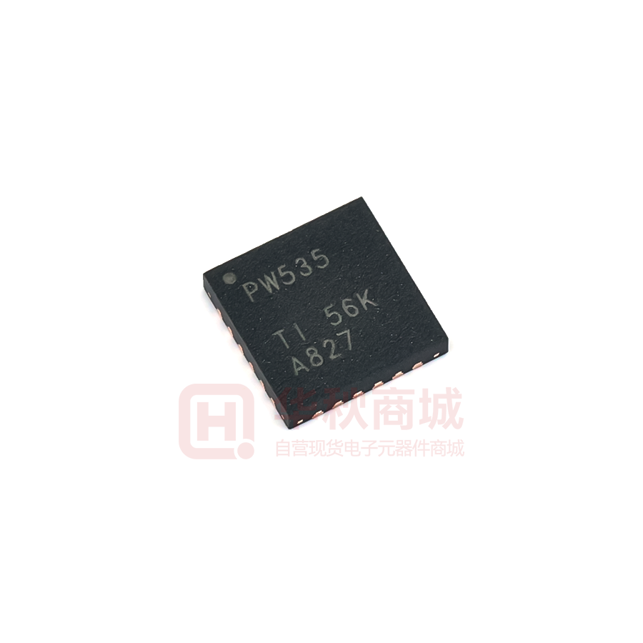

TCA9535 SCPS201E – AUGUST 2009 – REVISED MAY 2022 TCA9535 Low-Voltage 16-Bit I2C and SMBus Low-Power I/O Expander with Interrupt Output and Configuration Registers 1 Features • • • • • • • • • • • 3 Description I2C to Parallel port expander Wide power supply voltage range of 1.65 V to 5V Low standby-current consumption Open-drain active-low interrupt output 5-V tolerant I/O ports 400-kHz Fast I2C bus Polarity inversion register Address by three hardware address pins for use of up to eight devices Latched outputs with high-current drive capability for directly driving LEDs Latch-up performance exceeds 100 mA per JESD 78, class II ESD protection exceeds JESD 22 – 2000-V Human-Body Model (A114-A) – 1000-V Charged-Device Model (C101) The TCA9535 is a 24-pin device that provides 16 bits of general purpose parallel input and output (I/O) expansion for the two-line bidirectional I2C bus or (SMBus) protocol. The device can operate with a power supply voltage ranging from 1.65 V to 5.5 V. The TCA9535 consists of two 8-bit Configuration (input or output selection), Input Port, Output Port, and Polarity Inversion (active-high or active-low operation) registers. At power on, the I/Os are configured as inputs. The system controller can enable the I/Os as either inputs or outputs by writing to the I/O configuration bits. The TCA9535 is identical to the TCA9555, except that the TCA9535 does not include the internal I/O pull-up resistor, which requires pull-ups and pull-downs on unused I/O pins when configured as an input and undriven. 2 Applications • • • • • • Device Information Servers Routers (telecom switching equipment) Personal computers Personal electronics (for example, gaming consoles) Industrial automation Products with GPIO-limited processors PART NUMBER TCA9535 (1) BODY SIZE (NOM) TSSOP (24) 7.80 mm x 4.40 mm SSOP (24) 6.20 mm x 5.30 mm WQFN (24) 4.00 mm x 4.00 mm VQFN (24) 4.00 mm x 4.00 mm For all available packages, see the orderable addendum at the end of the data sheet. VCC I2C or SMBus Controller PACKAGE(1) P00 Peripheral Devices SDA P01 SCL P02 INT P03 x P04 x (e.g. Processor) P05 P06 x x RESET, EN or Control Inputs INT or status outputs LEDs Keypad P07 TCA9535 P10 P11 P12 P13 A2 P14 A1 P15 A0 P16 GND P17 Block Diagram An IMPORTANT NOTICE at the end of this data sheet addresses availability, warranty, changes, use in safety-critical applications, intellectual property matters and other important disclaimers. PRODUCTION DATA. TCA9535 www.ti.com SCPS201E – AUGUST 2009 – REVISED MAY 2022 Table of Contents 1 Features............................................................................1 2 Applications..................................................................... 1 3 Description.......................................................................1 4 Revision History.............................................................. 2 5 Pin Configuration and Functions...................................3 6 Specifications.................................................................. 4 6.1 Absolute Maximum Ratings........................................ 4 6.2 ESD Ratings............................................................... 4 6.3 Recommended Operating Conditions.........................4 6.4 Thermal Information....................................................5 6.5 Electrical Characteristics.............................................5 6.6 I2C Interface Timing Requirements.............................6 6.7 Switching Characteristics............................................7 6.8 Typical Characteristics................................................ 8 7 Detailed Description......................................................14 7.1 Overview................................................................... 14 7.2 Functional Block Diagram......................................... 14 7.3 Feature Description...................................................15 7.4 Device Functional Modes..........................................16 7.5 Programming............................................................ 16 7.6 Register Maps...........................................................22 8 Application and Implementation.................................. 23 8.1 Application Information............................................. 23 8.2 Typical Application.................................................... 23 9 Power Supply Recommendations................................27 10 Layout...........................................................................29 10.1 Layout Guidelines................................................... 29 10.2 Layout Example...................................................... 29 11 Device and Documentation Support..........................30 11.1 Documentation Support.......................................... 30 11.2 Receiving Notification of Documentation Updates.. 30 11.3 Support Resources................................................. 30 11.4 Trademarks............................................................. 30 11.5 Electrostatic Discharge Caution.............................. 30 11.6 Glossary.................................................................. 30 12 Mechanical, Packaging, and Orderable Information.................................................................... 30 4 Revision History NOTE: Page numbers for previous revisions may differ from page numbers in the current version. Changes from Revision D (June 2016) to Revision E (May 2022) Page • Globally changed instances of legacy terminology to controller and target where I2C is mentioned..................1 • Changed VCC to GND on the Controlled Switch in Figure 8-1 .........................................................................23 Changes from Revision C (May 2016) to Revision D (June 2016) Page • Added DB package ............................................................................................................................................1 Changes from Revision B (August 2015) to Revision C (May 2016) Page • Added RGE package.......................................................................................................................................... 1 • Added IOL for different Tj ....................................................................................................................................4 • Deleted ΔICC spec from the Electrical Characteristics table, added ΔICC typical characteristics graph............. 5 • Changed ICC standby into different input states, with increased maximums ..................................................... 5 • Changed Cio maximum ...................................................................................................................................... 5 Changes from Revision A (September 2009) to Revision B (August 2015) Page • Added Pin Configuration and Functions section, ESD Ratings table, Feature Description section, Device Functional Modes, Application and Implementation section, Power Supply Recommendations section, Layout section, Device and Documentation Support section, and Mechanical, Packaging, and Orderable Information section................................................................................................................................................................ 1 2 Submit Document Feedback Copyright © 2022 Texas Instruments Incorporated Product Folder Links: TCA9535 TCA9535 www.ti.com SCPS201E – AUGUST 2009 – REVISED MAY 2022 1 24 2 23 3 22 4 21 5 20 6 19 7 18 8 17 9 16 10 15 11 14 12 13 VCC SDA SCL A0 P17 P16 P15 P14 P13 P12 P11 P10 24 P00 P01 P02 P03 P04 P05 23 22 21 20 19 1 18 2 17 Exposed Center Pad 3 4 16 15 5 14 6 13 7 8 9 10 11 A0 P17 P16 P15 P14 P13 12 P06 P07 GND P10 P11 P12 INT A1 A2 P00 P01 P02 P03 P04 P05 P06 P07 GND A2 A1 INT VCC SDA SCL 5 Pin Configuration and Functions Figure 5-1. DB, PW (TSSOP) Package 24-Pin (Top View) The exposed center pad, if used, must be connected as a secondary ground or left electrically open. Figure 5-2. RTW (WQFN), RGE (VQFN) Package 24-Pin (Top View) Table 5-1. Pin Functions PIN NO. NAME TYPE DESCRIPTION DB, PW RTW, RGE A0 21 18 Input Address input 0. Connect directly to VCC or ground A1 2 23 Input Address input 1. Connect directly to VCC or ground A2 3 24 Input Address input 2. Connect directly to VCC or ground GND 12 9 — INT 1 22 Output P00(1) 4 1 I/O P-port I/O. Push-pull design structure. At power on, P00 is configured as an input P01(1) 5 2 I/O P-port I/O. Push-pull design structure. At power on, P01 is configured as an input P02(1) 6 3 I/O P-port I/O. Push-pull design structure. At power on, P02 is configured as an input P03(1) 7 4 I/O P-port I/O. Push-pull design structure. At power on, P03 is configured as an input P04(1) 8 5 I/O P-port I/O. Push-pull design structure. At power on, P04 is configured as an input P05(1) 9 6 I/O P-port I/O. Push-pull design structure. At power on, P05 is configured as an input P06(1) 10 7 I/O P-port I/O. Push-pull design structure. At power on, P06 is configured as an input Ground Interrupt output. Connect to VCC through an external pull-up resistor P07(1) 11 8 I/O P-port I/O. Push-pull design structure. At power on, P07 is configured as an input P10(1) 13 10 I/O P-port I/O. Push-pull design structure. At power on, P10 is configured as an input P11(1) 14 11 I/O P-port I/O. Push-pull design structure. At power on, P11 is configured as an input P12(1) 15 12 I/O P-port I/O. Push-pull design structure. At power on, P12 is configured as an input P13(1) 16 13 I/O P-port I/O. Push-pull design structure. At power on, P13 is configured as an input P14(1) 17 14 I/O P-port I/O. Push-pull design structure. At power on, P14 is configured as an input P15(1) 18 15 I/O P-port I/O. Push-pull design structure. At power on, P15 is configured as an input P16(1) 19 16 I/O P-port I/O. Push-pull design structure. At power on, P16 is configured as an input P17(1) 20 17 I/O P-port I/O. Push-pull design structure. At power on, P17 is configured as an input SCL 22 19 Input Serial clock bus. Connect to VCC through a pull-up resistor SDA 23 20 Input Serial data bus. Connect to VCC through a pull-up resistor VCC 24 21 — (1) Supply voltage If port is unused, it must be tied to either VCC or GND through a resistor of moderate value (about 10 kΩ) Submit Document Feedback Copyright © 2022 Texas Instruments Incorporated Product Folder Links: TCA9535 3 TCA9535 www.ti.com SCPS201E – AUGUST 2009 – REVISED MAY 2022 6 Specifications 6.1 Absolute Maximum Ratings over operating free-air temperature range (unless otherwise noted)(1) VCC MIN MAX UNIT Supply voltage –0.5 6 V voltage(2) –0.5 6 V –0.5 6 V VI Input VO Output voltage(2) IIK Input clamp current VI < 0 –20 mA IOK Output clamp current VO < 0 –20 mA IIOK Input-output clamp current VO < 0 or VO > VCC ±20 mA IOL Continuous output low current VO = 0 to VCC 50 mA IOH Continuous output high current VO = 0 to VCC ICC –50 mA Continuous current through GND –250 mA Continuous current through VCC 160 mA 100 °C 150 °C Tj(MAX) Maximum junction temperature Tstg (1) (2) Storage temperature –65 Operation outside the Absolute Maximum Ratings may cause permanent device damage. Absolute maximum ratings do not imply functional operation of the device at these or any other conditions beyond those listed under Recommended Operating Conditions. If briefly operating outside the Recommended Operating Conditions but within the Absolute Maximum Ratings, the device may not sustain damage, but it may not be fully functional. Operating the device in this manner may affect device reliability, functionality, performance, and shorten the device lifetime. The input negative-voltage and output voltage ratings may be exceeded if the input and output current ratings are observed. 6.2 ESD Ratings VALUE V(ESD) (1) (2) Electrostatic discharge Human-body model (HBM), per ANSI/ESDA/JEDEC JS-001(1) ±2000 Charged-device model (CDM), per JEDEC specification JESD22-C101(2) ±1000 UNIT V JEDEC document JEP155 states that 500-V HBM allows safe manufacturing with a standard ESD control process. JEDEC document JEP157 states that 250-V CDM allows safe manufacturing with a standard ESD control process. 6.3 Recommended Operating Conditions over operating free-air temperature range (unless otherwise noted) VCC MAX 5.5 V SCL, SDA 0.7 × VCC VCC (1) V A2–A0, P07–P00, P17–P10 0.7 × VCC 5.5 V –0.5 0.3 × VCC V VIH High-level input voltage VIL Low-level input voltage SCL, SDA, A2–A0, P07–P00, P17–P10 IOH High-level output current P07–P00, P17–P10 IOL Low-level output current(2) IOL Low-level output current(2) TA Operating free-air temperature (1) (2) 4 MIN 1.65 Supply voltage P07–P00, P17–P10 INT, SDA –10 Tj ≤ 65°C 25 Tj ≤ 85°C 18 Tj ≤ 100°C 11 Tj ≤ 85°C 6 Tj ≤ 100°C 3.5 –40 85 UNIT mA mA mA °C For voltages applied above VCC, an increase in ICC results. The values shown apply to specific junction temperatures, which depend on the RθJA of the package used. See the Calculating Junction Temperature and Power Dissipation section on how to calculate the junction temperature. Submit Document Feedback Copyright © 2022 Texas Instruments Incorporated Product Folder Links: TCA9535 TCA9535 www.ti.com SCPS201E – AUGUST 2009 – REVISED MAY 2022 6.4 Thermal Information TCA9535 THERMAL METRIC(1) RθJA Junction-to-ambient thermal resistance RθJC(top) Junction-to-case (top) thermal resistance RθJB Junction-to-board thermal resistance ψJT ψJB RθJC(bot) (1) PW (TSSOP) DB (SSOP) RTW (WQFN) RGE (VQFN) 24 PINS 24 PINS 24 PINS 24 PINS 108.8 92.9 43.6 48.4 °C/W UNIT 54 53.5 46.2 58.1 °C/W 62.8 50.4 22.1 27.1 °C/W Junction-to-top characterization parameter 11.1 21.9 1.5 3.3 °C/W Junction-to-board characterization parameter 62.3 50.1 22.2 27.2 °C/W Junction-to-case (bottom) thermal resistance N/A N/A 10.7 15.3 °C/W For more information about traditional and new thermal metrics, see the Semiconductor and IC Package Thermal Metrics application report. 6.5 Electrical Characteristics over recommended operating free-air temperature range (unless otherwise noted) PARAMETER TEST CONDITIONS VIK Input diode clamp voltage II = –18 mA VPORR Power-on reset voltage, VCC rising VI = VCC or GND, IO = 0 VPORF Power-on reset voltage, VCC falling VI = VCC or GND, IO = 0 IOH = –8 mA VOH P-port high-level output voltage(2) IOH = –10 mA II Low-level output current Input leakage current 1.65 V to 5.5 V MIN TYP(1) MAX –1.2 0.75 1.65 V 1.2 2.3 V 1.8 3V 2.6 4.75 V 4.1 1.65 V 1 2.3 V 1.7 3V 2.5 1.5 1 V V V 4.75 V 4 1.65 V to 5.5 V 3 VOL = 0.5 V 1.65 V to 5.5 V 8 VOL = 0.7 V 1.65 V to 5.5 V 10 INT VOL = 0.4 V 1.65 V to 5.5 V 3 SCL, SDA Input leakage VI = VCC or GND 1.65 V to 5.5 V ±1 A2–A0 Input leakage VI = VCC or GND 1.65 V to 5.5 V ±1 P port(3) UNIT V 1.2 VOL = 0.4 V SDA IOL VCC mA μA IIH Input high leakage current P port VI = VCC 1.65 V to 5.5 V 1 μA IIL Input low leakage current P port VI = GND 1.65 V to 5.5 V –1 μA Submit Document Feedback Copyright © 2022 Texas Instruments Incorporated Product Folder Links: TCA9535 5 TCA9535 www.ti.com SCPS201E – AUGUST 2009 – REVISED MAY 2022 6.5 Electrical Characteristics over recommended operating free-air temperature range (unless otherwise noted) PARAMETER Operating mode ICC TEST CONDITIONS VCC MIN TYP(1) 5.5 V 22 40 VI = VCC or GND, IO = 0, I/O = inputs, fSCL = 400 kHz, No load 3.6 V 11 30 VI = VCC, IO = 0, I/O = inputs, fSCL = 0 kHz, No load Quiescent current Standby mode VI = GND, IO = 0, I/O = inputs, fSCL = 0 kHz, No load CI Cio (1) (2) (3) MAX 2.7 V 8 19 1.95 V 5 11 5.5 V 1.5 3.9 3.6 V 0.9 2.2 2.7 V 0.6 1.8 1.95 V 0.6 1.5 5.5 V 1.5 8.7 3.6 V 0.9 4 2.7 V 0.6 3 1.95 V 0.4 2.2 Input capacitance SCL VI = VCC or GND 1.65 V to 5.5 V 3 8 Input-output pin capacitance SDA VIO = VCC or GND 1.65 V to 5.5 V 3 9.5 P port VIO = VCC or GND 1.65 V to 5.5 V 3.7 9.5 UNIT μA pF pF All typical values are at nominal supply voltage (1.8-, 2.5-, 3.3-, or 5-V VCC) and TA = 25°C. Each I/O must be externally limited to a maximum of 25 mA, and each octal (P07–P00 and P17–P10) must be limited to a maximum current of 100 mA, for a device total of 200 mA. The total current sourced by all I/Os must be limited to 160 mA (80 mA for P07–P00 and 80 mA for P17–P10). 6.6 I2C Interface Timing Requirements over recommended operating free-air temperature range (unless otherwise noted) (see Figure 7-2) MIN MAX UNIT 0 100 kHz I2C BUS—STANDARD MODE fscl I2C clock frequency tsch I2C tscl I2C clock low time tsp I2C tsds I2C serial-data setup time tsdh I2C ticr I2C input rise time ticf I2C tocf I2C output fall time tbuf I2C tsts I2C start or repeated start condition setup tsth I2C tsps I2C stop condition setup tvd(data) Valid data time SCL low to SDA output valid 3.45 µs tvd(ack) Valid data time of ACK condition ACK signal from SCL low to SDA (out) low 3.45 µs Cb I2C bus capacitive load 400 pF 400 kHz clock high time 4 µs 4.7 µs spike time 50 250 serial-data hold time ns 0 input fall time 10-pF to 400-pF bus bus free time between stop and start start or repeated start condition hold ns ns 1000 ns 300 ns 300 ns 4.7 µs 4.7 µs 4 µs 4 µs I2C BUS—FAST MODE 6 fscl I2C clock frequency tsch I2C clock high time 0.6 µs tscl I2C 1.3 µs 0 clock low time Submit Document Feedback Copyright © 2022 Texas Instruments Incorporated Product Folder Links: TCA9535 TCA9535 www.ti.com SCPS201E – AUGUST 2009 – REVISED MAY 2022 6.6 I2C Interface Timing Requirements (continued) over recommended operating free-air temperature range (unless otherwise noted) (see Figure 7-2) MIN tsp I2C spike time tsds I2C tsdh I2C serial-data hold time ticr I2C MAX 50 serial-data setup time input rise time UNIT ns 100 ns 0 ns 20 300 ns 20 × (VCC / 5.5 V) 300 ns 20 × (VCC / 5.5 V) 300 ns ticf I2C input fall time tocf I2C output fall time tbuf I2C bus free time between stop and start 1.3 µs tsts I2C 0.6 µs tsth I2C start or repeated start condition hold 0.6 µs tsps I2C tvd(data) Valid data time SCL low to SDA output valid 0.9 µs tvd(ack) Valid data time of ACK condition ACK signal from SCL low to SDA (out) low 0.9 µs Cb I2C bus capacitive load 400 pF 10-pF to 400-pF bus start or repeated start condition setup stop condition setup 0.6 µs 6.7 Switching Characteristics over recommended operating free-air temperature range, CL ≤ 100 pF (unless otherwise noted) (see Figure 7-2 and Figure 7-3) PARAMETER tiv Interrupt valid time tir Interrupt reset delay time tpv Output data valid; For VCC = 2.3 V–5.5 V Output data valid; For VCC = 1.65 V–2.3 V FROM (INPUT) TO (OUTPUT) P port INT SCL INT SCL P port MIN MAX UNIT 4 μs 4 μs 200 ns 300 ns tps Input data setup time P port SCL 150 ns tph Input data hold time P port SCL 1 μs Submit Document Feedback Copyright © 2022 Texas Instruments Incorporated Product Folder Links: TCA9535 7 TCA9535 www.ti.com SCPS201E – AUGUST 2009 – REVISED MAY 2022 6.8 Typical Characteristics TA = 25°C (unless otherwise noted) 40 2.2 Vcc = 1.65 V Vcc = 1.8 V Vcc = 2.5 V 32 Vcc = 3.3 V Vcc = 3.6 V Vcc = 5 V Vcc = 5.5V 1.8 28 24 20 16 12 8 -15 10 35 TA - Temperature (°C) 60 1.4 1.2 1 0.8 0.6 0.2 -40 85 -15 D001 Figure 6-1. Supply Current vs Temperature for Different Supply Voltage (VCC) 10 35 TA - Temperature (°C) 60 85 D002 Figure 6-2. Standby Supply Current vs Temperature for Different Supply Voltage (VCC) 30 30 -40qC 25qC 85qC -40qC 25qC 85qC 25 IOL - Sink Current (mA) 25 ICC - Supply Current (µA) Vcc = 5.5V 0.4 0 -40 20 15 10 5 20 VCC = 1.65 V 15 10 5 0 1.5 0 2 2.5 3 3.5 4 4.5 VCC - Supply Voltage (V) 5 5.5 0 0.1 D003 Figure 6-3. Supply Current vs Supply Voltage for Different Temperature (TA) 0.2 0.3 0.4 0.5 VOL - Output Low Voltage (V) 0.6 0.7 D004 Figure 6-4. I/O Sink Current vs Output Low Voltage for Different Temperature (TA) for VCC = 1.65 V 60 35 25 IOL - Sink Current (mA) -40qC 25qC 85qC 30 IOL - Sink Current (mA) Vcc = 3.3 V Vcc = 3.6 V Vcc = 5 V 1.6 4 VCC = 1.8 V 20 15 10 50 -40qC 25qC 85qC 40 VCC = 2.5 V 30 20 10 5 0 0 0 0.1 0.2 0.3 0.4 0.5 VOL - Output Low Voltage (V) 0.6 0.7 0 D005 Figure 6-5. I/O Sink Current vs Output Low Voltage for Different Temperature (TA) for VCC = 1.8 V 8 Vcc = 1.65 V Vcc = 1.8 V Vcc = 2.5 V 2 ICC - Supply Current (µA) ICC - Supply Current (µA) 36 0.1 0.2 0.3 0.4 0.5 VOL - Output Low Voltage (V) 0.6 0.7 D006 Figure 6-6. I/O Sink Current vs Output Low Voltage for Different Temperature (TA) for VCC = 2.5 V Submit Document Feedback Copyright © 2022 Texas Instruments Incorporated Product Folder Links: TCA9535 TCA9535 www.ti.com SCPS201E – AUGUST 2009 – REVISED MAY 2022 6.8 Typical Characteristics (continued) TA = 25°C (unless otherwise noted) 70 80 -40qC 25qC 85qC 50 VCC = 3.3 V 40 30 20 10 60 VCC = 5 V 50 40 30 20 10 0 0 0 0.1 0.2 0.3 0.4 0.5 VOL - Output Low Voltage (V) 0.6 0.7 0 0.1 0.2 0.3 0.4 0.5 VOL - Output Low Voltage (V) D007 Figure 6-7. I/O Sink Current vs Output Low Voltage for Different Temperature (TA) for VCC = 3.3 V 0.6 0.7 D009 Figure 6-8. I/O Sink Current vs Output Low Voltage for Different Temperature (TA) for VCC = 5 V 300 90 70 VOL - Output Low Voltage (V) -40qC 25qC 85qC 80 IOL - Sink Current (mA) -40qC 25qC 85qC 70 IOL - Sink Current (mA) IOL - Sink Current (mA) 60 VCC = 5.5 V 60 50 40 30 20 1.8 V, 1 mA 1.8 V, 10 mA 3.3 V, 1mA 250 3.3 V, 10 mA 5 V, 1 mA 5 V, 10 mA 200 150 100 50 10 0 -40 0 0 0.1 0.2 0.3 0.4 0.5 VOL - Output Low Voltage (V) 0.6 0.7 Figure 6-9. I/O Sink Current vs Output Low Voltage for Different Temperature (TA) for VCC = 5.5 V 10 35 TA - Temperature (°C) 60 85 D011 Figure 6-10. I/O Low Voltage vs Temperature for Different VCC and IOL 20 25 -40qC 25qC 85qC IOH - Source Current (mA) IOH - Source Current (mA) -15 D010 15 VCC = 1.65 V 10 5 0 -40qC 25qC 85qC 20 VCC = 1.8 V 15 10 5 0 0 0.1 0.2 0.3 0.4 0.5 VCC-VOH - Output High Voltage (V) 0.6 0.7 0 D012 Figure 6-11. I/O Source Current vs Output High Voltage for Different Temperature (TA) for VCC = 1.65 V 0.1 0.2 0.3 0.4 0.5 VCC-VOH - Output High Voltage (V) 0.6 0.7 D013 Figure 6-12. I/O Source Current vs Output High Voltage for Different Temperature (TA) for VCC = 1.8 V Submit Document Feedback Copyright © 2022 Texas Instruments Incorporated Product Folder Links: TCA9535 9 TCA9535 www.ti.com SCPS201E – AUGUST 2009 – REVISED MAY 2022 6.8 Typical Characteristics (continued) TA = 25°C (unless otherwise noted) 60 40 IOH - Source Current (mA) 35 IOH - Source Current (mA) -40qC 25qC 85qC 30 VCC = 2.5 V 25 20 15 10 0 0.1 0.2 0.3 0.4 0.5 VCC-VOH - Output High Voltage (V) 0.6 VCC = 3.3 V 30 20 0.7 0 0.1 0.2 0.3 0.4 0.5 VCC-VOH - Output High Voltage (V) D014 Figure 6-13. I/O Source Current vs Output High Voltage for Different Temperature (TA) for VCC = 2.5 V 0.6 0.7 D015 Figure 6-14. I/O Source Current vs Output High Voltage for Different Temperature (TA) for VCC = 3.3 V 70 80 -40qC 25qC 85qC 50 -40qC 25qC 85qC 70 IOH - Source Current (mA) 60 IOH - Source Current (mA) 40 0 0 VCC = 5 V 40 30 20 10 60 VCC = 5.5 V 50 40 30 20 10 0 0 0 0.1 0.2 0.3 0.4 0.5 VCC-VOH - Output High Voltage (V) 0.6 0.7 0 D016 Figure 6-15. I/O Source Current vs Output High Voltage for Different Temperature (TA) for VCC = 5 V 350 0.1 0.2 0.3 0.4 0.5 VCC-VOH - Output High Voltage (V) 0.6 0.7 D017 Figure 6-16. I/O Source Current vs Output High Voltage for Different Temperature (TA) for VCC = 5.5 V 400 18 1.65 V, 10 mA 2.5 V, 10 mA 3.6 V, 10 mA 5 V, 10 mA 5.5 V, 10 mA 15 1.65 V 1.8 V 2.5 V 3.3 V 5V 5.5 V 300 Delta ICC (µA) VCC-VOH - I/O High Voltage (mV) -40qC 25qC 85qC 10 5 250 200 150 12 9 6 3 100 50 -40 -15 10 35 TA - Temperature (°C) 60 85 0 -40 D018 Figure 6-17. VCC – VOH Voltage vs Temperature for Different VCC 10 50 -15 10 35 TA - Temperature (°C) 60 85 D019 Figure 6-18. Δ ICC vs Temperature for Different VCC (VI = VCC – 0.6 V) Submit Document Feedback Copyright © 2022 Texas Instruments Incorporated Product Folder Links: TCA9535 TCA9535 www.ti.com SCPS201E – AUGUST 2009 – REVISED MAY 2022 Parameter Measurement Information A. B. C. CL includes probe and jig capacitance. All inputs are supplied by generators having the following characteristics: PRR ≤ 10 MHz, ZO = 50 Ω, tr/tf ≤ 30 ns. All parameters and waveforms are not applicable to all devices. Figure 7-1. I2C Interface Load Circuit and Voltage Waveforms Submit Document Feedback Copyright © 2022 Texas Instruments Incorporated Product Folder Links: TCA9535 11 TCA9535 www.ti.com SCPS201E – AUGUST 2009 – REVISED MAY 2022 VCC RL = 4.7 kΩ DUT INT CL = 100 pF (see Note A) Interrupt Load Configuration 1 SCL 2 3 4 5 6 7 8 Data From Port Target Address SDA S 1 1 1 Start Condition 0 1 A1 A0 1 R/W Data 1 A Data From Port Data 4 A NACK From Stop Controller Condition ACK From Controller ACK From Target NA P Read From Port Data Into Port Data 2 Data 3 tph Data 4 Data 5 tps INT tiv tir 0.7 × VCC INT SCL 0.3 × VCC 0.7 × VCC R/W tiv 0.3 × VCC tir Data Into 0.7 × VCC Port (Pn) 0.3 × VCC A. B. C. A 0.7 × VCC INT 0.3 × VCC CL includes probe and jig capacitance. All inputs are supplied by generators having the following characteristics: PRR ≤ 10 MHz, ZO = 50 Ω, tr/tf ≤ 30 ns. All parameters and waveforms are not applicable to all devices. Figure 7-2. Interrupt Load Circuit and Voltage Waveforms 12 Submit Document Feedback Copyright © 2022 Texas Instruments Incorporated Product Folder Links: TCA9535 TCA9535 www.ti.com A. B. C. D. E. SCPS201E – AUGUST 2009 – REVISED MAY 2022 CL includes probe and jig capacitance. tpv is measured from 0.7 × VCC on SCL to 50% I/O (Pn) output. All inputs are supplied by generators having the following characteristics: PRR ≤ 10 MHz, ZO = 50 Ω, tr/tf ≤ 30 ns. The outputs are measured one at a time, with one transition per measurement. All parameters and waveforms are not applicable to all devices. Figure 7-3. P-Port Load Circuit and Voltage Waveforms Submit Document Feedback Copyright © 2022 Texas Instruments Incorporated Product Folder Links: TCA9535 13 TCA9535 www.ti.com SCPS201E – AUGUST 2009 – REVISED MAY 2022 7 Detailed Description 7.1 Overview The TCA9535 device is a 16-bit I/O expander for the I2C bus and is designed for 1.65-V to 5.5-V VCC operation. It provides general-purpose remote I/O expansion for most microcontroller families via the I2C interface. The TCA9535 consists of two 8-bit Configuration (input or output selection), Input Port, Output Port, and Polarity Inversion (active-high or active-low operation) registers. At power-on, the I/Os are configured as inputs. The system controller can enable the I/Os as either inputs or outputs by writing to the I/O configuration register bits. The data for each input or output is kept in the corresponding Input or output register. The polarity of the Input Port register can be inverted with the Polarity Inversion register. All registers can be read by the system controller. The TCA9535 open-drain interrupt ( INT) output is activated when any input state differs from its corresponding Input Port register state and is used to indicate to the system controller that an input state has changed. INT can be connected to the interrupt input of a microcontroller. By sending an interrupt signal on this line, the remote I/O can inform the microcontroller if there is incoming data on its ports without having to communicate via the I2C bus. Thus, the TCA9535 can remain a simple target device. The device outputs (latched) have high-current drive capability for directly driving LEDs. The device has low current consumption. The TCA9535 device is similar to the PCA9555, except for the removal of the internal I/O pull-up resistor, which greatly reduces power consumption when the I/Os are held low. The TCA9535 is equivalent to the PCA9535 with lower voltage support (down to VCC = 1.65 V), and also improved power-on-reset circuitry for different application scenarios. Three hardware pins (A0, A1 and A2) are used to program and vary the fixed I2C address and allow up to 8 devices to share the same I2C bus or SMBus. 7.2 Functional Block Diagram TCA9535 INT A0 A1 A2 SCL SDA 1 Interrupt Logic LP Filter 21 2 P07-P00 3 22 23 Input Filter I2C Bus Control Shift Register 16 Bits I/O Port P17-P10 Write Pulse VCC GND 24 12 Read Pulse Power-On Reset Pin numbers shown are for the PW package. 14 Submit Document Feedback Copyright © 2022 Texas Instruments Incorporated Product Folder Links: TCA9535 TCA9535 www.ti.com SCPS201E – AUGUST 2009 – REVISED MAY 2022 All I/Os are set to inputs at reset. Figure 7-1. Logic Diagram (Positive Logic) Data From Shift Register Output Port Register Data Configuration Register Data From Shift Register D Q FF Write Configuration Pulse VCC Q1 D CLK Q Q FF I/O Pin CLK Q Write Pulse Output Port Register Q2 Input Port Register D Q FF Read Pulse GND Input Port Register Data CLK Q To INT Data From Shift Register D Q Polarity Register Data FF Write Polarity Pulse CLK Q Polarity Inversion Register At power-on reset, all registers return to default values. Figure 7-2. Simplified Schematic of P-Port I/Os 7.3 Feature Description 7.3.1 5-V Tolerant I/O Ports The TCA9535 features I/O ports, which are tolerant up to 5 V. This allows the TCA9535 to be connected to a large array of devices. To minimize ICC, any input signals must be designed so the input voltage stays within VIH and VIL of the device as described in the Electrical Characteristics section. 7.3.2 Hardware Address Pins The TCA9535 features 3 hardware address pins (A0, A1, and A2). The user selects the device I2C address by pulling each pin to either VCC or GND to signify the bit value in the address. This allows up to 8 TCA9535 devices to be on the same bus without address conflicts. See the Functional Block Diagram for the 3 address pins. The voltage on the pins must not change while the device is powered up in order to prevent possible I2C glitches as a result of the device address changing during a transmission. All of the pins must be tied either to VCC or GND and cannot be left floating. Submit Document Feedback Copyright © 2022 Texas Instruments Incorporated Product Folder Links: TCA9535 15 TCA9535 www.ti.com SCPS201E – AUGUST 2009 – REVISED MAY 2022 7.3.3 Interrupt ( INT) Output An interrupt is generated by any rising or falling edge of the port inputs in the input mode. After time tiv, the signal INT is valid. Resetting the interrupt circuit is achieved when data on the port is changed to the original setting or data is read from the port that generated the interrupt. Resetting occurs in the read mode at the acknowledge (ACK) bit after the rising edge of the SCL signal. Note that the INT is reset at the ACK just before the byte of changed data is sent. Interrupts that occur during the ACK clock pulse can be lost (or be very short) because of the resetting of the interrupt during this pulse. Each change of the I/Os after resetting is detected and is transmitted as INT. Reading from or writing to another device does not affect the interrupt circuit, and a pin configured as an output cannot cause an interrupt. Changing an I/O from an output to an input may cause a false interrupt to occur if the state of the pin does not match the contents of the Input Port register. Because each 8-bit port is read independently, the interrupt caused by port 0 is not cleared by a read of port 1, or the interrupt caused by port 1 is not cleared by a read of port 0. INT has an open-drain structure. INT requires a pull-up resistor to VCC of moderate value (typically about 10 kΩ). 7.4 Device Functional Modes 7.4.1 Power-On Reset (POR) When power (from 0 V) is applied to VCC, an internal power-on reset circuit holds the TCA9535 in a reset condition until VCC has reached VPORR. At that time, the reset condition is released. The TCA9535 registers and I2C-SMBus state machine initialize to their default states. Then, VCC must be lowered to below VPORF and back up to the operating voltage for a power-reset cycle. 7.4.2 Powered-Up When power has been applied to VCC above VPORR, and the POR has taken place, the device is in a functioning mode. In this state, the device is ready to accept any incoming I2C requests and is monitoring for changes on the input ports. 7.5 Programming 7.5.1 I2C Interface The TCA9535 has a standard bidirectional I2C interface that is controlled by a controller device in order to be configured or read the status of this device. Each target on the I2C bus has a specific device address to differentiate between other target devices that are on the same I2C bus. Many target devices require configuration upon startup to set the behavior of the device. This is typically done when the controller accesses internal register maps of the target, which have unique register addresses. A device can have one or multiple registers where data is stored, written, or read. For more information see Understanding the I2C Bus application report, SLVA704. The physical I2C interface consists of the serial clock (SCL) and serial data (SDA) lines. Both SDA and SCL lines must be connected to VCC through a pull-up resistor. The size of the pull-up resistor is determined by the amount of capacitance on the I2C lines. For further details, see I2C Pull-up Resistor Calculation application report, SLVA689. Data transfer may be initiated only when the bus is idle. A bus is considered idle if both SDA and SCL lines are high after a STOP condition. See Table 7-1. Figure 7-3 and Figure 7-4 show the general procedure for a controller to access a target device: 1. If a controller wants to send data to a target: • Controller-transmitter sends a START condition and addresses the target-receiver. • Controller-transmitter sends data to target-receiver. • Controller-transmitter terminates the transfer with a STOP condition. 2. If a controller wants to receive or read data from a target: • Controller-receiver sends a START condition and addresses the target-transmitter. • Controller-receiver sends the requested register to read to target-transmitter. • Controller-receiver receives data from the target-transmitter. 16 Submit Document Feedback Copyright © 2022 Texas Instruments Incorporated Product Folder Links: TCA9535 TCA9535 www.ti.com • SCPS201E – AUGUST 2009 – REVISED MAY 2022 Controller-receiver terminates the transfer with a STOP condition. SCL SDA Data Transfer START Condition STOP Condition Figure 7-3. Definition of Start and Stop Conditions SDA line stable while SCL line is high SCL 1 0 1 0 1 0 1 0 ACK MSB Bit Bit Bit Bit Bit Bit LSB ACK SDA Byte: 1010 1010 ( 0xAAh ) Figure 7-4. Bit Transfer Table 7-1 shows the interface definition. Table 7-1. Interface Definition BYTE BIT 7 (MSB) 6 5 4 3 2 1 0 (LSB) I2C target address L H L L A2 A1 A0 R/ W P0x I/O data bus P07 P06 P05 P04 P03 P02 P01 P00 P1x I/O data bus P17 P16 P15 P14 P13 P12 P11 P10 7.5.1.1 Bus Transactions Data is exchanged between the controller and the TCA9535 through write and read commands, and this is accomplished by reading from or writing to registers in the target device. Registers are locations in the memory of the target which contain information, whether it be the configuration information or some sampled data to send back to the controller. The controller must write information to these registers in order to instruct the target device to perform a task. Submit Document Feedback Copyright © 2022 Texas Instruments Incorporated Product Folder Links: TCA9535 17 TCA9535 www.ti.com SCPS201E – AUGUST 2009 – REVISED MAY 2022 7.5.1.1.1 Writes To write on the I2C bus, the controller sends a START condition on the bus with the address of the target, as well as the last bit (the R/ W bit) set to 0, which signifies a write. After the target sends the acknowledge bit, the controller then sends the register address of the register to which it wishes to write. The target acknowledges again, letting the controller know it is ready. After this, the controller starts sending the register data to the target until the controller has sent all the data necessary (which is sometimes only a single byte), and the controller terminates the transmission with a STOP condition. See the Control Register and Command Byte section to see list of the TCA9535 internal registers and a description of each one. Figure 7-5 shows an example of writing a single byte to a target register. Controller controls SDA line Target controls SDA line Write to one register in a device Device (Target) Address (7 bits) S 0 1 0 0 START A2 A1 A0 Register Address N (8 bits) 0 R/W=0 A Data Byte to Register N (8 bits) B7 B6 B5 B4 B3 B2 B1 B0 ACK A D7 D6 D5 D4 D3 D2 D1 D0 ACK A P ACK STOP Figure 7-5. Write to Register Figure 7-6 shows the Write to the Polarity Inversion Register. Controller controls SDA line Target controls SDA line Register Address 0x02 (8 bits) Device (Target) Address (7 bits) S 0 START 1 0 0 A2 A1 A0 0 R/W=0 A 0 0 0 0 ACK 0 1 0 Data Byte to Register 0x02 (8 bits) 0 A D7 D6 D5 D4 D3 D2 D1 D0 ACK A ACK P STOP Figure 7-6. Write to the Polarity Inversion Register Figure 7-7 shows the Write to Output Port Registers. 18 Submit Document Feedback Copyright © 2022 Texas Instruments Incorporated Product Folder Links: TCA9535 TCA9535 www.ti.com 1 SCL SCPS201E – AUGUST 2009 – REVISED MAY 2022 2 3 4 5 6 7 8 9 Command Byte Target Address SDA S 0 1 0 0 A2 A1 A0 0 A 0 0 0 0 0 0 Data to Port 0 1 0 A R/W Acknowledge From Target Start Condition 0.7 Data to Port 1 0.0 Data 0 A 1.7 Acknowledge From Target Data 1 1.0 A P Acknowledge From Target Write to Port Data Out from Port 0 tpv Data Valid Data Out from Port 1 tpv Figure 7-7. Write to Output Port Registers 7.5.1.1.2 Reads Reading from a target is very similar to writing, but requires some additional steps. In order to read from a target, the controller must first instruct the target which register it wishes to read from. This is done by the controller starting off the transmission in a similar fashion as the write, by sending the address with the R/ W bit equal to 0 (signifying a write), followed by the register address it wishes to read from. When the target acknowledges this register address, the controller sends a START condition again, followed by the target address with the R/ W bit set to 1 (signifying a read). This time, the target acknowledges the read request, and the controller releases the SDA bus but continues supplying the clock to the target. During this part of the transaction, the controller becomes the controller-receiver, and the target becomes the target-transmitter. The controller continues to send out the clock pulses, but releases the SDA line so that the target can transmit data. At the end of every byte of data, the controller sends an ACK to the target, letting the target know that it is ready for more data. When the controller has received the number of bytes it is expecting, it sends a NACK, signaling to the target to halt communications and release the bus. The controller follows this up with a STOP condition. See the Control Register and Command Byte section to see list of the TCA9535's internal registers and a description of each one. Figure 7-8 shows an example of reading a single byte from a target register. Controller controls SDA line Target controls SDA line Read from one register in a device Device (Target) Address (7 bits) S 0 START 1 0 0 A2 A1 A0 Register Address N (8 bits) 0 R/W=0 A B7 B6 B5 B4 B3 B2 B1 B0 ACK Data Byte from Register N (8 bits) Device (Target) Address (7 bits) A ACK Sr 0 1 0 0 A2 A1 A0 Repeated START 1 R/W=1 A D7 D6 D5 D4 D3 D2 D1 D0 NA ACK P NACK STOP Figure 7-8. Read from Register After a restart, the value of the register defined by the command byte matches the register being accessed when the restart occurred. For example, if the command byte references Input Port 1 before the restart, and the restart occurs when Input Port 0 is being read, the stored command byte changes to reference Input Port 0. The original command byte is forgotten. If a subsequent restart occurs, Input Port 0 is read first. Data is clocked into the register on the rising edge of the ACK clock pulse. After the first byte is read, additional bytes may be read, but the data now reflect the information in the other register in the pair. For example, if Input Port 1 is read, the next byte read is Input Port 0. Submit Document Feedback Copyright © 2022 Texas Instruments Incorporated Product Folder Links: TCA9535 19 TCA9535 www.ti.com SCPS201E – AUGUST 2009 – REVISED MAY 2022 Data is clocked into the register on the rising edge of the ACK clock pulse. There is no limitation on the number of data bytes received in one read transmission, but when the final byte is received, the bus controller must not acknowledge the data. Figure 7-9 and Figure 7-10 show two different scenarios of Read Input Port Register. SCL 1 2 3 4 5 6 7 8 9 I0.x SDA S 0 0 1 0 A2 A1 A0 7 A 1 R/W 6 5 4 3 I1.x 2 1 0 A 7 6 5 4 3 Acknowledge From Controller Acknowledge From Target I0.x 2 1 0 A 7 6 5 4 3 I1.x 2 1 0 A 7 6 5 4 3 2 Acknowledge From Controller Acknowledge From Controller 1 0 1 P No Acknowledge From Controller Read From Port 0 Data Into Port 0 Read From Port 1 Data Into Port 1 INT tiv tir Transfer of data can be stopped at any time by a Stop condition. When this occurs, data present at the latest acknowledge phase is valid (output mode). It is assumed that the command byte previously has been set to 00 (read Input Port register). This figure eliminates the command byte transfer, a restart, and target address call between the initial target address call and actual data transfer from the P port. Figure 7-9. Read Input Port Register, Scenario 1 1 SCL 2 3 4 5 6 7 8 9 10.x SDA S 0 1 0 0 00 1 0A A2 A1 A0 R/W Acknowledge From Target 11.x A 10 10.x A 11.x 03 A Acknowledge From Controller Acknowledge From Controller tps tph 11 1 P Acknowledge From Controller No Acknowledge From Controller t ph Read From Port 0 Data Into Port 0 Data 00 Data 01 t iv Data 02 Data 03 tph Read From Port 1 Data 11 Data 10 Data Into Port 1 Data 12 tir INT tiv t iv t ir Transfer of data can be stopped at any time by a Stop condition. When this occurs, data present at the latest acknowledge phase is valid (output mode). It is assumed that the command byte previously has been set to 00 (read Input Port register). This figure eliminates the command byte transfer, a restart, and target address call between the initial target address call and actual data transfer from the P port. Figure 7-10. Read Input Port Register, Scenario 2 7.5.2 Device Address Figure 7-11 shows the address byte of the TCA9535. 20 Submit Document Feedback Copyright © 2022 Texas Instruments Incorporated Product Folder Links: TCA9535 TCA9535 www.ti.com SCPS201E – AUGUST 2009 – REVISED MAY 2022 R/W Target Address 0 1 0 0 A2 A1 A0 Fixed Programmable Figure 7-11. TCA9535 Address Table 7-2 shows the address reference of the TCA9535. Table 7-2. Address Reference INPUTS I2C BUS TARGET ADDRESS A2 A1 A0 L L L 32 (decimal), 0×20 (hexadecimal) L L H 33 (decimal), 0x21 (hexadecimal) L H L 34 (decimal), 0x22 (hexadecimal) L H H 35 (decimal), 0x23 (hexadecimal) H L L 36 (decimal), 0x24 (hexadecimal) H L H 37 (decimal), 0x25 (hexadecimal) H H L 38 (decimal), 0x26 (hexadecimal) H H H 39 (decimal), 0x27 (hexadecimal) The last bit of the target address defines the operation (read or write) to be performed. A high (1) selects a read operation, while a low (0) selects a write operation. 7.5.3 Control Register and Command Byte Following the successful acknowledgment of the address byte, the bus controller sends a command byte shown in Table 7-3 that is stored in the control register in the TCA9535. Three bits of this data byte state the operation (read or write) and the internal register (input, output, polarity inversion, or configuration) that is affected. This register can be written or read through the I2C bus. The command byte is sent only during a write transmission. When a command byte has been sent, the register that was addressed continues to be accessed by reads until a new command byte has been sent. Figure 7-12 shows the control register bits. 0 0 0 0 0 B2 B1 B0 Figure 7-12. Control Register Bits Table 7-3. Command Byte CONTROL REGISTER BITS B2 B1 B0 COMMAND BYTE (HEX) REGISTER PROTOCOL POWER-UP DEFAULT 0 0 0 0x00 Input Port 0 Read byte xxxx xxxx 0 0 1 0x01 Input Port 1 Read byte xxxx xxxx 0 1 0 0x02 Output Port 0 Read-write byte 1111 1111 0 1 1 0x03 Output Port 1 Read-write byte 1111 1111 1 0 0 0x04 Polarity Inversion Port 0 Read-write byte 0000 0000 1 0 1 0x05 Polarity Inversion Port 1 Read-write byte 0000 0000 1 1 0 0x06 Configuration Port 0 Read-write byte 1111 1111 1 1 1 0x07 Configuration Port 1 Read-write byte 1111 1111 Submit Document Feedback Copyright © 2022 Texas Instruments Incorporated Product Folder Links: TCA9535 21 TCA9535 www.ti.com SCPS201E – AUGUST 2009 – REVISED MAY 2022 7.6 Register Maps 7.6.1 Register Descriptions The Input Port registers (registers 0 and 1) shown in Table 7-4 reflect the incoming logic levels of the pins, regardless of whether the pin is defined as an input or an output by the Configuration Register. It only acts on read operation. Writes to these registers have no effect. The default value, X, is determined by the externally applied logic level. Before a read operation, a write transmission is sent with the command byte to let the I2C device know that the Input Port registers are accessed next. Table 7-4. Registers 0 and 1 (Input Port Registers) Bit I0.7 Default Bit Default I0.6 I0.5 I0.4 I0.3 I0.2 I0.1 I0.0 X X X X X X X X I1.7 I1.6 I1.5 I1.4 I1.3 I1.2 I1.1 I1.0 X X X X X X X X The Output Port registers (registers 2 and 3) shown in Table 7-5 show the outgoing logic levels of the pins defined as outputs by the Configuration register. Bit values in this register have no effect on pins defined as inputs. In turn, reads from this register reflect the value that is in the flip-flop controlling the output selection, not the actual pin value. Table 7-5. Registers 2 and 3 (Output Port Registers) Bit O0.7 Default Bit Default O0.6 O0.5 O0.4 O0.3 O0.2 O0.1 O0.0 1 1 1 1 1 1 1 1 O1.7 O1.6 O1.5 O1.4 O1.3 O1.2 O1.1 O1.0 1 1 1 1 1 1 1 1 The Polarity Inversion registers (registers 4 and 5) shown in Table 7-6 allow polarity inversion of pins defined as inputs by the Configuration register. If a bit in this register is set (written with 1), the corresponding pin's polarity is inverted. If a bit in this register is cleared (written with a 0), the corresponding pin's original polarity is retained. Table 7-6. Registers 4 and 5 (Polarity Inversion Registers) Bit Default Bit Default N0.7 N0.6 N0.5 N0.4 N0.3 N0.2 N0.1 N0.0 0 0 0 0 0 0 0 0 N1.7 N1.6 N1.5 N1.4 N1.3 N1.2 N1.1 N1.0 0 0 0 0 0 0 0 0 The Configuration registers (registers 6 and 7) shown in Table 7-7 configure the directions of the I/O pins. If a bit in this register is set to 1, the corresponding port pin is enabled as an input with a high-impedance output driver. If a bit in this register is cleared to 0, the corresponding port pin is enabled as an output. Table 7-7. Registers 6 and 7 (Configuration Registers) Bit Default Bit Default 22 C0.7 C0.6 C0.5 C0.4 C0.3 C0.2 C0.1 C0.0 1 1 1 1 1 1 1 1 C1.7 C1.6 C1.5 C1.4 C1.3 C1.2 C1.1 C1.0 1 1 1 1 1 1 1 1 Submit Document Feedback Copyright © 2022 Texas Instruments Incorporated Product Folder Links: TCA9535 TCA9535 www.ti.com SCPS201E – AUGUST 2009 – REVISED MAY 2022 8 Application and Implementation Note Information in the following applications sections is not part of the TI component specification, and TI does not warrant its accuracy or completeness. TI’s customers are responsible for determining suitability of components for their purposes. Customers should validate and test their design implementation to confirm system functionality. 8.1 Application Information Applications of the TCA9535 has the device connected as a target to an I2C controller (processor), and the I2C bus may contain any number of other target devices. The TCA9535 is typically in a remote location from the controller, placed close to the GPIOs to which the controller needs to monitor or control. IO Expanders such as the TCA9535 are typically used for controlling LEDs (for feedback or status lights), controlling enable or reset signals of other devices, and even reading the outputs of other devices or buttons. 8.2 Typical Application Figure 8-1 shows an application in which the TCA9535 can be used. Subsystem 1 (e.g., Temper ature Sensor) INT V CC (5 V) 10 k  ( X 4) VCC SCL Controller SDA INT GND 2k 24 22 23 1 V DD SCL SDA P00 P01 P02 INT P03 4 Subsystem 2 (e.g., Counter) 100 k  (X 3) RESET 5 A 6 7 8 ENABLE P04 P05 9 TCA9535 10 k  ( X 5) B GND P06 P07 3 P10 A2 P11 2 A1 P12 P13 21 A0 P14 P15 P16 GND P17 12 10 11 13 14 15 16 17 18 19 20 Controlled Switch (e.g., CBT Device) ALARM Keypad Subsystem 3 (e.g., Alarm) Device address is configured as 0100100 for this example. P00, P02, and P03 are configured as outputs. P01, P04–P07, and P10–P17 are configured as inputs. Pin numbers shown are for the PW package. Figure 8-1. Application Schematic 8.2.1 Design Requirements The designer must take into consideration the system, to be sure not to violate any of the parameters. Table 8-1 shows some key parameters which must not be violated. Submit Document Feedback Copyright © 2022 Texas Instruments Incorporated Product Folder Links: TCA9535 23 TCA9535 www.ti.com SCPS201E – AUGUST 2009 – REVISED MAY 2022 Table 8-1. Design Parameters DESIGN PARAMETER EXAMPLE VALUE I2C and Subsystem Voltage (VCC) 5V Output current rating, P-port sinking (IOL) 25 mA I2C bus clock (SCL) speed 400 kHz 8.2.1.1 Calculating Junction Temperature and Power Dissipation When designing with this device, it is important that the Recommended Operating Conditions not be violated. Many of the parameters of this device are rated based on junction temperature. So junction temperature must be calculated in order to verify that safe operation of the device is met. The basic equation for junction temperature is shown in Equation 1. Tj = TA + (qJA ´ Pd ) (1) θJA is the standard junction to ambient thermal resistance measurement of the package, as seen in Thermal Information table. Pd is the total power dissipation of the device, and the approximation is shown in Equation 2. ( Pd » ICC _ STATIC ´ VCC ) + å Pd _ PORT _ L + å Pd _ PORT _ H (2) Equation 2 is the approximation of power dissipation in the device. The equation is the static power plus the summation of power dissipated by each port (with a different equation based on if the port is outputting high, or outputting low. If the port is set as an input, then power dissipation is the input leakage of the pin multiplied by the voltage on the pin). Note that this ignores power dissipation in the INT and SDA pins, assuming these transients to be small. They can easily be included in the power dissipation calculation by using Equation 3 to calculate the power dissipation in INT or SDA while they are pulling low, and this gives maximum power dissipation. Pd _ PORT _ L = (IOL ´ VOL ) (3) Equation 3 shows the power dissipation for a single port which is set to output low. The power dissipated by the port is the VOL of the port multiplied by the current it is sinking. ( ) Pd _ PORT _H = IOH ´ (VCC - VOH ) (4) Equation 4 shows the power dissipation for a single port which is set to output high. The power dissipated by the port is the current sourced by the port multiplied by the voltage drop across the device (difference between VCC and the output voltage). 8.2.1.2 Minimizing ICC When I/O is Used to Control LED When an I/O is used to control an LED, normally it is connected to VCC through a resistor as shown in Figure 8-1. Because the LED acts as a diode, when the LED is off, the I/O VIN is about 1.2 V less than VCC. The ΔICC parameter in the Electrical Characteristics table shows how ICC increases as VIN becomes lower than VCC. For battery-powered applications, it is essential that the voltage of I/O pins is greater than or equal to VCC when the LED is off to minimize current consumption. Figure 8-2 shows a high-value resistor in parallel with the LED. Figure 8-3 shows VCC less than the LED supply voltage by at least 1.2 V. Both of these methods maintain the I/O VIN at or above VCC and prevent additional supply current consumption when the LED is off. 24 Submit Document Feedback Copyright © 2022 Texas Instruments Incorporated Product Folder Links: TCA9535 TCA9535 www.ti.com SCPS201E – AUGUST 2009 – REVISED MAY 2022 VCC LED 100 kΩ VCC Pn Figure 8-2. High-Value Resistor in Parallel With LED 3.3 V VCC 5V LED Pn Figure 8-3. Device Supplied by Lower Voltage 8.2.2 Detailed Design Procedure The pull-up resistors, RP, for the SCL and SDA lines need to be selected appropriately and take into consideration the total capacitance of all targets on the I2C bus. The minimum pull-up resistance is a function of VCC, VOL,(max), and IOL as shown in Equation 5. Rp(min) = VCC - VOL(max) IOL (5) The maximum pull-up resistance is a function of the maximum rise time, tr (300 ns for fast-mode operation, fSCL = 400 kHz) and bus capacitance, Cb as shown in Equation 6. Rp(max) = tr 0.8473 ´ Cb (6) The maximum bus capacitance for an I2C bus must not exceed 400 pF for standard-mode or fast-mode operation. The bus capacitance can be approximated by adding the capacitance of the TCA9535, Ci for SCL or CIO for SDA, the capacitance of wires/connections/traces, and the capacitance of additional targets on the bus. For further details, refer to I2C Pull-up Resistor Calculation application report, SLVA689. Submit Document Feedback Copyright © 2022 Texas Instruments Incorporated Product Folder Links: TCA9535 25 TCA9535 www.ti.com SCPS201E – AUGUST 2009 – REVISED MAY 2022 8.2.3 Application Curves 1.8 Standard-Mode Fast-Mode Minimum Pull-Up Resistance (k:) Maximum Pull-Up Resistance (k:) 25 20 15 10 5 1.4 1.2 1 0.8 0.6 0.4 0.2 0 0 0 50 100 150 200 250 300 Bus Capacitance (pF) 350 400 450 0 0.5 D008 1 1.5 2 2.5 3 3.5 4 Pull-Up Reference Voltage (V) 4.5 5 5.5 D009 VOL = 0.2 × VCC, IOL = 2 mA when VCC ≤ 2 V VOL = 0.4 V, IOL = 3 mA when VCC > 2 V Standard-mode: fSCL = 100 kHz, tr = 1 µs Fast-mode: fSCL = 400 kHz, tr = 300 ns Figure 8-4. Maximum Pull-Up Resistance (Rp(max)) vs Bus Capacitance (Cb) 26 VDPUX > 2 V VDUPX
TCA9535RTWR
物料型号:TCA9535 器件简介:TCA9535是一款德州仪器生产的低电压16位I2C和SMBus低功耗I/O扩展器,具有中断输出和配置寄存器。 引脚分配:TCA9535有24个引脚,包括电源引脚VCC和GND,I2C总线引脚SCL和SDA,以及用于不同功能的多个I/O引脚。 参数特性:工作电压范围1.65V至5V,具有400kHz的I2C总线速度,支持5V容错I/O端口,具有低待机电流消耗,以及高达100mA的LED驱动能力。 功能详解:TCA9535提供两个8位的配置寄存器,输入端口,输出端口和极性反转寄存器。上电时,I/O配置为输入。系统控制器可以通过写入I/O配置位来启用I/O作为输入或输出。 应用信息:适用于服务器、路由器、个人电脑、个人电子设备(例如游戏机)、工业自动化以及GPIO有限的处理器产品。 封装信息:TCA9535有多种封装选项,包括TSSOP(24)、SSOP(24)、WQFN(24)和VQFN(24)。
