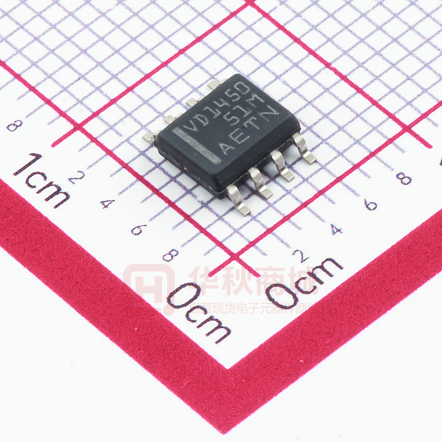

    THVD1450 具有 ±18kV IEC ESD 保护功能的 3.3V 至 5V RS-485 收发器
THVD1450DR 数据手册
Product Folder Order Now Technical Documents Support & Community Tools & Software THVD1410 THVD1450, THVD1451, THVD1452 SLLSEY3E – MAY 2018 – REVISED MAY 2019 THVD14xx 3.3-V to 5-V RS-485 Transceivers with ±18-kV IEC ESD Protection 1 Features • 1 • • • • • • • • • • • • Meets or Exceeds the Requirements of the TIA/EIA-485A Standard 3 V to 5.5 V Supply Voltage Differential Output Exceeds 2.1 V for PROFIBUS Compatibility with 5-V Supply Bus I/O ESD Protection – ±30 kV HBM – ±18 kV IEC 61000-4-2 Contact Discharge – ±25 kV IEC 61000-4-2 Air-Gap Discharge – ±4 kV IEC 61000-4-4 Fast Transient Burst Extended Operational Common-mode Range: ±15 V Low EMI 500 kbps and 50 Mbps Data Rates Large Receiver Hysteresis for Noise Rejection Low Power Consumption – Standby Supply Current: < 1 µA – Current During Operation: < 3 mA Extended Ambient Temperature Range: –40°C to 125°C Glitch-Free Power-Up/Down for Hot Plug-in Capability Open, Short, and Idle Bus Failsafe 1/8 Unit Load (Up to 256 Bus Nodes) Small-Size VSON and VSSOP Packages Save Board Space or SOIC for Drop-in Compatibility Each of these devices operates from a single supply between 3 V and 5.5 V. The devices in this family feature an extended common-mode voltage range which makes them suitable for multi-point applications over long cable runs. THVD14xx family of devices is available in small VSON and VSSOP packages for space constrained applications. These devices are characterized over ambient free-air temperatures from –40°C to 125°C. Device Information(1) PART NUMBER PACKAGE THVD1410 THVD1450 THVD1451 THVD1452 BODY SIZE (NOM) VSSOP (8) 3.00 mm × 3.00 mm SOIC (8) 4.90 mm × 3.91 mm VSON (8) 3.00 mm × 3.00 mm VSSOP (8) 3.00 mm × 3.00 mm SOIC (8) 4.90 mm × 3.91 mm VSON (8) 3.00 mm × 3.00 mm SOIC (8) 4.90 mm × 3.91 mm VSSOP (10) 3.00 mm × 3.00 mm SOIC (14) 8.65 mm × 3.91 mm (1) For all available packages, see the orderable addendum at the end of the data sheet. THVD1410 and THVD1450 Simplified Schematic R RE DE D 1 2 7 3 6 B A 4 2 Applications • • • • • • • • Motor Drives Factory Automation & Control Grid Infrastructure Building Automation HVAC Systems Video Surveillance Process Analytics Wireless Infrastructure 3 Description THVD14xx is a family of noise-immune RS-485/RS422 transceivers designed to operate in rugged industrial environments. The bus pins of these devices are robust to high levels of IEC electrical fast transients (EFT) and IEC electrostatic discharge (ESD) events, eliminating the need for additional system level protection components. THVD1451 Simplified Schematic R D 2 8 A 7 B 3 6 Z 5 Y THVD1452 Simplified Schematic R RE DE D 2 (1) 3 (2) (9 ) 12 A (8 ) 11 B 4 (3) 5 (4) (7 ) 10 Z (6) 9 Y 1 An IMPORTANT NOTICE at the end of this data sheet addresses availability, warranty, changes, use in safety-critical applications, intellectual property matters and other important disclaimers. PRODUCTION DATA. THVD1410 THVD1450, THVD1451, THVD1452 SLLSEY3E – MAY 2018 – REVISED MAY 2019 www.ti.com Table of Contents 1 2 3 4 5 6 7 Features .................................................................. Applications ........................................................... Description ............................................................. Revision History..................................................... Device Comparison Table..................................... Pin Configuration and Functions ......................... Specifications......................................................... 1 1 1 2 4 5 8 7.1 7.2 7.3 7.4 7.5 7.6 7.7 7.8 7.9 7.10 Absolute Maximum Ratings ...................................... 8 ESD Ratings.............................................................. 8 ESD Ratings [IEC] .................................................... 8 Recommended Operating Conditions....................... 9 Thermal Information .................................................. 9 Power Dissipation ..................................................... 9 Electrical Characteristics......................................... 10 Switching Characteristics ........................................ 11 Typical Characteristics: All Devices ........................ 12 Typical Characteristics: THD1450, THVD1451 and THVD1452 ............................................................... 14 7.11 Typical Characteristics: THVD1410 ...................... 15 8 9 Parameter Measurement Information ................ 16 Detailed Description ............................................ 18 9.1 9.2 9.3 9.4 Overview ................................................................. Functional Block Diagrams ..................................... Feature Description................................................. Device Functional Modes........................................ 18 18 19 19 10 Application and Implementation........................ 22 10.1 Application Information...................................... 22 10.2 Typical Application ............................................... 22 11 Power Supply Recommendations ..................... 28 12 Layout................................................................... 29 12.1 Layout Guidelines ................................................. 29 12.2 Layout Example .................................................... 29 13 Device and Documentation Support ................. 30 13.1 13.2 13.3 13.4 13.5 13.6 13.7 13.8 Device Support...................................................... Third-Party Products Disclaimer ........................... Related Links ........................................................ Receiving Notification of Documentation Updates Community Resources.......................................... Trademarks ........................................................... Electrostatic Discharge Caution ............................ Glossary ................................................................ 30 30 30 30 30 30 30 30 14 Mechanical, Packaging, and Orderable Information ........................................................... 31 4 Revision History Changes from Revision D (March 2019) to Revision E • Page Changed THVD1451 From: Product Preview To: Production data ....................................................................................... 1 Changes from Revision C (February 2019) to Revision D • Page Changed THVD1410 From: Product Preview To: Production data ....................................................................................... 1 Changes from Revision B (December 2018) to Revision C • Page Changed THVD1452 From: Product Preview To: Production data ....................................................................................... 1 Changes from Revision A (May 2018) to Revision B Page • Added Feature: "Differential Output Exceeds 2.1 V..."........................................................................................................... 1 • Changed Feature: ±18 kV IEC 61000-4-2 Air-Gap Discharge To: ±25 kV IEC 61000-4-2 Air-Gap Discharge ..................... 1 • Added SOIC (8) package to THVD1451 ............................................................................................................................... 1 • Added Thermal Pad to the THVD1450 DRB package ........................................................................................................... 5 • Added Thermal Pad to the THVD1451 DRB package ........................................................................................................... 6 • Changed all pins HBM ESD rating from 4 kV to 8 kV ............................................................................................................ 8 • Changed IEC ESD air-gap discharge rating from 18 kV to 25 kV.......................................................................................... 8 • Changed THVD1410 power dissipation numbers .................................................................................................................. 9 • Changed THVD1410 driver tr, tf TYP from 400 ns to 460 ns and MAX from 600 ns to 680 ns ........................................... 11 • Changed THVD1410 receiver tr, tf TYP from 13 ns to 10 ns................................................................................................ 11 • Changed THVD1410 receiver tPHL, tPLH TYP from 60 ns to 35 ns ....................................................................................... 11 • Added Typical Characteristics, THD1450D .......................................................................................................................... 14 2 Submit Documentation Feedback Copyright © 2018–2019, Texas Instruments Incorporated Product Folder Links: THVD1410 THVD1450 THVD1451 THVD1452 THVD1410 THVD1450, THVD1451, THVD1452 www.ti.com SLLSEY3E – MAY 2018 – REVISED MAY 2019 • Added condition to Figure 8 to Figure 3 ............................................................................................................................... 14 • Added Typical Characteristics, THD1410............................................................................................................................. 15 • Changed A to A/Y and B to B/Z in Figure 20 to Figure 24................................................................................................... 16 • Added 3rd paragraph to the Overview section ..................................................................................................................... 18 Changes from Original (November 2017) to Revision A • Page Changed the document status From: Advanced Information To: Production Mix data ......................................................... 1 Copyright © 2018–2019, Texas Instruments Incorporated Submit Documentation Feedback Product Folder Links: THVD1410 THVD1450 THVD1451 THVD1452 3 THVD1410 THVD1450, THVD1451, THVD1452 SLLSEY3E – MAY 2018 – REVISED MAY 2019 www.ti.com 5 Device Comparison Table 4 PART NUMBER DUPLEX ENABLES SIGNALING RATE THVD1410 Half DE, RE up to 500 kbps THVD1450 Half DE, RE THVD1451 Full None THVD1452 Full DE, RE Submit Documentation Feedback up to 50 Mbps NODES 256 Copyright © 2018–2019, Texas Instruments Incorporated Product Folder Links: THVD1410 THVD1450 THVD1451 THVD1452 THVD1410 THVD1450, THVD1451, THVD1452 www.ti.com SLLSEY3E – MAY 2018 – REVISED MAY 2019 6 Pin Configuration and Functions THVD1410, THVD1450 Devices 8-Pin D Package (SOIC) Top View THVD1410, THVD1450 Devices 8-Pin DGK Package (VSSOP) Top View R 1 8 VCC RE 2 7 B DE 3 6 A D 4 5 GND R 1 8 VCC RE 2 7 B DE 3 6 A D 4 5 GND Not to scale Not to scale THVD1450 Device 8-Pin DRB Package (VSON) Top View R 1 RE 2 DE 3 D 4 Th ermal Pad 8 VCC 7 B 6 A 5 GND No t to scale Pin Functions PIN I/O DESCRIPTION NAME D DGK DRB A 6 6 6 Bus input/output Bus I/O port, A (complementary to B) B 7 7 7 Bus input/output Bus I/O port, B (complementary to A) D 4 4 4 Digital input Driver data input DE 3 3 3 Digital input Driver enable, active high (2-MΩ internal pull-down) GND 5 5 5 Ground R 1 1 1 Digital output Receive data output VCC 8 8 8 Power 3.3-V to 5-V supply RE 2 2 2 Digital input Thermal Pad — — I/O Copyright © 2018–2019, Texas Instruments Incorporated Device ground Receiver enable, active low (2-MΩ internal pull-up) No electrical connection. Should be connected to GND for optimal thermal performance. Submit Documentation Feedback Product Folder Links: THVD1410 THVD1450 THVD1451 THVD1452 5 THVD1410 THVD1450, THVD1451, THVD1452 SLLSEY3E – MAY 2018 – REVISED MAY 2019 www.ti.com THVD1451 Device 8-Pin D Package (SOIC) Top View THVD1451 Device 8-Pin DRB Package (VSON) Top View VCC 1 8 A R 2 7 B VCC 1 D 3 6 Z R 2 GND 4 5 Y D 3 GND 4 Th ermal Pad 8 A 7 B 6 Z 5 Y No t to scale No t to scale Pin Functions PIN I/O Description NAME D DRB A 8 8 Bus input Bus input, A (complementary to B) B 7 7 Bus input Bus input, B (complementary to A) D 3 3 GND 4 4 Ground Device ground Digital output Receive data output 3.3-V to 5-V supply Digital input Driver data input R 2 2 VCC 1 1 Power Y 5 5 Bus output Digital bus output, Y (Complementary to Z) Z 6 6 Bus output Digital bus output, Z (Complementary to Y) Thermal Pad — 6 I/O Submit Documentation Feedback No electrical connection. Should be connected to GND for optimal thermal performance. Copyright © 2018–2019, Texas Instruments Incorporated Product Folder Links: THVD1410 THVD1450 THVD1451 THVD1452 THVD1410 THVD1450, THVD1451, THVD1452 www.ti.com SLLSEY3E – MAY 2018 – REVISED MAY 2019 THVD1452 Device 14-Pin D Package (SOIC) Top View THVD1452 Device 10-Pin DGS Package (VSSOP) Top View NC 1 14 VCC R 2 13 VCC RE 3 12 A DE 4 11 B D 5 10 Z GND 6 9 Y GND 7 8 NC R 1 10 VCC RE 2 9 A DE 3 8 B D 4 7 Z GND 5 6 Y Not to scale Not to scale NC – No internal connection Pin Functions PIN I/O DESCRIPTION NAME D DGS A 12 9 Bus input Bus input, A (complementary to B) B 11 8 Bus input Bus input, B (complementary to A) D 5 4 Digital input Driver data input DE 4 3 Digital input Driver enable, active high (2-MΩ internal pull-down) 6, 7 (1) 5 Ground 1, 8 — — 2 1 Digital output Receive data output 13, 14 (1) 10 Power 3.3-V to 5-V supply Y 9 6 Bus output Digital bus output, Y (Complementary to Z) Z 10 7 Bus output Digital bus output, Z (Complementary to Y) RE 3 2 Digital input Receiver enable, active low (2-MΩ internal pull-up) GND NC R VCC (1) Device ground Internally not connected These pins are internally connected Copyright © 2018–2019, Texas Instruments Incorporated Submit Documentation Feedback Product Folder Links: THVD1410 THVD1450 THVD1451 THVD1452 7 THVD1410 THVD1450, THVD1451, THVD1452 SLLSEY3E – MAY 2018 – REVISED MAY 2019 www.ti.com 7 Specifications 7.1 Absolute Maximum Ratings over operating free-air temperature range (unless otherwise noted) (1) MIN MAX Supply voltage VCC -0.5 7 V Bus voltage Range at any bus pin (A, B, Y, or Z) as differential or common-mode with respect to GND -18 18 V Input voltage Range at any logic pin (D, DE, or RE) -0.3 5.7 V Receiver output current IO -24 24 mA -65 150 ℃ Storage temperature range (1) UNIT Stresses beyond those listed under Absolute Maximum Ratings may cause permanent damage to the device. These are stress ratings only, which do not imply functional operation of the device at these or any other conditions beyond those indicated under Recommended Operating Conditions. Exposure to absolute-maximum-rated conditions for extended periods may affect device reliability. 7.2 ESD Ratings Human body model (HBM), per ANSI/ESDA/JEDEC JS-001 (1) V(ESD) (1) (2) Electrostatic discharge VALUE UNIT Bus pins and GND ±30 kV All other pins ±8 kV Charged device model (CDM), per JEDEC JESD22-C101 (2) All pins ±1.5 kV Machine model (MM), per JEDEC JESD22-A115-A All pins ±200 V JEDEC document JEP155 states that 500-V HBM allows safe manufacturing with a standard ESD control process. JEDEC document JEP157 states that 250-V CDM allows safe manufacturing with a standard ESD control process. 7.3 ESD Ratings [IEC] V(ESD) V(EFT) 8 Electrostatic discharge Electrical fast transient Submit Documentation Feedback VALUE UNIT Bus pins and GND ±18 kV Air-gap discharge, per IEC 61000-4- Bus pins and 2 GND ±25 kV Bus pins and GND ±4 kV Contact discharge, per IEC 610004-2 Per IEC 61000-4-4 Copyright © 2018–2019, Texas Instruments Incorporated Product Folder Links: THVD1410 THVD1450 THVD1451 THVD1452 THVD1410 THVD1450, THVD1451, THVD1452 www.ti.com SLLSEY3E – MAY 2018 – REVISED MAY 2019 7.4 Recommended Operating Conditions over operating free-air temperature range (unless otherwise noted) MIN VCC Supply voltage VI Input voltage at any bus terminal (1) NOM MAX UNIT 3 5.5 V -15 15 V VIH High-level input voltage (driver, driver enable, and receiver enable inputs) 2 VCC V VIL Low-level input voltage (driver, driver enable, and receiver enable inputs) 0 0.8 V VID Differential input voltage -15 15 V IO Output current, driver -60 60 mA IOR Output current, receiver -8 8 mA RL Differential load resistance 54 1/tUI Signaling rate: THVD1410 1/tUI Signaling rate: THVD1450, THVD1451, THVD1452 TA Operating ambient temperature TJ Junction temperature (1) Ω 500 kbps 50 Mbps -40 125 ℃ -40 150 ℃ The algebraic convention, in which the least positive (most negative) limit is designated as minimum is used in this data sheet. 7.5 Thermal Information THERMAL METRIC (1) RθJA Junction-to-ambient thermal resistance THVD1410 THVD1450 THVD1451 THVD1452 THVD1410 THVD1450 THVD1452 THVD1450 THVD1451 D (SOIC) D (SOIC) DGK (VSSOP) DGS (VSSOP) DRB (VSON) 8 PINS 14 PINS 8 PINS 10 PINS 8 PINS 114.3 86.4 155.2 155.6 48.6 °C/W 56.7 43.7 47.2 49.3 49.1 °C/W RθJC(to Junction-to-case (top) thermal resistance p) UNIT RθJB Junction-to-board thermal resistance 57.7 42.5 76.1 77.1 21.1 °C/W ΨJT Junction-to-top characterization parameter 12.8 10.2 3.9 4.5 0.8 °C/W ΨJB Junction-to-board characterization parameter 57 42.2 74.8 75.7 21.1 °C/W RθJC(b Junction-to-case (bottom) thermal resistance N/A N/A N/A N/A 2.7 °C/W ot) (1) For more information about traditional and new thermal metrics, see the Semiconductor and IC Package Thermal Metrics application report. 7.6 Power Dissipation PARAMETE R PD Description TEST CONDITIONS MIN TYP MAX UNIT Driver and receiver enabled, VCC = 5.5 Unterminated: RL = 300 Ω, CL = 50 pF V, TA = 1250C, 50% duty cycle square RS-422 load: RL = 100 Ω, CL = 50 pF wave at 500kbps signaling rate, RS-485 load: RL = 54 Ω, CL = 50 pF THVD1410 360 mW 370 mW 410 mW Driver and receiver enabled, VCC = 5.5 Unterminated: RL = 300 Ω, CL = 50 pF V, TA = 1250C, 50% duty cycle square RS-422 load: RL = 100 Ω, CL = 50 pF wave at 50Mbps signaling rate, RS-485 load: RL = 54 Ω, CL = 50 pF THVD145x devices 360 mW 320 mW 330 mW Copyright © 2018–2019, Texas Instruments Incorporated Submit Documentation Feedback Product Folder Links: THVD1410 THVD1450 THVD1451 THVD1452 9 THVD1410 THVD1450, THVD1451, THVD1452 SLLSEY3E – MAY 2018 – REVISED MAY 2019 www.ti.com 7.7 Electrical Characteristics over operating free-air temperature range (unless otherwise noted). All typical values are at 25°C and supply voltage of VCC = 5 V. PARAMETER TEST CONDITIONS MIN TYP RL = 60 Ω, -15 V ≤ Vtest ≤ 15 V (See Figure 20) (1) 1.5 3.5 RL = 60 Ω, -15 V ≤ Vtest ≤ 15 V, 4.5 V ≤ VCC ≤ 5.5 V, (See Figure 20) 2.1 MAX UNIT Driver Driver differential output voltage magnitude |VOD| RL = 100 Ω (See Figure 21) RL = 54 Ω (See Figure 21) Δ|VOD| Change in differential output voltage VOC Common-mode output voltage ΔVOC(SS) Change in steady-state commonmode output voltage IOS Short-circuit output current V 2 4 V 1.5 3.5 V -200 RL = 54 Ω (See Figure 21) 1 DE = VCC, -7 V ≤ VO ≤ 12 V V 200 VCC/2 3 mV V -200 200 mV -250 250 mA 125 µA Receiver DE = 0 V, VCC = 0 V or 5.5 V II Bus input current DE = 0 V, VCC = 0 V or 5.5 V VTH+ Positive-going input threshold voltage VTH- Negative-going input threshold voltage VHYS Input hysteresis VI = 12V VI = -7V 50 -100 VI = 15V VI = -15V Over common-mode range of ± 15 V -65 60 µA 125 -130 µA See (2) -100 -20 mV -200 -130 See (2) mV VCC – 0.4 VCC – 0.2 30 VOH Output high voltage IOH = -8 mA VOL Output low voltage IOL = 8 mA IOZR Output high-impedance current VO = 0 V or VCC, RE = VCC Input current (D, DE, RE) 3 V ≤ VCC ≤ 5.5 V, 0 V ≤ VIN ≤ VCC µA -200 0.2 mV V 0.4 V -1 1 µA -6.2 6.2 µA Logic IIN Device ICC TSD (1) (2) 10 Driver and receiver enabled RE = 0 V , DE = VCC, No load 2.4 3 mA Driver enabled, receiver disabled RE = VCC, DE = VCC, No load 2 2.5 mA Driver disabled, receiver enabled RE = 0 V, DE = 0 V, No load 700 960 µA Driver and receiver disabled RE = VCC, DE = 0 V, D = open, No load 0.1 1 µA Supply current (quiescent) Thermal shutdown temperature 170 ℃ |VOD| ≥ 1.4 V when TA > 85 ℃, Vtest < -7 V and VCC < 3.135 V. Under any specific conditions, VTH+ is assured to be at least VHYS higher than VTH–. Submit Documentation Feedback Copyright © 2018–2019, Texas Instruments Incorporated Product Folder Links: THVD1410 THVD1450 THVD1451 THVD1452 THVD1410 THVD1450, THVD1451, THVD1452 www.ti.com SLLSEY3E – MAY 2018 – REVISED MAY 2019 7.8 Switching Characteristics over operating free-air temperature range (unless otherwise noted). All typical values are at 25°C and supply voltage of VCC = 5 V. PARAMETER TEST CONDITIONS MIN TYP MAX UNIT 250 460 680 ns 250 500 ns 10 ns 80 200 ns RE = 0 V, See Figure 23 and Figure 24 100 600 ns RE = VCC, See Figure 23 and Figure 24 4 11 µs 10 20 ns 35 110 ns 7 ns 30 60 ns DE = VCC, See Figure 26 60 140 ns DE = 0 V, See Figure 27 6 14 µs 1 3 6 ns 3 10 Driver: THVD1410 tr, tf Differential output rise/fall time tPHL, tPLH Propagation delay tSK(P) Pulse skew, |tPHL – tPLH| tPHZ, tPLZ Disable time tPZH, tPZL RL = 54 Ω, CL = 50 pF, See Figure 22 Enable time Receiver: THVD1410 tr, tf Output rise/fall time tPHL, tPLH Propagation delay tSK(P) Pulse skew, |tPHL – tPLH| tPHZ, tPLZ Disable time CL = 15 pF, See Figure 25 tPZH(1), tPZL(1), tPZH(2), Enable time tPZL(2), Driver: THVD1450, THVD1451, THVD1452 tr, tf Differential output rise/fall time tPHL, tPLH Propagation delay tSK(P) Pulse skew, |tPHL – tPLH| tPHZ, tPLZ Disable time tPZH, tPZL RL = 54 Ω, CL = 50 pF, See Figure 22 Enable time 20 ns 3.5 ns 15 25 ns RE = 0 V, See Figure 23 and Figure 24 20 50 ns RE = VCC, See Figure 23 and Figure 24 2.5 10 µs 2 6 ns CL = 15 pF, See Figure 25 25 40 ns Receiver: THVD1450, THVD1451, THVD1452 tr, tf Output rise/fall time tPHL, tPLH Propagation delay tSK(P) Pulse skew, |tPHL – tPLH| tPHZ, tPLZ Disable time tPZH(1), tPZL(1), tPZH(2), Enable time tPZL(2), Copyright © 2018–2019, Texas Instruments Incorporated 3.5 ns 14 28 ns DE = VCC, See Figure 26 50 110 ns DE = 0V, See Figure 27 4 14 µs Submit Documentation Feedback Product Folder Links: THVD1410 THVD1450 THVD1451 THVD1452 11 THVD1410 THVD1450, THVD1451, THVD1452 SLLSEY3E – MAY 2018 – REVISED MAY 2019 www.ti.com 7.9 Typical Characteristics: All Devices 6 VOL VOH 5 VO Driver Output Voltage (V) VO Driver Differential Output Voltage (V) 6 4 3 2 1 0 5 4 3 2 1 0 0 10 20 30 40 50 60 70 80 IO Driver Output Current (mA) VCC = 5 V 90 100 110 0 10 20 30 40 50 60 70 80 IO Driver Output Current (mA) D001 DE = VCC D=0V VCC = 5 V Figure 1. Driver Output Voltage vs Driver Output Current 6 90 100 110 D002 DE = VCC D=0V Figure 2. Driver Differential Output voltage vs Driver Output Current 6 5 5 4 4 3 3 2 2 1 VTH ( 7 V) 1 VTH (0 V) VTH (12 V) 0 -170 -160 -150 -140 -130 -120 -110 -100 -90 -80 -70 VID Differential Input Voltage (mV) VCC = 5 V -60 VO Driver Output Voltage (V) Receiver Output (V) 3.2 VOL VOH 2.8 2.4 2 1.6 1.2 0.8 0.4 0 0 -50 0 D007 TA = 25°C 5 10 15 20 25 30 35 40 45 50 55 60 65 70 75 80 IO Driver Output Current (mA) D101 VCC = 3.3 V DE = VCC D=0V Figure 3. Receiver Output vs Input Figure 4. Driver Output Voltage vs Driver Output Current 3.5 3 3 2.8 2.6 2.4 2.2 2 1.8 1.6 2.5 2 1.5 1 0.5 1.4 1.2 0 5 10 15 20 25 30 35 40 45 50 55 60 65 70 75 80 IO Driver Output Current (mA) D102 VCC = 3.3 V DE = VCC D=0V Figure 5. Driver Differential Output Voltage vs Driver Output Current 12 VTH (12V) VTH (0V) VTH (-7V) 3.2 Receiver Output (V) VO Driver Differential Output Voltage (V) 3.4 Submit Documentation Feedback 0 -180 -160 -140 -120 -100 -80 VID Differential Input Voltage (mV) VCC = 3.3 V -60 -40 D106 TA = 25°C Figure 6. Receiver Output vs Input Copyright © 2018–2019, Texas Instruments Incorporated Product Folder Links: THVD1410 THVD1450 THVD1451 THVD1452 THVD1410 THVD1450, THVD1451, THVD1452 www.ti.com SLLSEY3E – MAY 2018 – REVISED MAY 2019 Typical Characteristics: All Devices (continued) 80 IO Driver Output Current (mA) 70 60 50 40 30 20 10 0 0 0.5 TA = 25°C RL = 54 Ω 1 1.5 2 2.5 3 3.5 4 4.5 VCC Supply Voltage (V) 5 5.5 6 D003 DE = VCC D = VCC Figure 7. Driver Output Current vs Supply Voltage Copyright © 2018–2019, Texas Instruments Incorporated Submit Documentation Feedback Product Folder Links: THVD1410 THVD1450 THVD1451 THVD1452 13 THVD1410 THVD1450, THVD1451, THVD1452 SLLSEY3E – MAY 2018 – REVISED MAY 2019 www.ti.com 7 16 6 14 VO Driver Propagation Delay (ns) VO Driver Rise and Fall Time (ns) 7.10 Typical Characteristics: THD1450, THVD1451 and THVD1452 5 4 3 2 1 0 -40 -20 0 20 40 60 80 Temperature (qC) 100 120 12 10 8 6 4 2 0 -40 140 VCC = 5 V Figure 8. Driver Rise or Fall Time vs Temperature 40 60 80 Temperature (qC) 100 120 140 D005 Figure 9. Driver Propagation Delay vs Temperature VO Driver Rise and Fall Time (ns) ICC Supply Current (mA) 20 4 100 80 60 40 20 0 5 10 15 20 25 30 35 SIgnaling Rate (Mbps) RL = 54 Ω 40 45 3.8 3.6 3.4 3.2 3 2.8 -40 0 50 -20 0 D006 VCC = 5 V TA = 25°C 20 40 60 80 Temperature (0C) 100 120 140 D103 VCC = 3.3 V Figure 11. Driver Rise or Fall Time vs Temperature Figure 10. Supply Current vs Signal Rate 17 85 16.5 82.5 80 16 ICC Supply Current (mA) VO Driver Propagation Delay (ns) 0 VCC = 5 V 120 15.5 15 14.5 14 13.5 77.5 75 72.5 70 67.5 65 62.5 13 60 12.5 -40 57.5 -20 0 20 40 60 80 Temperature (0C) 100 120 140 0 5 10 D104 RL = 54 Ω VCC = 3.3 V Figure 12. Driver Propagation Delay vs Temperature 14 -20 D004 Submit Documentation Feedback 15 20 25 30 35 SIgnaling Rate (Mbps) VCC = 3.3 V 40 45 50 D105 TA = 25°C Figure 13. Supply Current vs Signal Rate Copyright © 2018–2019, Texas Instruments Incorporated Product Folder Links: THVD1410 THVD1450 THVD1451 THVD1452 THVD1410 THVD1450, THVD1451, THVD1452 www.ti.com SLLSEY3E – MAY 2018 – REVISED MAY 2019 600 276 580 273 VO Driver Propagation Delay (ns) VO Driver Rise and Fall Time (ns) 7.11 Typical Characteristics: THVD1410 560 540 520 500 480 460 440 420 400 -40 -20 0 20 40 60 80 Temperature (0C) 100 120 270 267 264 261 258 255 252 249 246 -40 140 VCC = 5 V Figure 14. Driver Rise or Fall Time vs Temperature 20 40 60 80 Temperature (0C) 100 120 140 D108 Figure 15. Driver Propagation Delay vs Temperature 550 V0 Driver Rise and Fall Time (ns) 100 ICC Supply Current (mA) 0 VCC = 5 V 105 95 90 85 80 75 525 500 475 450 425 400 375 350 325 70 50 100 150 200 250 300 350 Signaling Rate (kbps) RL = 54 Ω 400 450 300 -40 500 -20 0 D109 VCC = 5 V TA = 25°C 20 40 60 80 Temperature (0C) 100 120 140 D110 VCC = 3.3 V Figure 16. Supply Current vs Signal Rate Figure 17. Driver Rise or Fall Time vs Temperature 345 58 340 56 335 ICC Supply Current (mA) VO Driver Propagation Delay (ns) -20 D107 330 325 320 315 310 305 300 54 52 50 48 46 295 290 -40 -20 0 20 40 60 80 Temperature (0C) 100 120 140 44 50 100 150 D111 RL = 54 Ω VCC = 3.3 V Figure 18. Driver Propagation Delay vs Temperature Copyright © 2018–2019, Texas Instruments Incorporated 200 250 300 350 Signaling Rate (kbps) VCC = 3.3 V 400 450 500 D112 TA = 25°C Figure 19. Supply Current vs Signal Rate Submit Documentation Feedback Product Folder Links: THVD1410 THVD1450 THVD1451 THVD1452 15 THVD1410 THVD1450, THVD1451, THVD1452 SLLSEY3E – MAY 2018 – REVISED MAY 2019 www.ti.com 8 Parameter Measurement Information Vcc 375 Ÿ DE A/Y D VOD 0V or Vcc R Vtest L B/Z 375 Ÿ Figure 20. Measurement of Driver Differential Output Voltage With Common-Mode Load A/Y VA RL/2 A/Y B/Z D VB VOD 0V or Vcc RL/2 B/Z VOC(PP) CL ûVOC(SS) VOC VOC Figure 21. Measurement of Driver Differential and Common-Mode Output With RS-485 Load Vcc Vcc 50 % V I DE A/Y 0V tPLH D VOD R L= 54 Ÿ tPHL CL= 50 pF ~2 V ~ Input Gen erator VI 90 % B/Z 50 Ÿ 50 % V OD 10 % tr ~± 2 V ~ tf Figure 22. Measurement of Driver Differential Output Rise and Fall Times and Propagation Delays A/Y S1 D V Vcc O V 50 % I 0V B/Z DE Input Gen erator VI CL = RL = 50 pF 110 Ÿ tPZH V 90 50 Ÿ OH % 50 % V O tPHZ ~ ~ 0V Figure 23. Measurement of Driver Enable and Disable Times With Active High Output and Pull-Down Load 16 Submit Documentation Feedback Copyright © 2018–2019, Texas Instruments Incorporated Product Folder Links: THVD1410 THVD1450 THVD1451 THVD1452 THVD1410 THVD1450, THVD1451, THVD1452 www.ti.com SLLSEY3E – MAY 2018 – REVISED MAY 2019 Parameter Measurement Information (continued) Vcc Vcc RL= 110 Ÿ A/Y 50 % VI S1 0V VO D B/Z tPZL tPLZ DE § Vcc VO C L= 50 pF Input 50% VI Gen erator 50Ÿ 10% VOL Figure 24. Measurement of Driver Enable and Disable Times With Active Low Output and Pull-up Load 3V A Input Generator R VO VI 50 Ÿ 1.5V 0V 50 % VI B 0V tPLH tPHL VOH 90% CL=15 pF 50% RE VOD 10 % tr VOL tf Figure 25. Measurement of Receiver Output Rise and Fall Times and Propagation Delays Vcc Vcc Vcc VI 50 % DE 0V or Vcc 0V A D R B 1 kŸ VO tPZH(1) tPHZ S1 VO CL=15 pF 90 % 50 % tPZL(1) VI D at Vcc S1 to GND § 0V RE Input Generator VOH 50 Ÿ tPLZ VO 50 % VCC D at 0V S1 to Vcc 10 % VOL Figure 26. Measurement of Receiver Enable/Disable Times With Driver Enabled Vcc Vcc VI 50% 0V A V or 1.5V R 1.5 V or 0V B RE VO 1 NŸ tPZH(2) S1 CL=15 pF VOH 50% VO § 0V A at 1.5 V B at 0 V S1 to GND tPZL(2) Input Generator VI VCC 50 Ÿ VO 50% VOL A at 0V B at 1.5V S1 to VCC Figure 27. Measurement of Receiver Enable Times With Driver Disabled Copyright © 2018–2019, Texas Instruments Incorporated Submit Documentation Feedback Product Folder Links: THVD1410 THVD1450 THVD1451 THVD1452 17 THVD1410 THVD1450, THVD1451, THVD1452 SLLSEY3E – MAY 2018 – REVISED MAY 2019 www.ti.com 9 Detailed Description 9.1 Overview THVD1410 and THVD1450 are low-power, half duplex RS-485 transceivers available in two speed grades suitable for data transmission up to 500 kbps and 50 Mbps respectively. THVD1451 is fully enabled with no external enabling pins. THVD1452 has active-high driver enable and activelow receiver enable. A standby current of less than 1 µA can be achieved by disabling both driver and receiver. THVD14xx family of devices have a higher typical differential output voltage (VOD) than traditional transceivers for better noise immunity. A minimum differential output voltage of 2.1 V is specified with VCC voltage of 5 V ±10% to meet the requirements of PROFIBUS applications. 9.2 Functional Block Diagrams VCC R RE A DE B D GND Figure 28. THVD1410 and THVD1450 VCC A R R B VCC D Z D Y GND Figure 29. THVD1451 VCC A R R B RE DE D Z D Y GND Figure 30. THVD1452 18 Submit Documentation Feedback Copyright © 2018–2019, Texas Instruments Incorporated Product Folder Links: THVD1410 THVD1450 THVD1451 THVD1452 THVD1410 THVD1450, THVD1451, THVD1452 www.ti.com SLLSEY3E – MAY 2018 – REVISED MAY 2019 9.3 Feature Description Internal ESD protection circuits protect the transceiver against electrostatic discharges (ESD) according to IEC 61000-4-2 of up to ±18 kV and against electrical fast transients (EFT) according to IEC 61000-4-4 of up to ±4 kV. With careful system design, one could achieve ±4 kV EFT Criterion A (no data loss when transient noise is present). The THVD14xx device family provides internal biasing of the receiver input thresholds in combination with large input-threshold hysteresis. The receiver output remains logic high under a bus-idle or bus-short conditions without the need for external failsafe biasing resistors. Device operation is specified over a wide ambient temperature range from –40°C to 125°C. 9.4 Device Functional Modes 9.4.1 Device Functional Modes for THVD1410 and THVD1450 When the driver enable pin, DE, is logic high, the differential outputs A and B follow the logic states at data input D. A logic high at D causes A to turn high and B to turn low. In this case the differential output voltage defined as VOD = VA – VB is positive. When D is low, the output states reverse: B turns high, A becomes low, and VOD is negative. When DE is low, both outputs turn high-impedance. In this condition the logic state at D is irrelevant. The DE pin has an internal pull-down resistor to ground, thus when left open the driver is disabled (high-impedance) by default. The D pin has an internal pull-up resistor to VCC, thus, when left open while the driver is enabled, output A turns high and B turns low. Table 1. Driver Function Table for THVD1410 and THVD1450 INPUT ENABLE D DE A OUTPUTS B H H H L Actively drive bus high Actively drive bus low FUNCTION L H L H X L Z Z Driver disabled X OPEN Z Z Driver disabled by default OPEN H H L Actively drive bus high by default When the receiver enable pin, RE, is logic low, the receiver is enabled. When the differential input voltage defined as VID = VA – VB is higher than the positive input threshold, VTH+, the receiver output, R, turns high. When VID is lower than the negative input threshold, VTH-, the receiver output, R, turns low. If VID is between VTH+ and VTH- the output is indeterminate. When RE is logic high or left open, the receiver output is high-impedance and the magnitude and polarity of VID are irrelevant. Internal biasing of the receiver inputs causes the output to go failsafe-high when the transceiver is disconnected from the bus (open-circuit), the bus lines are shorted to one another (short-circuit), or the bus is not actively driven (idle bus). Table 2. Receiver Function Table for THVD1410 and THVD1450 DIFFERENTIAL INPUT ENABLE OUTPUT VID = VA – VB RE R VTH+ < VID L H Receive valid bus high VTH- < VID < VTH+ L ? Indeterminate bus state VID < VTH- L L Receive valid bus low X H Z Receiver disabled FUNCTION X OPEN Z Receiver disabled by default Open-circuit bus L H Fail-safe high output Short-circuit bus L H Fail-safe high output Idle (terminated) bus L H Fail-safe high output Copyright © 2018–2019, Texas Instruments Incorporated Submit Documentation Feedback Product Folder Links: THVD1410 THVD1450 THVD1451 THVD1452 19 THVD1410 THVD1450, THVD1451, THVD1452 SLLSEY3E – MAY 2018 – REVISED MAY 2019 www.ti.com 9.4.2 Device Functional Modes for THVD1451 For this device, the driver and receiver are fully enabled, thus the differential outputs Y and Z follow the logic states at data input D at all times. A logic high at D causes Y to turn high and Z to turn low. In this case, the differential output voltage defined as VOD = VY – VZ is positive. When D is low, the output states reverse: Z turns high, Y becomes low, and VOD is negative. The D pin has an internal pull-up resistor to VCC, thus, when left open while the driver is enabled, output Y turns high and Z turns low. Table 3. Driver Function Table for THVD1451 INPUT OUTPUTS FUNCTIONS D Y Z H H L L L H Actively drive bus low OPEN H L Actively drive bus High by default Actively drive bus high When the differential input voltage defined as VID = VA – VB is higher than the positive input threshold, VTH+, the receiver output, R, turns high. When VID is less than the negative input threshold, VTH–, the receiver output, R, turns low. If VID is between VTH+ and VTH– the output is indeterminate. Internal biasing of the receiver inputs causes the output to go failsafe-high when the transceiver is disconnected from the bus (open-circuit), the bus lines are shorted to one another (short-circuit), or the bus is not actively driven (idle bus). Table 4. Receiver Function Table for THVD1451 20 DIFFERENTIAL INPUT OUTPUT VID = VA – VB R VTH+ < VID H Receive valid bus high VTH- < VID < VTH+ ? Indeterminate bus state FUNCTION VID < VTH- L Receive valid bus low Open-circuit bus H Fail-safe high output Short-circuit bus H Fail-safe high output Idle (terminated) bus H Fail-safe high output Submit Documentation Feedback Copyright © 2018–2019, Texas Instruments Incorporated Product Folder Links: THVD1410 THVD1450 THVD1451 THVD1452 THVD1410 THVD1450, THVD1451, THVD1452 www.ti.com SLLSEY3E – MAY 2018 – REVISED MAY 2019 9.4.3 Device Functional Modes for THVD1452 When the driver enable pin, DE, is logic high, the differential outputs Y and Z follow the logic states at data input D. A logic high at D causes Y to turn high and Z to turn low. In this case the differential output voltage defined as VOD = VY – VZ is positive. When D is low, the output states reverse: Z turns high, Y becomes low, and VOD is negative. When DE is low, both outputs turn high-impedance. In this condition the logic state at D is irrelevant. The DE pin has an internal pull-down resistor to ground, thus when left open the driver is disabled (high-impedance) by default. The D pin has an internal pull-up resistor to VCC, thus, when left open while the driver is enabled, output Y turns high and Z turns low. Table 5. Driver Function Table for THVD1452 INPUT ENABLE OUTPUTS D DE Y H H H L Actively drive bus high L H L H Actively drive bus low X L Z Z Driver disabled X OPEN Z Z Driver disabled by default OPEN H H L Actively drive bus high by default Z FUNCTION When the receiver enable pin, RE, is logic low, the receiver is enabled. When the differential input voltage defined as VID = VA – VB is higher than the positive input threshold, VTH+, the receiver output, R, turns high. When VID is lower than the negative input threshold, VTH-, the receiver output, R, turns low. If VID is between VTH+ and VTH- the output is indeterminate. When RE is logic high or left open, the receiver output is high-impedance and the magnitude and polarity of VID are irrelevant. Internal biasing of the receiver inputs causes the output to go failsafe-high when the transceiver is disconnected from the bus (open-circuit), the bus lines are shorted to one another (short-circuit), or the bus is not actively driven (idle bus). Table 6. Receiver Function Table for THVD1452 DIFFERENTIAL INPUT ENABLE OUTPUT VID = VA – VB RE R VTH+ < VID L H Receive valid bus high VTH- < VID < VTH+ L ? Indeterminate bus state Receive valid bus low FUNCTION VID < VTH- L L X H Z Receiver disabled X OPEN Z Receiver disabled by default Open-circuit bus L H Fail-safe high output Short-circuit bus L H Fail-safe high output Idle (terminated) bus L H Fail-safe high output Copyright © 2018–2019, Texas Instruments Incorporated Submit Documentation Feedback Product Folder Links: THVD1410 THVD1450 THVD1451 THVD1452 21 THVD1410 THVD1450, THVD1451, THVD1452 SLLSEY3E – MAY 2018 – REVISED MAY 2019 www.ti.com 10 Application and Implementation NOTE Information in the following applications sections is not part of the TI component specification, and TI does not warrant its accuracy or completeness. TI’s customers are responsible for determining suitability of components for their purposes. Customers should validate and test their design implementation to confirm system functionality. 10.1 Application Information The THVD14xx family consists of half-duplex and full-duplex RS-485 transceivers commonly used for asynchronous data transmissions. For half-duplex devices, the driver and receiver enable pins allow for the configuration of different operating modes. Full-duplex implementation requires two signal pairs (four wires), and allows each node to transmit data on one pair while simultaneously receiving data on the other pair. 10.2 Typical Application An RS-485 bus consists of multiple transceivers connecting in parallel to a bus cable. To eliminate line reflections, each cable end is terminated with a termination resistor, RT, whose value matches the characteristic impedance, Z0, of the cable. This method, known as parallel termination, generally allows for higher data rates over longer cable length. R R R A RE D RT B DE R A RT D A R B A R D R RE DE D RE B DE D B D D R RE DE D Figure 31. Typical RS-485 Network With Half-Duplex Transceivers Y R D Z A RT RT B R R DE RE Master RE D Slave B R A DE Z RT RT A B Z Y D D Y R Slave D R RE DE D Figure 32. Typical RS-485 Network With Full-Duplex Transceivers 22 Submit Documentation Feedback Copyright © 2018–2019, Texas Instruments Incorporated Product Folder Links: THVD1410 THVD1450 THVD1451 THVD1452 THVD1410 THVD1450, THVD1451, THVD1452 www.ti.com SLLSEY3E – MAY 2018 – REVISED MAY 2019 Typical Application (continued) 10.2.1 Design Requirements RS-485 is a robust electrical standard suitable for long-distance networking that may be used in a wide range of applications with varying requirements, such as distance, data rate, and number of nodes. 10.2.1.1 Data Rate and Bus Length There is an inverse relationship between data rate and cable length, which means the higher the data rate, the short the cable length; and conversely, the lower the data rate, the longer the cable length. While most RS-485 systems use data rates between 10 kbps and 100 kbps, some applications require data rates up to 250 kbps at distances of 4000 feet and longer. Longer distances are possible by allowing for small signal jitter of up to 5 or 10%. 10000 Cable Length (ft) 5%, 10%, and 20% Jitter 1000 Conservative Characteristics 100 10 100 1k 10 k 100 k 1M 10 M 100 M Data Rate (bps) Figure 33. Cable Length vs Data Rate Characteristic Even higher data rates are achievable (that is, 50 Mbps for the THVD1450, THVD1451 and THVD1452) in cases where the interconnect is short enough (or has suitably low attenuation at signal frequencies) to not degrade the data. 10.2.1.2 Stub Length When connecting a node to the bus, the distance between the transceiver inputs and the cable trunk, known as the stub, should be as short as possible. Stubs present a non-terminated piece of bus line which can introduce reflections of varying phase as the length of the stub increases. As a general guideline, the electrical length, or round-trip delay, of a stub should be less than one-tenth of the rise time of the driver, thus giving a maximum physical stub length as shown in Equation 1. L(STUB) ≤ 0.1 × tr × v × c where • • • tr is the 10/90 rise time of the driver c is the speed of light (3 × 108 m/s) v is the signal velocity of the cable or trace as a factor of c (1) 10.2.1.3 Bus Loading The RS-485 standard specifies that a compliant driver must be able to drive 32 unit loads (UL), where 1 unit load represents a load impedance of approximately 12 kΩ. Because the THVD14xx family consists of 1/8 UL transceivers, connecting up to 256 receivers to the bus is possible. Copyright © 2018–2019, Texas Instruments Incorporated Submit Documentation Feedback Product Folder Links: THVD1410 THVD1450 THVD1451 THVD1452 23 THVD1410 THVD1450, THVD1451, THVD1452 SLLSEY3E – MAY 2018 – REVISED MAY 2019 www.ti.com Typical Application (continued) 10.2.1.4 Receiver Failsafe The differential receivers of the THVD14xx family are failsafe to invalid bus states caused by the following: • Open bus conditions, such as a disconnected connector • Shorted bus conditions, such as cable damage shorting the twisted-pair together • Idle bus conditions that occur when no driver on the bus is actively driving In any of these cases, the differential receiver will output a failsafe logic high state so that the output of the receiver is not indeterminate. Receiver failsafe is accomplished by offsetting the receiver thresholds such that the input indeterminate range does not include zero volts differential. In order to comply with the RS-422 and RS-485 standards, the receiver output must output a high when the differential input VID is more positive than 200 mV, and must output a Low when VID is more negative than –200 mV. The receiver parameters which determine the failsafe performance are VTH+, VTH–, and VHYS (the separation between VTH+ and VTH–). As shown in the table, differential signals more negative than –200 mV will always cause a low receiver output, and differential signals more positive than 200 mV will always cause a high receiver output. When the differential input signal is close to zero, it is still above the VTH+ threshold, and the receiver output will be High. Only when the differential input is more than VHYS below VTH+ will the receiver output transition to a Low state. Therefore, the noise immunity of the receiver inputs during a bus fault conditions includes the receiver hysteresis value, VHYS, as well as the value of VTH+. 24 Submit Documentation Feedback Copyright © 2018–2019, Texas Instruments Incorporated Product Folder Links: THVD1410 THVD1450 THVD1451 THVD1452 THVD1410 THVD1450, THVD1451, THVD1452 www.ti.com SLLSEY3E – MAY 2018 – REVISED MAY 2019 Typical Application (continued) 10.2.1.5 Transient Protection The bus pins of the THVD14xx transceiver family include on-chip ESD protection against ±30-kV HBM and ±18kV IEC 61000-4-2 contact discharge. The International Electrotechnical Commission (IEC) ESD test is far more severe than the HBM ESD test. The 50% higher charge capacitance, C(S), and 78% lower discharge resistance, R(D), of the IEC model produce significantly higher discharge currents than the HBM model. As stated in the IEC 61000-4-2 standard, contact discharge is the preferred transient protection test method. R(C) R(D) High-Voltage Pulse Generator 330 Ω (1.5 kΩ) Device Under Test 150 pF (100 pF) C(S) Current (A) 50 M (1 M) 40 35 30 10-kV IEC 25 20 15 10 5 0 0 50 100 10-kV HBM 150 200 250 300 Time (ns) Figure 34. HBM and IEC ESD Models and Currents in Comparison (HBM Values in Parenthesis) The on-chip implementation of IEC ESD protection significantly increases the robustness of equipment. Common discharge events occur because of human contact with connectors and cables. Designers may choose to implement protection against longer duration transients, typically referred to as surge transients. EFTs are generally caused by relay-contact bounce or the interruption of inductive loads. Surge transients often result from lightning strikes (direct strike or an indirect strike which induce voltages and currents), or the switching of power systems, including load changes and short circuit switching. These transients are often encountered in industrial environments, such as factory automation and power-grid systems. Figure 35 compares the pulse-power of the EFT and surge transients with the power caused by an IEC ESD transient. The left hand diagram shows the relative pulse-power for a 0.5-kV surge transient and 4-kV EFT transient, both of which dwarf the 10-kV ESD transient visible in the lower-left corner. 500-V surge transients are representative of events that may occur in factory environments in industrial and process automation. 22 20 18 16 14 12 10 8 6 4 2 0 Pulse Power (MW) Pulse Power (kW) The right hand diagram shows the pulse power of a 6-kV surge transient, relative to the same 0.5-kV surge transient. 6-kV surge transients are most likely to occur in power generation and power-grid systems. 0.5-kV Surge 4-kV EFT 10-kV ESD 0 5 10 15 20 25 Time (µs) 30 35 40 3.0 2.8 2.6 2.4 2.2 2.0 1.8 1.6 1.4 1.2 1.0 0.8 0.6 0.4 0.2 0 6-kV Surge 0.5-kV Surge 0 5 10 15 20 25 30 35 40 Time (µs) Figure 35. Power Comparison of ESD, EFT, and Surge Transients Copyright © 2018–2019, Texas Instruments Incorporated Submit Documentation Feedback Product Folder Links: THVD1410 THVD1450 THVD1451 THVD1452 25 THVD1410 THVD1450, THVD1451, THVD1452 SLLSEY3E – MAY 2018 – REVISED MAY 2019 www.ti.com Typical Application (continued) If the surge transients, high-energy content is characterized by long pulse duration and slow decaying pulse power. The electrical energy of a transient that is dumped into the internal protection cells of a transceiver is converted into thermal energy, which heats and destroys the protection cells, thus destroying the transceiver. Figure 36 shows the large differences in transient energies for single ESD, EFT, surge transients, and an EFT pulse train that is commonly applied during compliance testing. 1000 100 Surge 10 1 Pulse Energy (J) EFT Pulse Train 0.1 0.01 EFT 10-3 10-4 ESD 10-5 10-6 0.5 1 2 4 6 8 10 15 Peak Pulse Voltage (kV) Figure 36. Comparison of Transient Energies 26 Submit Documentation Feedback Copyright © 2018–2019, Texas Instruments Incorporated Product Folder Links: THVD1410 THVD1450 THVD1451 THVD1452 THVD1410 THVD1450, THVD1451, THVD1452 www.ti.com SLLSEY3E – MAY 2018 – REVISED MAY 2019 Typical Application (continued) 10.2.2 Detailed Design Procedure Figure 37 and Figure 38 suggest a protection circuit against 1 kV surge (IEC 61000-4-5) transients. Table 7 shows the associated bill of materials. 5V 100nF 100nF 10k VCC R1 R RxD MCU/ UART DIR RE A DE B TVS D TxD R2 GND 10k Figure 37. Transient Protection Against Surge Transients for Half-Duplex Devices 5V 100nF R1 10k VCC A TVS R RxD B RE DIR R2 R1 MCU/ UART DE DIR Z TVS D TxD Y 10k GND R2 Figure 38. Transient Protection Against Surge Transients for Full-Duplex Devices Table 7. Bill of Materials DEVICE FUNCTION ORDER NUMBER MANUFACTURER XCVR RS-485 transceiver THVD14xx TI 10-Ω, pulse-proof thick-film resistor CRCW0603010RJNEAHP Vishay Bidirectional 400-W transient suppressor CDSOT23-SM712 Bourns R1 R2 TVS Copyright © 2018–2019, Texas Instruments Incorporated Submit Documentation Feedback Product Folder Links: THVD1410 THVD1450 THVD1451 THVD1452 27 THVD1410 THVD1450, THVD1451, THVD1452 SLLSEY3E – MAY 2018 – REVISED MAY 2019 www.ti.com 10.2.3 Application Curves 50 Mbps VCC = 5 V Figure 39. THVD1450 Waveforms with 54-Ω Termination 11 Power Supply Recommendations To ensure reliable operation at all data rates and supply voltages, each supply should be decoupled with a 100 nF ceramic capacitor located as close to the supply pins as possible. This helps to reduce supply voltage ripple present on the outputs of switched-mode power supplies and also helps to compensate for the resistance and inductance of the PCB power planes. 28 Submit Documentation Feedback Copyright © 2018–2019, Texas Instruments Incorporated Product Folder Links: THVD1410 THVD1450 THVD1451 THVD1452 THVD1410 THVD1450, THVD1451, THVD1452 www.ti.com SLLSEY3E – MAY 2018 – REVISED MAY 2019 12 Layout 12.1 Layout Guidelines Robust and reliable bus node design often requires the use of external transient protection devices in order to protect against surge transients that may occur in industrial environments. Since these transients have a wide frequency bandwidth (from approximately 3 MHz to 300 MHz), high-frequency layout techniques should be applied during PCB design. 1. Place the protection circuitry close to the bus connector to prevent noise transients from penetrating your board. 2. Use VCC and ground planes to provide low-inductance. Note that high-frequency currents tend to follow the path of least impedance and not the path of least resistance. 3. Design the protection components into the direction of the signal path. Do not force the transient currents to divert from the signal path to reach the protection device. 4. Apply 100-nF to 220-nF decoupling capacitors as close as possible to the VCC pins of transceiver, UART and/or controller ICs on the board. 5. Use at least two vias for VCC and ground connections of decoupling capacitors and protection devices to minimize effective via inductance. 6. Use 1-kΩ to 10-kΩ pull-up and pull-down resistors for enable lines to limit noise currents in theses lines during transient events. 7. Insert pulse-proof resistors into the A and B bus lines if the TVS clamping voltage is higher than the specified maximum voltage of the transceiver bus pins. These resistors limit the residual clamping current into the transceiver and prevent it from latching up. 8. While pure TVS protection is sufficient for surge transients up to 1 kV, higher transients require metal-oxide varistors (MOVs) which reduce the transients to a few hundred volts of clamping voltage, and transient blocking units (TBUs) that limit transient current to less than 1 mA. 12.2 Layout Example 5 Via to ground C R Via to VCC R 1 JMP 6 4 R MCU 5 6 R TVS 5 THVD14x0 Figure 40. Half-Duplex Layout Example Copyright © 2018–2019, Texas Instruments Incorporated Submit Documentation Feedback Product Folder Links: THVD1410 THVD1450 THVD1451 THVD1452 29 THVD1410 THVD1450, THVD1451, THVD1452 SLLSEY3E – MAY 2018 – REVISED MAY 2019 www.ti.com 13 Device and Documentation Support 13.1 Device Support 13.2 Third-Party Products Disclaimer TI'S PUBLICATION OF INFORMATION REGARDING THIRD-PARTY PRODUCTS OR SERVICES DOES NOT CONSTITUTE AN ENDORSEMENT REGARDING THE SUITABILITY OF SUCH PRODUCTS OR SERVICES OR A WARRANTY, REPRESENTATION OR ENDORSEMENT OF SUCH PRODUCTS OR SERVICES, EITHER ALONE OR IN COMBINATION WITH ANY TI PRODUCT OR SERVICE. 13.3 Related Links The table below lists quick access links. Categories include technical documents, support and community resources, tools and software, and quick access to order now. Table 8. Related Links PARTS PRODUCT FOLDER ORDER NOW TECHNICAL DOCUMENTS TOOLS & SOFTWARE SUPPORT & COMMUNITY THVD1410 Click here Click here Click here Click here Click here THVD1450 Click here Click here Click here Click here Click here THVD1451 Click here Click here Click here Click here Click here THVD1452 Click here Click here Click here Click here Click here 13.4 Receiving Notification of Documentation Updates To receive notification of documentation updates, navigate to the device product folder on ti.com. In the upper right corner, click on Alert me to register and receive a weekly digest of any product information that has changed. For change details, review the revision history included in any revised document.. 13.5 Community Resources The following links connect to TI community resources. Linked contents are provided "AS IS" by the respective contributors. They do not constitute TI specifications and do not necessarily reflect TI's views; see TI's Terms of Use. TI E2E™ Online Community TI's Engineer-to-Engineer (E2E) Community. Created to foster collaboration among engineers. At e2e.ti.com, you can ask questions, share knowledge, explore ideas and help solve problems with fellow engineers. Design Support TI's Design Support Quickly find helpful E2E forums along with design support tools and contact information for technical support. 13.6 Trademarks E2E is a trademark of Texas Instruments. All other trademarks are the property of their respective owners. 13.7 Electrostatic Discharge Caution These devices have limited built-in ESD protection. The leads should be shorted together or the device placed in conductive foam during storage or handling to prevent electrostatic damage to the MOS gates. 13.8 Glossary SLYZ022 — TI Glossary. This glossary lists and explains terms, acronyms, and definitions. 30 Submit Documentation Feedback Copyright © 2018–2019, Texas Instruments Incorporated Product Folder Links: THVD1410 THVD1450 THVD1451 THVD1452 THVD1410 THVD1450, THVD1451, THVD1452 www.ti.com SLLSEY3E – MAY 2018 – REVISED MAY 2019 14 Mechanical, Packaging, and Orderable Information The following pages include mechanical, packaging, and orderable information. This information is the most current data available for the designated devices. This data is subject to change without notice and revision of this document. For browser-based versions of this data sheet, refer to the left-hand navigation. Copyright © 2018–2019, Texas Instruments Incorporated Submit Documentation Feedback Product Folder Links: THVD1410 THVD1450 THVD1451 THVD1452 31 PACKAGE OPTION ADDENDUM www.ti.com 10-Dec-2020 PACKAGING INFORMATION Orderable Device Status (1) Package Type Package Pins Package Drawing Qty Eco Plan (2) Lead finish/ Ball material MSL Peak Temp Op Temp (°C) Device Marking (3) (4/5) (6) THVD1410D ACTIVE SOIC D 8 75 RoHS & Green NIPDAU Level-1-260C-UNLIM -40 to 125 VD1410 THVD1410DGK ACTIVE VSSOP DGK 8 80 RoHS & Green NIPDAUAG Level-1-260C-UNLIM -40 to 125 1410 THVD1410DGKR ACTIVE VSSOP DGK 8 2500 RoHS & Green NIPDAUAG Level-1-260C-UNLIM -40 to 125 1410 THVD1410DR ACTIVE SOIC D 8 2500 RoHS & Green NIPDAU Level-1-260C-UNLIM -40 to 125 VD1410 THVD1450D ACTIVE SOIC D 8 75 RoHS & Green NIPDAU Level-1-260C-UNLIM -40 to 125 VD1450 THVD1450DGK ACTIVE VSSOP DGK 8 80 RoHS & Green NIPDAUAG Level-1-260C-UNLIM -40 to 125 1450 THVD1450DGKR ACTIVE VSSOP DGK 8 2500 RoHS & Green NIPDAUAG Level-1-260C-UNLIM -40 to 125 1450 THVD1450DR ACTIVE SOIC D 8 2500 RoHS & Green NIPDAU Level-1-260C-UNLIM -40 to 125 VD1450 THVD1450DRBR ACTIVE SON DRB 8 3000 RoHS & Green SN Level-1-260C-UNLIM -40 to 125 1450 THVD1450DRBT ACTIVE SON DRB 8 250 RoHS & Green SN Level-1-260C-UNLIM -40 to 125 1450 THVD1451D ACTIVE SOIC D 8 75 RoHS & Green NIPDAU Level-1-260C-UNLIM -40 to 125 VD1451 THVD1451DR ACTIVE SOIC D 8 2500 RoHS & Green NIPDAU Level-1-260C-UNLIM -40 to 125 VD1451 THVD1451DRBR ACTIVE SON DRB 8 3000 RoHS & Green SN Level-1-260C-UNLIM -40 to 125 1451 THVD1451DRBT ACTIVE SON DRB 8 250 RoHS & Green SN Level-1-260C-UNLIM -40 to 125 1451 THVD1452D ACTIVE SOIC D 14 50 RoHS & Green NIPDAU Level-1-260C-UNLIM -40 to 125 1452 THVD1452DGS ACTIVE VSSOP DGS 10 80 RoHS & Green NIPDAUAG Level-1-260C-UNLIM -40 to 125 1452 THVD1452DGSR ACTIVE VSSOP DGS 10 2500 RoHS & Green NIPDAUAG Level-1-260C-UNLIM -40 to 125 1452 THVD1452DR ACTIVE SOIC D 14 2500 RoHS & Green NIPDAU Level-1-260C-UNLIM -40 to 125 1452 (1) The marketing status values are defined as follows: ACTIVE: Product device recommended for new designs. LIFEBUY: TI has announced that the device will be discontinued, and a lifetime-buy period is in effect. Addendum-Page 1 Samples PACKAGE OPTION ADDENDUM www.ti.com 10-Dec-2020 NRND: Not recommended for new designs. Device is in production to support existing customers, but TI does not recommend using this part in a new design. PREVIEW: Device has been announced but is not in production. Samples may or may not be available. OBSOLETE: TI has discontinued the production of the device. (2) RoHS: TI defines "RoHS" to mean semiconductor products that are compliant with the current EU RoHS requirements for all 10 RoHS substances, including the requirement that RoHS substance do not exceed 0.1% by weight in homogeneous materials. Where designed to be soldered at high temperatures, "RoHS" products are suitable for use in specified lead-free processes. TI may reference these types of products as "Pb-Free". RoHS Exempt: TI defines "RoHS Exempt" to mean products that contain lead but are compliant with EU RoHS pursuant to a specific EU RoHS exemption. Green: TI defines "Green" to mean the content of Chlorine (Cl) and Bromine (Br) based flame retardants meet JS709B low halogen requirements of
THVD1450DR
物料型号: - THVD1410 - THVD1450 - THVD1451 - THVD1452
器件简介: 这些是德州仪器(Texas Instruments)生产的3.3-5V RS-485收发器,具有±18kV IEC ESD保护功能,适用于恶劣的工业环境。这些设备在3V至5.5V的单电源下工作,具有扩展的共模电压范围,适合多点应用和长电缆运行。
引脚分配: - THVD1410和THVD1450设备有8个引脚,分别在SOIC、VSSOP和VSON封装中。 - THVD1451设备也有8个引脚,提供SOIC和VSON封装。 - THVD1452设备有10个引脚,提供VSSOP和SOIC封装。
参数特性: - 供电电压:3V至5.5V - 差分输出:超过2.1V,兼容5V供电的PROFIBUS - ESD保护:±30kV HBM、±18kV IEC 61000-4-2接触放电、±25kV空气间隙放电、±4kV IEC 61000-4-4快速瞬变脉冲 - 扩展共模范围:±15V - 低EMI:支持500kbps和50Mbps数据率 - 接收器滞后大,抗噪声 - 低功耗:待机电流小于1µA,操作电流小于3mA - 扩展环境温度范围:-40°C至125°C
功能详解: - 设备在设计上能够抵抗高级别的IEC电气快速瞬变(EFT)和IEC静电放电(ESD)事件,无需额外的系统级保护组件。 - 提供了热垫,以优化热性能。
应用信息: - 电机驱动 - 工厂自动化与控制 - 电网基础设施 - 楼宇自动化 - 暖通空调系统 - 视频监控 - 过程分析 - 无线基础设施
封装信息: - VSON和VSSOP封装节省板空间,适用于空间受限的应用。 - SOIC封装提供良好的兼容性。
